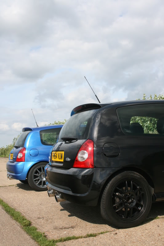

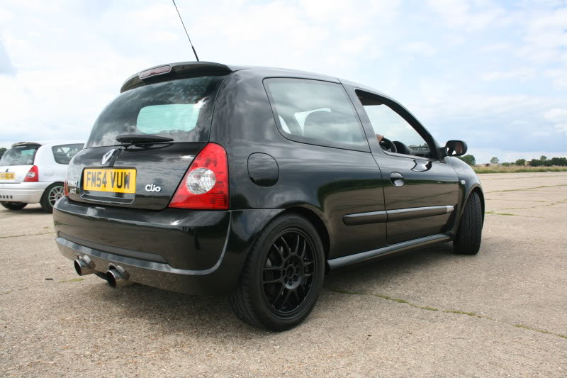

Went to a local Cliosport meet today so a few pictures of my car:
Miltek's
Tripoding (Or trying too, Not the easiest thing to get a photo of, did do better than this, Hankook v12's are shocking though)
1/4 mile up the airfield :)
Rhys' 182 only beat me by about 1 or 2 car lengths, which i was happy with as he keeps up with dmallett's cammed ph1, and has proven on a rolling road to be a strong engine :) And i also have a slipping clutch!!

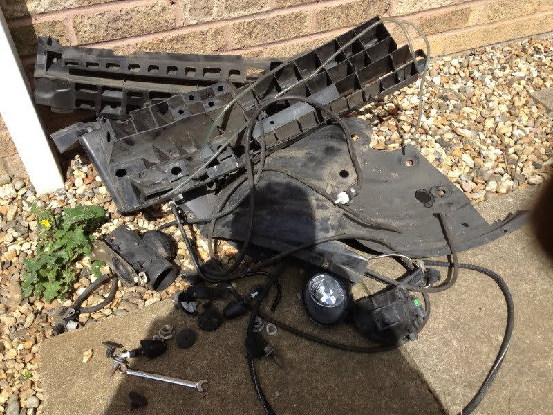

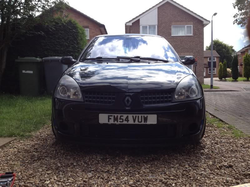

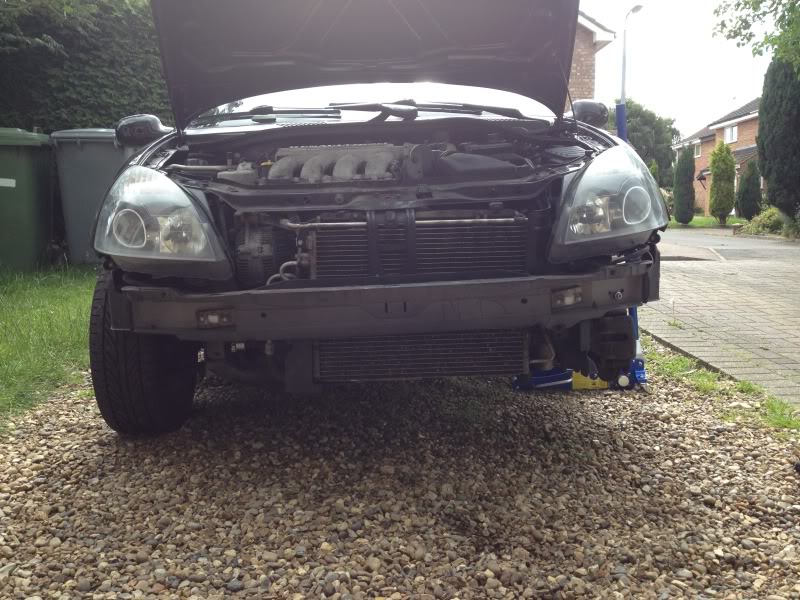

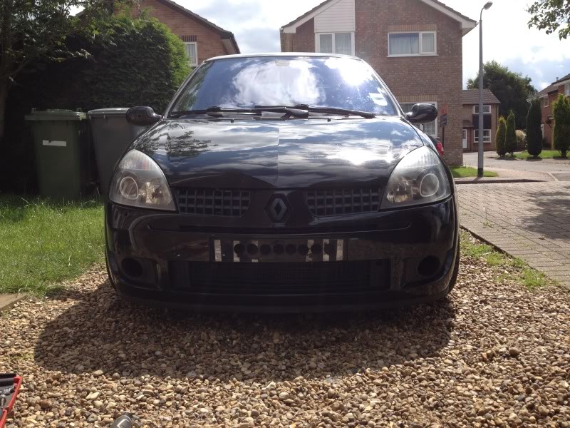

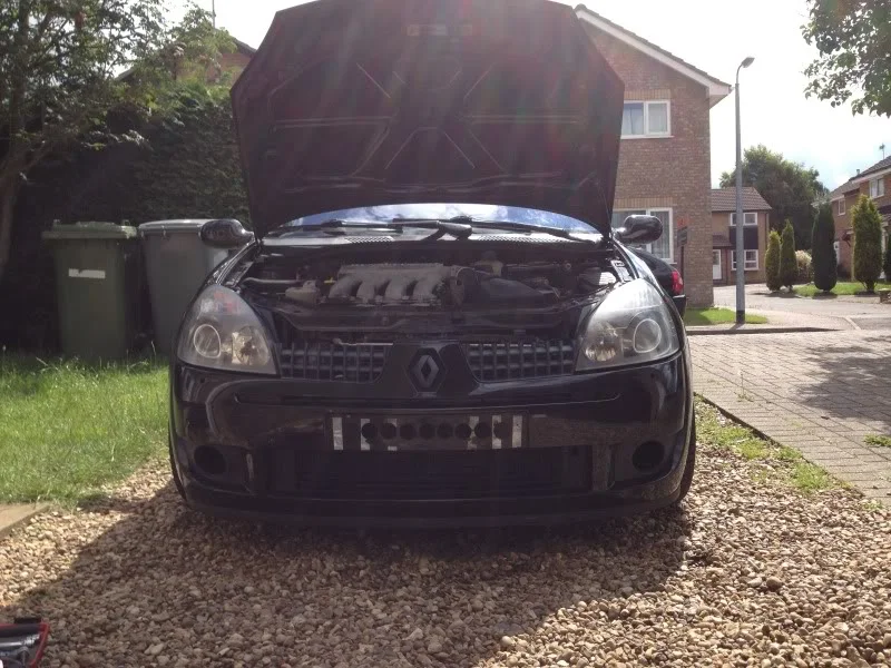

Had a bit of spare time today so got a little bit done on front end.
Bumper off, then i set about removing carbon condensor, acoustic valve, re-locating horns, Remove fogs, Removed washer jets, removed all the guts from the front bumper, cut RS Grill down, put some holes in the bumper because it looks cool :p fit skoda splitter, fit 3/4 plate on velcro.
Photo's are crap as the sun was behind my car and i was using my iPhone, Bumper off, no carbon condensor or horns to block airflow to brakes :)
Bumper back on, plate off showing holes, need to clean sticker residue off from old plates (save that for another day)
3/4 plate on.
Front end is looking alot better. Leaving the Si cup race car style tow eye off for now as it looks mean without it, might get a black TRS tow strap. If i had more time, i'd of removed fog light surrounds, cut excess plastic away, i also need to refurb my headlights again as i done a really bad job. I would of also removed sidelights too as they spoil the colour of the Xenons when they are on, but my hands are too big, save that for when the lights are off.
And all of the sh*t i pulled out :)

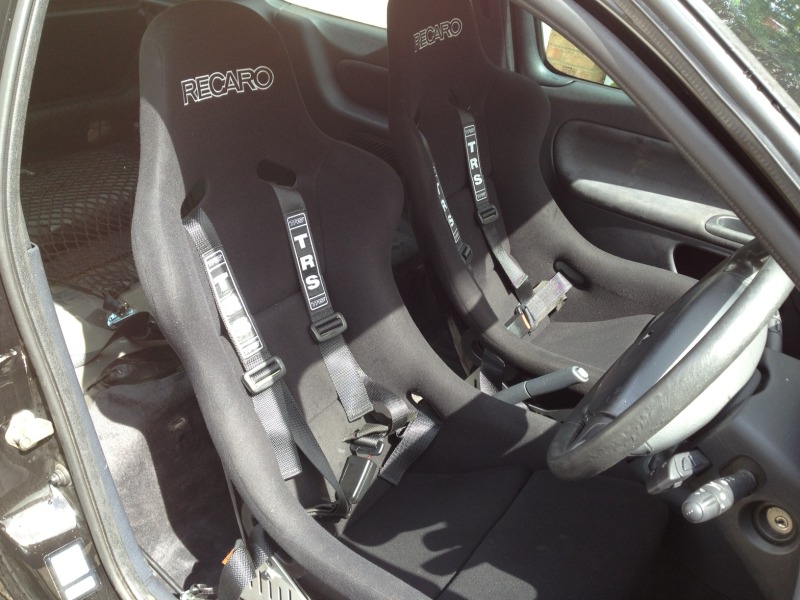

Picking up dmallett's set of Recaro Pole Positions tomorrow. Had been waiting for 1 to come available for my passenger seat, but these were too good to miss, include harness', Recaro side mounts, OMP sub frames and local to pick up! So my old Recaro Pole Position drivers seat will be on eBay as of tonight :)
Will fit them tomorrow after work too if i get time, not as simple as it was on my other cars as the Miltek has a silencer below one of the bolts so means the cat back will need to come off :(

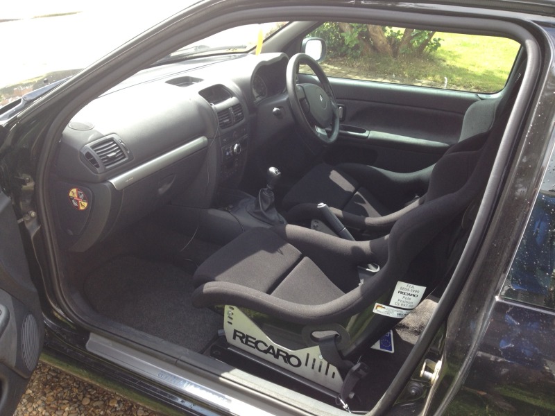

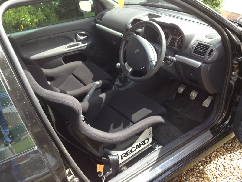

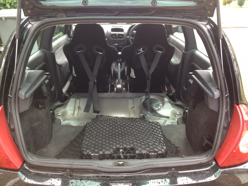

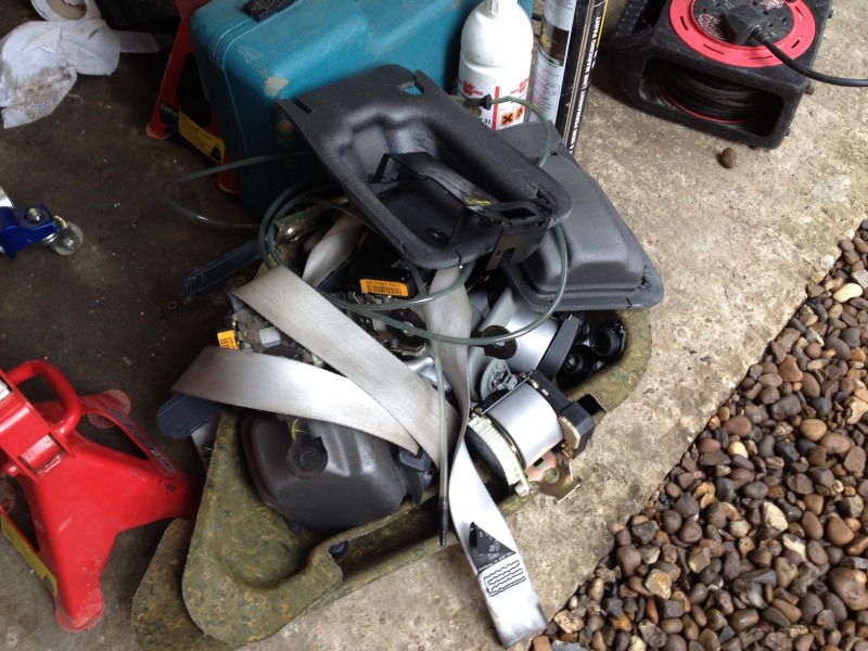

I also got my Recaro's i got off dmallett fitted yesterday, fitted on OMP subframes, Recaro alloy side mounts and TRS 3 point harness', I wanted these as appose to the Sabelt 3" 4 point harness' i had as they were a chore to get buckled into and awkward to adjust for passengers, so moved to something simpilar :)
Rear seats removed, eventually getting a K-Tec boot matt, when i can convince my self to part with such a sum of money for what is only a bit of carpet! Does look smart tho.
This is what i've removed too..

Best seats ever! did you have to adjust them at all to how i had them?
I think the passenger could go backwards to far forwards IMO, driver is spot on! Defiantly, so comfortable! Hense why i bit your hand off when you said about selling up :)

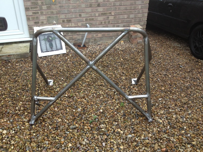

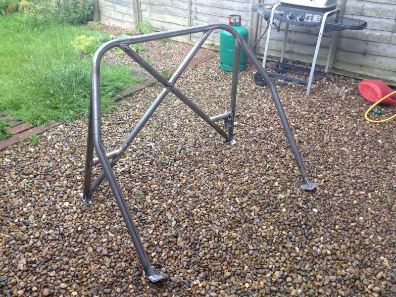

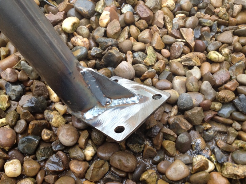

Picked this bad boy up today from a local fabricator i found:
I wasn't expecting Tig's this good for what i paid for it ;)
K-tec's half roll cage, bolt in, as good as it is being that it's painted and uses existing mounts, this is quarter of the price ;) I know it's no full cage and isn't as safe, but for what is mainly a road car, with the occasional track day, it's ideal, main thing i wanted it for was for the harness bar TBH. Off to powder coaters Sunday ;)
If anyone is interested in one of these cages PM me...

Steve got his the other day! Very impressive fit, had to squeeze it in through the front door lol
He said they were selling well (collected mine) What spec did Steve go for? Seats out to fit it i take it? What about Dash?
Re: Boosted BlackGold Project - F4rT content.
Seats out, dash should be fine :) we tried to fit it mine through the boot but had no luck lol
He got the same minus the harness bits.
Ah right nice one :) Shame as it would of meant his K-Tec boot matt could lay flat lol.
