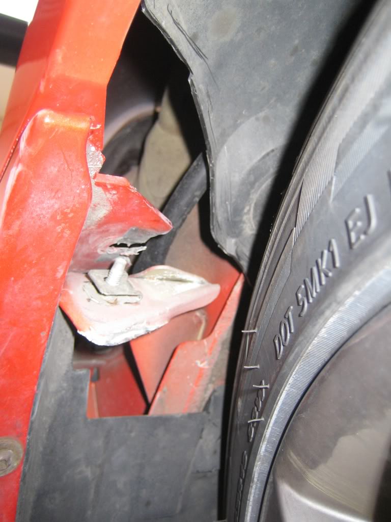

Maybe good to ask them to alter your front bumper-brackets. When you feel along the wheelarch you'll feel them sticking out. This is one point where i know i'll get scrubbing..
I worst case they could take out a front tyre :eek:

I'm not sure, Think bumper needs to be removed ? Fred (Yozza) knows, pm him he will tell you !
ps; do check what i'm talking about, it will scare you how dangerous the design of this is when lowering / widening track

I suppose they could take out a tyre, but this happened to mine first! (Tyre didn't even have a mark)...

:dead: ok point taken il make sure i check it out, can the screw not be "cut down"

The bolt isn't the problem. It's the bracket it goes through. The bracket in the pic above has been bent down around 60 degrees when the wheel caught it. Either cut/grind/bend the bracket out of the way. Tip - move it further out of the way than you think you'll need, especially if you carry a fat passenger like I did.

Oh ok i understand thanks for the tip,looks like it made a good job of your arch bracket.
under hard turn in i supose it will do the same as taking a large passenger!
