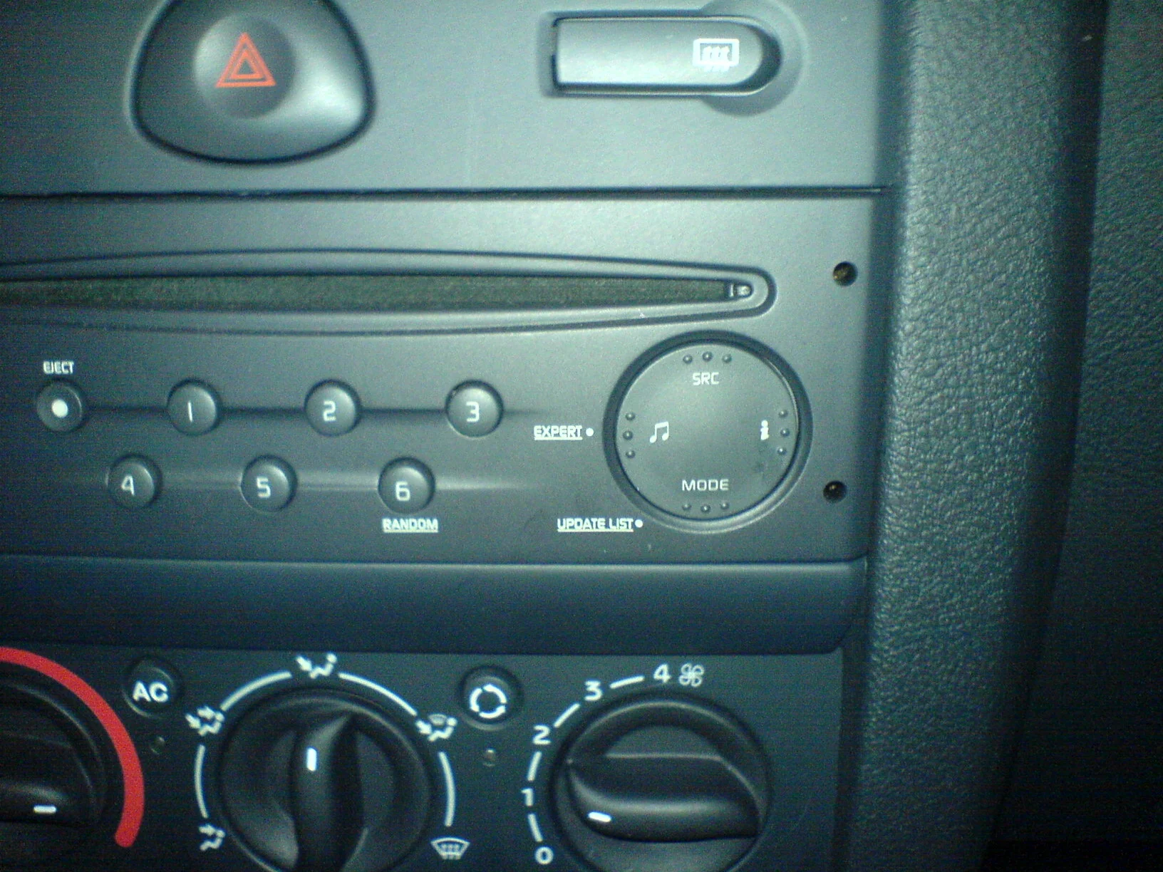

check the expert menu!
if it is the standard headunit you can go to the expert menu and switch the mw, lw on and off!!!
You need to hold down the button (well inclue picture in a min need to go take a photo!!!!)
When in the menu you can switch it back on
its the music note button!!!
see picture

cheers rob im away to muck around wi it now, ill see what happens
