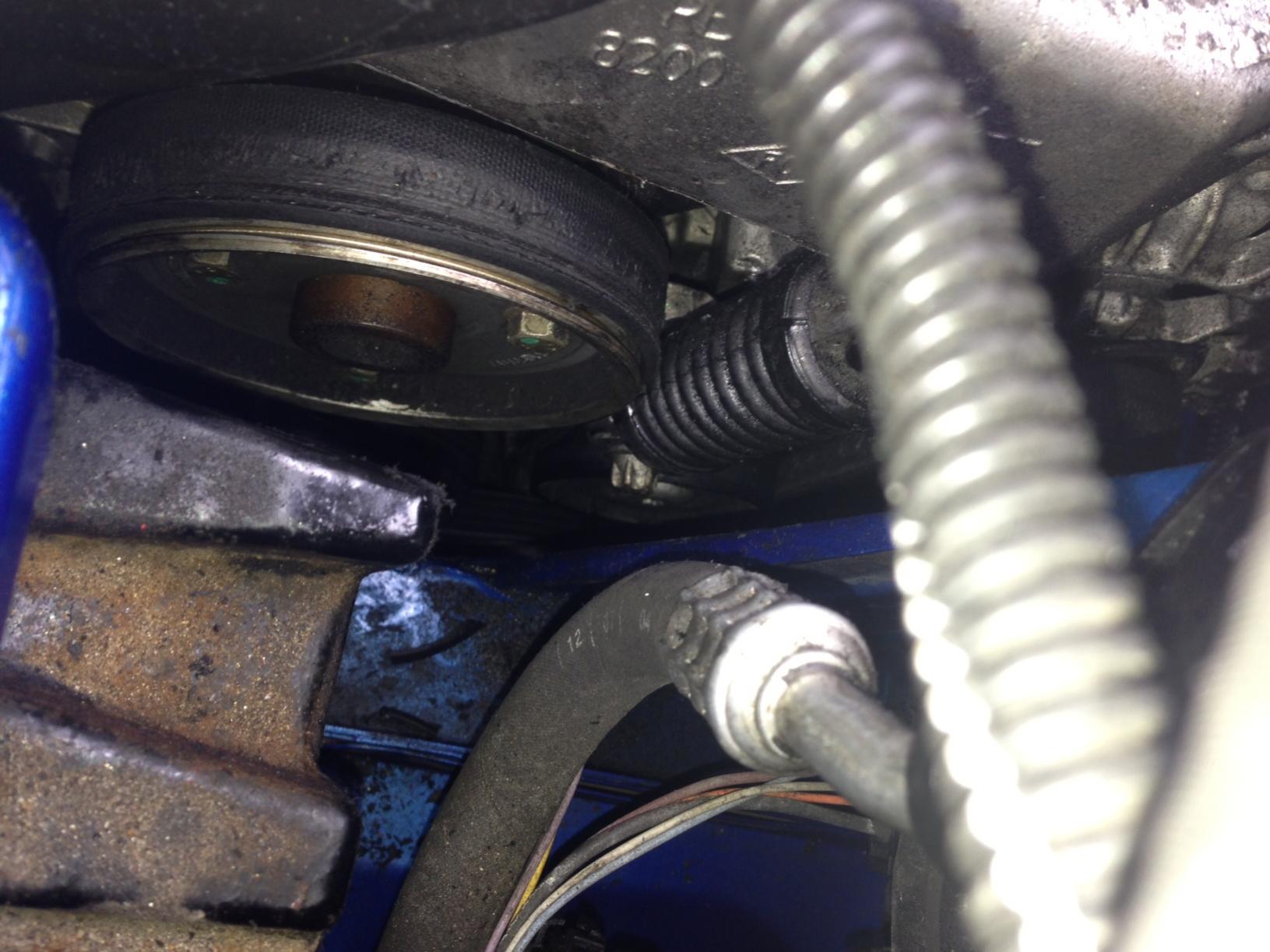

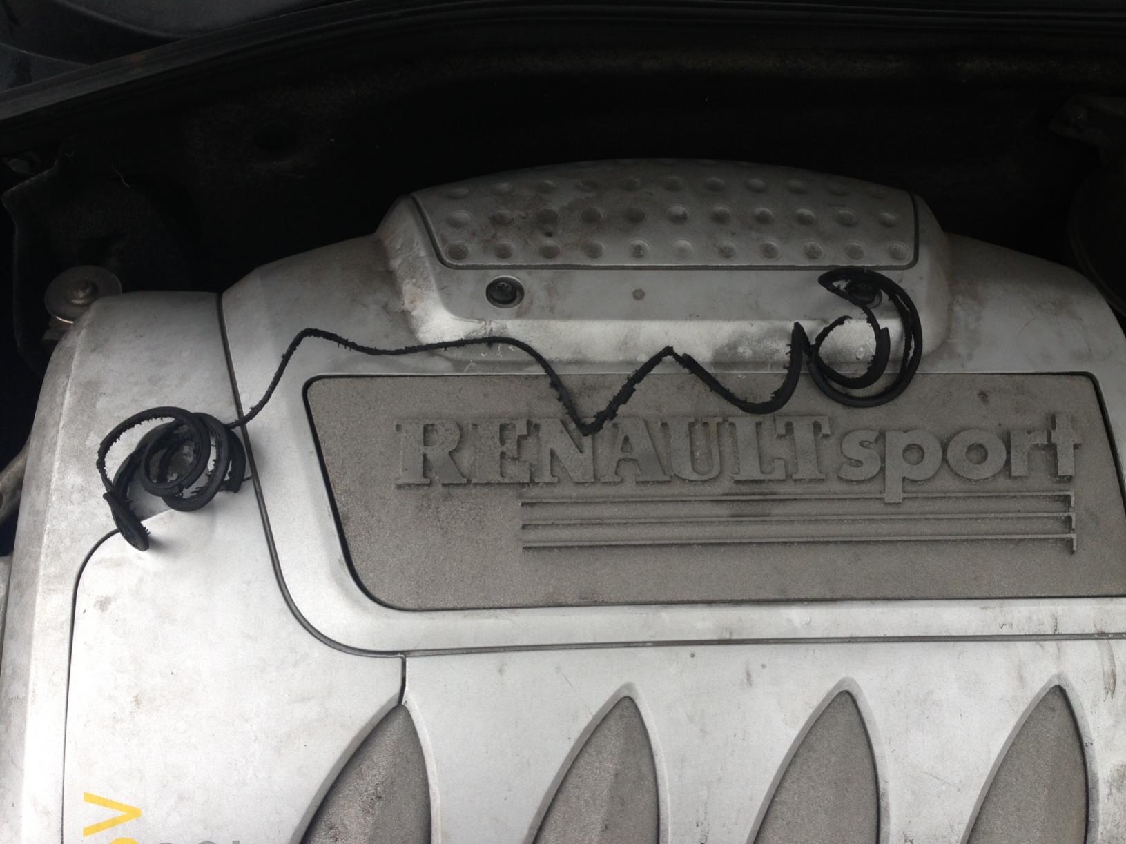

I managed to get some photos of the snapped belt at the roadside. the first picture shows the belt shavings, the second pictures shows the aux belt afterwards, obviously you can see the top section of the belt has been shaved away, but still seems firmly on the pulleys
After seeing these photos could anybody hazard a guess of how this could have happened? Could the belt 'jumped' for a split section out of place as it was oily and cause it to scrape on something else causing the shavings? (i.e. the cambelt, which in turn would of made that jump and ruin the engine?)
I really have no idea, but as much information as i can find out from you very knowledgable people now will avoid me being given the spill by the mechanic, and worst case see another 182 off the road as no way could i afford to fix it if he manages to worm out of anything some way i've only just bought it :(
  monaco 172
Could have put the belt on the crank wrong causing it to pull across, a well respected guy on here managed to get this wrong on mine. Causing the belt to be a tooth out on all the pulleys.
Luckily I noticed it in time, bought a new belt and sorted it myself.
  182 Trophy
belt is rubbing on the tensioner. Tensioner is seized and should have been replaced
This. I had exactly the same issue when I replaced my alternator recently.
It's not like you can even miss this, though - it made refitting the belt an absolute arse of a job. It's obvious when the tensioner is seized and I'd say that he either did it knowingly or he doesn't know what he's doing, especially if I can figure it out - I work with IT for a living :p
