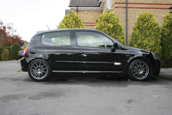

I have a FF 182 and i have lowered it on apex springs 30mm all round however it seems to sit lower than a typical 30mm drop and sits as low as my m8s 172 cup that is pretty much slammed on Gaz coily .
Anyway...I now have the problem where by my cat is rubbing and banging on pretty much every speed bump or lump in the road and it keeps getting knocked out of place from the join to the system thus creating a whistling noise and its doin my head in. :dapprove:
Has any one els had or heard of this problem?
Ed
http://i593.photobucket.com/albums/tt20/escotty90/IMG_0278.jpg
