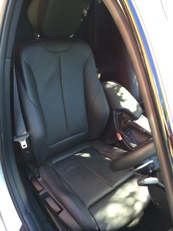

Had to take it back to BMW again today - the new drivers seat cover is for a 5dr M135i not a 3dr. As such, its too narrow (the seatbelt fits onto the seat on the 5dr, but not the 3dr), so there's a large gap down the side of the seat. How they thought i wouldnt notice i have no idea :rolleyes:
Luckily for me, RealOEM works very well on iPhone, so i was able to show them the error of their ways in front of some other customers.

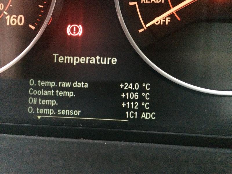

So last Tuesday the fan came on again :mad:
Pulled over, switched it off, then back on again (used to clear it), but no such luck, car stayed in limp-home mode.
Unfortunately, that is where it stayed until this morning when i took it into BMW. The fan design has been updated again apparently - there is issues with the temp sensor, so it doesn't turn the fan on properly at 90oc. Instead it gets too hot, then all hells breaks lose and the fan goes into overdrive. As such, mine needs to go back in on the 23rd October for 2 days to get the new parts fitted/big software update. My concern is (& BMW didnt seem too worried by this), is that as the fan seems to have failed completely, the coolant temps are getting rather high imho!! This is shown by the "hidden menu" below:
