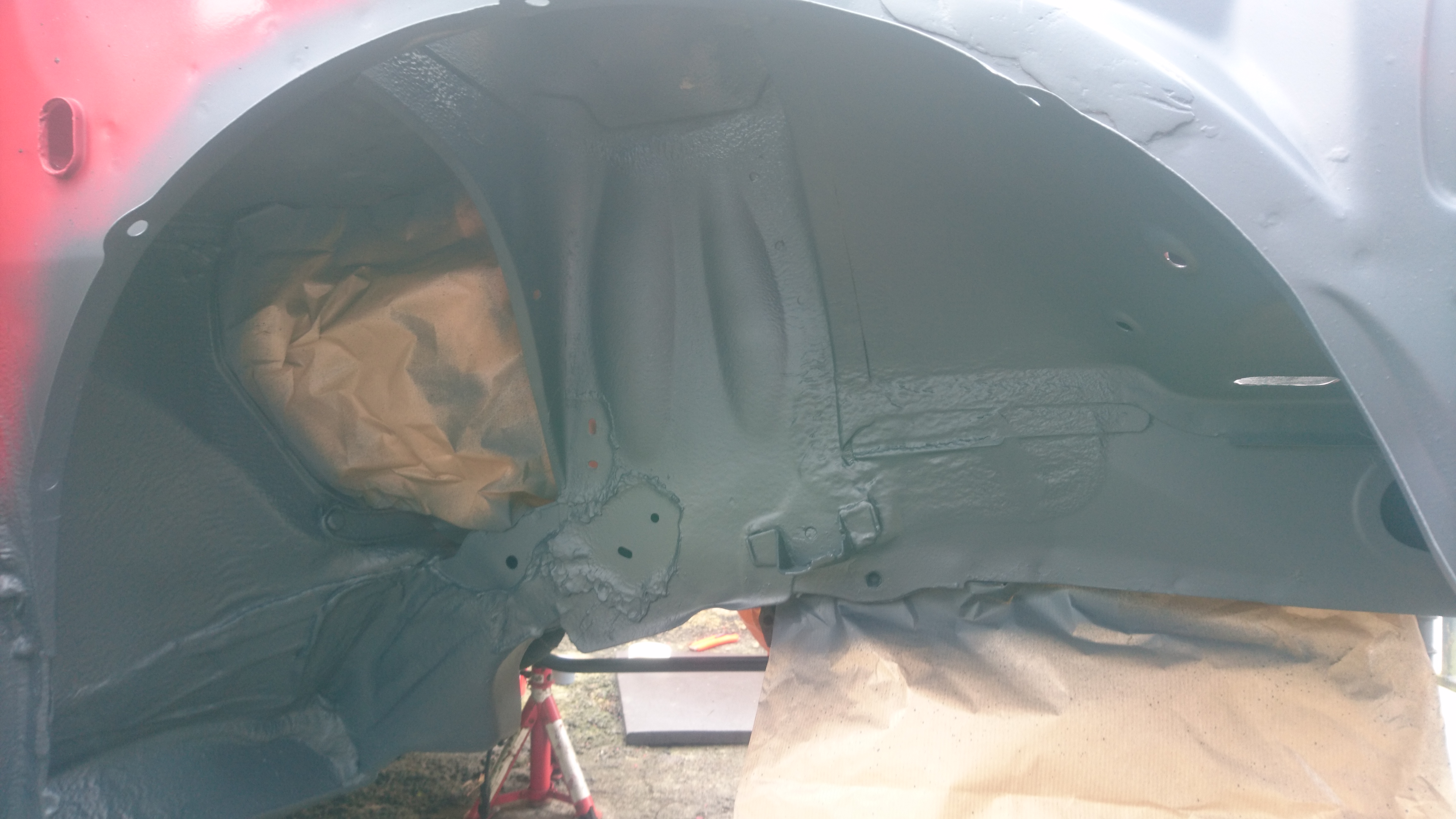

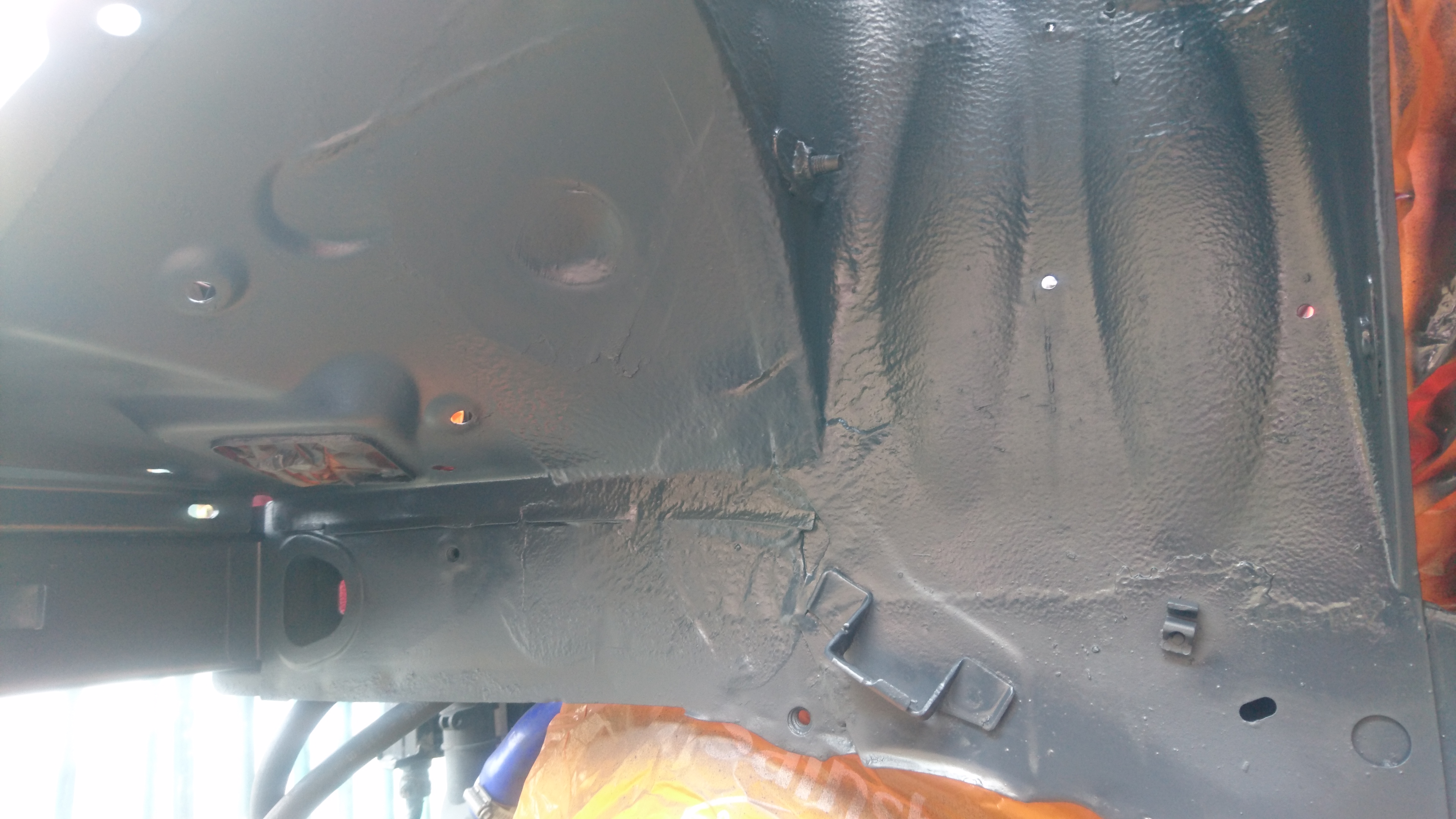

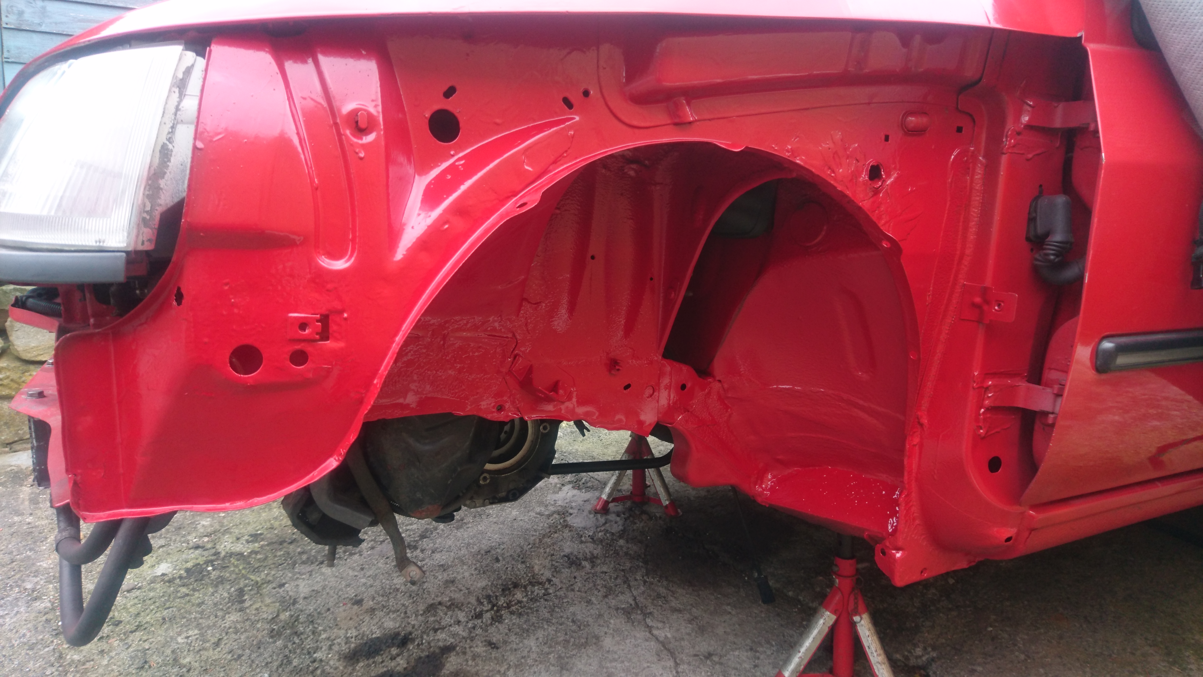

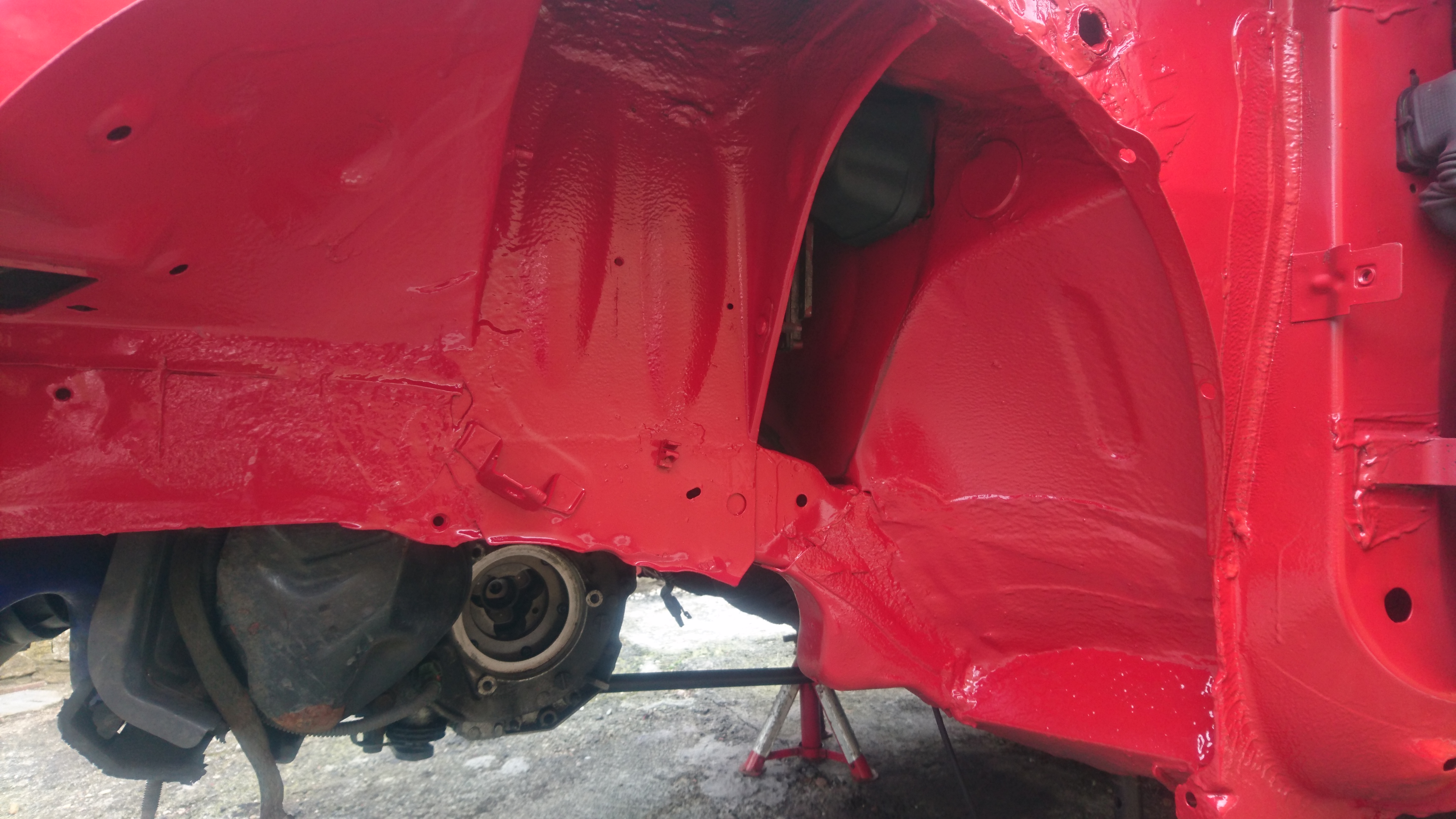

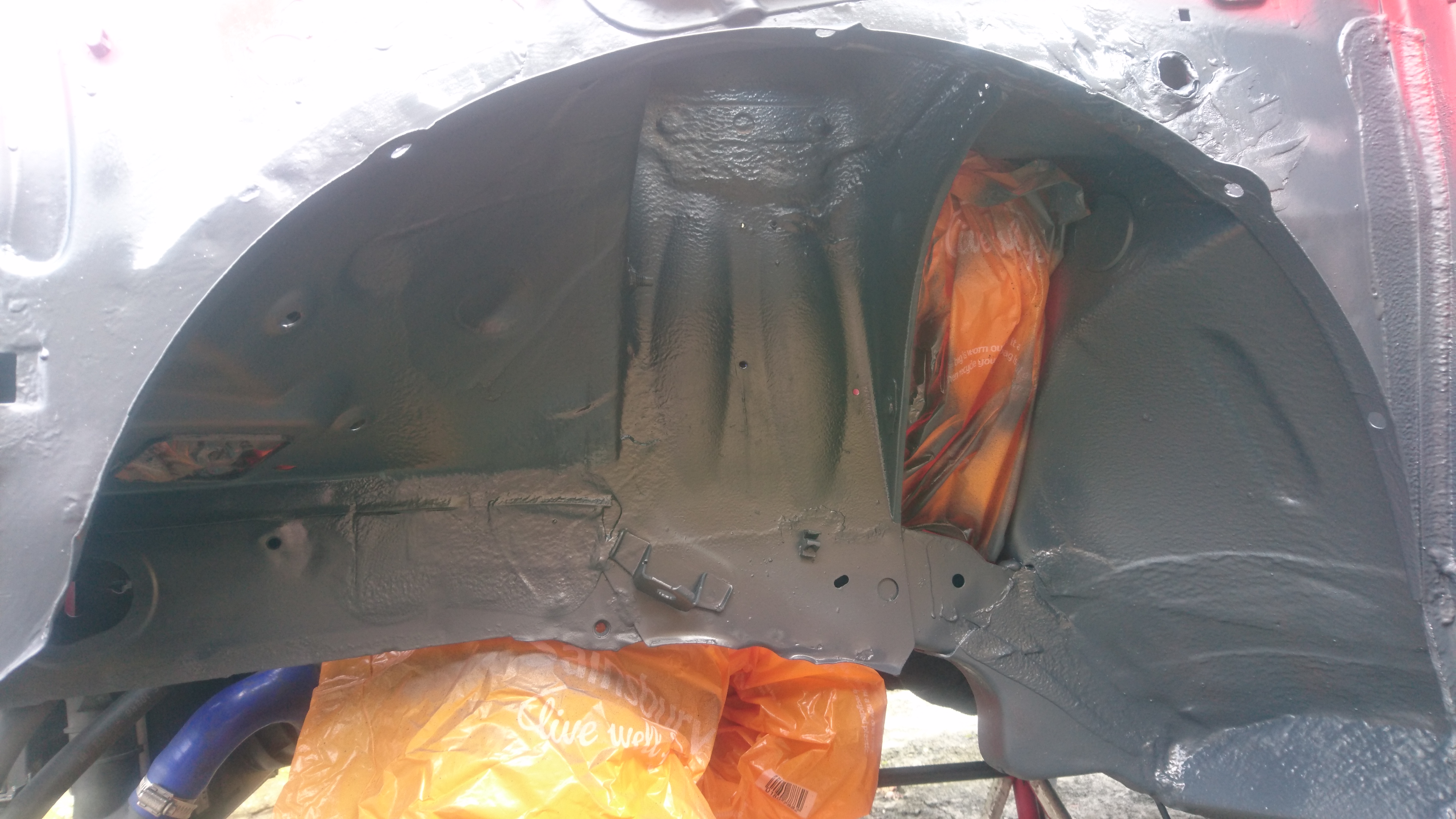

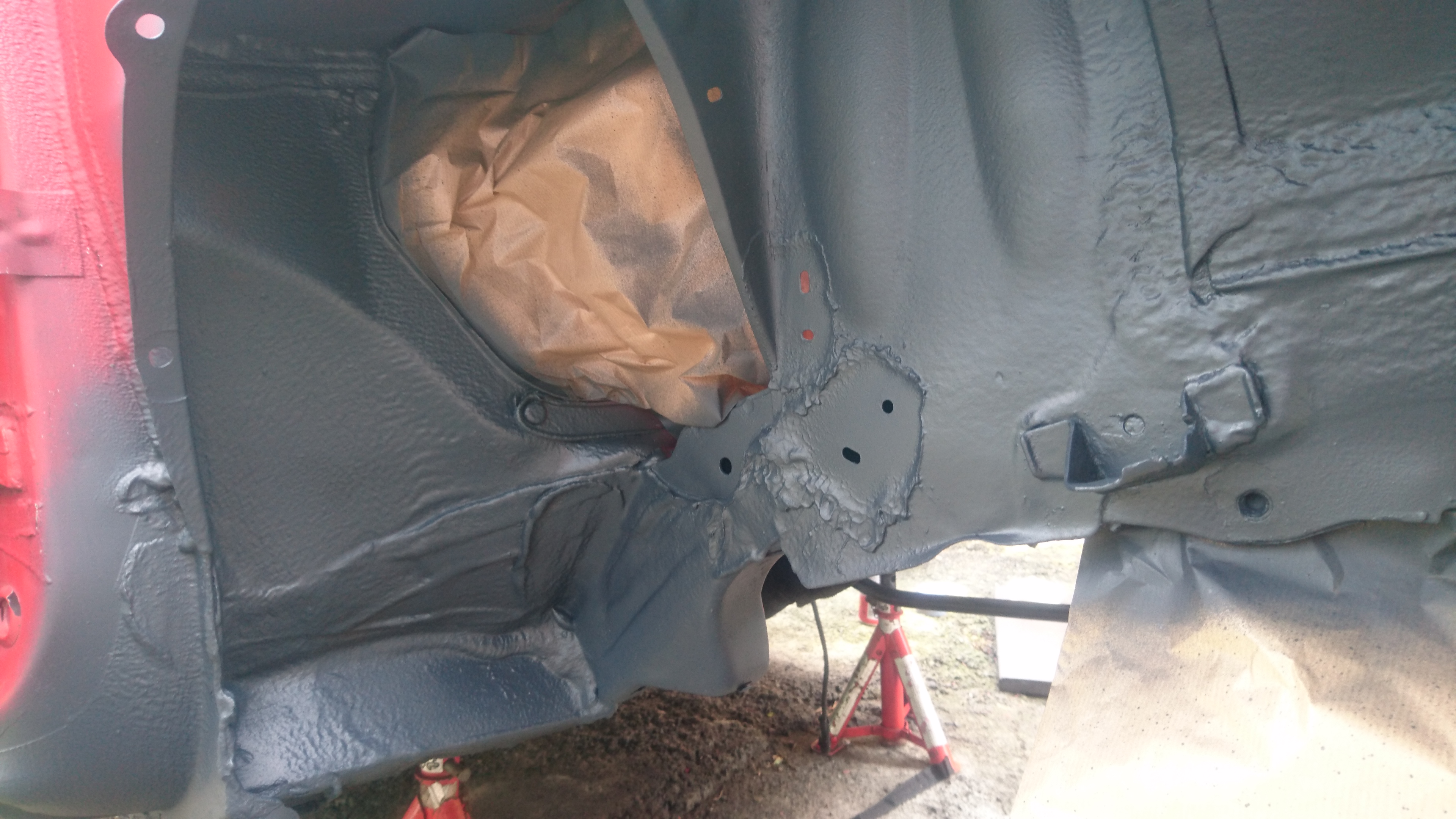

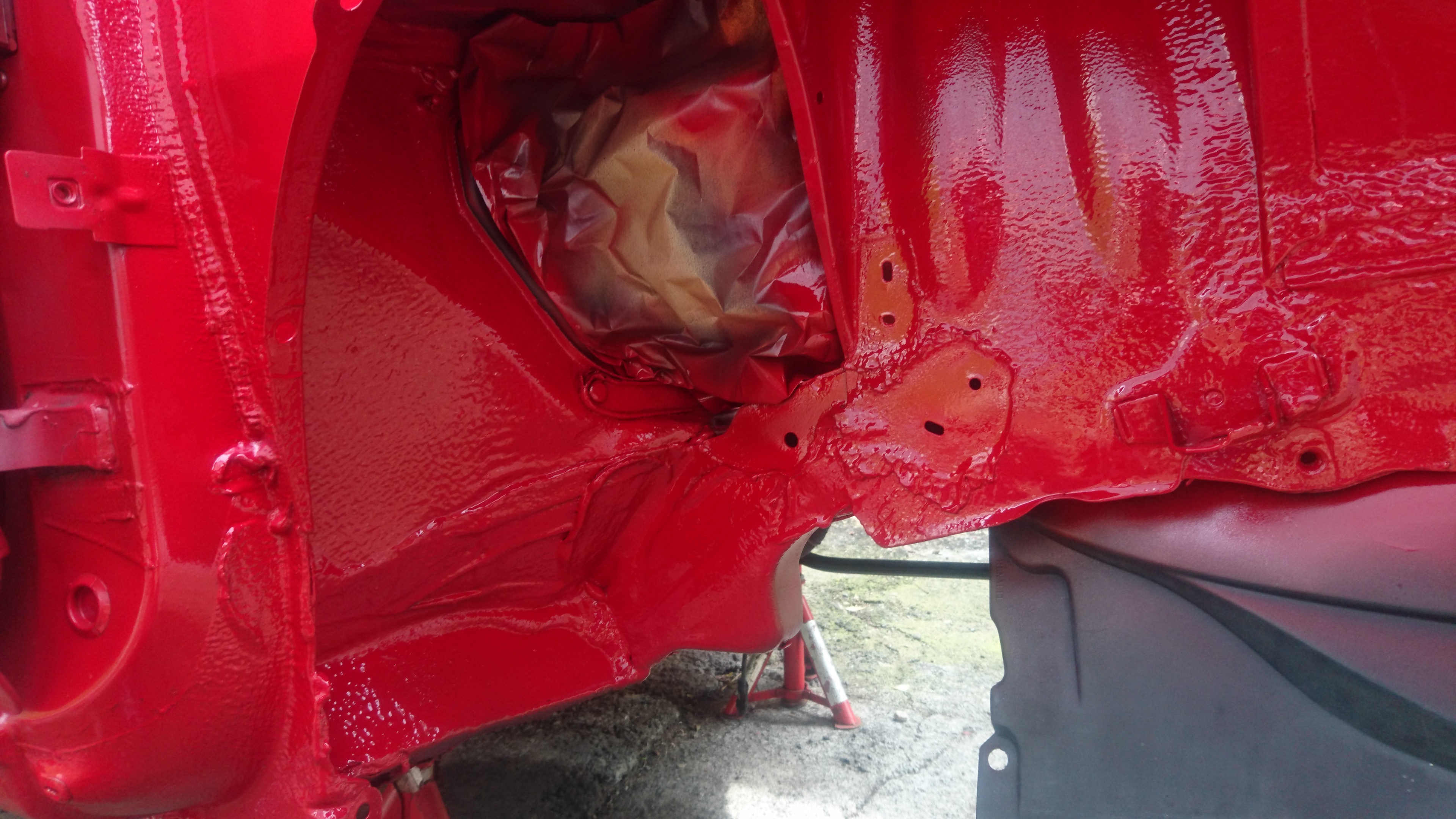

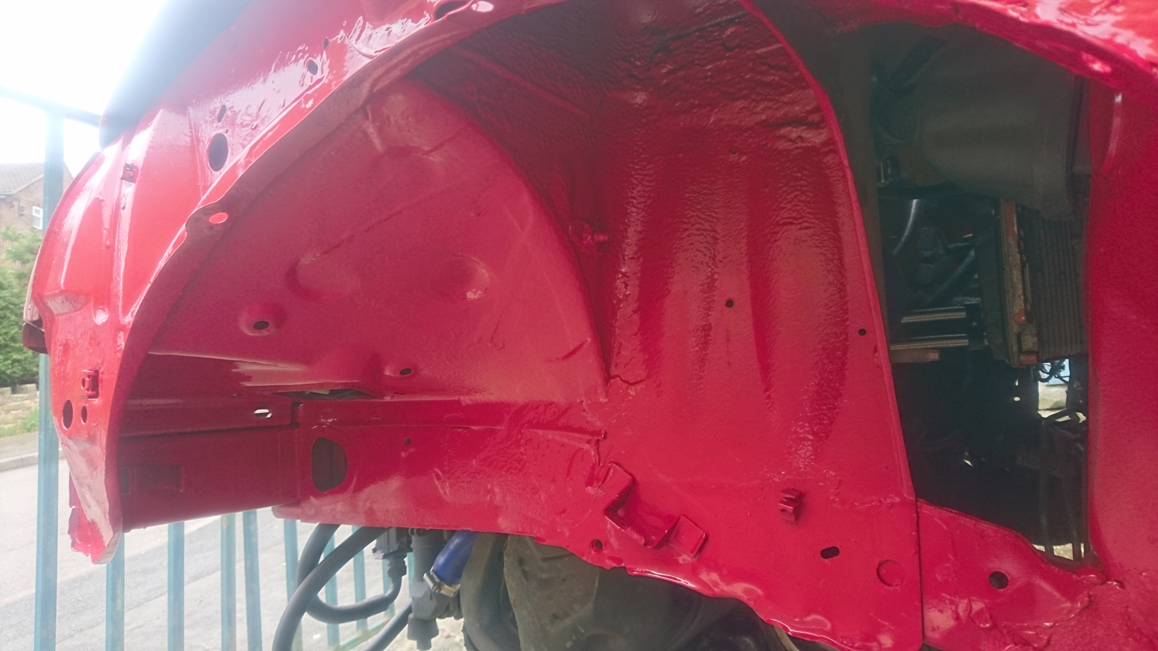

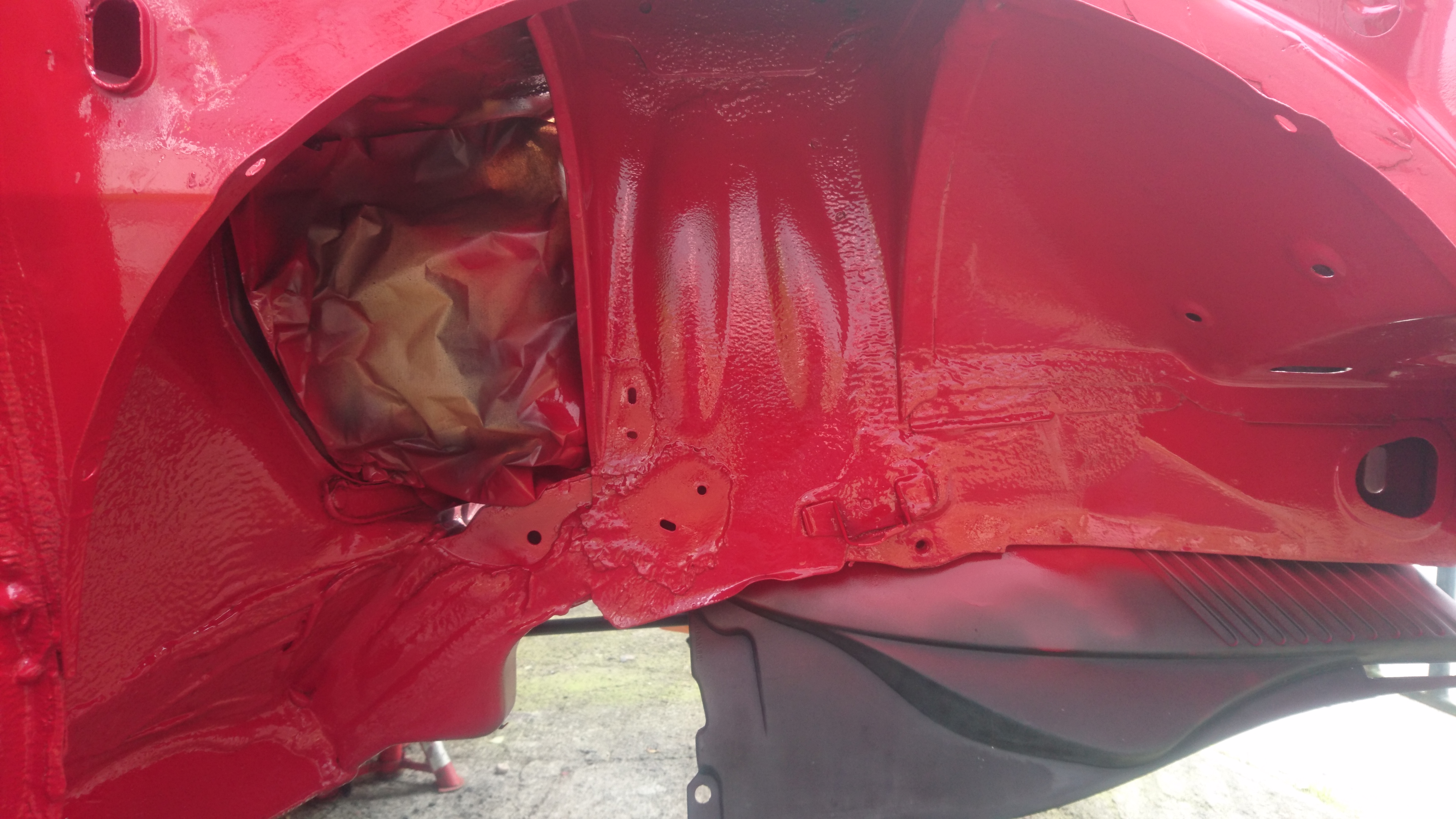

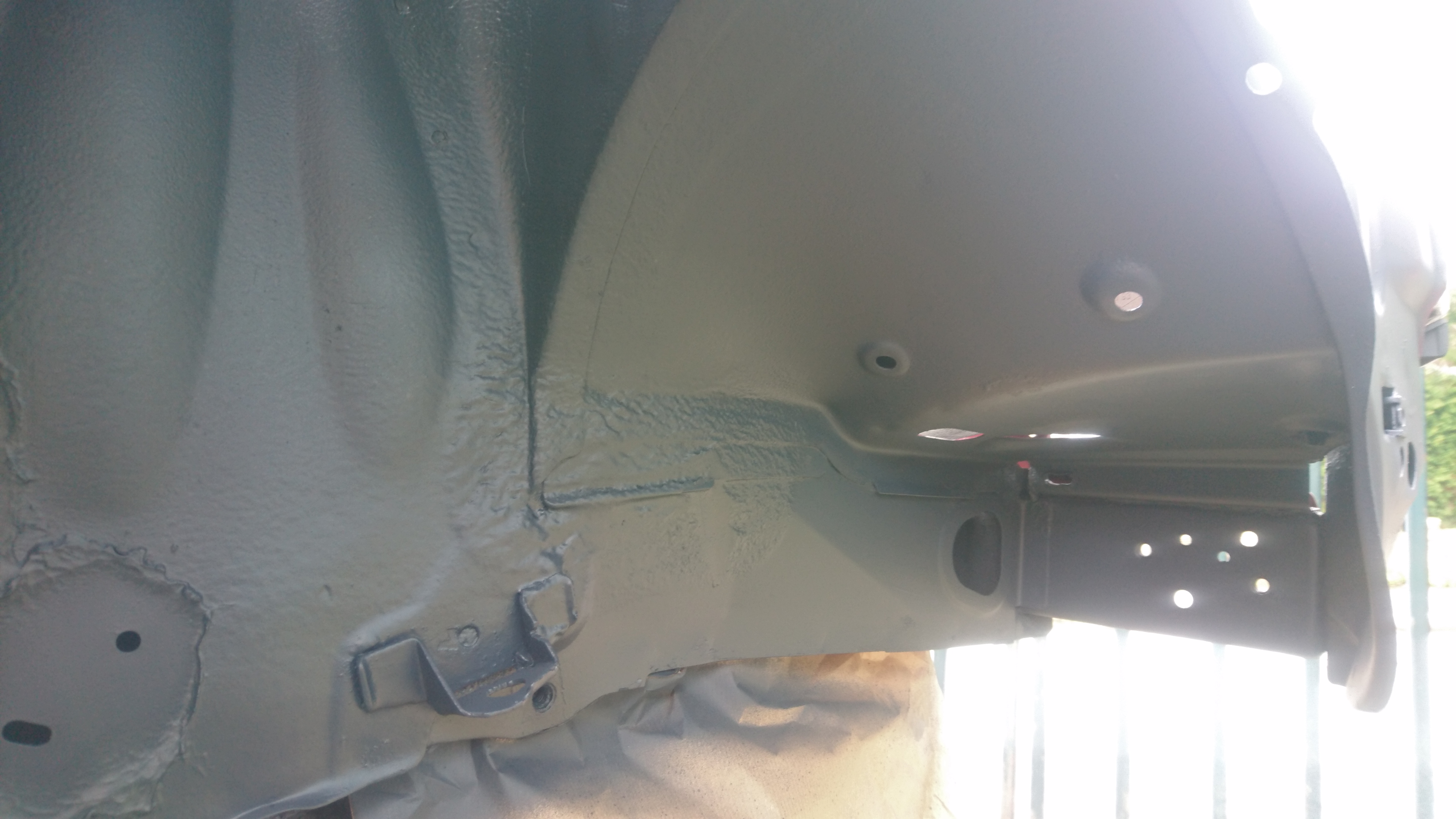

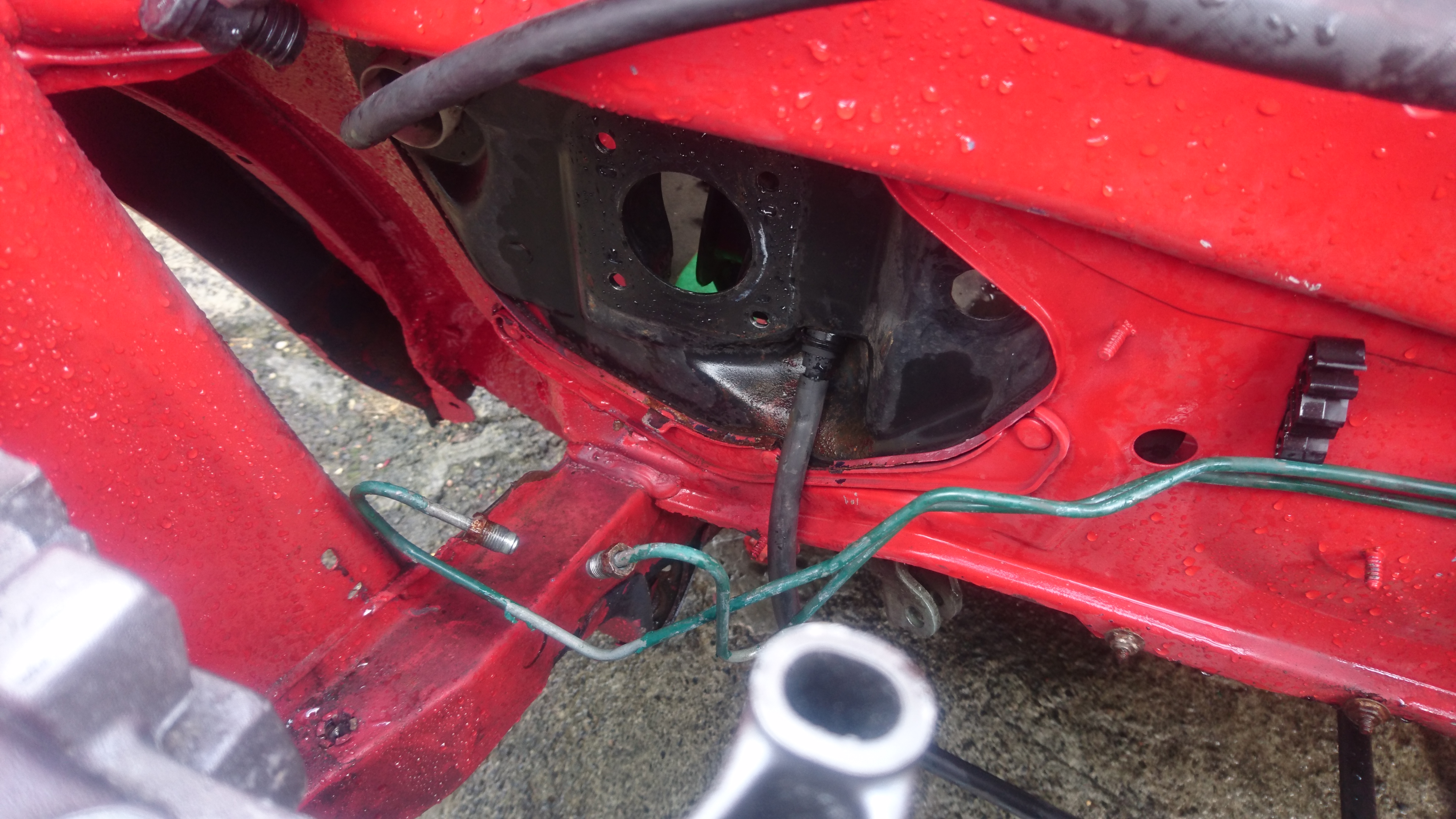

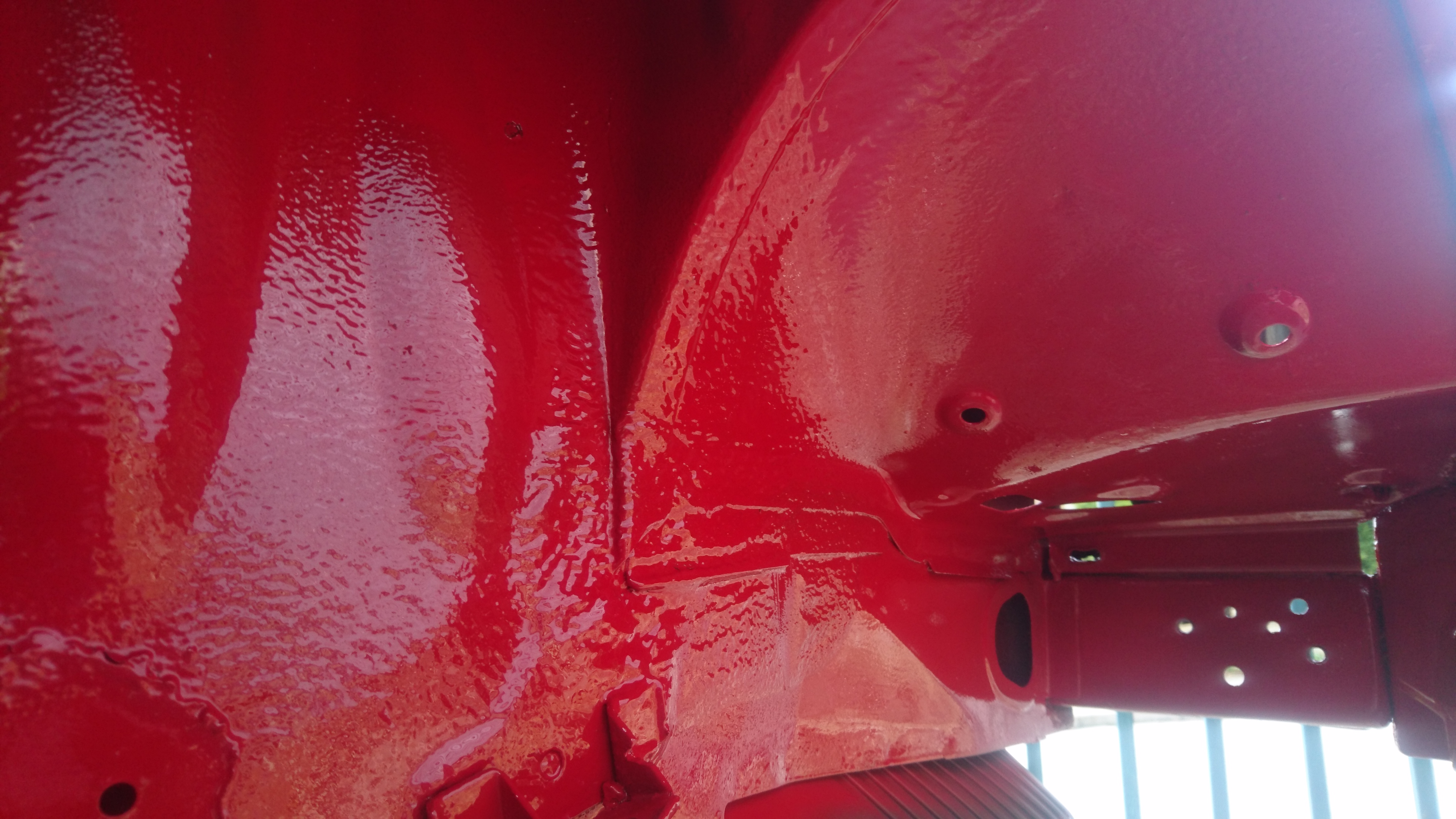

30-03-2018 Arch Painting
Weather was okay first thing this morning, so badly masked up the arches and set about them with the stone chip.
Got two layers on and then naffed off out, so left it to dry and got back in time to cover the car back up before the heavens opened.
I'll attack the lot with the red paint next time spring decides to attempt to sprung soon ,lol!

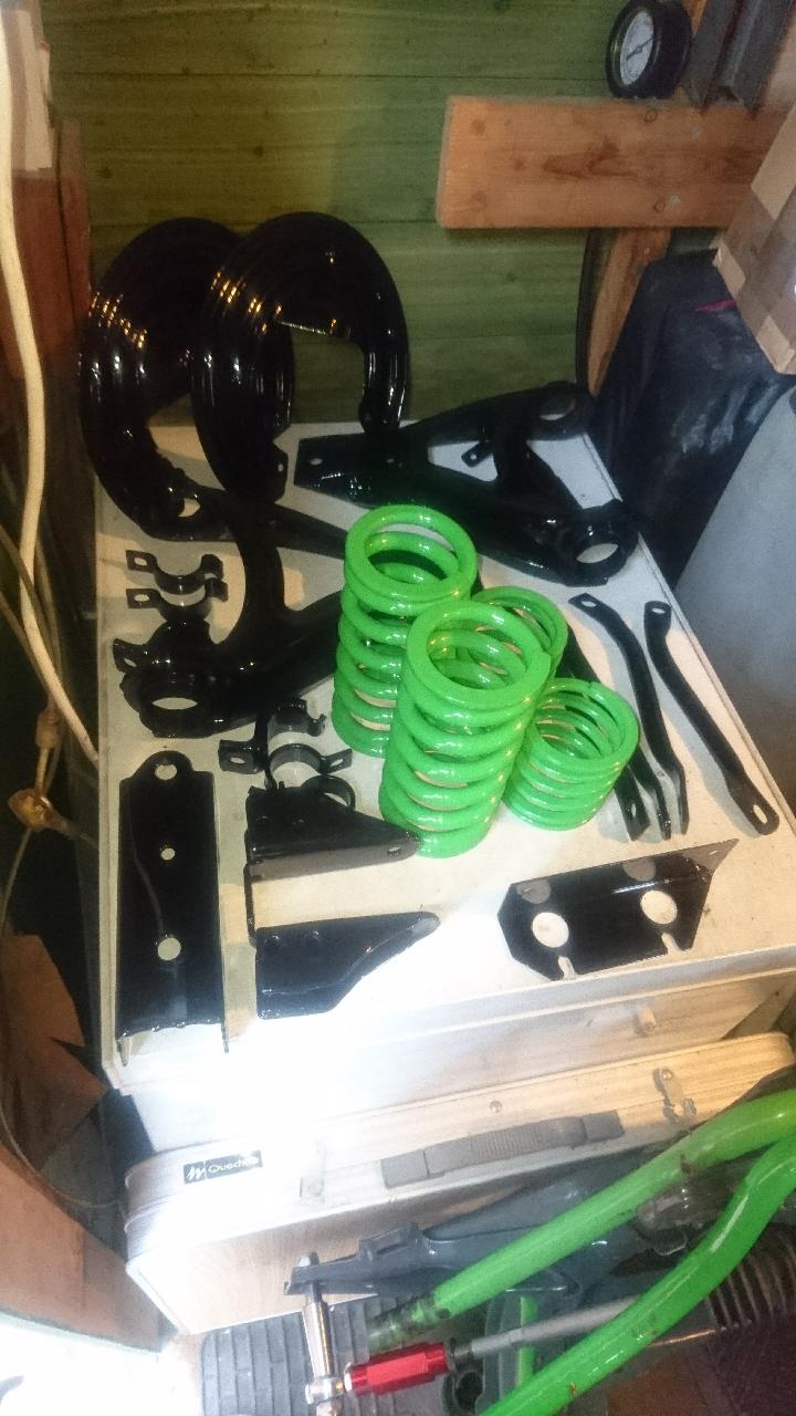

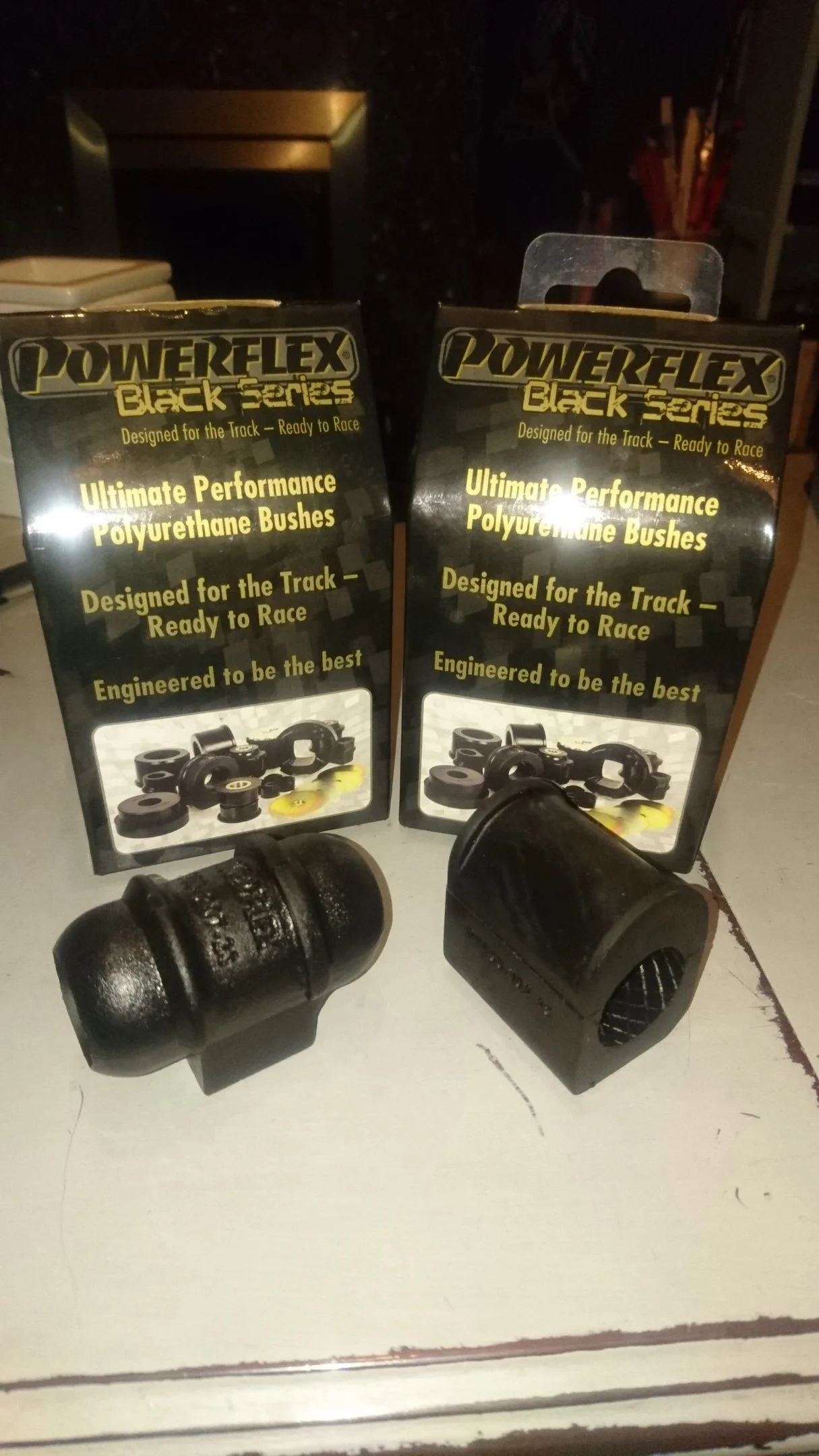

New black series arb bushes purchased. Sticking with purple on the wishbones for now as think I'm going to go pms spherical at some point on those.

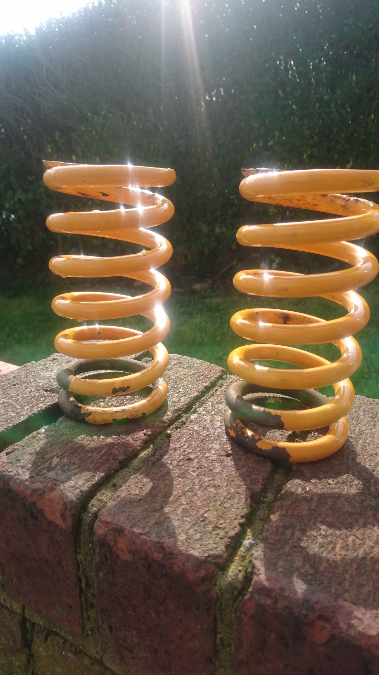

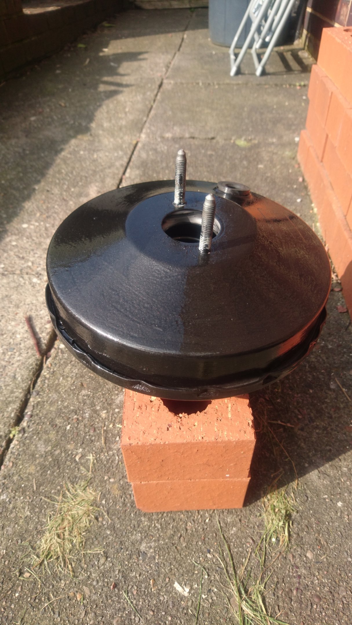

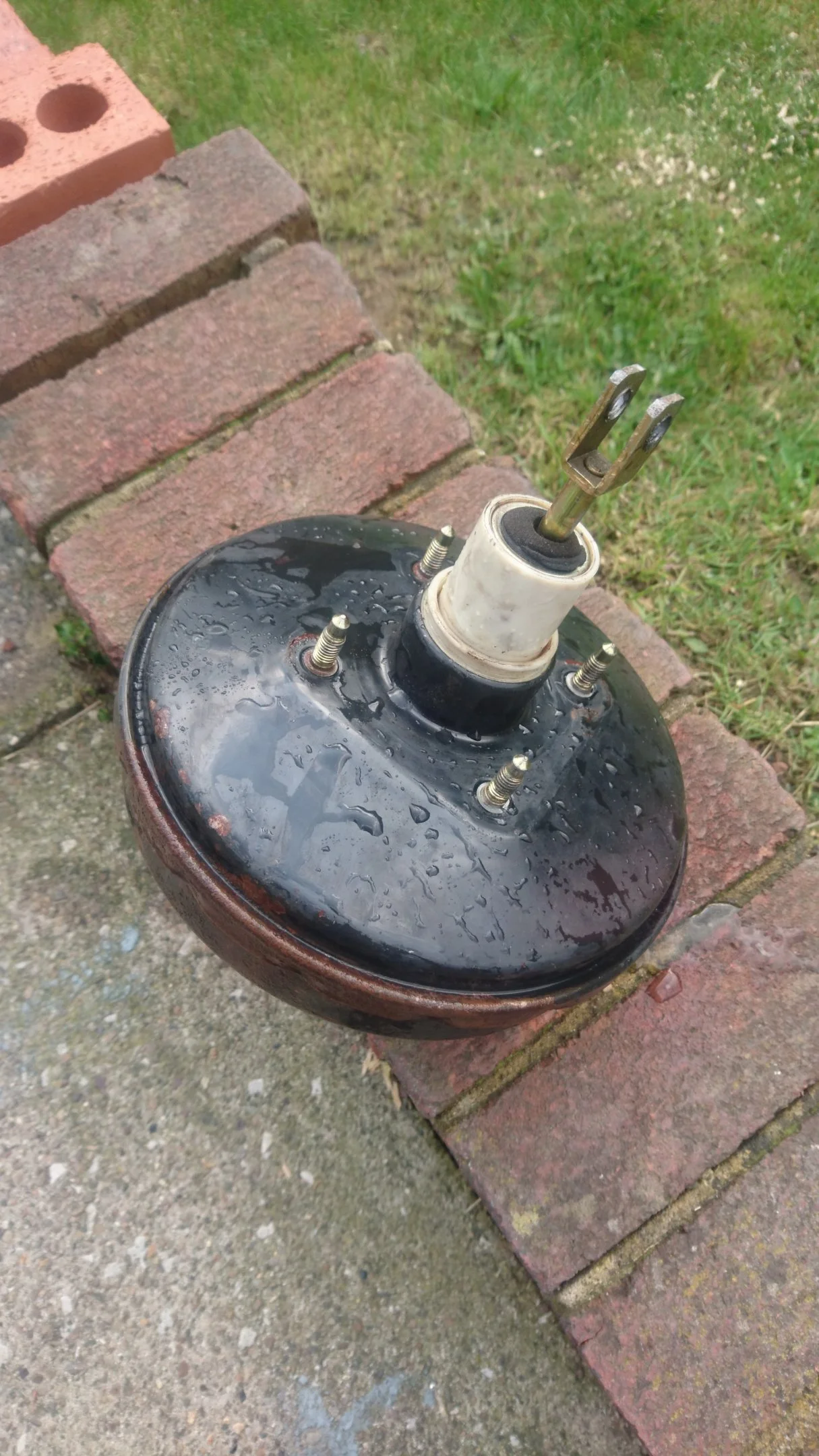

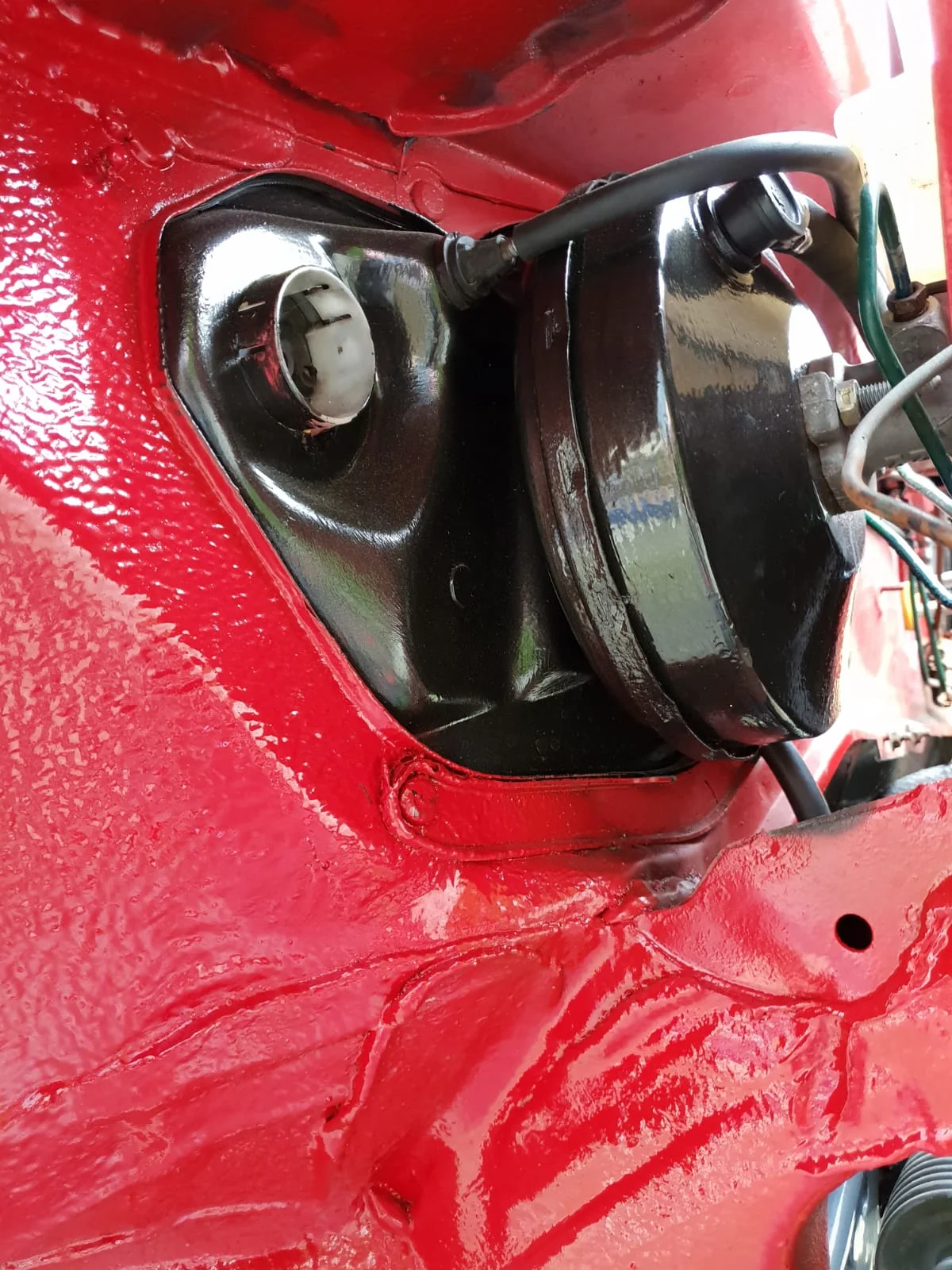

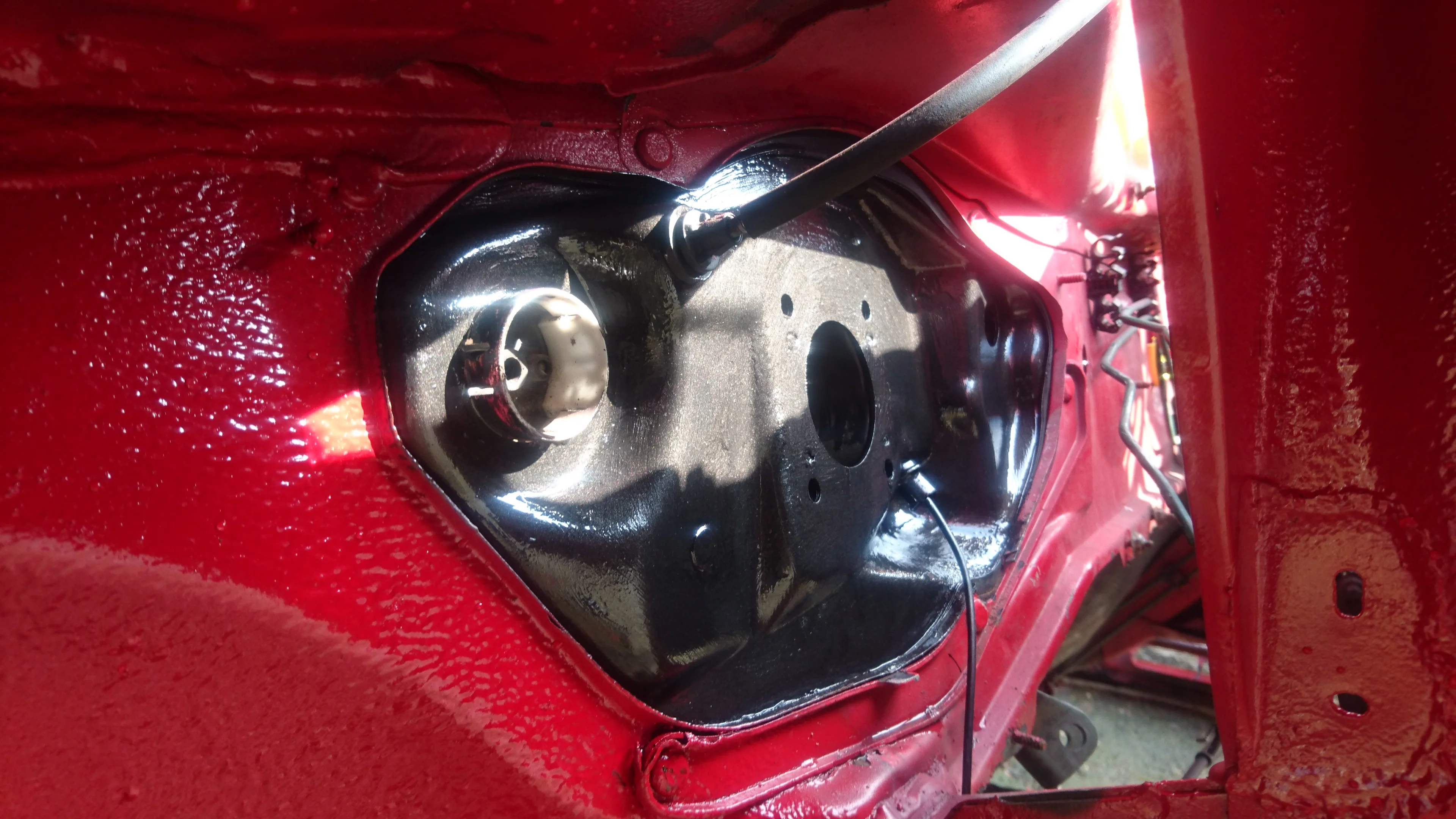

Bit more painting recently, tidied up front springs and brake booster plus the pedal box panel in the chassis.
About ready to start popping it all back together now :-)
Had to remove manifold again get the booster out and no pics of springs finished yet, I'll assemble them back to the coilovers before the reveal ;-)

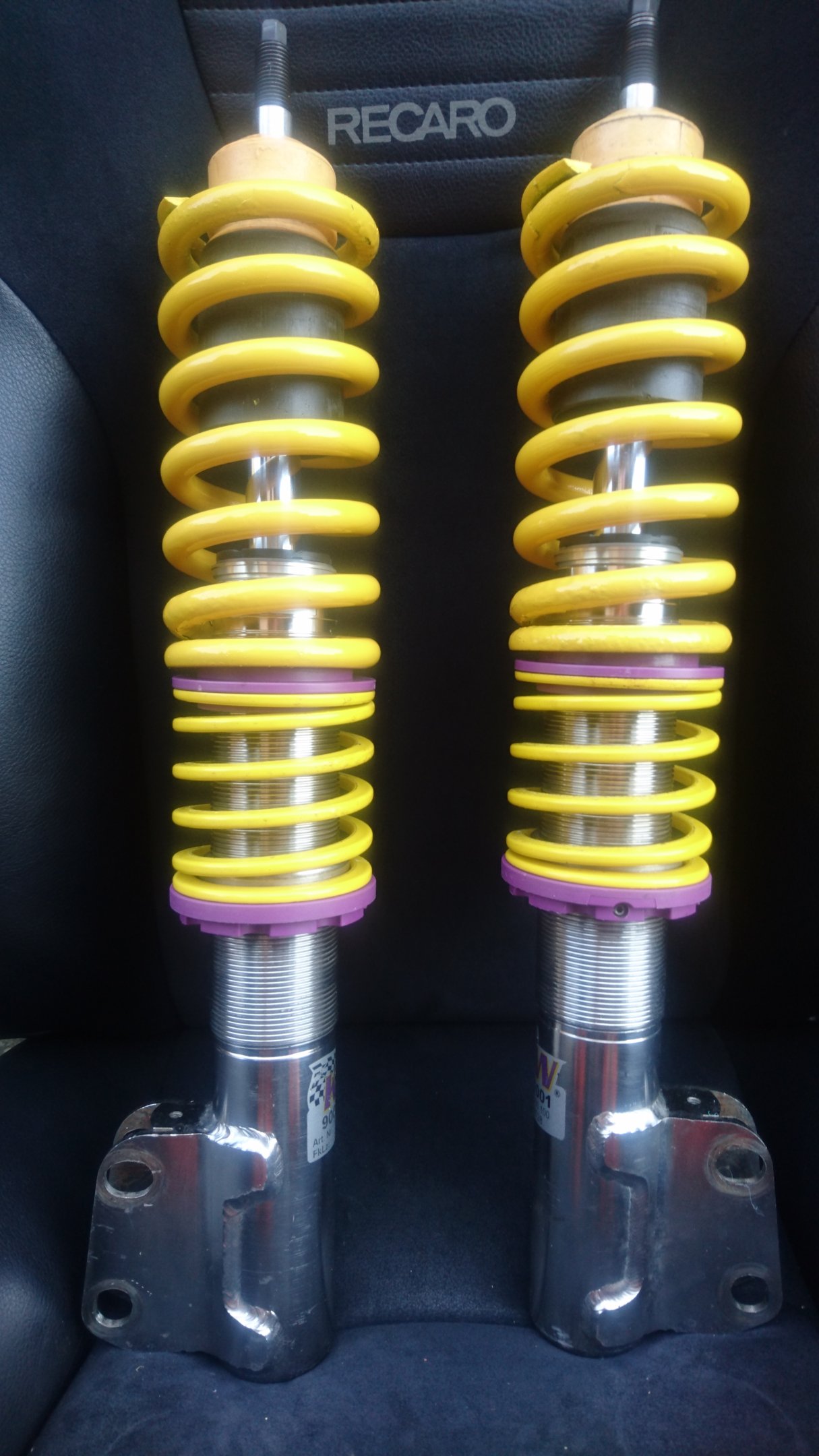

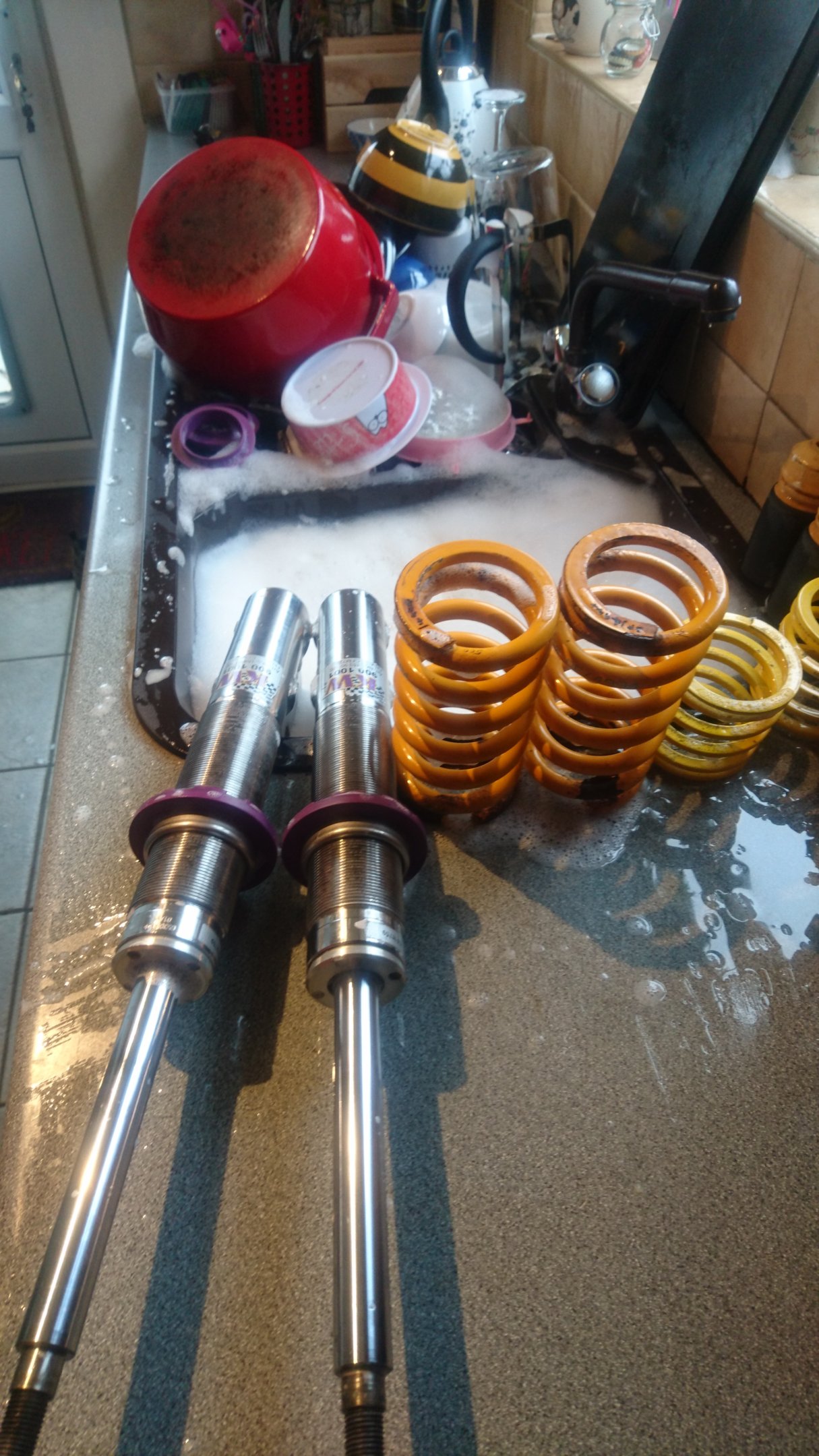

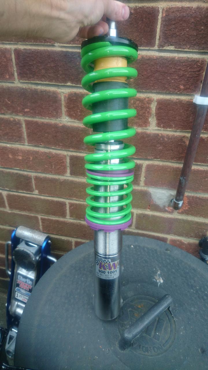

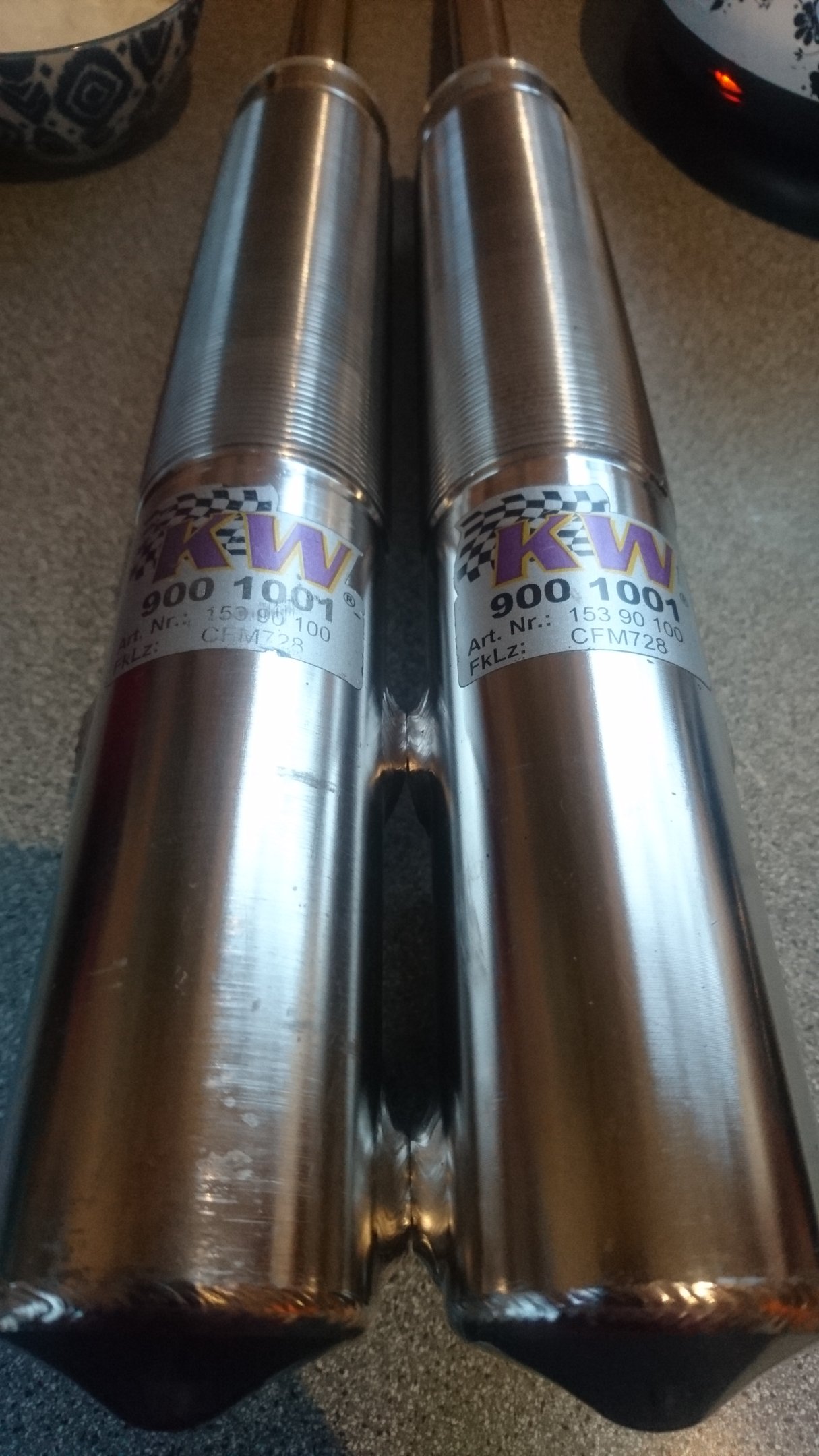

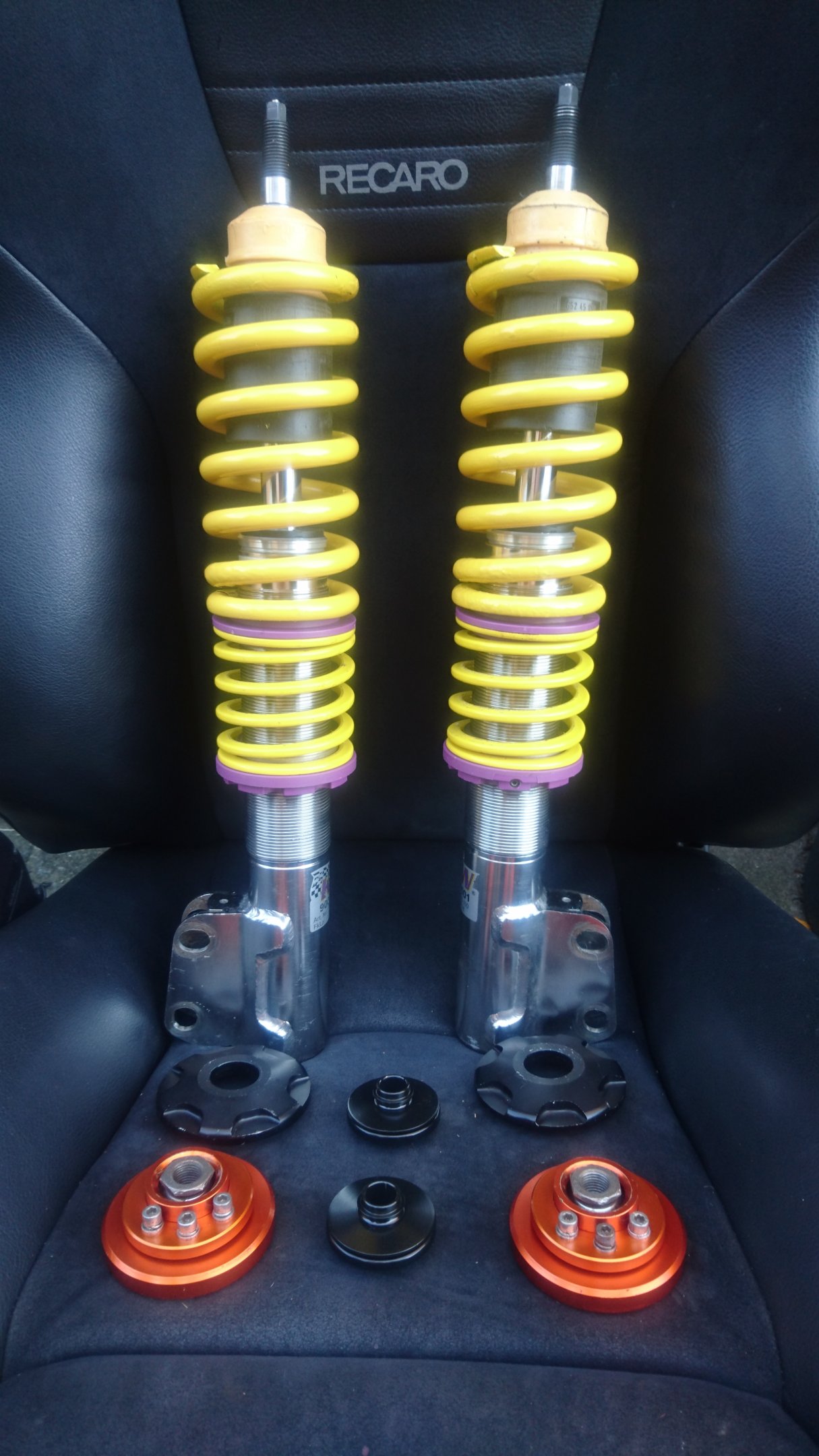

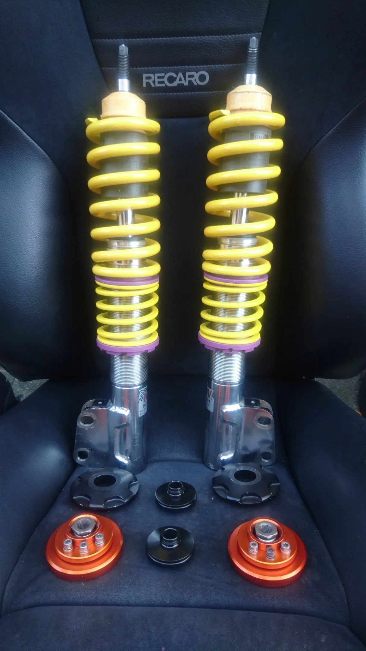

had a change of plan and whilst I was getting some parts for GTT powdrcoated I decided to get the springs done for the KW's, sacralige I know but meh, I like green!
I will also eventually put the darn car back together, promise!

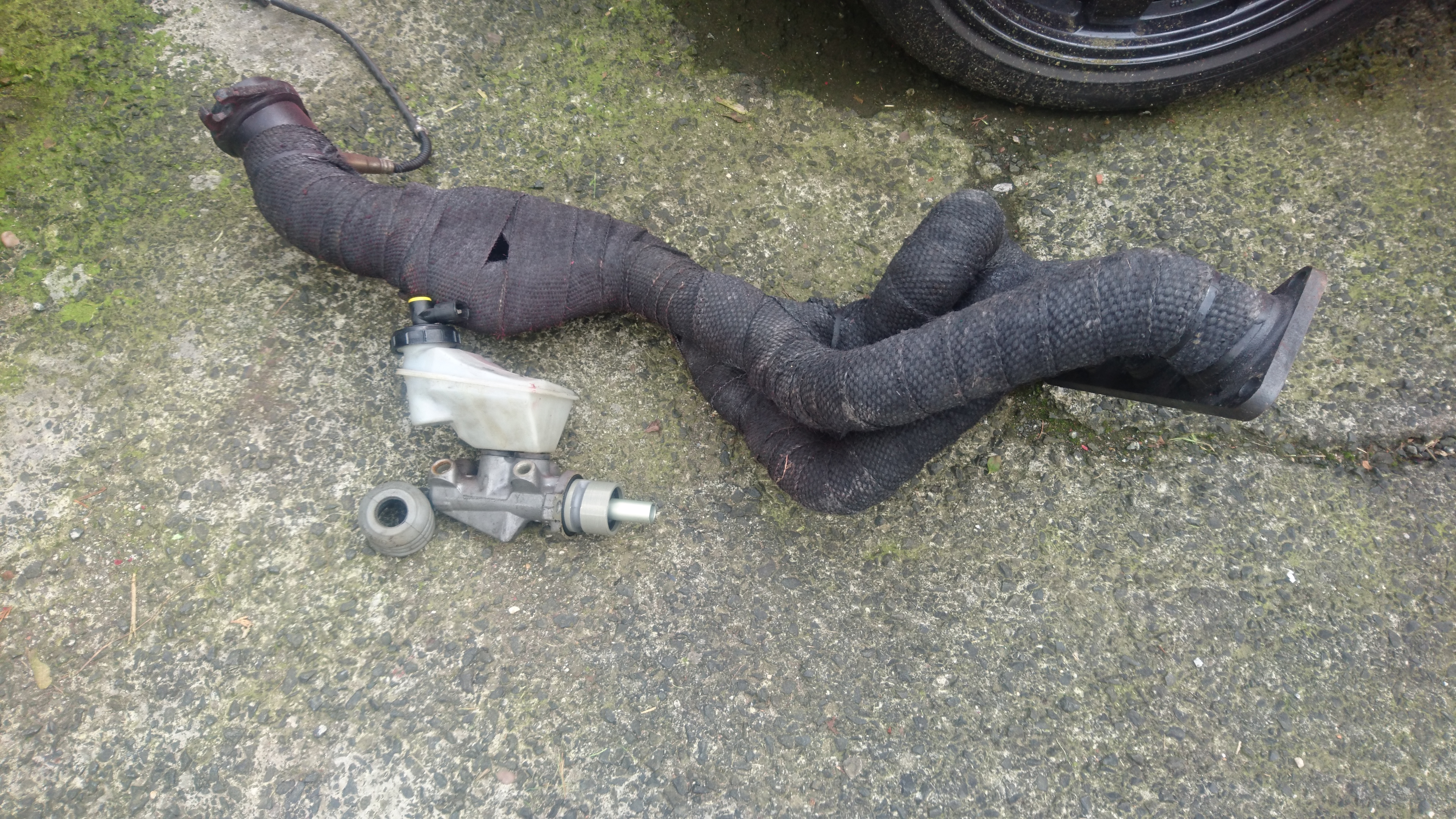

the manifold is back off again currently to be taken to machine shop for a new lambda bung to be welded in to clear the linkage from the PMS shifter, then its on!

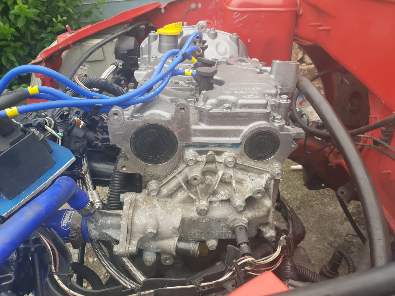

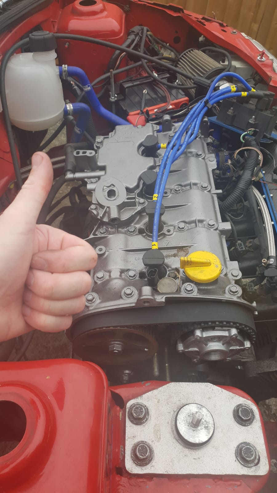

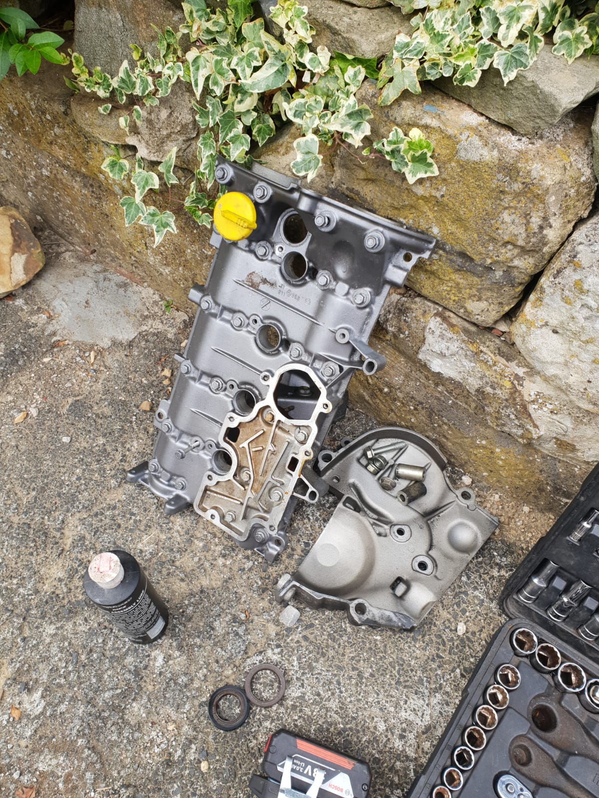

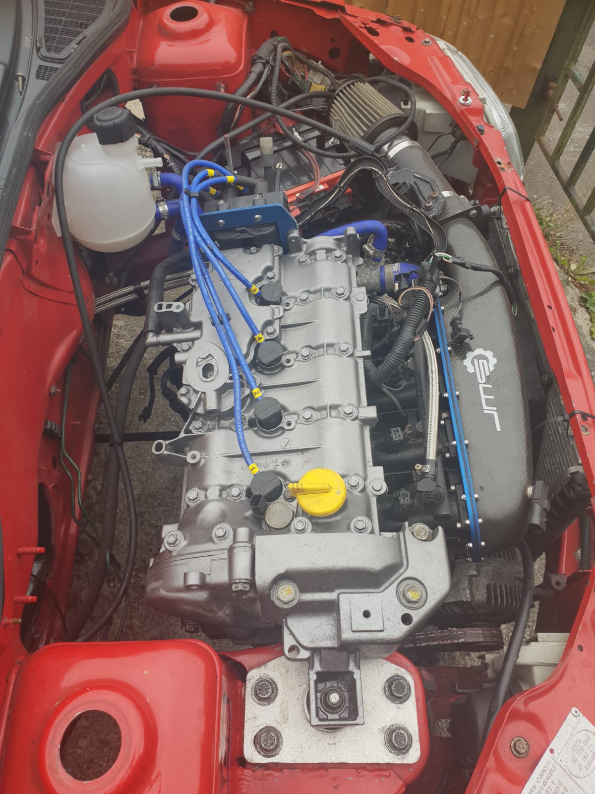

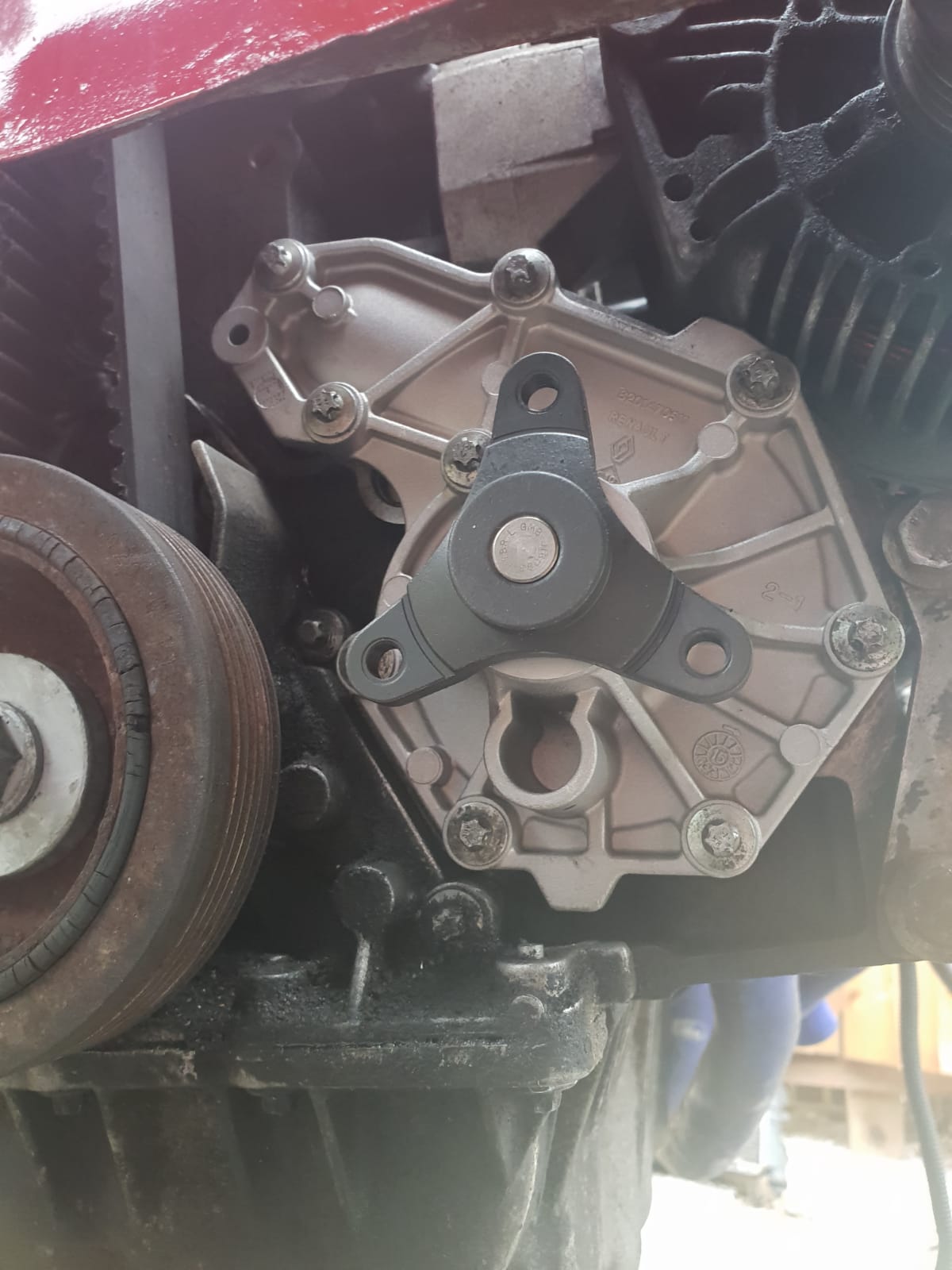

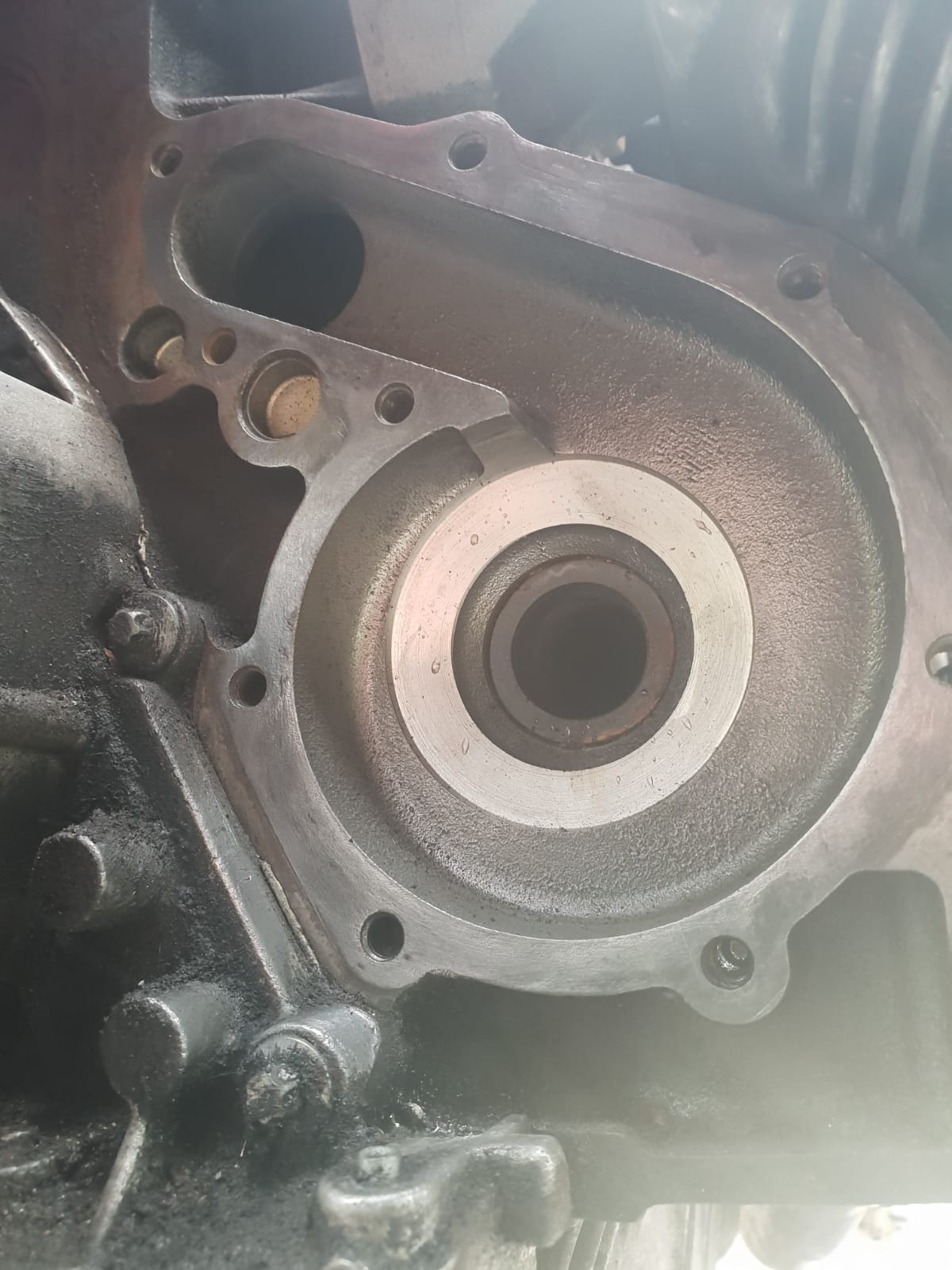

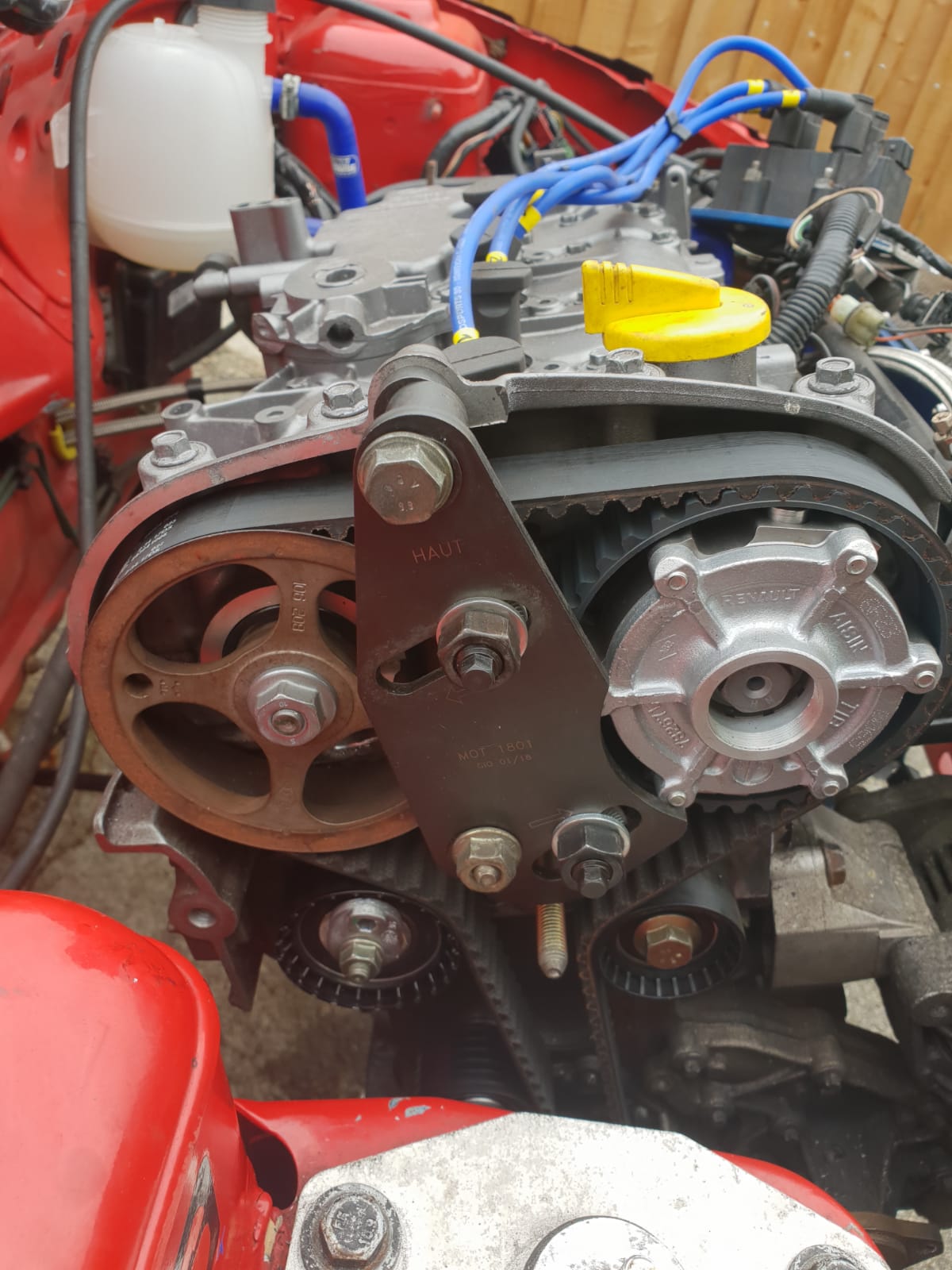

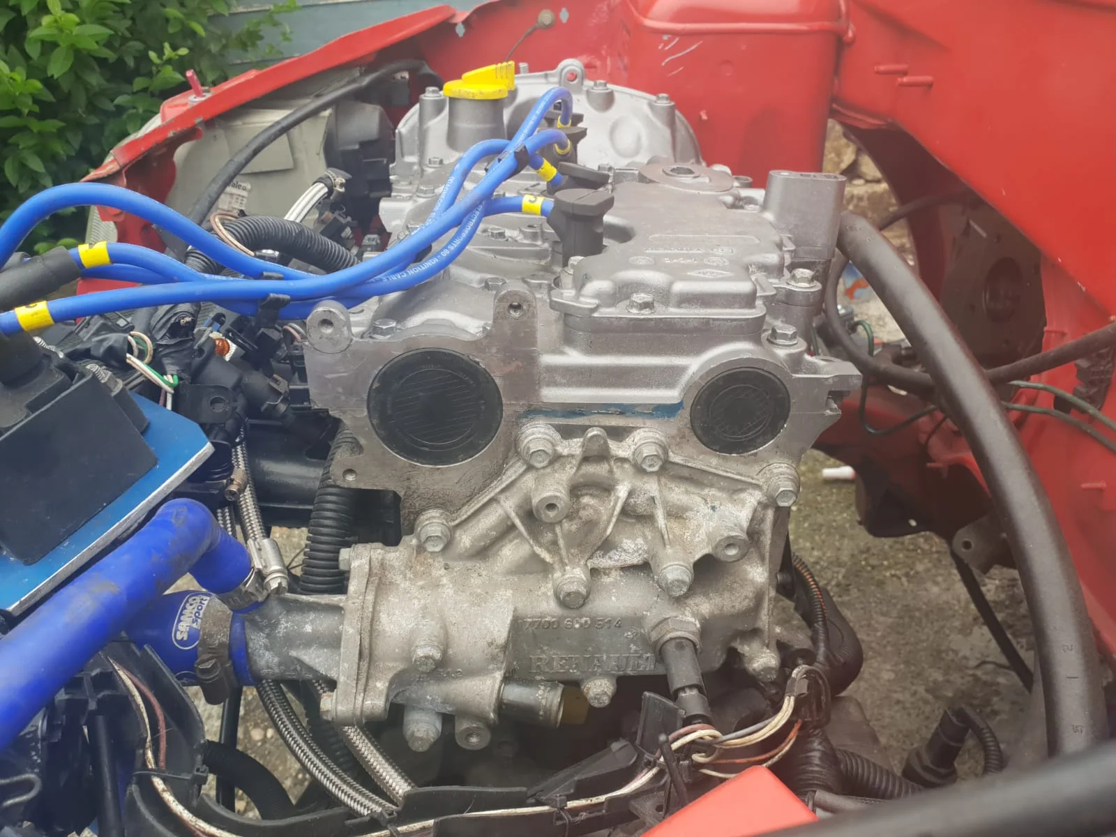

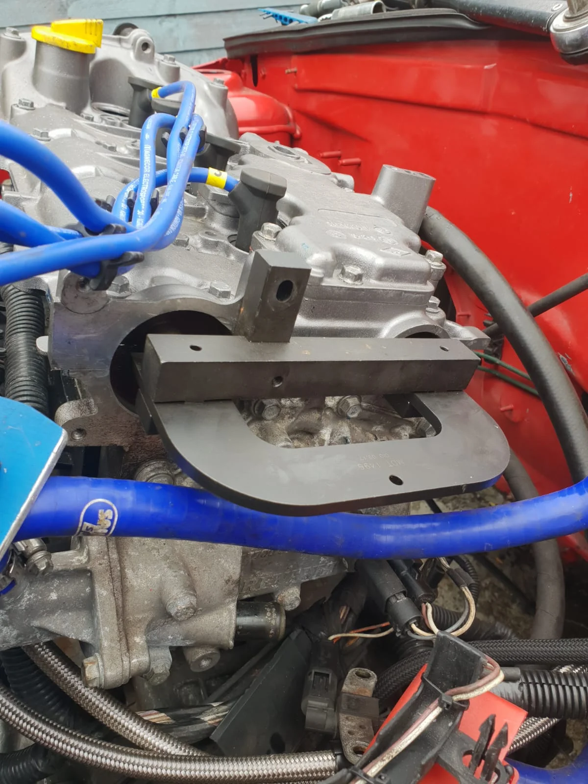

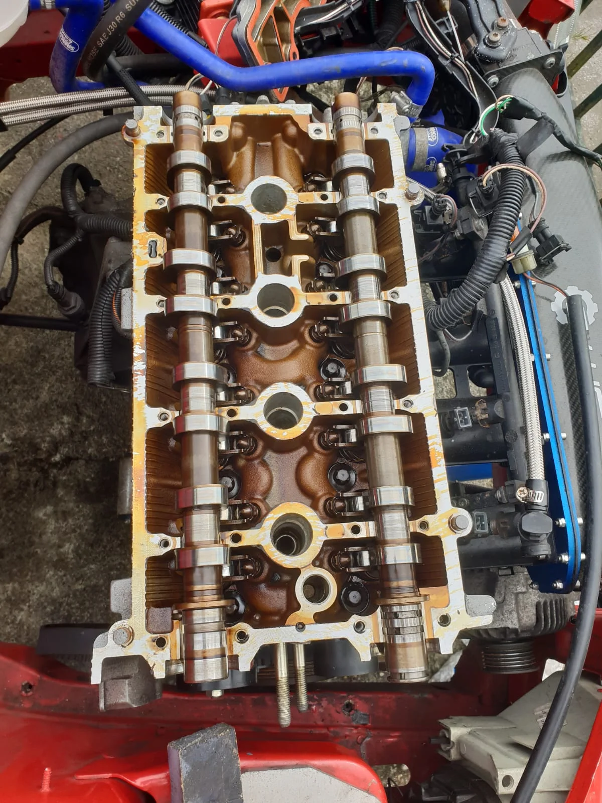

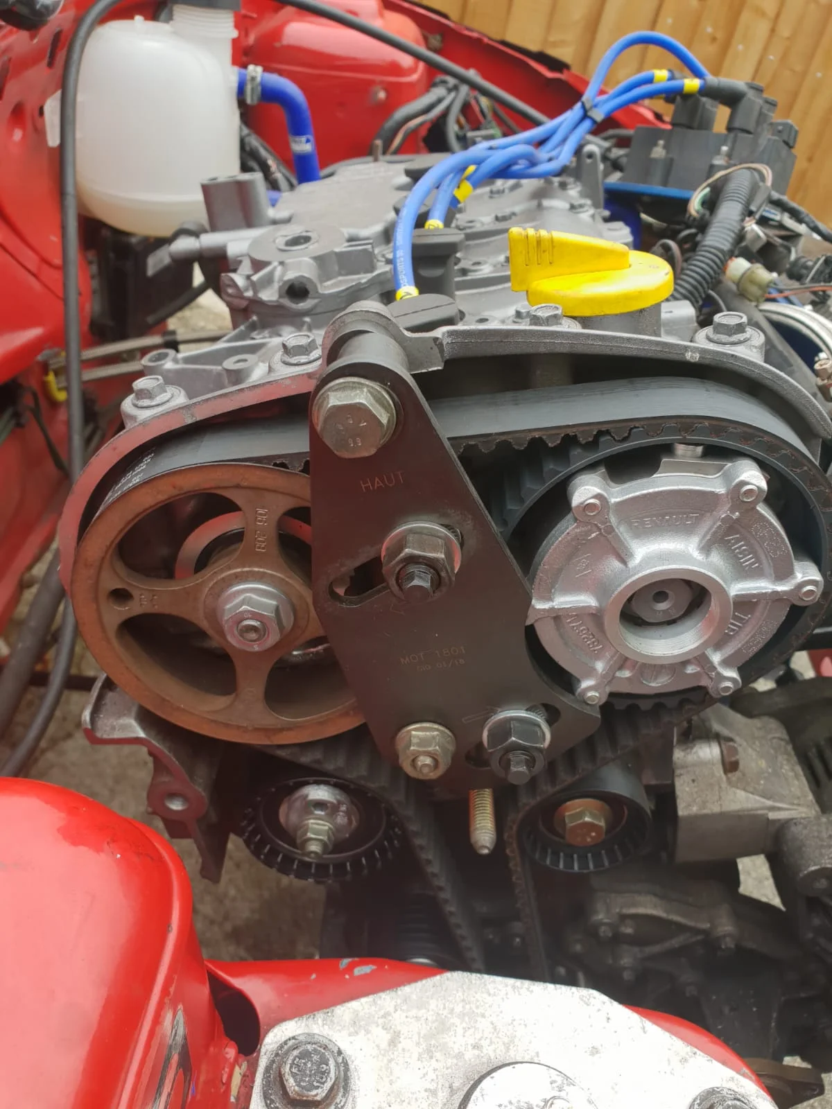

More progress today, finally got the cambelt and Dephaser job done.
The Dephaser was noisey and cambelt overdue, I'd bought 197 cams while back but circumstances meant wasn't in a position to time and map them. As such decided I'd change the belts and Dephaser and get another year out the car before fitting the cams.

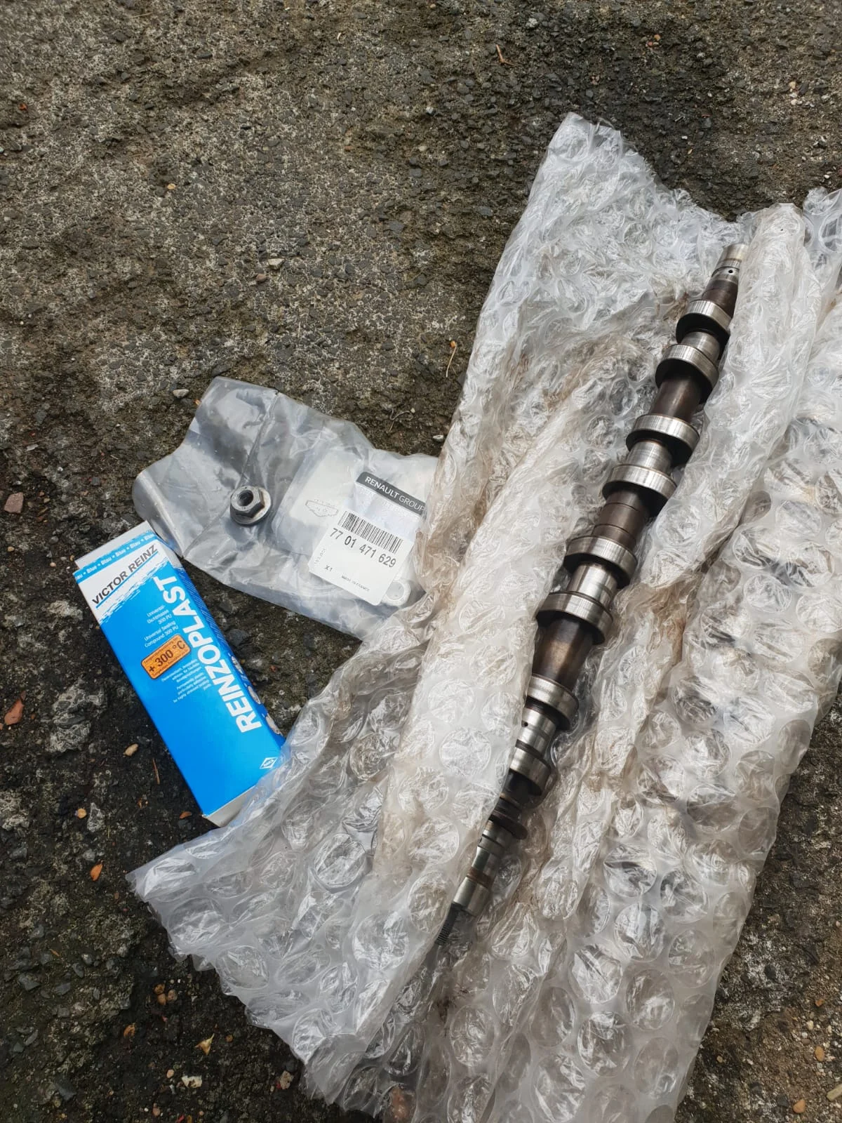

Things however didn't go to plan and after successfully replacing everything and timing the lump, the exhaust cam stud stripped out the cam on final torqing nightmare
As such my hand was forced into fitting the 197 cams to complete the job.
All went smoothly, all fitted, timed to stock for now and new water pump fitted.

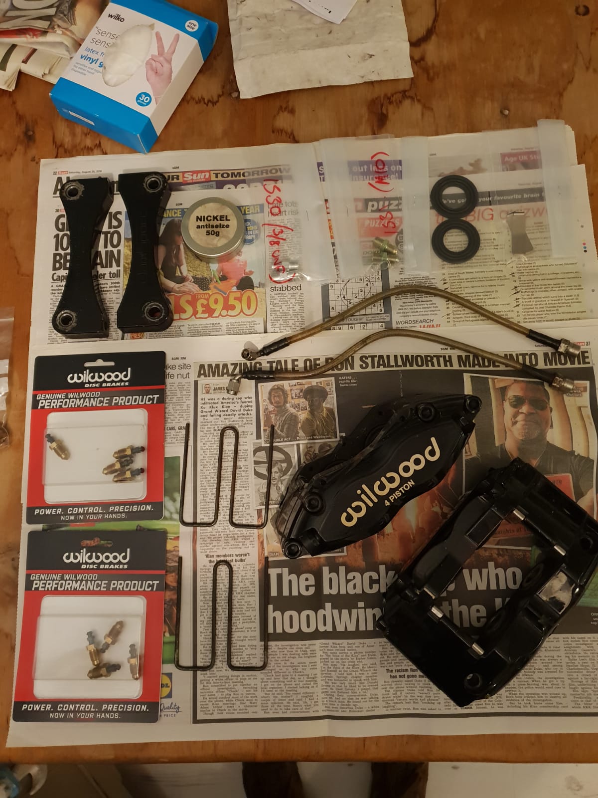

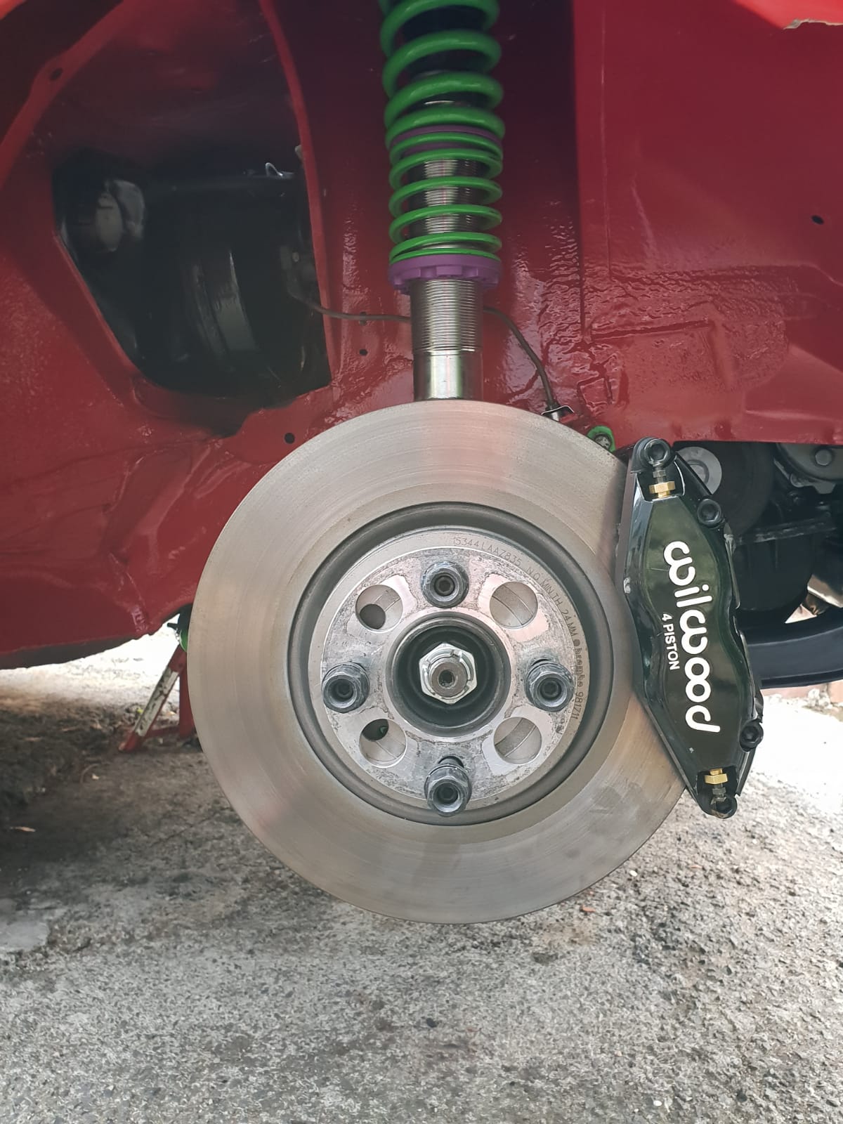

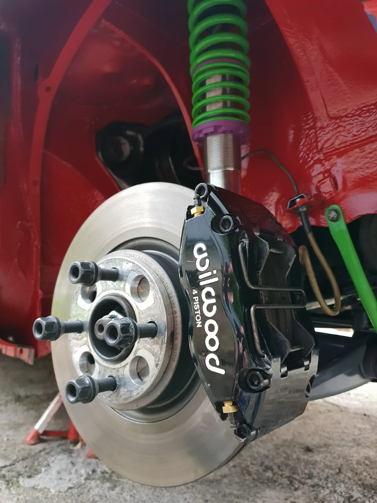

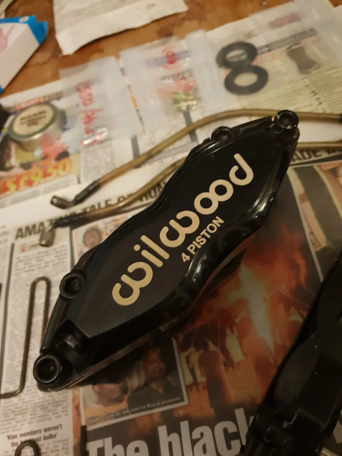

So progress made. Next is brake overhaul to get the Willwood 4 pots fitted.
Anyway, many pics!

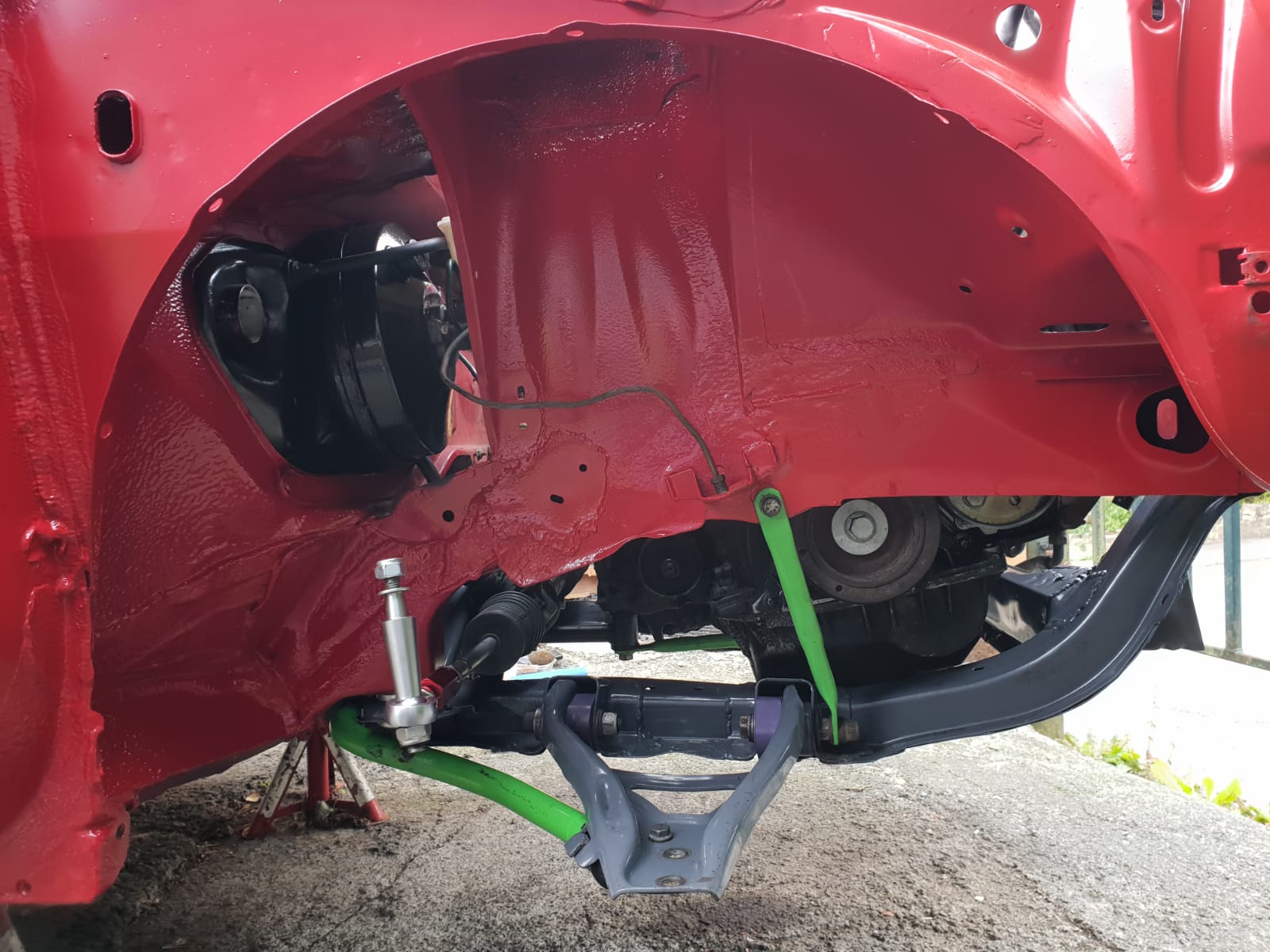

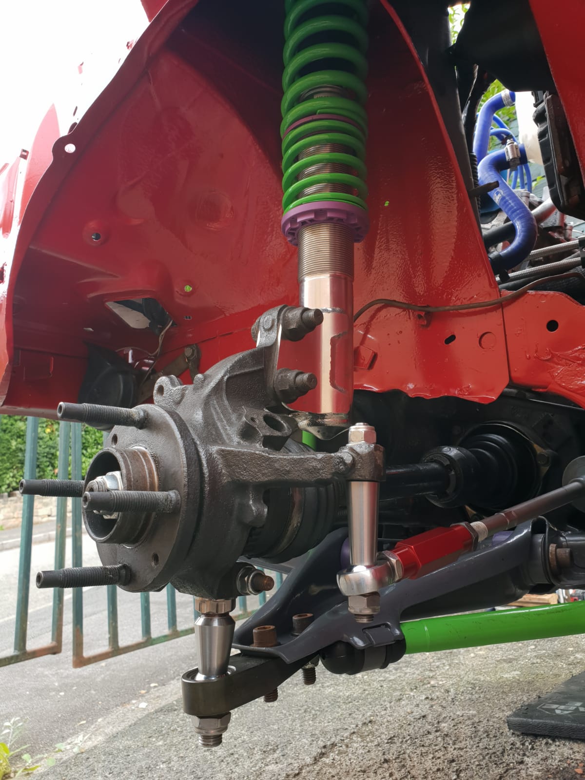

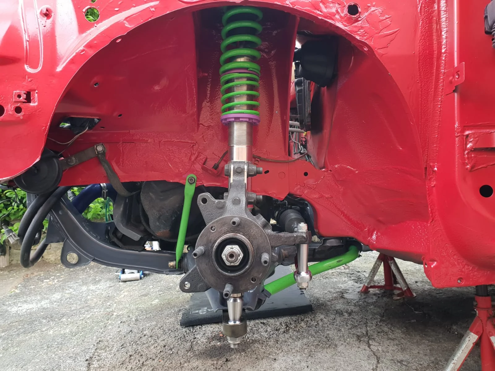

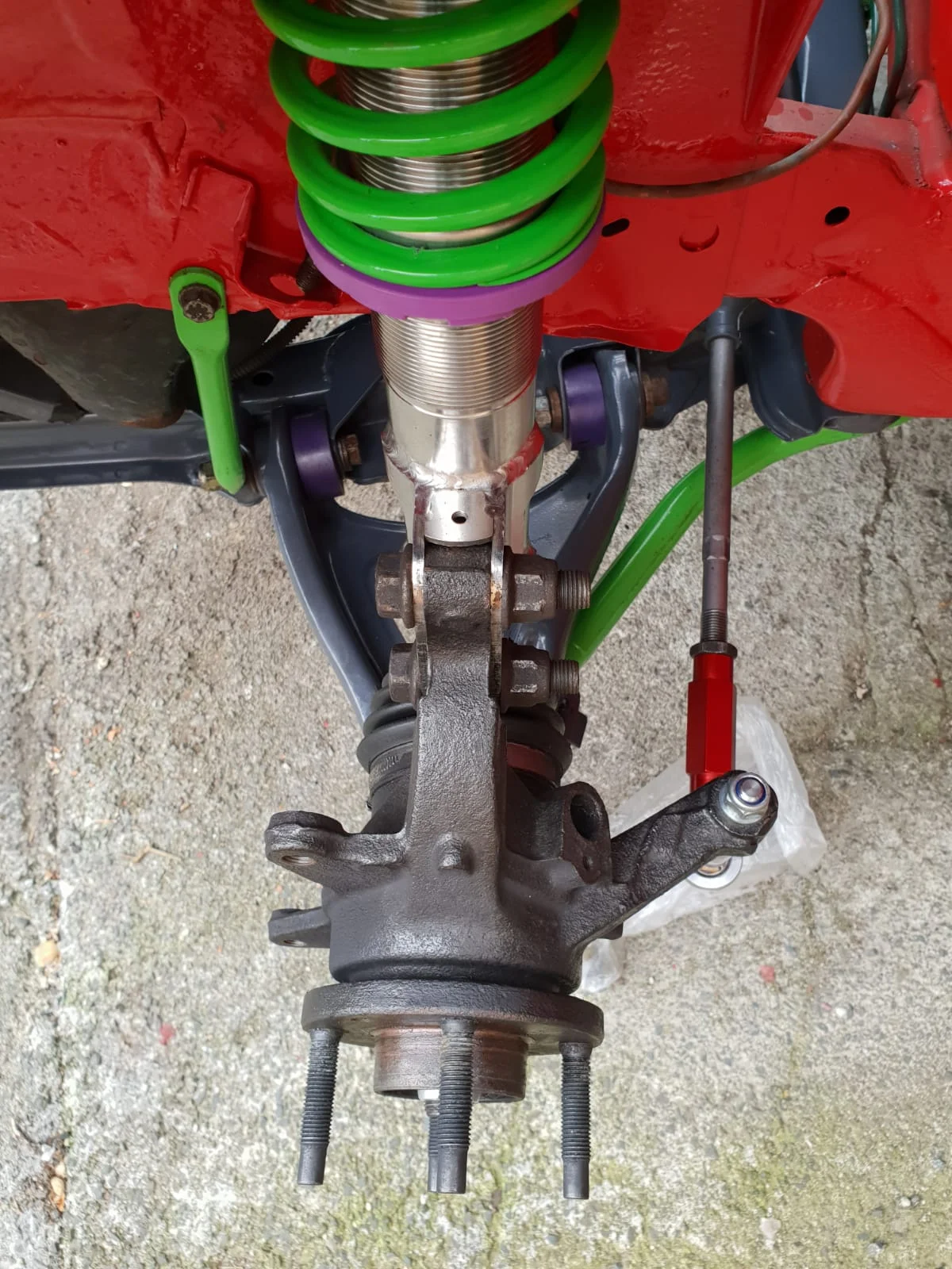

30-09-2018 Putting things back together

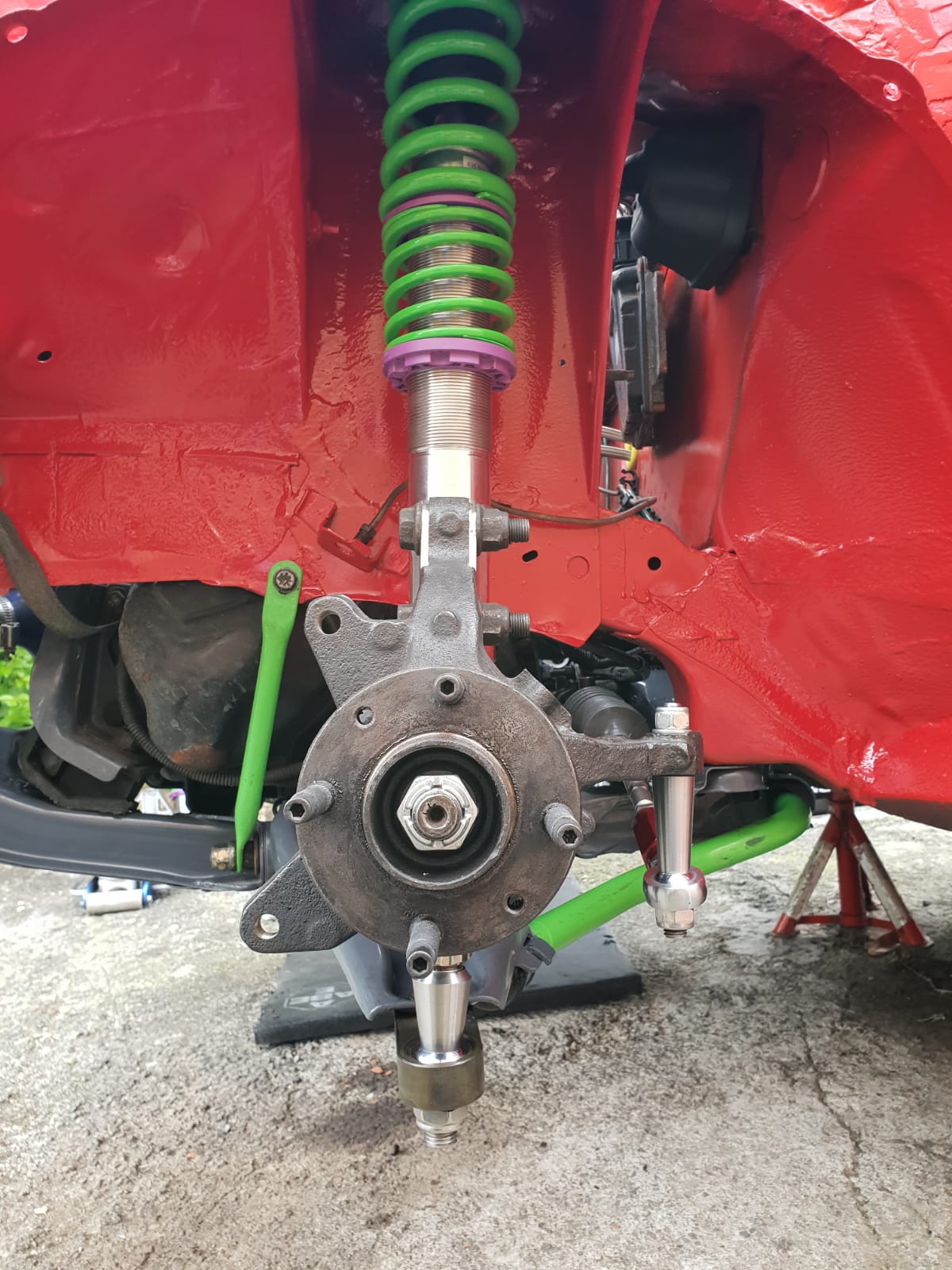

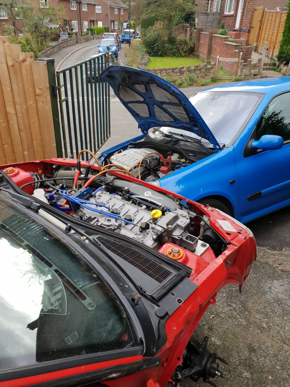

Started piecing the car back together today. Newly coated springs fitted to the KW's after cleaned, treated and painted arches. Refitted the drivetrain, filled up the box oil and coolant etc and painted and refitted my brake servo.
Also fired up the engine for first time since I fitted the 182 manifold, new cat back exhaust (temp fitted for now just to get car running) and did the belts and cams.
Fired up fine until smoke started pouring out the alternator which appears to be buggered... So need a new one of those! Lol!

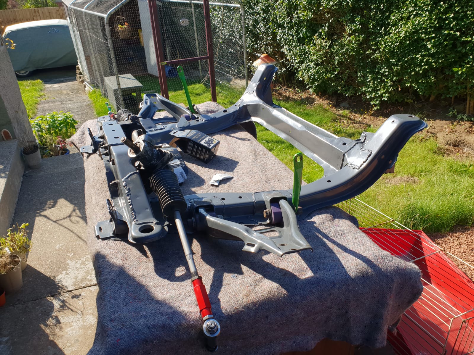

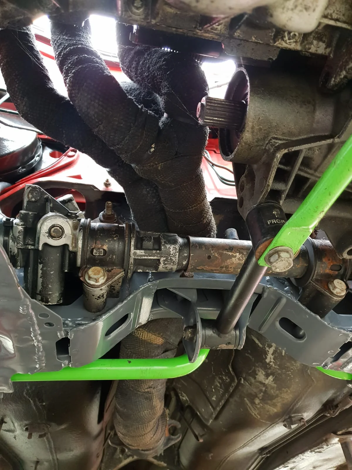

Subframe built back up with powerflex black series arb bushes
Brake servo painted and refitted
Heat wrapped 182 manifold fitted,clearance is tight but enough!
Arch before suspension refitted
Other side with all back in place

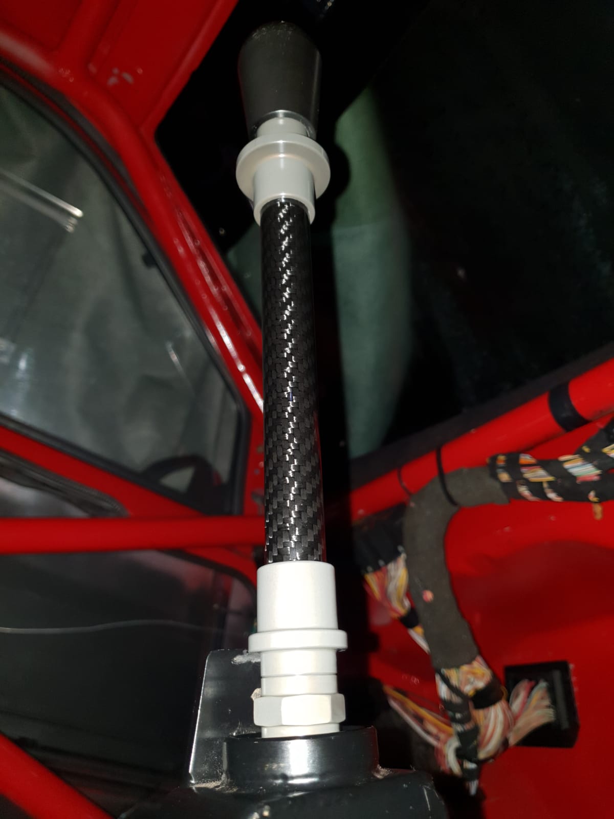

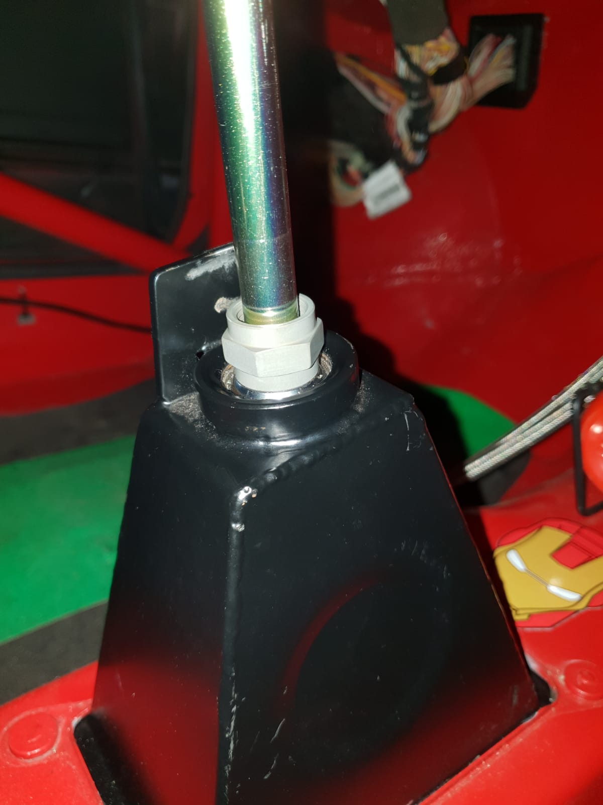

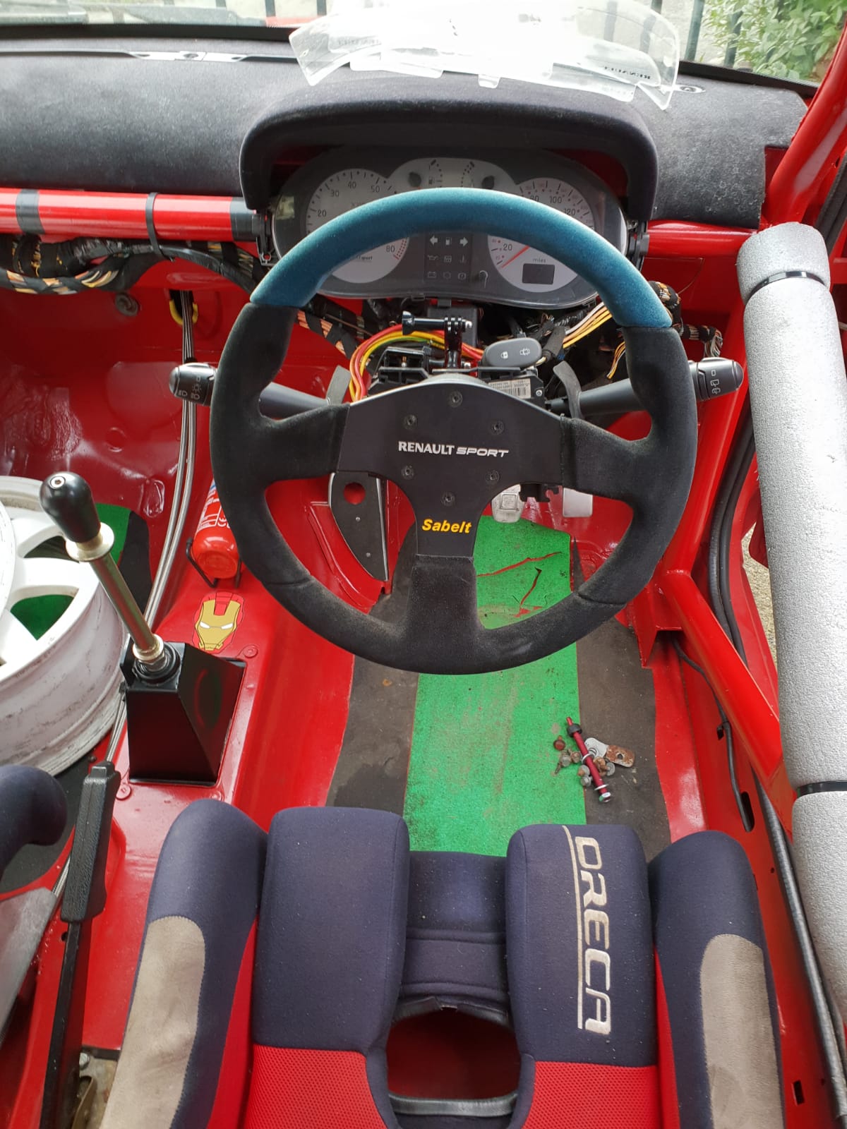

And refitted the pms shifter and sabelt wheel
So need to acquire another alternator and then it's onto brakes next!

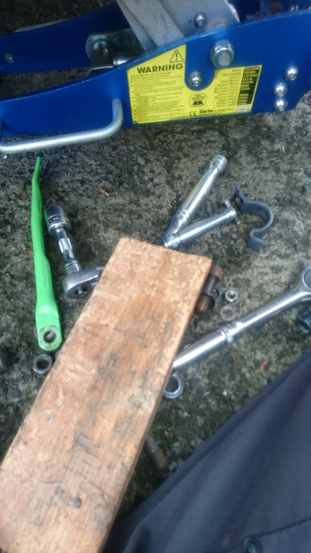

No idea that's just what came with the kit. Believe you can buy correct ones from jamsport but chap I bought the kit off measured these up instead and worked at a machine shop so me modded them to fit at work so cost him less.

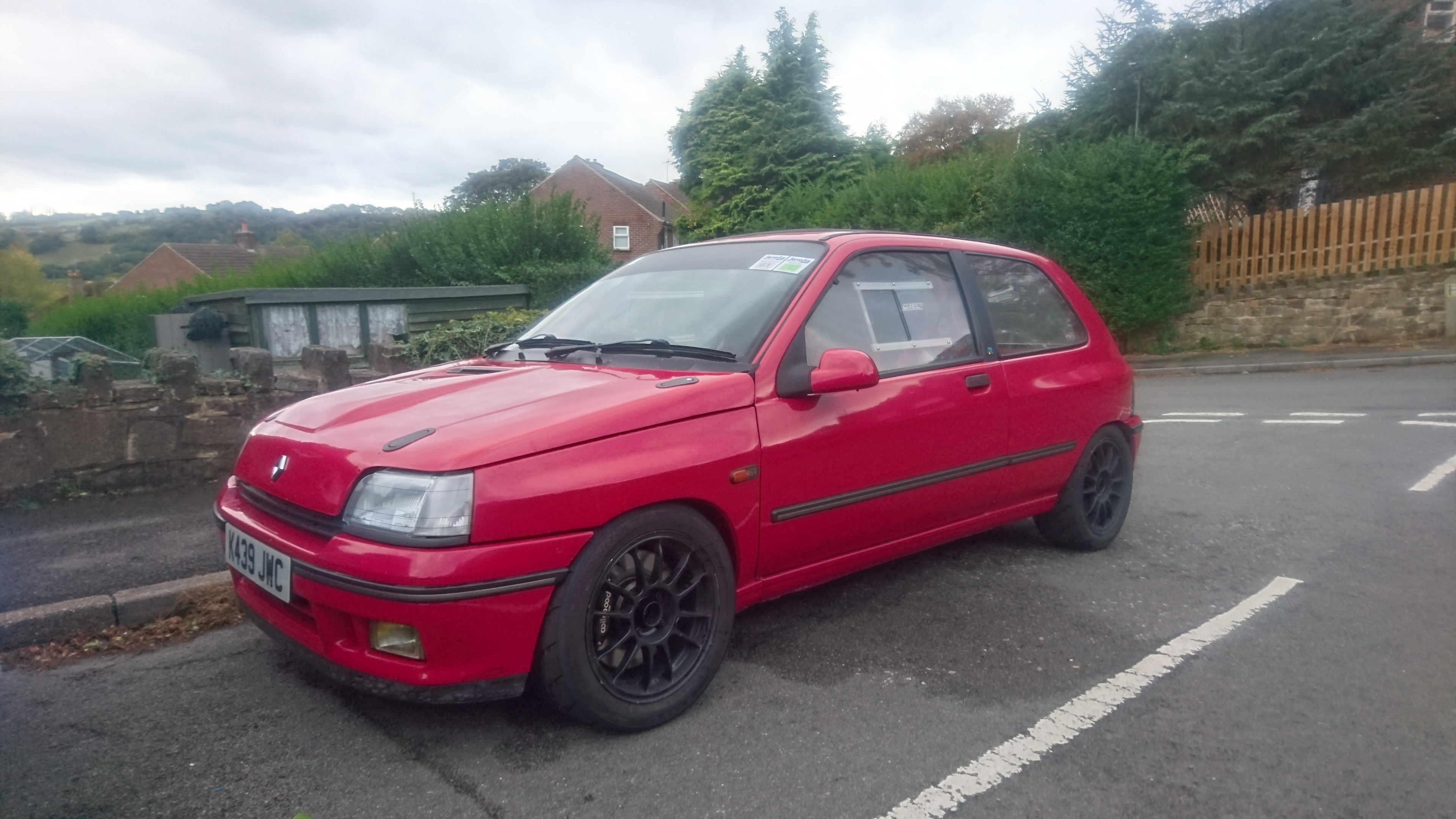

moved under her own steam for the first time tonight, up the road and back.....
no bonnet, brakes awful, weights on the front wheel catching caliper on one side and then the lashed up exhaust fell off...…….but god I love it! so chuffed just to get it moving.
more work on bleeding the brakes required, annoying imperial American crap though so had to order a 1/4" ring spanner off eBay and I'm going to need some smaller bleed pipe for the nipples on the callipers...…..
Well back enough into one piece now, outstanding are to try to bleed the brakes again and needs new rear discs, probably a bit more of a fettle with the exhaust but save for that she's back up and running!
To then be consigned to the back of the drive for winter! Lol!! Fail!

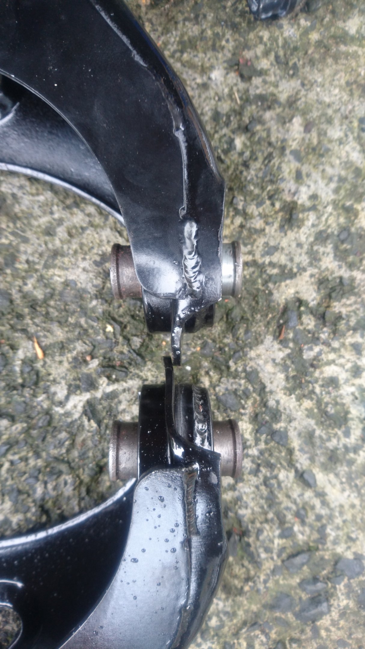

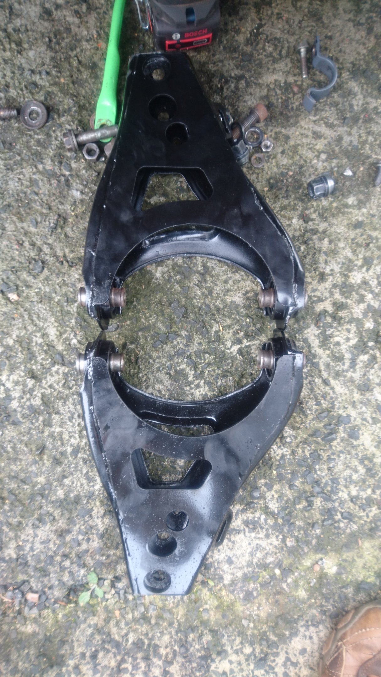

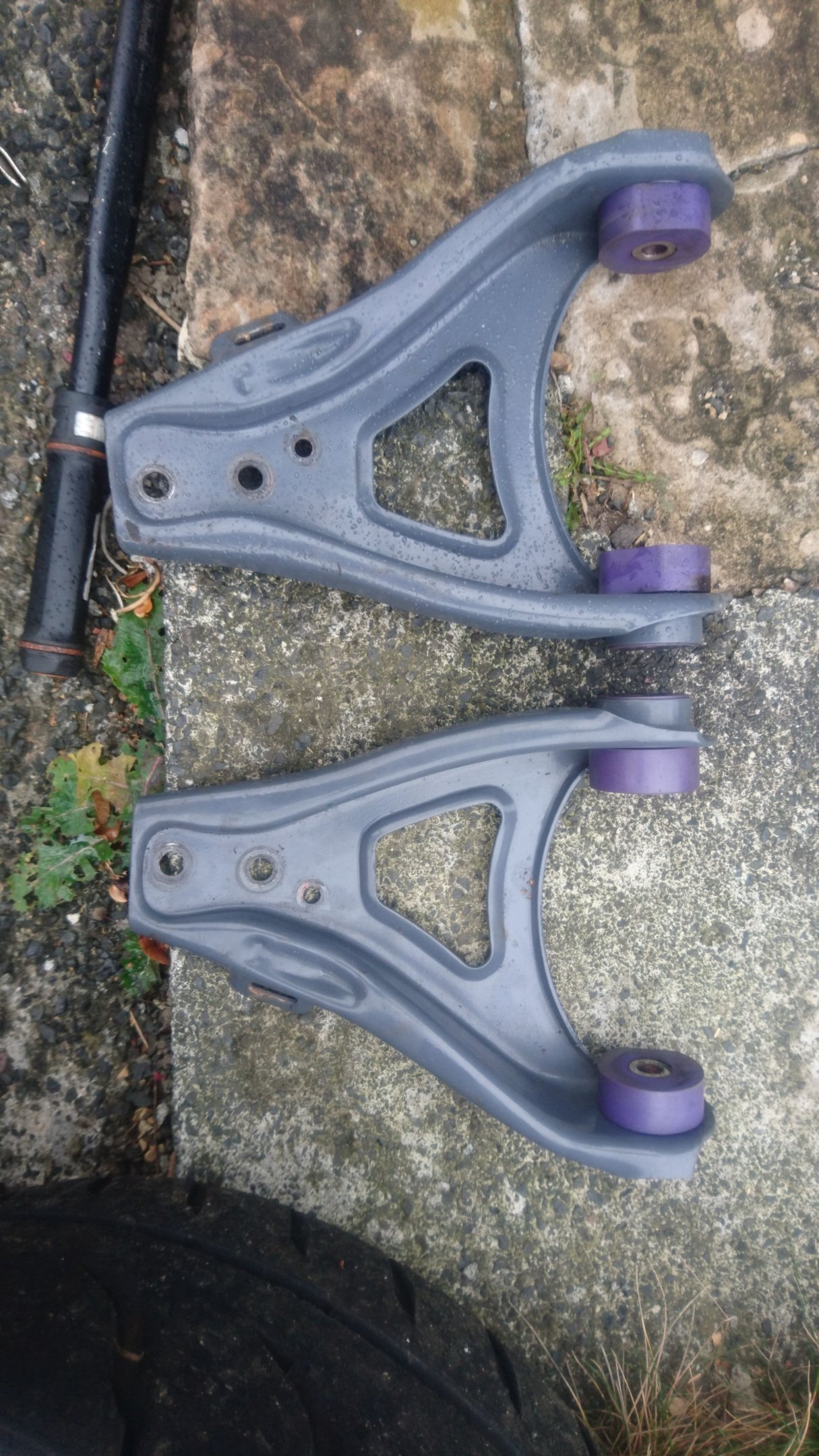

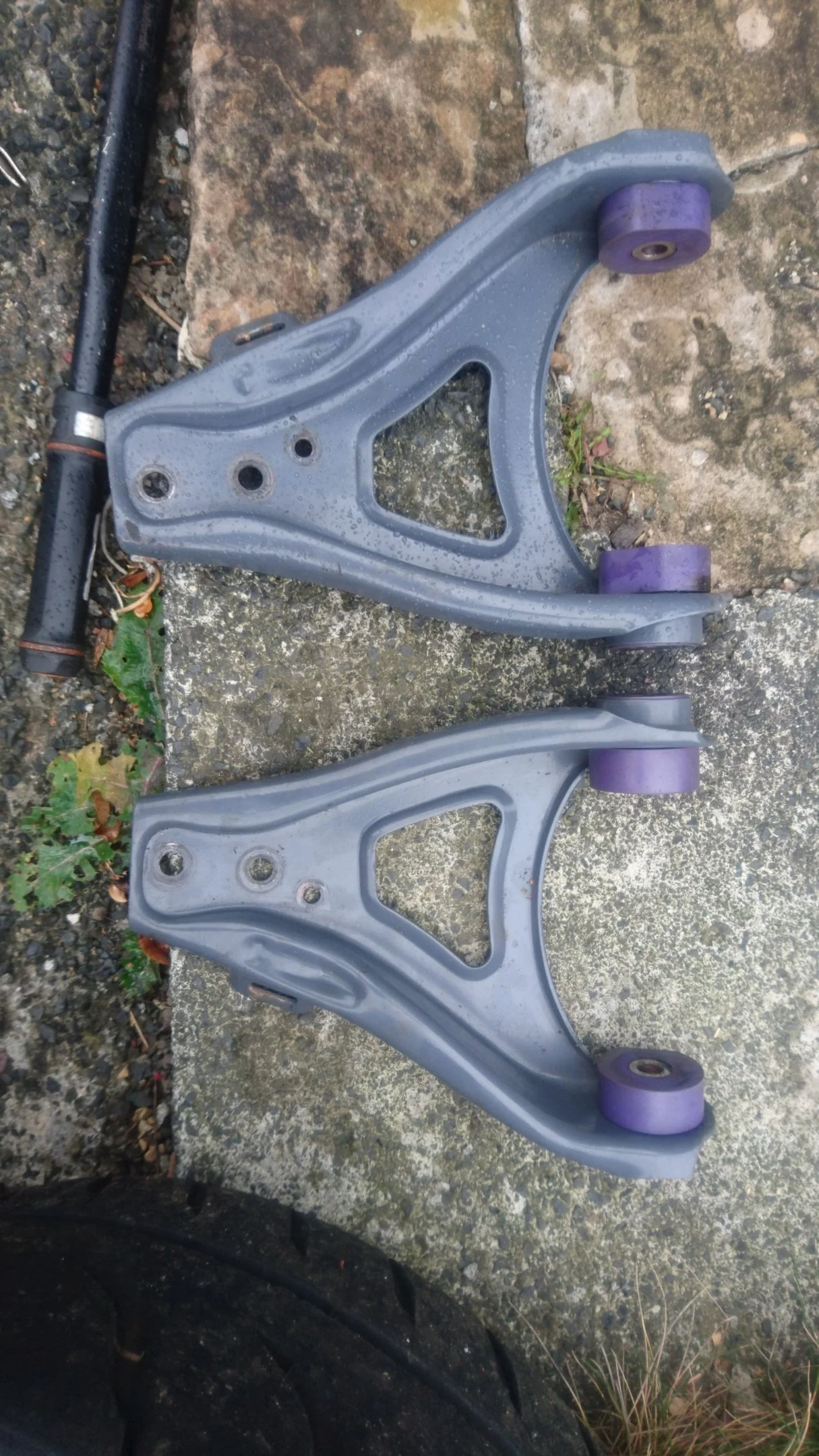

Due to my ongoing spending issues I acquired a set of pms lower arms with the spherical bearings and strengthening plates for a bargain so couldn't say no.
No fitted pics but bit of struggle on the offside so had to 'adjust' it to fit but after a bit of loving persuasion they're on.
No fitted pics unfortunately but hopefully grab an mot next month just to get it done and try get some pics of the front setup on the pit loaded up and like it will be in use if you get me.

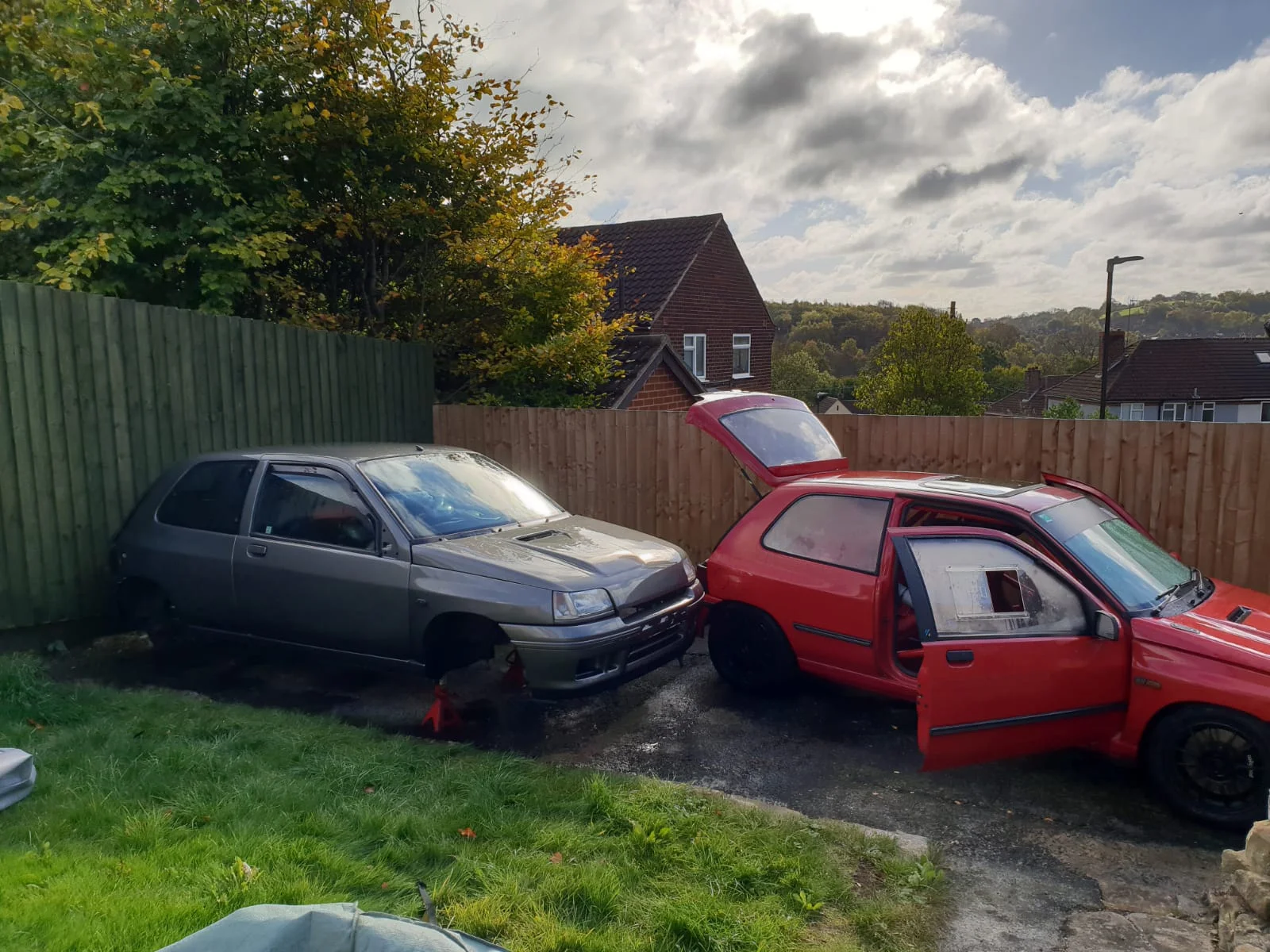

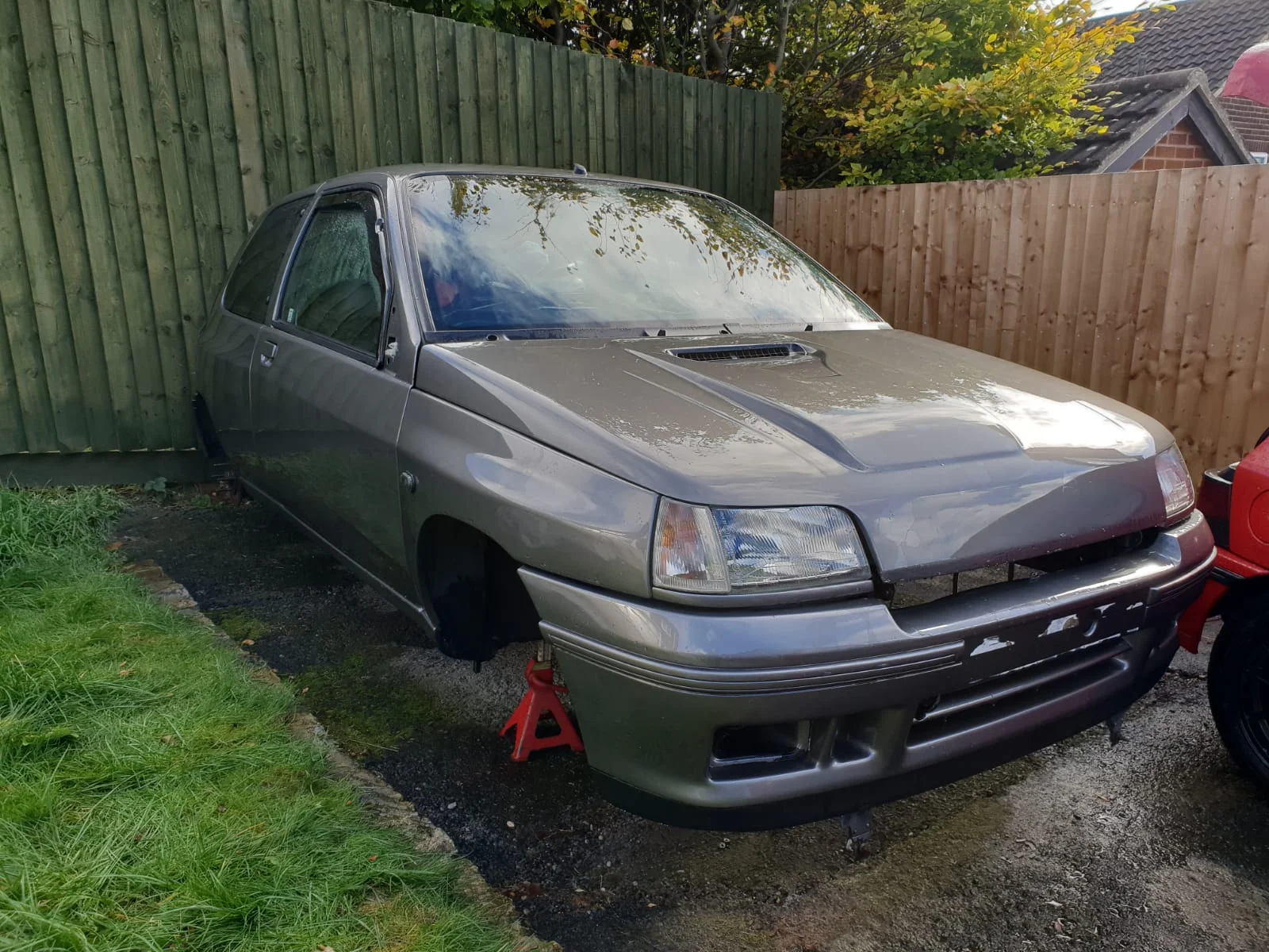

And the old grey mk1 got a wash again to just cling a little bit onto my clio past.... One day sweet princess, one day, lol!

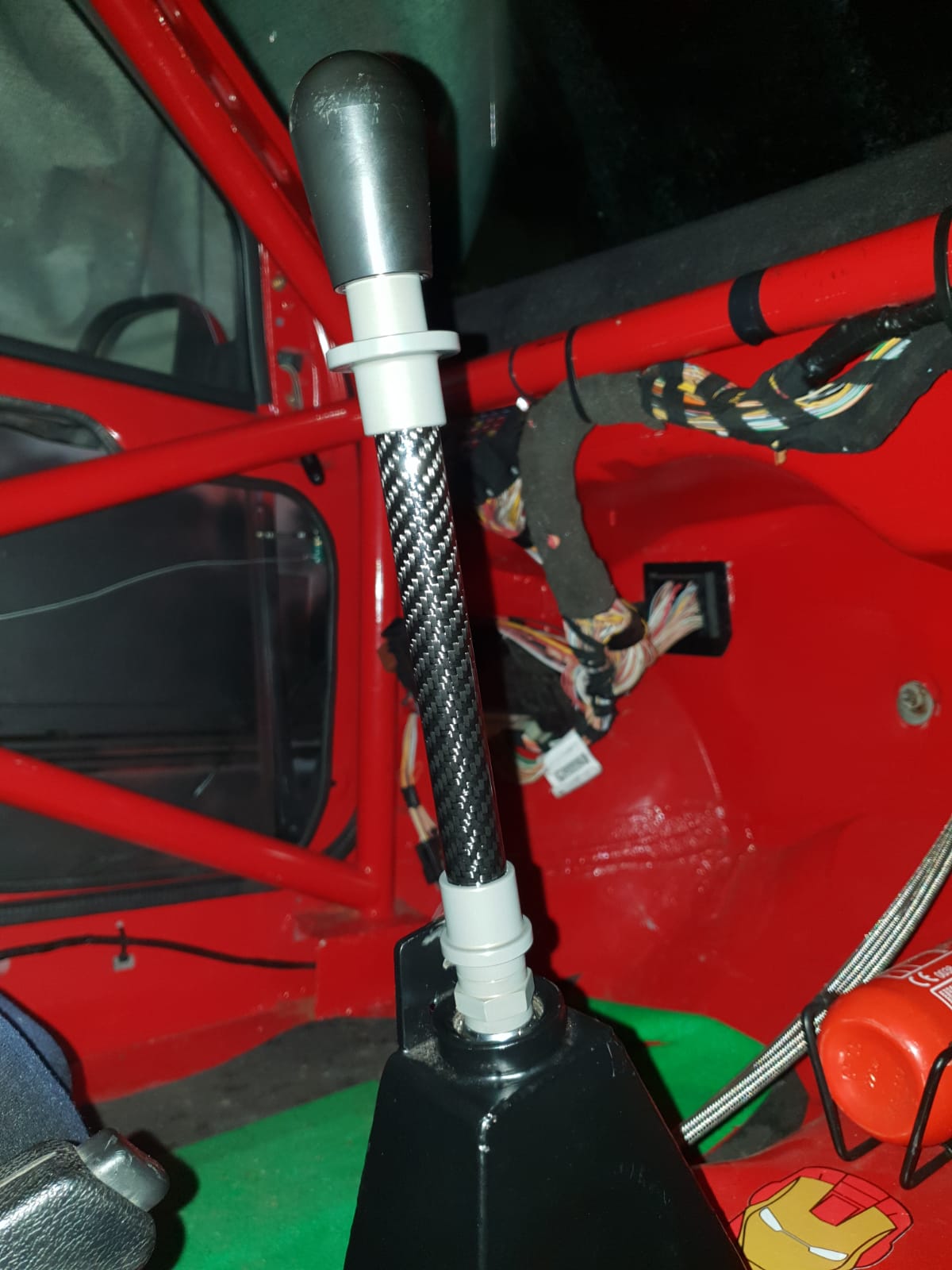

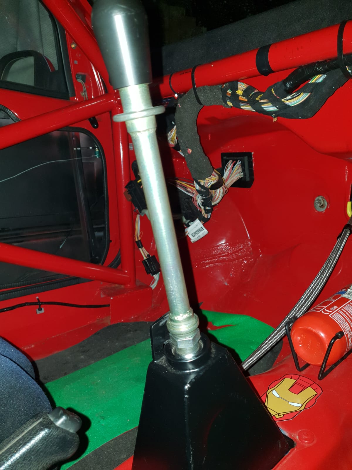

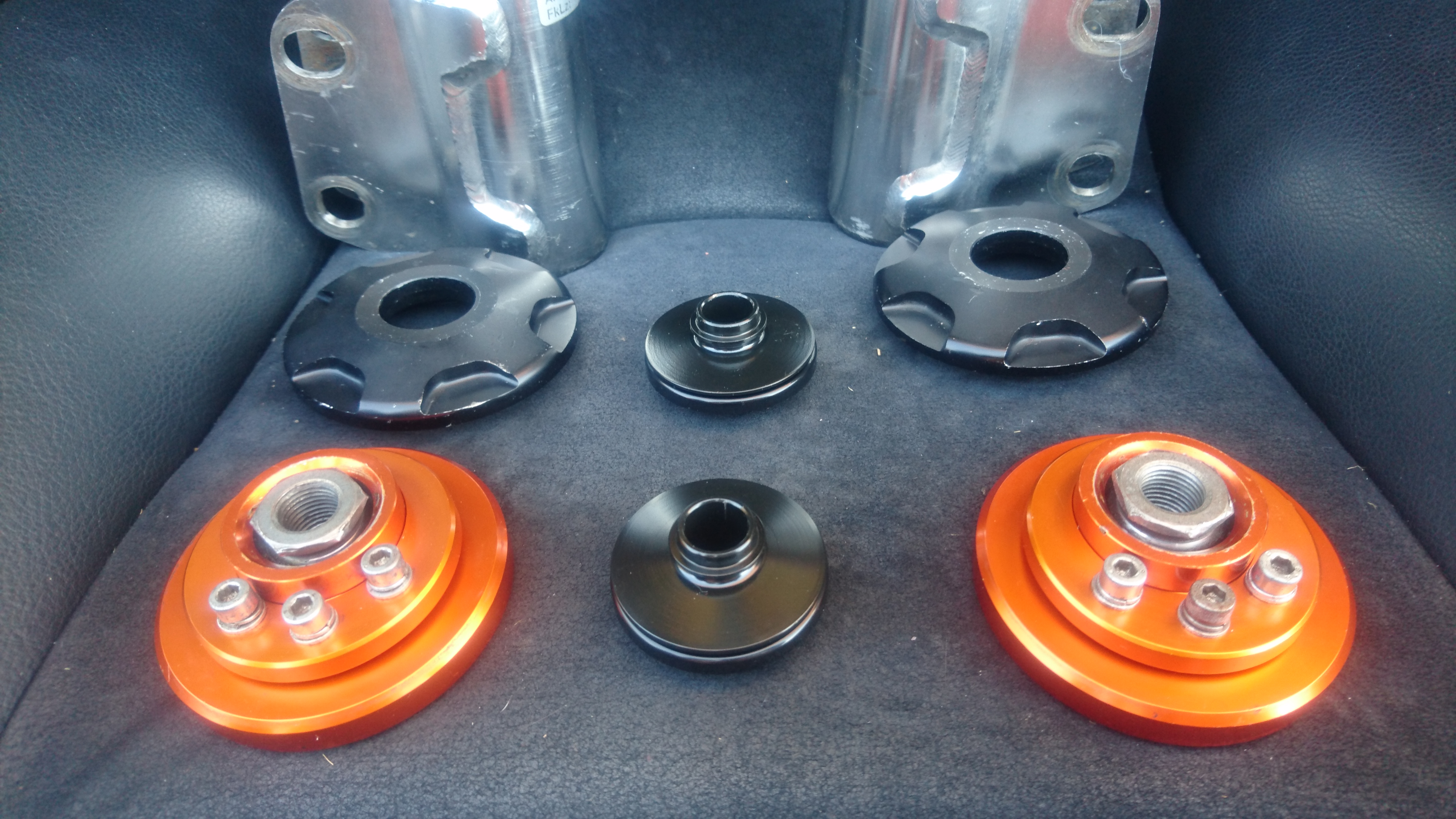

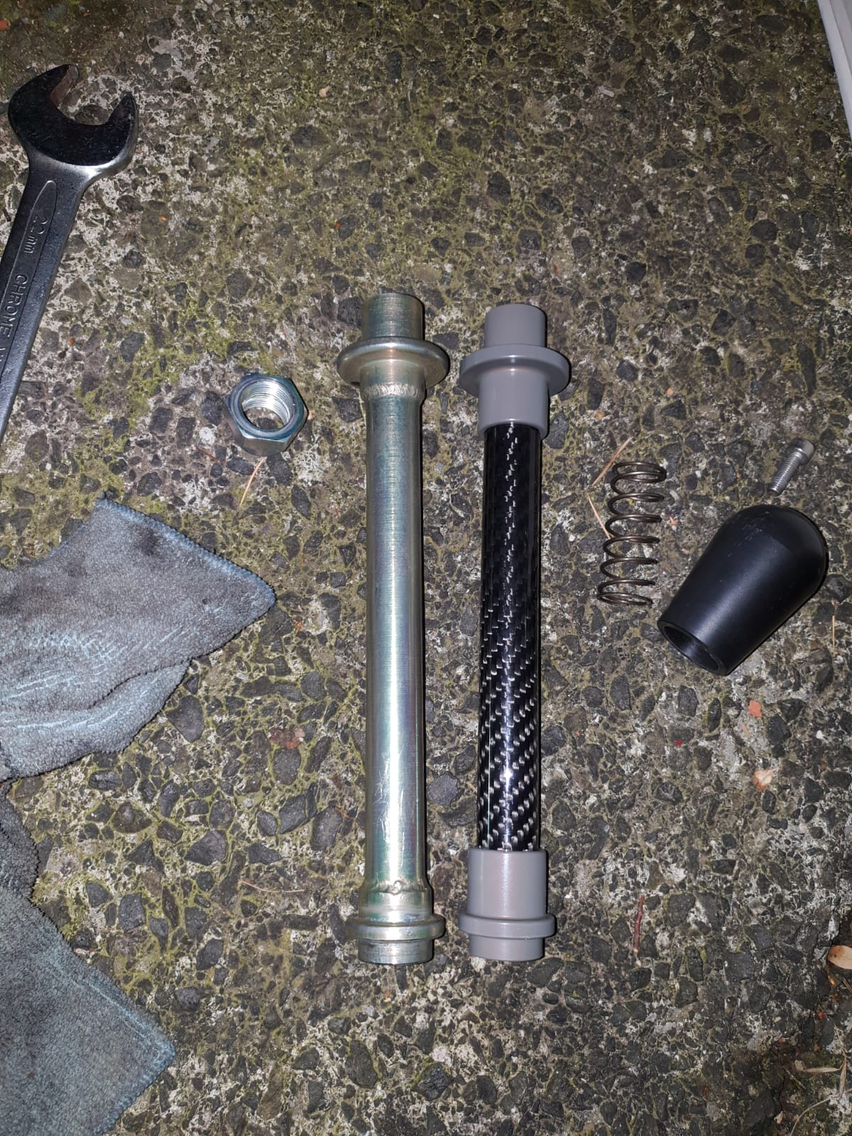

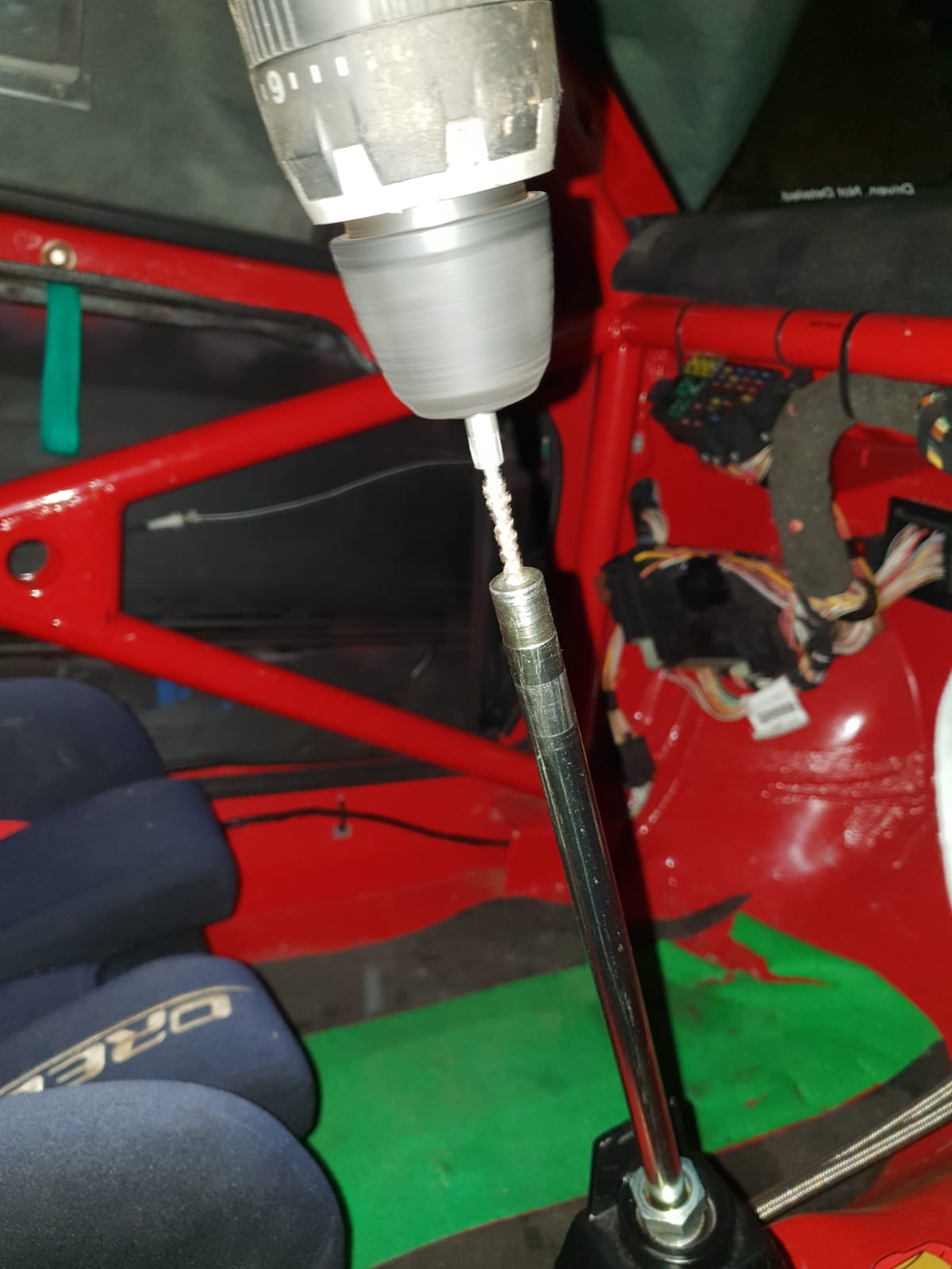

Out with the old
Not quite same shape new
Some persuading tools
Finished and attention turned to the old grey girl
Did a small buy just because. The adonised alloy grey components of the sleeve look a bit odd in the flash light but much better in natural light imo.
Saved a whopping 150g as well, gainz, lol!
Old sleeve
Side by side off car
Threads cleaned for retaining screw
New nut fitted
And fitted
Cheers

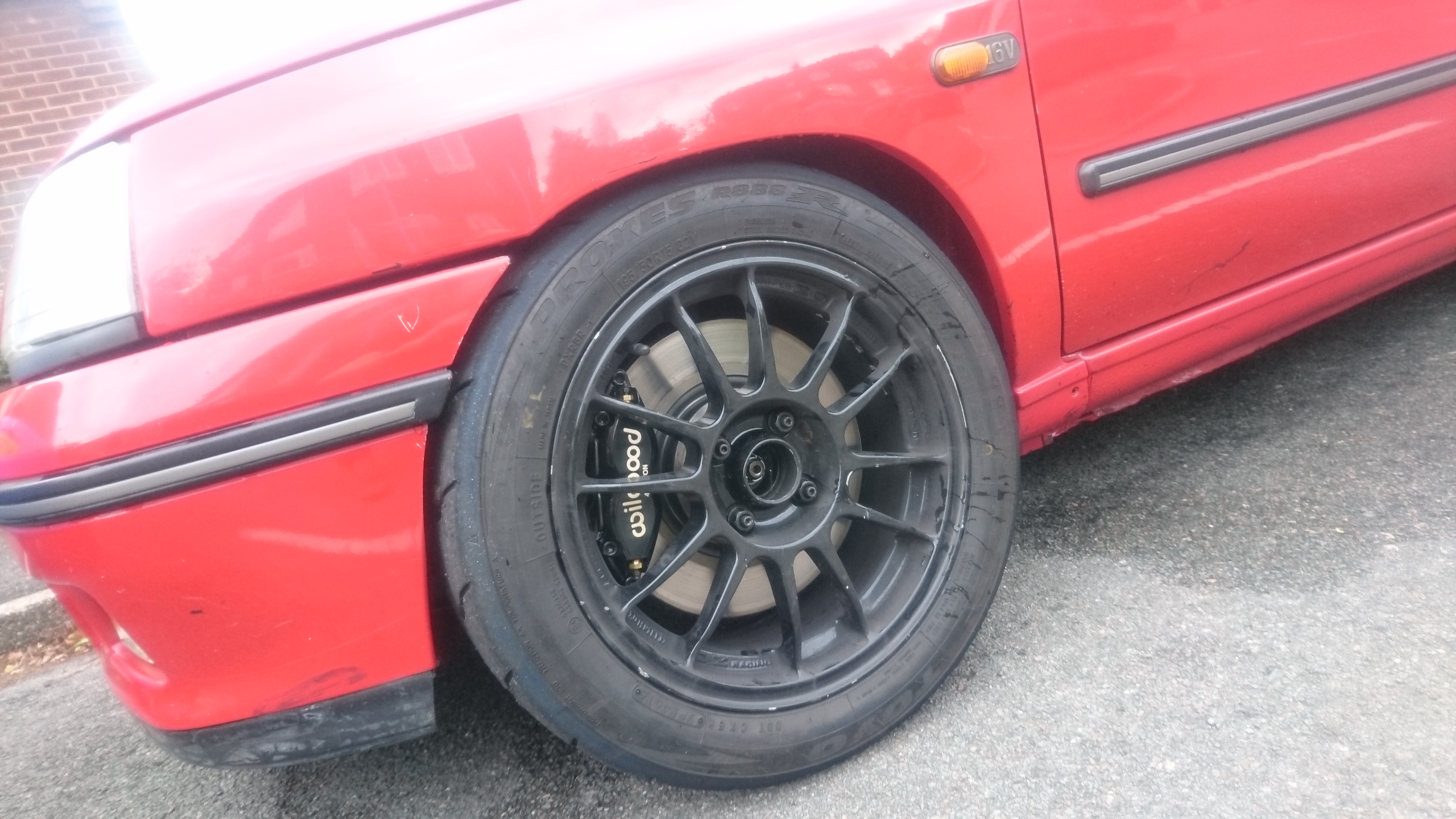

MOT passed today, goods times.

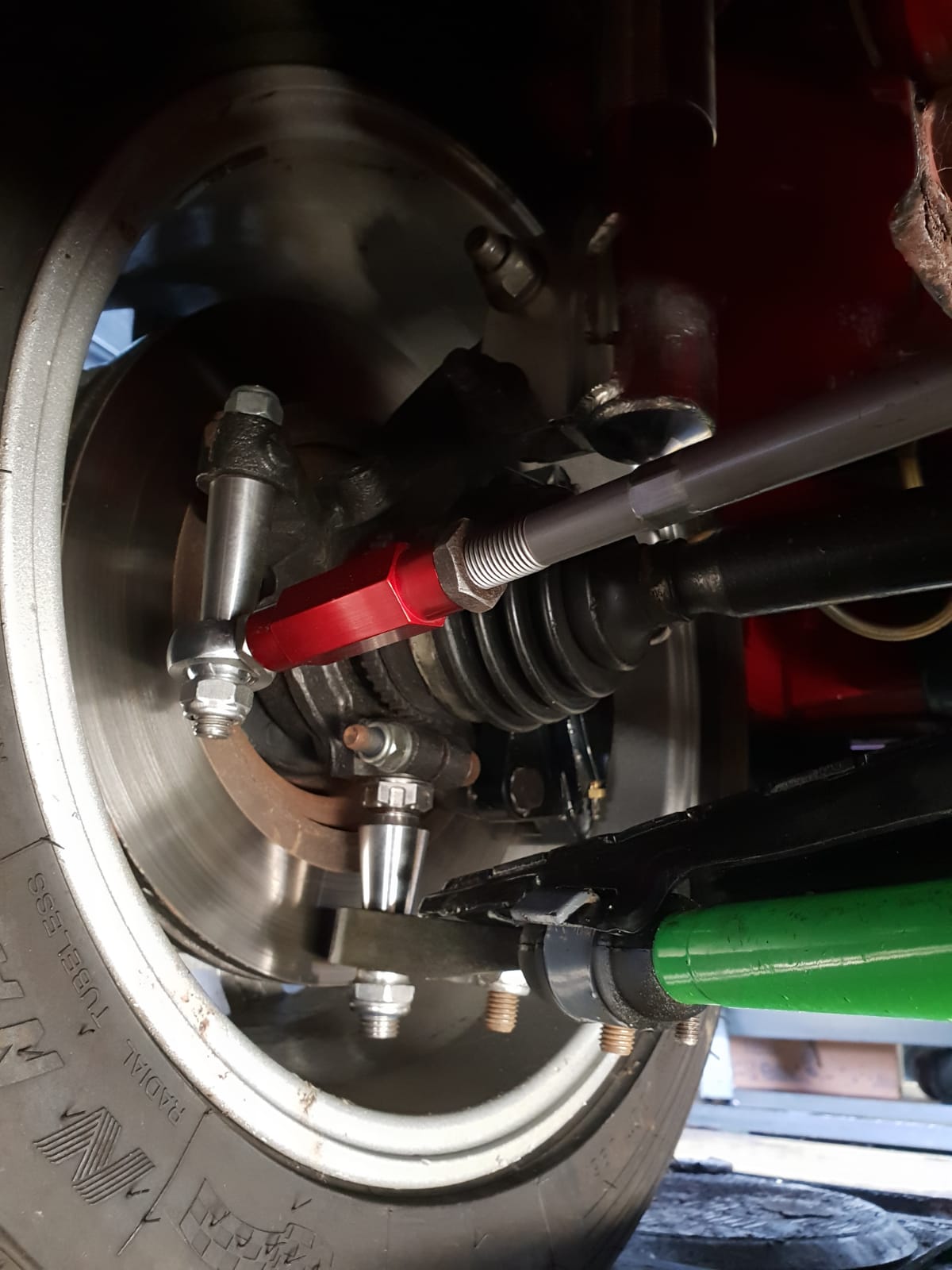

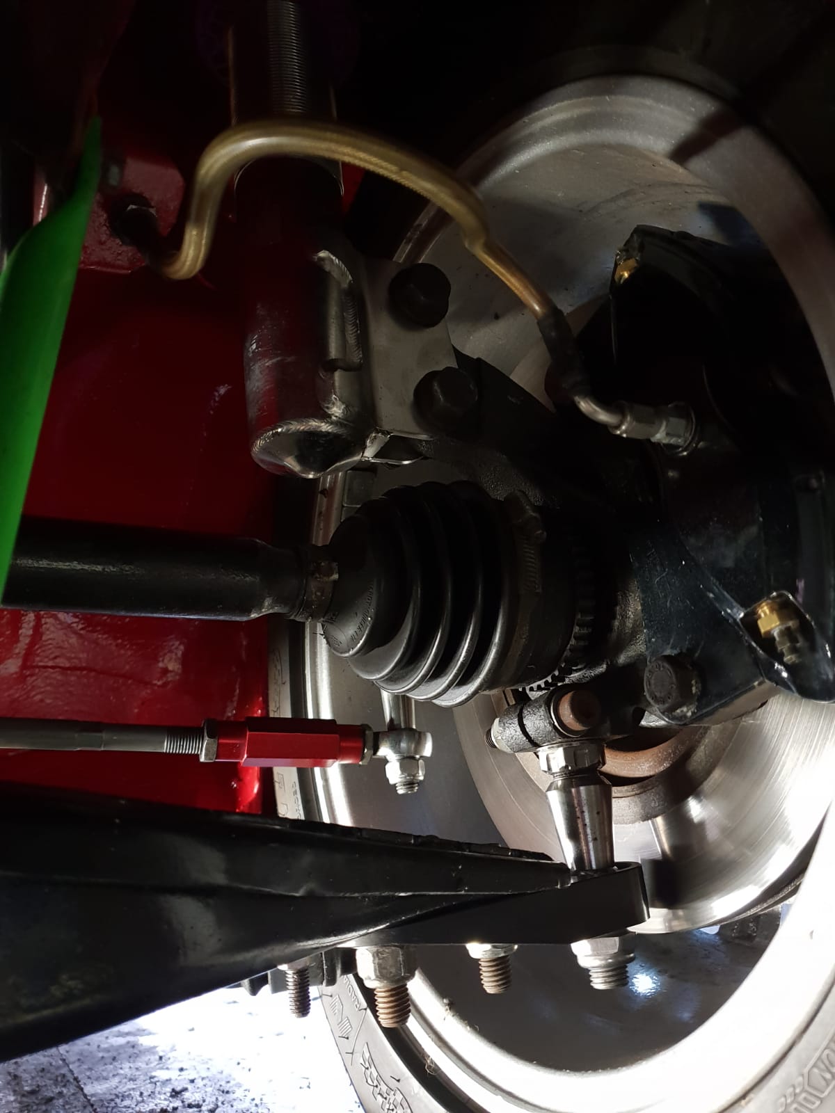

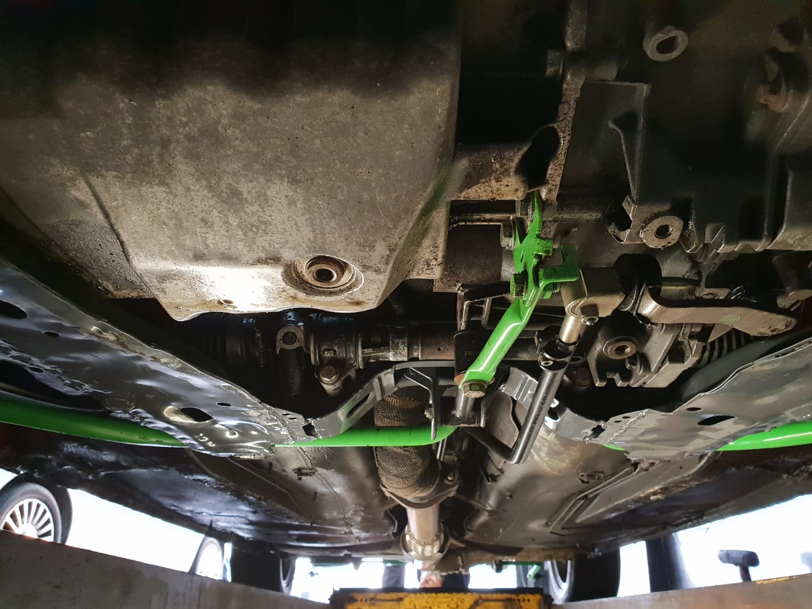

Also took opportunity to look over the loaded up geo of the roll kit whilst it was on the pit. Lower arms sitting pretty flat with fully equal suspension load on the front axle.
Anyway, couple of pics:
Under the car
And the kit working it's magic
