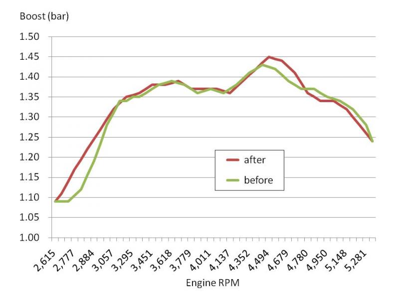

Results are in, I was losing boost...albeit not a huge amount.
The only comparable 'before' run I could find was when I was recently playing about with the Audi S4...I still held my own despite the lack of boost peak LOL
I'd say it is worth a check over...but make sure you check them ALL!

must be able to feel that small flat spot of lag gone now?
It certainly does feel different, the front tyres are scrabbling about a little more than they were before.
The other thing I'll mention is that when looking through my pre Mountune MP215 data recently the peak boost figure was 1.33 bar.
Consider that when looking at what it now has above...from 3,000 rpm to 5,250 rpm it holds a figure above the peak spike it had before.

Nope! Ambient and intake were comparable as well...I just didn't bother graphing it as was interested in the changes in bar only.
Having had a normal commute run in this morning it definitely does get boosting fully a lot sooner, cleaner and harder...pretty much exactly as you would expect it to from looking at the before/after graph...it's at that low rpm point where the delta is greatest that it feels the most improved.

Not as such...I went over all the clamps giving them a little tweak to tighten them up...but as the one directly on the turbo is buried so deep in the engine bay, and also that all clamps beforehand were more than tight enough...I didn't bother with it. My fiddling about with all the others must have wobbled the pipe enough for it to eventually work its way off.

1.4 bar is a lot of pressure on cheap oem jubilee clips. Probably Murray clamps would be a good investment.

So, after a few days of running the family around on holiday to various places I'm averaging 50.6 mpg on this latest tankful.
I think the loose boost hose was seriously harming my economy as I've only been able to get a maximum of 40 or so over the last few months.
Definitely worth checking the boost hose clamps!
