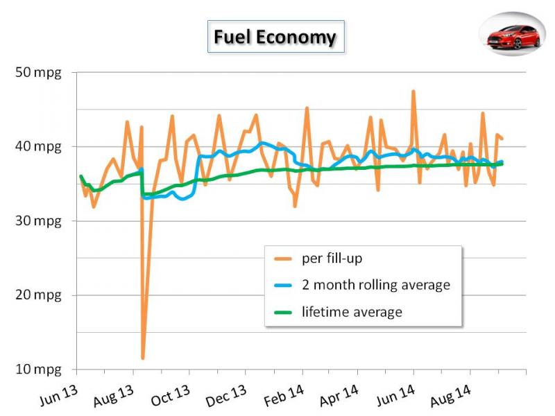

Love the fuel consumption figure. Can these fiesta do any wrong?
MarkCup
I brimmed it this evening before a 200 mile drive home...what it was showing was quite optimistic, the real mpg calculated as 46.3, still not bad considering it was full of bodies and was fairly short runs.
A progressive drive home solo and mostly on quiet motorways has given me an indicated 40 dead so more likely 37 ish in reality. I hardly ever touch motorways so I guess that's the norm?

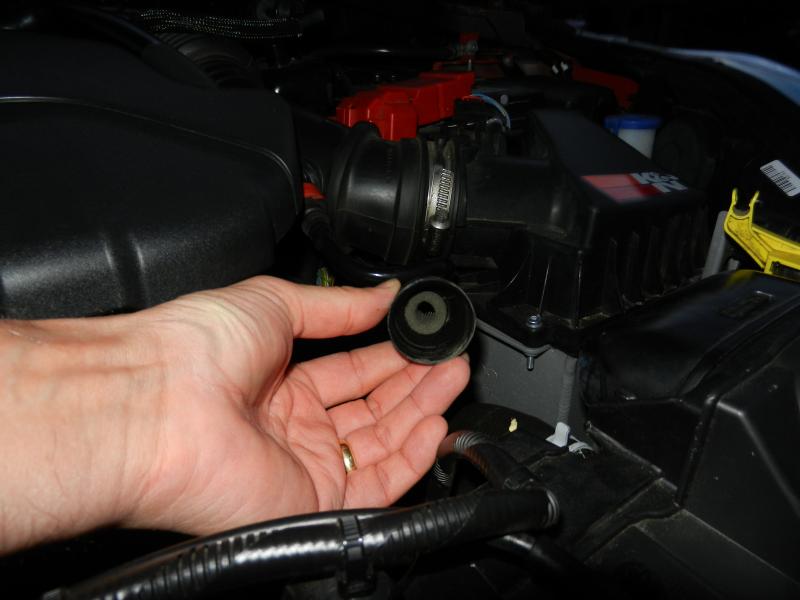

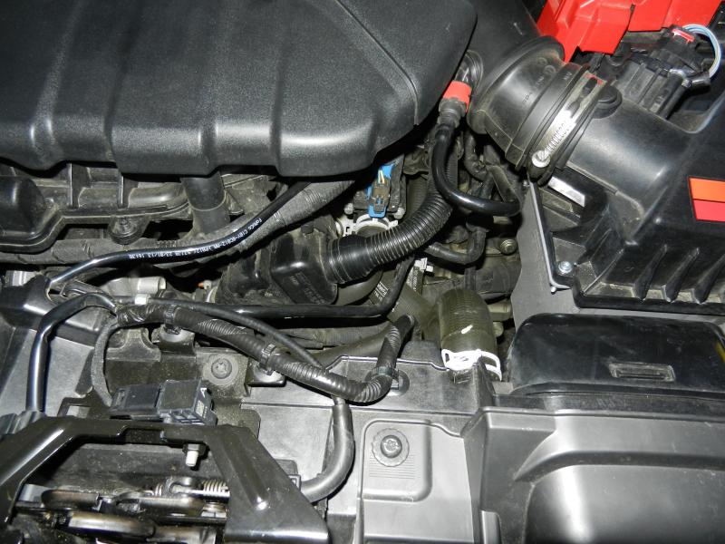

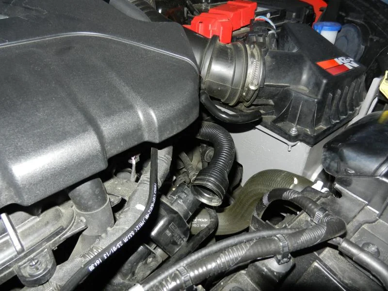

I heard about this simple, reversible and free mod a short while ago and today while at Goodwood idly chatting I thought I'd give it a go.
Find your sound symposer and the ribbed pipe that spurs off around the right-hand side of the engine toward the bulkhead;
Hold the symposer body with one hand using the other to firmly pull and wiggle the pipe away (friction fit only with two small ridges to locate it);

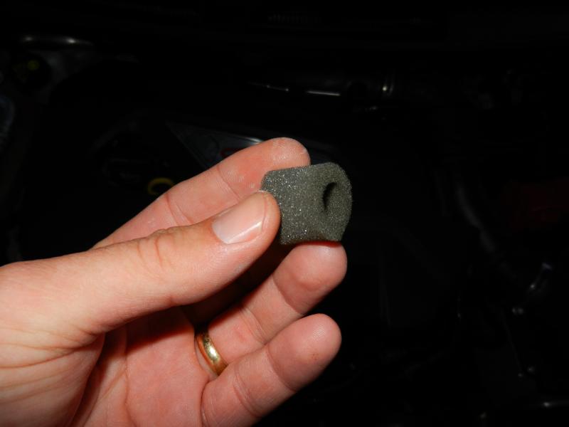

Peer deep inside to locate this little fella;
Then using a pair of tweezers or long needle-nosed pliers gentle pull this out (friction fit only);
The result is a slight increase in symposer noise volume in the cabin along with a much harder/harsher/sharper edge to it.
For now, I like it. If/when I tire of it it's going straight back in.

Might try that then, although I'm tempted to block the noise completely lol
MarkCup
Dead easy to do, you could even just block it up with blu-tac if you wanted to...it only carries the noise after all.
Was hilarious when I pulled it off at Goodwood today, Chris or Tim (can't remember which) started talking through it when I was sat in the car and it sounded like his head was in the passenger foot well!

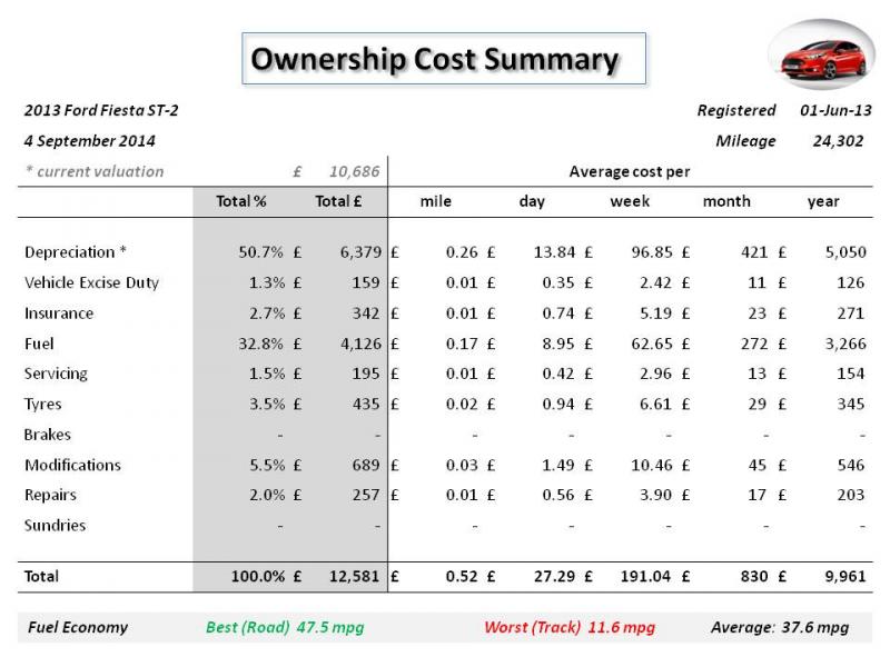

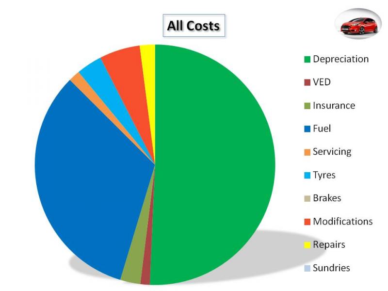

Time for another cost update...
Mileage now is just over 24k, second service is booked a couple weeks from now, a front suspension knock and a driver's door seal that's come unstuck will need attention, other than that it's spot on. Starting to lose the tautness in the drive train now though as the miles increase. Still a riot to drive but capable of being comfortable and effortless over long distances.
Brake pads are down to 2-2.5mm all round now so a call to my supplying dealer ended up with costs of £407 for discs and pads all round supplied plus the expected absurd fitting labour cost.
Alternatives are being sought but I'd prefer to stick with standard pads as they're so good all round, 24k miles, low dust, zero fade and a solid pedal on track with good feel.
Decisions decisions.

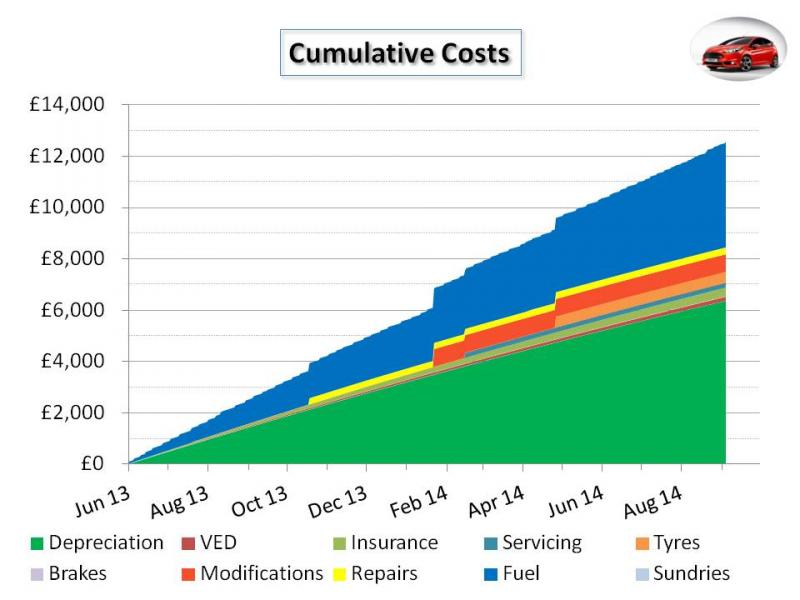

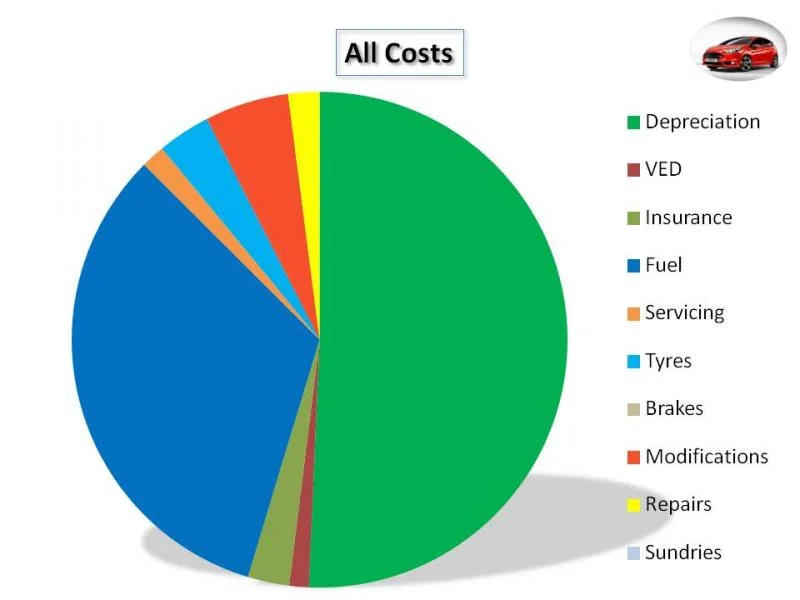

Is that graph right above..???
Your car has lost 50% of its value in just over one year.???
50% of costs incurred so far is depreciation.
As RDH said of all my costs so far, just over half has been depreciation.
This is based on my 1 year 3 month old car with 25k miles on it being sellable privately for £10,500. Considering how swamped the market is I think that's a fair valuation.

£10,500??? Last time checked was one under £13,500, that was an st-1 with 36k on the clock.
Gally
I've no idea where you got 10.5k from mate. They're trading higher than thst.
  53 Clio's & counting
To be fair working on a lower value isn't a bad way of doing things, at least it means you get more than you calculate lol
MarkCup
I didn't want to depreciate it straight line as that's not how it works in reality. I think my flaw is that I used the actual price I paid as the starting point and not the RRP, hence it being so low now.
If I started with the rrp of be nearer the figures suggested.
