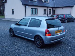

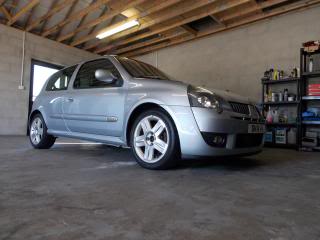

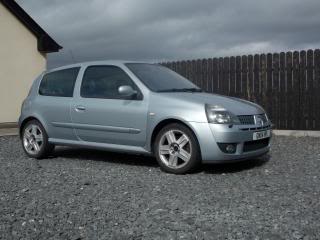

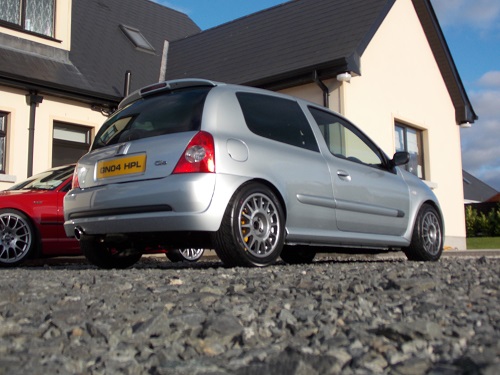

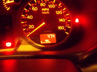

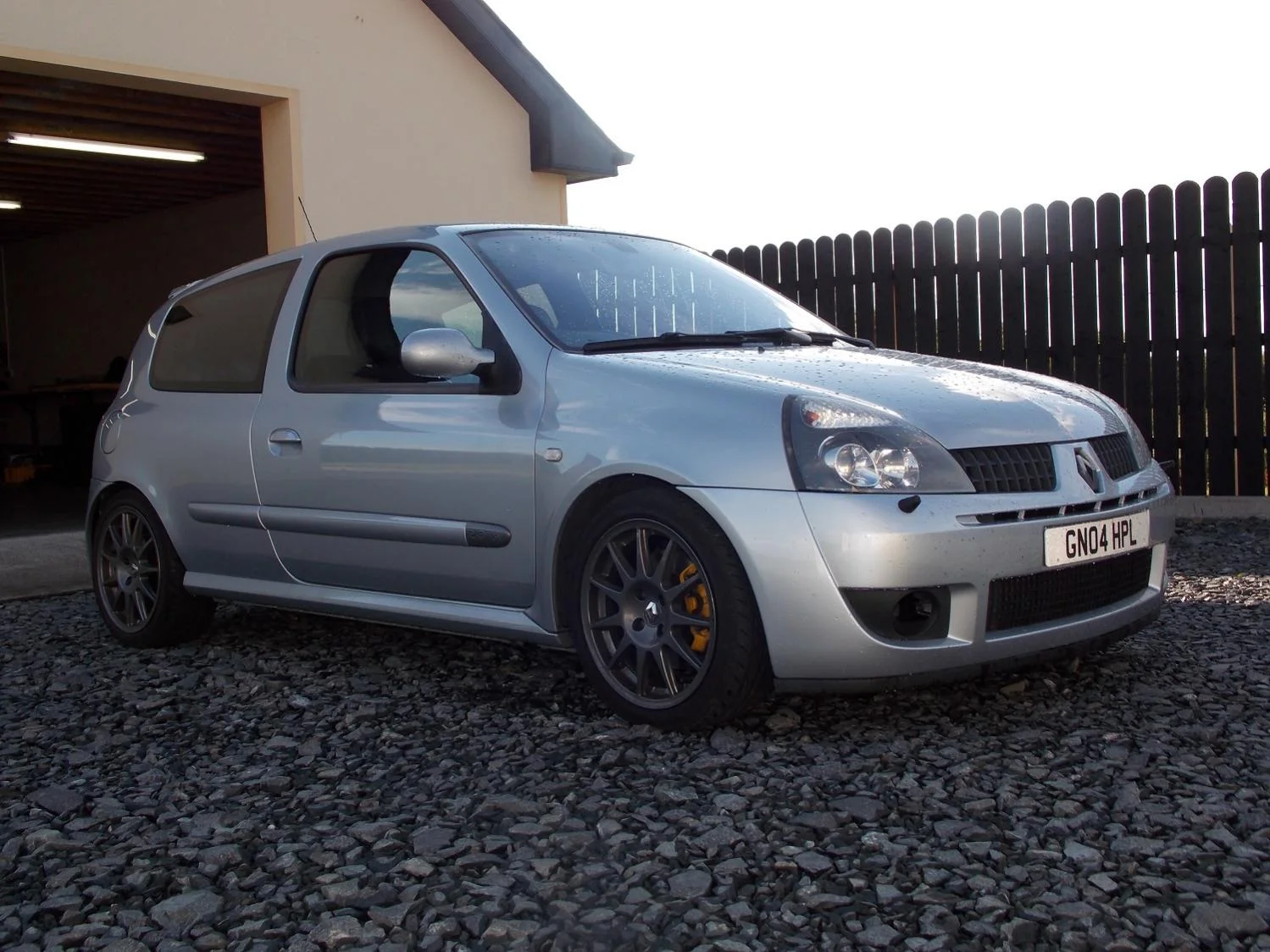

Went to view sbridgey`s iceburg silver 172 and after a bit of haggling off we headed with the 172 for Hollyhead for the boat back to Ireland.
It was the most economical road trip ever!!!

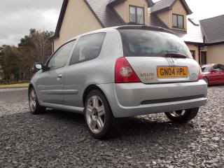

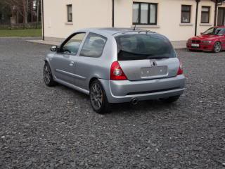

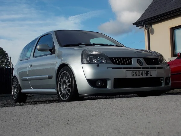

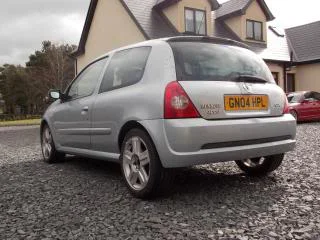

I had it at 48mpg before I took the pic :D

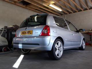

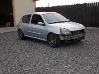

So got it home and took some snaps before I took it apart
It drove very well on the way home apart from the leaking exhaust which will be sorted.
So give it a good wash and into the garage it went while I went parts shopping.
A lot more up-dates to follow....
mckay
  Ph2 Iceburg 172

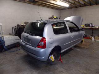

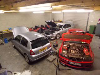

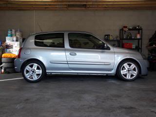

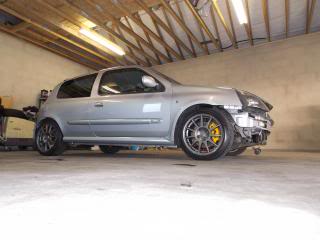

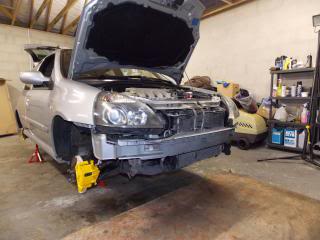

Took it into the garage and this is how it sat,
That's the last time its going to be looking like that :rasp:

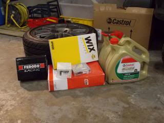

So here is the shopping list:

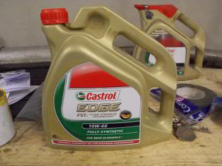

Castrol 10w60 engine oil
Genuine oil filter and sump washer
Genuine air filter
Nkg PFR6E-10 spark plugs
Gear box oil 75w90
Pollen filter

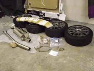

Now for the mods:
cooksport springs

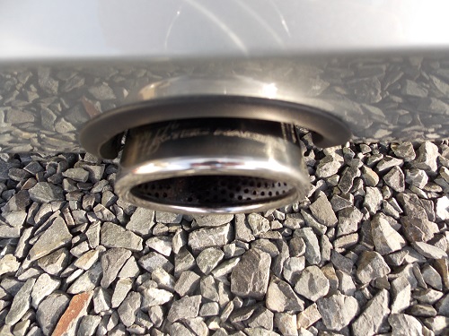

K-Tec recessed super-sport cat back s/s exhaust
Cup rear spoiler (got off cs member)

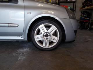

Recently refurbed cup turins finished in anthracite
Ferodo ds 2500 front brake pads
Heres some of the parts for servicing

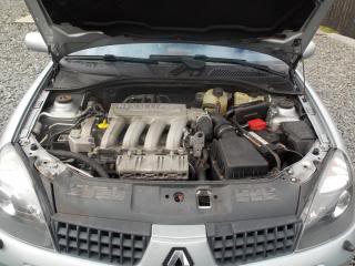

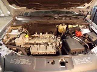

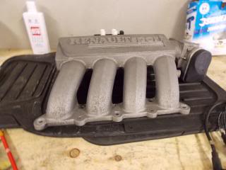

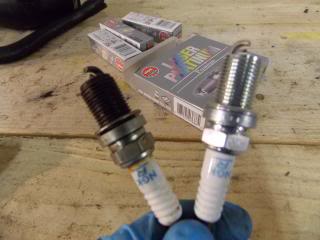

How off with the inlet manifold and out with the old plugs
Old plugs were a bit worse for ware!!!

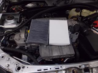

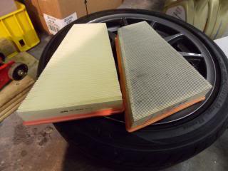

Changed the air filter which wasn't to bad

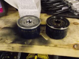

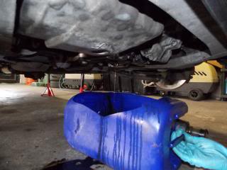

Next I drained the engine and gearbox oil
New and old oil filter
mckay
  Ph2 Iceburg 172
In with some new Castrol 10w60 and 75w90 gearbox oil

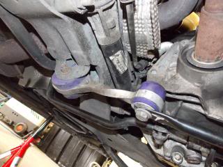

It also has a powerflex dog bone mount fitted

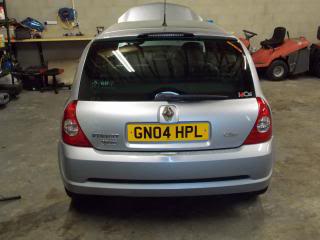

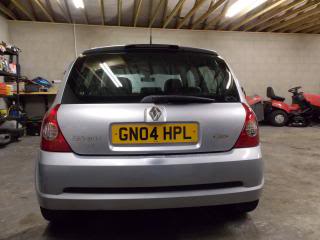

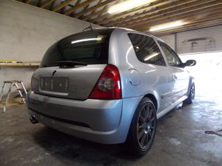

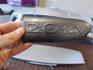

So while I was waiting on my mods to arrive I de-badged and de-stickered the rear end
looks better already ;)

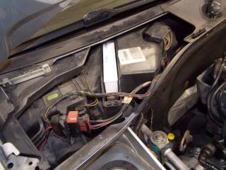

Had to let it sit for a few days while waiting on parts to arrive, so I did some work on my/wifes E46 320d and my mates E39 530d.

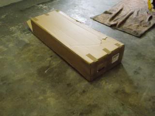

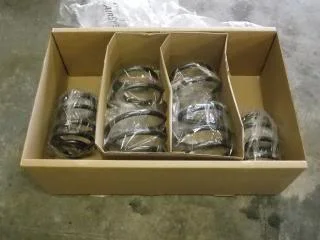

Post arrived :cool:

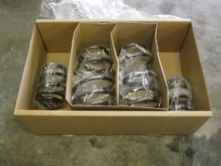

Cooksport springs
K-tec super-sport recessed cat back exhaust, cup spoiler and struts plus the refurbed cup turins

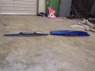

172 spoiler and cup spoiler

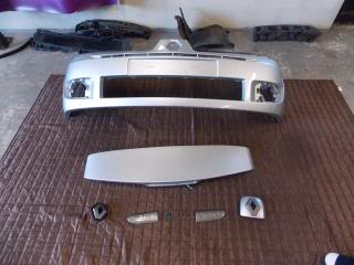

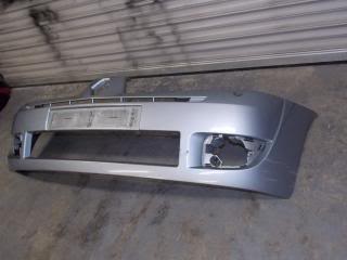

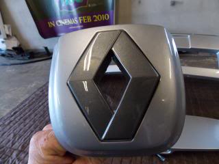

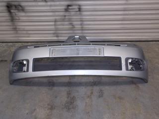

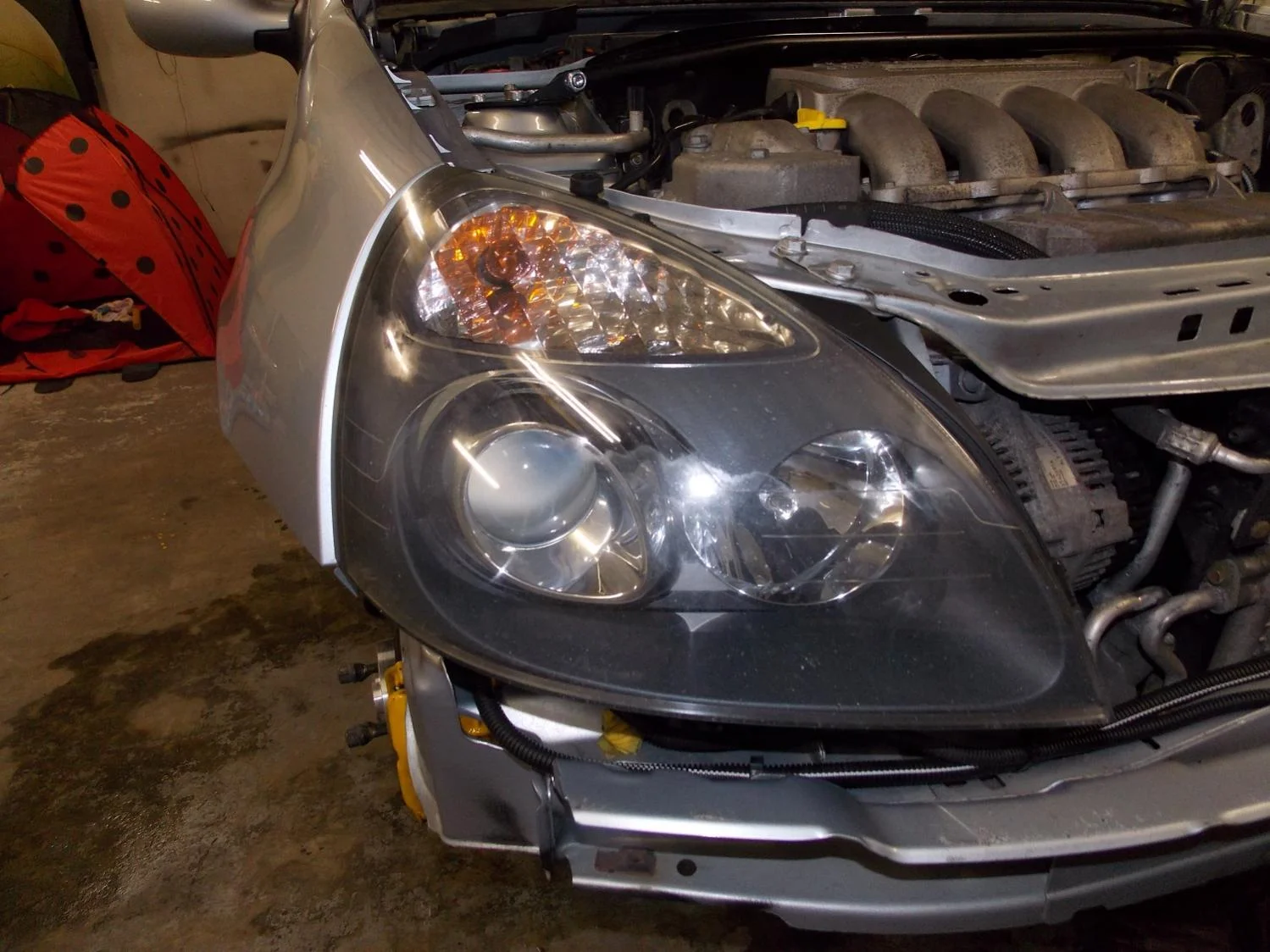

Removed the front bumper for painting as it had a few scuff marks
Also sent away all the diamonds and bullets to be painted in anthracite to match the wheels

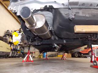

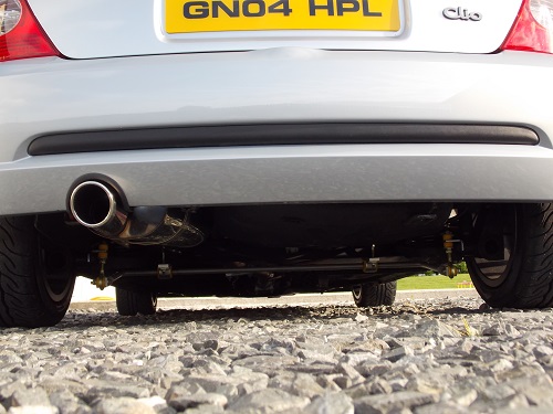

  Ph2 Iceburg 172

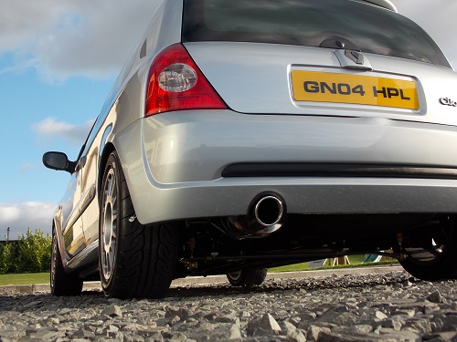

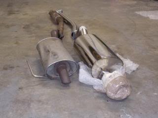

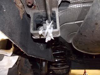

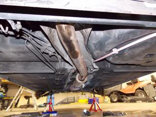

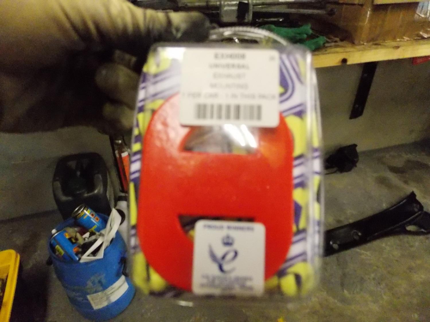

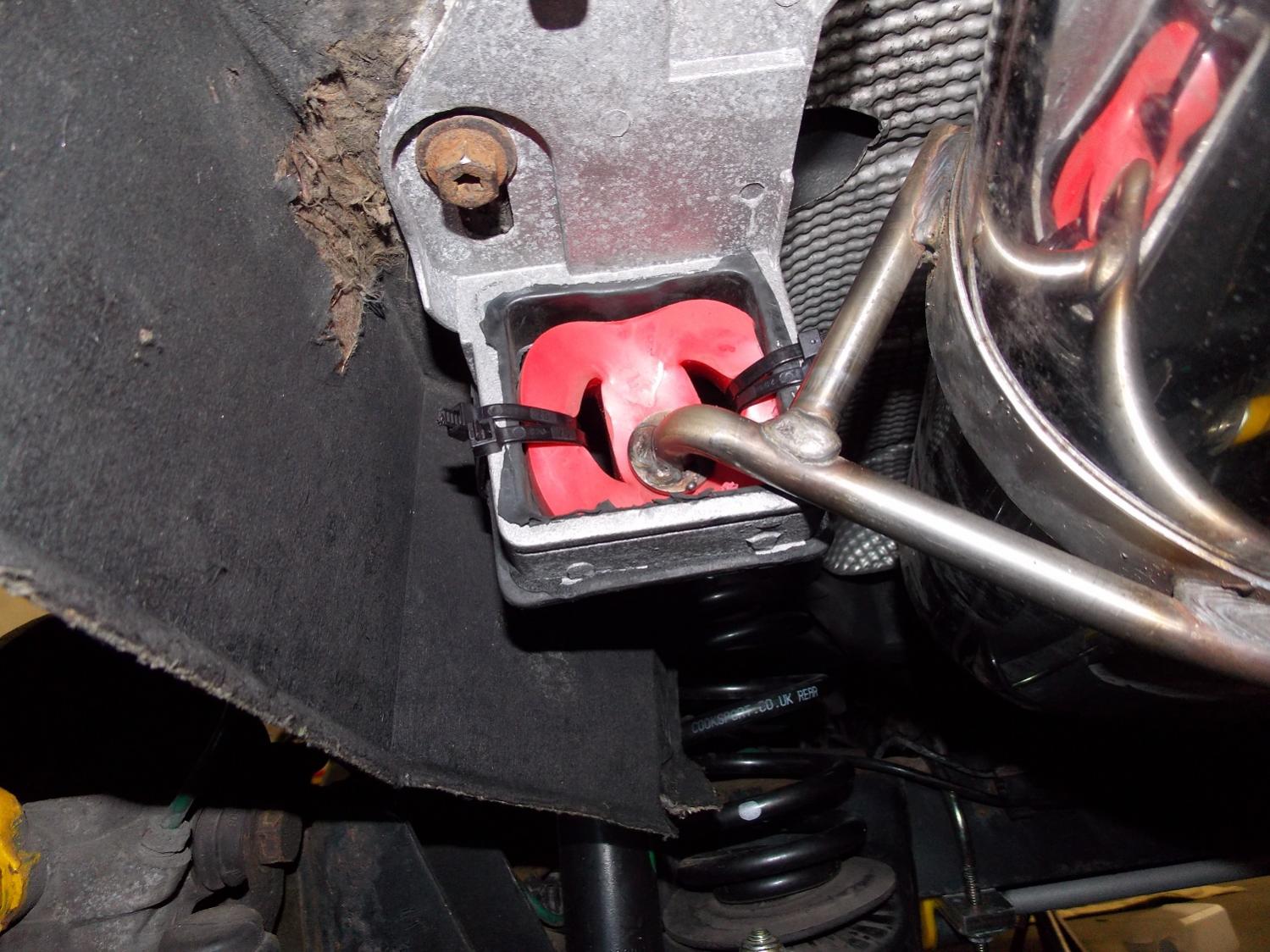

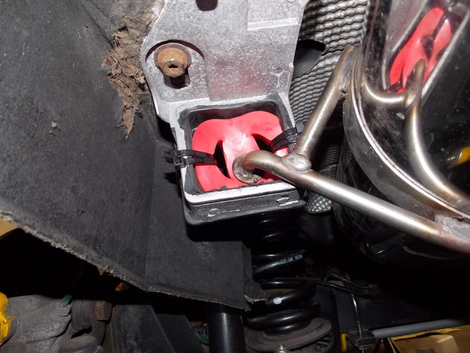

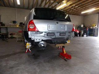

Old exhaust leaking
Hangers saw better days
Old and new
Fitted

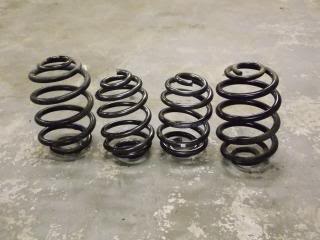

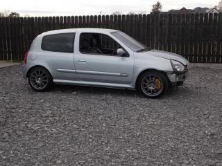

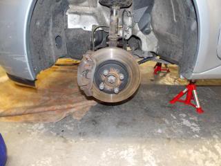

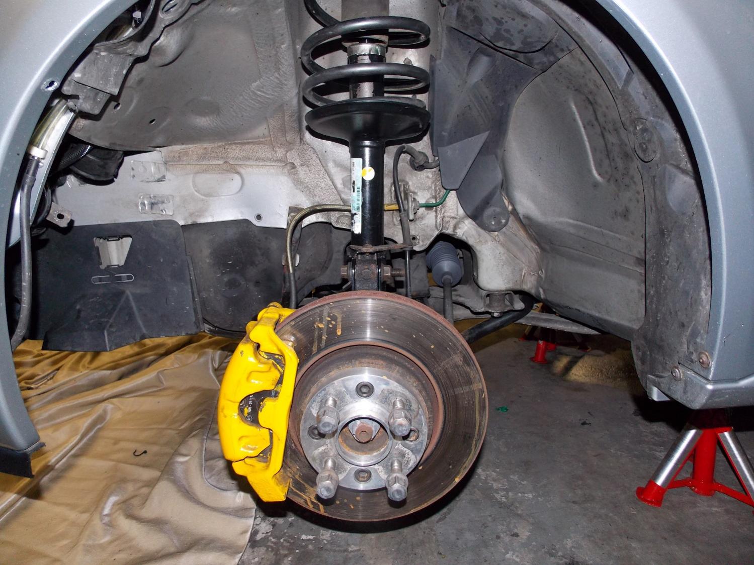

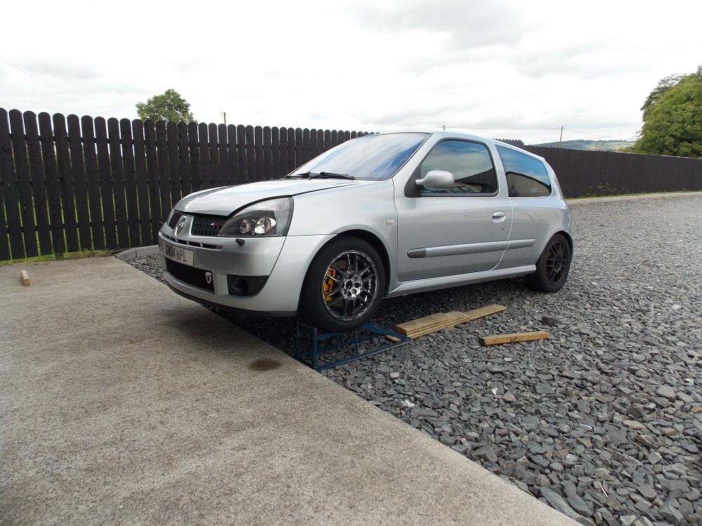

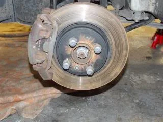

Now onto the springs Old and new rear springs

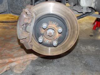

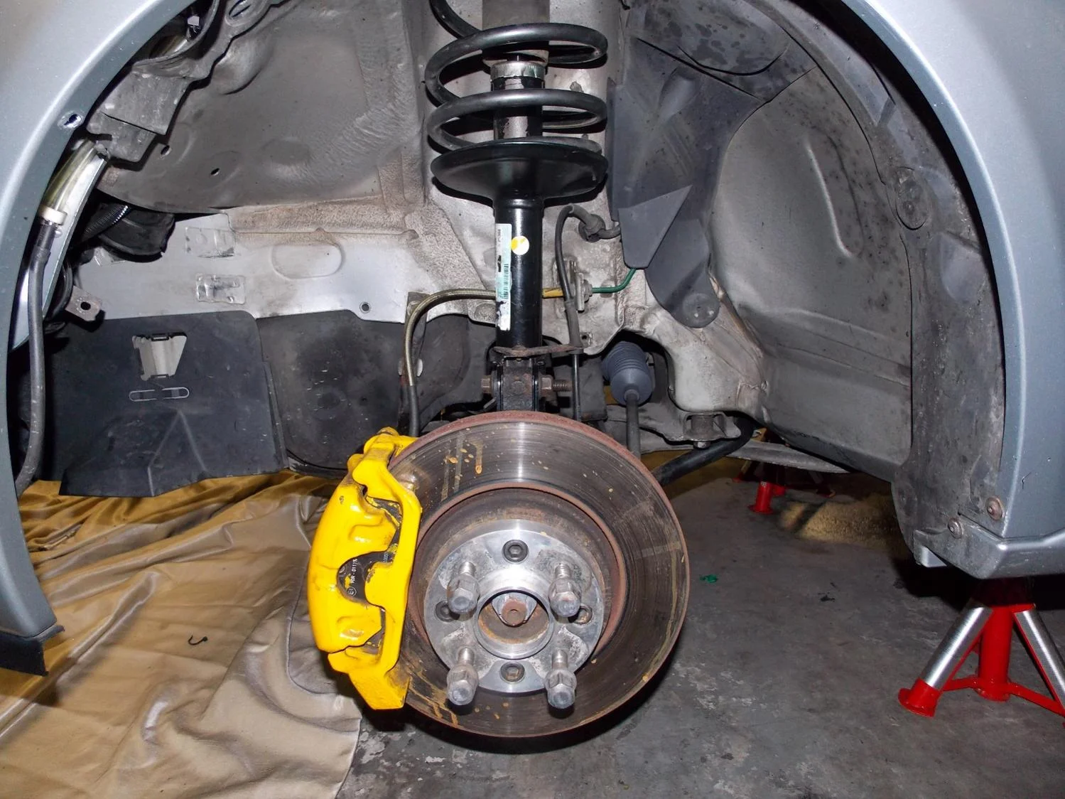

Going to fit the ferodo ds 2500 pads and tidy up the wheel arches and cailpers
Calipers painted yellow and arches cleaned

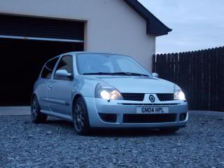

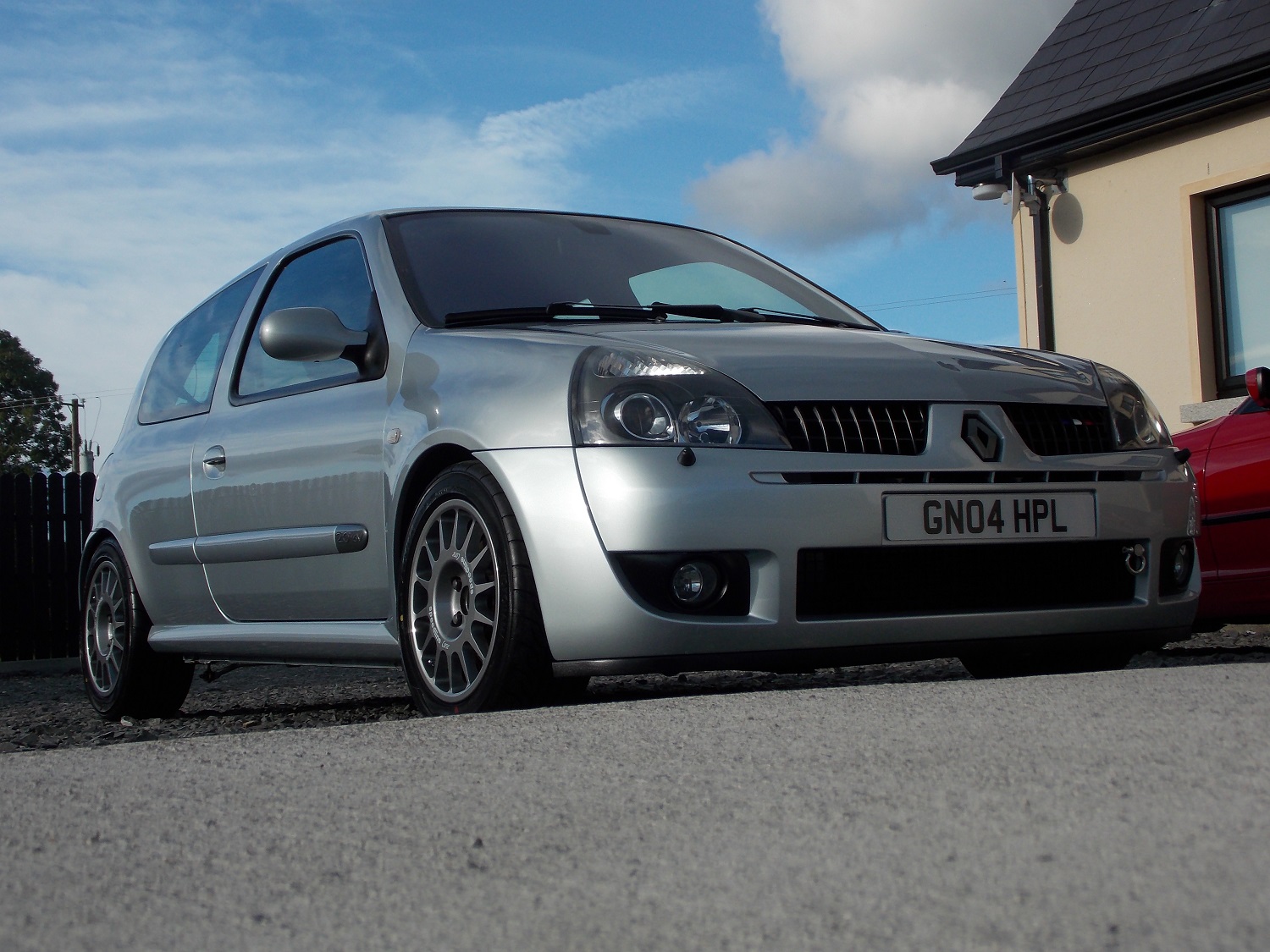

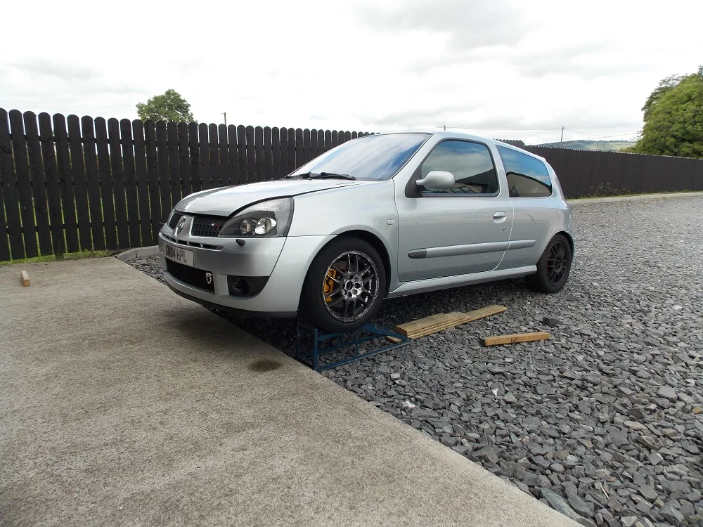

Back on it`s wheels and looking a lot better :cool:
Stuck in the pollen filter, old one was pretty bad :eek:

Bumper, Cup spoiler, diamonds and bullets back from paint

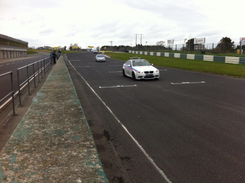

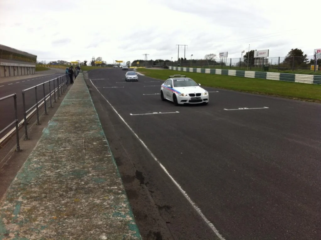

Here`s a few pictures from the track day in mondello park a few weeks ago.
mckay
  Ph2 Iceburg 172
Back where it belongs!!!

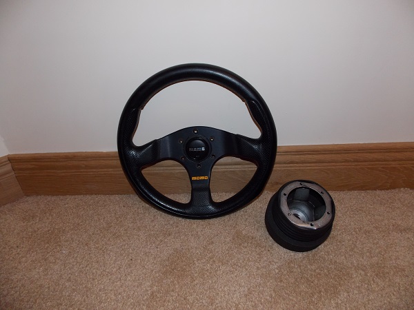

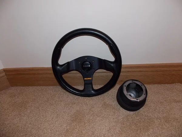

Momo team 300mm wheel and boss

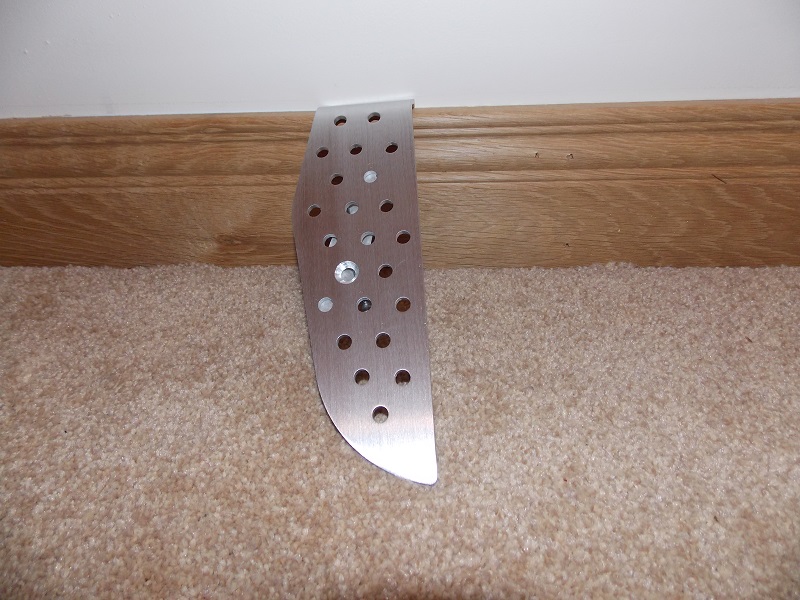

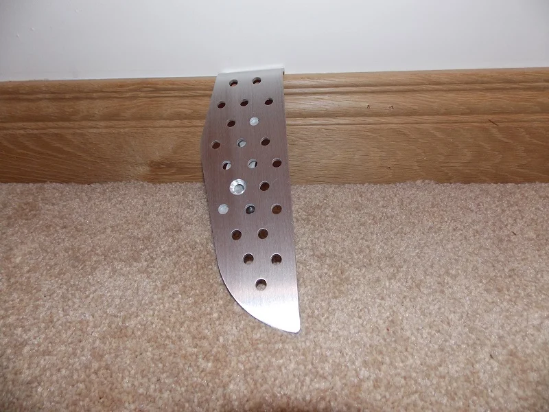

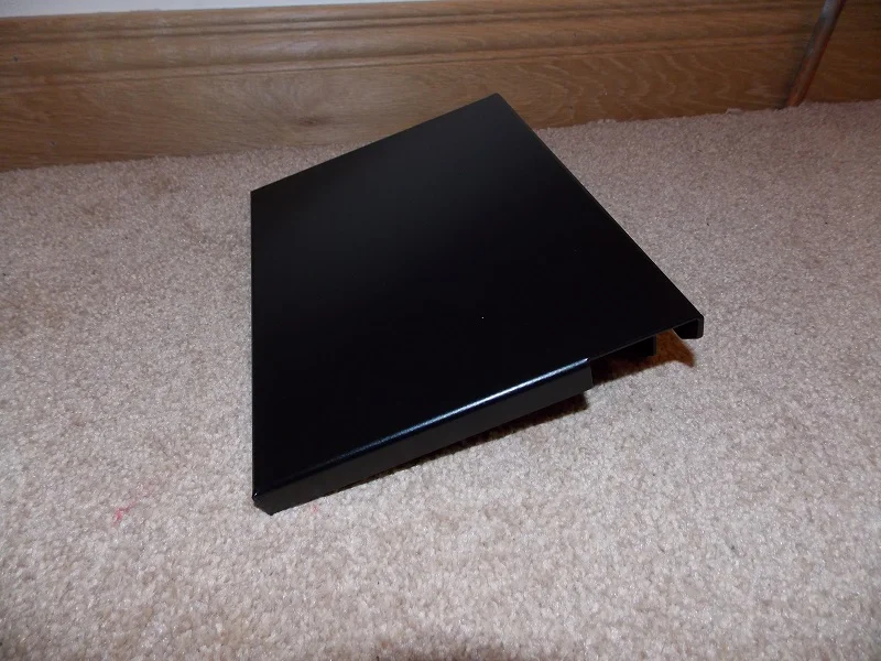

Aluminium foot rest

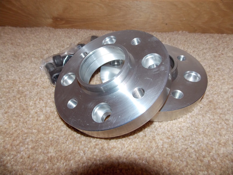

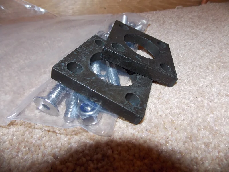

20mm front spacers
10mm rear hub spacers

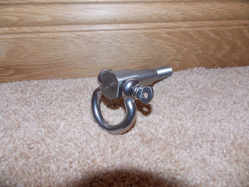

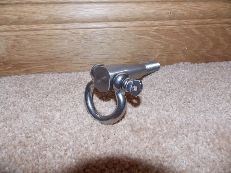

S/steel tow eye

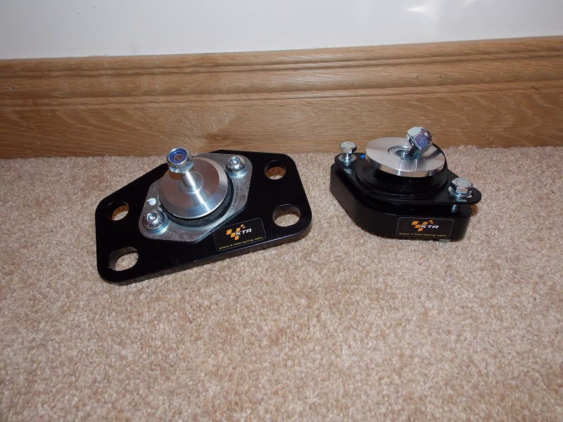

Vibra-technics engine mounts
Battery cover

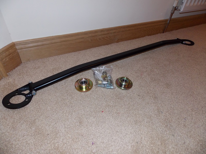

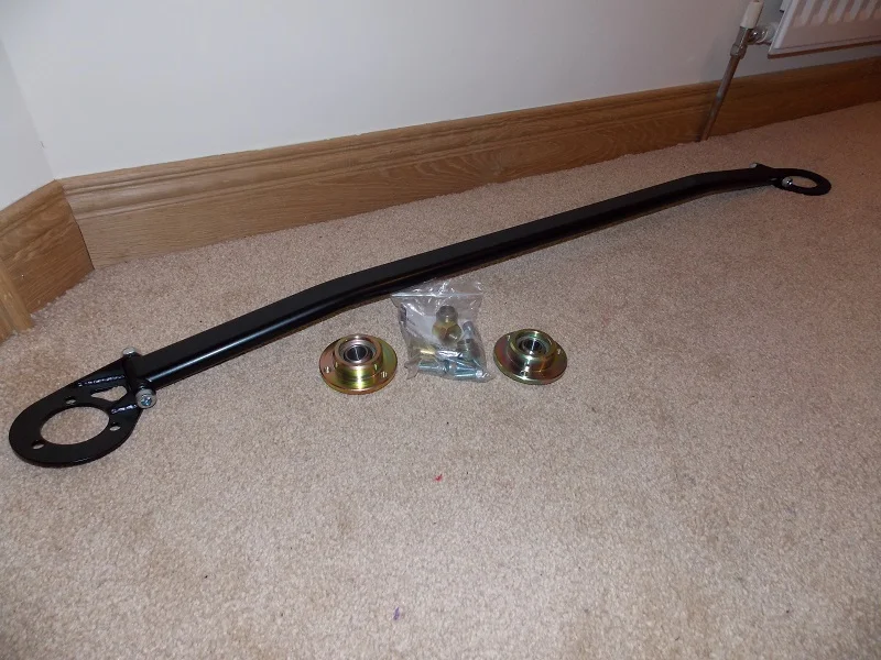

Pure motor-sport top mounts and strut brace package

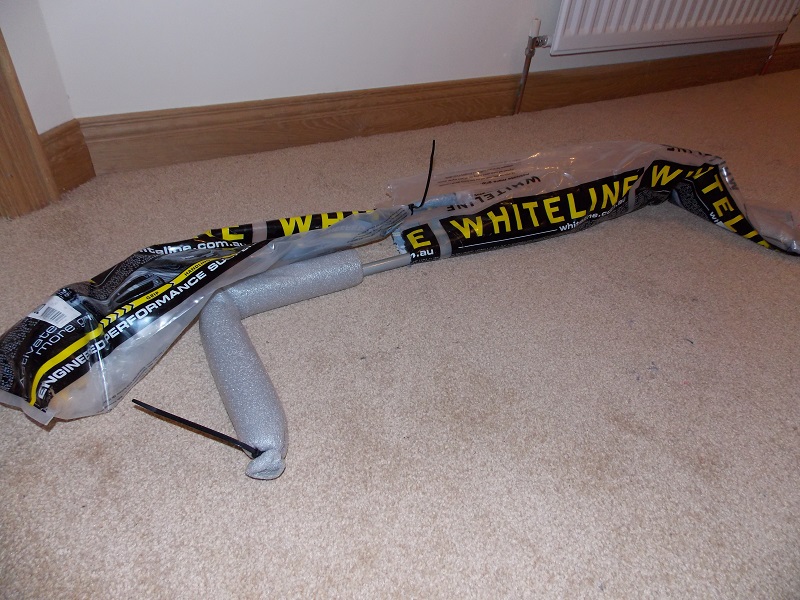

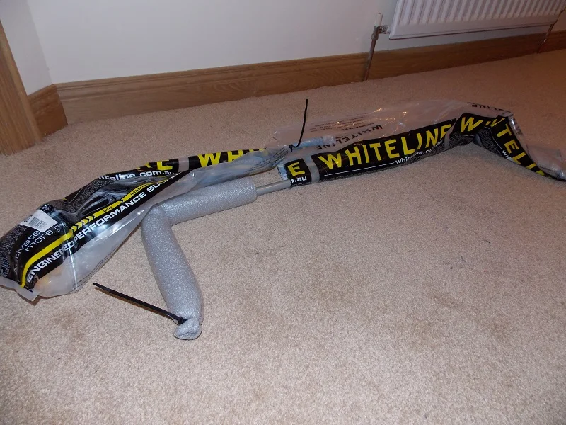

White-line rear arb
Just waiting on the rest of the parts for the suspension refresh from Colin in wests, and then get it all fitted at the weekend.

Thanks buddy, Haven't got the momo wheel fitted yet as I have to mot it first with the original wheel.
I bought it off a member on here so got a bargain really compared to the price of a new one.

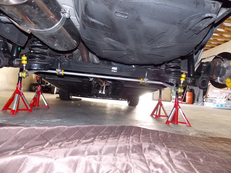

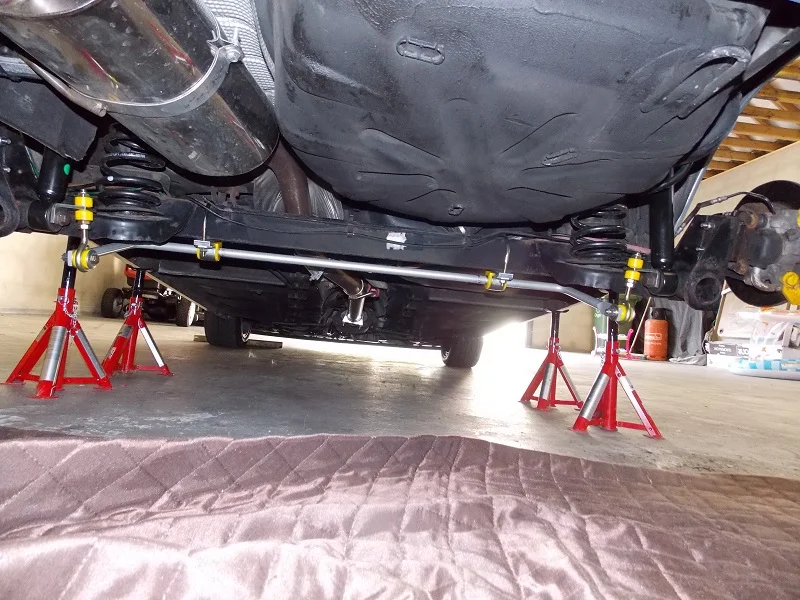

White-line rear arb

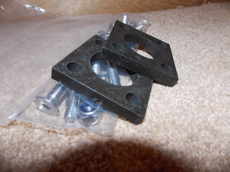

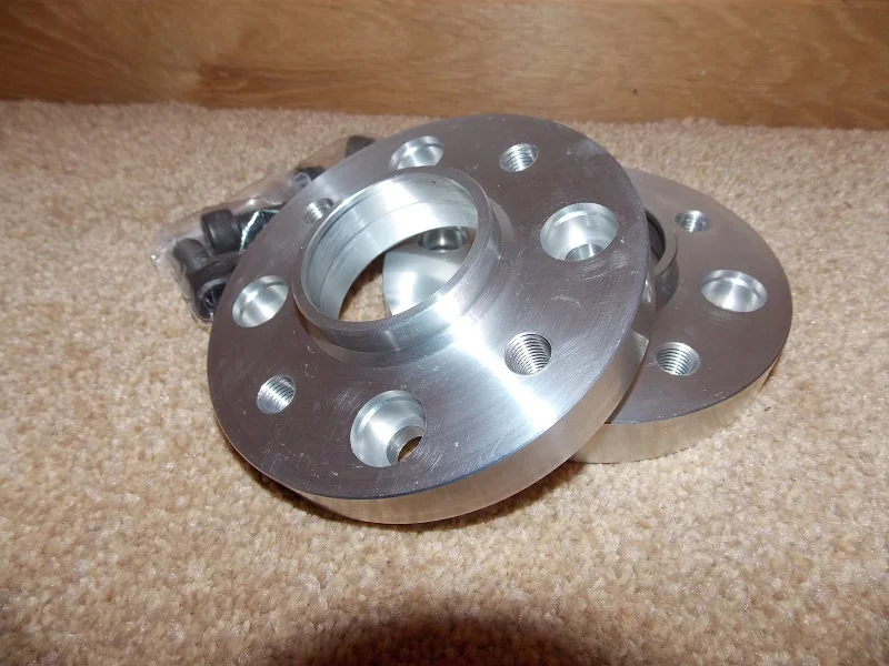

20mm front spacers and 10mm rears off Dan.

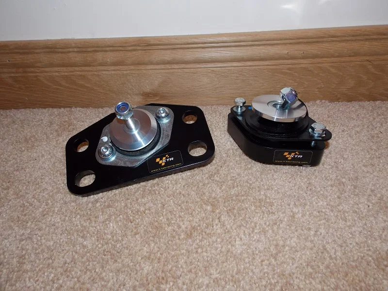

Vibra-technics engine and gear box mounts

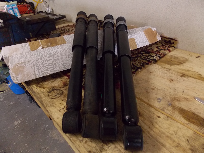

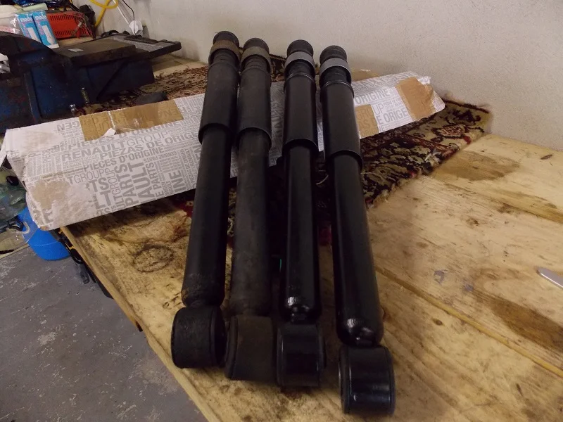

Old vs new rear shocks
10mm rear spacers
White-line rarb

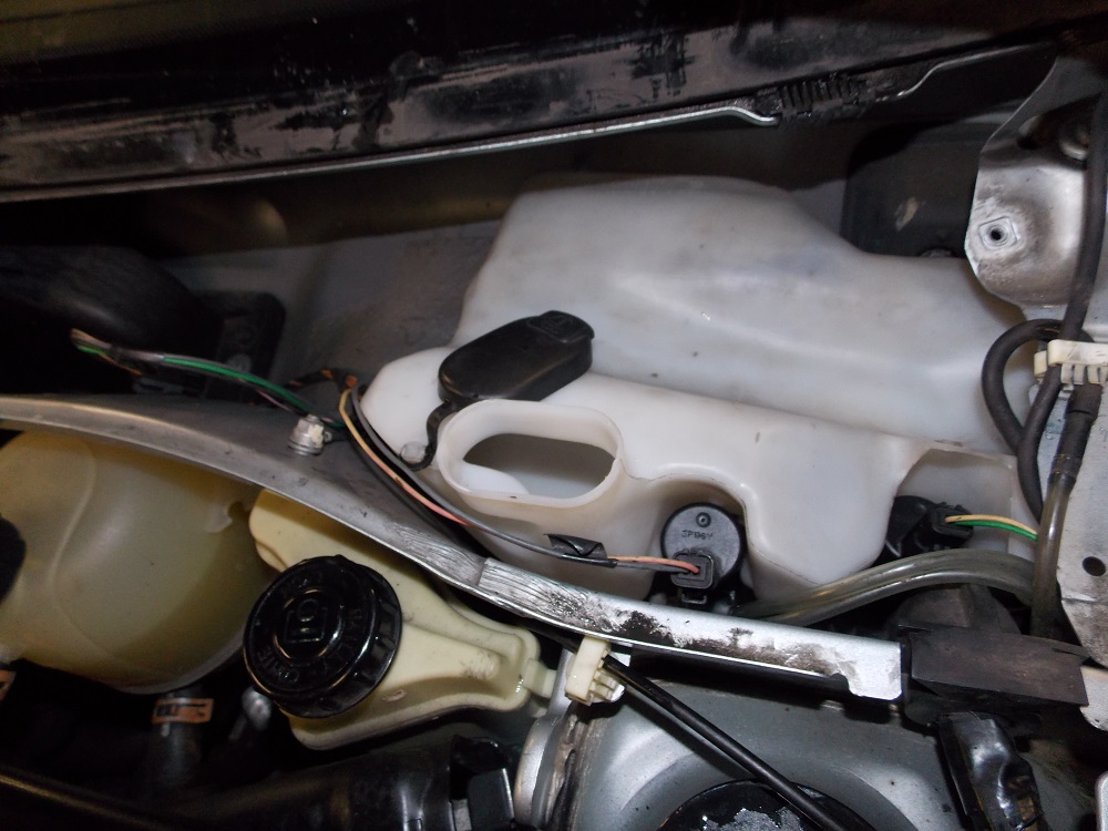

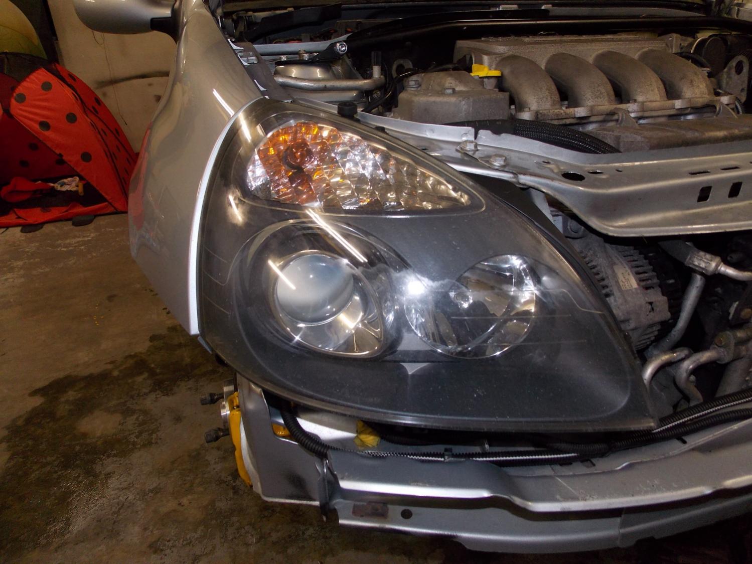

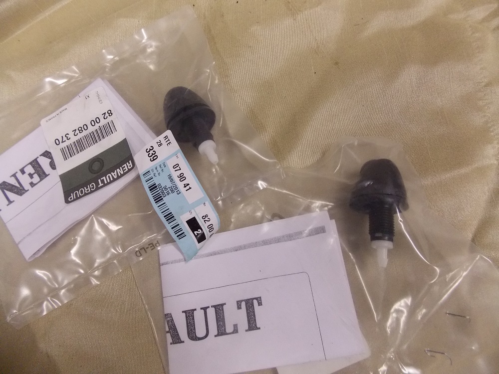

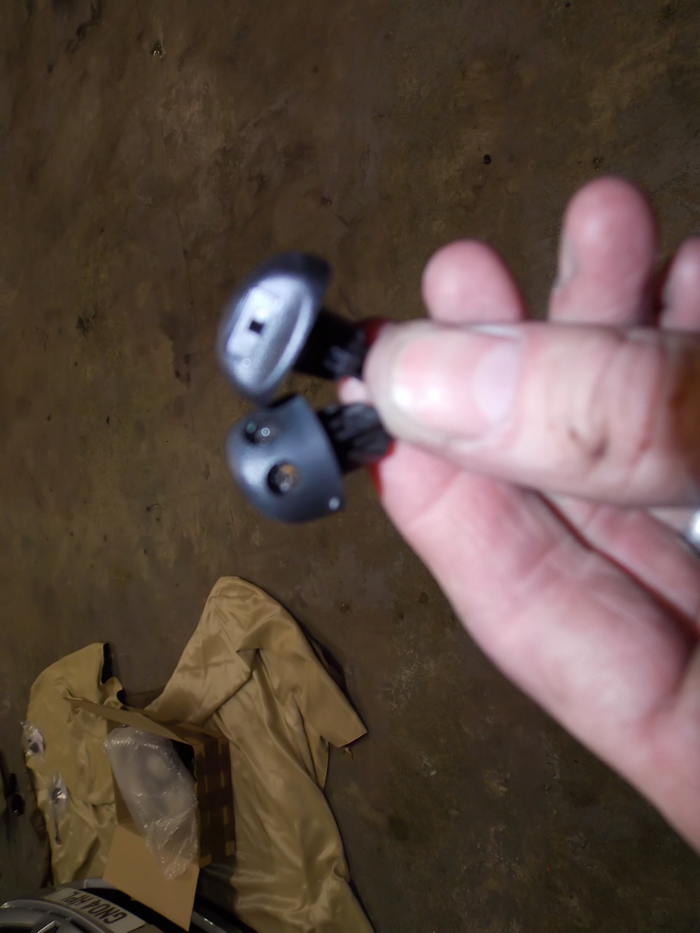

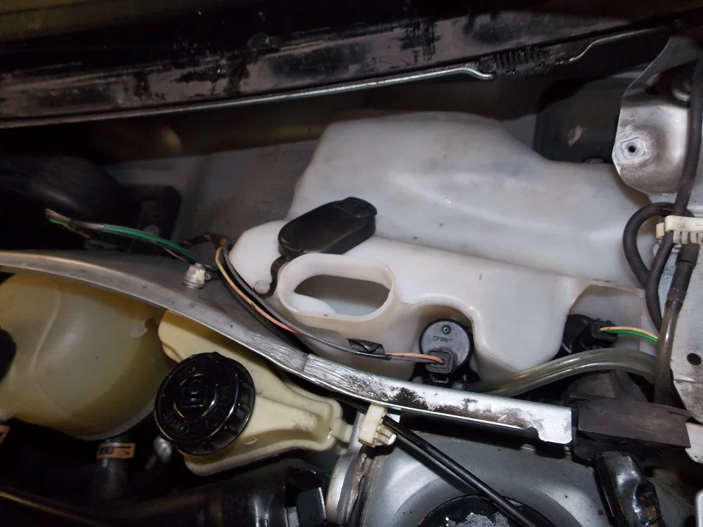

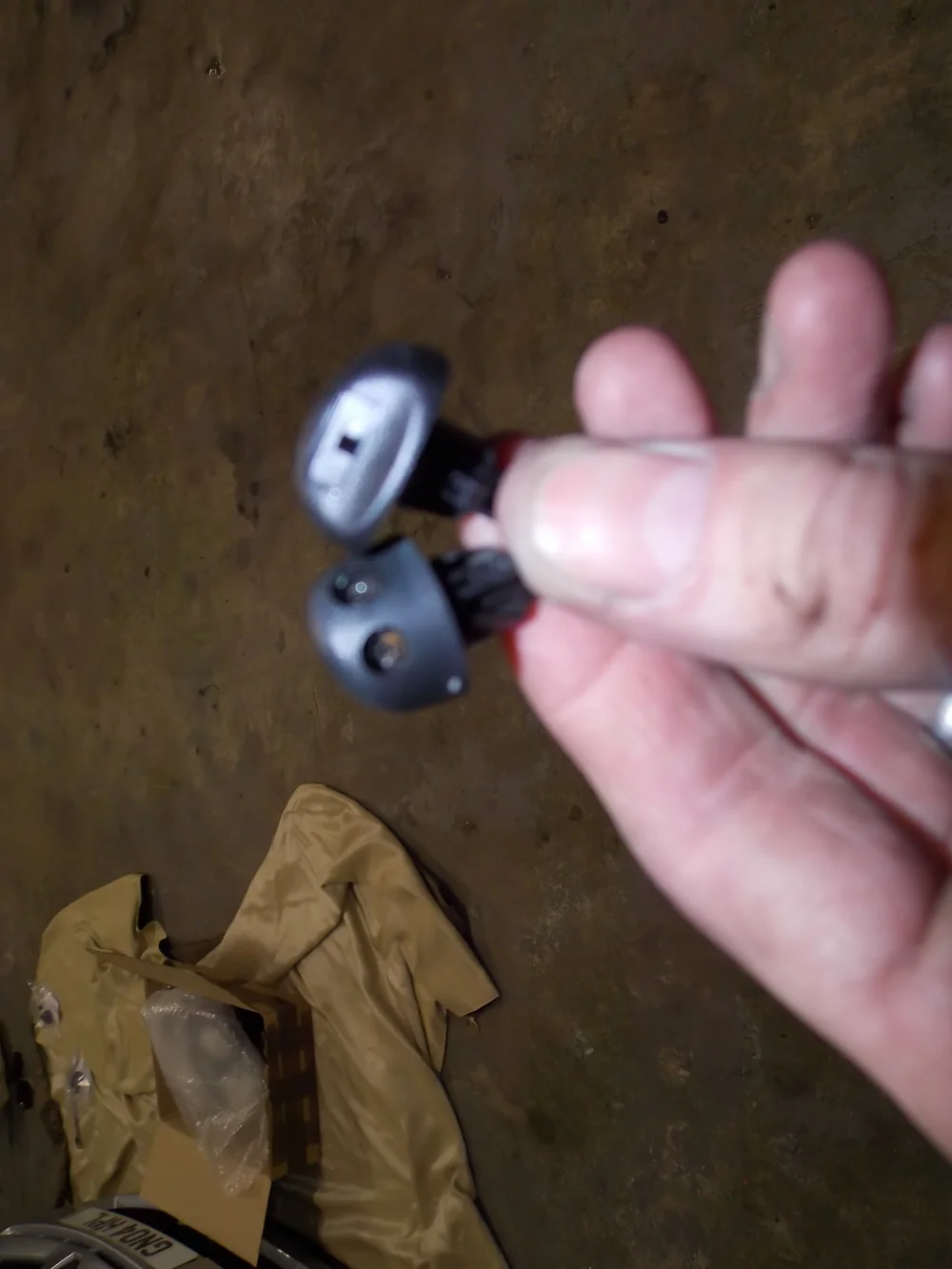

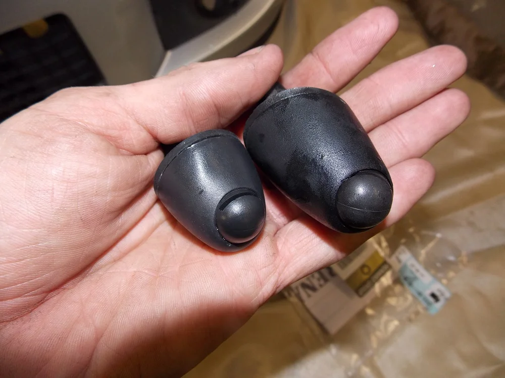

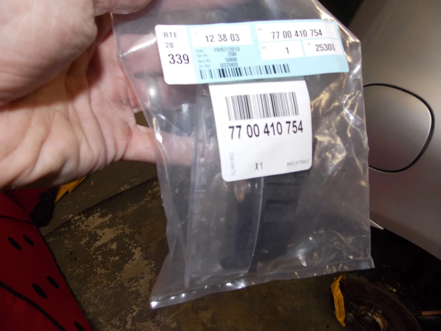

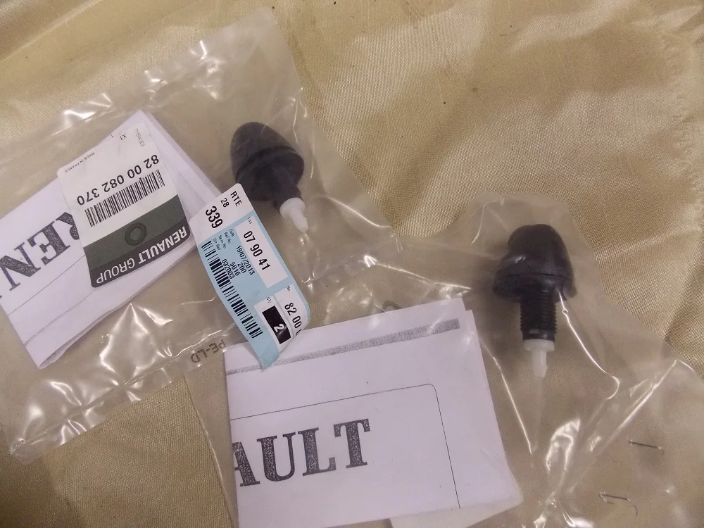

Sorted out the front headlight washers, did the mod on the motor and it worked spot on.

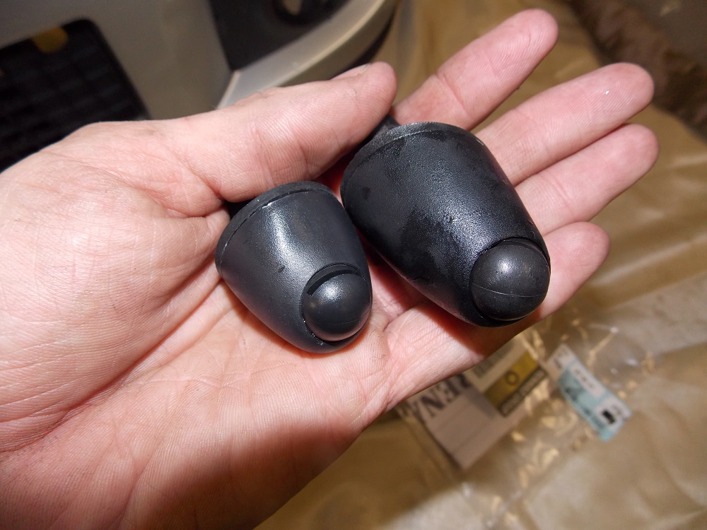

Fitted new Megane 225 washer jets. Big difference in size from Clio ones.
Fitted peugeot mist washers.

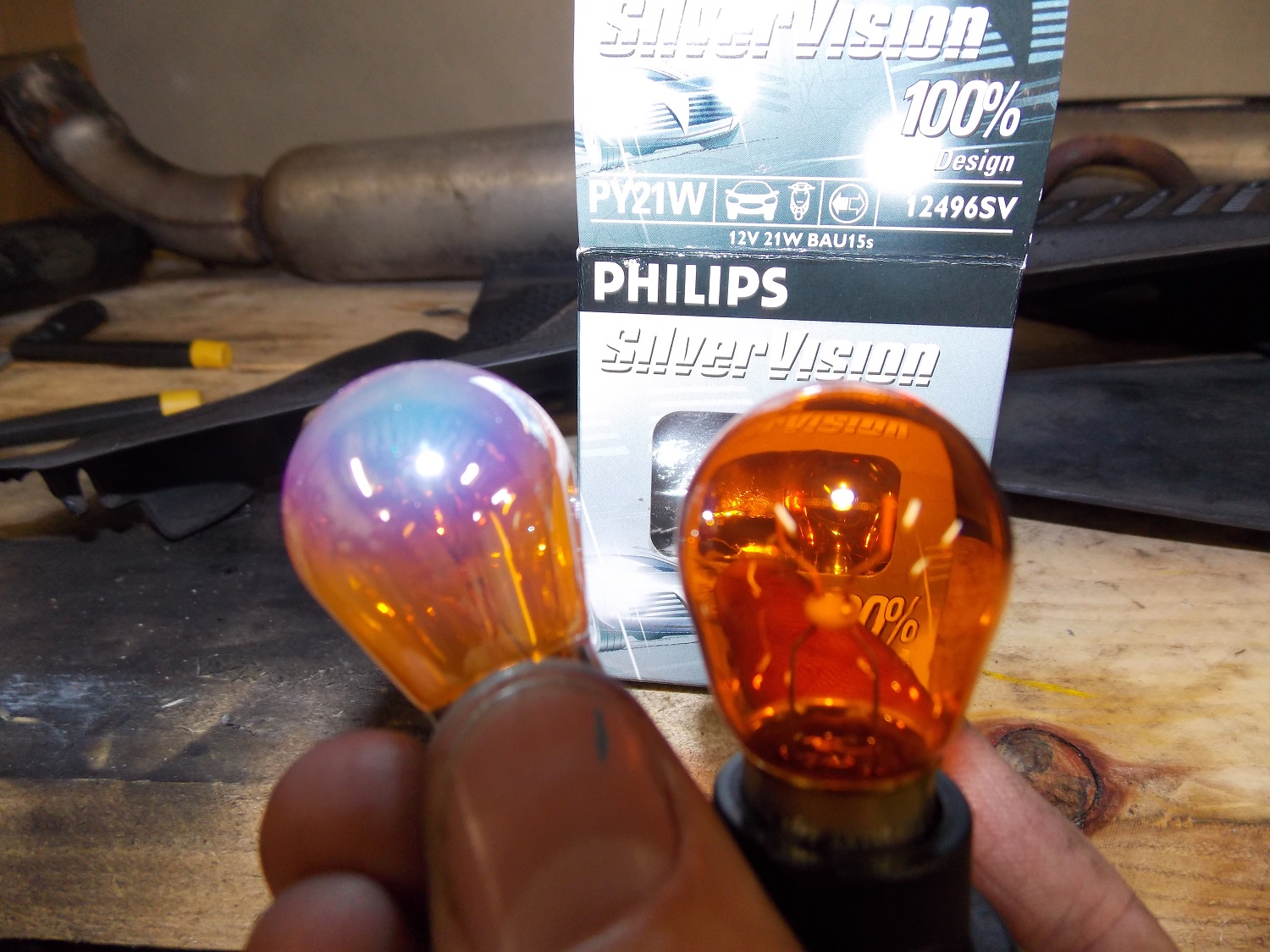

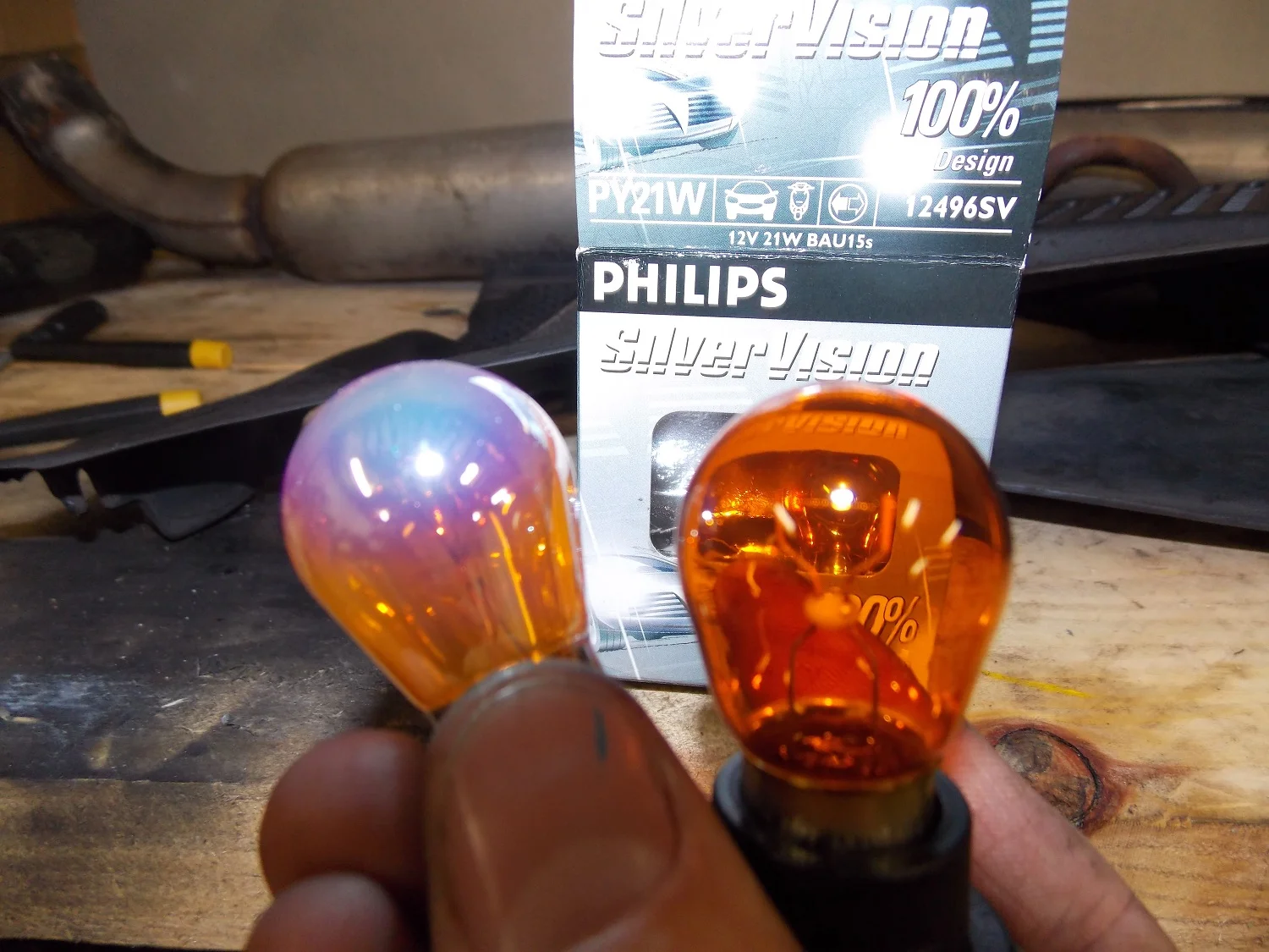

Fitted Philips silver vision indicator bulbs all-round

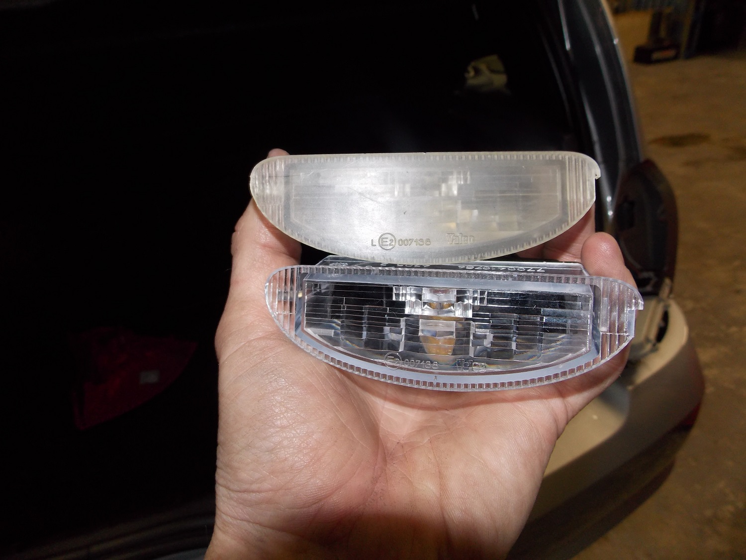

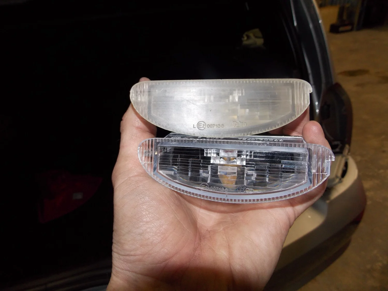

New rear reg plate light

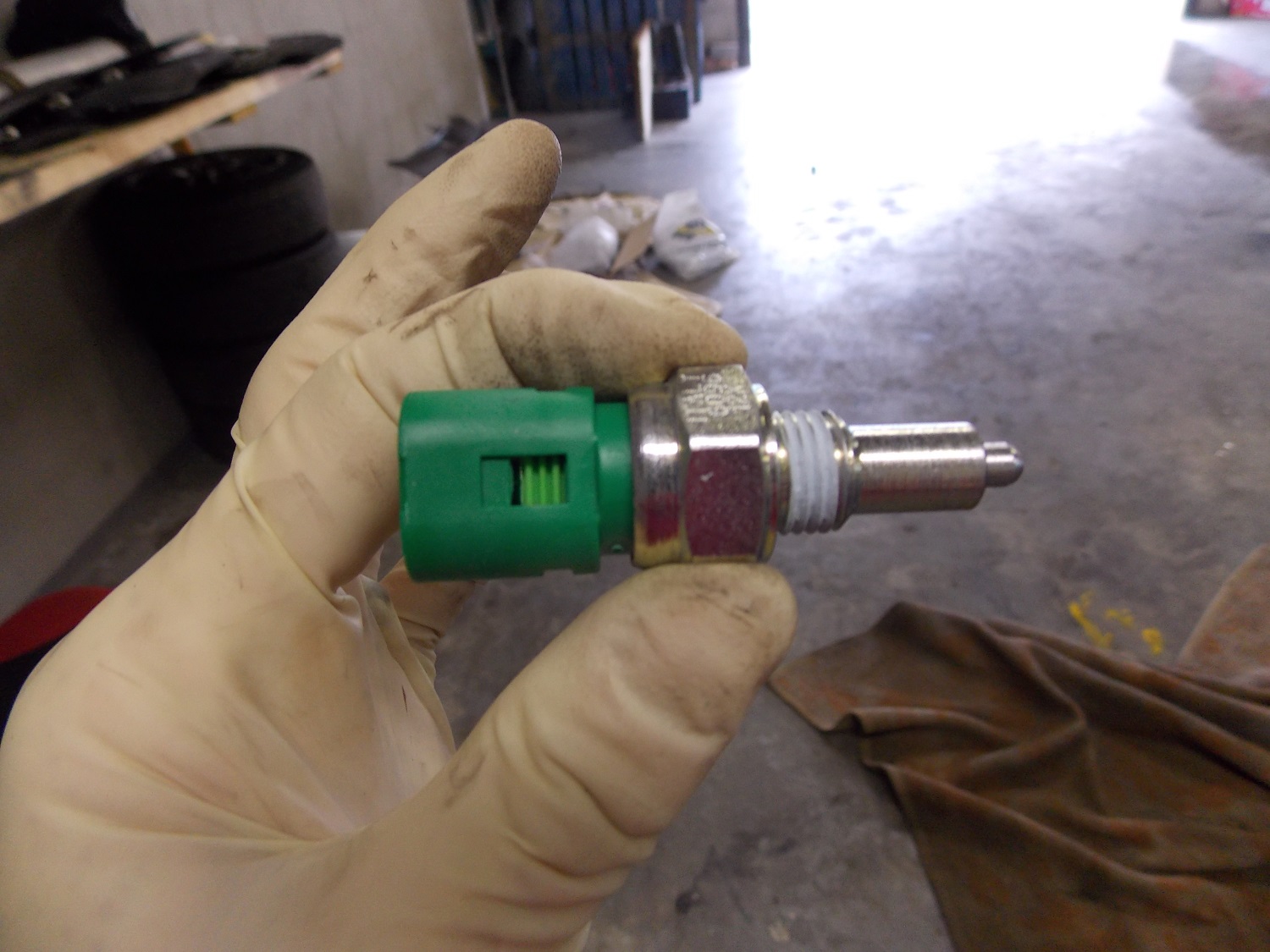

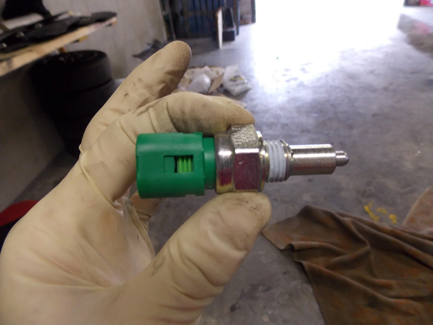

New reverse light switch

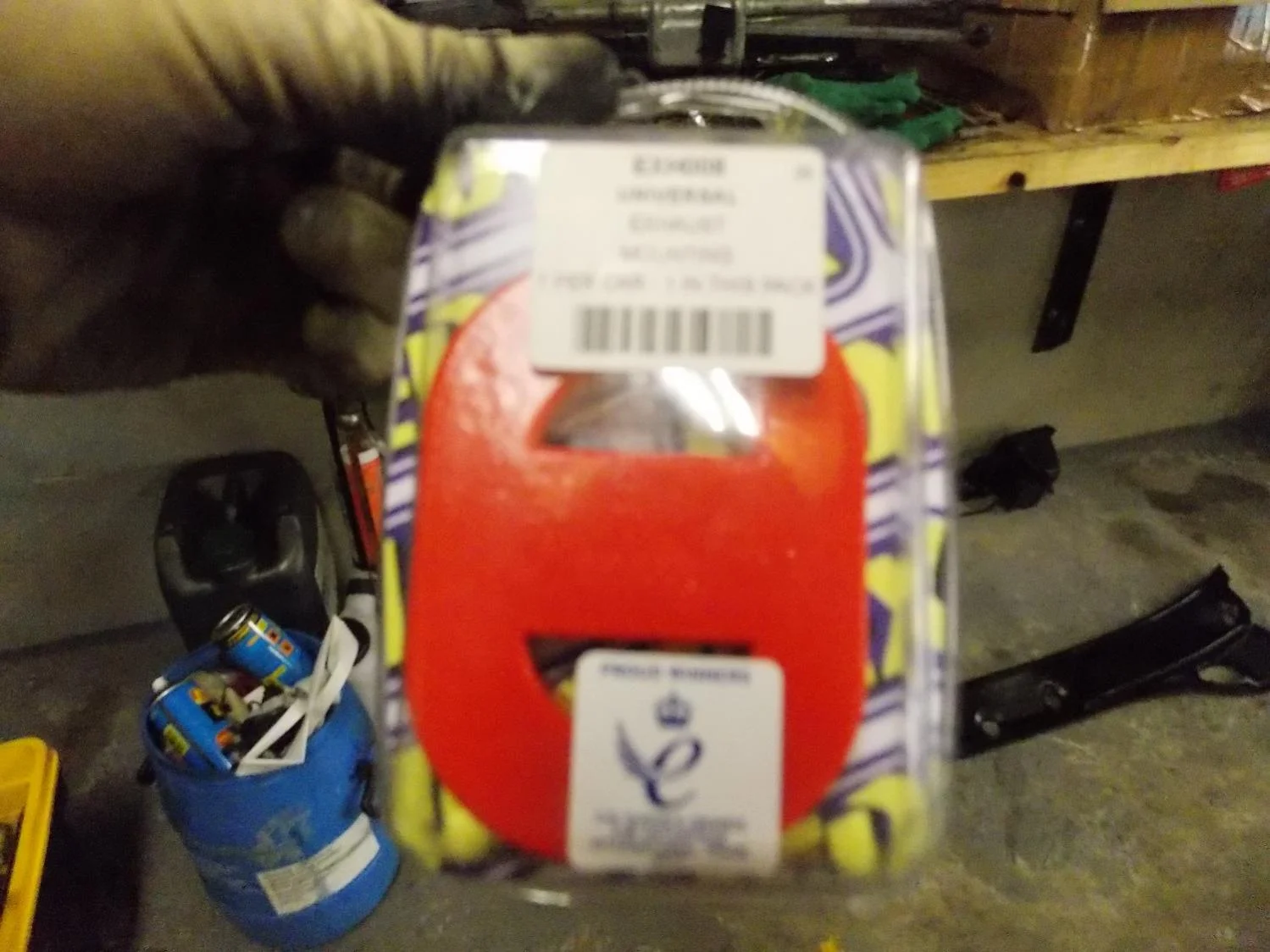

Power flex exhaust rubber

New front cup dampers with cooksport springs and 20mm spacers

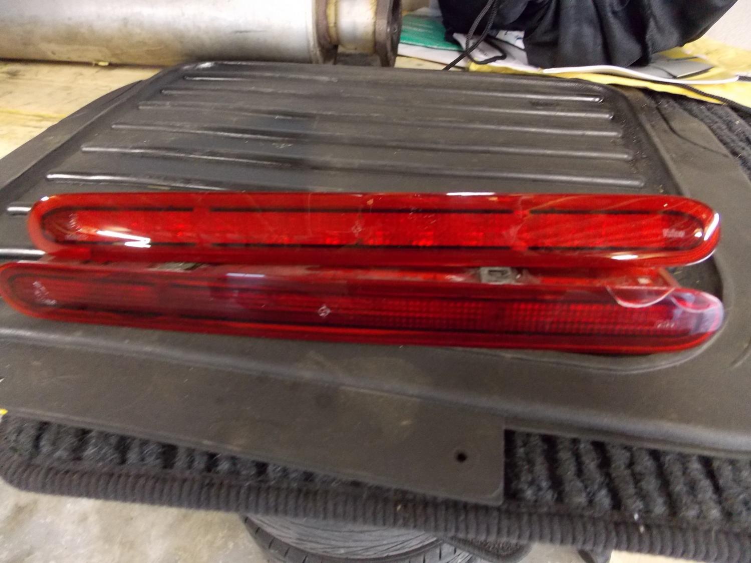

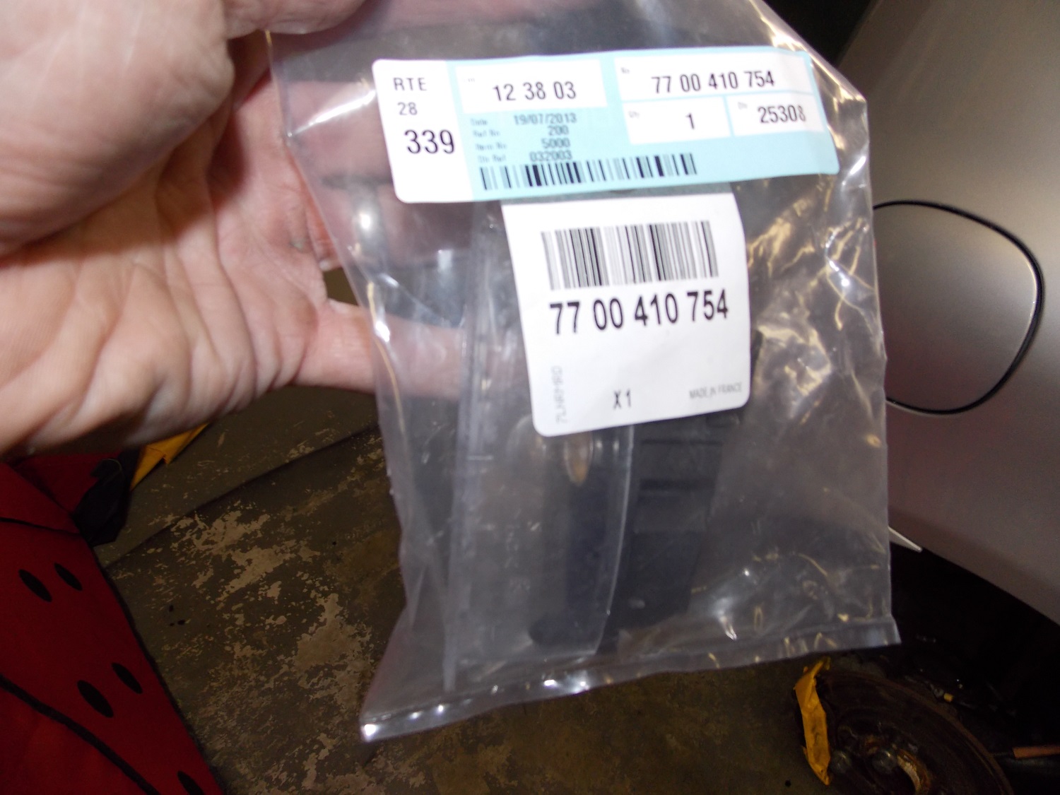

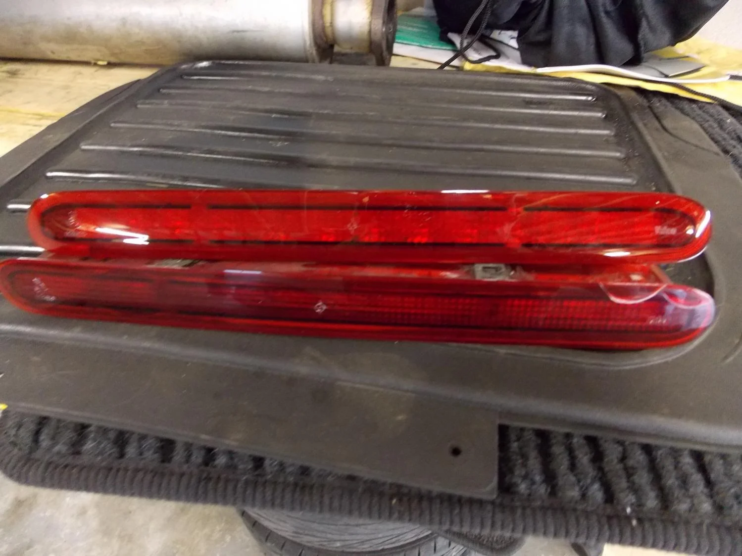

New cup spoiler brake light as old one was cracked

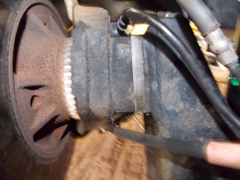

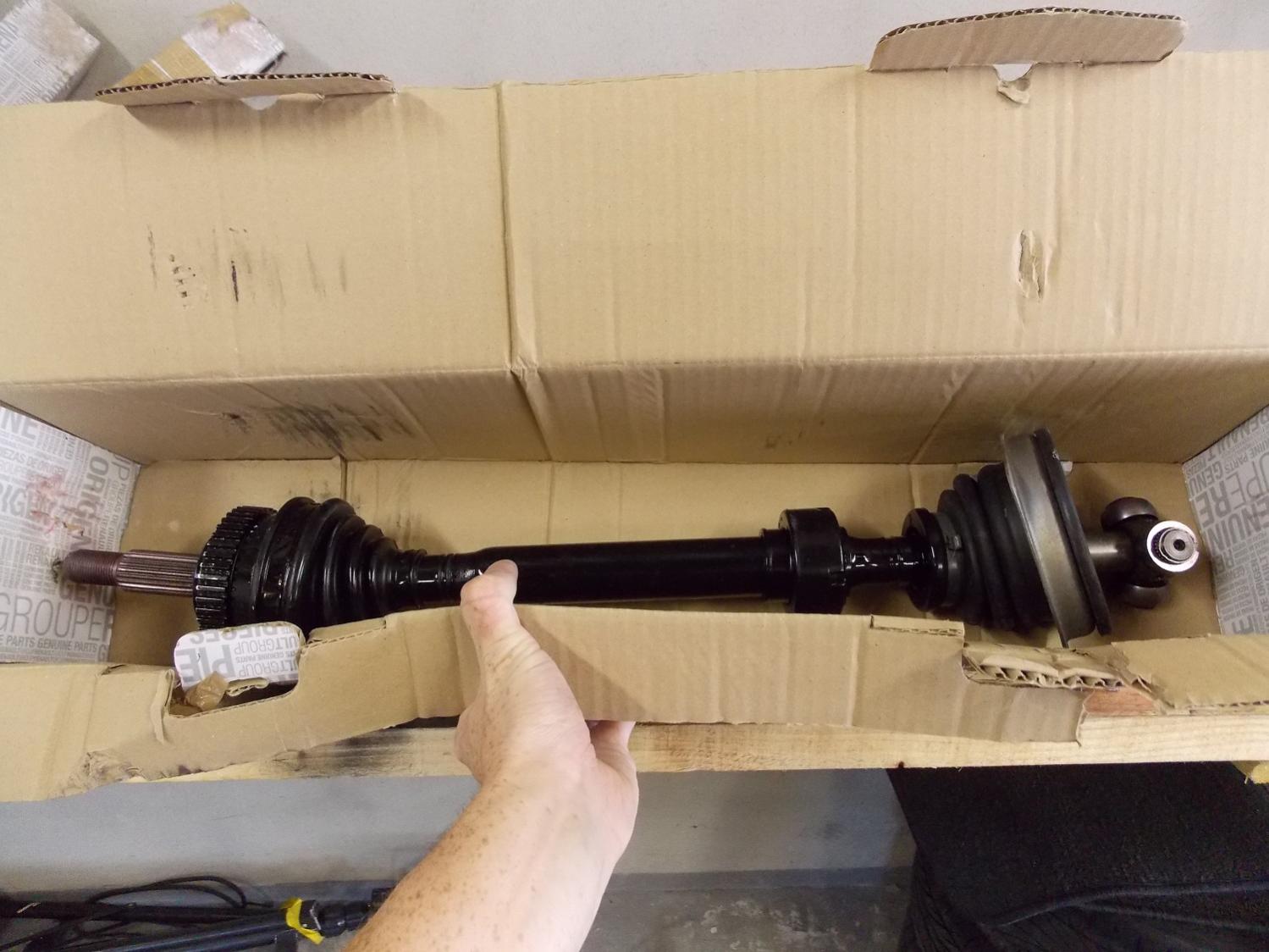

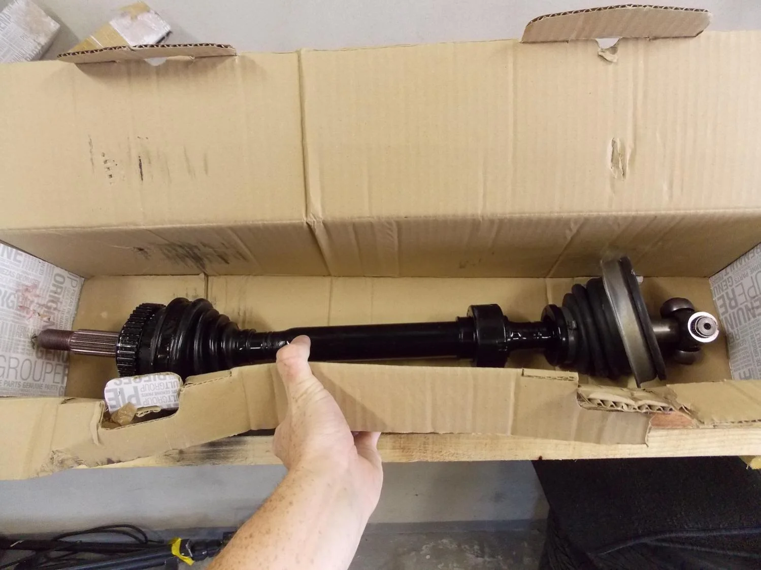

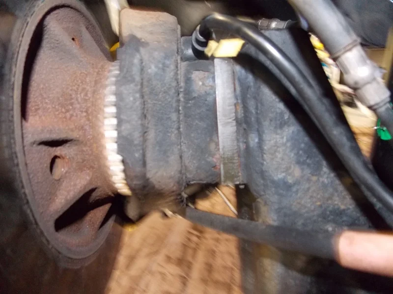

Drivers side drive shaft let go so put in new oem units on both sides.

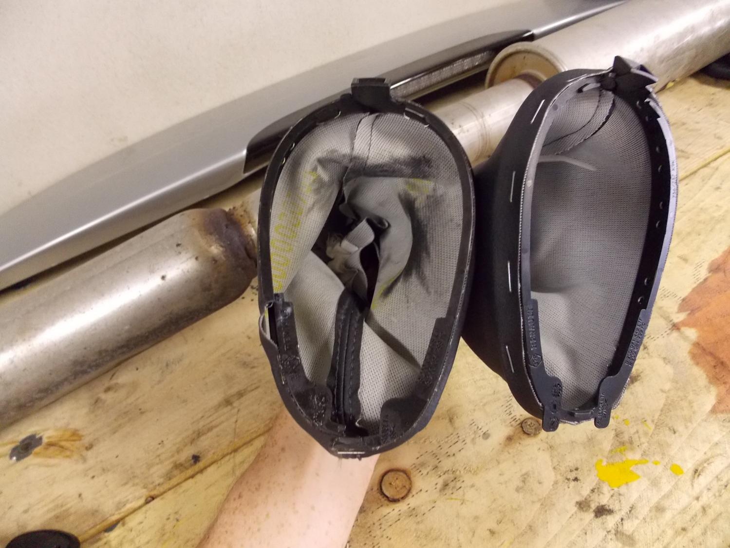

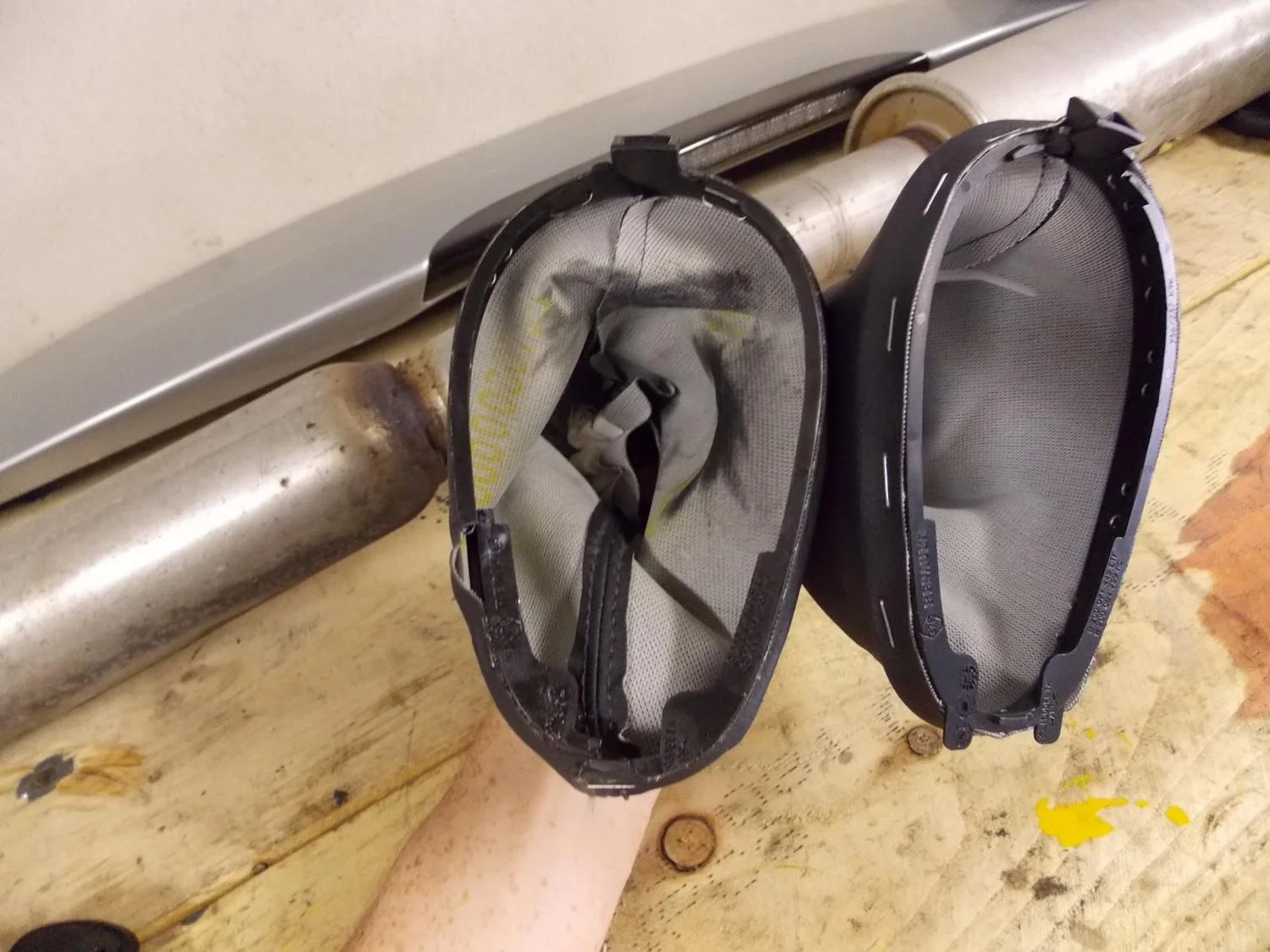

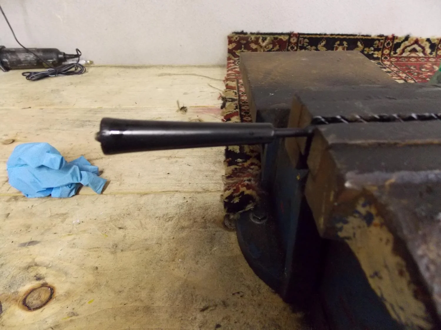

New gear lever gaitor

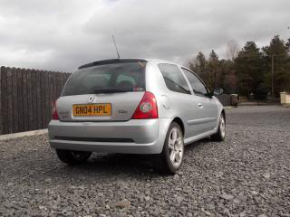

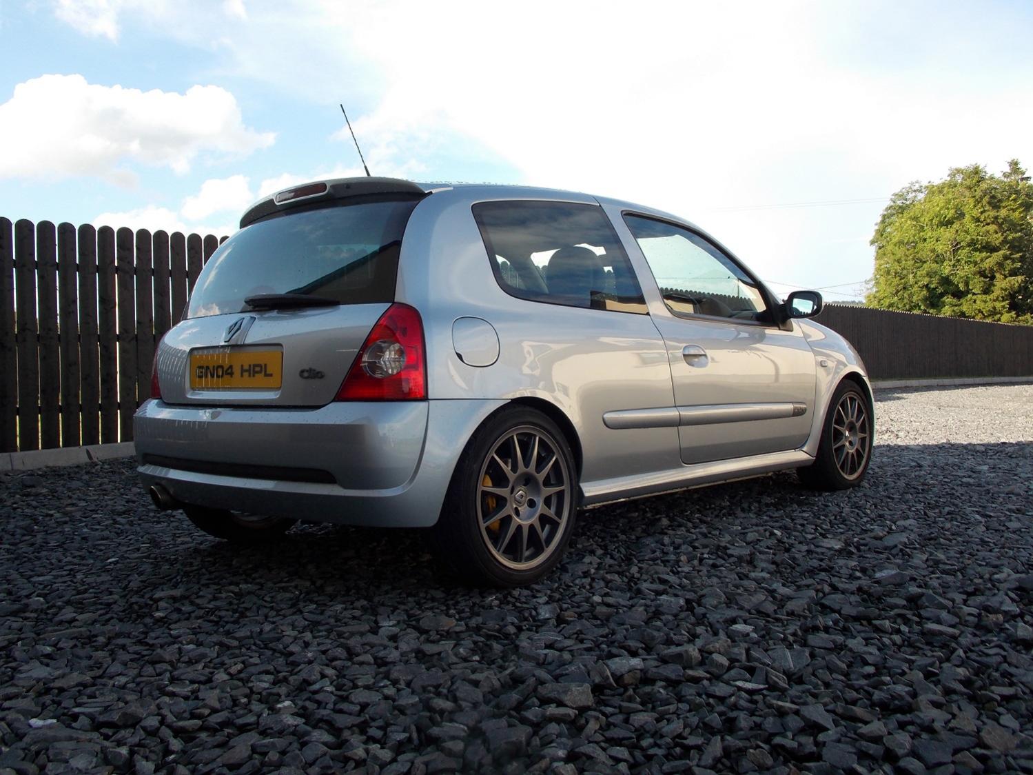

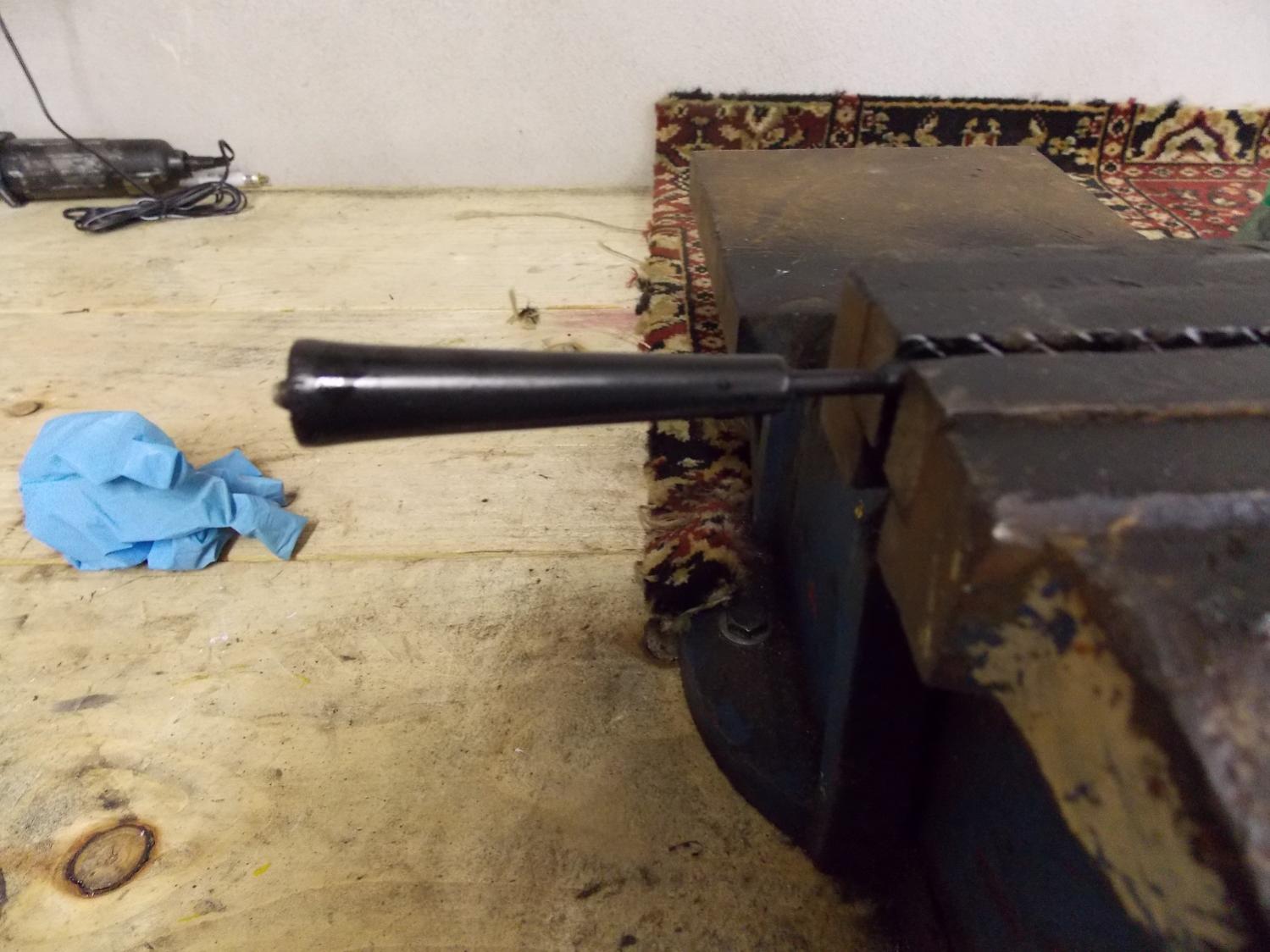

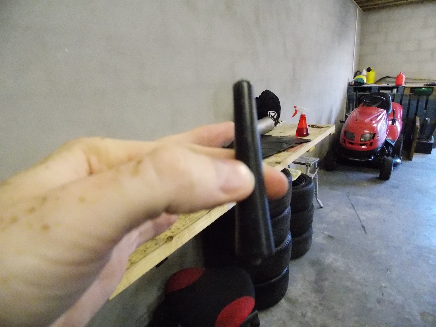

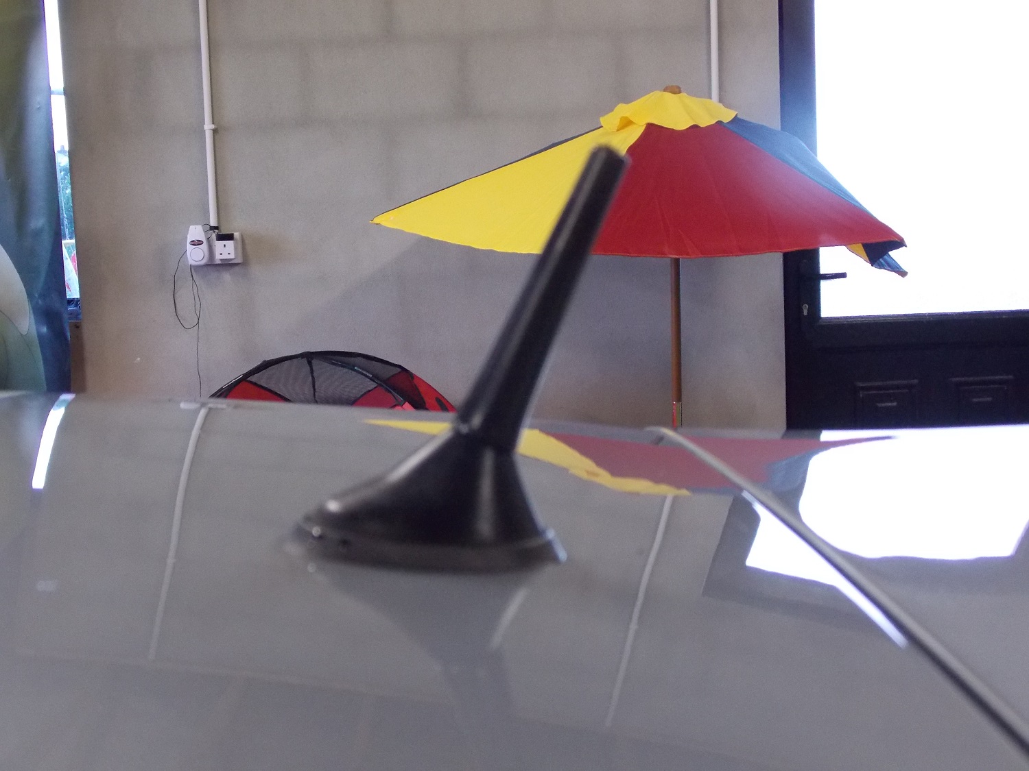

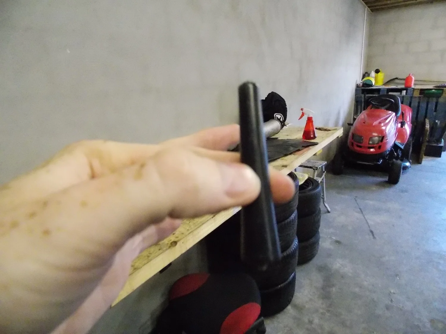

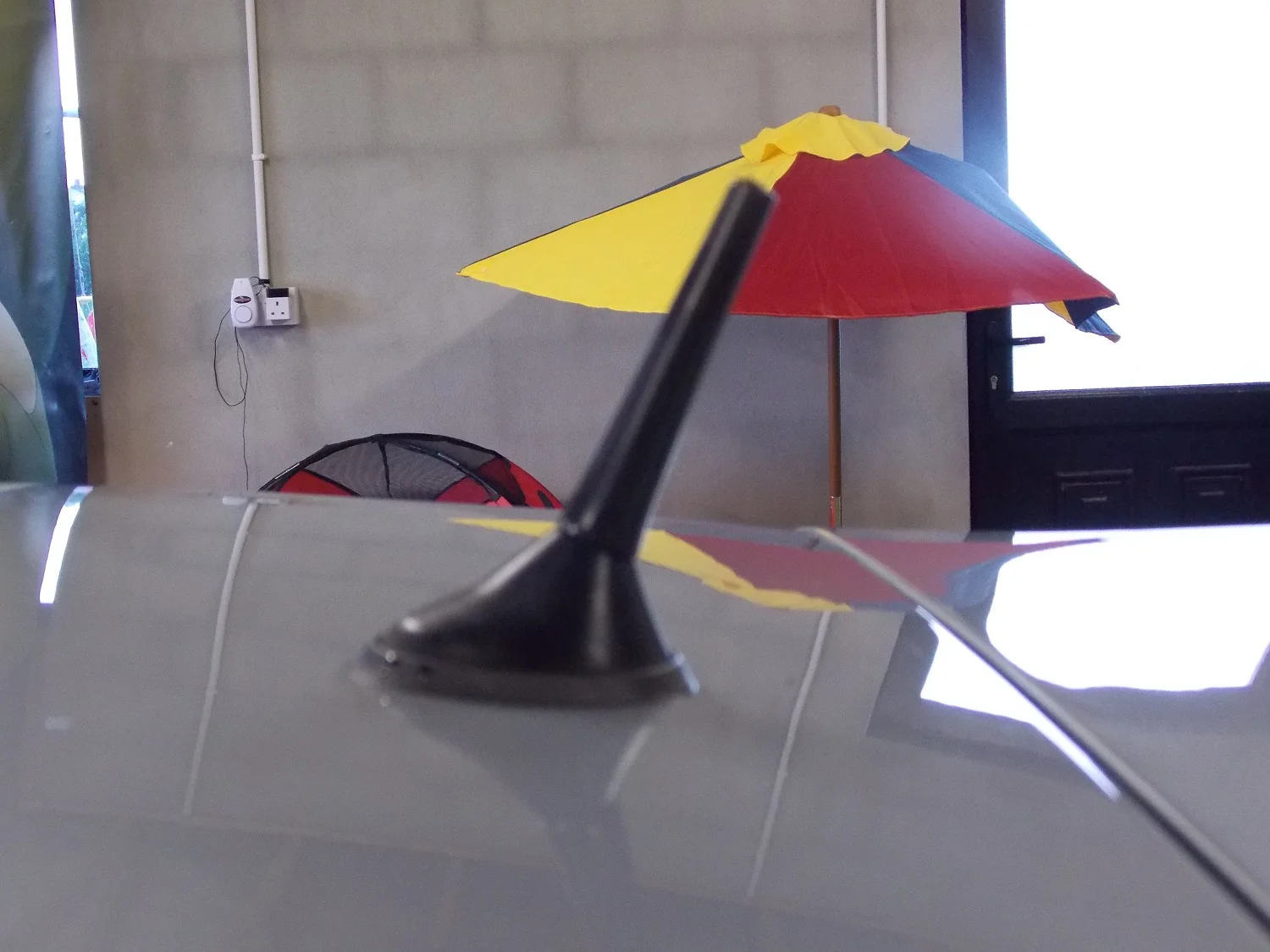

Modded my aerial to make a stubby version
Last time it had the turins on before I sold them.

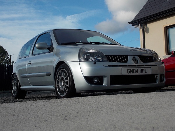

  Ph2 Iceburg 172

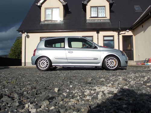

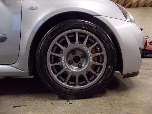

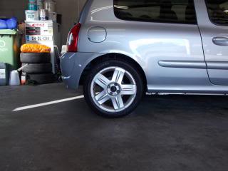

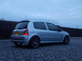

Give it a quick detail and fitted speedline 2118`s wrapped in yokohama ado8r`s

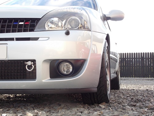

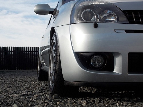

Painted grills and fog light surrounds and also added French flag to upper grill
Rear view of White-line arb
Removed rear wiper and fitted a blank.
