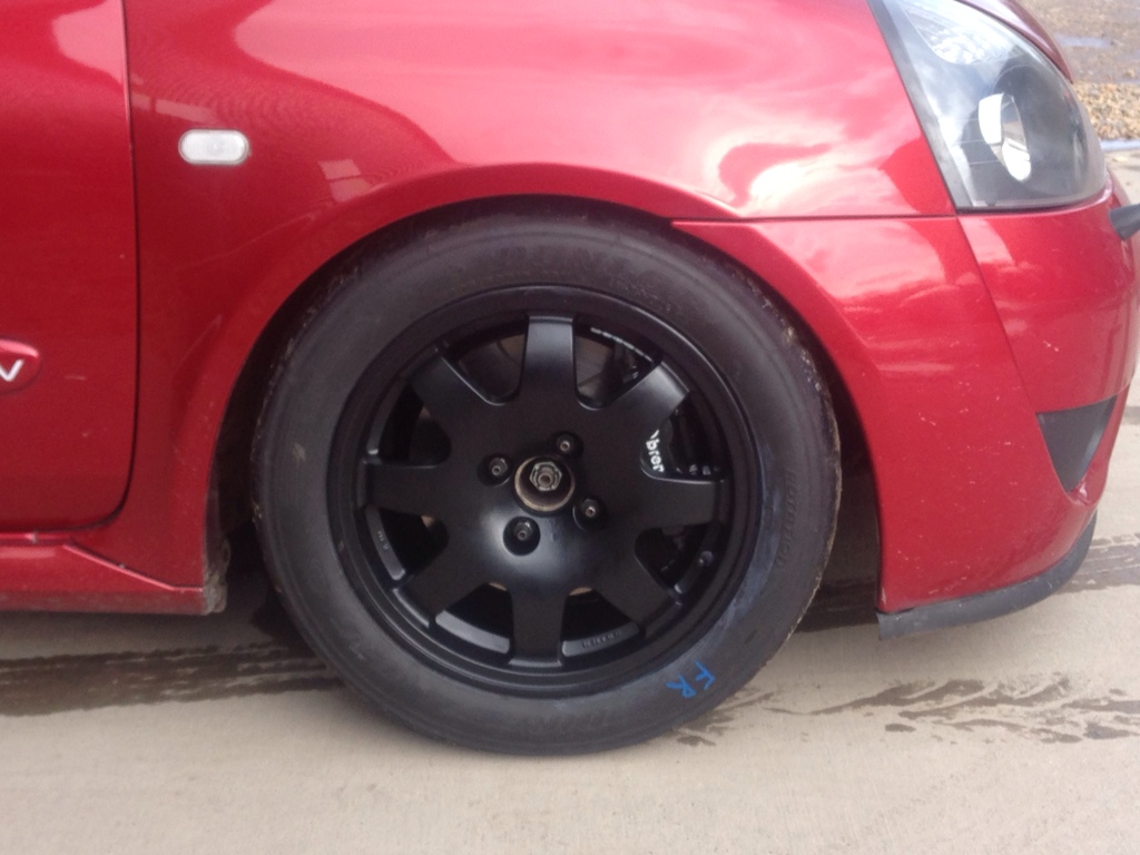

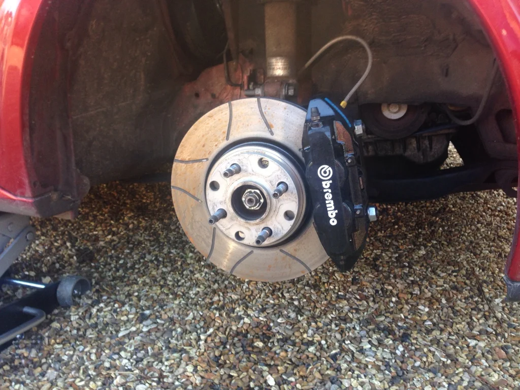

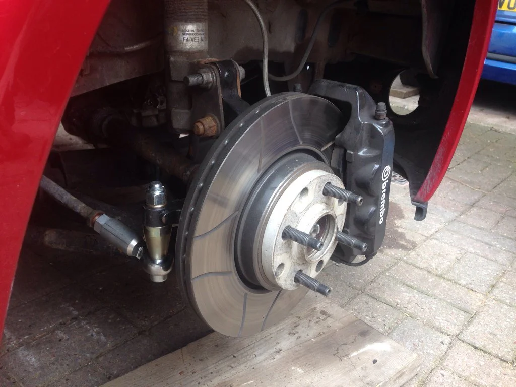

Some pics if it helps;
  e92 330i
They aren't PMS mate, unless they've copied them. They are designed by @NorthloopCup.
You need to clean them regularly :smile:
Oh I see, yep PMS do similar ones i guess then! I guess they look so good its a shame to cover them up!
