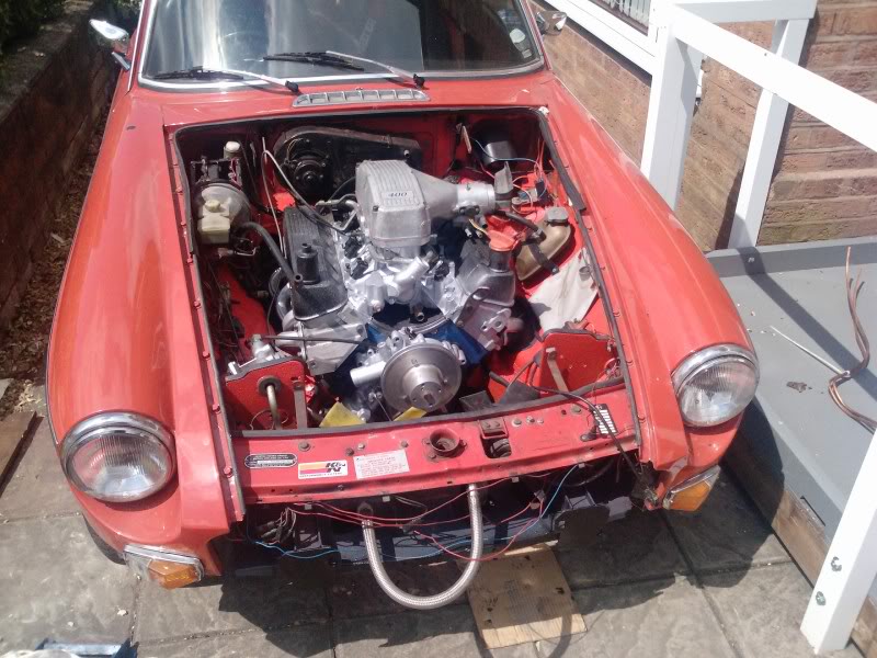

Just thought i'd post some pictures in here for anyone interested :o

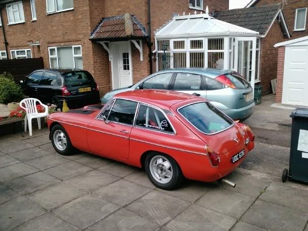

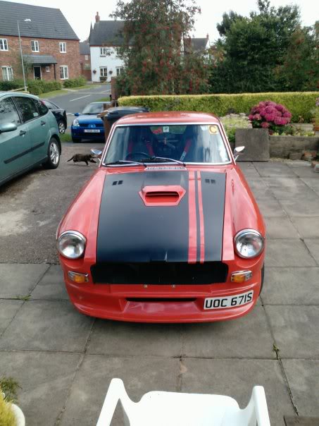

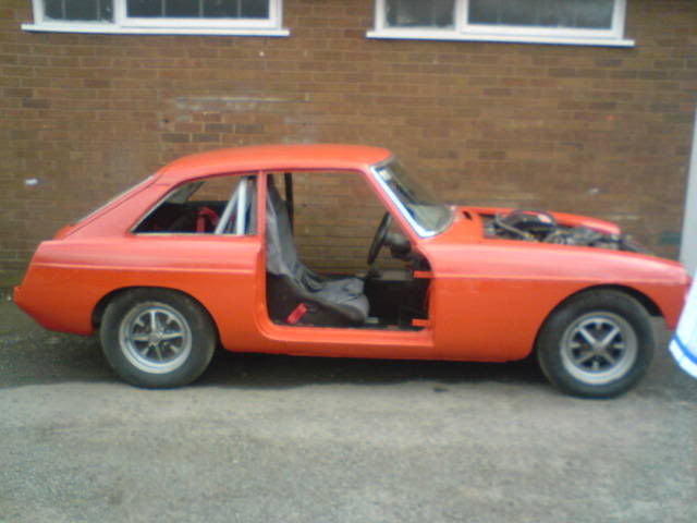

This is my 1978 MGB GT, owned it for 7 years now - started off as a standard GT, rubbers bumpers, 1800cc b series engine etc... and this is how it stands now,

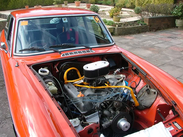

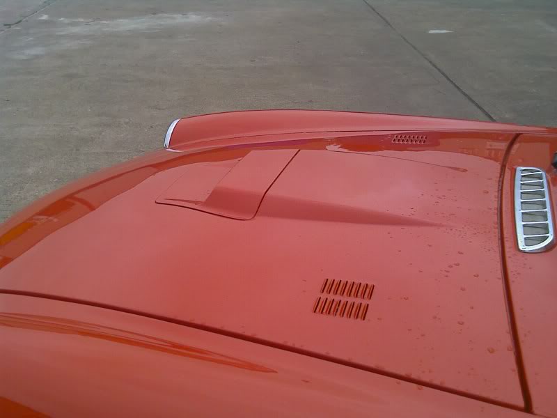

Bonnet Vent serves a purpose :D
It's a 3500cc Rover V8 with a 5 speed box running a webber carb :)
However its being removed:S
As i've decided for an upgrade to a 3.9 Rover V8 with EFI (fuel injection)

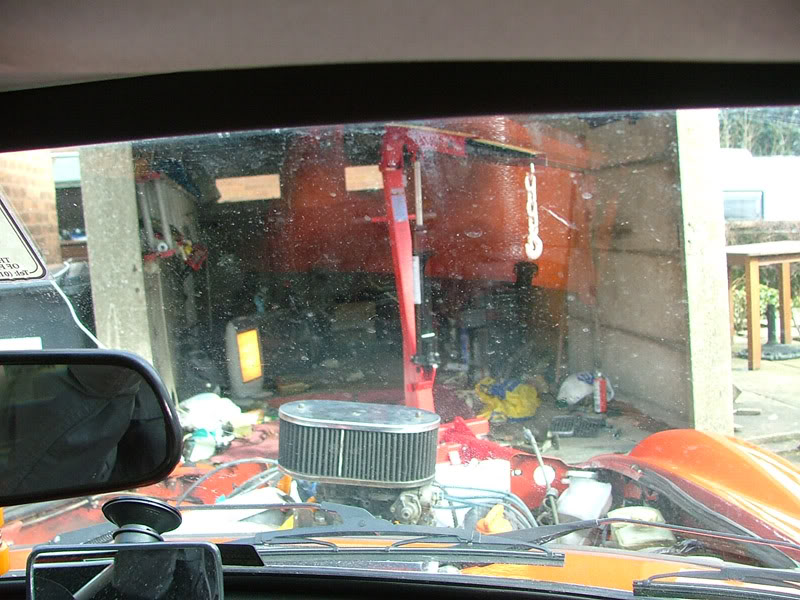

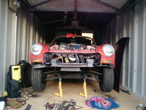

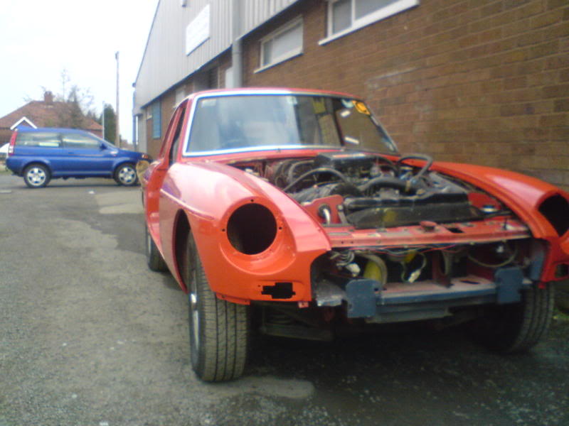

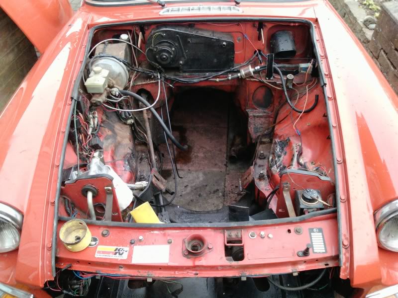

So the strip down has started,
All disconnected and ready to be taken out this weekend....
Will update this with progress pic's if you any of you guys are interested, will include pic's of engine removal, build up of the new engine etc...and some vid's once its up and running....

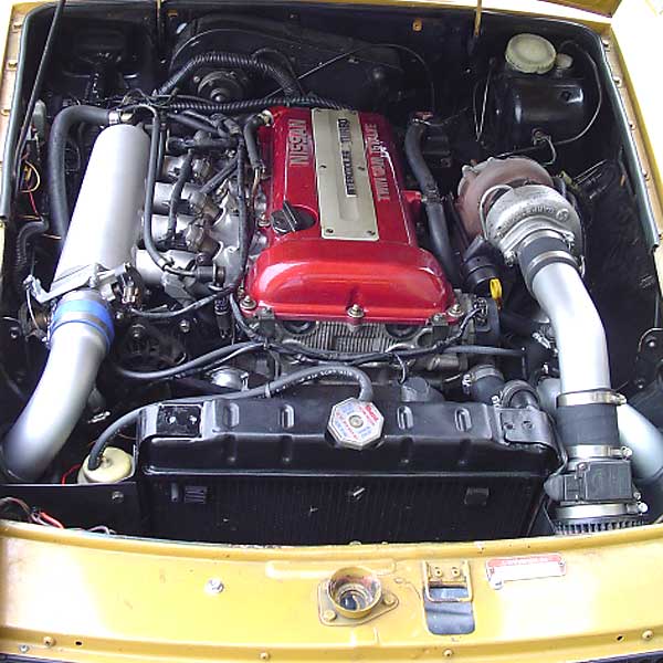

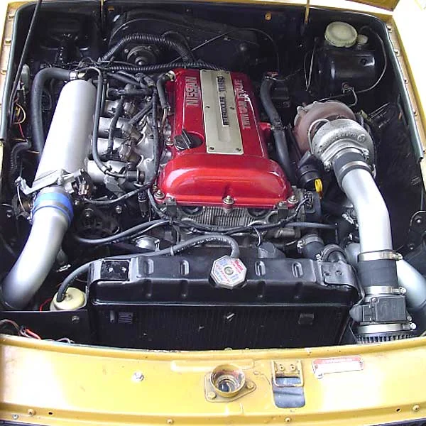

I'd love an SR20 one done to look like this...

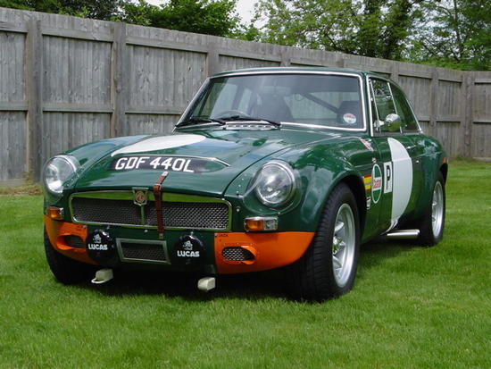

I heart the sebring kit
Lots & lots of upgrades for these cars available.

I went down the Rover V8 as it required minimal modifications, only mod was a little bit of cutting and welding to the tunnel to allow for the LT77 5-speed box - plus i love the sound of a v8! currently running a single silencer system and it sounds so good.
Bonnet is changing aswell, as i no longer need the vent for the cold air feed for the carb, so i've now got a fibreglass bonnet with a very subtle bulge to allow clearance for the plenum on the injection system.
The Sebring Kit - i love it - i've already smoothed the back end using a sebring rear valence and keep contemplating fitting the sebring arches - but i only had it resprayed about 2 years ago and it seems a shame cut out all the rear arches and fit new front wings or the arch extensions and need new paint again! but then again i could be tempted......but then again i quite like the sublte look of it as it sports no v8 badges but i think the rumble is the big give away!

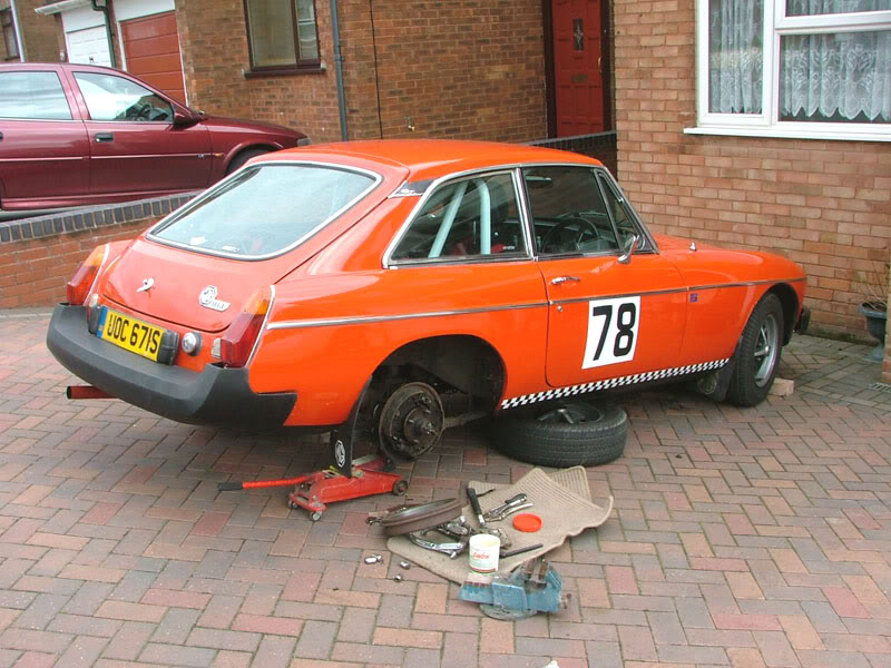

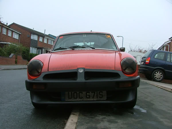

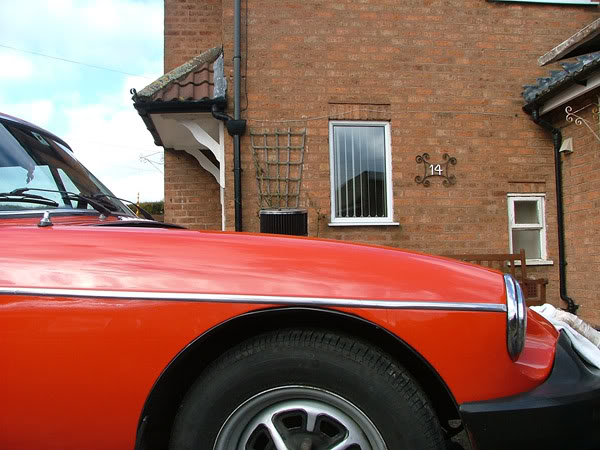

I've had my MGB now since 2004, first ever classic and it was a completely standard '78 rubber bumpered MGB GT.
It has gone through many looks, engines (x3)and rear axles/diffs (on my 4th!) and ive loved it apart from the numerous mechanical failings :P
Now I didn't know how to start with this thread as i've got literally hundreds of photo's so I will skip through some pictures year by year and finally get upto date where the serious work is taking place.

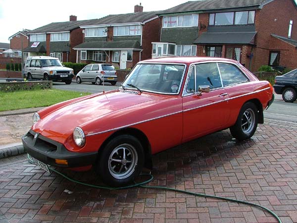

How she looked when I bought her in 2004 for £2000.

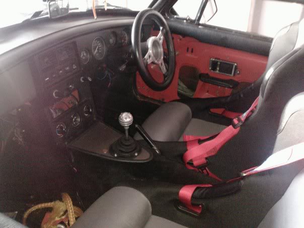

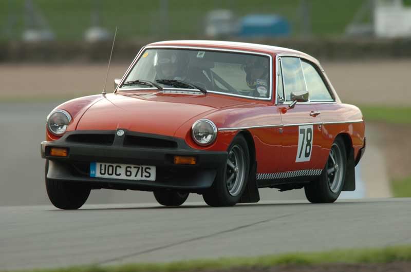

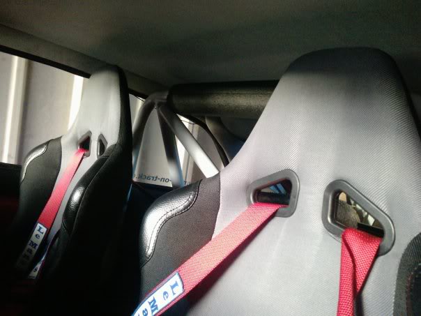

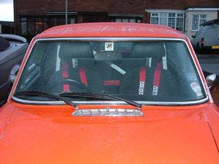

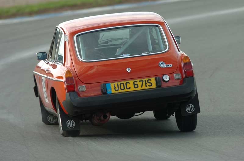

Half cage and bucket seats, harnesses fitted so I could get her on the track with some safety,
First Trackday with www.mgs-on-track.co.uk
A very often sight on the drive....
Car driven daily for almost two years..
Some more track action...

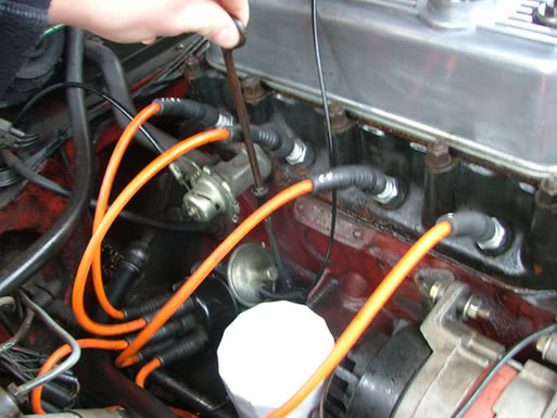

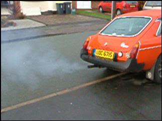

Piston rings then let go after the above trackday,
Puffing smoke from the dipstick,

V8 in place,
Slight clearance issue with the current carb/filter set up!
Good view though!
I was told it would be tight and they wasn't lying,

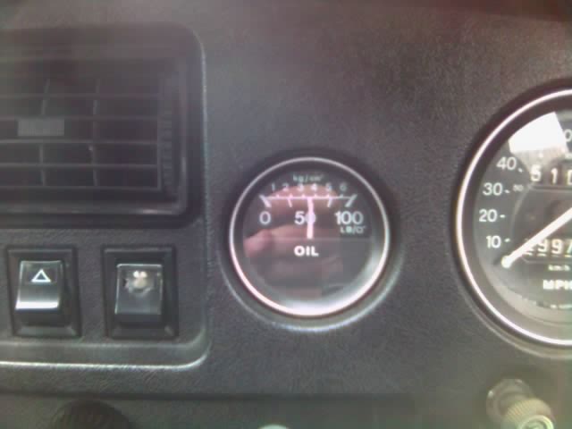

Oil pressure :) always nices to see on a v8!

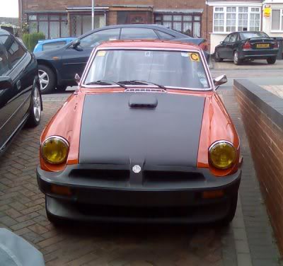

Debumpered, Sebring rear valence, st front spoiler, custom bonnet, lowered and some fresh paint (£500 self prep jobby)....
Steel bulge off a Mistubishi Prajero and louvres off a hotpoint microwave grafted in ;D
End result,

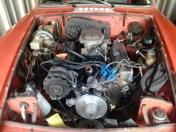

The 3.5 v8 then started rumbling quite badly on start up so new engine time and were now at about 2009 and this is how she looked before she was taken off the road this time for the 3.9 v8 EFI to be fitted.
Yet to be posted the 3.9 v8 installation, new cills, floor repairs, inner wing repairs and sebring kit...

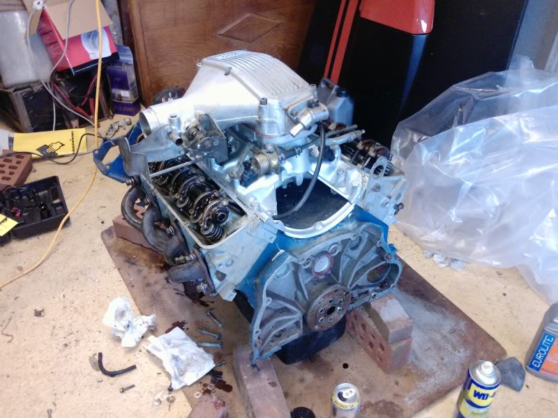

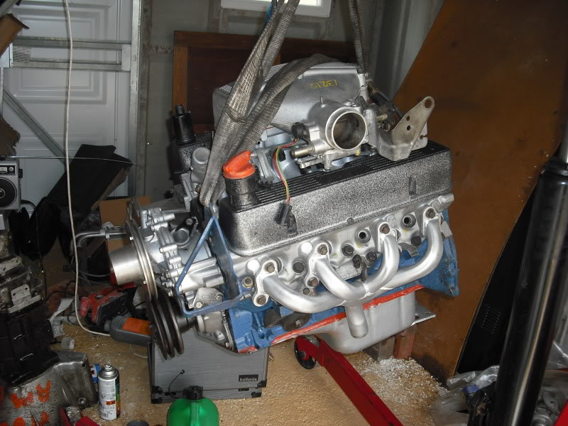

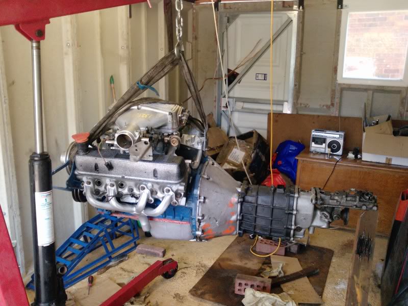

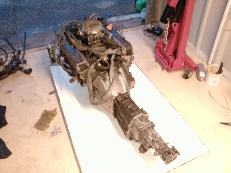

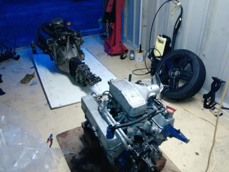

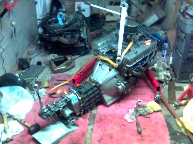

V8 build time - I bought a second hand 3.9 v8 off here for a very good price, sold as being bought from a breakers and arrived on a pallet complete with loom ecu etc as it was an EFI engine.
Upon first inspection it seemed very clean and with the water pump pulley snapped off, so it looks like it may have been pulled from a something with a front end smash and it was an auto so the fly wheel needed to be swapped over.
So I then set upon stripping both v8's down as I had to swap the front timing cover, water pump etc as you need to fit p6 items in order for it to fit the engine bay, shorter water pump and swap the sump over etc...
The old lump,
and the new one,
All painted and all bits swapped over well most it,

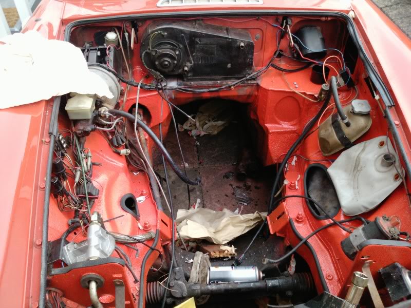

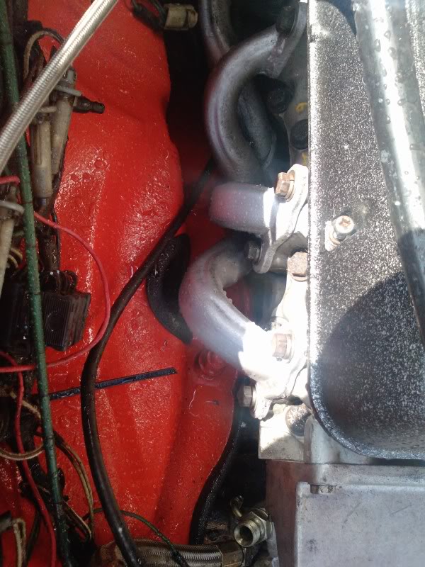

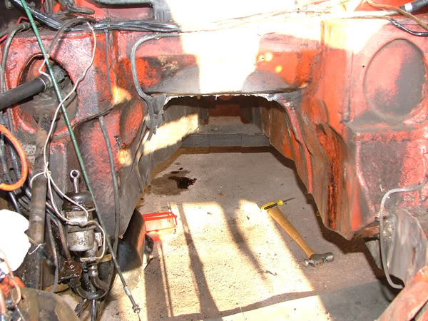

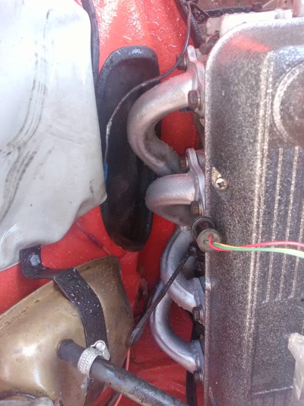

Next thing was to tidy up the engine bay and was oily, rusty and a complete mess if i'm honest, the inner wings had been battered by the manifolds so a tidy up was needed,
From this,
To this,

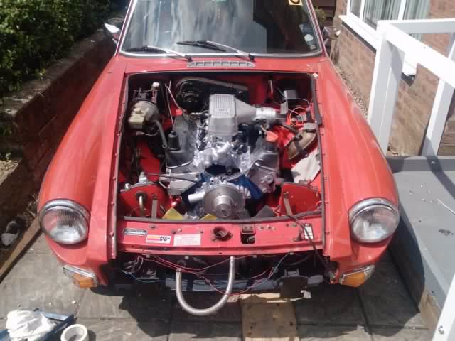

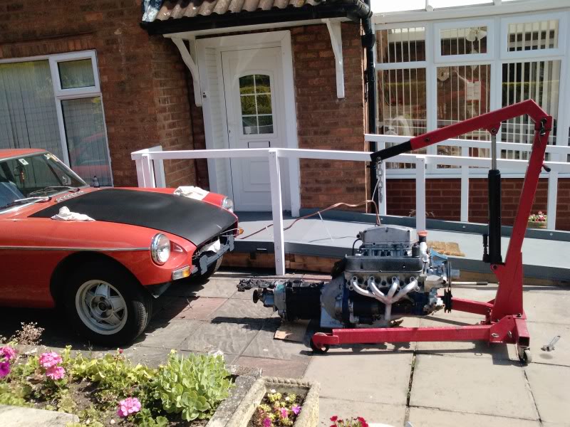

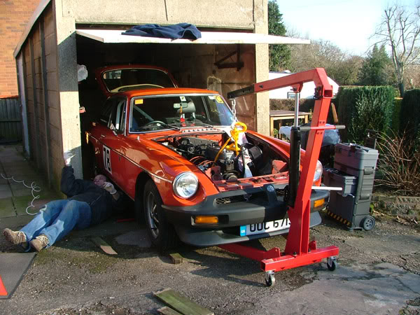

Lift off time,
Engine in,
Improved manifold clearance and air flow,

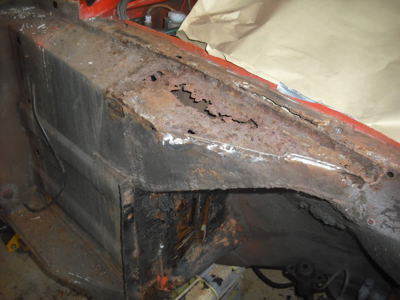

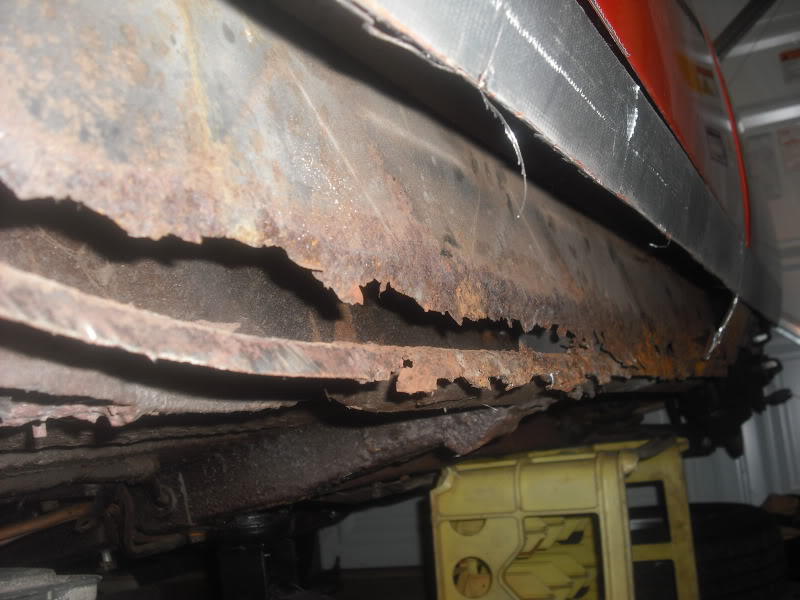

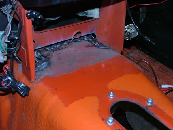

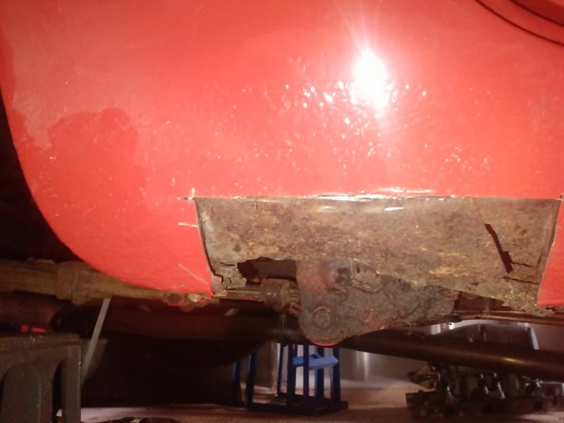

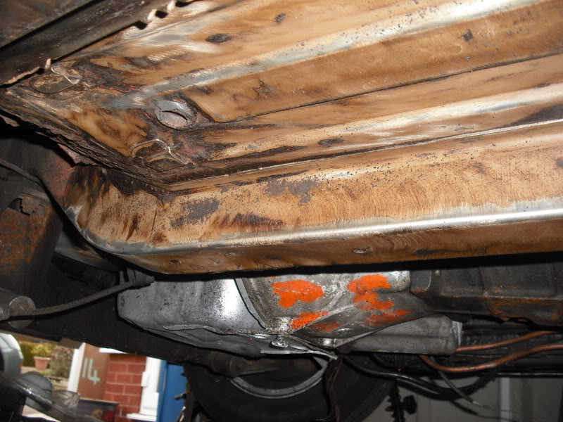

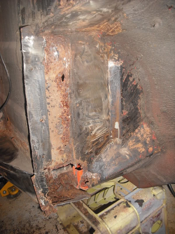

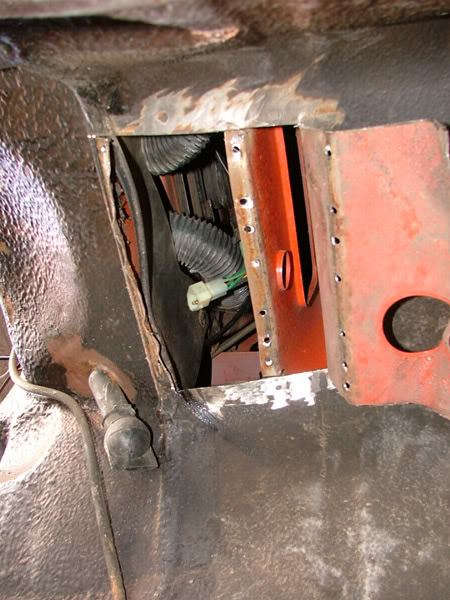

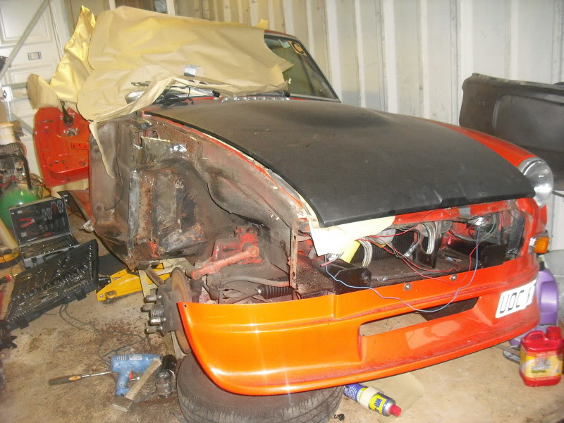

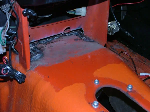

Right here's some rust....

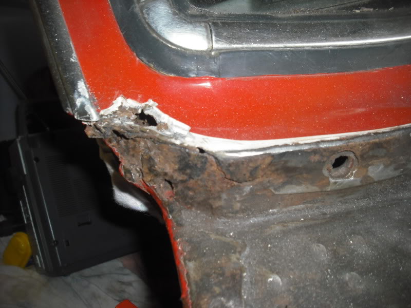

I started out by cutting away a section where my screw driver had gone through to find,
Cut some more....
So it was clear that although the bulk of the outer sill was fine, but the inner was not.
I then removed the front wing as its had never been removed in all the time i'd had the car but i'm glad I did.
Hmmm as you can see its going to need full sill replacement, inner wing repairs and now to check the floors...
Not bad at all :) as I was expecting the worst.
This was replicated on the p/side and required the same repairs :(
