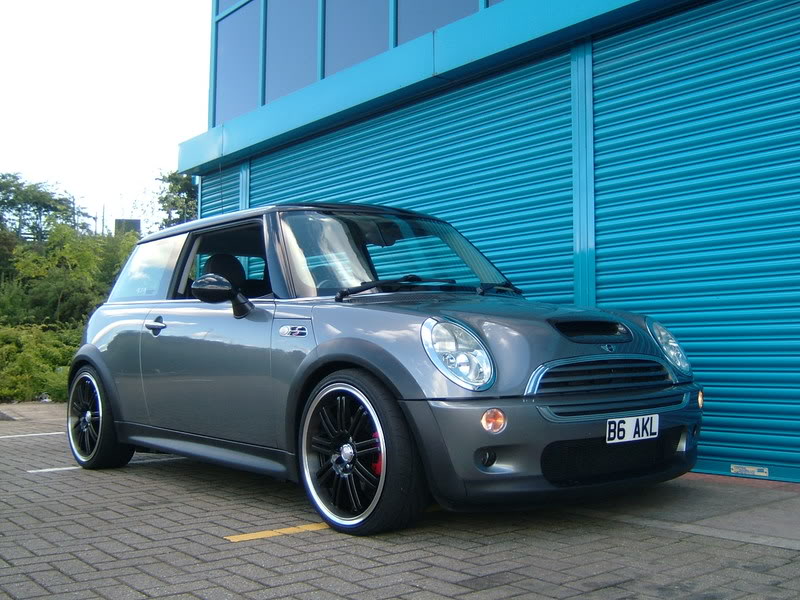

did you have a low black mini with BBS rims? or was yours a dark blue one? i seem to remember seeing a mini with an "addz" style number plate in there a few years back whilst i was there
nahh mine was a low grey one with black and polished rims, noisey as feck too :D
did it have an addz number plate? new engine it was in for IIRC? i know Nick and Andrei aka "the russian" very well
private plate but not a addz one, nahh mine went in for more boost and de-cat and a few pullys :) made it fun!
