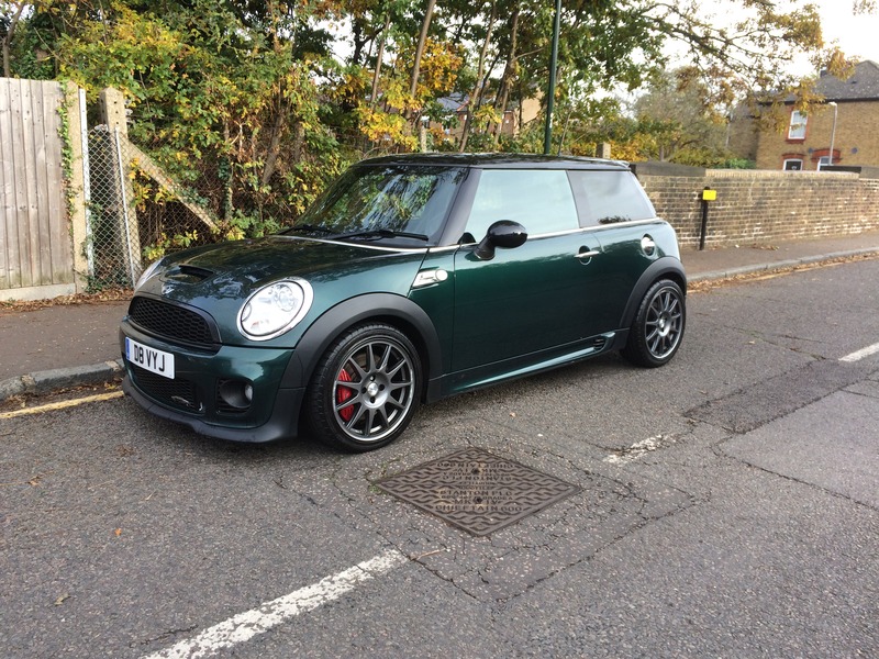

Long overdue update on this ...

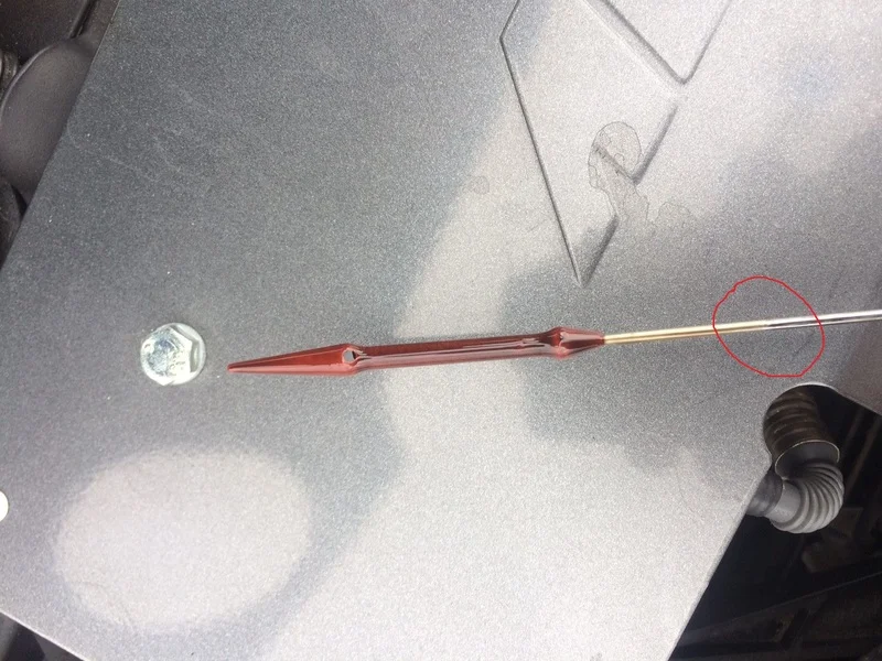

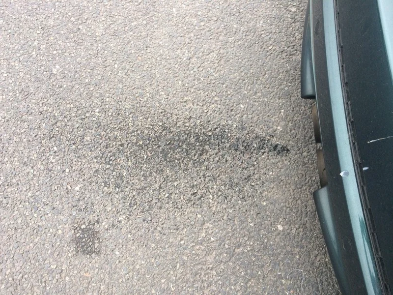

On the 10th October i had a Helix Organic Clutch, Single Mass Flywheel & Quaife differential fitted. As it was in the air, i also got the garage to do an oil change. Unfortunately, it would appear that they overfilled it by circa 0.5-1.0 litres as by the time id got to my destination after collection, the car was surrounded by a lovely cloud of blue smoke after warm idle.
The full story is here: http://www.minitorque.com/forum/f18/r56-fjcw-oil-overfill-144865/ but yup, lots of oil here:

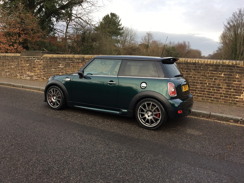

Long story short, after 3 weeks away & driving around in a standard R56S, i finally got the car back last week after they took apart the top end & changed the valve stem seals (no cost to me obviously). I also paid to have the full timing chain replaced & everything de-coked whilst it was apart. So yeah, lots of things changed as of late ... probably best to sell it & buy something else 😂
Having fitted the Quaife, it really highlights the difference in power delivery between the R53 & R56, with the torque of the latter giving quite amusing direction changes if you give it a bootful mid-corner - its literally like someone has grabbed the front end and pulled it around the corner for you, very quickly! Torque steer is also still quite apparent. In effect, its really quite a challenge to keep in a straight line, especially on a bumpy road. Its f*cking hilarious lol.
  Mini GP2
That's one of the best looking R56 JCW's i've seen. Proper colour and the wheels are the tits.
Interesting what you say about your decat, i love mine, isn't too loud on idle but open it up it sounds like a Mini Challenge car.

I agree the colour makes it.
That colour would look good on a Megane!
That does looks flipping marvellous tbh, it really is amazing what some Suspension can do to the looks, i did prefer the OEM Alloys before i have to admit, but not now!
Stunning Colour, its BRG isn't it?
Ah thanks, it certainly getting there looks/spec wise, although i do want the GP2 bellypan & diffuser next ...
De-cat wise, ive got more used to it now, is quite(ish) on idle, or cruising, but as you say, much louder when booting it. I think its the really loud bark at 3k in 2md that drives me a little mad though, its only really an issue when driving around 30 zones though i guess.
Cheers, i love the colour, pretty rare as well, seemed no one liked the BRG when they were new!
Yup, British Racing Green, perfect for a Mini :up:
Im still unsure on the wheels, think it needs to be a bit lower to pull them off ...

Have you done a compression test since the over fill? I've always thought it was just as bad as running it low. Especially on a turbo. Turbo seals definitely do not like it and nor do piston rings or even the bottom end.

How can a garage be so incompetent to put too much oil in!!
Makes you worry about the quality of the other jobs they've done doesn't it??
The 172 I bought years ago was put up for sale by a woman who had just spent over £1000 repairing the head after the belt had snapped, the garage who rebuilt it put waaaaay too much oil in it and it went pop again only a few days in my ownership - hence new engine for me :)
Yeah, i comp tested it before it went back to "the garage" for the 3rd time, was fine, so after some serious googling/discussion with more mechanical types, as they had already cleaned out the PCV system/intercooler the 2nd time it went back, i thought that it could only really have been turbo or valve stem seals - both expensive fixes to a problem i didn't cause, hence why it went back again! I assume that they did a leakdown test (i had no means to) to clarify where the issue was - this confirmed that the valve stem seals were gone so they were replaced.
My theory (being that they are a very well known & funded mini specialist), is that they probably use a similar system to BMW/Mini, so you press a button & it autofills the oil. Not a problem normally, but with the R56, you have to tip it up on one side to get all the oil out. If you dont do that as its say on a lift getting other work done, you could possibly end up with a load of oil left in the sump. Naturally i was rather annoyed that it happened in the first place, but the service/communication from them to rectify it was pretty impressive :up:

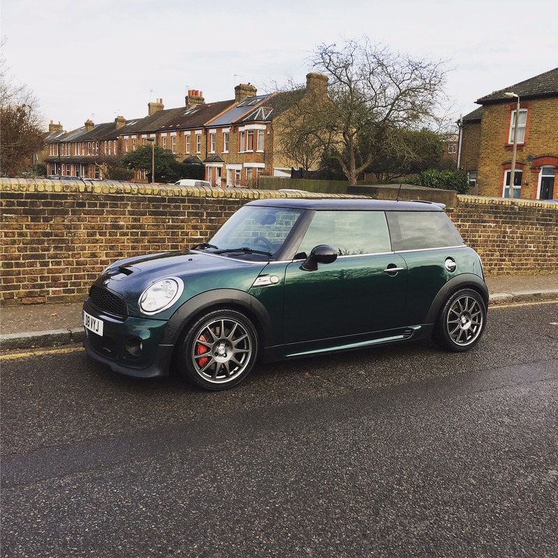

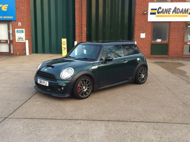

I did a little tinkering with mine on Saturday (the ride height has been irritating me as it makes the wheels look tiny!) and lowered it 8mm front/9mm rear. Its still got 3mm front/6mm left to go on the threads, but i dont really want to max them out really - its also now at a point where i am just above all the speedbumps around where i live, so can still drive normally/not have to crawl over them like in the R53.
Certainly not slammed, but definitely more "purposeful" :up:

Ended up raising it 5mm at the front at the weekend as the dampers appeared to be bottoming out - the roads around me are terrible so its not surprising really. Being that im not old/sensible, i thought less lowz/more drive-ability was probably a better idea 😂 Settings are now as follows:
Front:
Spring preload of 13mm which means its 3mm lower than Ohlins recommended settings, for a total of 9mm lower than the JCW. Rebound adjustment is at the bottom of the absorber and has 30 clicks in total with the zero point being the stiffest setting (full clockwise). The setting used currently is 15 clicks from zero.
Rear:
Spring preload of 19mm is 9mm lower than Ohlins suggestion, so 15mm lower than JCW. The dampers are currently set to 15 clicks from zero.

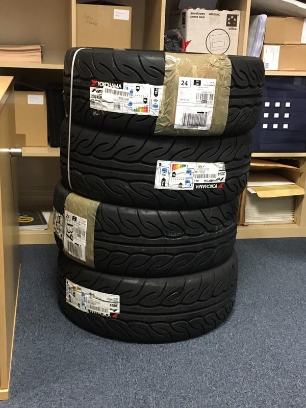

In other news, new tyres arrived:

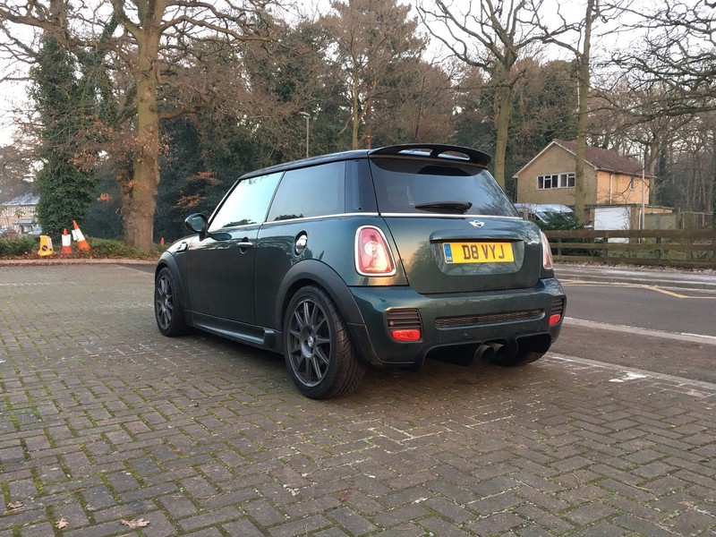

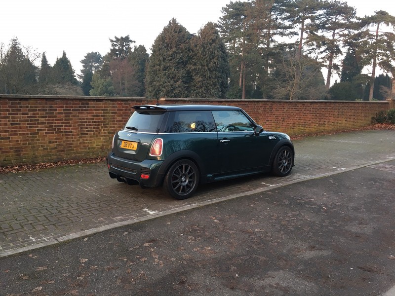

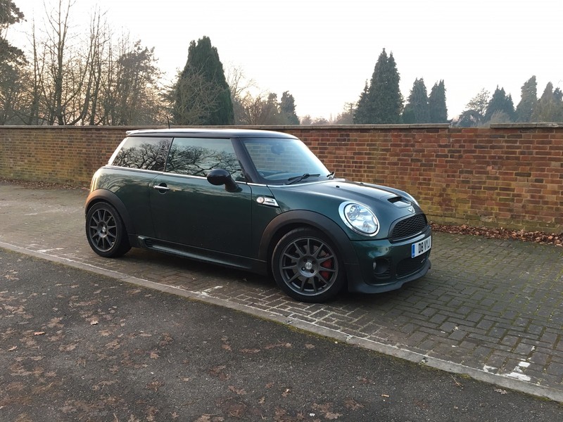

MOT done & car cleaned:
The AD08R's feel like they are offering far more dry weather grip than before & seem ok in the wet. Tyre wall is hard though, which means i am now back to runflat levels of ride quality - will definitely have to soften off the dampers a couple of clicks! On the flipside, that should mean they are far better on track, with less shoulder wear than something like a Pilot Super Sport.

Great looking car. These look very lardy and unsporty as standard, but looks much more aggressive now!
I've been running these since mid-summer last year and found the sidewalls to be quite compliant...certainly not a step change from the OEM Bridgestone RE050 I was running before.
I was ready for the usual WTAF?! sense when driving away from the fitters first time after they were changed but remember thinking "Oooh, these are no bad!". Not velvety smooth but not all sharp and jiggly either.
Regardless, they are a great tyre. Fantastic on track giving near full on track tyre grip levels with really good feel and breakaway. Increased noise, yes, but none of the usual track tyre whine and the tread pattern does a remarkable job of cutting through quite serious amounts of standing water. They can be overwhelmed though so exercise caution!
I must take stock of tread depths and mileage at the weekend...I've not checked them for a while and hope to get them through another Goodwood day before they need changing.
Thanks, they ride very very high as standard, thats most of the issue!! Mine would look better another 10mm lower i think, but the Ohlins just dont have that level of adjustment. Wouldnt be any good for the roads/speedhumps around here either though 😂
Maybe they are over-inflated then, they're suppose to be 32psi, but i havent checked them yet ...
Good to know re: puddles/standing water, although that trackday at Llandow looks like a normal summer day in Wales :tonguewink:
I am surprised that the 200 had enough torque to spin the wheels mind you haha.
