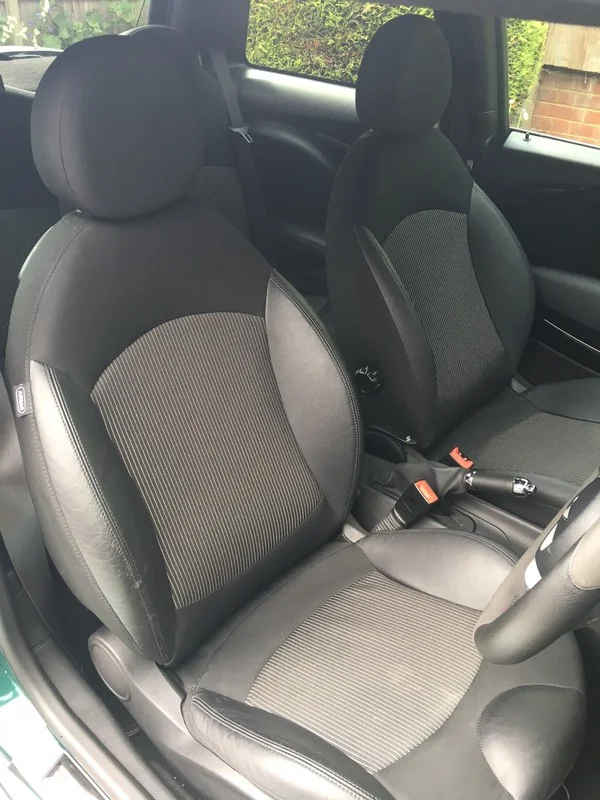

1. The standard seats are utter gash

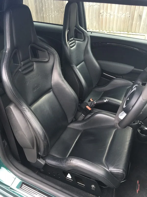

So, considering i had simply intended to drive it around as is, i started buying parts 🙈

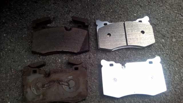

Some before/afters:
Much better, although even on their lowest setting, they sit higher than the standard things did. Odd.

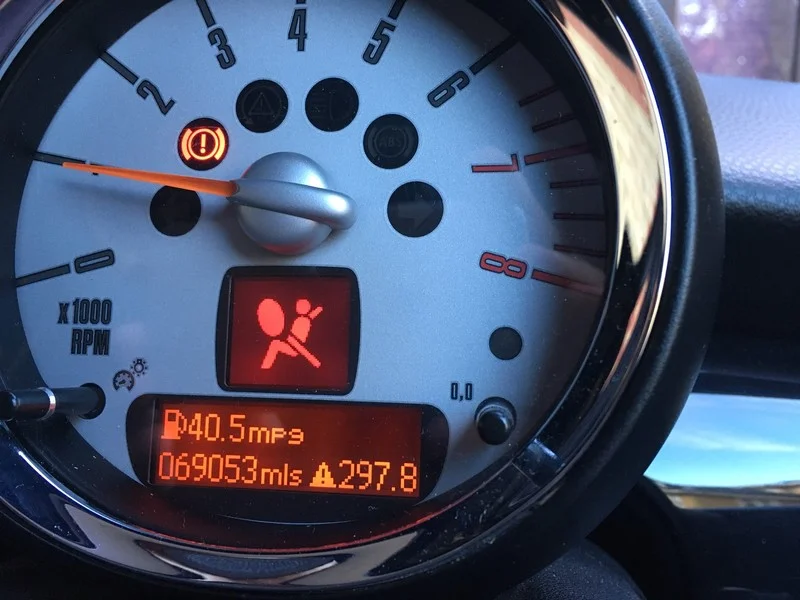

I then taxed it and drove to Norfolk to sign up a customer. Not only is the tax f*ck all at £16 a month (the M3 is £50 lol), but it averaged 40mpg, i mean WTF, do these things run on fresh air or something? I wasnt exactly pootling along, its a new car!!

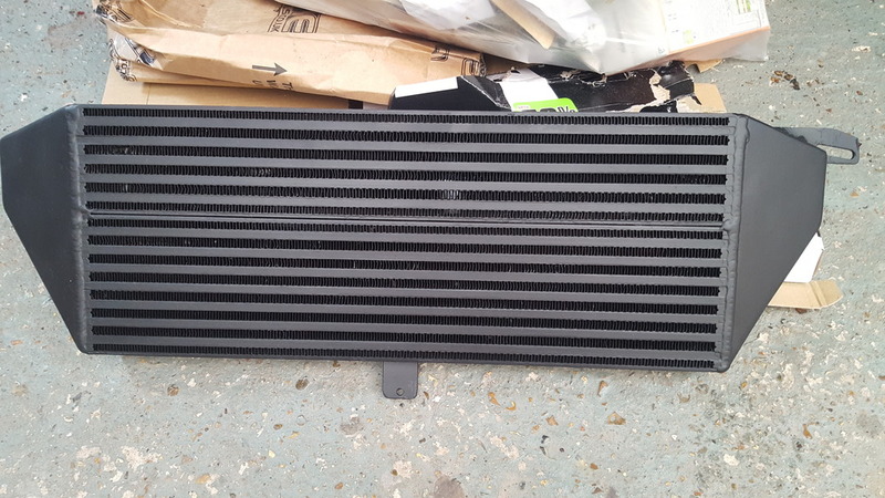

Last week i bought an Airtec FMIC off MT, & today i ordered an AEM N14 Intake from Lohen. I also want some BC Racing RM coilovers.

Seats have transformed the interior, fair play!
Those standard seats are gash, love the replacements!

How much you pay for the seats if you don't mind me asking? Bet they wernt cheap.

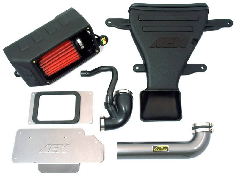

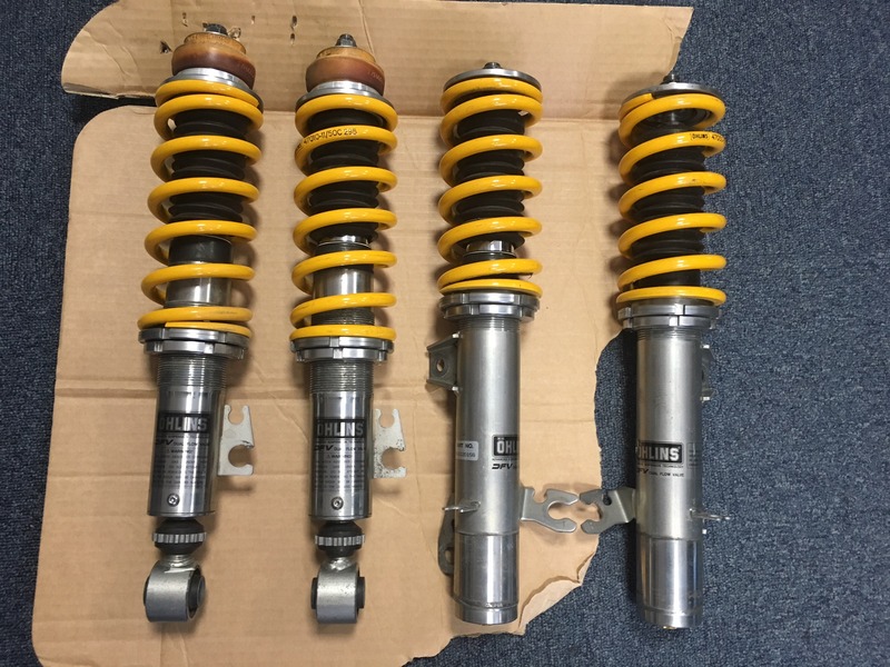

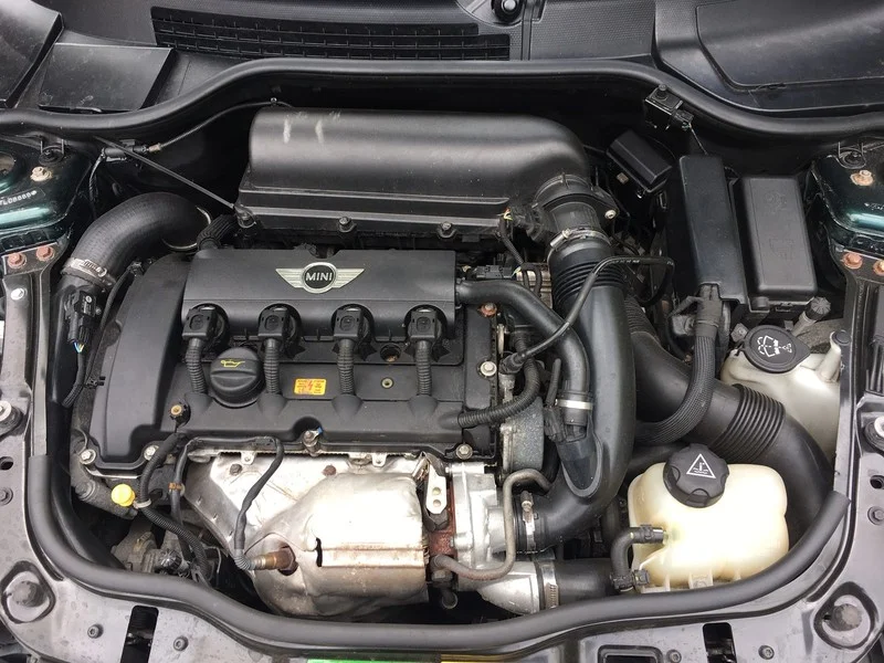

So, at the weekend, i set about trying to fit some of the part id accumulated, the AEM/Airtec/Ohlins/Carbotechs, first off was the AEM, took a little while, but very straight forward and all incredibly well made. For an induction kit, its ruddy expensive i think, but you can tell in the R&D/manufacturing that a lot of thought has gone into it. It also makes the OEM dump valve much louder, which is always nice :tonguewink:
Then onto the Ohlins/Carbotechs, which obviously involved removing the wheels. Problem, i cant find the locking wheelnut key. Doh. I think Richard gave it to me, so ive probably lost it, so will have to go to Mini to get another key, no problem i think. With that in mind, i decided to take some pictures of the dirty R53 & R56 together instead.

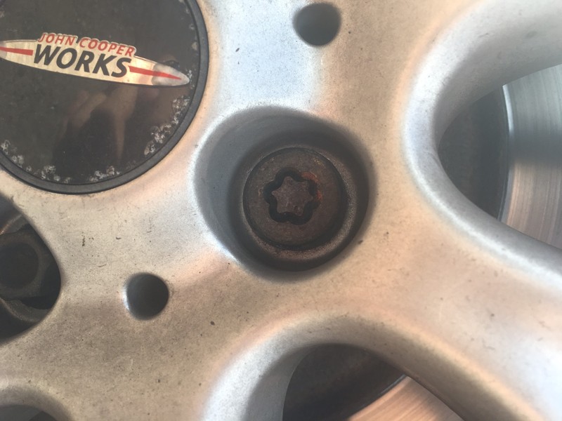

2. Upon trying to remove the lockers, it appears that when the wheels were off last (possibly to remove the coilovers/ultraleggeras) the nuts were gunned on/torque'd up by Superman. The locking key was going to be damaged pretty much instantly, so Mini said they'd have to drill them out (£60 a wheel lol). To make matters even more annoying, the locker on the front pass wheel had been put in at an angle/on the p1ss, so the thread/hub will be f*cked as well.
3. I then went home, rather irritated, to try the following: http://www.minitorque.com/forum/f274/locking-wheel-nut-removal-34155/ which doesnt work as they dont appear to be the splined ones, the 15/16 socket wasnt the right bit either & didnt want to destroy my tools trying. I did however undo all the other nuts (by jumping on my flipping extendable bar), then reinstalled with a little copper grease, to the torque i used on the R53.
The offending lockers:
So, i am now faced with an R56 that needs a wheel bearing, new hub, new pads front/rear, coilover fitting and clutch & flywheel changing, with 4 pretty much welded on McGard style locking nuts. Short of buying one of these: http://www.dynomec.co.uk/locking-wheelnut-remover.html for £185, does anyone have any suggestions? And this was the car to use whilst the R53 was being fixed lol, FFS ...

So yesterday morning i visited this chap:
Locking Wheel Nut Removal | Wheel Nut Remover - No.1 Locking Wheel Nut Remover
https://www.facebook.com/LockingWheelNutsRemoved/
Firstly he tried the Dynomec, which i was going to buy, & it simply snapped. Then he tired whacking a socket on, but again, it was not going to work, superman had the done the bolts up, then Thor had wielded his axe on the breaker bar to get them just that little bit tighter. So out came the ARC welder, a f*ck off great big lump hammer, & a breaker bar with a thing to be whacked on the end:
An hour later, we had the 4 knackered ones off, & 4 new non-lockers on instead. For £50, very much happy days!!!
