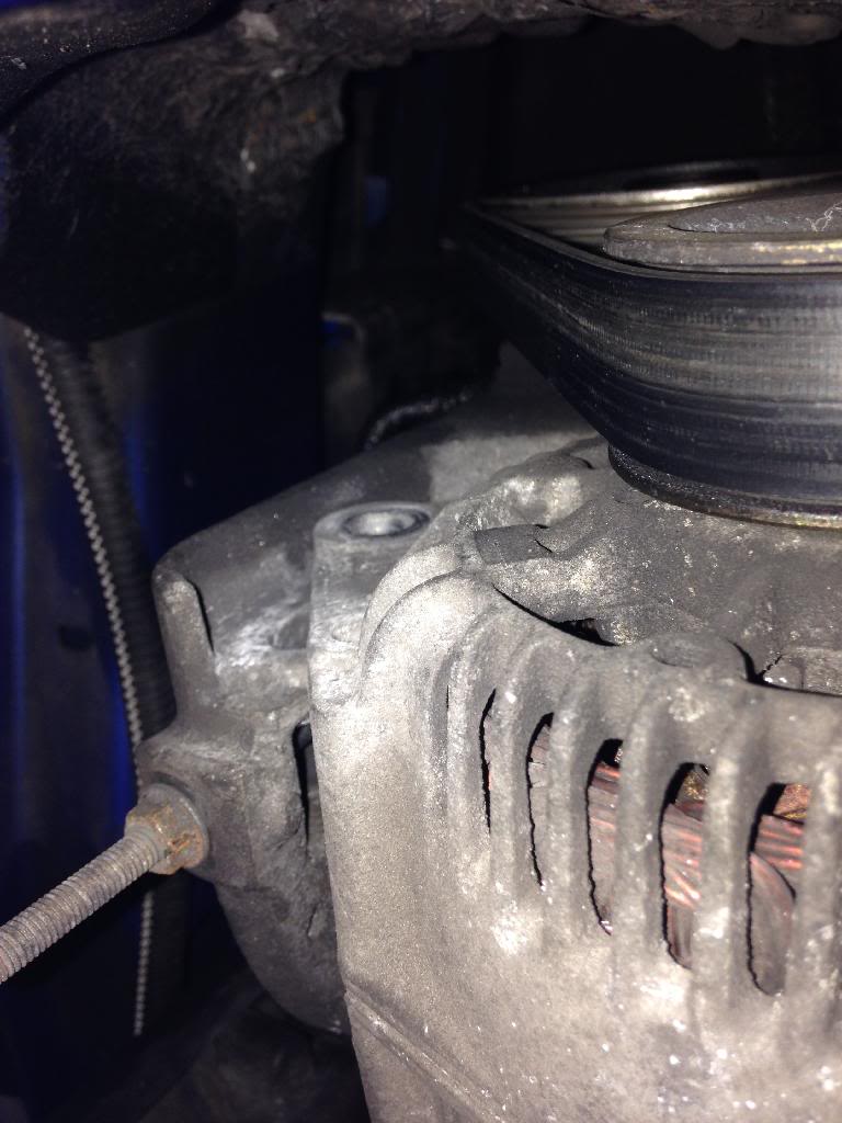

I'm missing the bottom alternator bolt
will this be ok to drive for the meanwhile, as I work late and I won't be able to get a replacement bolt until tomorrow and I could really do without my aux belt wiping out my cambelt at the moment!
  172 cup
Weight of the alternator and the entire tensions rests upon that tiny 10mm nut, get a bolt in there ASAP
What is currently keeping the belt under tension is it just the top bolt on the alternator ? The belt doesn't feel too lose atm I'm just wondering whether I should risk driving it home.

Seen one (albeit a FF 182) without the bolt that was fine for a while, before the top alternator bracket snapped and threw the belt off.
  HBT 172 Cup
Nothing is keeping the tension at the moment. It's a regular m8 bolt.
Whoops had to think twice, quite correct.
Although he will probably find the tension is being held by the bolt that goes through the alternator on the block, which is very much on borrowed time.
