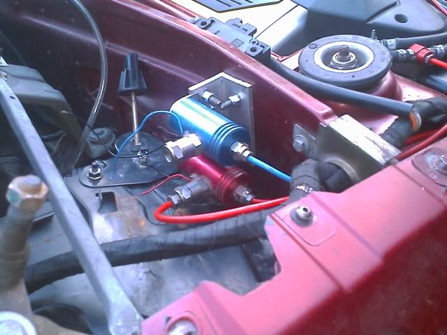

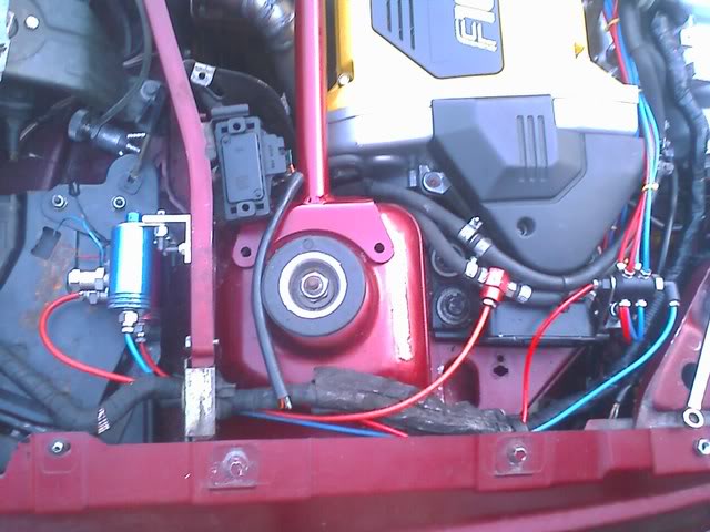

nitrous/fuelling solonoids installed

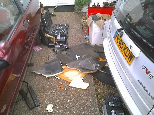

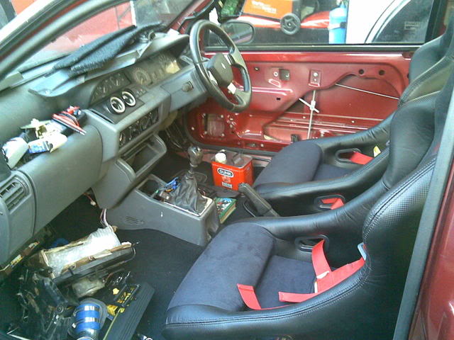

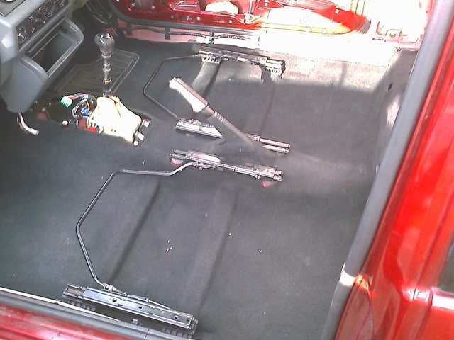

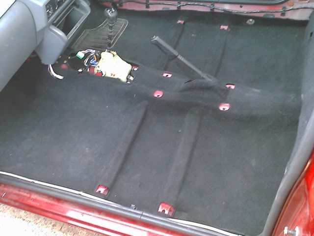

Cleaned out the carpet and took the padding out from underneath. Might do tar in the future.

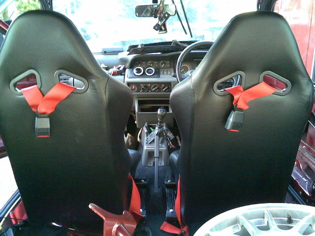

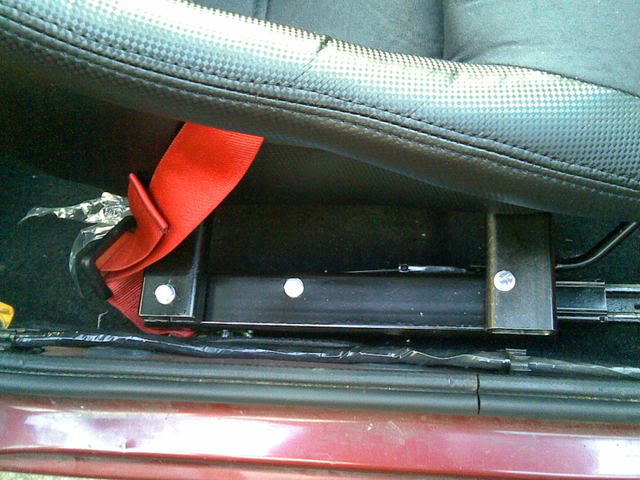

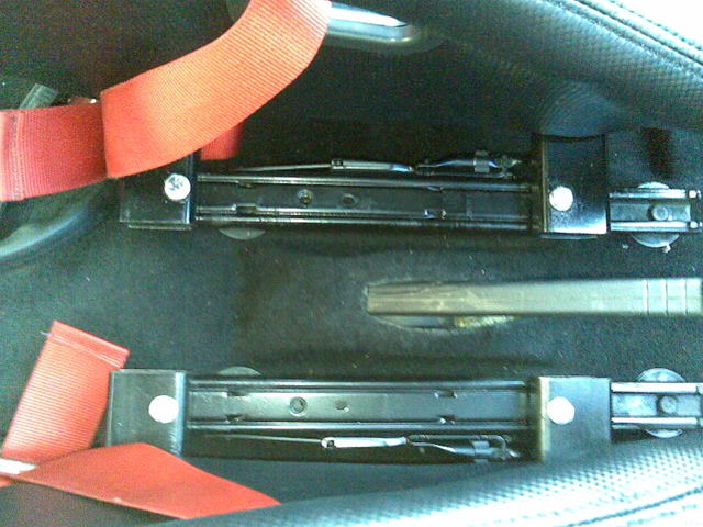

bolted oe subframes in to make custom bucket seat frames up on. No pics of seats fitted or custom metal work, but basically is made of 50mmx25mm box

So are you running a boost pressure map sensor? I don't see it mentioned in the spec list.
the Gas kit look gucci mate, good call. ;)
