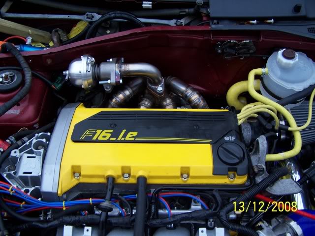

got the wastegate relocation pipe welded up this week, simple little bend to move it over.

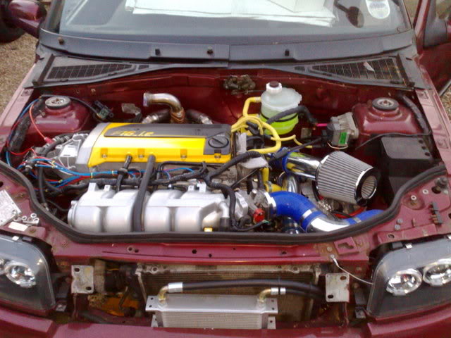

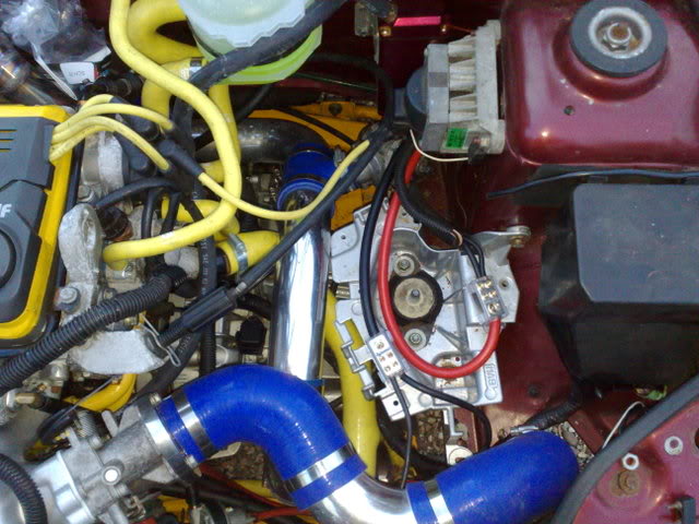

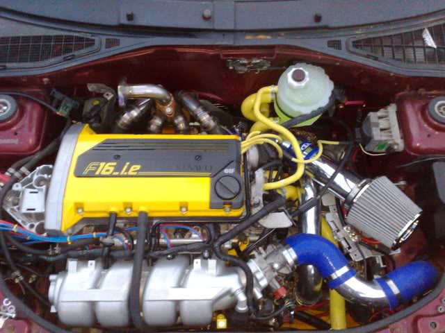

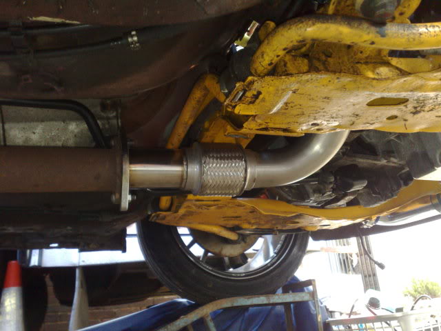

Few pics from today

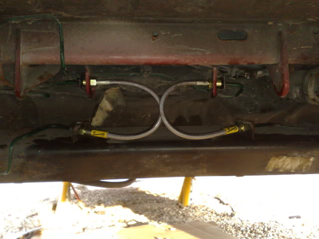

Fitted the rear braided lines (easier than i thought it was gunna be!!)

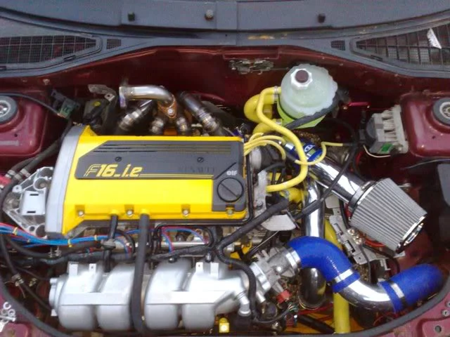

Just a few random shots

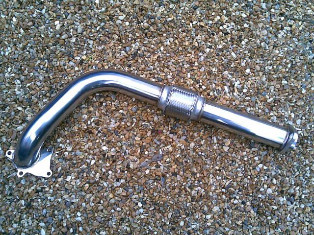

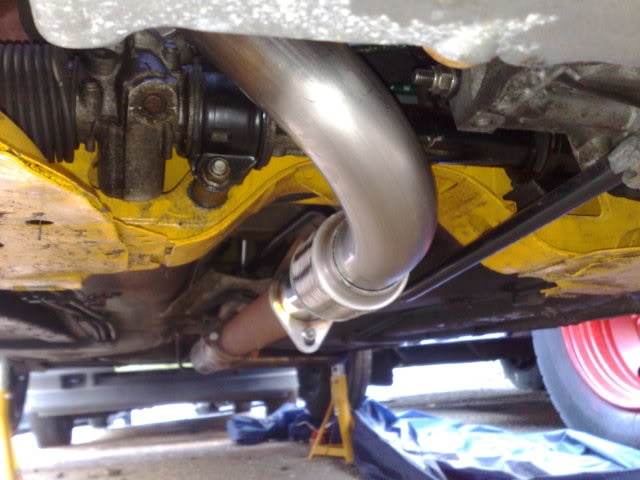

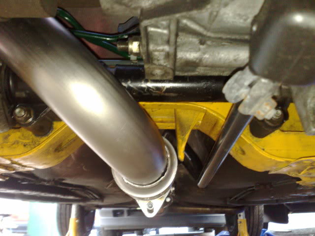

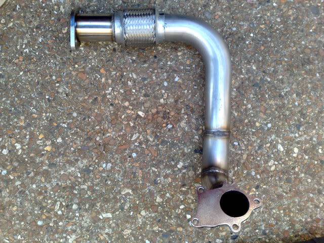

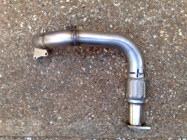

just looked back through the pics, realised how much i've changed the orginal downpipe i bought!
From this
To this!!

Thats some clever sh*t right there mate I didn't understand half of it!!
