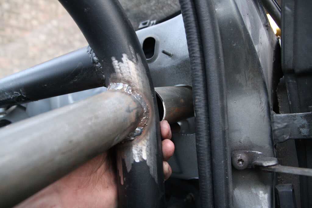

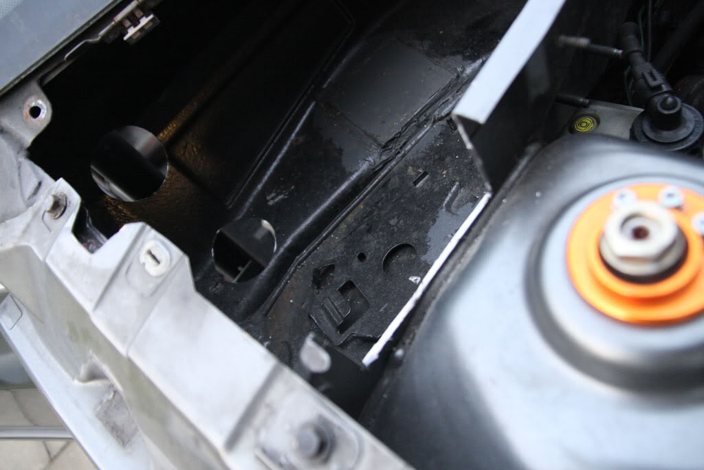

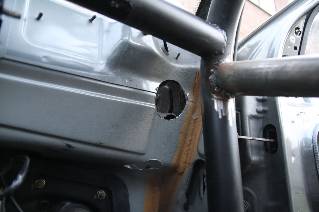

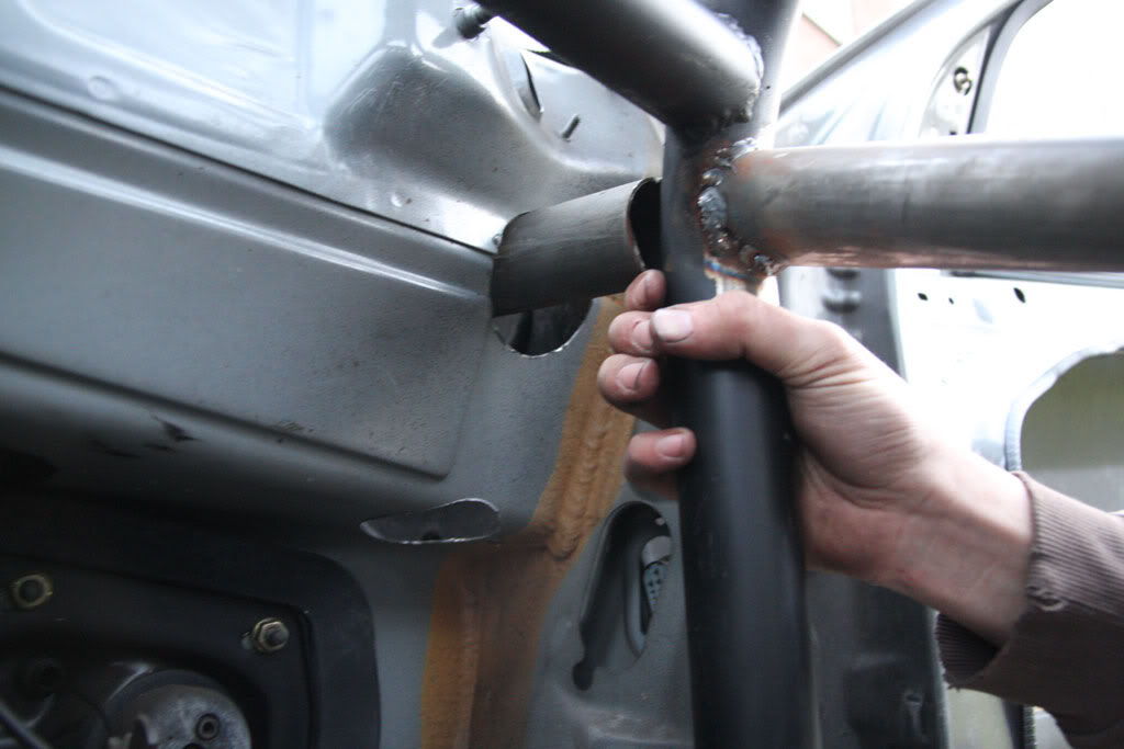

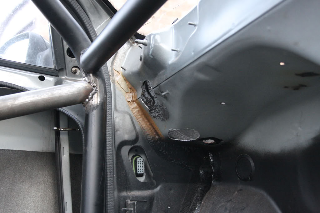

Been putting this job off for some time now - cutting the holes for the cage to pass through to the struts. A grinder and 70mm holesaw later...
Cage bar in place, not profiled at either end yet but you get the idea...
Diagonal will go from where the bottom door bar joins the A pillar of the cage, upto the strut bar though the other hole :) Will probably get them profiled and tacked in place tomorrow!
More soon.

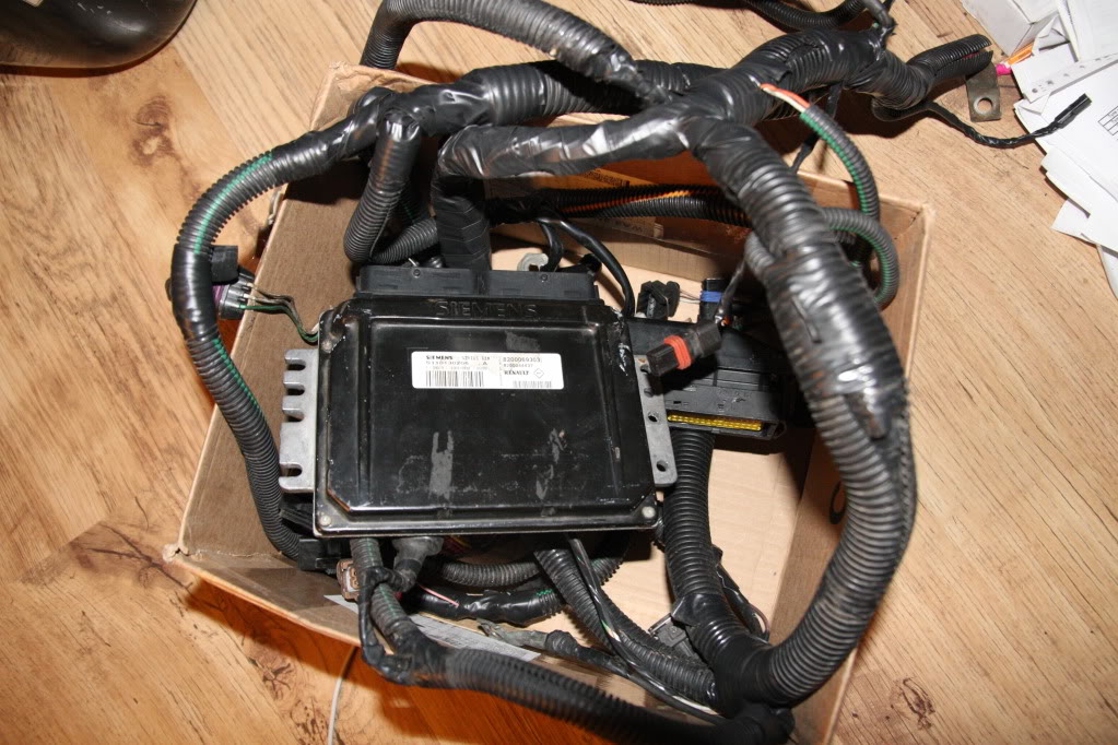

Au Revoir 172 ECU and one of the original 172-to-Mk1 Engine Looms! :)
Hopefully will make the conversion easy to do for the buyer and carry on running for quite some time to come! :approve:

Whats happening hear jord? You gettin the gen90 ecu or somethin?
