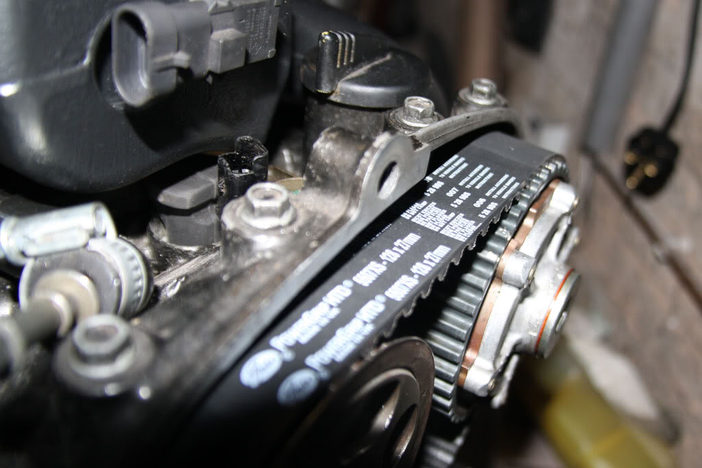

Checked the head over before building it up, then used new headgasket, newer dephaser pulley, new cambelt, mostly new everything - nothing should be wrong with it!

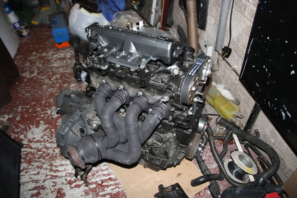

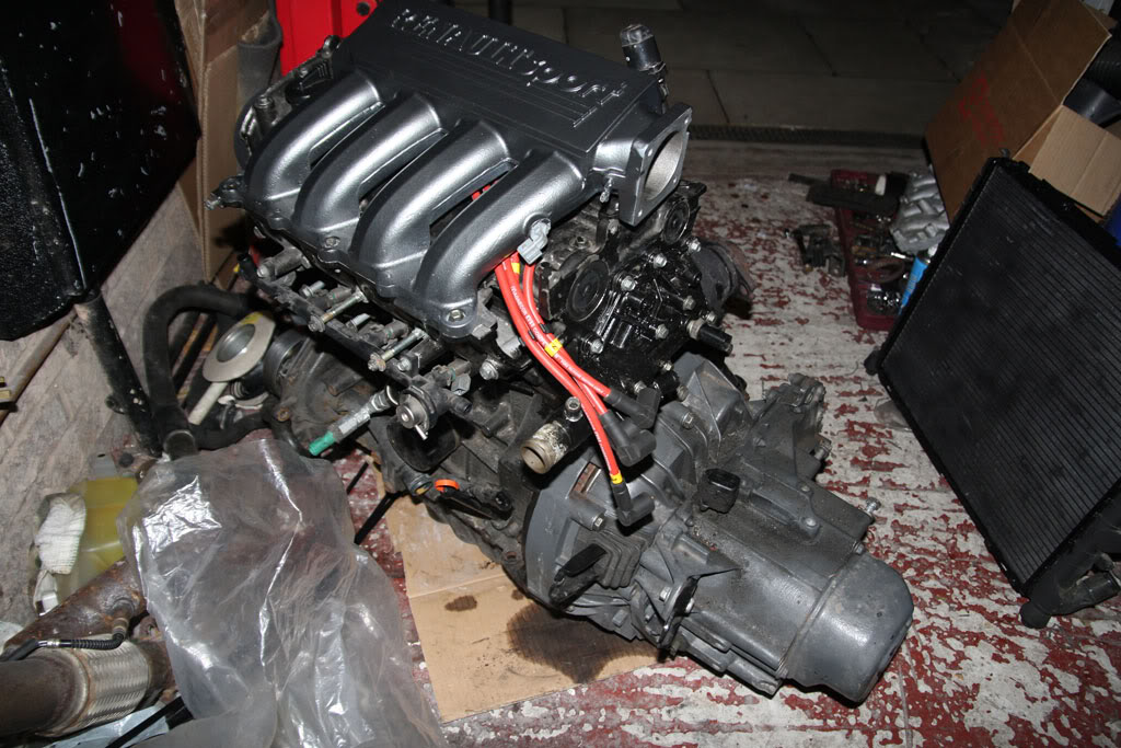

All built up near enough ready to go in - New Headgasket, Cambelt, Newer Dephaser Pulley etc. Just waiting on all the mounts/covers coming back from the powdercoaters, which does not really matter yet as the shell isnt back. Inlet manifold was re-sprayed and exhaust manifold re-sealed too.

Nah, thats (another) new one. Took it back after comparing it too my old belt and another new belt someone else had - all the same numbers + codes, but the one I had was 15mm ish shorter, very very odd.
Took it back, swapped it...got home and it was on within 10 seconds, joke!
wow. That is strange. Says something about production tollerances eh!

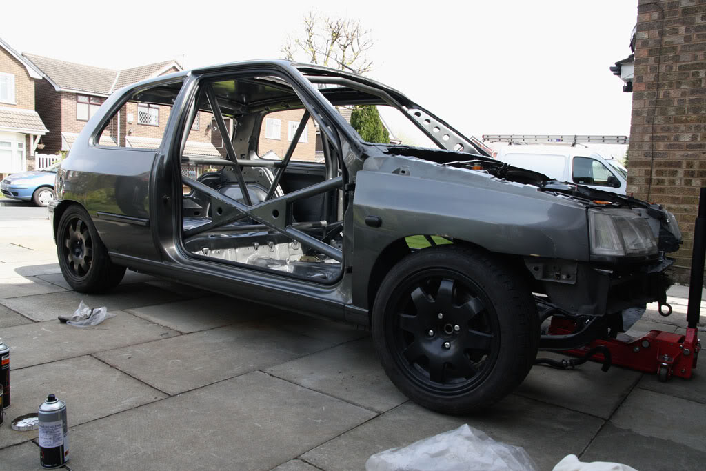

Trailered the shell back last night - so cracked on today. Started at 9am as the windscreen fitter was supposed to be coming, but once again (seems to be all the norm these past few days) I was let down and he didnt show up. He phoned me and said he can only make monday now.

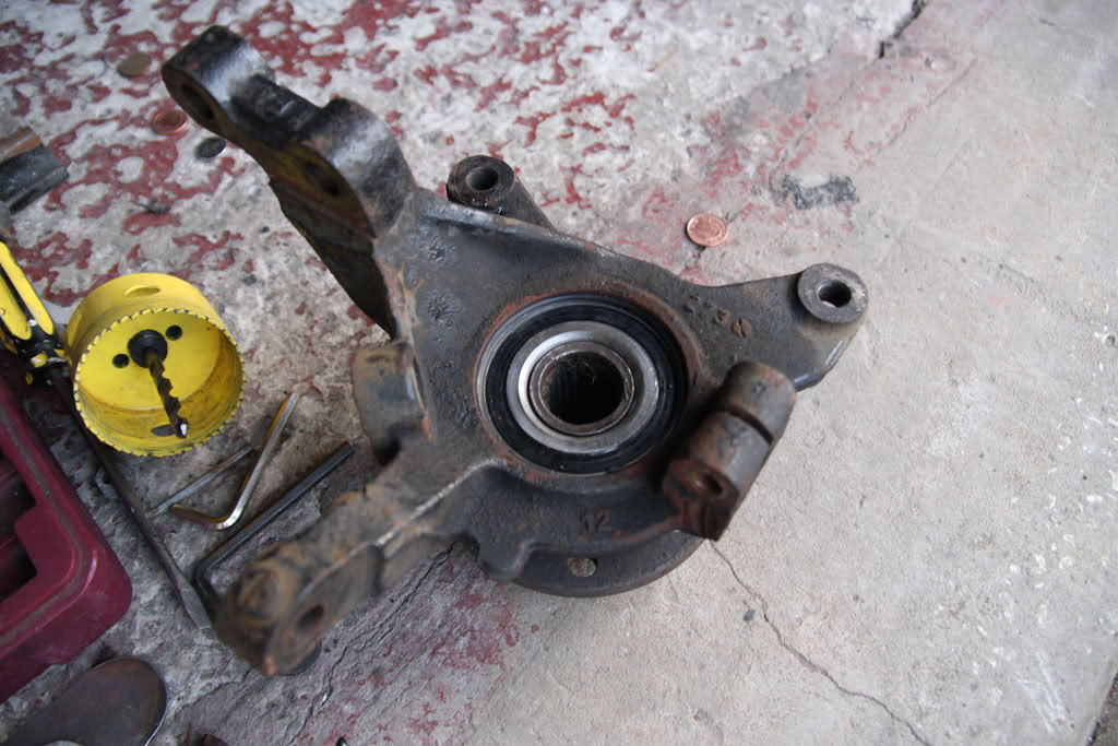

Anyway - I had a couple of issues that needed to be sorted first, the main one being the N/S hub bearing was completely shot, and needed replacing. Because of this, my N/S disk was completely knackered, as this was all that was holding the wheel in place and rubbing against the caliper.
Luckily Bloooooooooooor came to the rescue and donated me another pair of Brembo HC's to put on :)

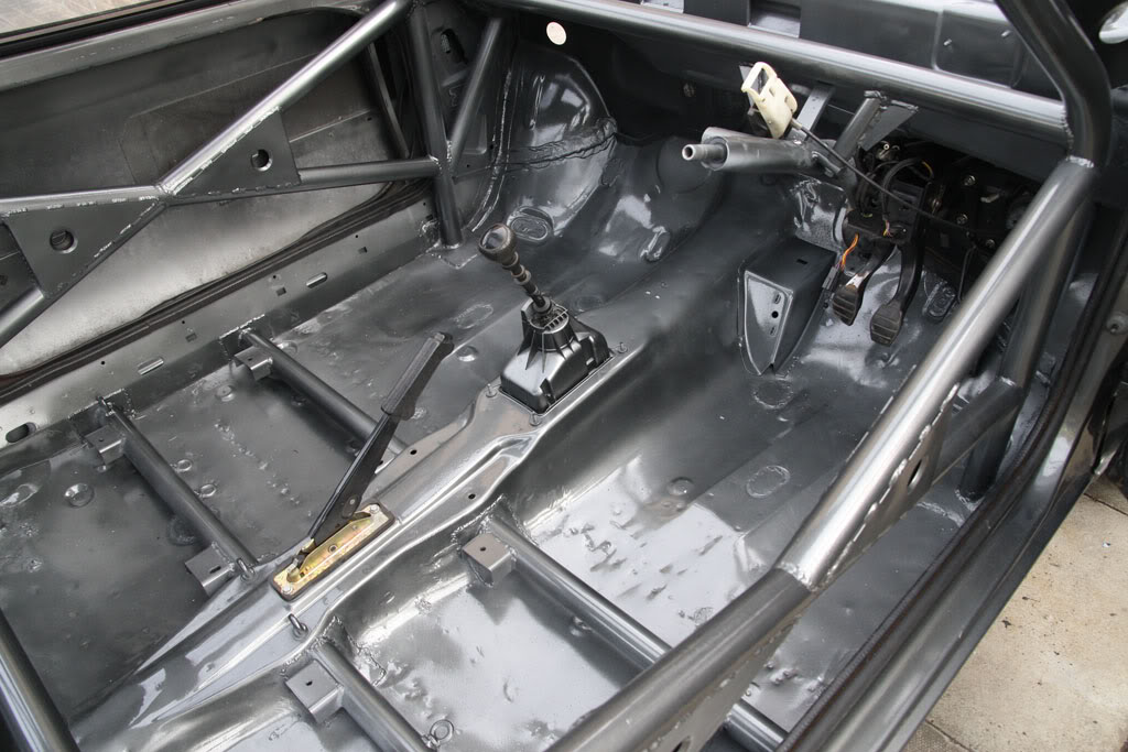

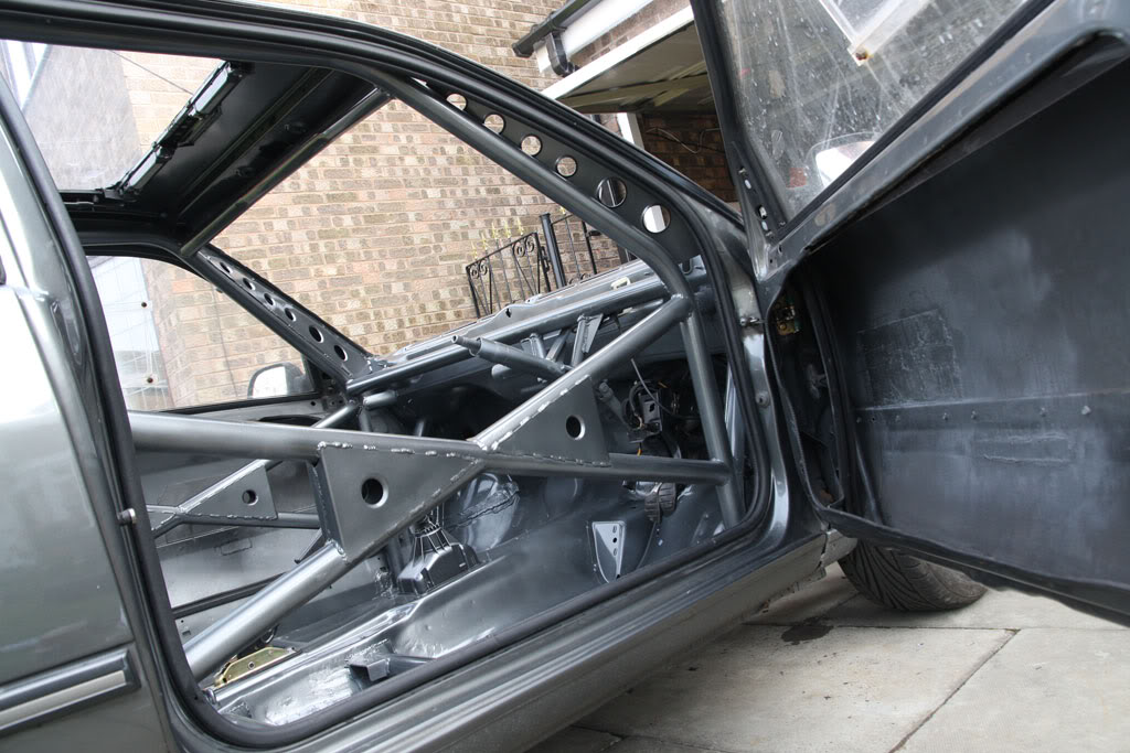

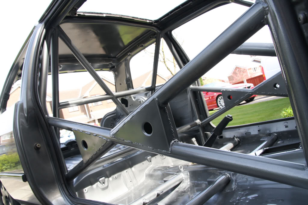

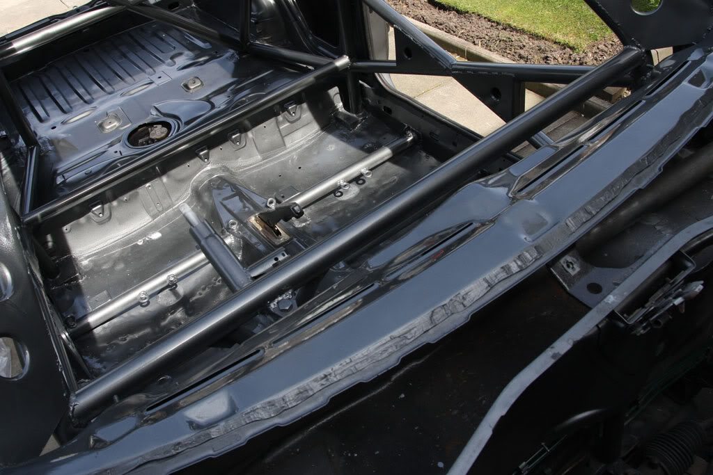

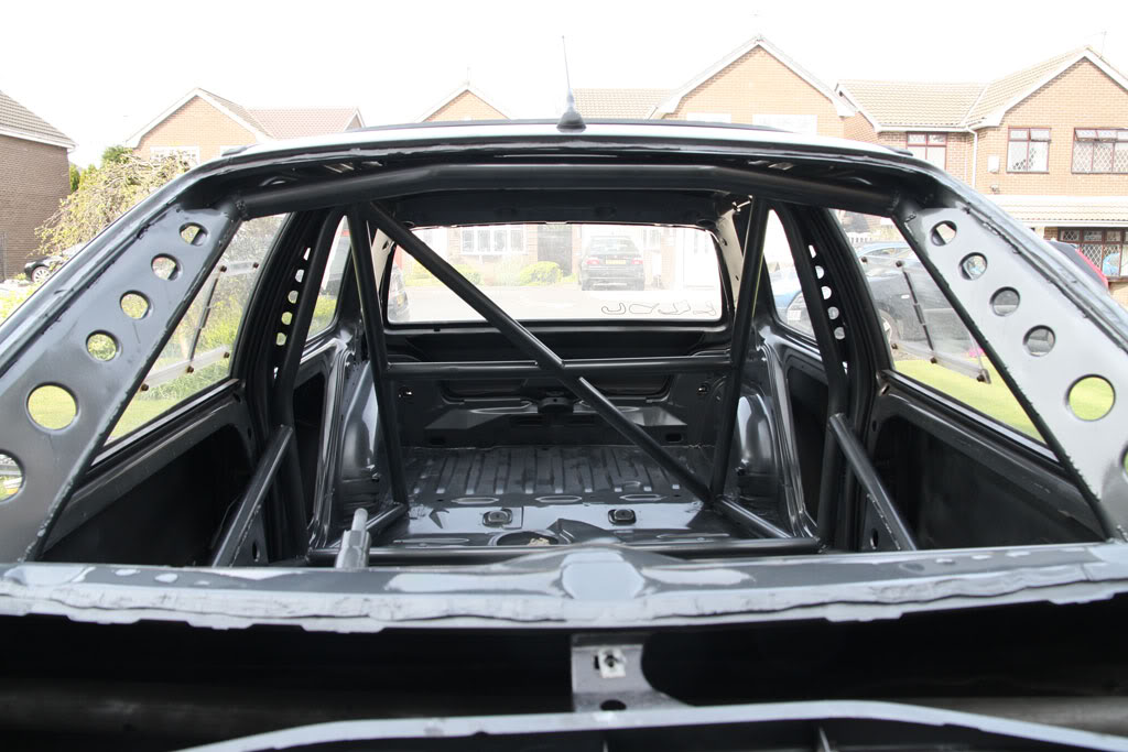

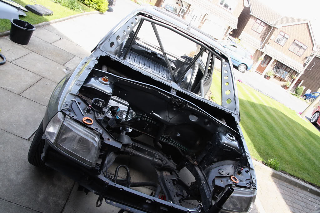

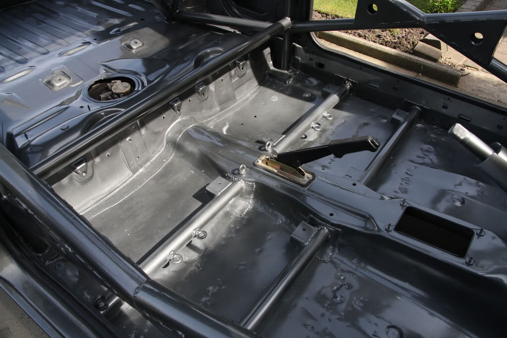

This is how the car came back last night...

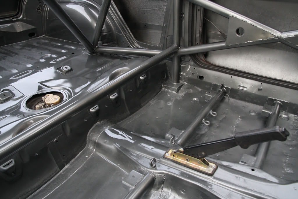

Started by fitting the pedalbox and master cylinder, then the gear shifter and linkage...

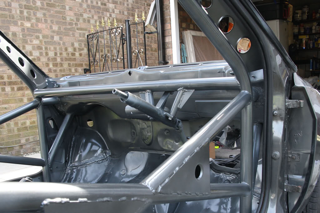

Better picture of the removable column mount now its all painted up. Two side supports and one rear support...
Then we carried on and fitted the doors/bootlid/rear windows...

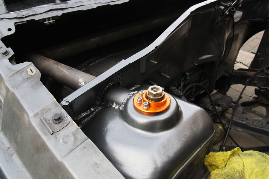

Also stripped the top mounts down and re-painted the strut tops...

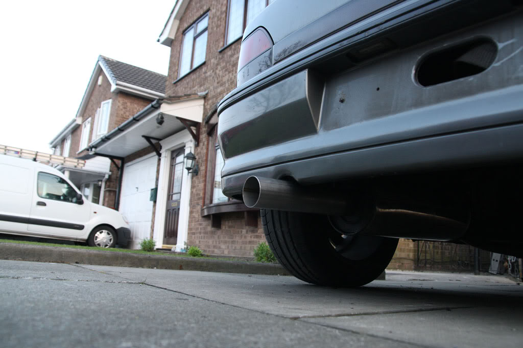

As you will know if you have been following the thread I removed the tailpipe of my backbox earlier last year and replaced it with a piece of 2.25" straight cut pipe...
A few months ago I decided to trim it down slightly, but ended up f*cking up the cut and it was wonky. So the plan was to cut it off and put a fresh piece of pipe on - which is what was done. Although, I've replaced it with 2.5" this time.

Last job was to remove the f*cked passenger hub as mentioned at the start of the post. Took it off and ran it down to get the bearing pressed in. Got hold of a bearing quite cheap from GSF - Cheers Maynard if you read this, I managed to get it for only £1 more than you quoted me, but I just went and picked it up to save messing with delivery etc. I still need the other bits off you, so il give you a call sometime soon.
Got home around 8pm and fitted the hub back to the car, along with the two donated Brembo HC's (Cheers again Bloooooooooooor). That took me to around 12 hours, and now im well and truly knackered, lol.
