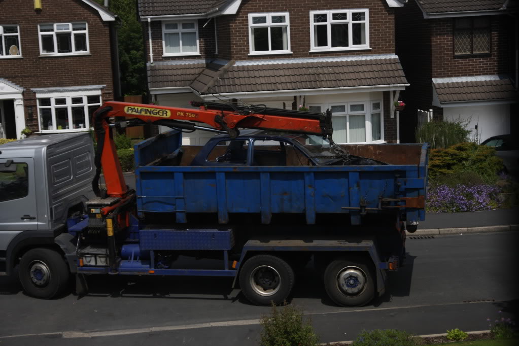

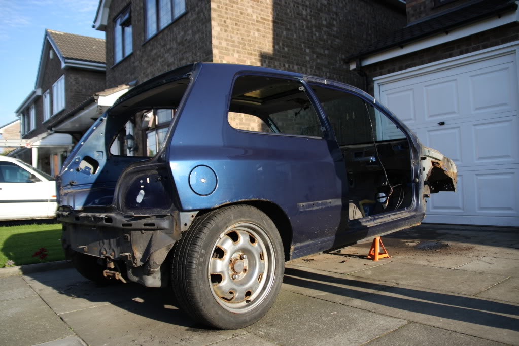

Not done anything on it today, been stripping the last bits off the blue car all day, pics later....its going to the scrapper tomorrow lol

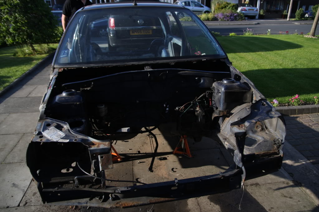

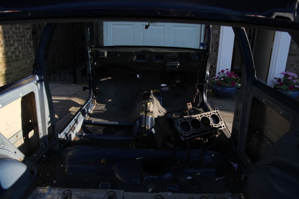

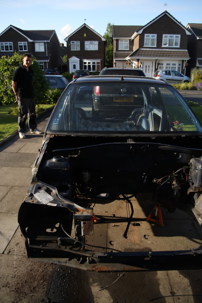

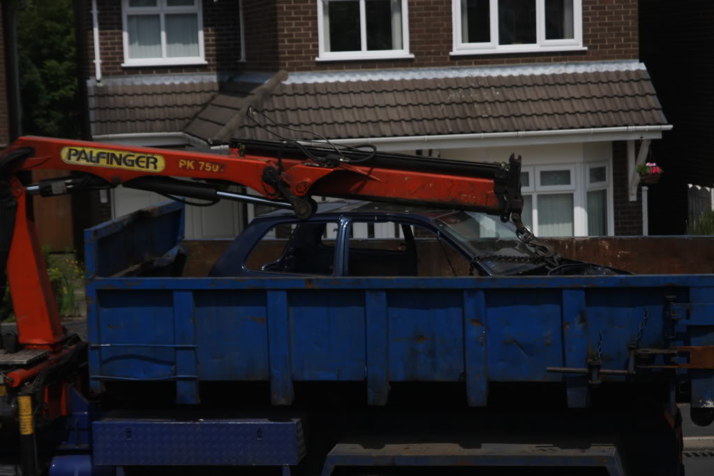

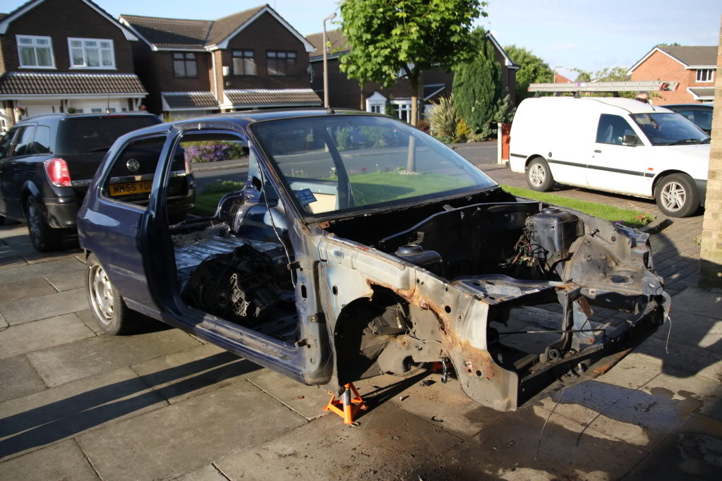

Finally going tommorow, been sat there for a month....Had a solid few days finishing removing anything I needed, few things left on that were either broke, worthless or rounded off....that reminds me, il remove the fuel cap too :cool:
Bottom end is in the car to go with it tommorow, as its siezed....removed the head and anything of value from the block, then chucked it in

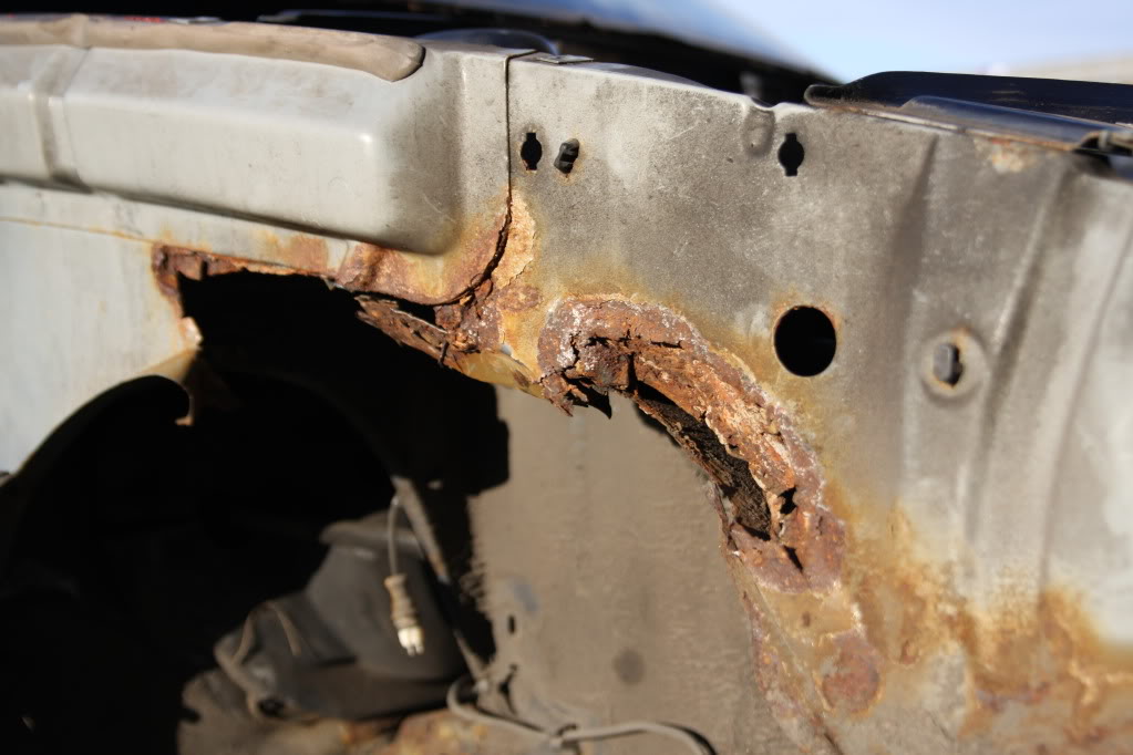

Shell is rotten along the underneath of the sills, under both front arches as can be seen, and the rust is coming back on the rear arches even after a re-spray not so long ago...
Bye bye 449 16v!
making room for the project originally, but cant work at home anymore, lol.

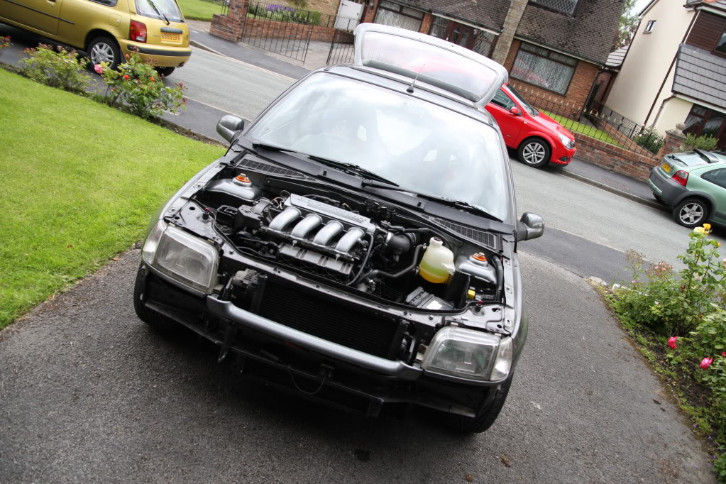

Fitted the schricks this afternoon, timed up runs fine etc etc...
Drove it from my grans to home (under a mile), was idling at home for 10 mins or so, then drove a few miles down the road....When i stopped, had quite alot of oil leaking from underneath...seems to be coming from the camcover/cambelt area :(
Just got it back home as soon as I could......but there was no oil at all on the driveway (bearing in mind it was sat there for 10 mins idling)....so its only started leaking as I left home to go on a drive......no idea what it could be!

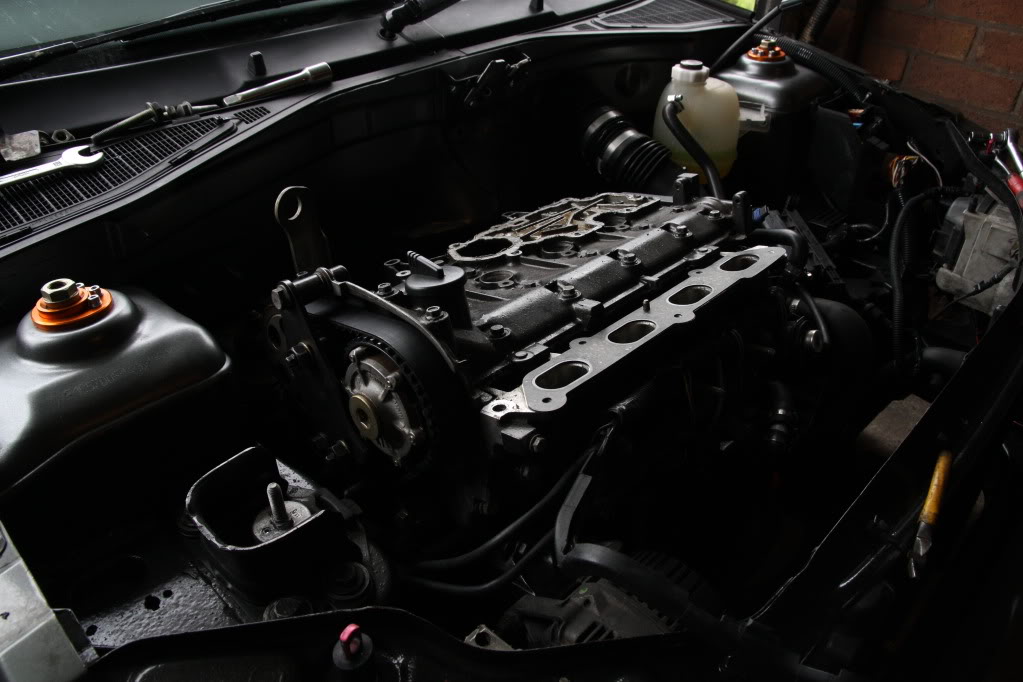

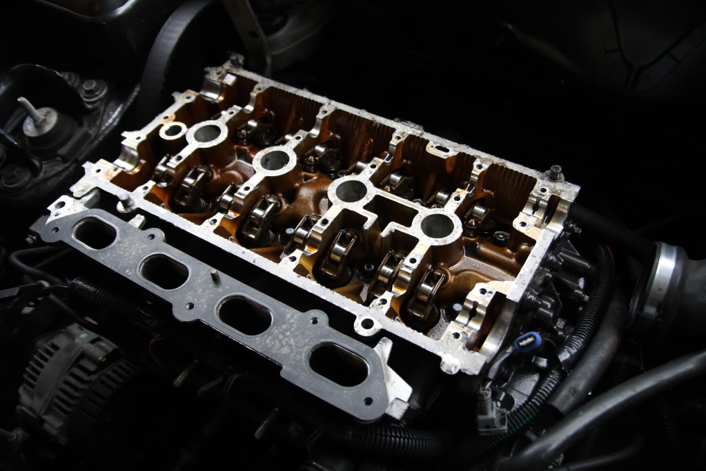

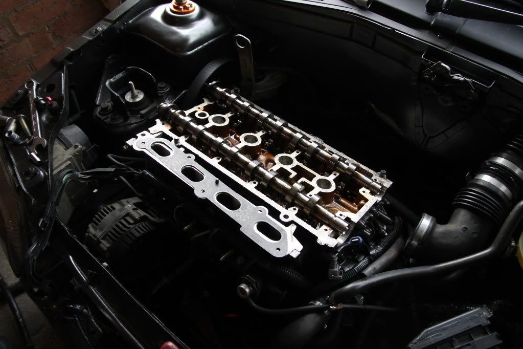

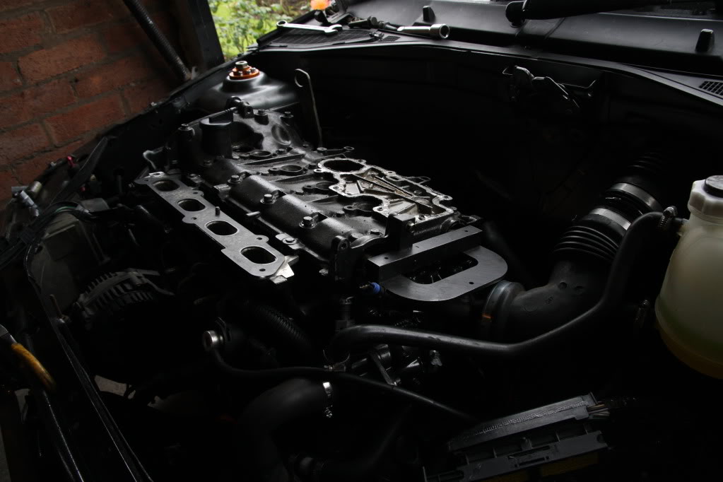

Ok...todays work...Bumper and bonnet off...
Cambelt covers off, cams, pullies and crank locked at TDC...SO much easier with the proper timing tools...
Rocker cover and original cams removed...
Schricks in place :)
Then put it all back together, cams timed up perfectly, checked it a few times....happy with it. Put cambelt cover and mount back on, then all the rest....started first time...
Still on the standard map, drives OK, needs that sorting ASAP though...Well, once the oil leak is sorted!
