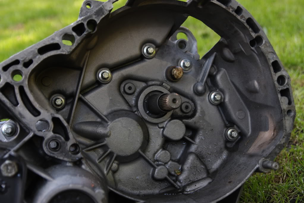

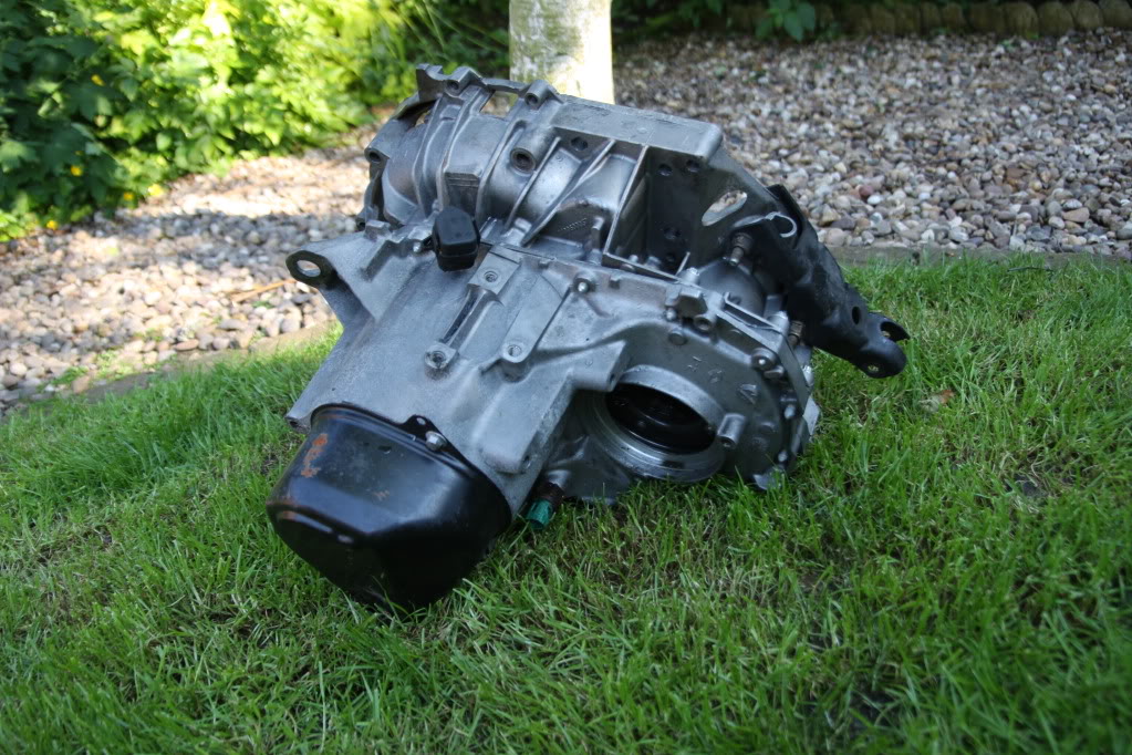

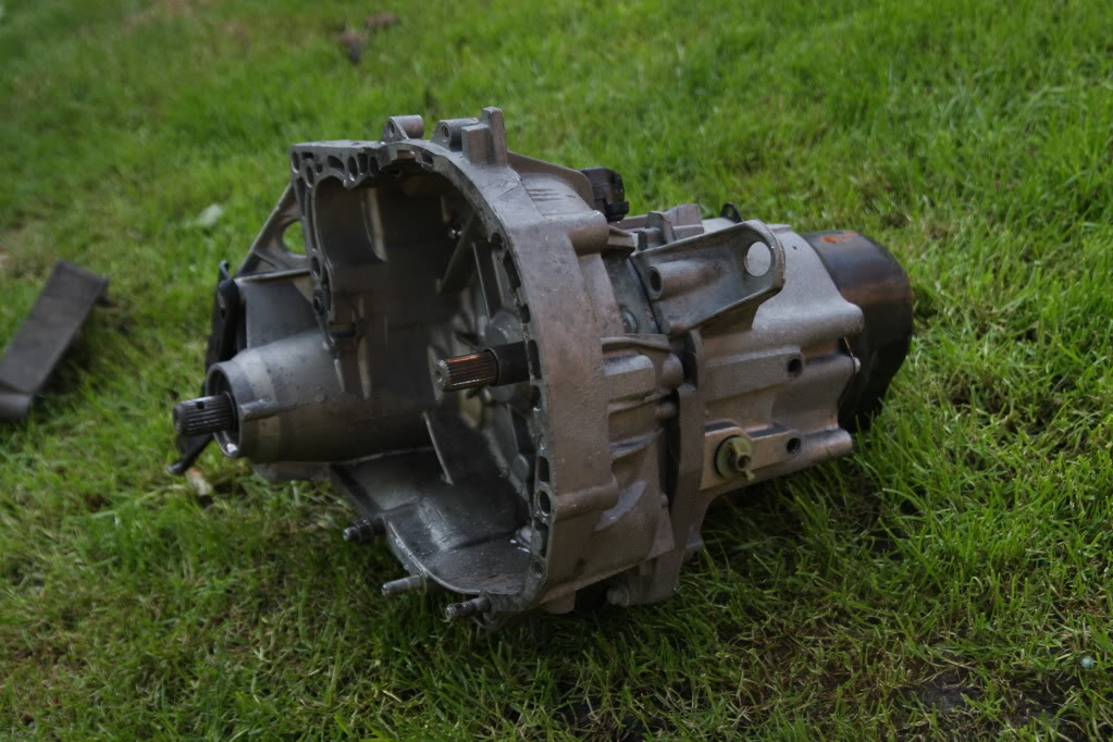

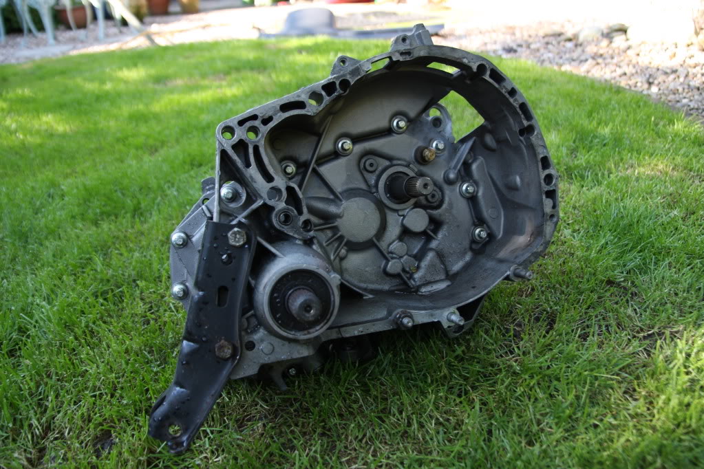

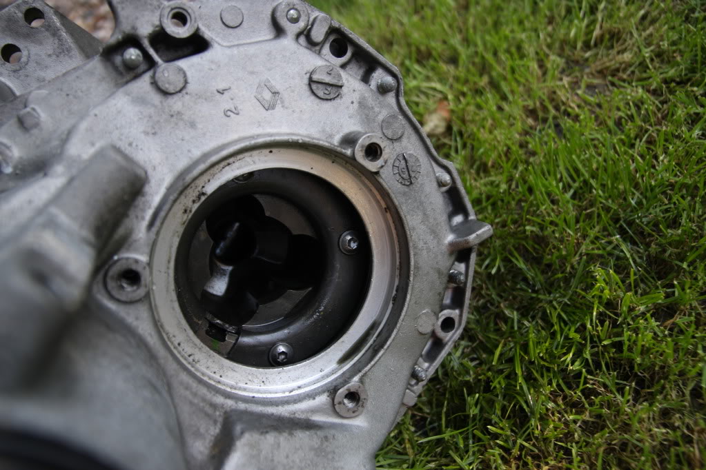

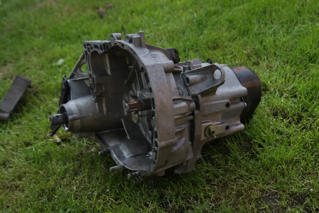

done quite a lot on the blue valver today, last parts removed, its bare now!
Cleaned up the near new JB3 (1.8 16v) box that was on it, not that old....previous owner had it from renault....Came up nice after a very quick jetwash...
Oh...and the bonus (why its going in mine), it has a bolt in diff, instead of the crappy circlip :)

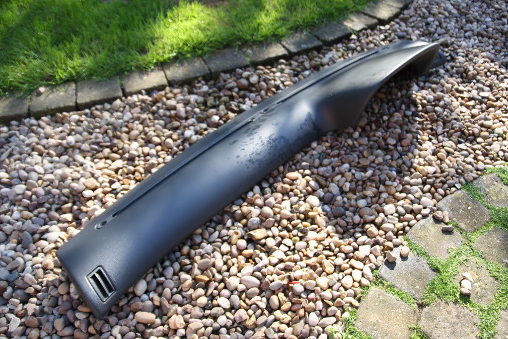

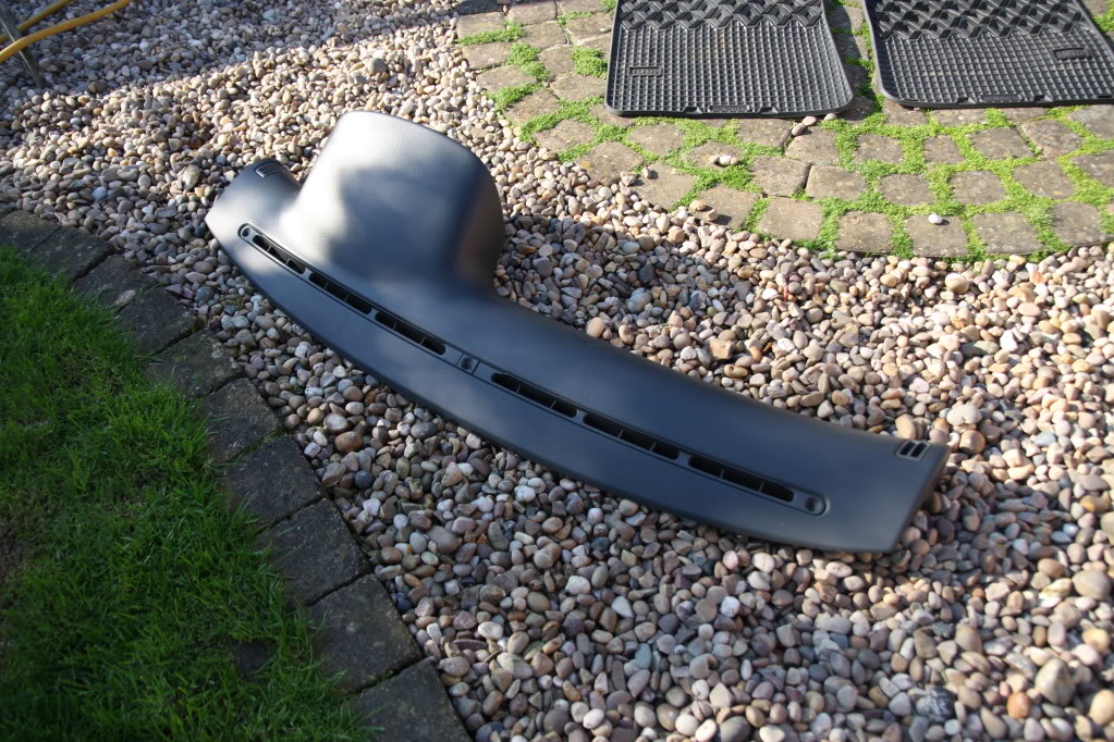

Also picked up a 1.2 dash top from the scrap yard, as im not running the middle 3 dials (oil pressure/temp/level). I have other plans for those readings in the near future so decided I didnt want the dash top to be shaped as it usually is for them!
If i can get it done cheap enough il have it flocked, but either way thats going on shortly :)

£50 for the dash top flocked!
In fact the guys who did my flocking already have a none 16V MK1 dash top, which has already been flocked ;)
IIRC £60 posted anywhere within the U.K

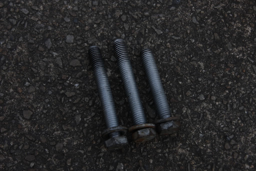

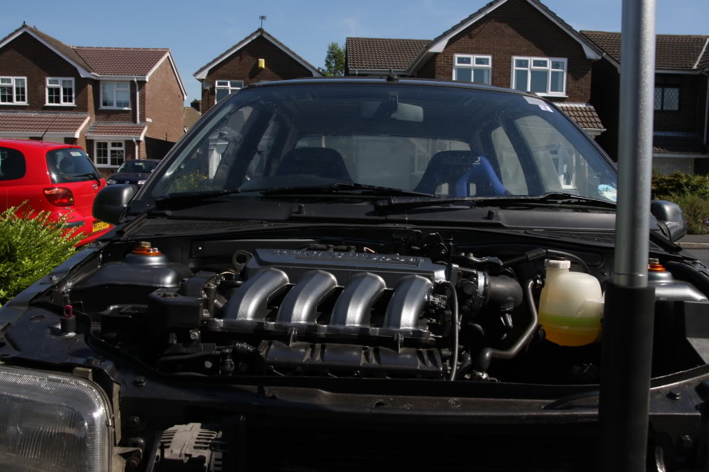

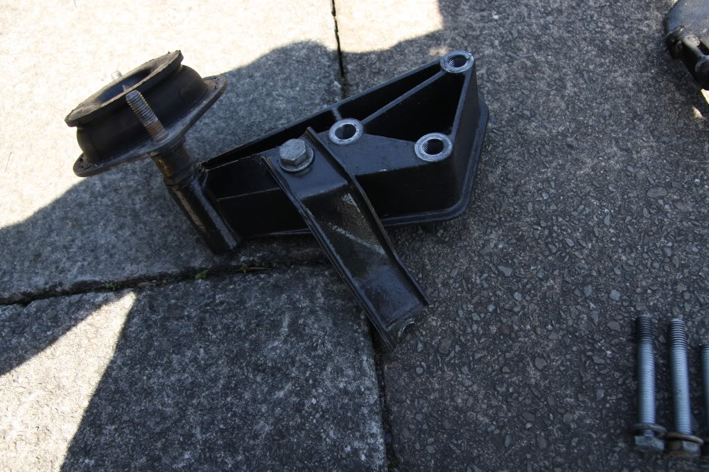

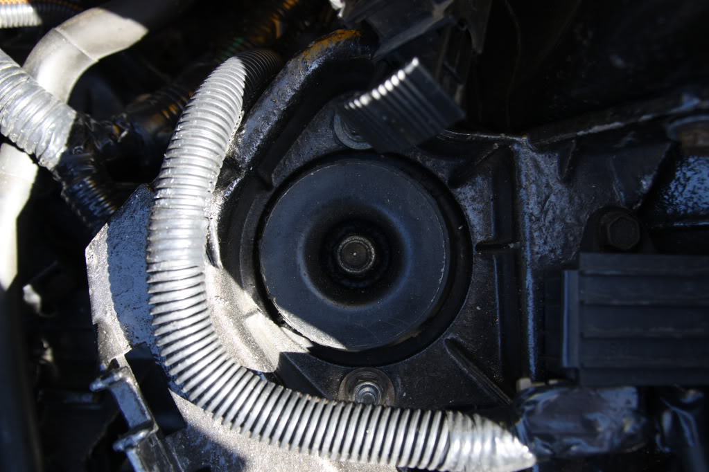

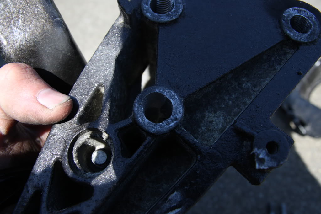

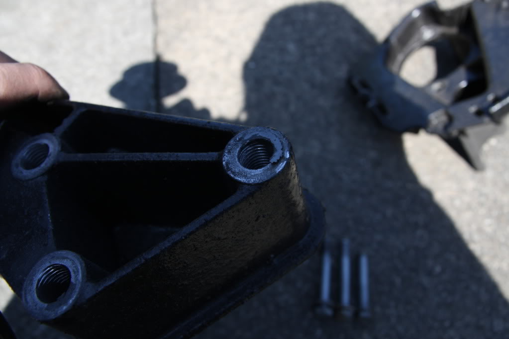

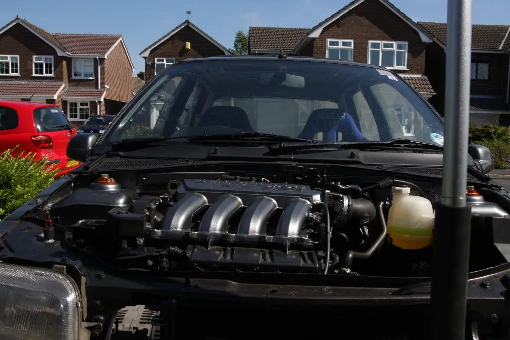

Exhaust manifold has been blowing worse and worse since brands, after having a look I noticed the engine was leaning down on the gearbox side....so I set about looking at it this morning....

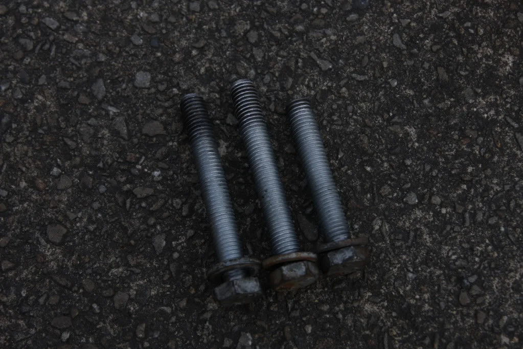

Thought the rubber was worn as it was leaning one way, but after taking the battery mount off to expose the part that bolts to the gearbox, the bolts were fingertight!!
one of them has sheared off (thread is stuck in the box), and the 'brace' for the mount has snapped clean off also...more fun :dapprove:
pics shortly.

so I thought, whys the engine leaning, oh....a fooked mount!
but oh no, the bolts were hanging out, and the brace had snapped clean off...
one bolt had sheared off...
And the holes on the mount ovalled...
fcuks sake.

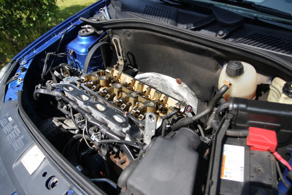

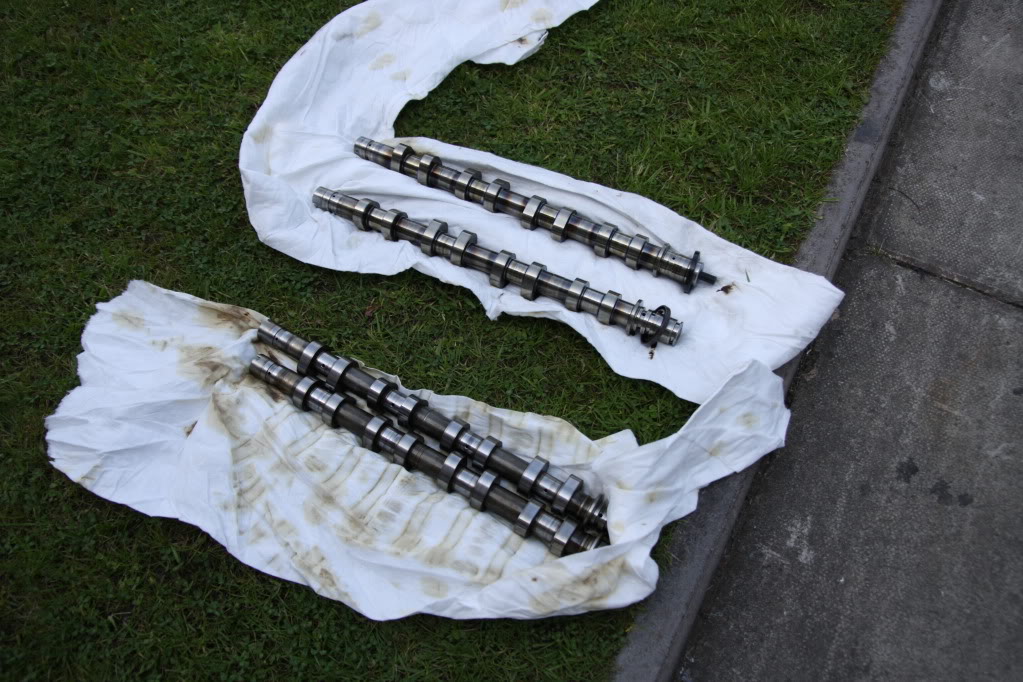

left mine for today, tooney came down around lunchtime, time to remove the schricks!
Schricks are furthest away in picture. His standard cams are now back in, timed up and running fine :) Just after we finished it all kicked off with the nighbours again, as they seem to have no life. Ultimatum from my mum is I cant work on the car here anymore whatsoever, so im a bit stuck now!

Cams arent in yet nah, just took them out of tooneys today. Not sure when they are going in (plan was before FCS), but with all this s**t from the neighbours dont know now.
Ideally wanted to get engine out, swap boxes, fit cams, time it up and put it back in....but need somewhere to do it now

No adjustable pullies, not sure how they would work on an F4R as the pullies are floating on the cams, there are no keyways. Also the inlet cam has the dephaser pulley which shifts the timing at a certain RPM
You don't need adjustable pulleys, only if you remove the vanos do you need an alternative pulley. the only advantage is the OE pulleys are a bit heavy vs ali ones

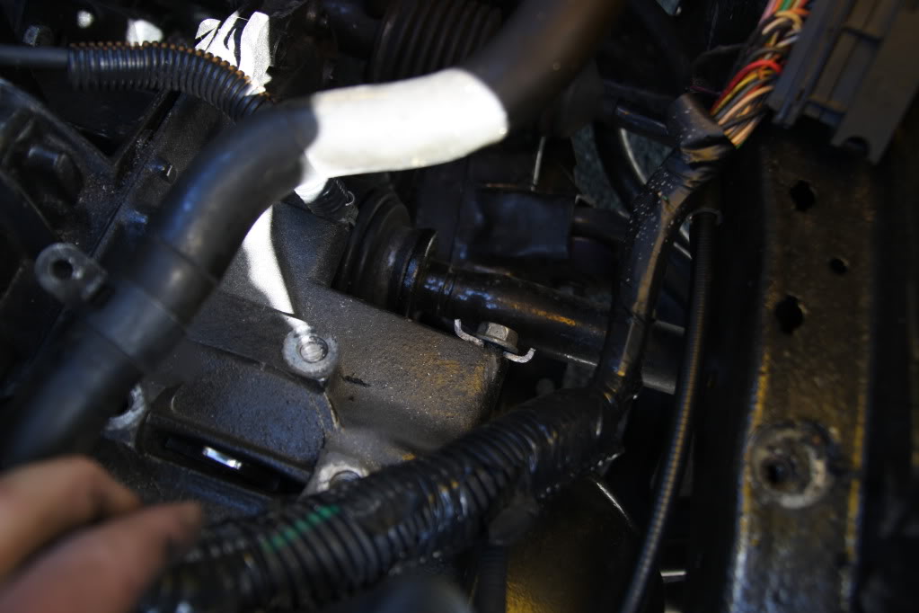

Anyway, we towed the car to the factory without a box mount on, then ive been doing it there. Put a fresh mount on (with no rounded holes), and a fresh rubber top bit.....put it all back together with two bolts and the rear brace (left snapped thread in for now)....everything has TONS of locktite on...
From this, noticed a few things. 1, engine is now level again. 2, the exhaust manifold isnt blowing at all now, sorted. 3, the radiator pipes now clear (those who know what im on about will know), and dont rub on anything....I think the mounts been loose for ages and the box was further forward than it was meant to be, hence rubbing the hose through! 4, gearchanges are now spot on, not hard at all to get it into 1st and 2nd like it was before!
So all in all, its sorted quite a few problems, i think its all been loose for quite some time (marham or before). Only thing left to do is try and get that thread out so I can run all 3 bolts in there rather than just the two.
