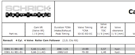

gonna be seriously fast once those cams are in mate:evil: any idea on the specs of them, lift+duration ??
Tooney (Who im having them off), is running them on a standard ecu and standard engine....well, decat/itg filter/matched inlets, made 192bhp when mapped iirc!
quite a few others on here are running them with good results too
