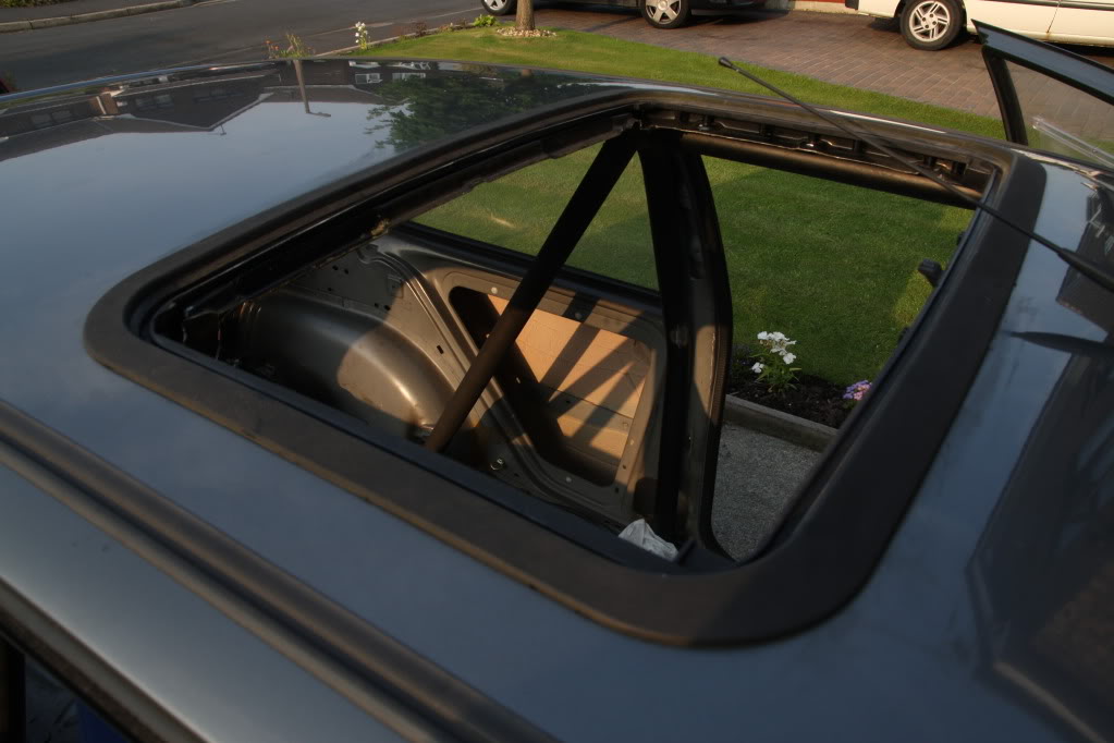

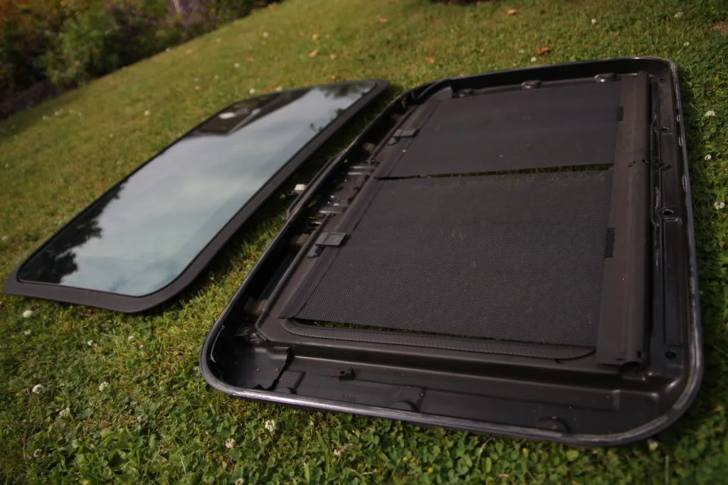

Done a bit more today, lost quite a bit of weight from the sunroof :)
Sunroof frame and glass removed...

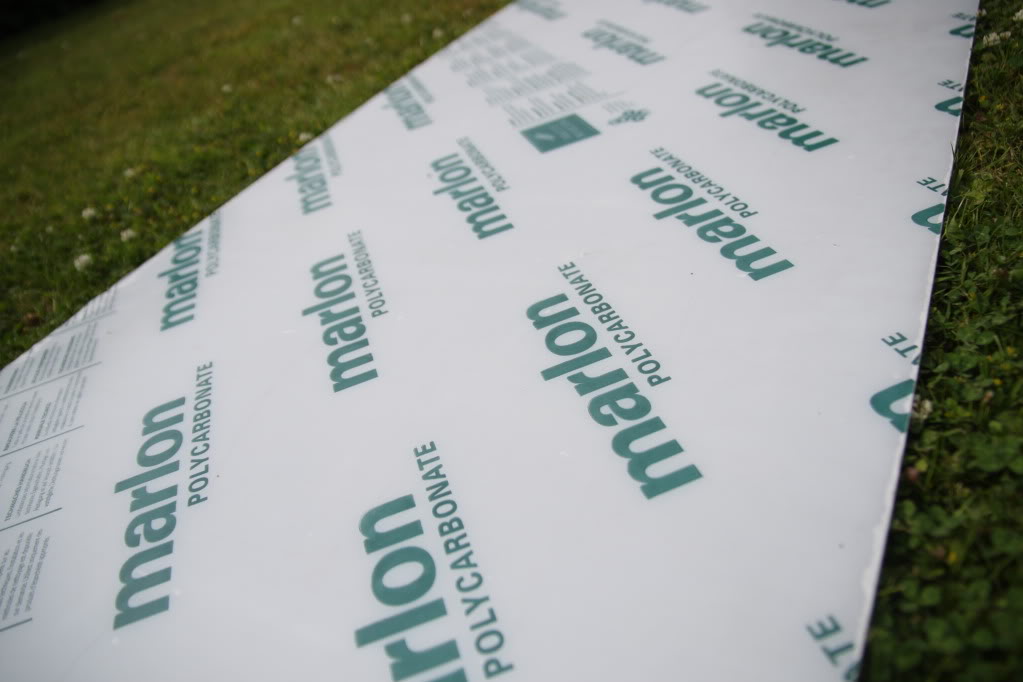

Polycarb...

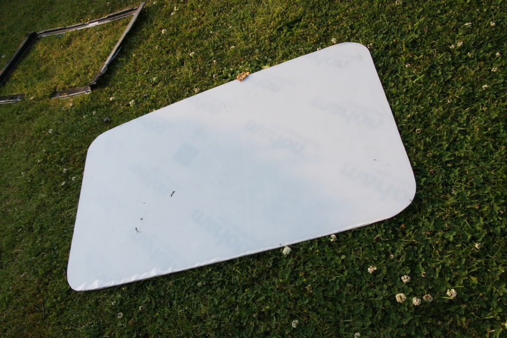

Cut to shape...

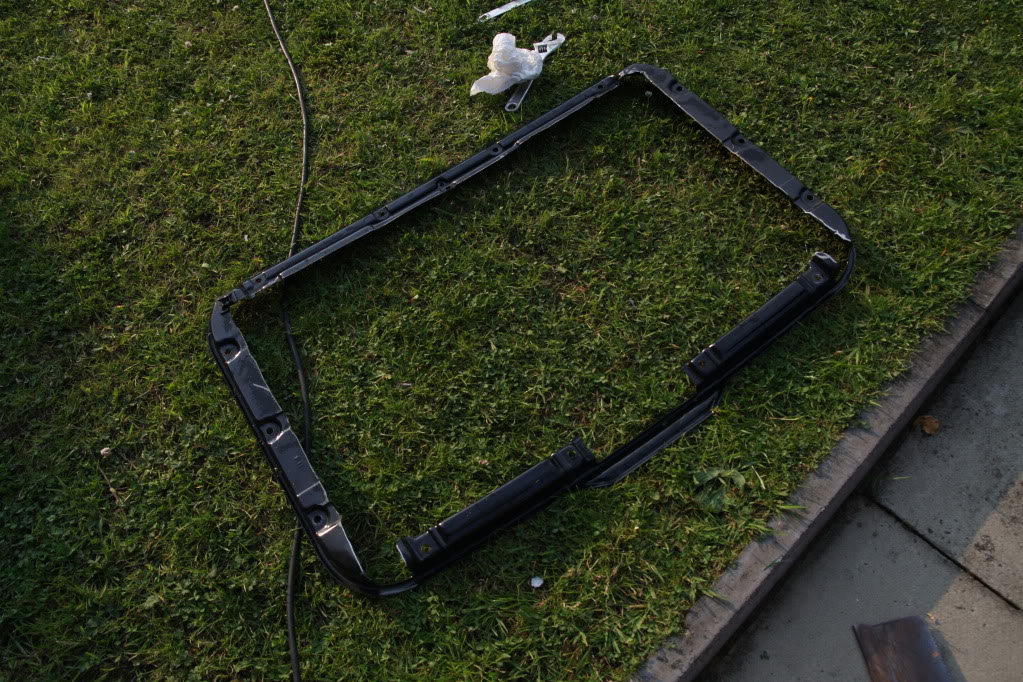

Then the inner sunroof frame met the grinder, excess metal removed...

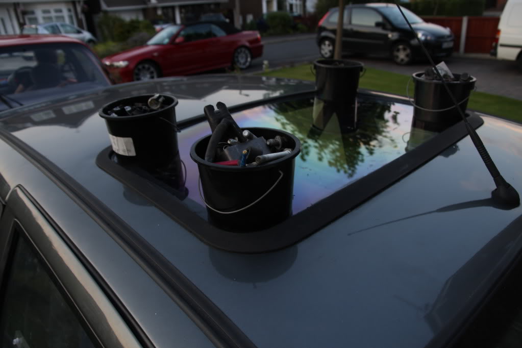

Fitted back to the car with silicone round the roof to be extra sure its not going to leak...

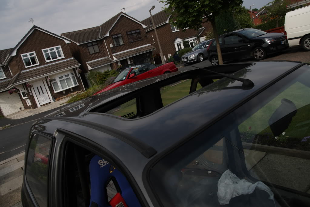

Then the polycarb siliconed into place, gotta finish it off tommorow once its all dried :)
More soon!
