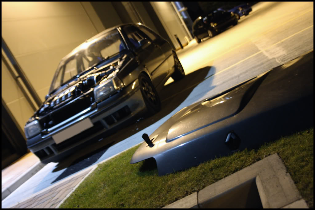

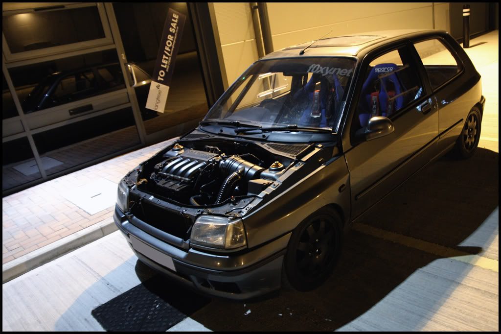

Quite a few jobs done over the past few days in preperation for Marham this weekend, leaving on friday morning and still got a few bits to sort tommorow...

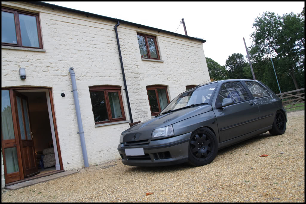

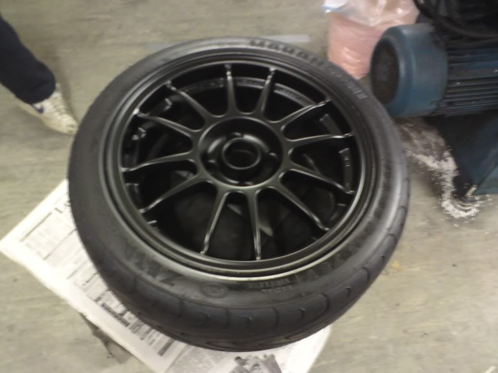

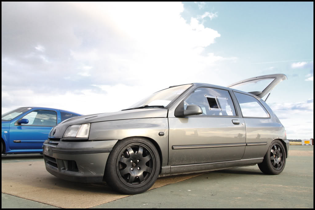

The superleggeras have been done satin black (rattle cans for now)...
Also fixed all the ghey warning lights on the 172 clocks, alot better not having the ABS/SERV/STOP/etc illuminated constantly!

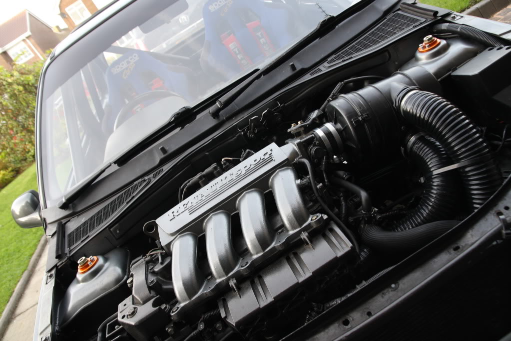

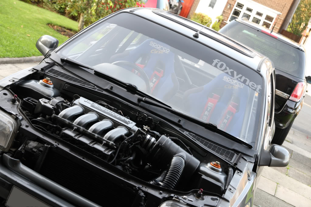

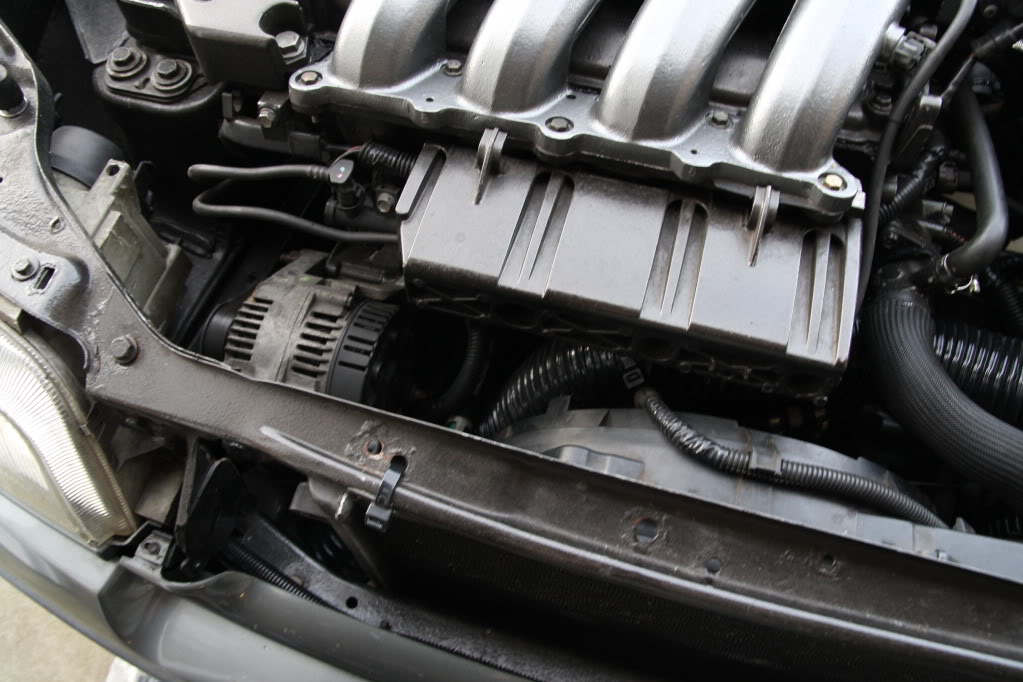

Picked up some 70mm black ducting, heavy duty industrial stuff, bit too heavy for my liking but it will do for now! Pics of this when fitted tommorow. Replaced the blue samco on the airbox with a black one, too.
Collected 2 x 20L Jerry cans after winning them for £2.61 on eBay, only down the road too, bargins bargins bargins.
Also fitted a black sunstrip to see how it looked, il decide if I like it or not after this weekend..
Still need to bleed the brakes, swap the exhaust manifold/downpipe gasket and tidy a few other things, then its about there :) Got to wire up the bullet camera again when Ive decided on a decent location to put it, considering il have the normal camera on the cage anyway, need somewhere interesting!
Will do a proper update tommorow!

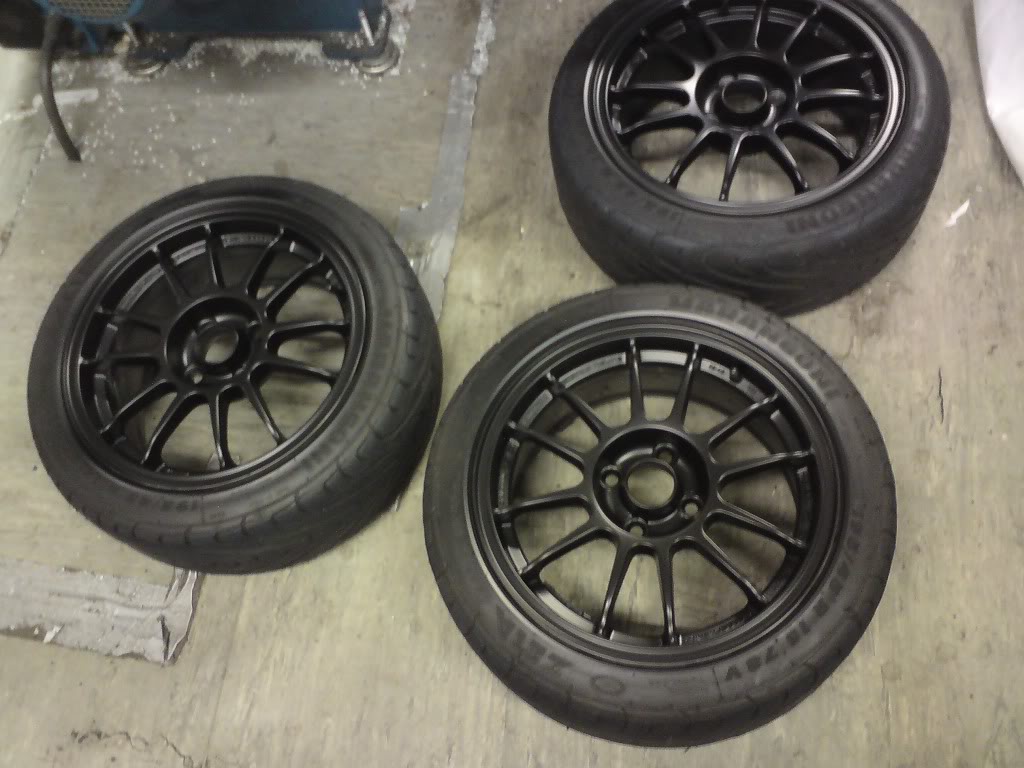

Ive yet to fit them (hate 45 profile tyres), might try one on tomorrow though!
Need to pop the spigot rings in too, halfrauds came through and supplied me with some to order :)

Good progress, Jord!
Should see a nice little weight saving with the O.Z's over the Willy wheels!
Re: Mk1 172 Hybrid Track Car Project
i prefer 45 profile tyres, thats what im running lol, just look less baloonish imo

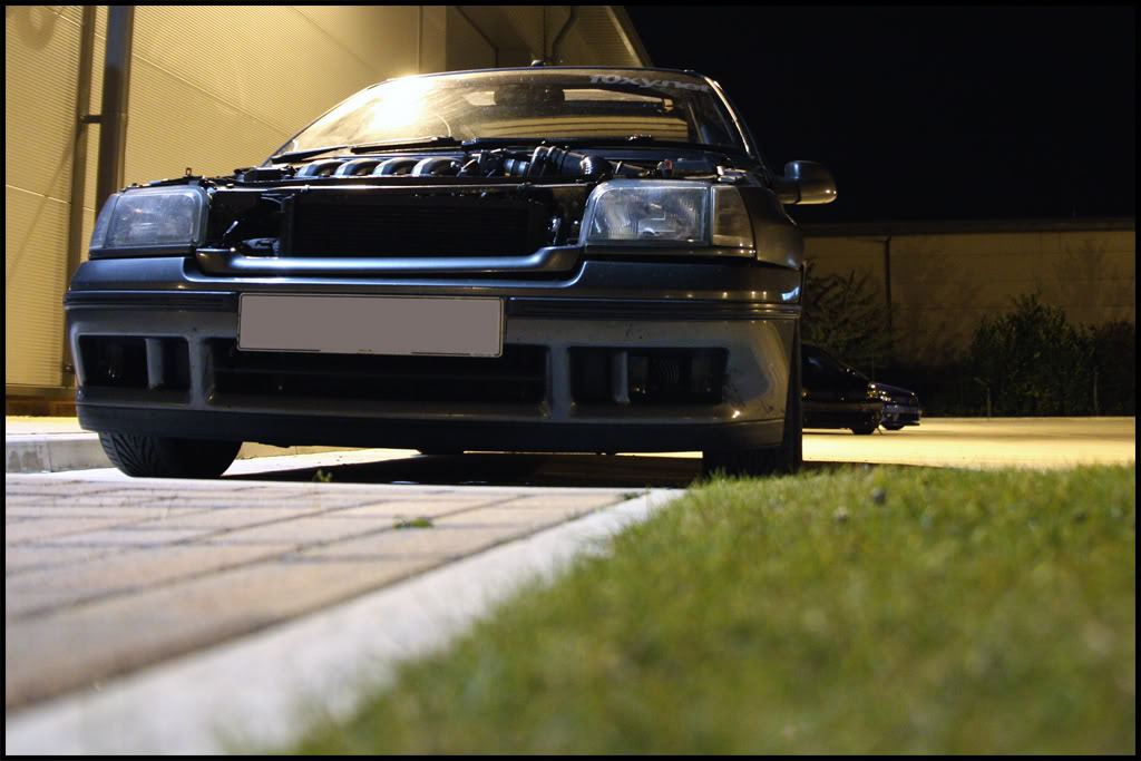

Passenger side is a bit of tight fit, well very, but it will do for now :)
New exhaust manifold gasket fitted, brakes bled through with fresh fluid. Black Samco fitted for the airbox. Sunstrip done yesterday (still undecided about it but it will remain for now).
Just got the bullet camera left to sort out, then its about ready to go!

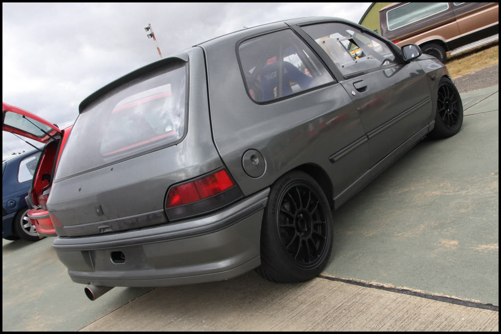

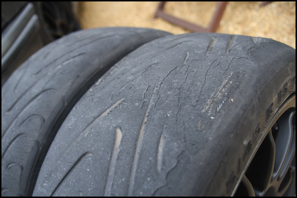

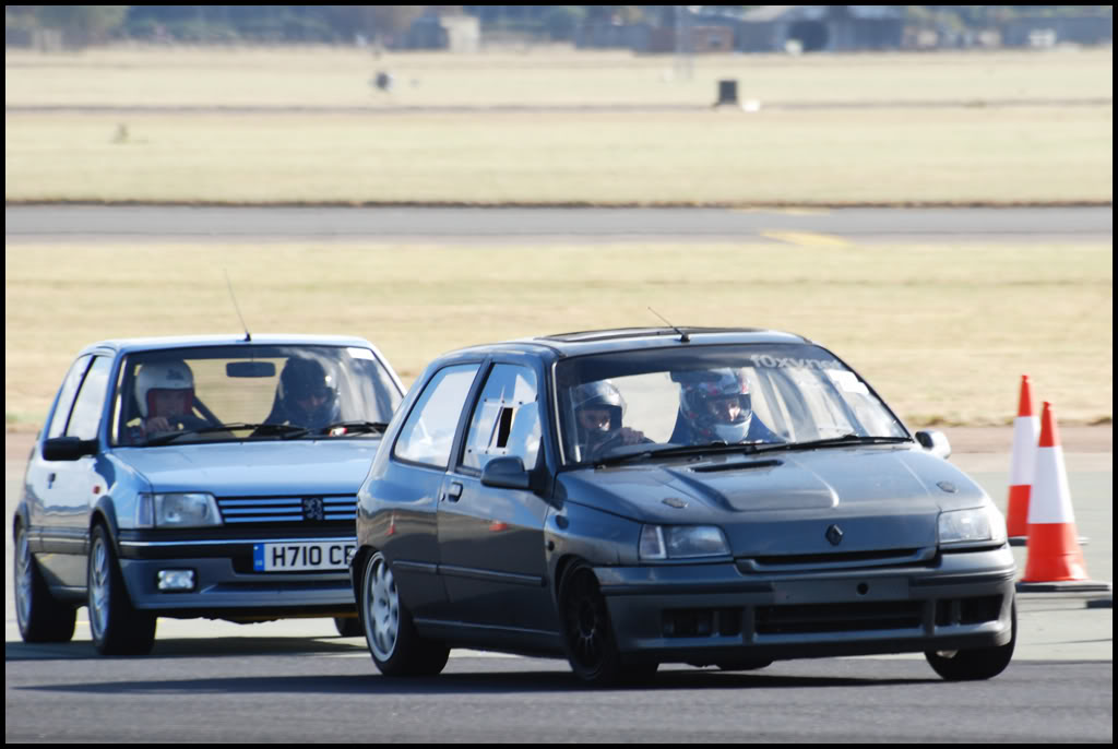

Just got back from Marham, no major problems with the car all weekend! :) Covered about 600 or so miles, and killed all 4 tyres on the Superleggeras, but all in all alot of fun.
The superleggeras make a decent difference in acceleration time, and speed once rolling, just need some half decent tyres on them now!

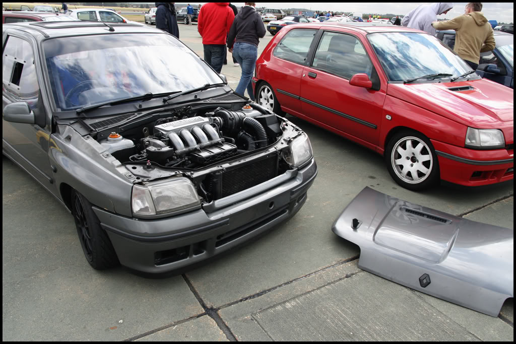

Another thing I noticed, after coming in from a 15-20min session, car red hot, popped the bonnet off and the inlet manifold/plenum was cold, and the rest of the block/engine untouchable it was that hot, must be them cold air feeds working well :)
Also the starter motor is finally giving up, anyone whos seen the car recently it struggles to start when warm, and it did the same this morning (from cold), so I think its finally going. Hopefully a replacement will sort that.
Had a lot of people coming over looking at the car/asking about it over the course of the weekend after it being on track, mostly suprised faces as to how well it was keeping up, just need them cams back in now with an ECU :evil:

Dont know, its only 45-50, cant make that much difference really can it? did feel alot different, steering wise too, but still, its quite a bit of weight saved on each corner and it did get up to speed faster than it normally does...
50's are going on now anyway, so Il have to see if the effect is the same, but either way they are staying for now :)
  Audi TT 225 Quattro
everything is better once the superleggeras are fitted, better steering, braking , acc etc, all to do with the rolling weight ( or lack of it in this case ) ;) i knew you'd get on well with them:D 45-50 will notice very little difference.....

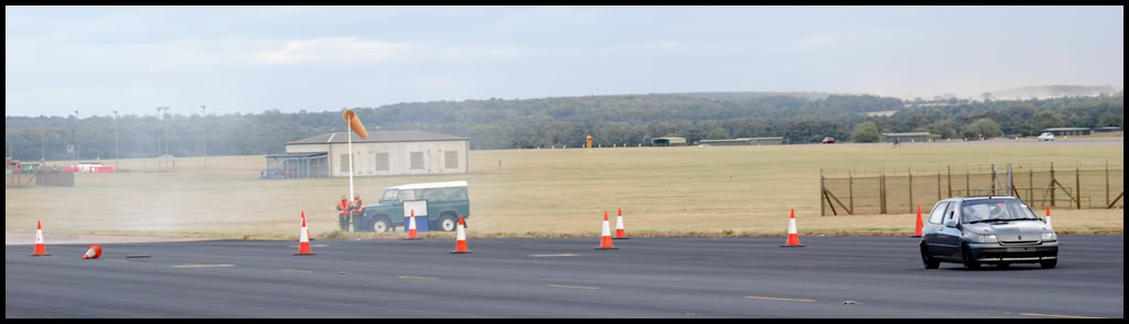

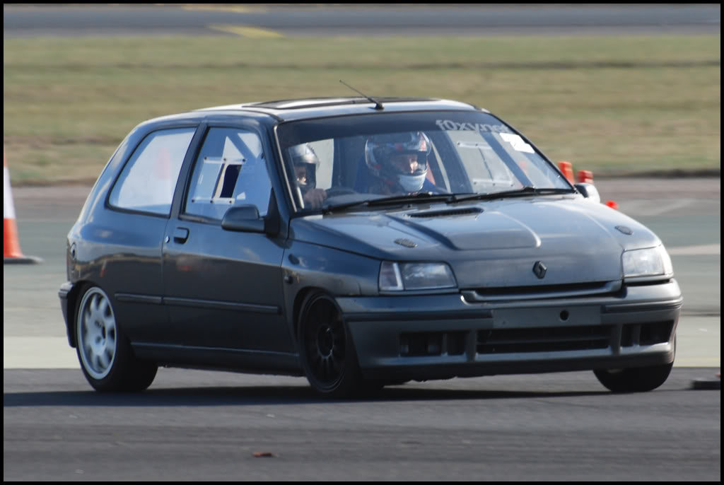

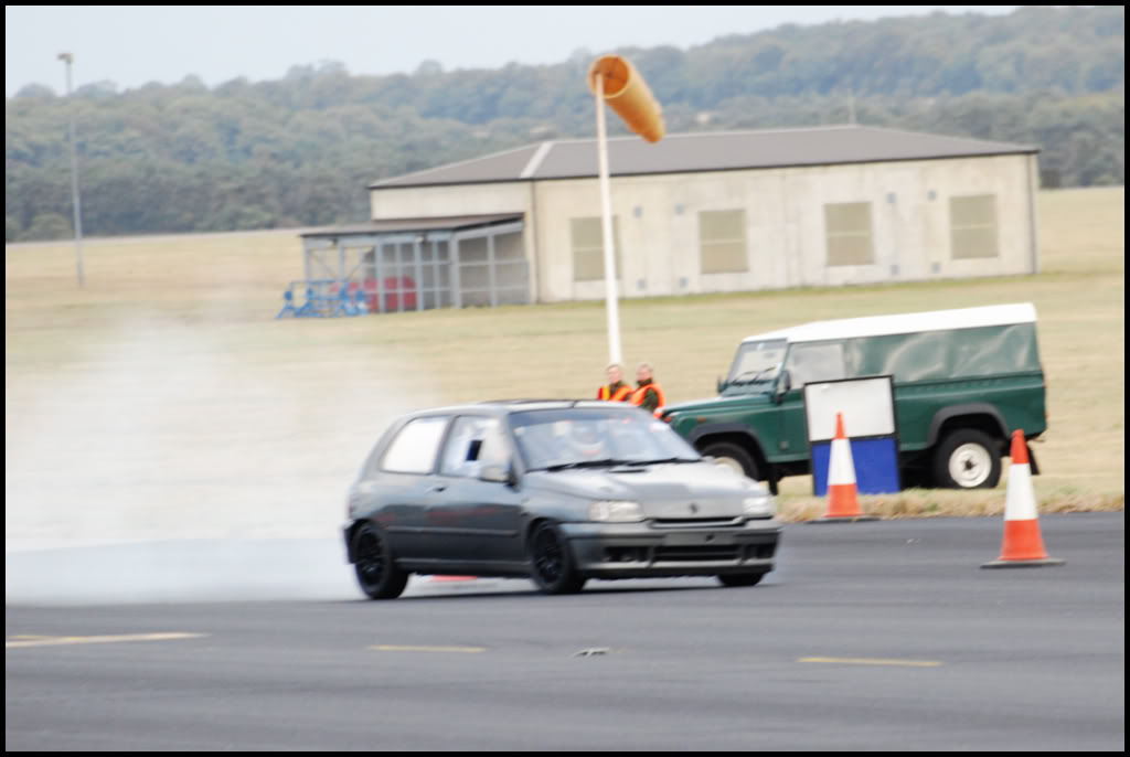

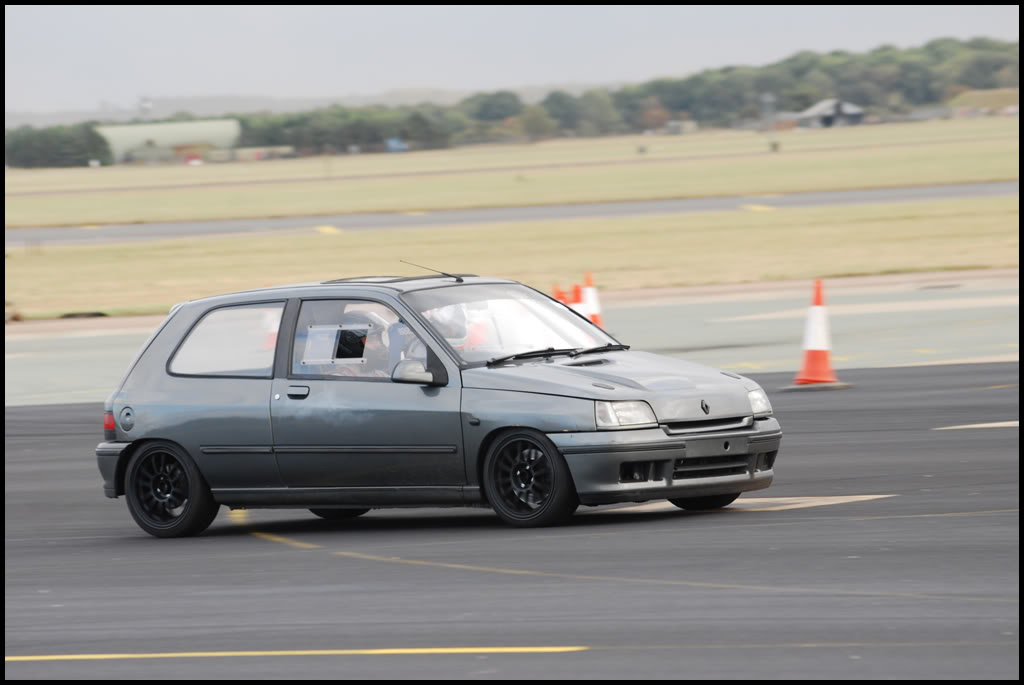

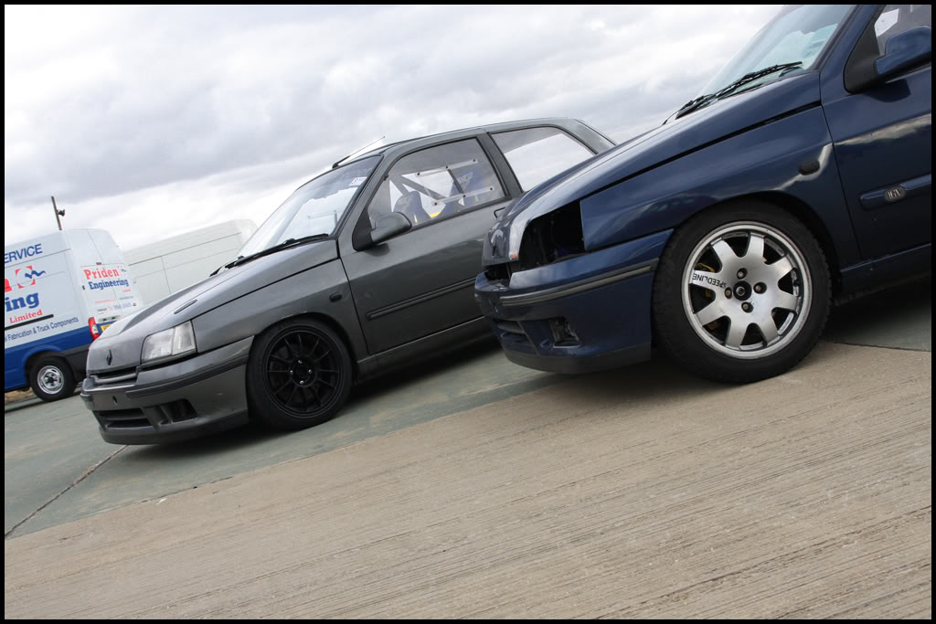

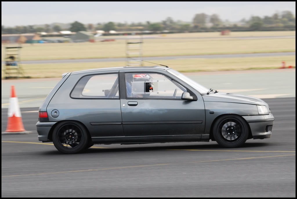

As said, no real problems at Marham, so not much else to update. Few pictures and videos below :)
Couple from where we were staying...
Few on track...
Here are my favourite bits from Saturday...

Cracking videos!
Those tires are well gone!
Do you take two sets with you?
Or just a spare 2 for the fronts?
I usually take another set, the williams wheels are just road wheels now to get to and from places, and the Superleggeras for track :)
