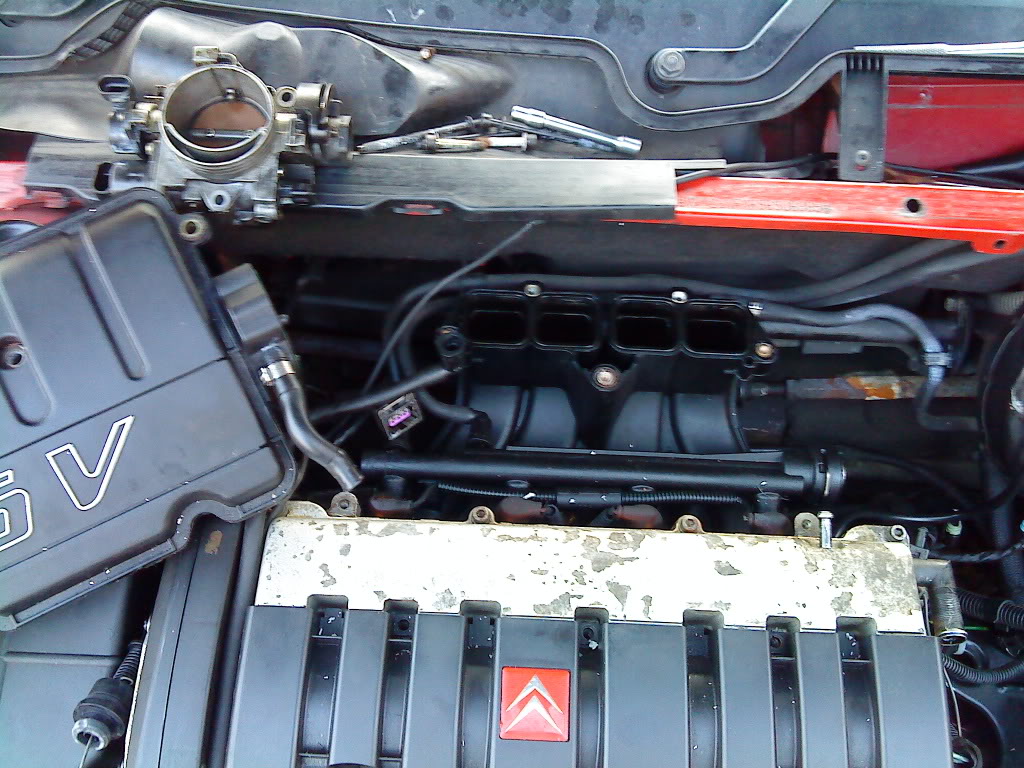

Right, started to take bits off last night to gte better access to the rack. It's right behind the inlet manifold which was a b**ch mother to get off as everything is in a stupily awkward place!
Either way, struggled on and it came off in the end!
Plenum, throttle body and all relevant wiring removed...

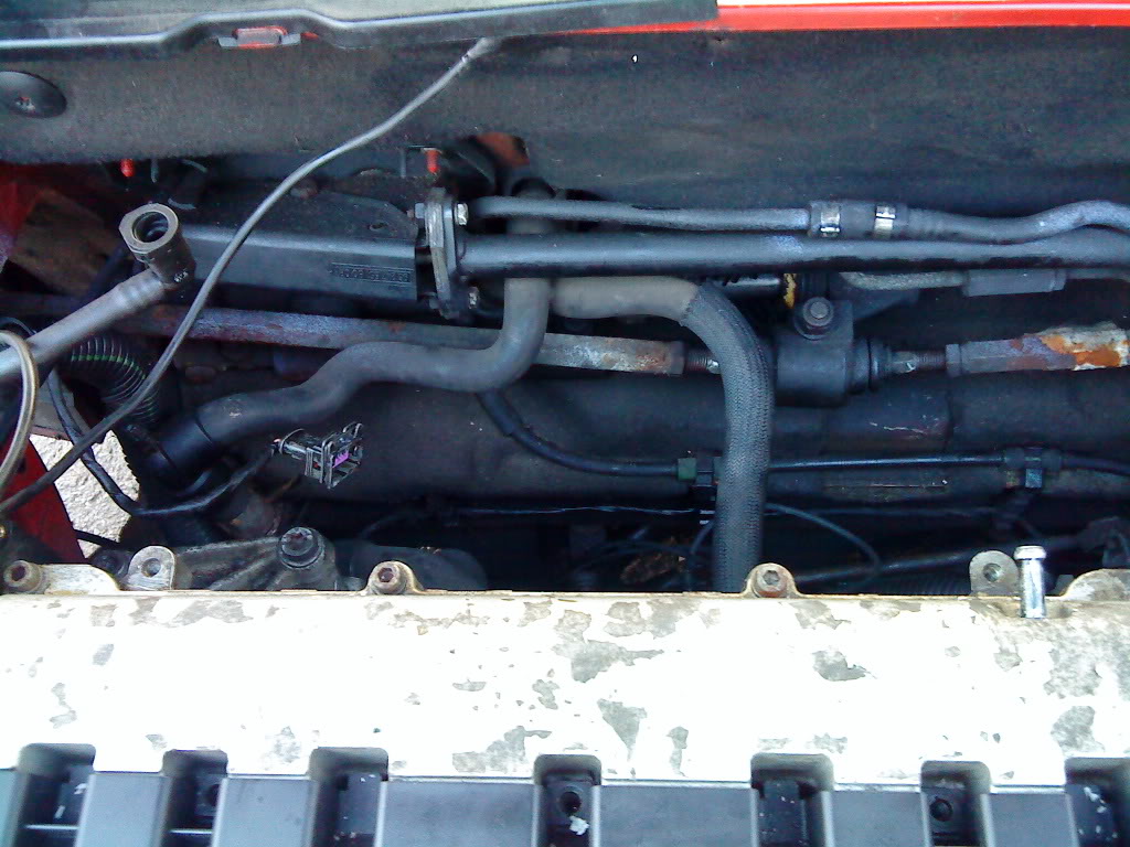

Inlet manifold, injectors and fuel rail removed leaving the rack exposed!

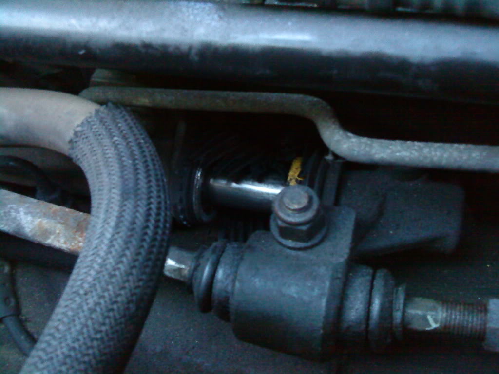

This is where most of the movement is coming from and where I "think" the knocking sound is coming from!
Took the track rod ends off the struts just but didn't take any pics, need to go and get a torx bit set as the rack uses T50's and mines snapped :(.
Hopefully be all back together and knock free later!
