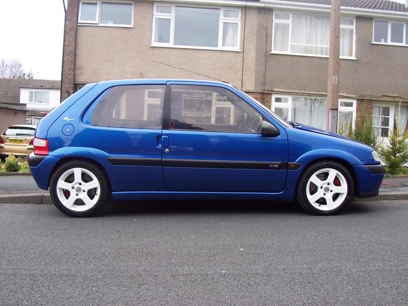

Itll be less noticeable with VTR wheels on I think. Its only 10mm or so but its bugging me :(

Everything is straight underneath! Seen a few that are like it from pics so I dunno mate. Inner wings are straight. It's had a wing and bumper as the bottom crossmember is bent but you could blow on it and it'd bend....

My passenger wheel sits like that, had a look at a few on on Sax-P and most of them have a wheel that sits back. I'll put it down to s**t build quality!

Yep! I've looked at about a hundred now on Sax-P and over 80% are like it! Gotta love the french, lol....

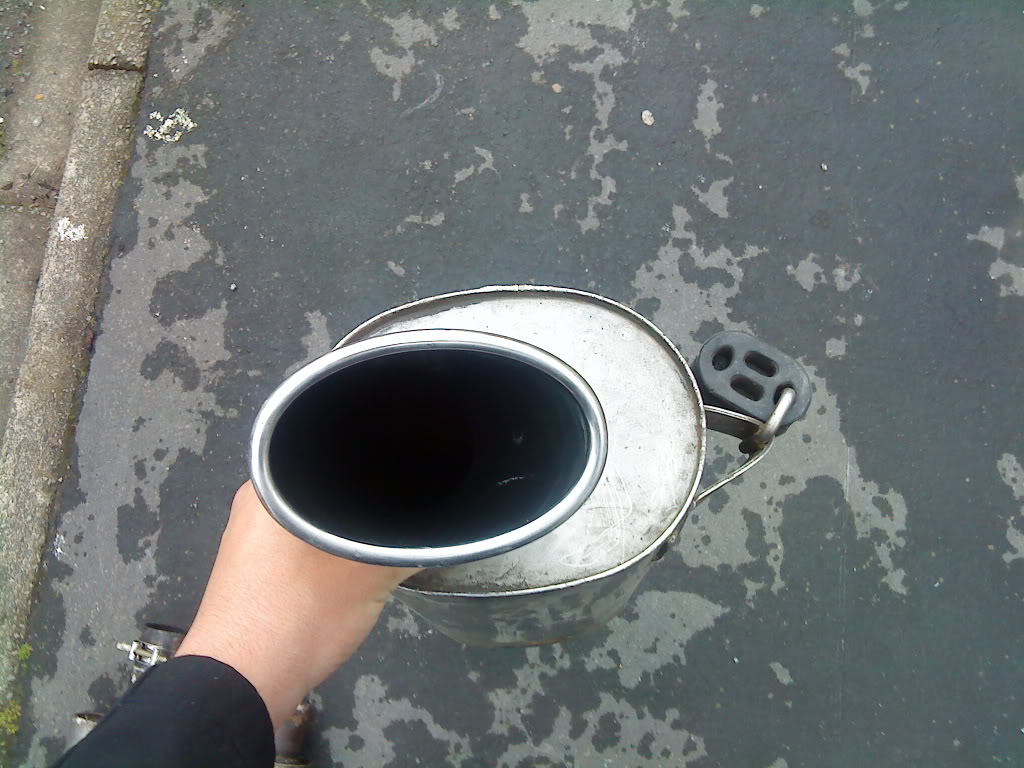

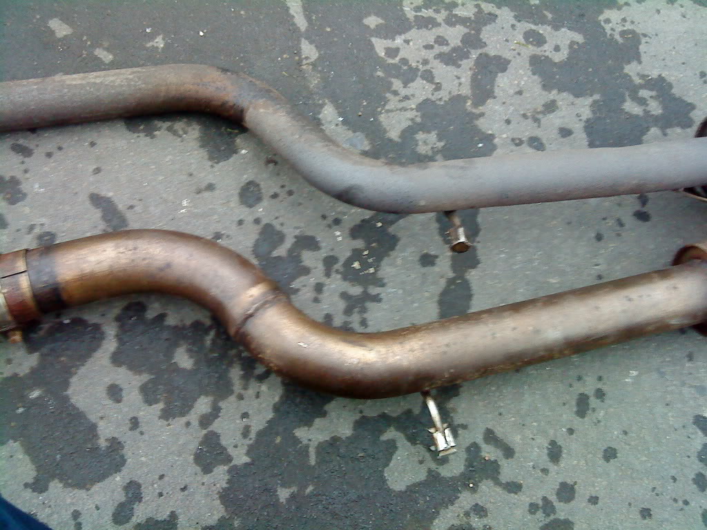

Took the Janspeed off then got offered to go to the pub for a Guiness. I'll finish it in a bit!

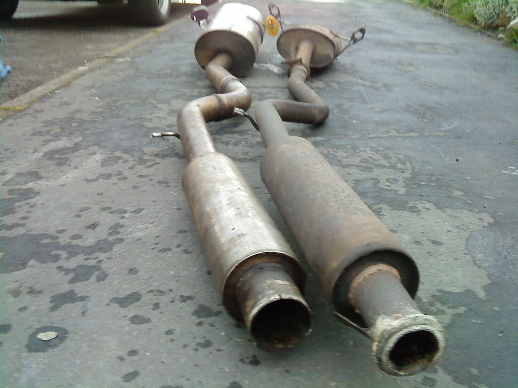

Few comparison pics.....
Cat to centre section joint (Havent taken a picture of the BTB silenced cat)
Tail pipe whorage....

Put the BTB on. What a bag of horse s**t, lol. Split weld and it sagged so it sat about 3" off the ground. So took it back off and put the Janspeed back on for now. Getting the coins back for the BTB tommorrow so I'll use that for tyres and a rear axle as the one on the car has play in the trailing arms.

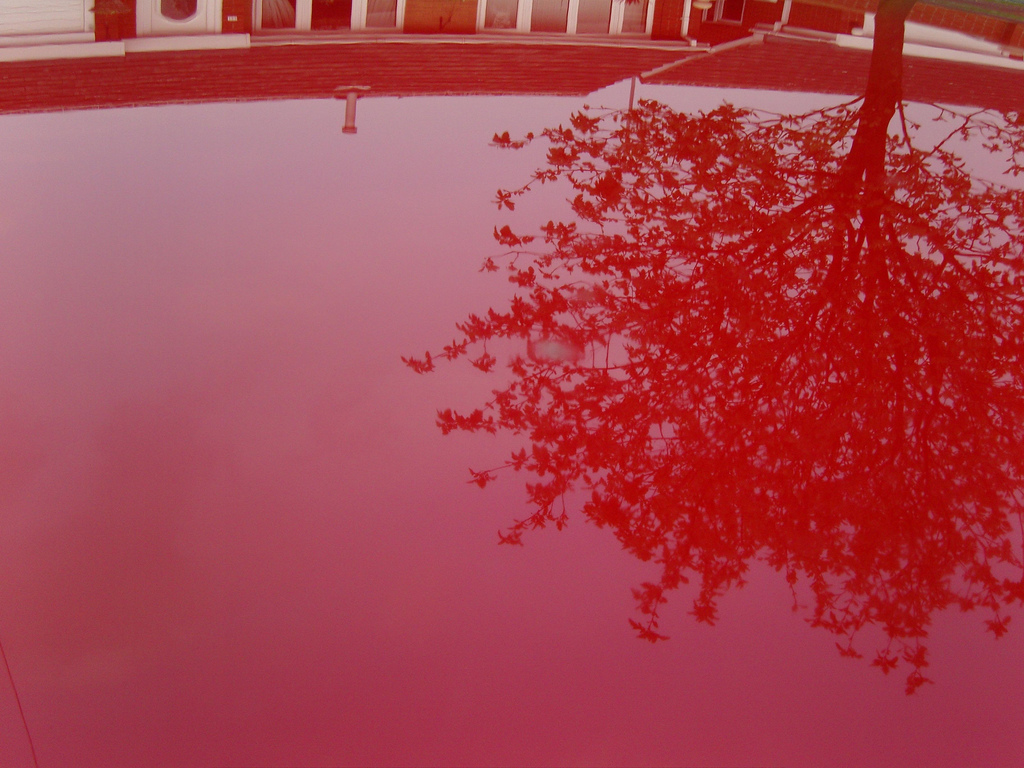

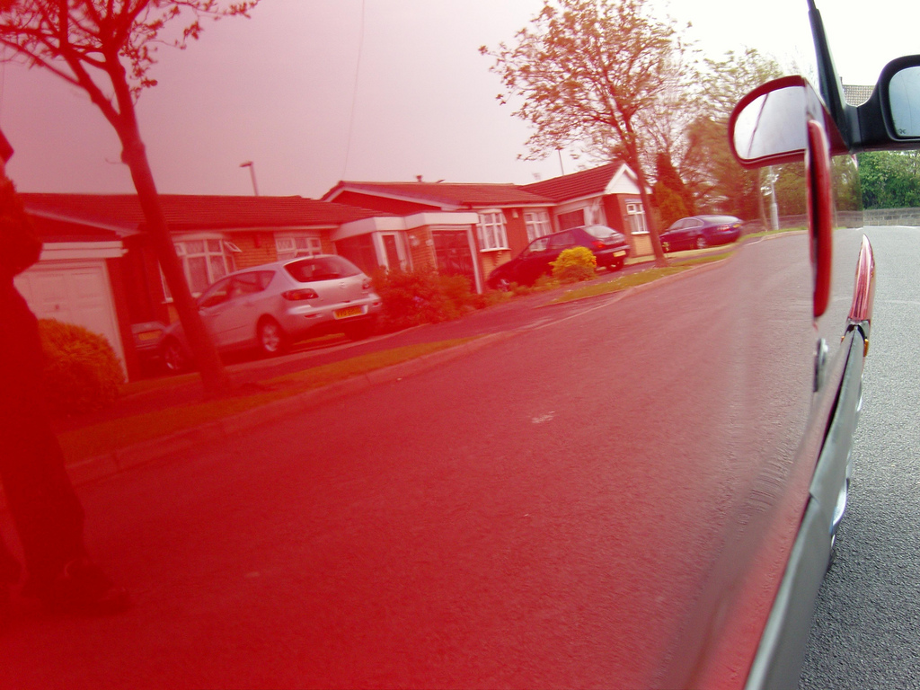

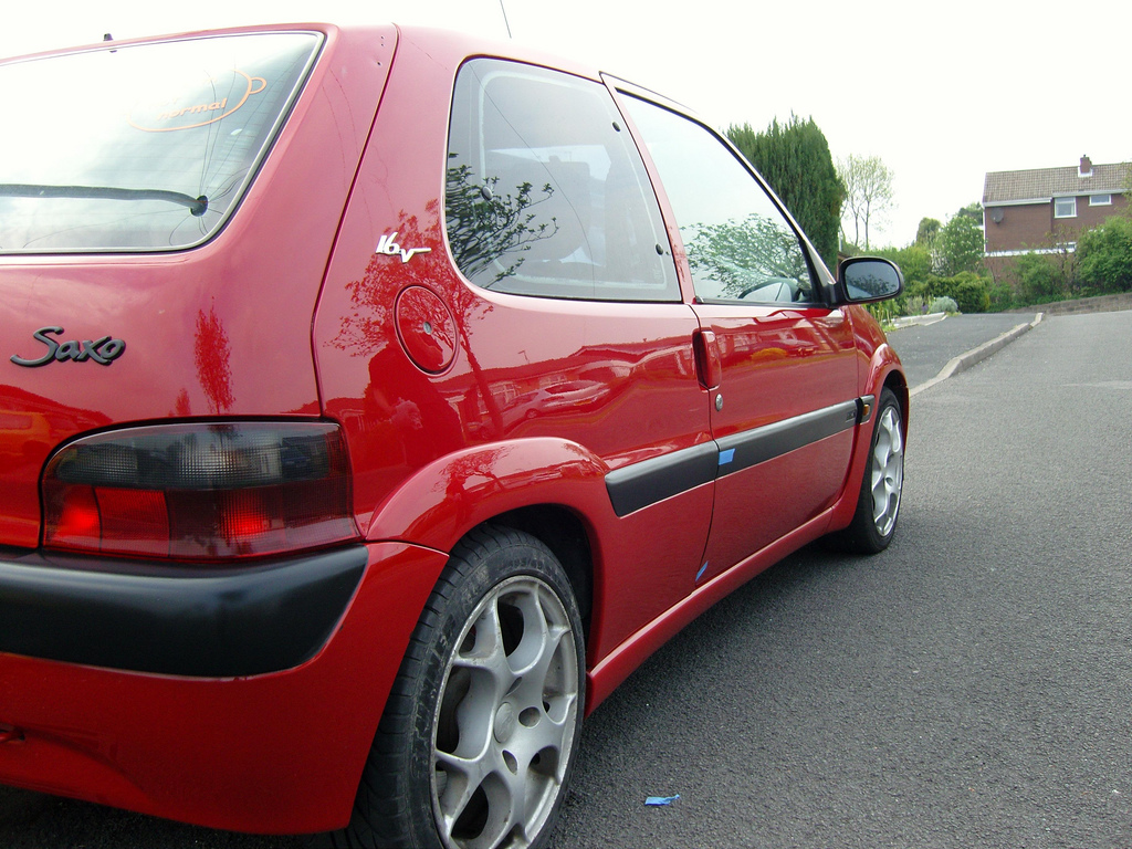

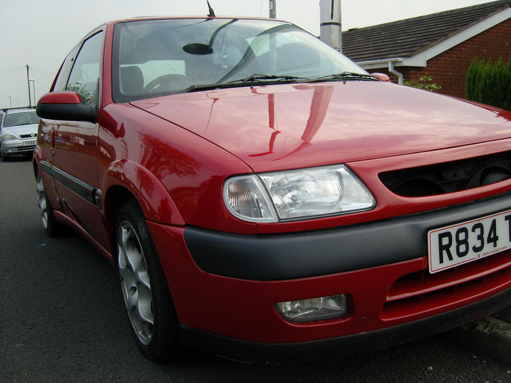

Reet, bit of an update! Middo gave the car a quick go over with the PC, looks a thousand times better, big thanks to him! Will get some pics up in a sec....

before anybody says have i got any before pics. i havent, as i really wasnt expecting to get any results from it lol
ended up wetsanding it alot more than i initially expected, and polishing the entire thing with a compound 4'' head and menz IP 3.02. then as time was pressing went straight to vics collectors wax. however when dave has filled up all the scratches we can wet sand again before finally refinishing the paint with some final / megs 80.
looks like it came up really well!! how did the bonnet come up, LOL?

Cheers mate, really did come up well!! Ready to be done again when the bonnet and wing are on ;)

Mark spent about an hour TBH, he was pissing about otherwise ;)

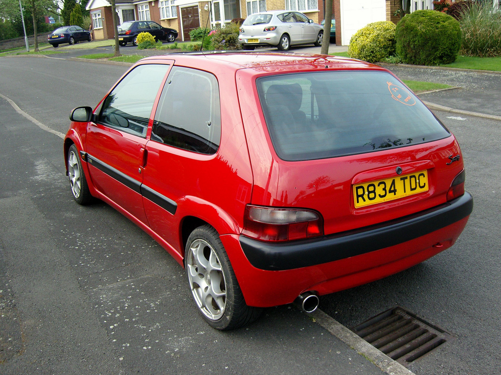

Wet sanded some heavy scracthing, Menzerna by PC and then topped with Victoria wax by hand. Some chip stick action, more wet sanding and a full on PCing is needed when I put the new bonnet and wing on though!
