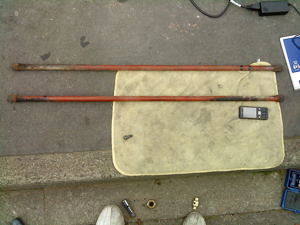

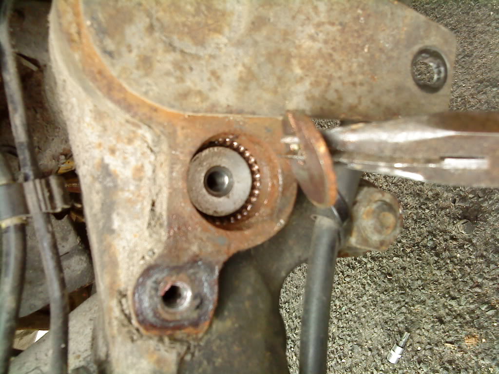

Been pretty busy over the last few days after Matt told me I could come to Donny for his Fast Car shoot and have a mooch on track. So, the new axle was on but as it was a standard height the car looked gay with the H+R springs 30mm's on the front. I'd put off lowering the torsion bar as I know it is a ballache at the best of times. Cracked on with it today, they more or less fell out, lol. Piece of piss! Few pics of them.....
Anti-roll bar plat off and the ARB spun round to get acces to the end of the torsion bar-
Both of them out in under 10 minutes!

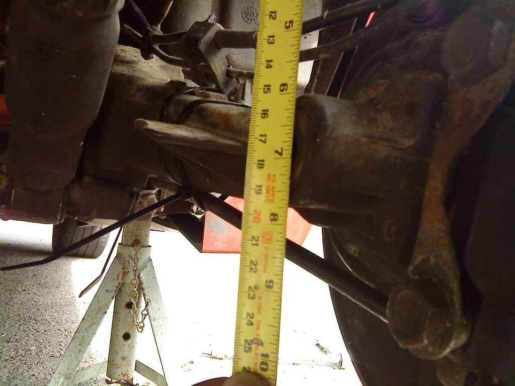

Original height of the stub axle to body was 225mm, I wanted to lower it 45mm so I jacked the arm upto 175mm (Leaving 5mm for the beam to sag back down again under its own weight once the jack is moved) and whacked the bars back in both sides with some copper grease on the splines..
Bolted all the torsion bars back in, ARB plates back on and double checked everything. Put the wheel back on and voila!

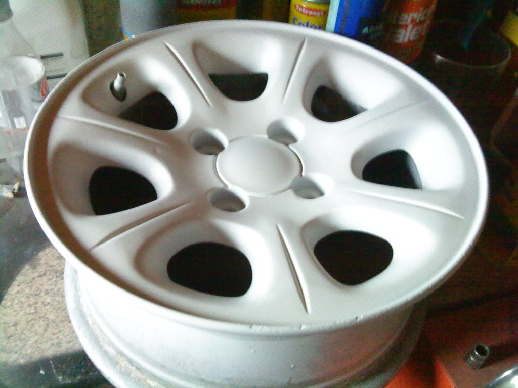

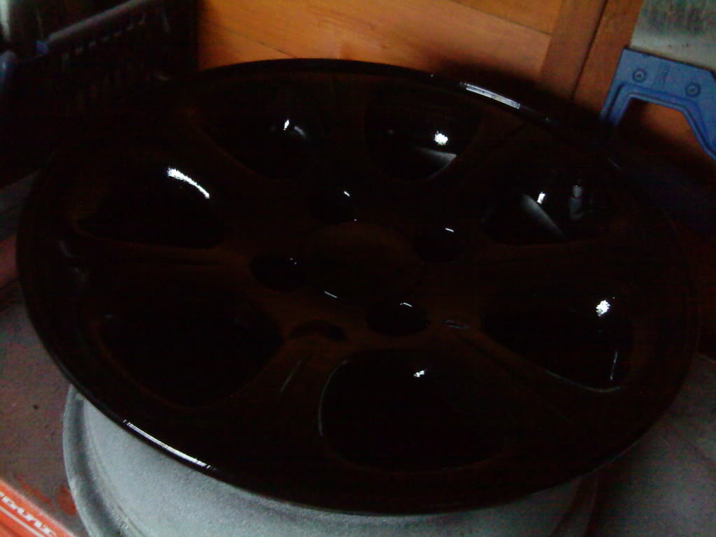

I bought some VTR wheels abit ago with shagged tyres and a fair bit of corrosion on the wheels themself. So I give them a quick rub down and primer before the gloss black coat..
Then a coat of gloss black. Not a very good picture but it'll do...
The wheels now have new tyres on but I need to source some wheel bolts before tommorrow, lol. Get some pics of the whole car at Donny tommorrow with them fitted. Not a brilliant refurb but for 3 hours work, I'm not particulaly bothered! I'll give them a 2000 wet and dry and polish but thats for when I have some spare time!

Took about 2 hours to sand them all and get the corrosion off as they were knackered TBH. Then about an 15 minutes to primer, 15 minutes to paint, then half hour to rub down and lacquer. Left the primer about 6 hours and the paint overnight. Its dusty as feck in the shed too so they were never going to be mint. Not bad though, the "flecks" of dust that the lacquer has picked up will come out so will be pretty good once Ive give em a wet sanding!

Not mint by a long way Gaz. About a million times closer than when I picked it up though! Honestly, torsion bars are SO easy. Dont hit em out, I used a socket and long 8mm bolt to wind them out, saves twatting the shite out of the end....

The washers came out really easy yeah, knoicked them out with a screwdriver and hammer then used some long nose pliers. Straight out, lol. It must be my technique ;)

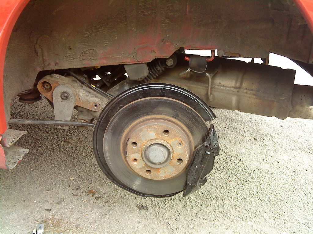

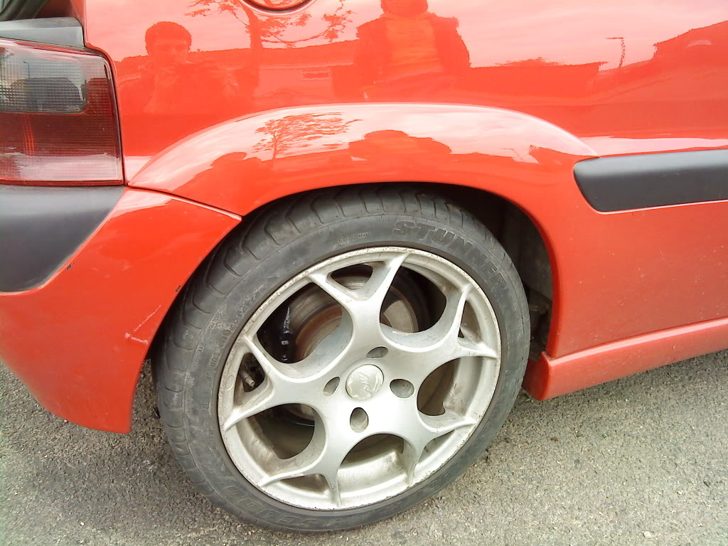

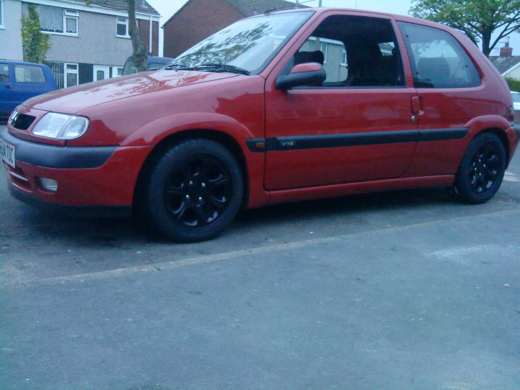

Had some new tyres fitted last week and went to get some new wheels bolts (VTR ones have to be flat heads) and put the wheels on, I bled all the brakes while each one was off aswell as they were never brilliant. Pedal feel is much better now, alot more solid! Anyway, this is what it looked like before I started.....

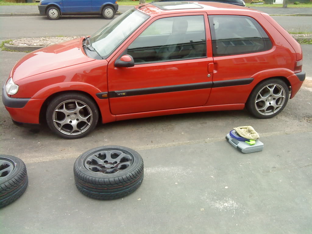

Then with the wheels on. IMO, looks a different car! Thousand times better, Although, I need to take them off again as they're not balanced properly, I watched them do it aswell. The car hates me.

Bloody hell Dave, what a difference those wheels make! Nice one!
(Resists the temptation to admit that Saxo's arent so bad....) :eek:
