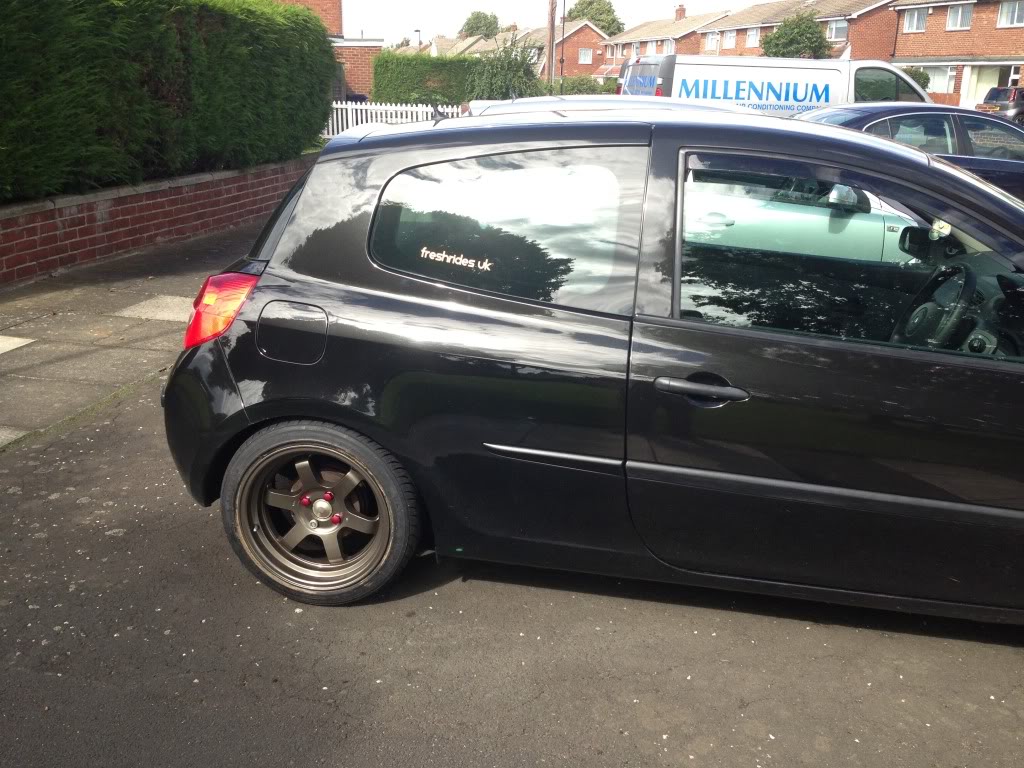

Cheeky pic of how it's sitting on the back ATM, AP spring, no adjuster, standard shock. No pic of the front cos it needs lowering more.
