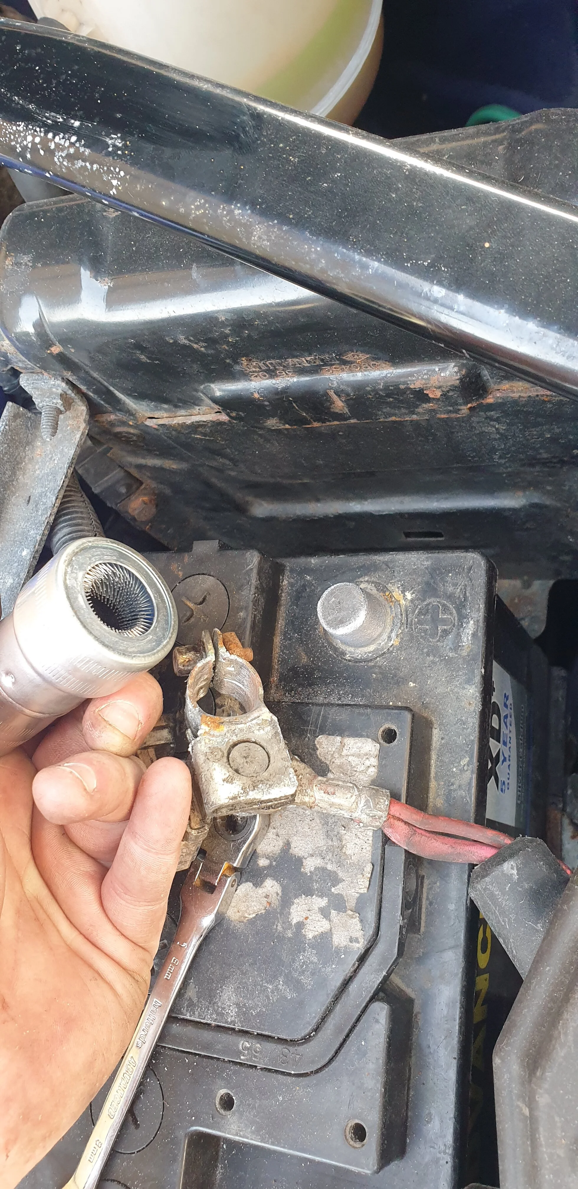

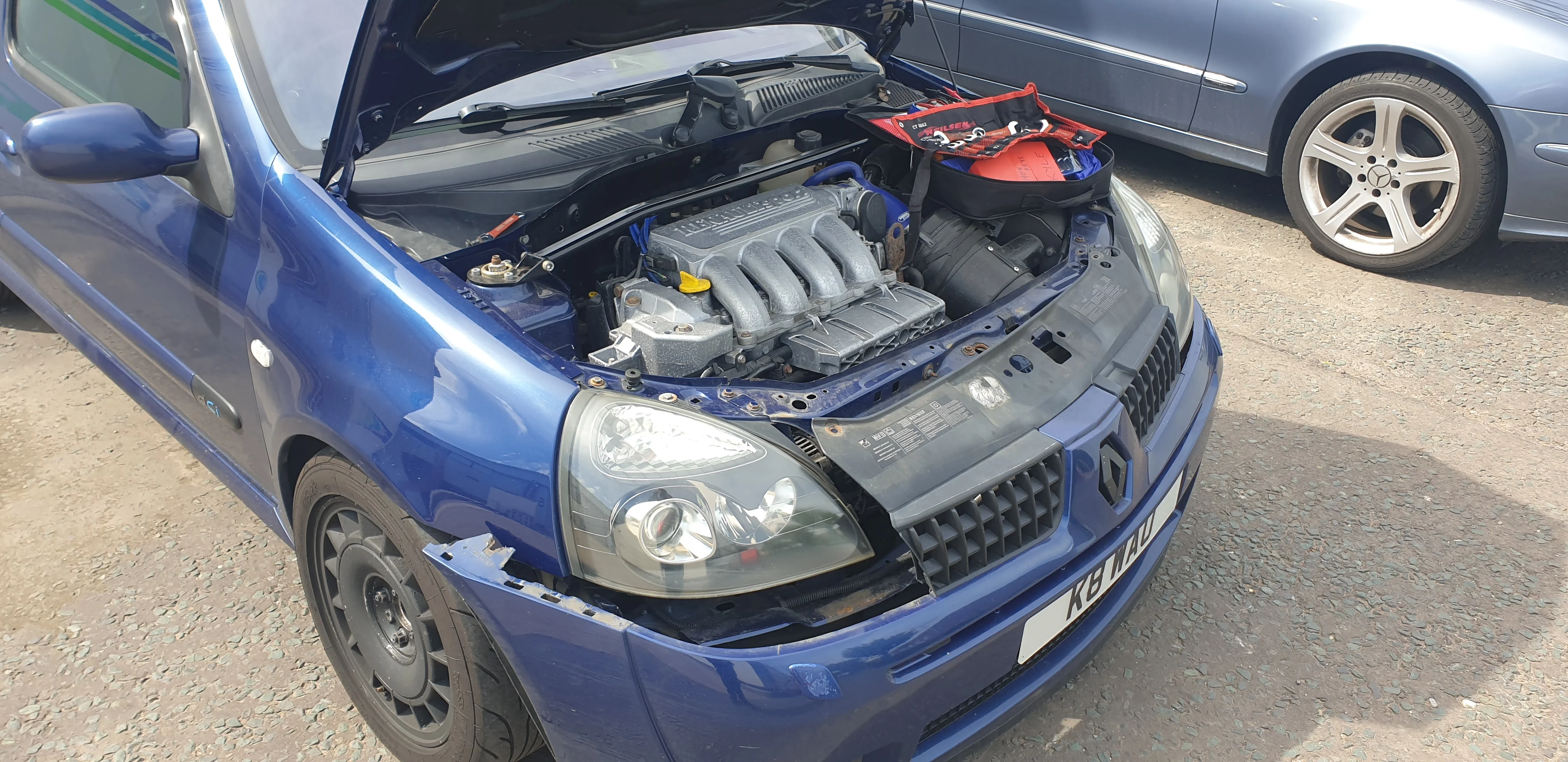

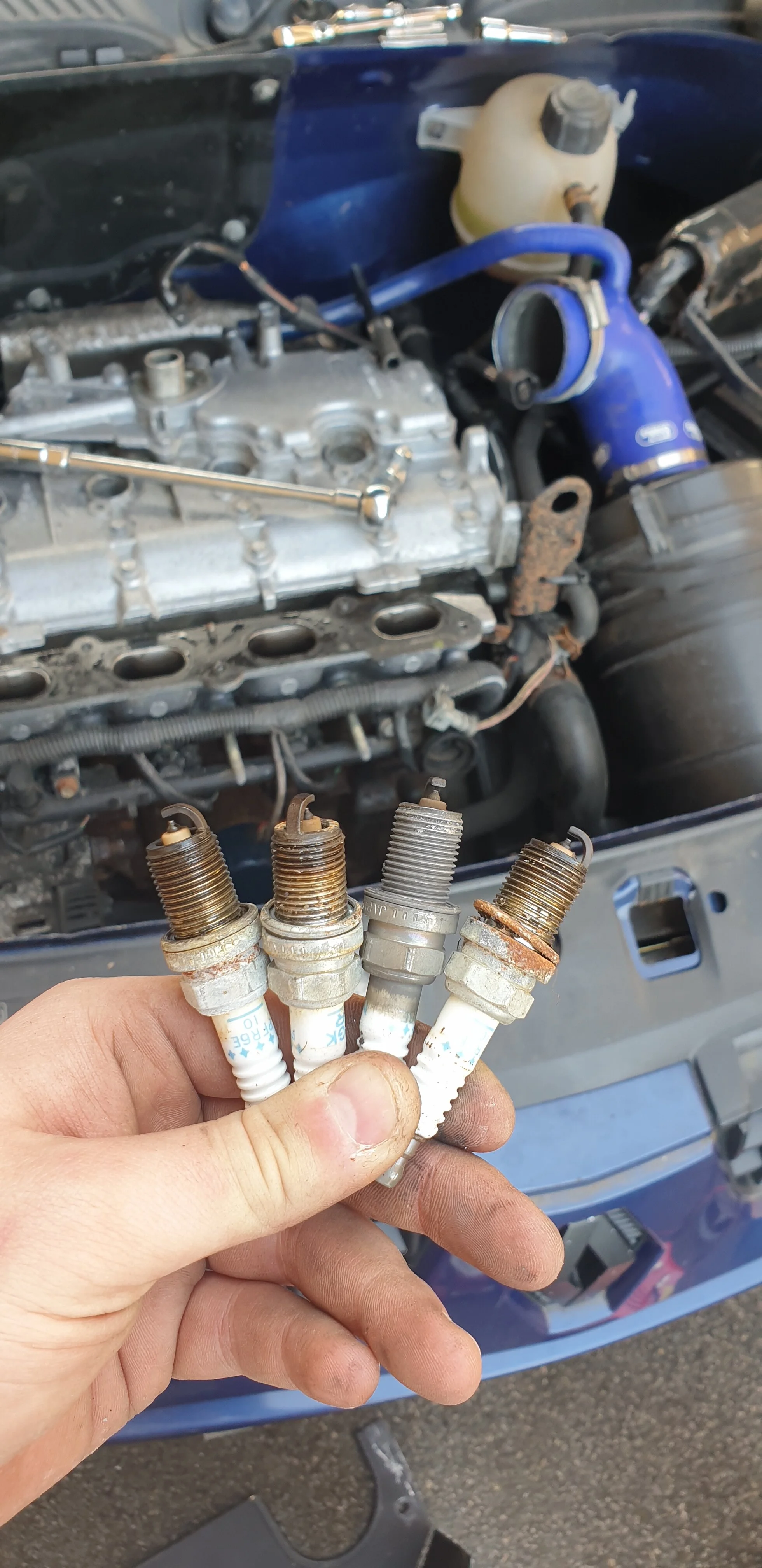

Pulled the Clio out today, battery completely flat as a witches titty

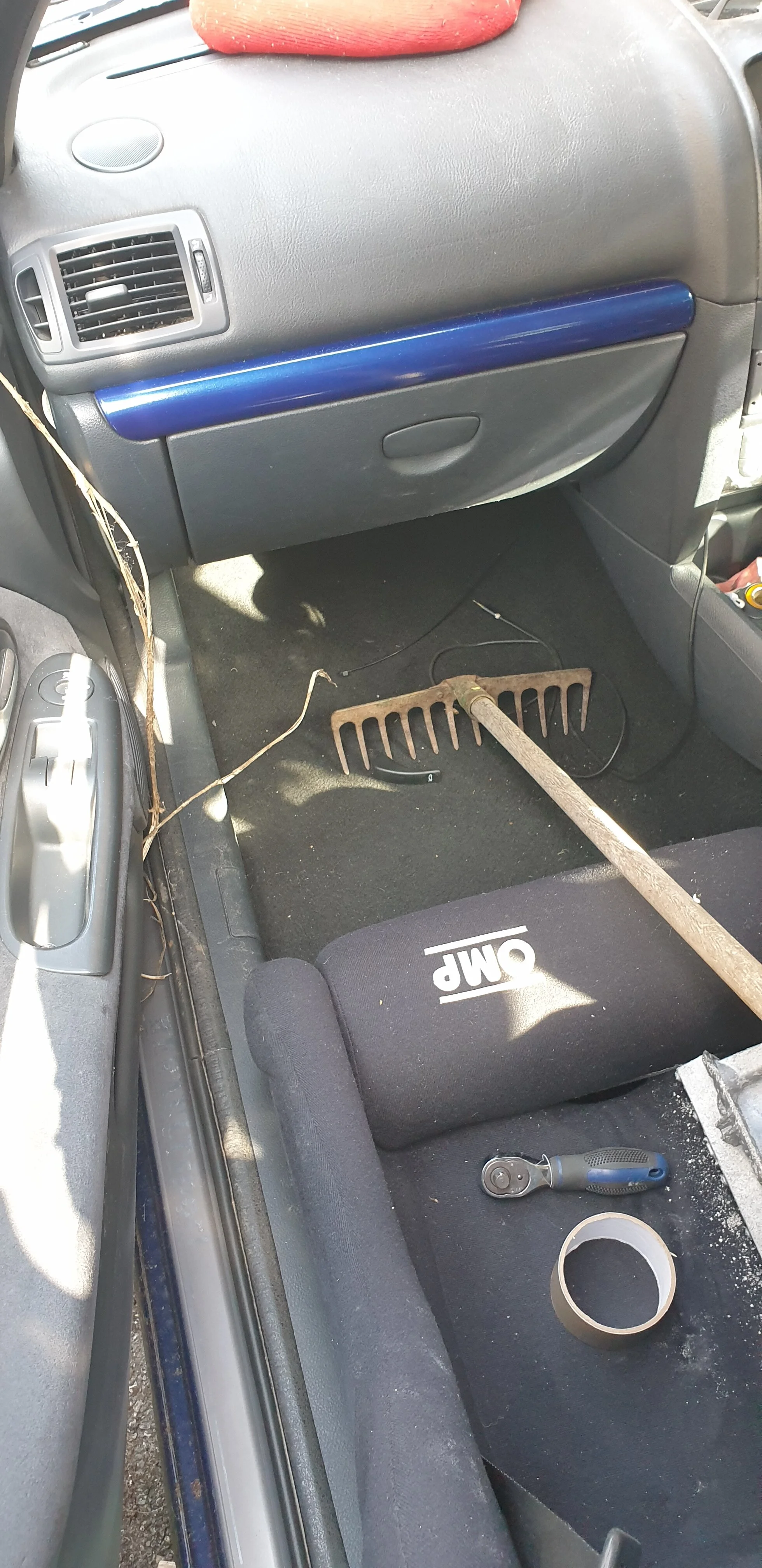

Tried to pull the bonnet with a rake because I couldn't fit in... popped the bonnet pull off🥲
So had to get my mrs to squeeze into the car (I couldn't even get my thigh in the door, perks of her losing weight)

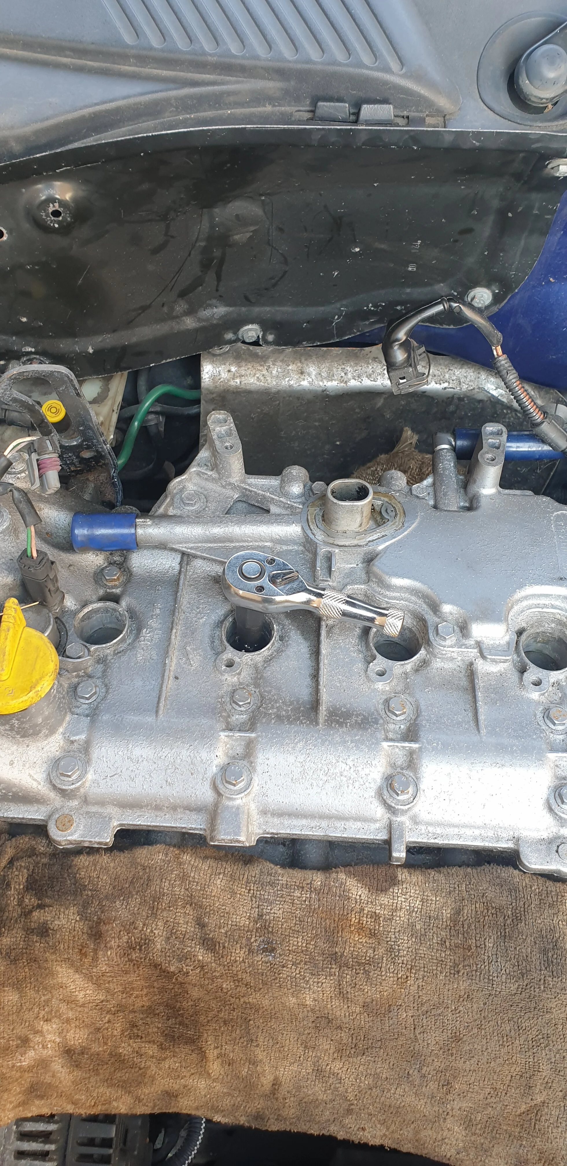

Got it on charge whilst I stripped the spark plugs out, got to use my new terminal cleaner

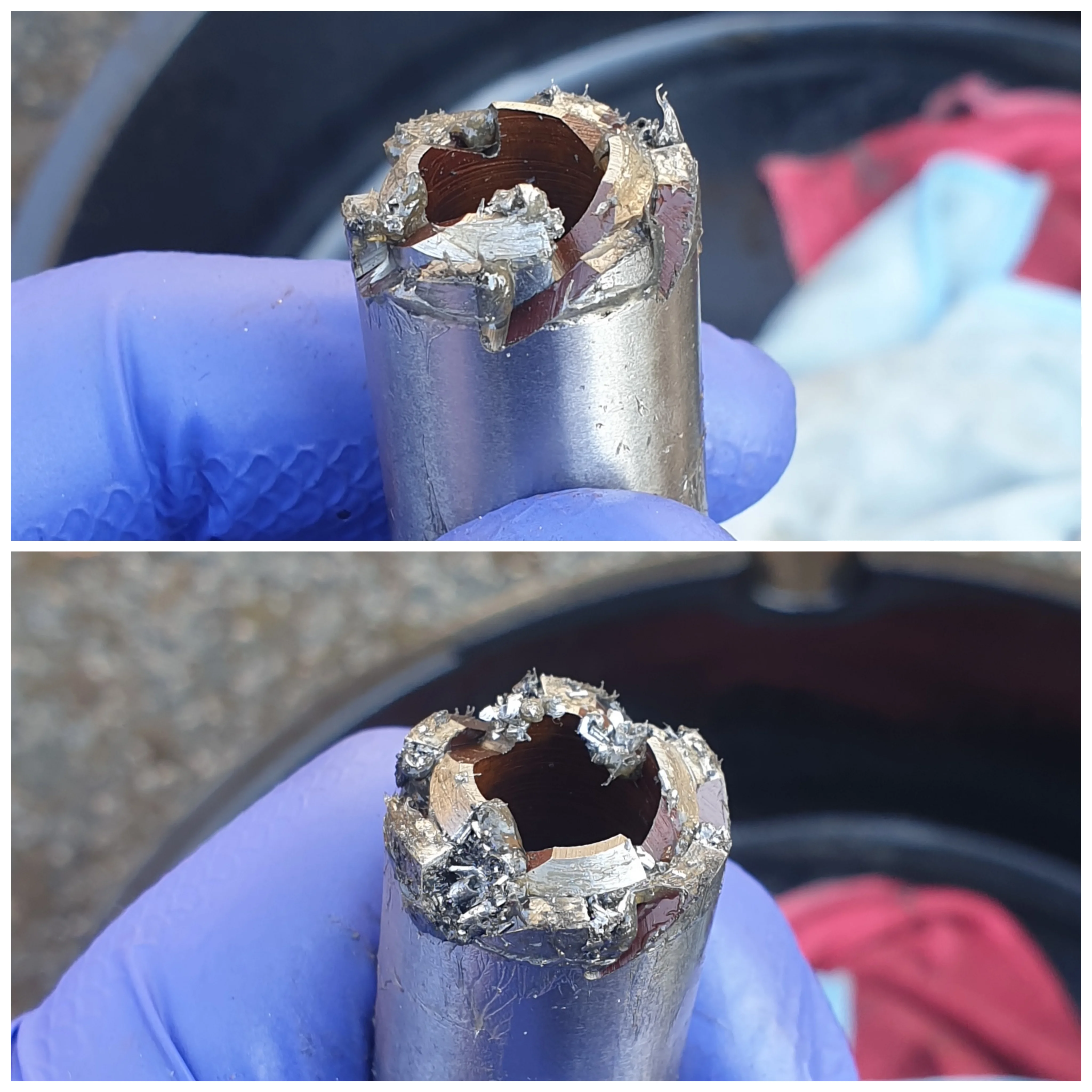

Can you tell which one got fired out of the head?🥲🙃
Few videos just to get your mind ticking over
Gonna helicoil the head for now and pick up a 197/200 engine to build up another decent NA screamer *cough* @NorthloopCup *cough*👀

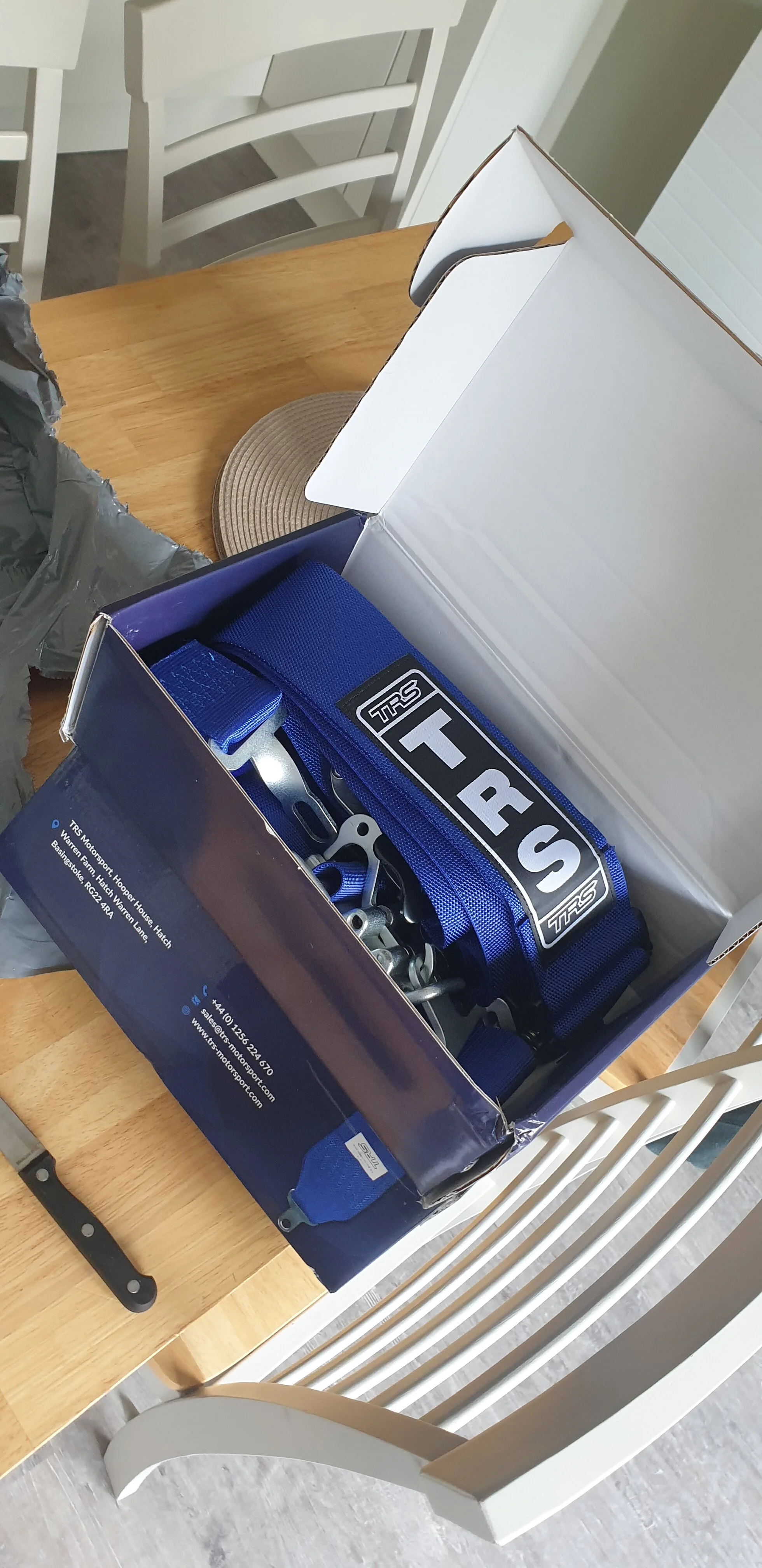

Bought some harnesses too

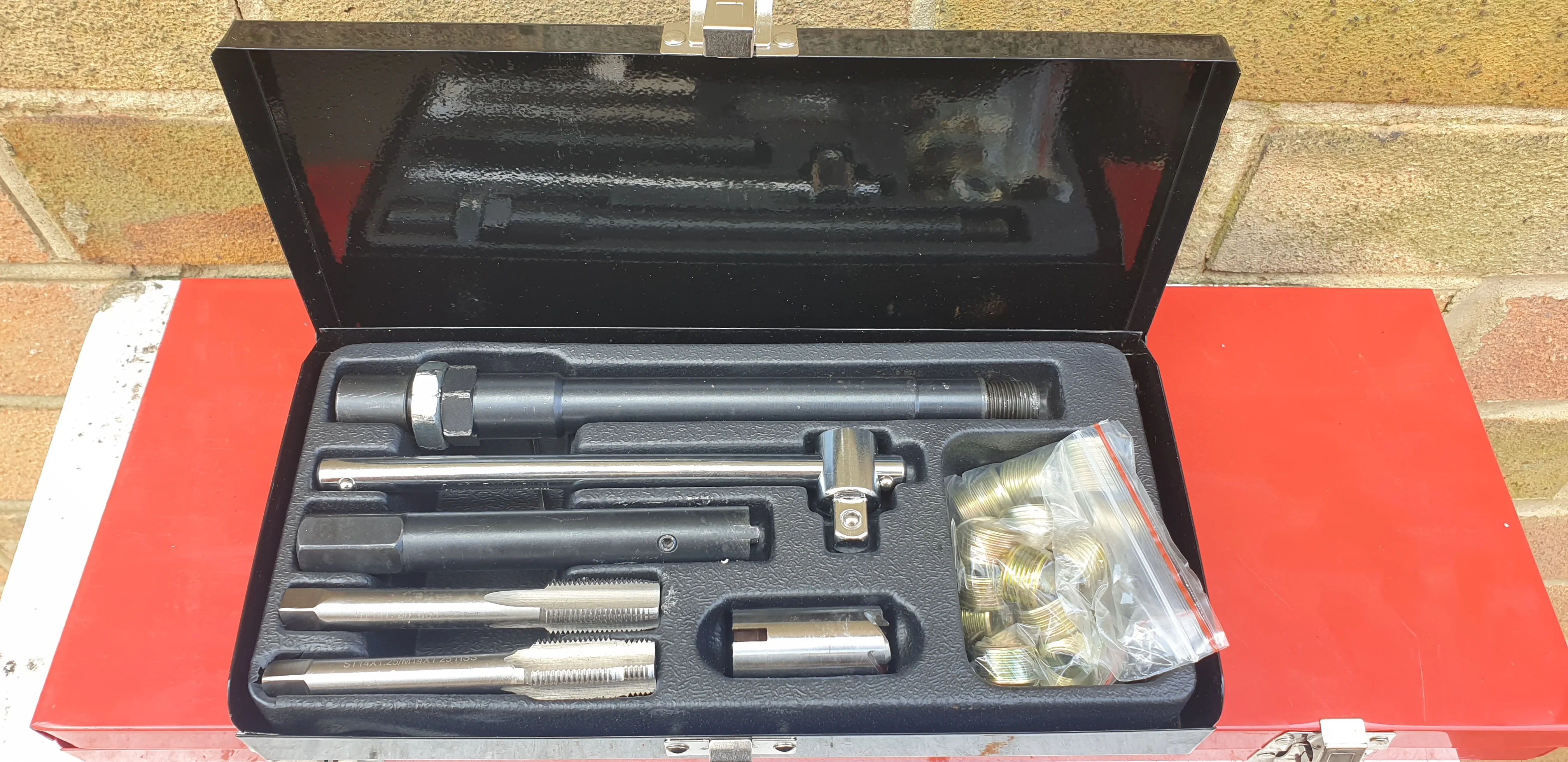

Had a day on the Clio today

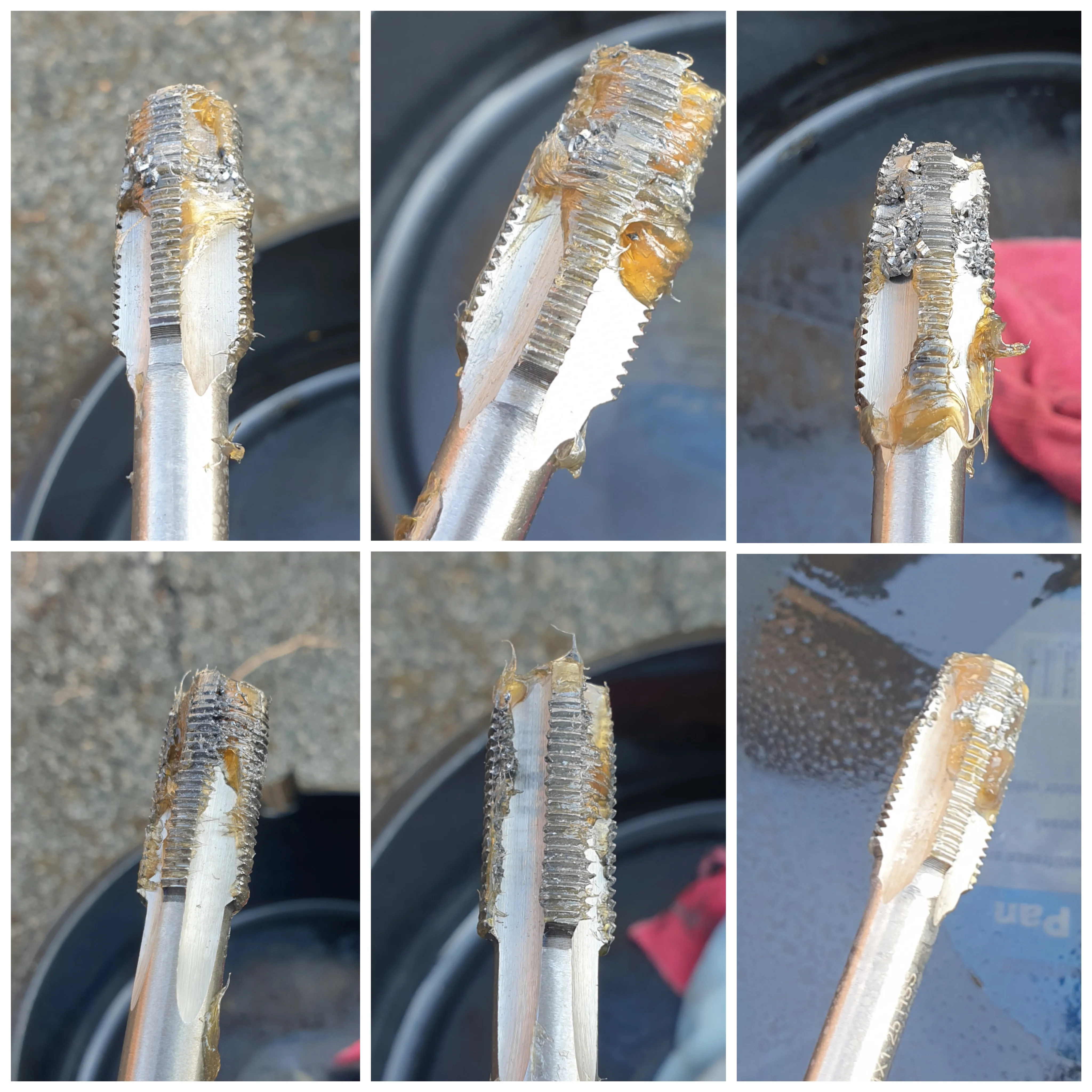

Started by tackling the spark plug threads
This is the kit I got for £40
First step is to use the M12-M14 step tap (If you have any original threads left) to centre the M14 tap which comes second

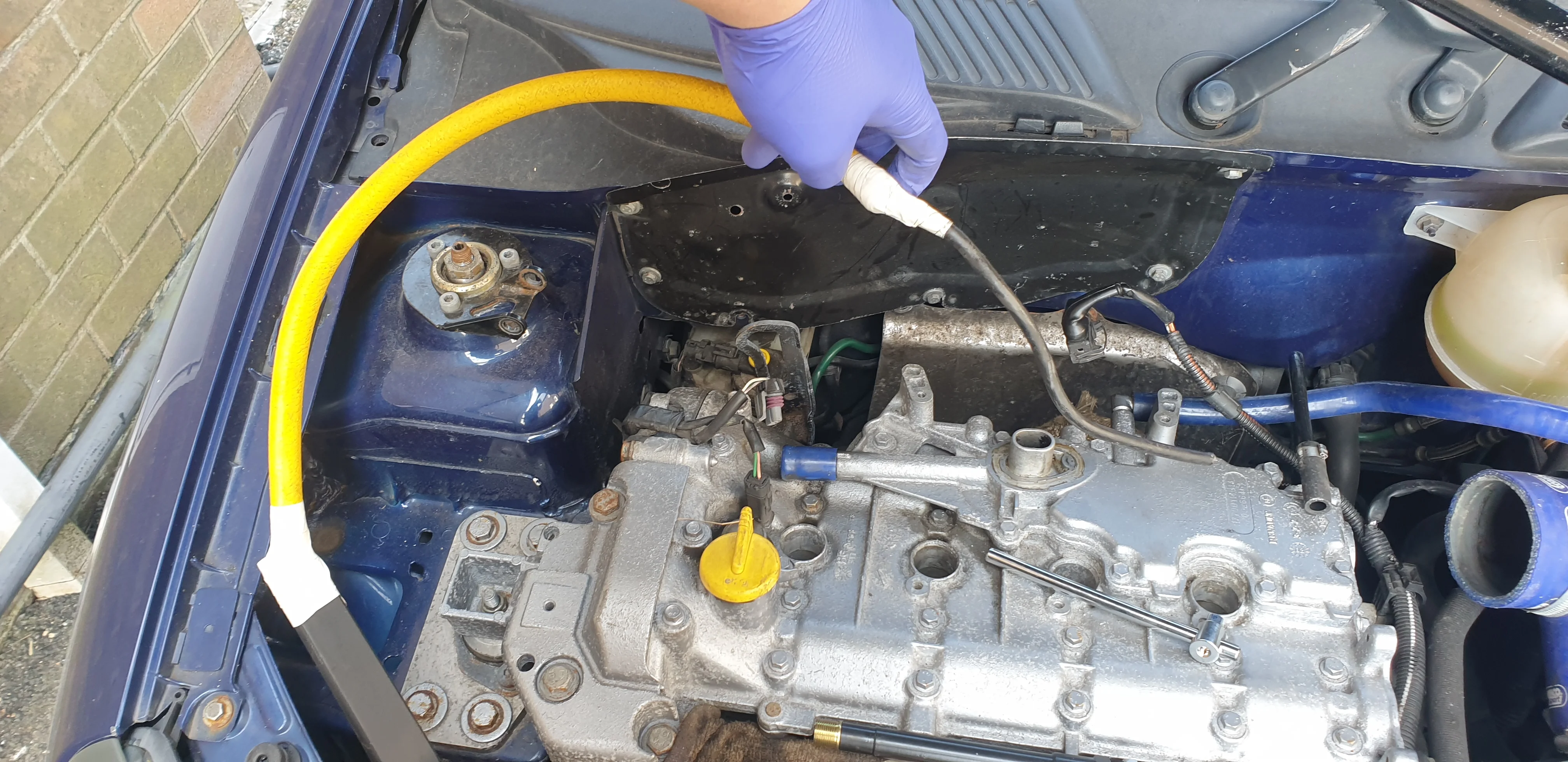

I slapped a load of grease on the threads and it caught a considerable amount of filings and chunks of the head
Same story with the seat cutter, a lot bits suspended in the grease

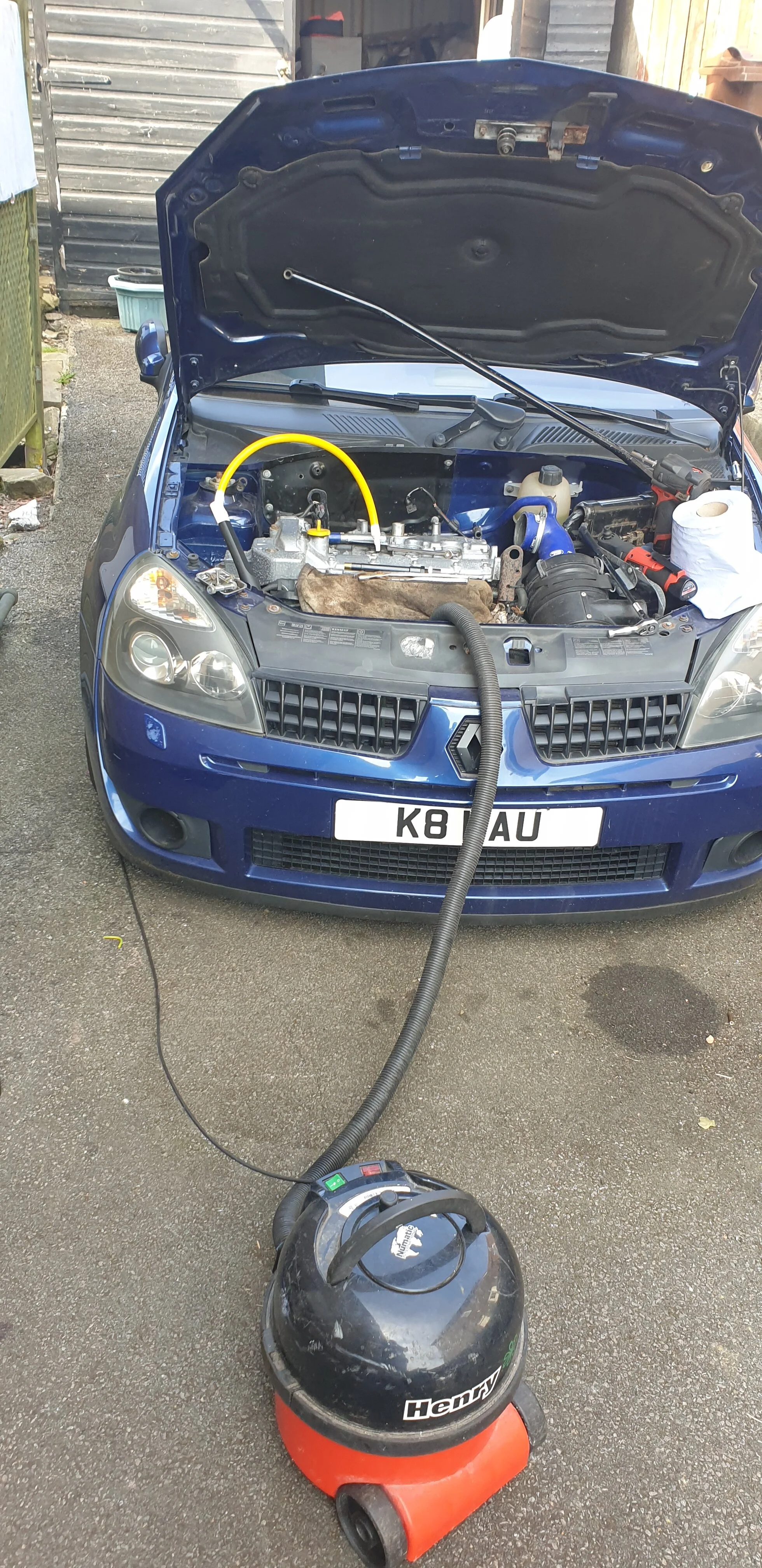

I then hoovered it out extensively and washed it with brake clean
Stuck the insert in there after chasing the threads a few times and it snugged tight. Put the old spark plug in to check for fitment and its spot on so threw the last new spark plug in there and made sure to nip them all nice and tight
Car seemed to start better and it didn't sound as 'misfirey', maybe just placebo. One thing I can guarantee was that my arsehole was well and truly f**king puckered to f**k when starting for the first time!! I'm never confident using inserts like this but just gonna send it and see how long it lasts

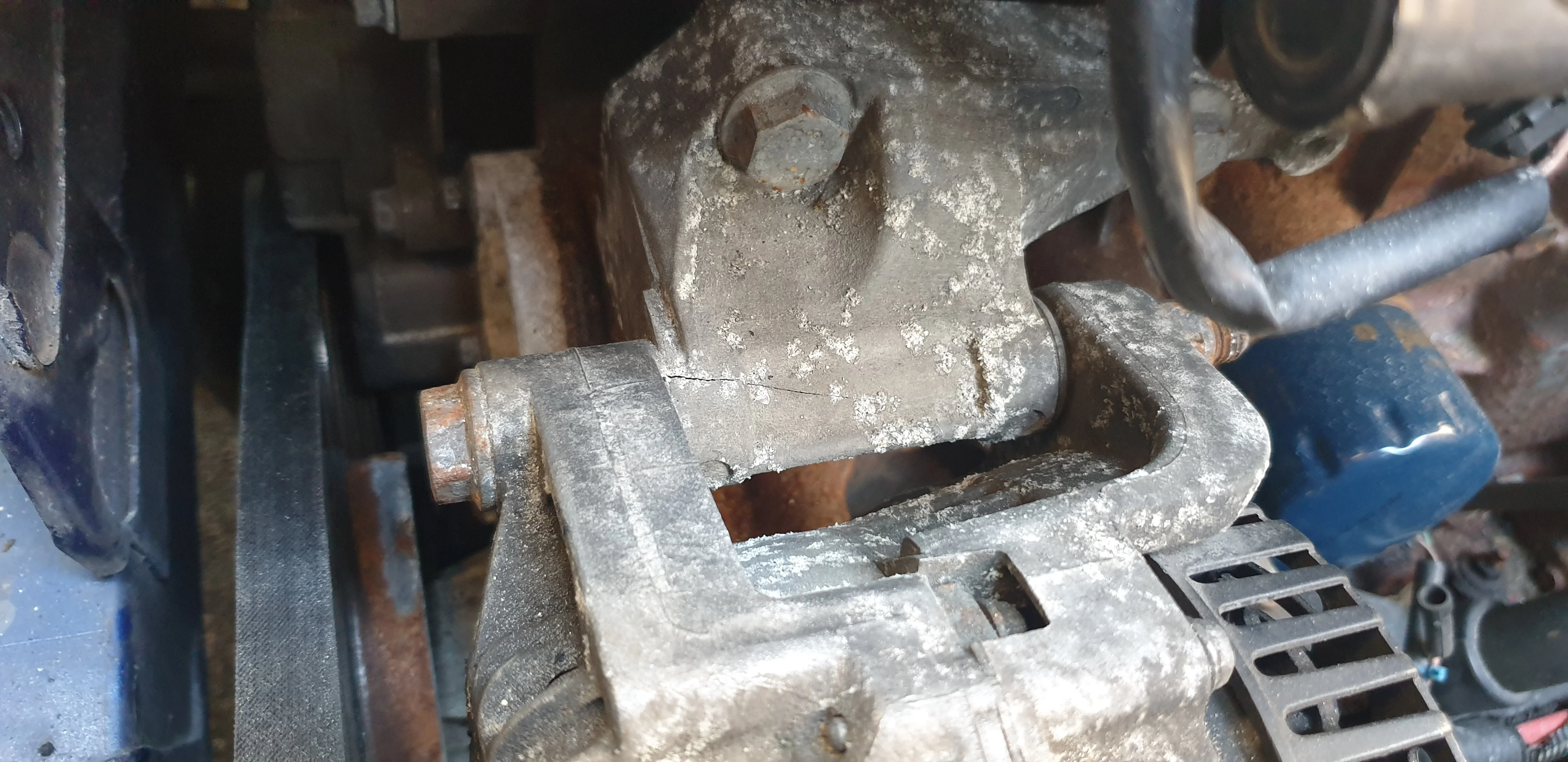

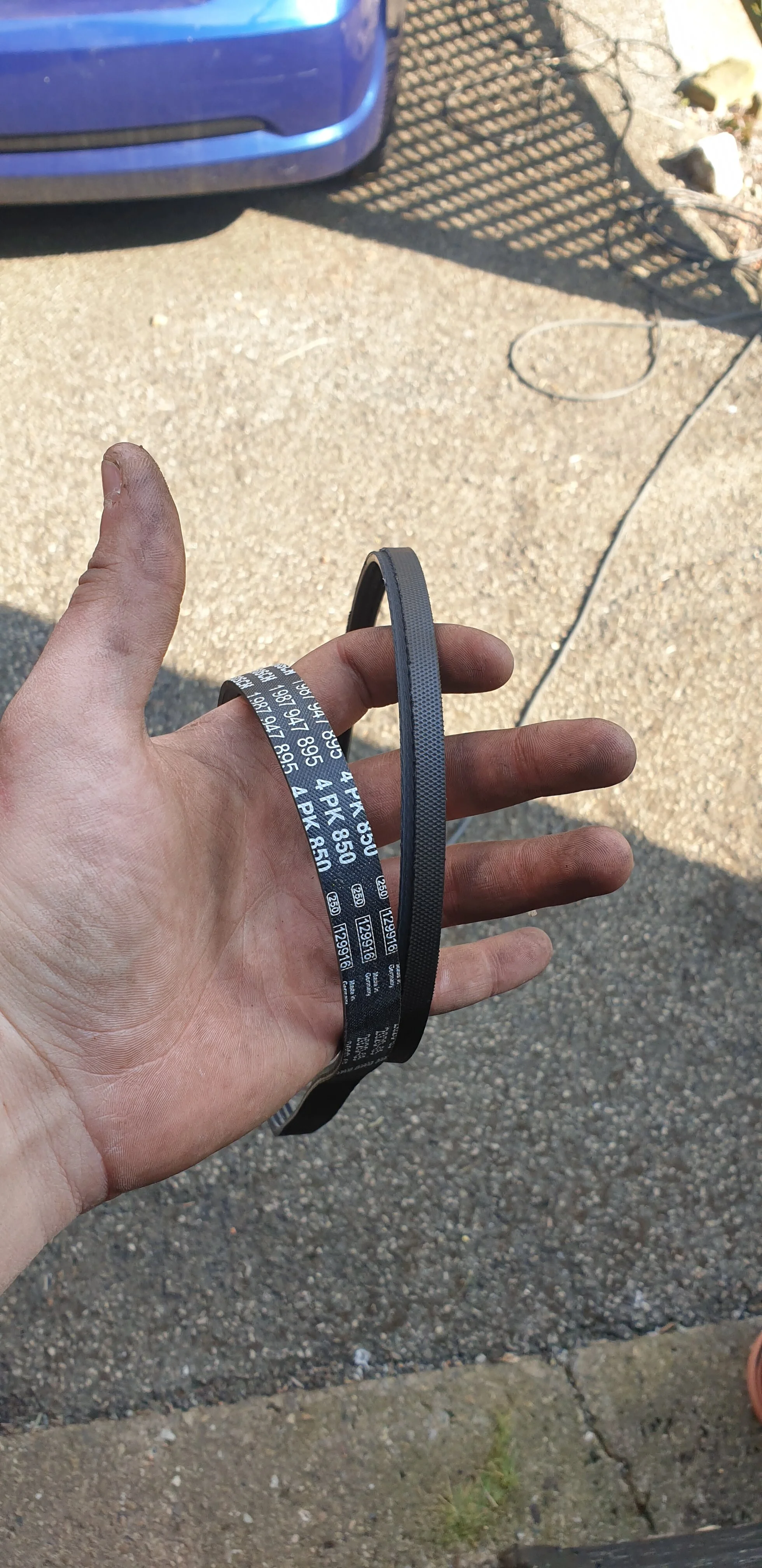

Changed the aux belt too as it was starting to fray, I pulled on the frayed part and it was deffo fucked as it kept on going😂

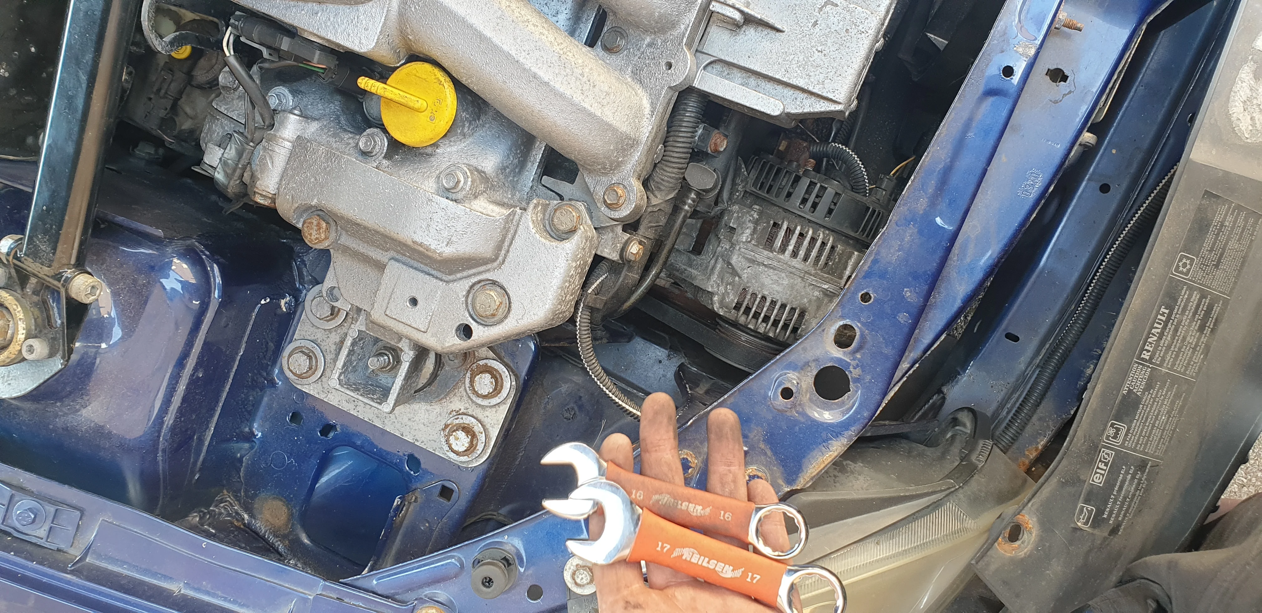

So easy to change the belt on my car though, although when doing so I noticed the alternator bracket is cracked!!🙄 Stubby spanners help getting into the manual tensioner bar

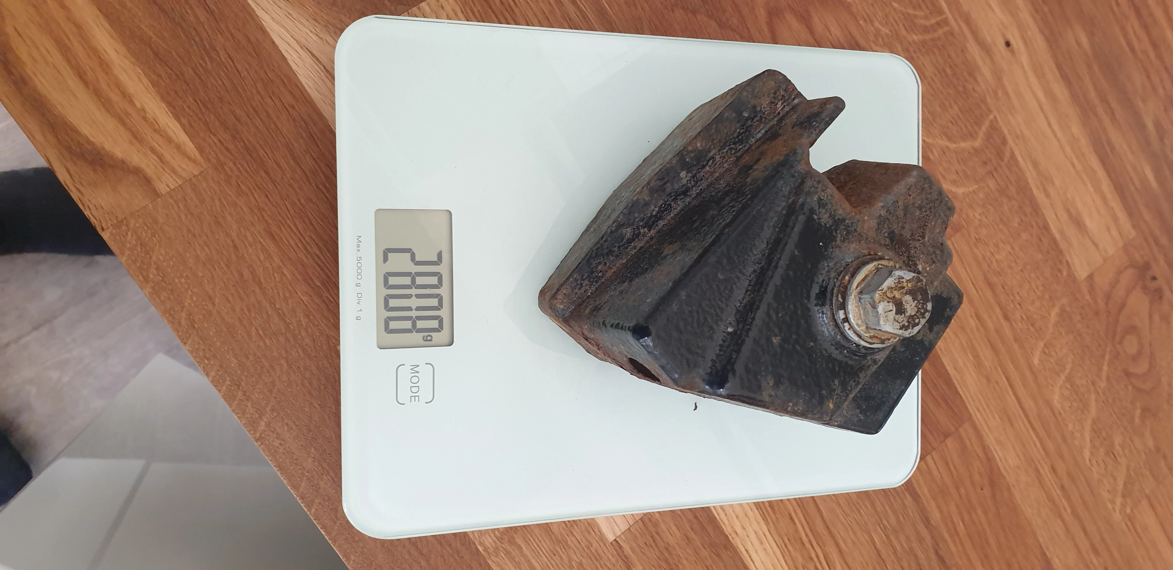

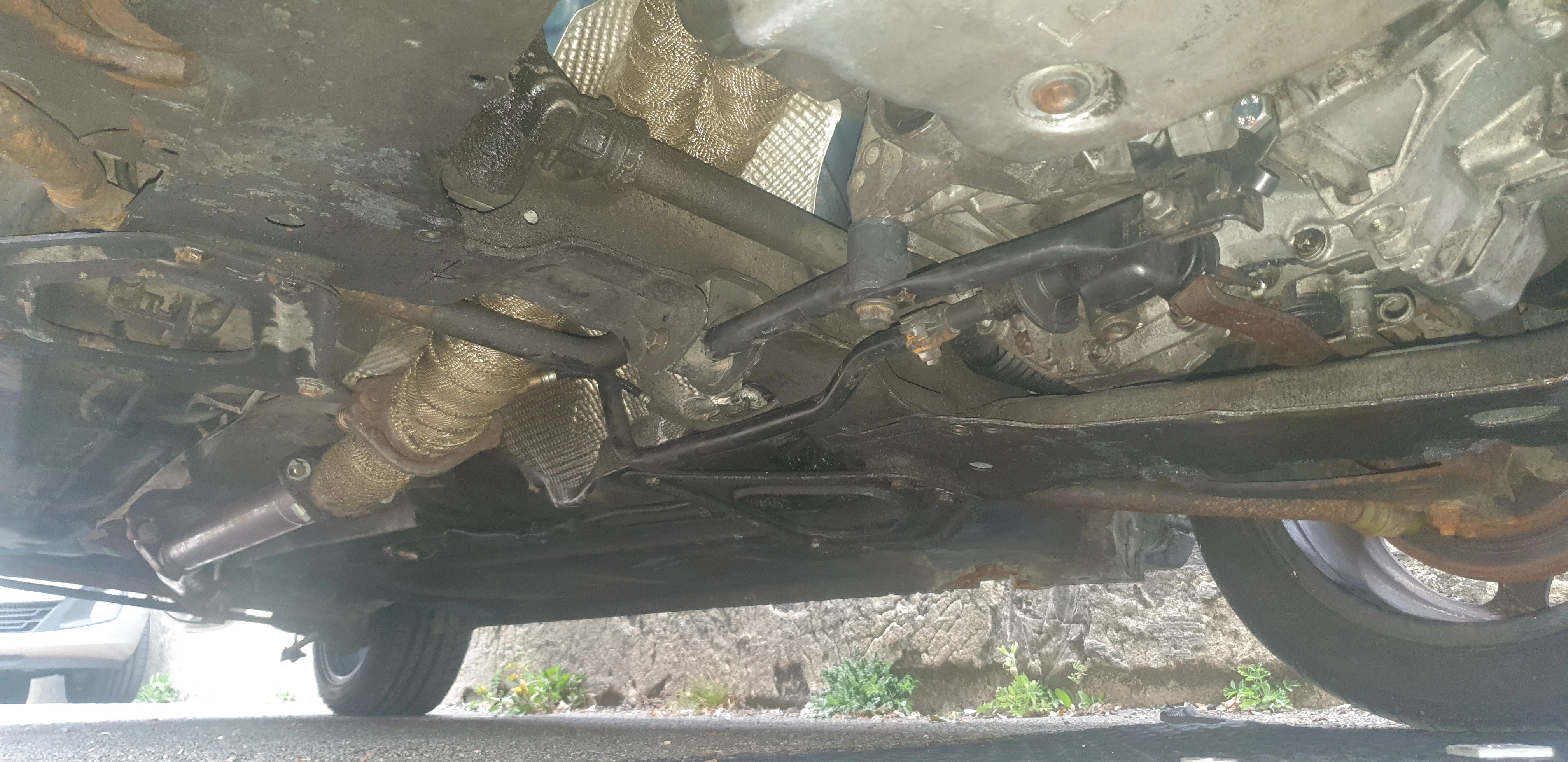

Whilst I was in that area I removed the weight from the drivers side
When doing the belt I noticed the alternator cover was flapping about as the plastic had just come loose. Theyre not held on by anything but a couple of tiny tabs on those M5 studs. 2 seconds and 2 M5 nuts later it was sured up and no longer loose

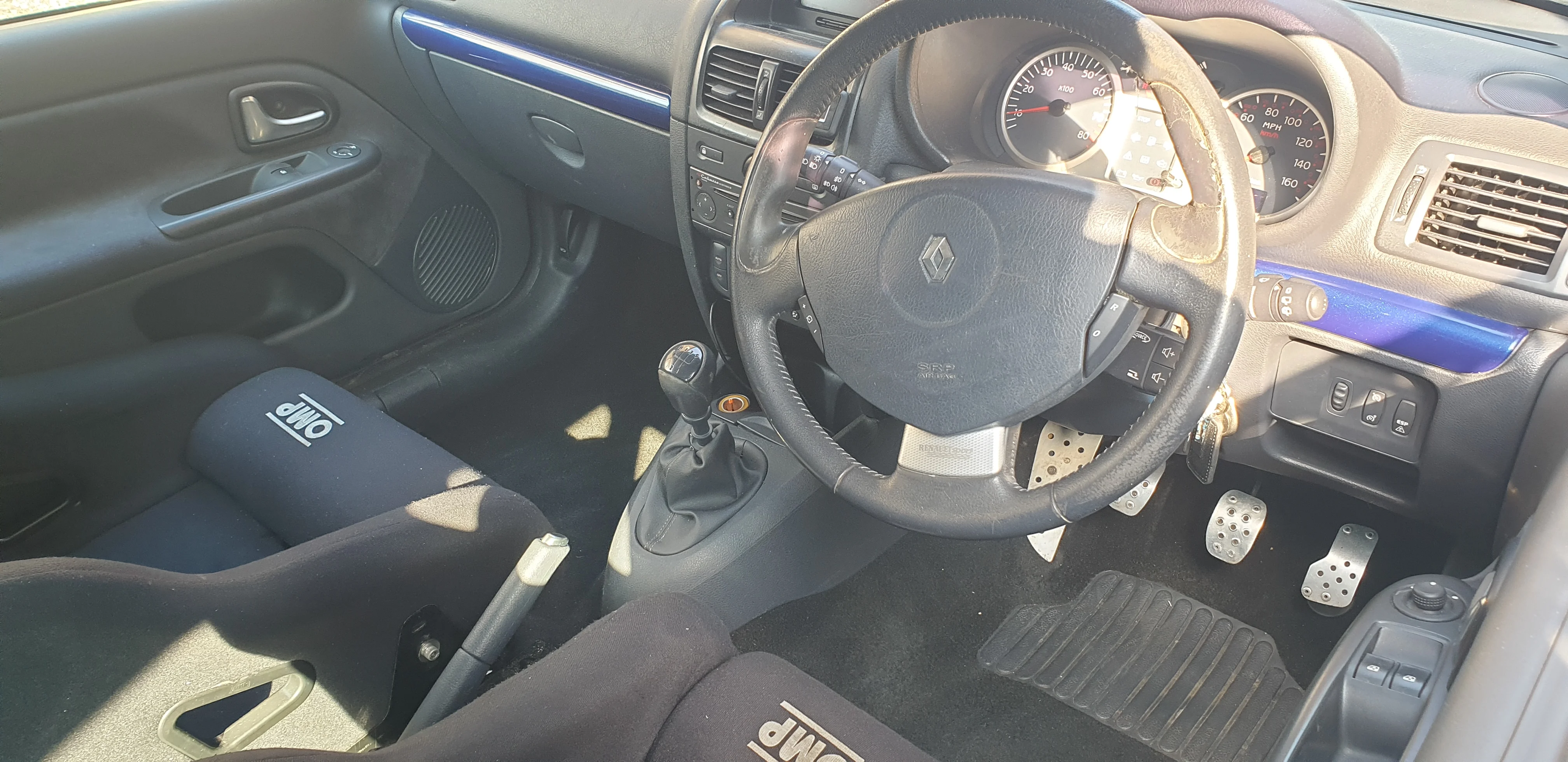

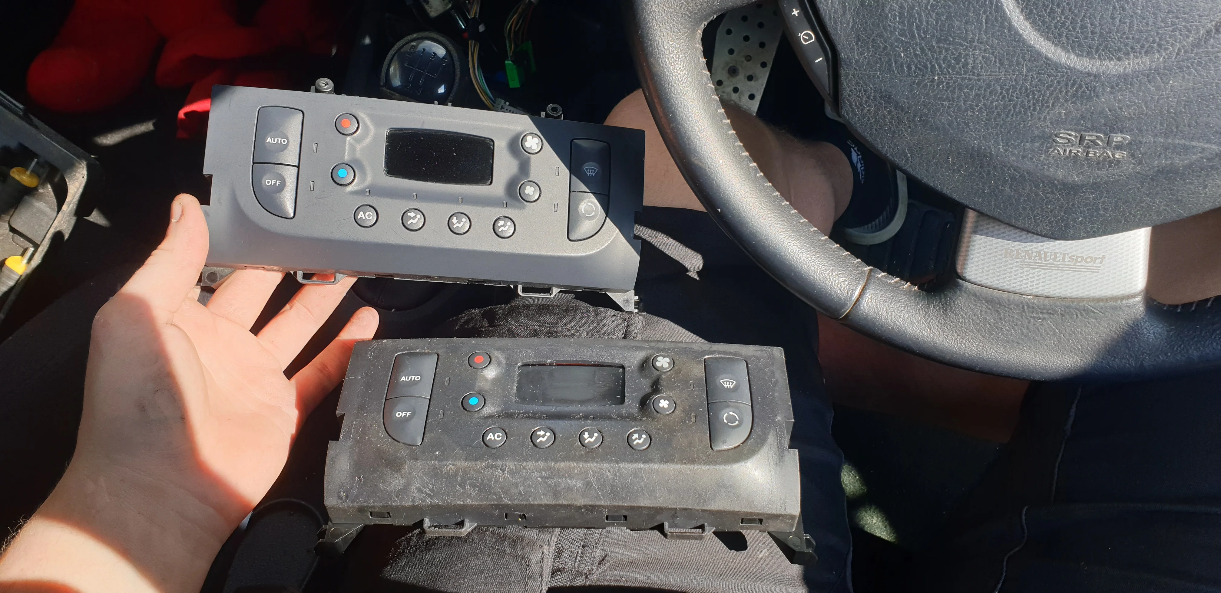

Gave the inside a quick clean in prep to move it and get it MOT ready, even treated it to a non sticky climate panel
Might whack the PMS shifter on one night this week if it passes an MOT

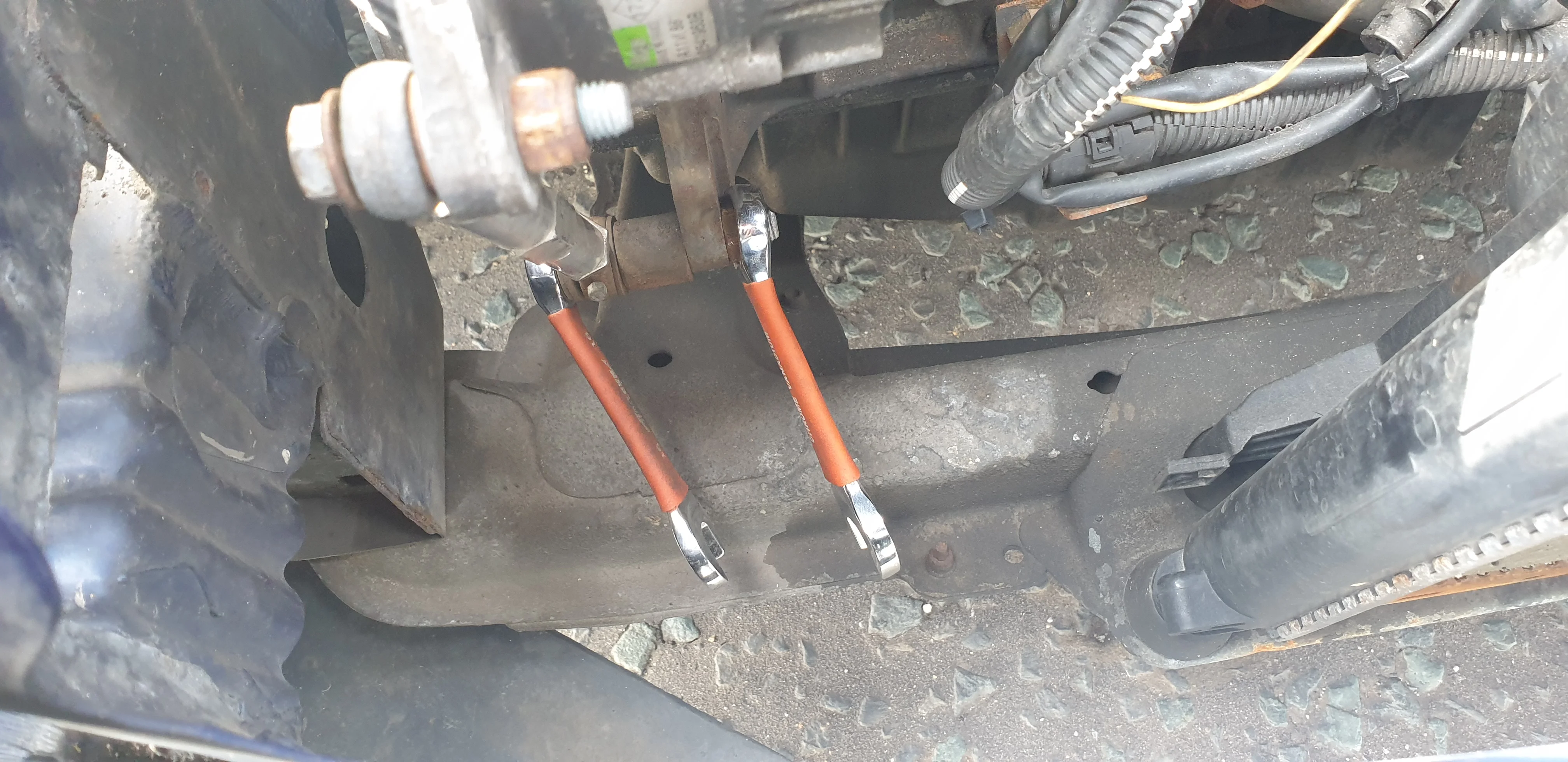

Honestly these and the mini ratchets are a good investment. Might only come in handy once or twice but they save you massive headaches when you cant quite get to something

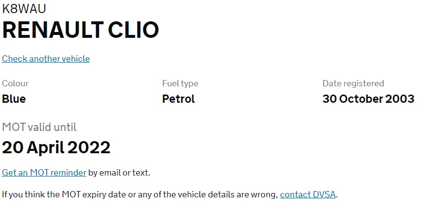

Well hoorah

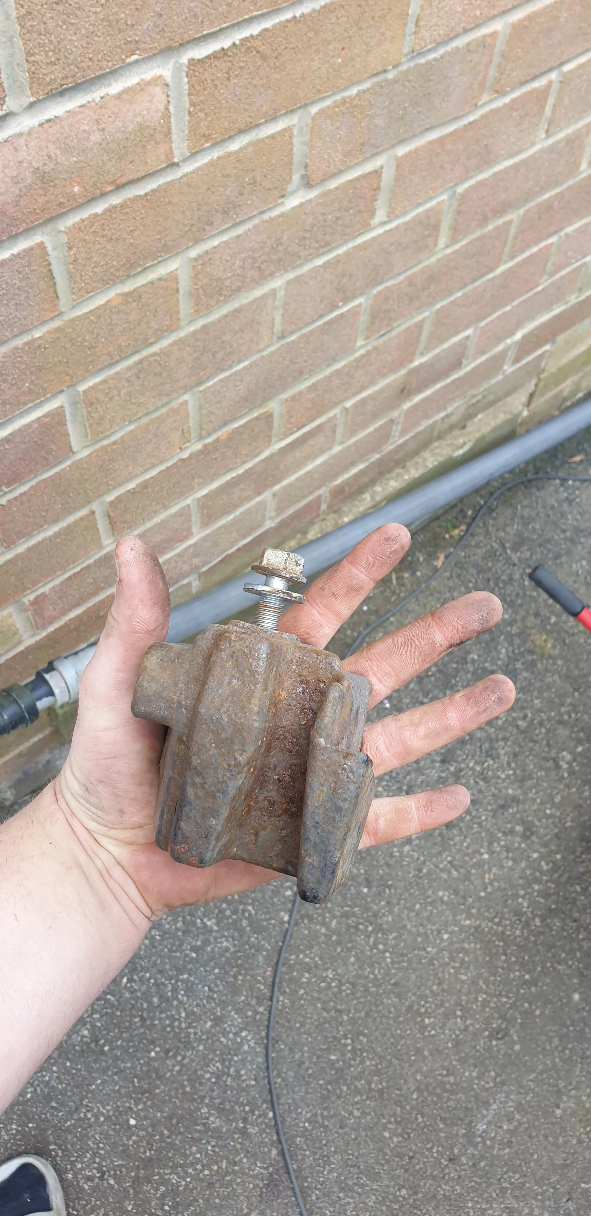

Passed but he made me aware that my OS driveshaft clip was hanging on by a thread so needs a new clip on it
Swapped out my pikey bodge for an EVOL dogbone and the proper bell housing brae as it was just previously held in the one big bolt into the gearbox casing. Had to bodge it with a chipboard washer as I drove to work and the rubber just fell out somewhere along the way 😂
Old bodge
New Evol dogbone and proper support bracket

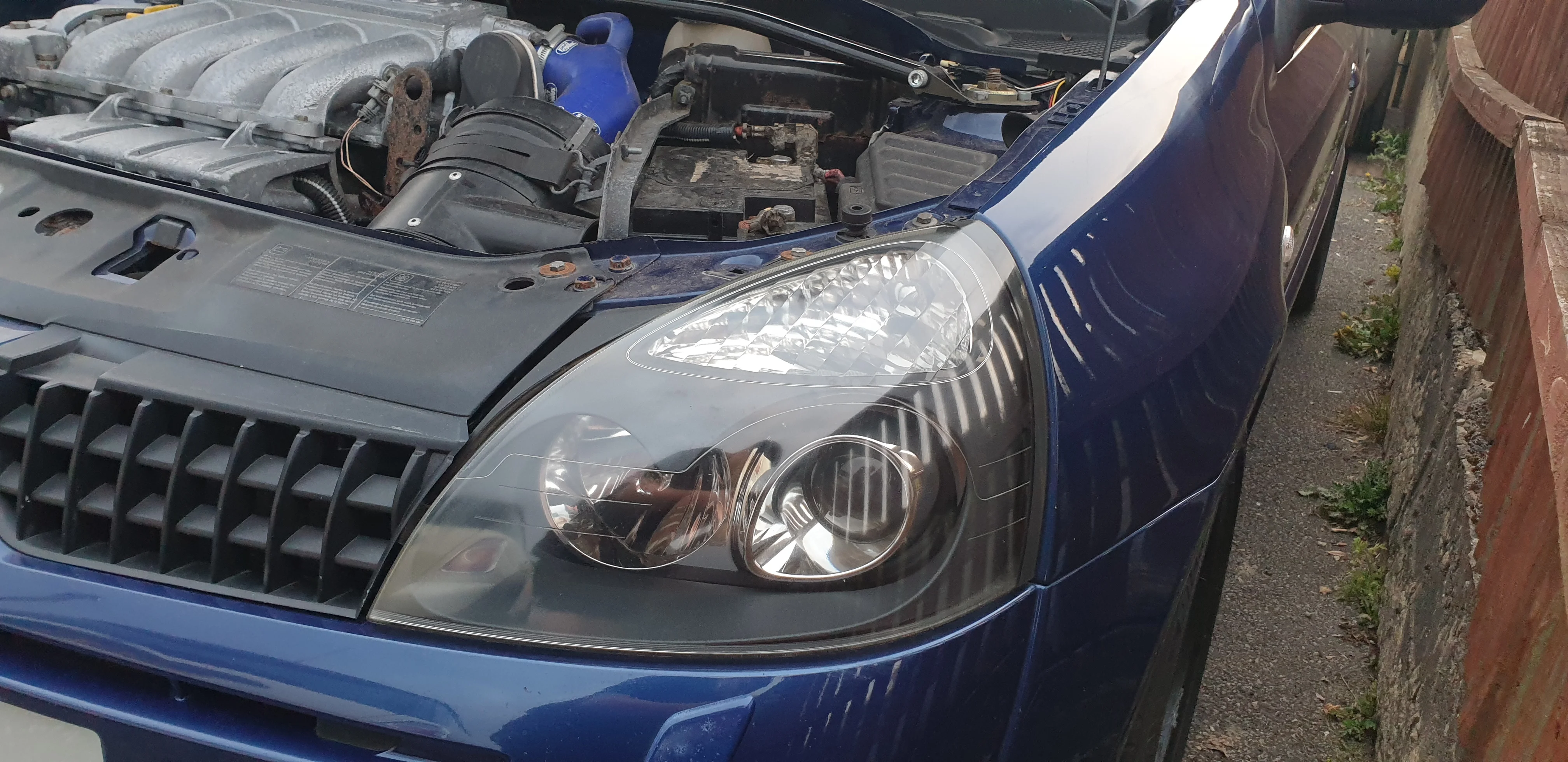

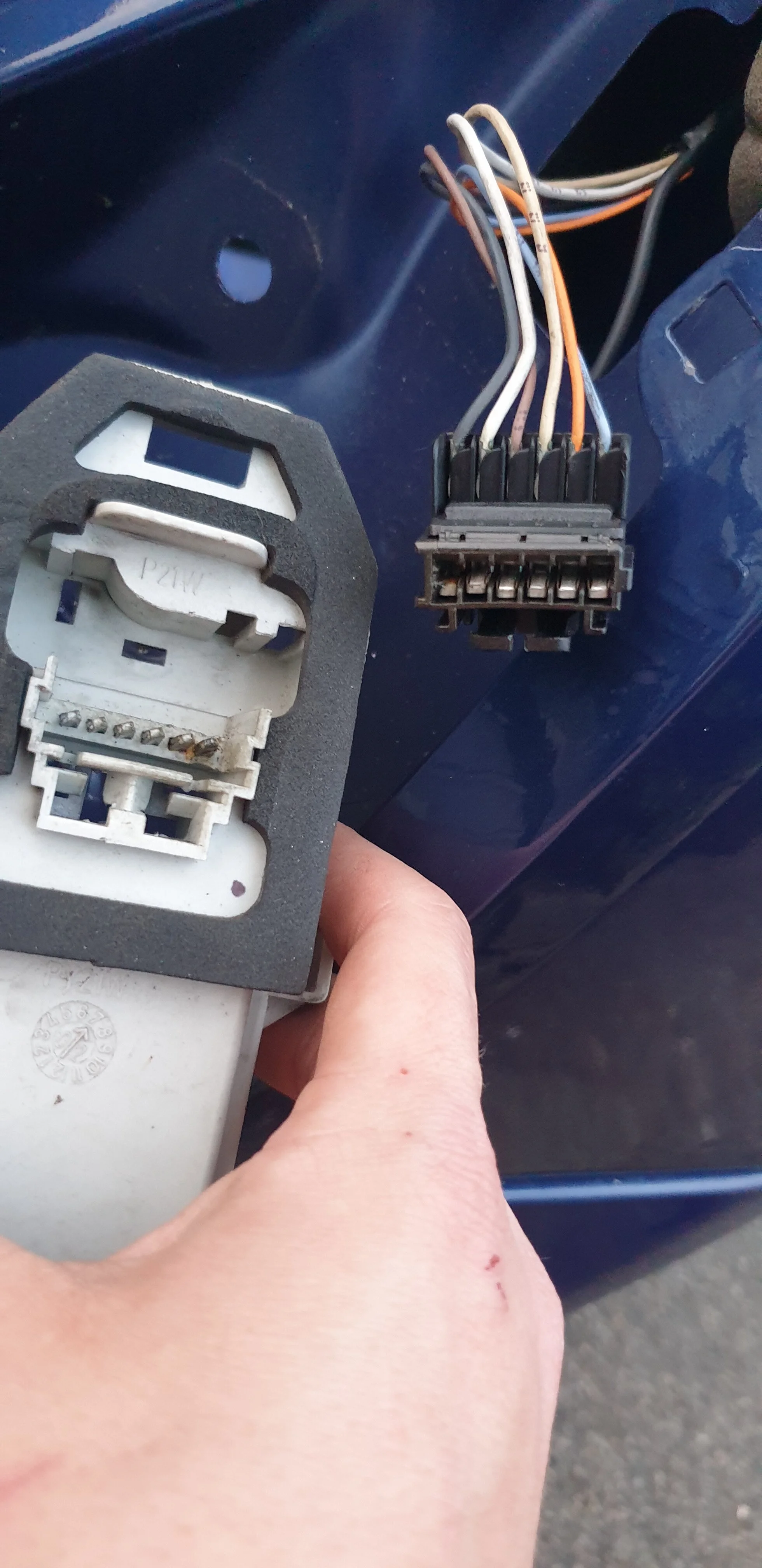

Had the annoying brake light/fog light/reverse issue so I cleaned up the rear light plugs and pins and then cleaned off the cluster tracks and bulbs too. No more issues!

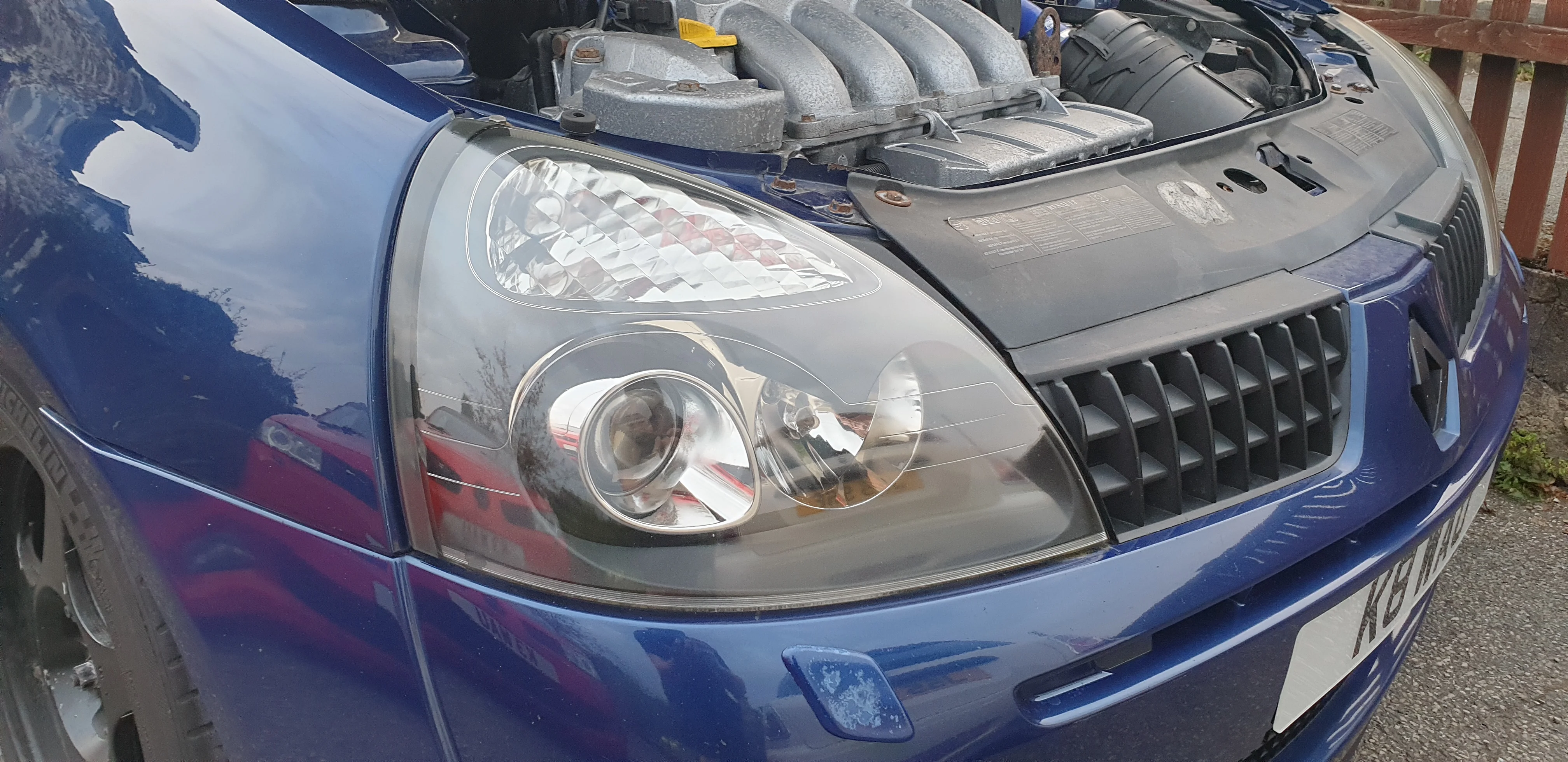

Cleaned up my headlights and got rid of the Amber indicators too

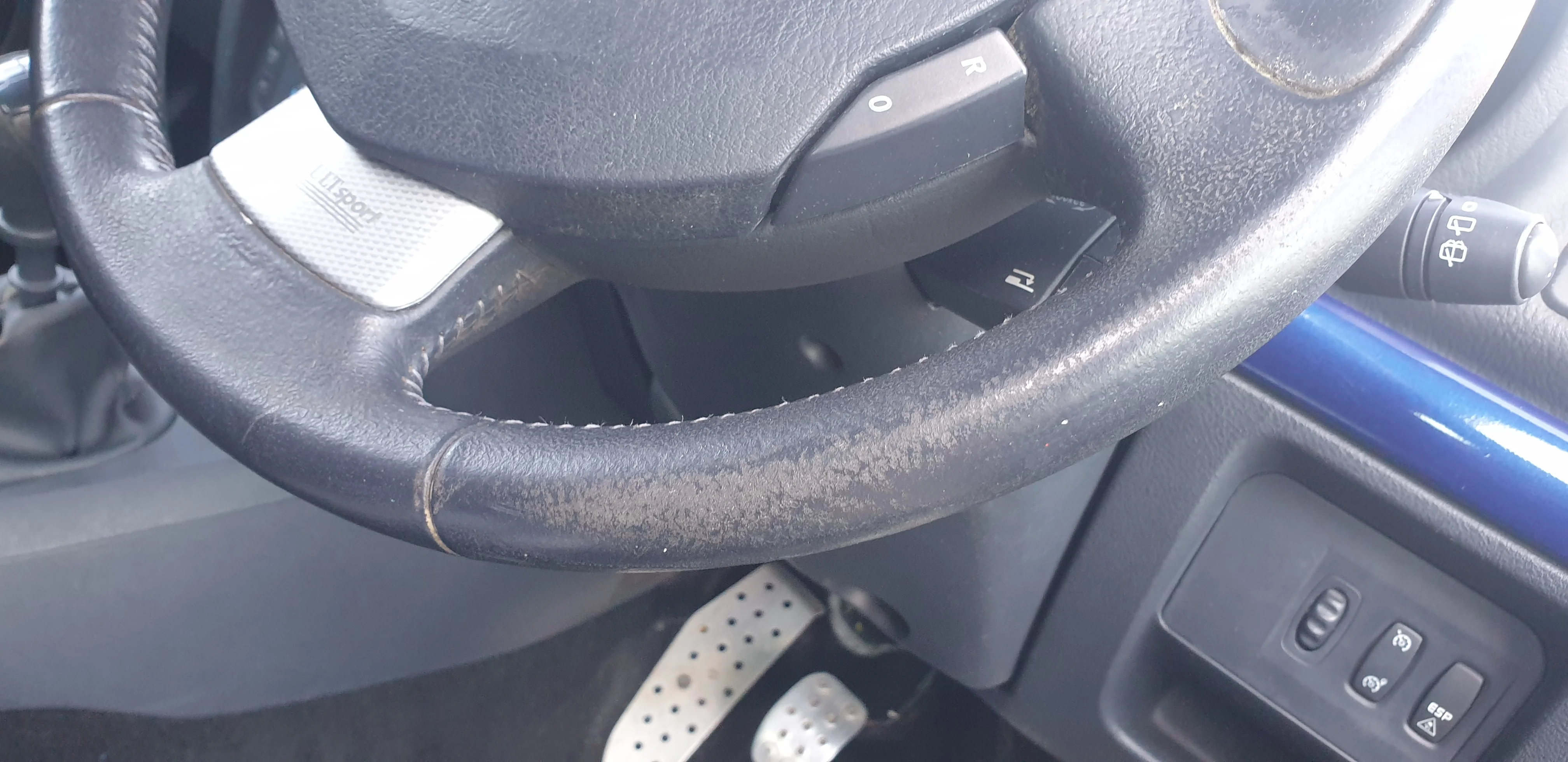

Need to give it a quick polish as the car cover has dulled it in some spots and slightly scratched it too😅 Ready for Sunday now and I dont have to drive a comfortable, quiet, heated seats, blisteringly cold aircon'd Kia everyday... yeah a Clio with no AC and solid everything is great to use everyday... right?😢😢

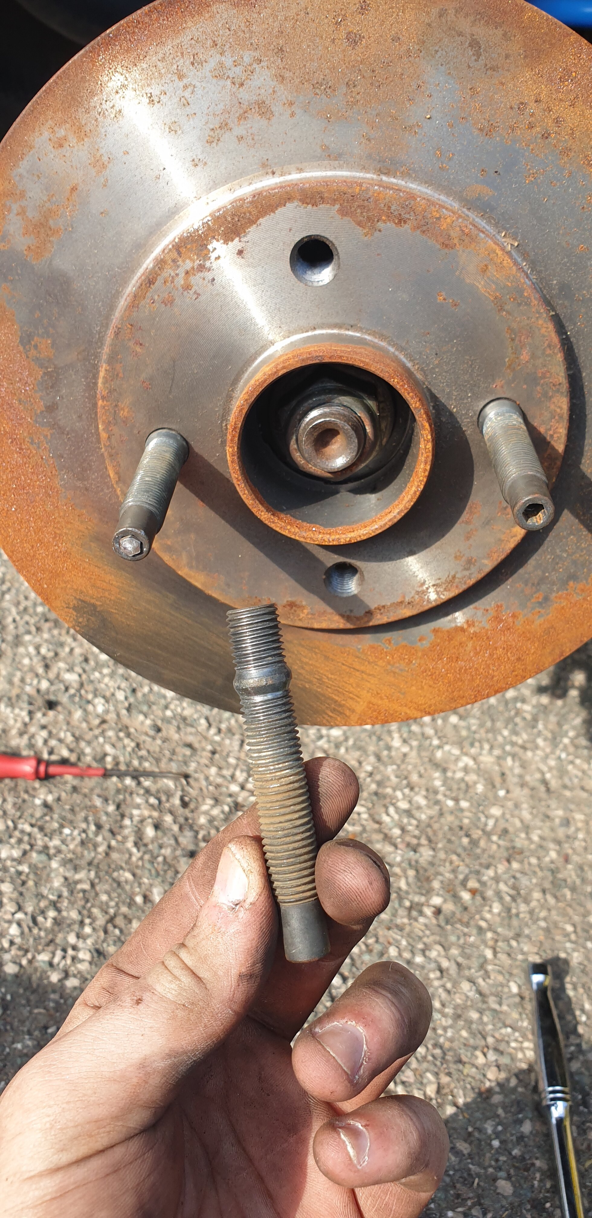

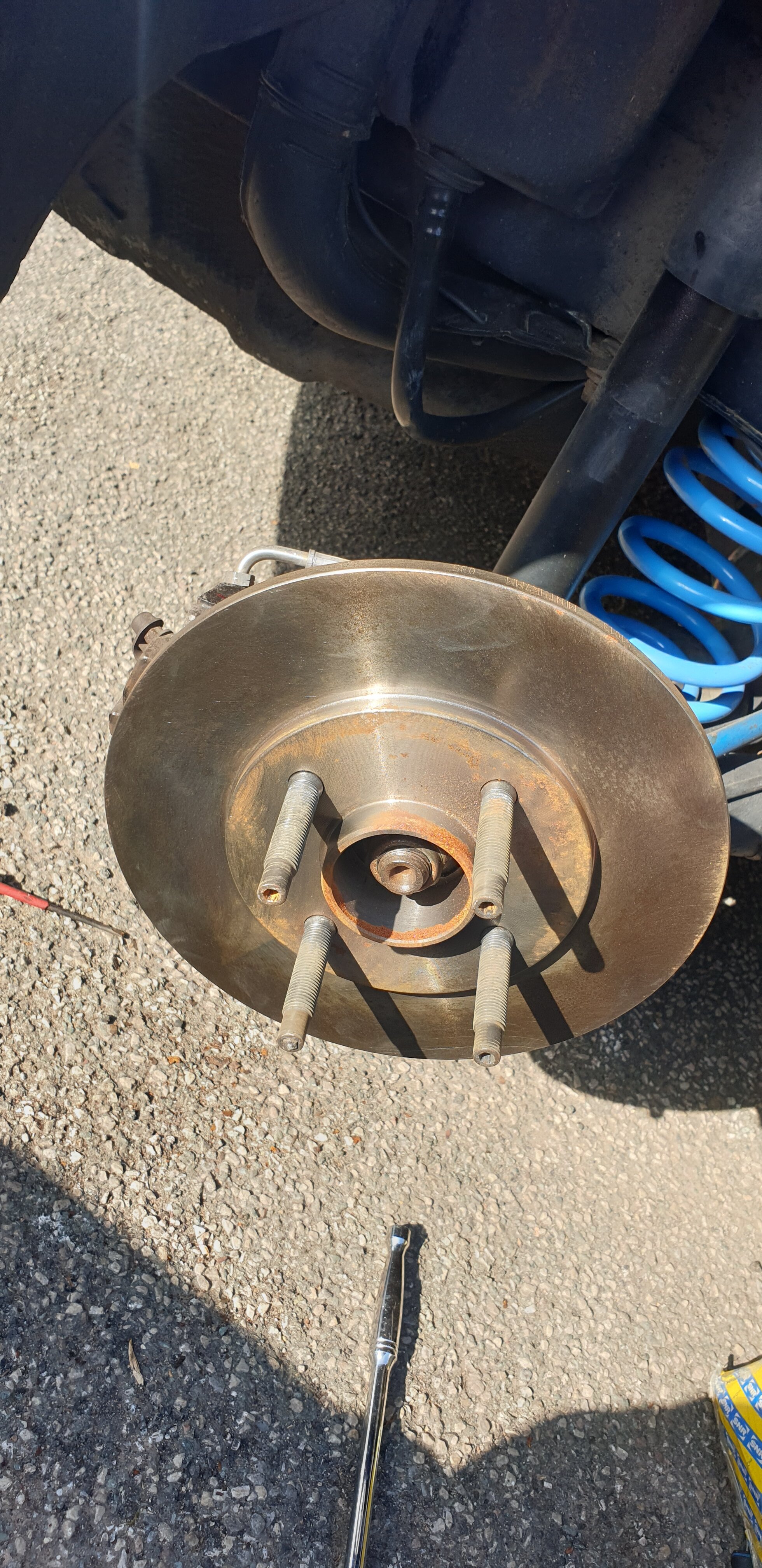

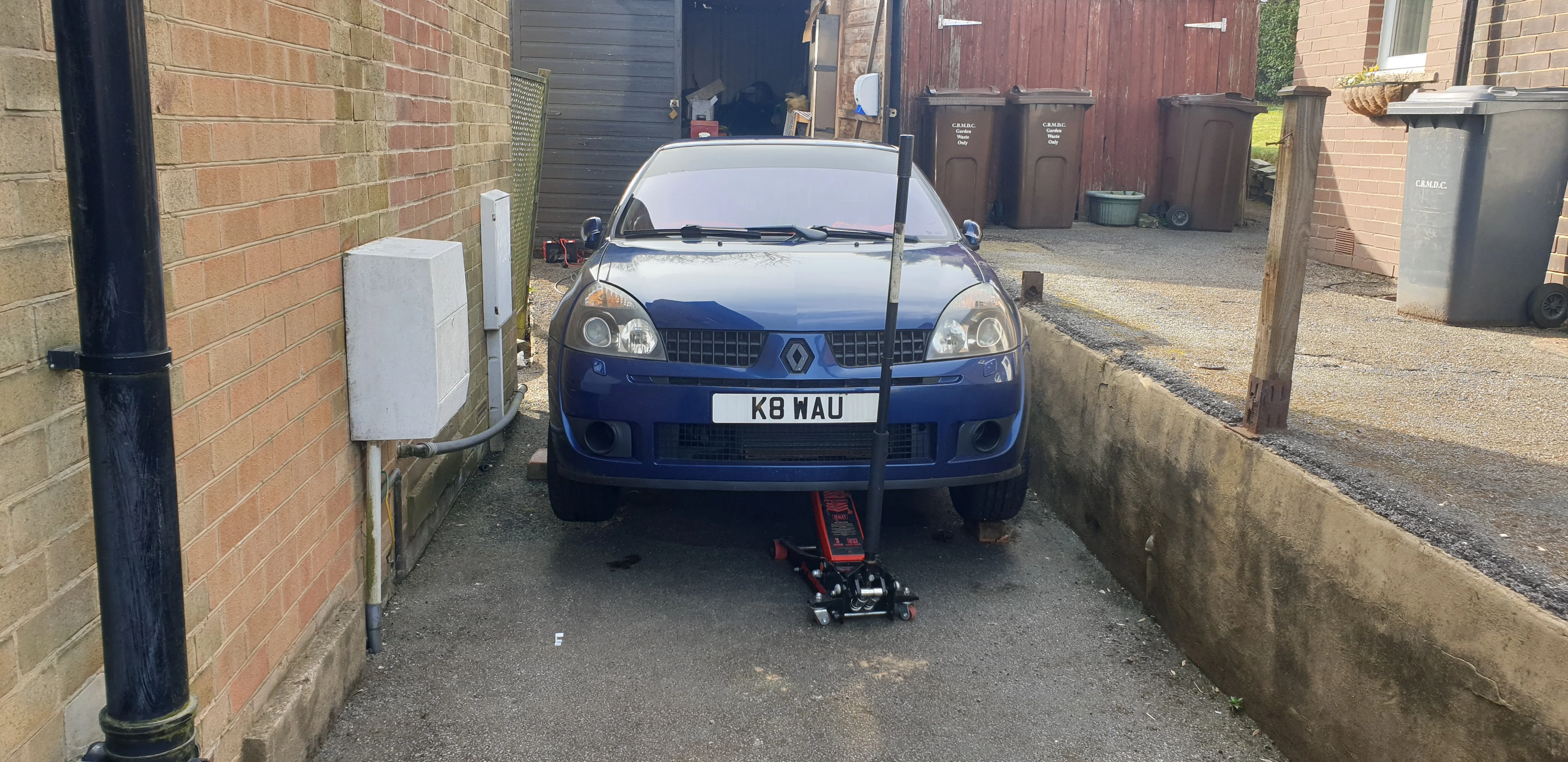

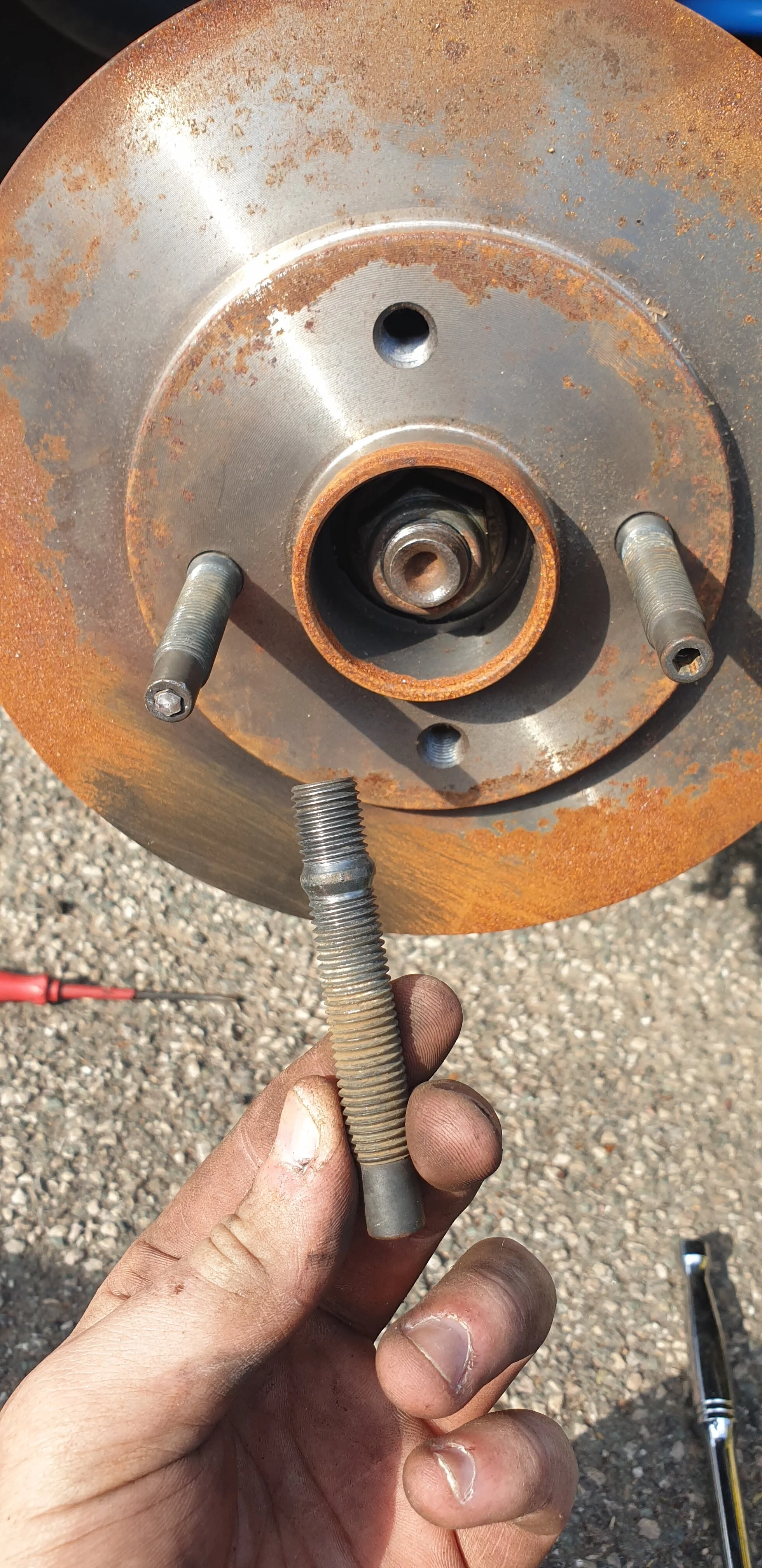

Was swapping my wheels when I found one of my rear discs was cracked in 2 spots🙃
Quick swap out with a brand new spare I had in stock. Studs were properly in there as I snapped my 5mm Allen bit in the end so double nutted them out and back in
Disc had a bit of surface crap on but cleaned off with the wire brush

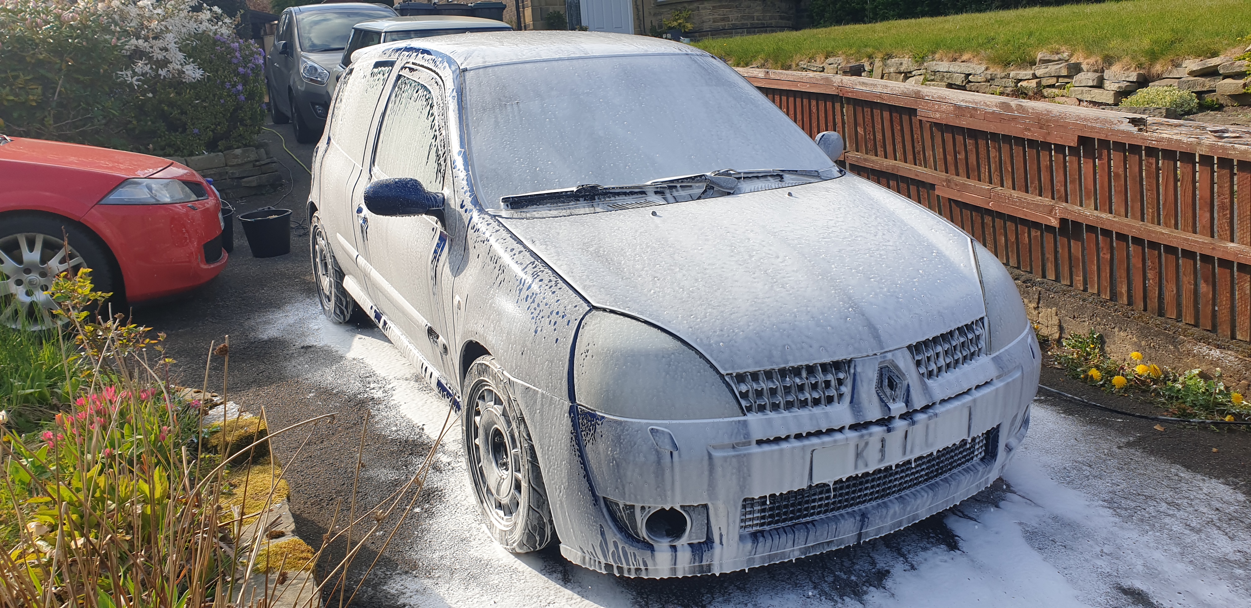

Swapped the Rota Slipstreams & PS3 for Turbines/Maracanas & NS2R 180 and gave it a bath
View attachment 1534743View attachment 1534744

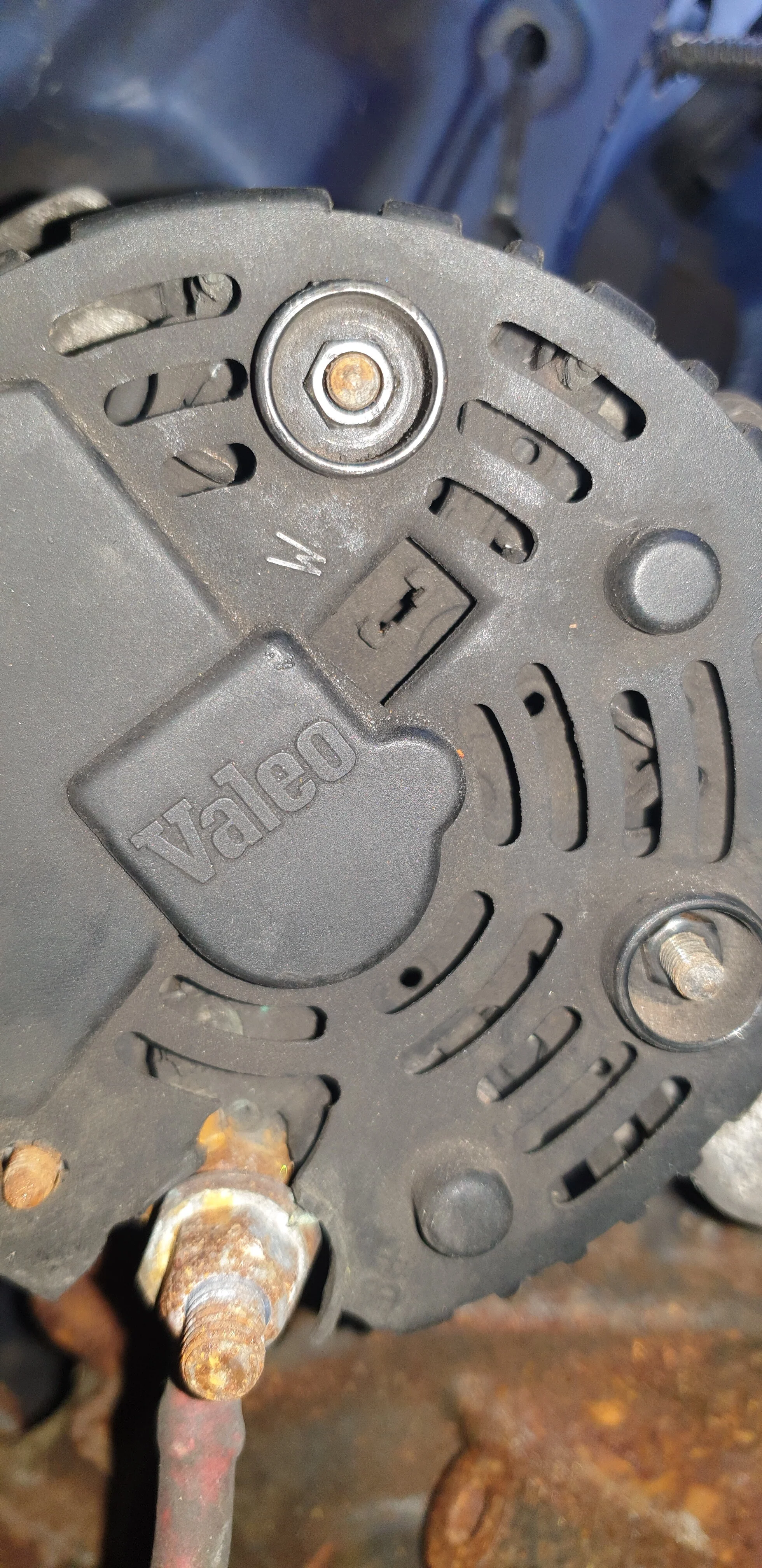

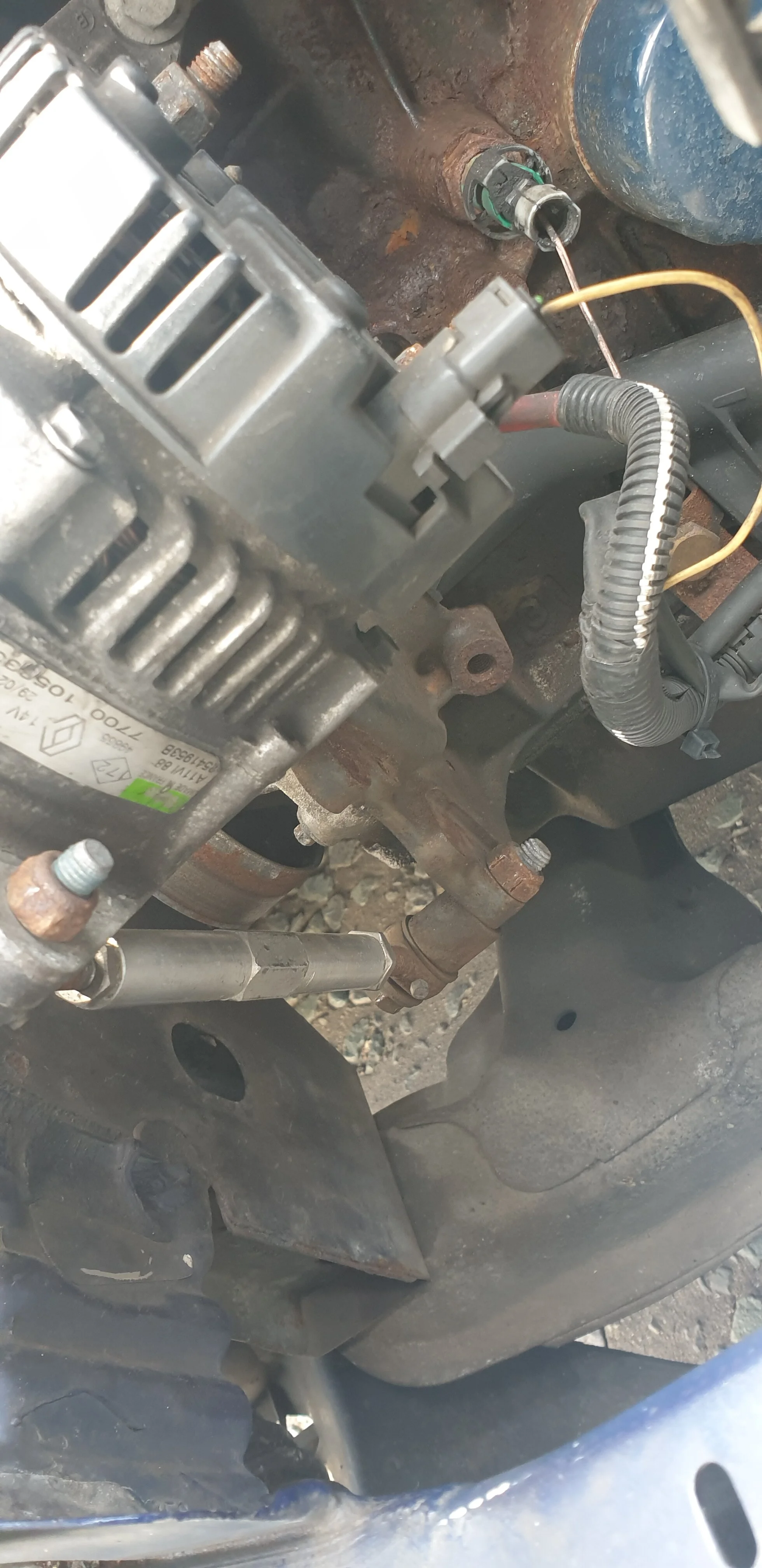

Since the aux belt change I've had a slight buzzing at about 3k around the cambelt area
Decided to investigate today at work, no the bumper isn't sat against the wing so f**k off
Alternator manual tensioner had buzzed loose. You can see how much real estate I've gained from removing PAS and AC. Piece of piss to do stuff to the car
Quick nip up with the stubby spanners, took over a full turn🤣

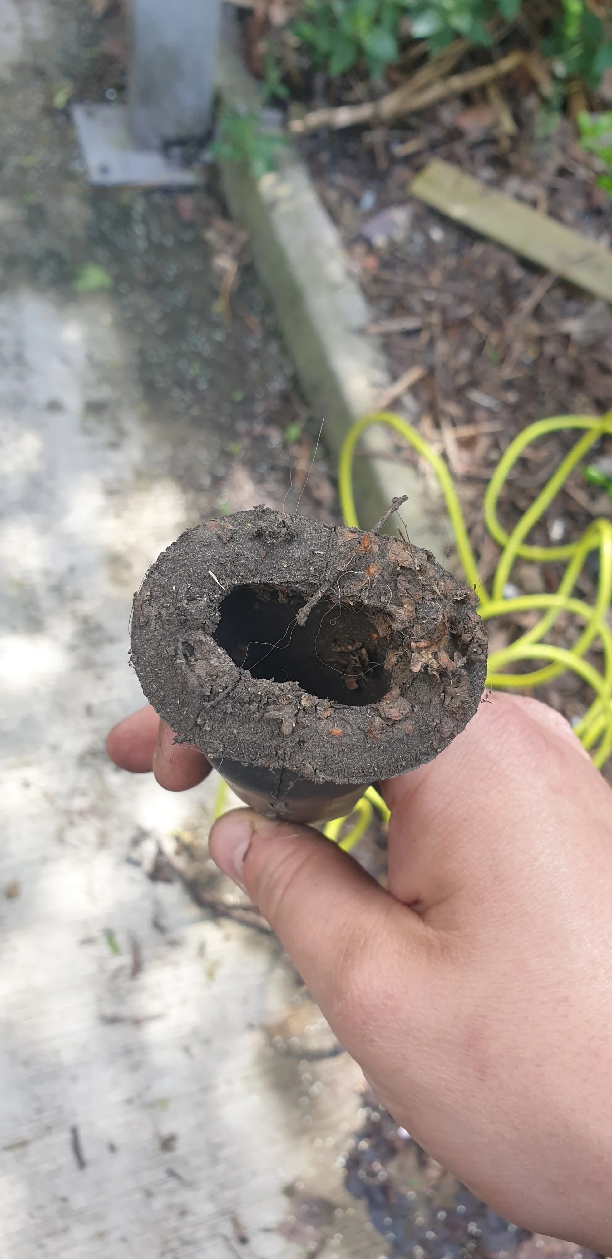

Decided to pull the middle drain out whilst in the engine bay, had a bit of s**t in there built up over the last 2 years so cleaned it out

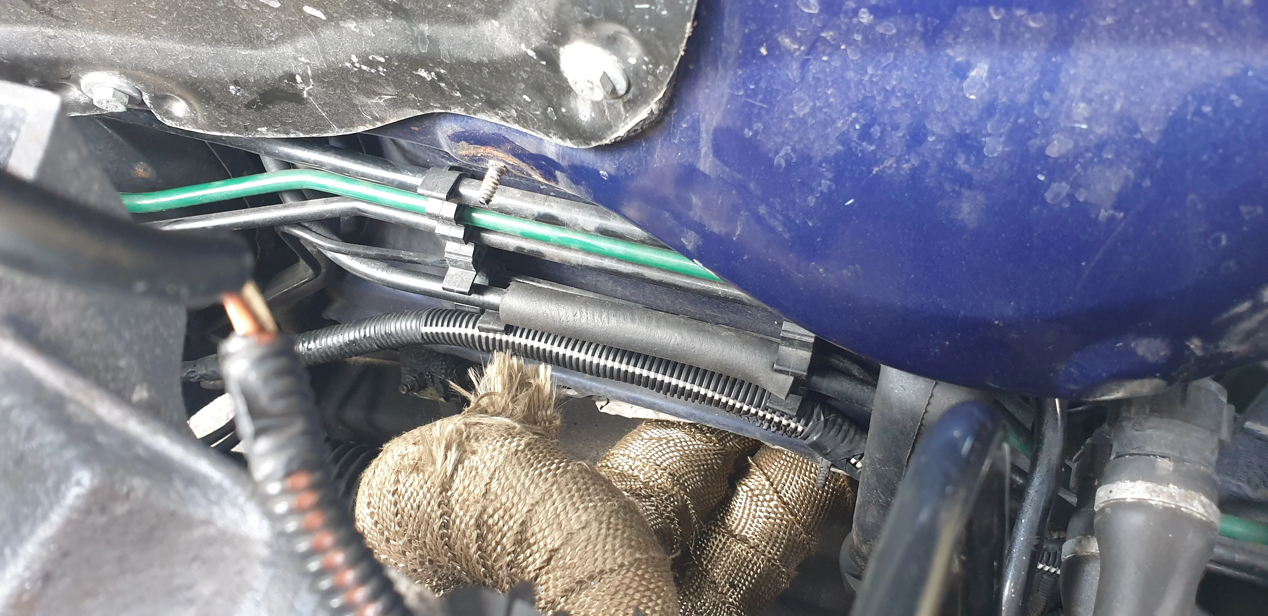

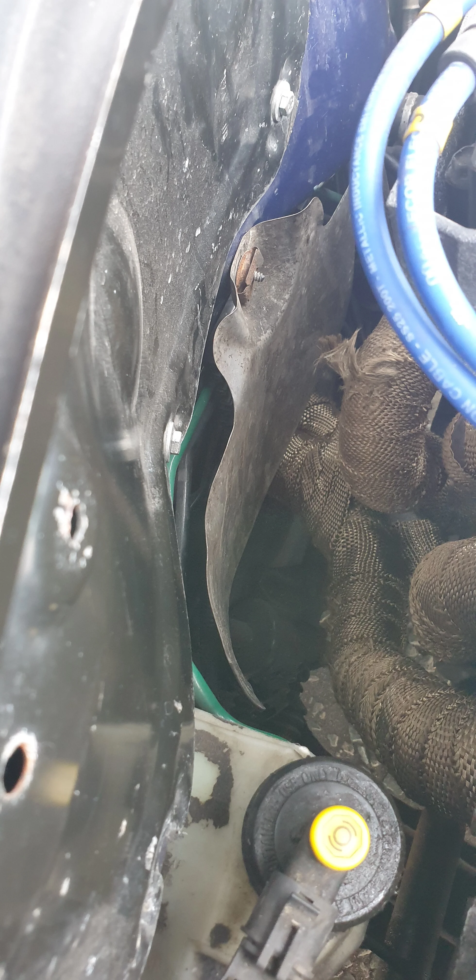

Noticed my clutch cable and loom were dangling behind the 1.2 8v heat shield... and I had the heat shield on upside down too🤦‍♂️😅 It fits loads better when you have it on the right way🤣🤣
Arms and hands are now itchy as f**k from the heat wrapped manifold rubbing on them

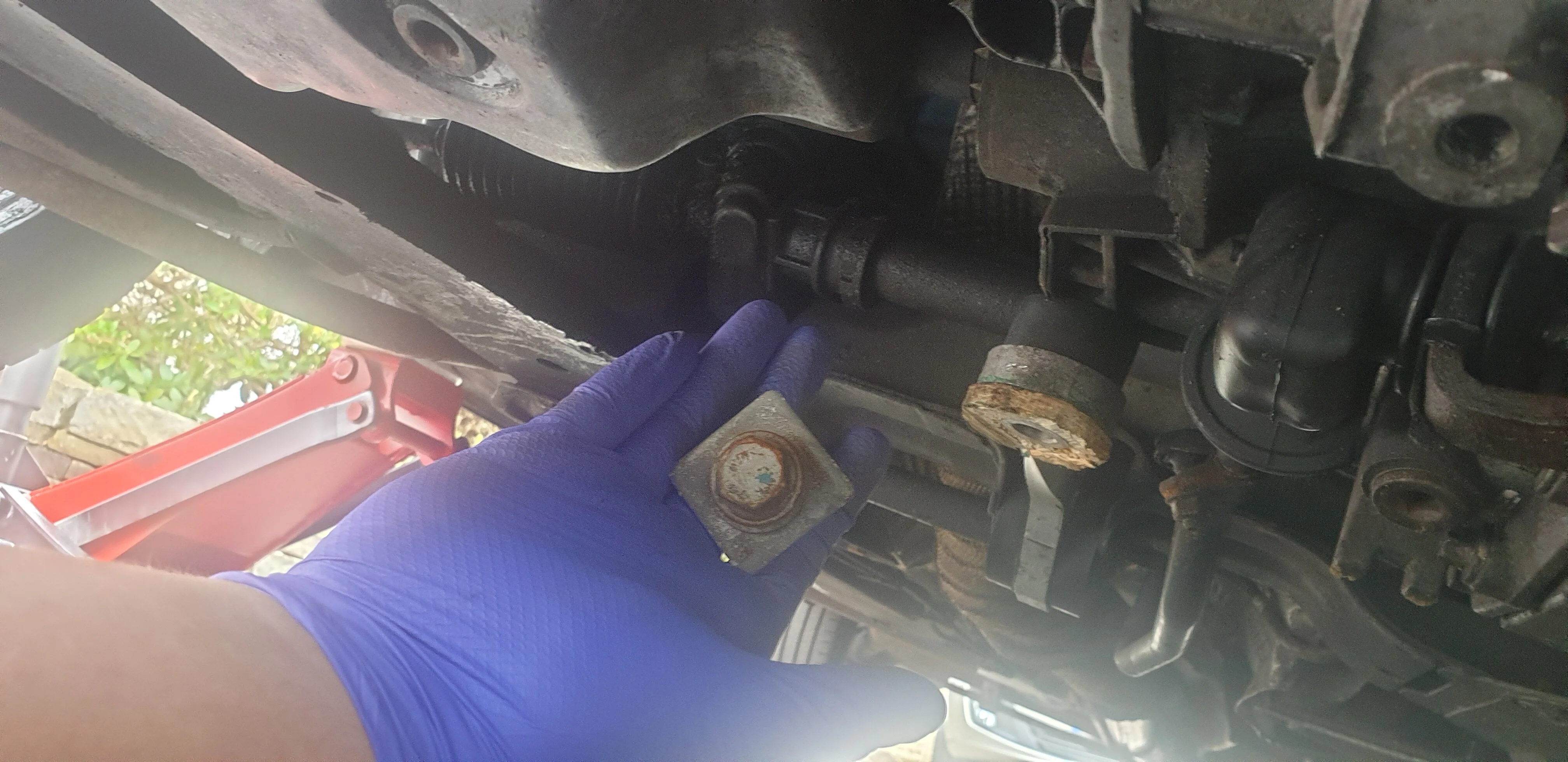

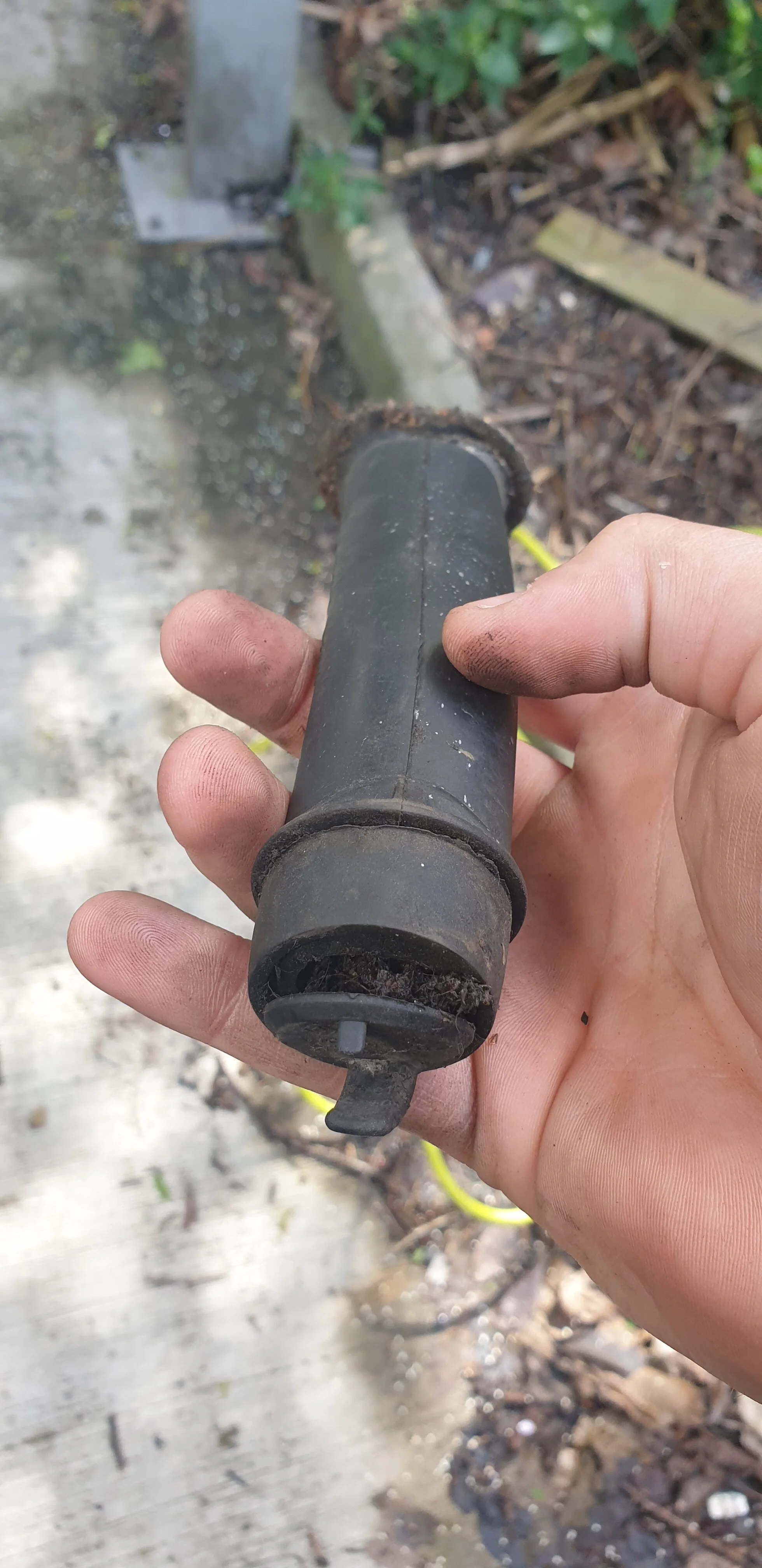

So tightening the alternator didn't solve the vibration sound issue and today it got horrifically worse on the way home
At first I thought it may have been something sinister... but with 2 seconds of investigating with the engine on I knew exactly what it was...
Klumpy Dumpy
Not all gingers stink of piss. But I do.
Aye rattled itself loose, a lot of stuff does with the Ktec/Vibra mounts and Evol dogbone🤣I'm not using the standard nuts because they got thrown in a bucket once upon a time so I just used some standard nuts so it took like 2 turns to tighten them both🤣🤣
Everytime I tighten something on this car it seems to feel faster🤔🤣 Weird placebo
