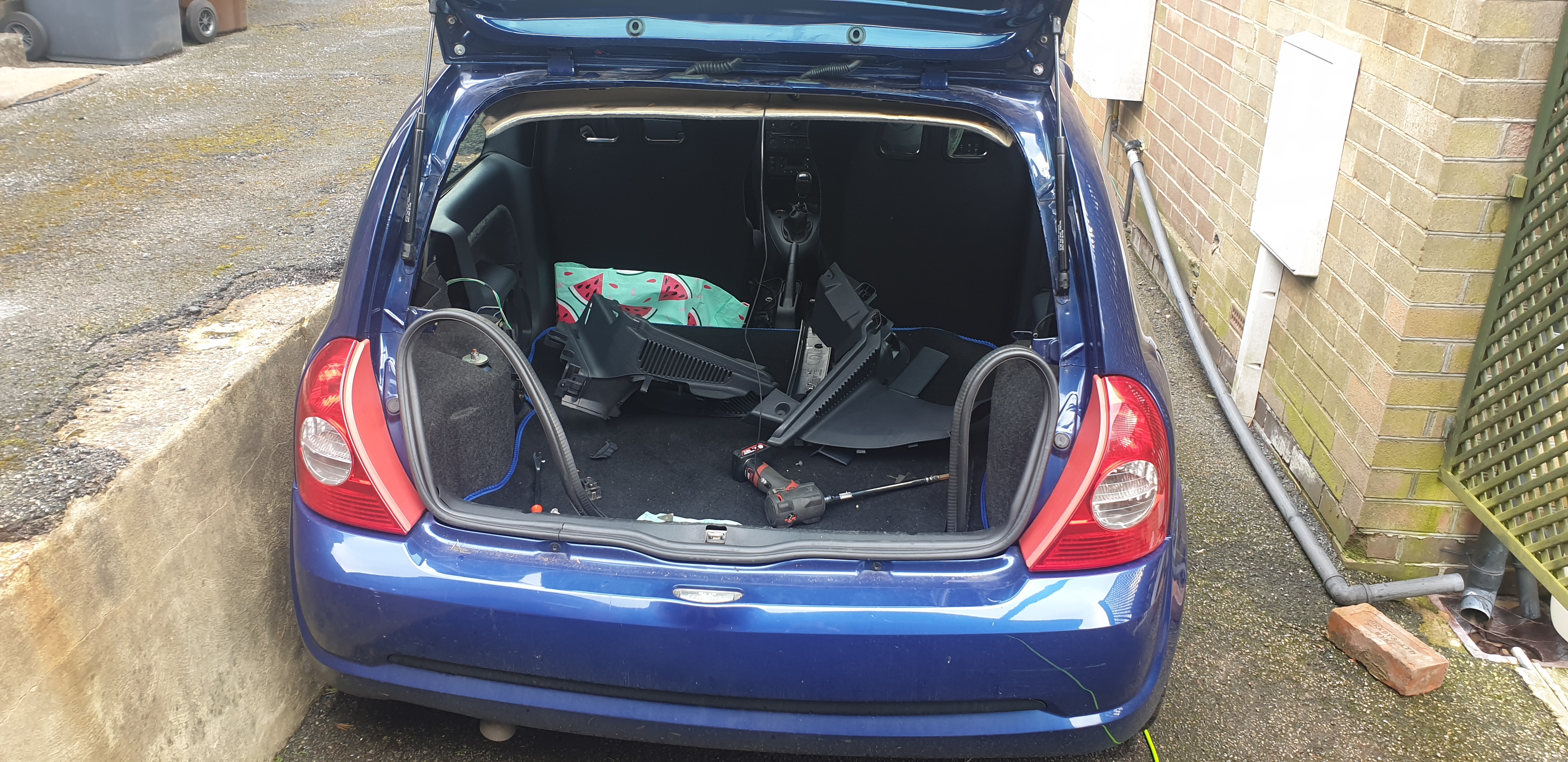

Clio wasn't keen with 15 bags of postcrete in the boot

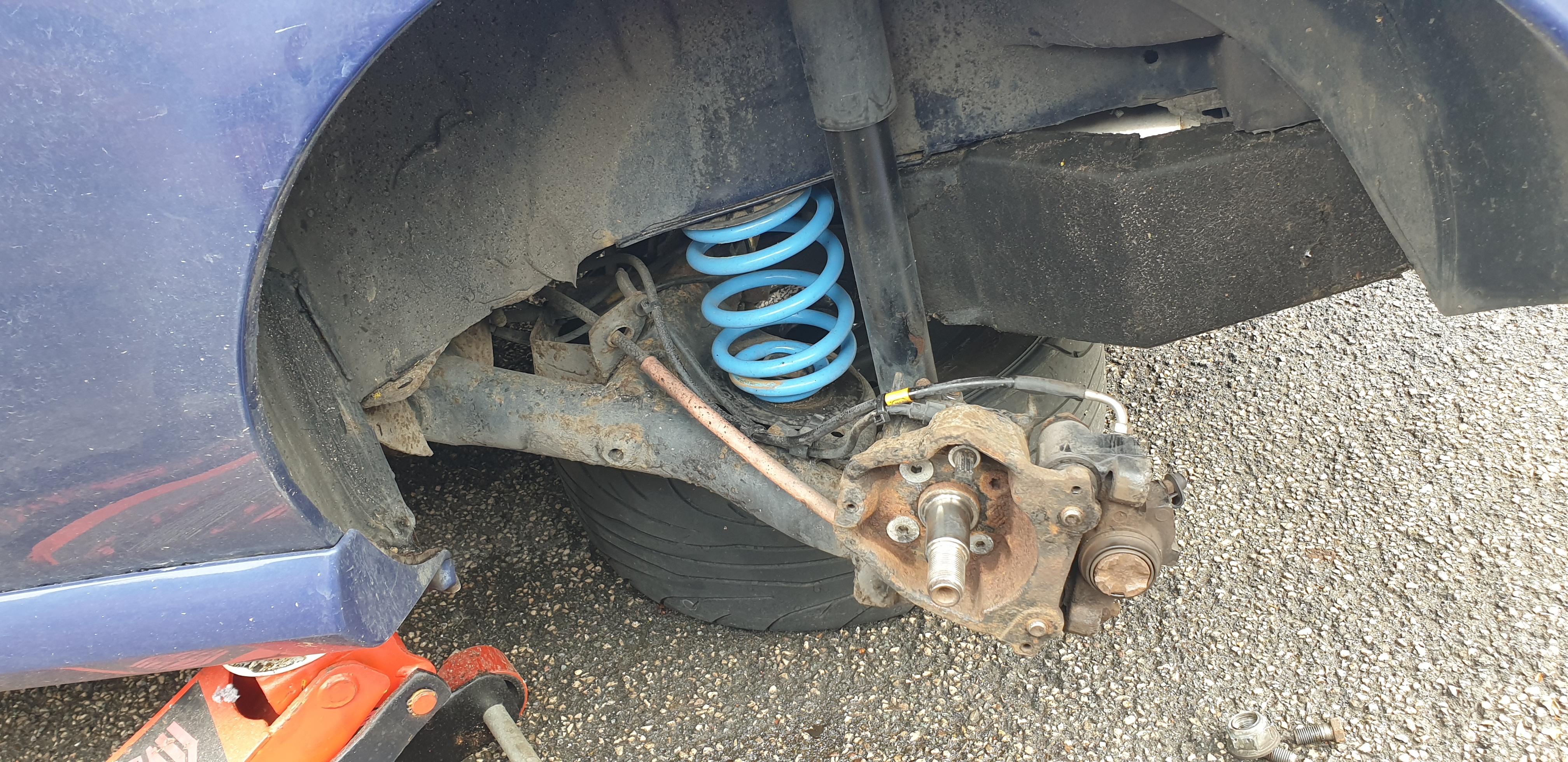

Humming on the rear has been getting progressively worse since the postcrete went in🤣

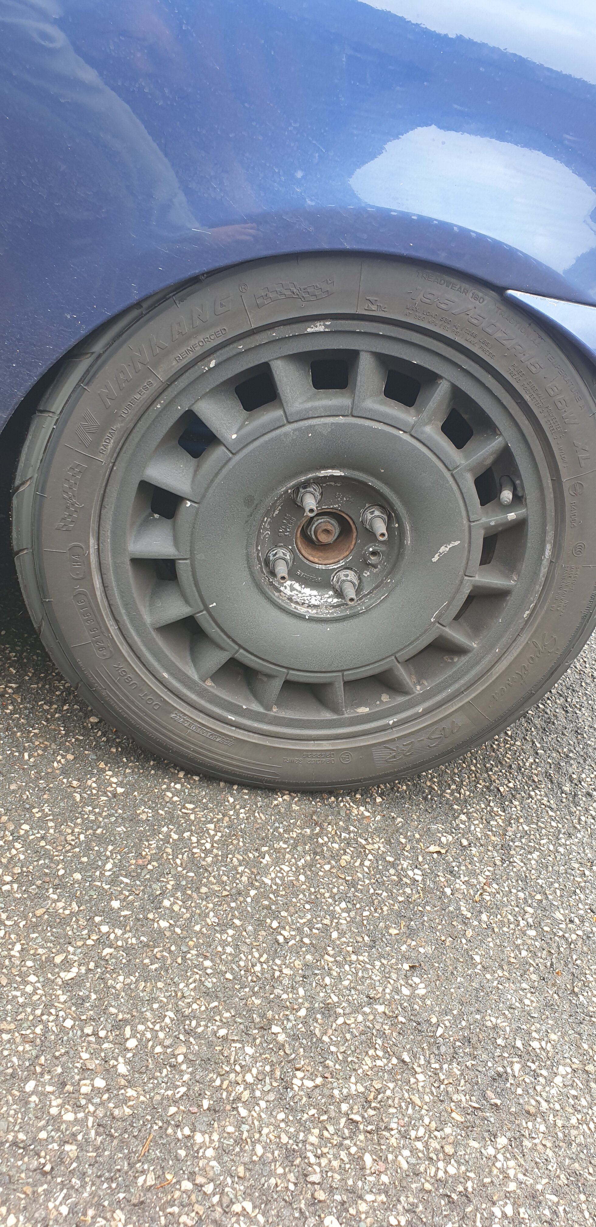

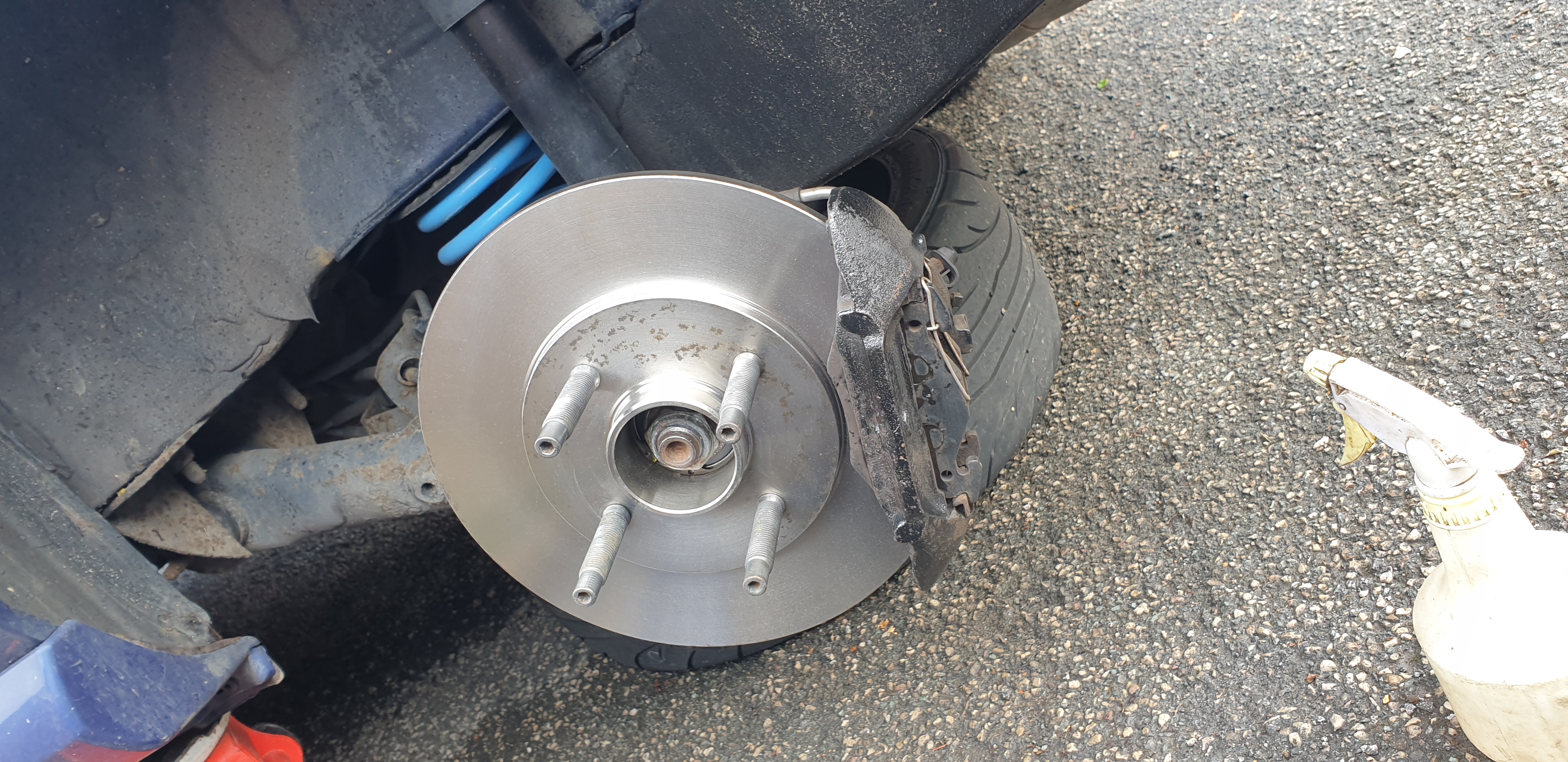

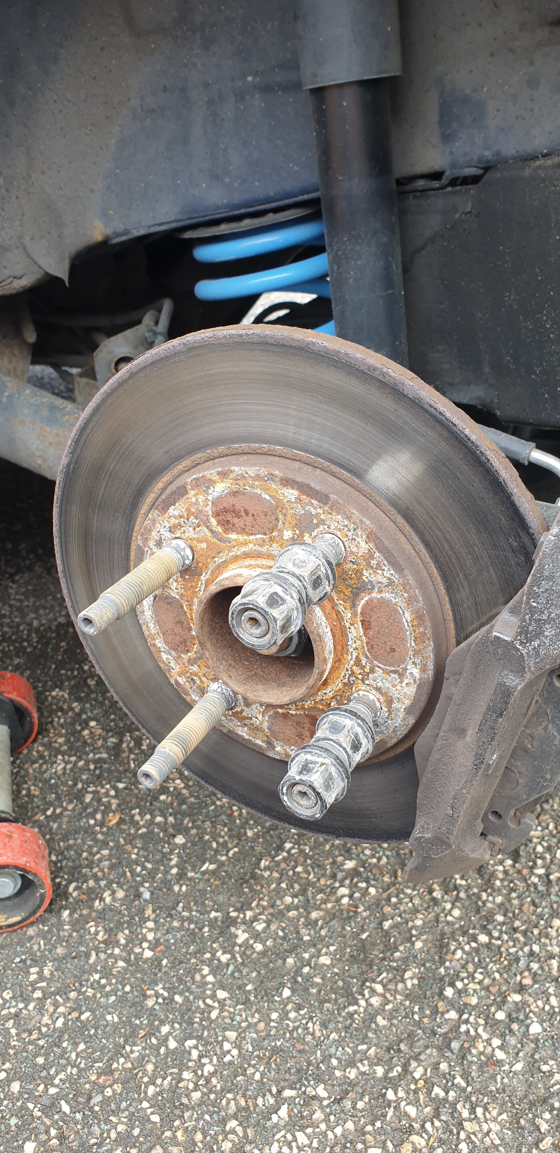

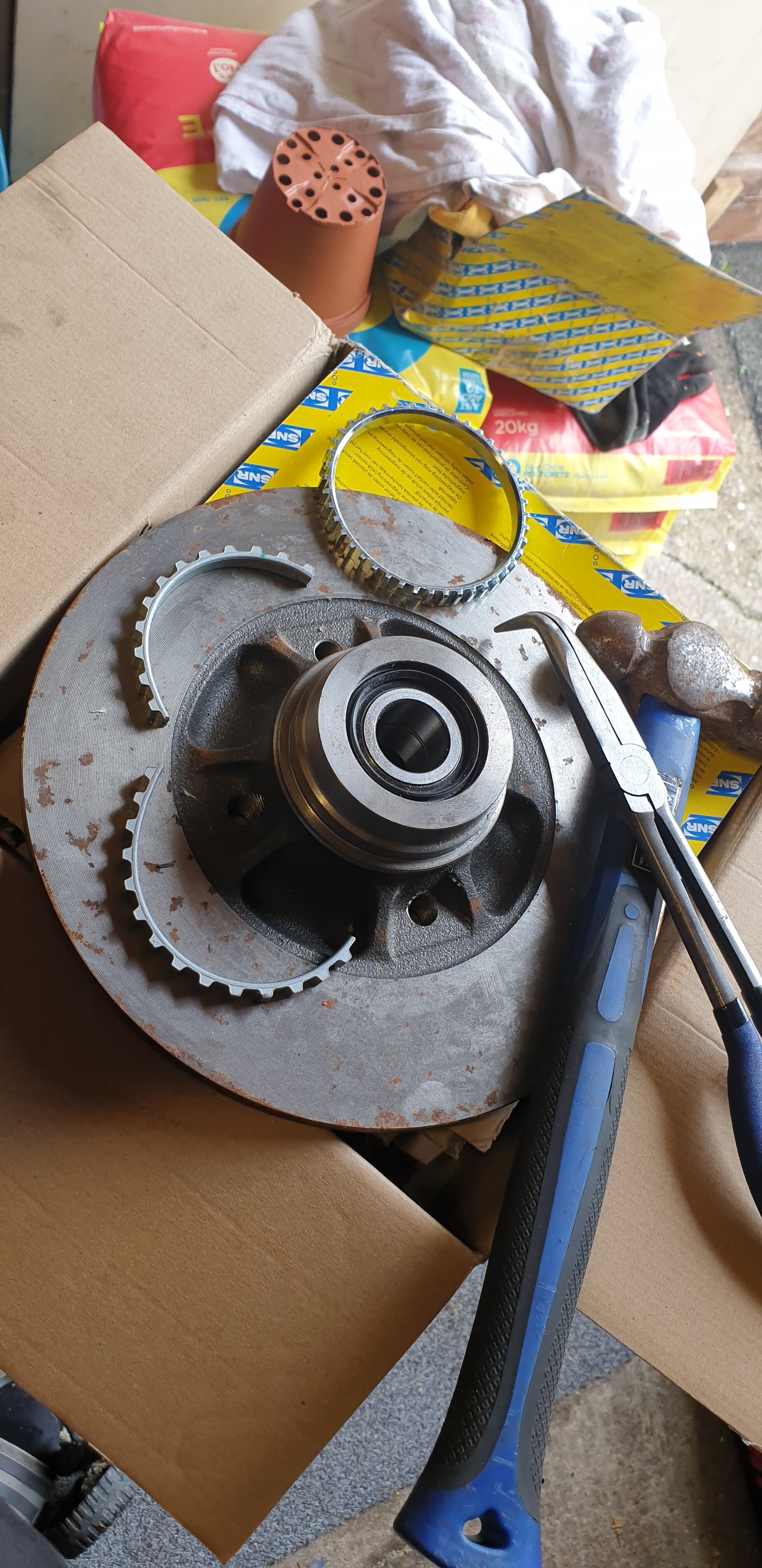

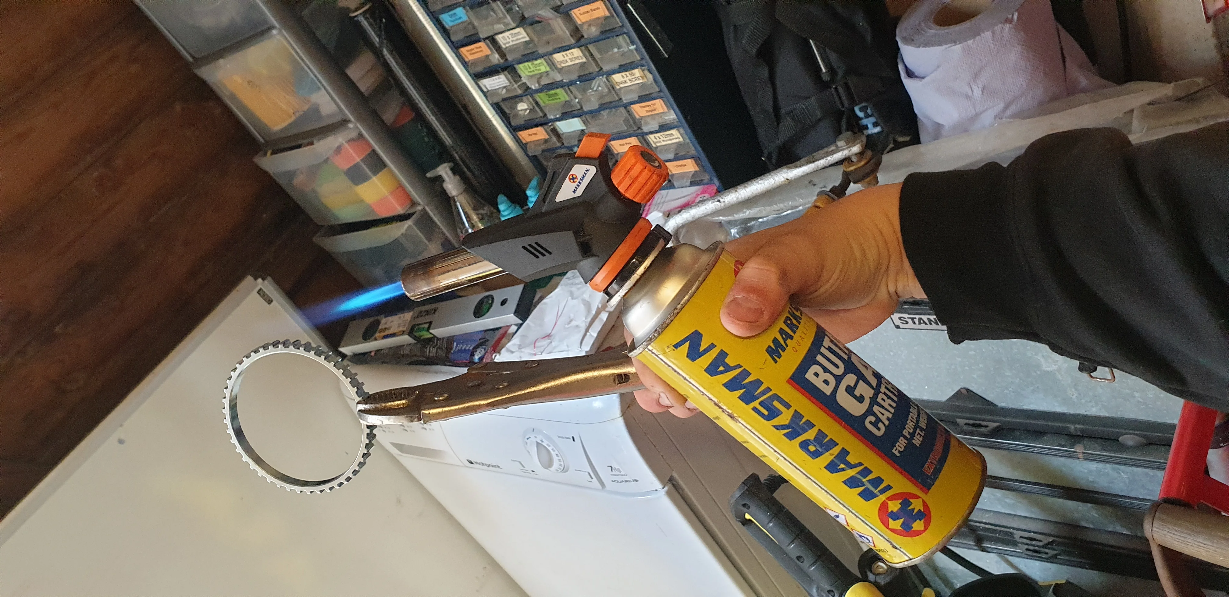

Figured I swapped one rear disc I really need to do the other

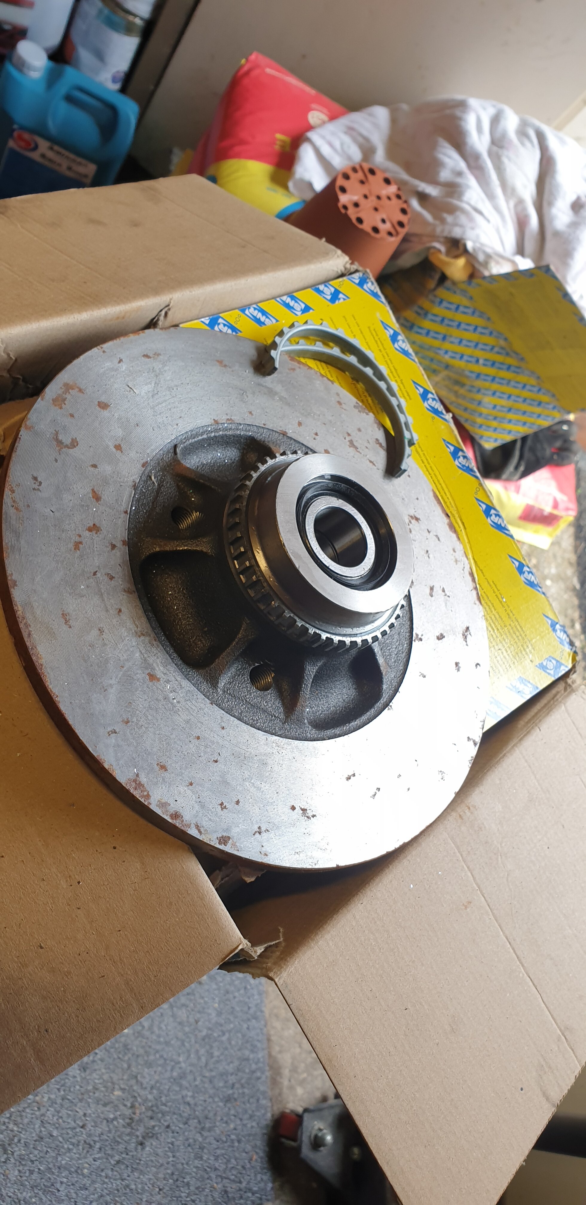

I originally bought these discs for £30 (for the pair) when GSF were getting rid of all their stock. I bought em cheap and for good reason... one had the 44T ABS ring and one had a 21T ring from a Megane🤔🤦‍♂️ I bought these discs over 3 years ago!
Came home tonight, knocked the old ring off
Heated the new one up
Knocked it on

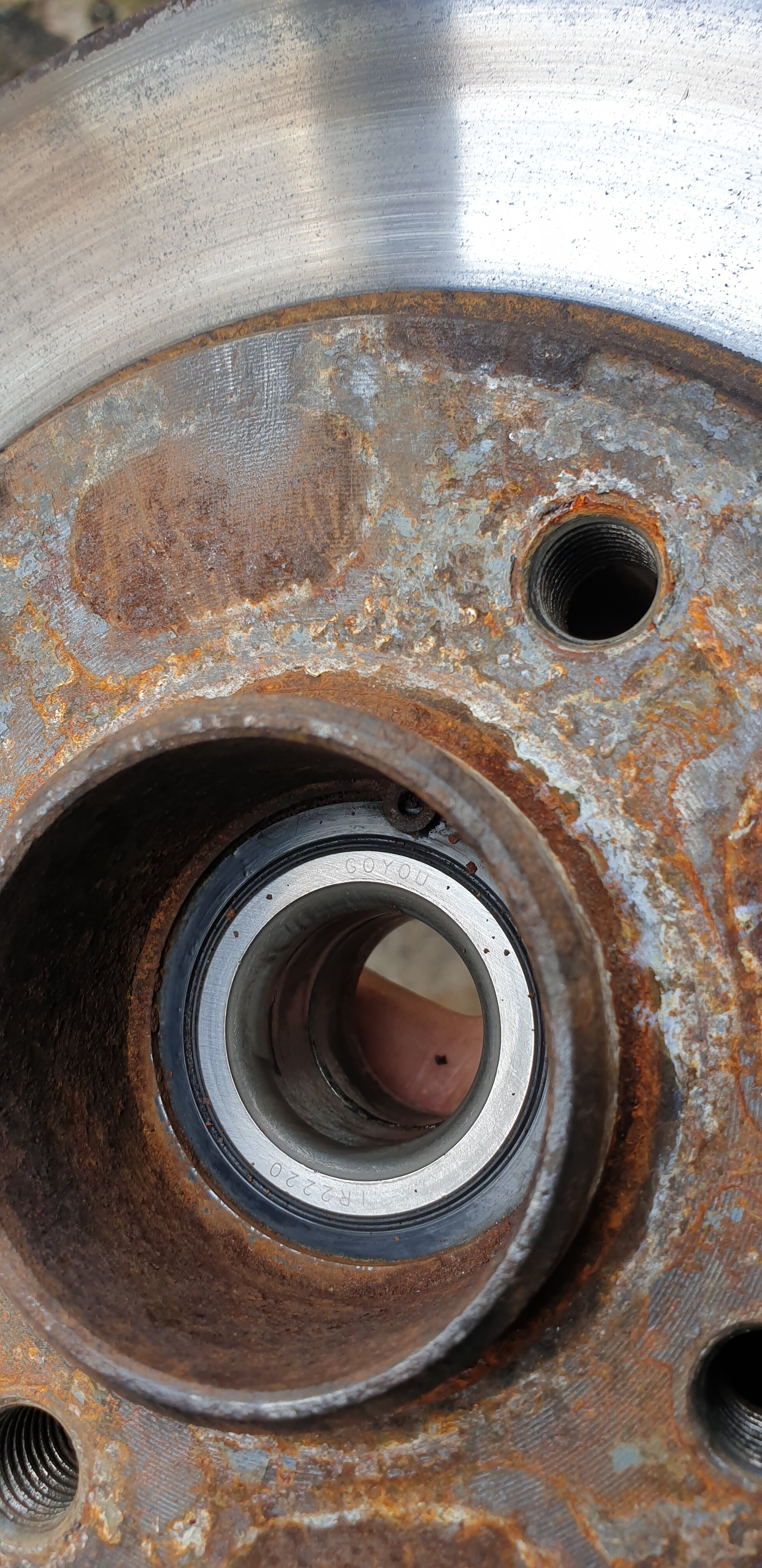

Old disc, been on there for 3+ years and a trackday🤣 PBS pads holding up well
Still not that rusty/dirty under here to say I only slathered Hammerite and caliper paint on there🤣
New disc on, cleaned the studs off. Always remember to stick the spacer washer with the flat side to the bearing and the tapered side to the car. I bet even Dr Pervert, sorry, @Dr Jekyll would be happy with those studs👀🤣
I'm hoping it will be quiet tomorrow. The old discs were probably cheap as f**k ebay specials, Goyou bearings🤔🤣

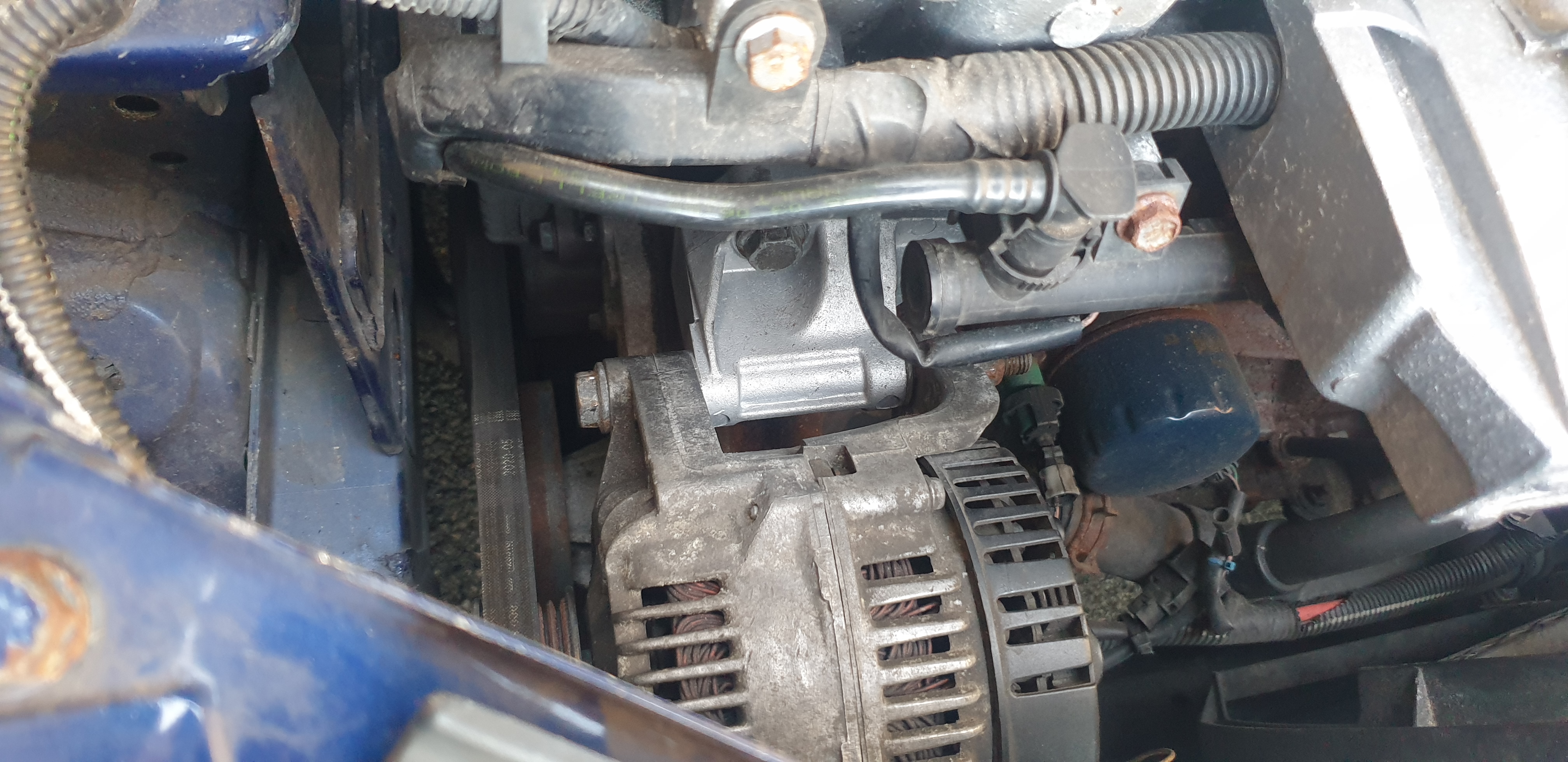

With the Mégane out of action the Clio had to be Un-SORN'd just a week after SORNing it🙃

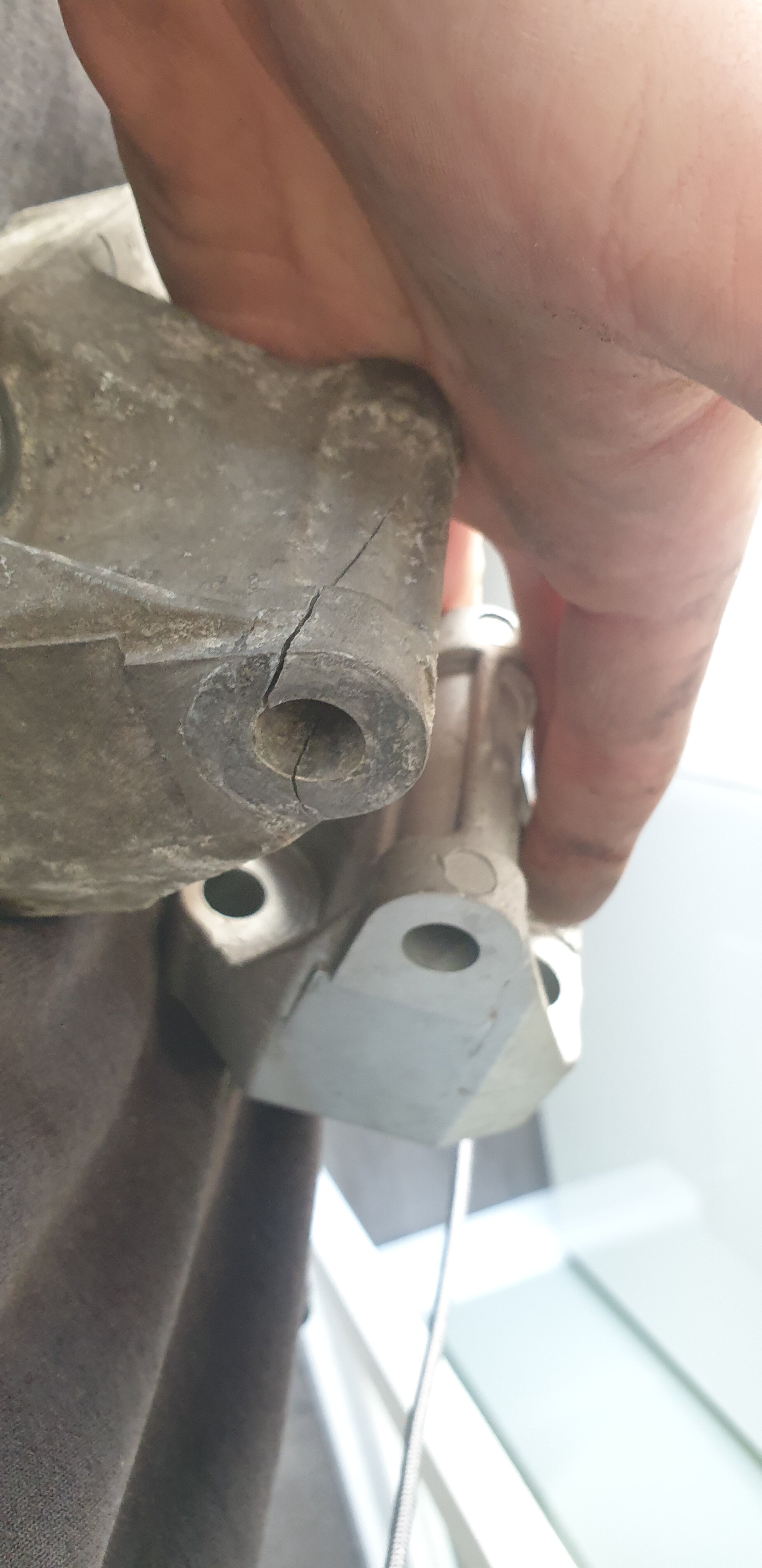

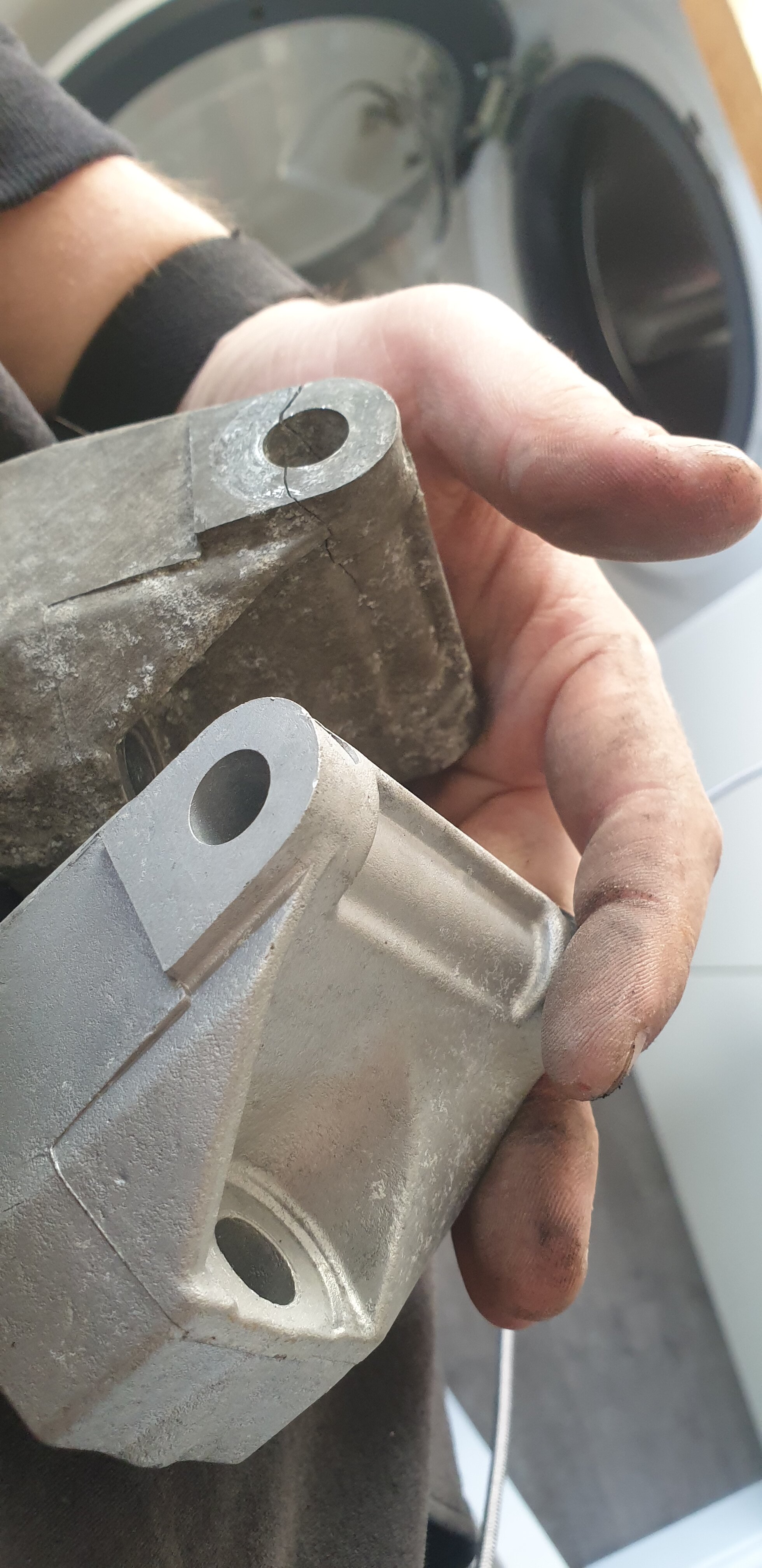

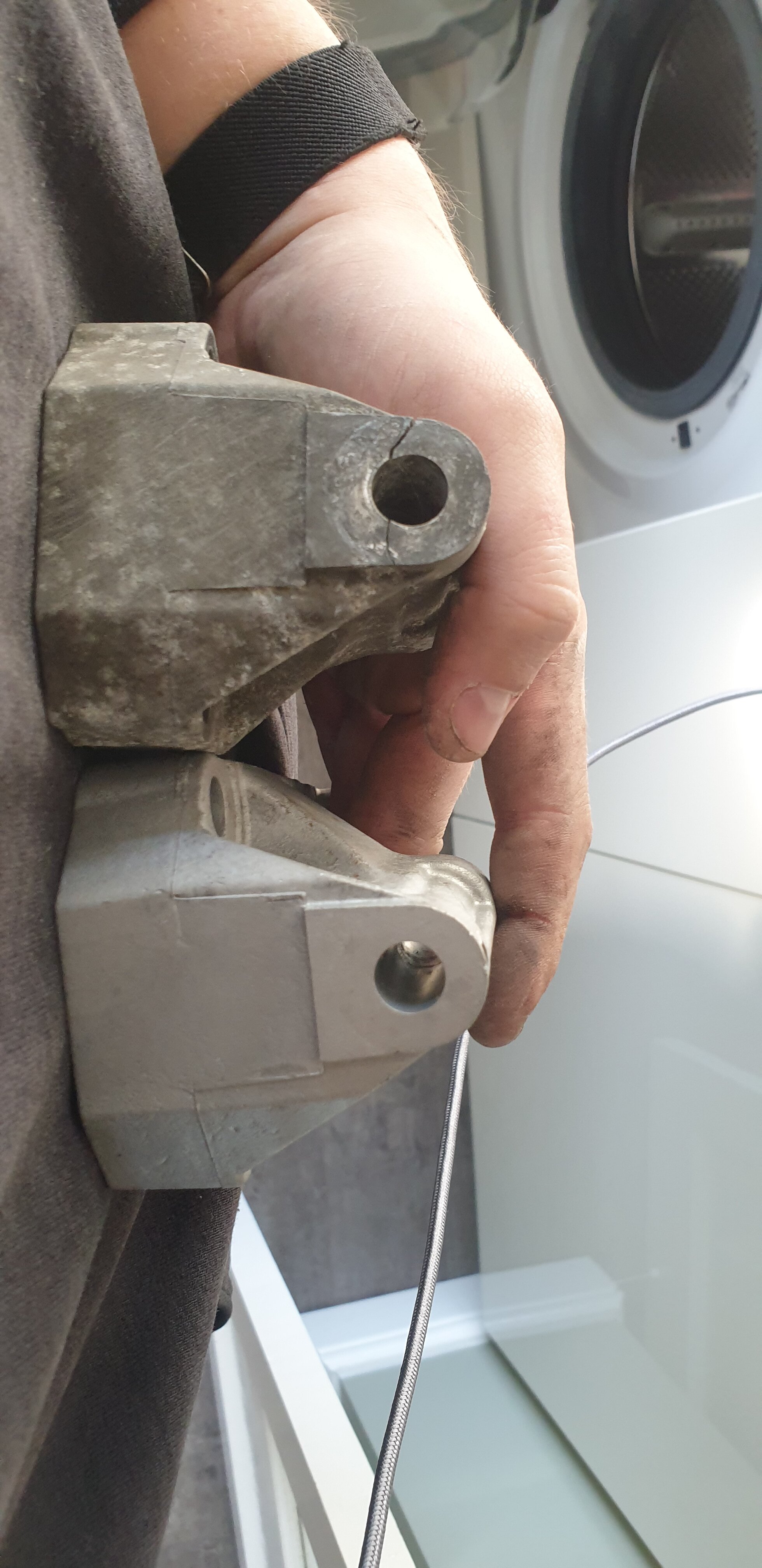

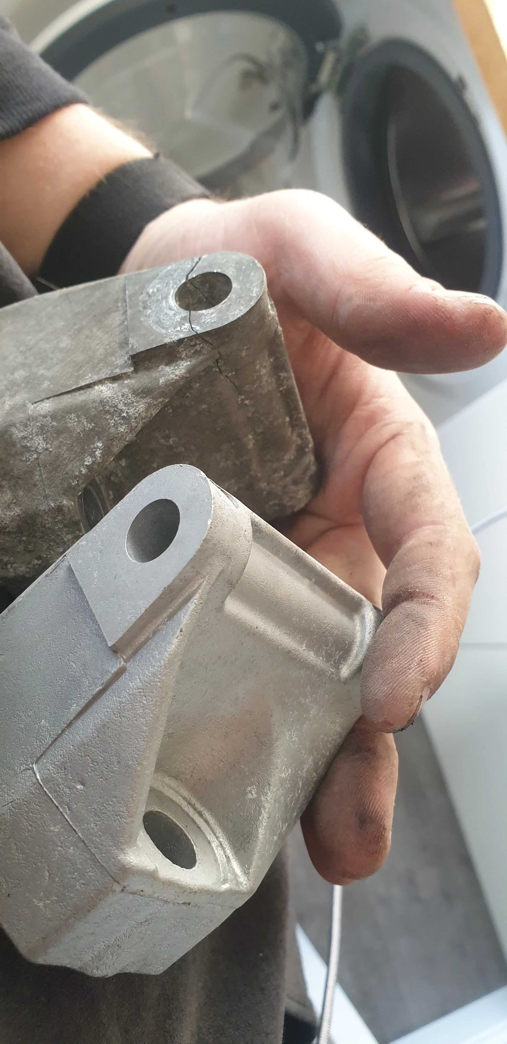

With that in mind I wanted to change the alternator bracket/mount as I got a good used one from @nath&alex which was all lovely and sodablasted. Cheers again Nath🙌
The old one was erm...
Not worth the risk in my eyes, got the new one in and cleaned my tensioner bar up too. Piss easy to work on this compared to the Meg, I reckon I could swap an alternator in 5 mins on this, it's a dream to work on without all the bullshit in the way
Charged the battery, took it for a quick spin and it's spot on. Needs a good bloody wash though! It's been 4 months since I last washed it🤣 Seeing the sodablasted bits makes me want to do everything now

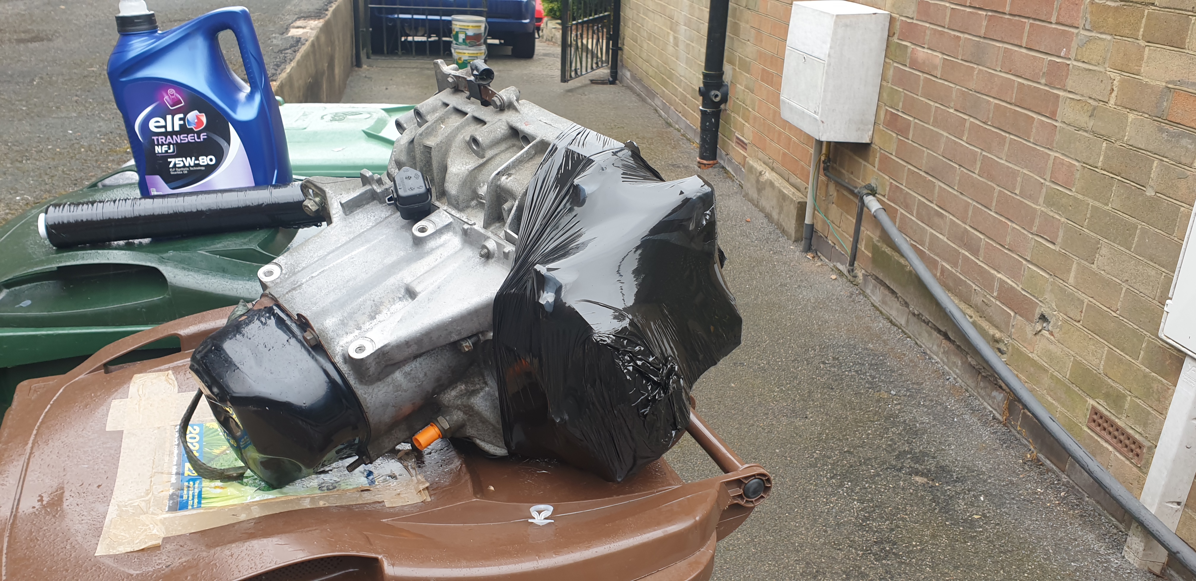

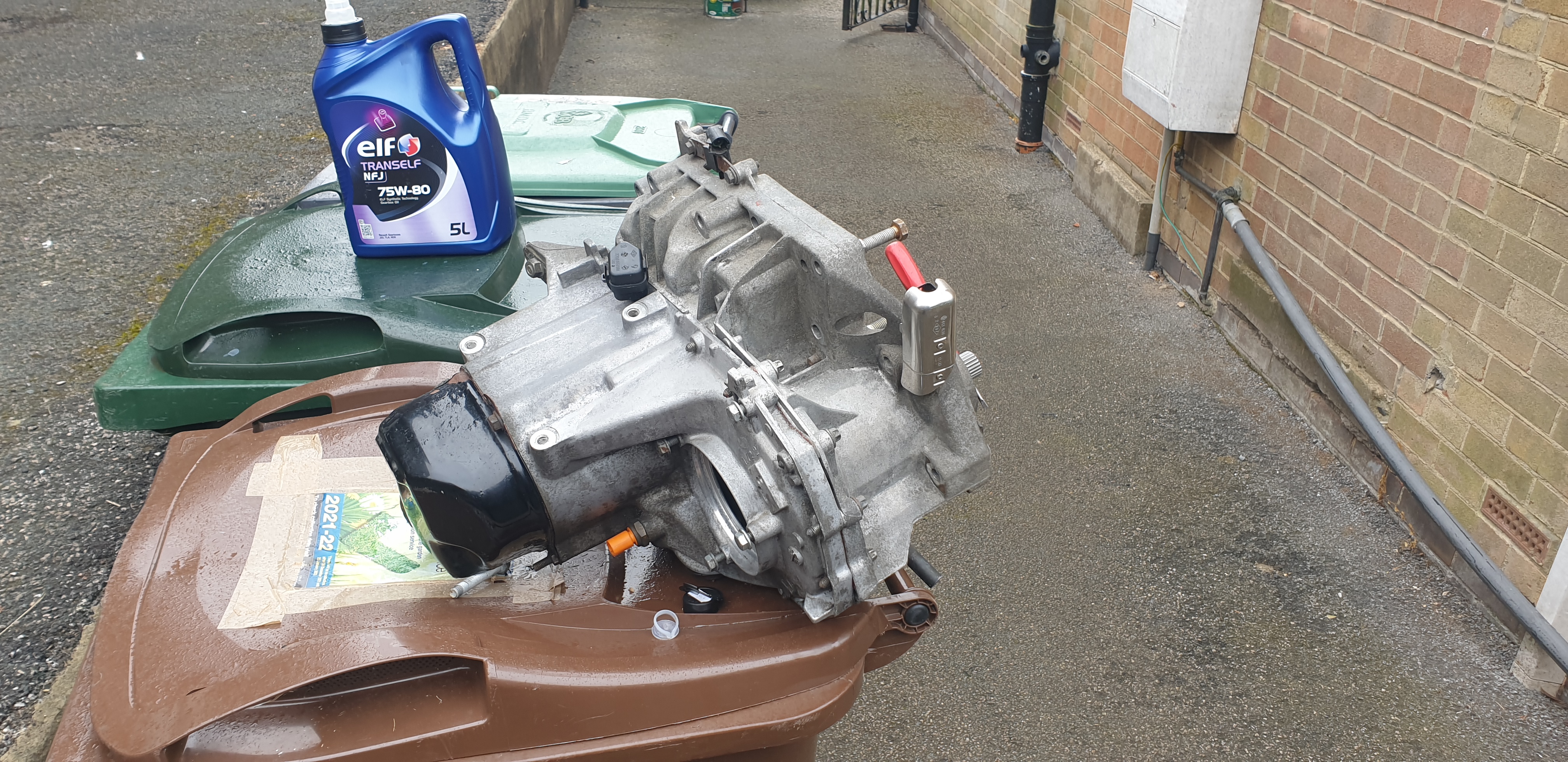

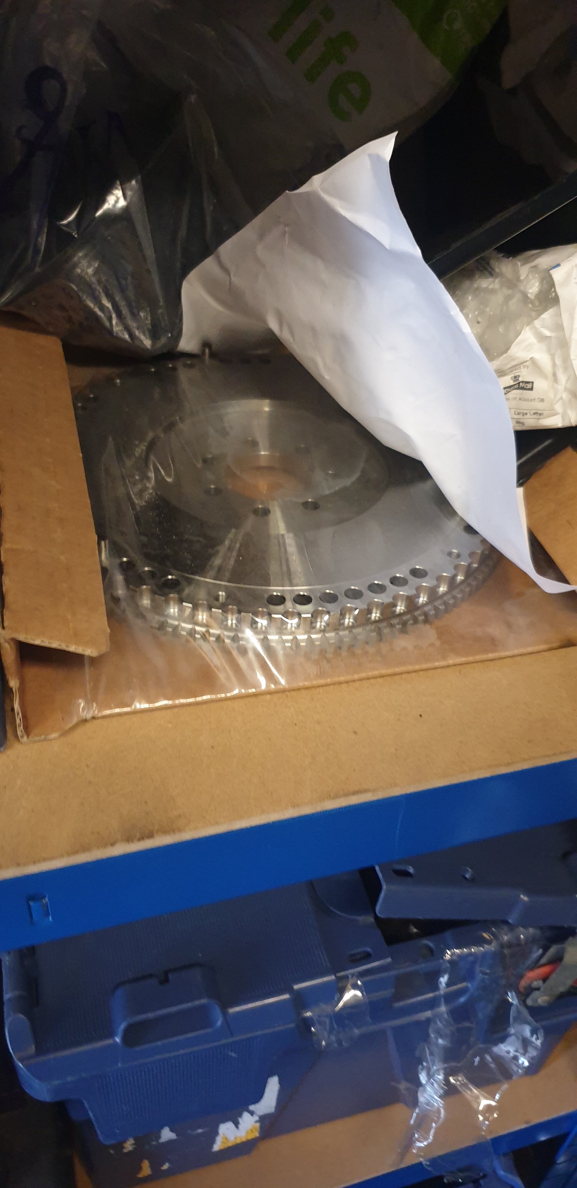

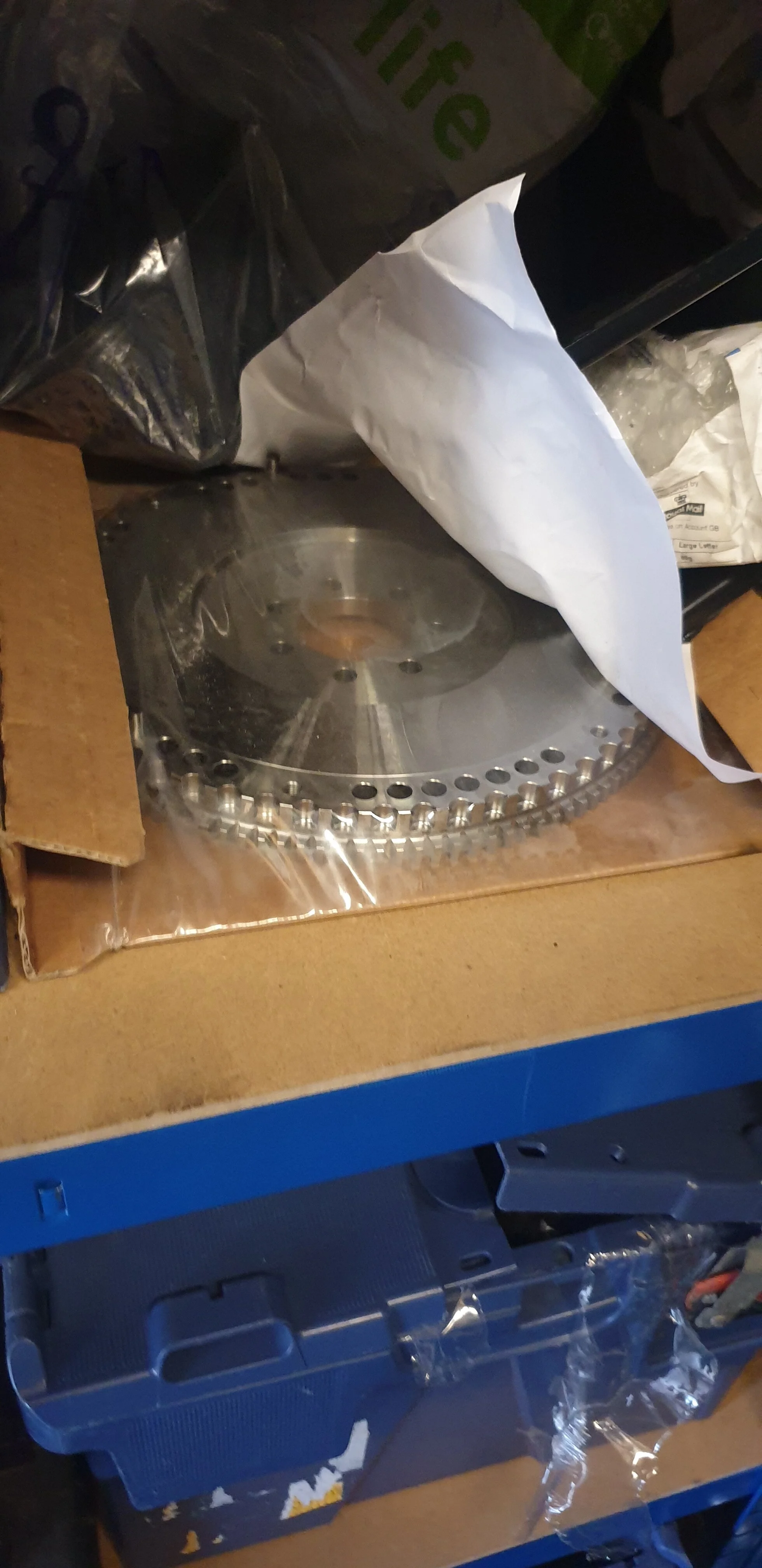

A @NorthloopCup rebuilt box with a Quaife and Mégane 5th gear, slung some oil in the diff and wrapped it to sit on the shelf for a bit. And a TTV lightened flywheel

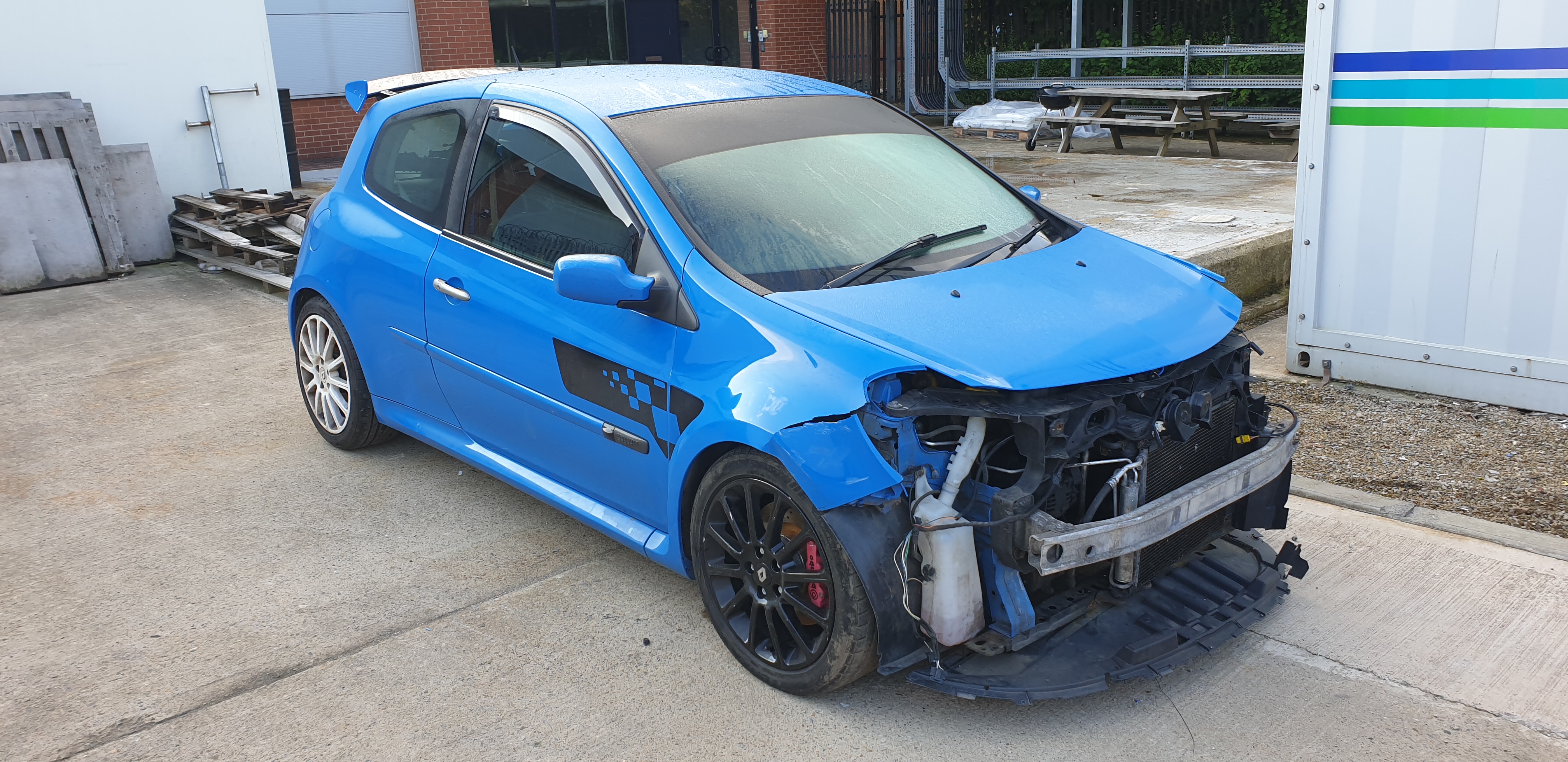

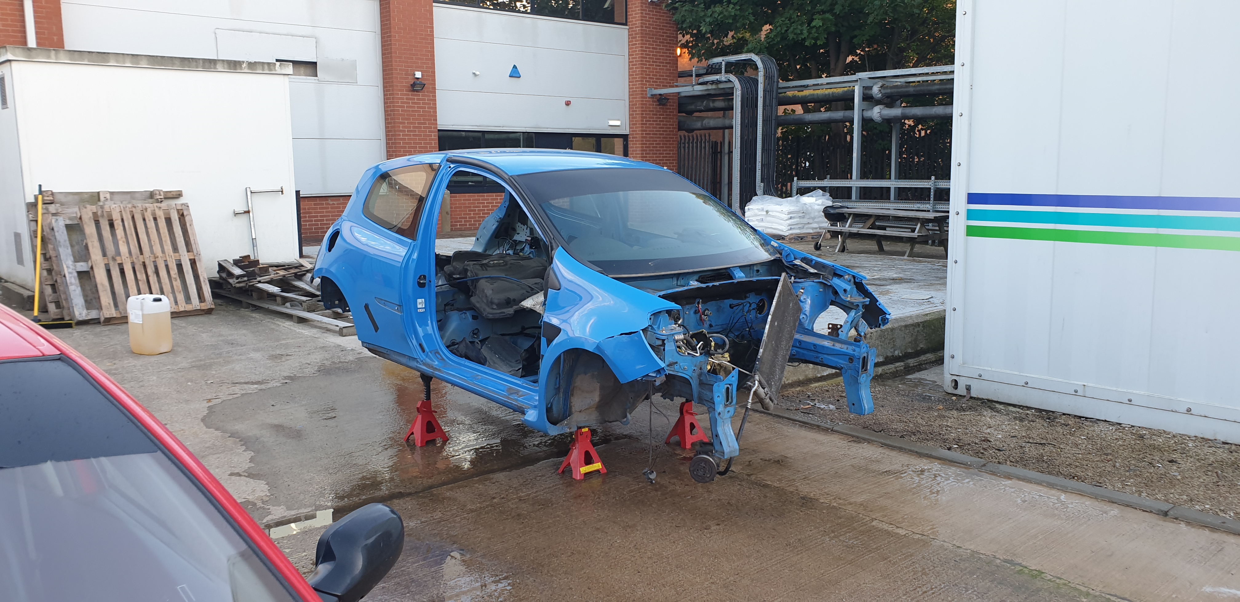

The 197 has donated a few parts to the cause
#RestInPieces
View attachment 1561616View attachment 1561617View attachment 1561618
#RestInPieces

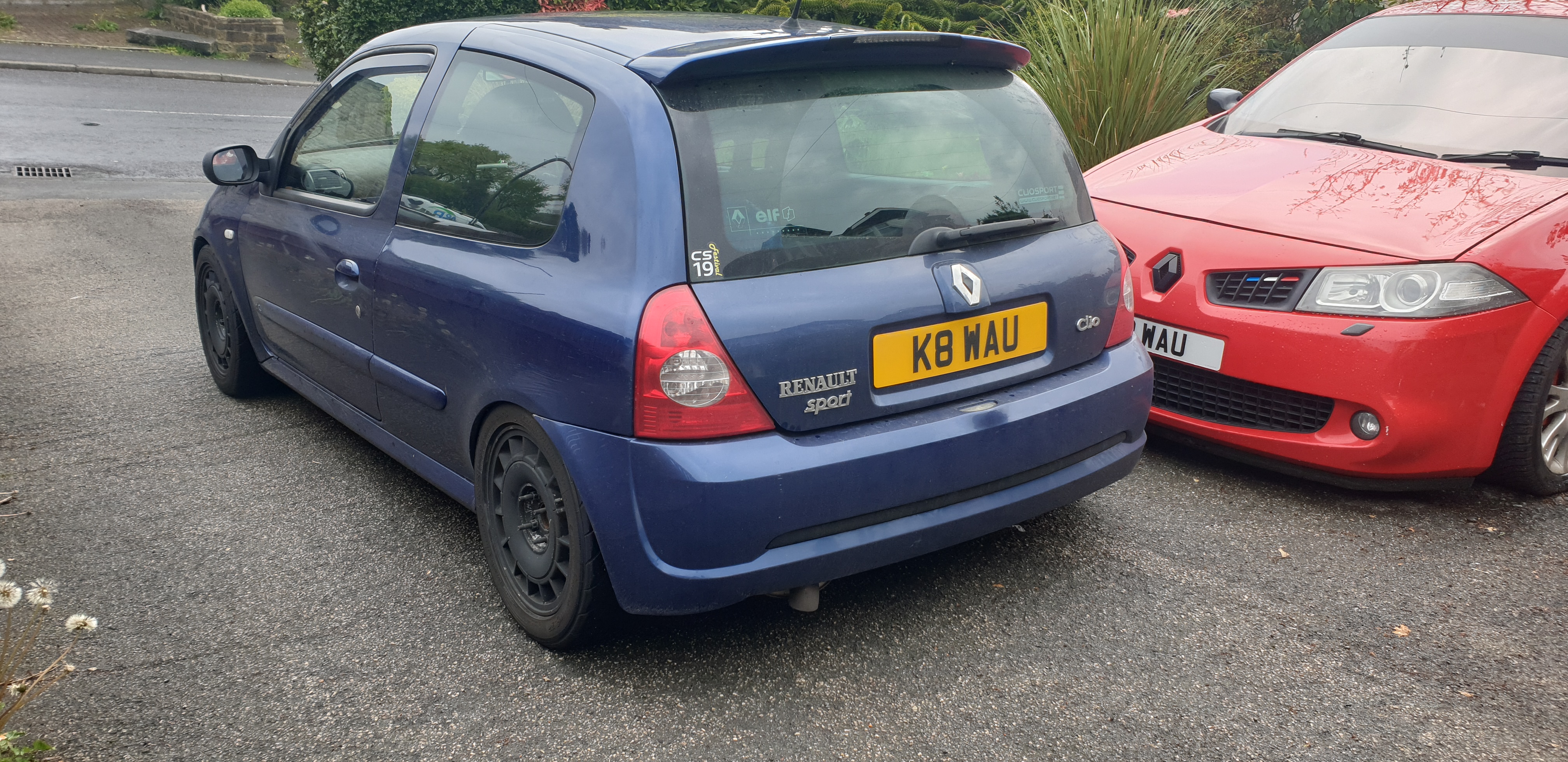

Been using this for the past month, never fails to put a smile on my face when pushing round the b roads on the way to and from destinations
Only issue, common as f**k issue...🙄🤣
Grabbed some pics of it with the Mégane
Now tucked away for the winter. Might sling a new cover on it at some point, the one from last year is shagged but that's what I expected for £15 tbh🤣

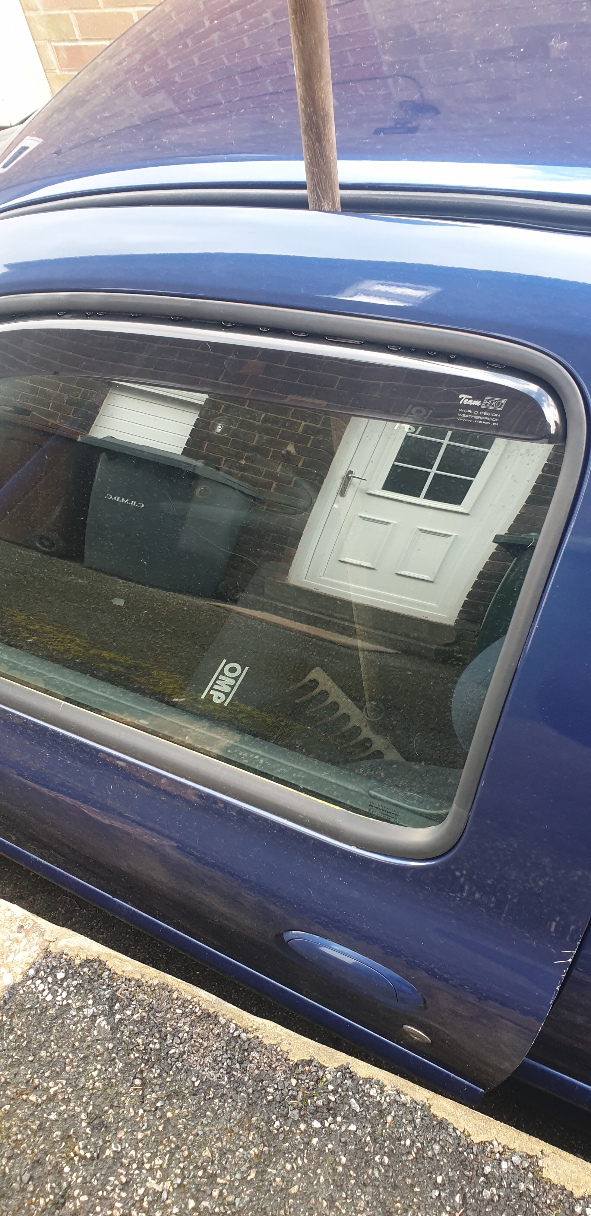

Things guaranteed

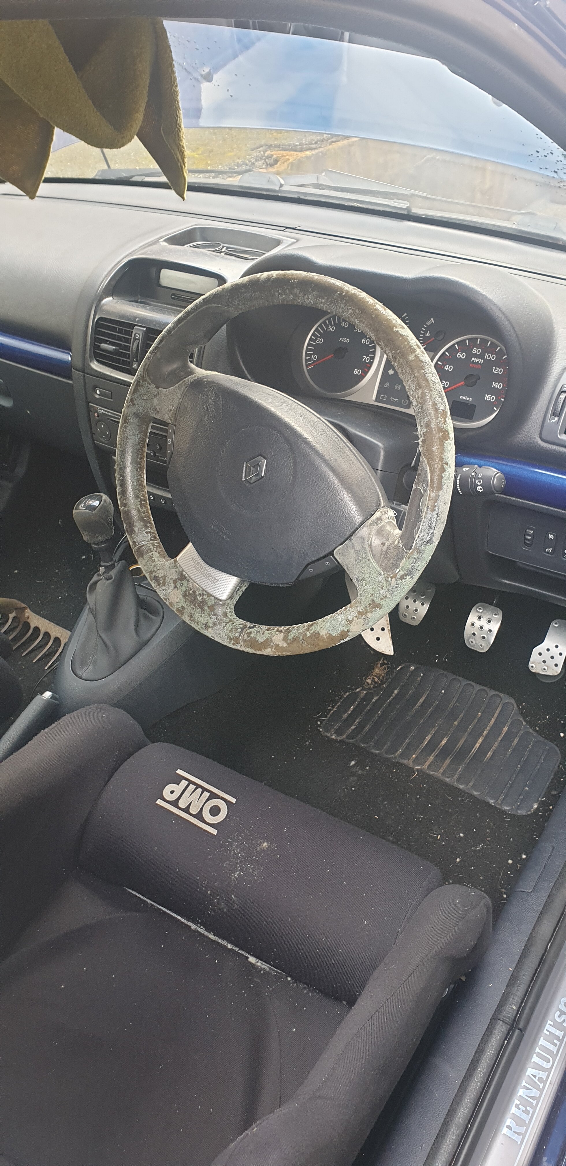

Life, death, taxes, my steering wheel turning gopping every winter when I don't use the car

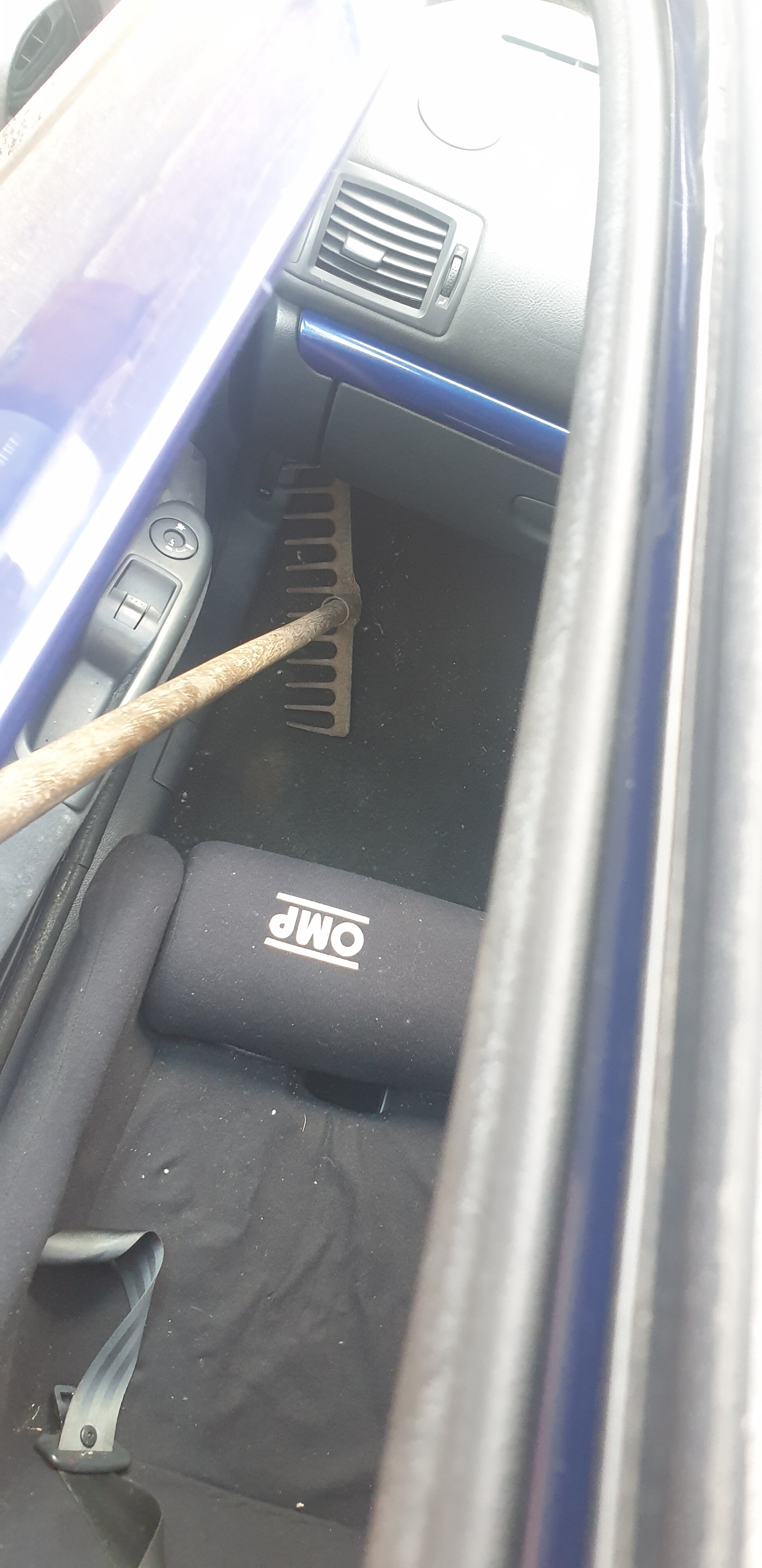

I never learn and I do it every year, park the car close to the wall, so close that I cant even get a key in the lock🙄 Ordered some enzyme cleaner and a heater to put in there
Once I'd sketchily pulled it a few inches I had enough room to unlock the door and get a rake in to pop the bonnet and press the central locking button😂

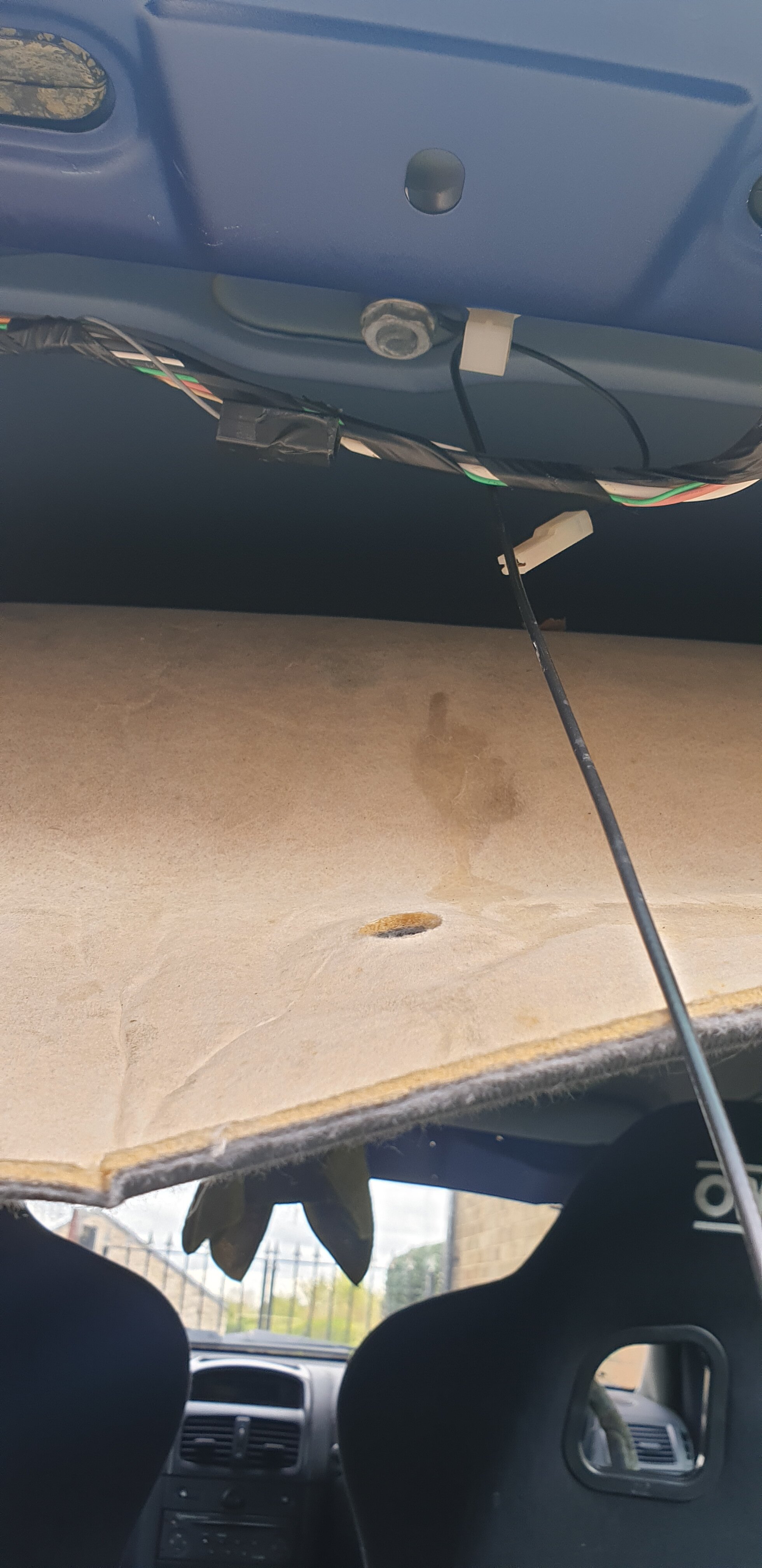

Started to try and find where the moisture is coming from because inside was quite wet in loads of places. I had a suspicion it was the aerial base
Stripped back
As suspected
Fresh drops of water on the headliner. Because of the headliner backing material it just drops on there and runs down to the front with it being parked on a slope
I've blebbed the base and hole with some mastic so with any hope that keeps some of the water out
MOT is due April so I'll tax it on the 1st, get the Mégane booked in for some work and get it stripped at work for a few goodies to be fitted
Bought another engine the other week so once I'm happy with the car I can build up a 205bhp+ NA engine for it. I want to get all my other things fitted this year and enjoy it with a lightened flywheel and Quaife for a bit before just going balls to the wall
View attachment 1583910View attachment 1583911
Stripped back
As suspected

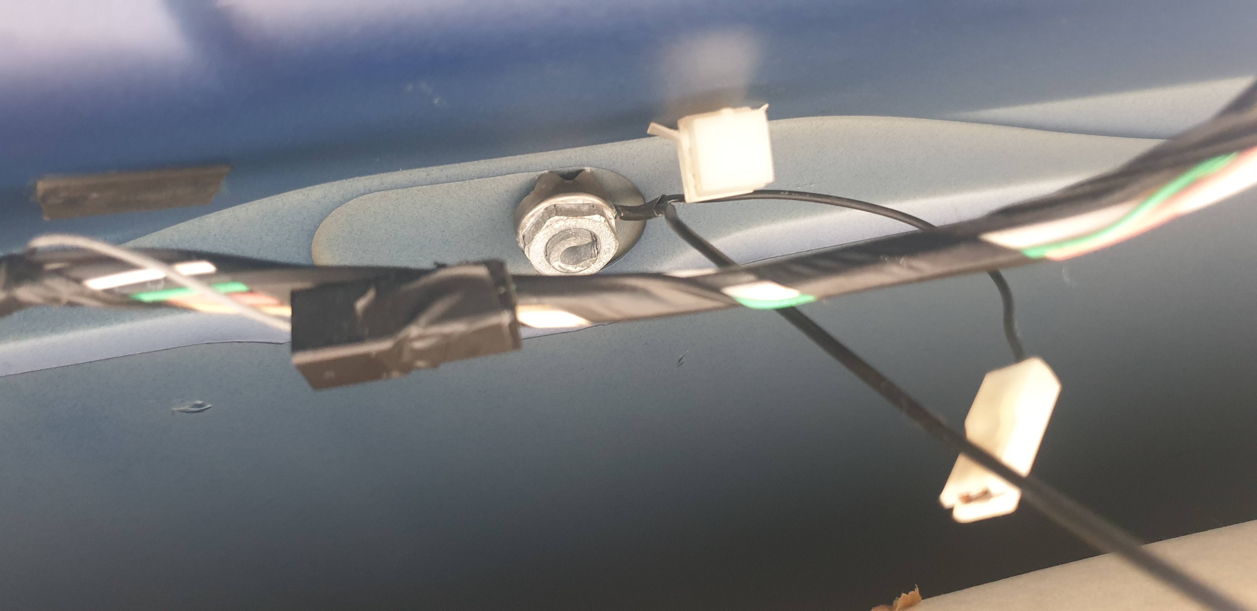

One of the first things I do with cars that have electric boot releases, where the battery is also in the boot is to fit a pair of wires from battery down to a connector which I cable tie behind a bumper - I made up a little patch lead to go between my lithium jump pack and the connector so with minimal fuss I can power up a locked car to access boot and battery.
Every time I use it I marvel at my own genius for a while before discovering my jump pack is flat or something else equally dumb.
This sounds like too much work for a shaved ape like me, the reason I couldn't unlock it was because the UCH is probably underwater😂😂😂
