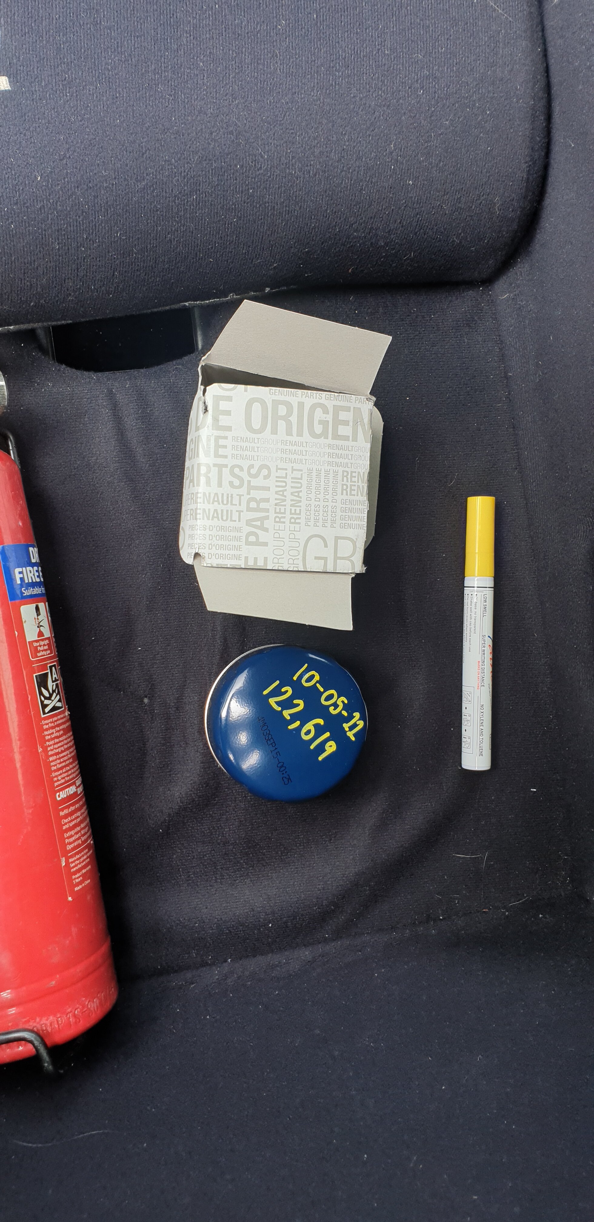

Probably one of the last oil and filters this engine will see. I'm hoping that this autumn I'll be able to build my Frankenstein engine
Genuine filter and Helix 5w40, this engine has had this oil for the past 20k. Done it zero harm so far

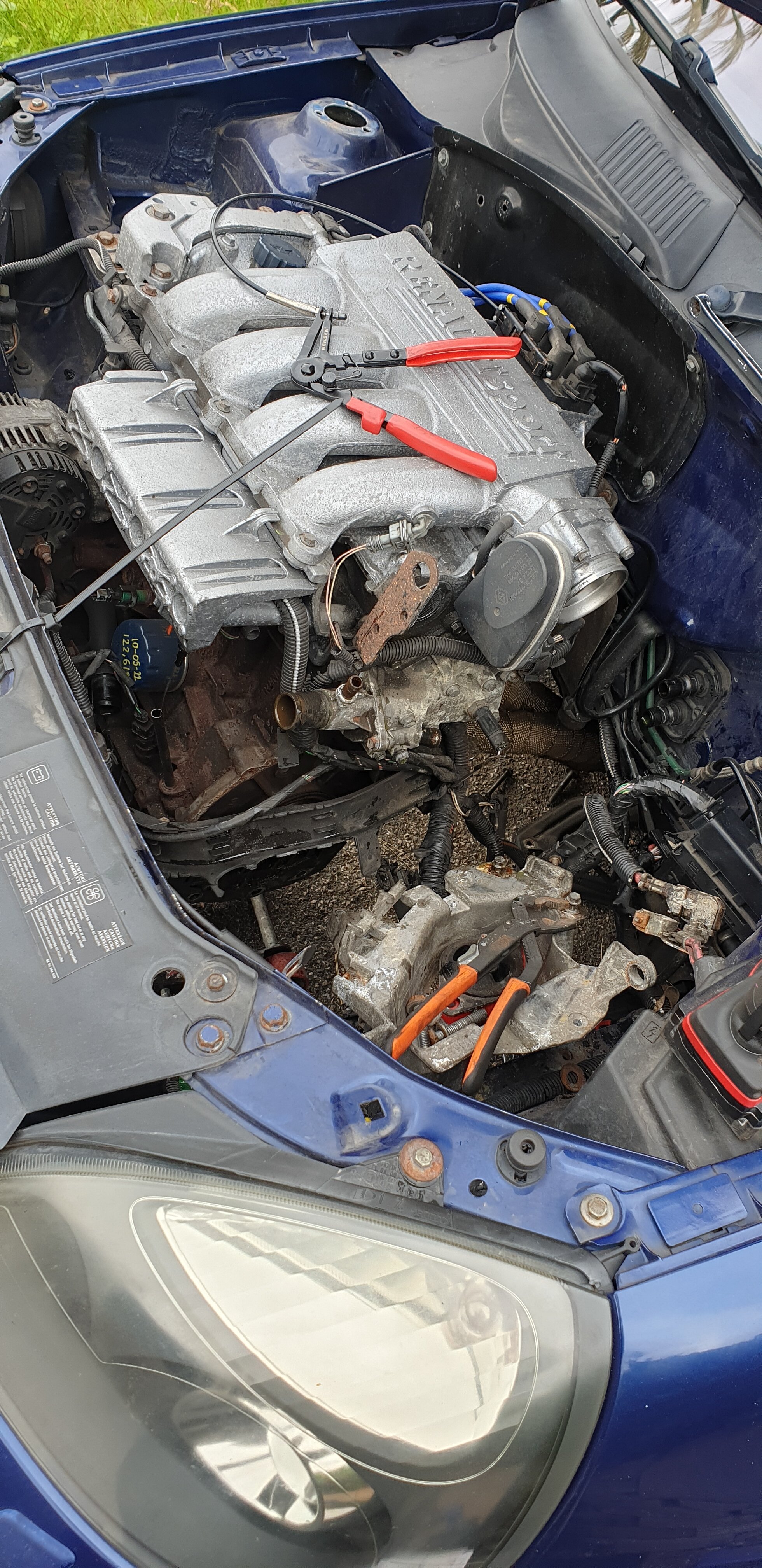

Started the day, loaded all the tools in the Clio and set off to work. I've had the week off work and I said I wanted to at least get the cage in this week
Started pulling things apart, seats and plastics out which took about 45 mins as I needed help for the middle 4 nuts. Decided. it would be best to run the battery cable for the relocation now so ran some 40mm² cable

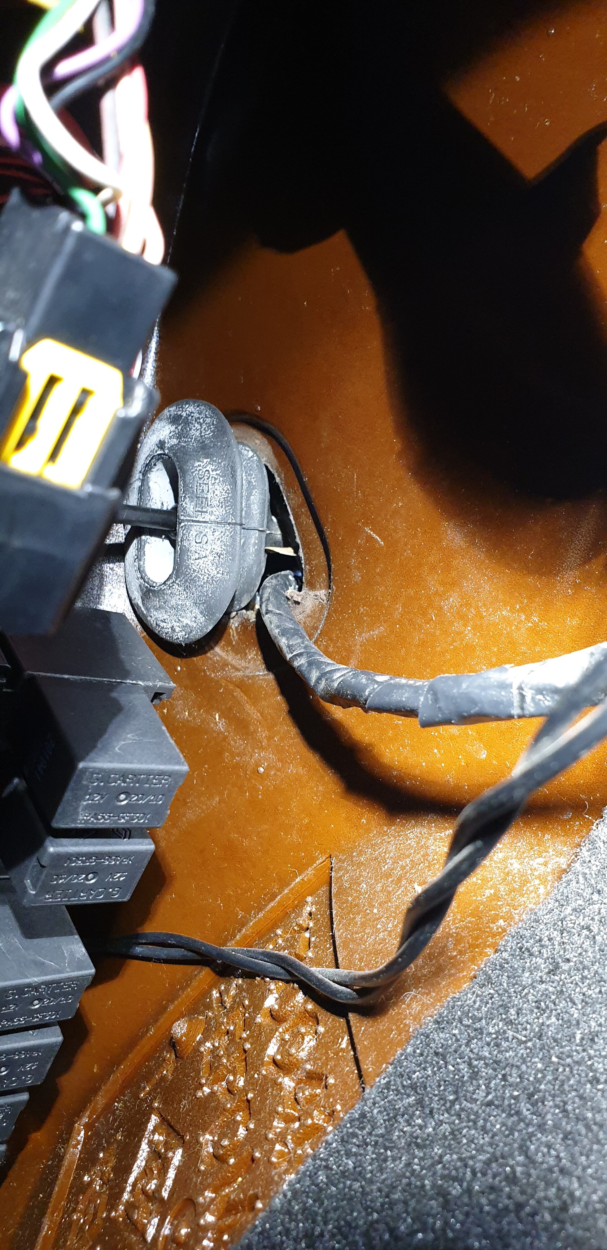

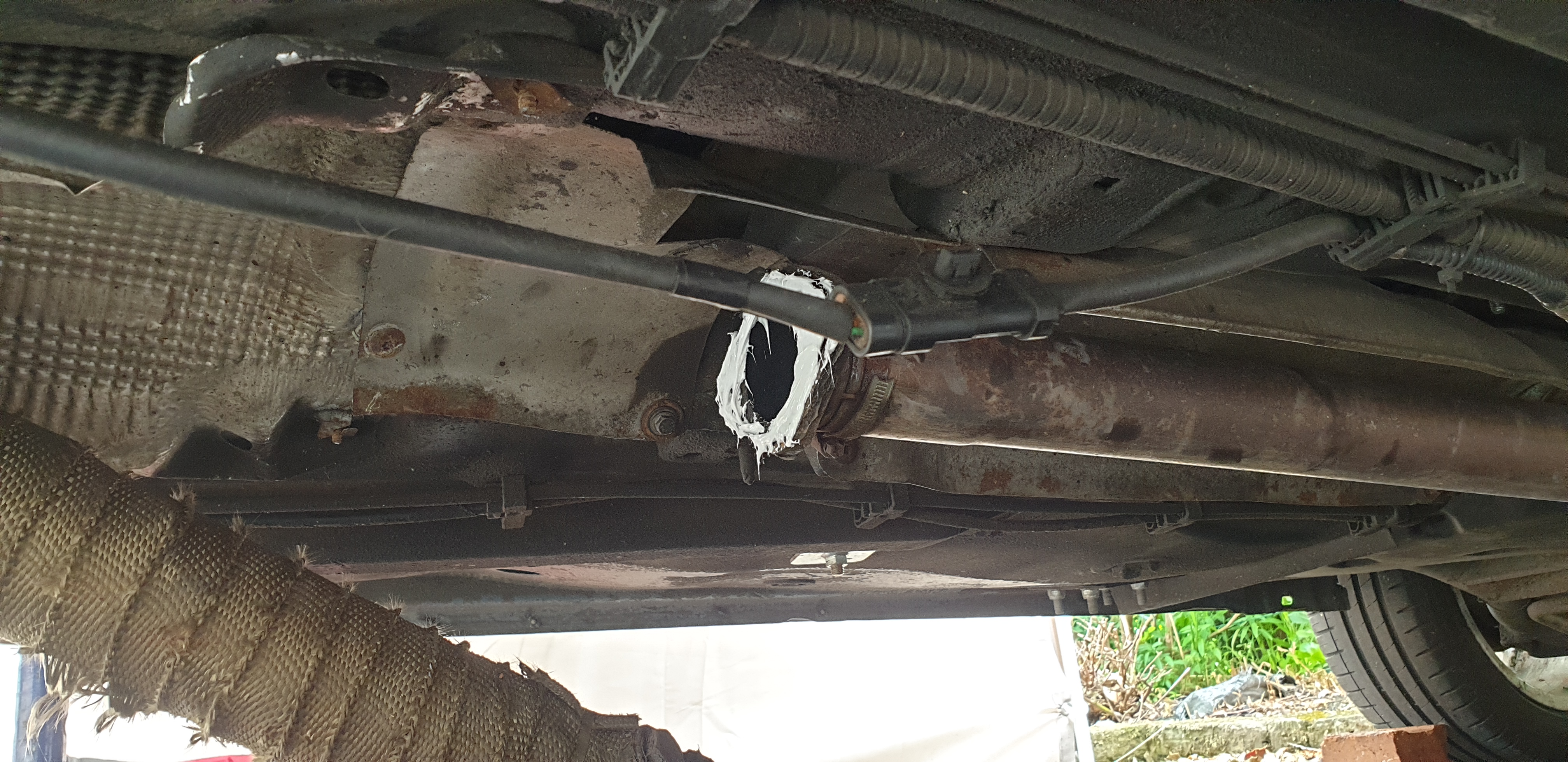

Went to cut a hole in the grommet for the bonnet pull😑😑

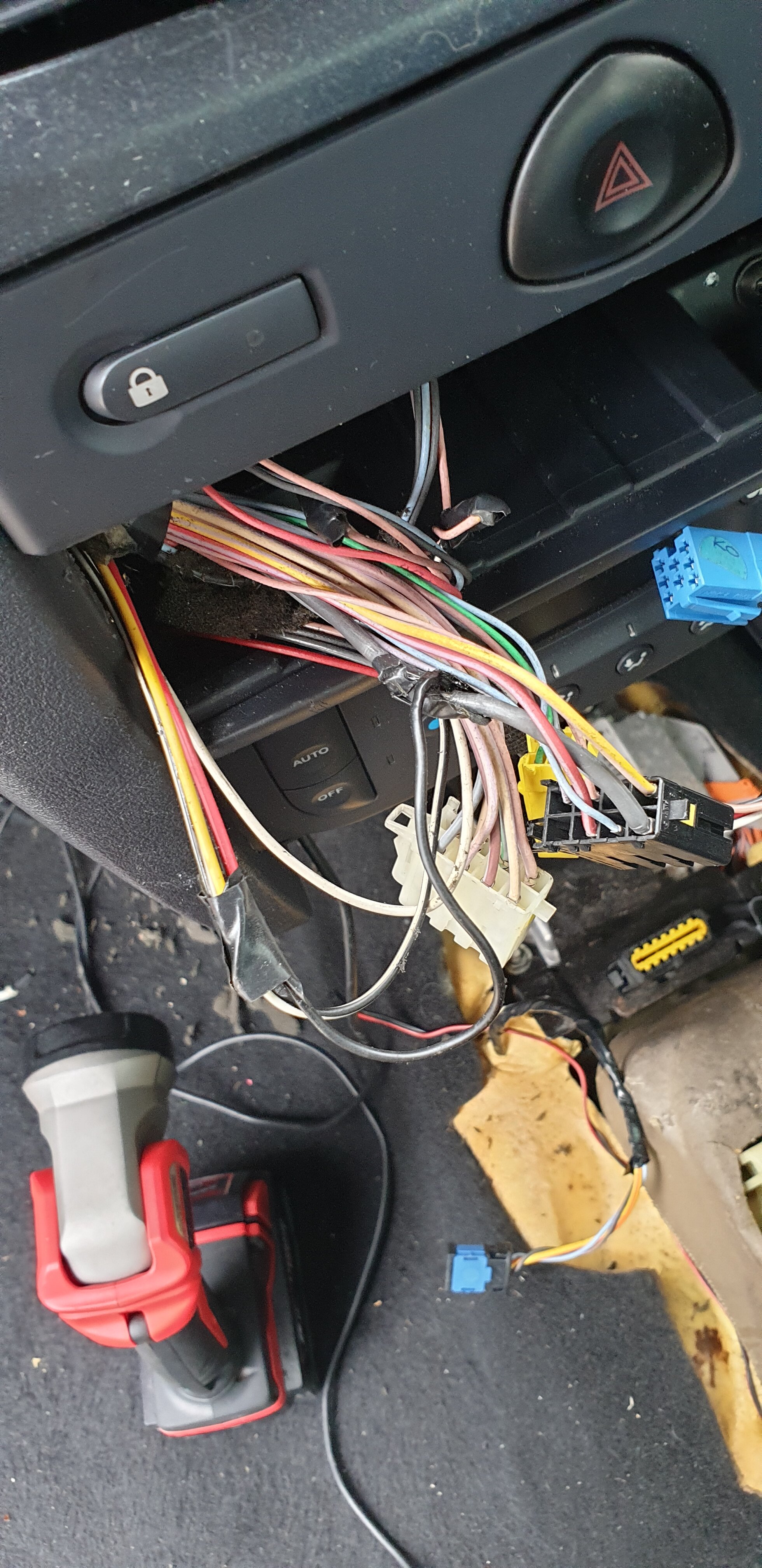

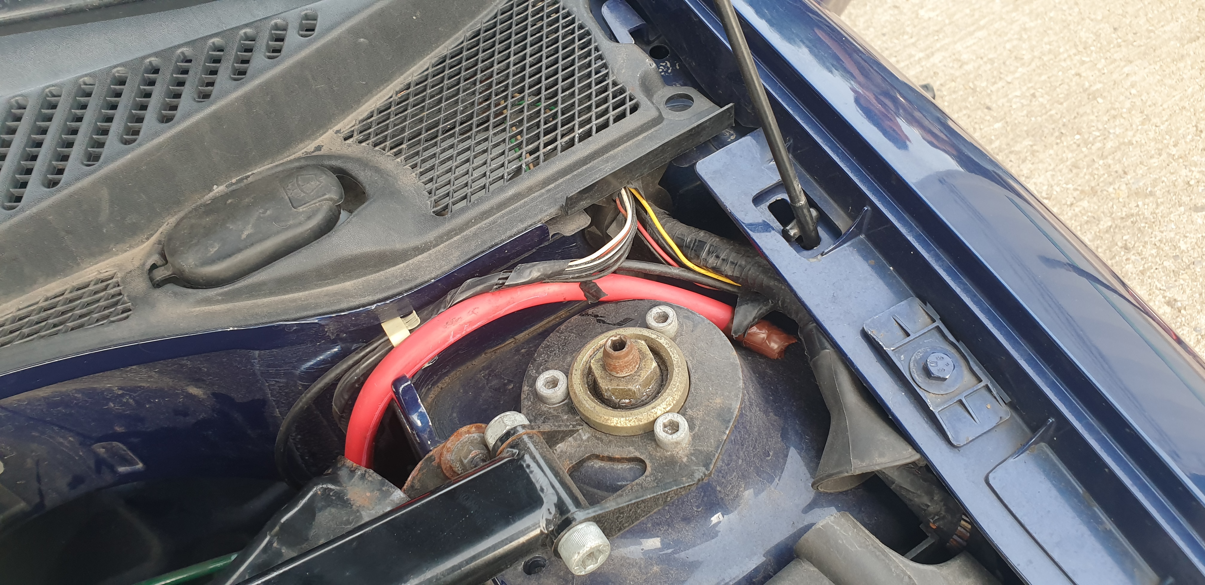

This is the attempt at wiring the alarm installer did. What a c**t, a total c**t
Got the grommet pushed back in with a slit cut to feed the cabling through. Put some 25mm backbox grommets and split conduit over the battery cable to avoid any chaffing

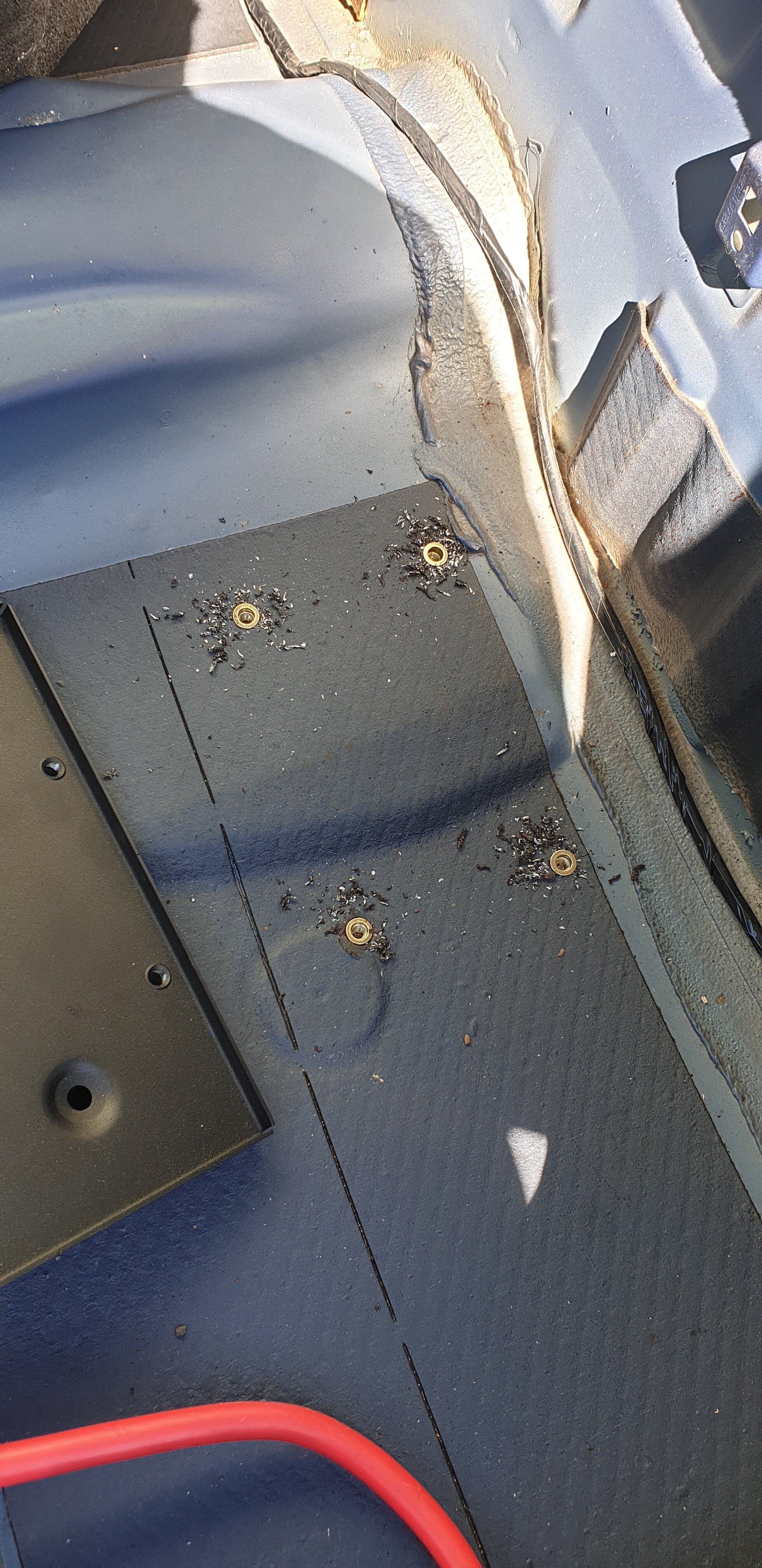

Holes drilled for the battery tray and rivnuts stuck in

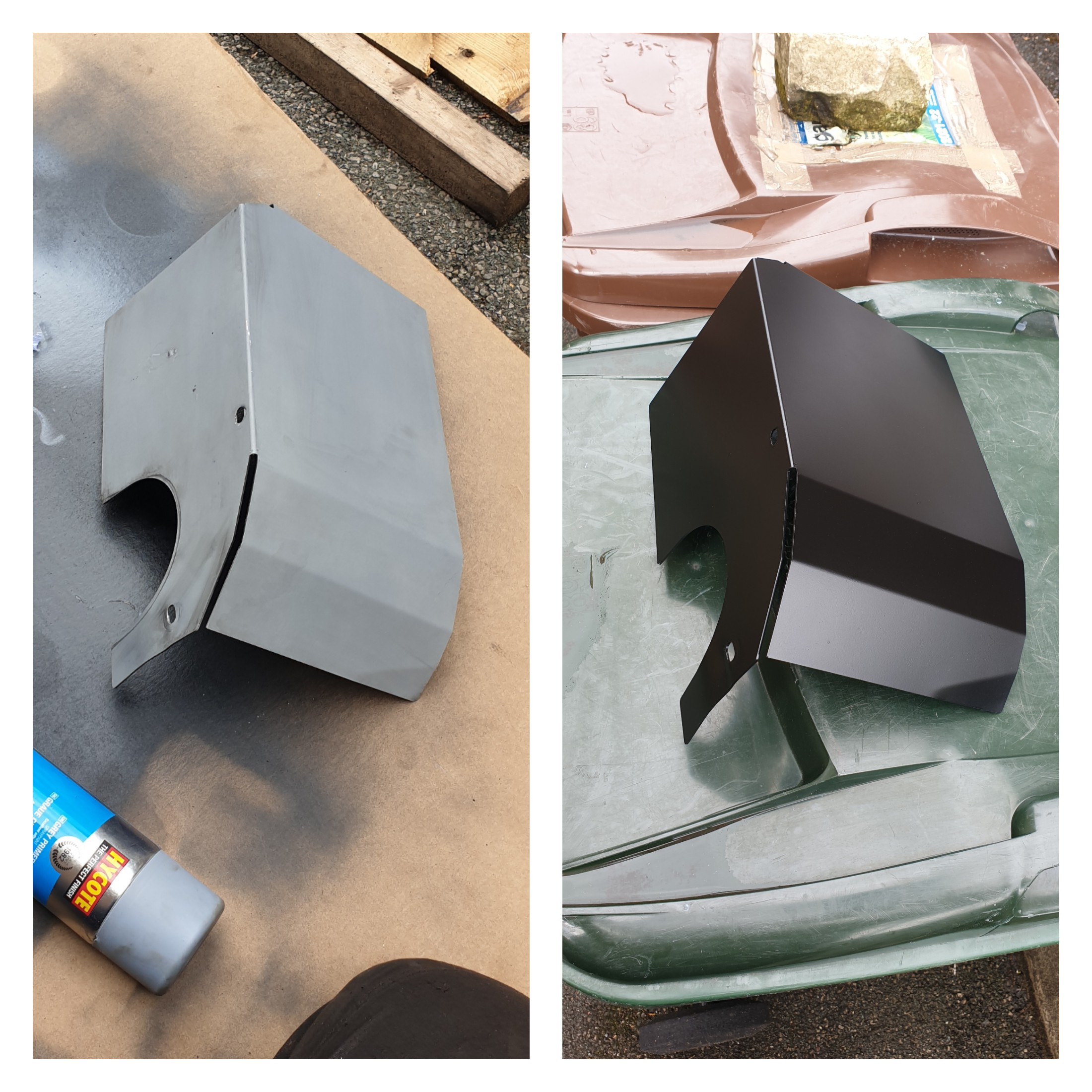

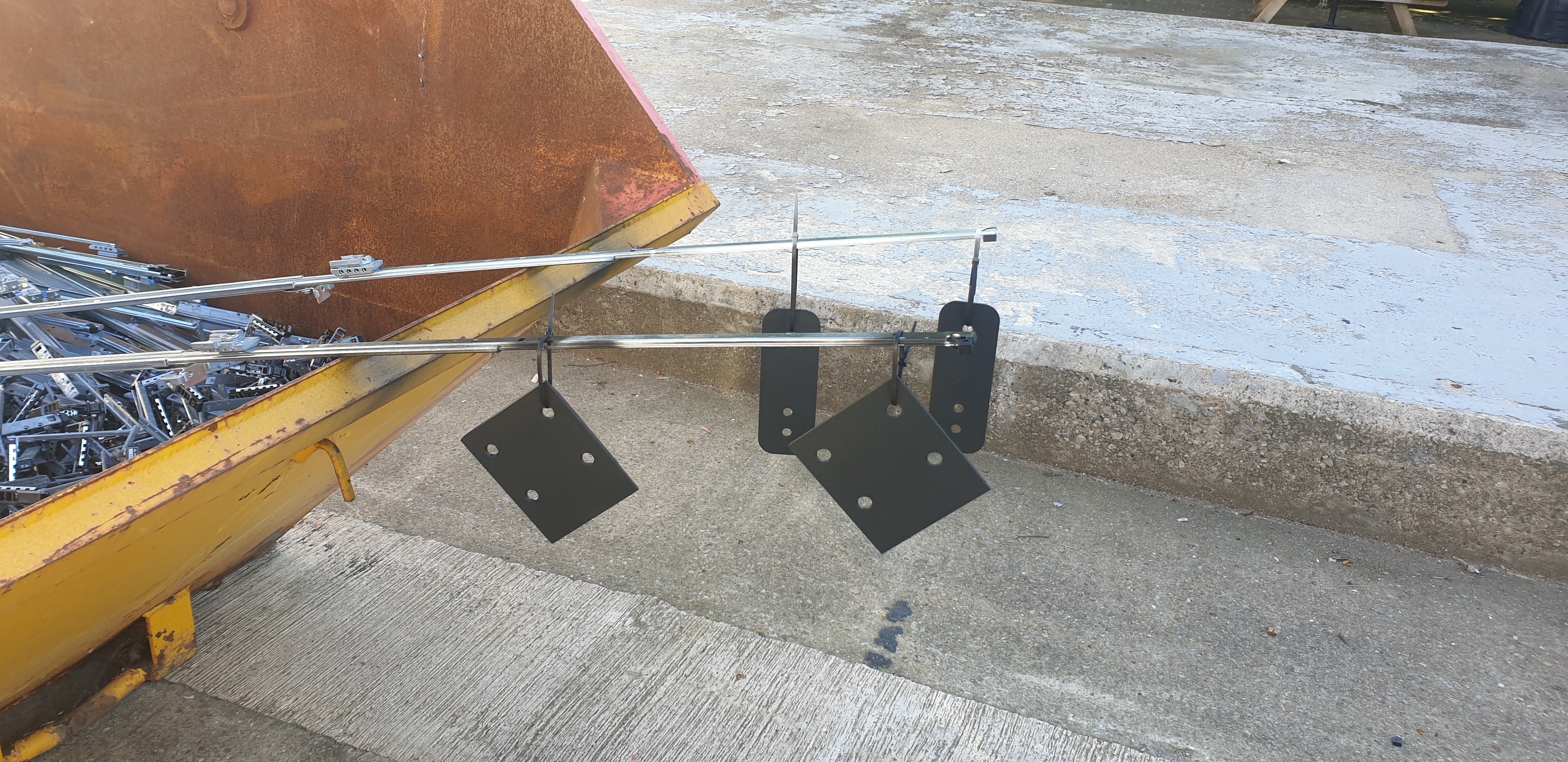

Cage spreader plates weren't painted so painted them with some truck bed liner paint. Good stuff that is

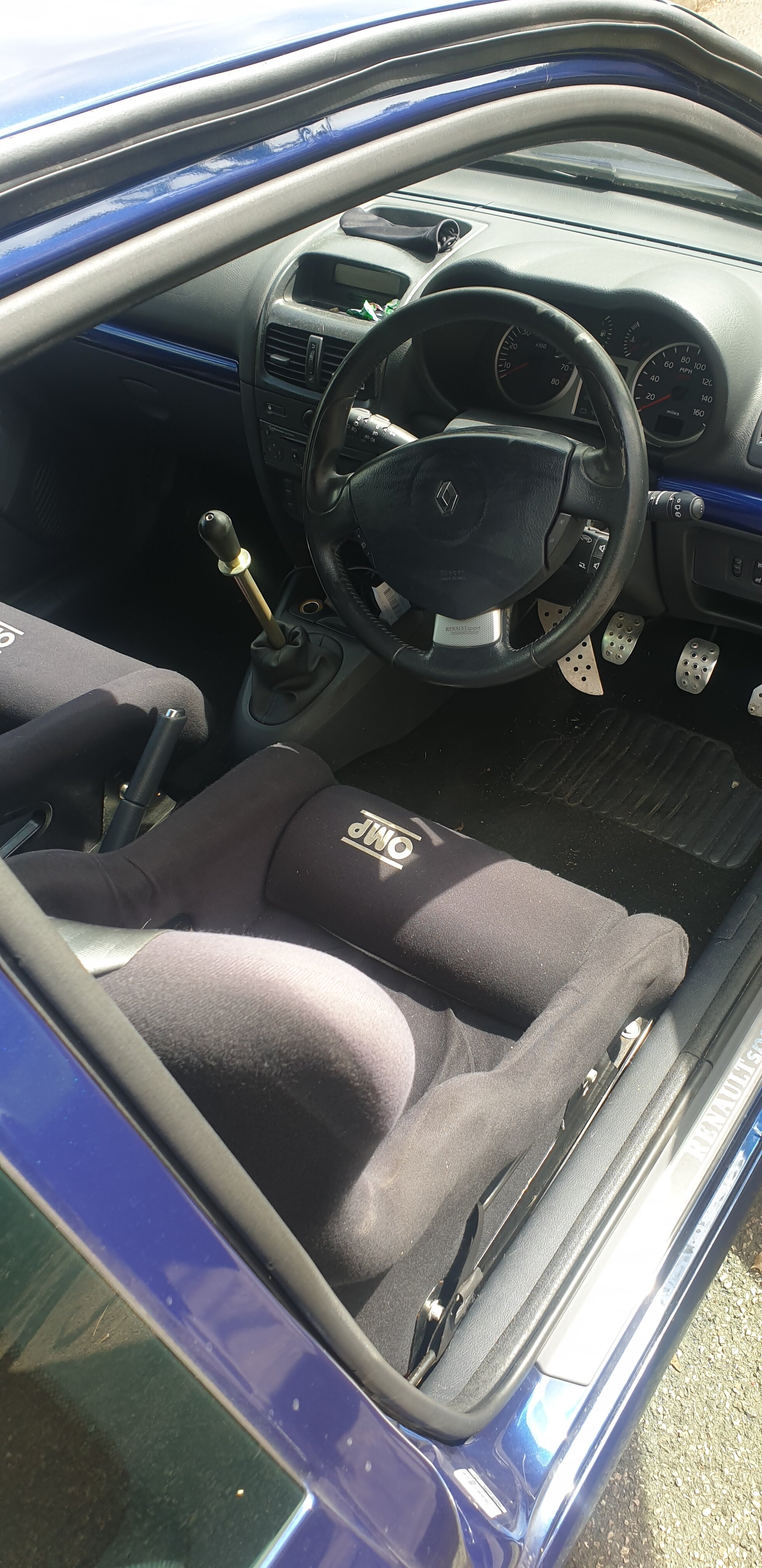

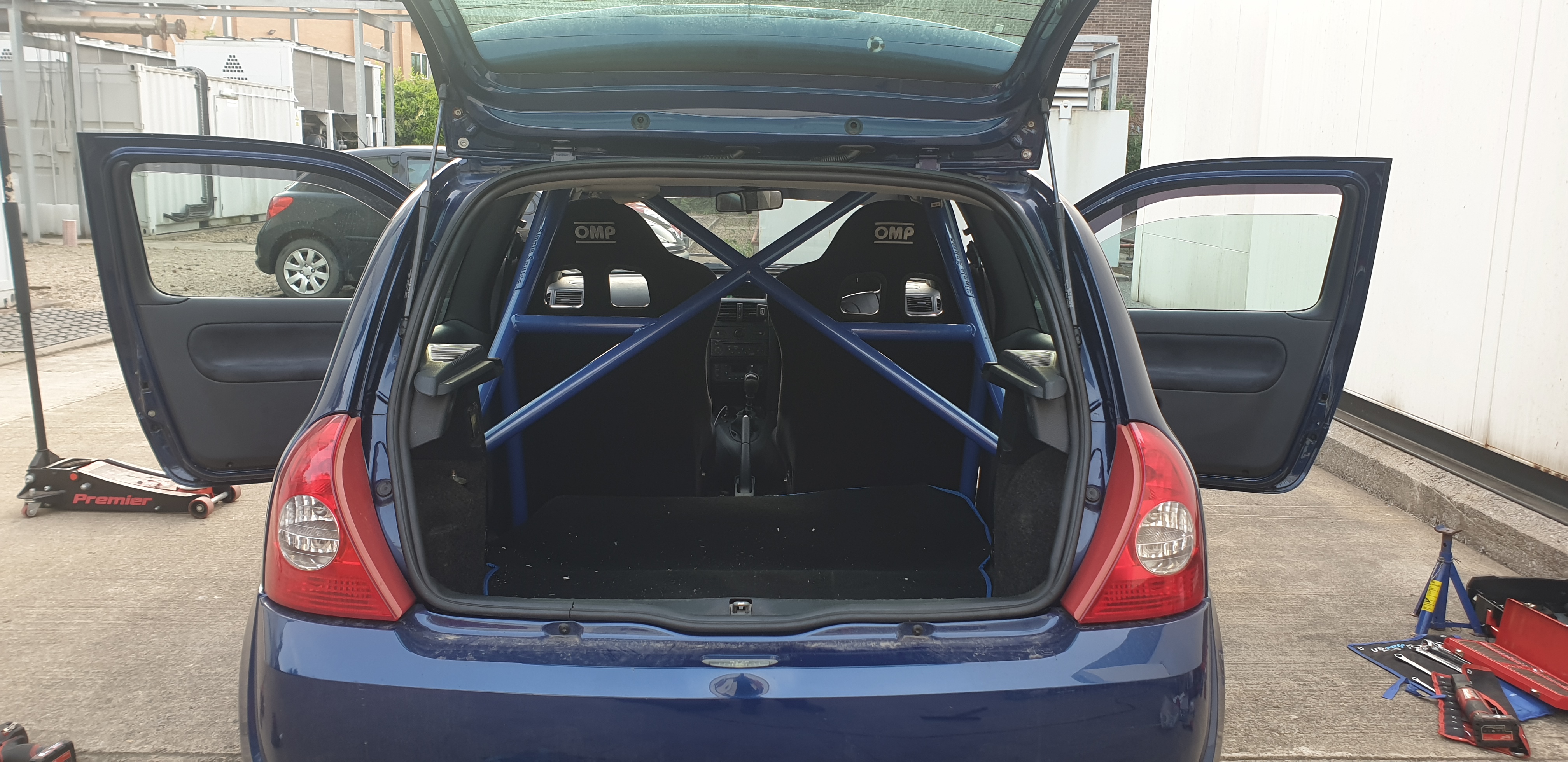

Cage put in, ratchet strapped into place, holes drilled, bolts and washers either side and done... Sounds simple yeah, still took me 2 hours🙃🤣
The finished product is spot on though. I bought this cage before covid kicked off and it's been sat at work since. The paint is mint, it pretty much matches Monaco blue which I never asked for but they must have liked me

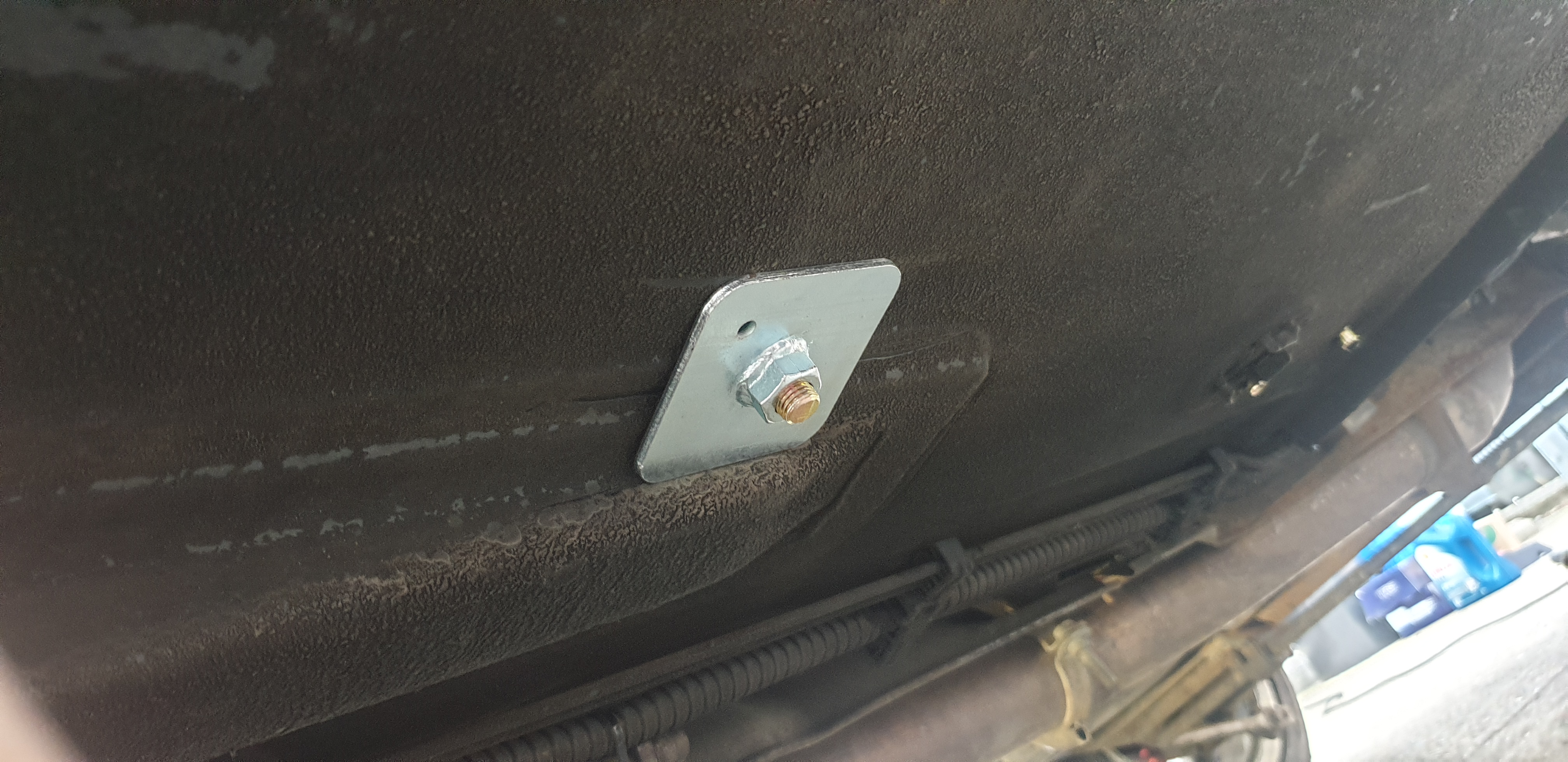

Spreader plates

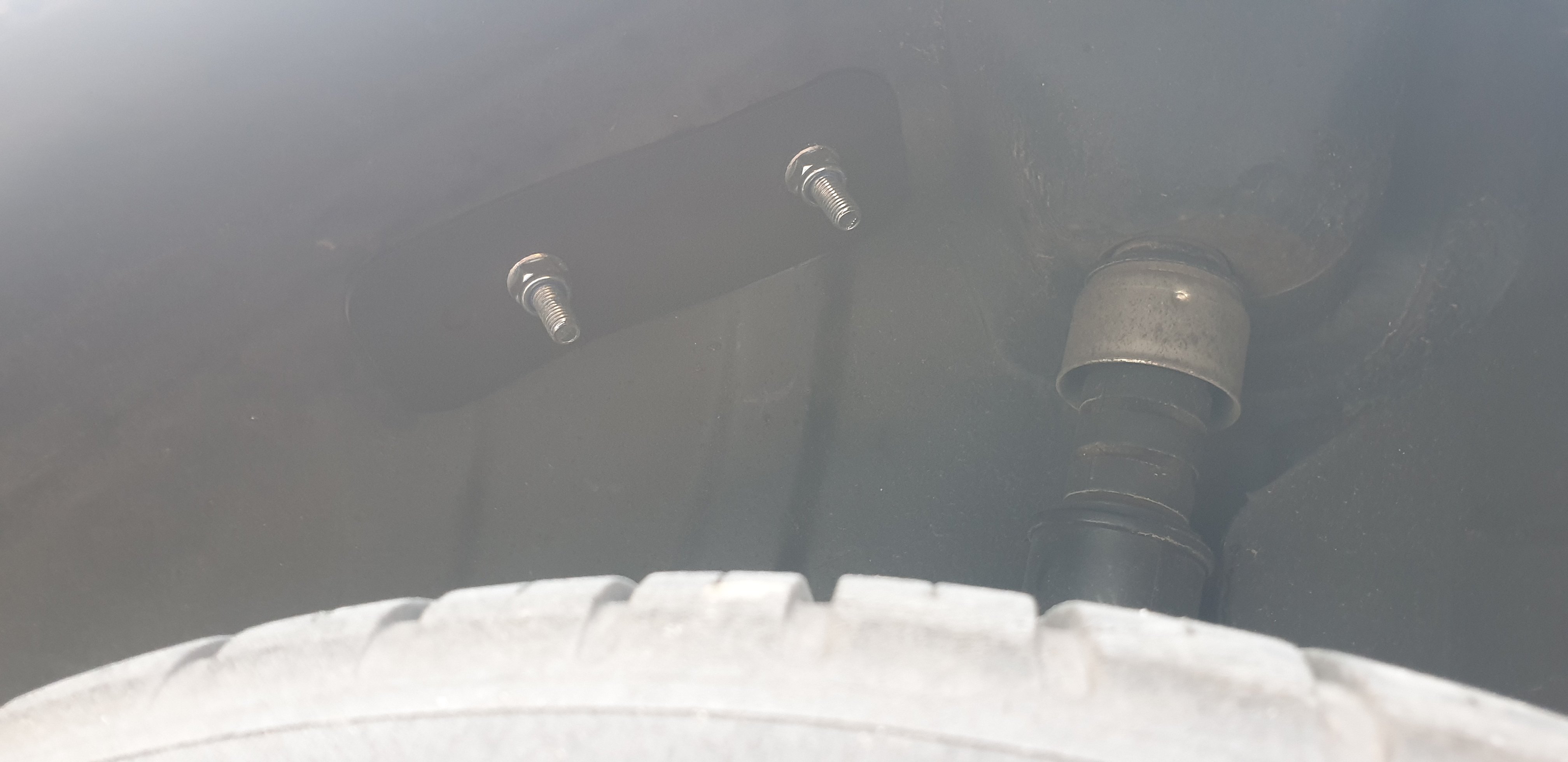

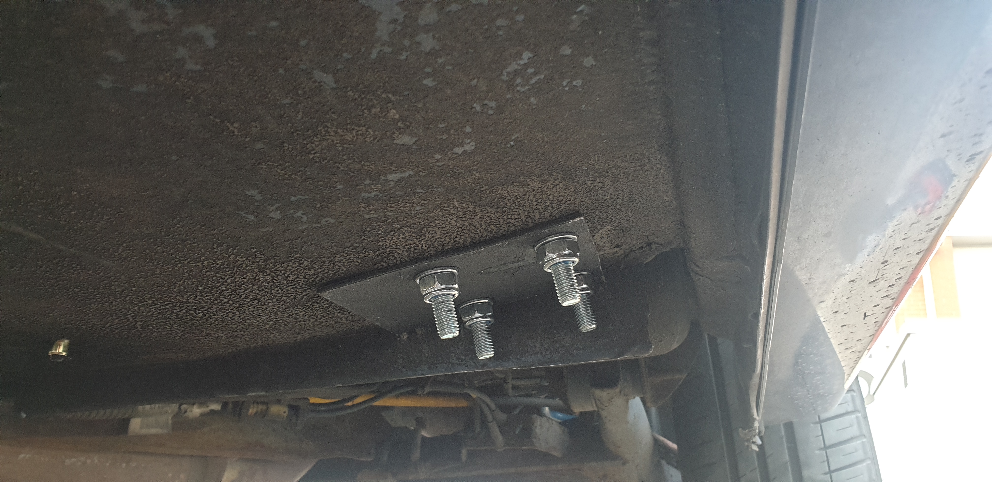

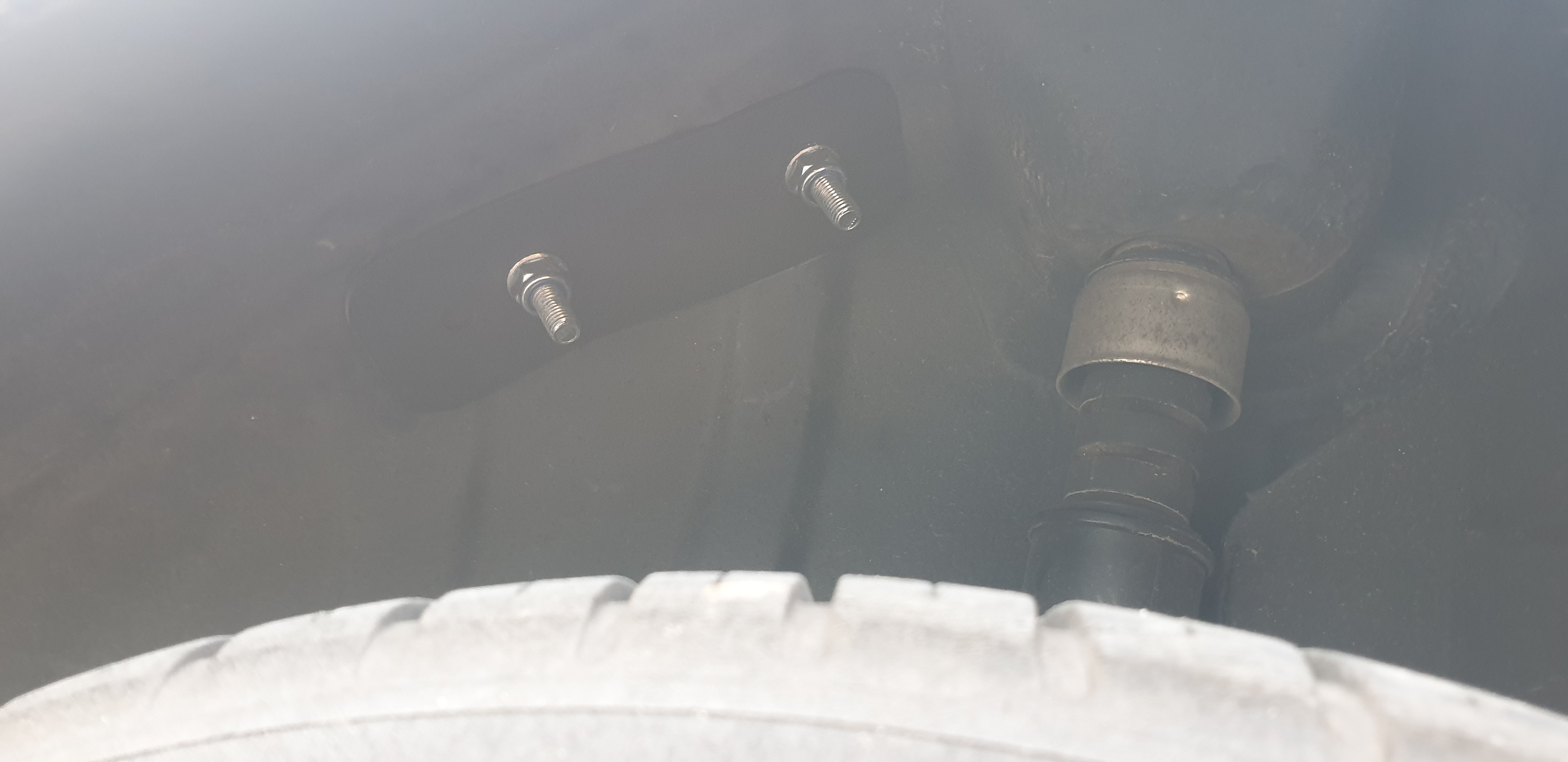

Bolts look long but they're not visible side on. Had to trim this spreader plate as it was mahoosive and wouldn't fit with the seam for the back seat

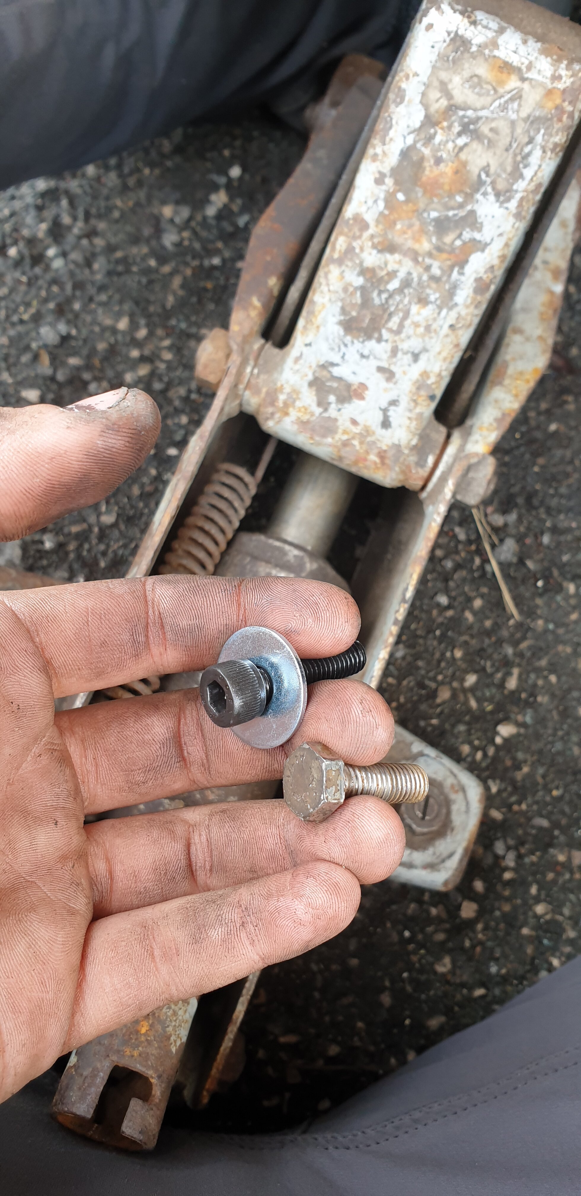

Drilled a hole for the crotch harness strap, shoved an eyelet and spreader plate on. Got it as close to central as the chassis legs would allow

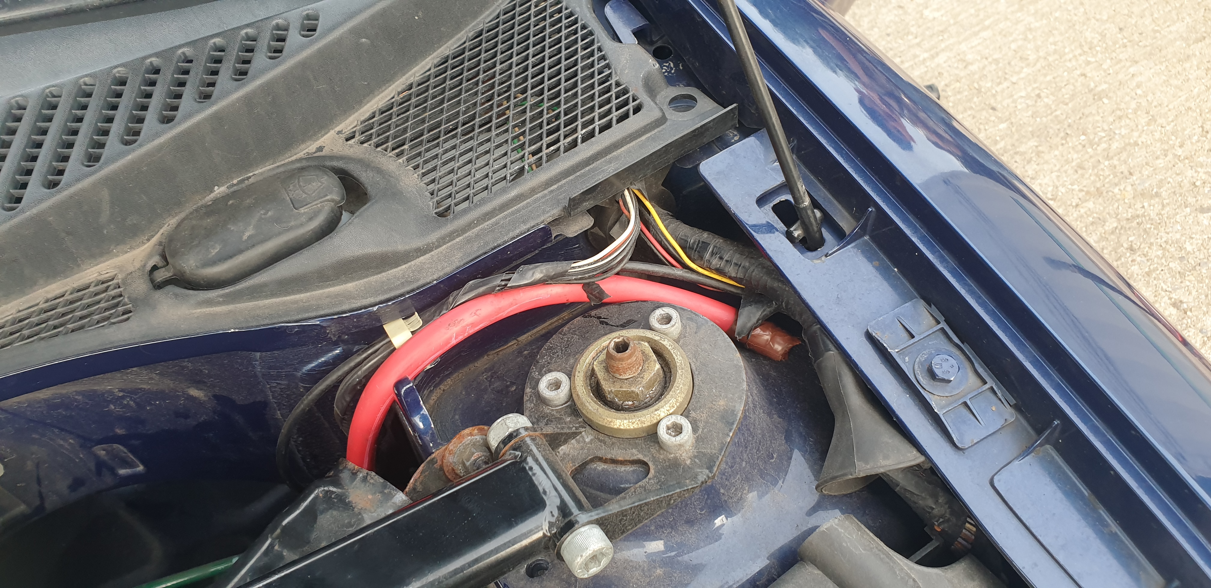

Battery cable at the bay side is just ticked up and taped at the minute. I forgot my hydraulic crimper so couldn't get it fitted in the back

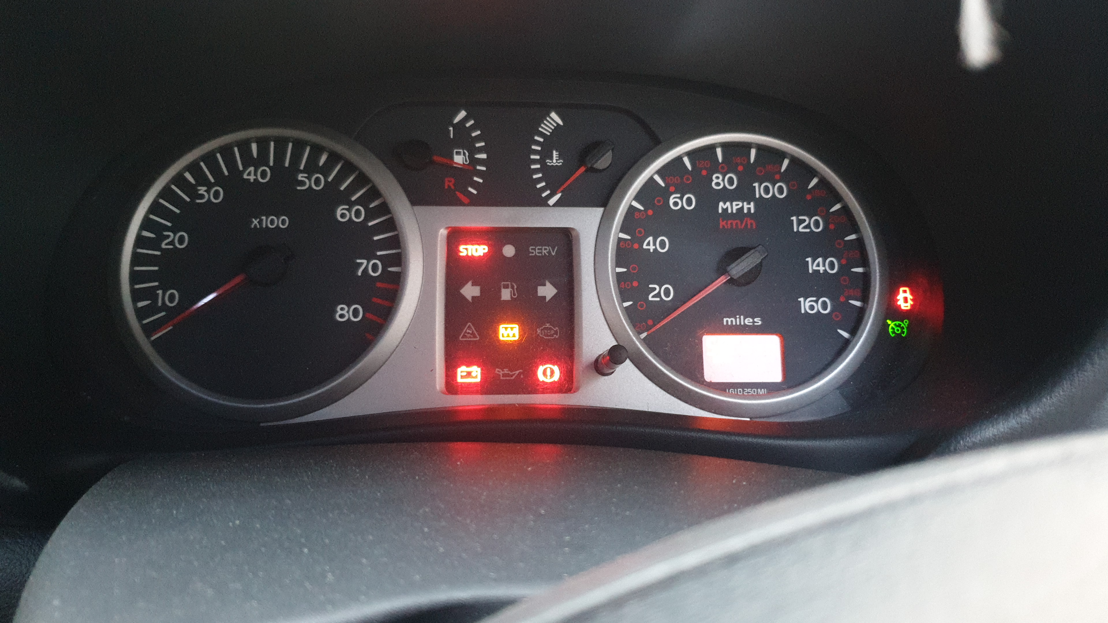

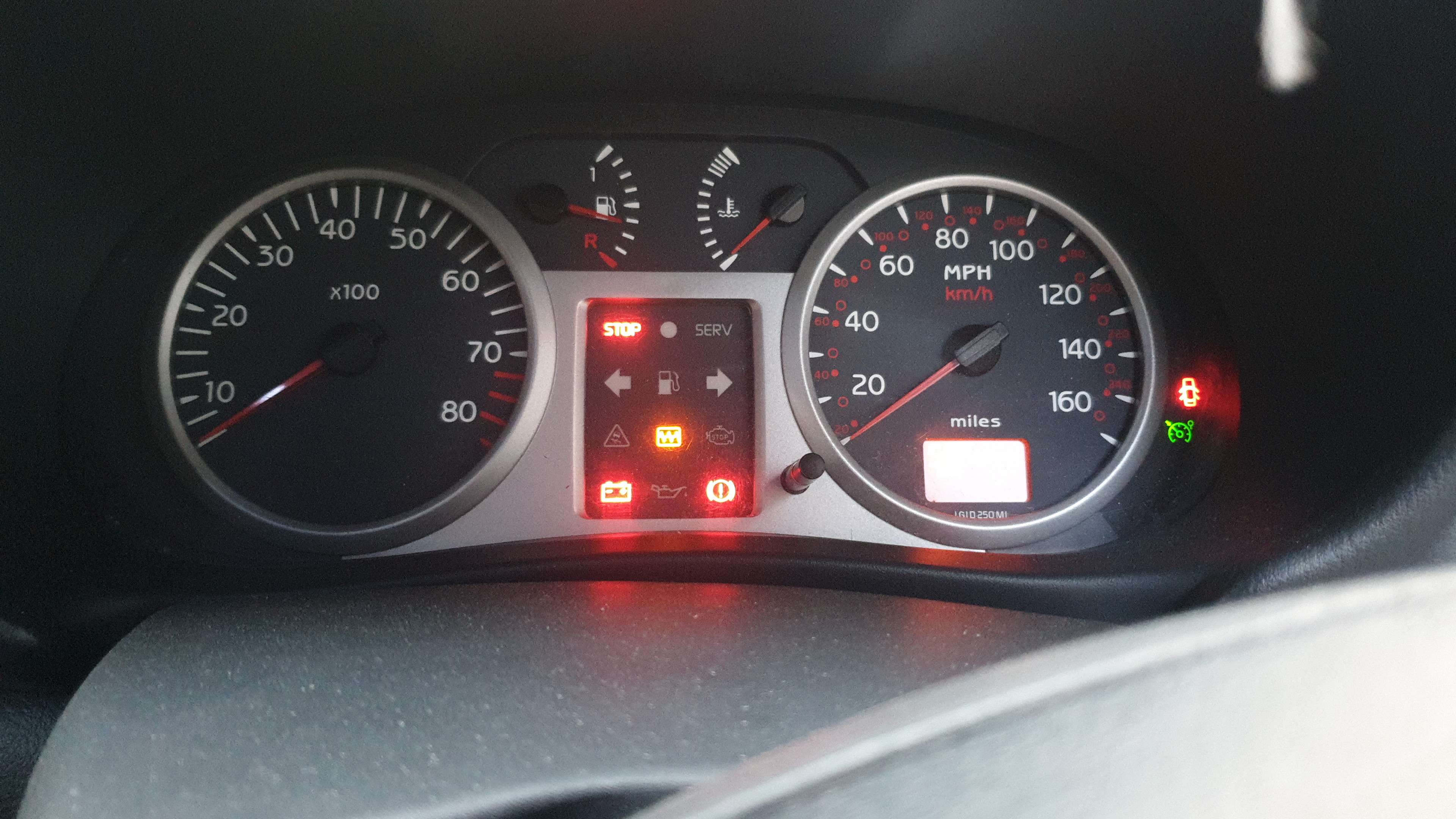

So I had the electronic fault light illuminated, wasn't there before but I've been f**king around with the alarm and wiring. s**t
Car would crank until the cows came home but no firing. Checked all UCH relays and wiring, nothing. Checked the alarm cabling and wiring, nothing. Checked the ECU wiring, nothing. Checked big white plug and fuses in the engine bay...
Bingo
Replace fuse, start car, drive home

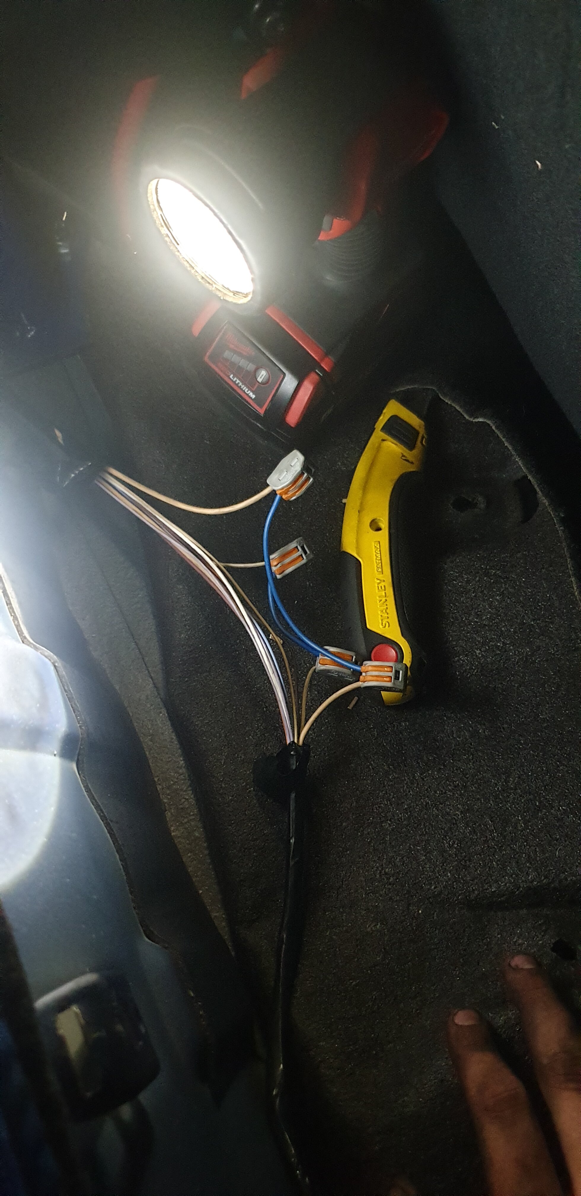

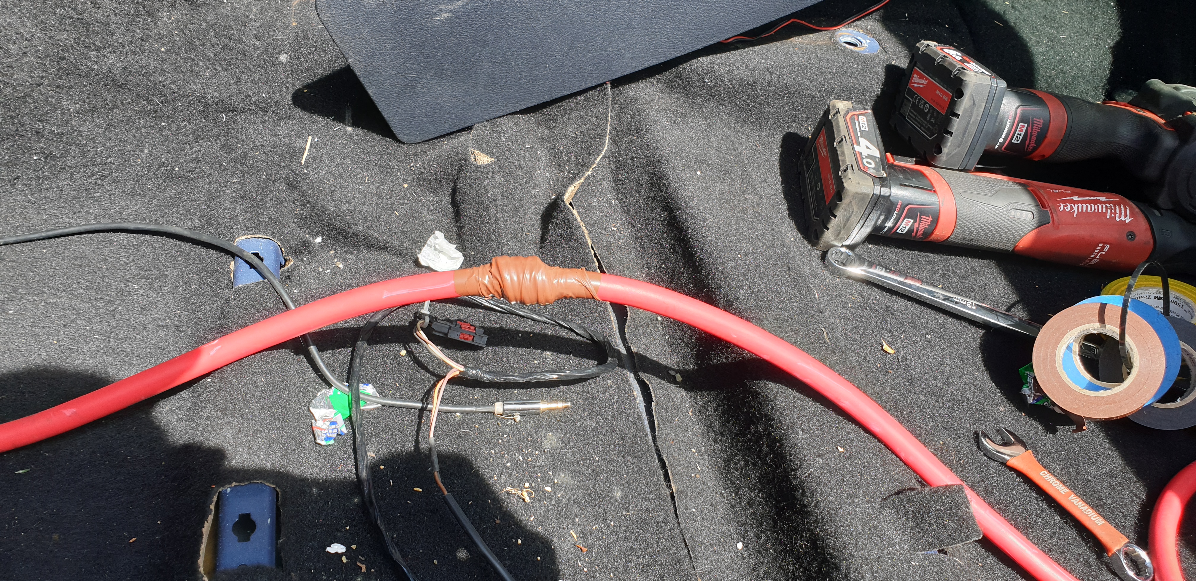

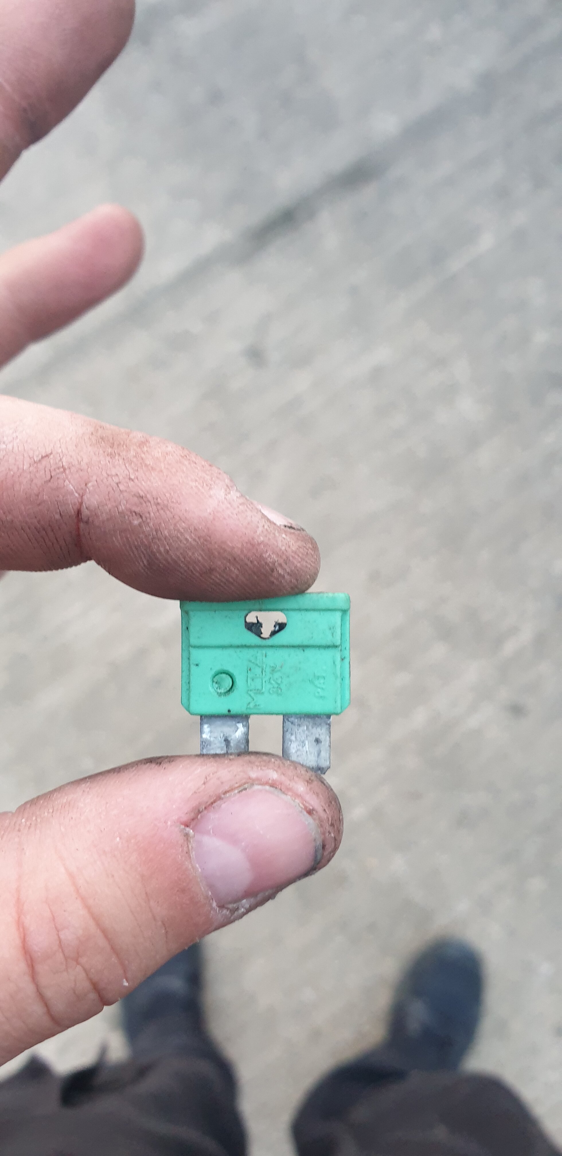

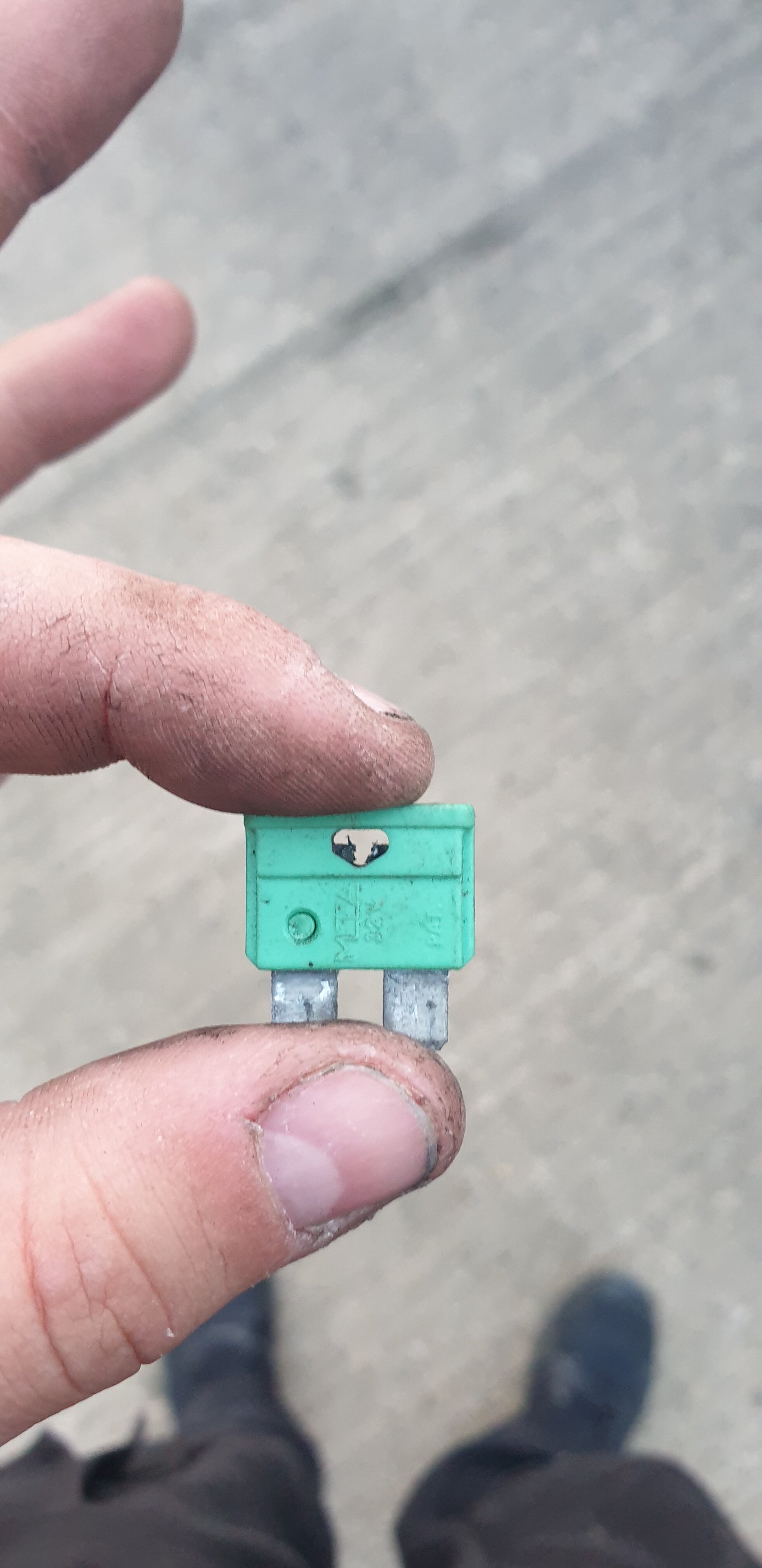

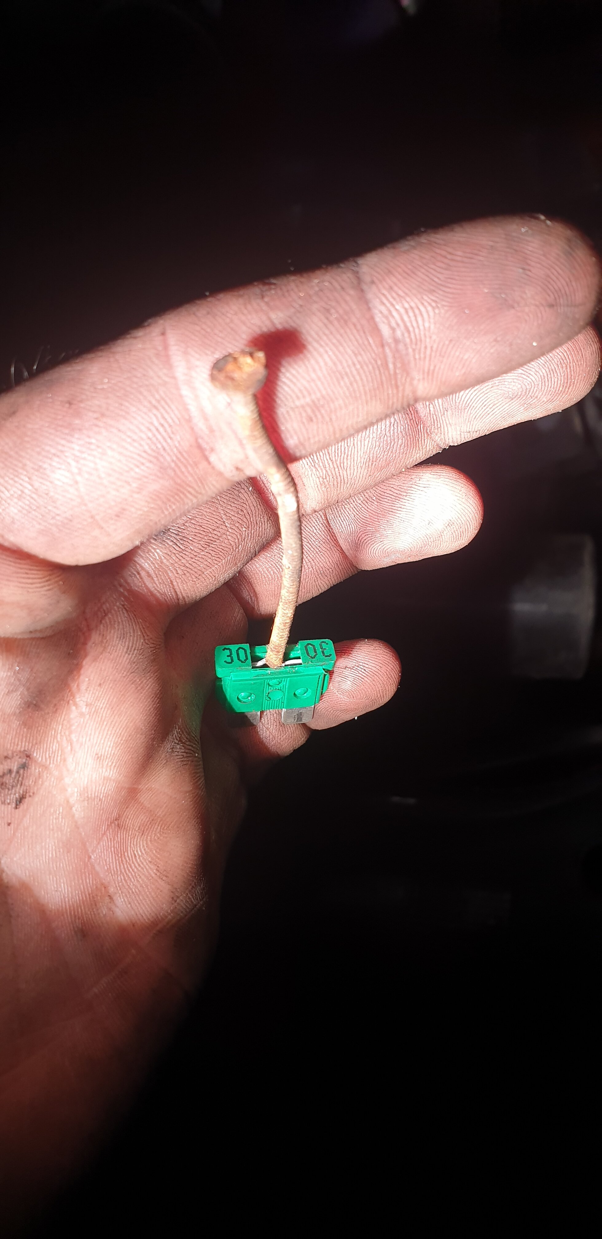

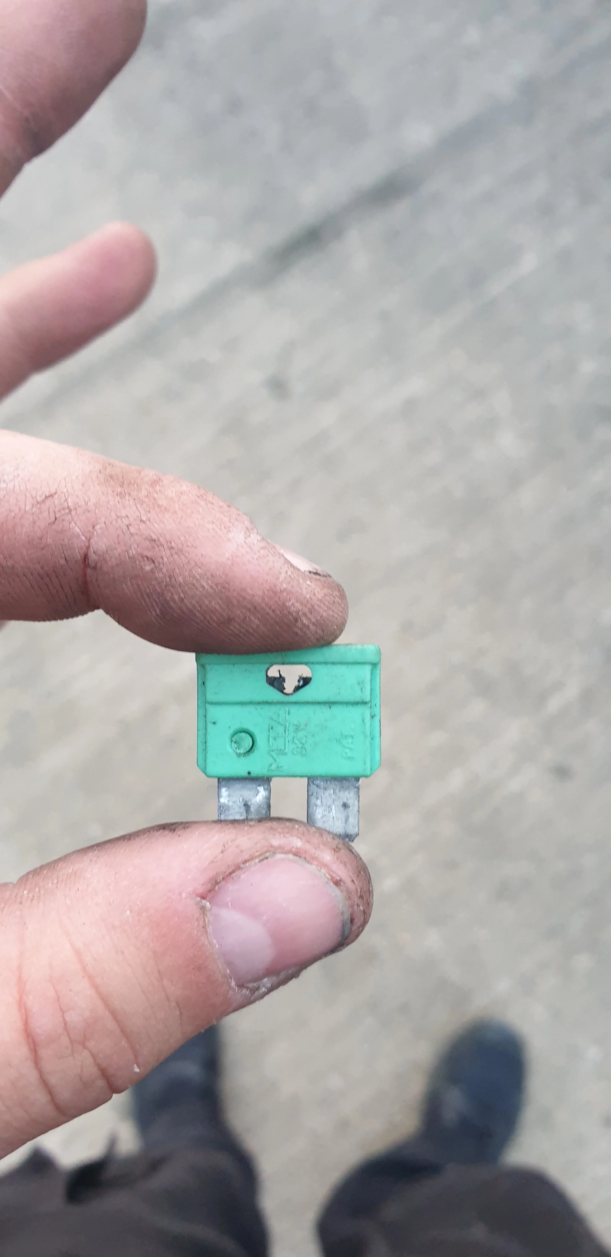

Check it again, check the fuse again... Blown. Right so that fuse is for lambda, coil pack, injectors and fuel pump. I'd been messing moving the lambda wiring earlier on as well as the brake lines for putting the cage in. Checked those over and all looked fine, so that was 45 mins crawling around on the floor. Checked the coil pack wiring as it was easy, looks good. Injectors I didn't check as I hadn't been anywhere near.

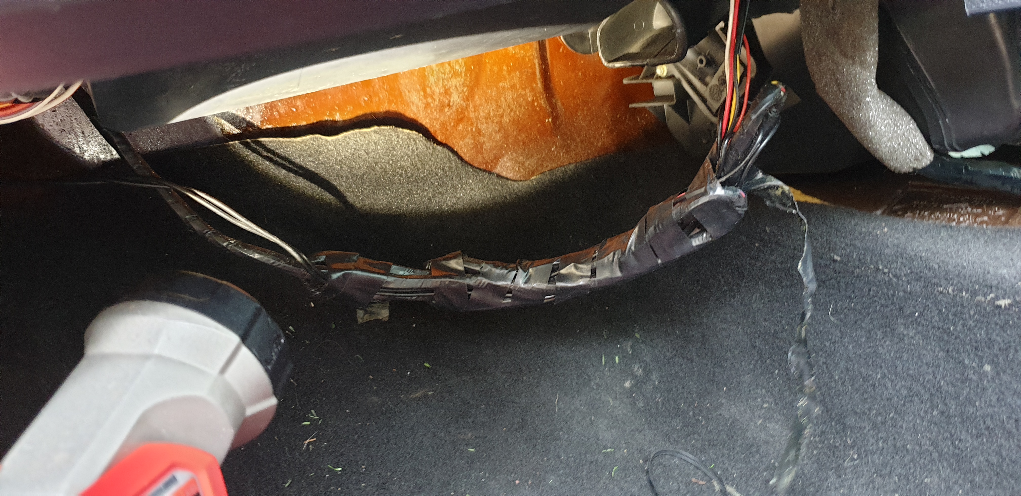

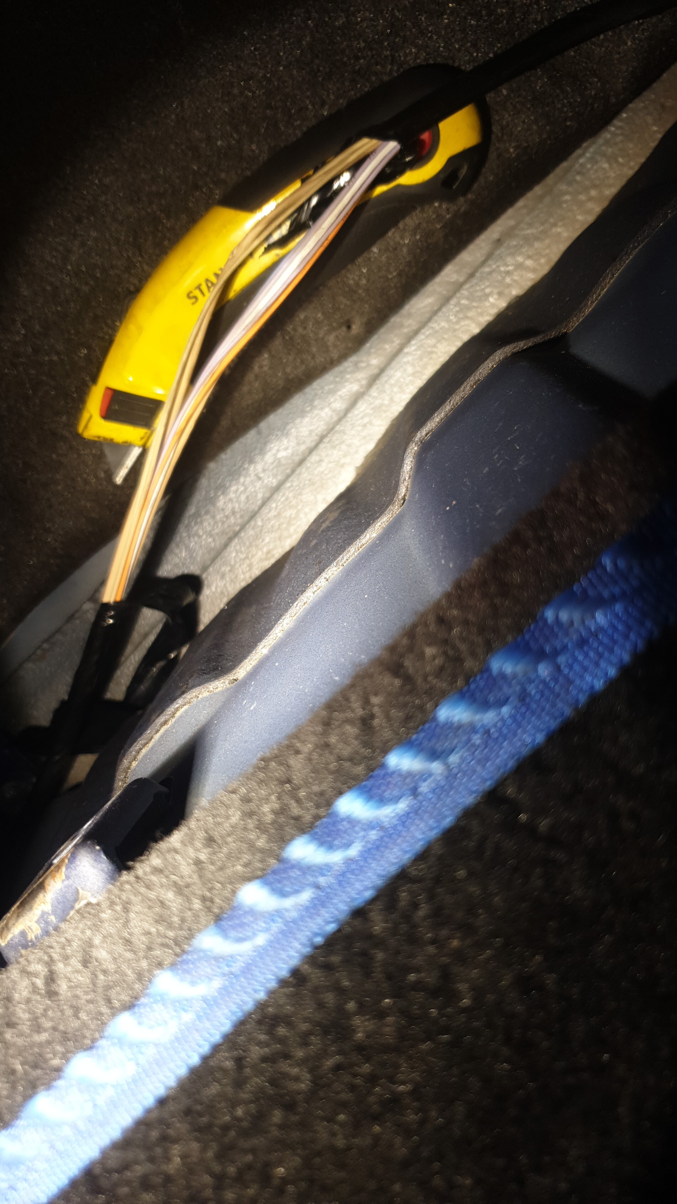

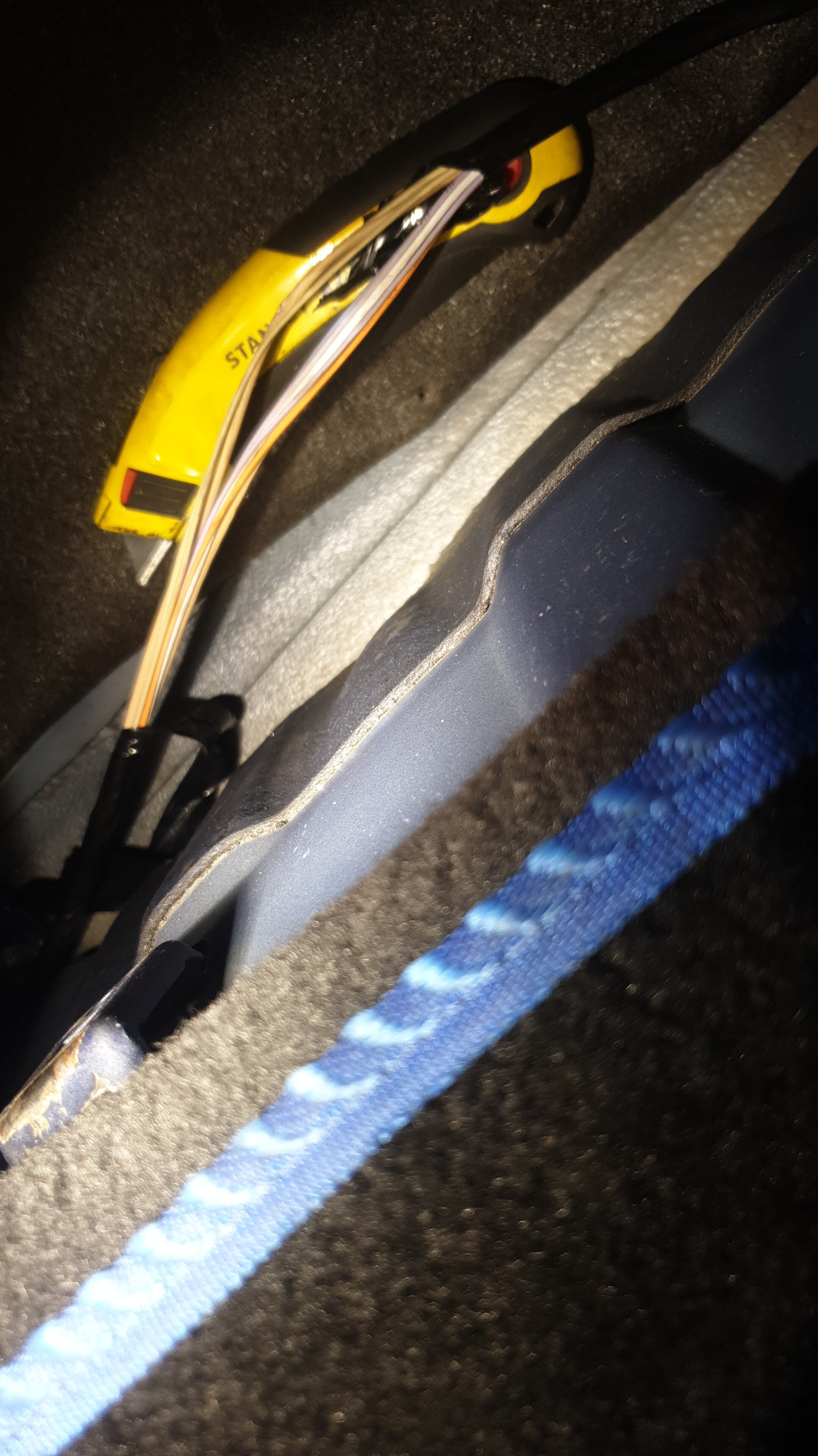

It then dawned on me that the fuel pump wiring runs across the base of the rear bench. So surely I must have nicked something when installing the cage, maybe squashed it or something

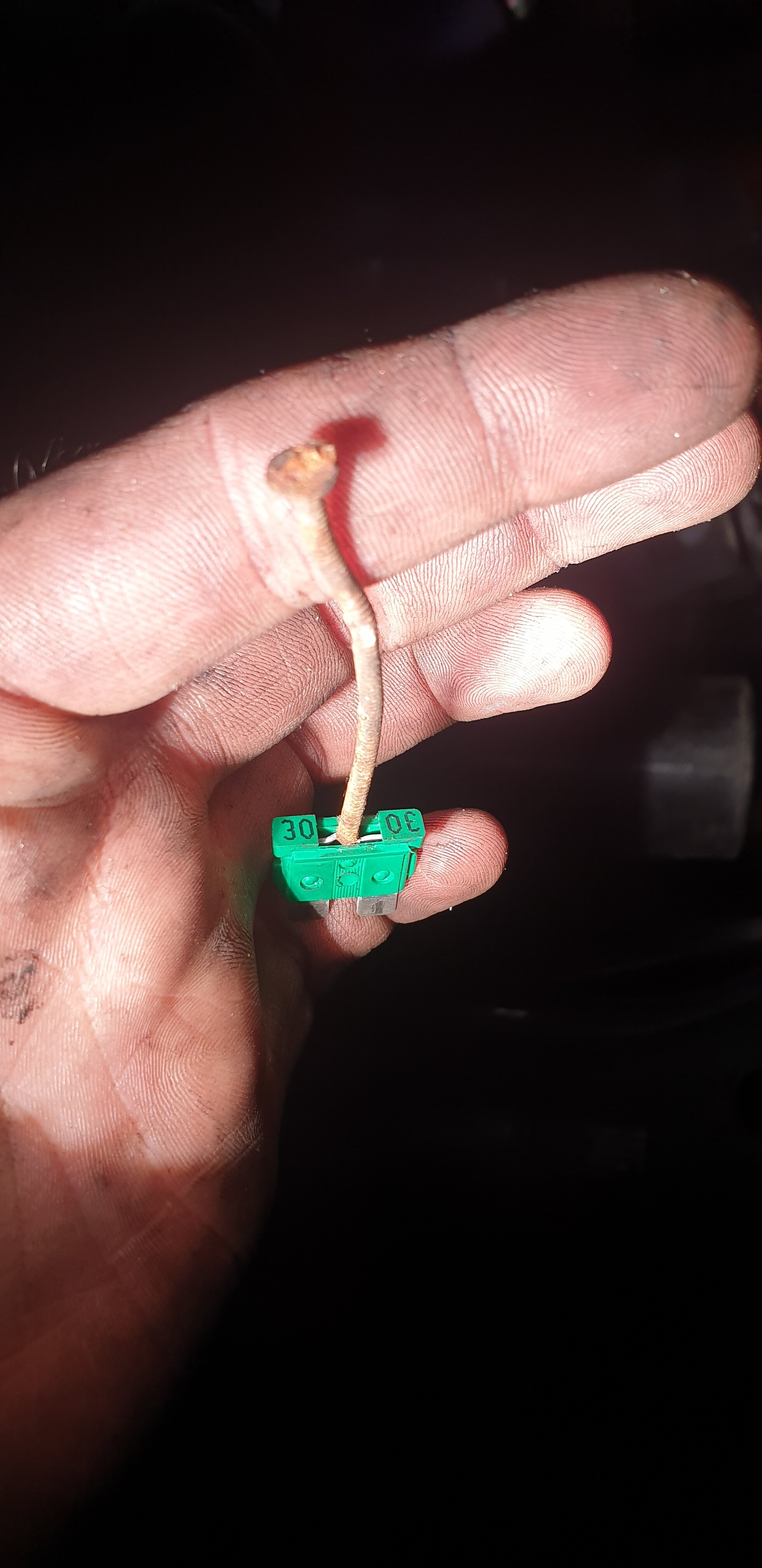

So I check to see if the wiring is snagged and it was a bit tight near the battery tray I'd just put in. Take the tray out and checked the wiring, looked okay apart from a tiny witness mark and a very very tiny s**t mark on the back of the carpet when something had clearly shorted out which you can see

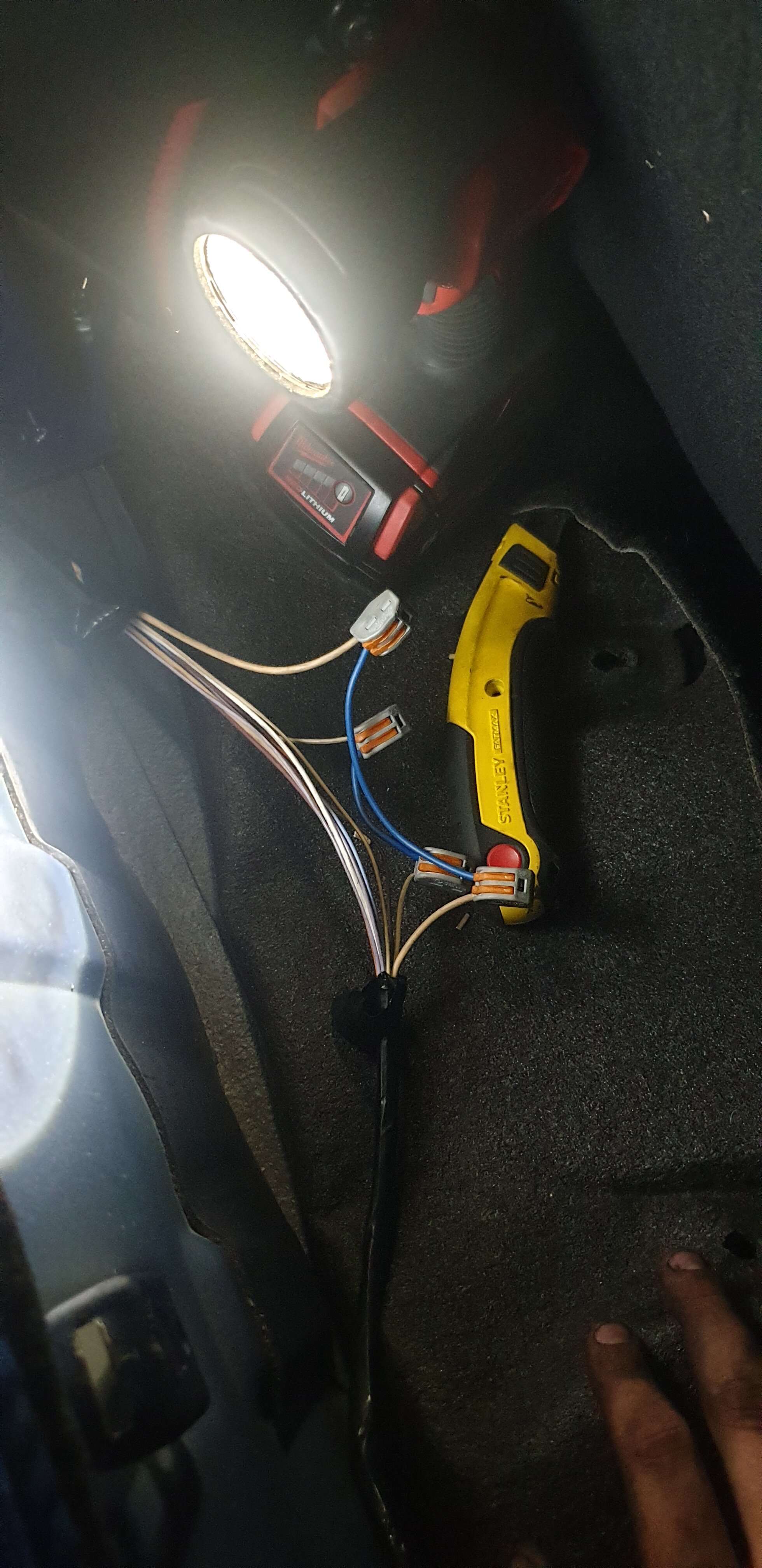

Terrible pic as I was not in the mood as this point but in there are 2 light brown wires to the fuel pump that had been squashed when I tightened the battery tray down. Stupid fat c**t Kyle
Anyway, I went full 🥧 🔑 mode and this is how I "fixed" the issue
Now I was in another world of s**t though. I'd used up all my spare 30A blade fuses knobbing about...
No mate, that's not it🤣🤣🤣
'borrowed' the fuse for the rear heated screen, cranked over for a few seconds and then it burled into life. Thank f**k
I'll get round to replacing those Wagos at some point. It's a proper horrid hack but it worked and got me home, where I now sit on the toilet telling strangers I've never met how I ruined my car... Instead of having a shower and going to f**king bed🤣

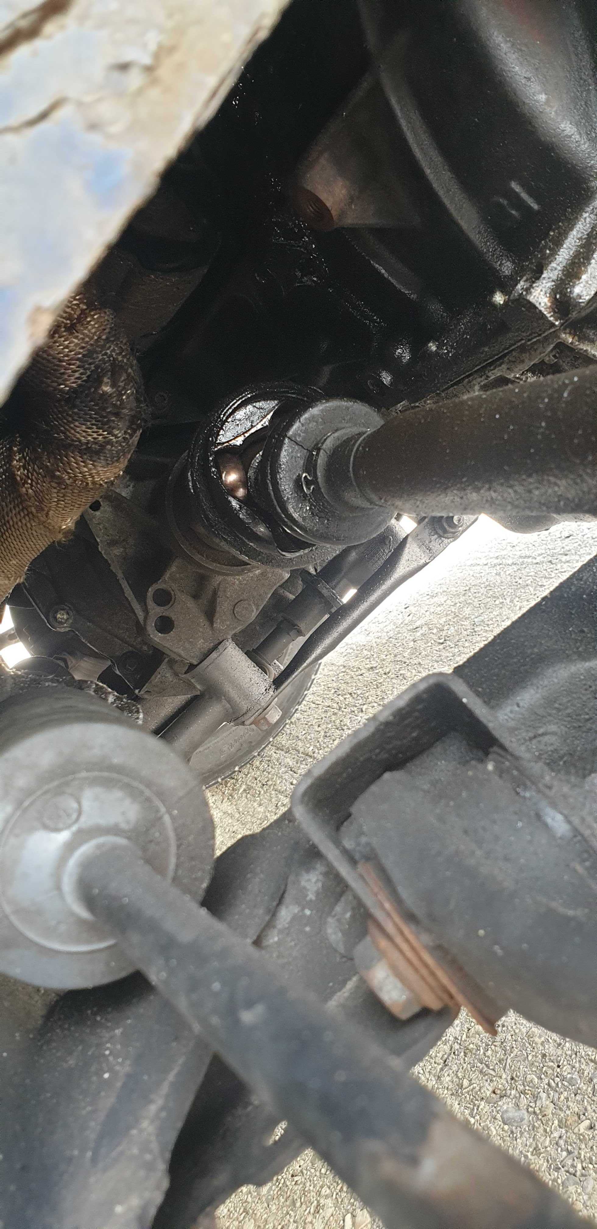

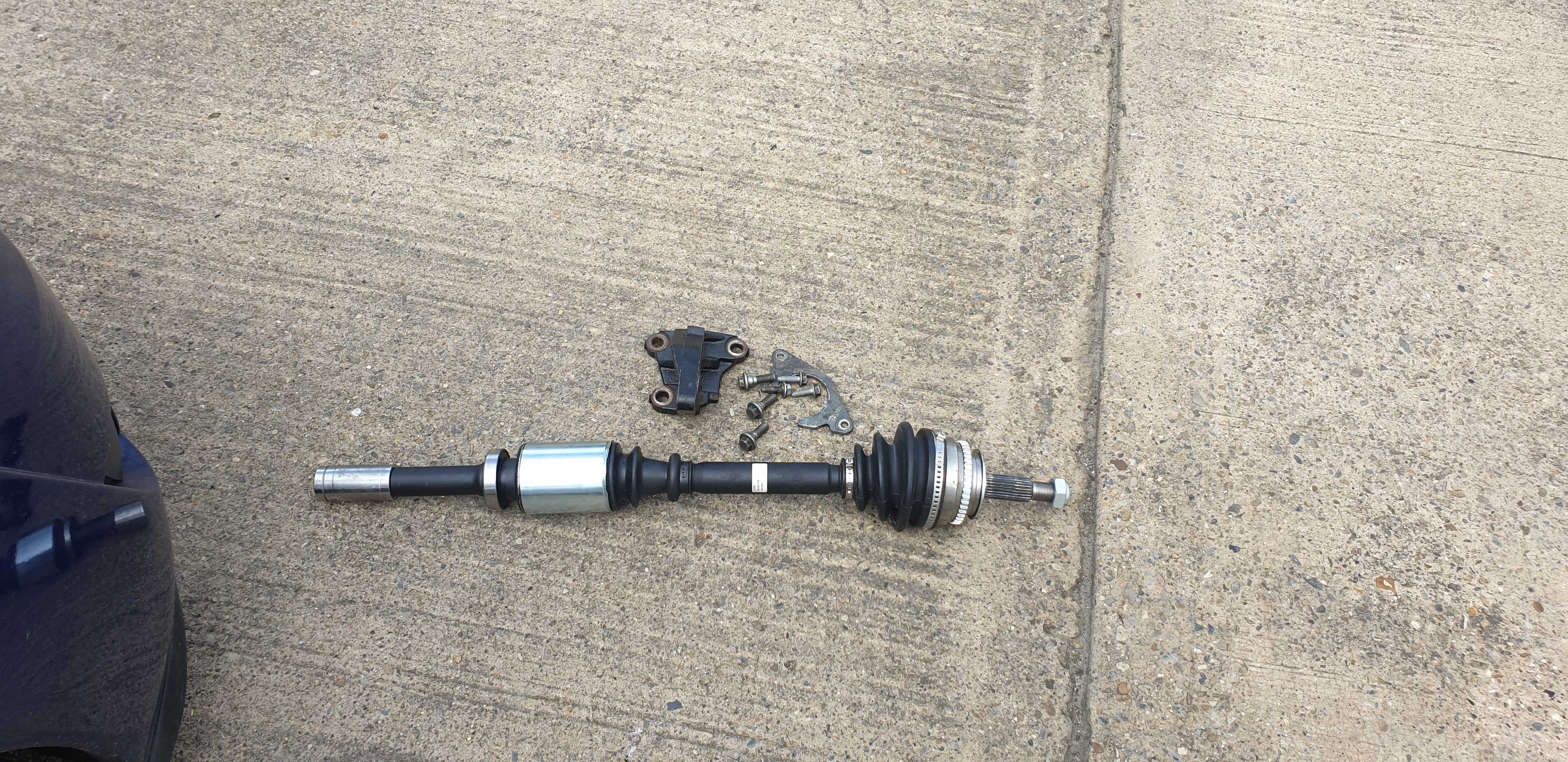

Drivers side shaft is fucked more than your dad's arsehole on a Saturday
Shaft rocks about all over and the vibrations coming out of left handers are mega🤣

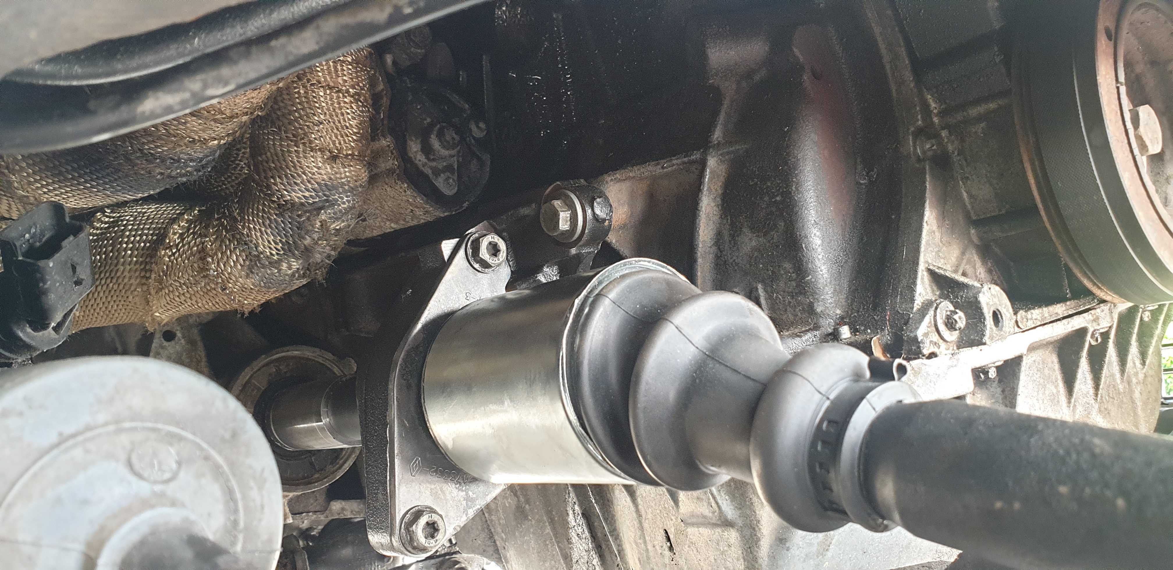

Ordered a shaftec 2 piece on eBay for £120. Went into the garage and dug out a bearing carrier. Gonna ditch the PH1 shaft, when I put it in originally it was because I had it in the garage and my 2 piece was shagged on the inner cv
Krarl

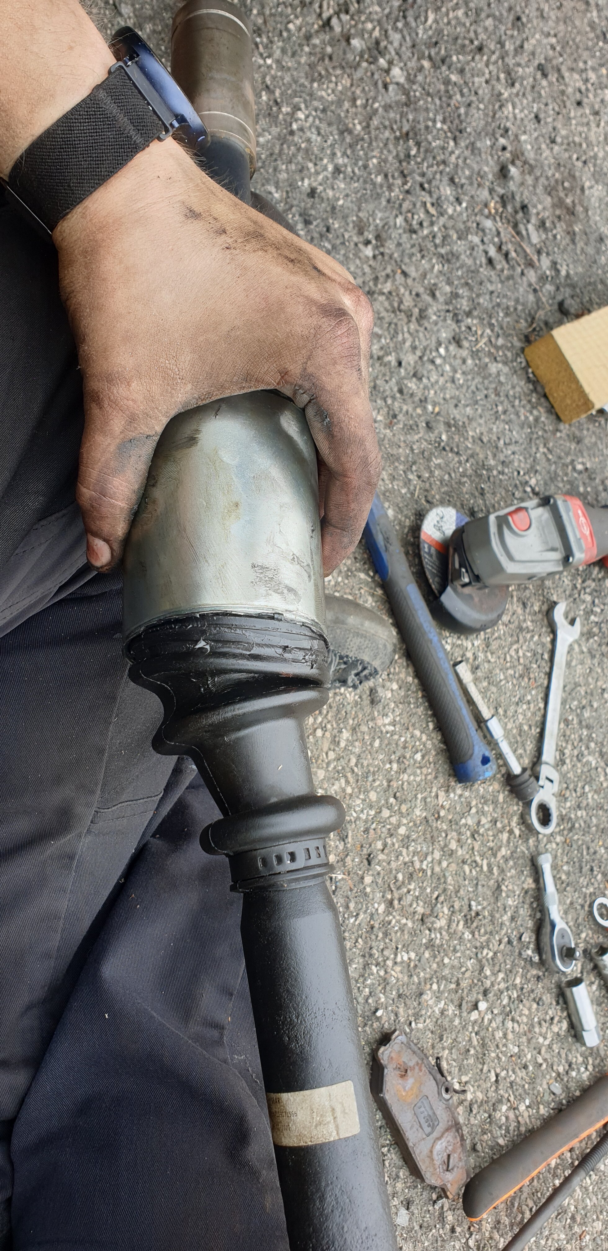

New shaftec shaft arrived yesterday, overall it looks EXACTLY how Renault intended them to be so a direct refurbishment of an OEM shaft, not like J&R and others that are just s**t copies
Got my spare bearing support cleaned up and set to swap it this morning at work

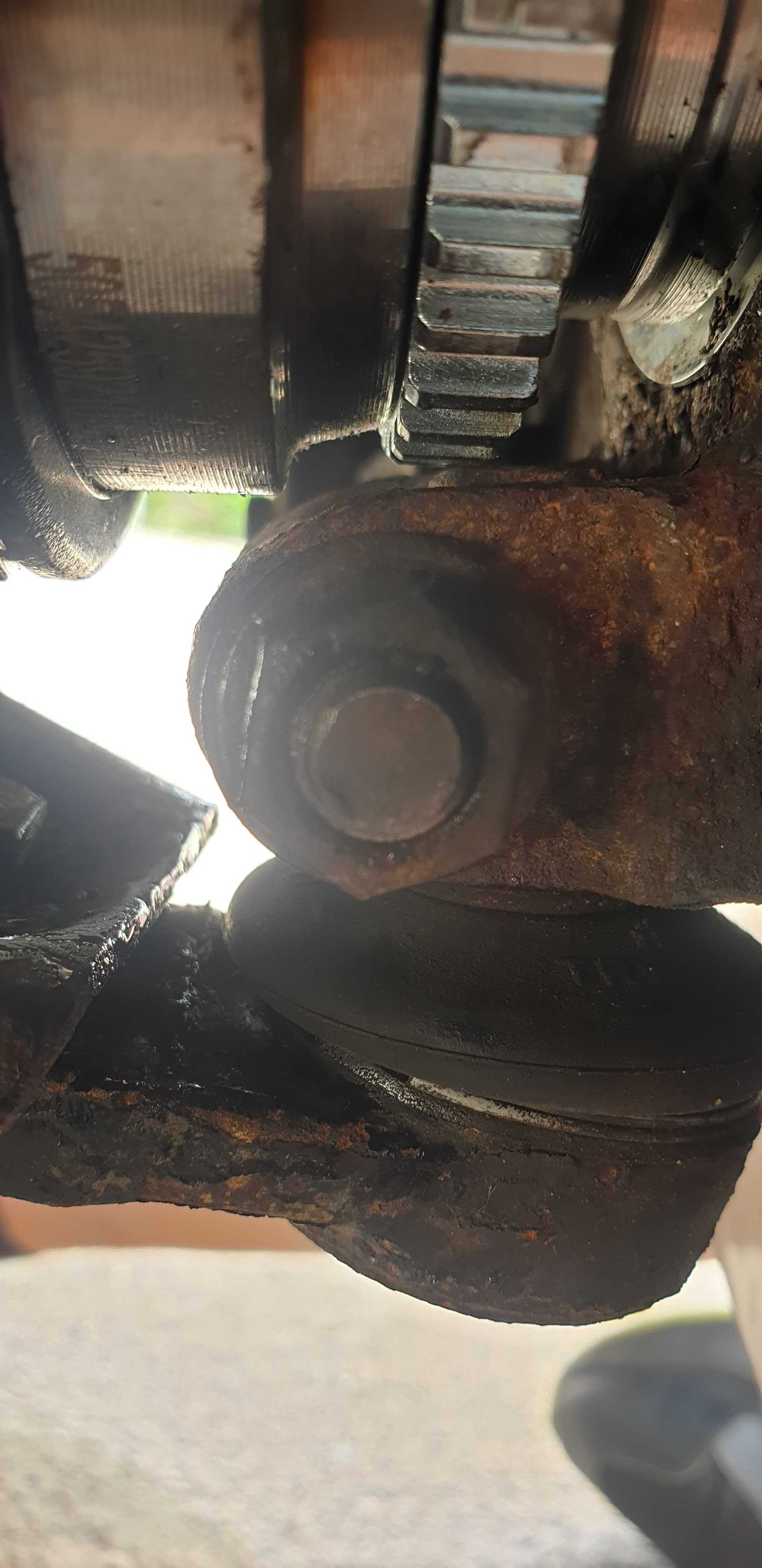

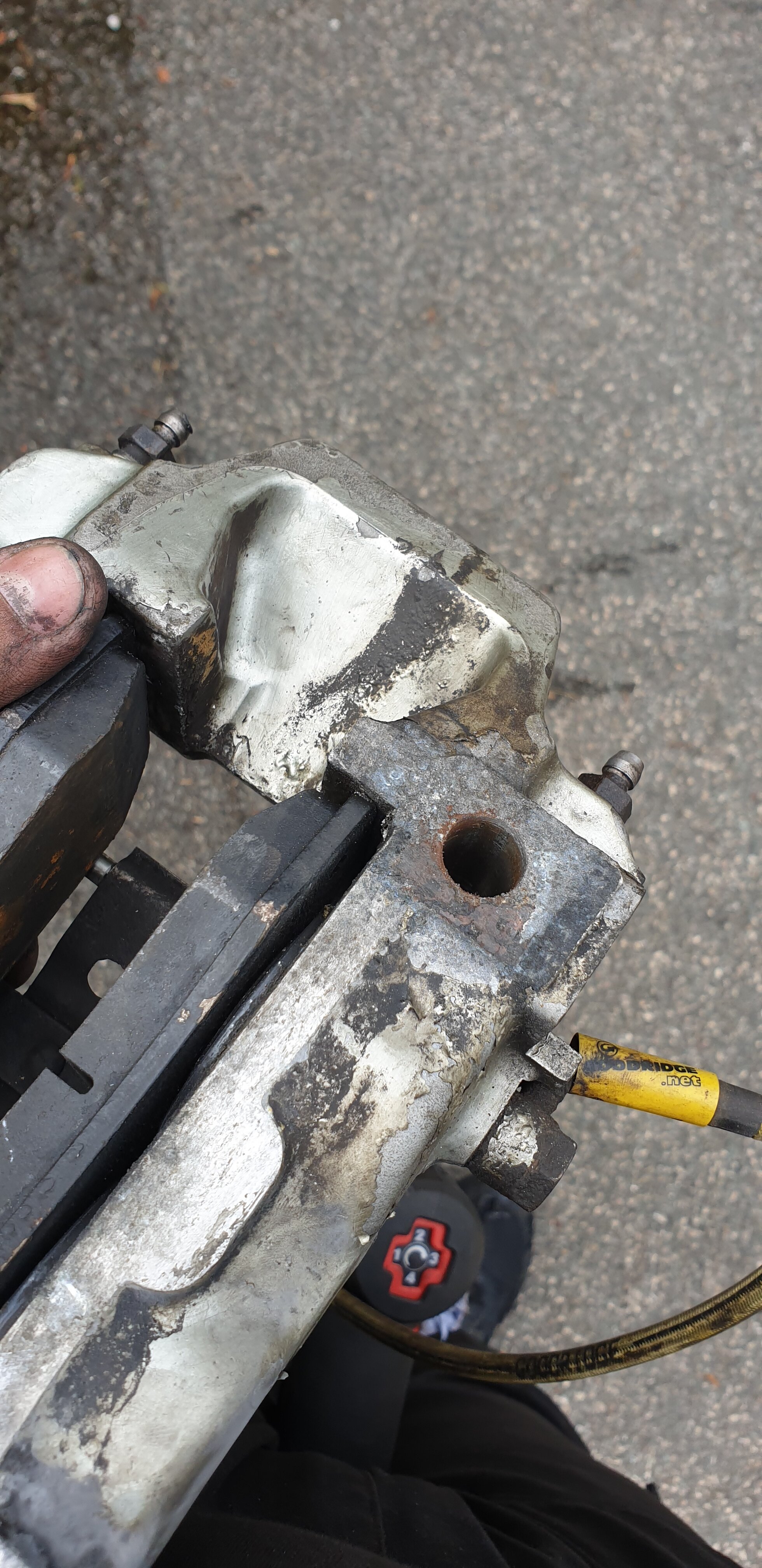

Took me about 15 mins to get the old shaft out, I love on a JC5 that the driver's shaft is an splined exterior to the box so no f**king about was needed
I know I showed the outer CV on the vid last time but here's the main culprit 😂
New shaft and bearing carrier in, you can see how wet the back of the block is with cv grease #RustProofing
The new shaft is the same as my old one in terms of ABS rings. The TRW balljoint fitted is mega long for some reason but after a few rotations the ring should self clearance like the old one did 👀 😂
A short video demonstrating how flogged the old one was. No wonder it vibrated and rattled like a skeleton with Parkinsons having a w**k in a celebrations tin

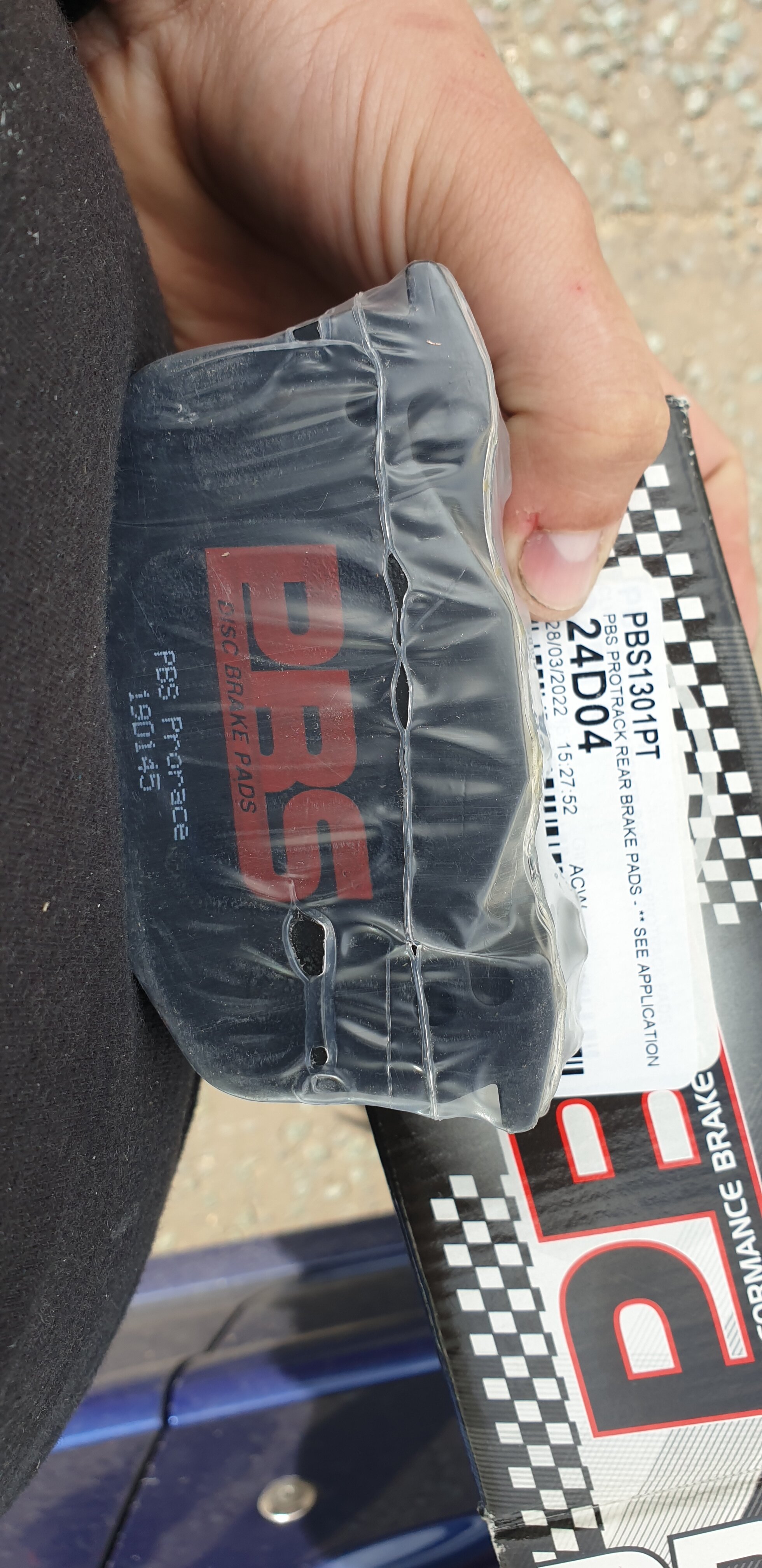

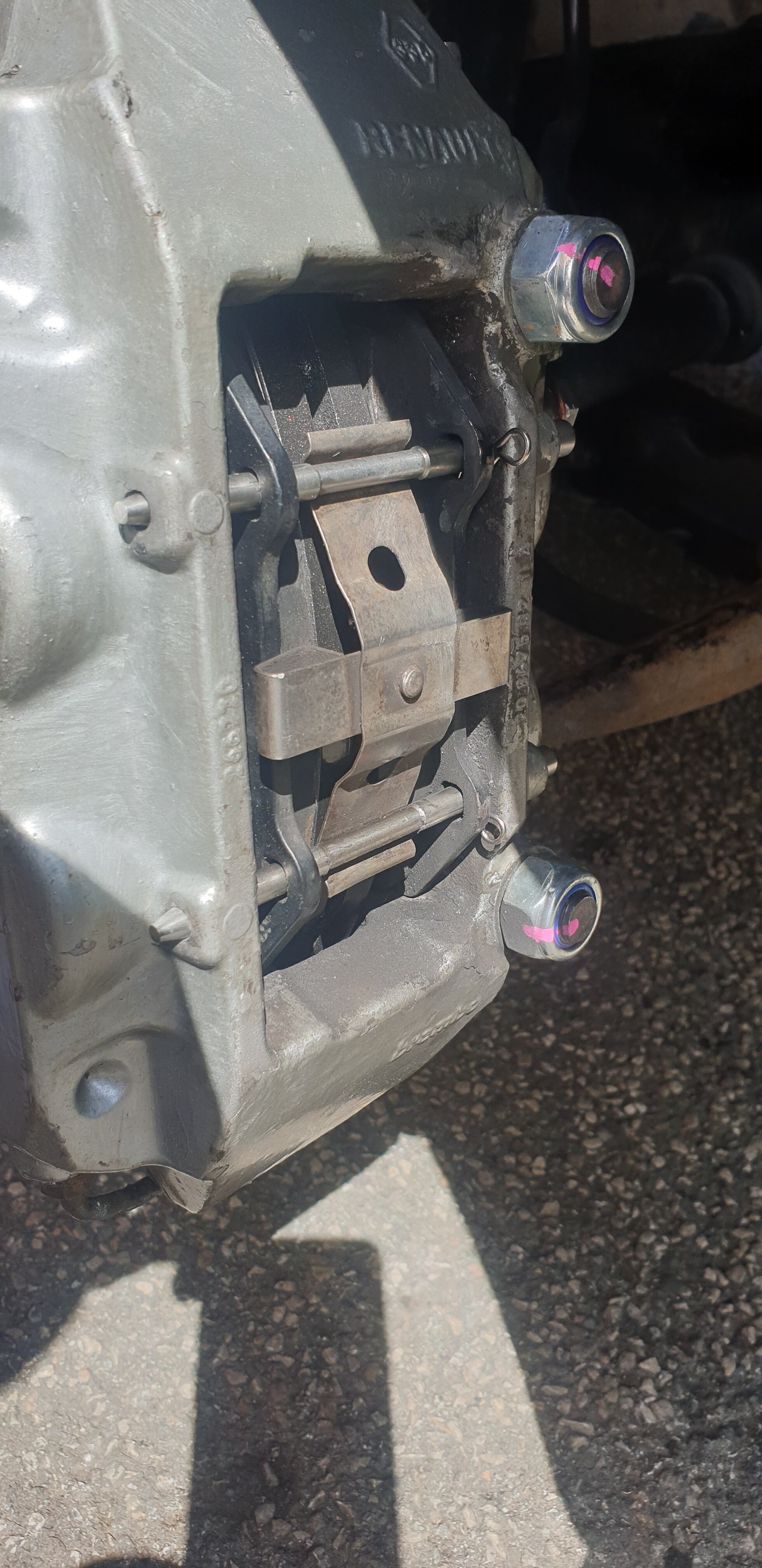

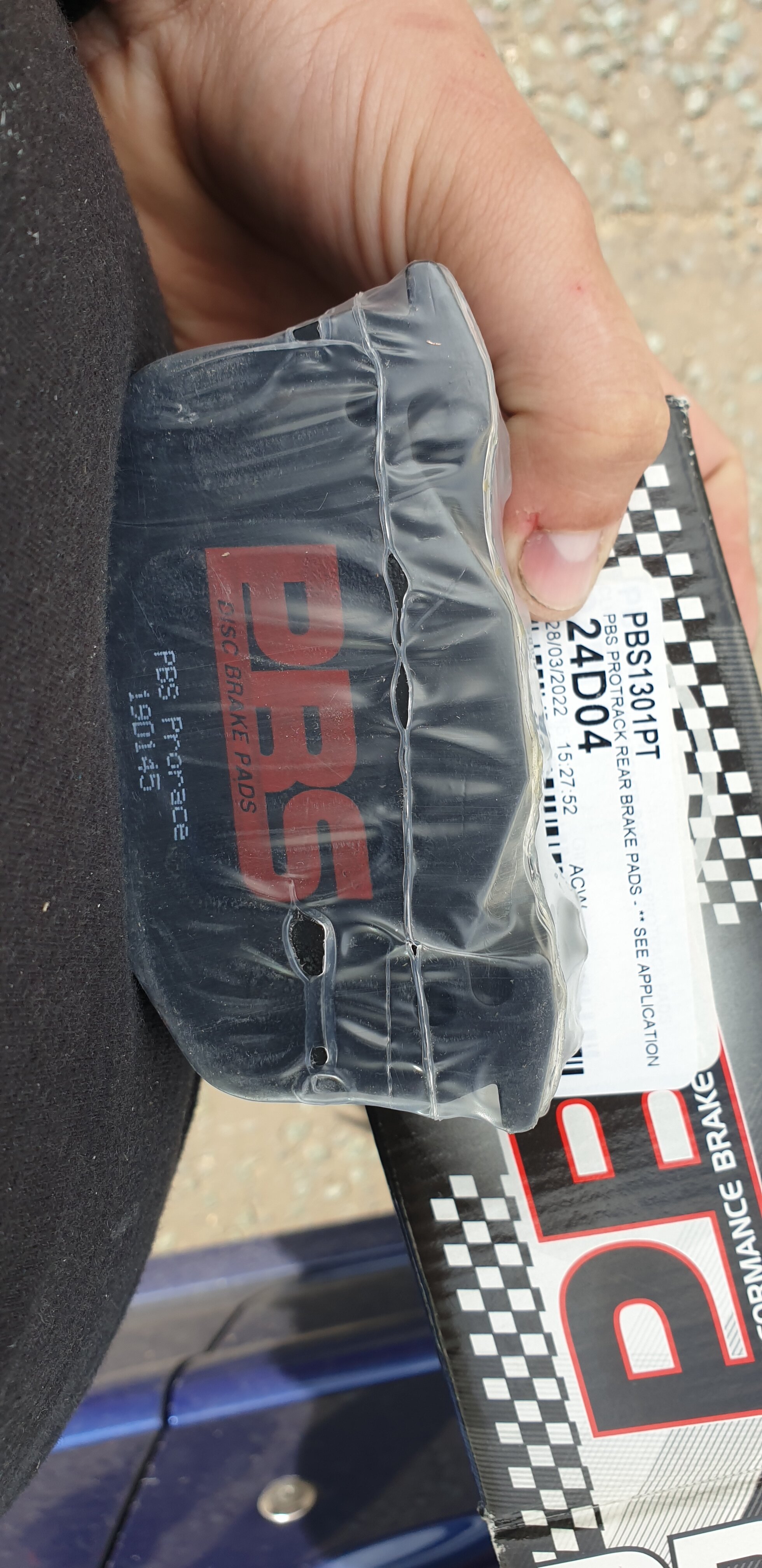

Found some dirt cheap PBS rear pads for the Clio, it currently has some 3 year old PBS ProRaces in there that still have some life left but not a lot. Needed to stock up before booking some trackdays, they were only ProTrack but for £40 posted I wasn't gonna grumble...
It's the little wins in life that give you hope, ProRace ones are a tad more expensive for these. They stand up to heat a lot better too but I'll learn from my mistakes this time round. I'll whip them off when I'm done with driving the car and it's sorn'd over winter to avoid them turning into apple crumble. Got plenty of Brembo pads already in spare carriers to lob on
thecrim22
  various
Rear brakes do next to f**k all on a clio anyways so for £40 sorted lad

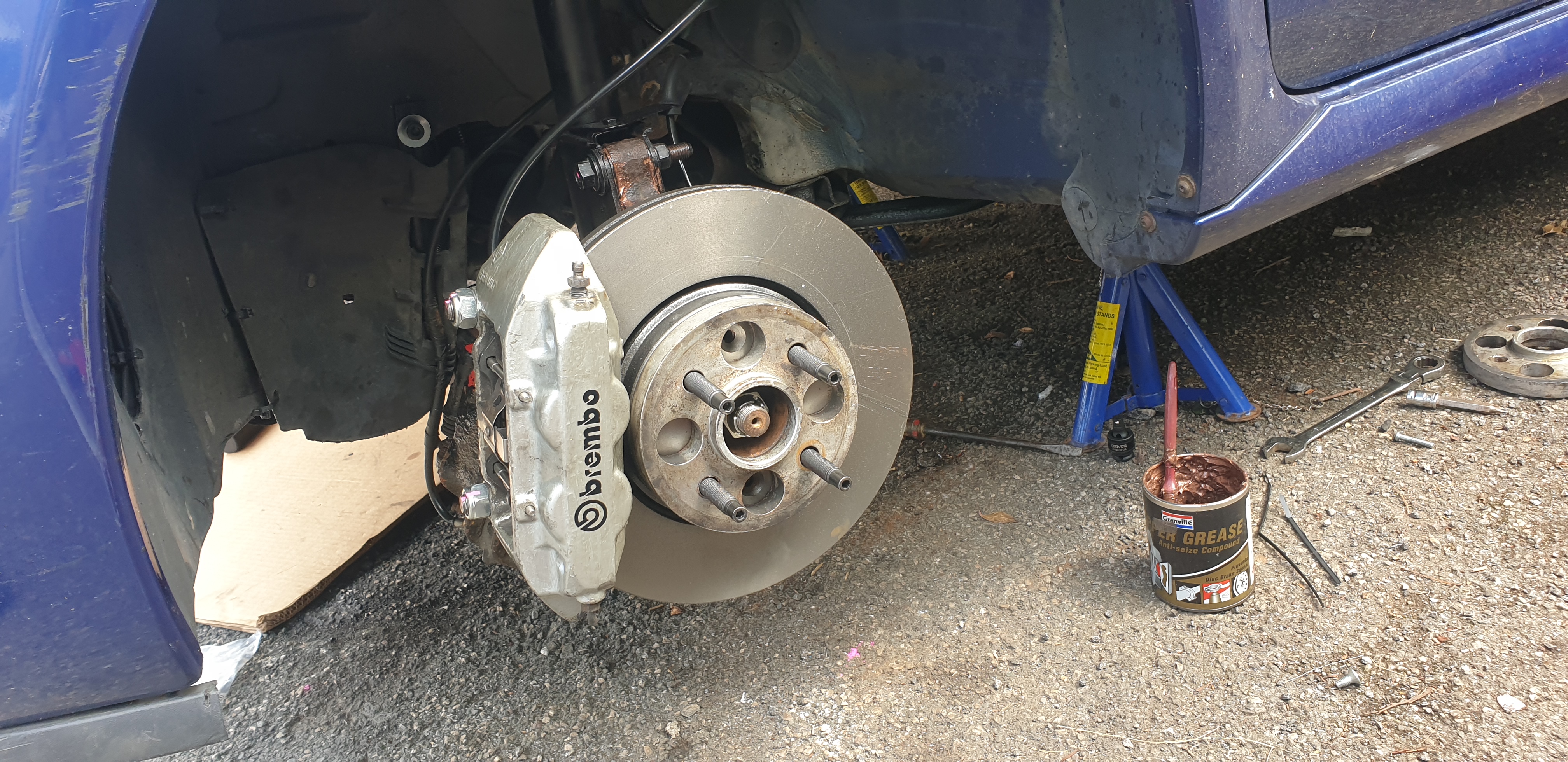

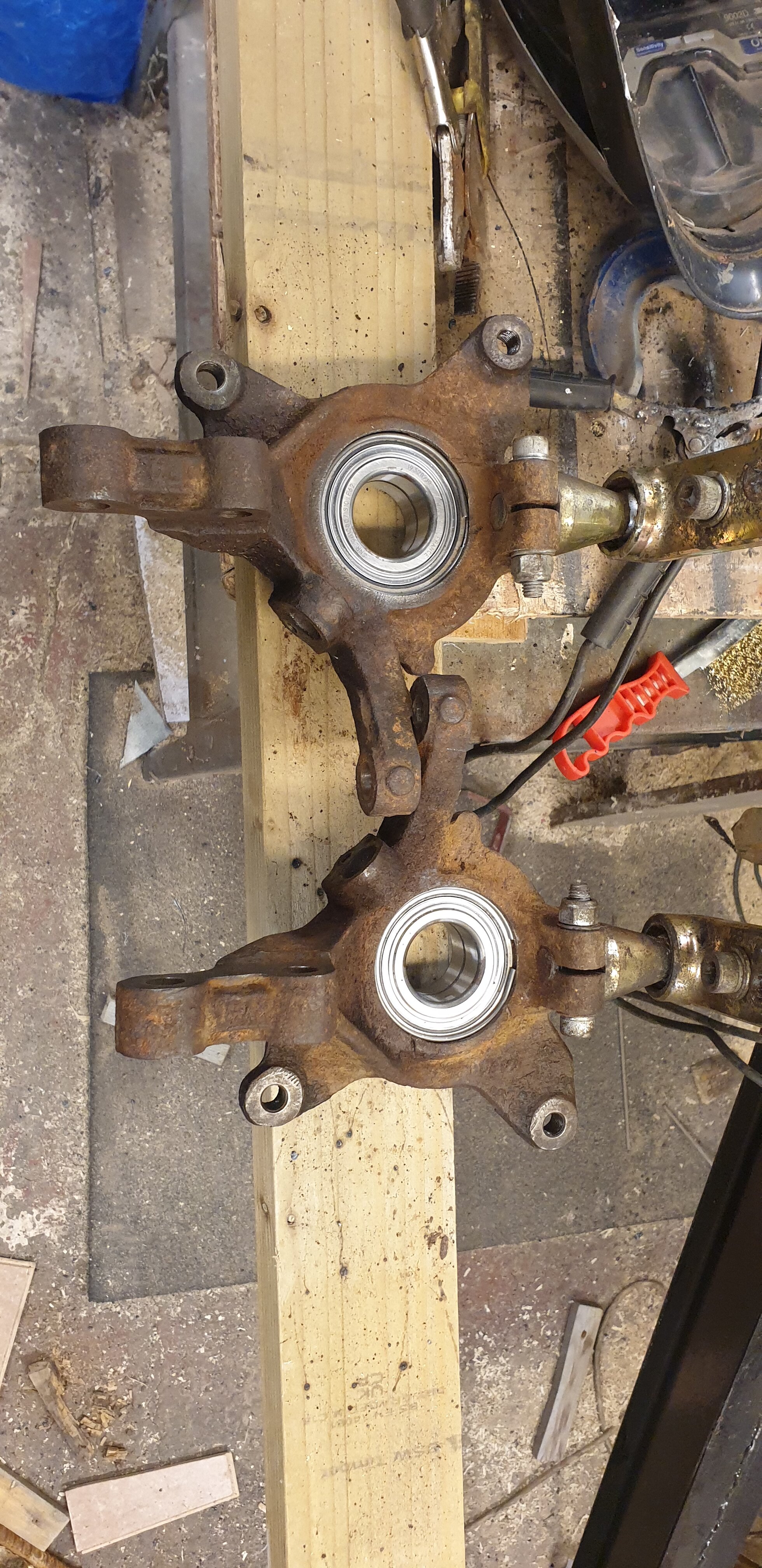

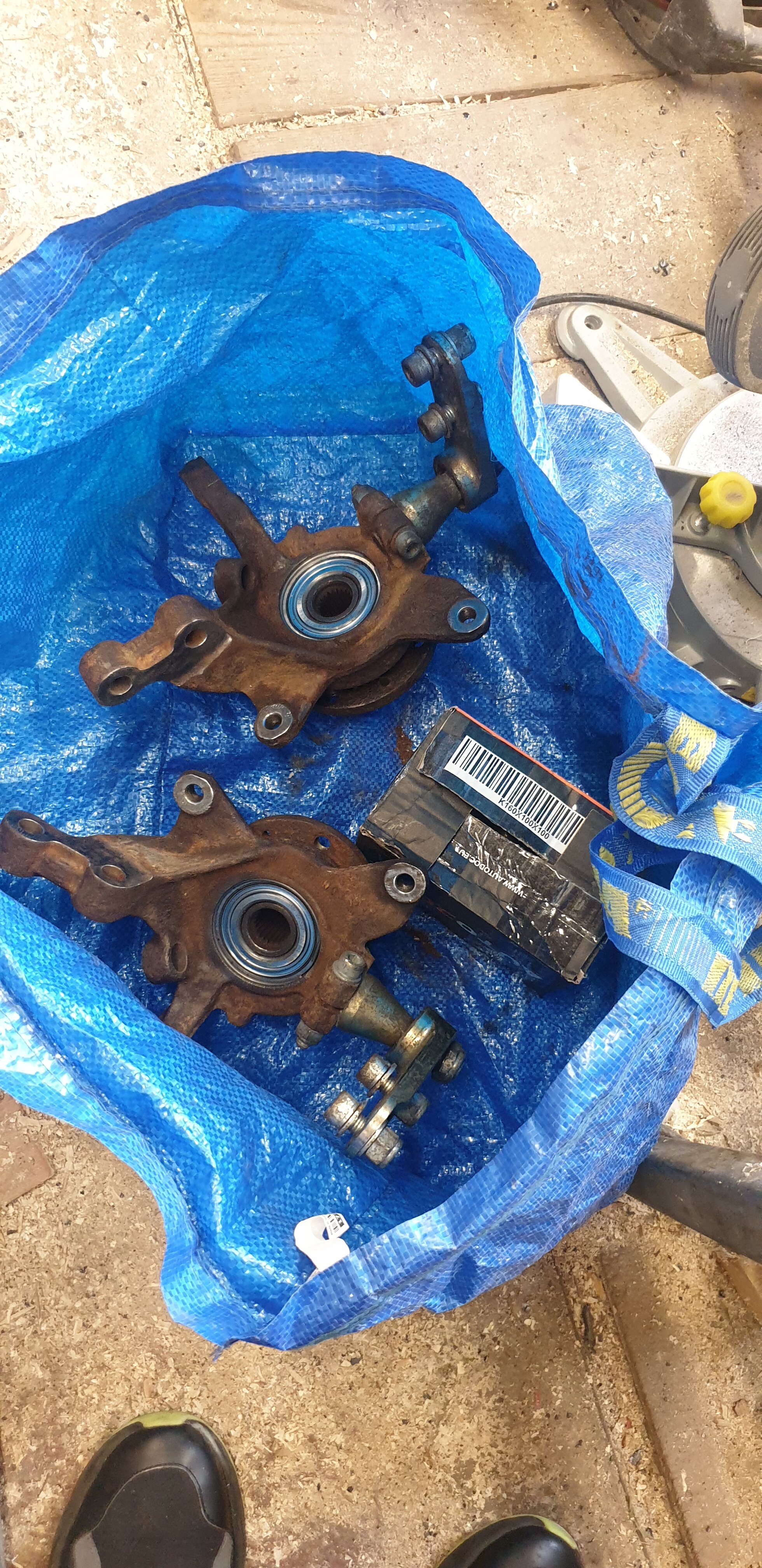

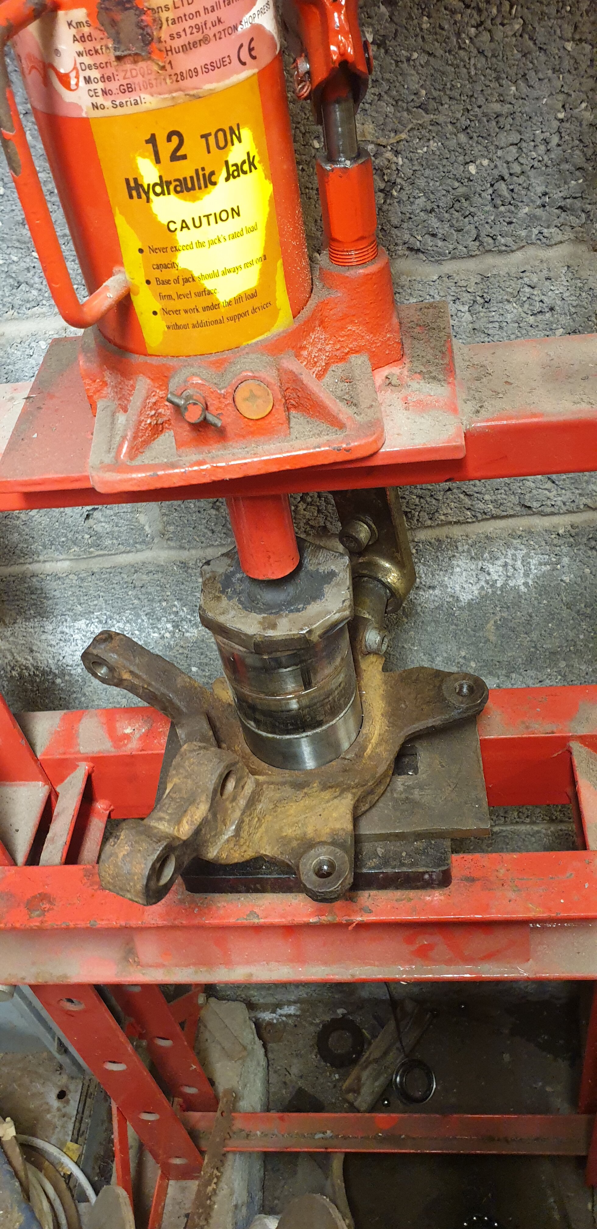

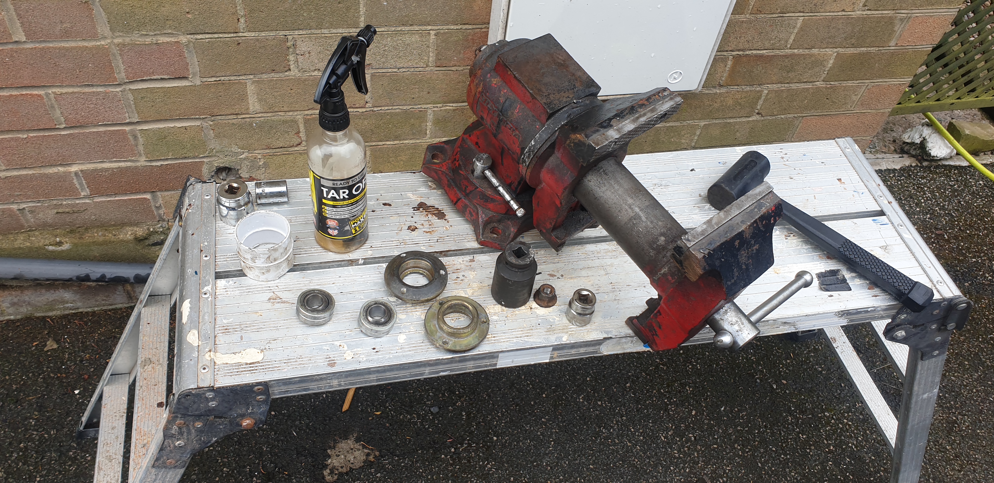

Went down to my mum and dad's to press wheel bearings into my roll centre hubs. My dad has a decent press and it makes things so much easier

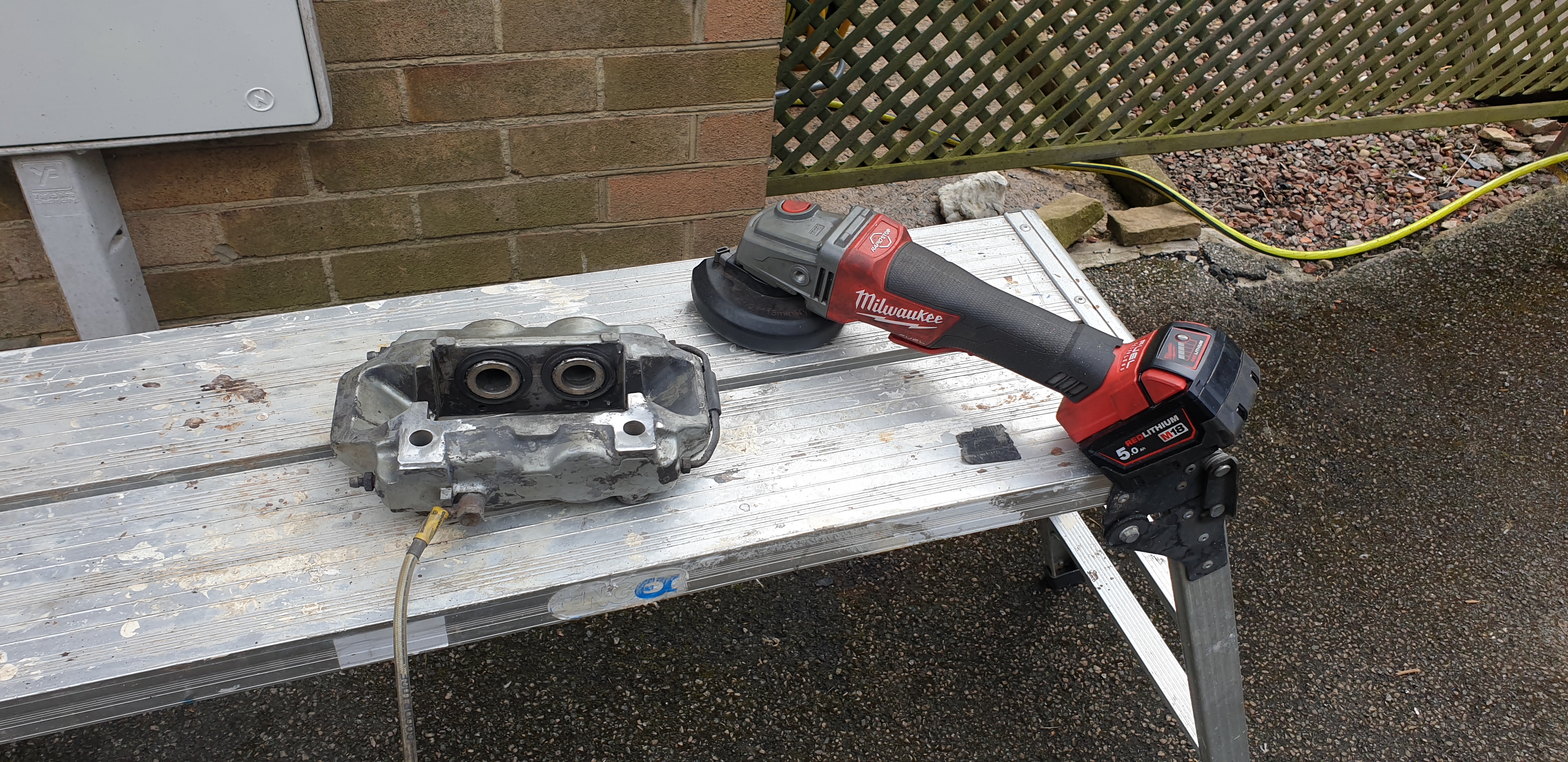

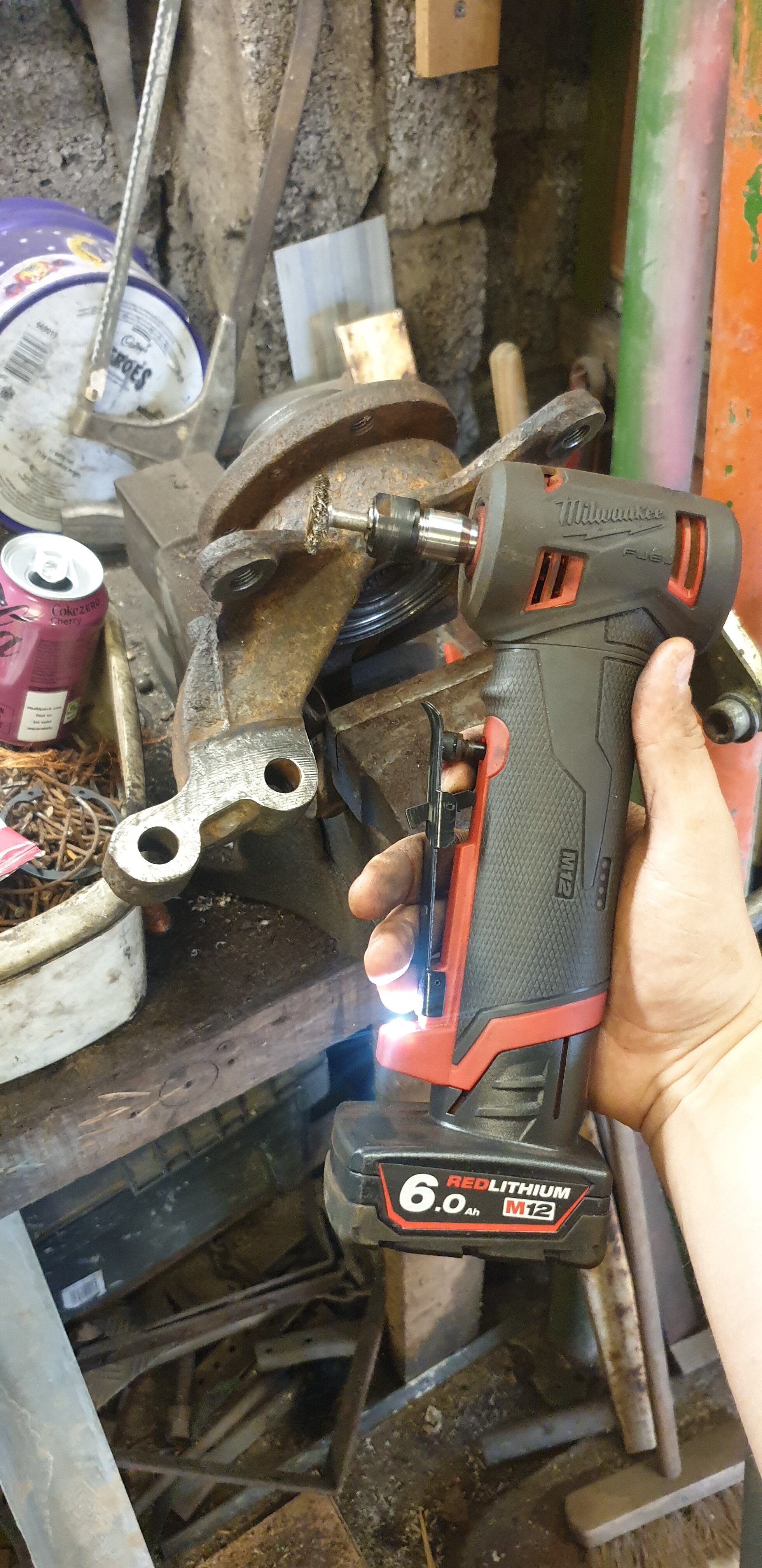

Started cleaning up all the mounting surfaces with my new favourite tool
All done

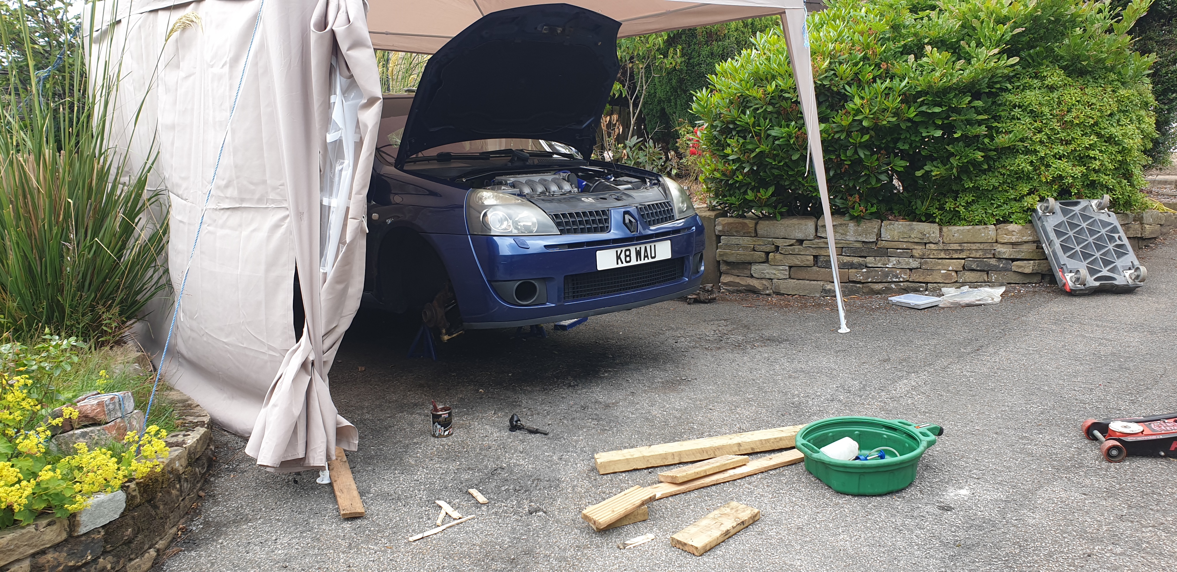

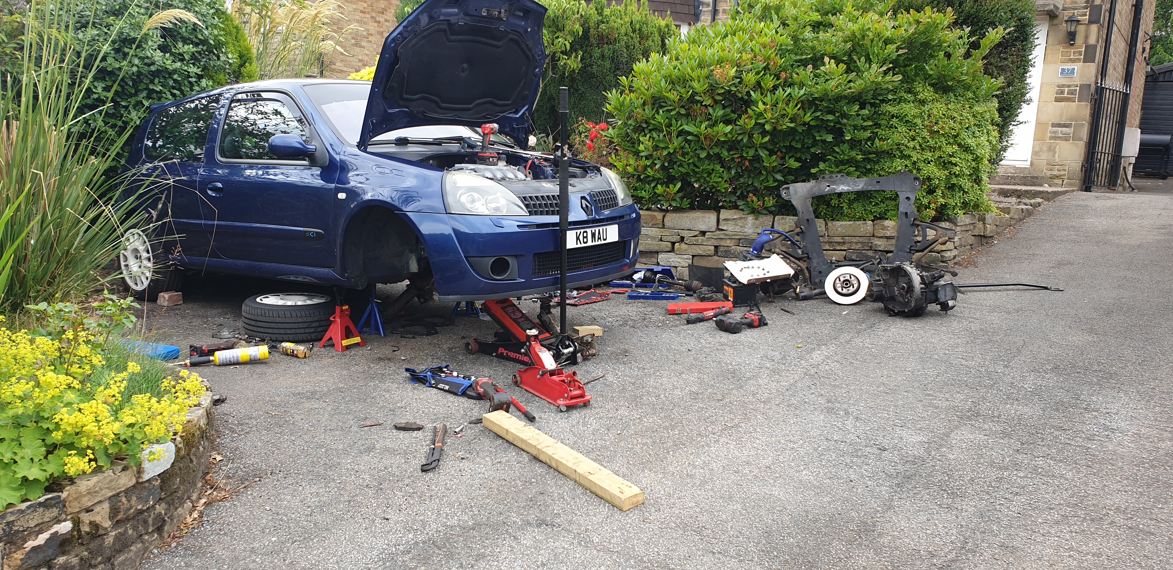

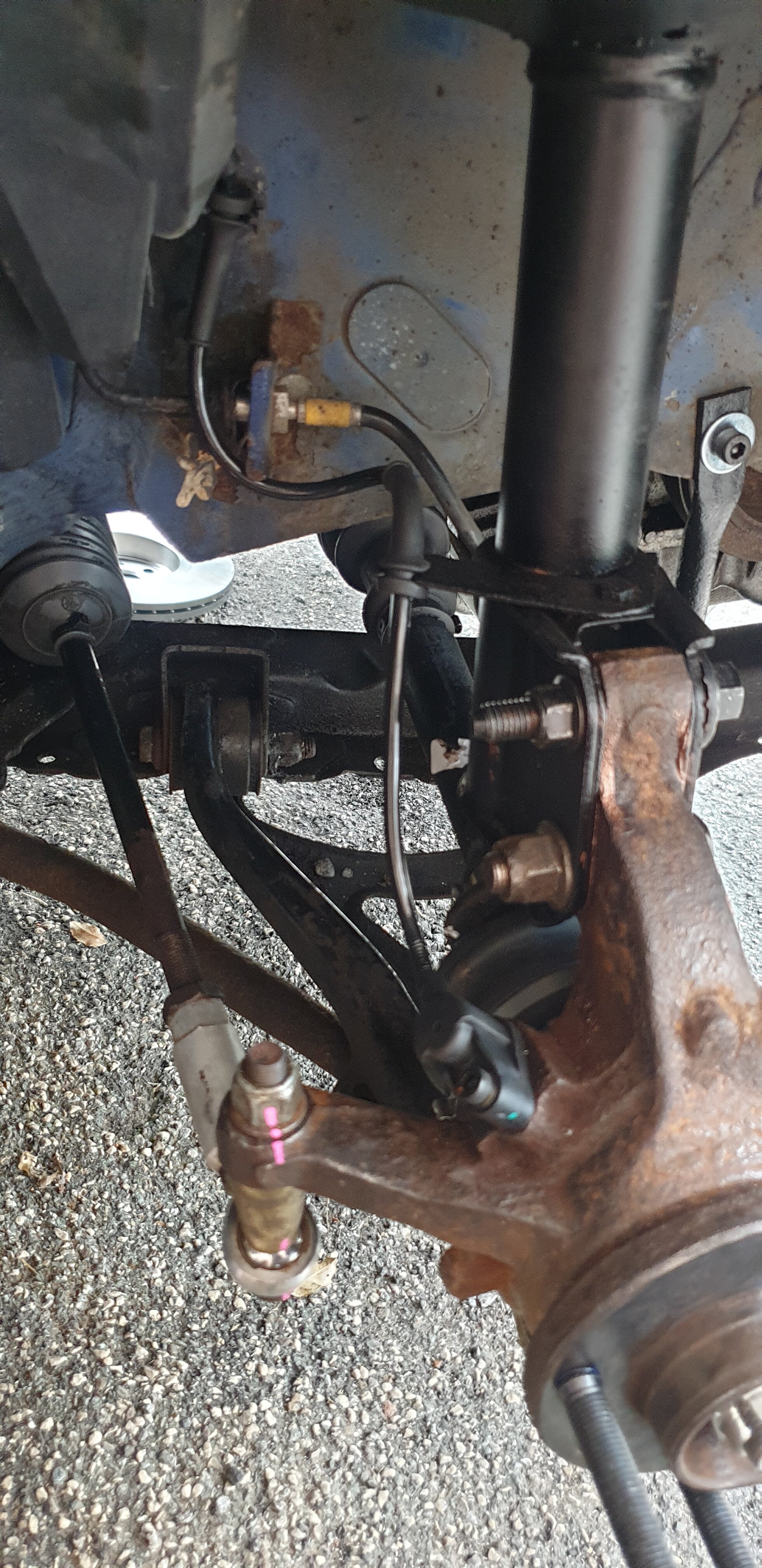

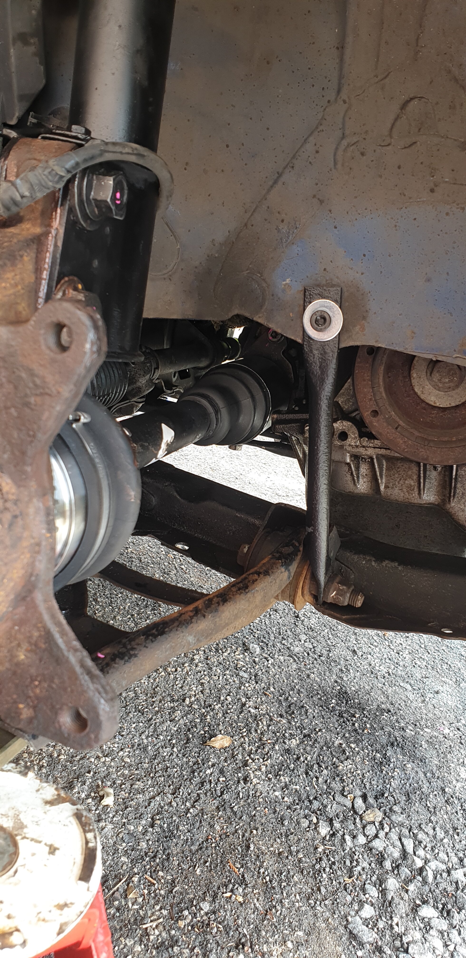

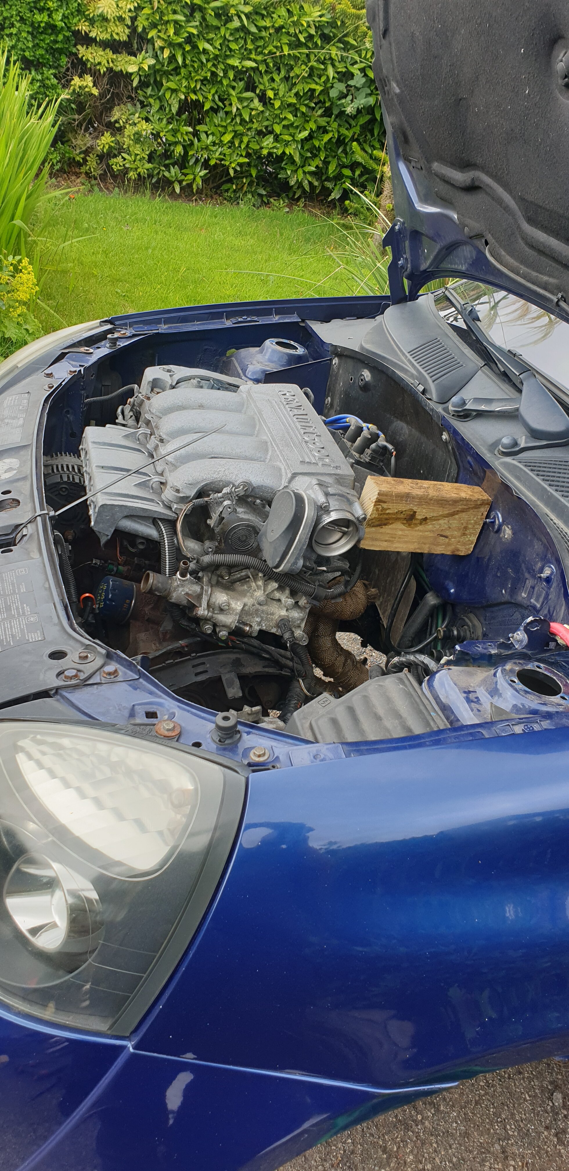

Set out to get everything stripped down. Everything including the shocks, hubs, subframe, gearbox, clutch, flywheel, shafts, top mounts, coolant hoses, airbox, battery ECU etc
Done. Took me about 4.5 hours to get it all stripped down

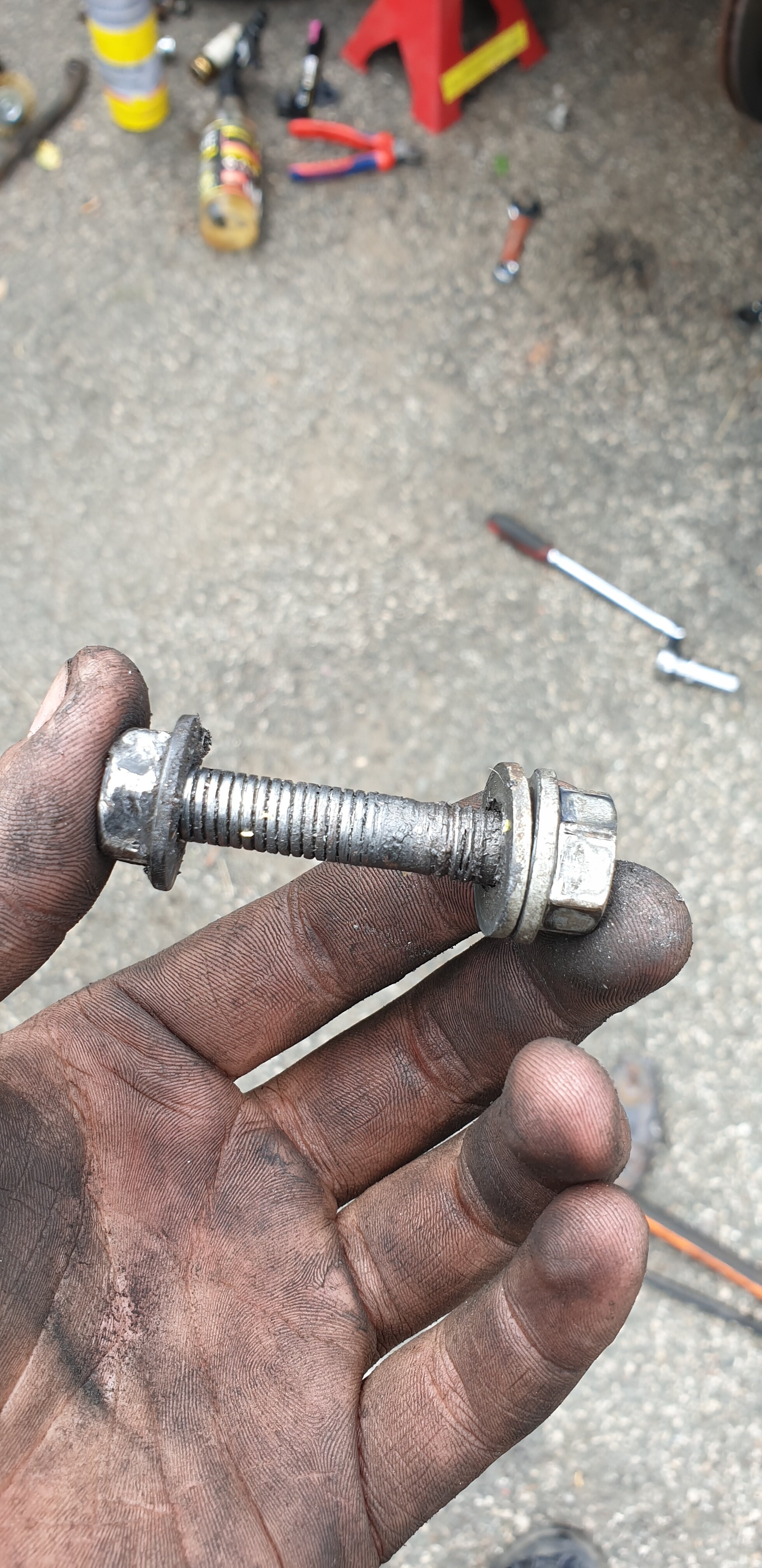

I struggled for 30 mins with 1 of the subframe bolts that decided to round itself to fuckery. Oh and that 509 mile old driveshaft I got the other week...
Pissed off, sent it back and bought a new one. The last one in the country to be exact🥲🤣

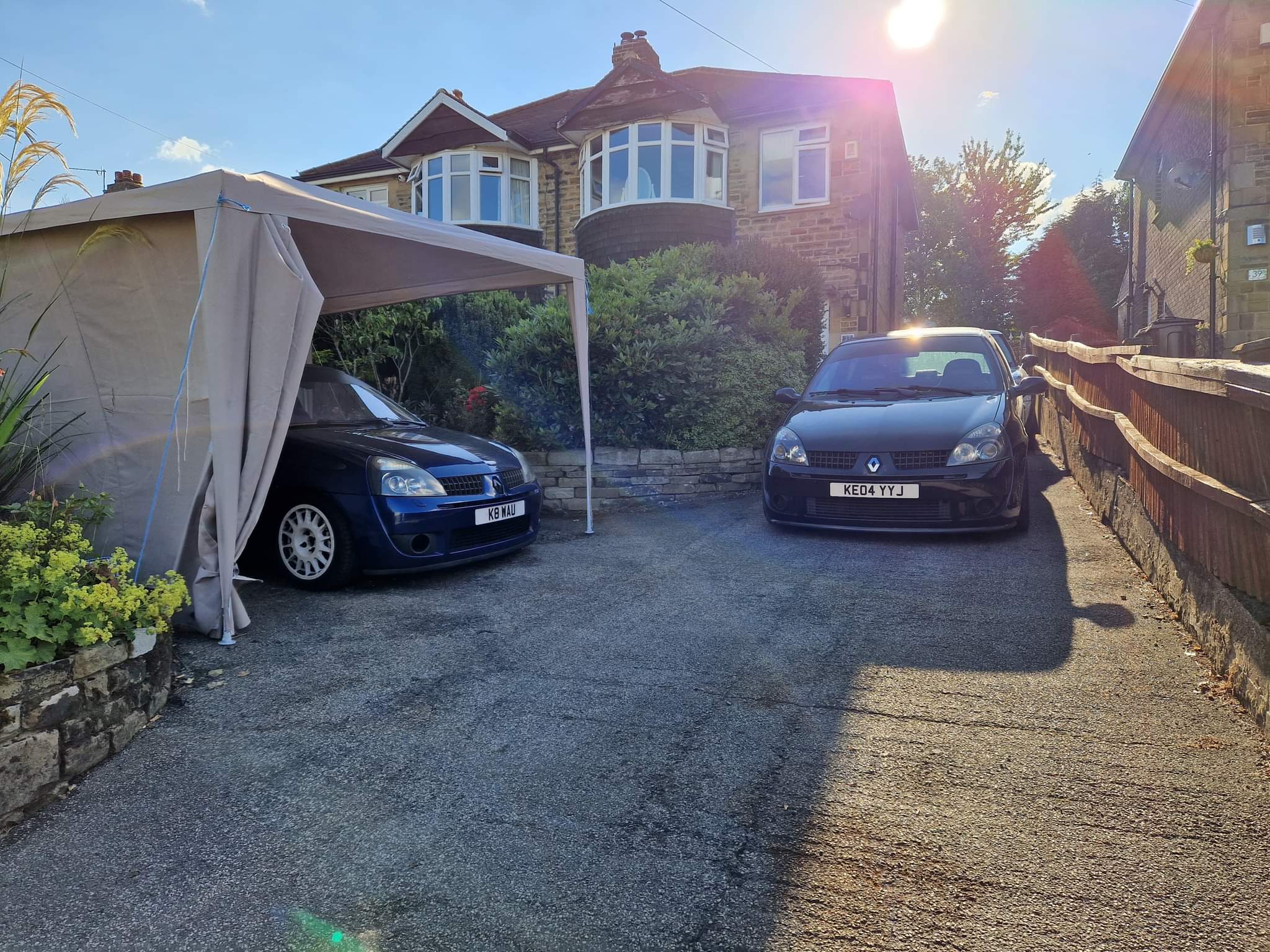

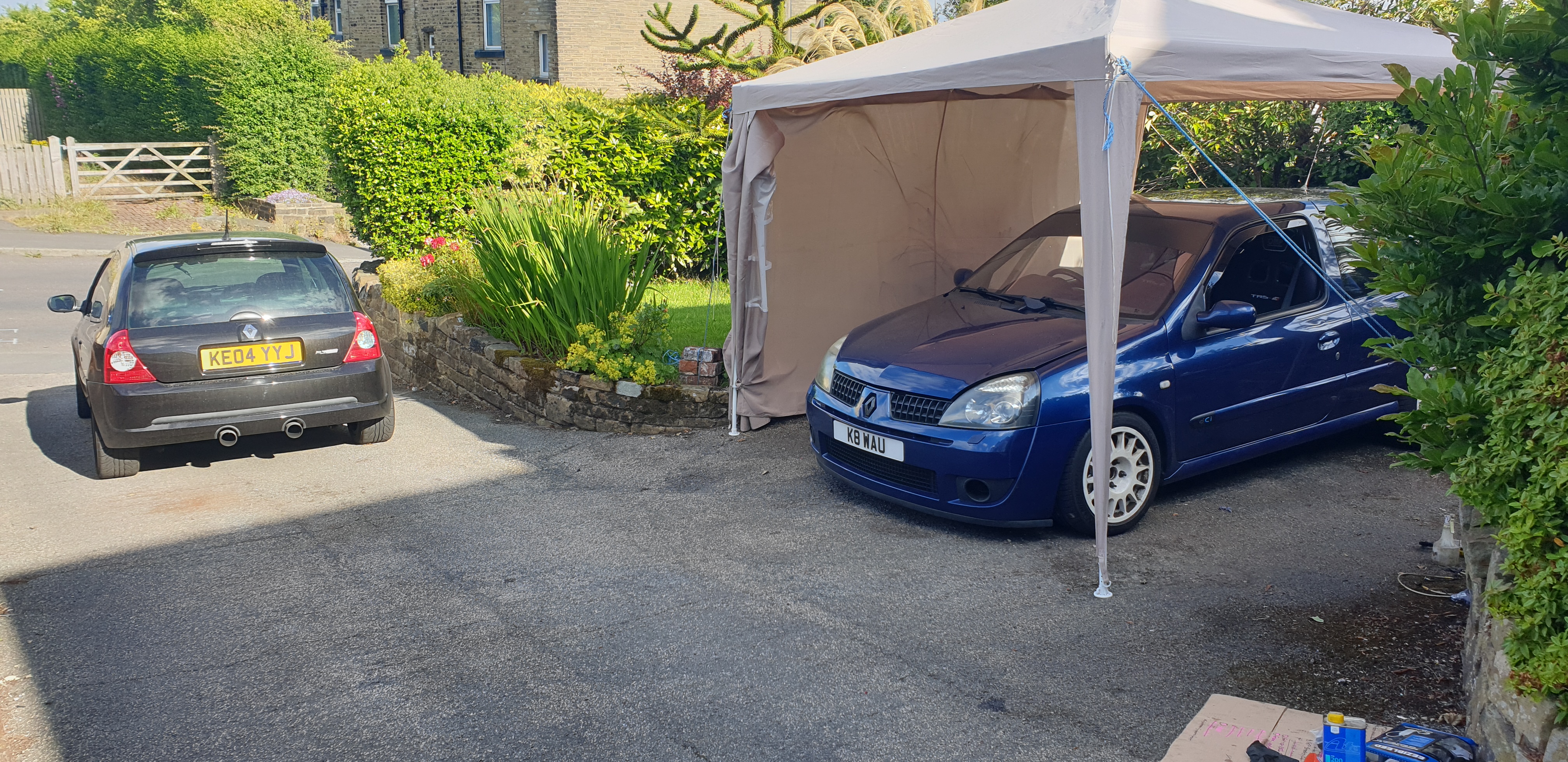

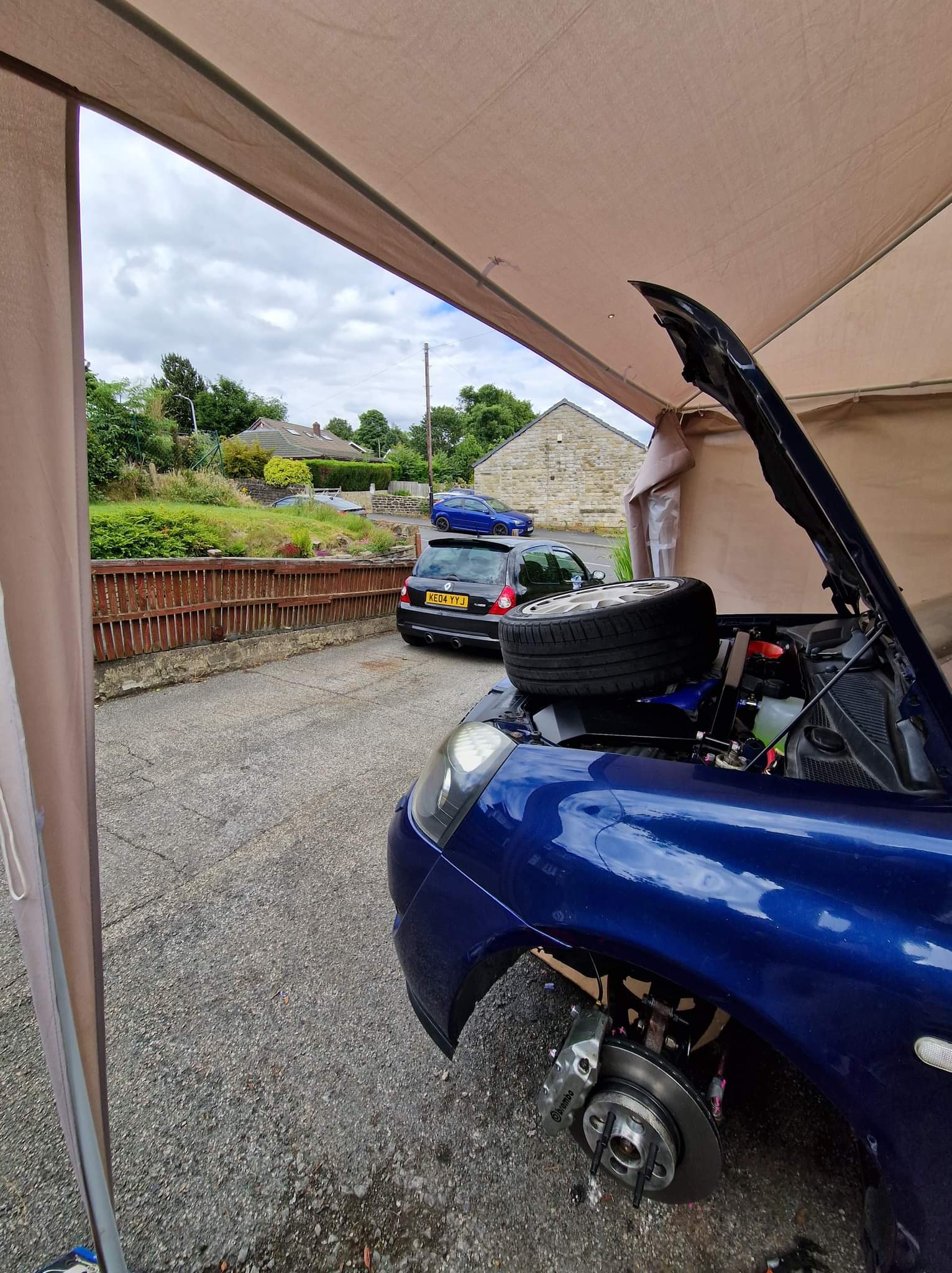

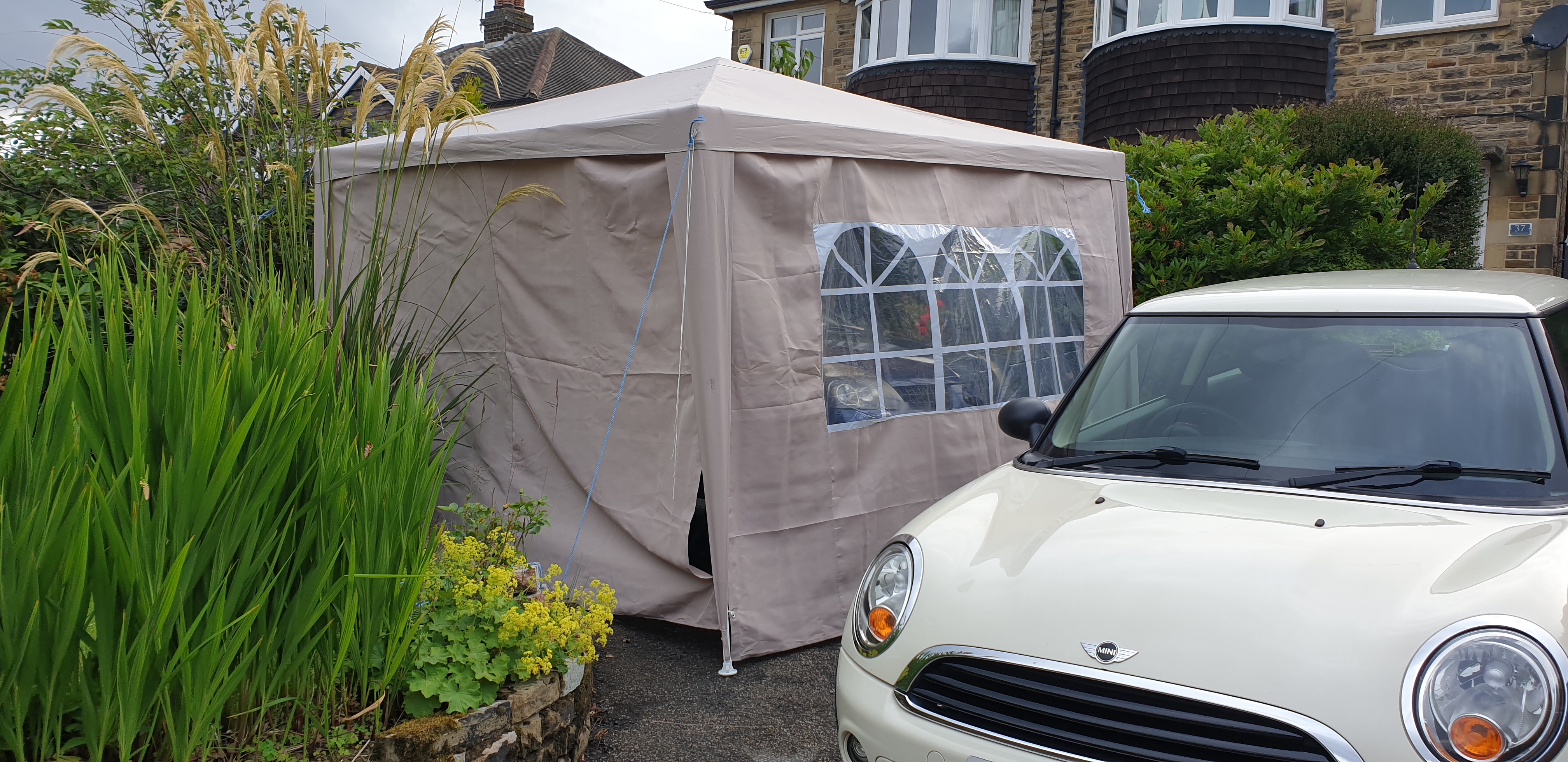

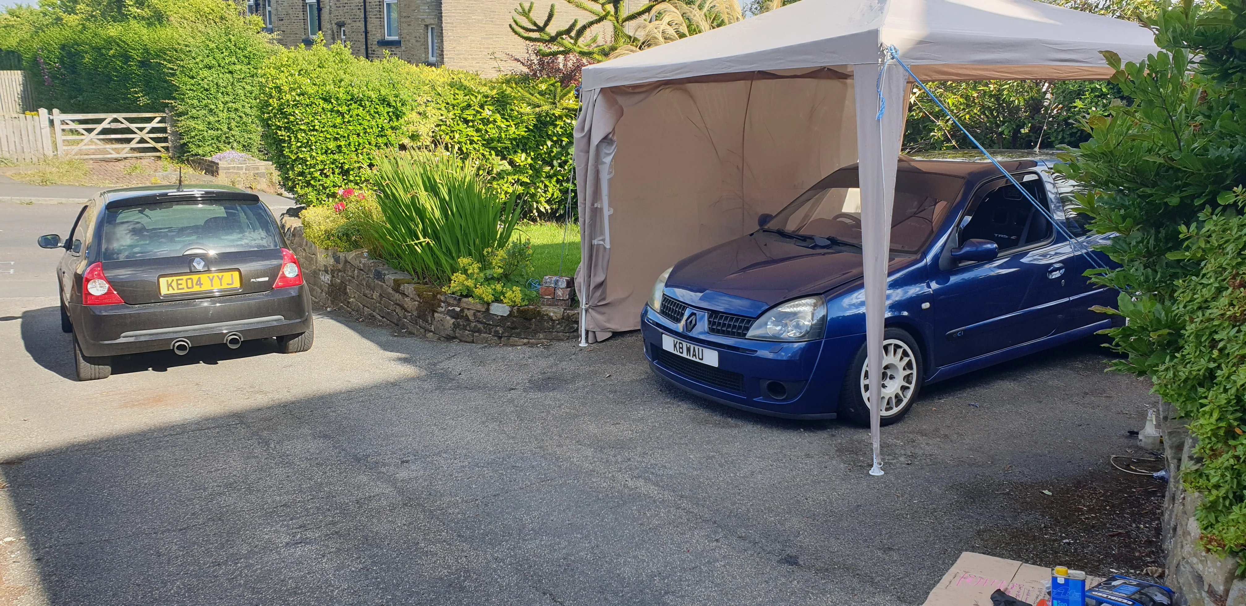

After getting everything stripped I set the gazebo up because it was meant to rain all week and I don't fancy getting piss wet

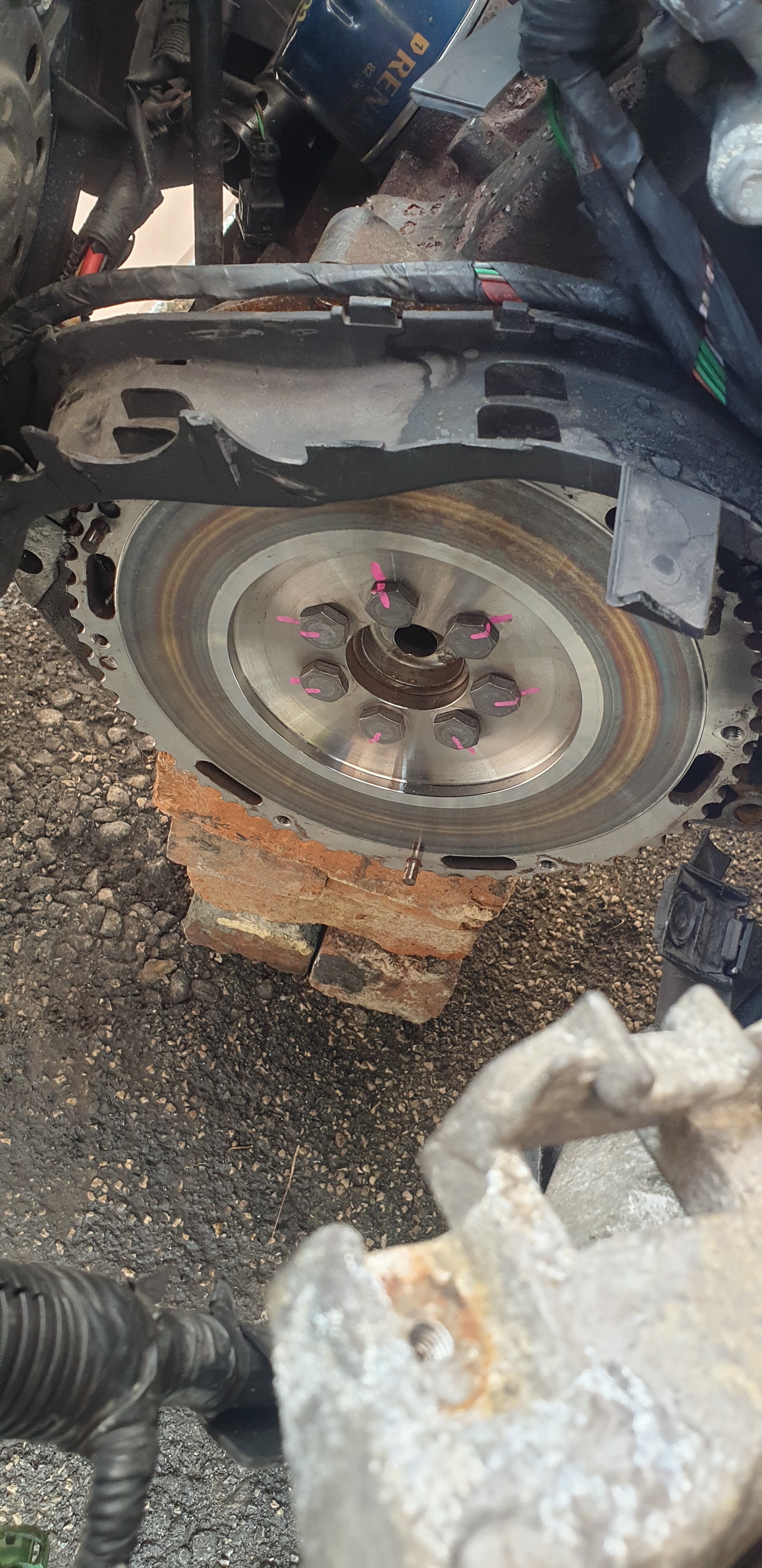

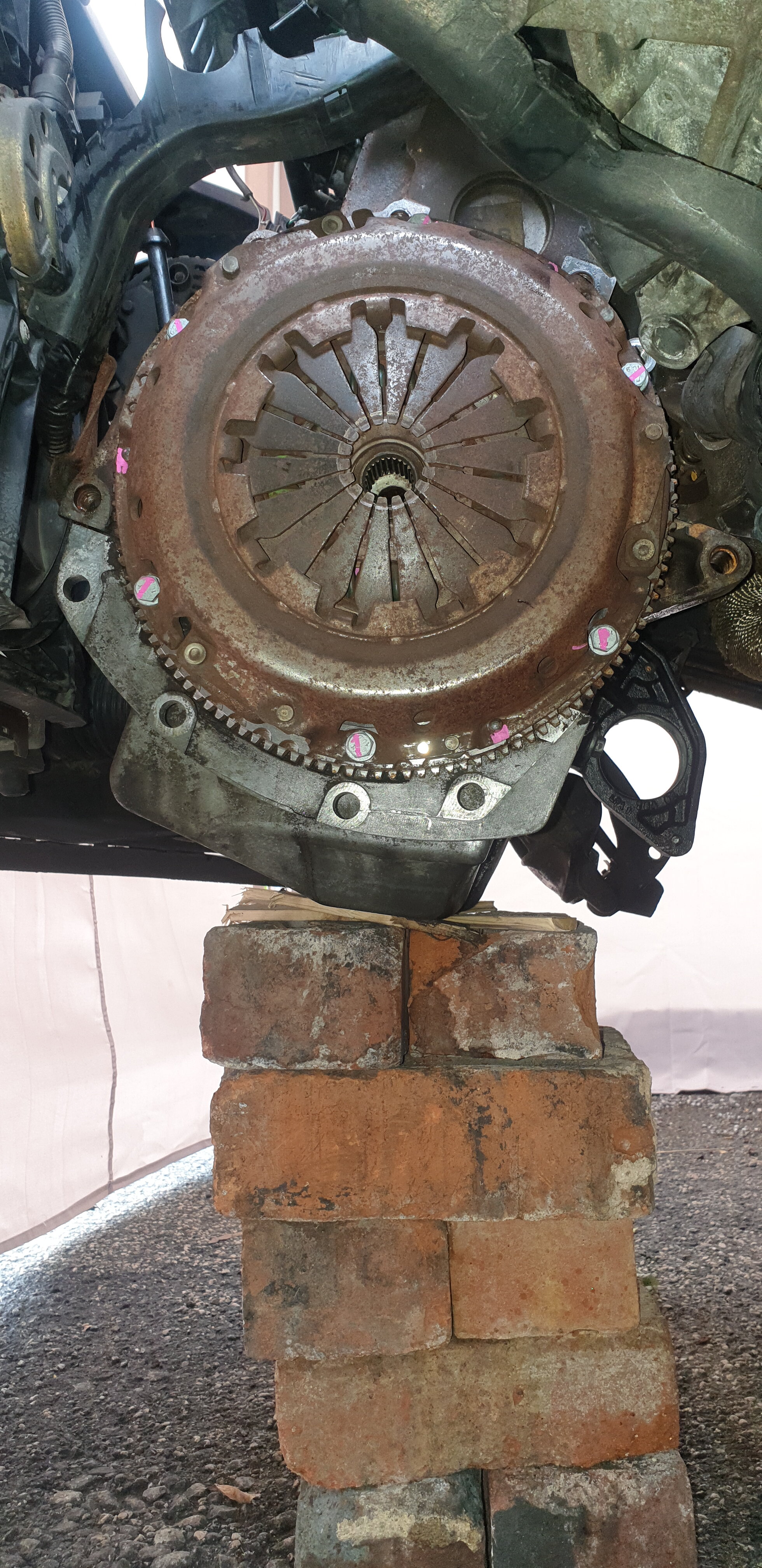

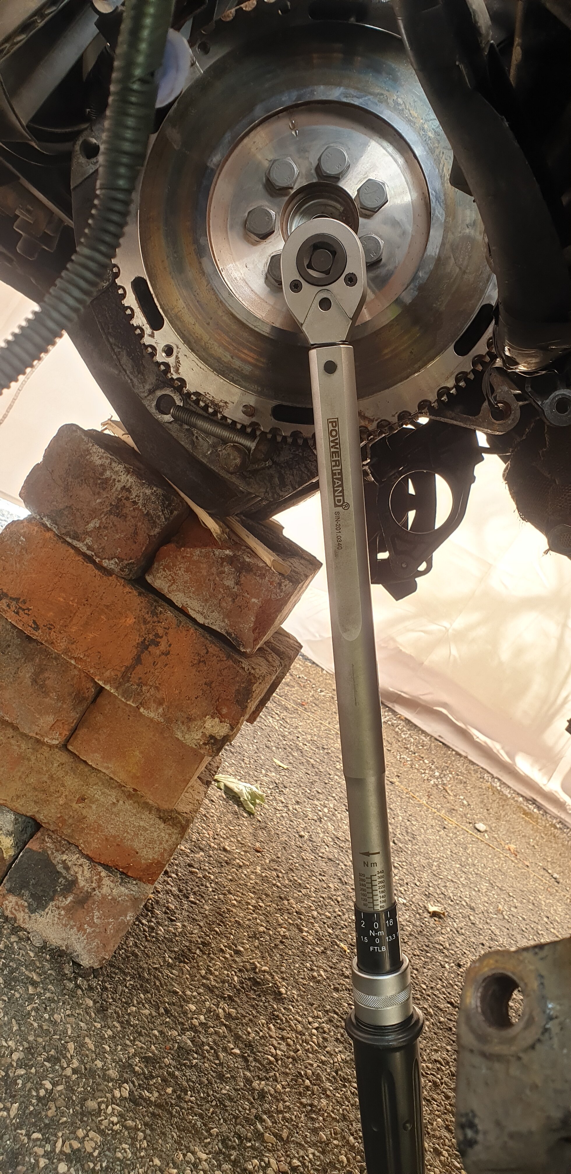

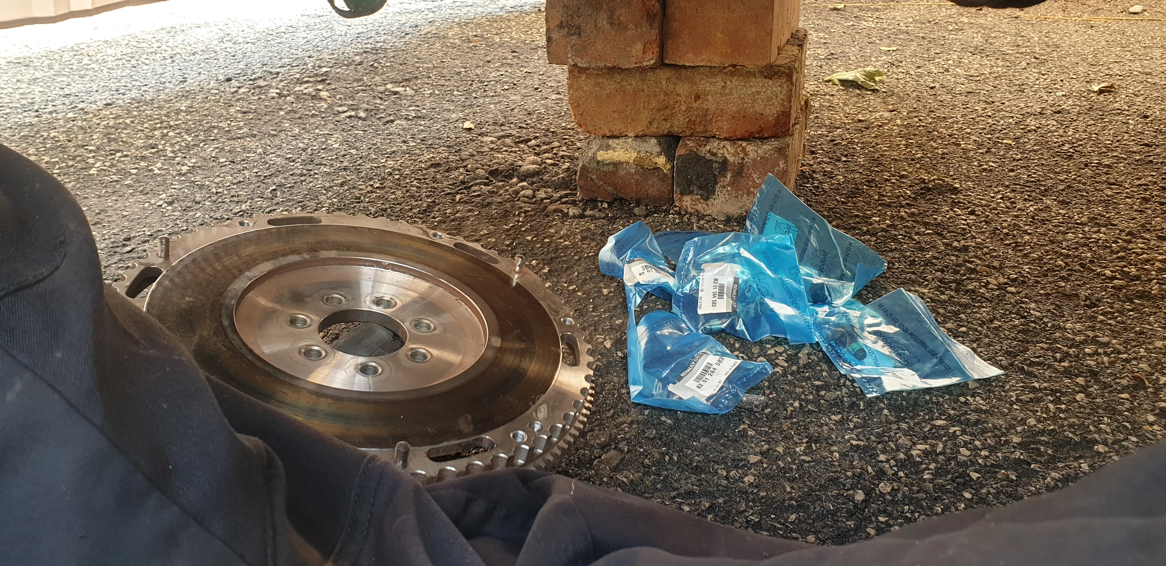

Found out that my car had a clutch just before I got it which was a genuine Renault Valeo and has been perfect. So that got put back on
New lightened flywheel with new genuine bolts
Nah I didn't send it, I used the proper tool which was calibrated and has been sat in the box waiting for this day. 55nm
Paint pen'd up

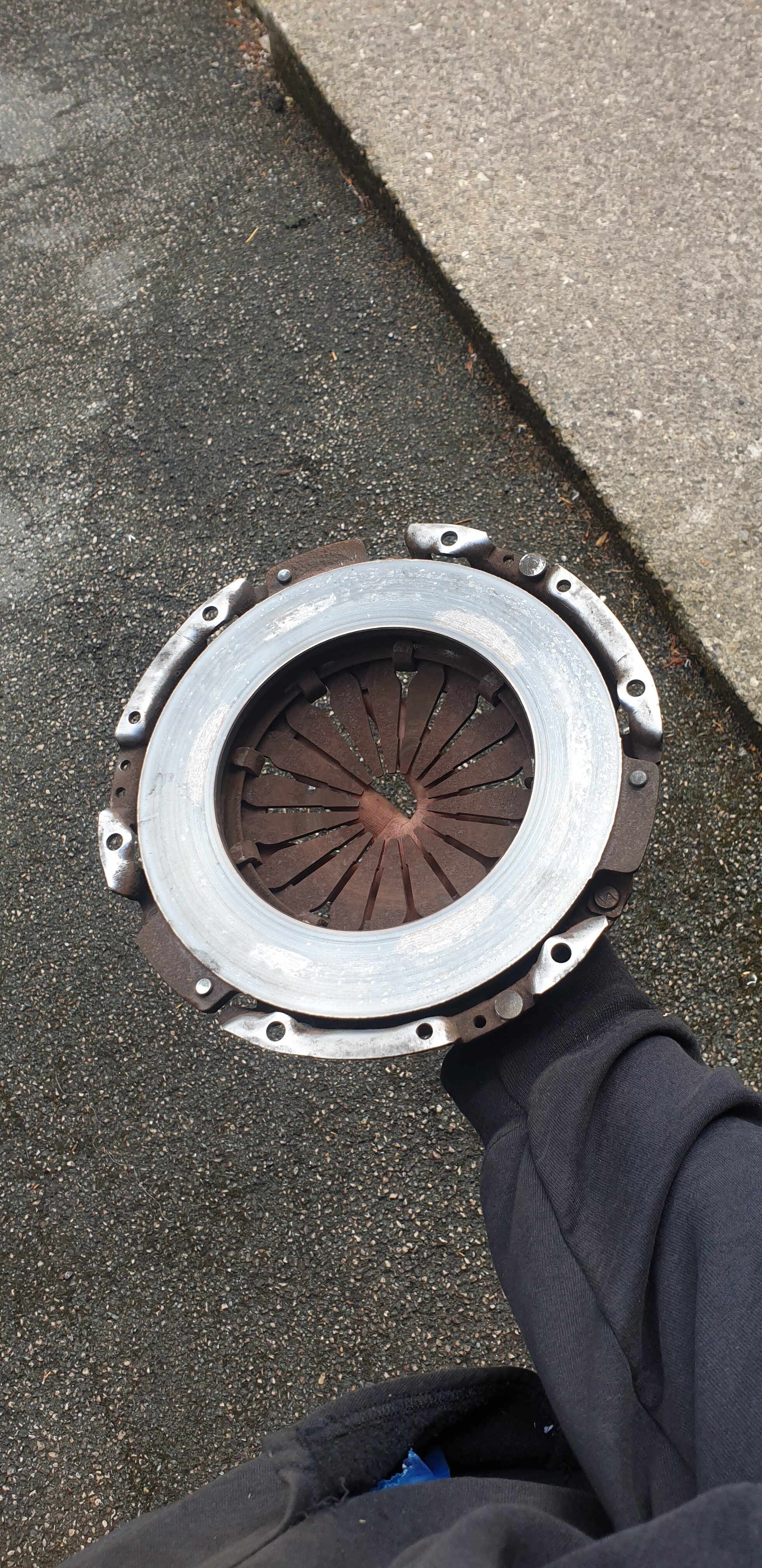

Cleaned the clutch pressure plate up with the die grinder
New clutch cover bolts, torqued to 20nm and paint pen'd

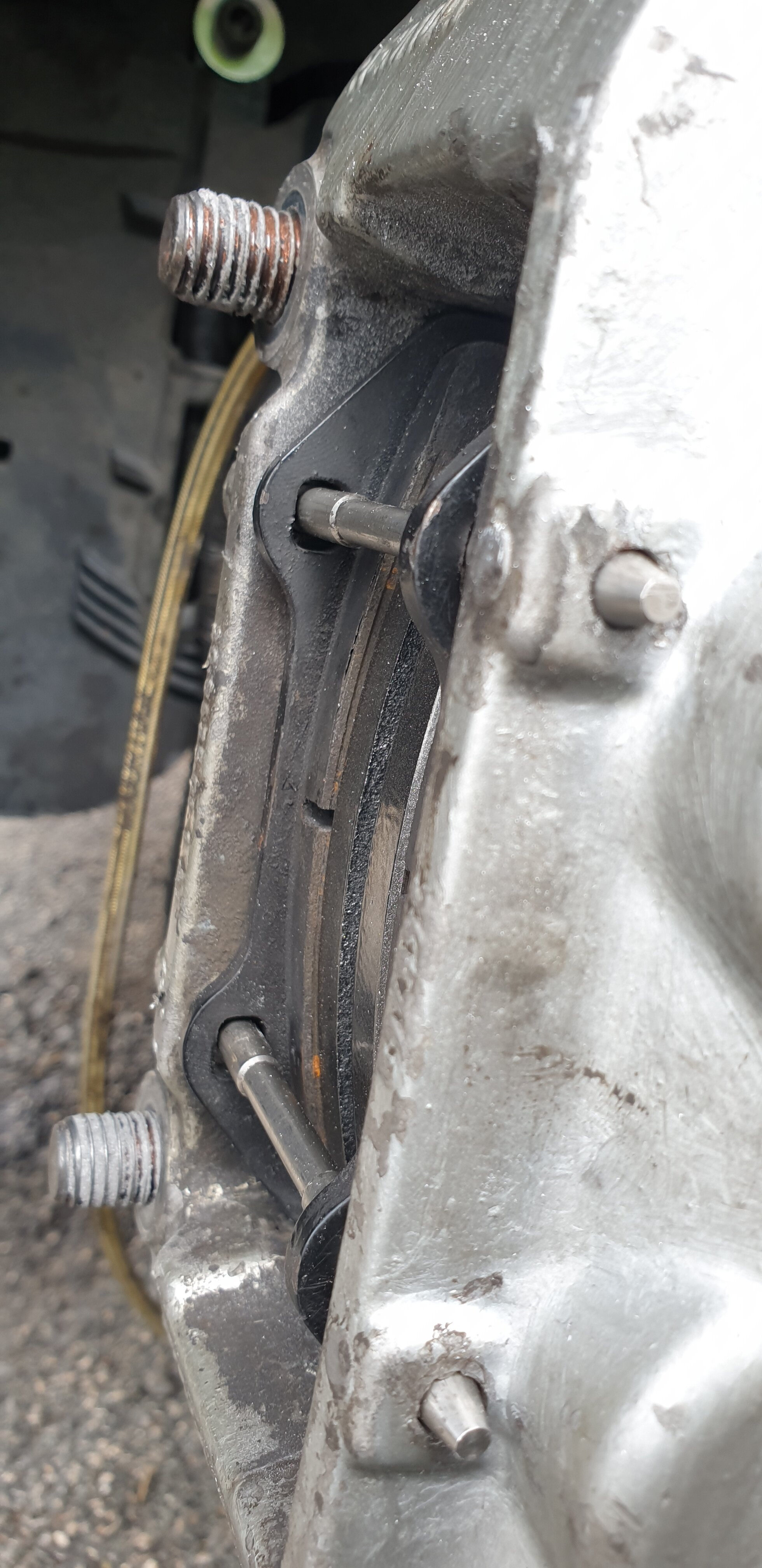

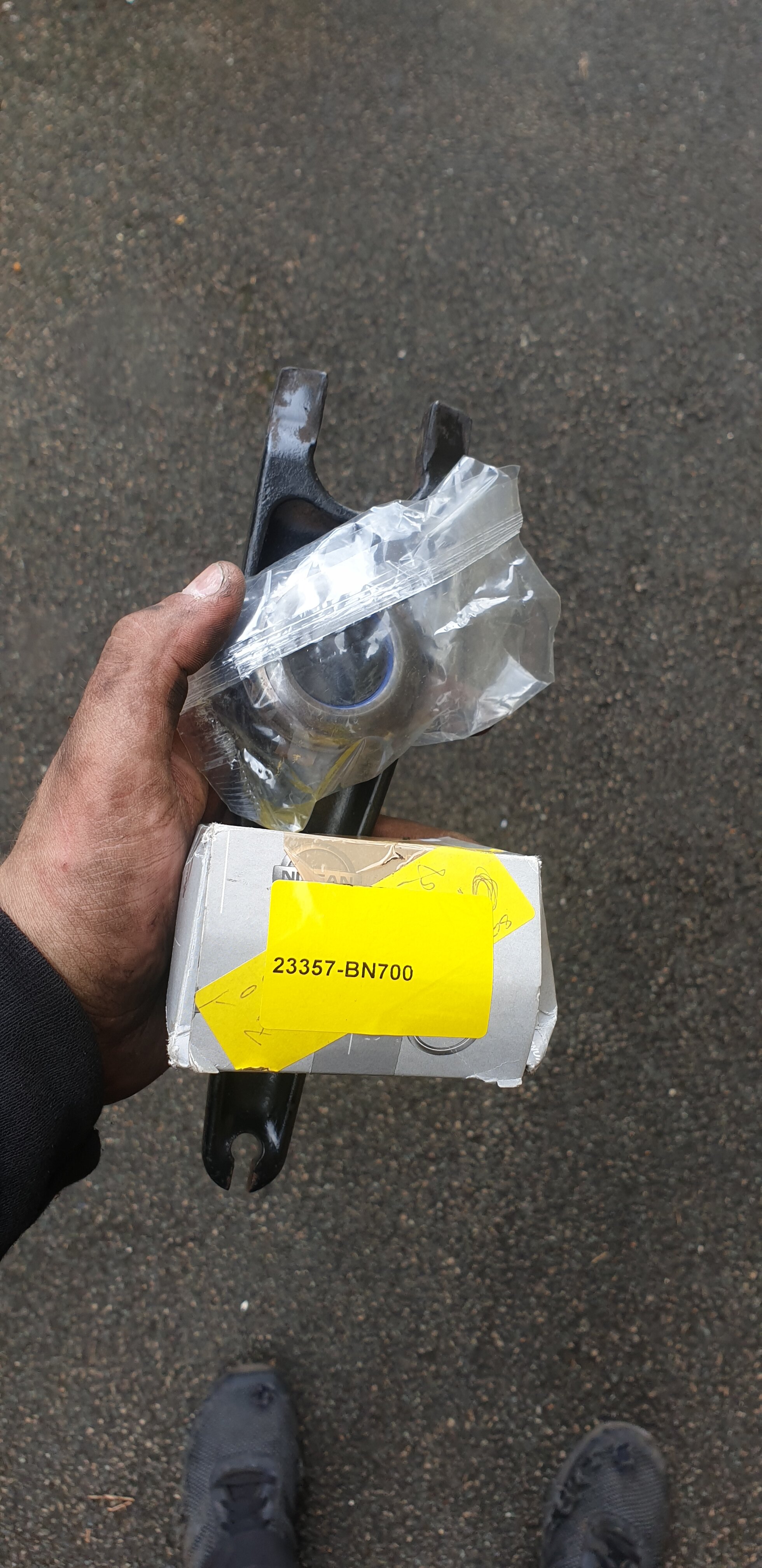

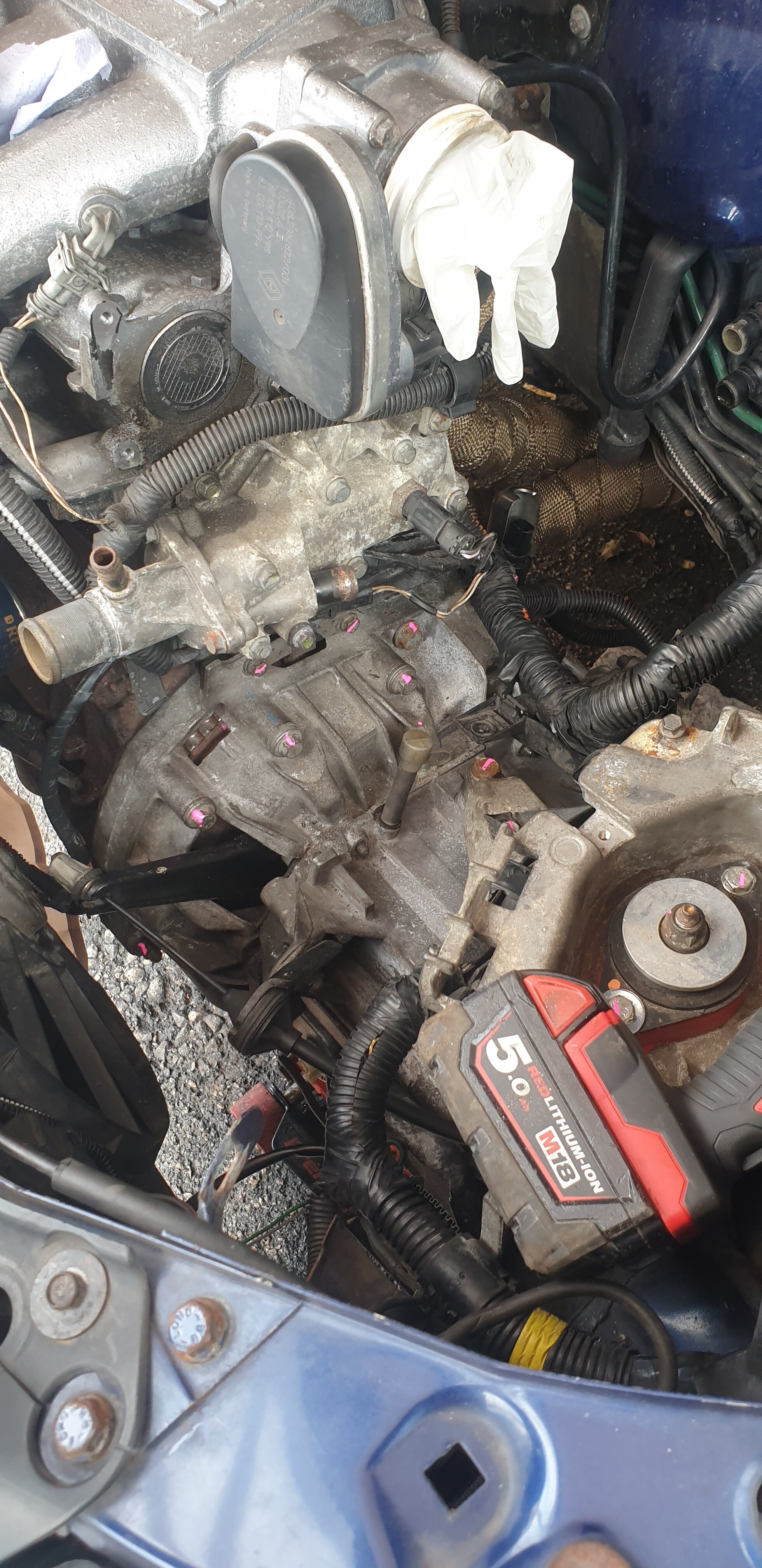

New clutch release bearing, genuine Nissan item and part number in the pic for anyone else. They're the same across all JC5 boxes
Gearbox in, was a right f**k about on my own but I got there in the end

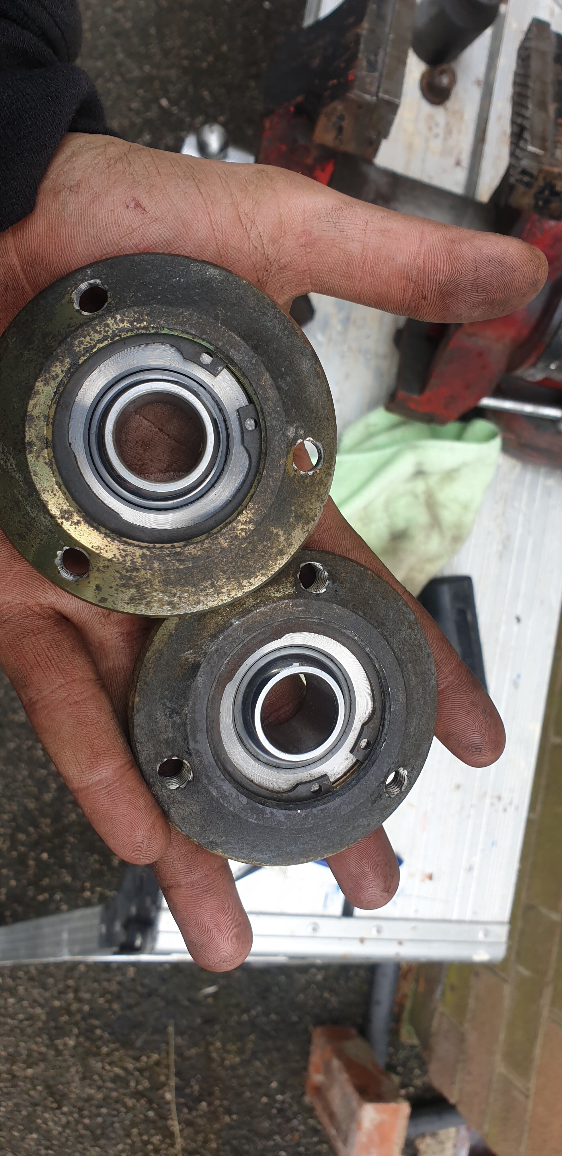

Started messing around to get the top mount bearings out, no press this time, just a lot of skill and strength with a vice on a f**king hop up🙃🤣
New bearings in
Continued in next post
Krarl
Old top mount bearings were shag-arsed, the 2nd top mount in the video shows what effort it should take to move the bearing🤣

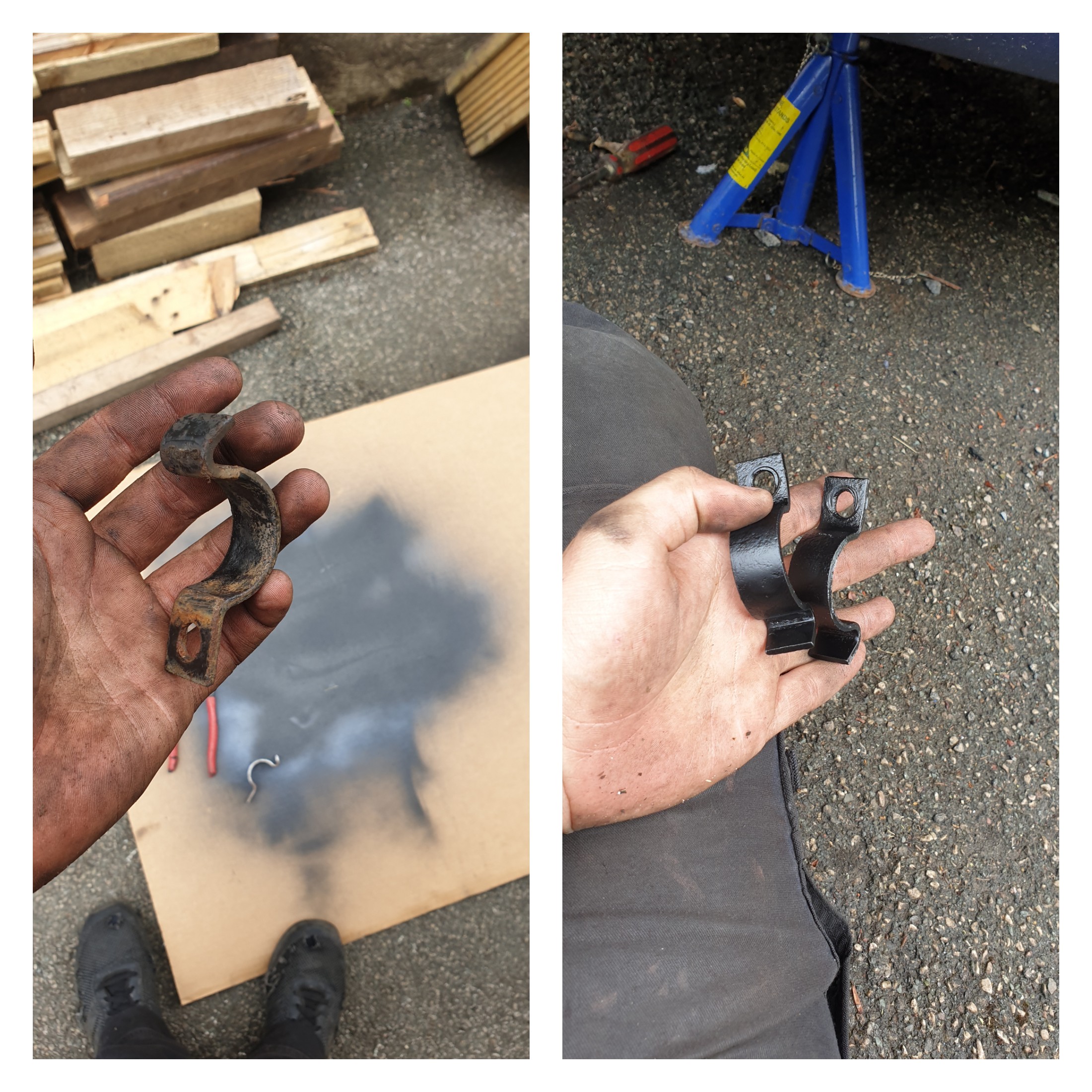

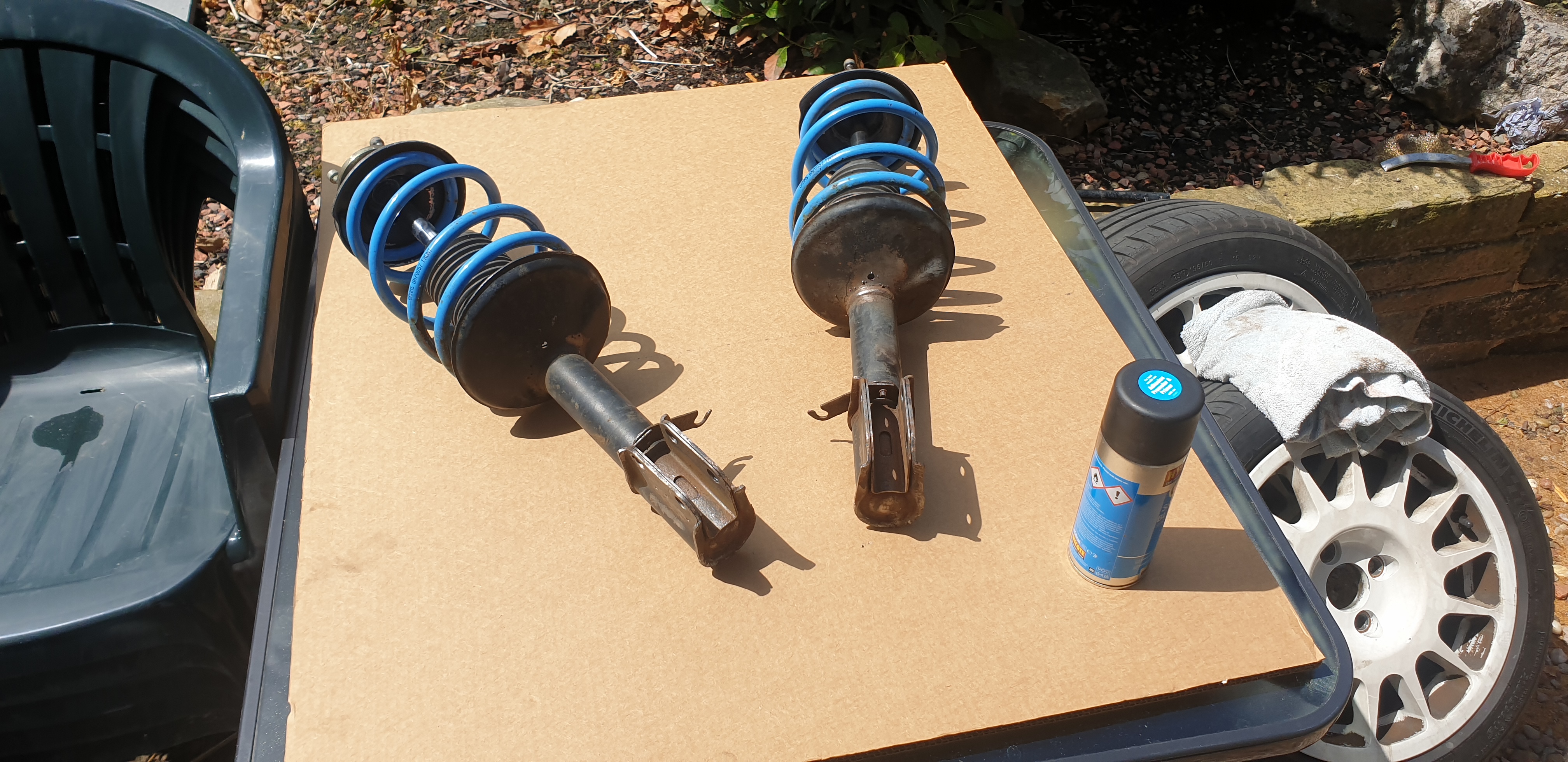

With all that done I started cleaning up a few shoddy looking bits whilst they were off

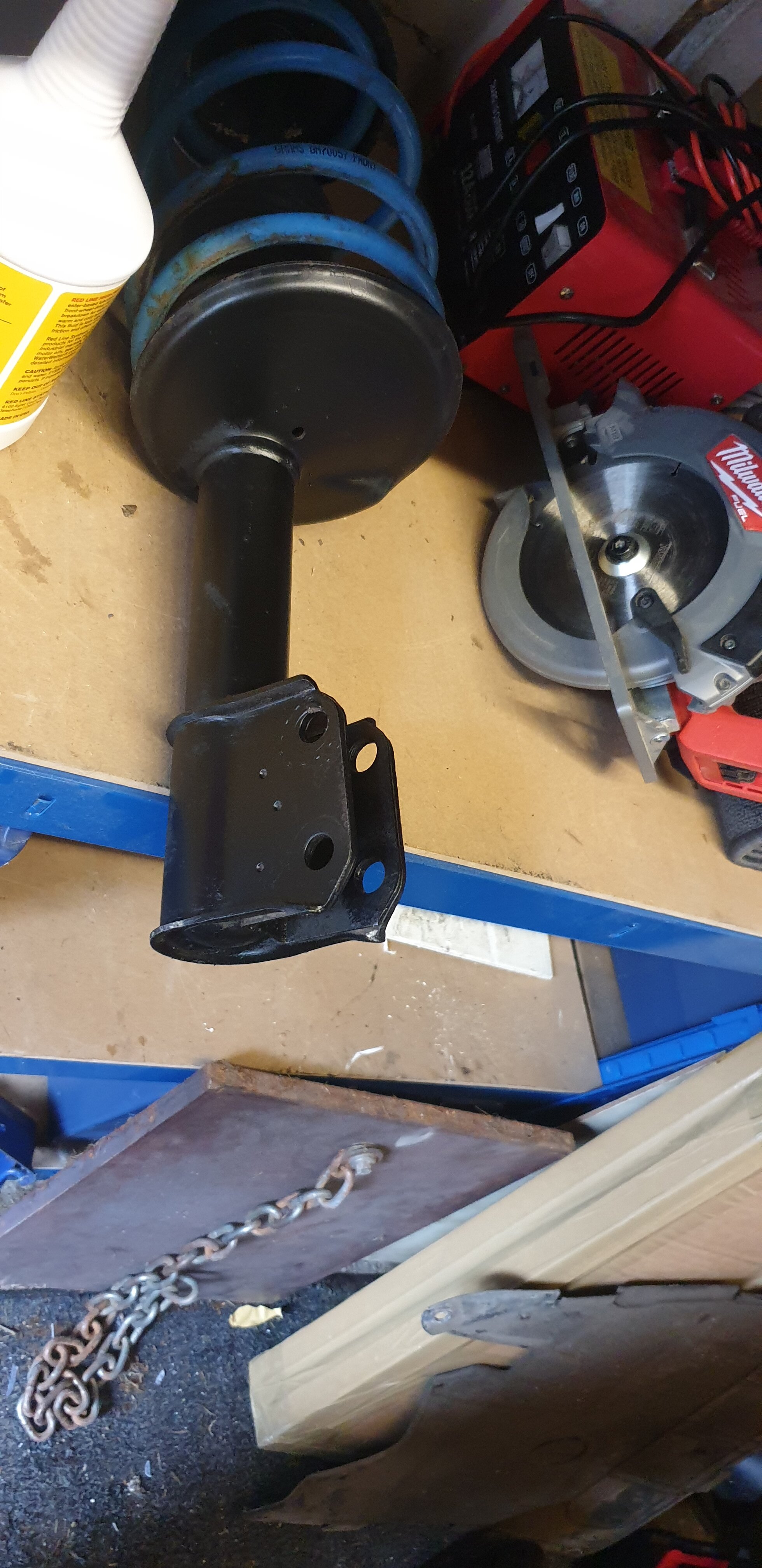

Shocks before
After

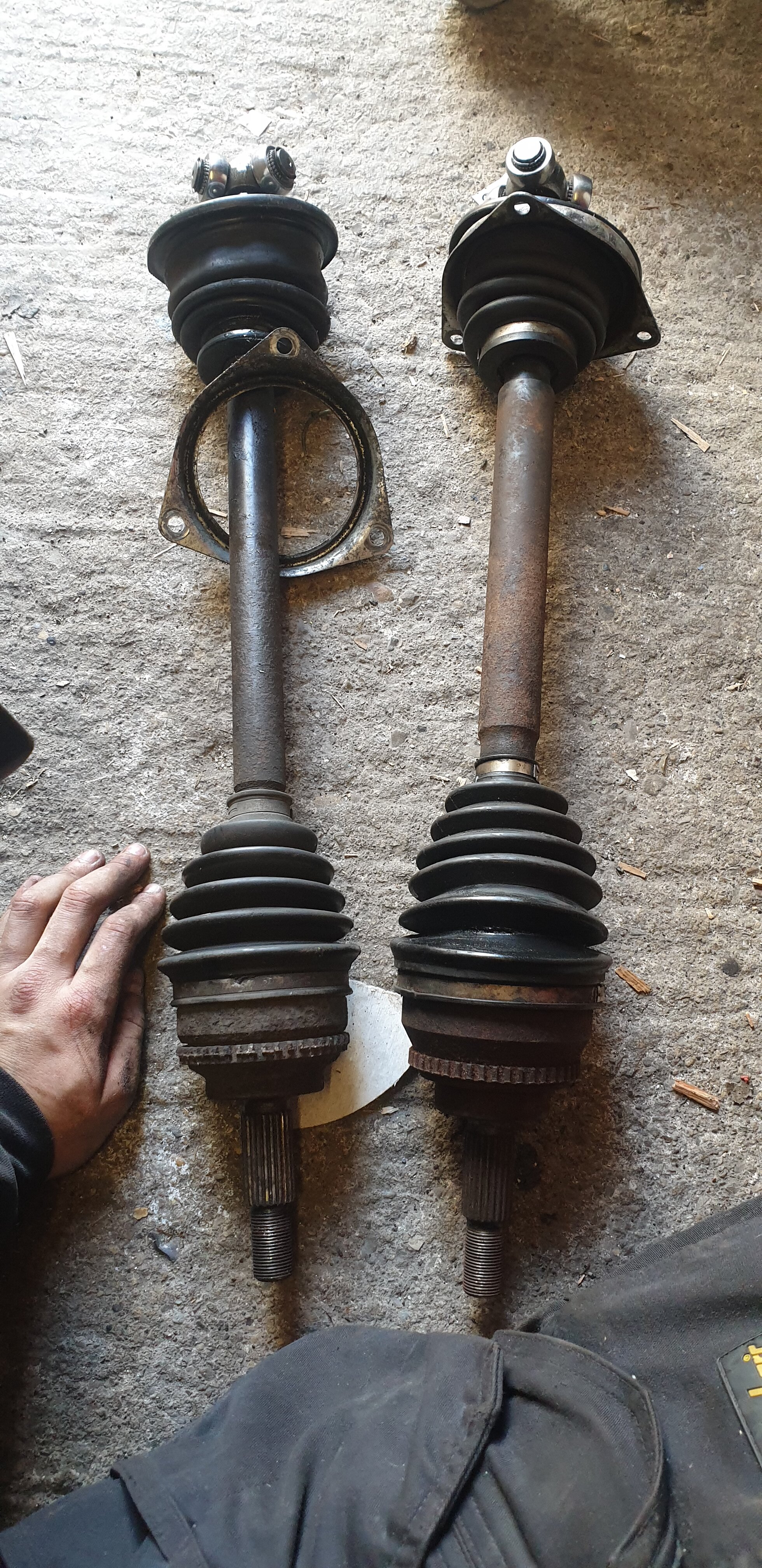

Old shaft on the left Vs the one I had in the garage which I believe is from a PH1. Not sure but it's way beefier

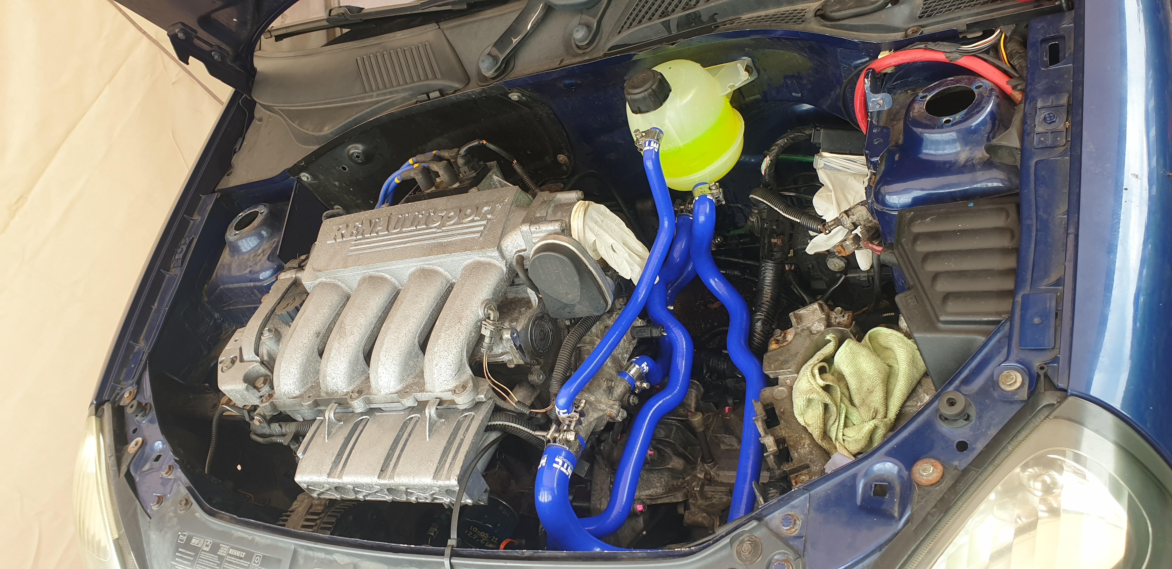

New coolant hoses on with Mikalor clamps, a new expansion tank and the Renault fruit juice

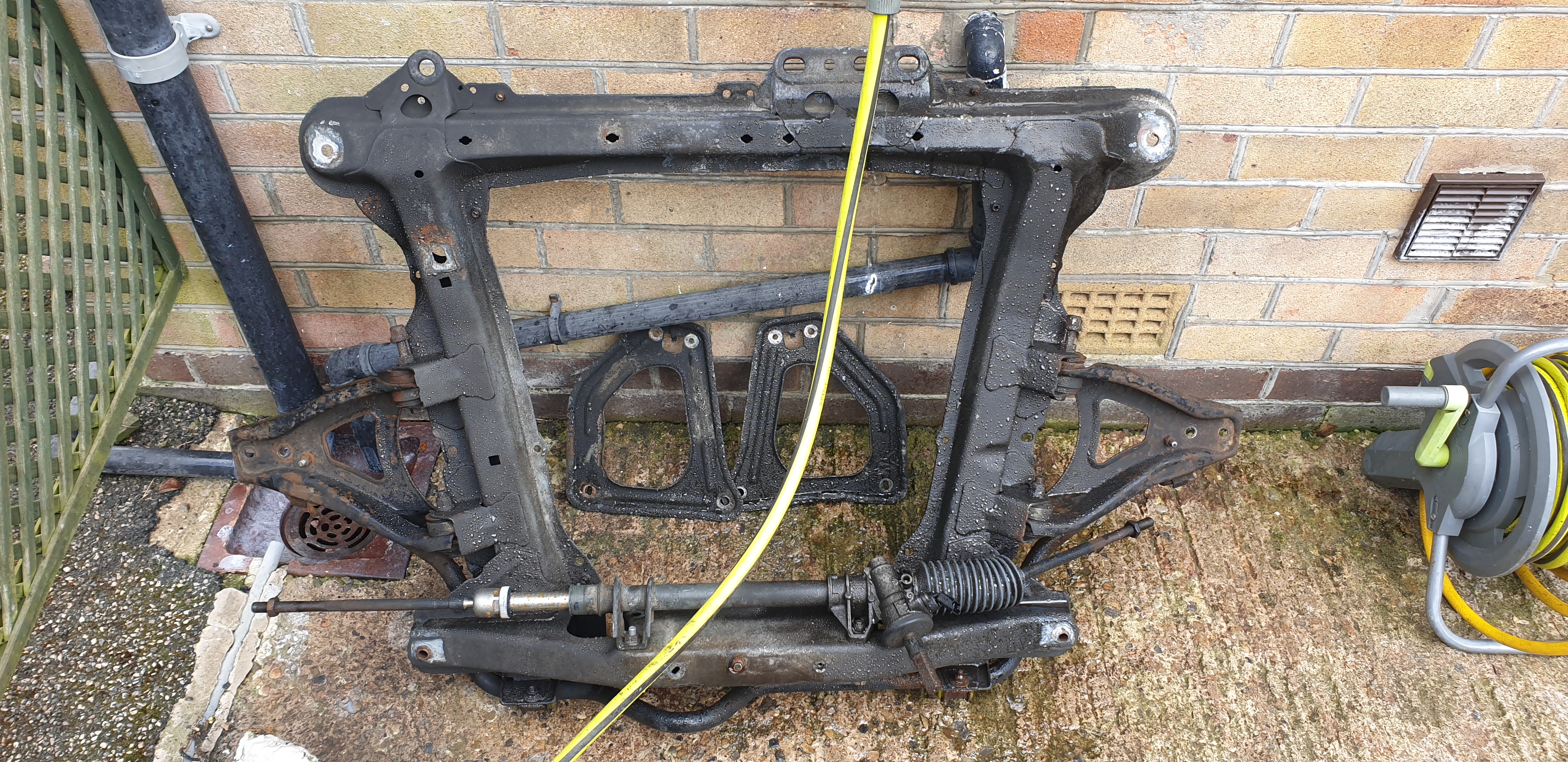

Set about cleaning the subframe, jetwashed it all down to get rid of the s**t, then degreased it, scrubbed it to f**k and jetted it again after
No before pic but imagine 10x more CV grease. Come to think of it I gave it another hit after this with some heavier duty degreaser and it came up a tad better

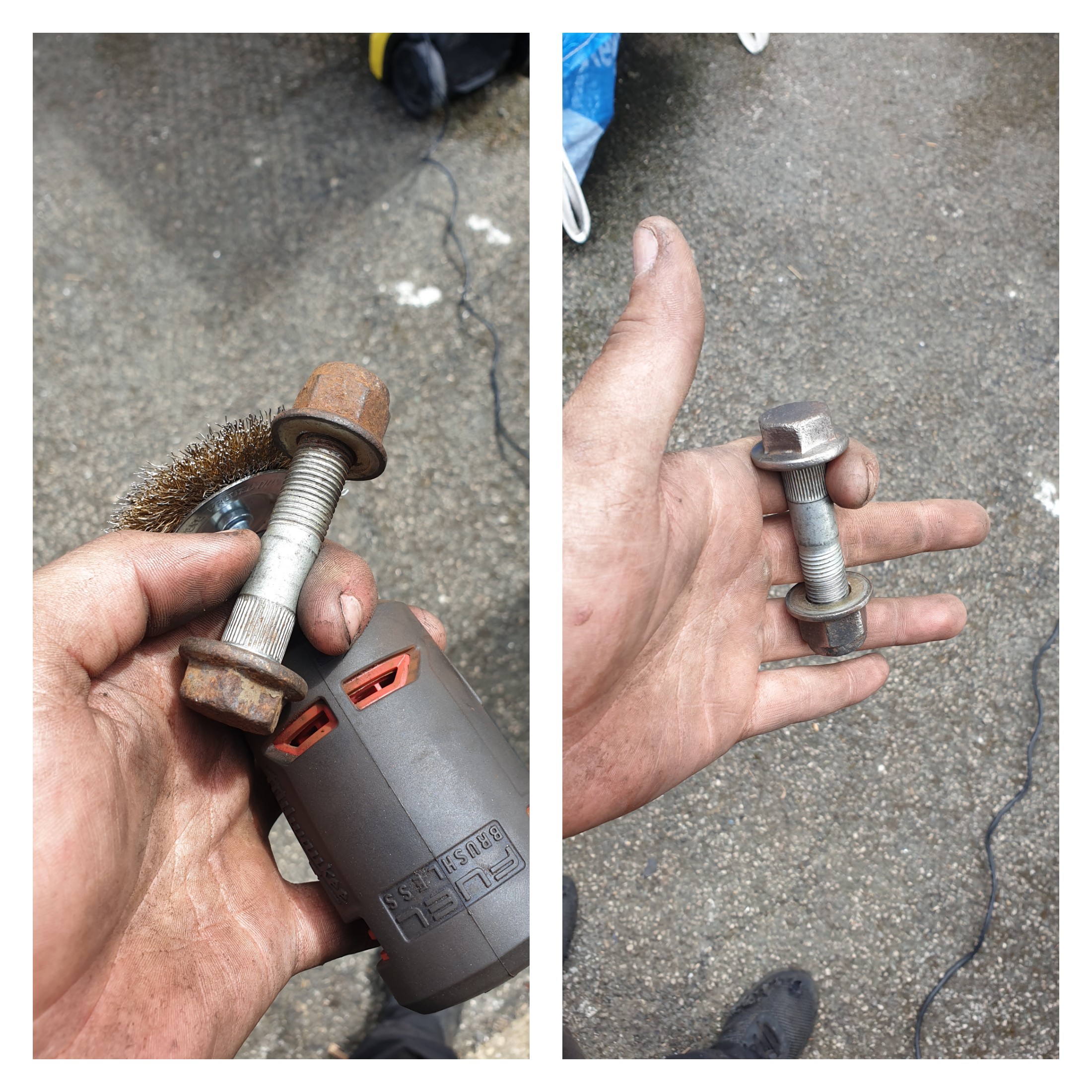

I was in a cleaning mood so all the bolts got some die grinder action

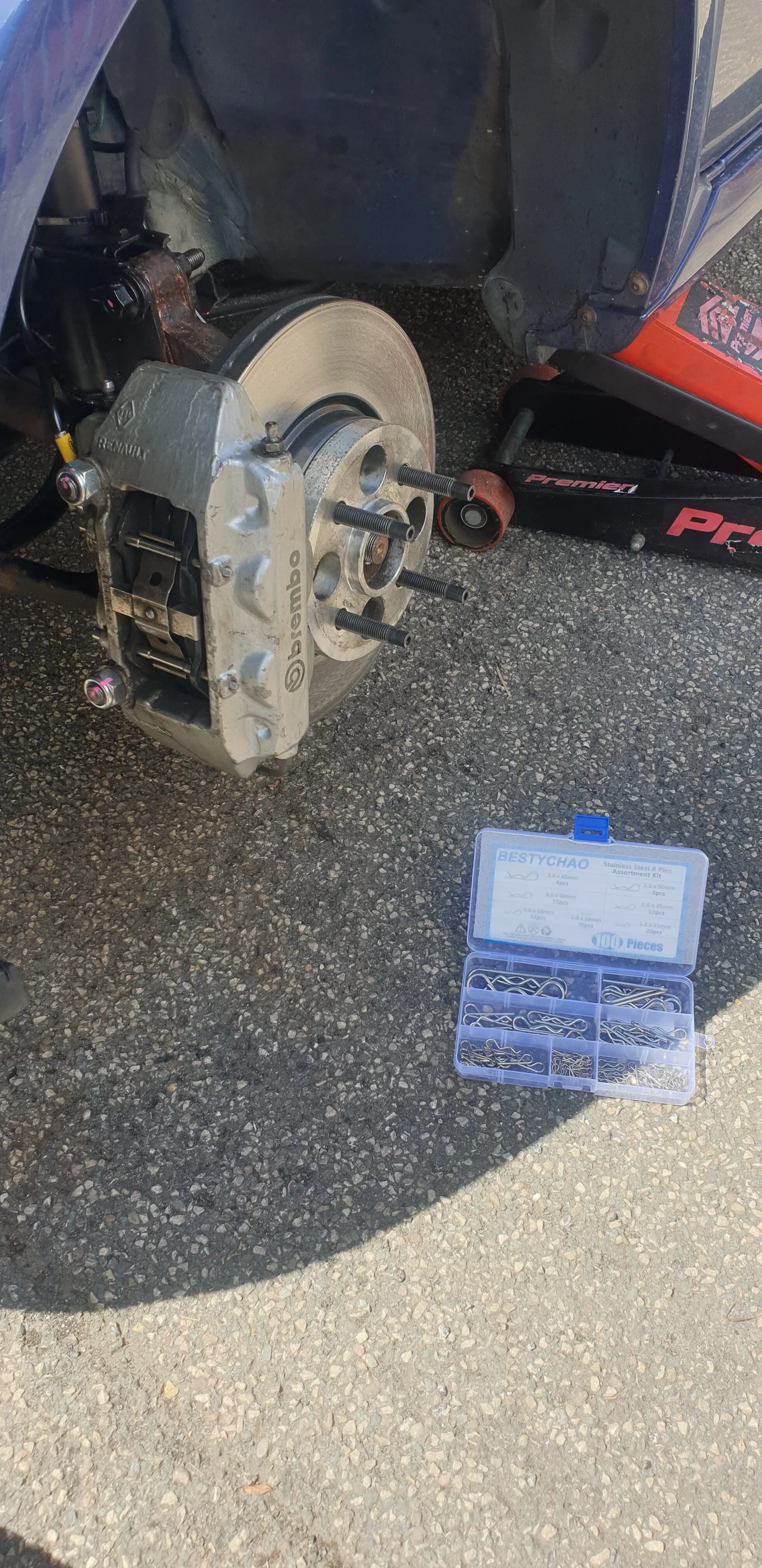

Got the subframe back onto the car, Christ it took the piss. Mainly because my driveway is as smooth as the moon so moving the jack resulted in the subframe falling in my face several times as it slipped off
Despite being attacked by the subframe I got it back up on my own without dying.
I then spent the next few hours slowly adding more and more parts to the car
ECU, battery, battery tray all back in. Gave the battery cover a wipe with brake cleaner on a rag...

Cleaned and painted the ARB brackets too
Better
Refreshed some of the hardware
Sealed the exhaust back up with some nice mastic. People joke and laugh but the proper gasket is f**king s**t and mastic is the cheapest and best way of sealing an exhaust. Never ever had an issue sealing an exhaust with mastic🤣

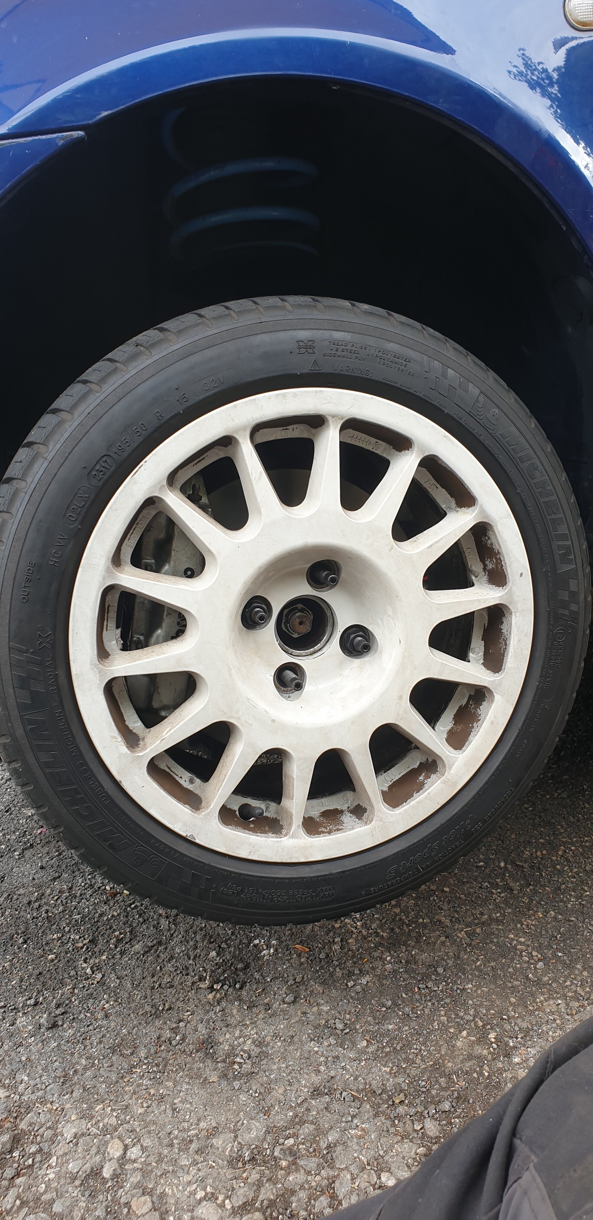

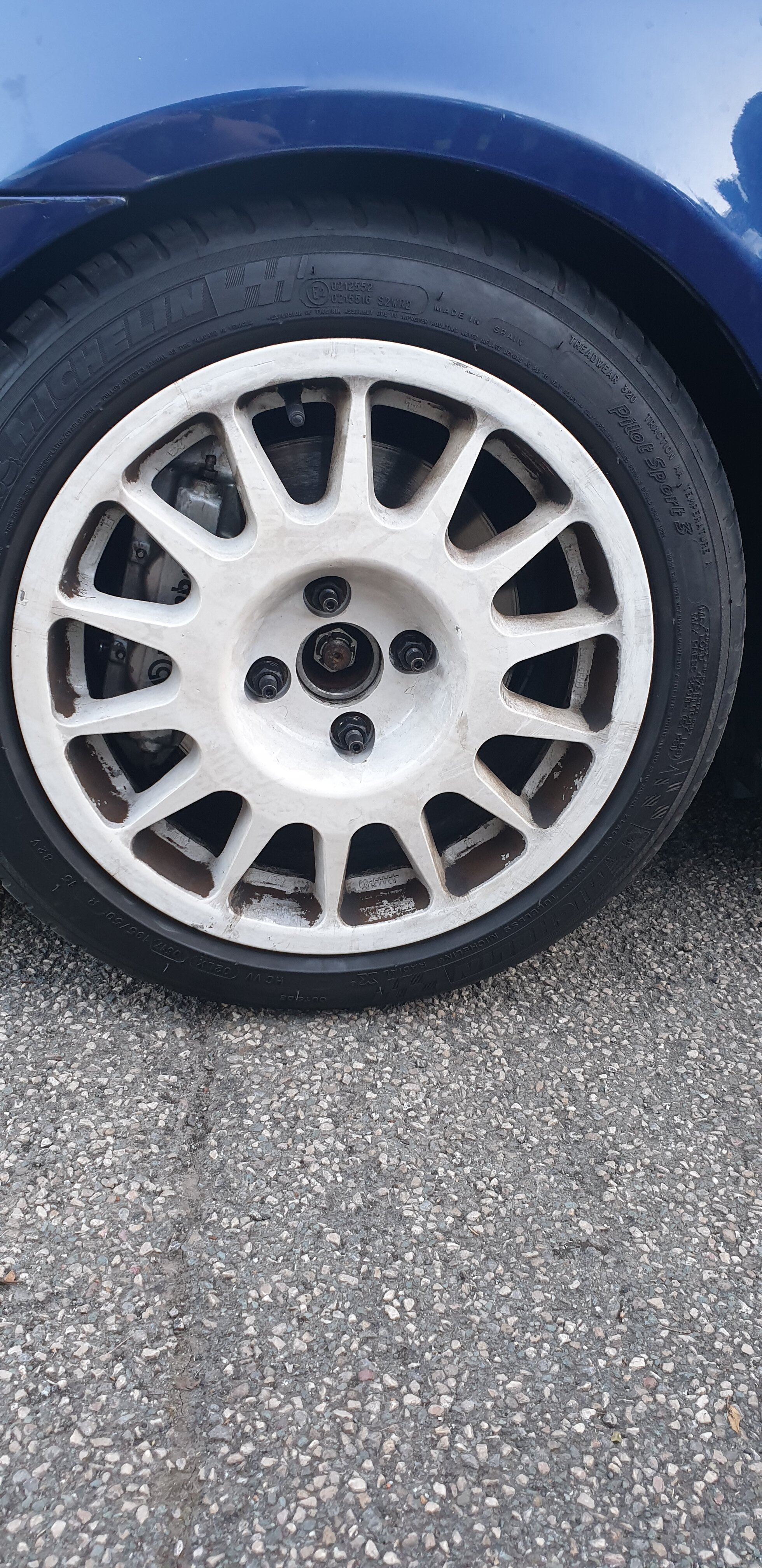

I then set about test fitting my Brembos
The wheels clear with loads of room
Krarl
Friday

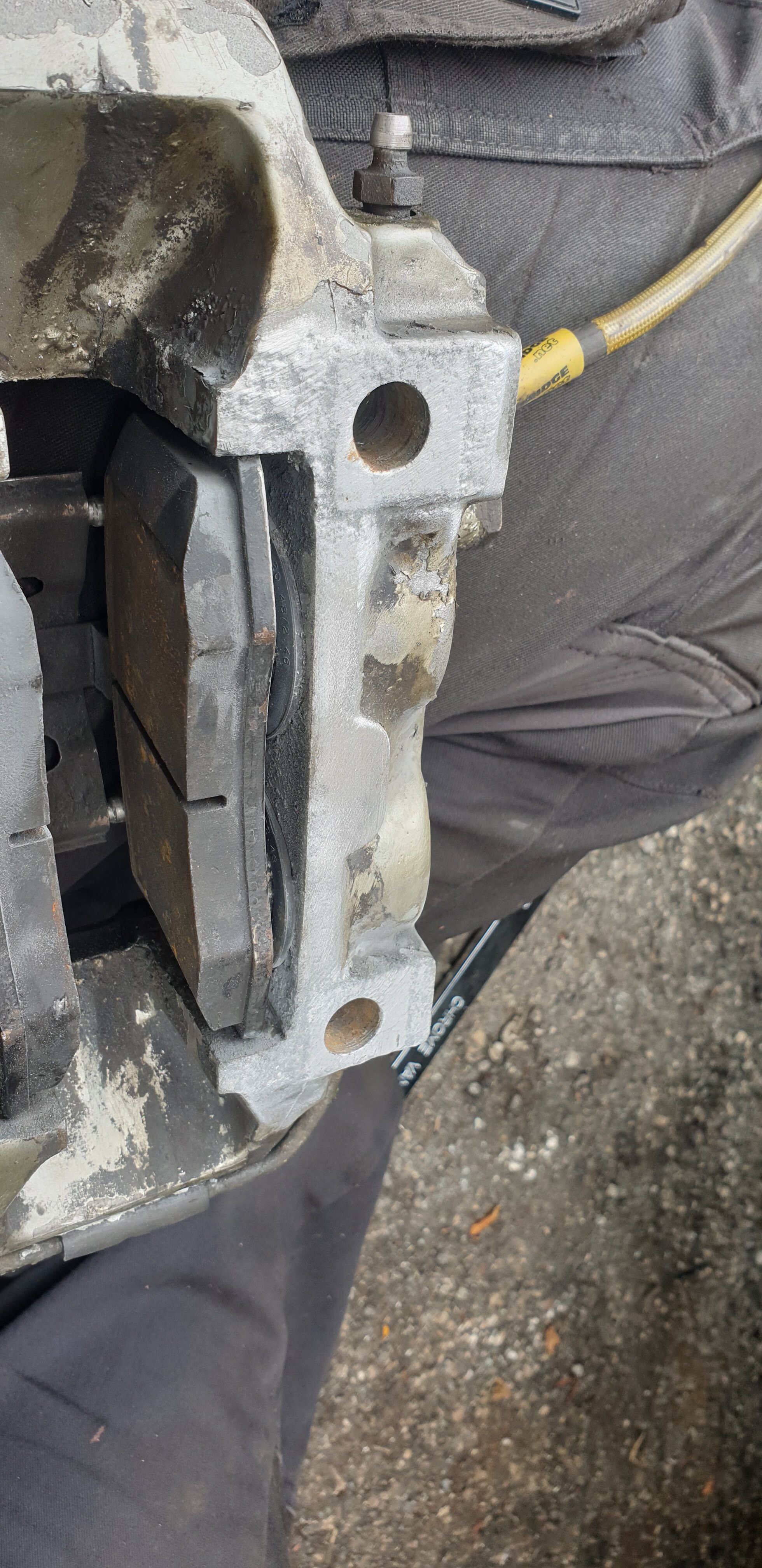

So I kept test fitting the Brembos but the pads were way too far forward on the disc which would mean a hug lip and wasted braking surface area.
Even after cleaning the mating surface there was still 3mm+- to take off in order to get the pads in the right spot
I stuck them in the handheld lathe to take a few mm off which got them spot on!
The list started to take shape at this point and I really did have quite a lot of things ticked off
The Lemark ABS sensors turned up around half 1 so I got them put in with some new bolts. Along with the roll centre rack ends and wheel studs
Sexy. A big thanks to @Clio_fool for making me these brackets about 3 years ago🤣 The fitment of them is perfect and all the hardware is overengineered to chuff much like the hubs from Mark

So @Louis came over at about half 10 to help me set up the PMS shifter I'd I stalled on Friday. They're an absolute fuckstick to set up on your bill so having 2 people is a must
Louis had set his own up not too long back so knows literally everything about them and what needs to be what. We ended up straight away removing and flipping the bolt around under the shifter tower because it fouled the exhaust tunnel. He then swapped the dog one bolt around as it was fouling that too🤣
about an hour or so messing about and we got it perfect! It felt so silky smooth and genuinely makes the car feel like something proper, not just a floppy pathetic gearstick dangling about
Louis then shoved a thick o-ring under the shifter sleeve to alieviate small rattles. And then he got the interior back together to make it one again, whilst I farted about doing something else, probably thumbing my arse

TTV lightened flywheel
Flywheel bolts, clutch cover bolts

New stud and nuts
Expansion tank
MTC coolant hoses

Drivers side driveshaft
Release bearing

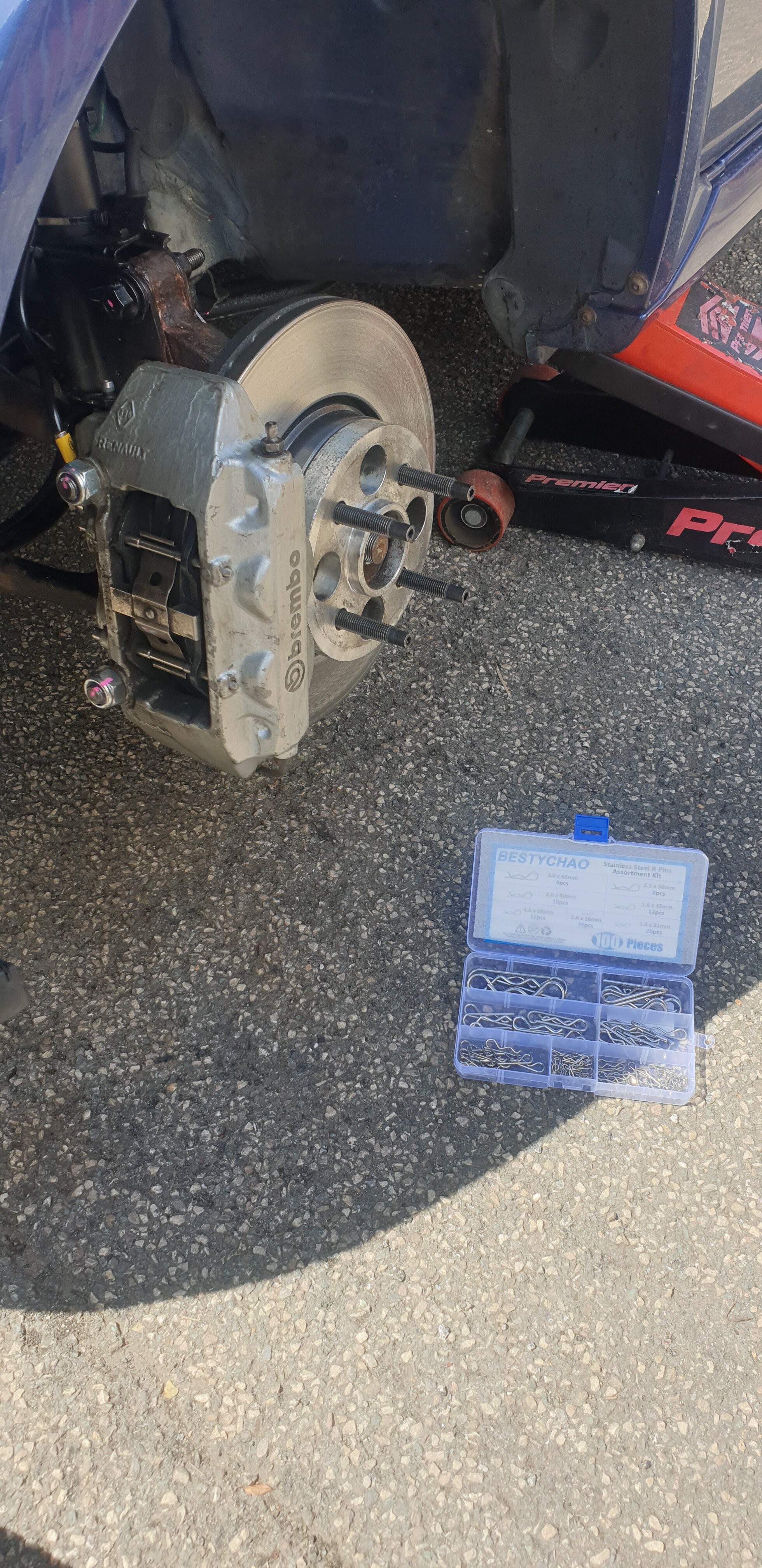

One thing I did forget yesterday
The R clips for the Mr Pink pins. 2 mins to jack the car up, take the wheel off and stick some in. I bought a cheap set from Amazon after losing 3 of these f**king things🤣 The pads would probably never come out but for piece of mind why would you not put them in!
These are the size of the clips I used
Quick pic of the inside with the shifter in. Not the best pic mind

TTV flywheel, you can noticeably tell it's there just from starting the car. The starter engages and it's fired before you can blink, the engine turns so incredibly well now there's not an additional 2kg rolling about. Couple that with the AC and PAS removed it slingshots it's way to 7.5krpm in the first 3 gears. I've noticed the clutch is silky smooth and so easy to depress now too

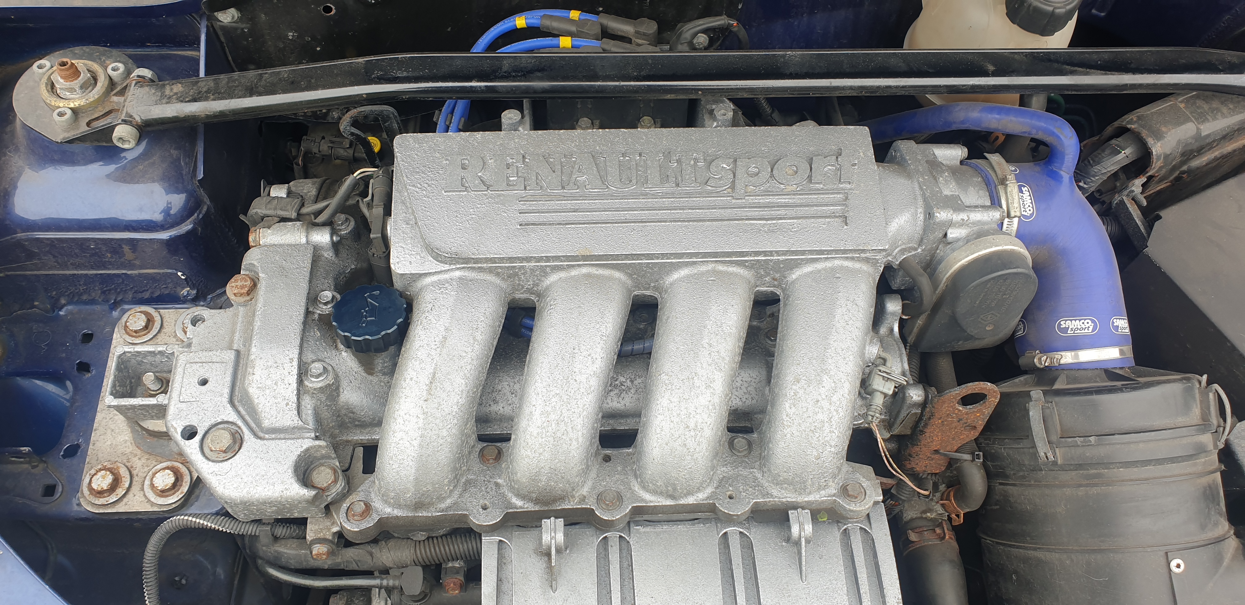

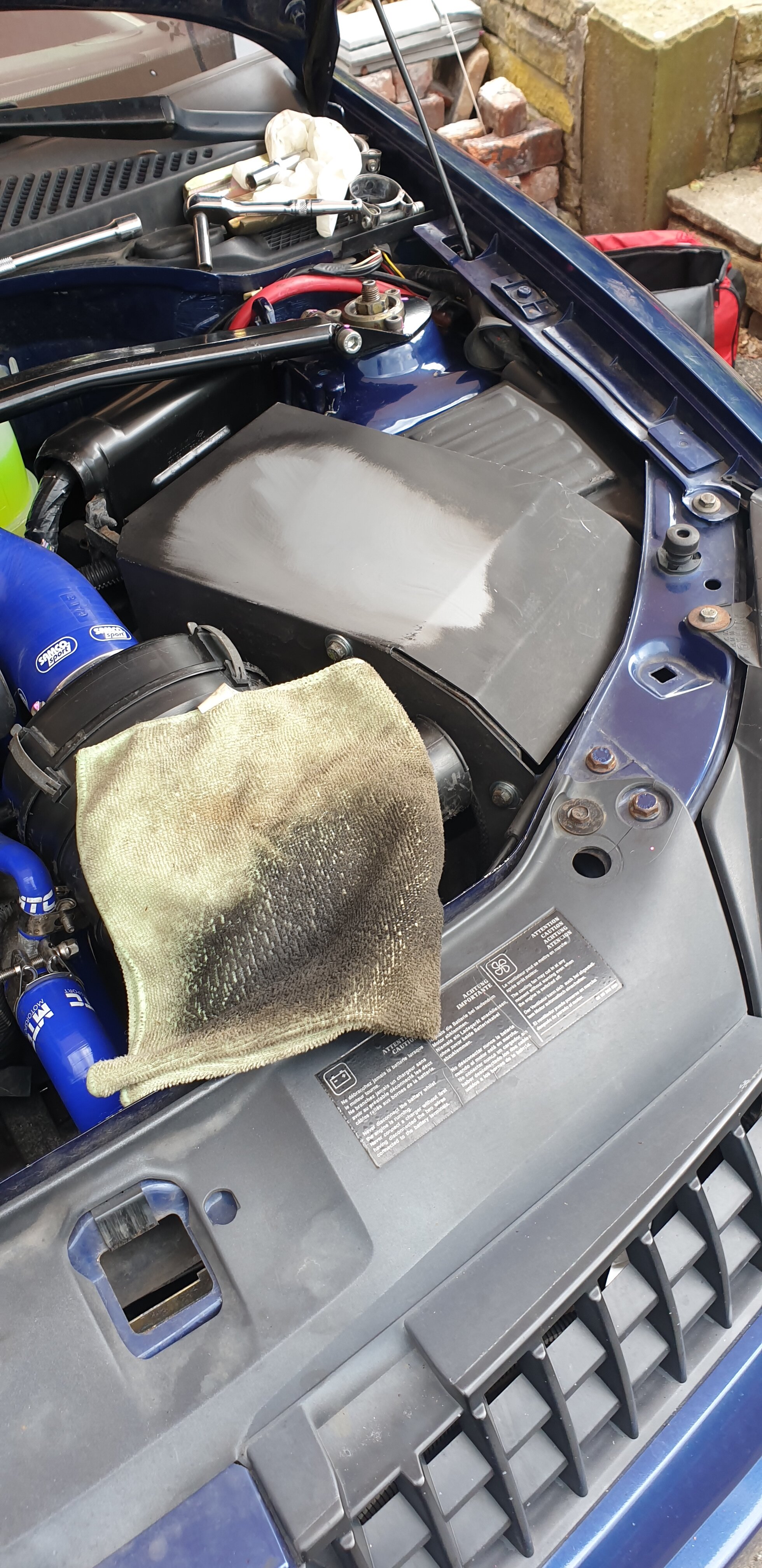

The bay is a tad cleaner now but still needs a good going over
