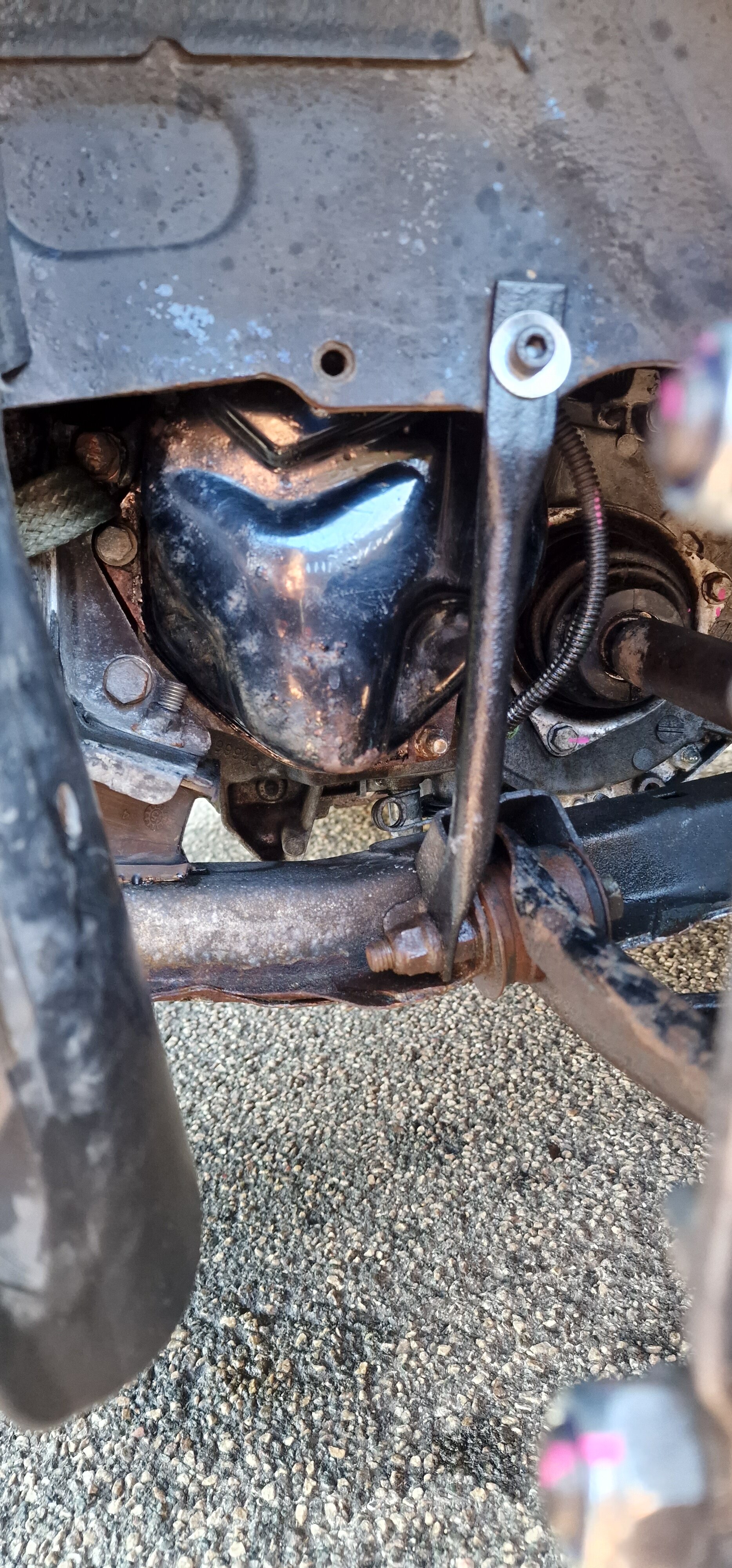

Gearbox weep has been eating away at me and I had to crumble and do something. It's really, really fucked me off
It's coming out of the end cap so I tightened down the 3x13mm which I managed to nip slightly. Gave everything a spray down and wipe and it didn't weep for the 15 mins I was sat there

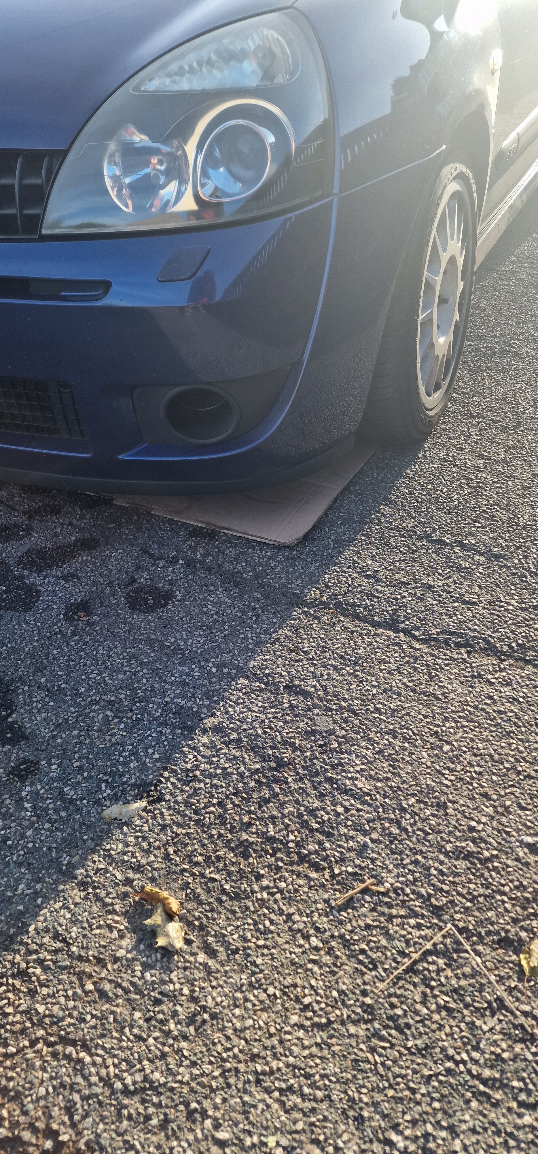

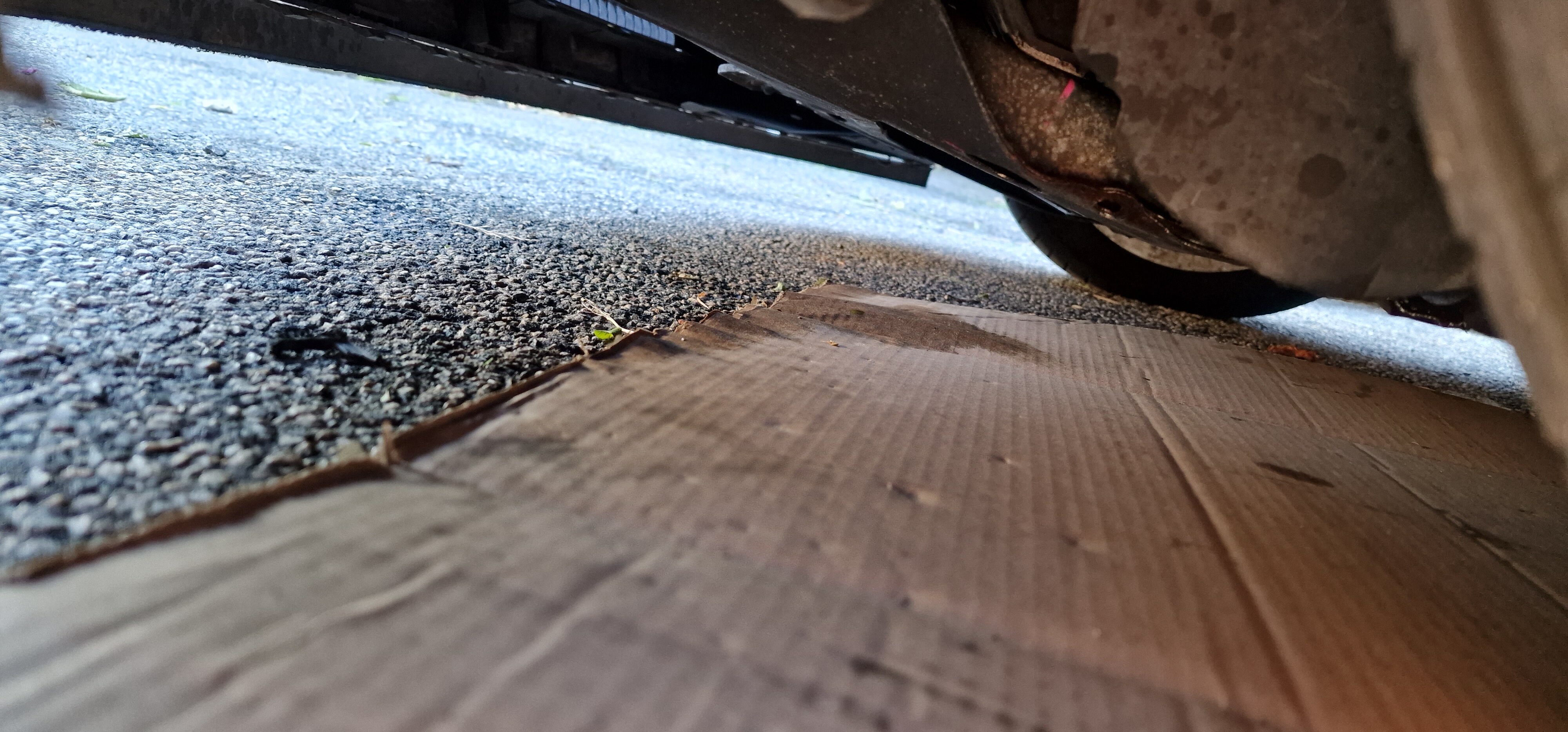

Chucked the cardboard of shame under there

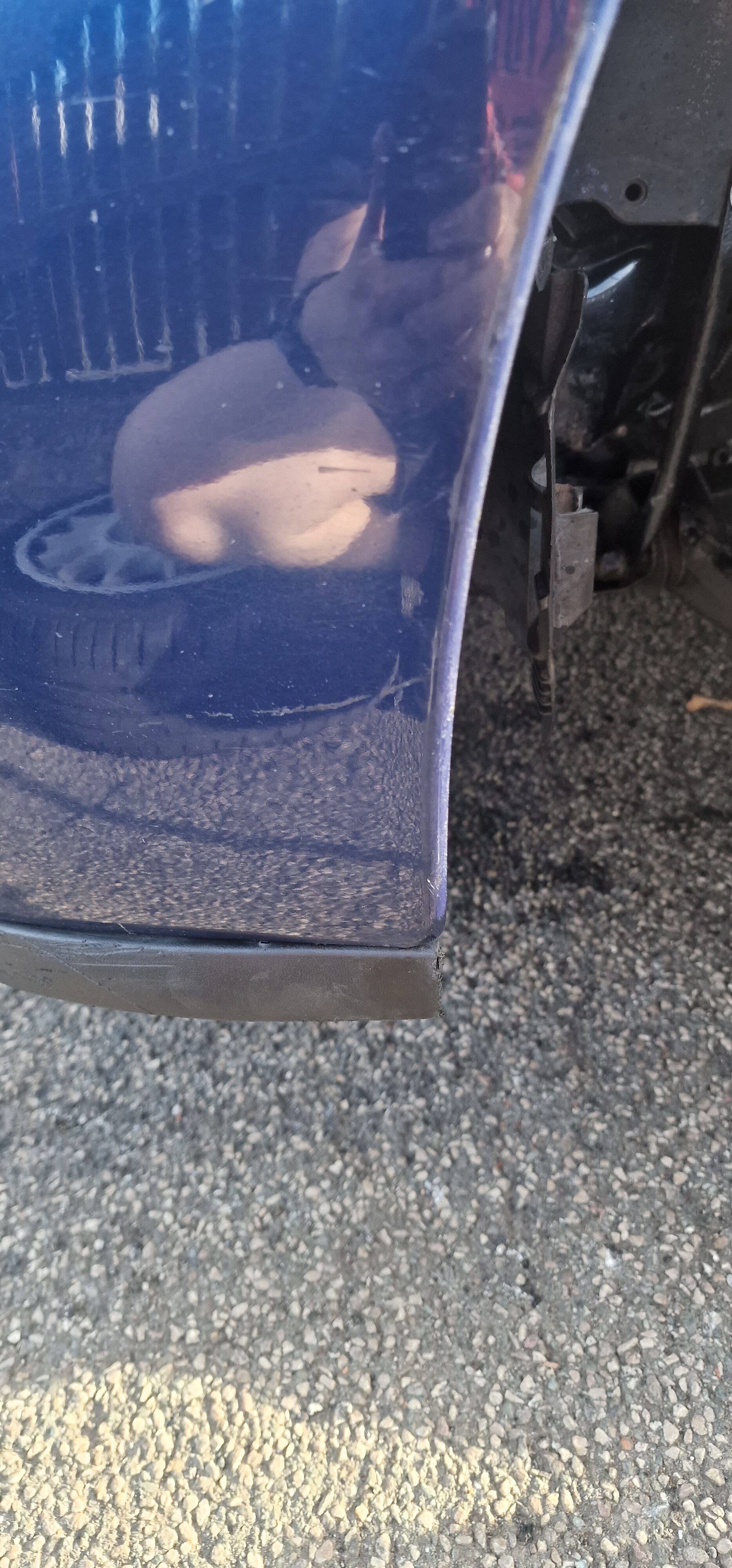

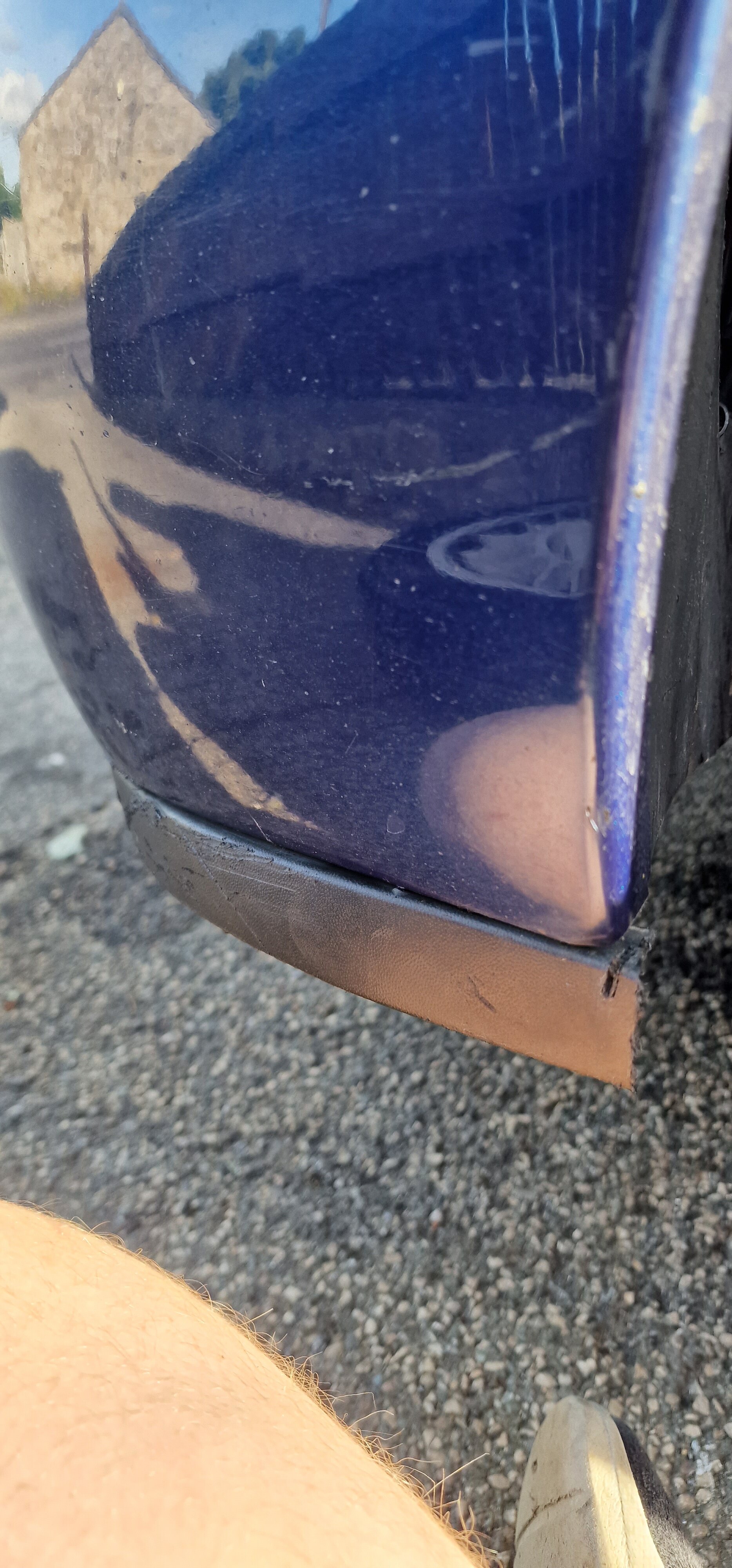

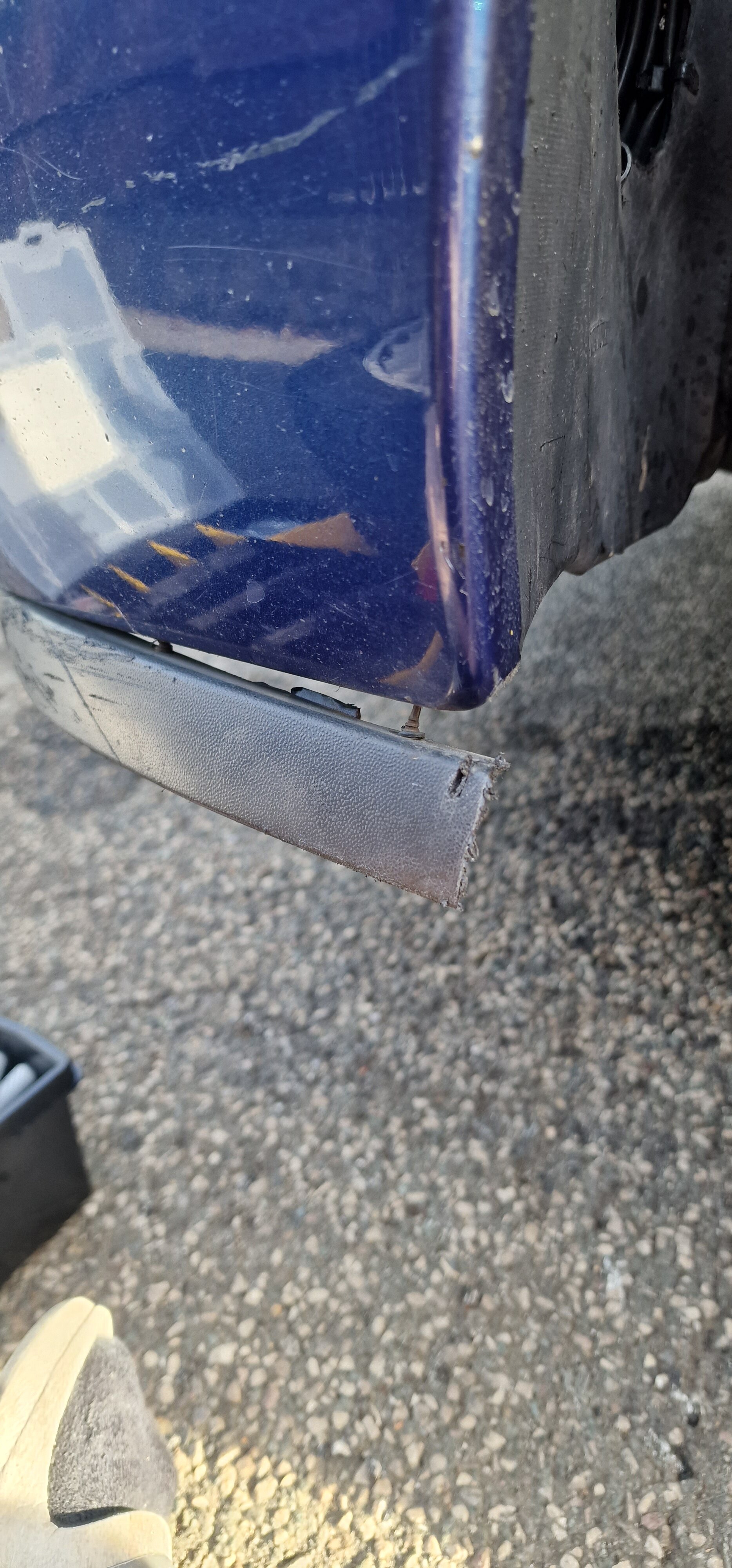

Sorted another annoyance whilst waiting for the box to weep. The corner of my Fabia splitter has been coming away for the past 2 years, stuck some more self tappers in there
Then chopped it slightly because that was then doing my head in🤣

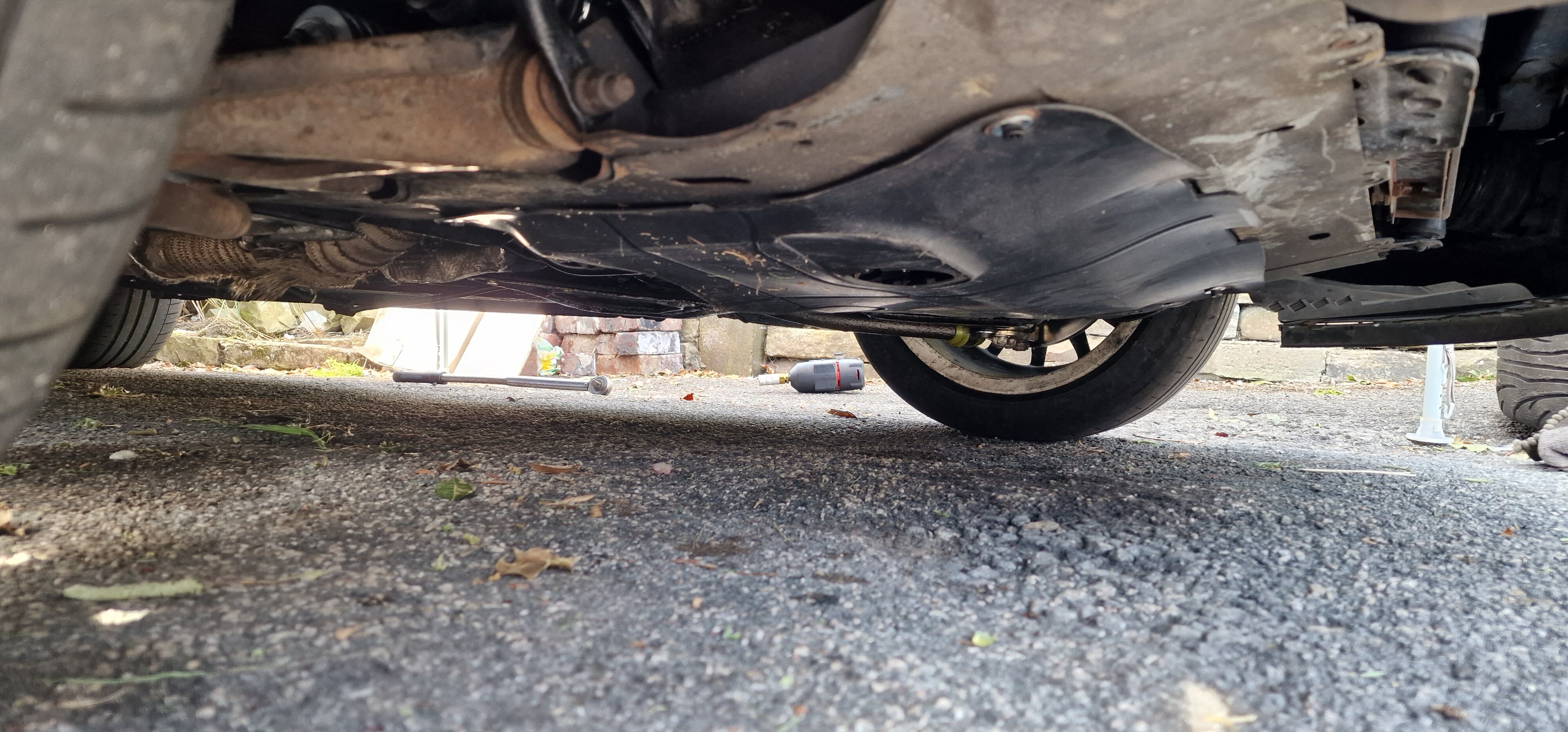

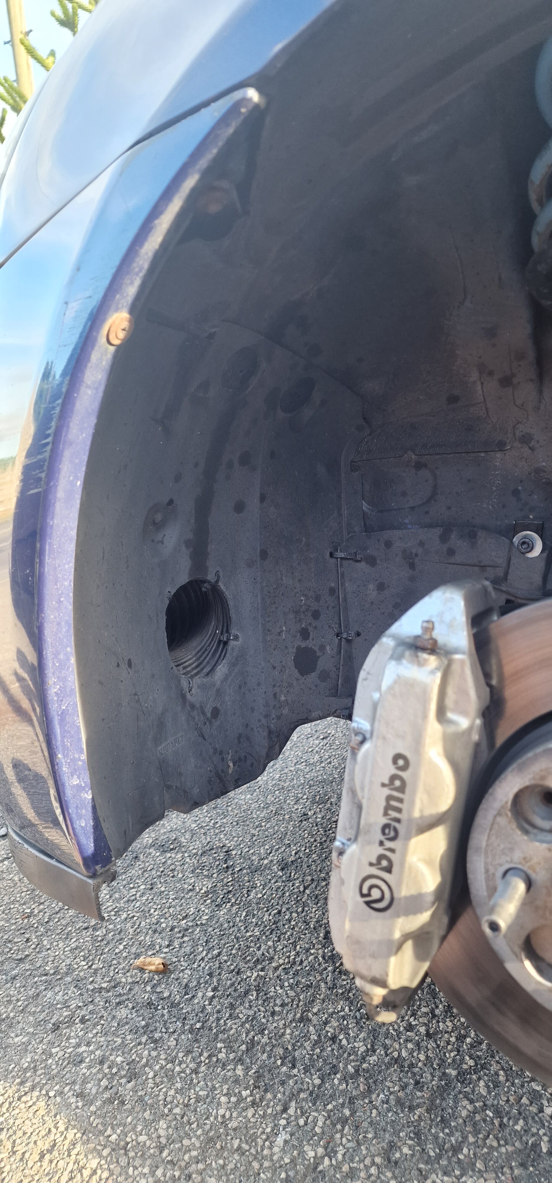

Tiny bit of oil around the arch liner too

That leaks a pisser on the gearbox end cap, they sometimes go pourous with rust, still available new from ren iirc.
That sawcut in splitter was making my ocd go wild :LOL: looks so much better cut to length
Aye I've got a brand new end cap, I just didn't put it on because I forgot like a mong🤣🤣
This is promising though, card was under there for a good 14 hours and not a single drop. Must have just needed the end cap nipping because that was bone dry too. Still gonna see what happens when it gets warm

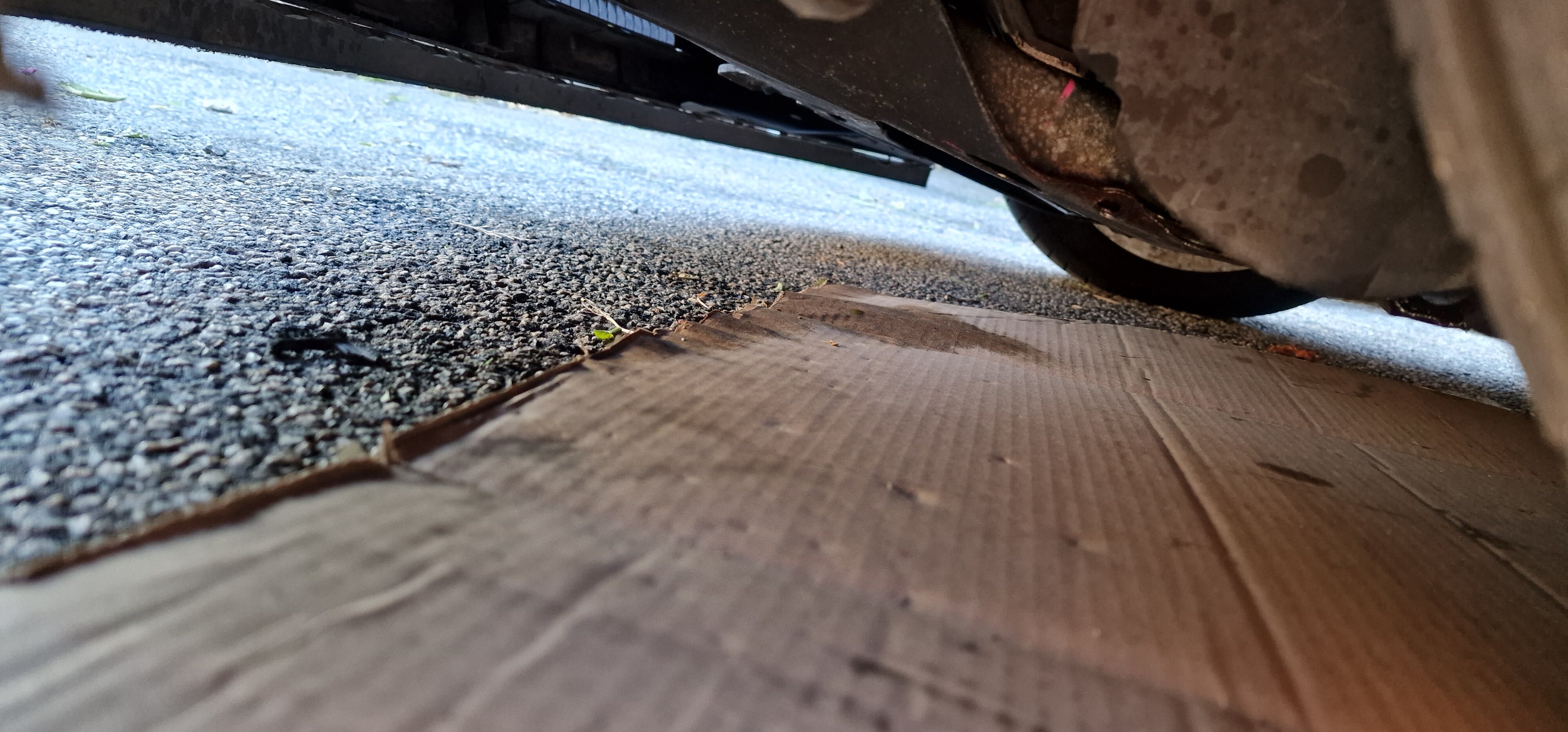

Still leaking, selector seal is weeping ffs
Gonna f**king send it and just top the box oil up at dinnertime on Saturday. f**king pissed off is an understatement considering the c**t has got to come back out for a f**king £10 seal. Will have to put a nappy on it this week in the form of an undertray
That’s very annoying considering the seal and bushes were replaced! That’s the joys of leaving something sat around for years. I bet the seals gone hard.
Mines the same Kyle. I need to get the s**t out and to Mark. Just putting it off as I know I’ll want a dig at the same time

it’s hard to say really mate. Enough to have a constantly wet selector and a very small mark on the floor. I recon I lost a litre in 18months

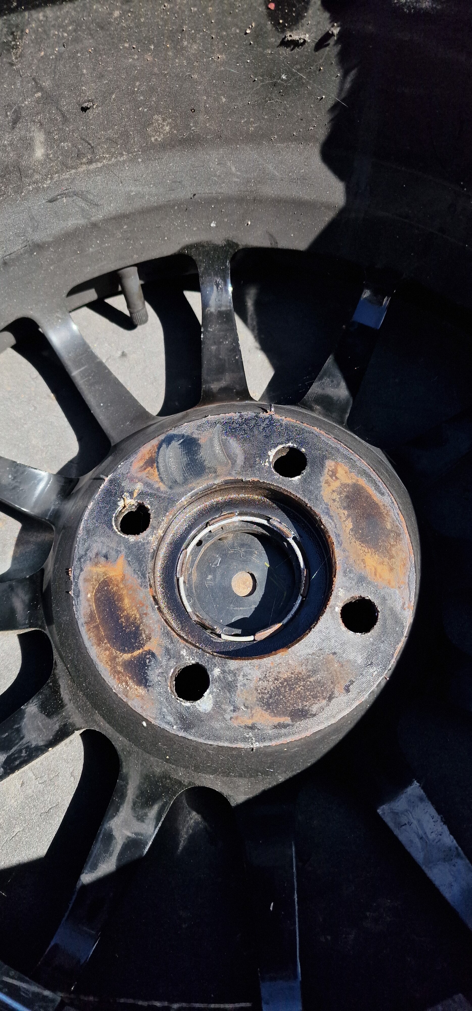

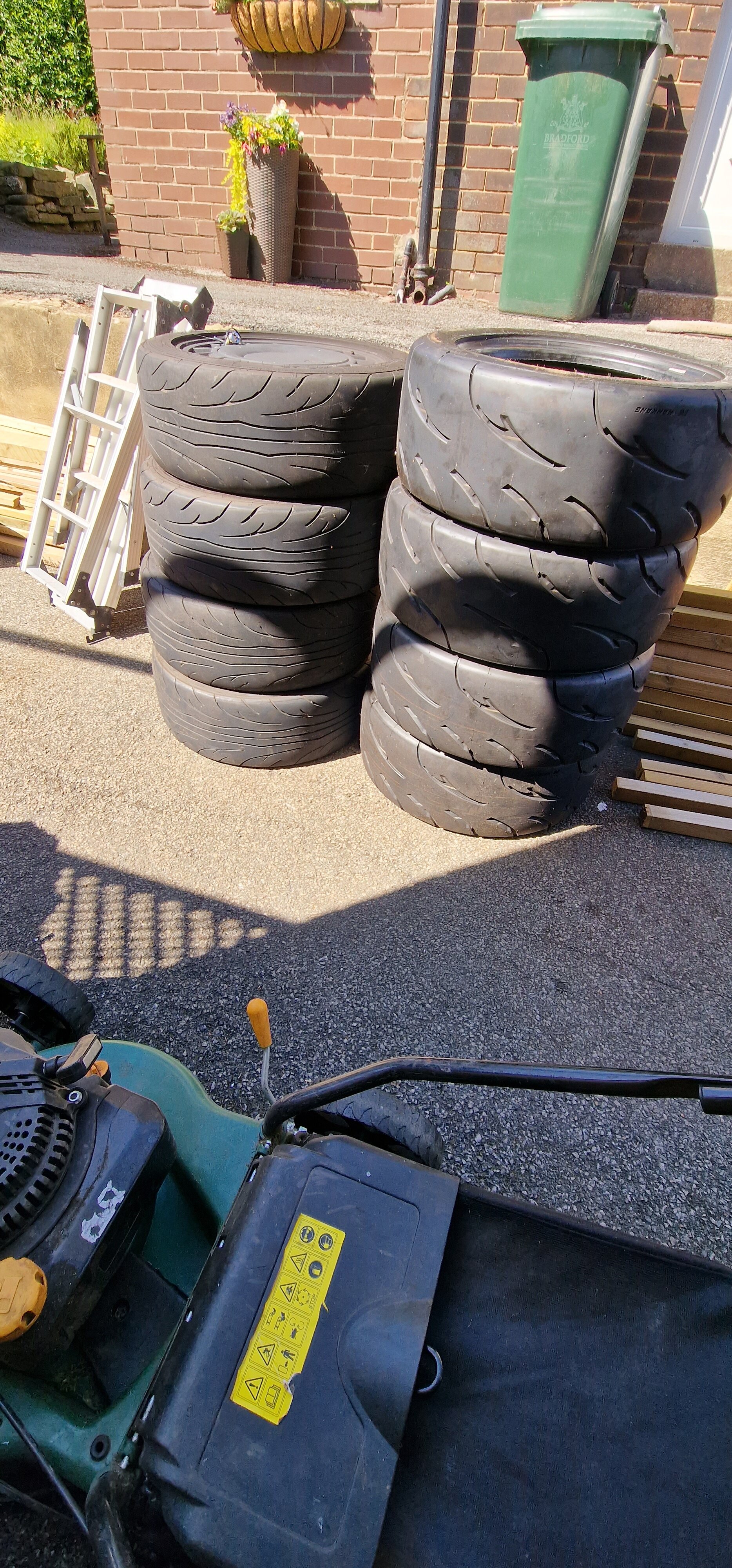

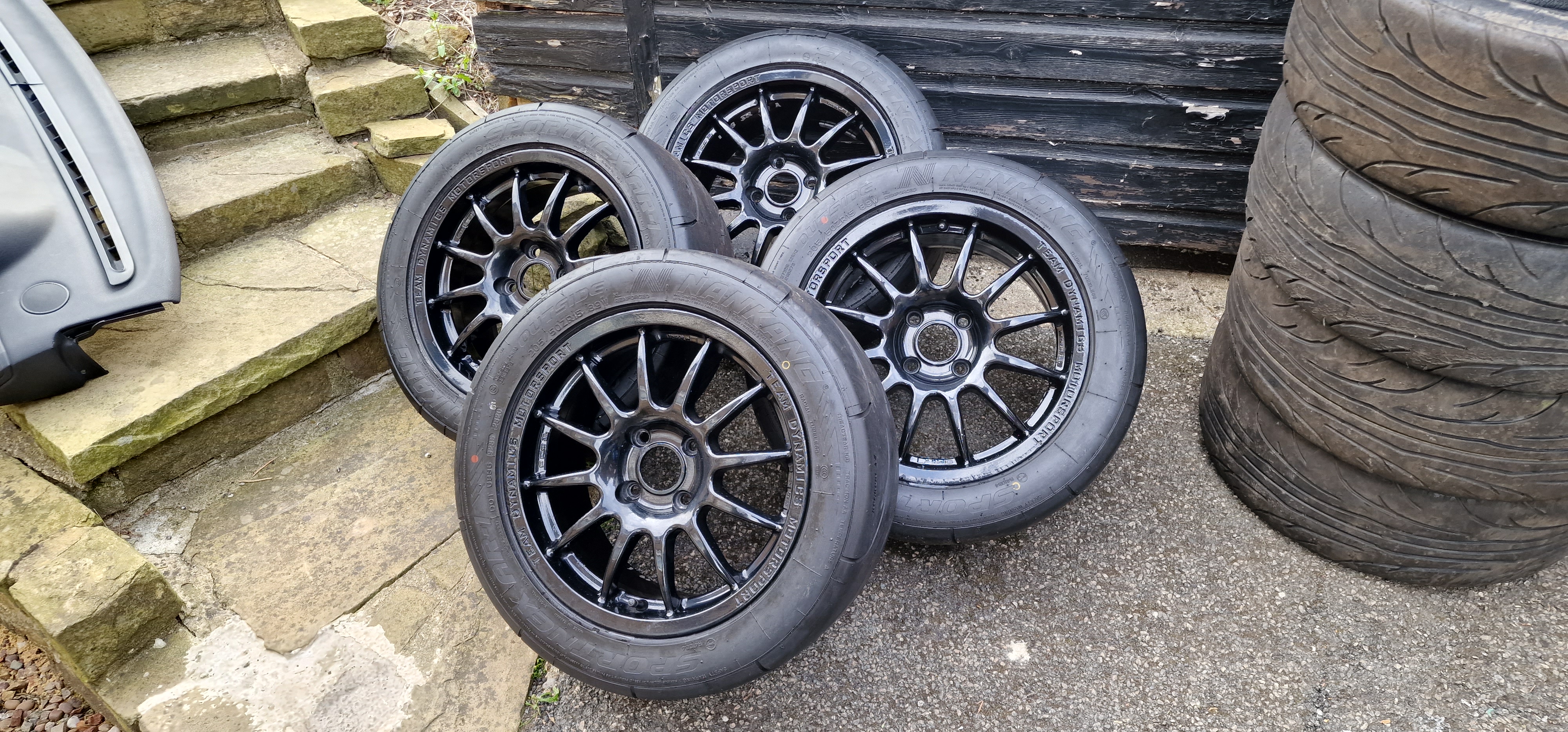

I got my track wheels out, last time I used them was CSF19... 3 years ago!!😳 Had to clean the mating faces of the wheels, I was a 22 year old thick as mince tit back then. Powdercoat needed the Milwaukee die grinder and a wire wheel sorted them
Before

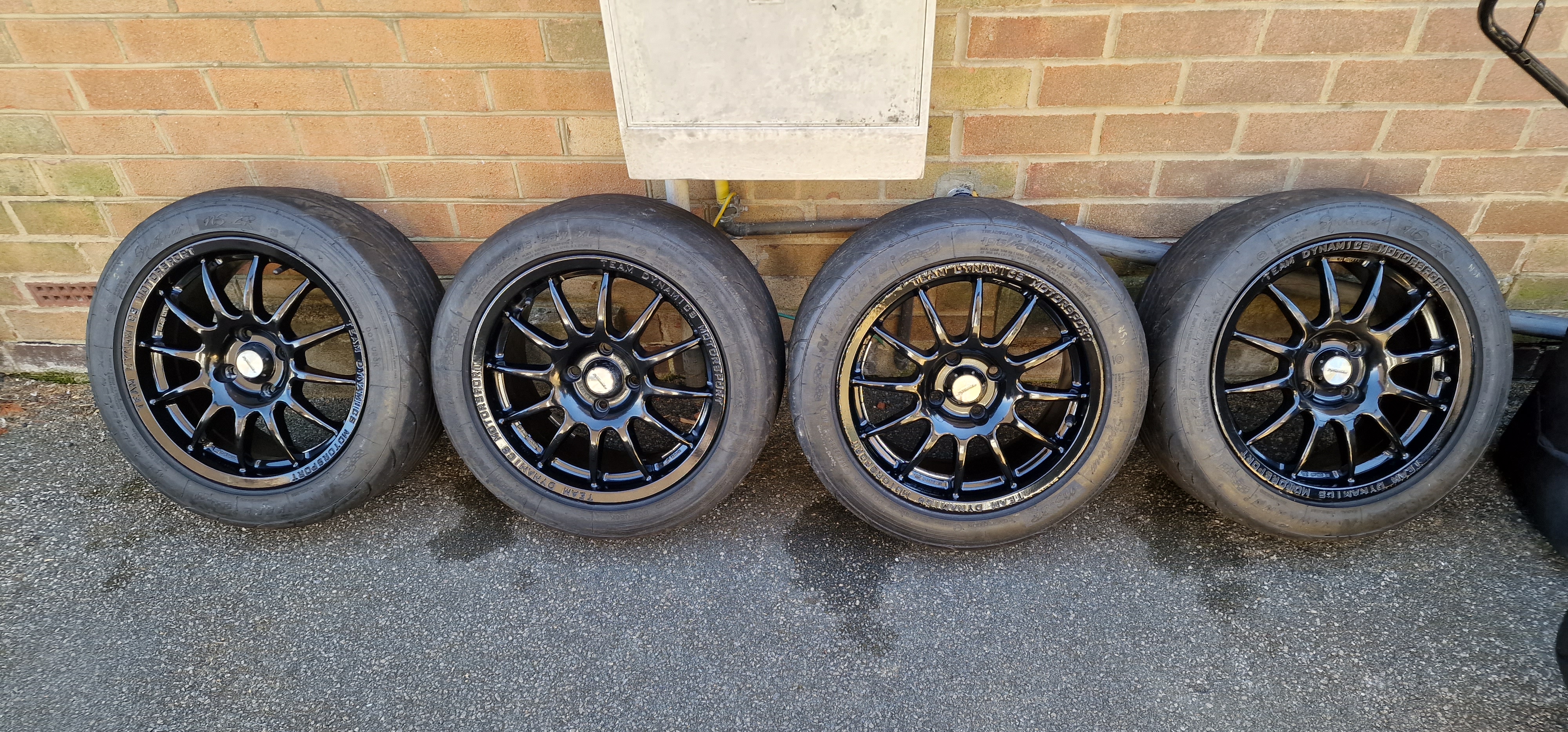

After
Gave them a good clean because I've not washed them since then too🤣
Rest of my wheels were put away bar the TD's and the AR1s. Gonna get the AR1 fitted this week and test fitment

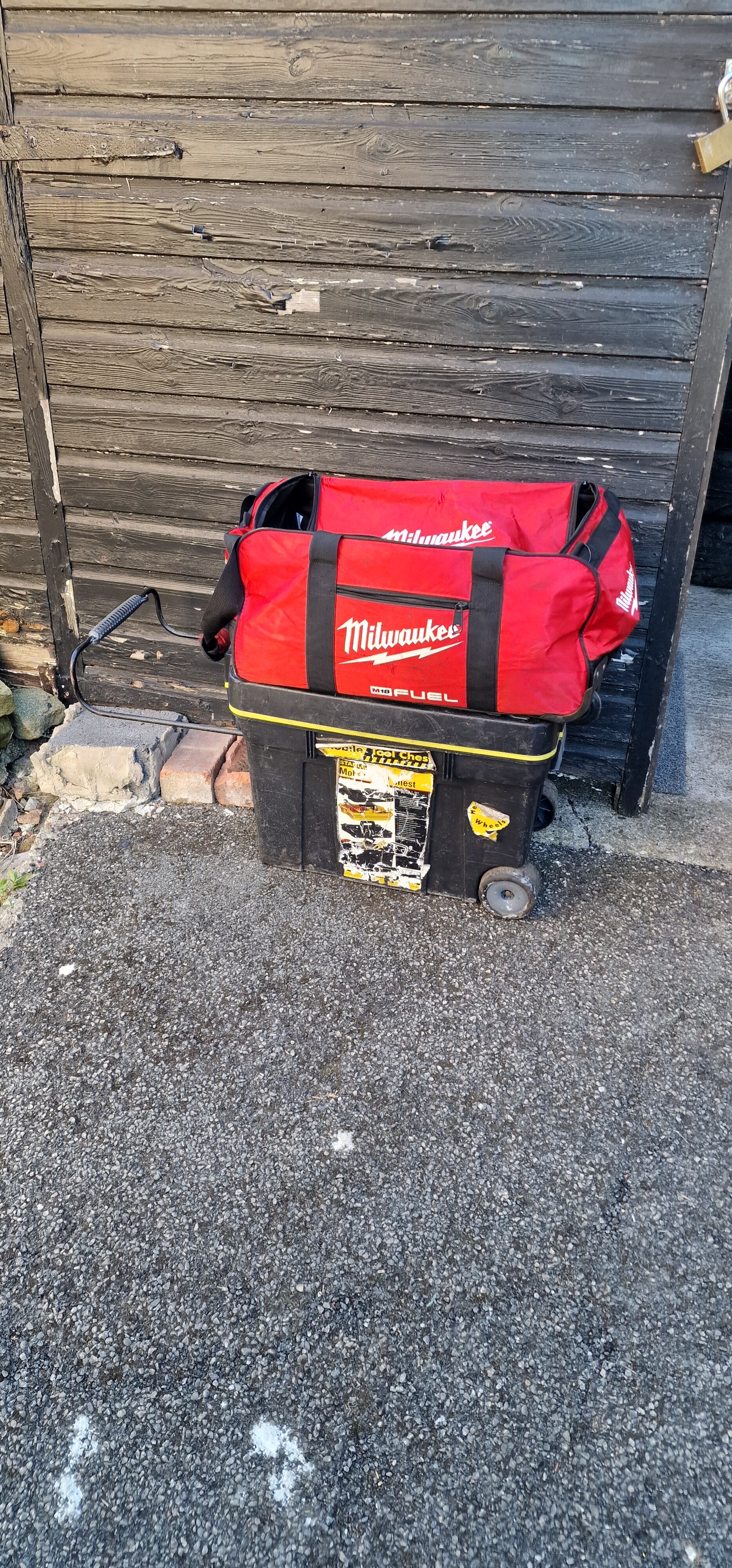

Started getting my spares and tools ready for CSF too. Opening my tool chest made me realise how far I've come with tools over the past 3 years too. There were some proper w**k tools in my Stanley box🤣

Even though the selector seal is quite drippy it wont lose much. My old Kangoo was the same, when i topped it up occasionally it took hardly nothing, just monitor it and if it ends up being a gusher time to fix

Itll be fine mate, if your worried check it before setting off. Defo wont need to top up at Blyton if it stays the same.

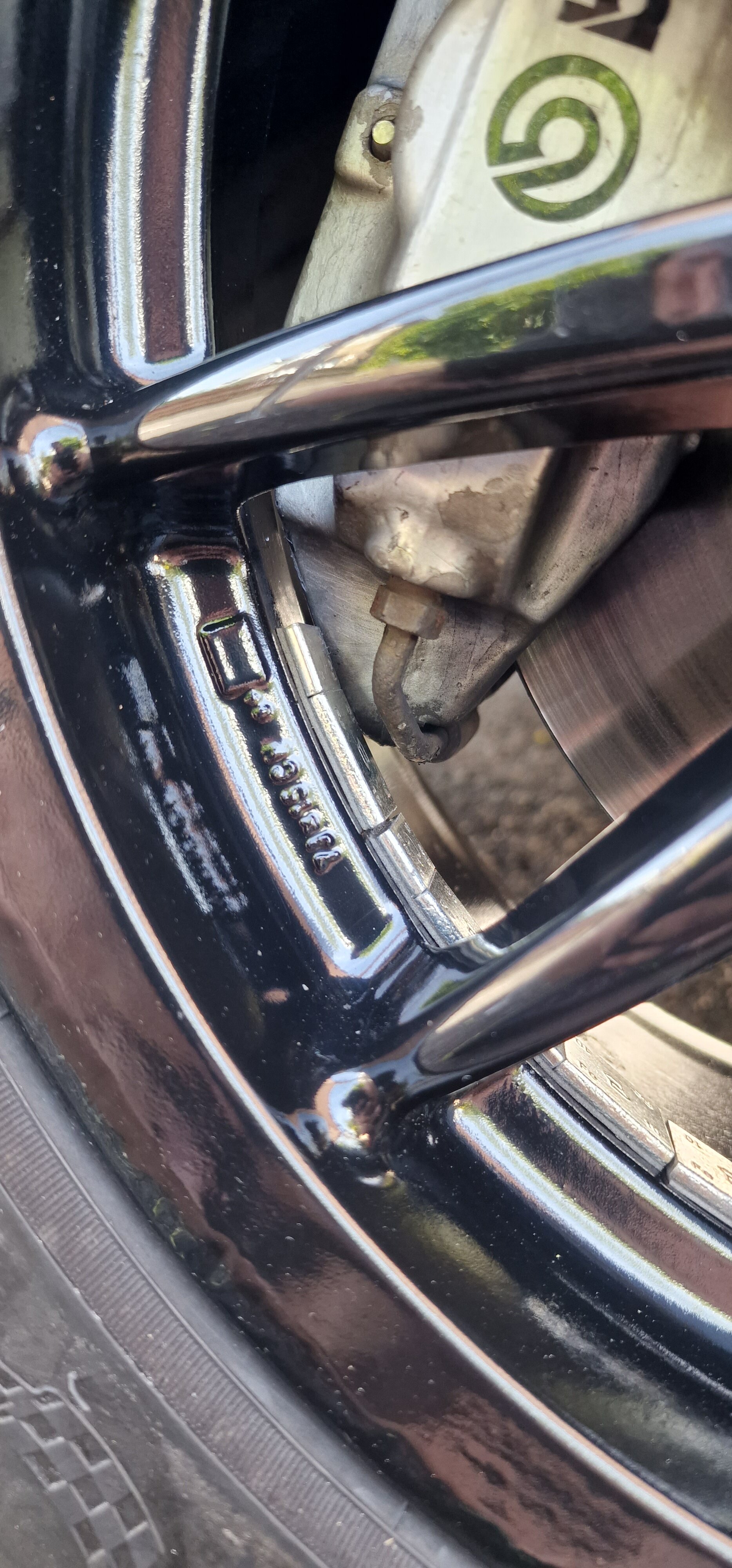

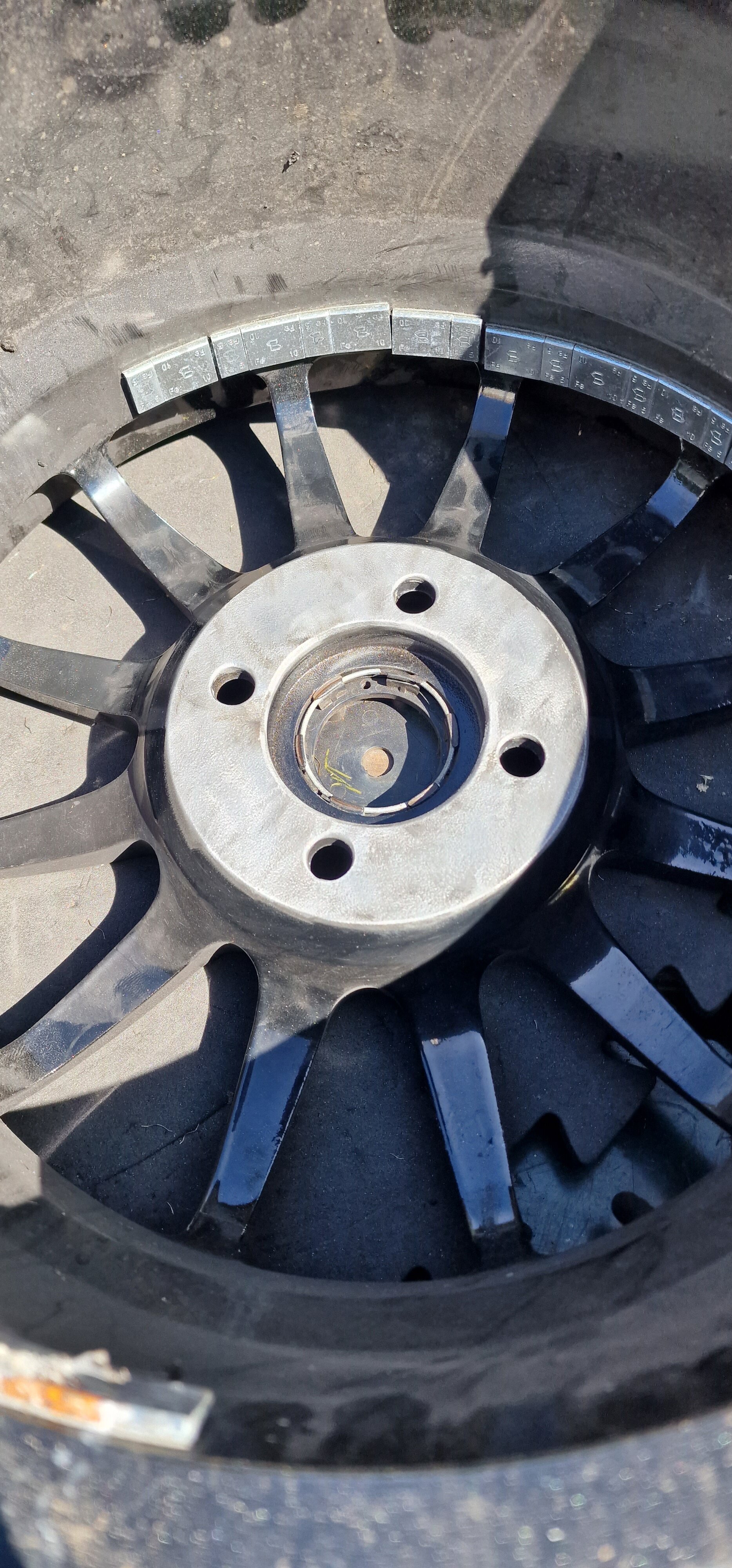

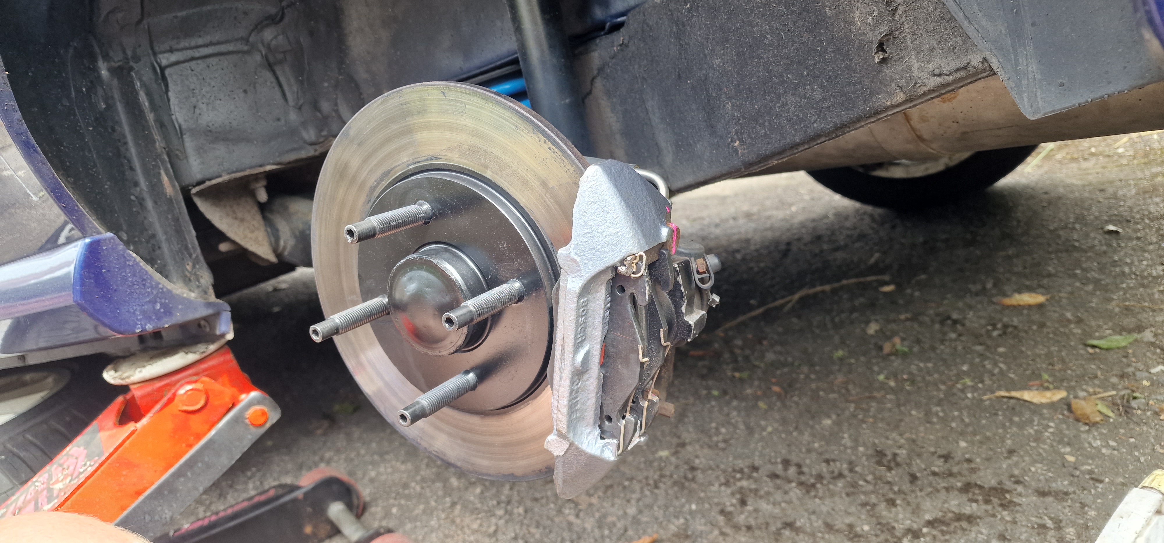

Test fit the Team Dynamics
Very very tight. Don't fit with the wheel weights 😬🤣
Thankfully when I got the AR1 fitted none of the wheels needed weights on the outside of the barrel. What an absolute winner, no need to shave the calipers yet then. Wheels look so good and meaty. I've no idea what tyre dressing @Stefan. used but it turned my hands black bright🤣

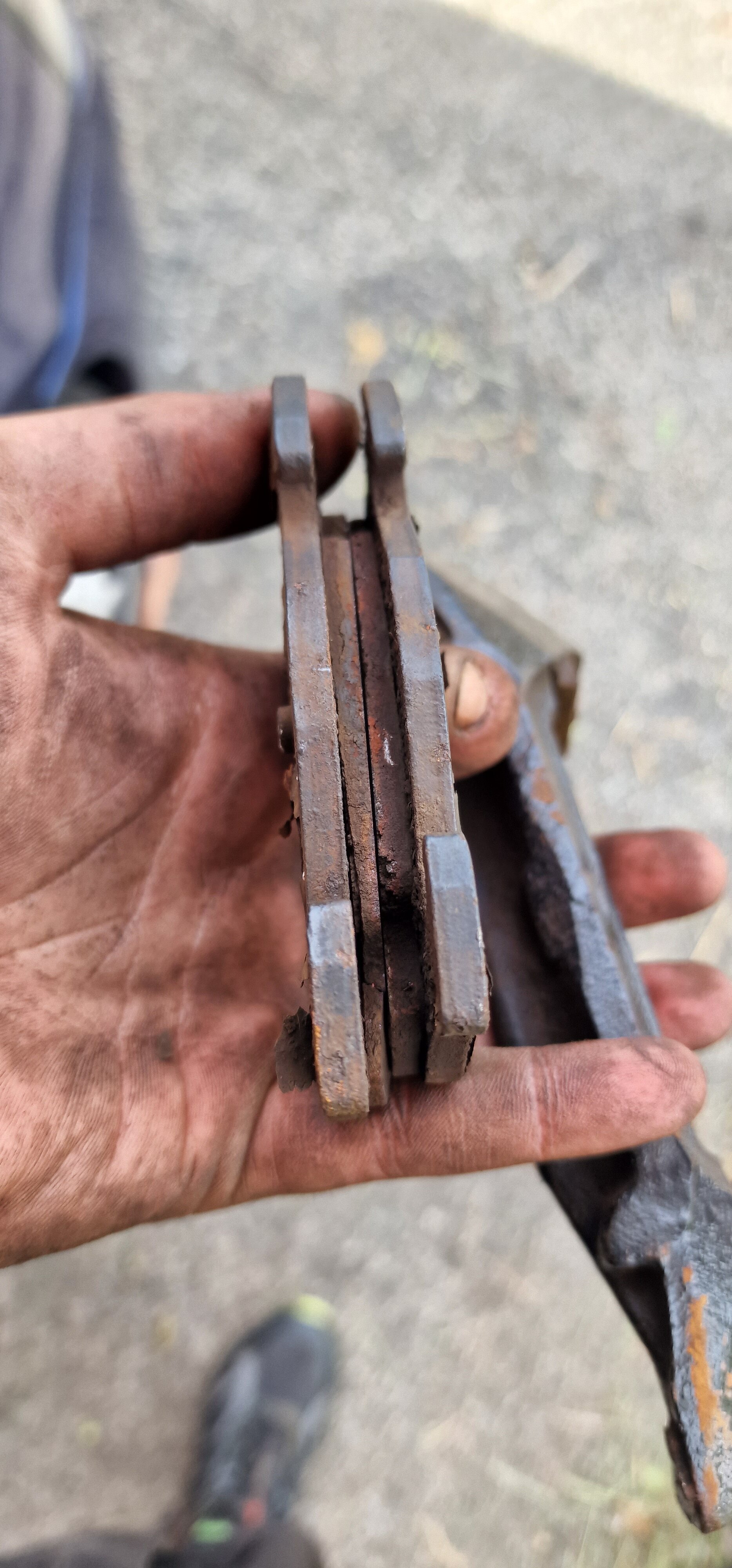

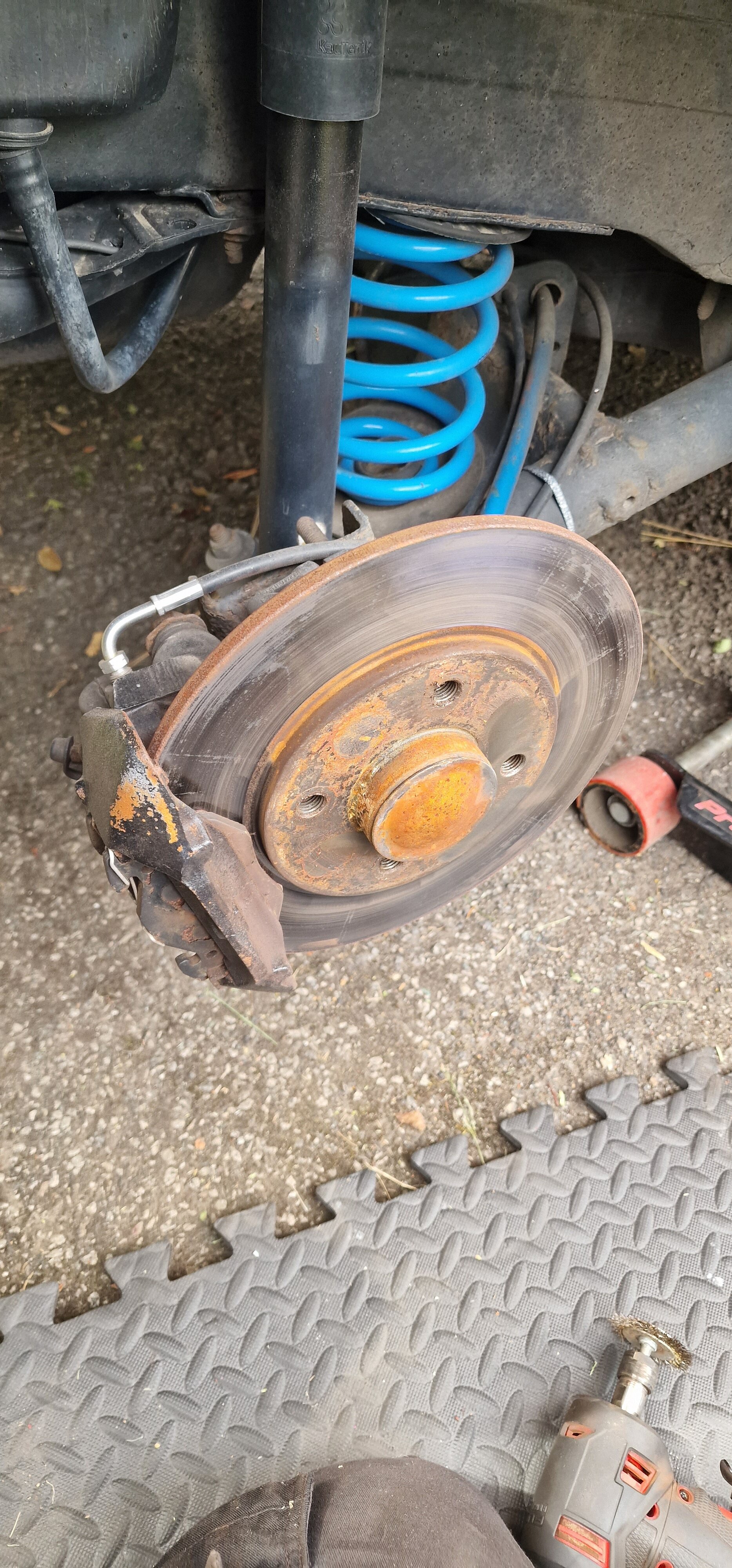

Next on the list, replace the old PBS pads on the rear. Gave it a good clean up whilst in there
Before (this was the other side but the NS was much the same)
After. The Milwaukee die grinder has really early it's keep!
The old pads were shagged and had started to delaminate like the fronts had

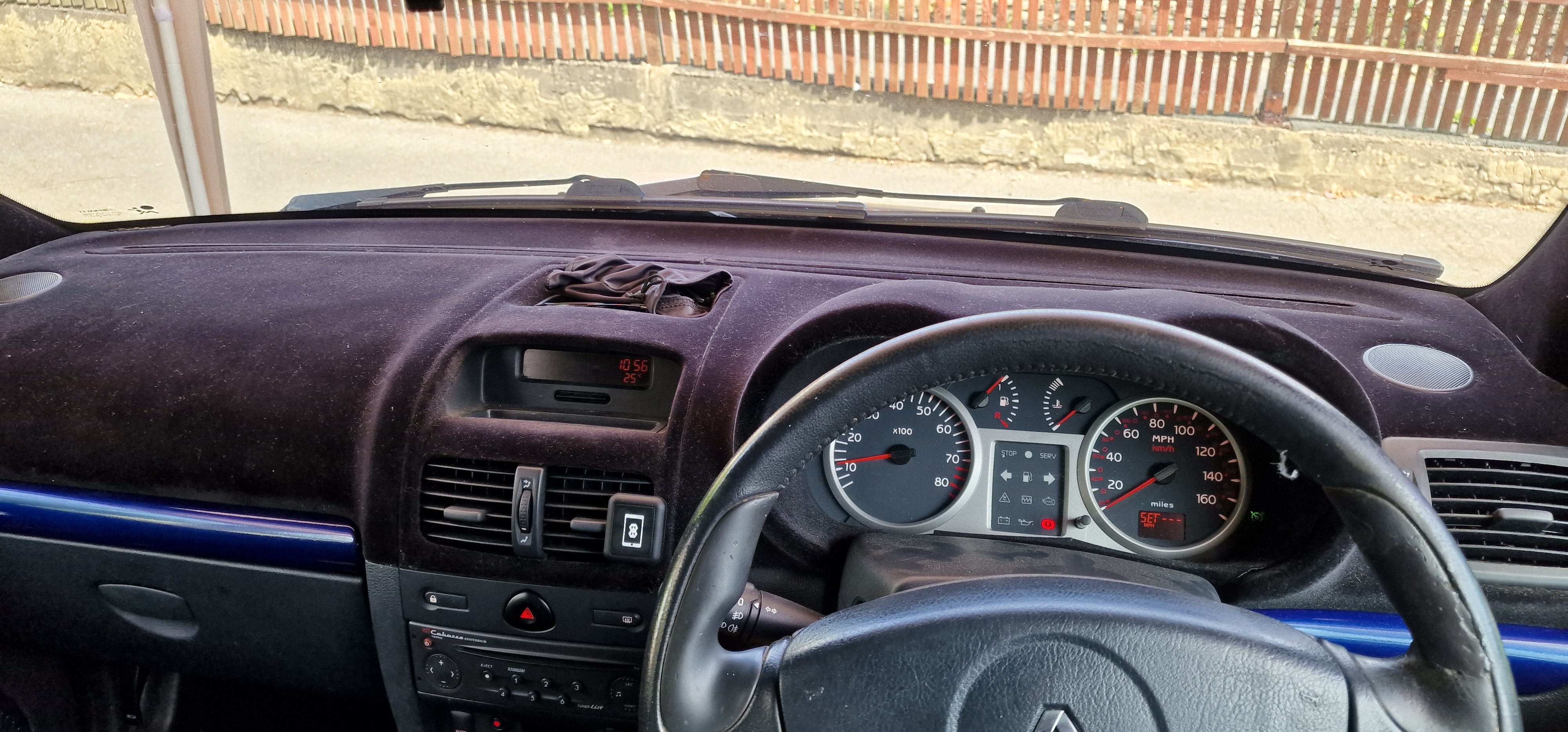

Flocked upper dash in

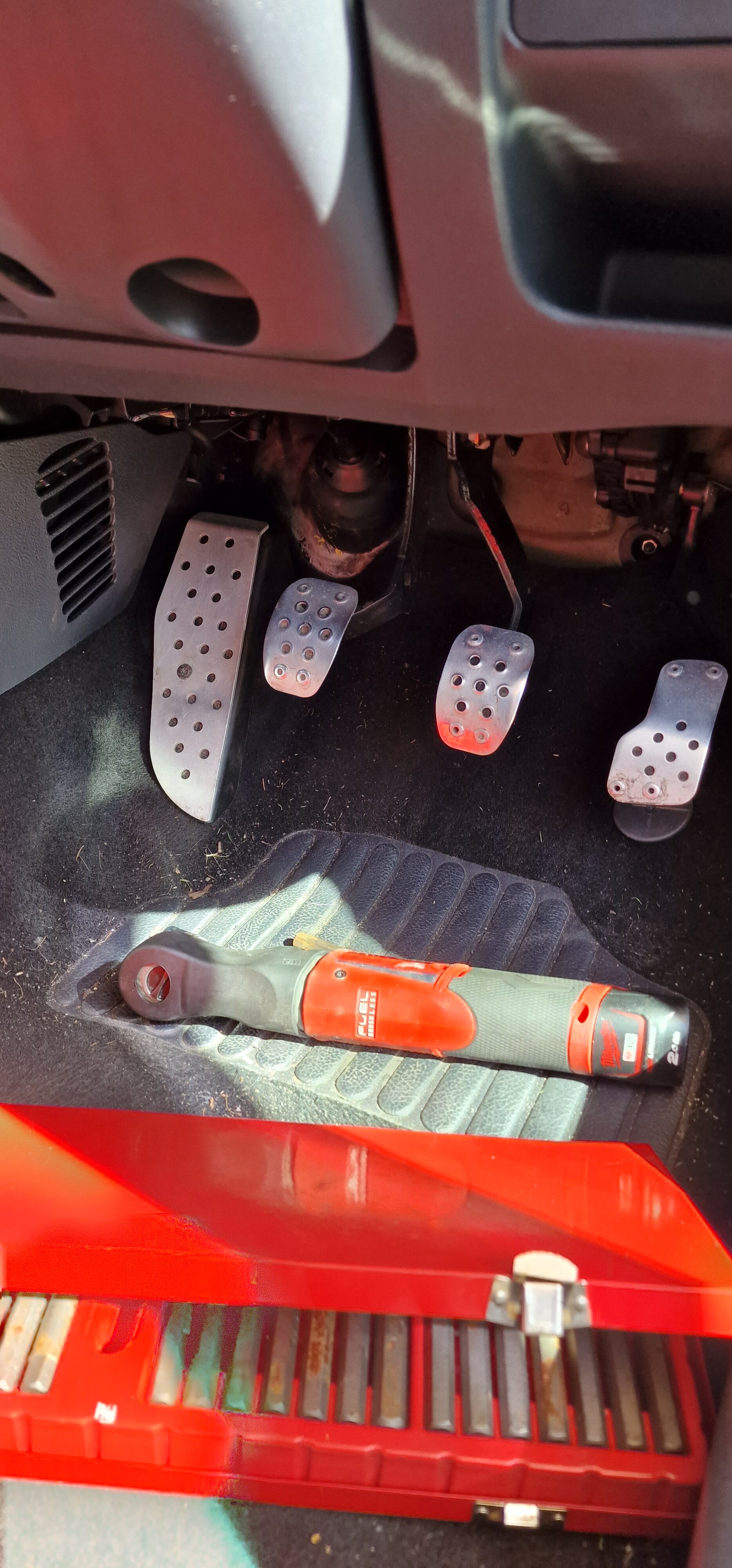

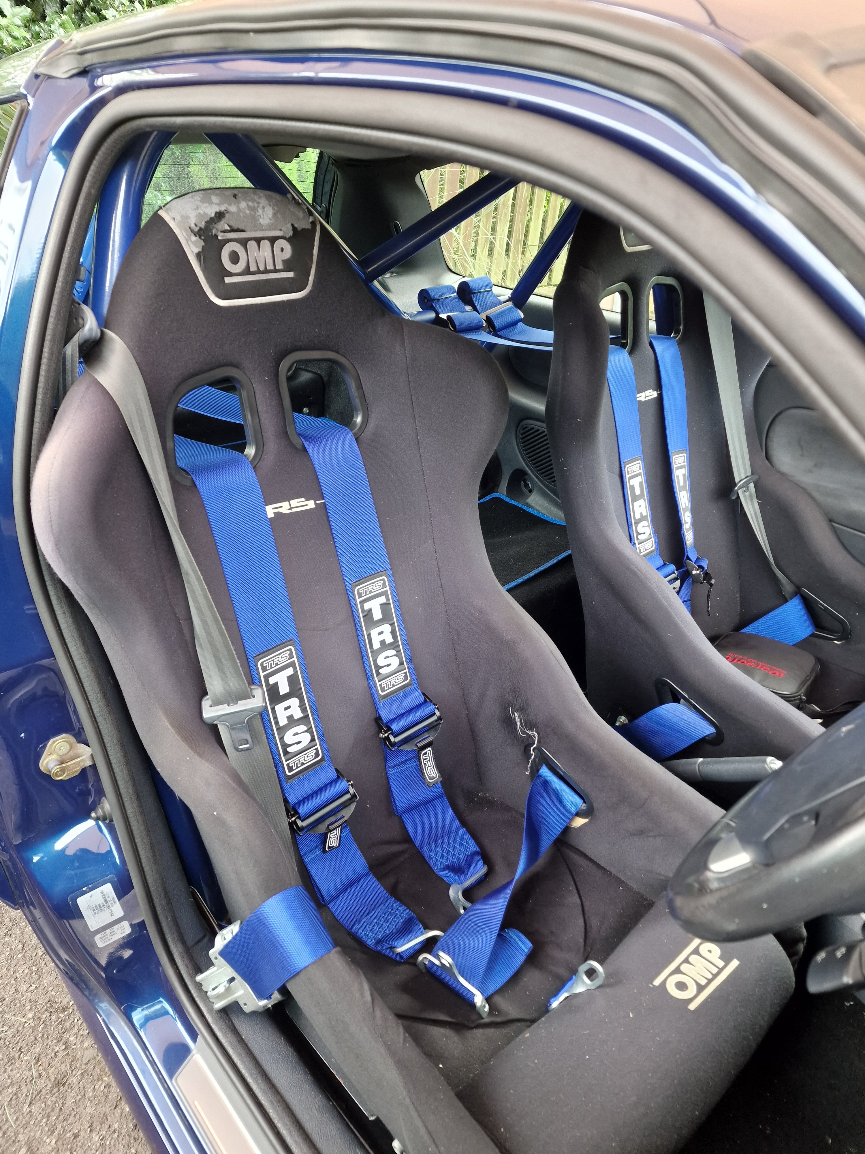

Fitted the footrest @colesy sent me. Like a r****d I removed the plastic part and just fitted the alloy bit thinking it was a replacement. After it annoying me for 2 years I'm finally happy it's not spinning and getting in the way of the clutch pedal🤣

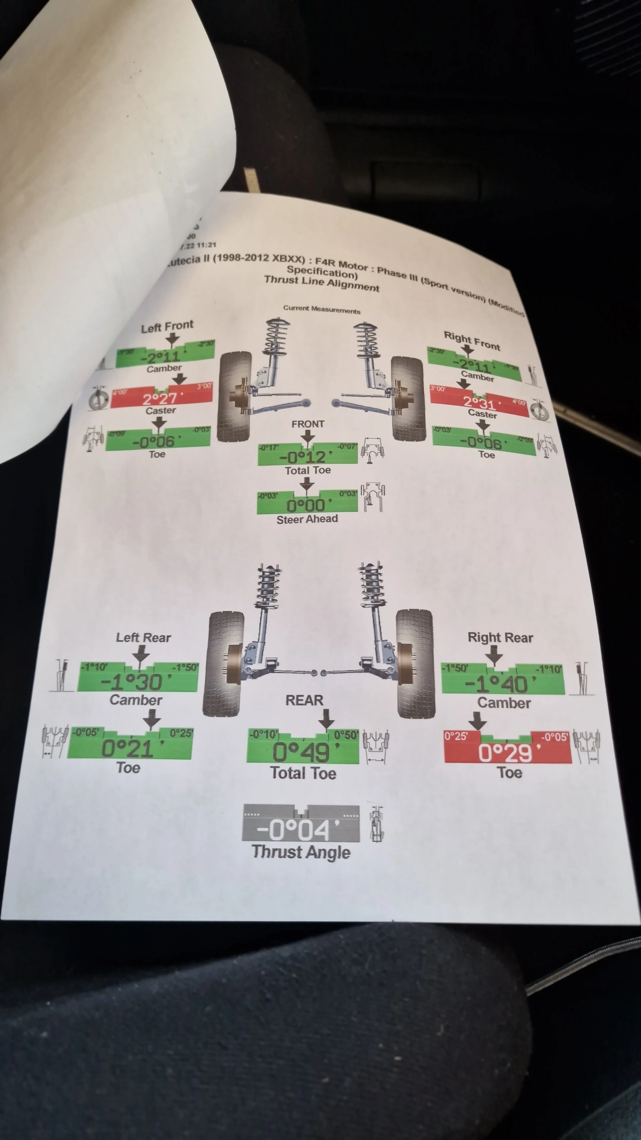

Then had the alignment done at Atec-Align. It was that far off it didn't read on the gauges so Chong eyeballed it first and then set it afterwards. For an 18 year old car everything is spot on. Probably need to shim the rear beam to sort the toe. -2.11⁰ camber and -0.06⁰ toe out

Nice tight fit there with the brembo and TD, same as mine. I had a 20 micron gap when test fitted mine but that was bolts only hand tight. Will gain a little once torqued up. I did however shave mine down with a lapping wheel on a grinder just to give that little extra space.
YorkshireKyle
Not all gingers stink of piss. But I do.
Aye if I want to run weights on the outside of the barrel I'll have to shave them with the grinder. Couldn't believe how tight they are even with a 20mm spacer!
VenomUK
  Clio 172
I had the weights placed on the inner part of the barrel but still shaved them down just for peace of mind. I'm only running 3mm spacers.

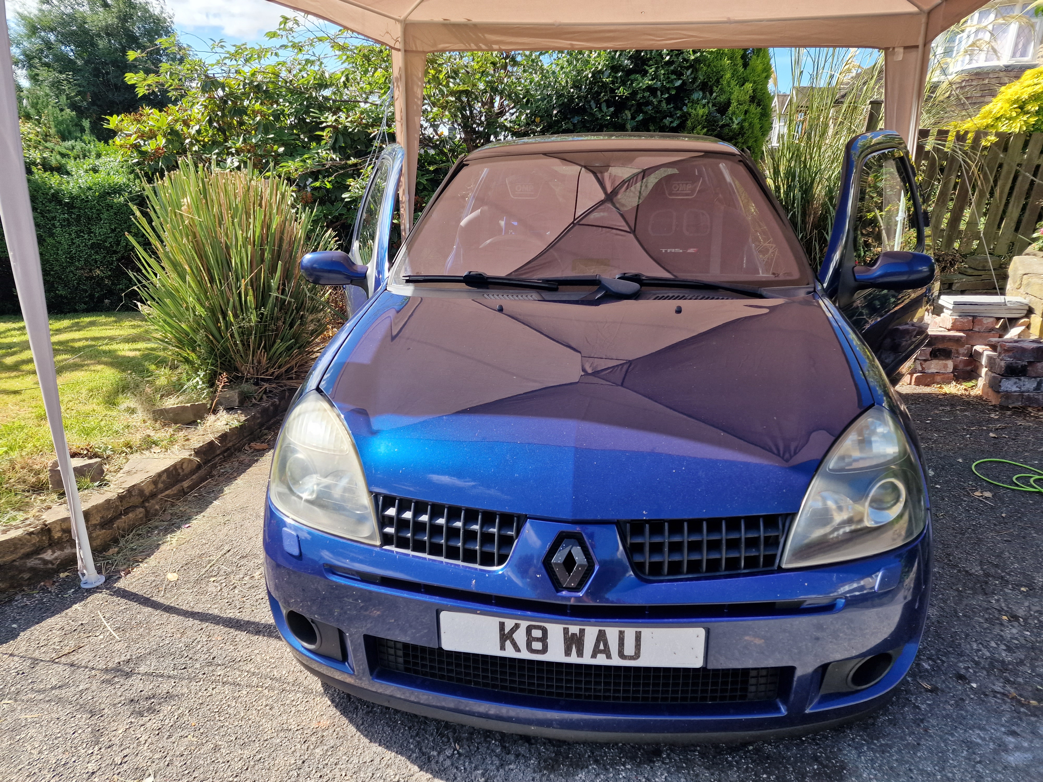

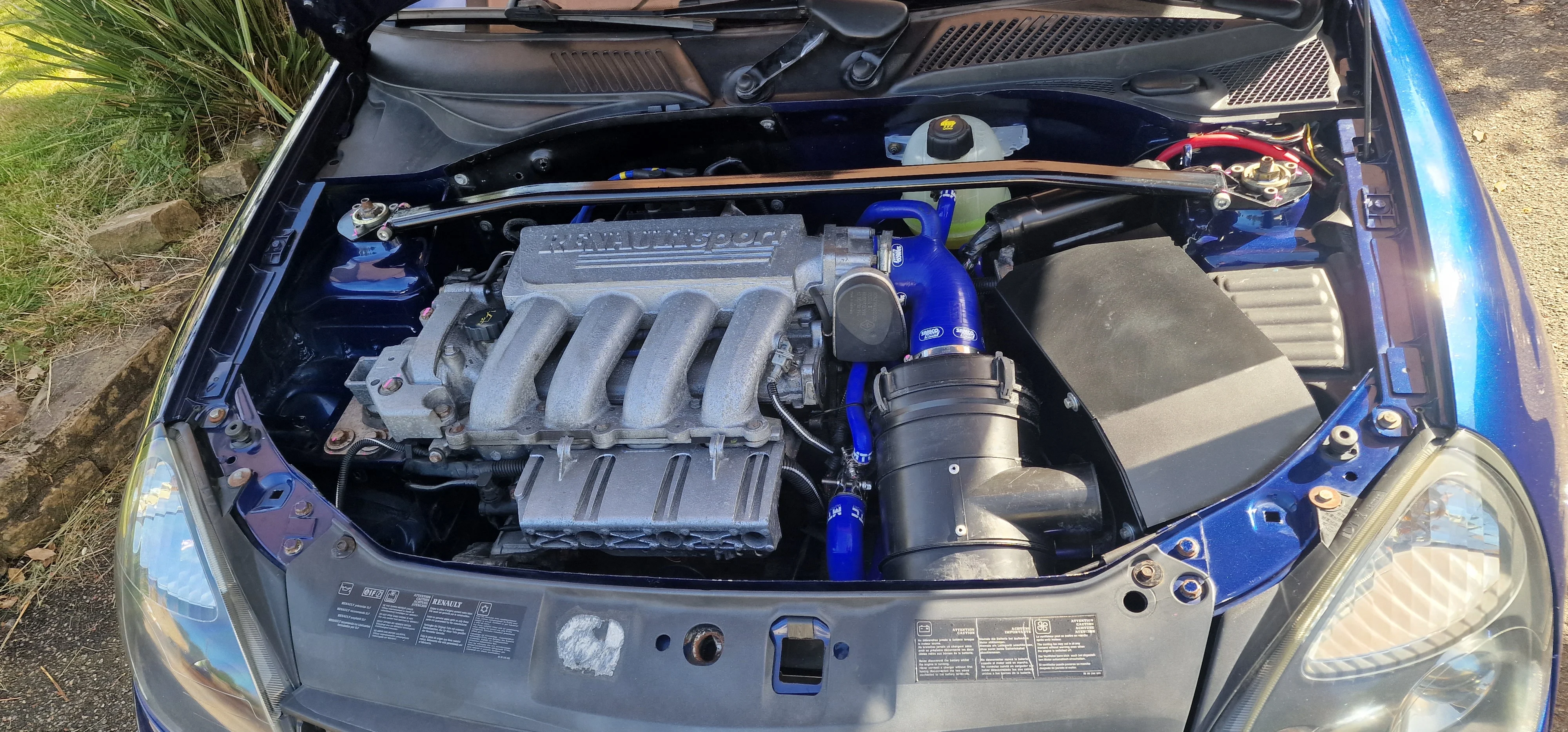

Put a new sunstrip on, sanded and polished the headlights, cleaned my engine bay, cleaned the car inside and out and then painted my washer blanks again as they looked a bit cack
Old sunstrip off, it looks so w**k without one🤣

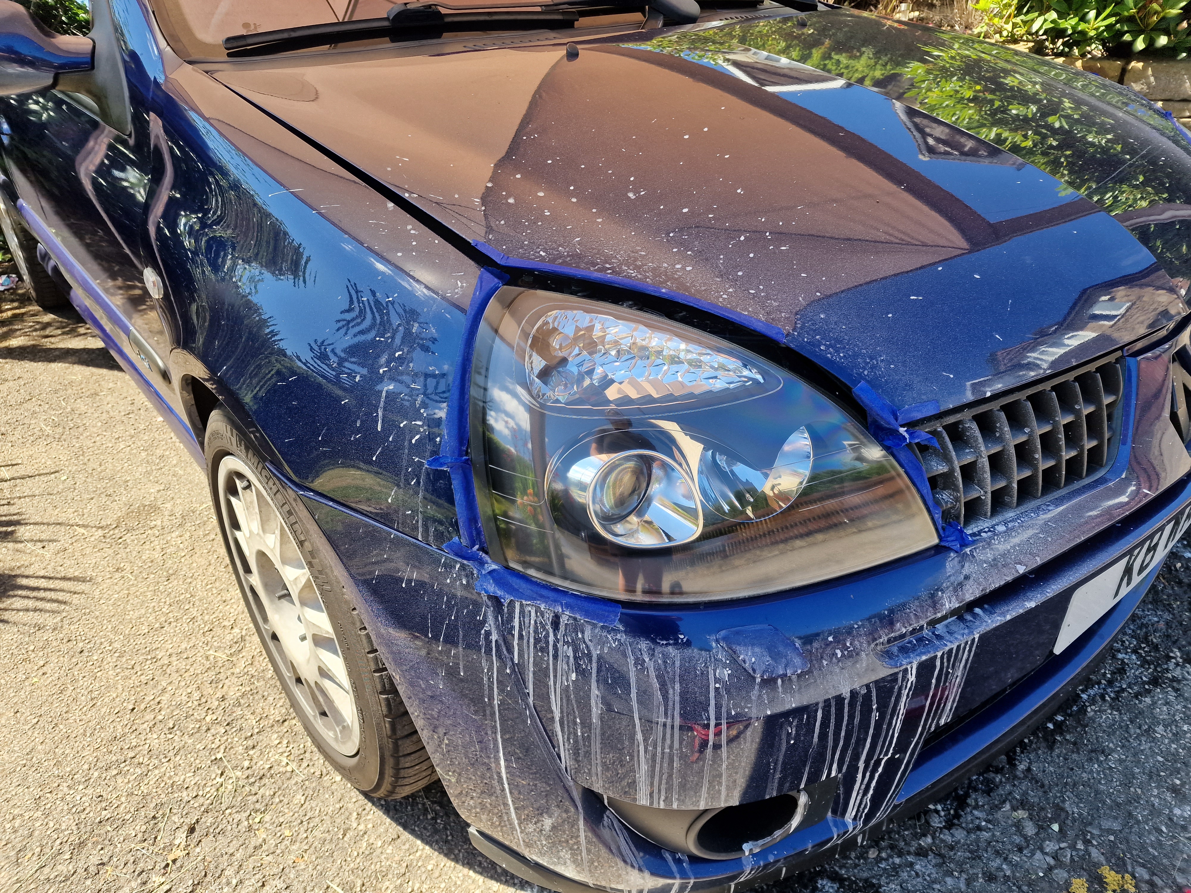

Coated the hard plastics in Gtechniq C4

Gave the headlights a good iso wipe and then some Gtechniq crystal serum light
Then gave the inside a good clean to make it nice enough for passengers
