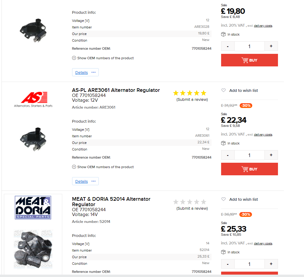

Managed to find a Valeo unit for £163 on Autodoc
Autodoc do list some contenders...
But £163 looks a great price for a whole new one. Could repair one or both of the buggered ones.

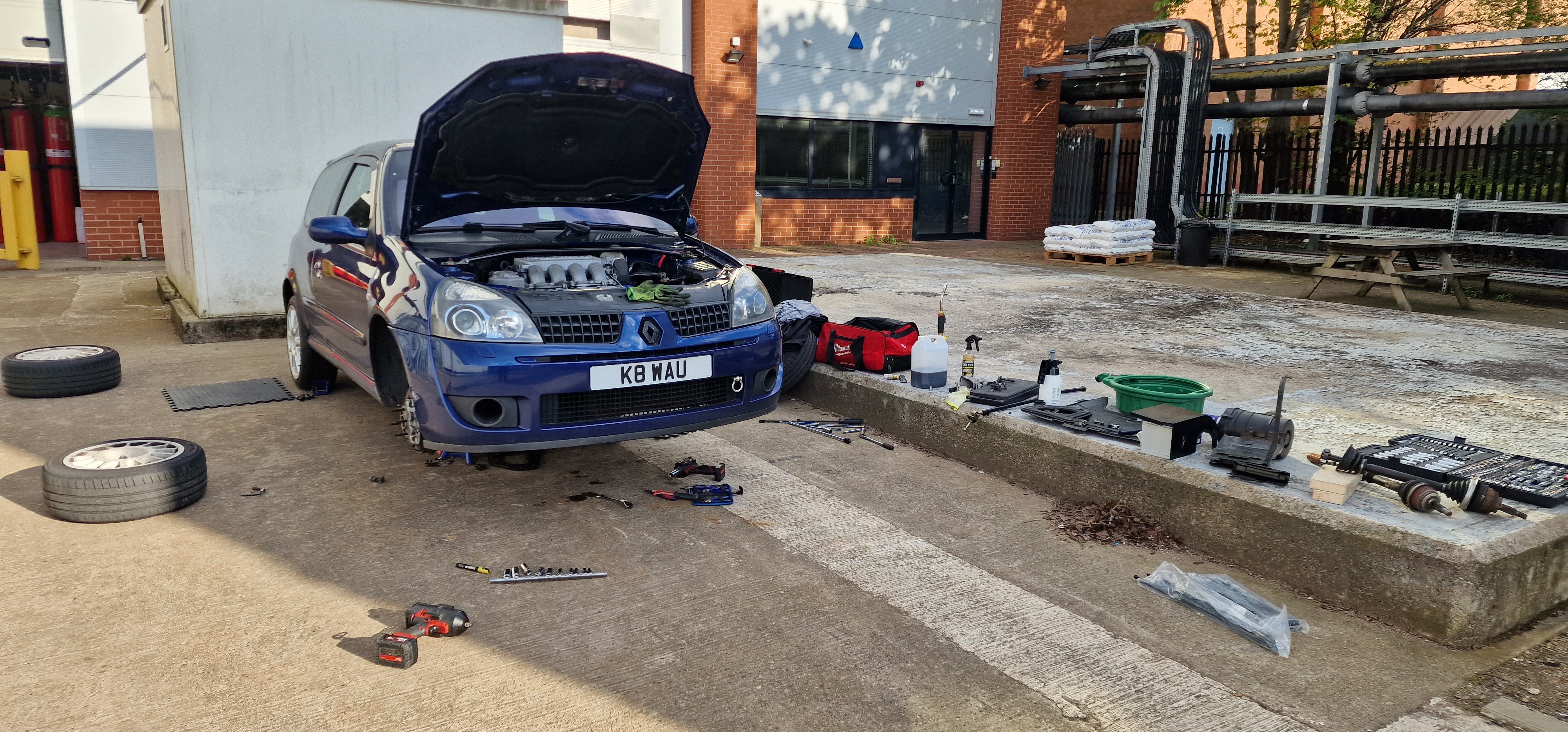

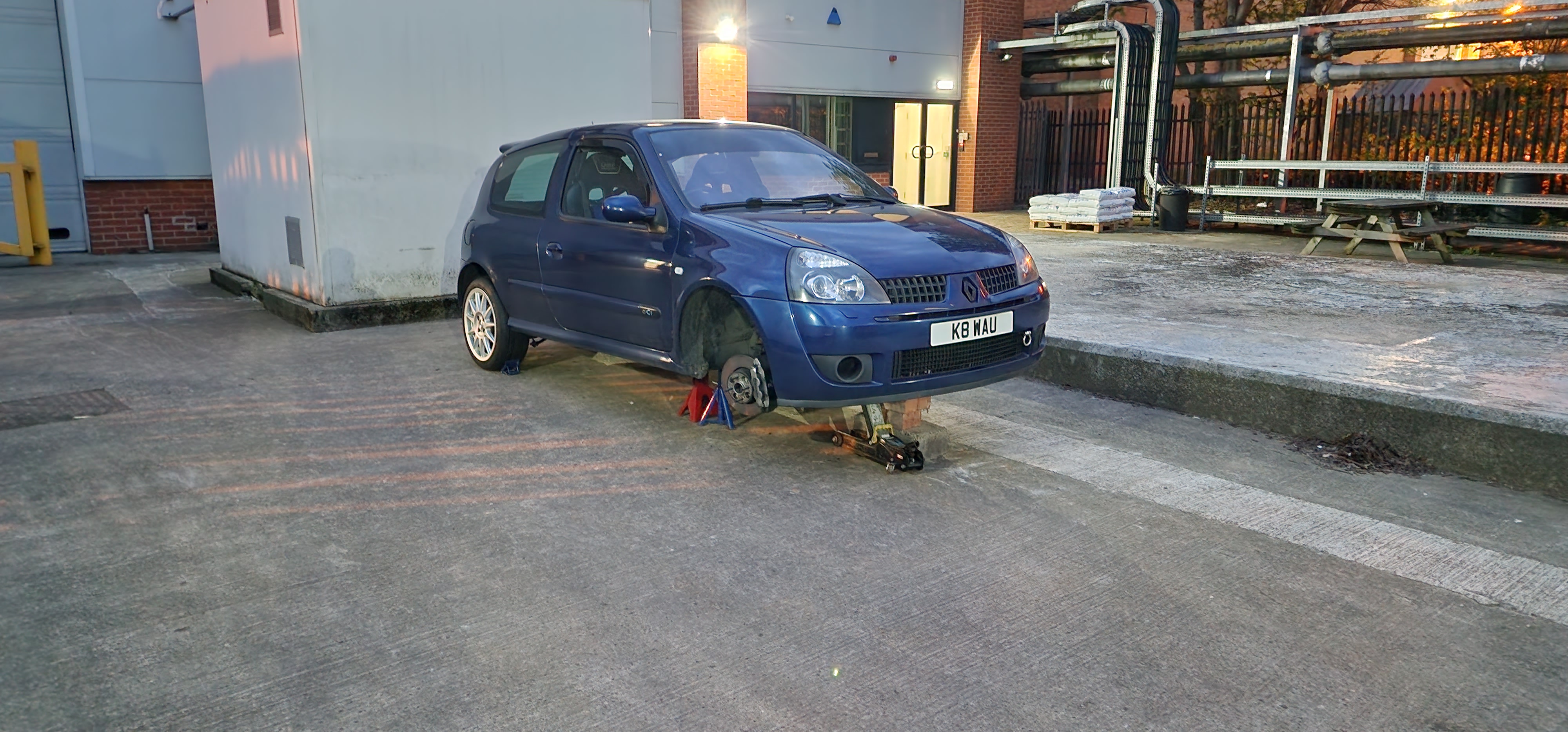

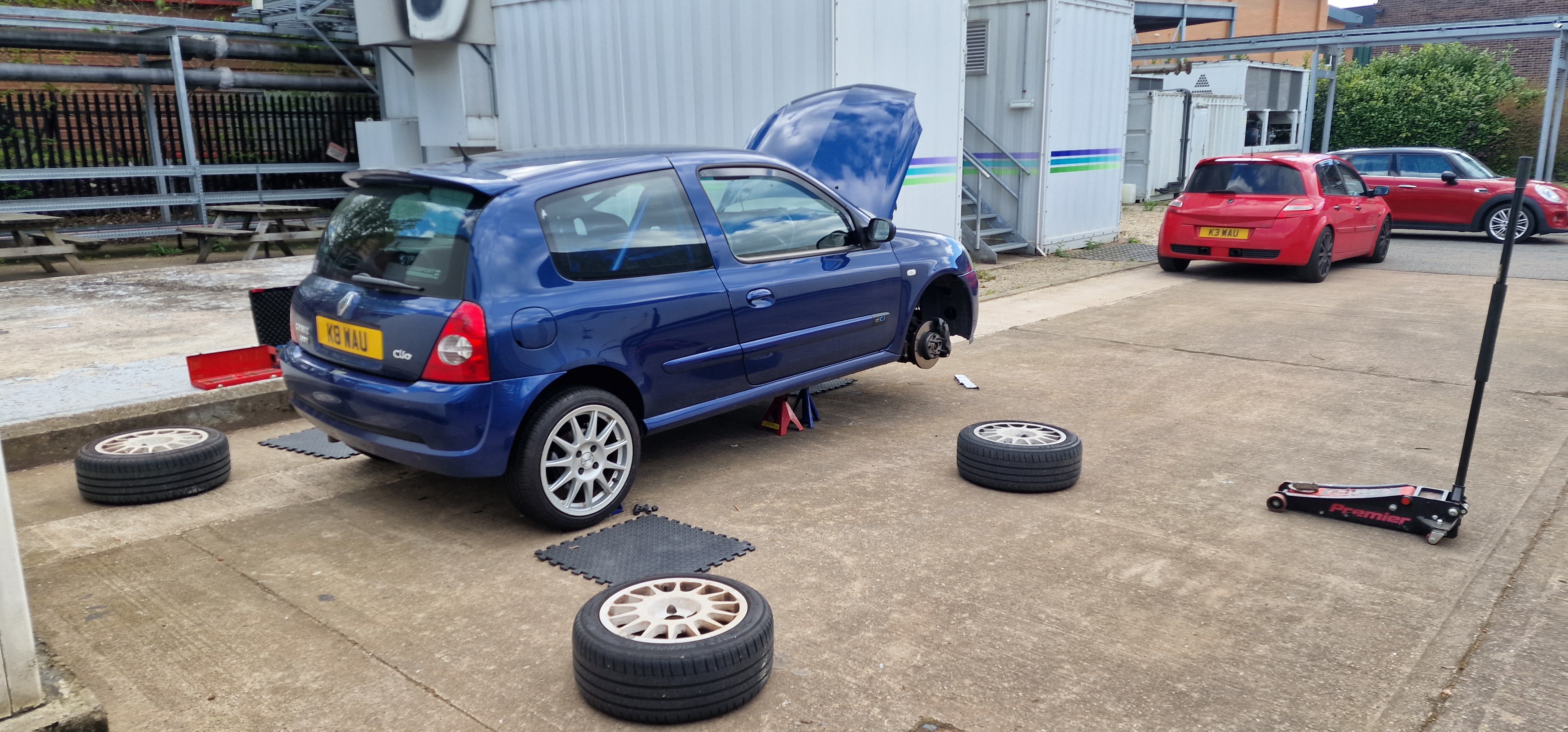

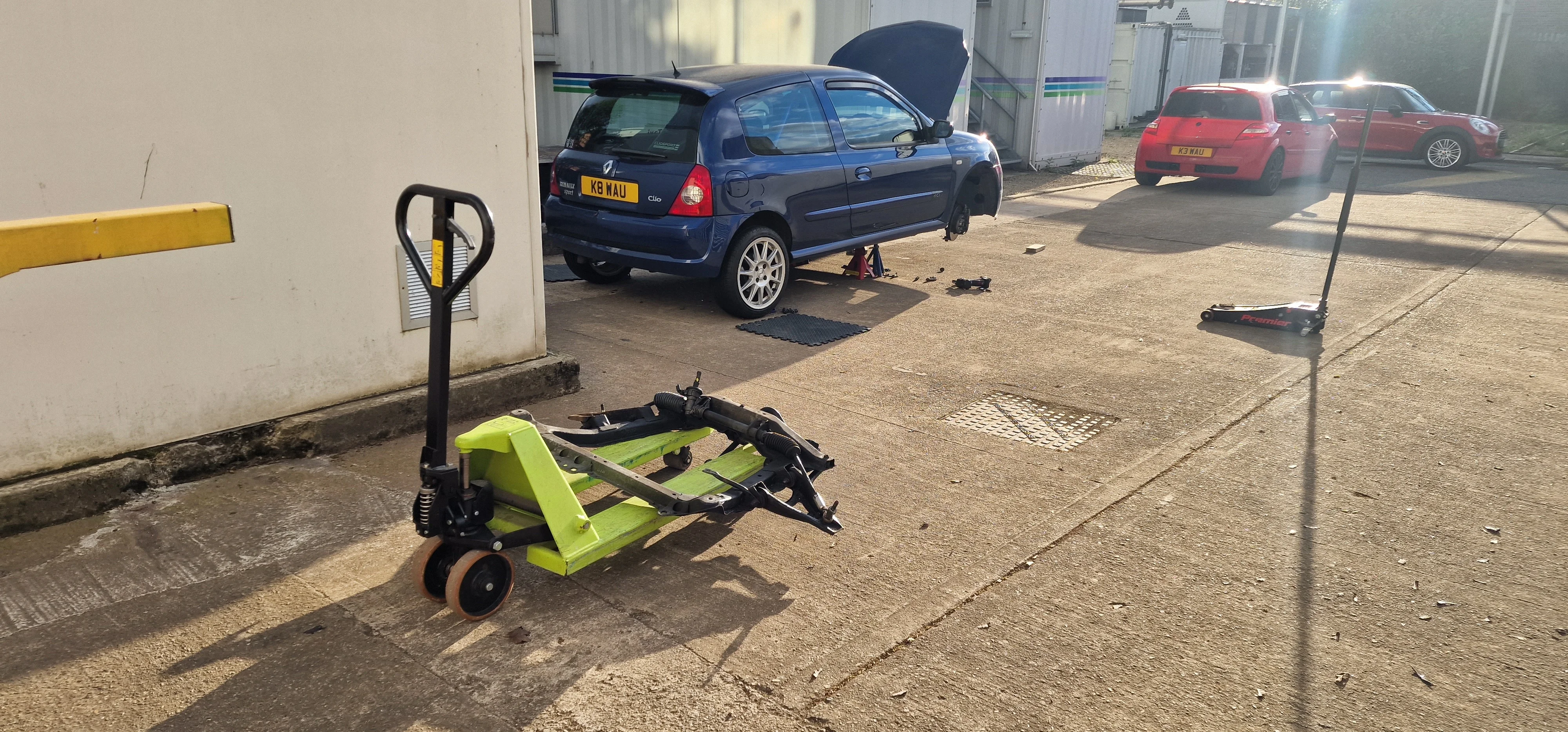

Having the bathroom ripped out next week and need a skip on the drive (yes an actual skip not the Renaults I own)

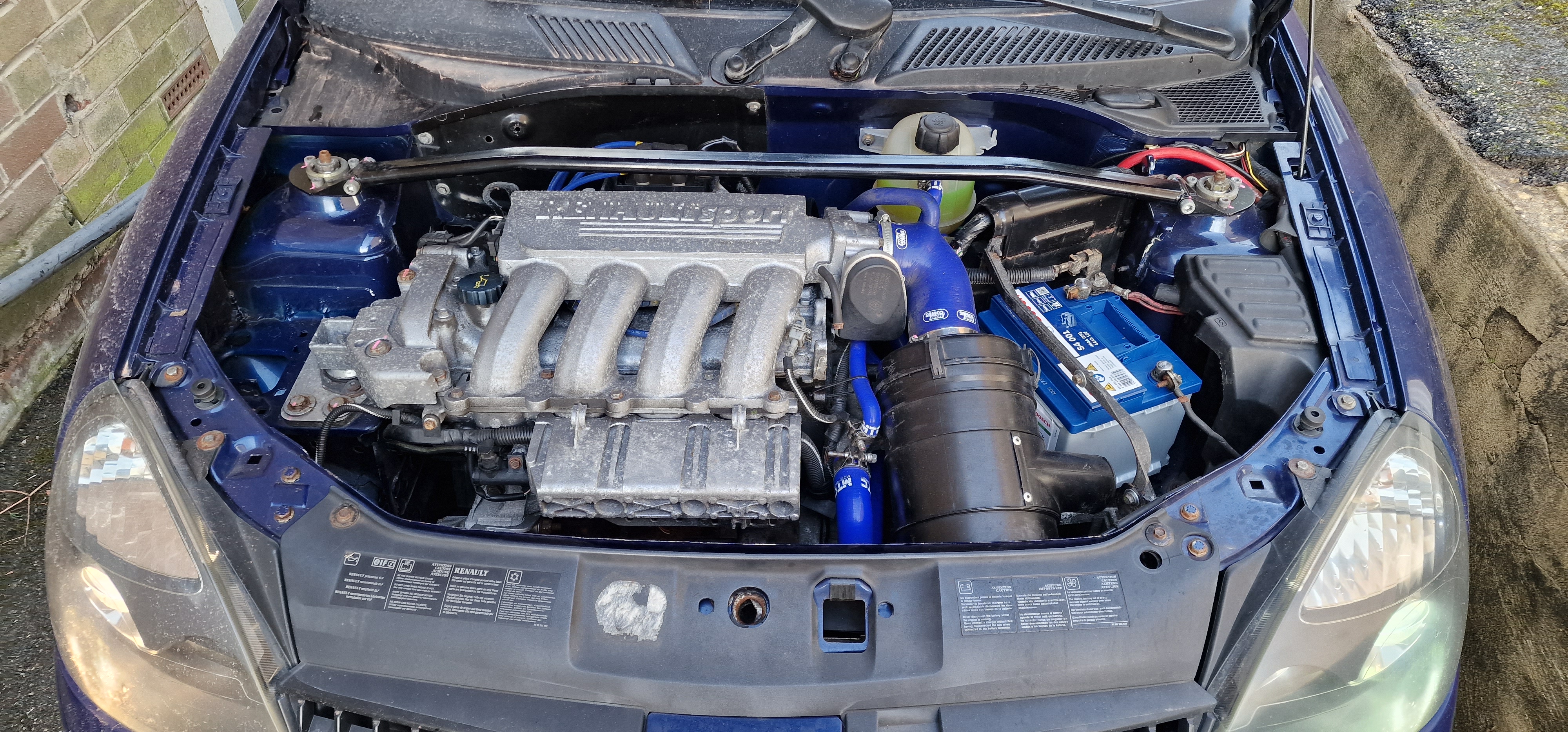

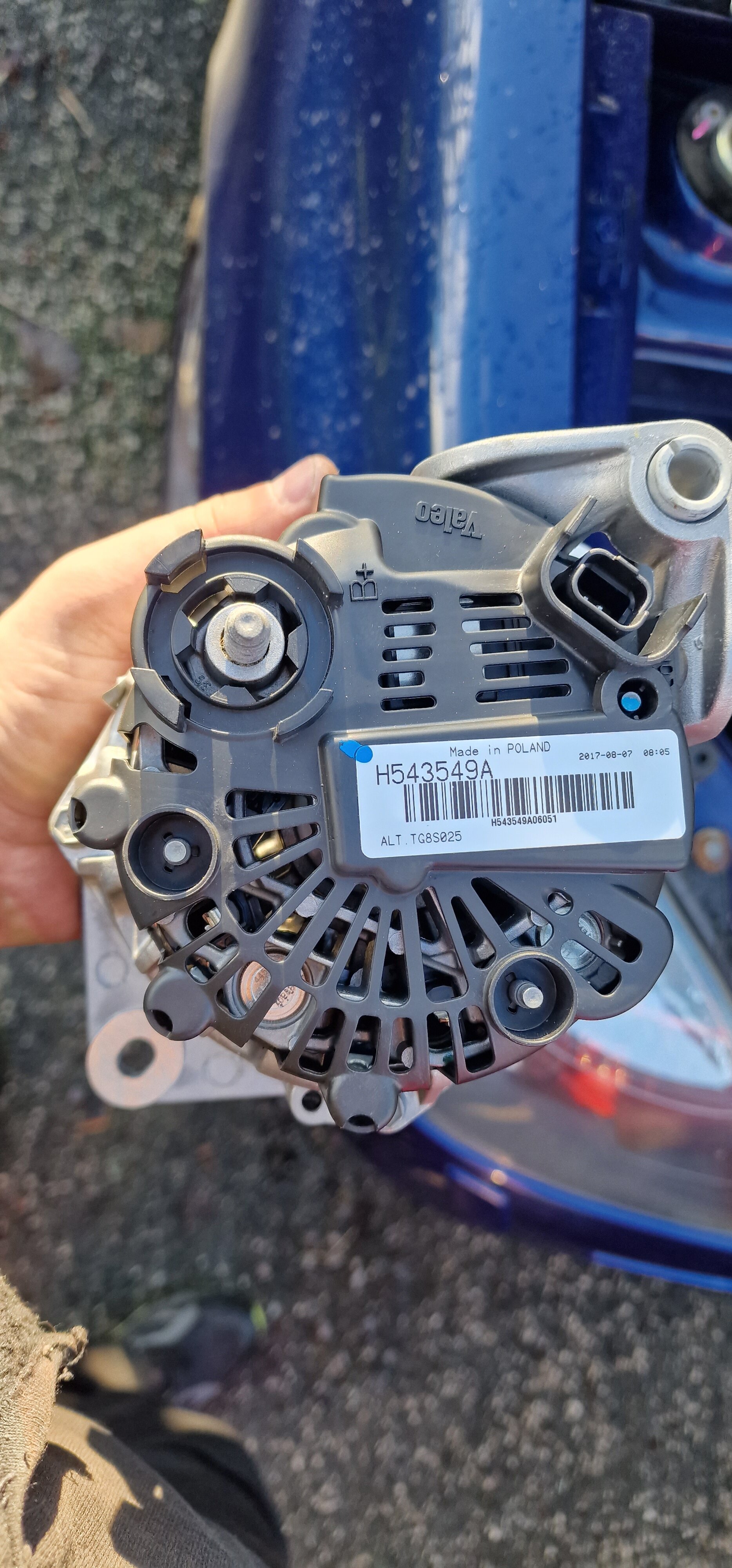

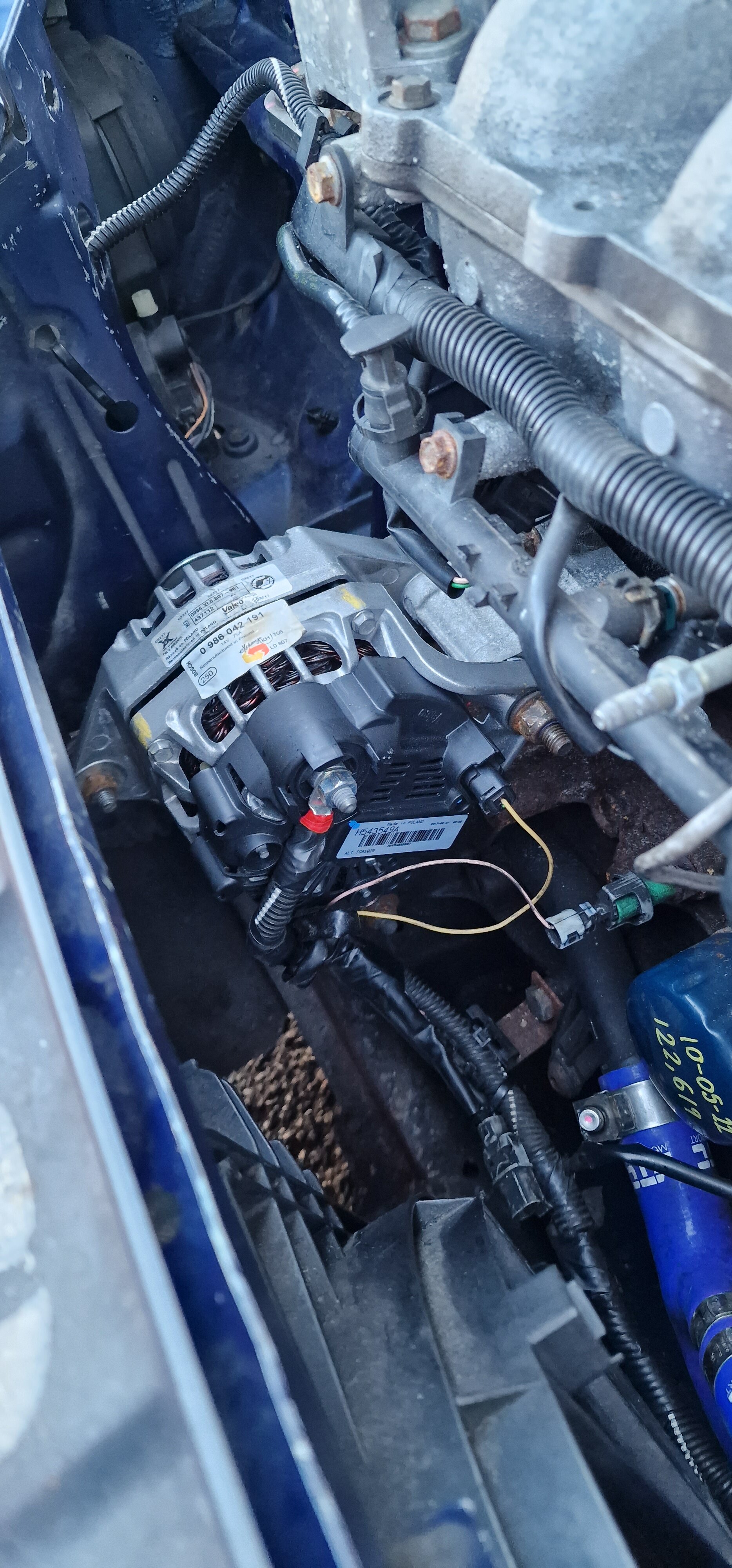

So with that I needed to move the Clio. The issue is the alternator was fried and the battery I stole from @leeds2592 was now dead. Below 6v dead so I'm guessing the Halfrauds batteries are just shite quality as it's not old and should at least hold some charge
Bunged the battery on the charger, at first it wasn't drawing any amps but after a few mins it climbed up to about 10A. With that I set about swapping the alternator

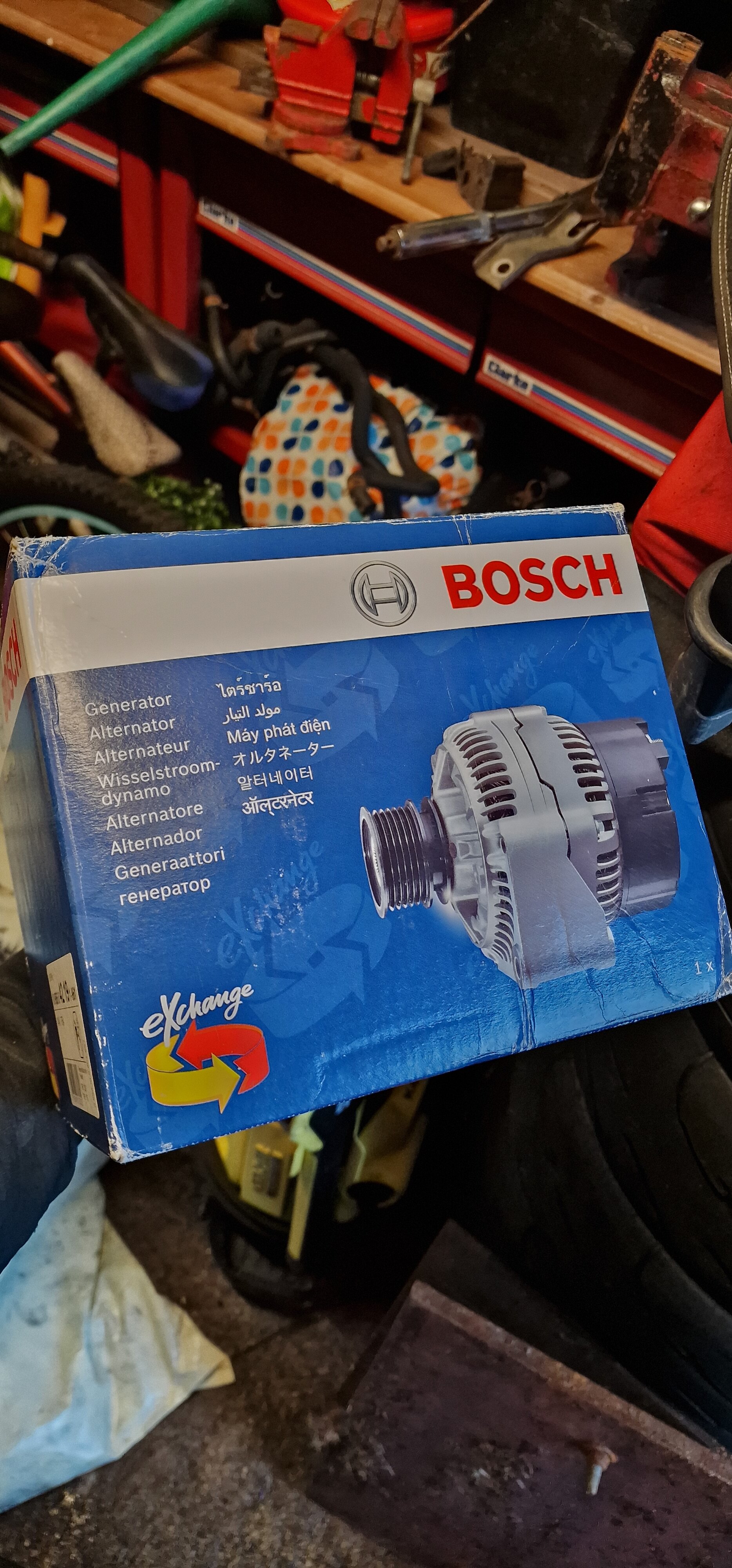

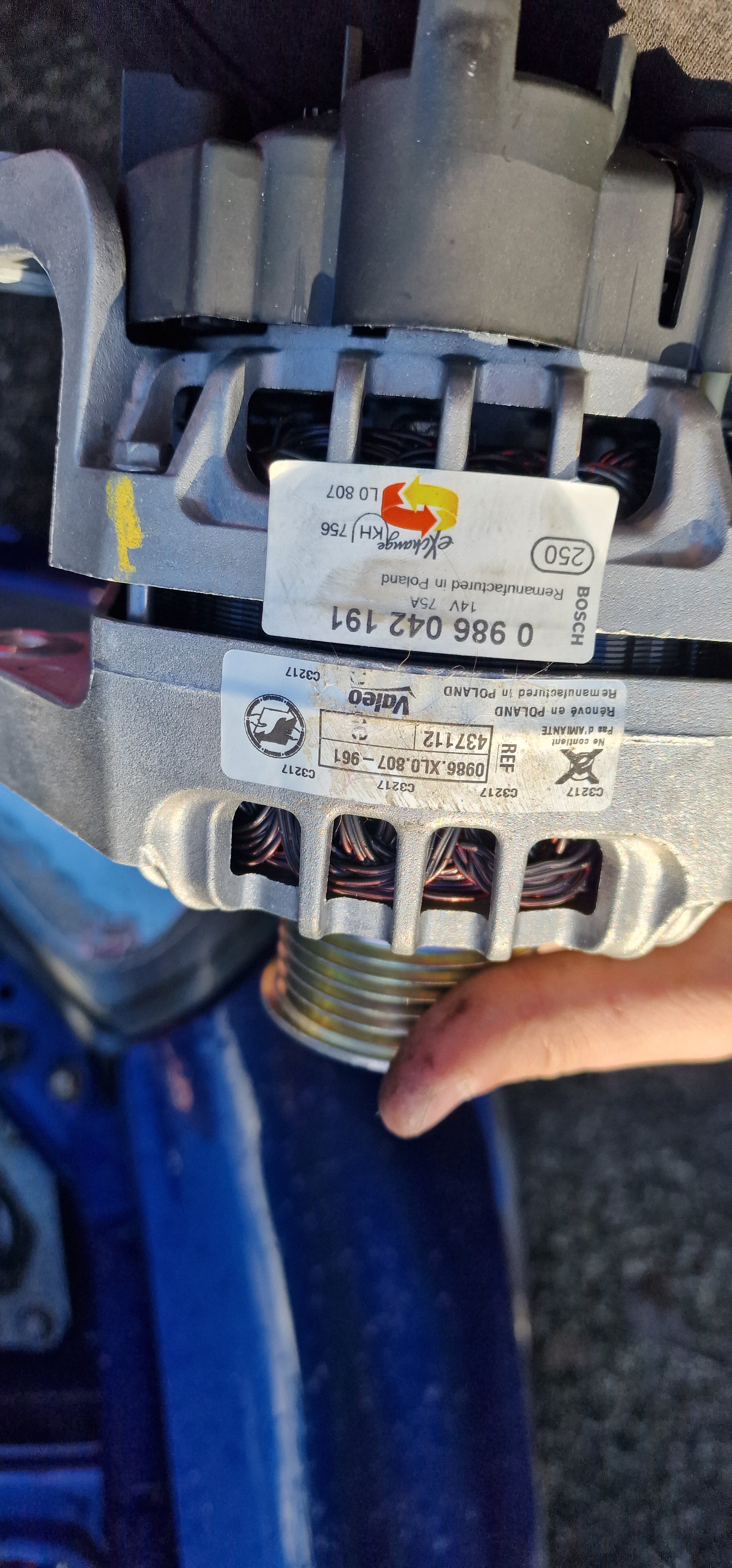

I managed to bag a 75A Refurb Bosch alternator on eBay in November for £65. A good result considering a proper Valeo/Genuine cup one is nearing £200 now
The box
The alternator, I doubt there's very much left of it that's actually Bosch🤣

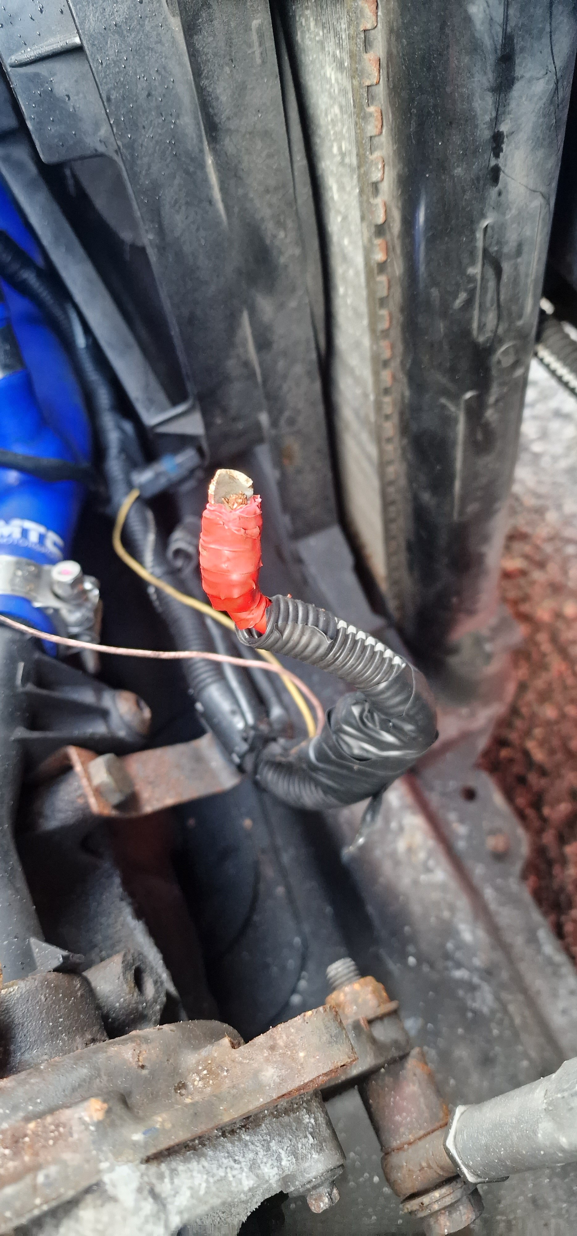

Removing the old alternator, first job now the battery is gone. Take the battery cable off...
Well I suppose it's off😑

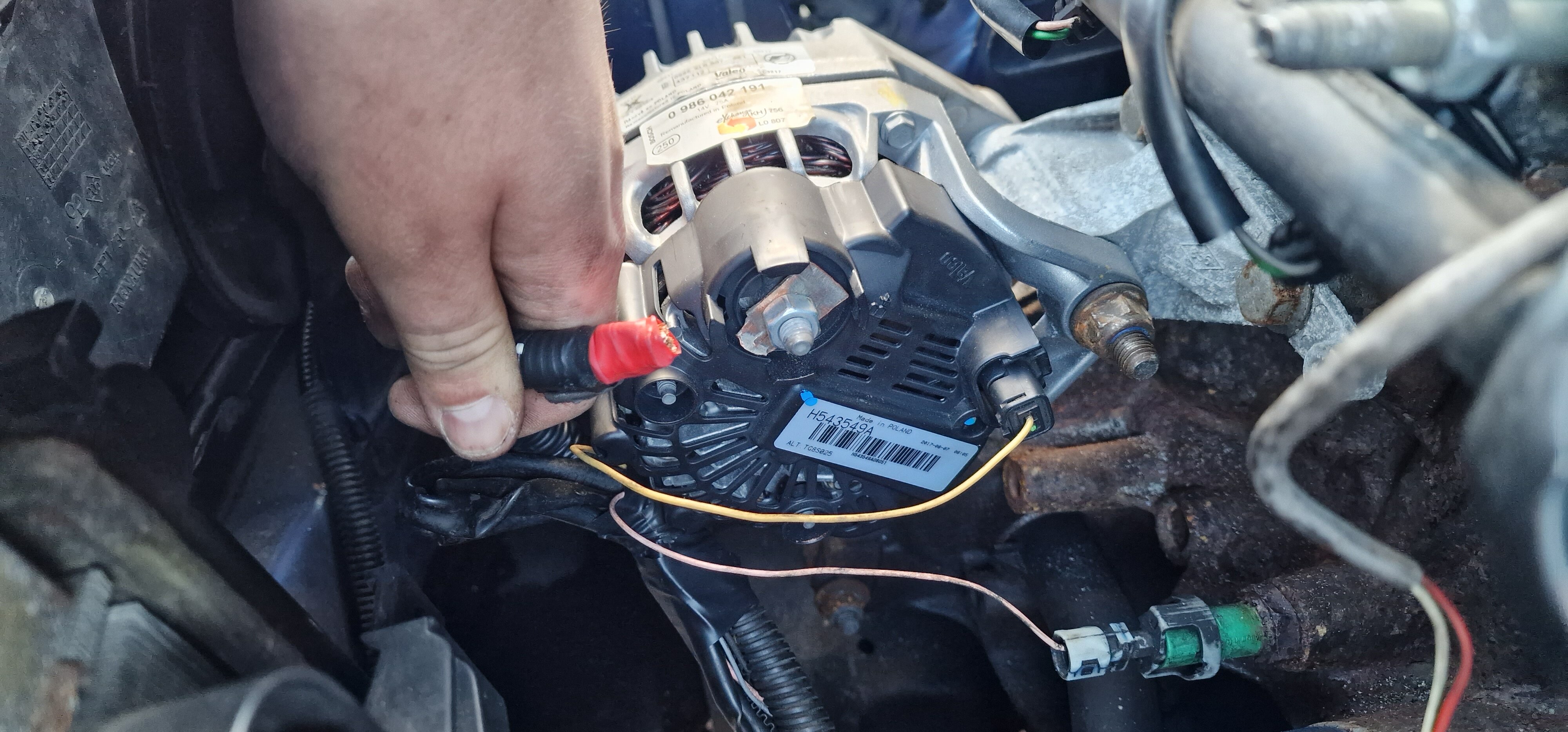

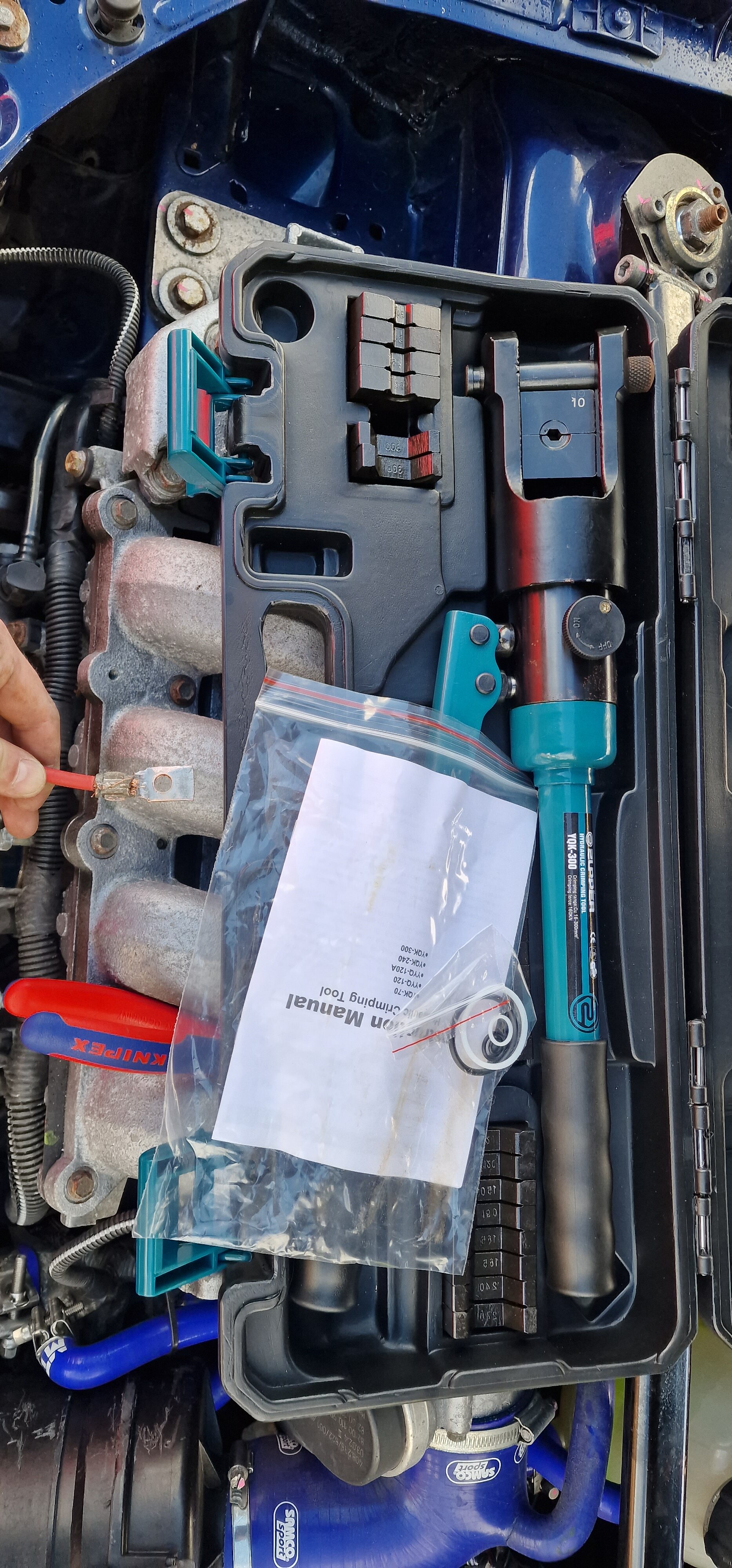

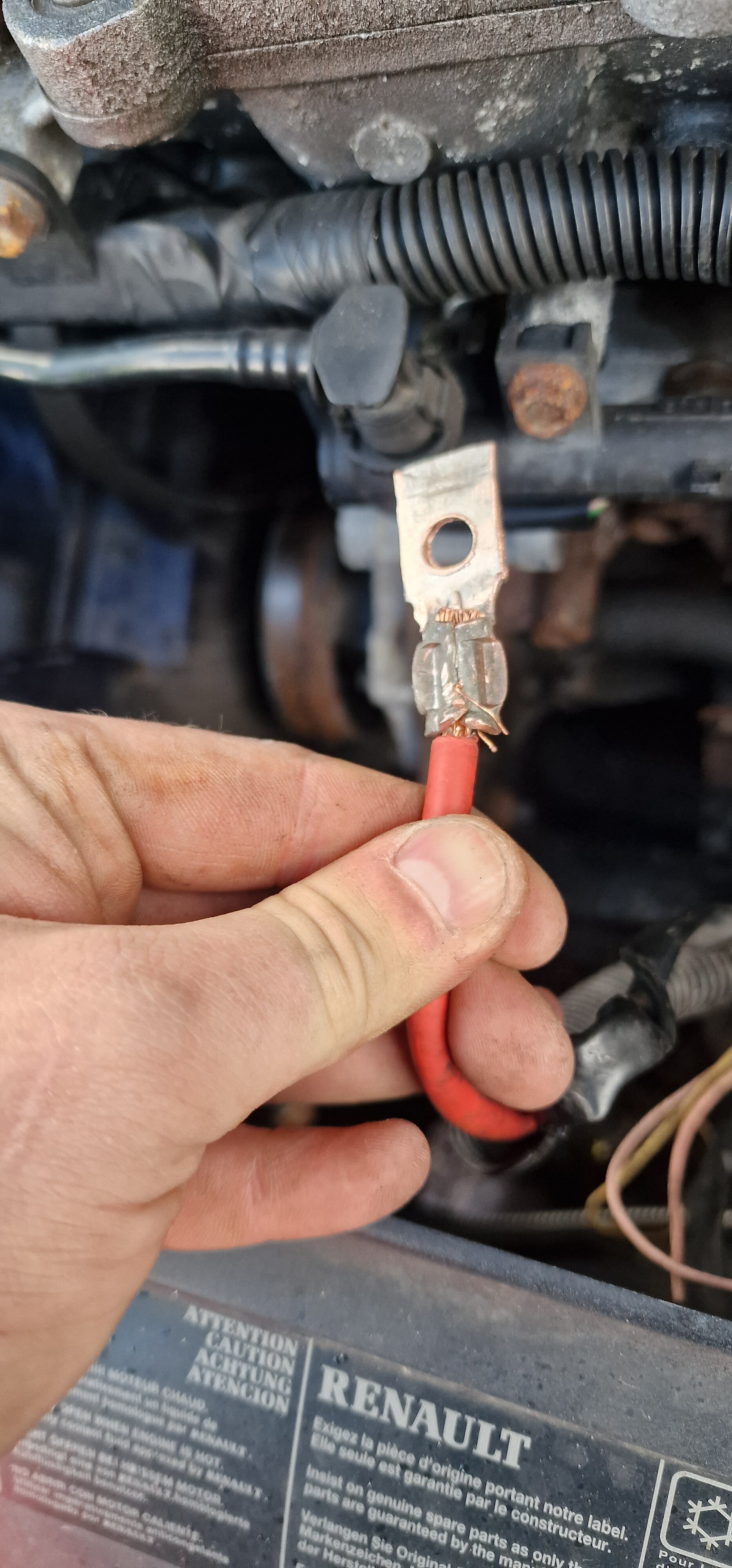

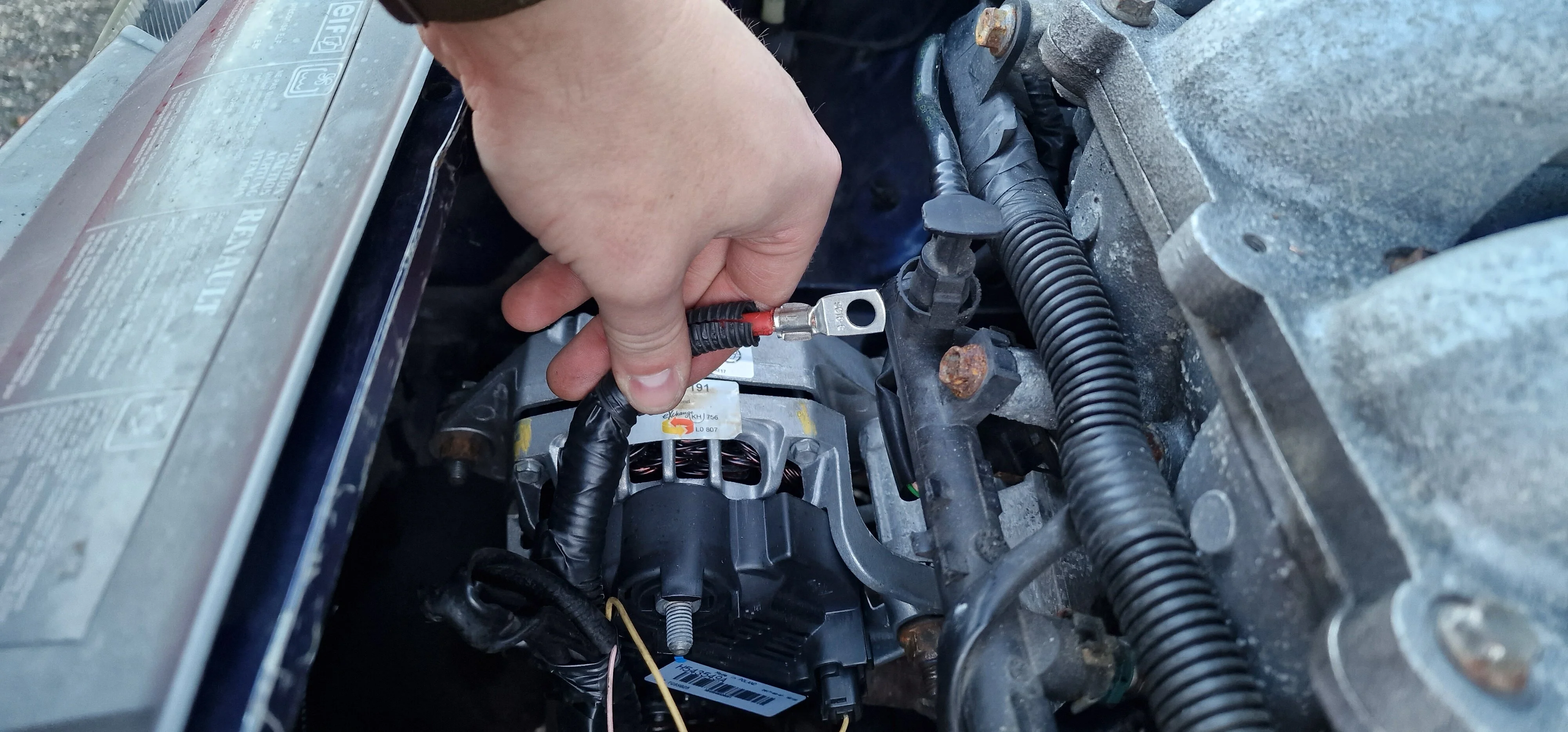

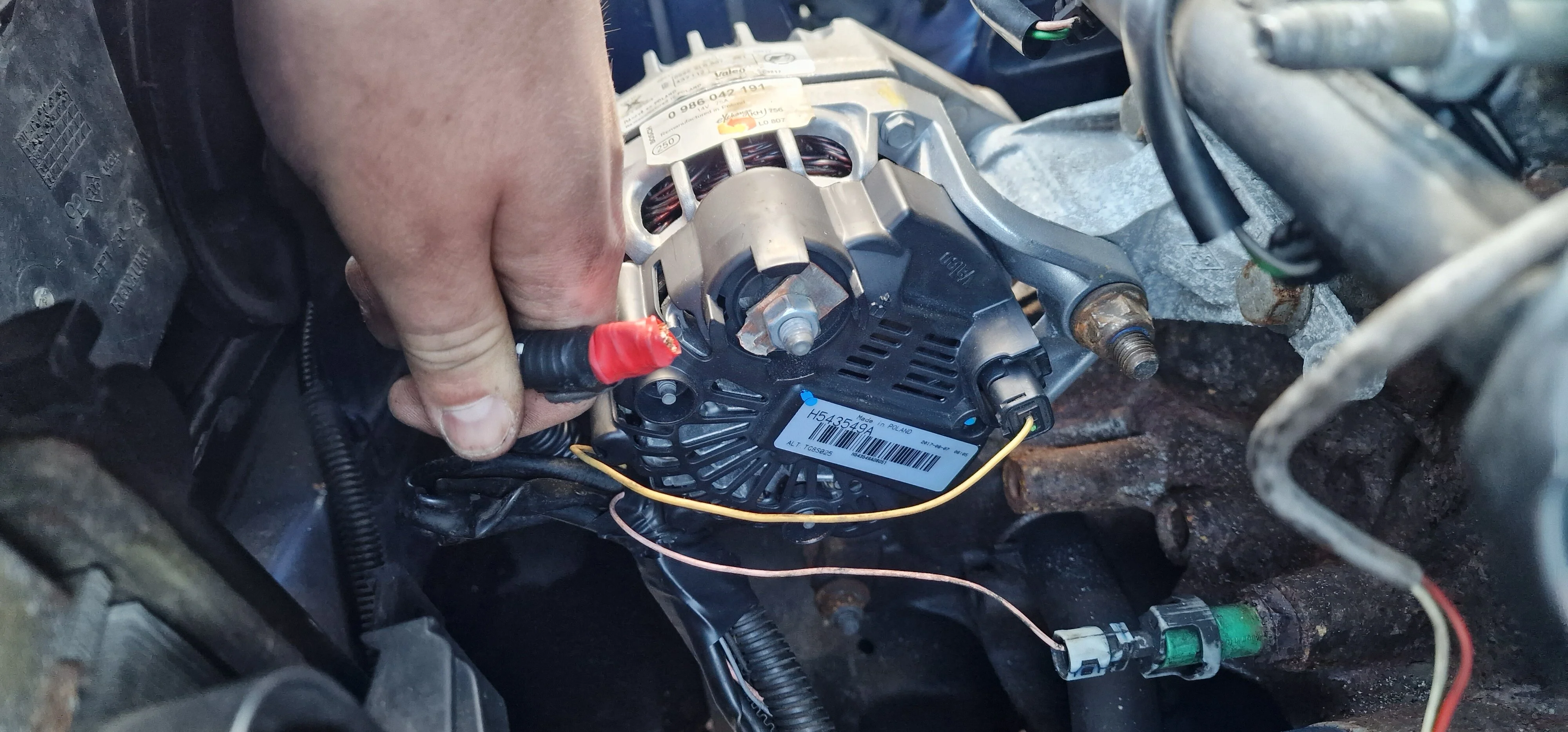

Anyway, found another terminal on a spare loom I have in the garage, knocked out all the old copper and crimped it back on using my big crimper. This thing is a total beast

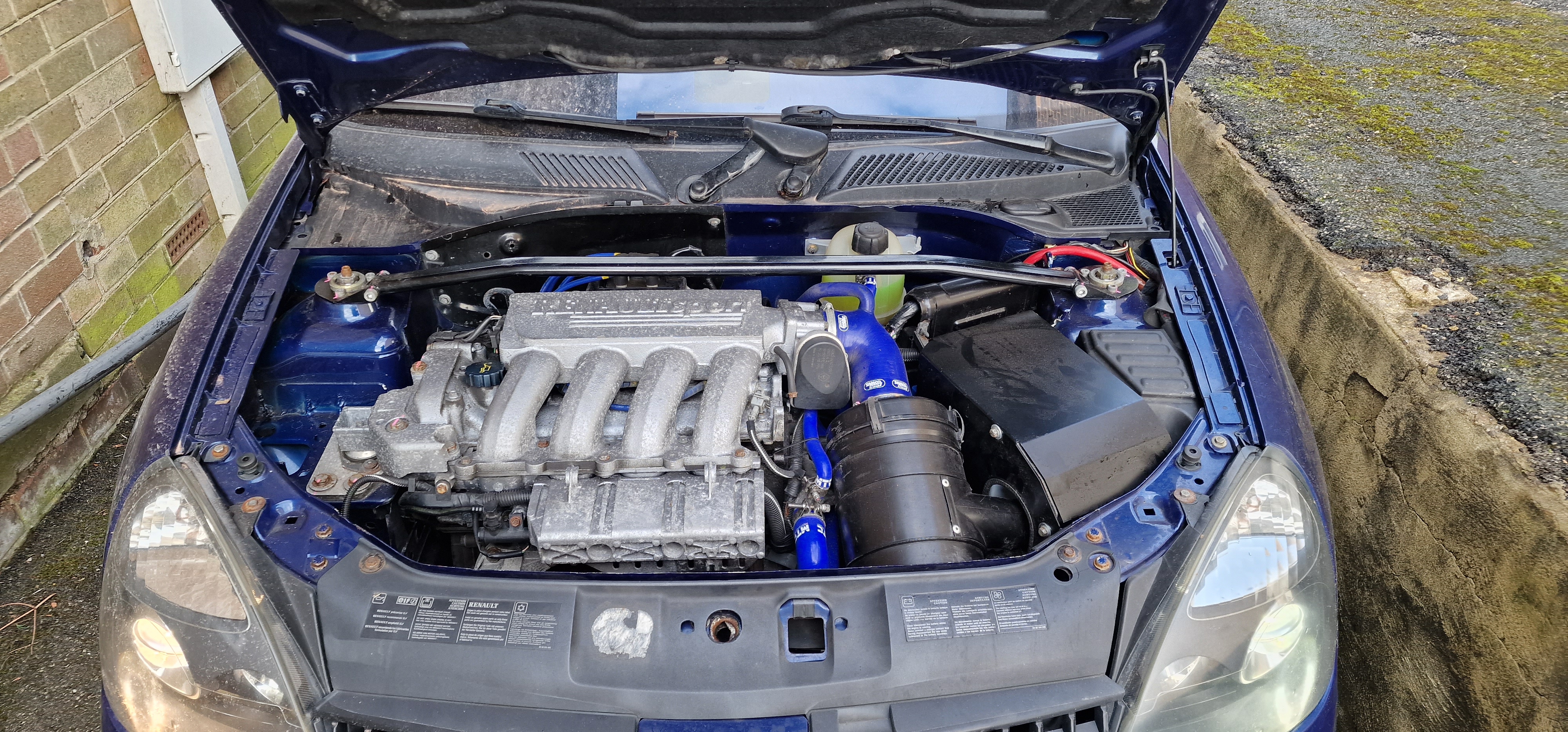

New alternator in, everything back together and ready to start. Gave everything a quick wiggle and a once over...
Righto, it must have just gotten fatigued with me twatting the old copper out of it and snapped as soon as I put 10nm of torque into it😑
A quick trip to Screwfix for some new terminals, not f**king about reusing old ones anymore
Cabling re-taped, routed nicely and reattached. This time the terminal didn't snap. Hooray, 4th time lucky eh

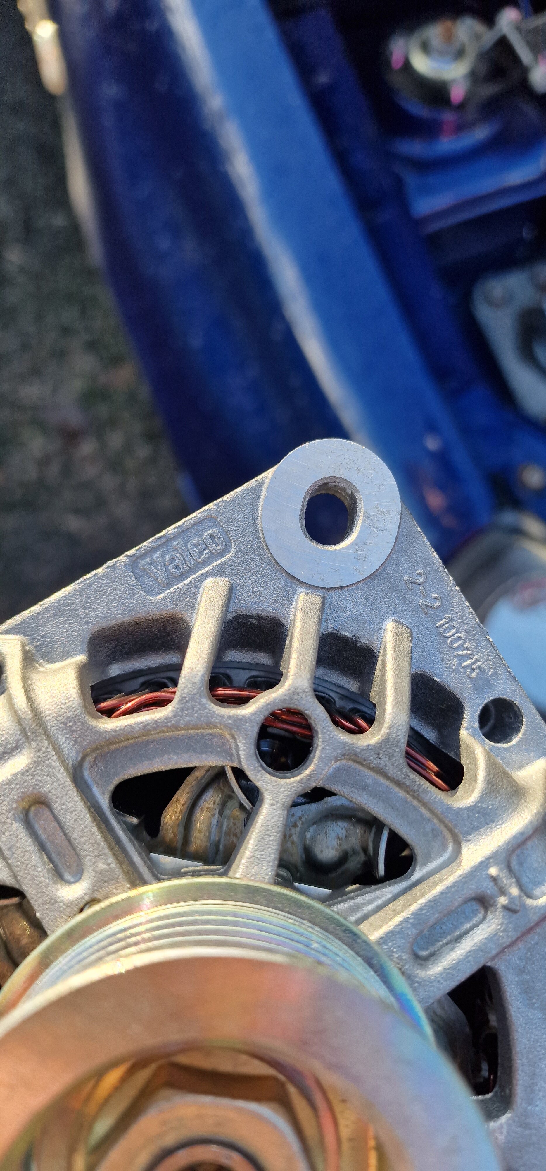

The alternator ain't the same as a 172 cup one, the connector for the signal wire is on the back nearest to the block instead of on the front
With that done I slung the battery back on and it fired up first time. No errors and charging the battery to 13.5v just fine

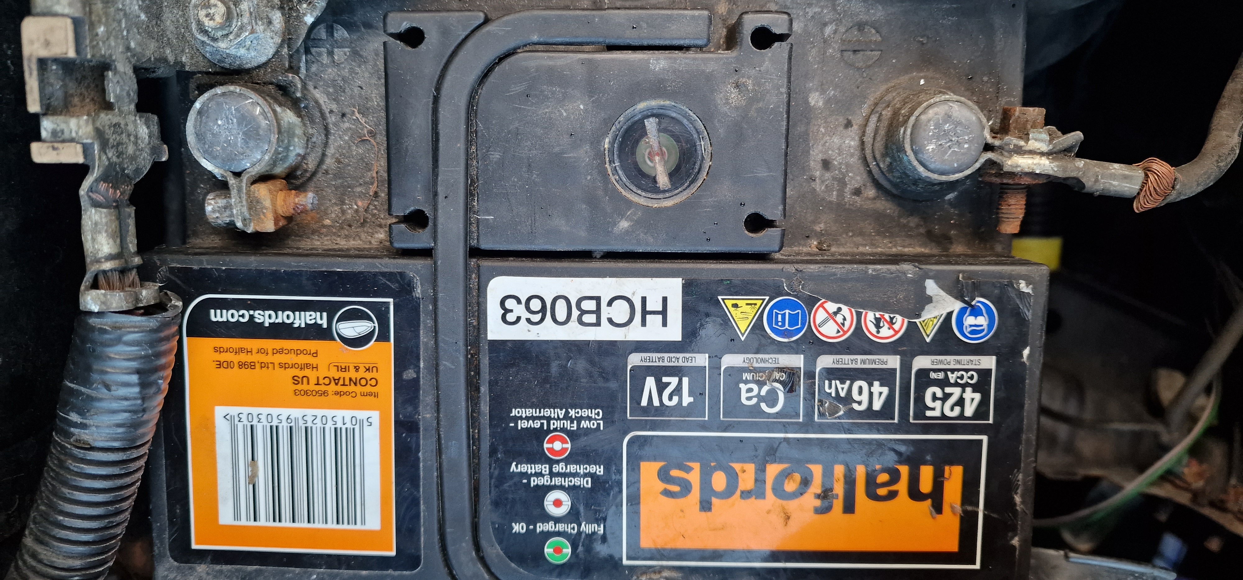

The battery is on its last legs so I'll grab another just for peace of mind. But with the car now fired up I took it for a quick whizz round the block and fell in love again. Feels so good to drive and can't wait for more track days this year

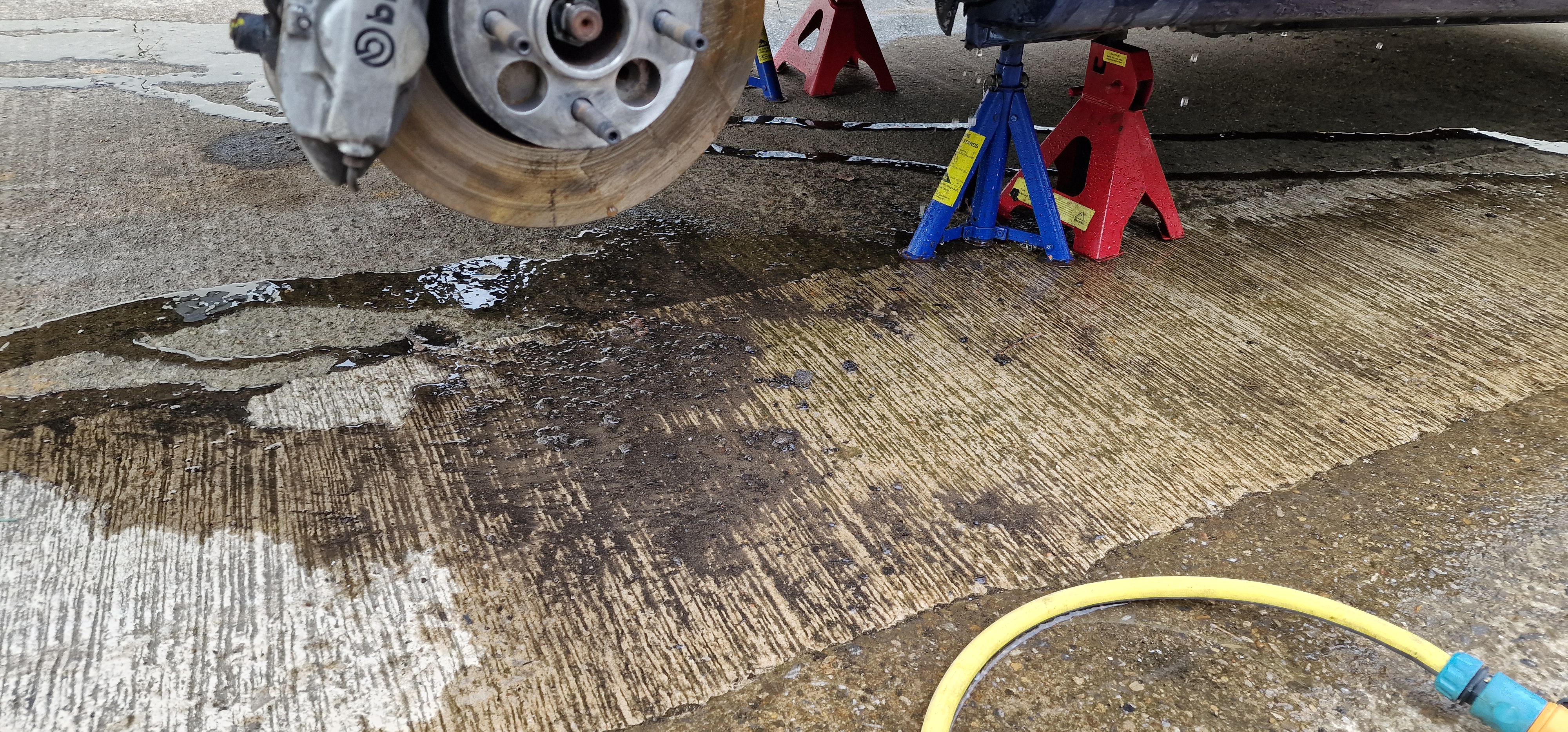

Pulled it out earlier to give it a good clean
The spastics core drilling the wall for the bathroom decided against using the hosepipe right next to them to stop dust going everywhere and covered the car

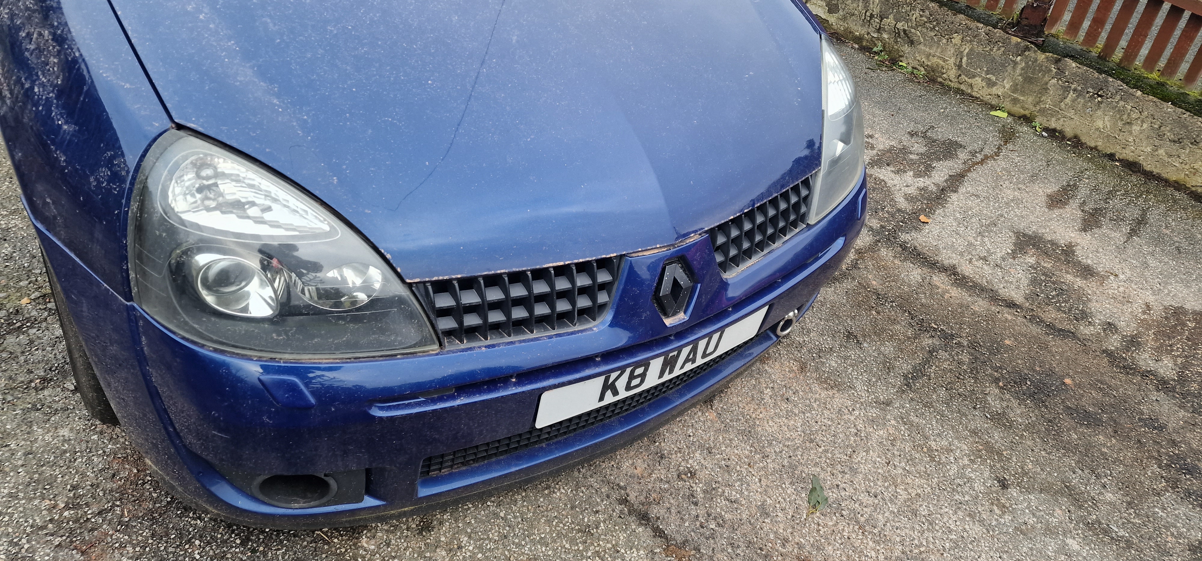

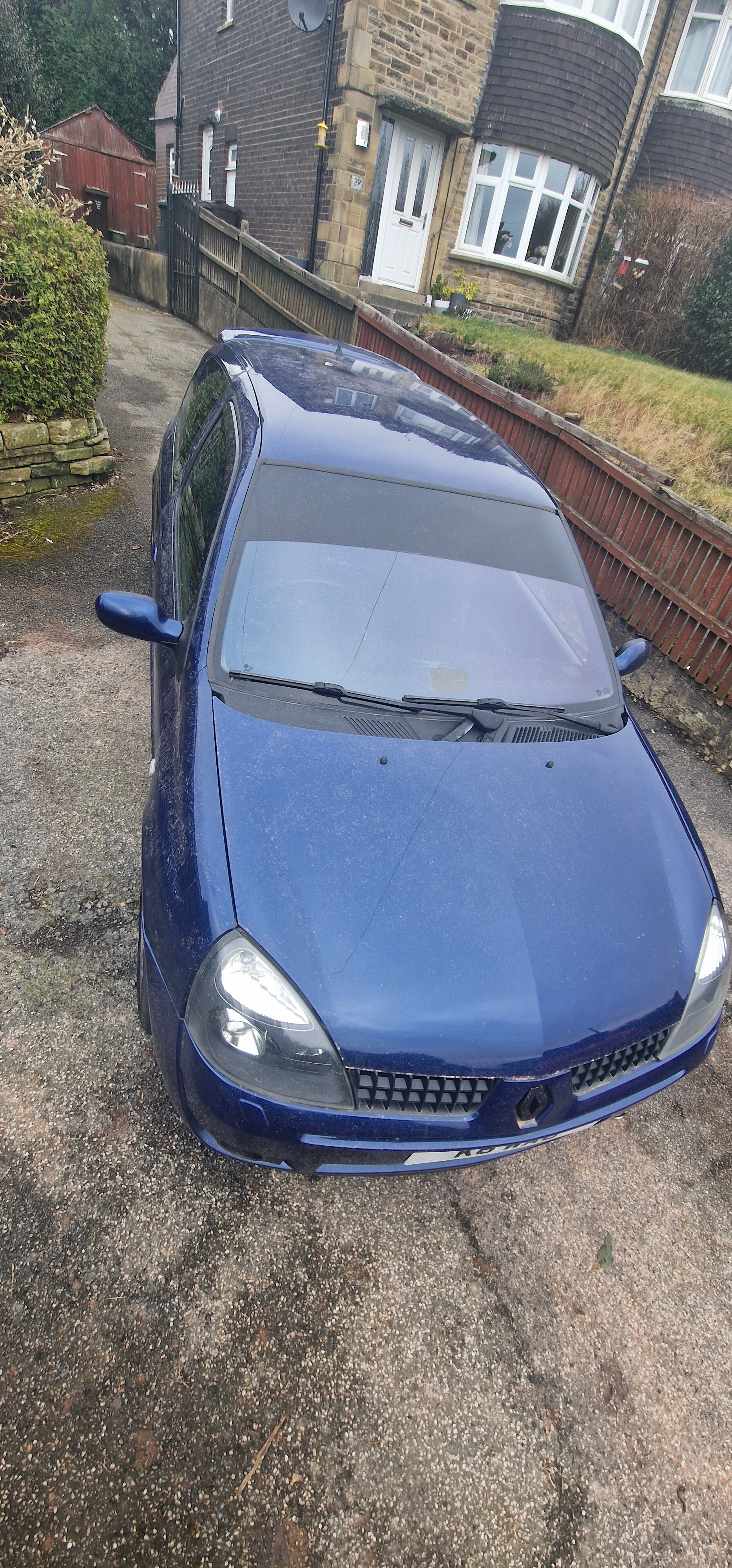

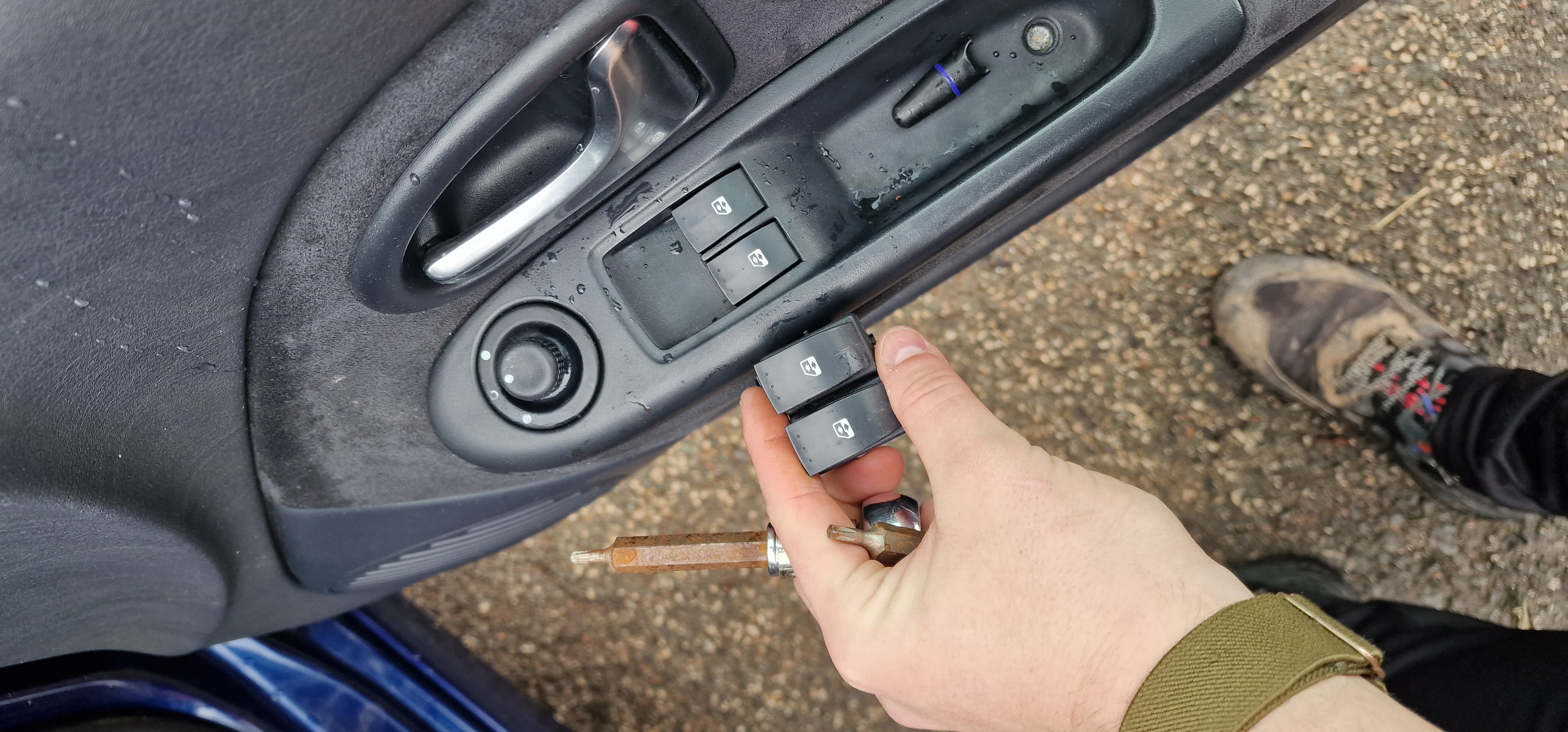

Clio taxed again. Replaced the drivers side window switch because the drivers window wouldn't come up unless you sat there flicking at the switch like an OnlyFans model with their bean
Window now goes up. Took it for a good hour long drive earlier but there was quite a bit of traffic so didn't really get much opportunity to open the taps. It never fails to put a smile on my face though, it's not fast by modern standards but it's so asbo it just doesn't matter. Whilst on my outing I spotted another Monaco too which was a rare sight!

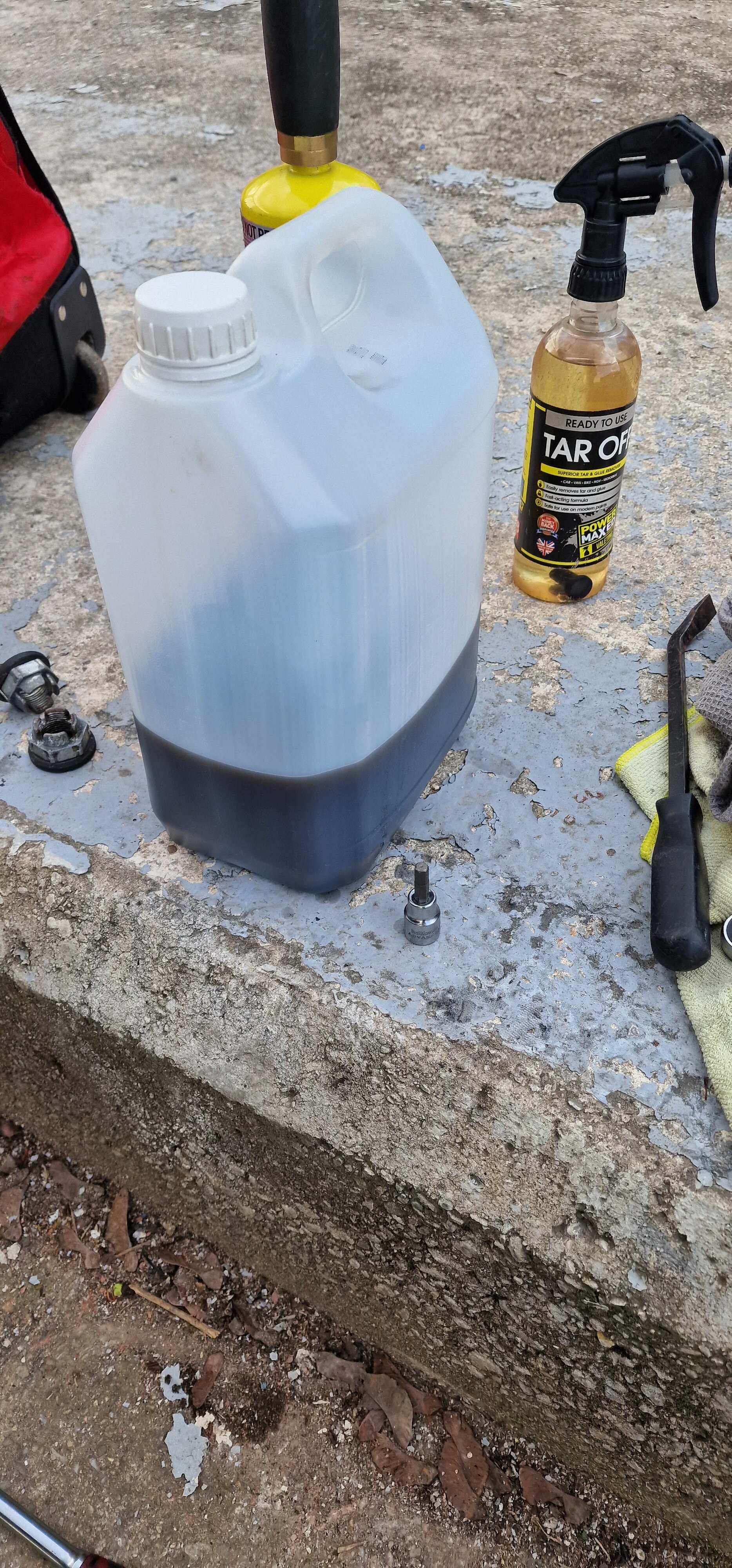

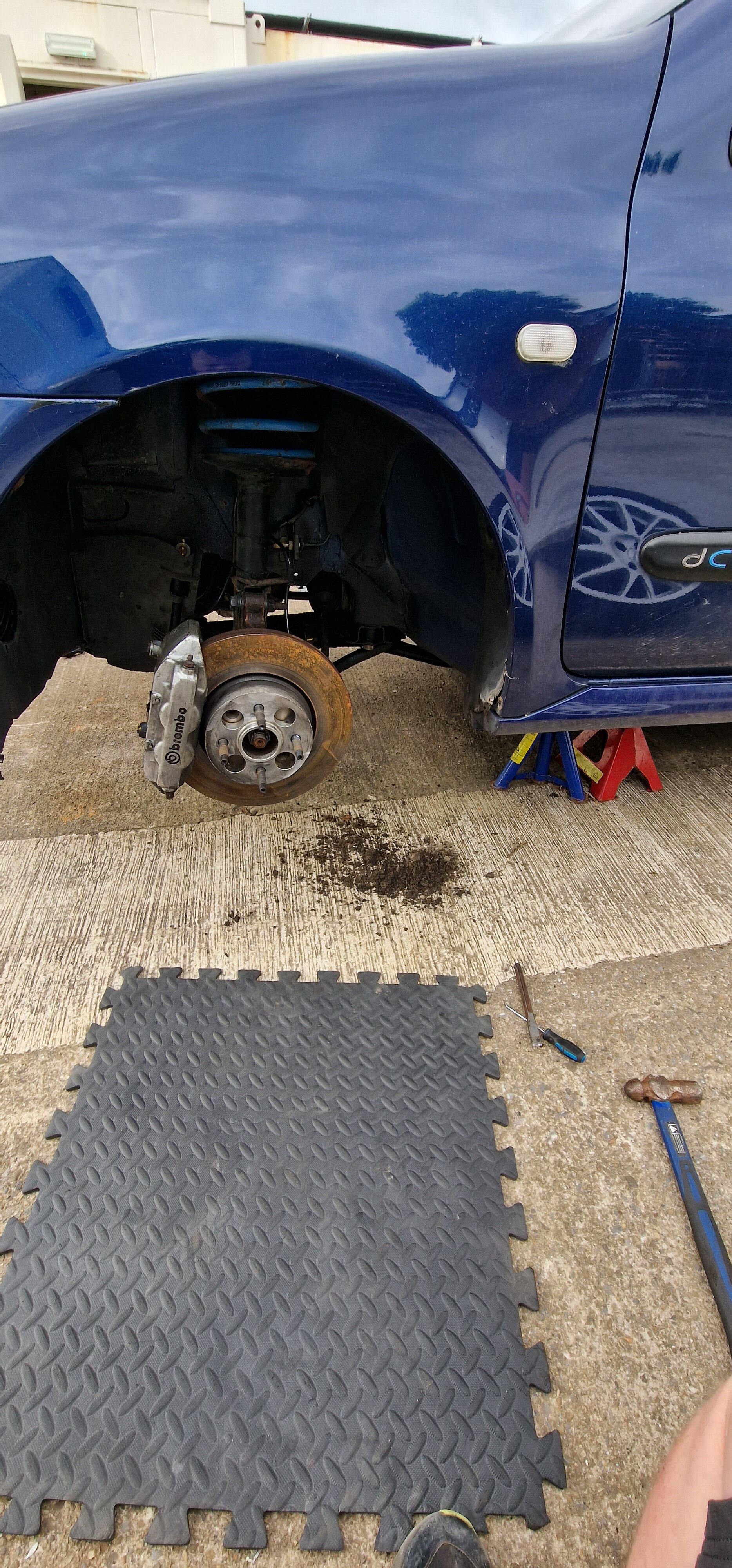

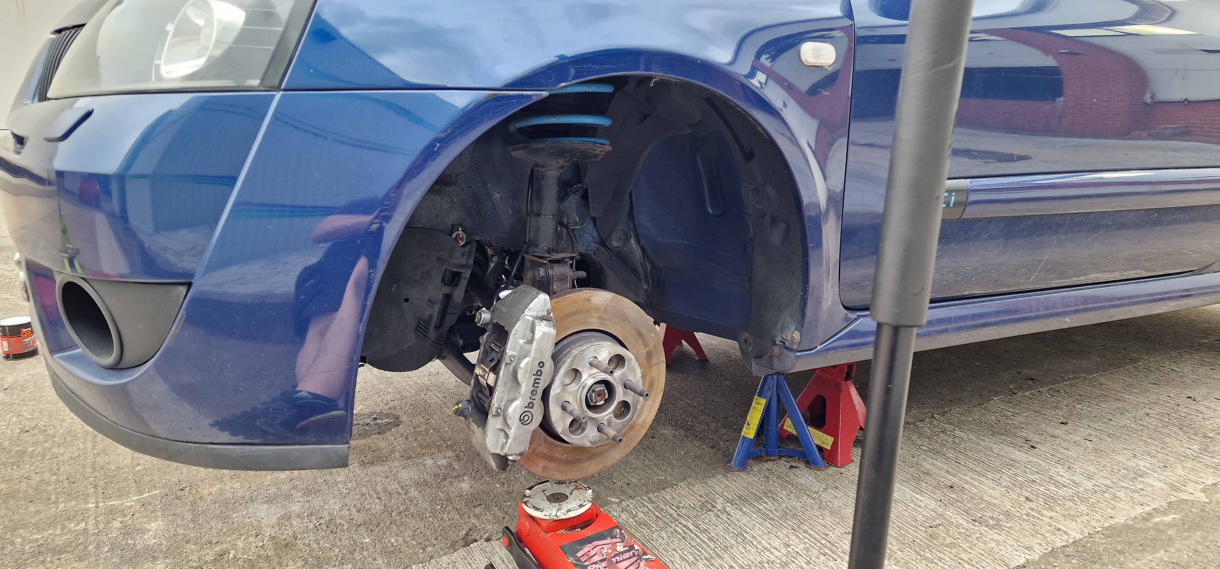

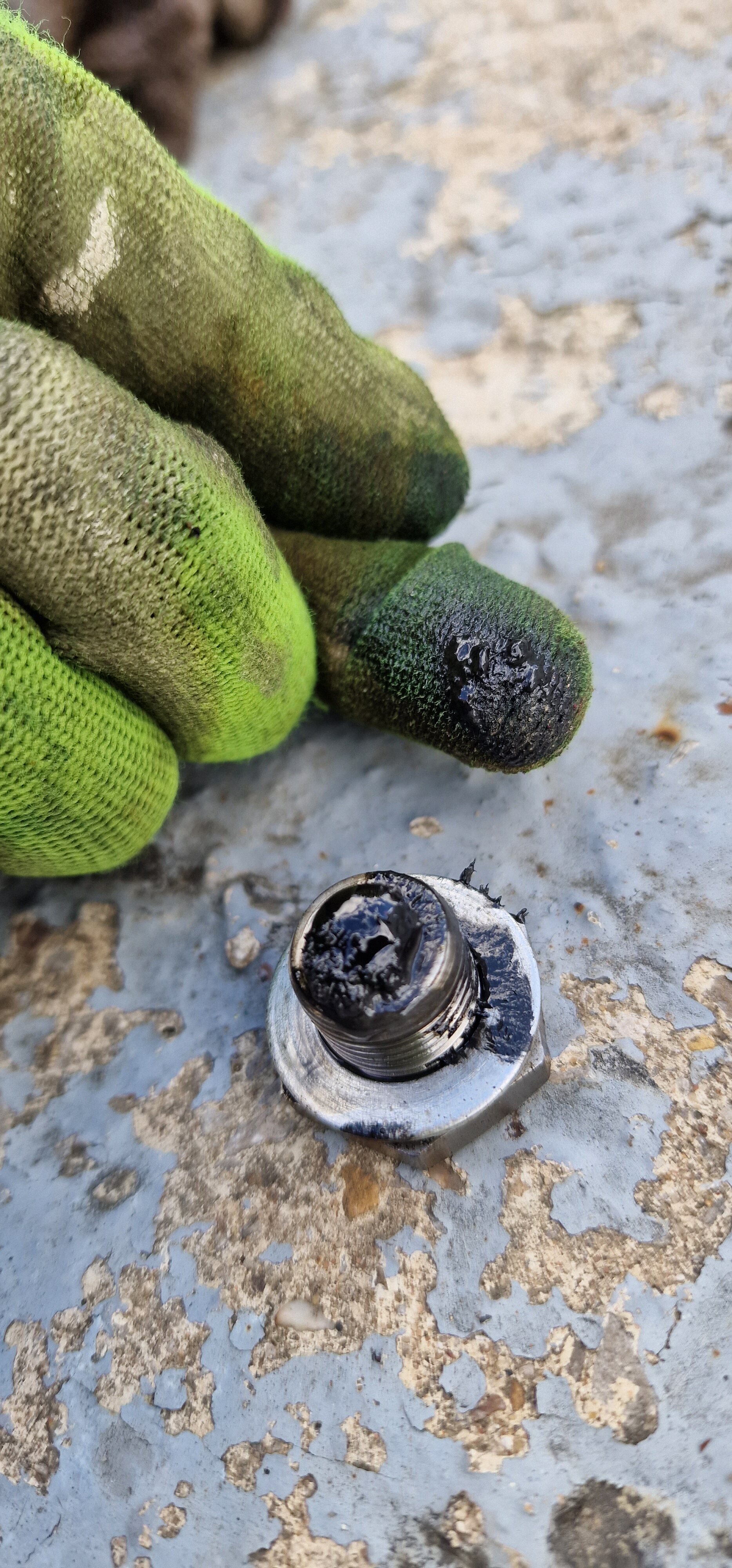

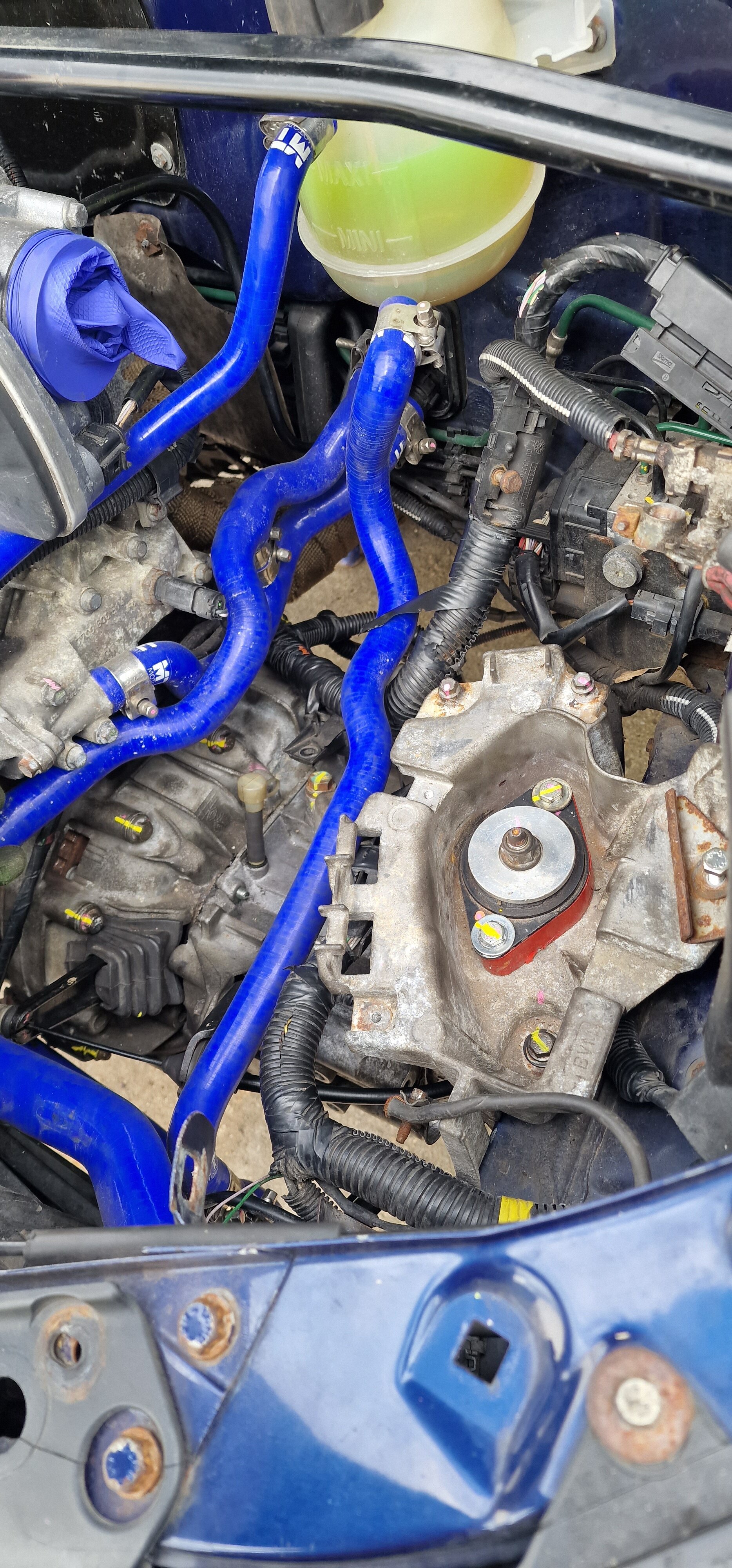

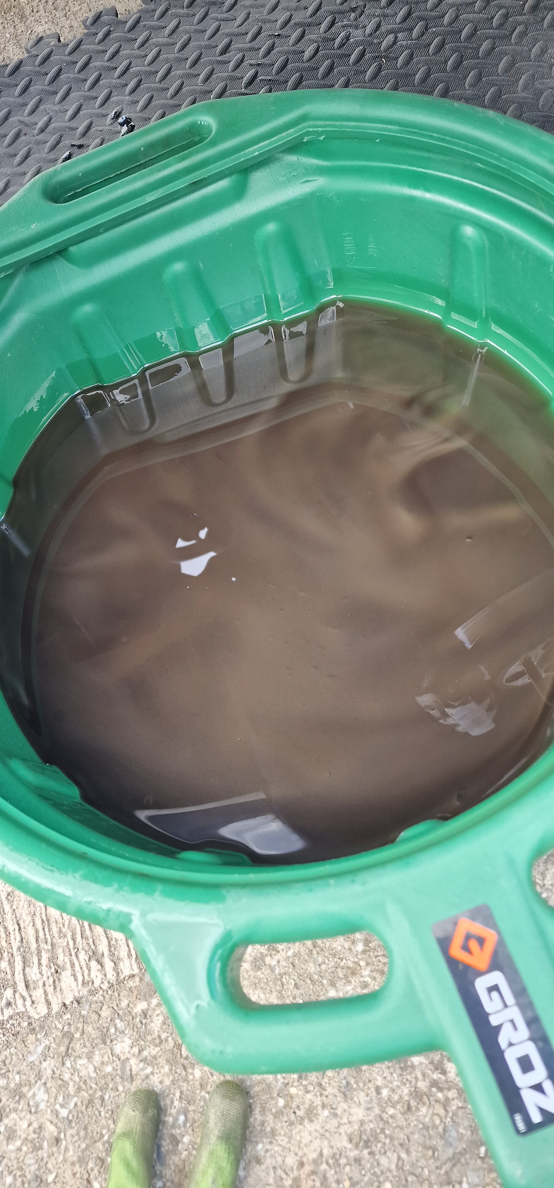

Whipped the box out after work tonight

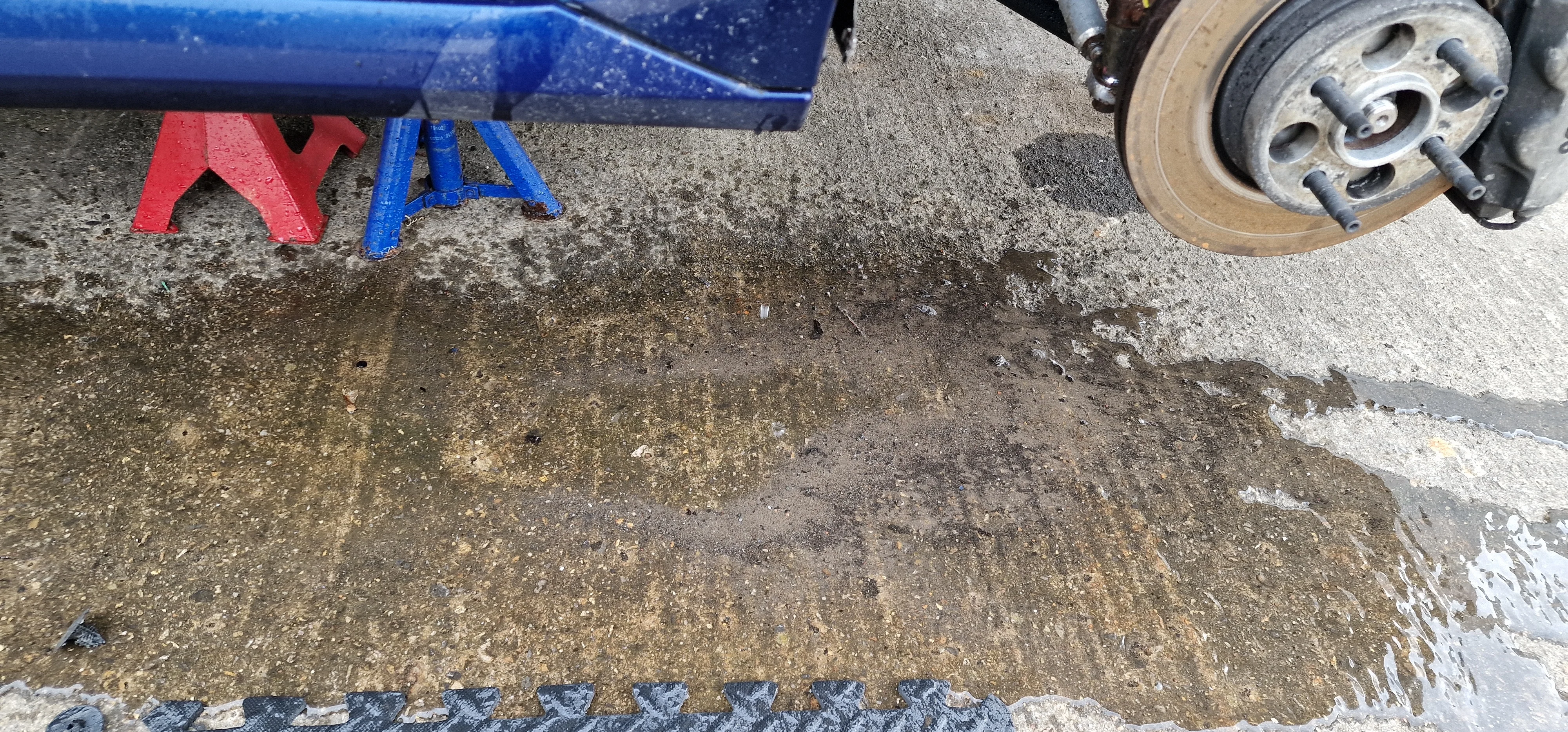

Box oil that came out was a bit black/brown and the plug had a bit of fuzz but nothing ridiculous. The inside of the box is spotless so the oil has deffo done it job of cleaning it
Took the 2118s off too, gonna get em powdercoated this week so shoved on a pair of turinis. I'm not 100% sold on them but I said that exact same thing about the 2118🤣
Gonna take the box to my mate next week and get him to have a gander. It shouldn't need bearings as it sounds perfect. Just a selector bush and seal I reckon. Took me about 2 hours to get it all out, the rest of it I was stood yacking and then had to have a 30 min break because laying on my back makes me feel sick for some weird reason🤣

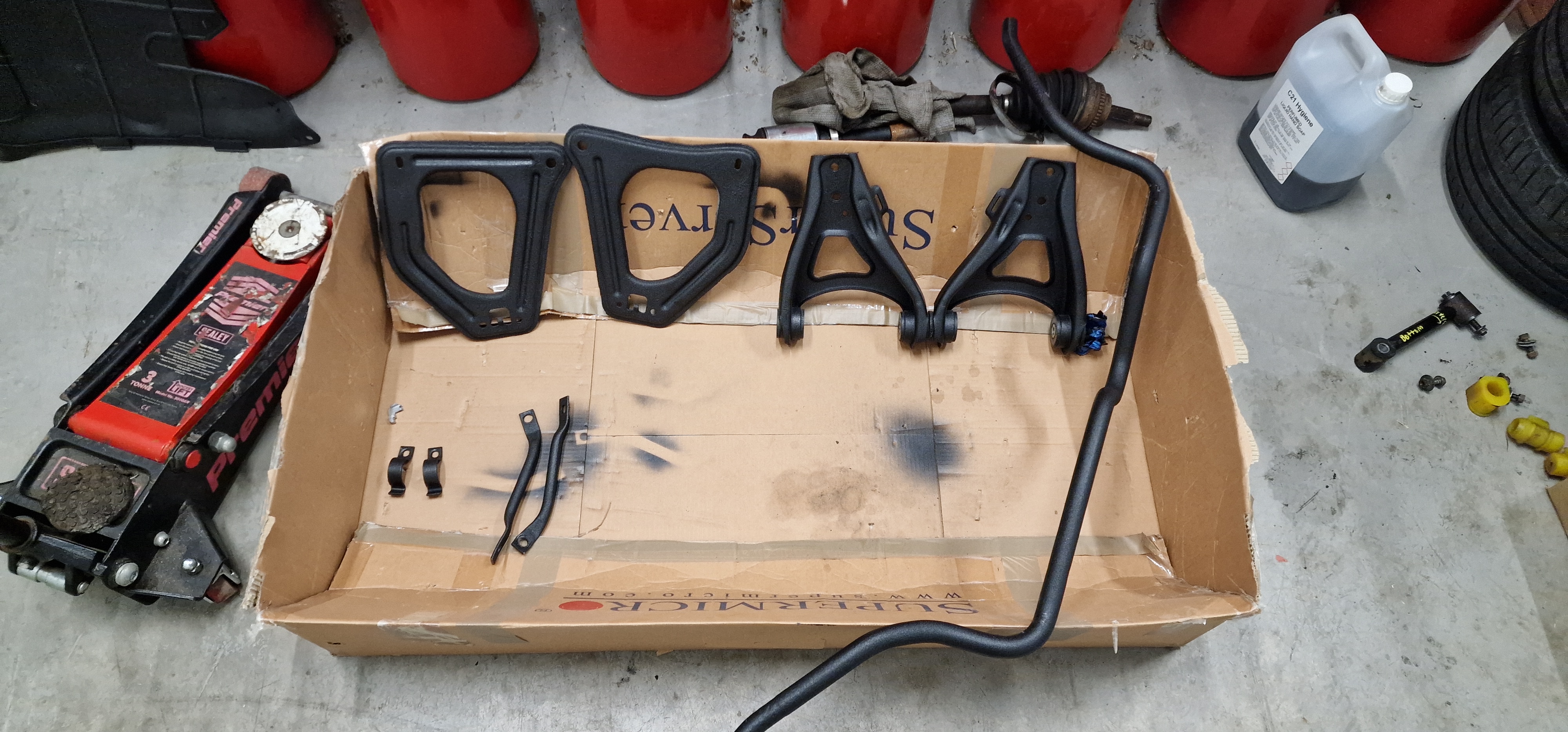

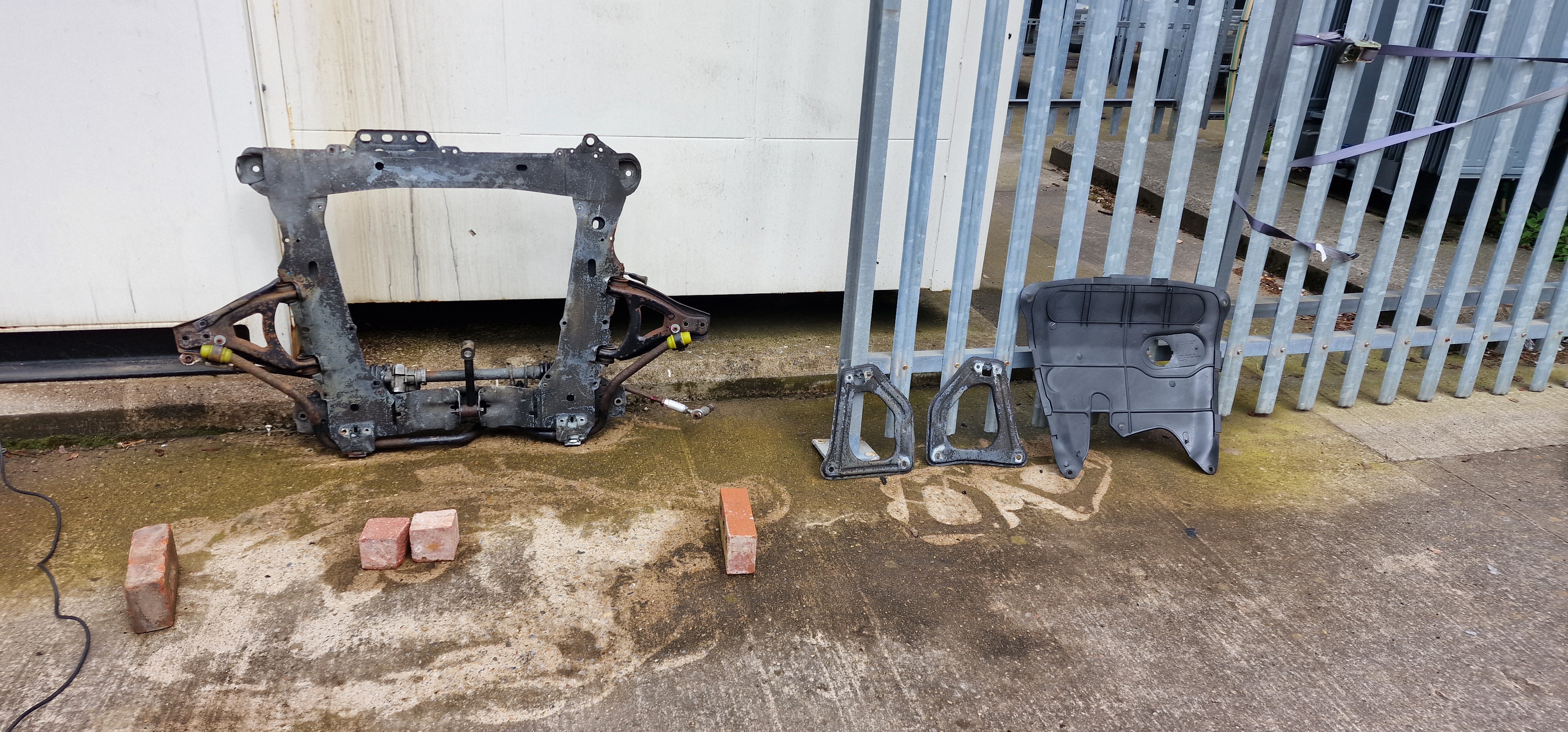

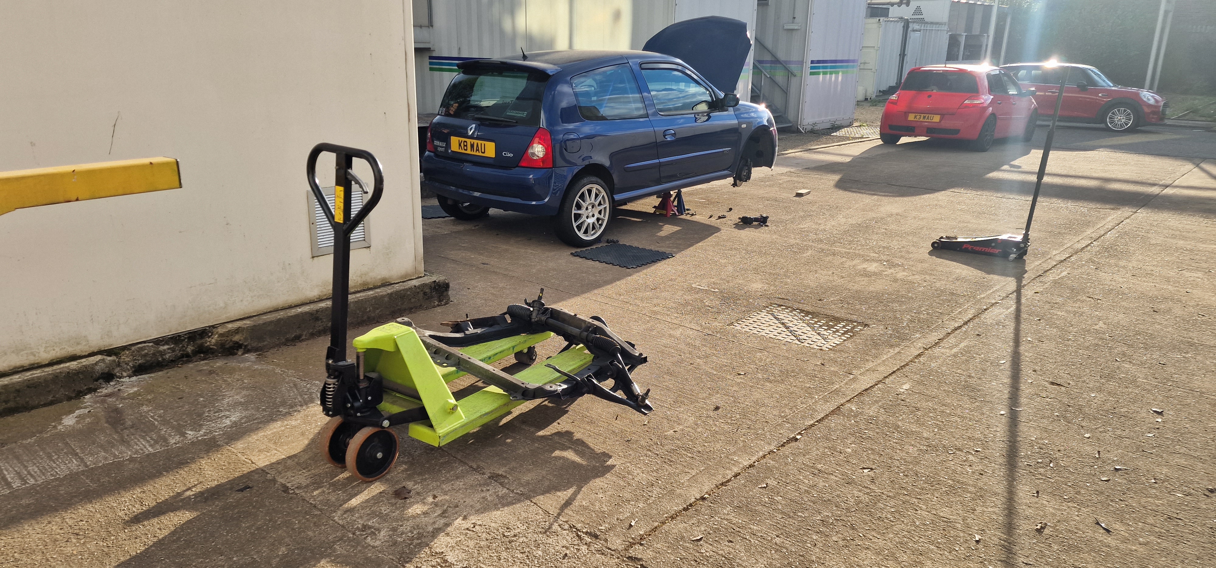

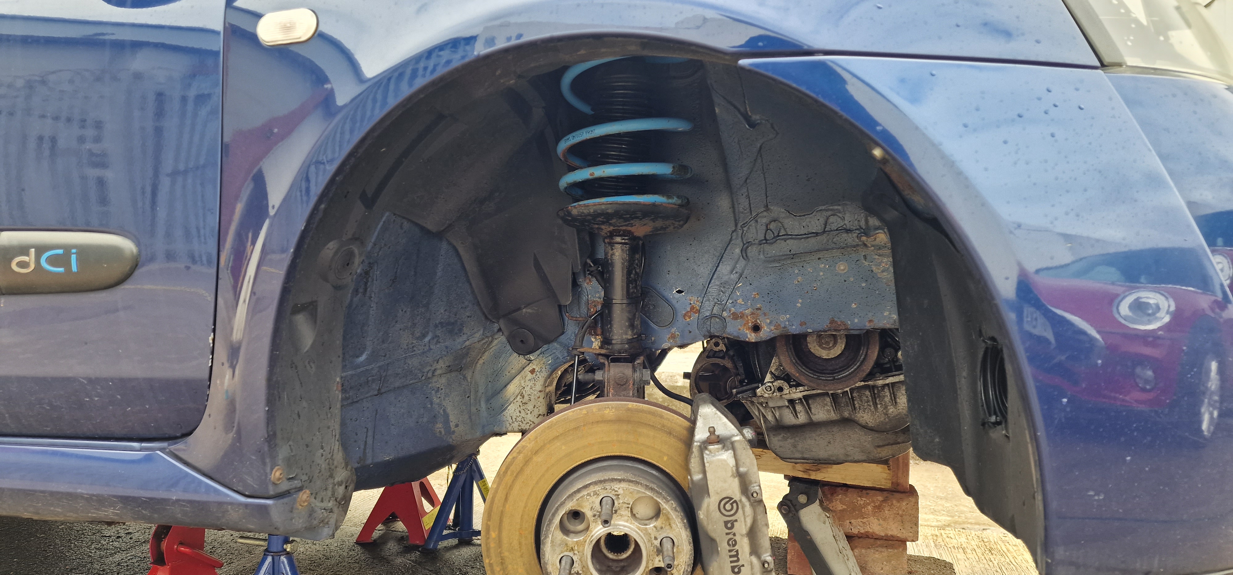

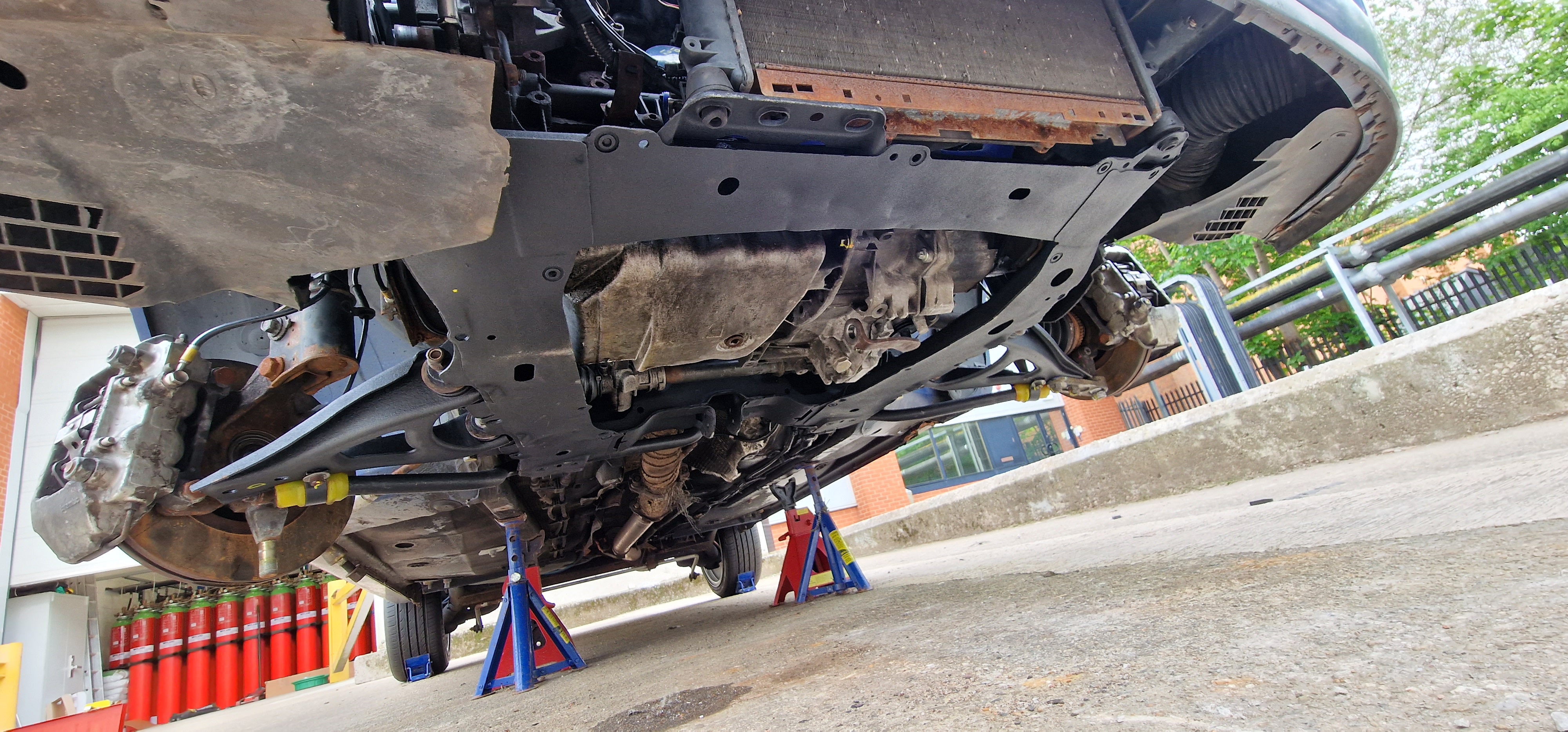

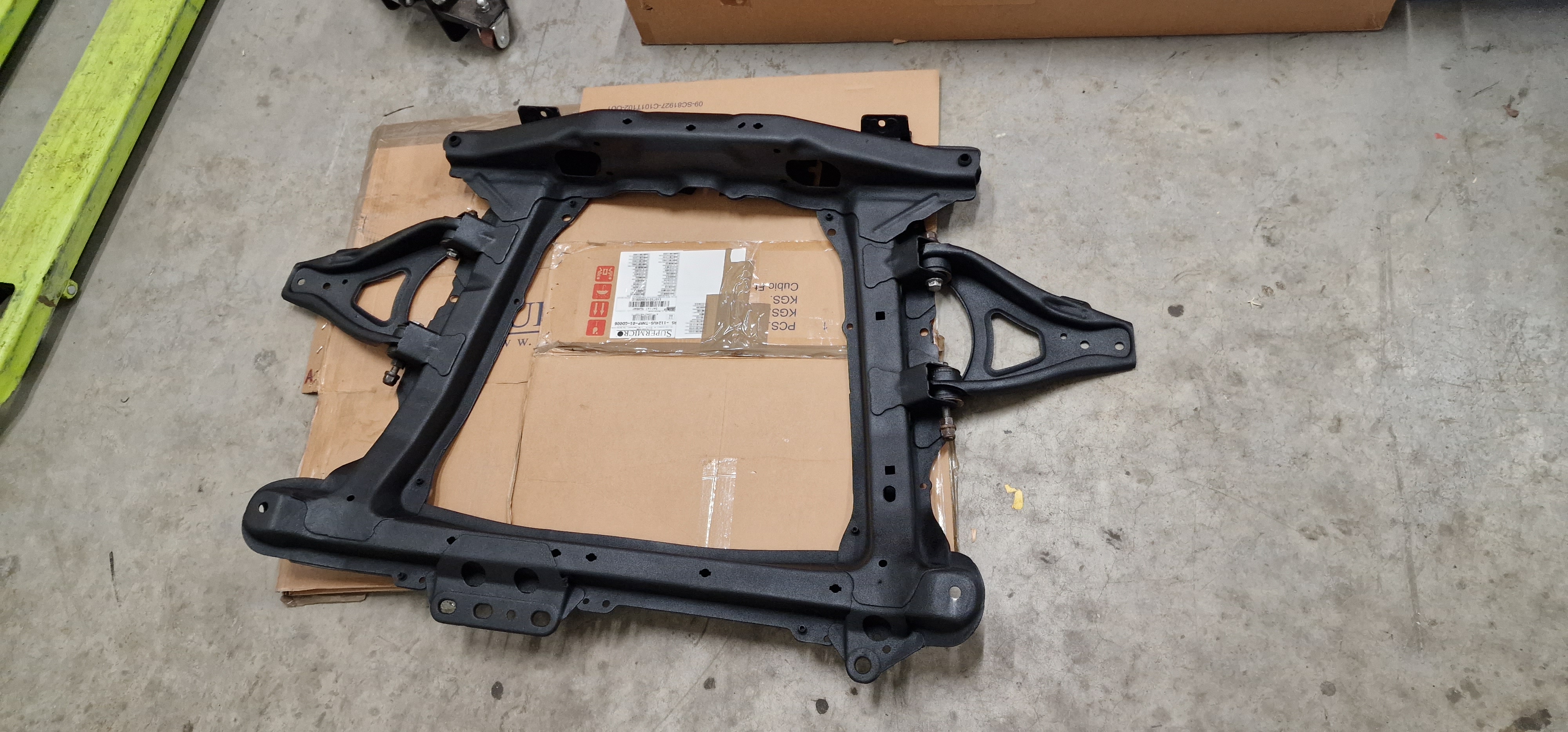

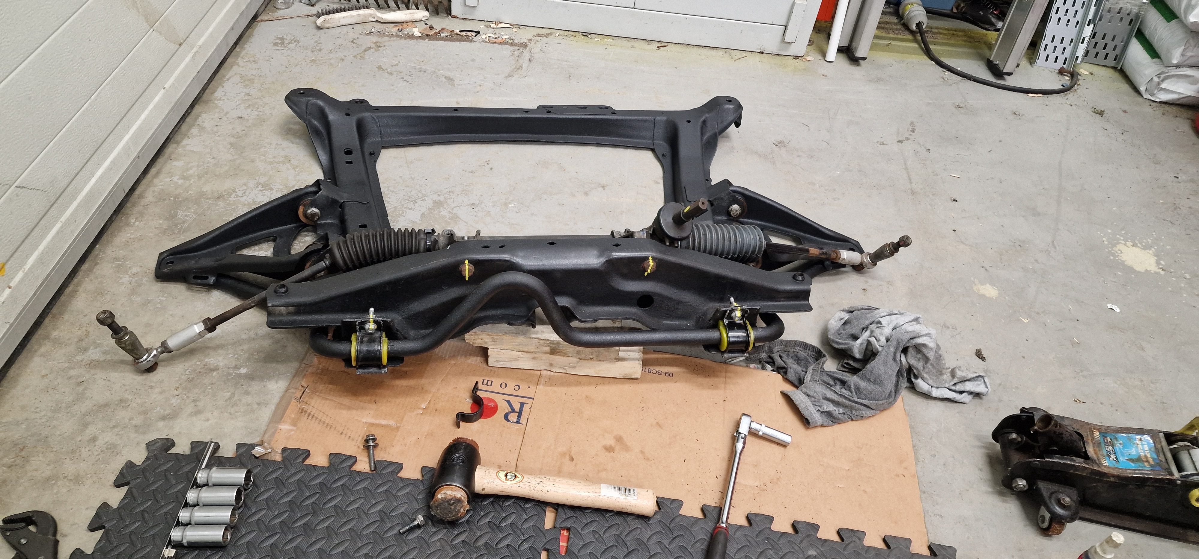

So whilst the box was away I decided to give a lot of things a good clean down. Jetwashed the subframe, support plates and my undertray. They were all coated and caked in a nice thick layer of s**t and gearbox oil despite only doing a few thousand miles
Give under the arches a spray down to get rid of the majority of crap. At some point I want to paint everything at some point

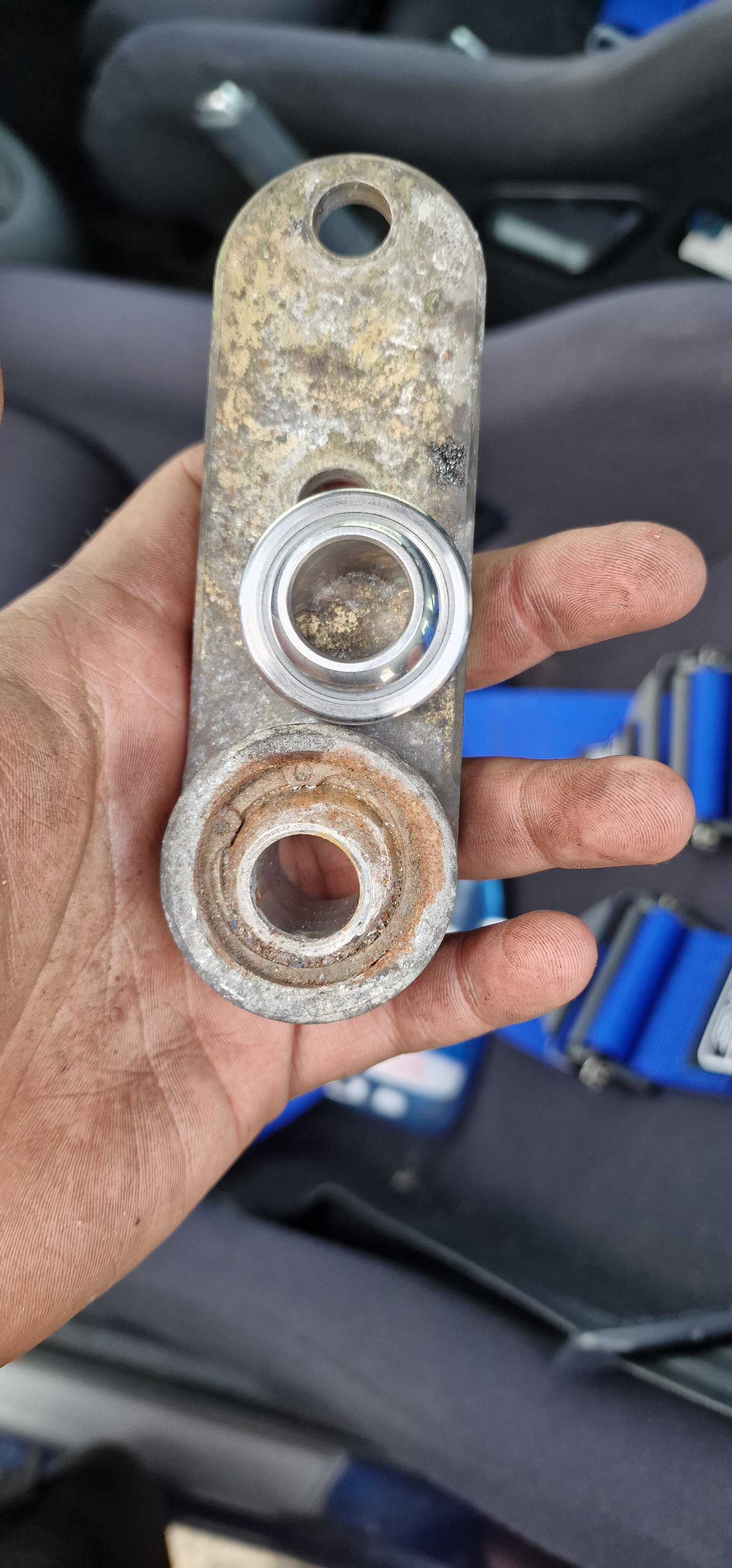

Replaced the bearings for the roll centre ball joint as the others were pretty crusty

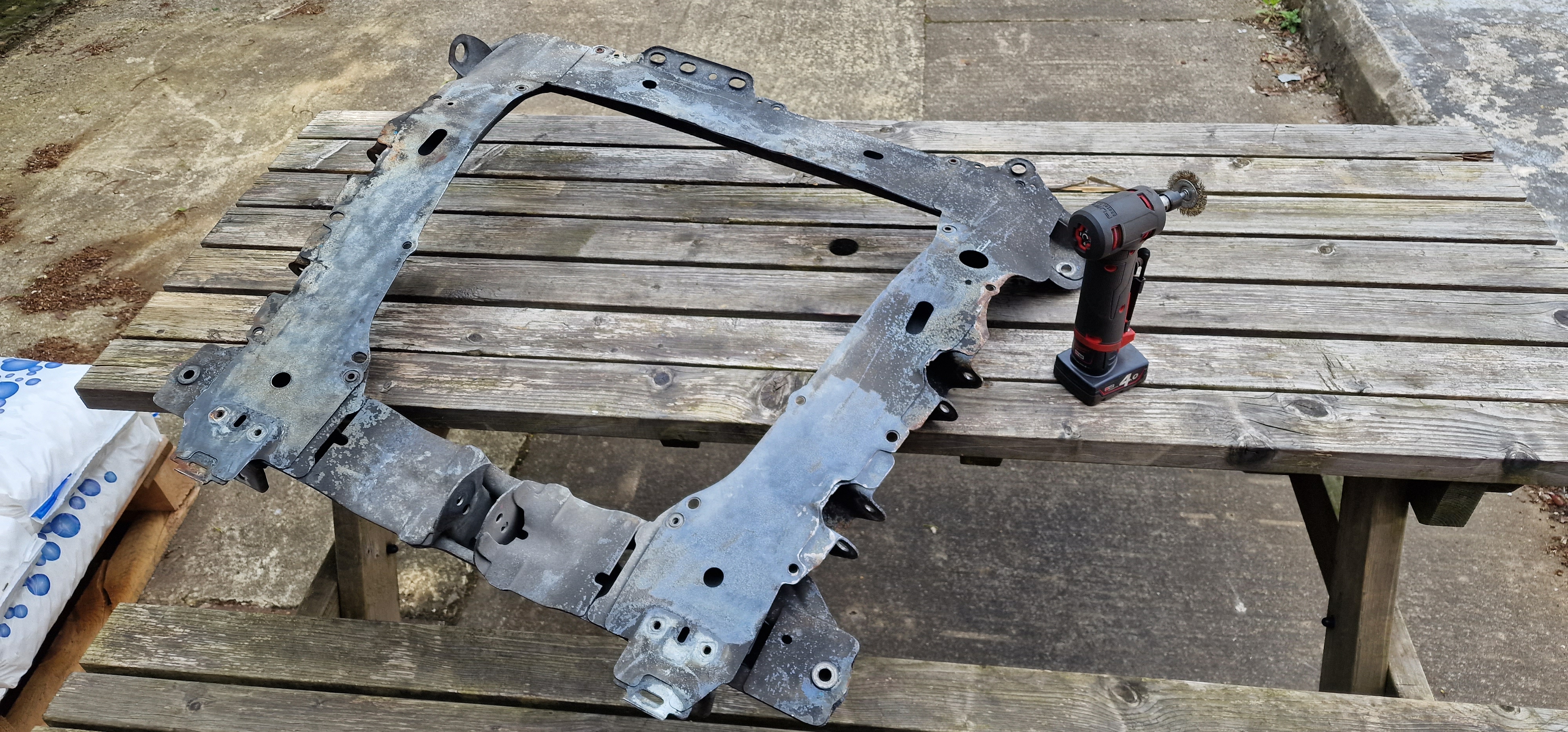

Then I looked at everything... Whilst it was off the car and thought "should I paint it..."
So this is where I started going a bit mental with the die grinder🤣
I didn't go balls to the wall but enough to smarten everything up. I thought about getting everything blasted and dipped then powdercoated but it's a scabby Clio I use on track. I just painted everything with bedliner instead

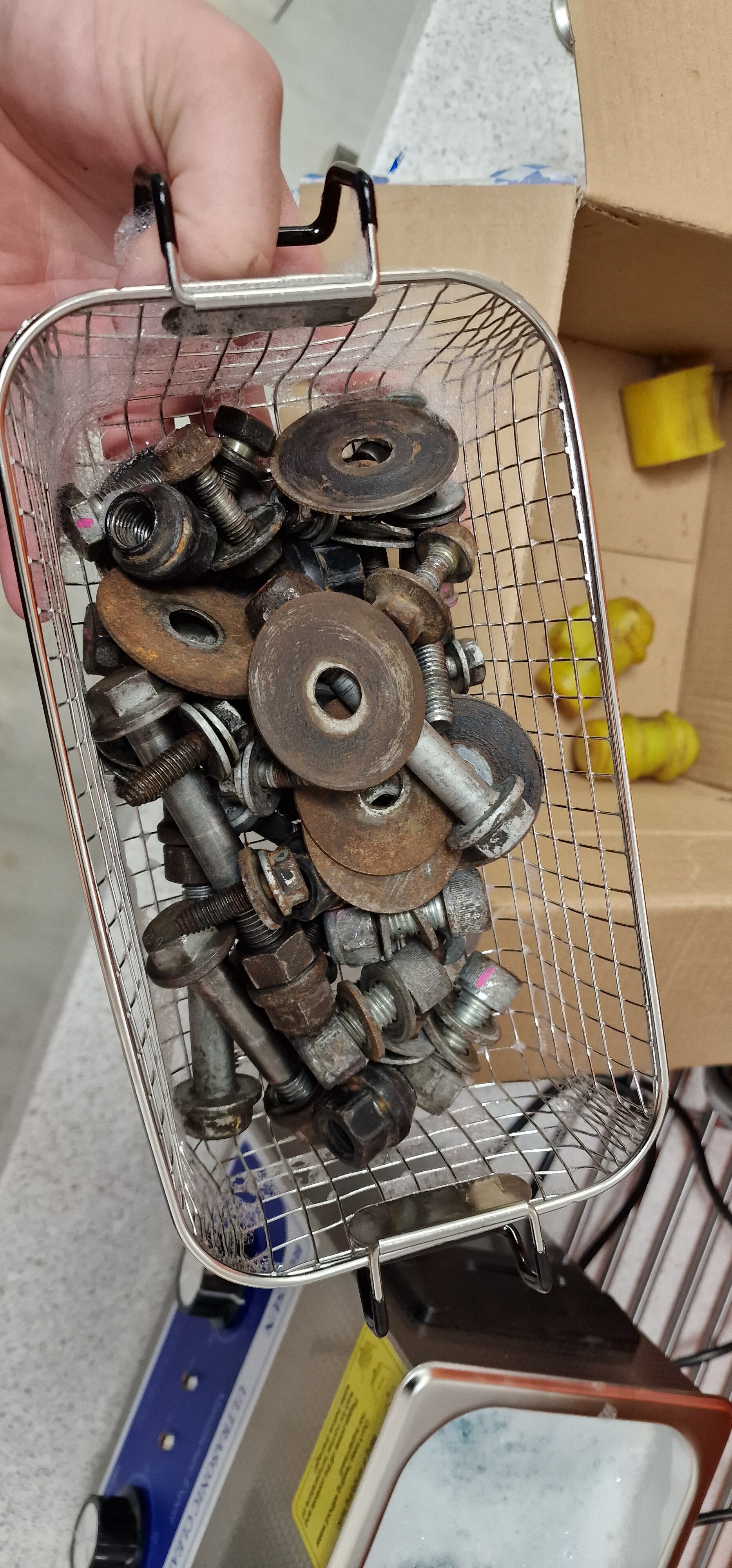

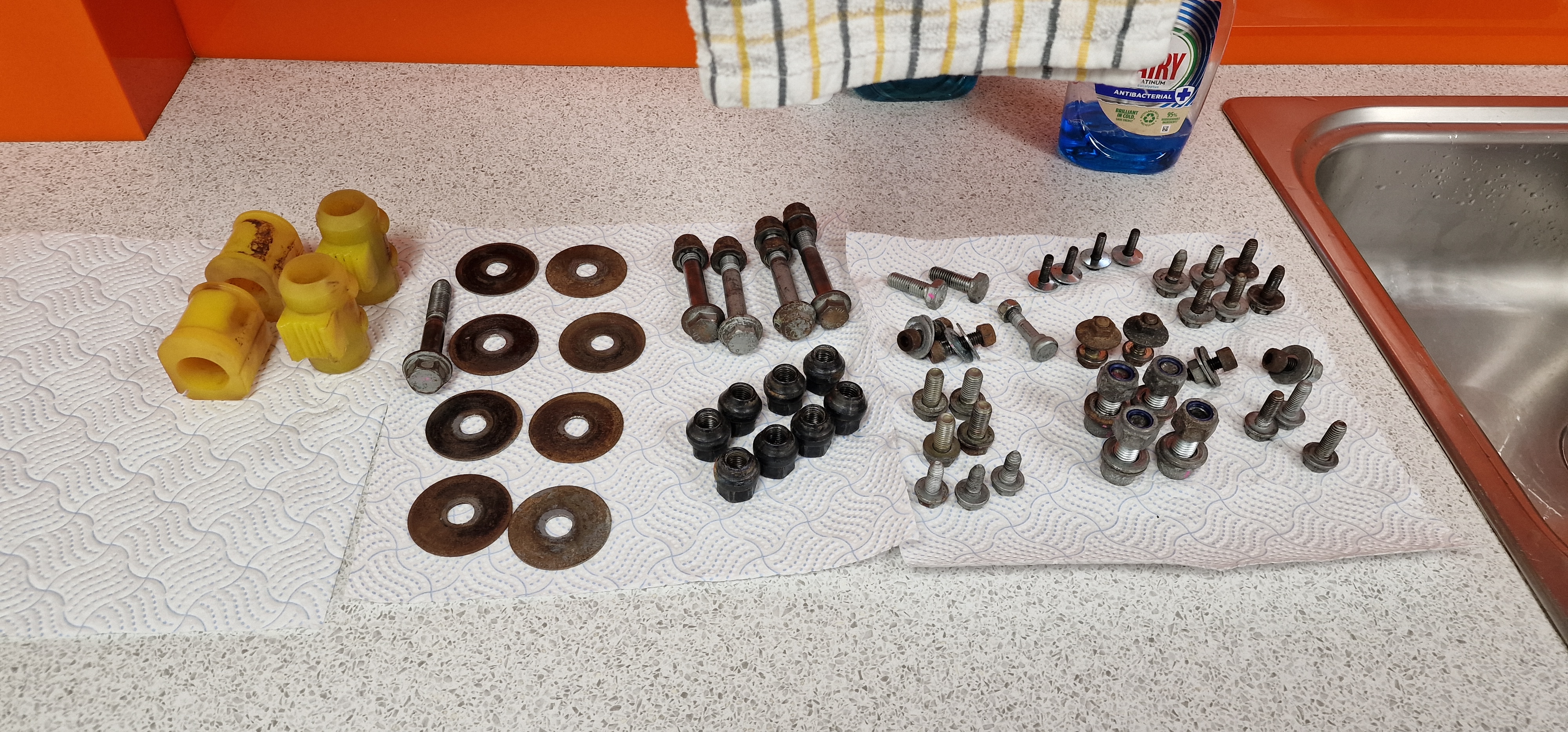

I bought a 3l heated ultrasonic cleaner this week, all the bolts were covered in grease and detritus so they got launched through it
They came up pretty good, all nice and degreased. Gave them all a wire wheel on the die grinder to get some of the crust and rust off
Subframe and lower arms back together. I'm still waiting on inner arb brackets to put the roll bar back on. Hopefully they arrive tomorrow

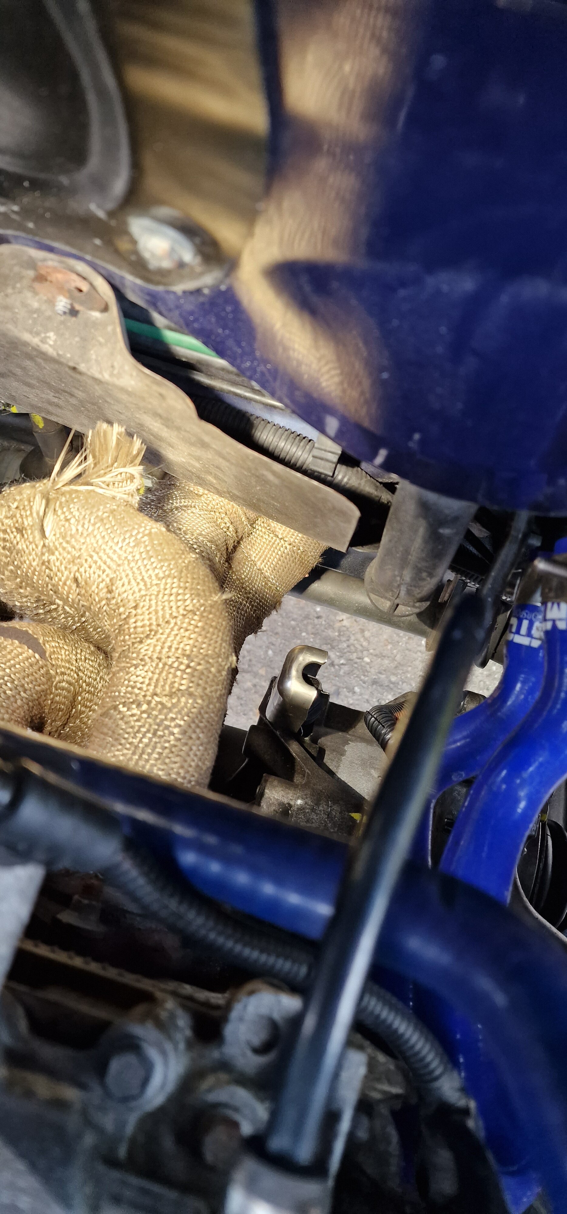

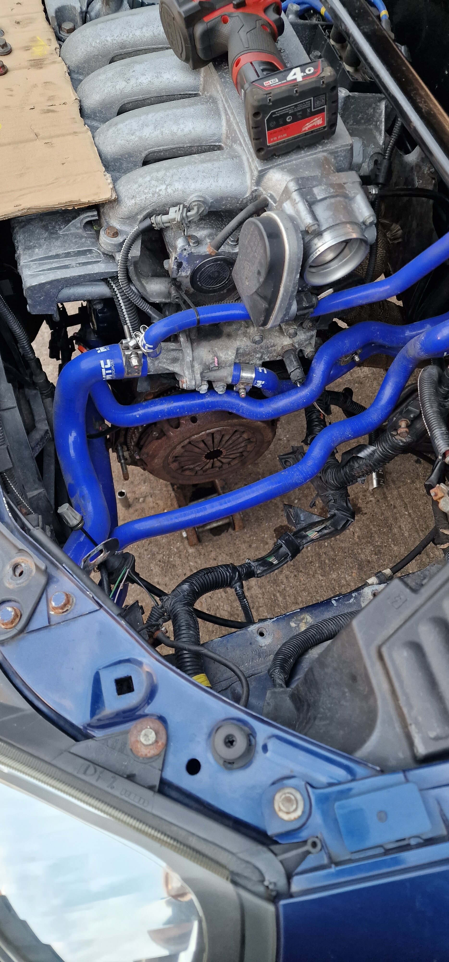

Shoved the box back in after work today. Got everything back in on the top side apart from the Speedo drive. I did end up buying one of the PMS Speedo drive bungs but I've no idea how the f**k it fits🤣
Yellow paint marker this time round

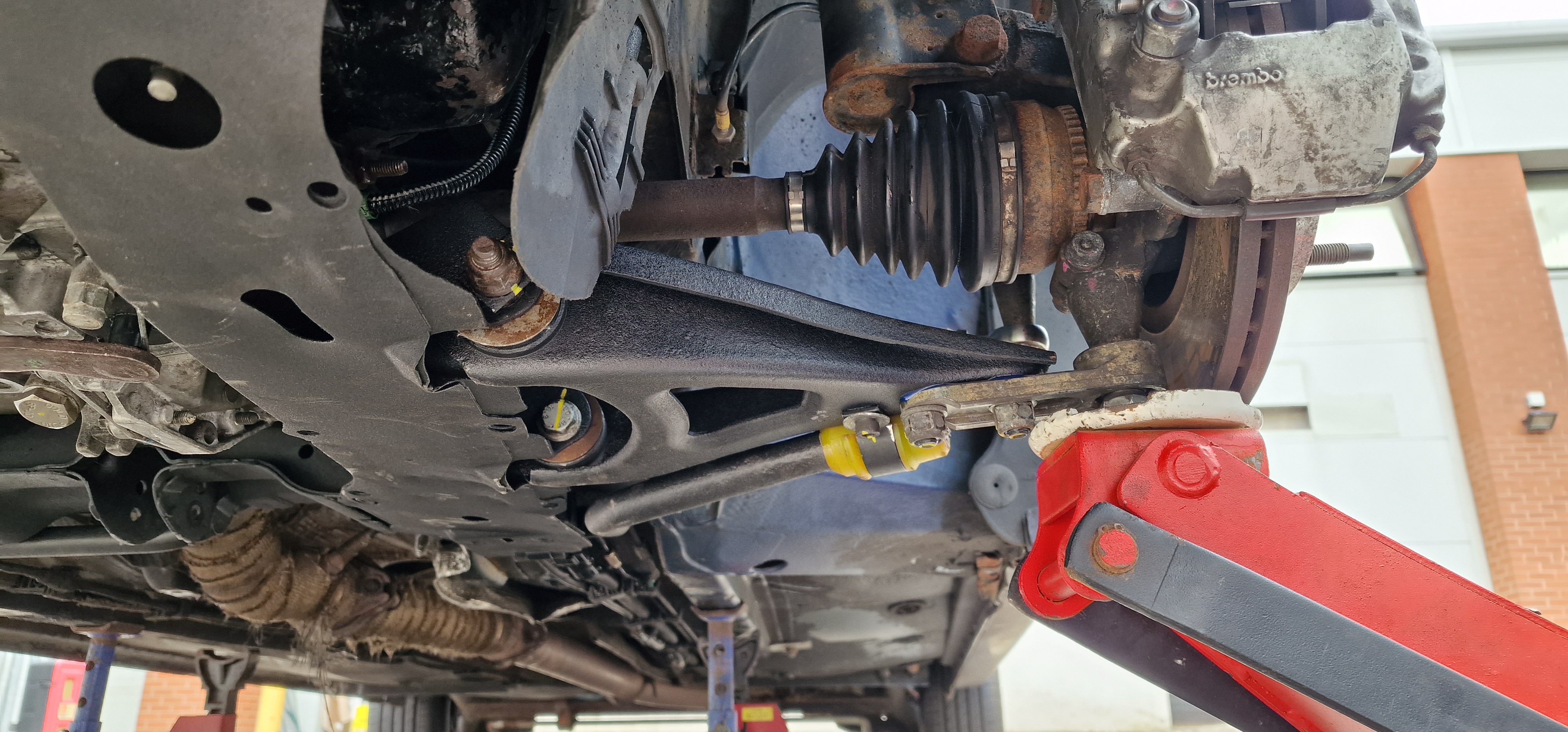

Started building the subframe back up putting the rack on. I swapped all the nuts and bolts so that everything matches now
Subframe back on. Raided the Renault parts bucket and swapped the front bolts so that they matched as well
Passenger side is all buttoned up bar torquing the track rod end bolt, jacked it up and torqued the wishbone bushes
Gave everything else a spanner check and a paint mark, it seems a perverse putting a paint line on everything but it makes it way easier to see if there's been any movement. Plus it's methodical and I can mark anything I've just tightened and I know it's tight
Speedo sensor back in, I don't wanna destroy anything by shoving the PMS bung in there
Gonna have to wait for a new drivers side shaft to materialise before doing the driver's side. Gonna try and get the shifter and the dogbone back on and leave it at the stage where I just need to put the driver's shaft in and button that side up. I started it up earlier and just used the clutch to make sure that there wasn't any funny business from the

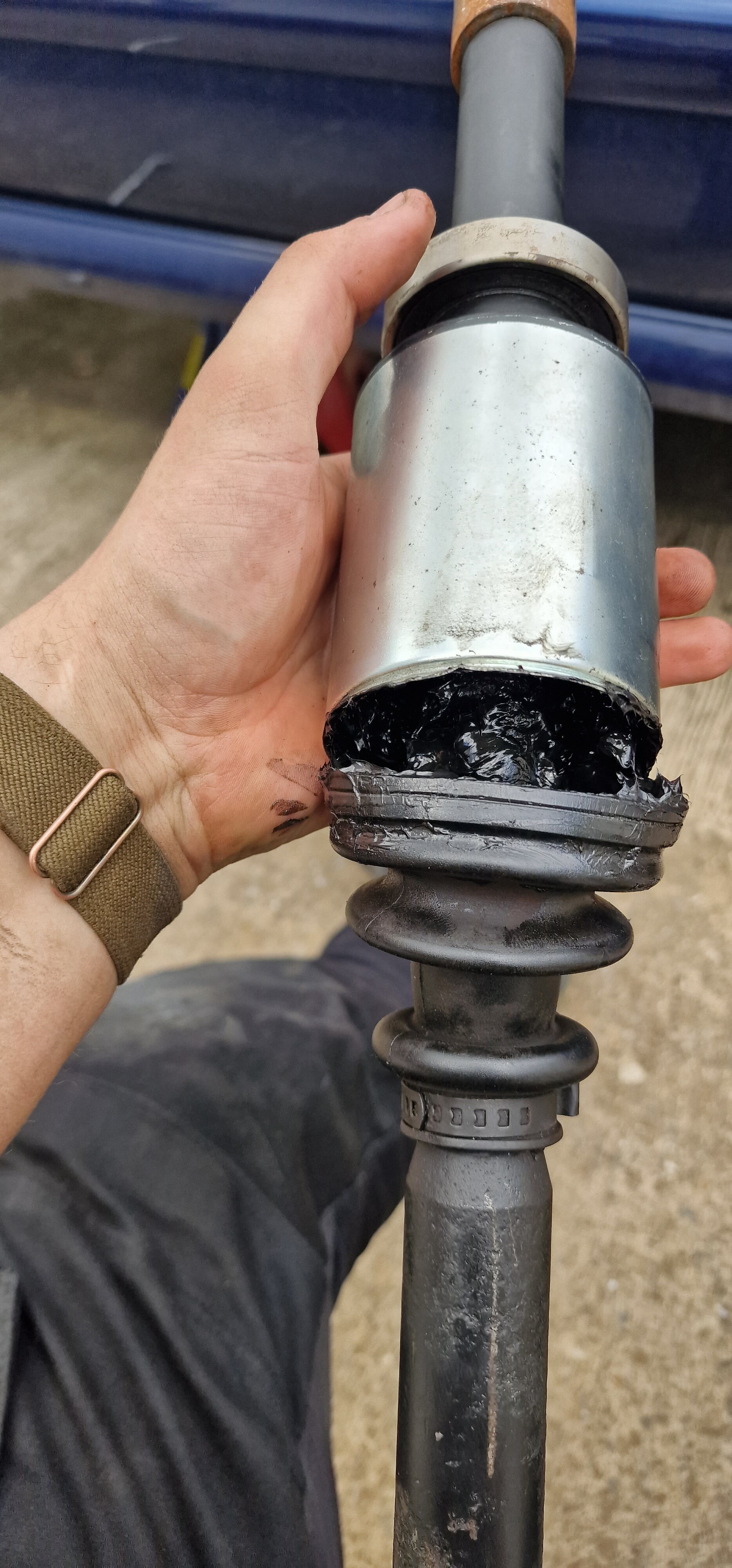

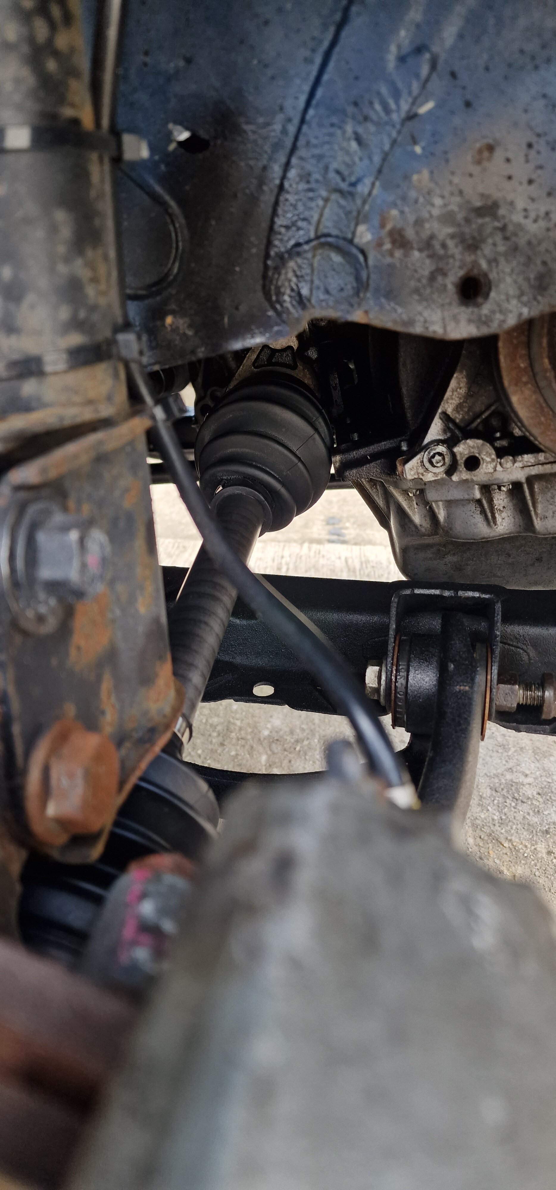

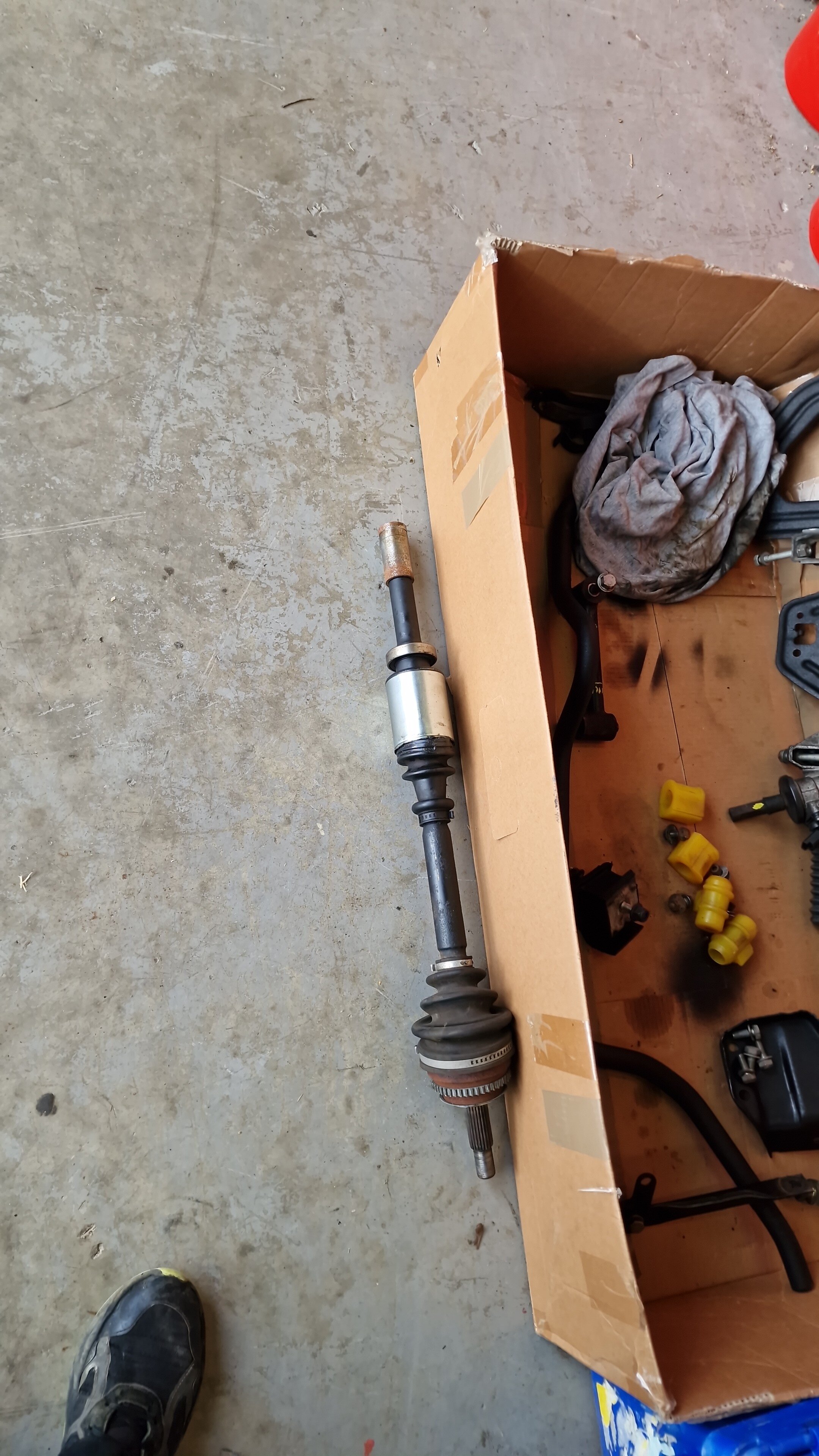

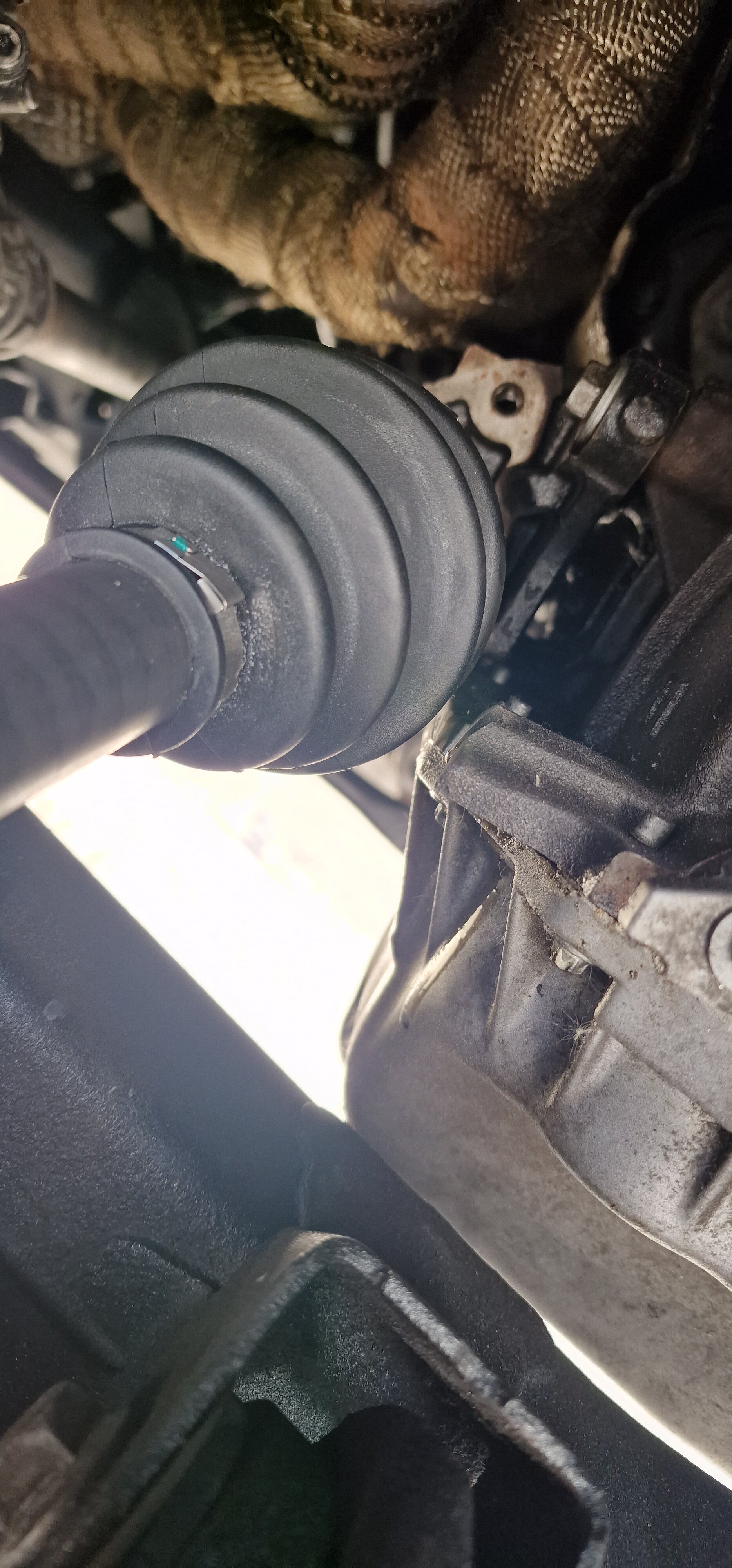

Bought a new Borg & Beck driveshaft. Used this brand of stuff before and tbh it seems decent enough quality. I gave it a good rag about and the inner boot stayed on so it's already beating the fuckin shaftec cunting thing and it was less than half the price!
Needed the block chopped a bit
Before
Chopped and rounded the edges with a flap disc
Got my shifter back on, drivers side all buttoned back together and everything paint pen'd up

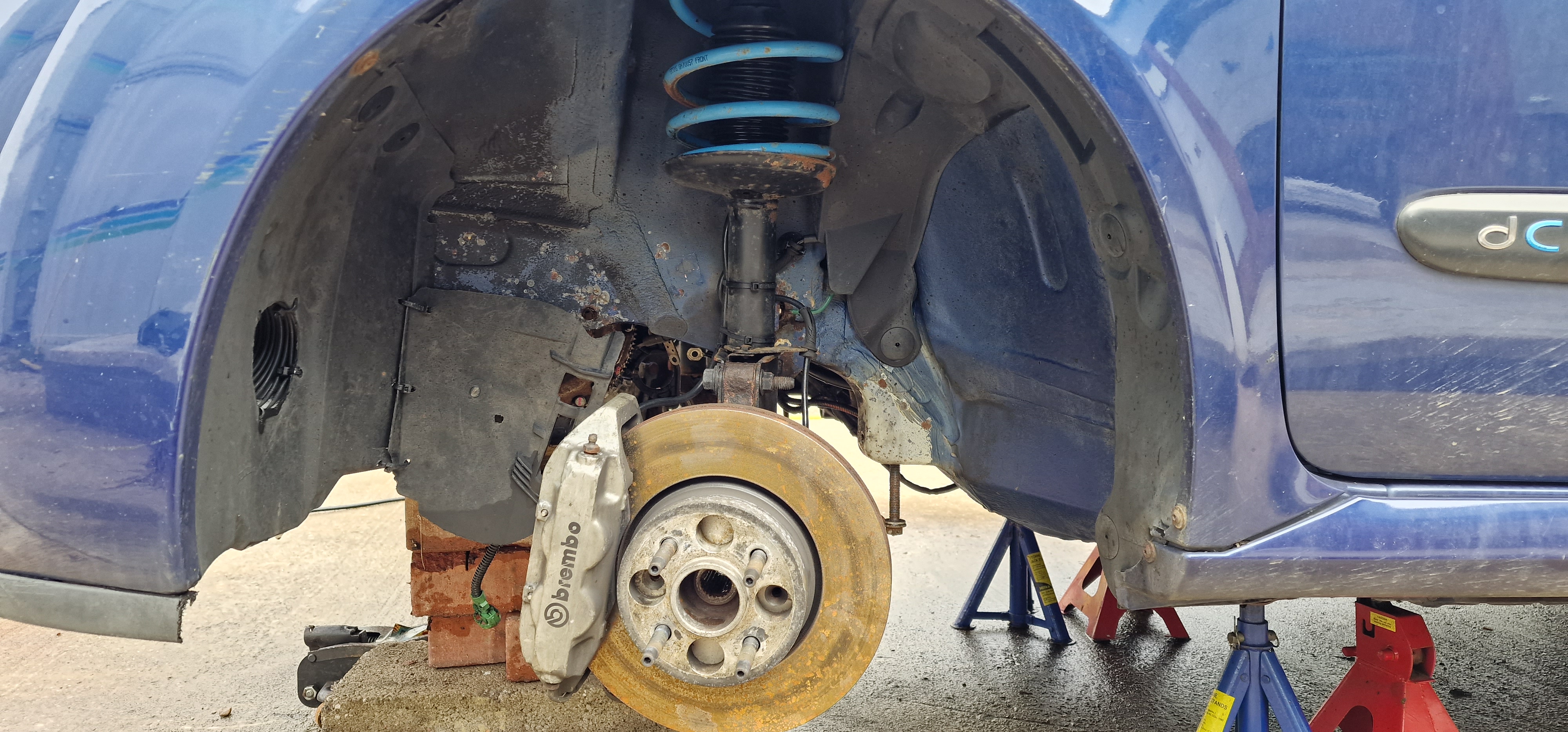

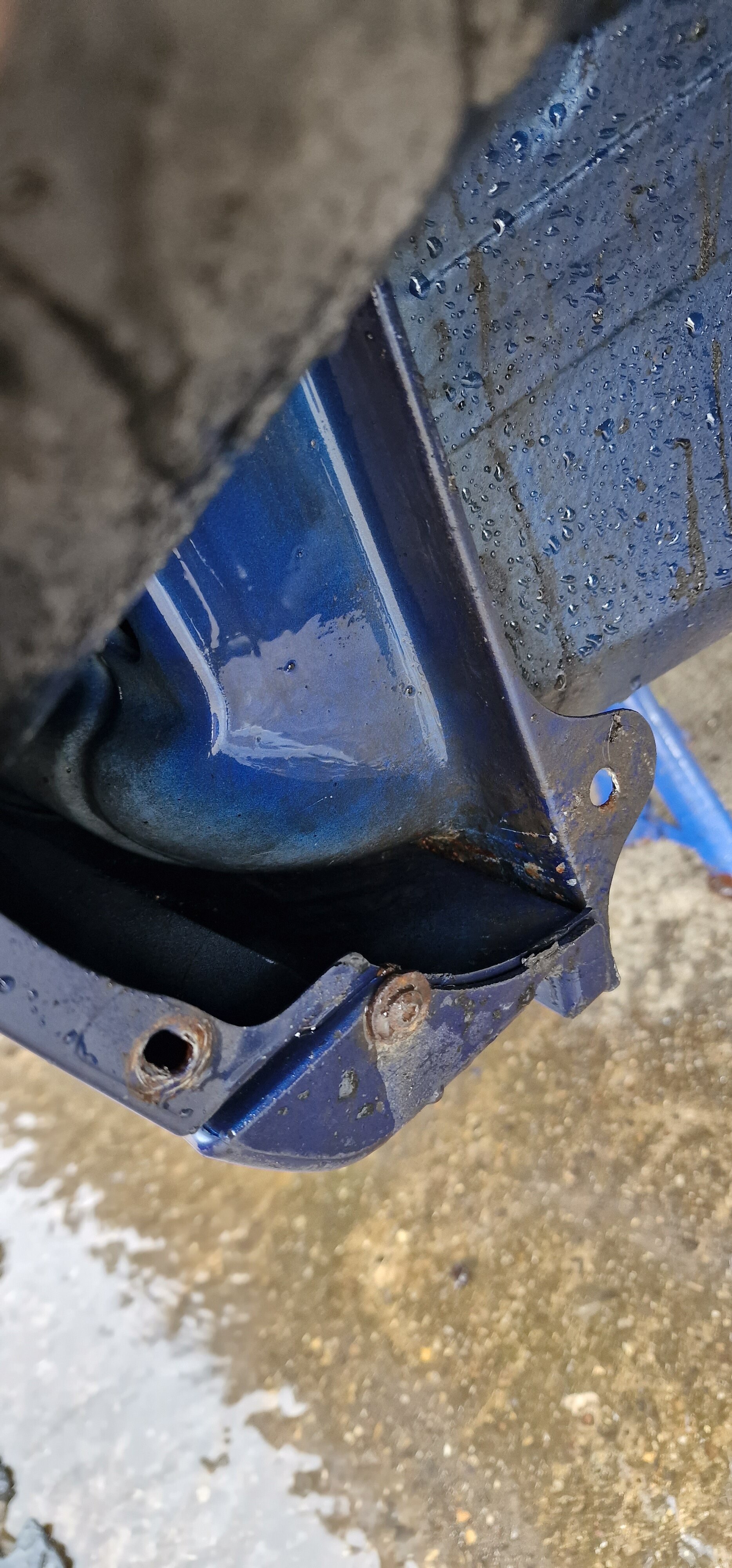

I've never had the arch liners out on this so was keen to see what was lurking. It wasn't as bad as I thought but there was definitely a few handfuls behind each arch liner
Gave it a good clean out, flushed out with some water, let it dry and gave everything a good spray with some Dynax

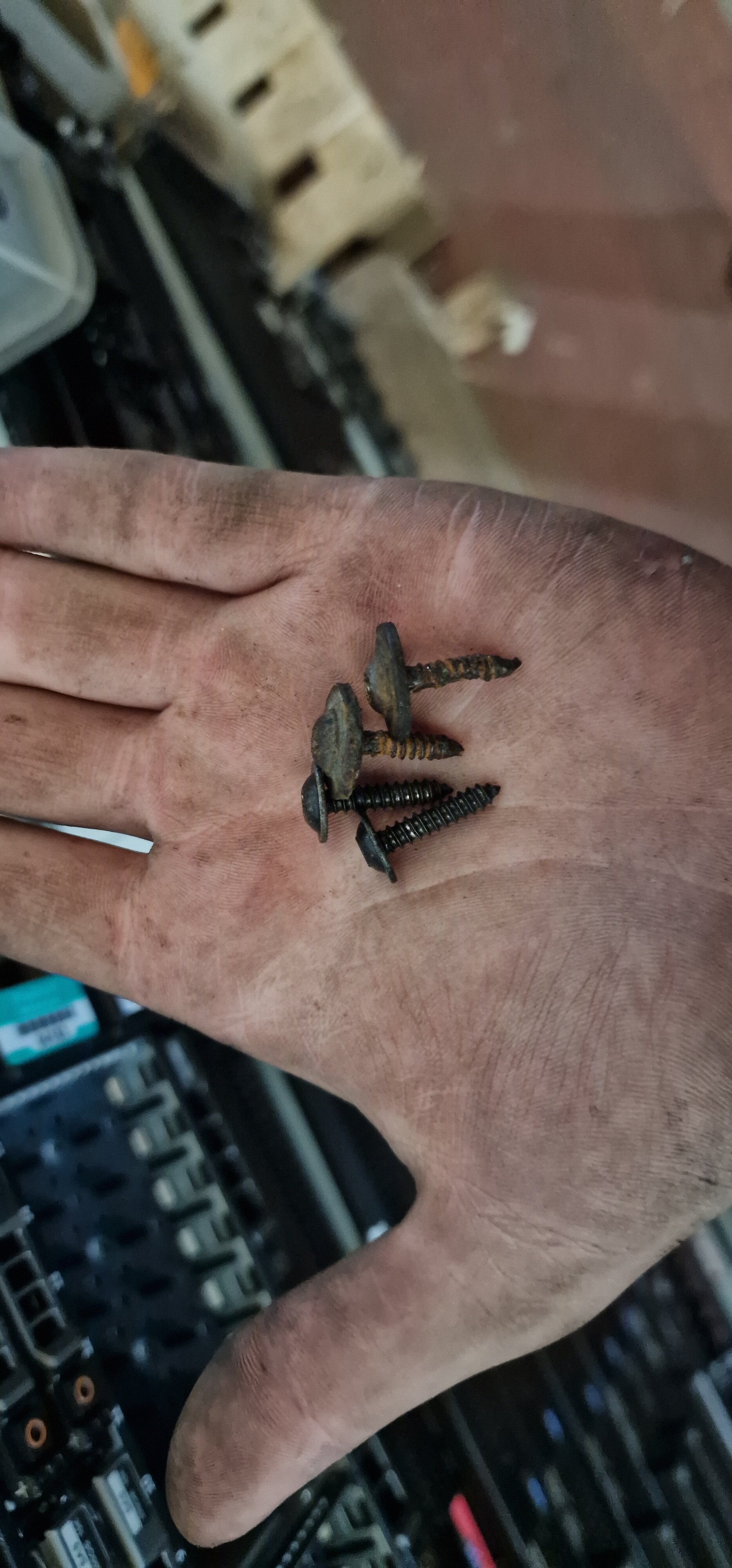

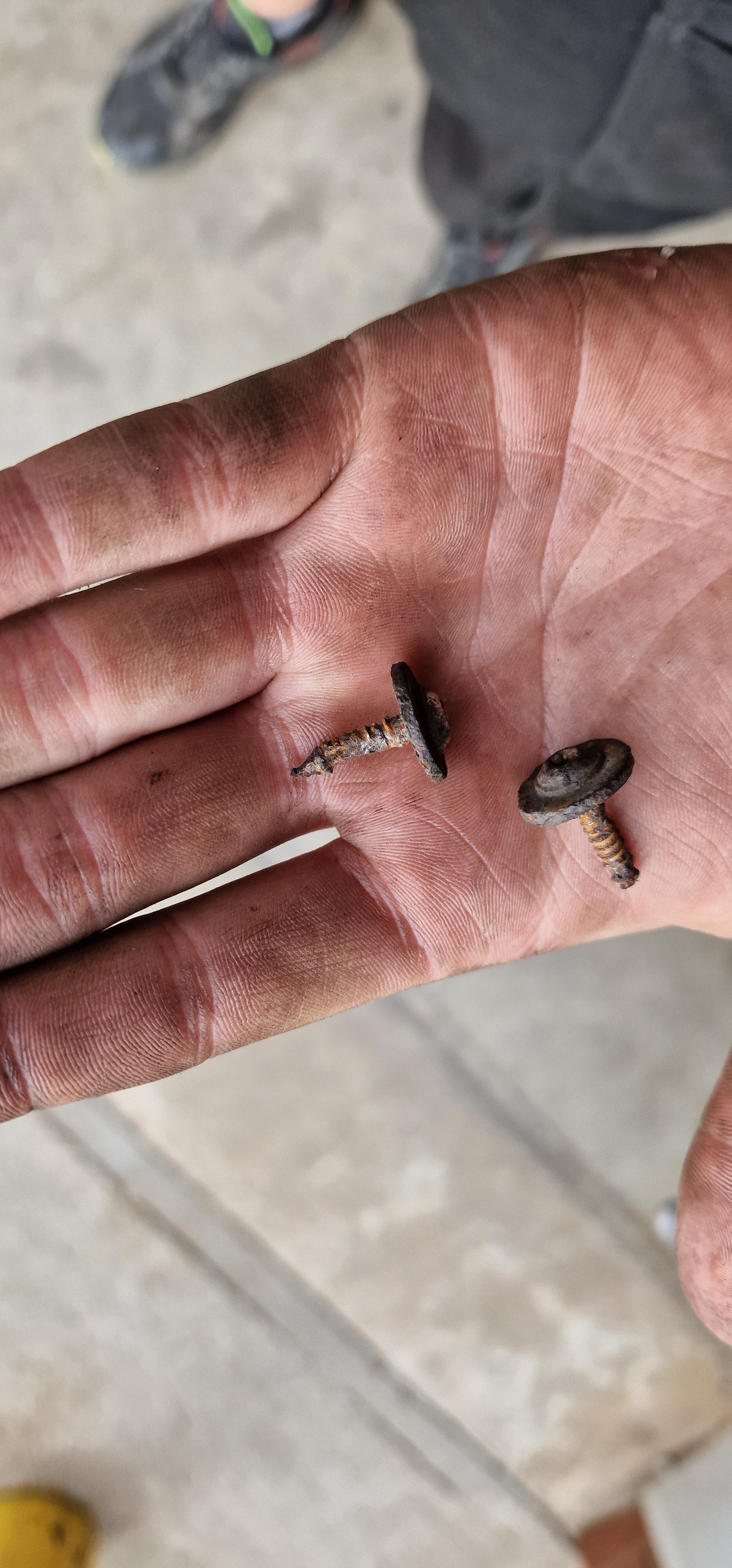

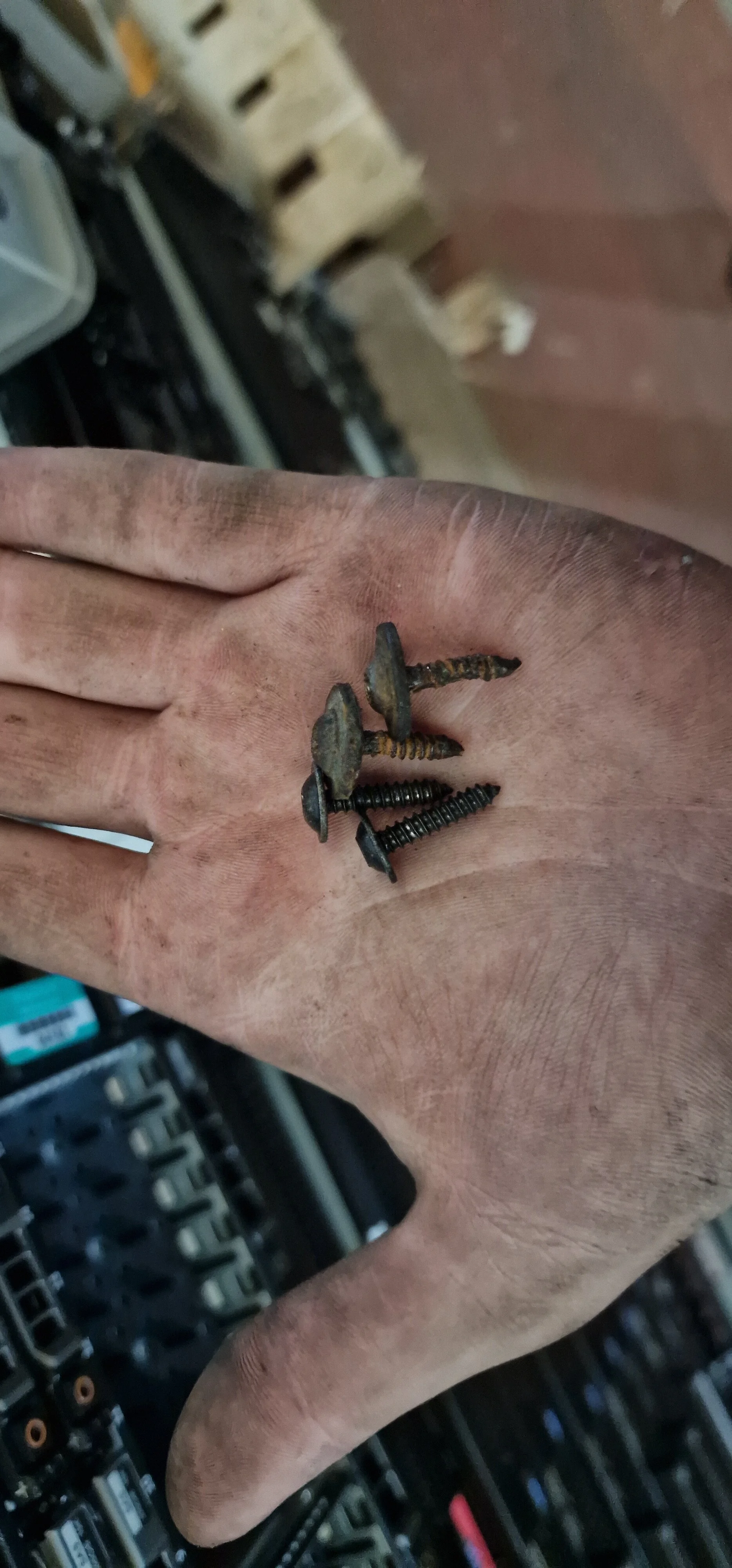

The screws were totally fucked

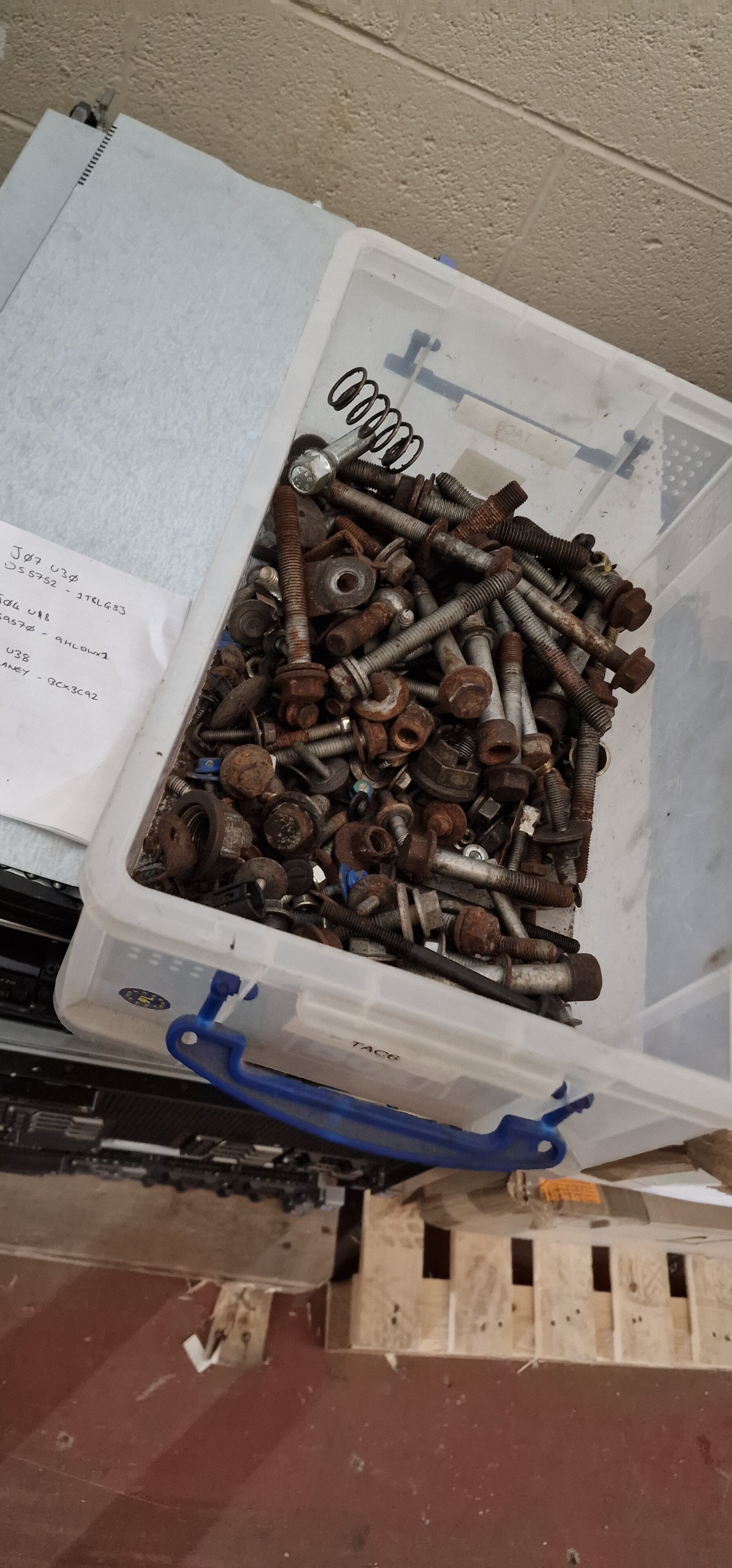

Thankfully I've broken at least 1 Renault at work so have a nice bucket of bolts for spares🤣
Picked out a nice clean set of interior screws

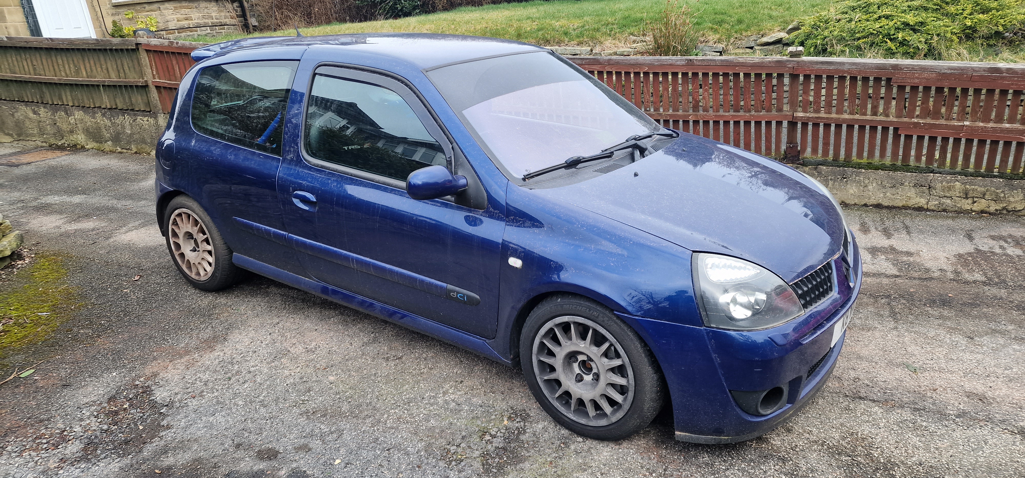

Gave it a quick rinse to remove some of the dust and pulled it out
The turinis look mint now it's back in the deck. Deffo need to get some better tyres, these are budgets (at best) and whilst they have lots of tread they're s**t🤣 Even at 30mph turning felt like the wheel was doing one thing and the tyres just wanted to continue doing their own thing
