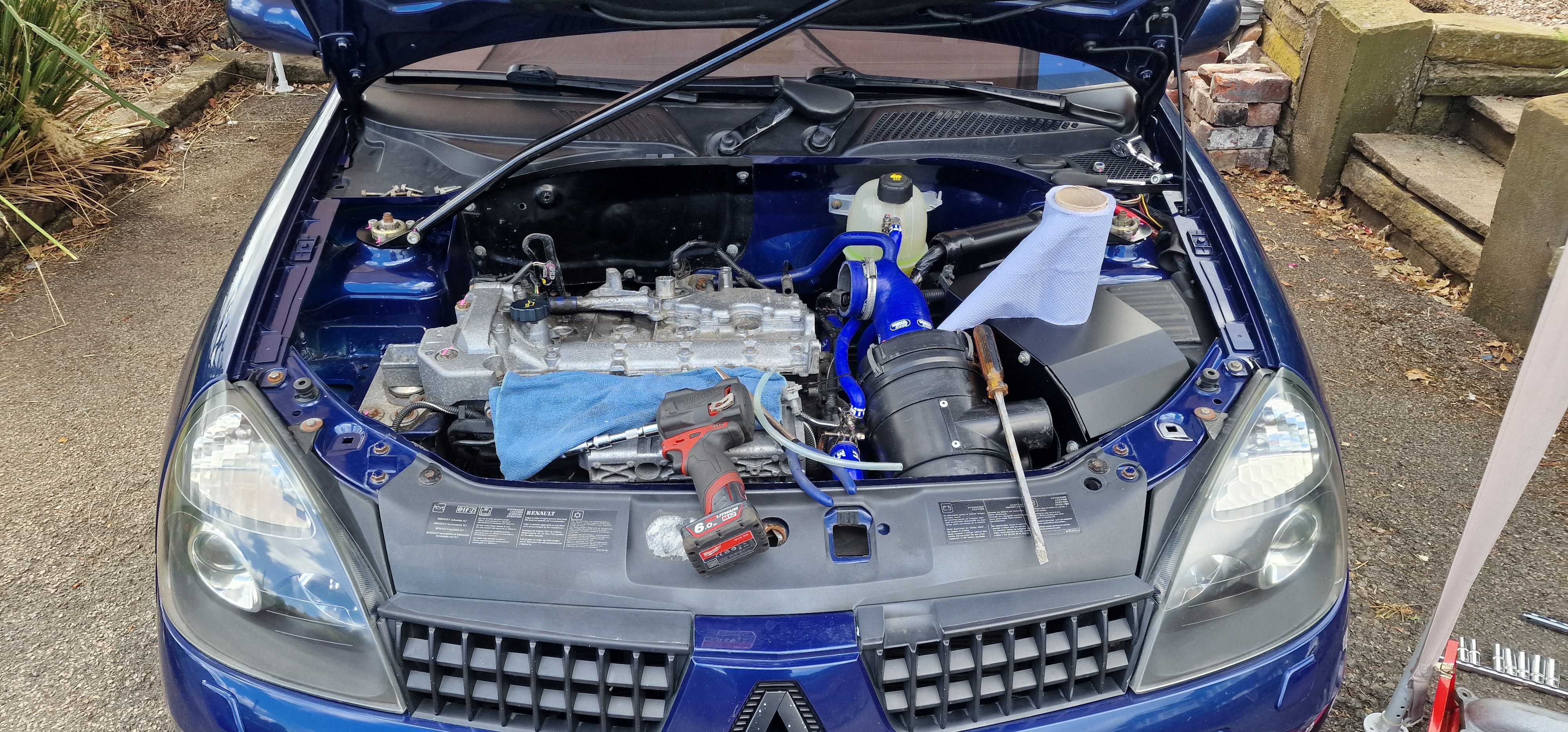

Stripped it back, only takes 2 mins to whip the inlet off but means moving the strut brace. Dried off all 4 plugs as they were all like this
Dried them all out, blew them out and then checked that all spark plugs were tight, plug #3 needed a slight nip but wasnt loose. Put it all back together and it started proper popping and banging like f**k like itd installed a pop and bang map. Actually sounded like gunshots
Stripped the inlet back off and realised I'd got the #3 HT lead on #4 plug like a dickhead. Swapped them back over and it fired up sound. Went for a drive and it was still spluttering slightly so gave it a good old Italian tune up🤣

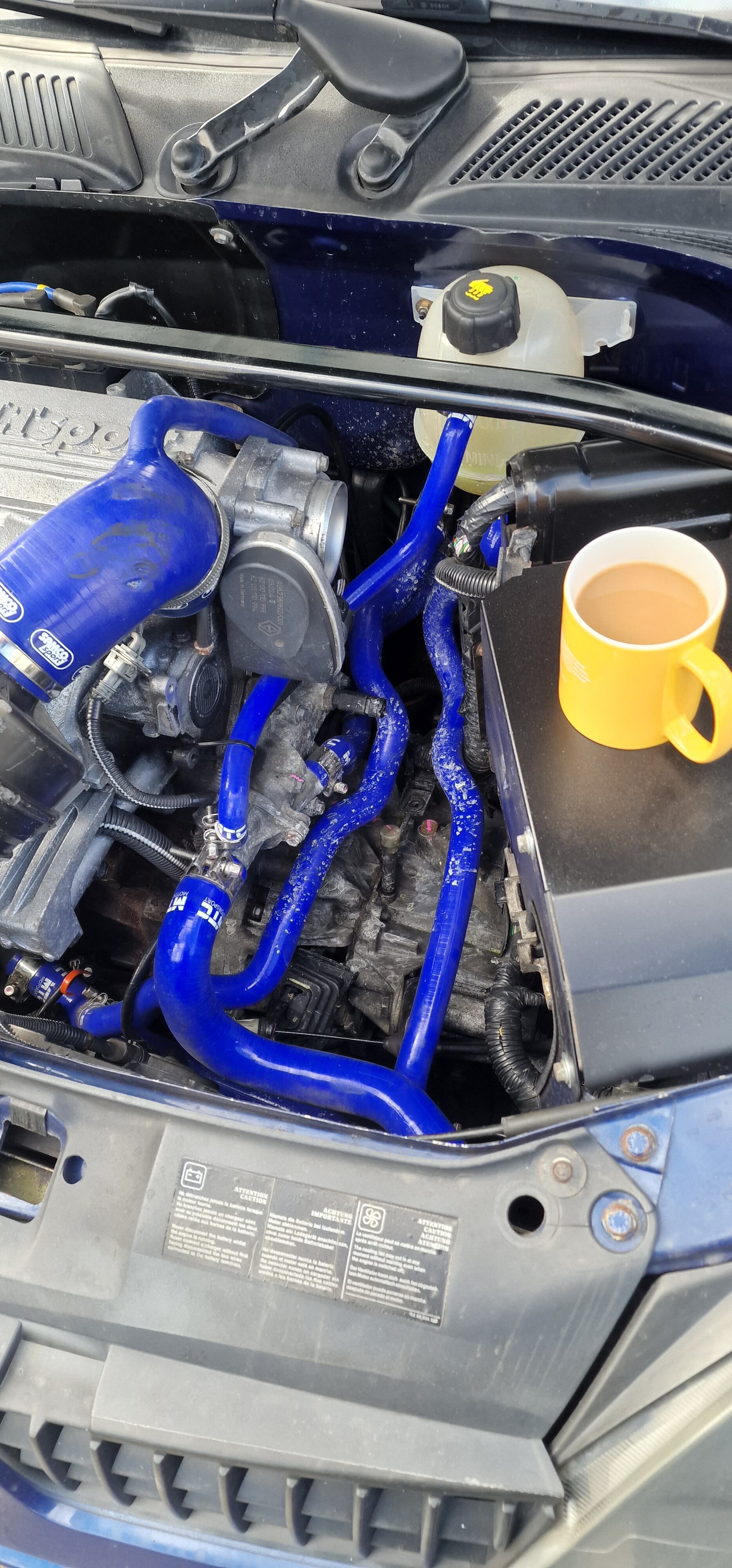

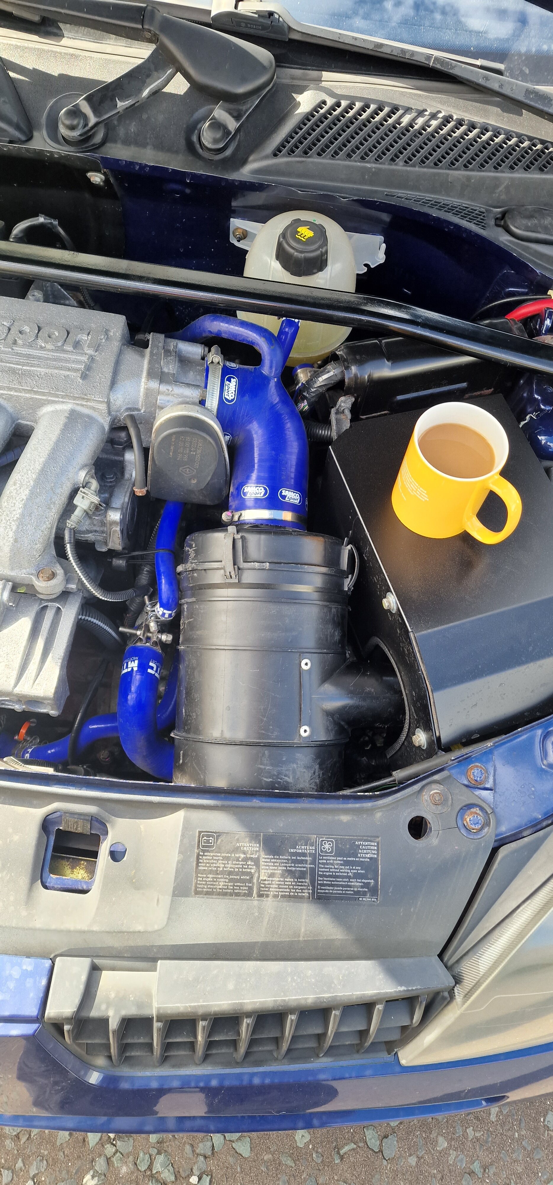

Since CSF there's been a slight leak on the cooling side (alongside the dribbly gearbox), the new hoses needed a heat cycle and the clamps had loosened slightly so needed a quick nip up.
Rotated my airbox slightly too so that both trumpets are fully into the opening for fresh air

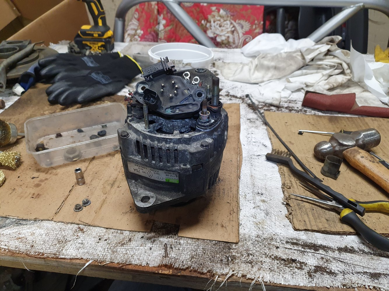

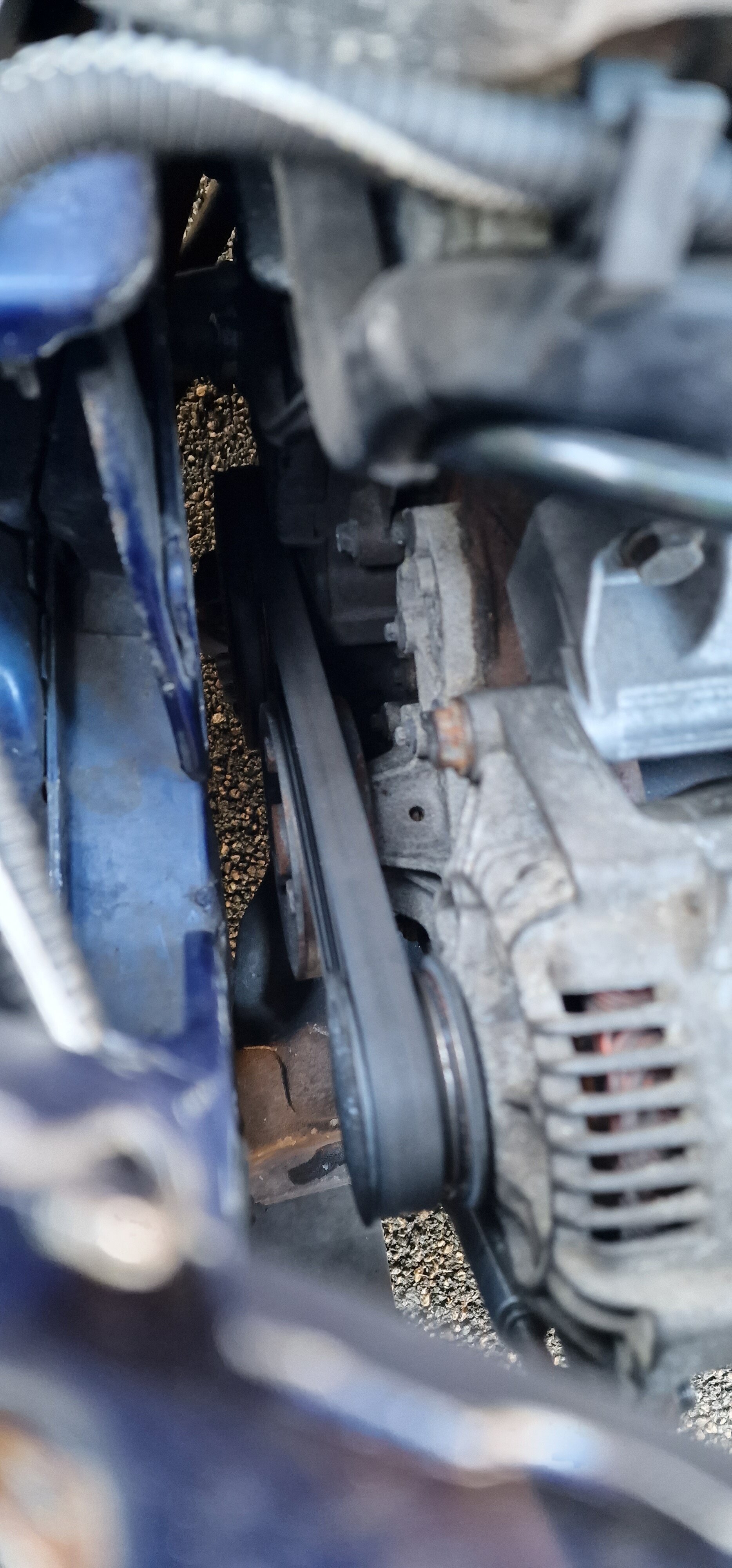

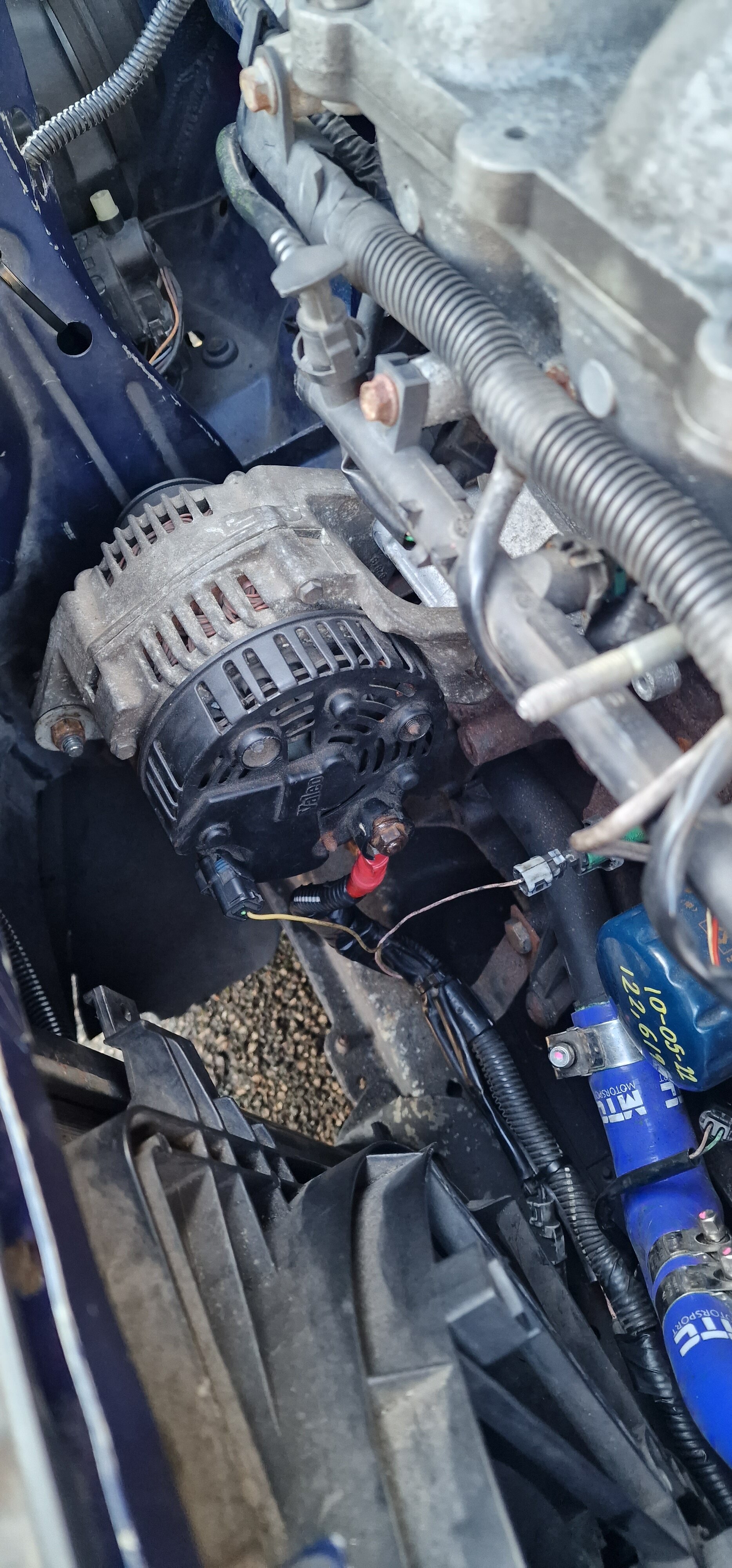

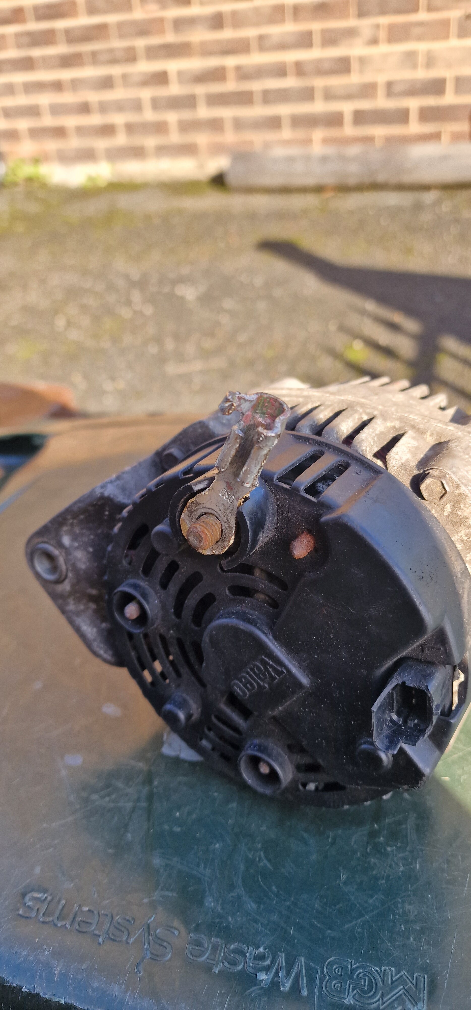

Came out this morning, car threw out the STOP and battery light FFS
Went out when the sun came up to have a look and test. Not getting any charge from the alternator🙄 Tested at the battery and directly off the back of the alternator

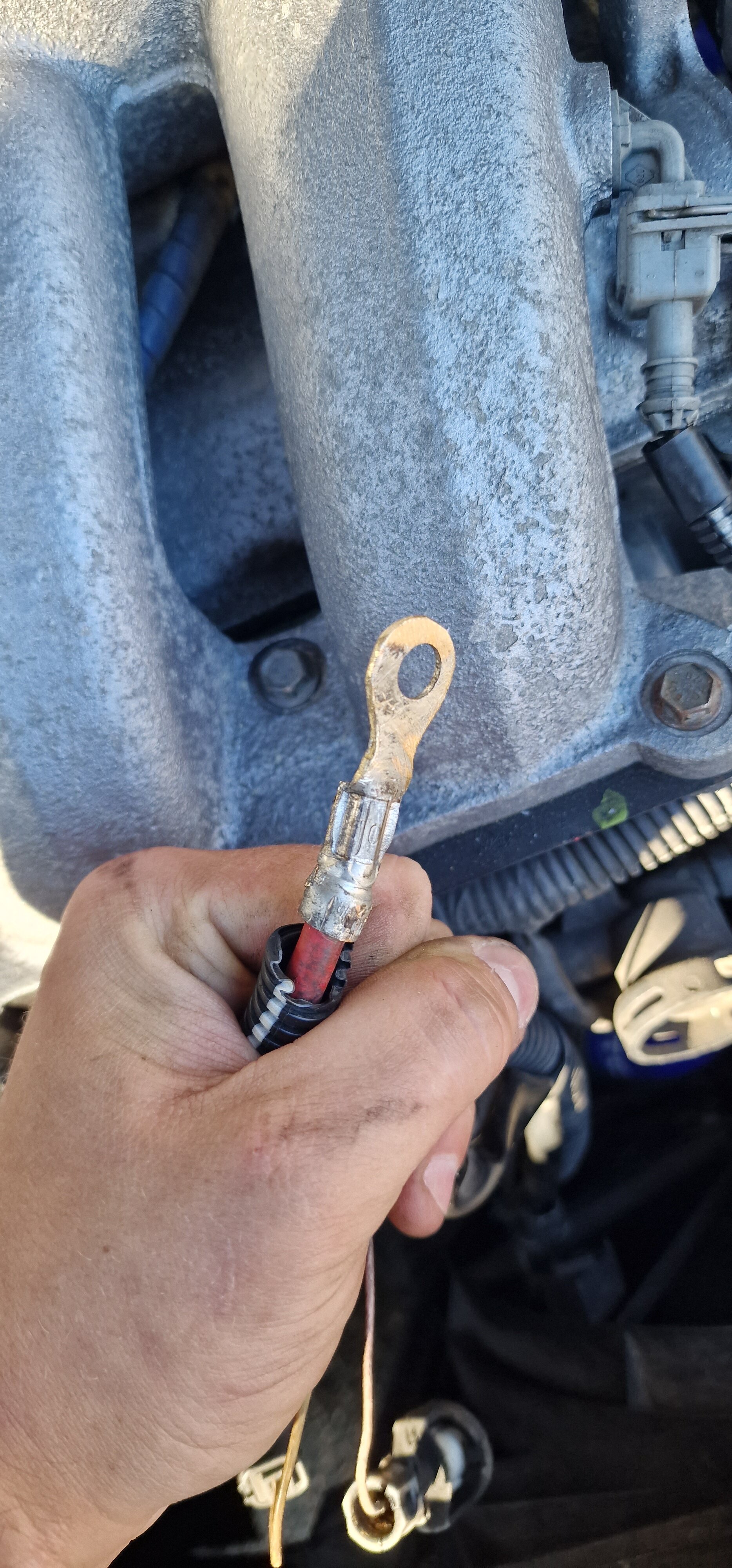

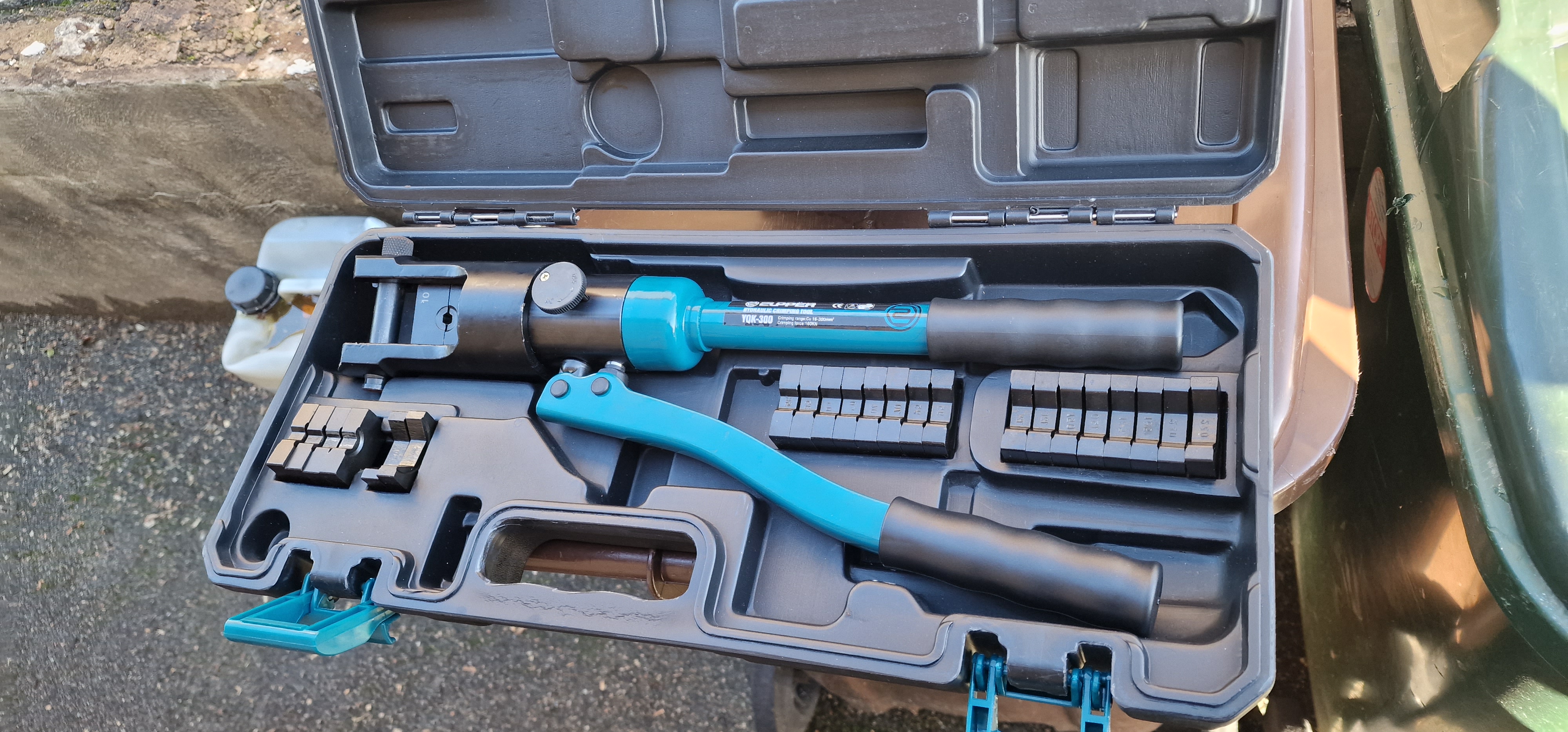

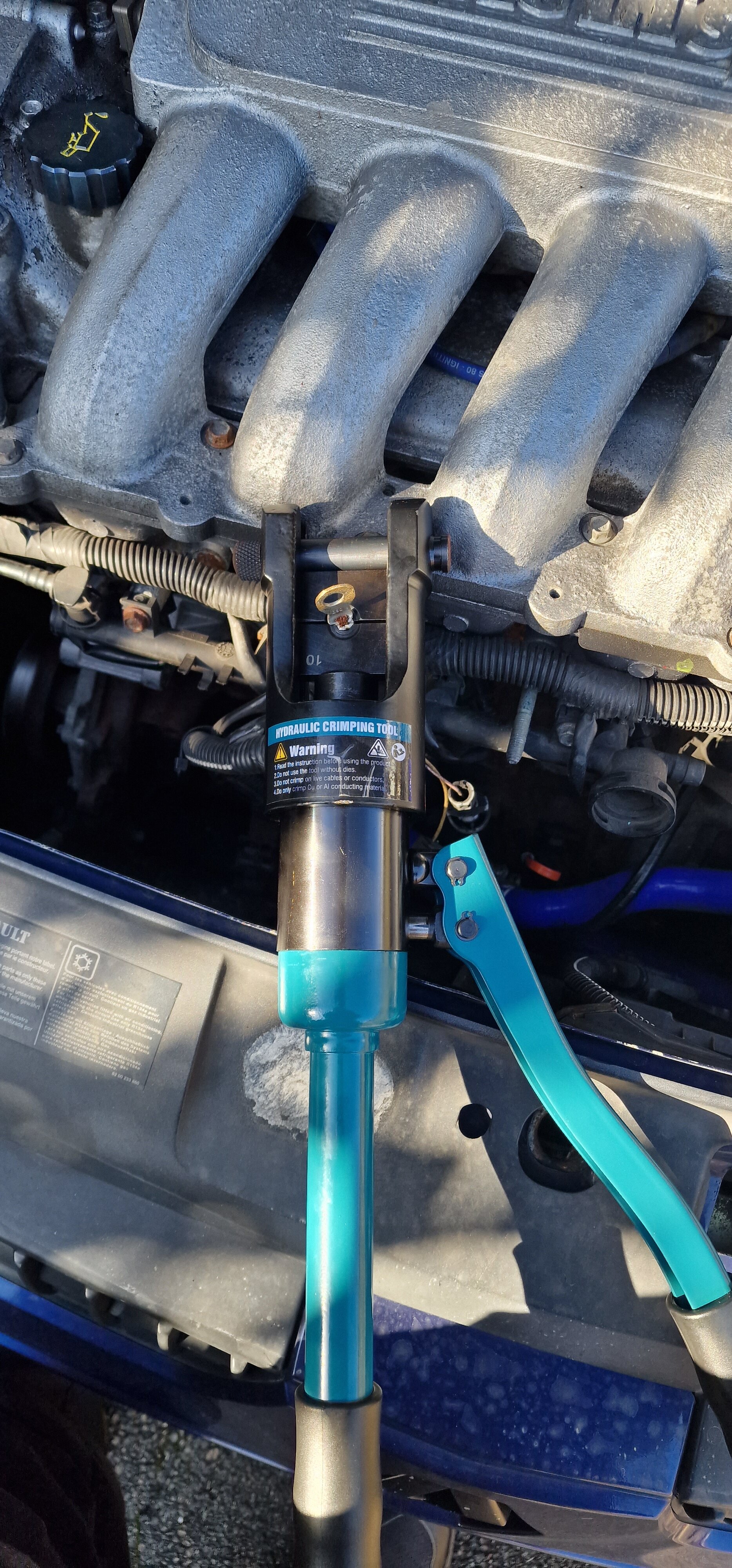

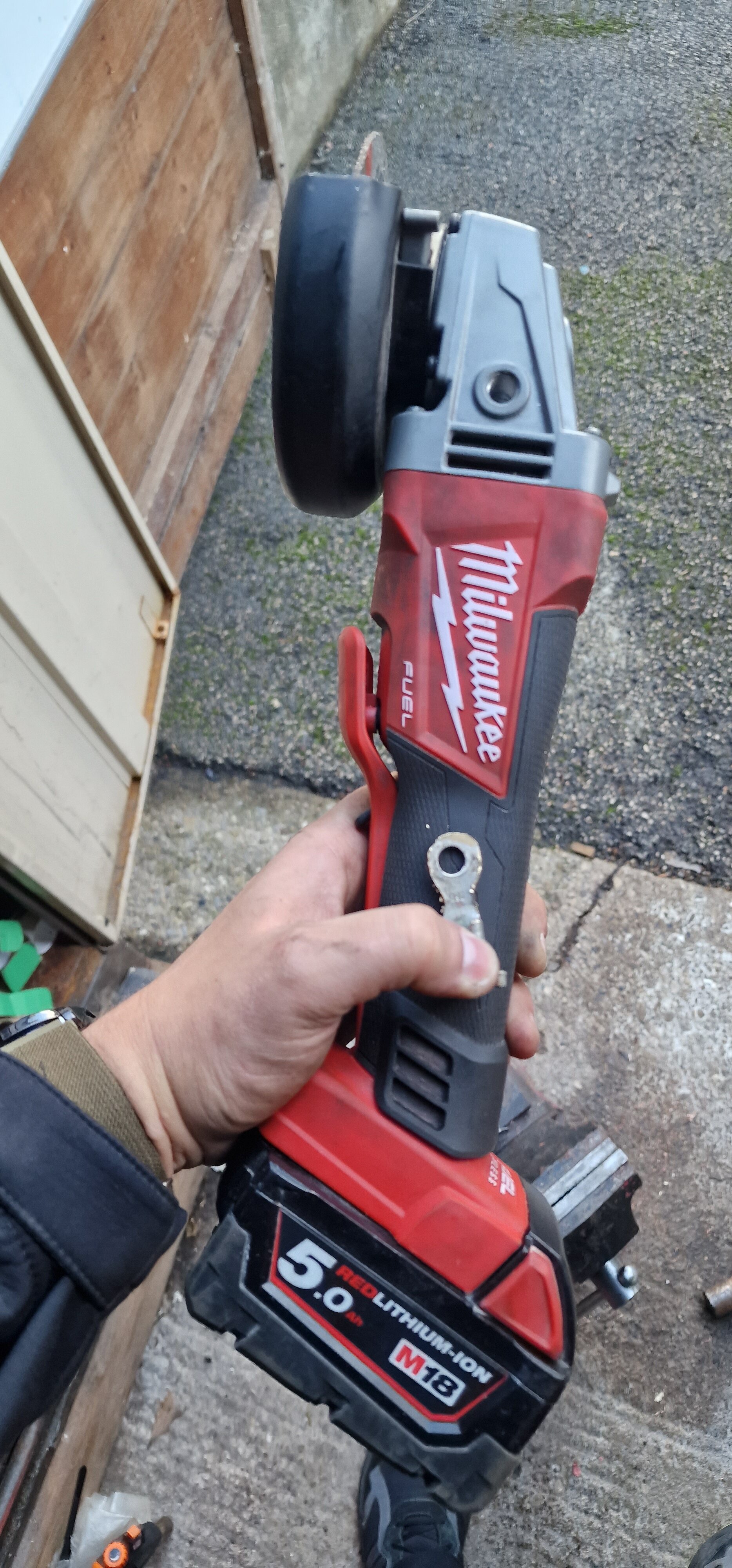

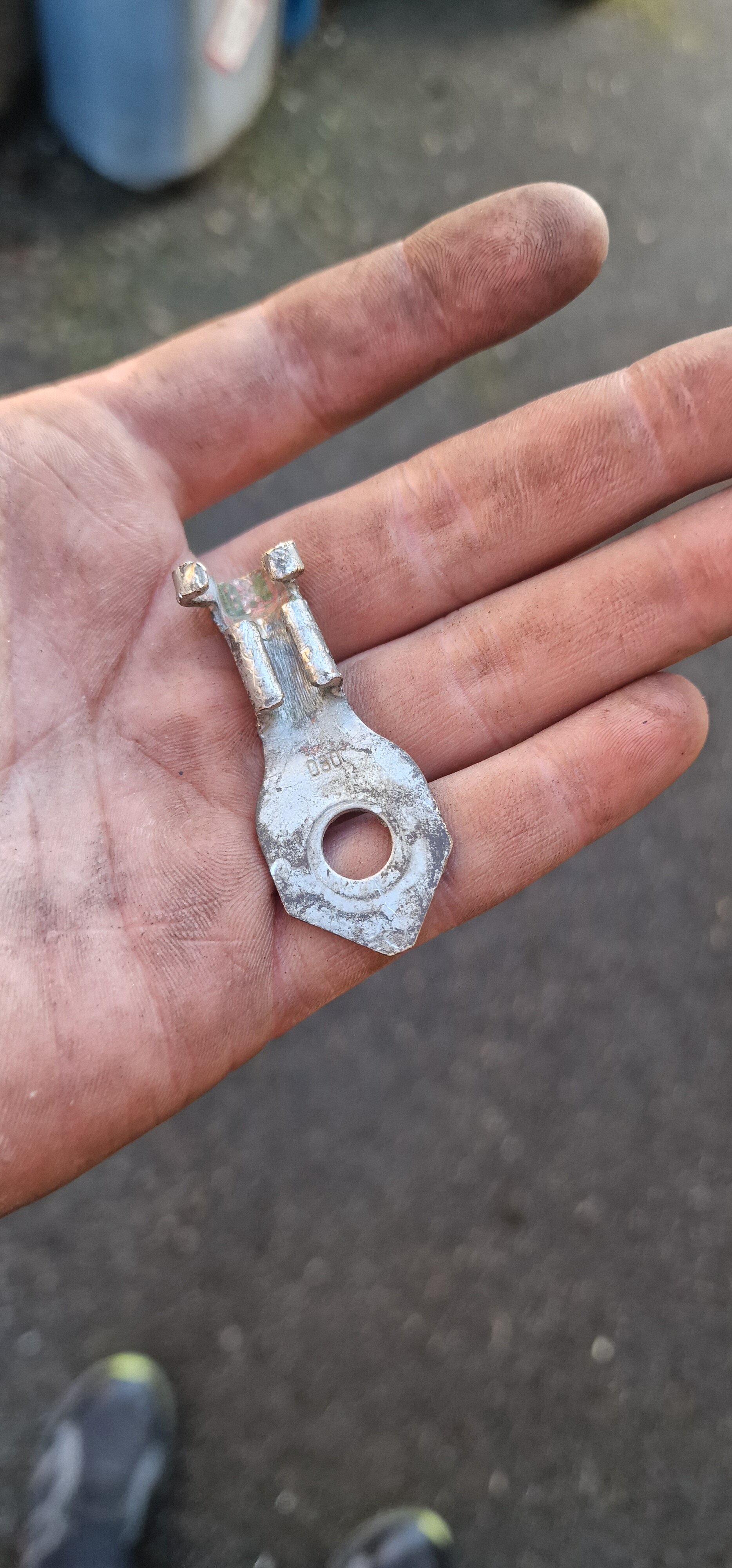

Set about removing it, immediately snapped the terminal off the battery cable. Had to get major PMT (@Adey.) I cut a spare terminal off of a loom I had in the garage from an old derv Clio I ripped apart years ago. I don't have any rings in my sparky drawer
Ring terminal scavenged had to knock out the old copper cable
Wouldn't fit without modification in the hand lathe...
Broke out the crimper
Better termination than Renault has ever done
HwangDongs finest
Tidied the loom up, still need to strip this back one day as I don't have all the ancillaries the car came with
Love this setup, belt is super small and nothing in the way, still doesn't stop you scraping your knuckles but so much easier
Started the car, tested the voltage and it was 13V🫣 Turned it off and then got absolutely nothing and sits at 11.8V now
Turns out this alternator is probably fucked too because it makes a right whine, smells like it's gonna combust and gets up to about 200⁰C after about 30 seconds
Looks like £172 for a new one FFS🙄🤬

Worth pulling your other alternator apart and figuring out whats up.
One of them deffo needs a rectifier which are about £75 on their own if you can find one😭
I'm gonna get the one currently on the car rebuilt. Spoke to Tom earlier and he said he has his rebuilt and the last one was £120 for refurb🥶
Klumpy Dumpy
Not all gingers stink of piss. But I do.
Wonder if the a diode pack off another similar alternator would fit? The brushes and bearings look pretty basic/common.
Yeah the brushes and bearings are a piece of piss to get hold of mate. There is another Valeo model very very similar but uses a single wire exciter on a post instead of a 2 pin connector
