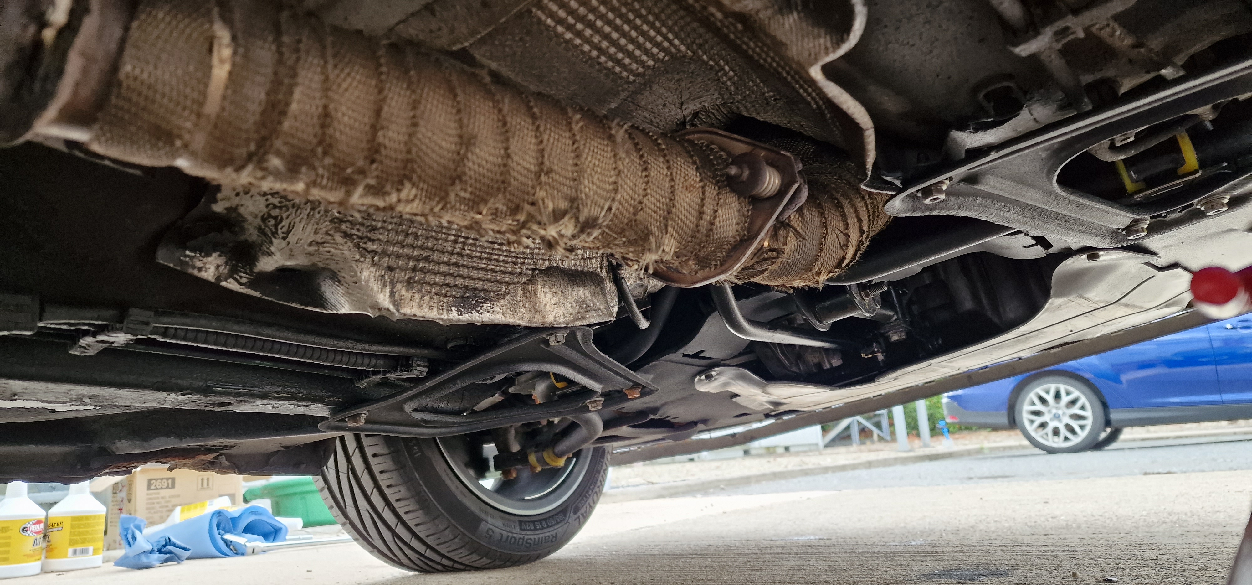

Gave my manifold wrap a quick haircut too. It was dangling down and it looked a bit unsightly

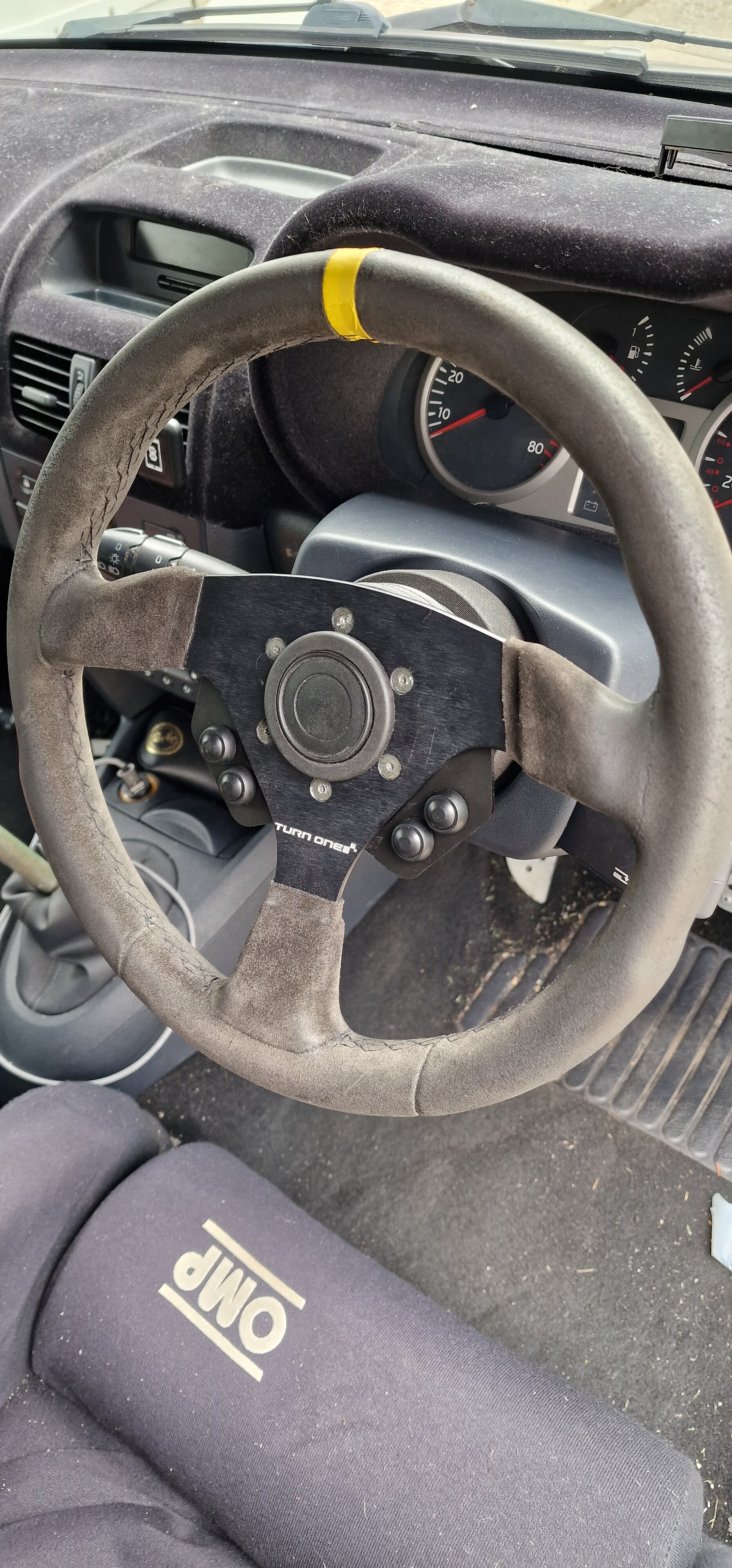

What size of steering wheel is that tubby?
Louis

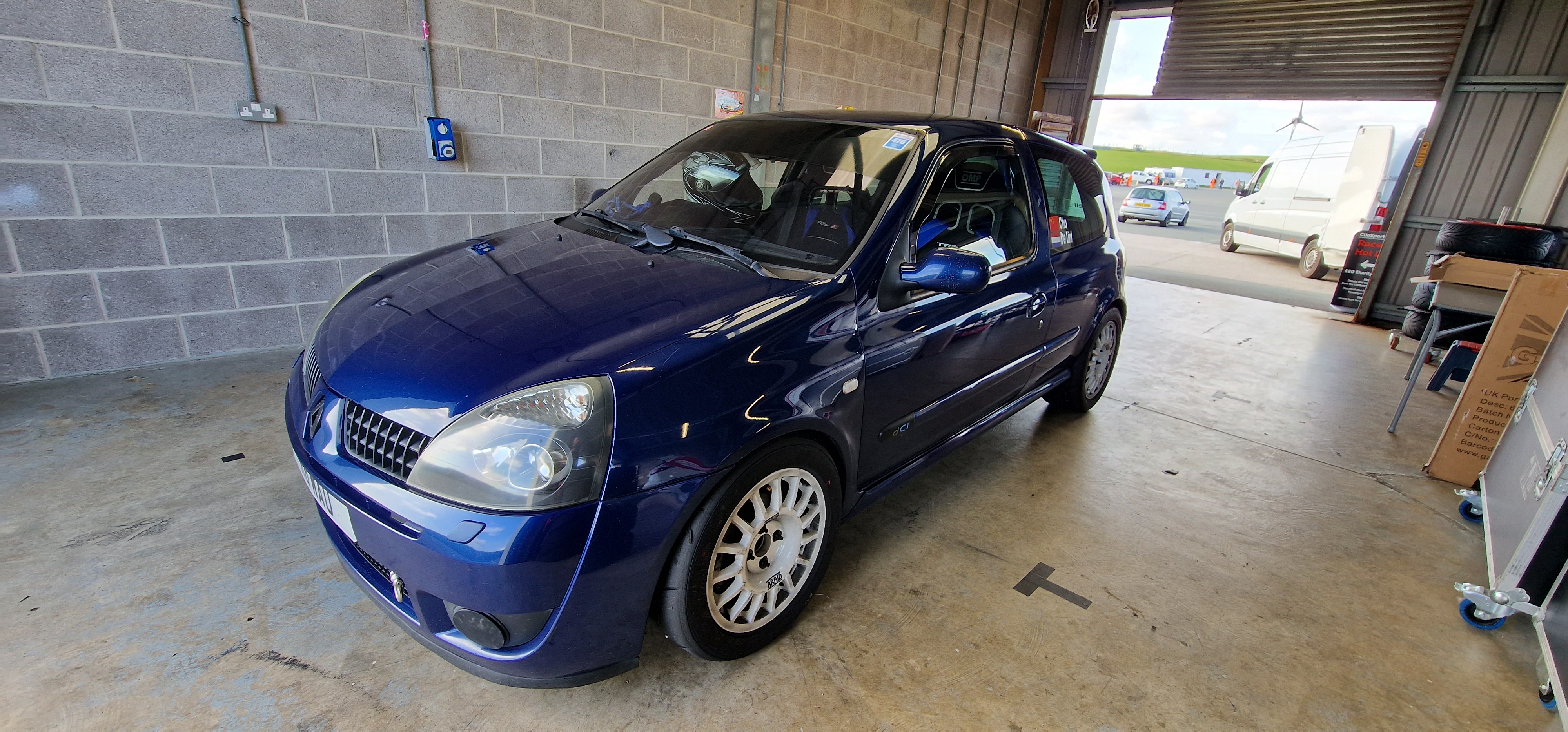

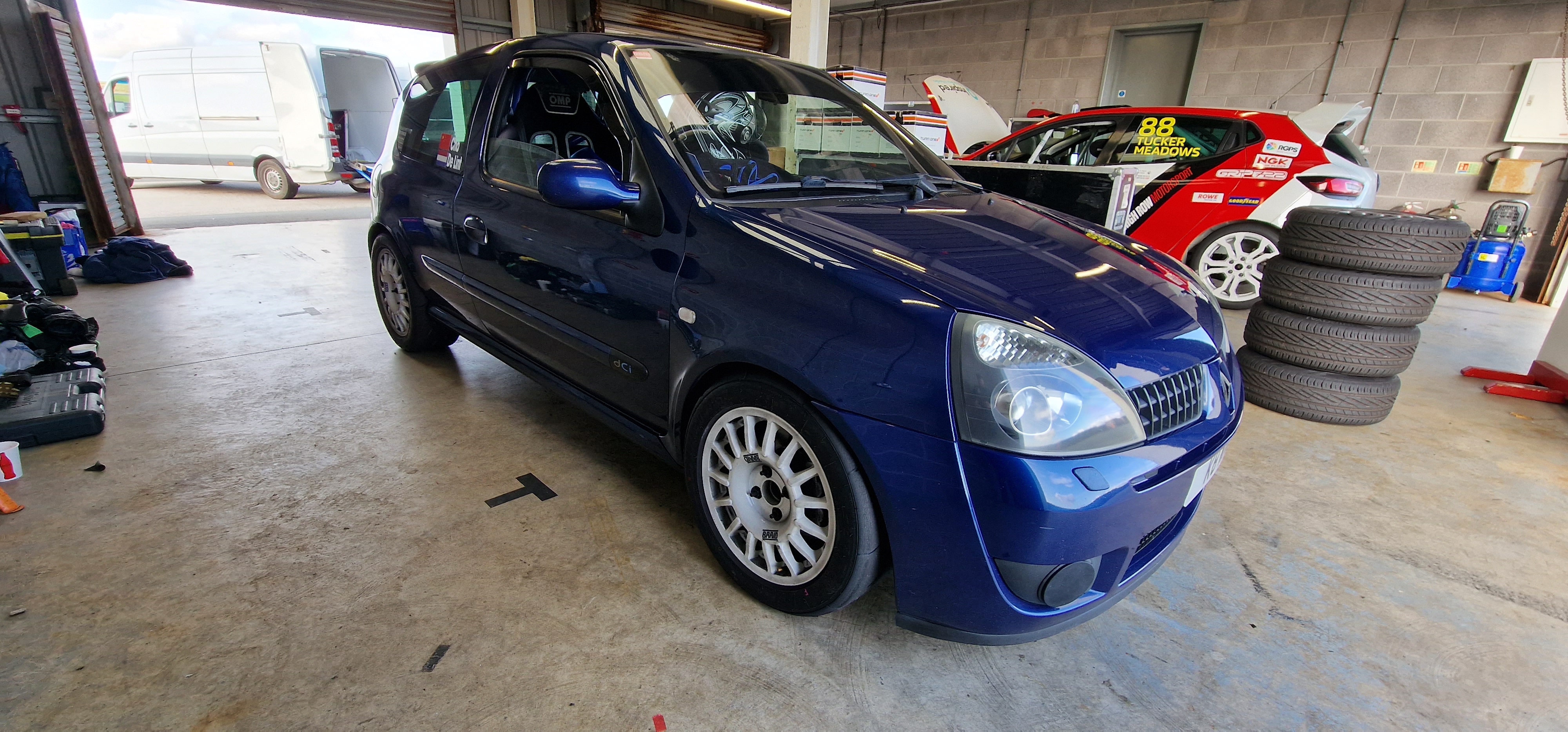

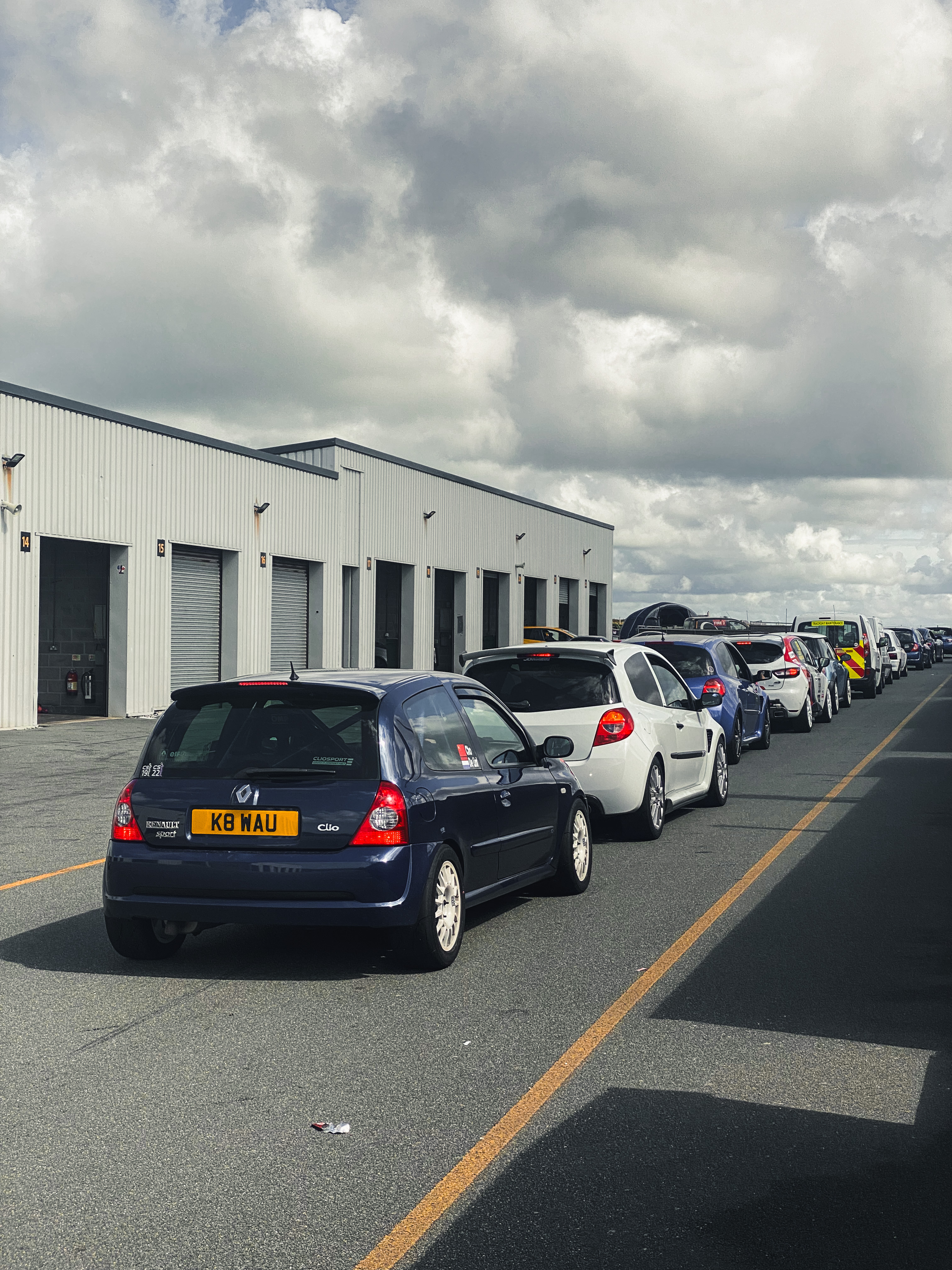

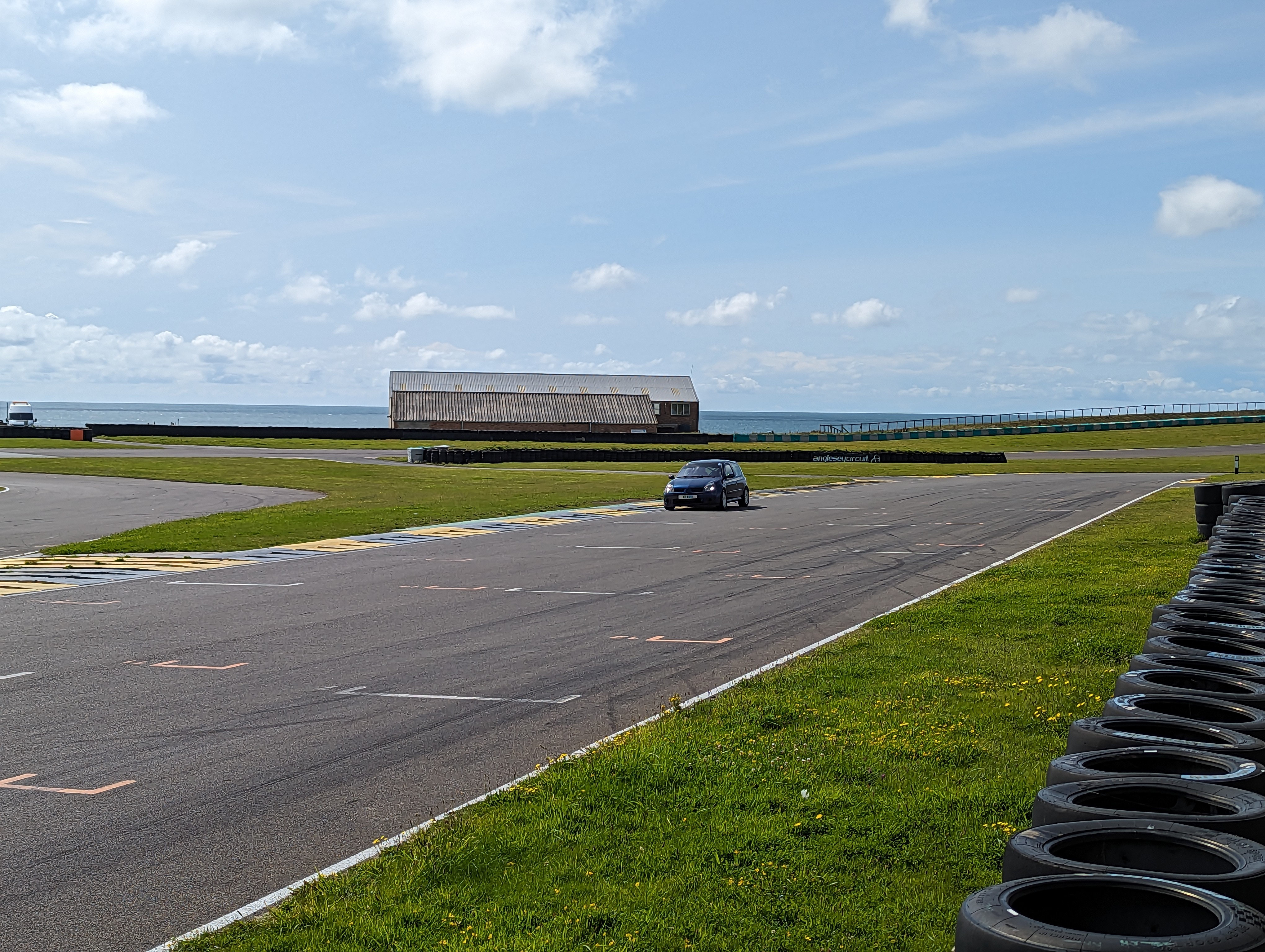

CSF the car was faultless. Went out in the AM session on road tyres, it was a bit greasy so it meant I could get used to the track. Came in at about 11am after a few sessions out, swapped to my track wheels and swapped the PBS pads up front for DS1.11.

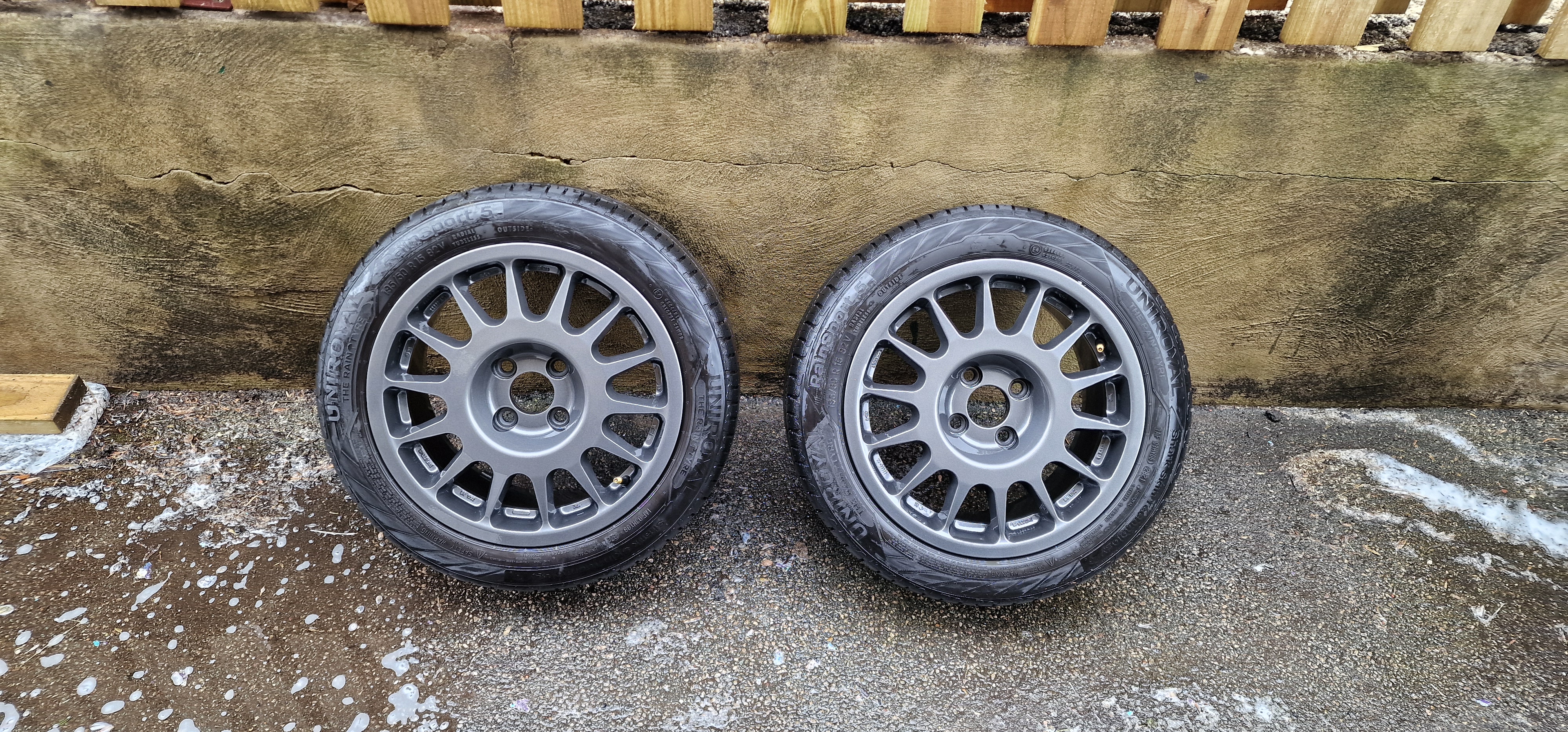

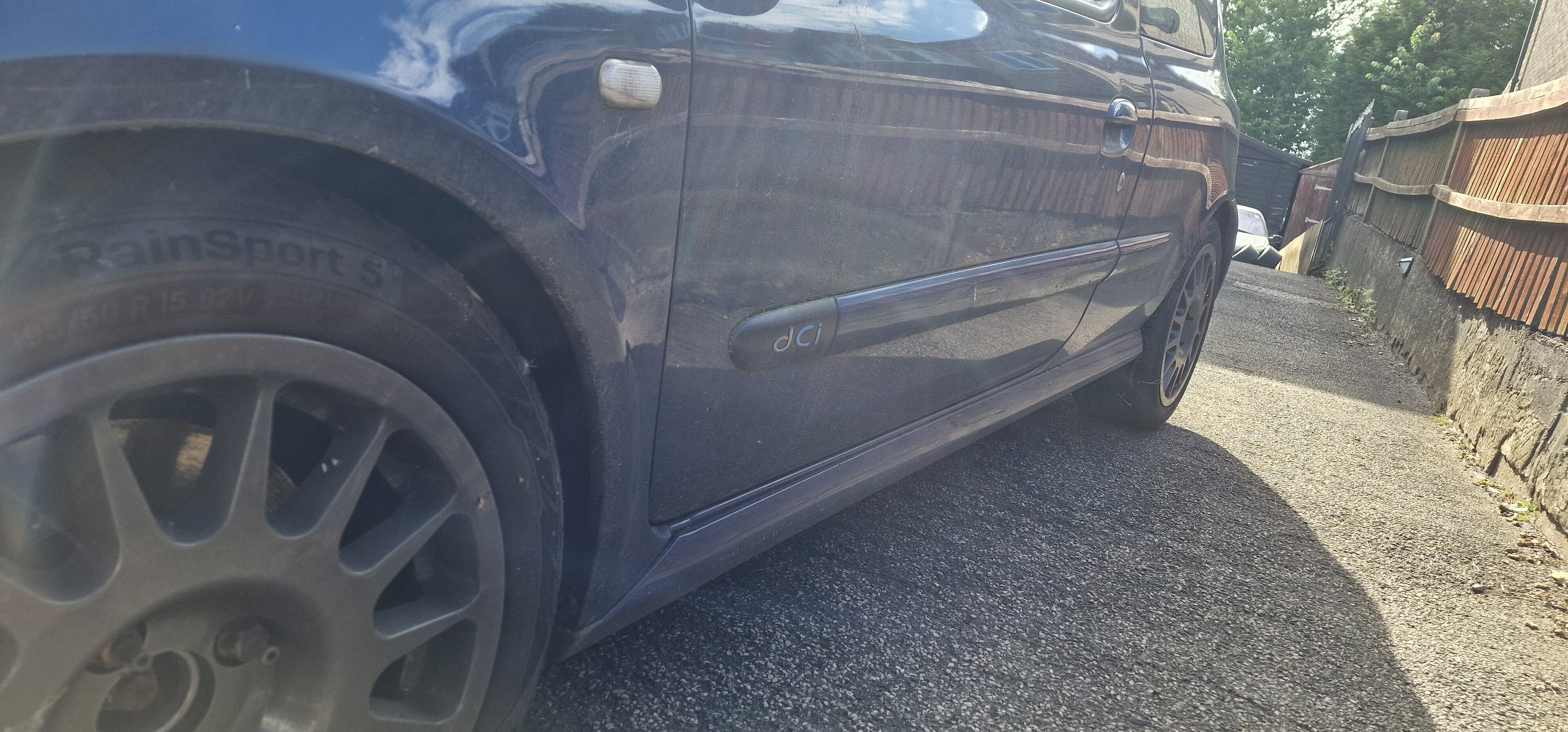

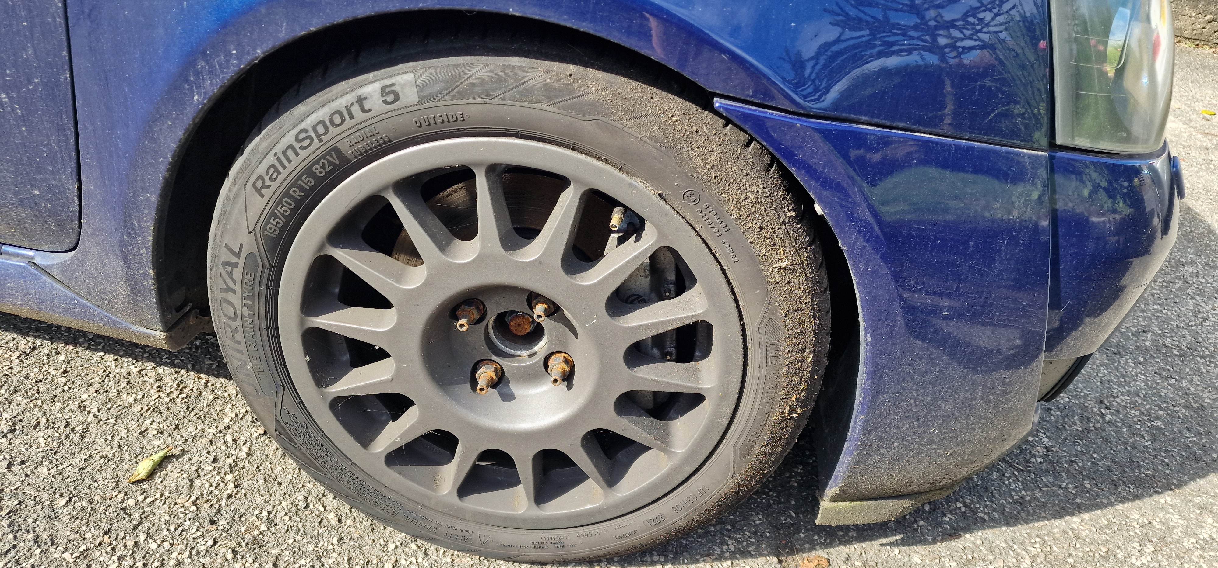

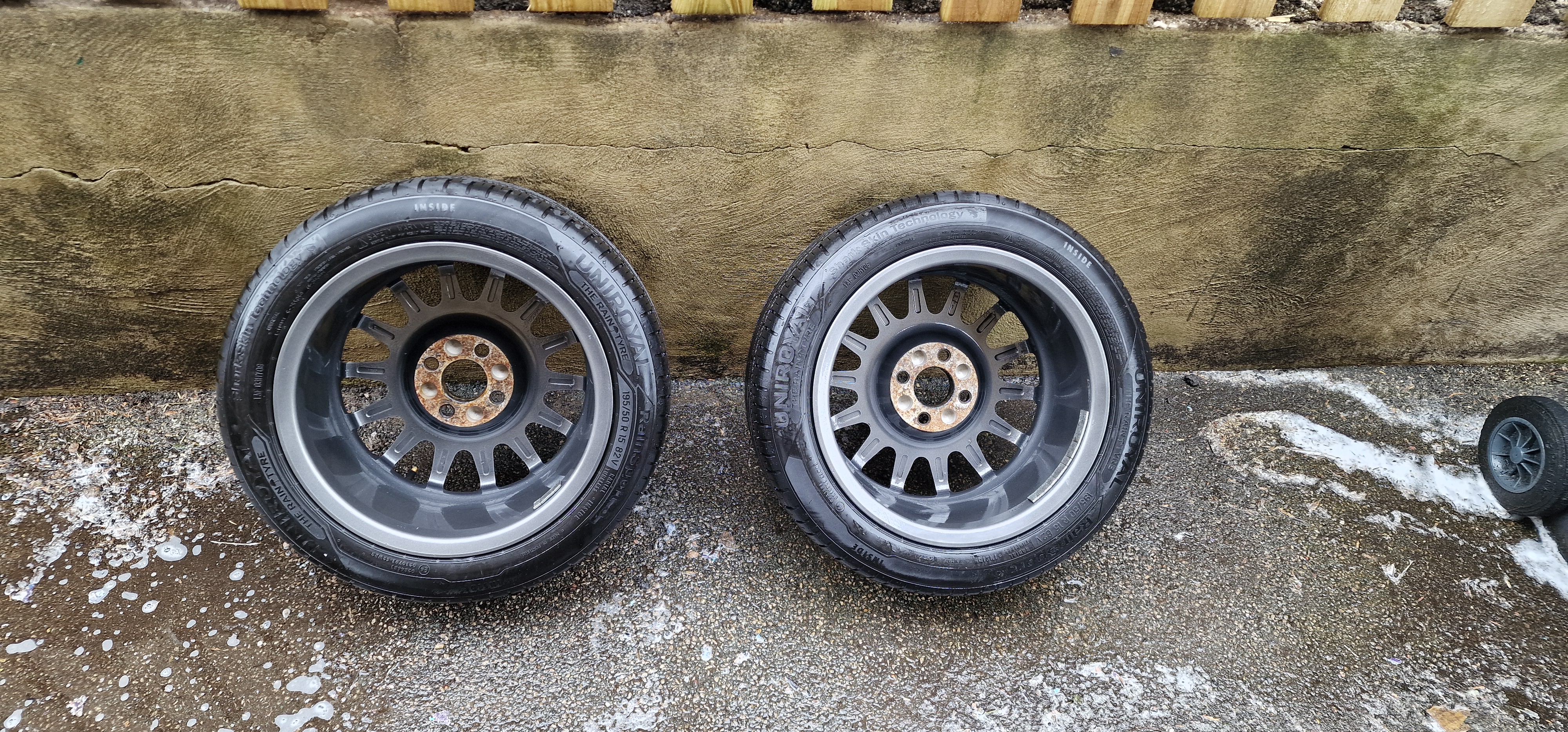

Had one issue where I tried to put some 15mm spacers on, the Braid wheels I got for track have a much lower ET than the 2118 so wanted to reduce the offset. But because the spigot of the hub protrudes about 16mm they didn't sit flush and it caused a right palava, thought I'd fucked it big time. There was brake fluid drips (taste tested) on the floor in the garage but thankfully it was just coming out of @TRH_Racing car instead🤣🤣
After putting the 20mm spacers back on it felt immediately better, the brakes worked and it wasn't wobbling. So first session out the car just felt completely different on the AR1. I never got to use them properly at Cadwell because of the diff seal issue nearly igniting the car. They still struggled hammering them and I realised my car needs a bit more midrange grunt, its hopeless on the standard map

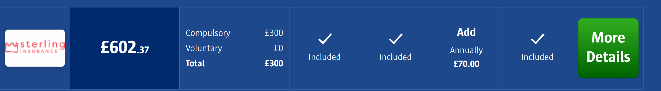

Its actually embarrasing that a "specialist modified car insurer" can't even beat a price comparison website
This is with mods included 1500 miles a year. £209 cheaper than what Flux have offered to me

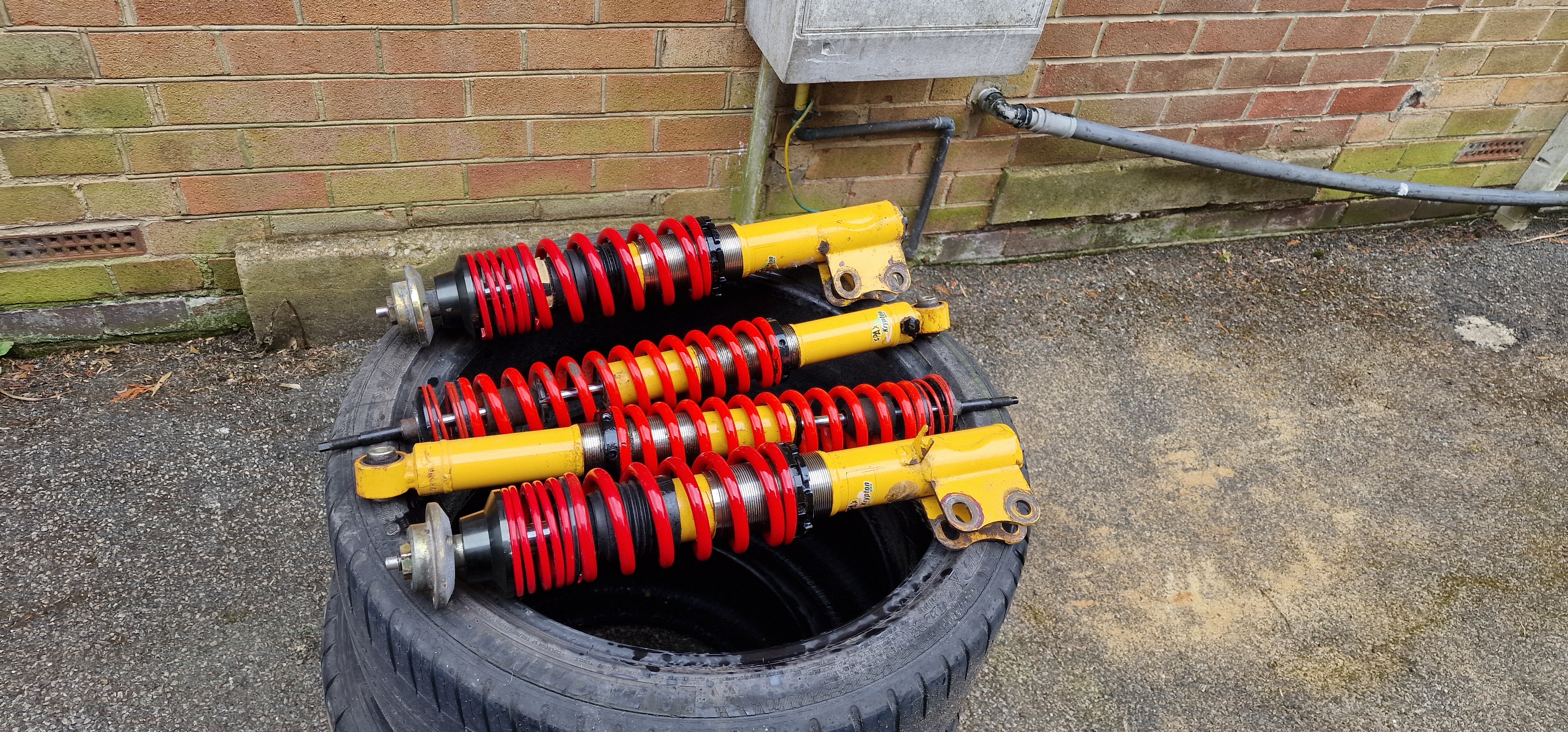

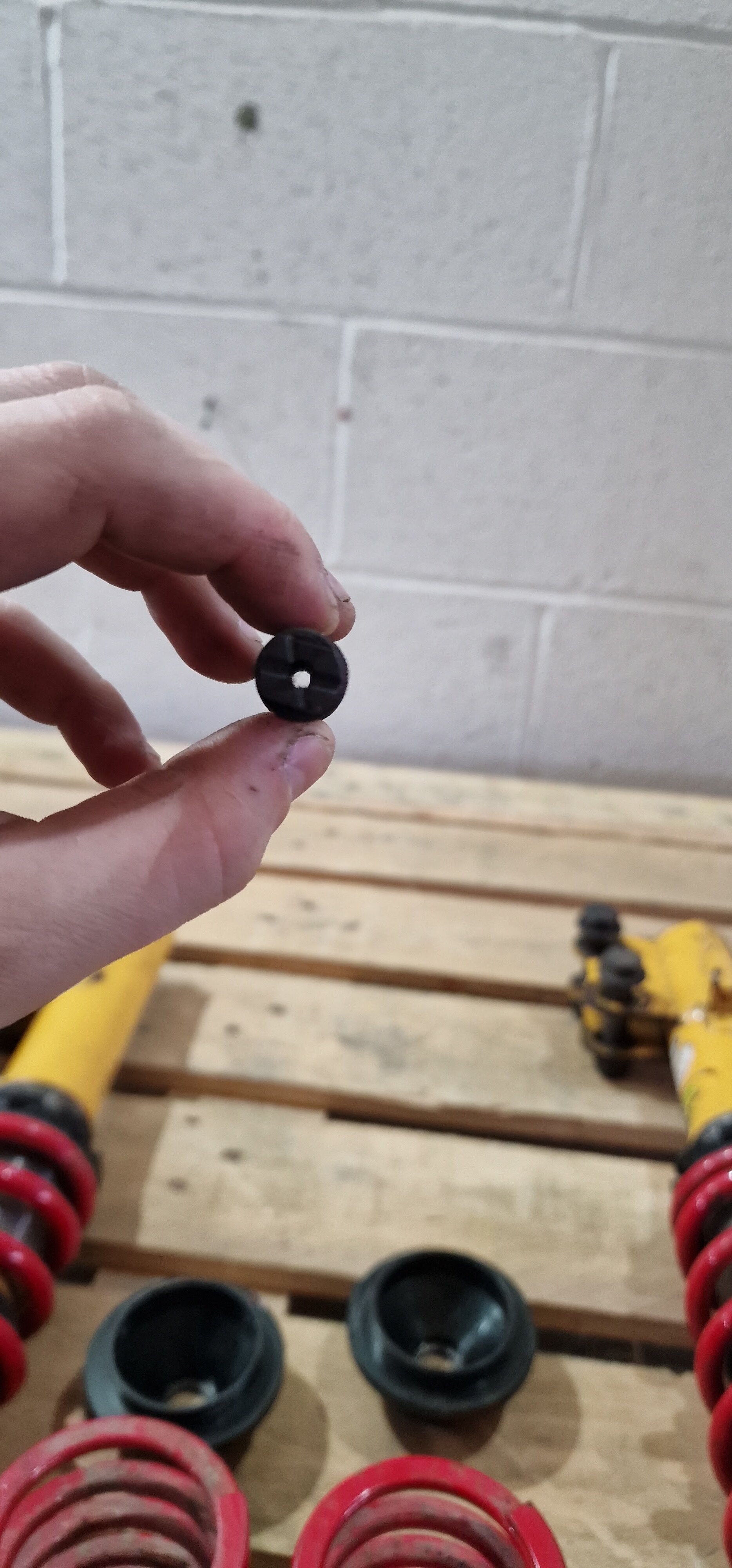

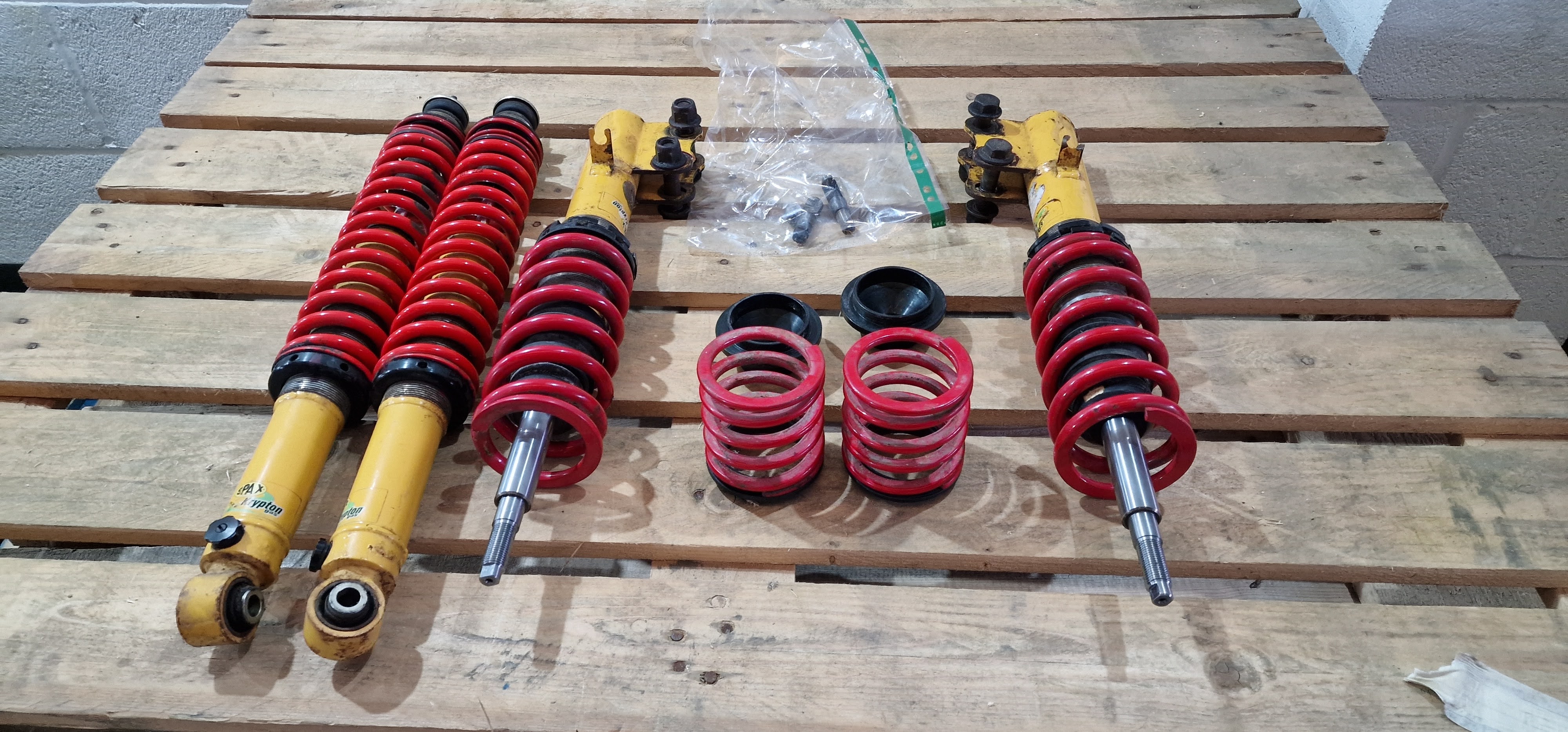

One thing I haven't posted is my coilovers

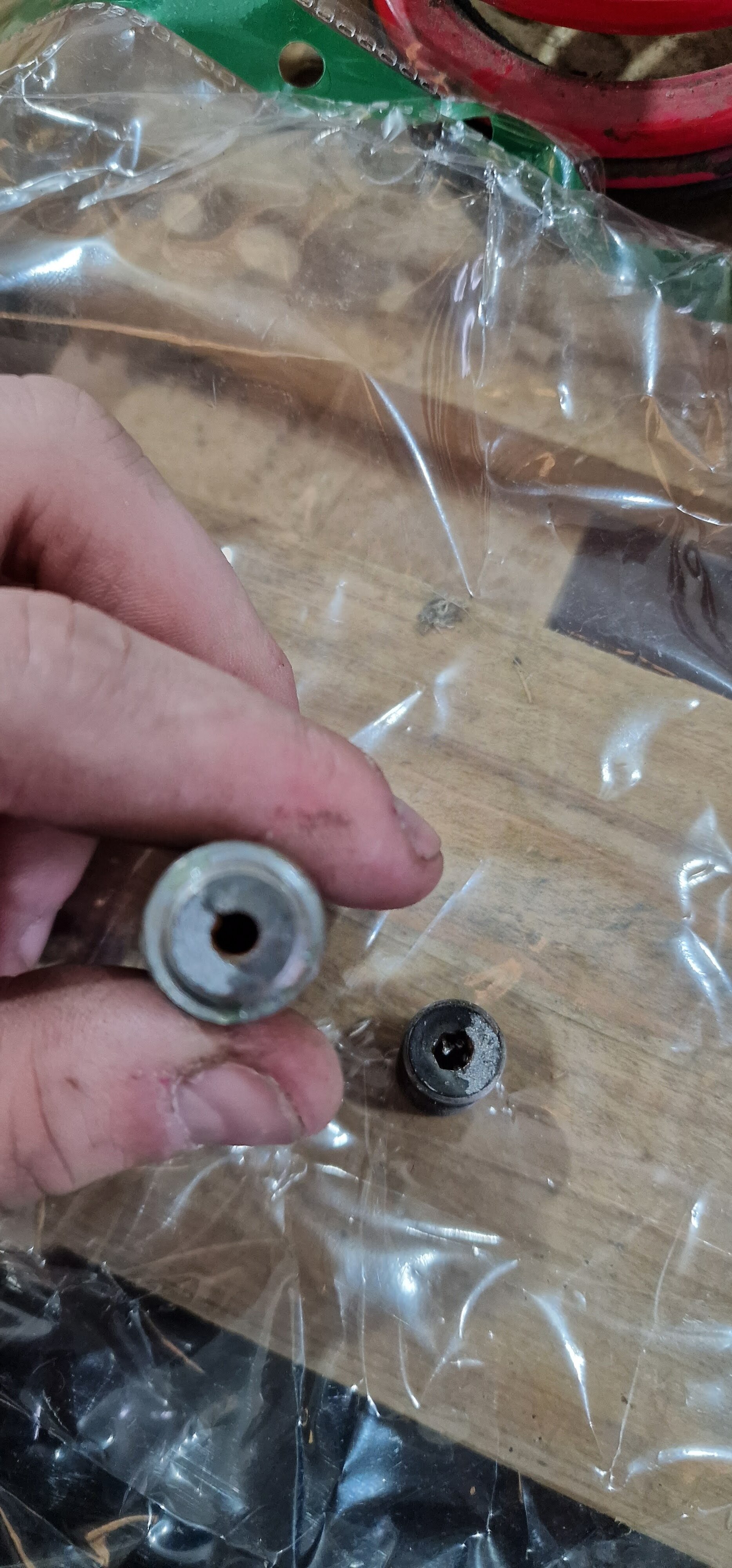

I bought these from someone breaking their track car, he took them off his car after I'd sent him money and snapped the front coilover threaded inserts. To be fair the guy selling them tried to contact Spax who said it would be £175+VAT per shock to have the insert machined out and replaced. I think they were taking the piss and said I'm still interested and he knocked £100 off
I took them down to Bridgecraft engineering and was reassured that something could be done with them
Allan stripped them down, got the old inserts out and gave me a ring which went something like "yeah I've got the inserts out and in just on with making some new ones. The old ones were hollow..."
Yes you read that right, they put f**king hollow inserts into the top of each coilover
Allan got the new inserts all sorted and basically said that the new inserts will need machining out should they ever fail. However having their hubs I can say nothing they do will fail🤣
All back together, new inserts. Just need to ACF them and fit some covers
Not bad for £180 plus some money to get them fixed by Allan👀

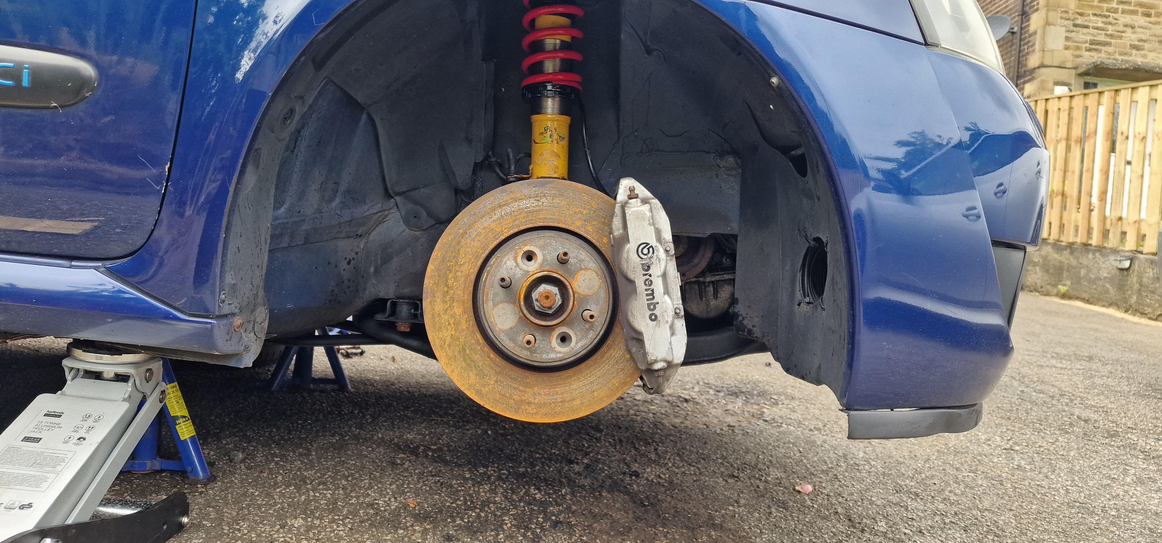

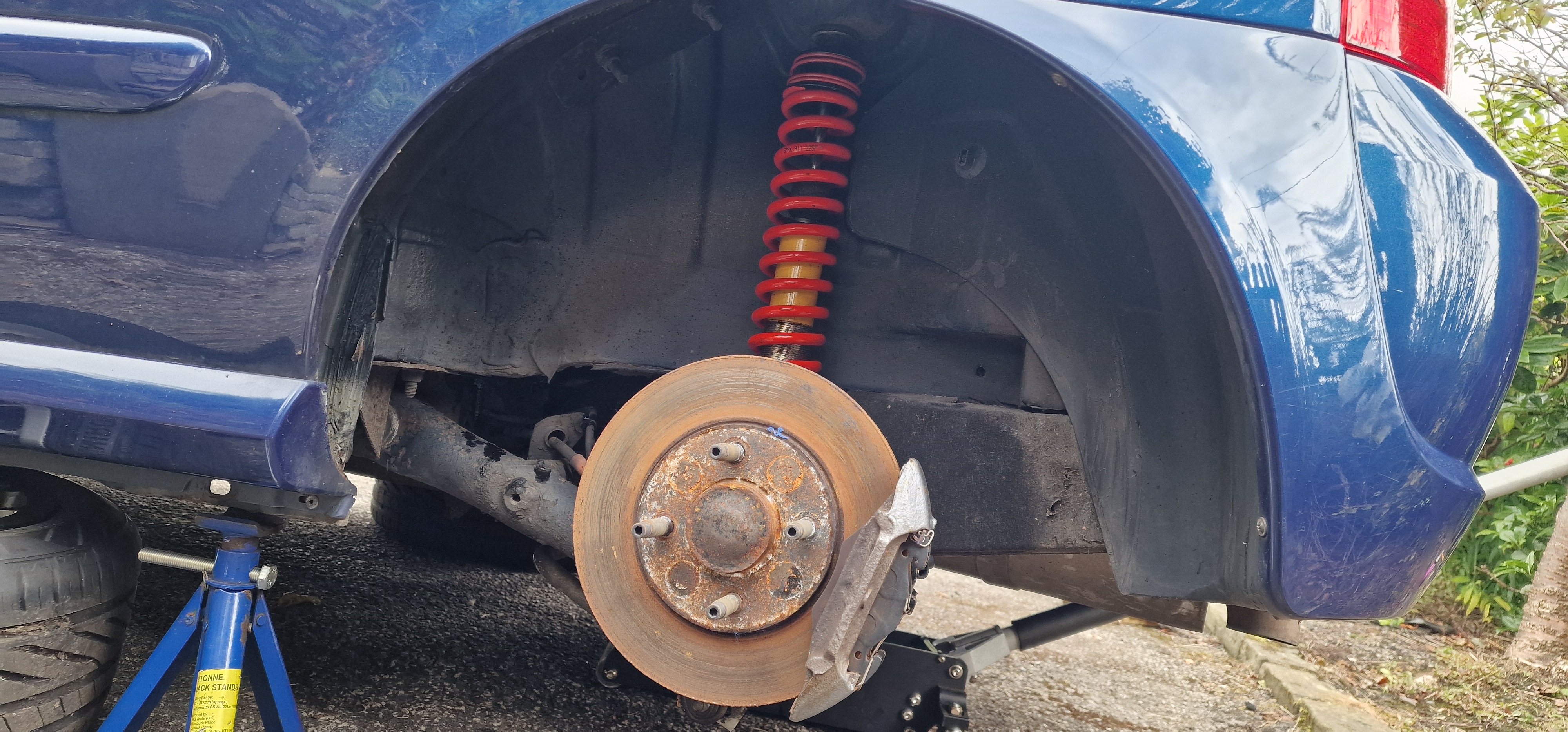

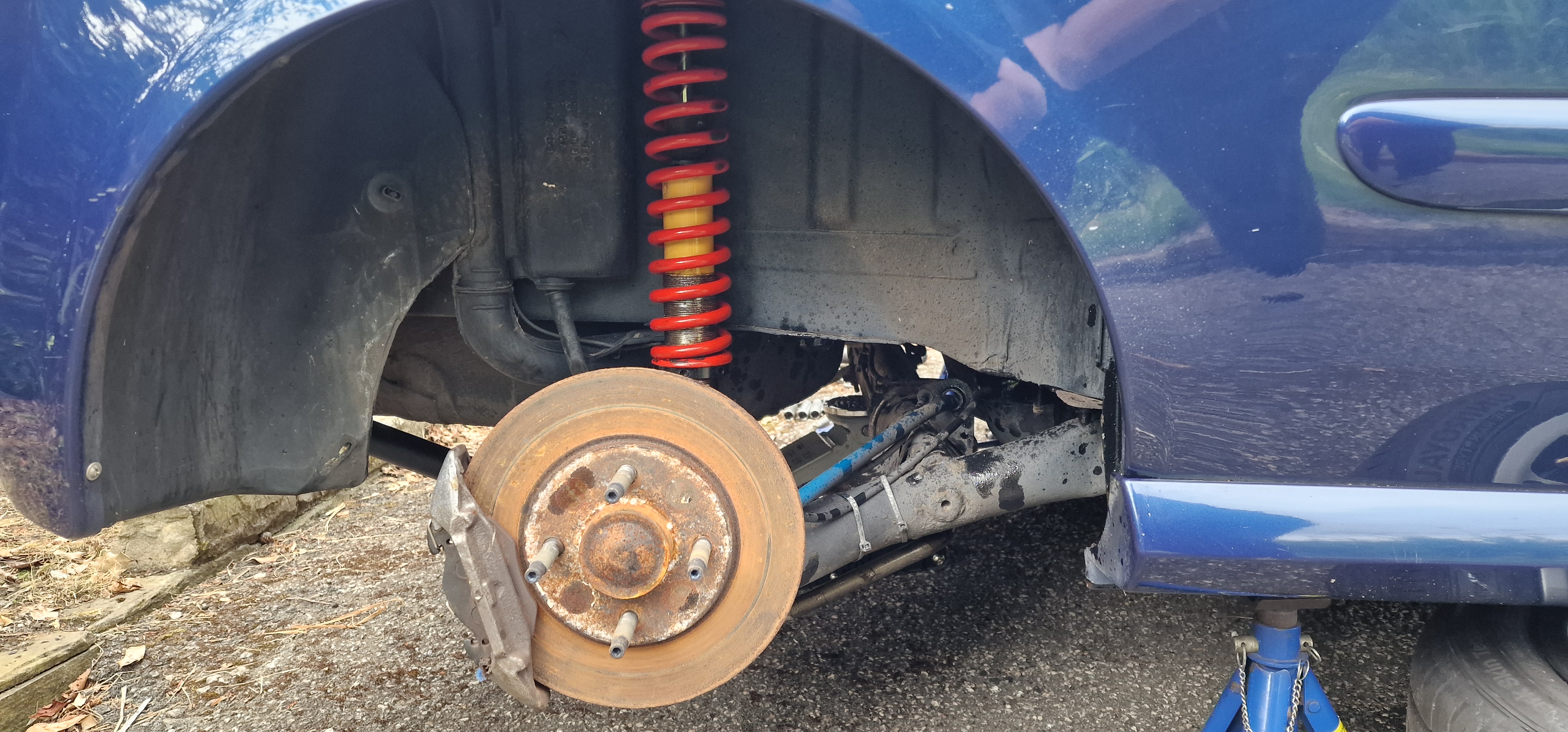

With CSF rapidly approaching I needed to start pulling my finger out
So with my above list set out to get done I cracked on this weekend

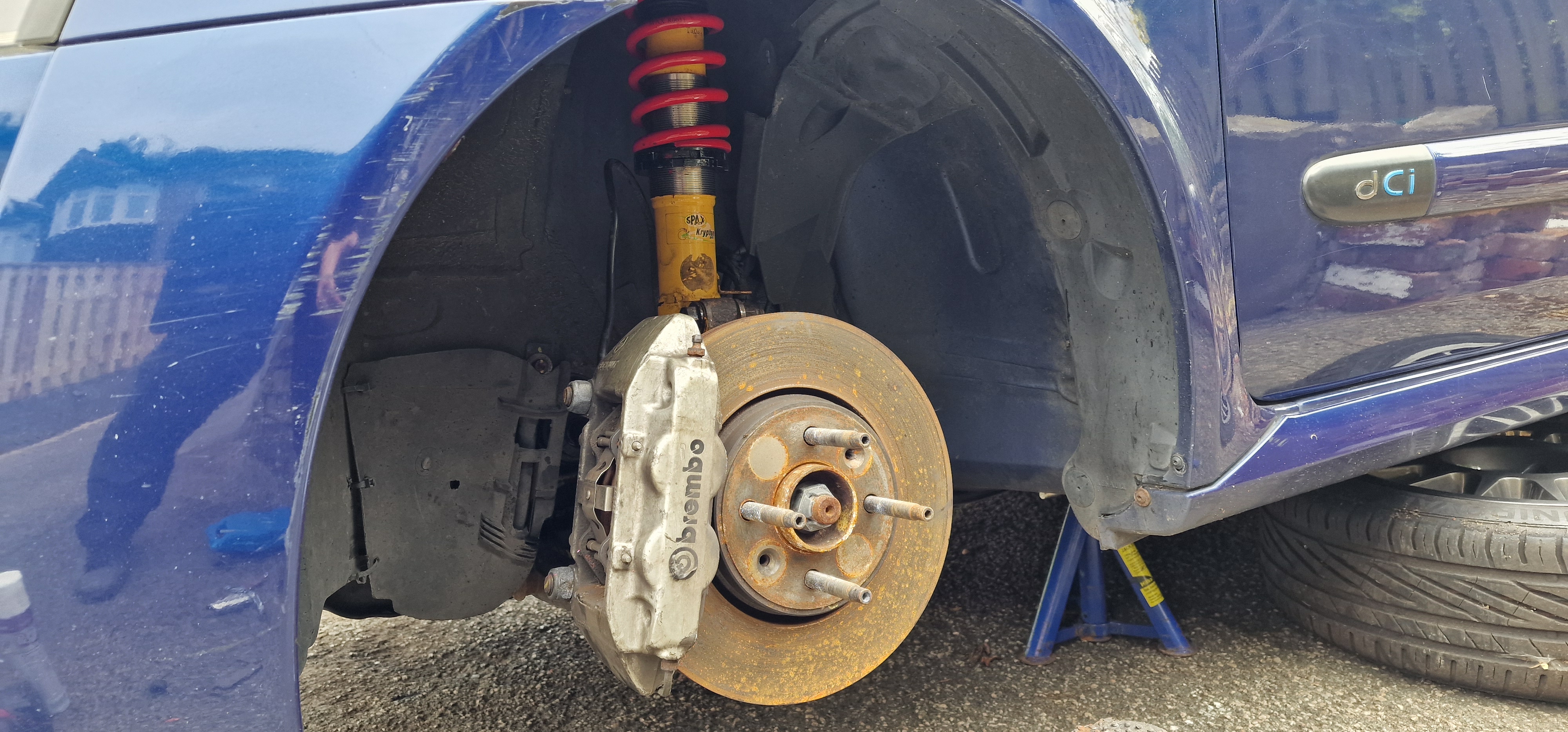

First I got my coilovers out, gave them a good clean and a liberal spray of ACF-50
Got the front end stripped down and on first
I then thought "now would be a perfect time to change the oil"
Aye would have if I hadn't left my drain pan at work like a f**king mongtard
So instead I got the rears on

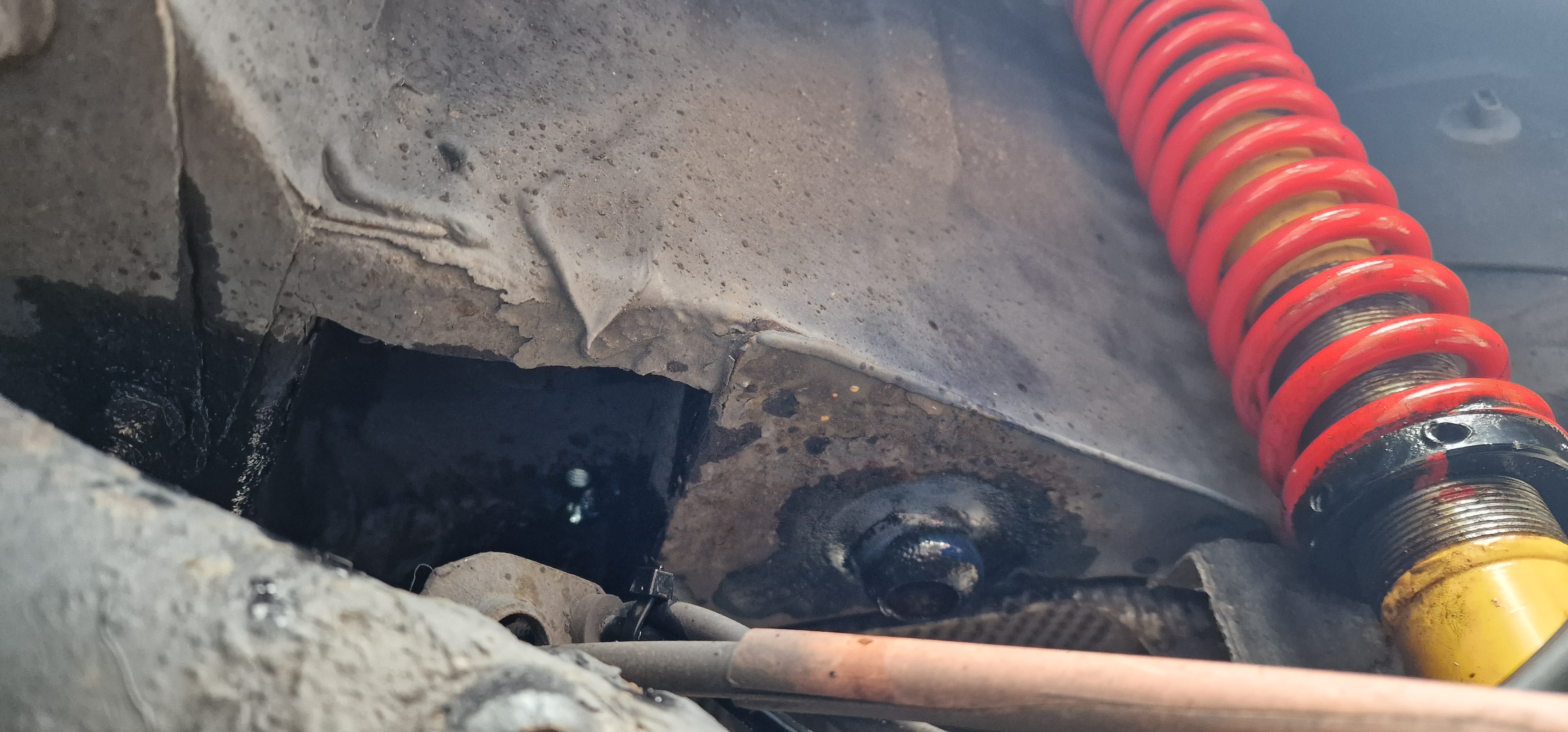

Whilst under there I gave the usual rusty places a good spritz with ACF
And cleaned the wheels (did the fronts too)
Fitted and back down. The front toe is way out now because I've added more camber, it was -2.3⁰ before and I reckon there's even more now🤣

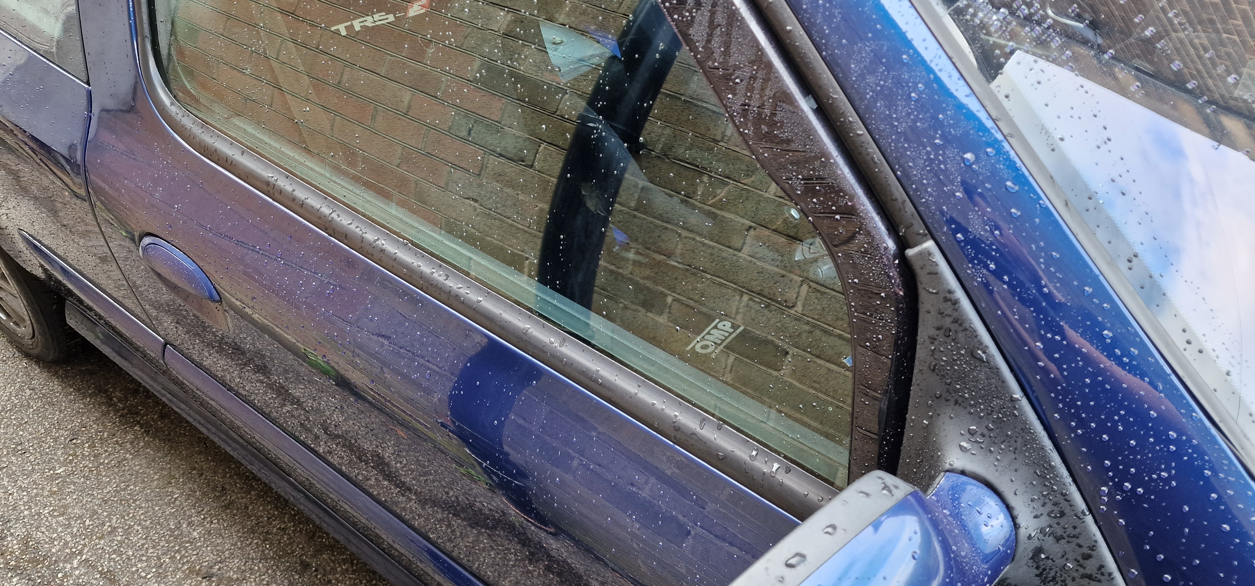

Can't believe none of the CS nonces have noticed I removed the wind deflectors

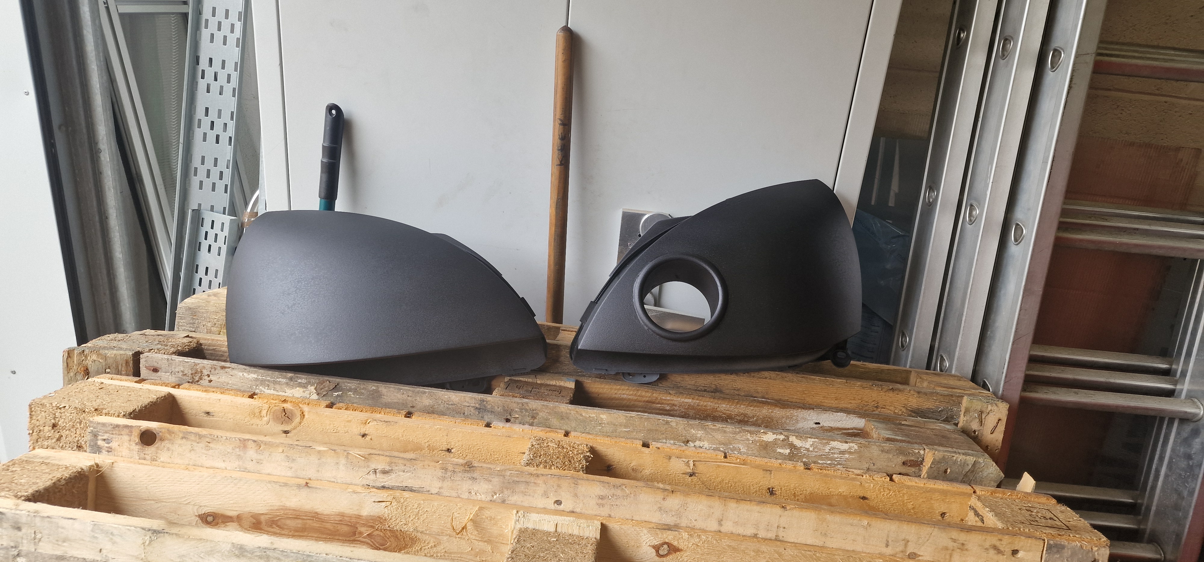

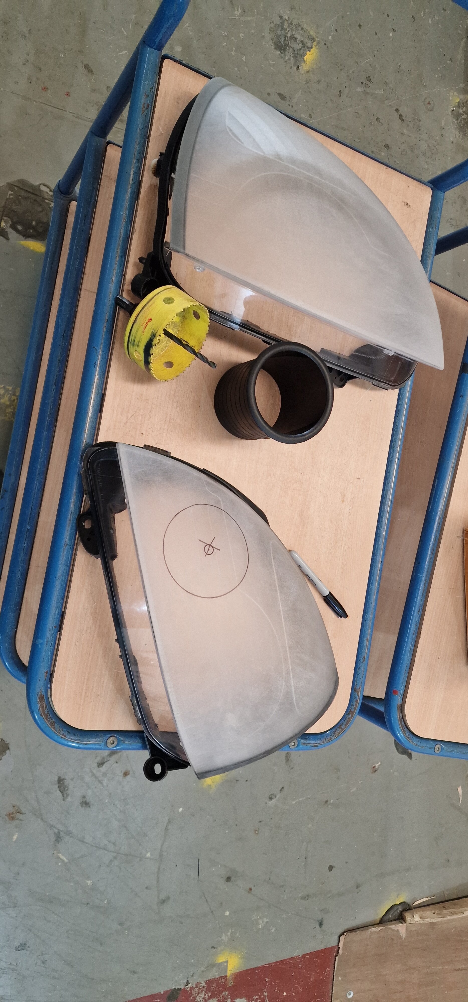

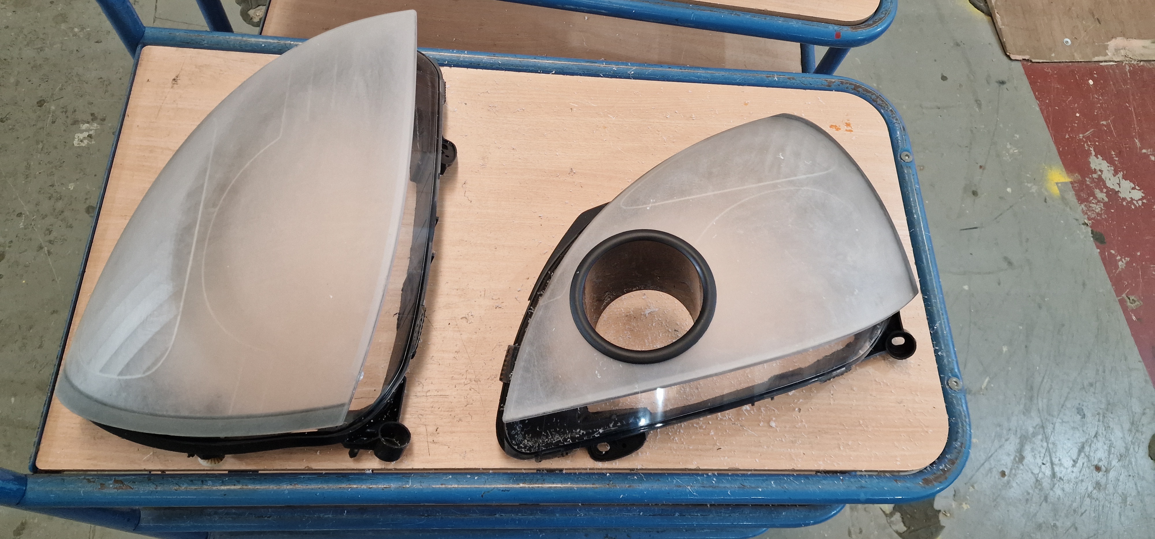

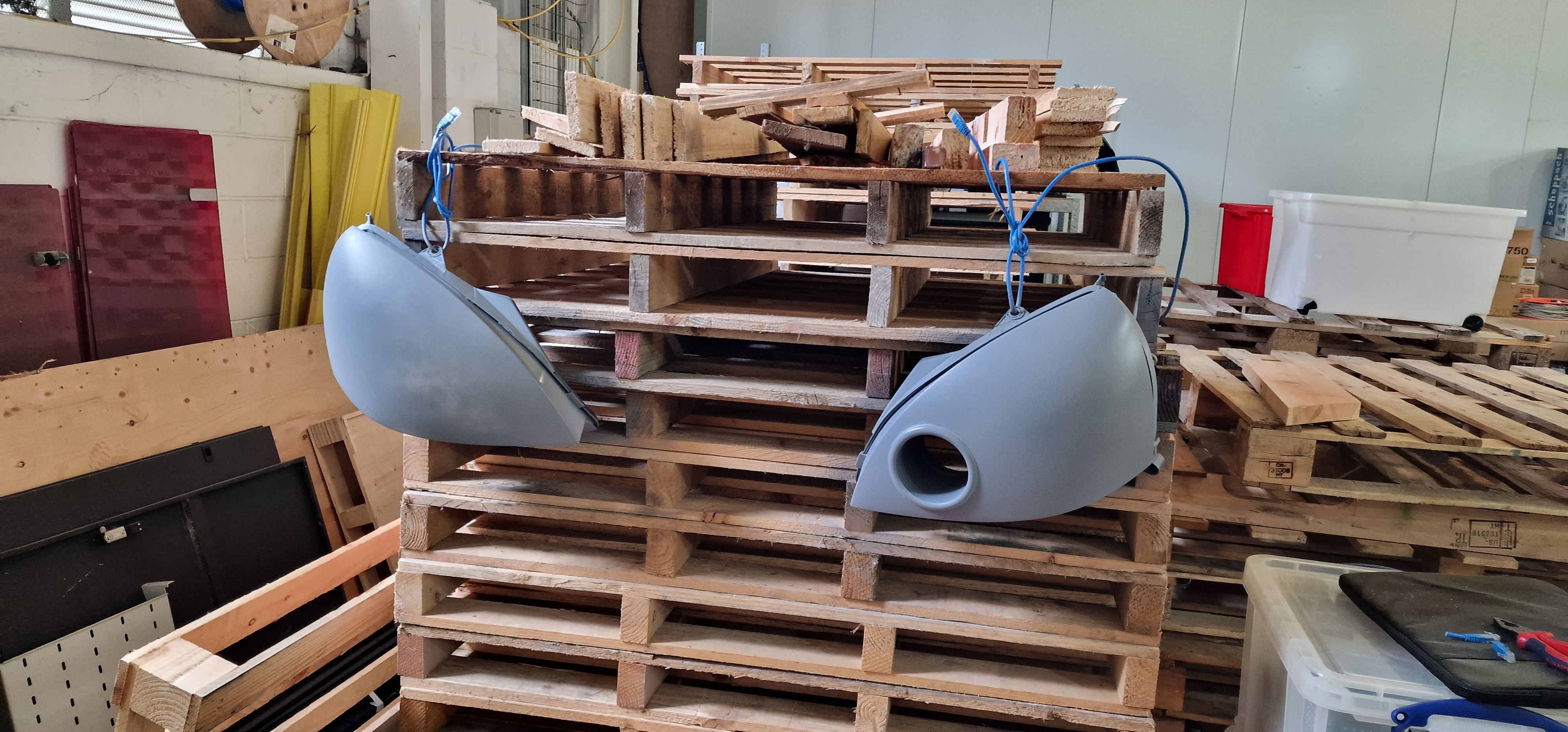

Anyway, headlight blanks. I've got a pretty mint set of black insert xenons so I wanna keep them mint. Headlight blanks for track it is
Cut the backs off some old headlights I had lying about and marked up where I want the 100mm bass port to go
But of fettling and it was in and snug
I used some JB weld and fireproof mastic to seal it in as it's what I had lying about
Primed
Painted in raptor liner as it's what I had in the garage. Fine enough for who it's for

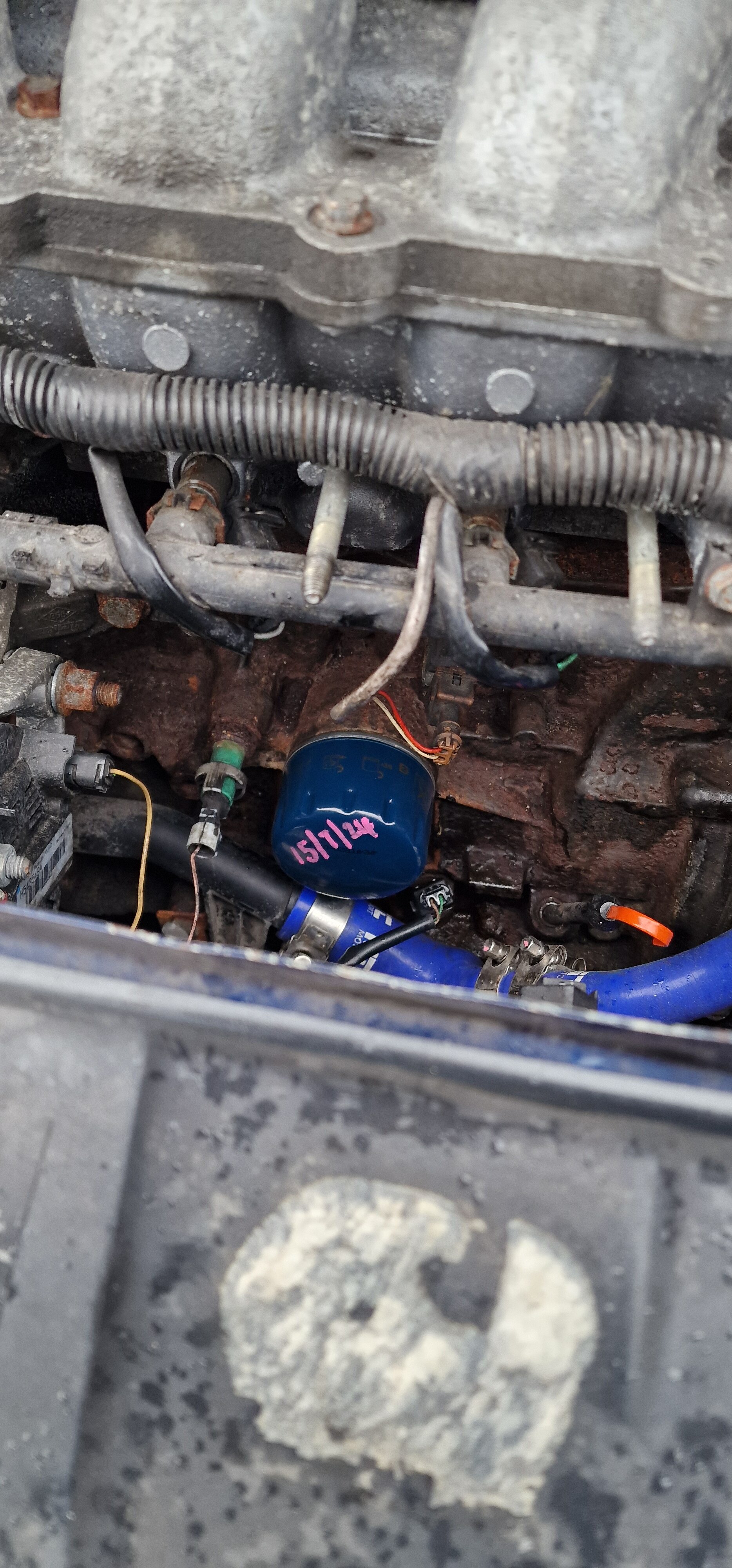

Came home from work tonight and changed the oil. Didn't bother writing the mileage on the filter this time because it's done about 1500 miles in 14 months

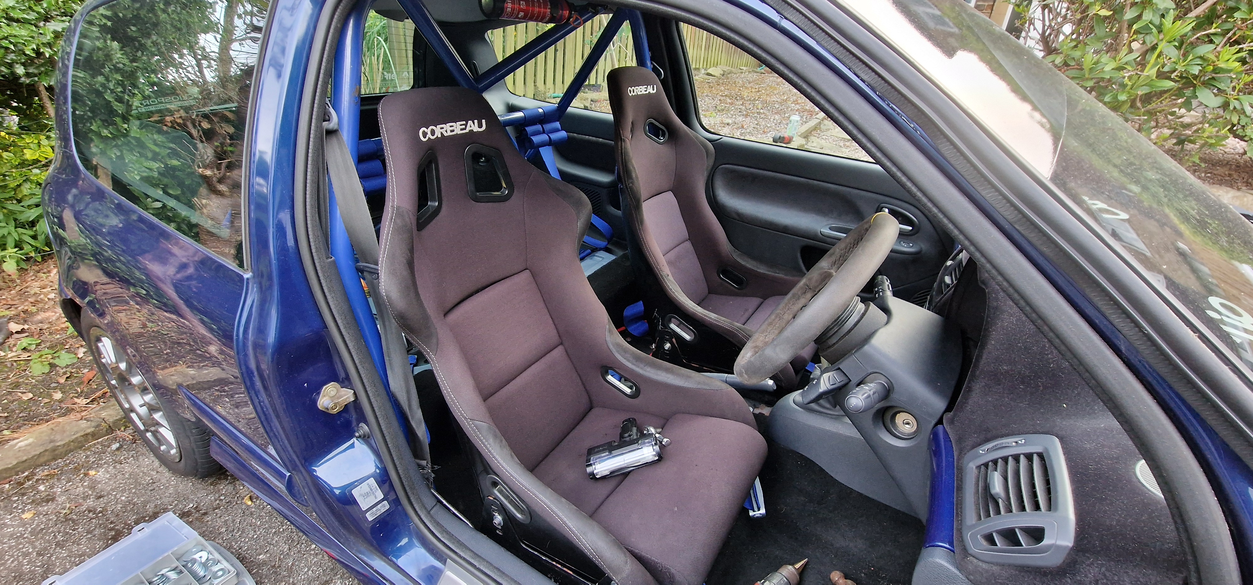

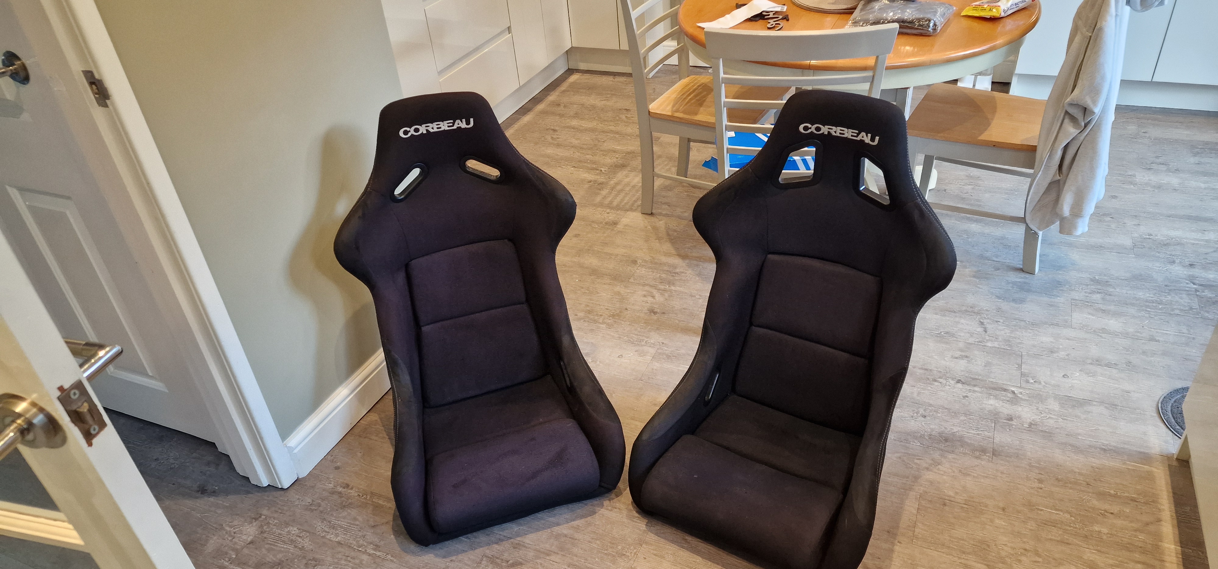

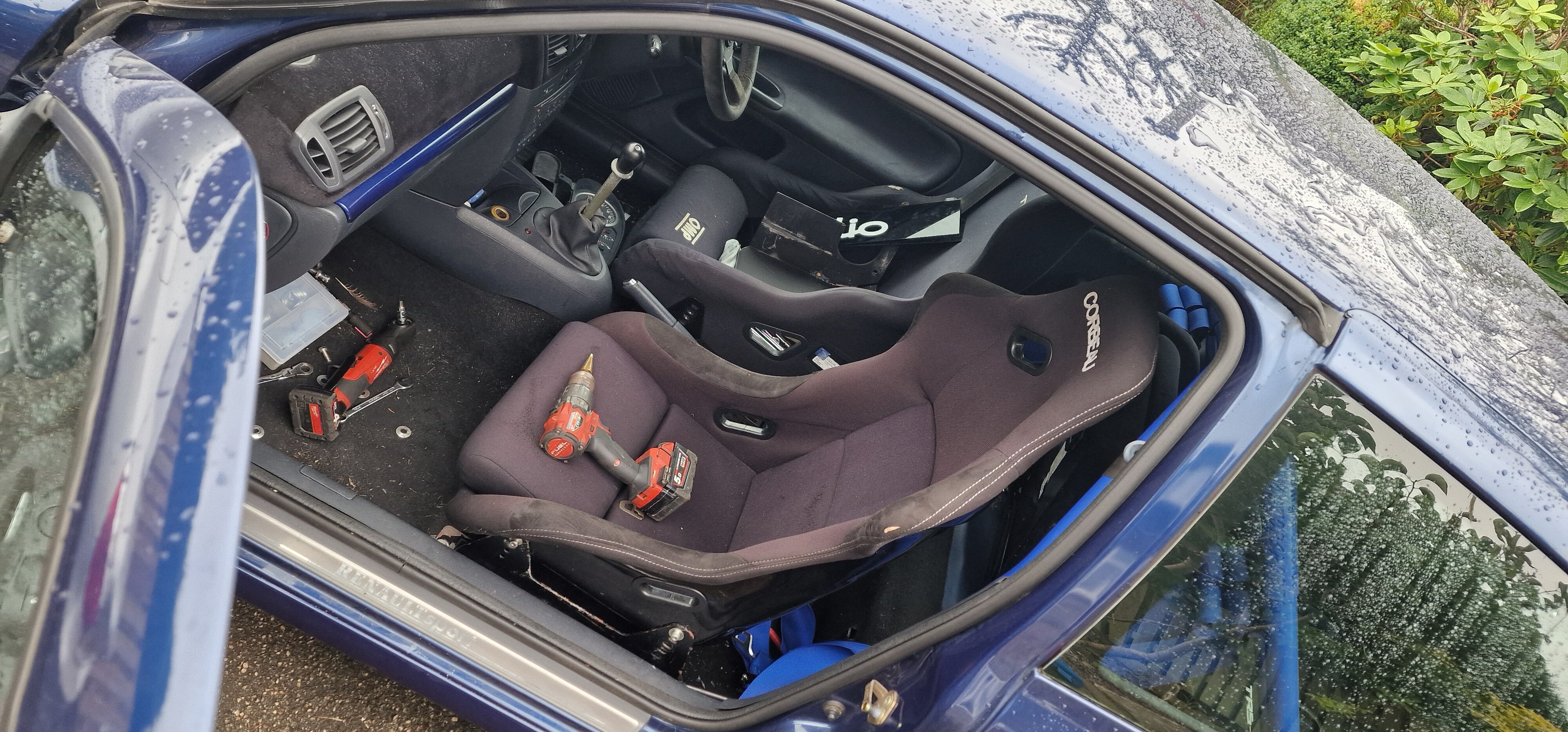

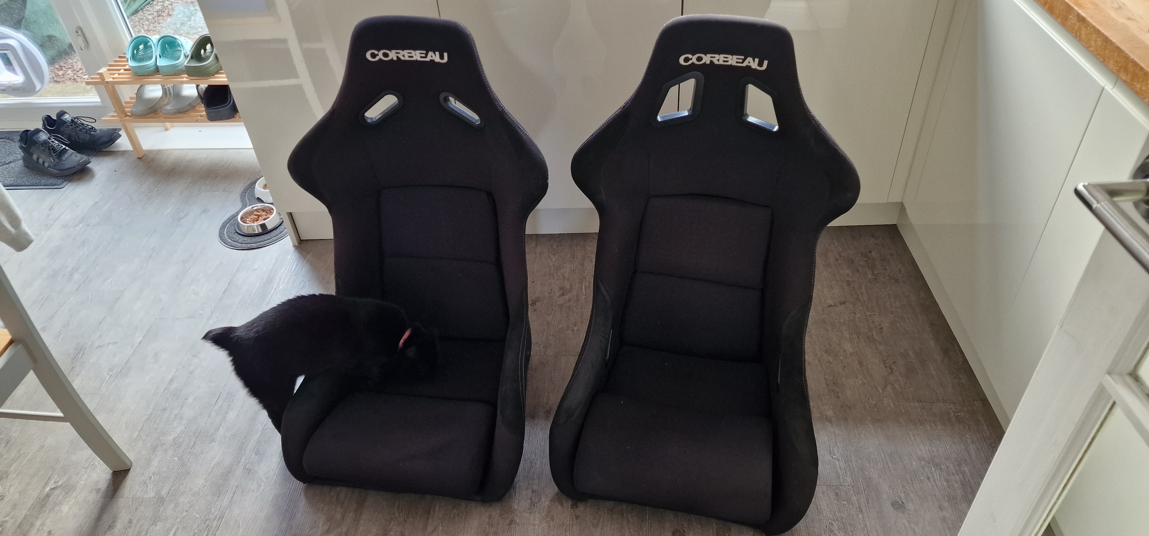

Bought a new pair of Corbeau clubsport XLs about a fortnight ago
Gave them a good clean and they came up alright
After changing the oil I cracked on and managed to get the passenger side one done before it started really raining. My Jon Foz frames that are supposed to be universal fitting that aren't universal fitting now have more holes in
Fits loads better than the OMP seats

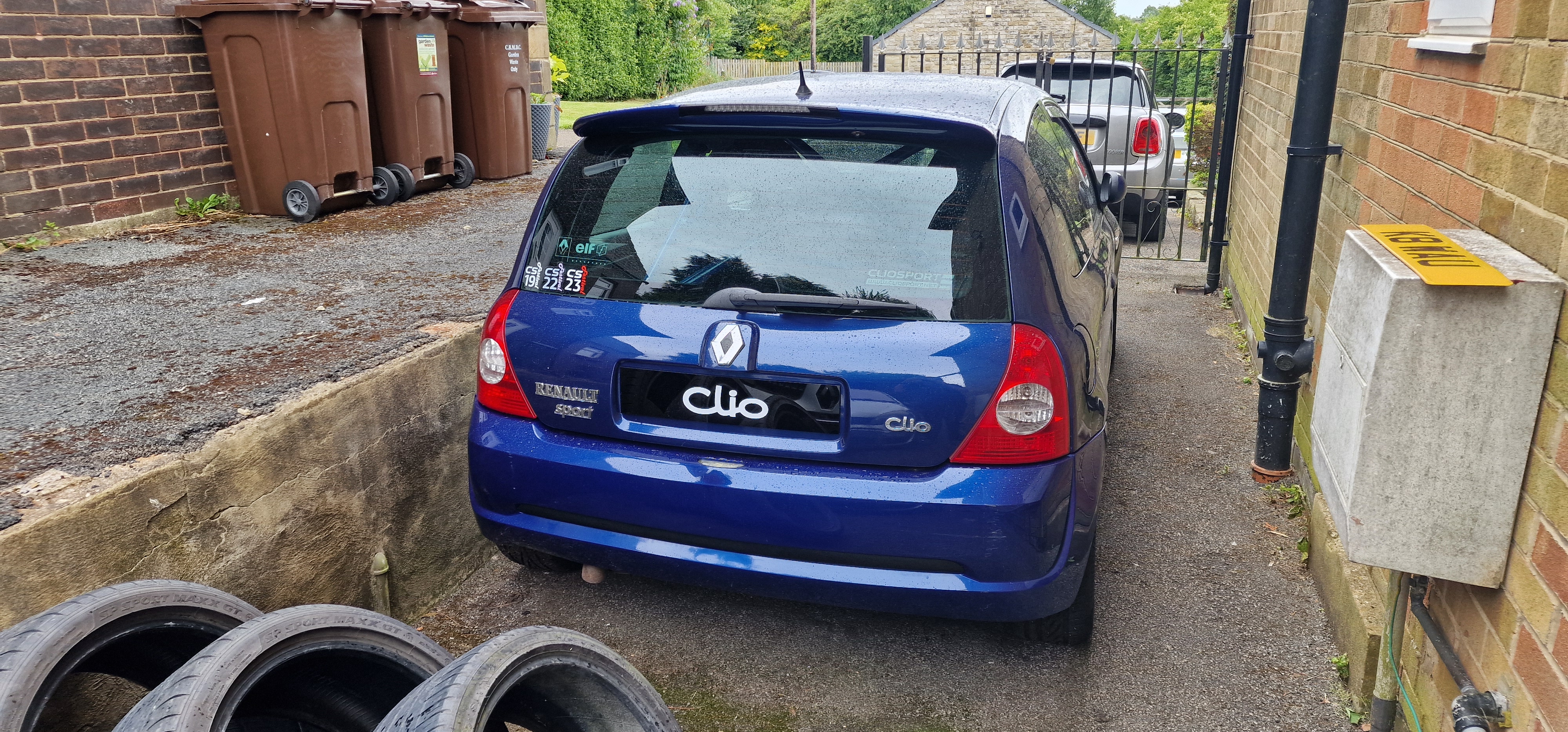

Made up some Clio plate blanks too for when I pull the reg plate off

Came home last night and cracked on with fitting the drivers side bucket. Got it all hunky dory and happy with the seating position
I made the passenger one match too because it felt a lot better a bit lower down with a slight amount of rearward angle. A nice edition is that my doors shut easier now🤣
