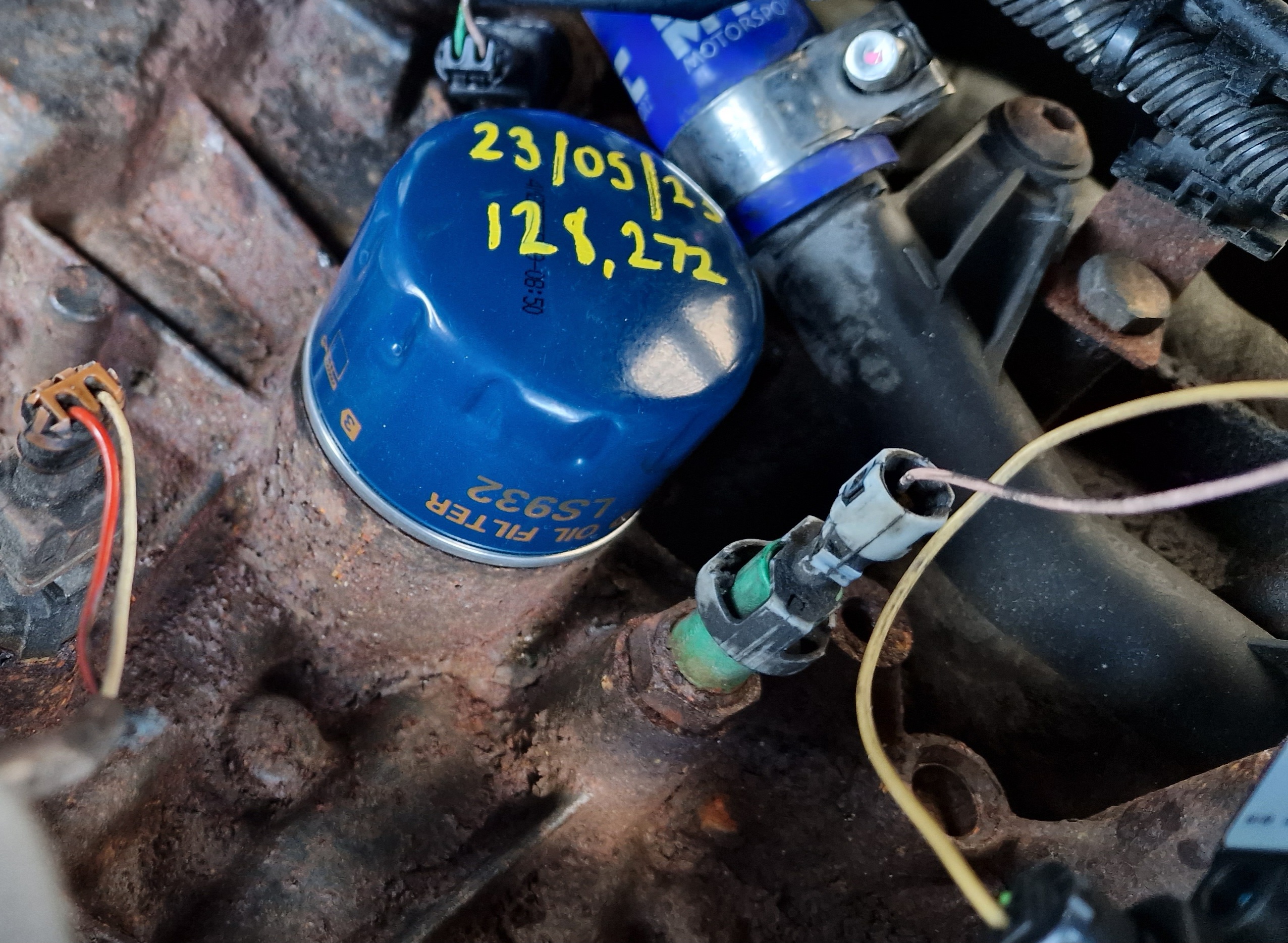

Gave the car an oil change yesterday. She'll 5w40 and a Purflix filter
128,272

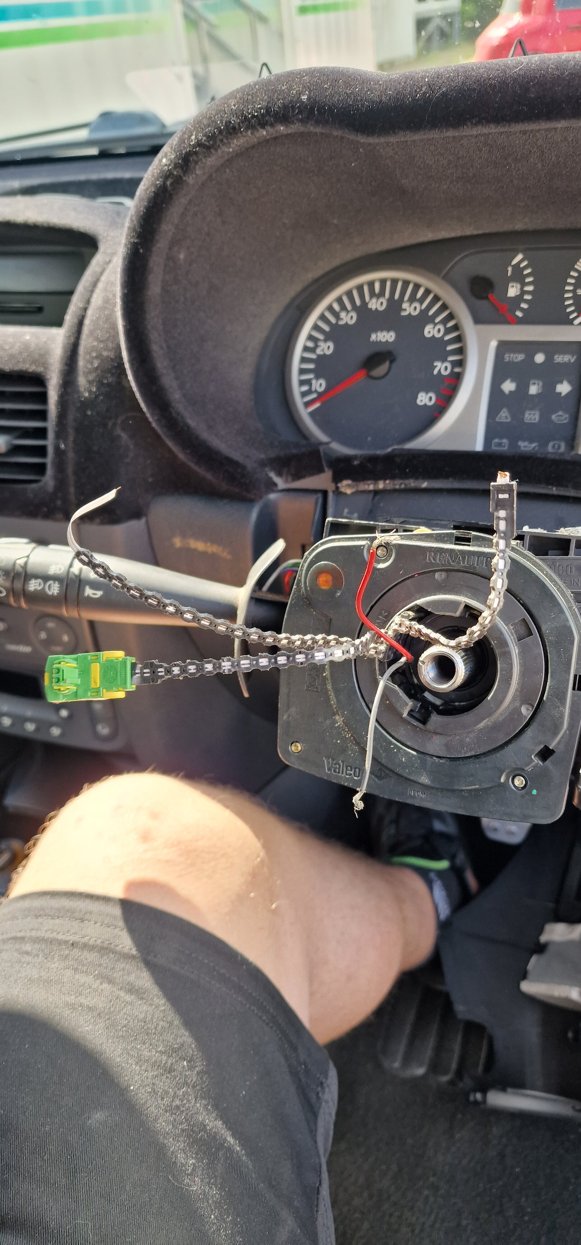

I need to put my new steering wheel on anyway so I might as well sort 3 issues at the same time. My clock spring has been out of calibration ever since I've owned the car🤣

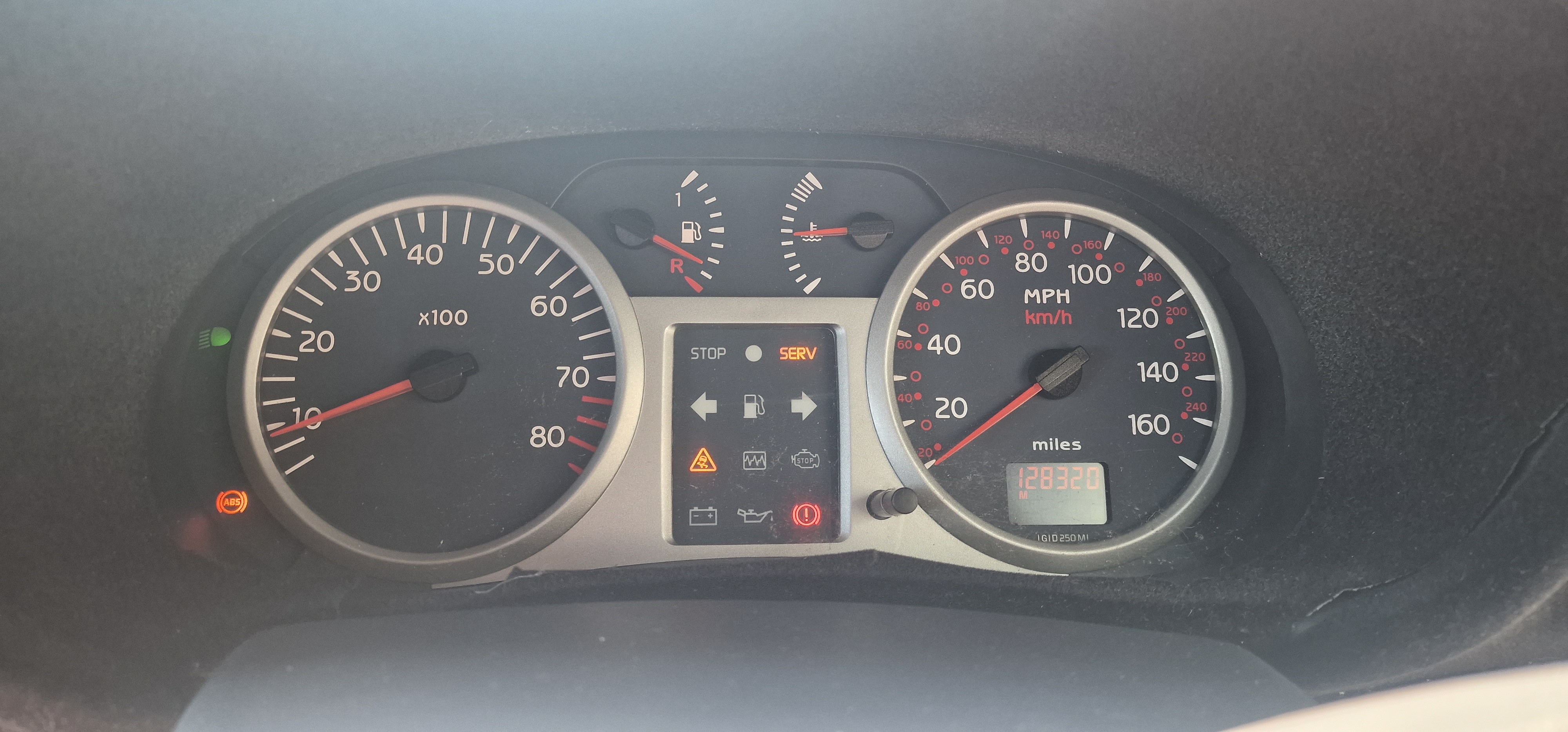

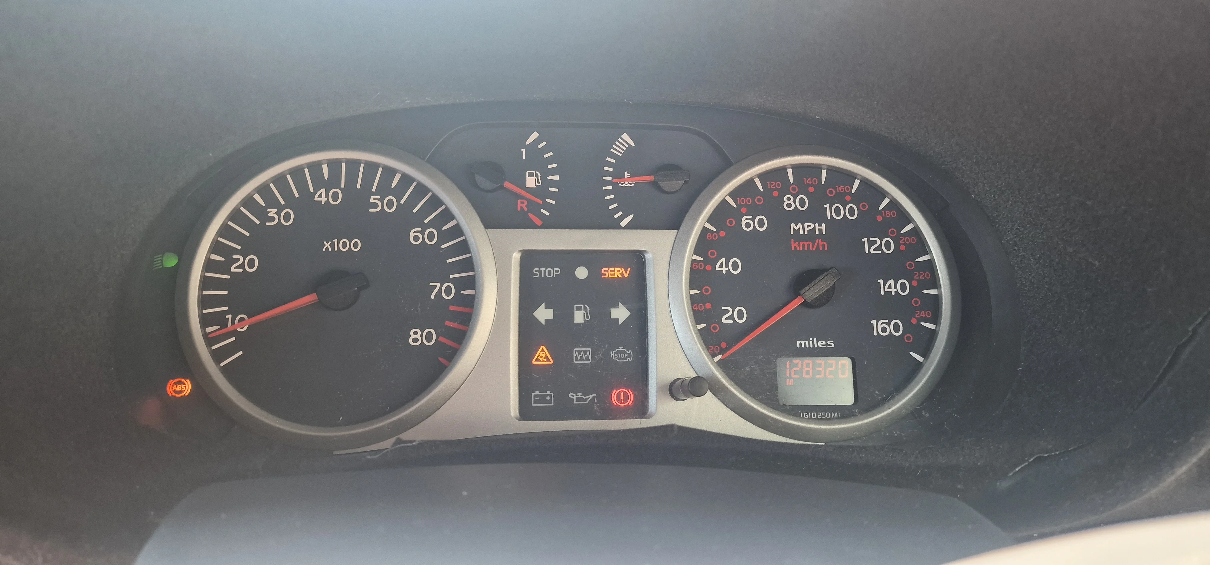

So the other day after my MOT the ABS light randomly came on and the squib started to make a weird clack. Annoying, but gave me a good idea of what it's like with no ABS or TC. Because it's currently on s**t tyres it drove awful, I can't wait to see the back of these! (If anyone has a decent set of 205/45/16 please message me)
Christmas tree

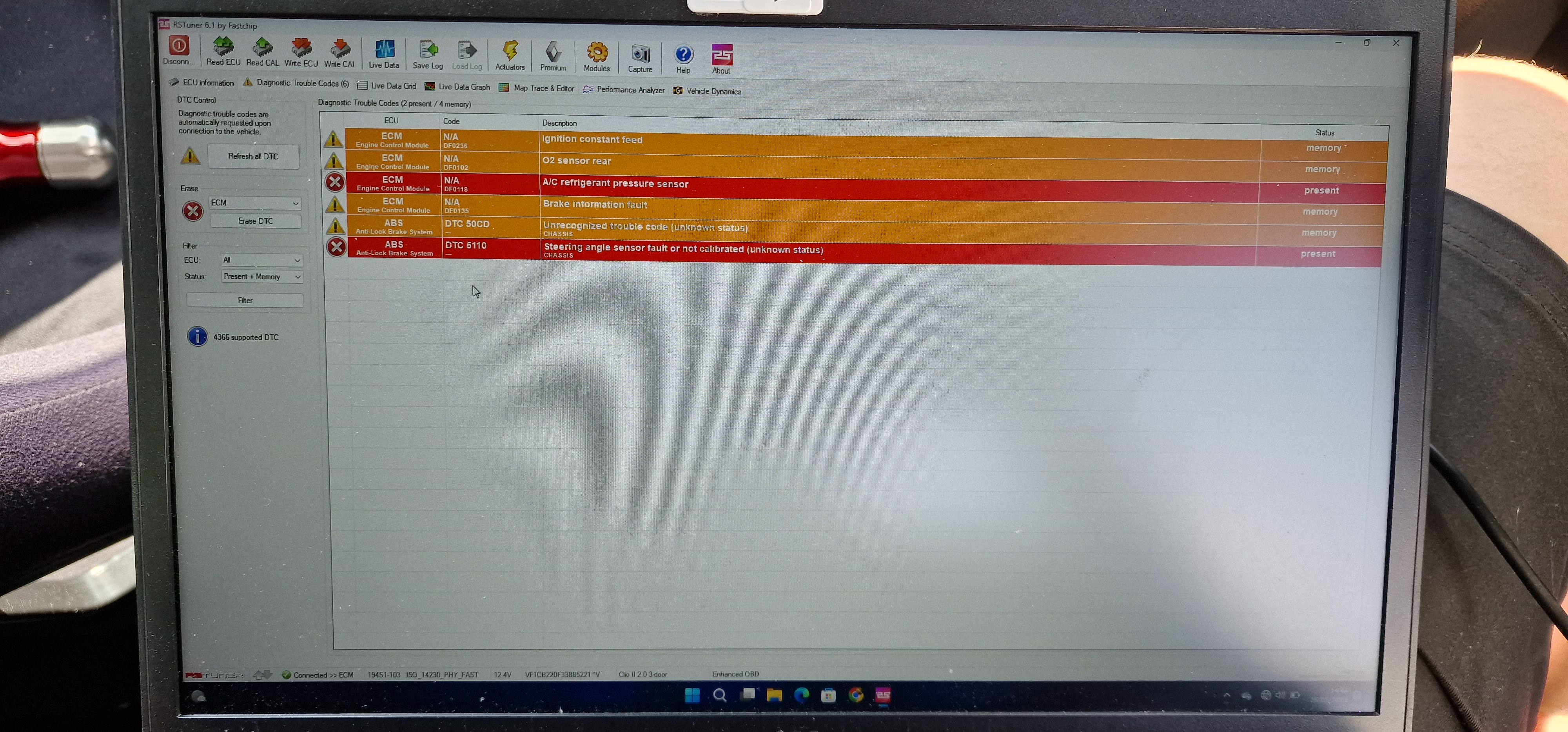

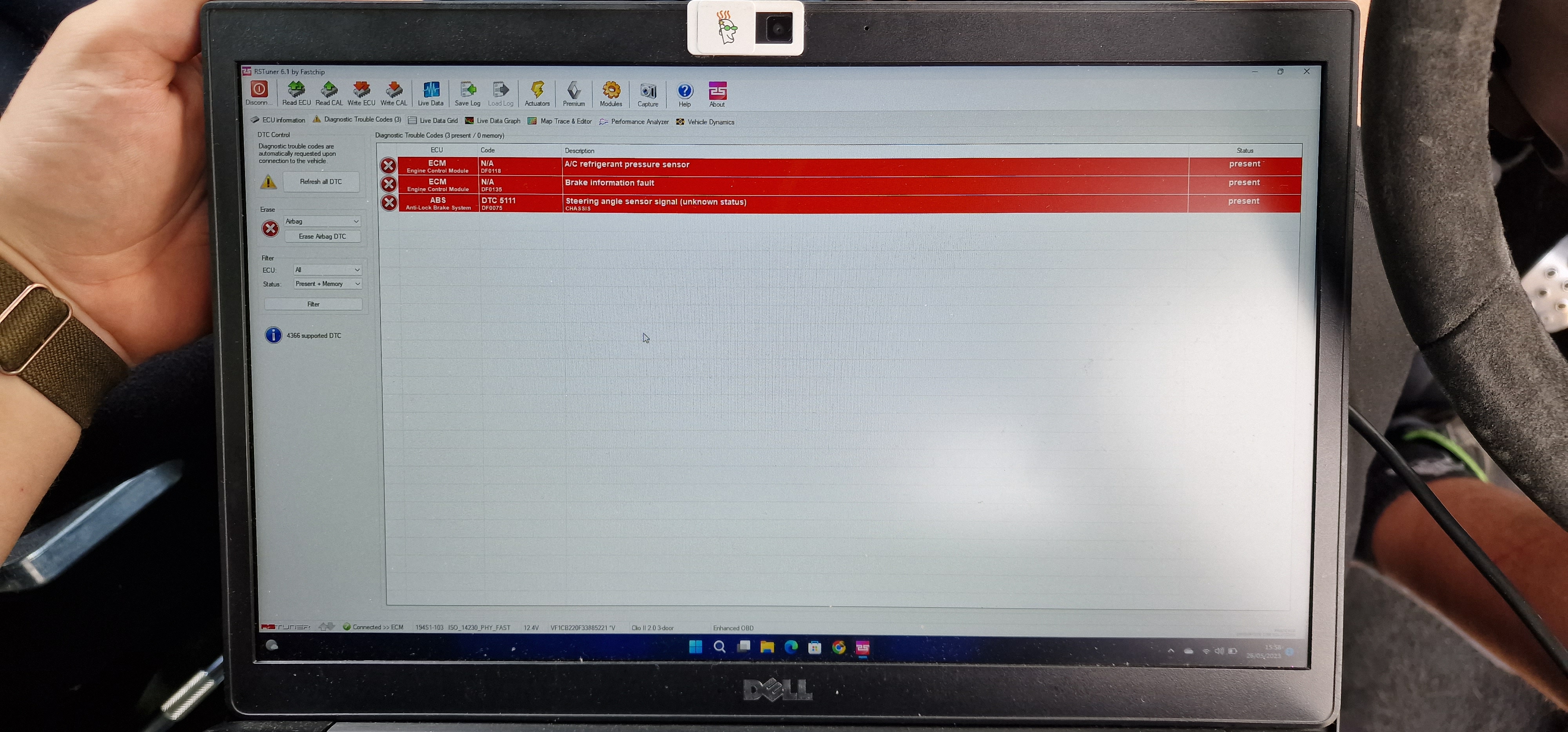

All the codes

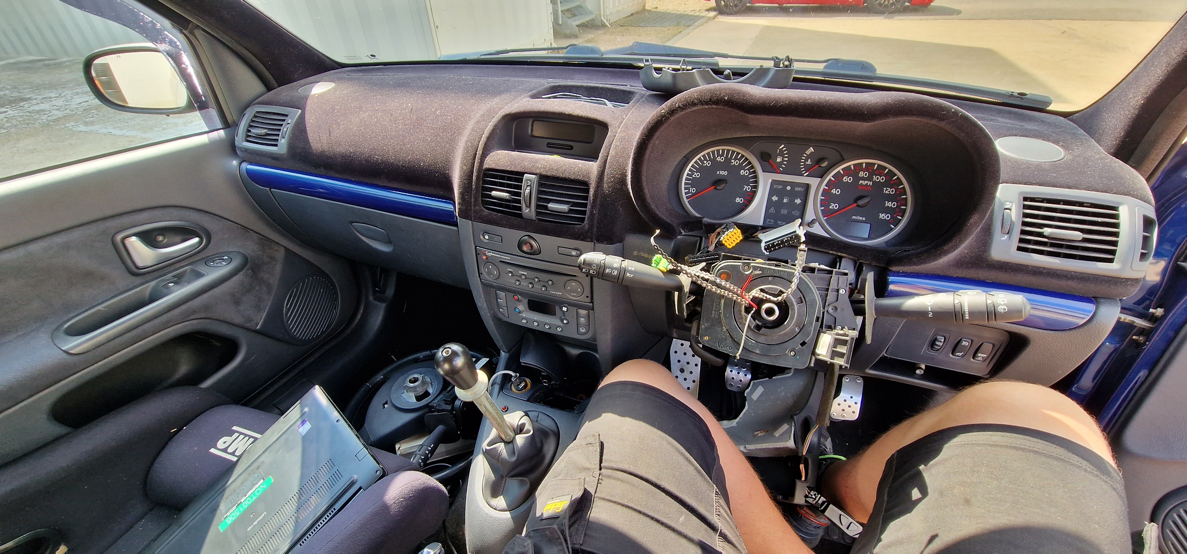

I originally thought it was the squib at fault, I know the angle sensor has been uncalibrated ever since I bought the car but thats never bothered me
I set to ripping the old squib off and the old angle sensor, just to see if I could trick the car with a fresh angle sensor
I used an old shitty squib with cut wires, it'll become more apparent why I did in a minute (I just taped these up for now)
A quick code check... Did it work?
No, but oh well it was worth a try anyway. Gonna need CLiP to reset the angle value on the steering angle dangle sensor

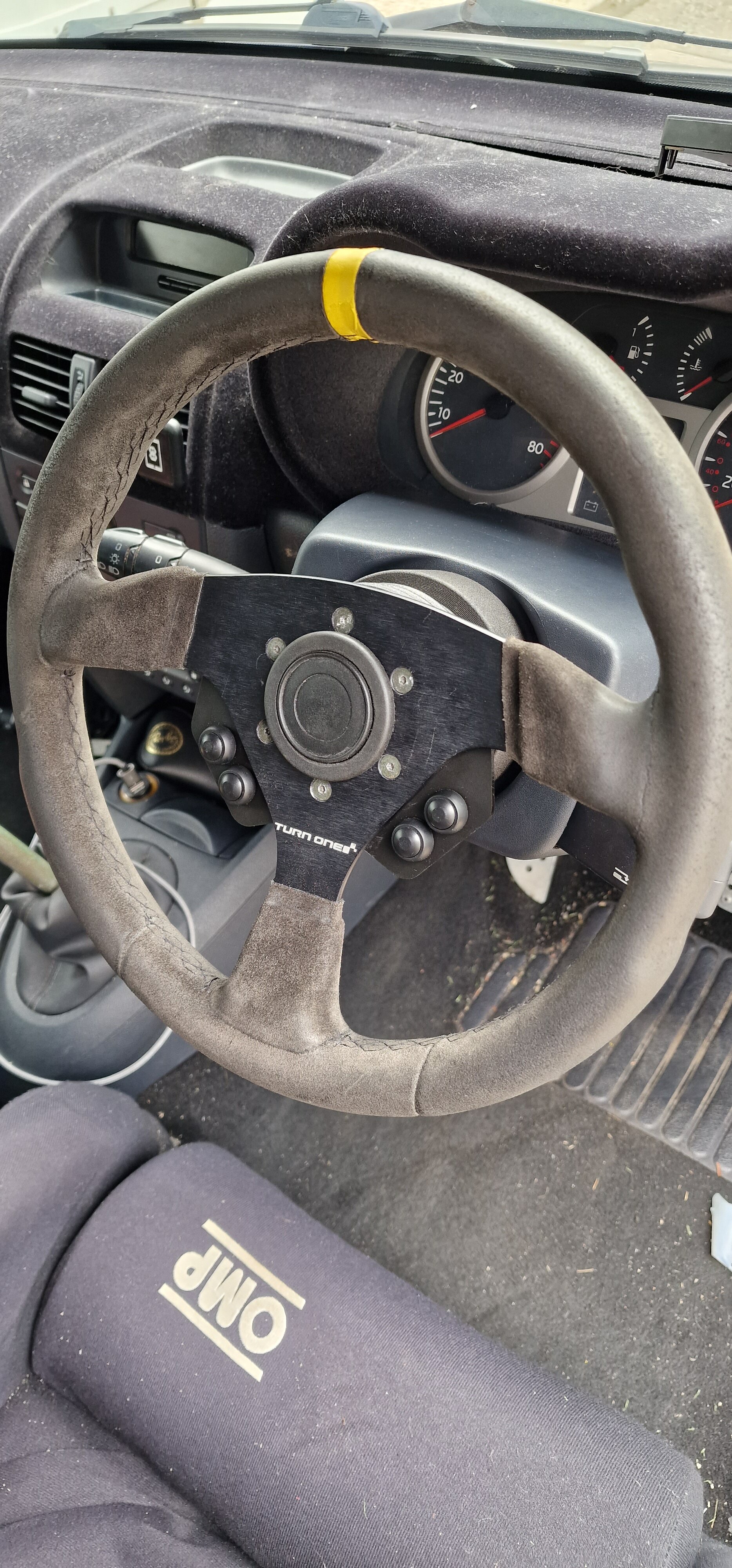

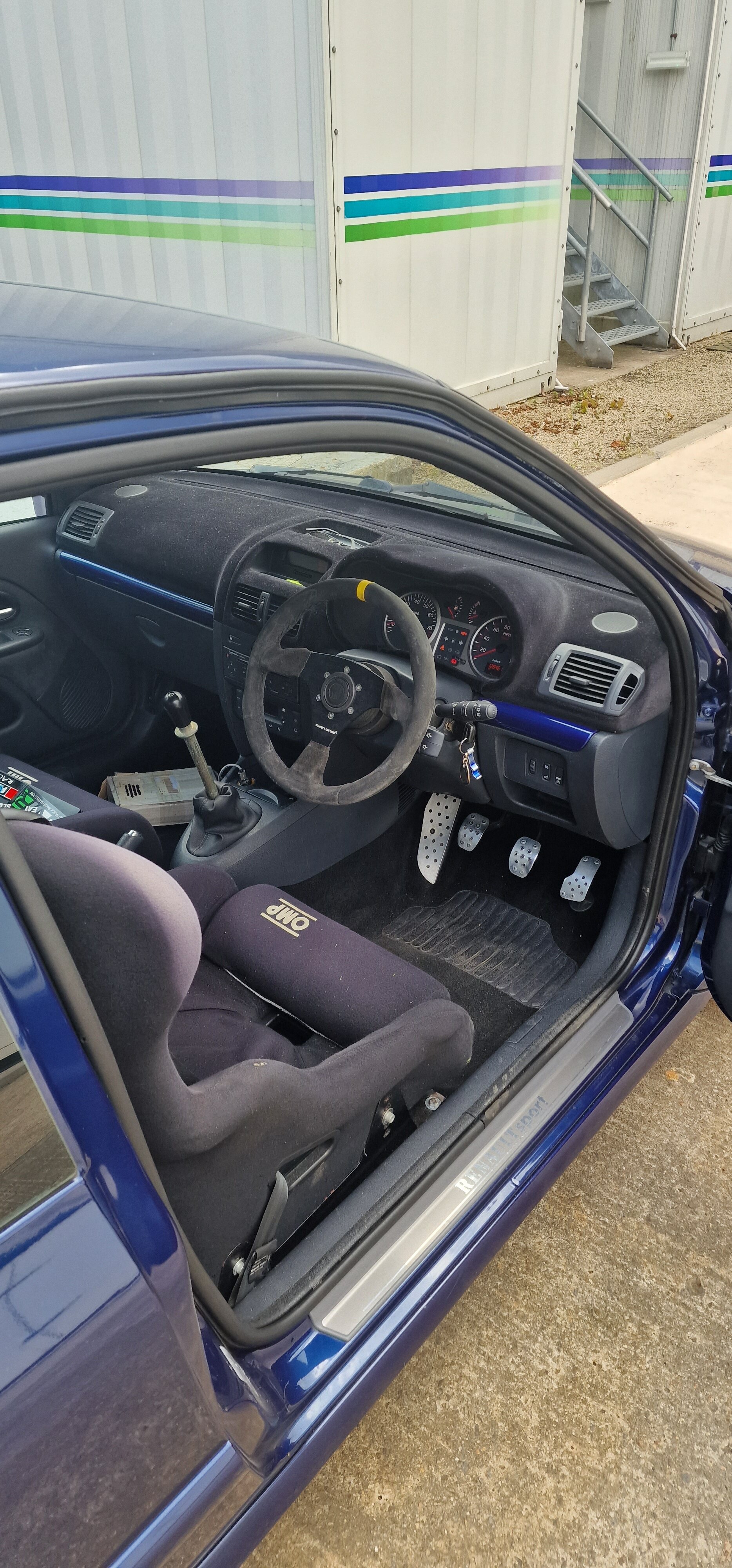

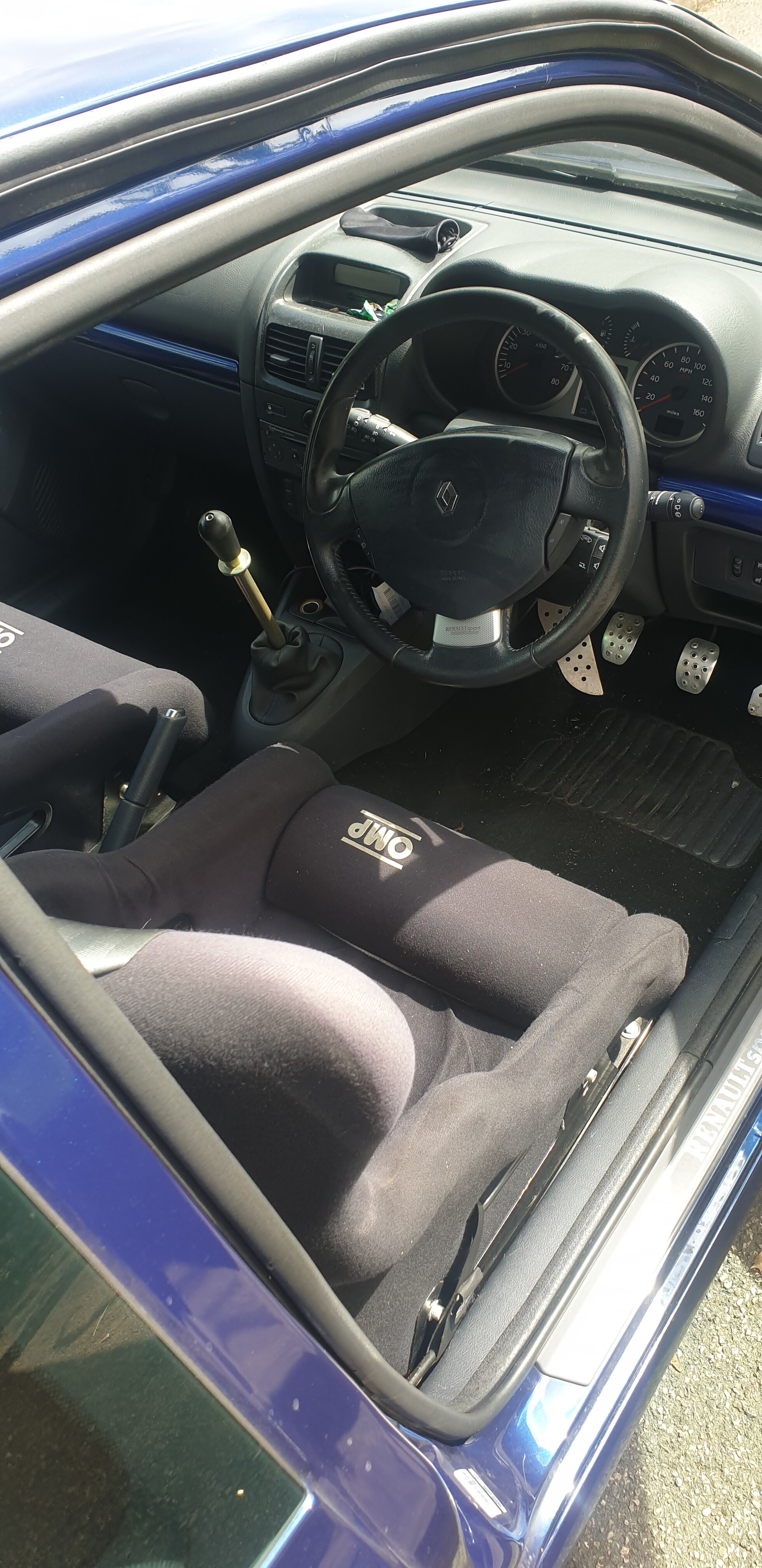

The main reason I was in there was to try and rid the car of all it's codes. Whilst in there I wanted to get rid of the awful coach steering wheel
Before
After
Feels so much better with the smaller wheel in, big thanks to @scalino65 as the wheel and boss are in great nick. I need to order a wheel cover to stop it going all manky

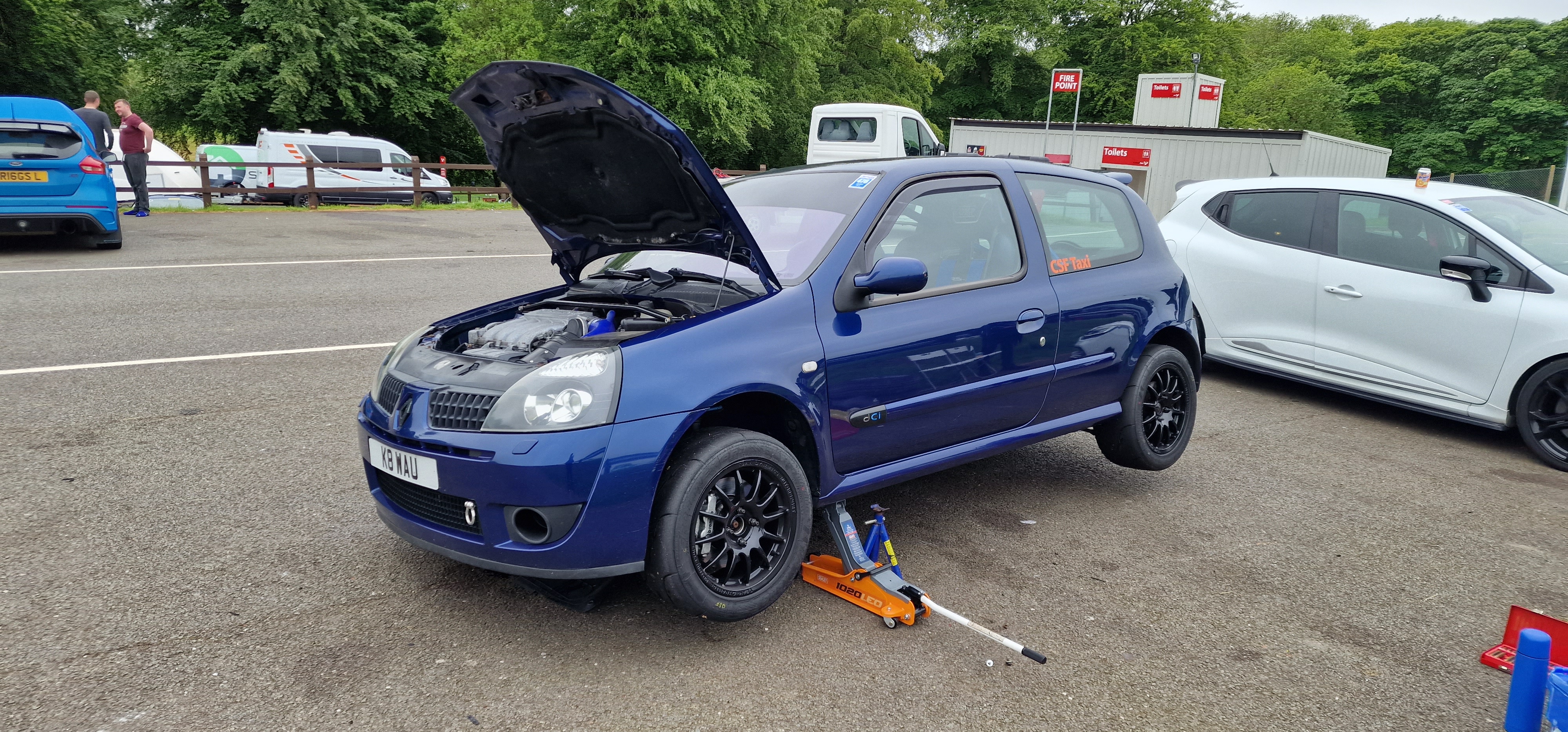

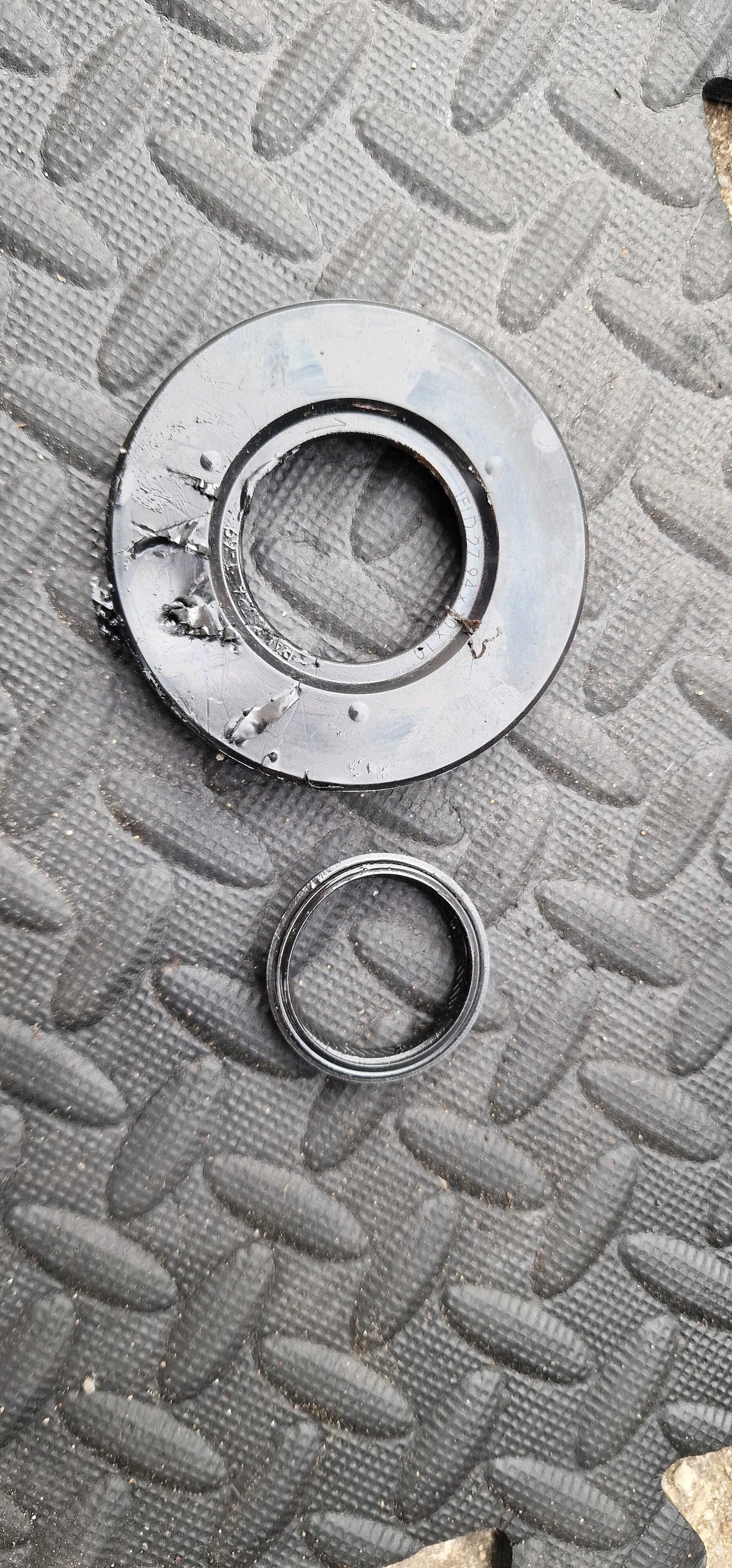

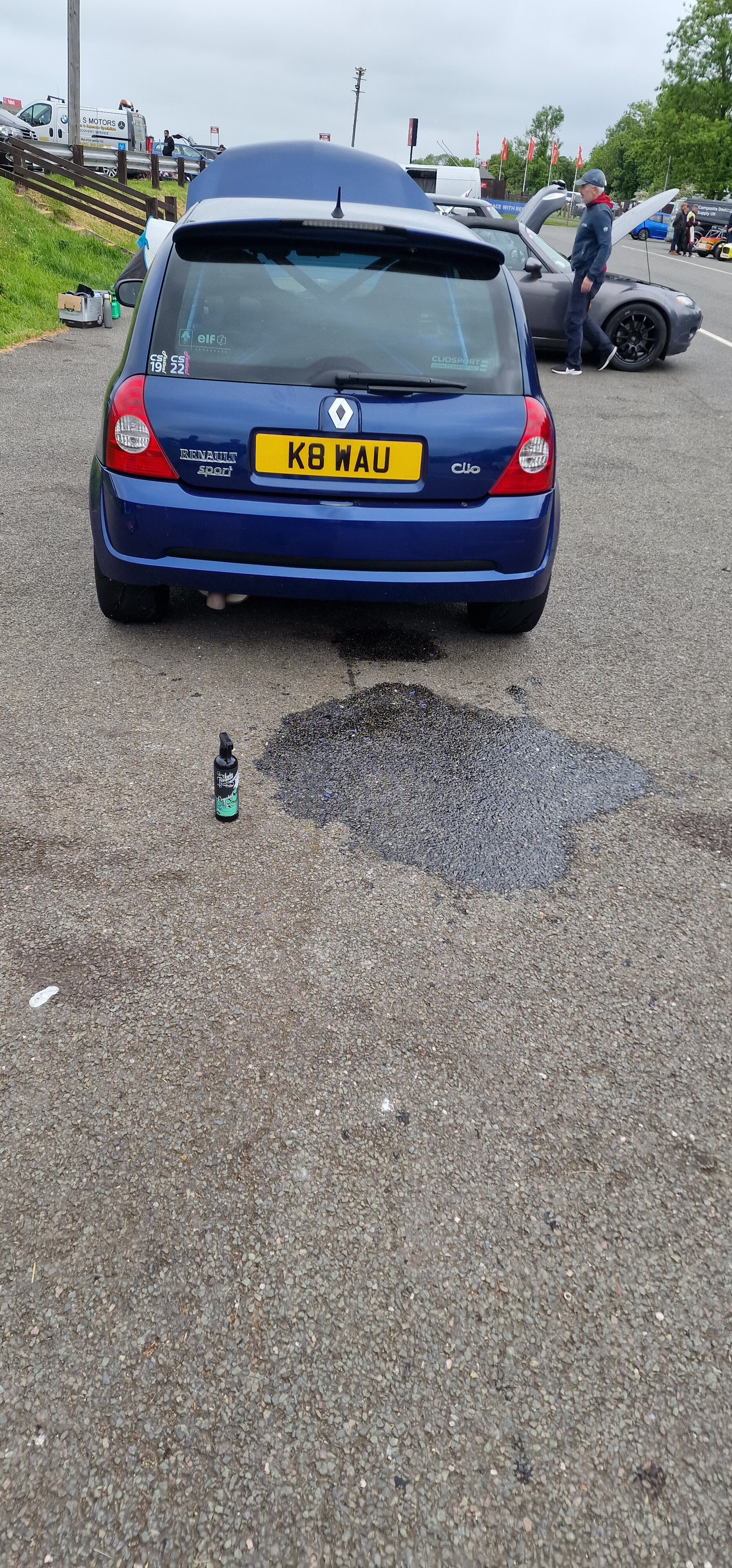

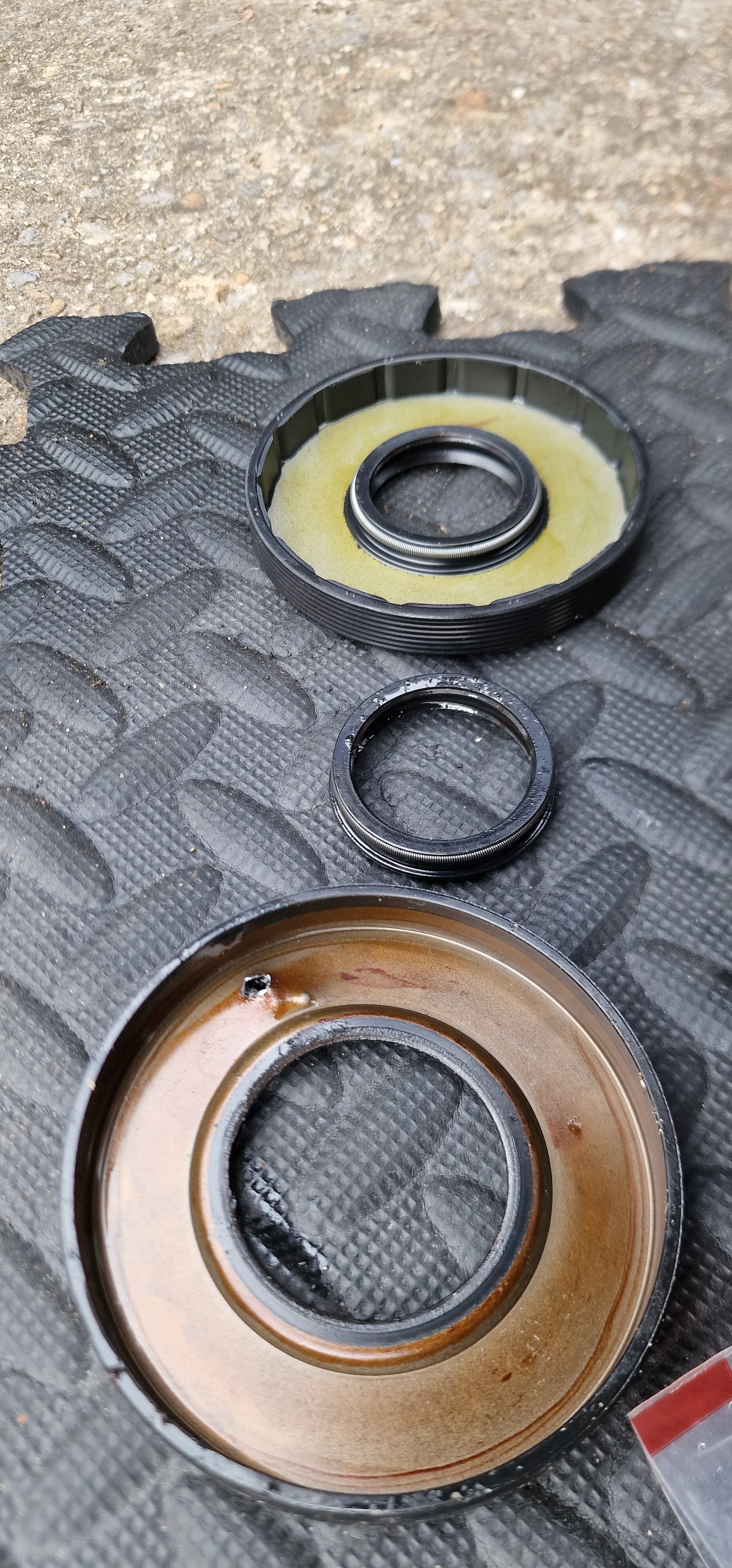

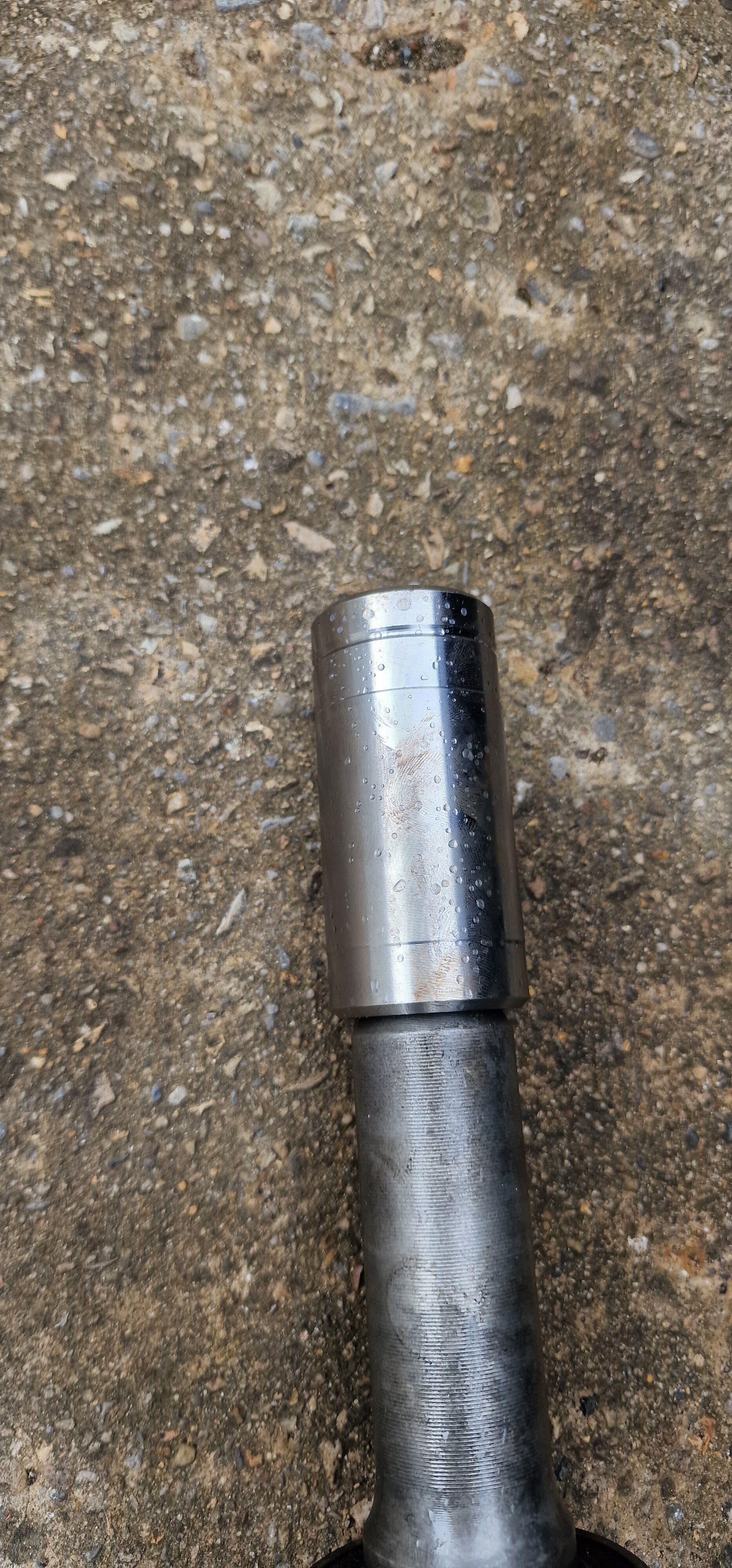

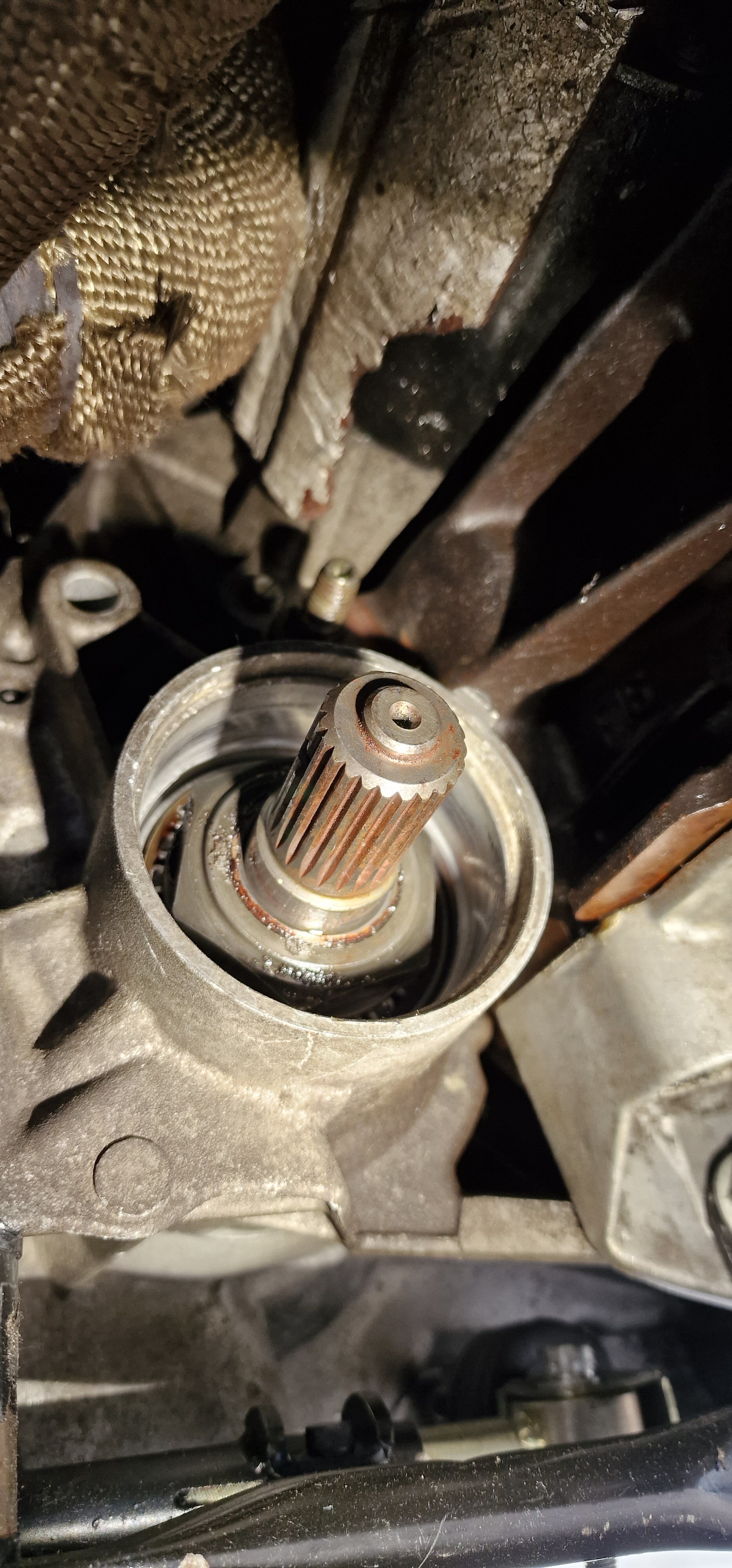

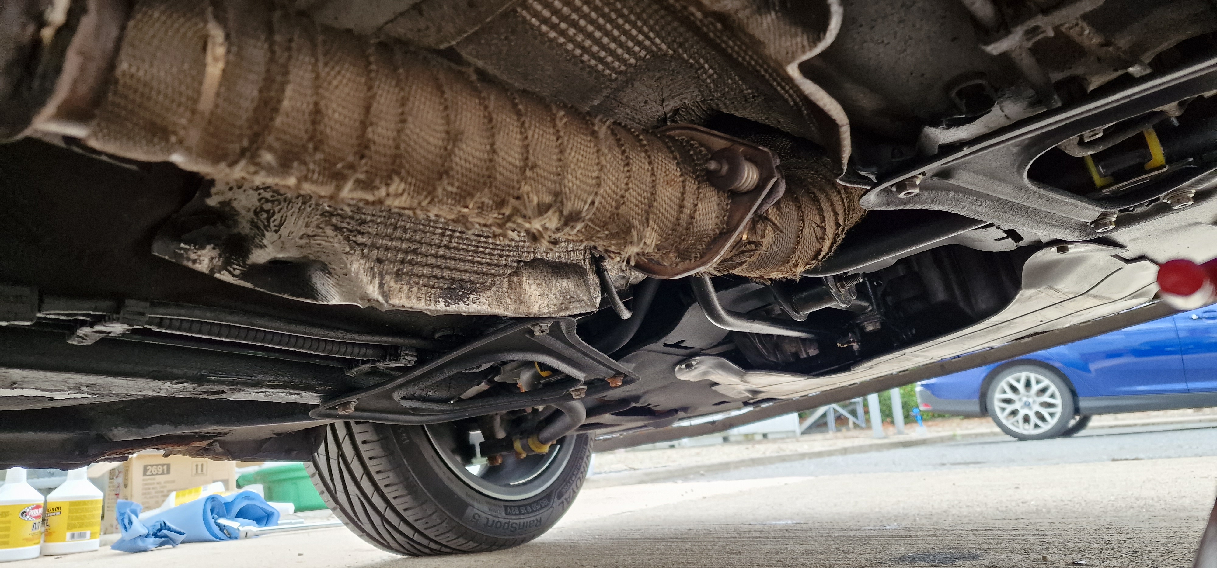

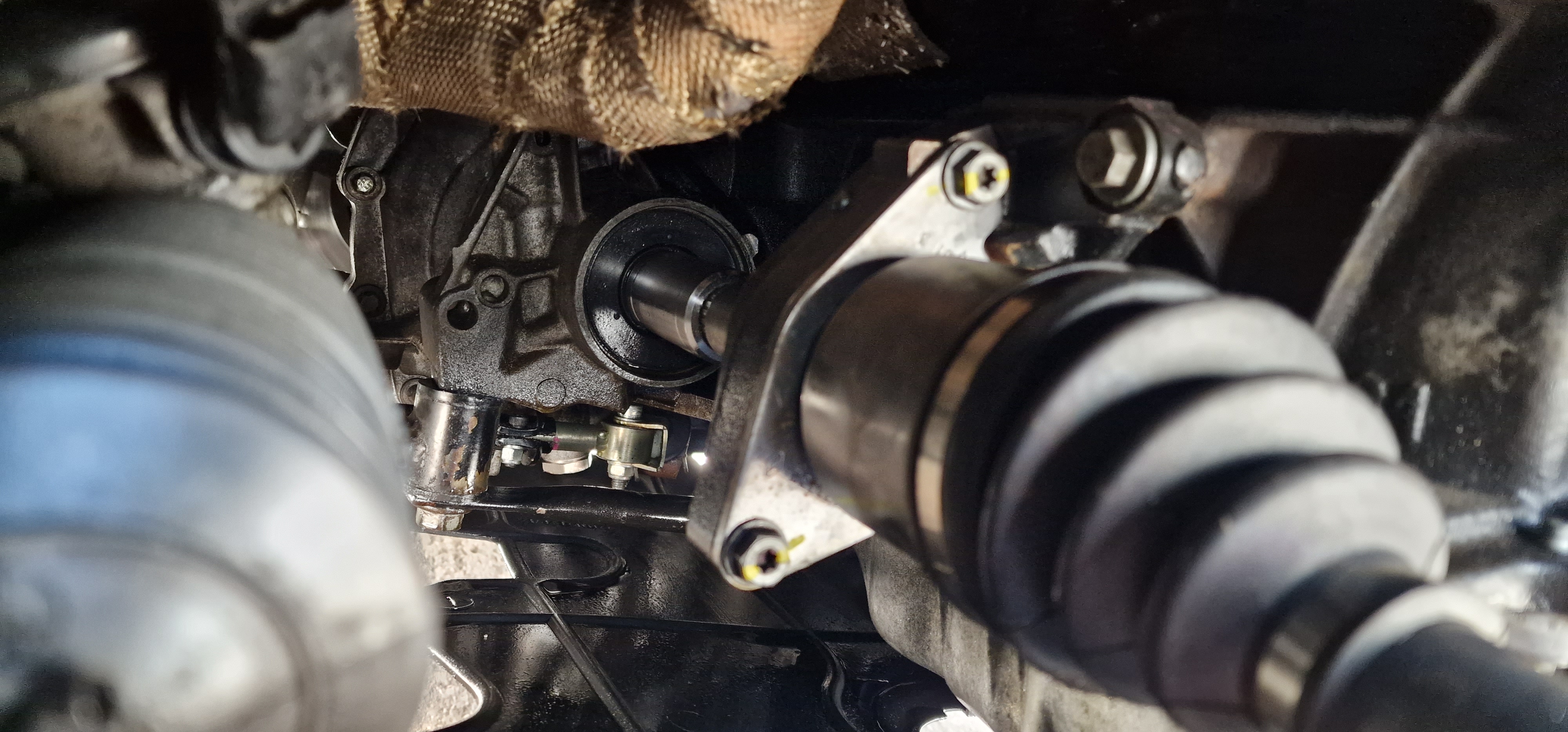

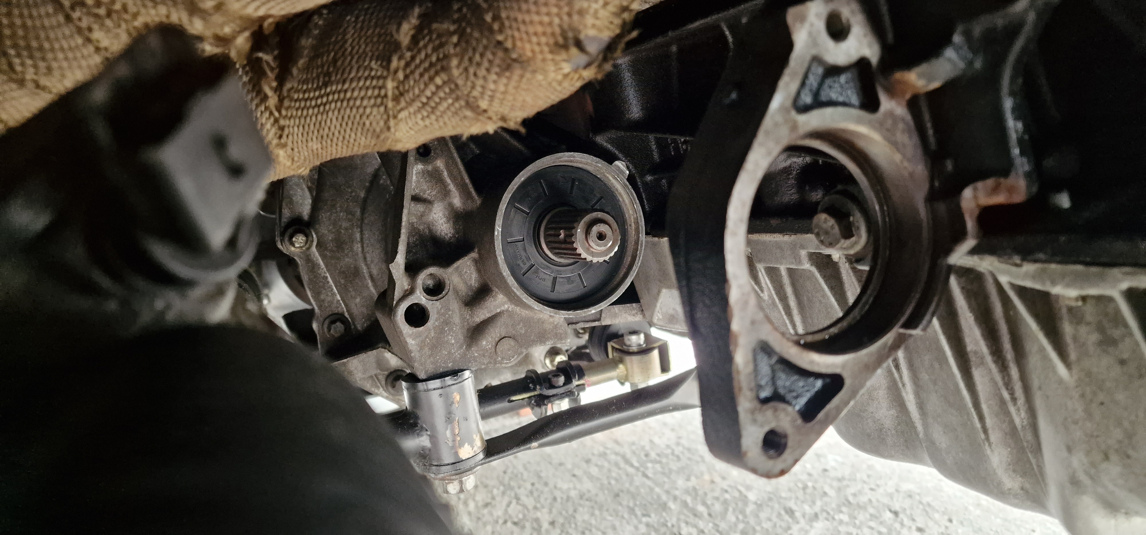

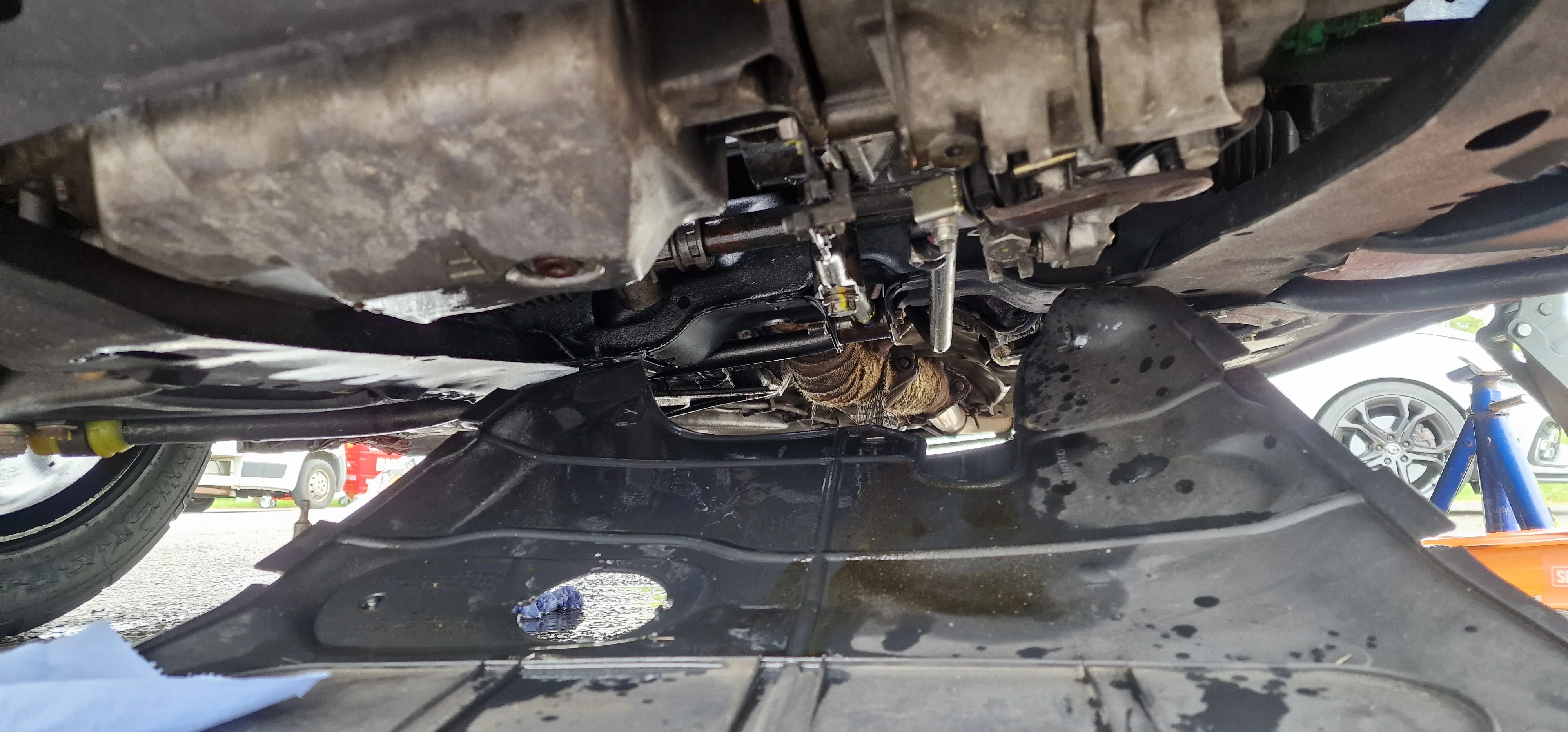

So after the let down at Cadwell I parked the car up and set about diagnosing what had gone wrong. It was clear as day to me that there had to be an issue with the diff seal on the driver's side, the reason how was still beyond me. Getting underneath I could see what had happened
It's hard to make out from that picture what had happened but the sleeve that connects the output shaft from the diff to the driveshaft has slid away from the driveshaft. It decided it wanted to be inside the gearbox, you can just about see the splines if you zoom in
Shaft coming out. Once out I twatted the sleeve down the splines until it was hard up against the shaft like so. It had moved at least 10mm
Which had caused this to happen
The seal is 1 piece, the sleeve had smashed the inner part out of it which caused the oil to piss out
Old seal out. Gave everything a bit of a clean after this picture
New seal in

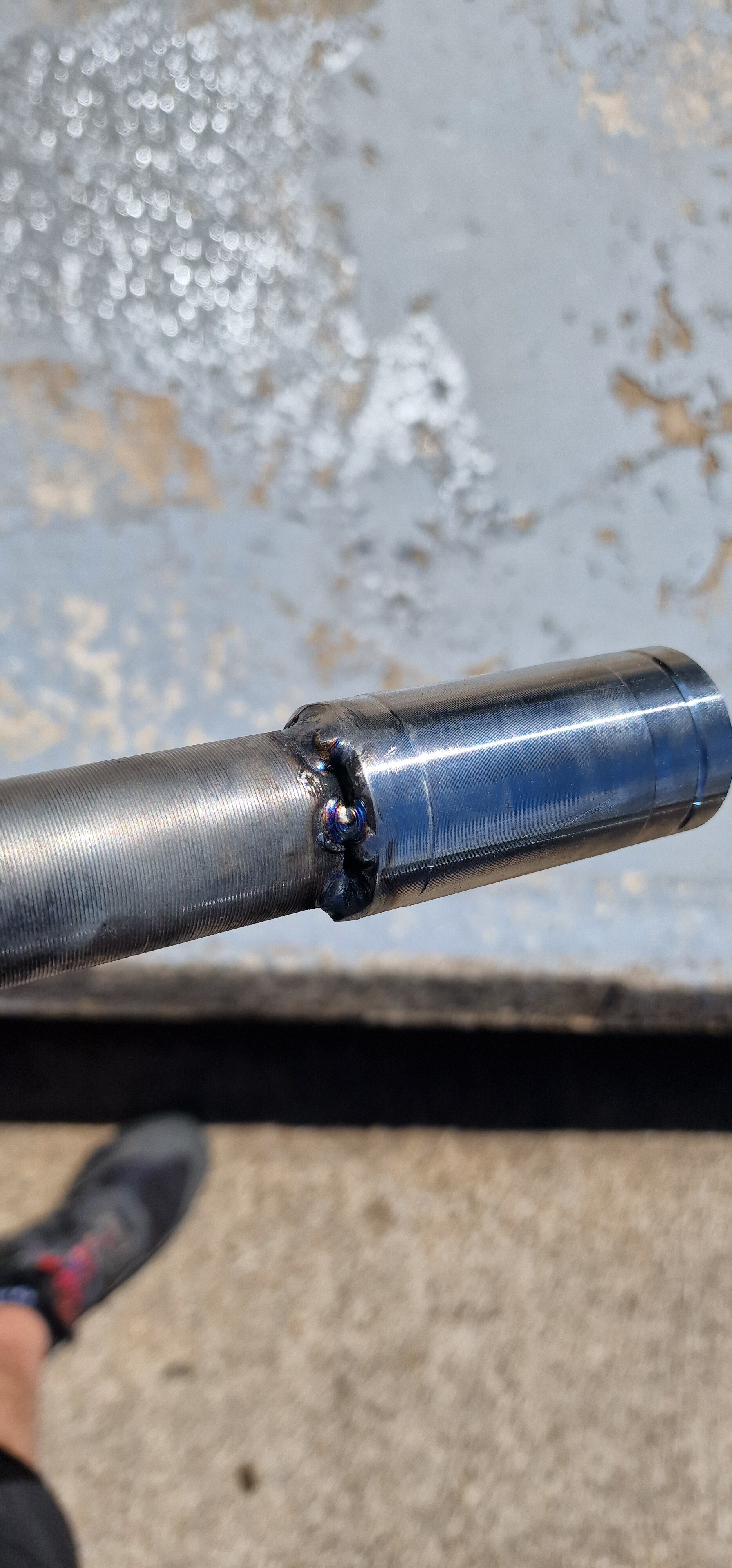

I took the driveshaft to my dad's on the weekend and he blobbed a few tacks on there with the trusty old farmers arc welder. It will win no awards for cosmetics but it will definitely hold
All back together again, I filled the gearbox with ELF NFJ this time, I do have 4 quarts of MTL but I didn't want to throw away £100 over and over and I dont trust the seal not to leak yet. Once it's had a few hundred miles on it I might consider it.
Before I started it up I sprayed a liberal amount of brake cleaner all over my exhaust heat wrap. The seal is right in front of where the manifold comes down above the subframe, when I sprayed it down it came off brown so I'm glad I cleaned it off. Very minimal smoke even after letting it get up to temp
View attachment 1651226View attachment 1651228
New seal in

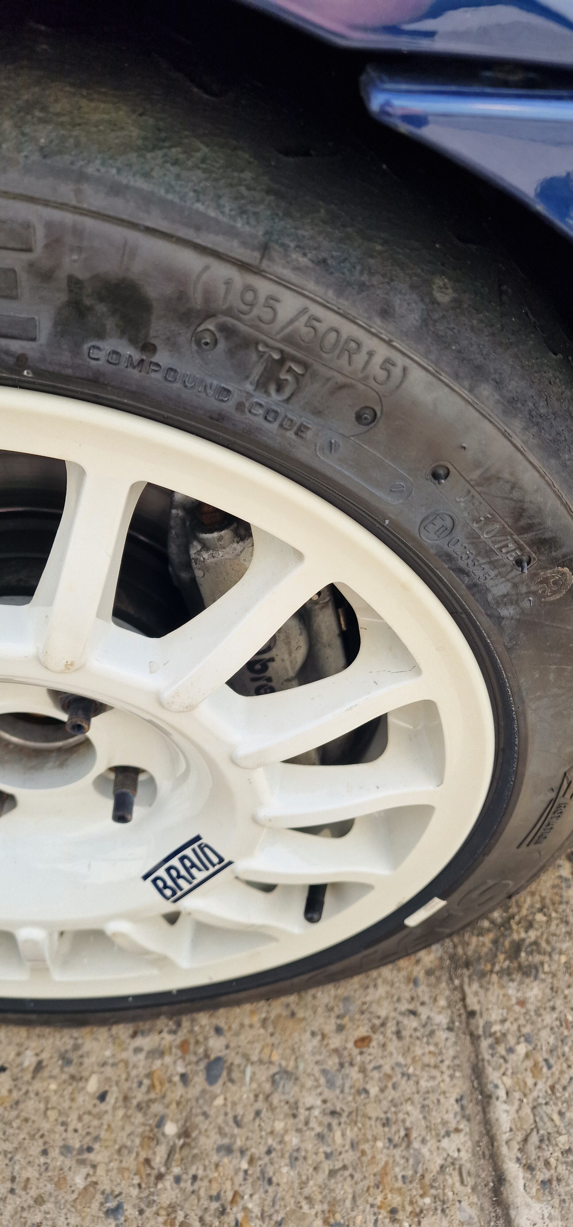

If everything goes to plan I should be picking up some new track wheels at the end of the month. One of my TD 1.2 has a slight crack near the spigot but I can't tell how far it goes towards where the nuts go, not worth the stress
Still need to sort the wheel angle sensor value with CLiP to get rid of the ABS, TC and SERV lights. Heading down to Donington on the 21st so might stop by @MicKPM 👀🤣

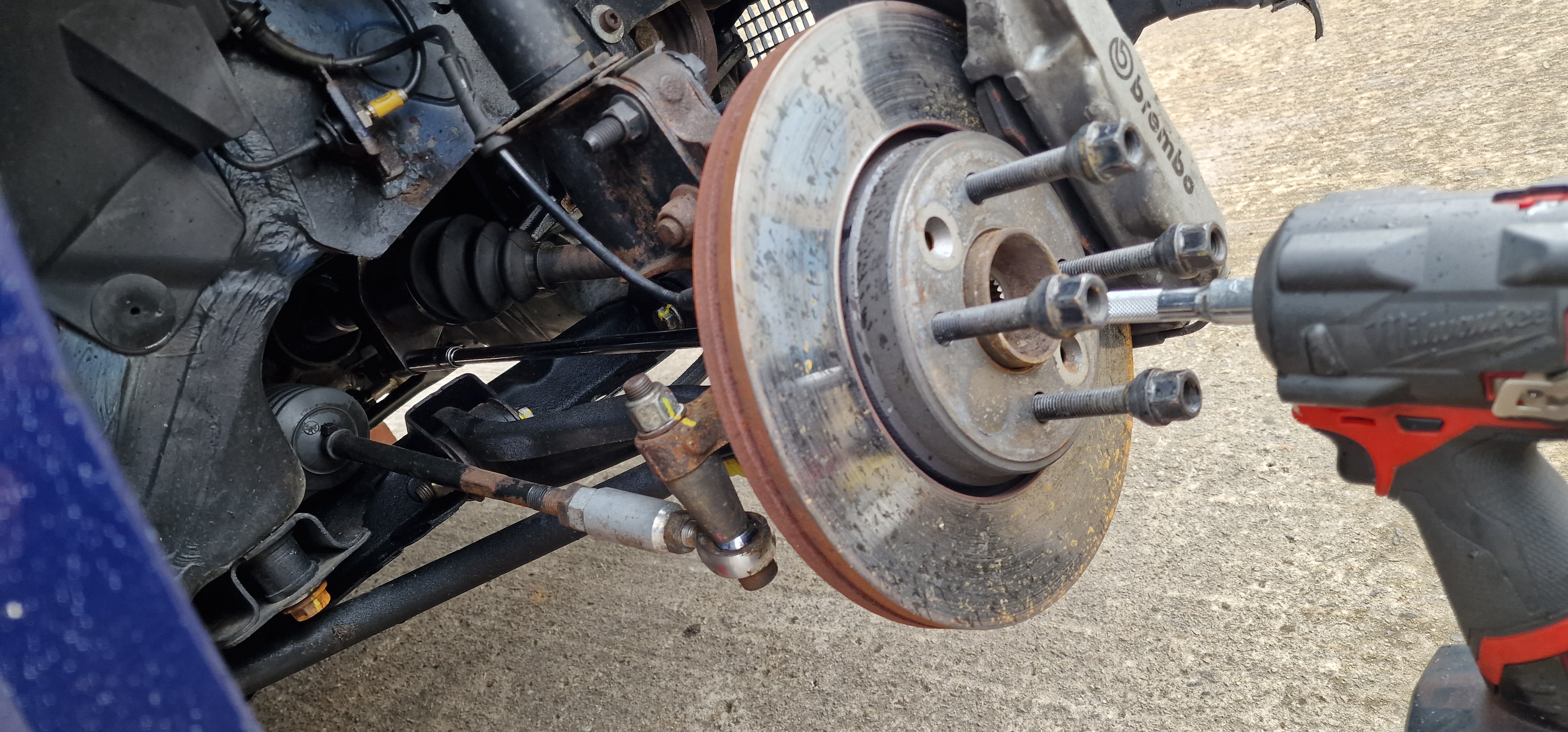

Some of you may know I'm a proper pervert for wheels. Like to the point I have wheels in my garage that don't actually fit my car anymore
So naturally I bought even more🤣

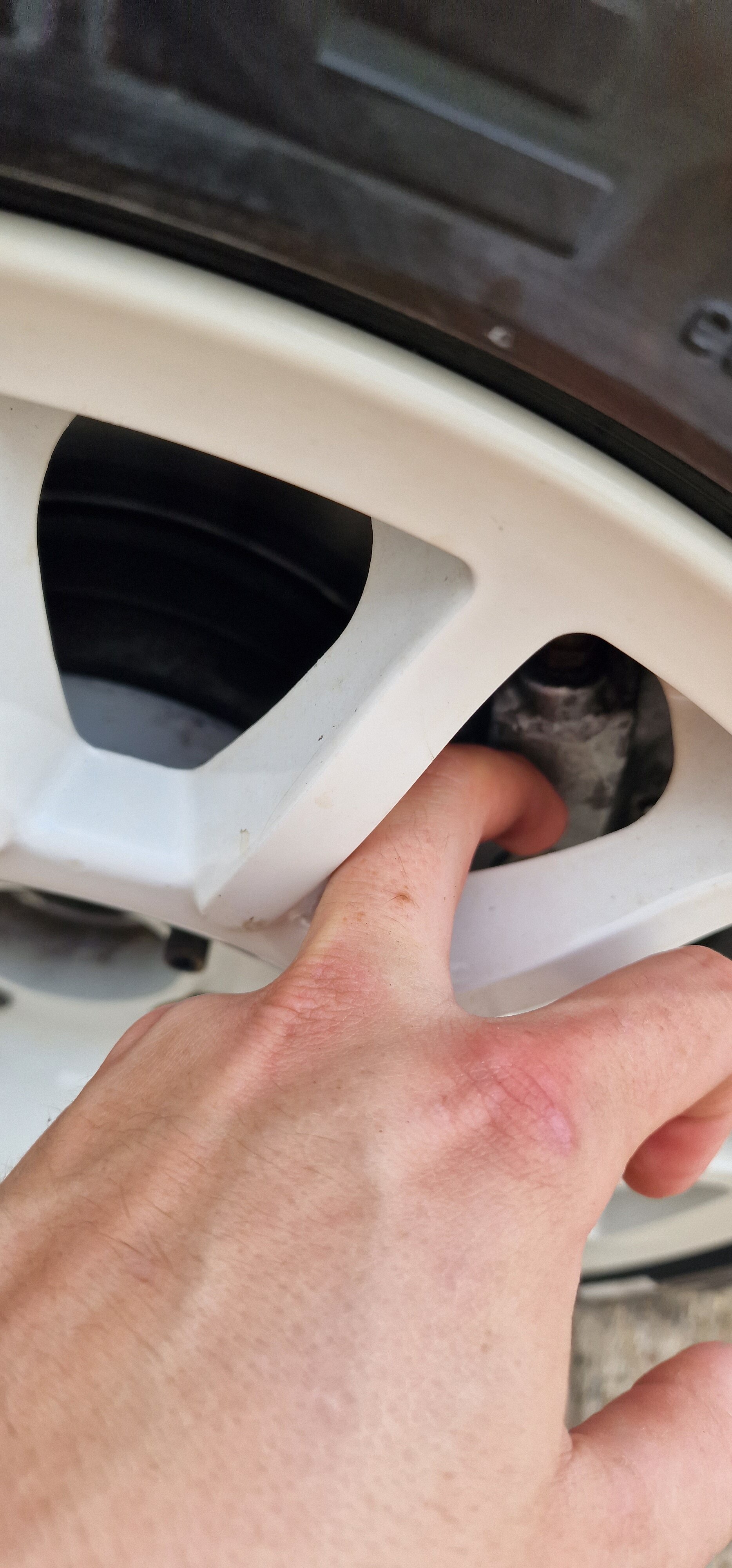

Braid Acropolis 7J x 15" and 60.1cb. possibly the most rare wheels I own now
The offset means they stick out a lot more than the 2118. More importantly they clean the Brembos with ample room!
Even with the spacers removed they have loads of space!

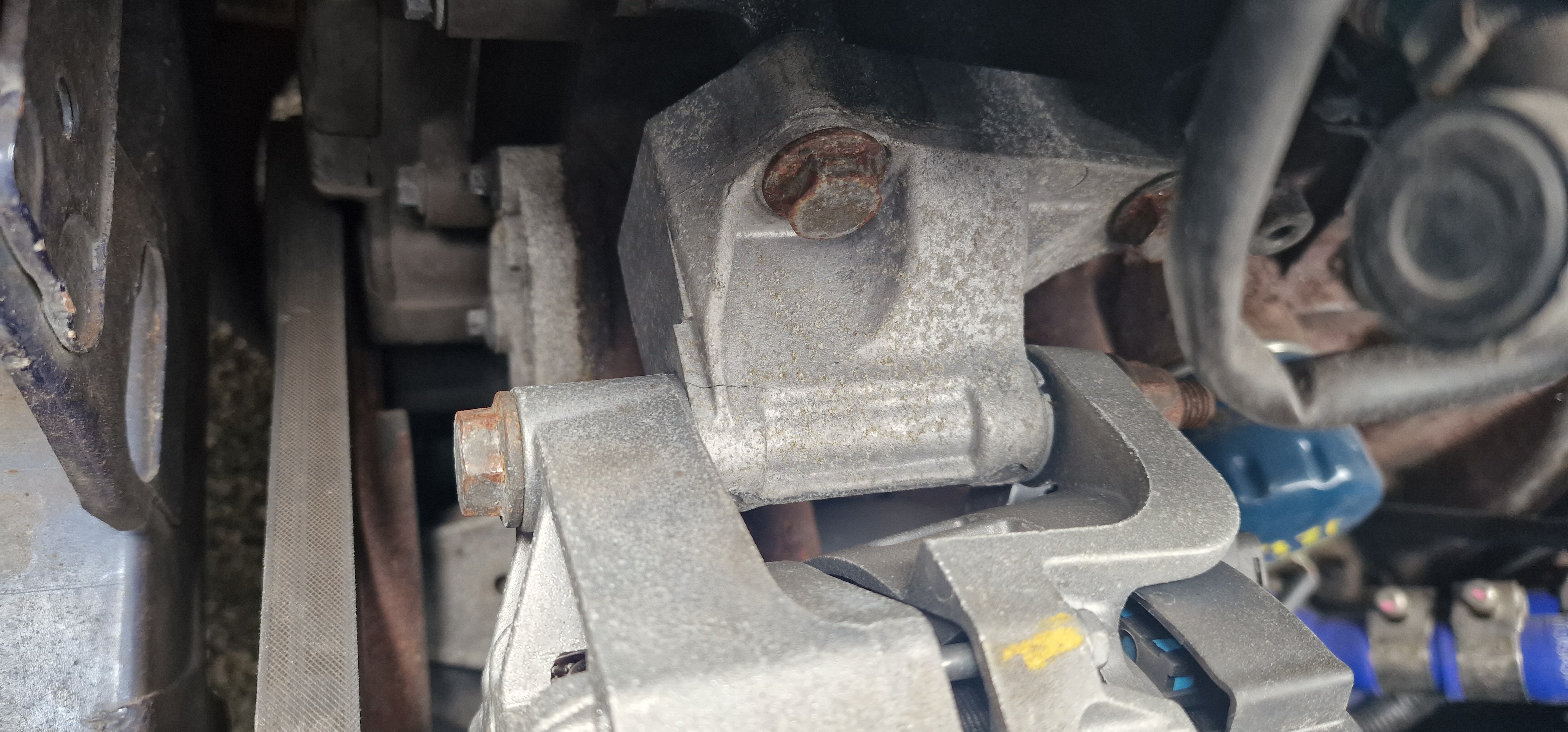

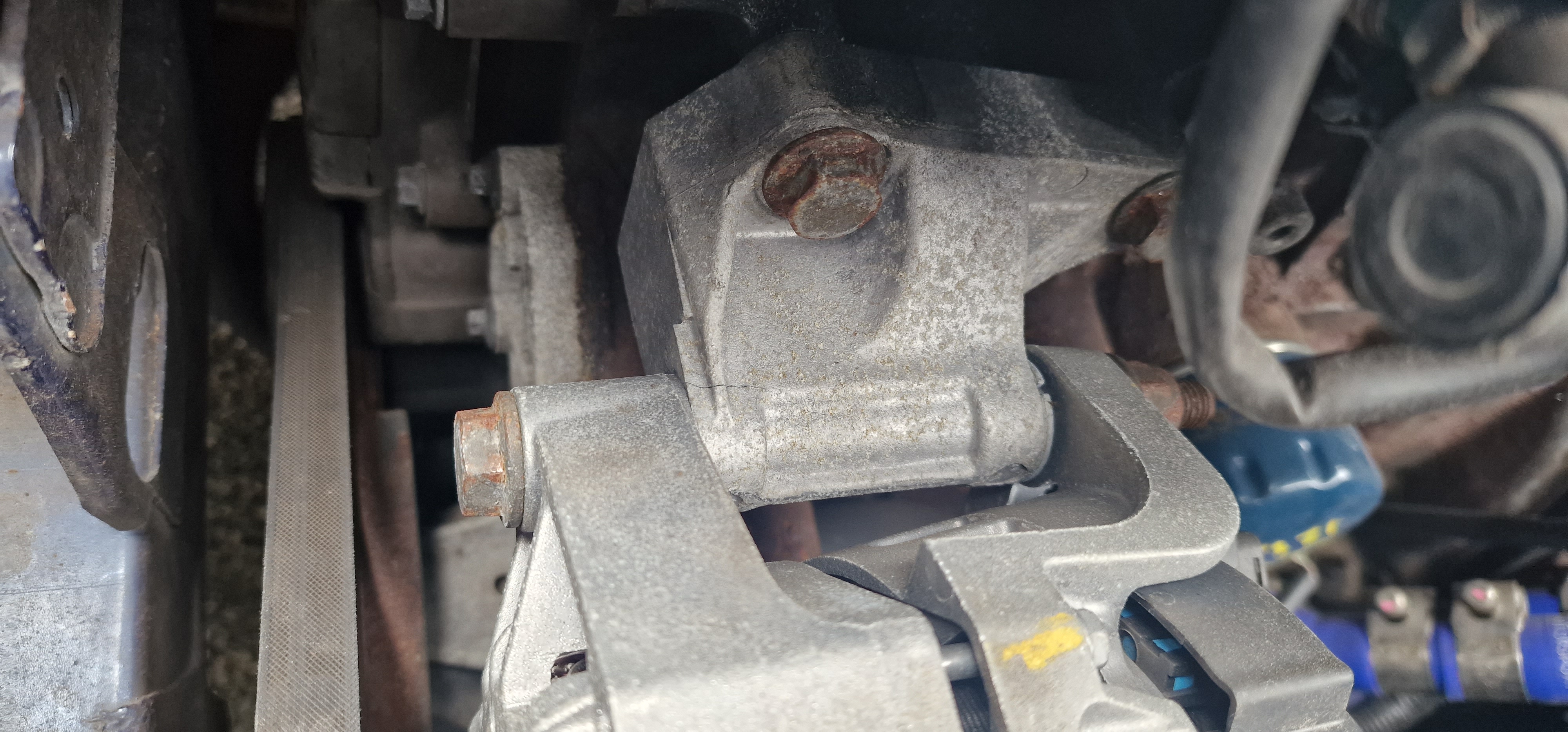

For a second time my upper alternator got a crack in it. Speaking to a few people it's quite common for it to happen
This was why... I've used up all my good fortune with that!
Took off the manual tensioner rod to clean it up. I ended up using all new hardware to mount it as the bottom bolt had stripped slightly too

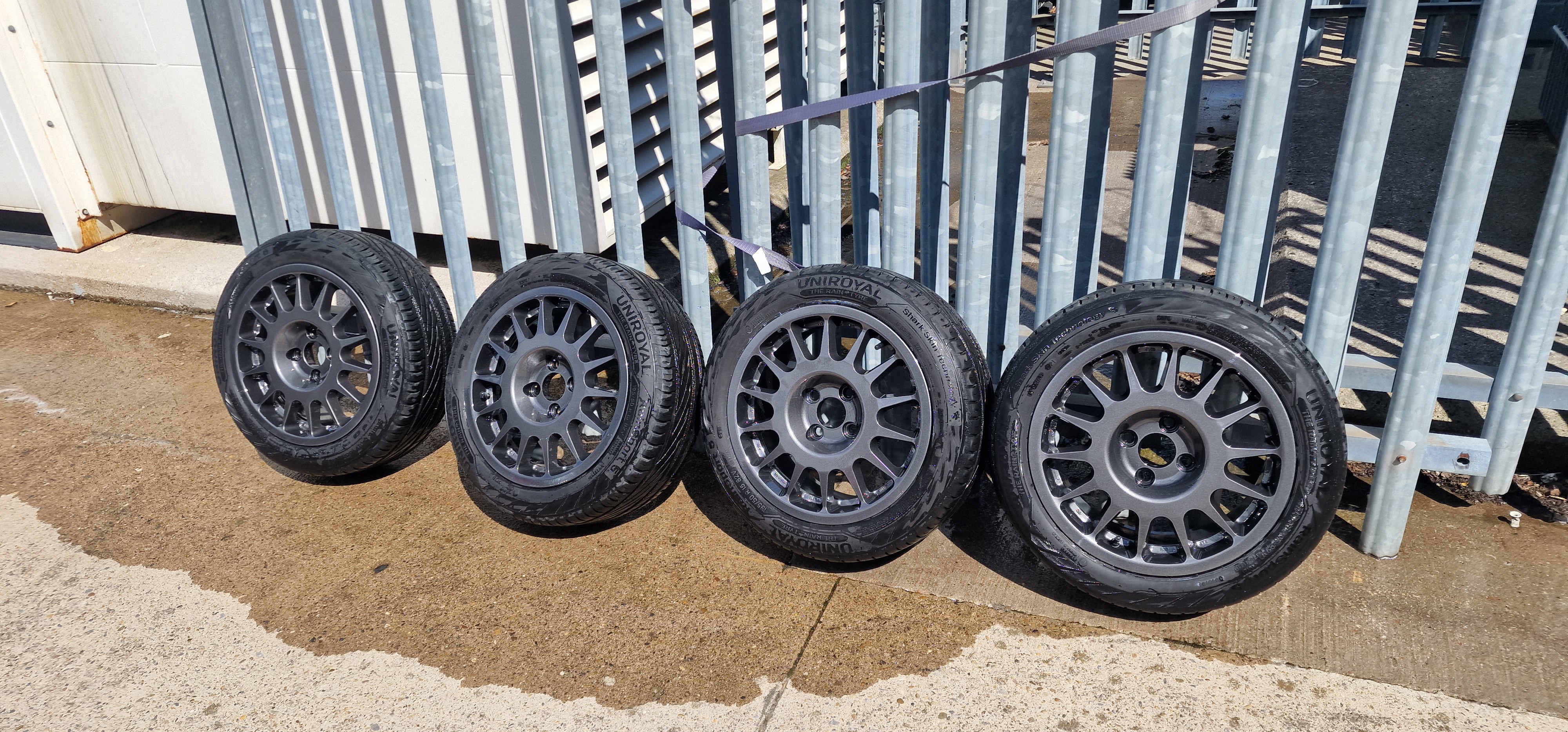

Got my AR1 put on my Braid Wheels for track
Driving the car in the rain has been eventful, especially when leaving the motorway. Coming off the sliproad and your brakes being piss wet isn't the best so I got some 100mm bungs to put in for when I'm not on track
Got my 2118s powdercoated amphasite and had some Rainsport 5s put on

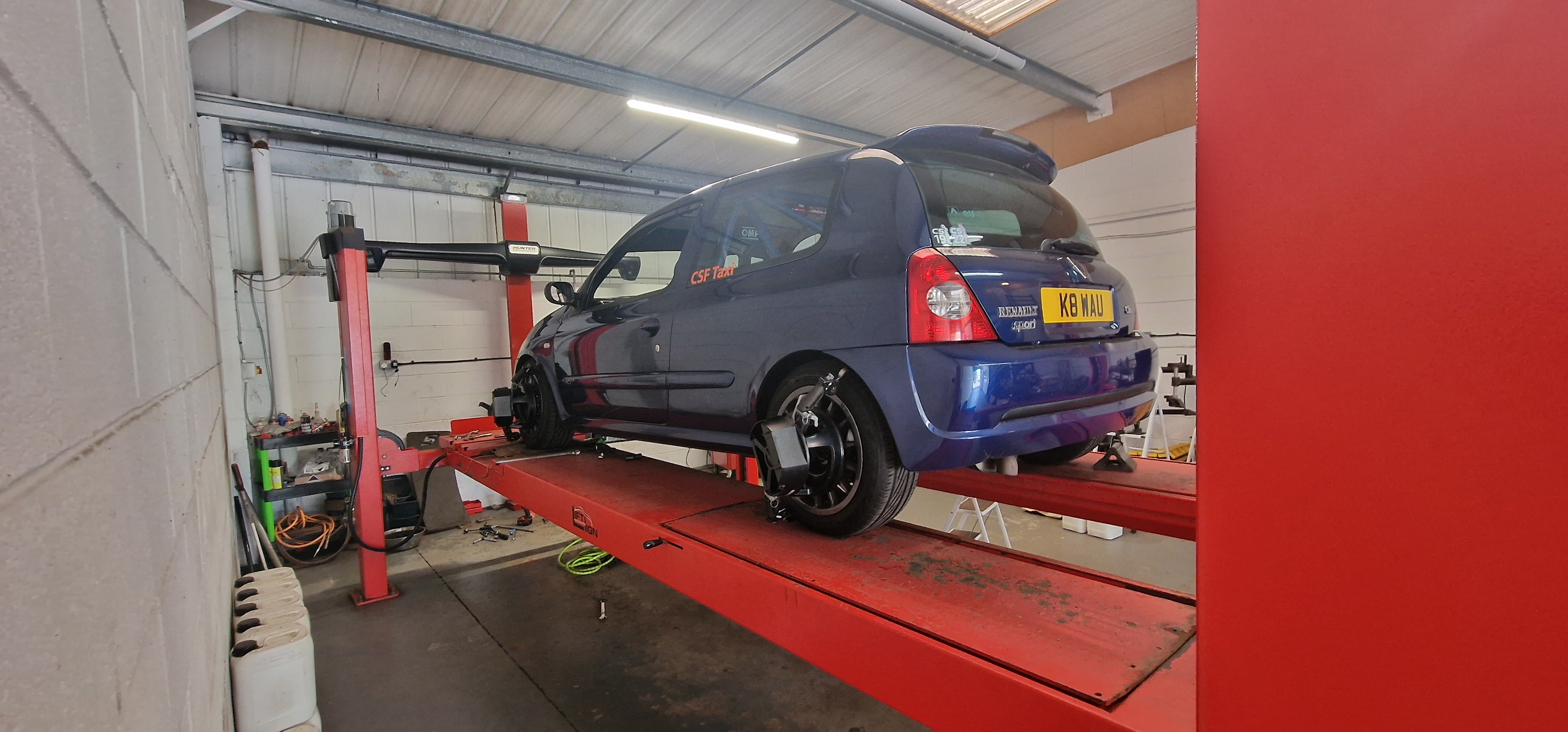

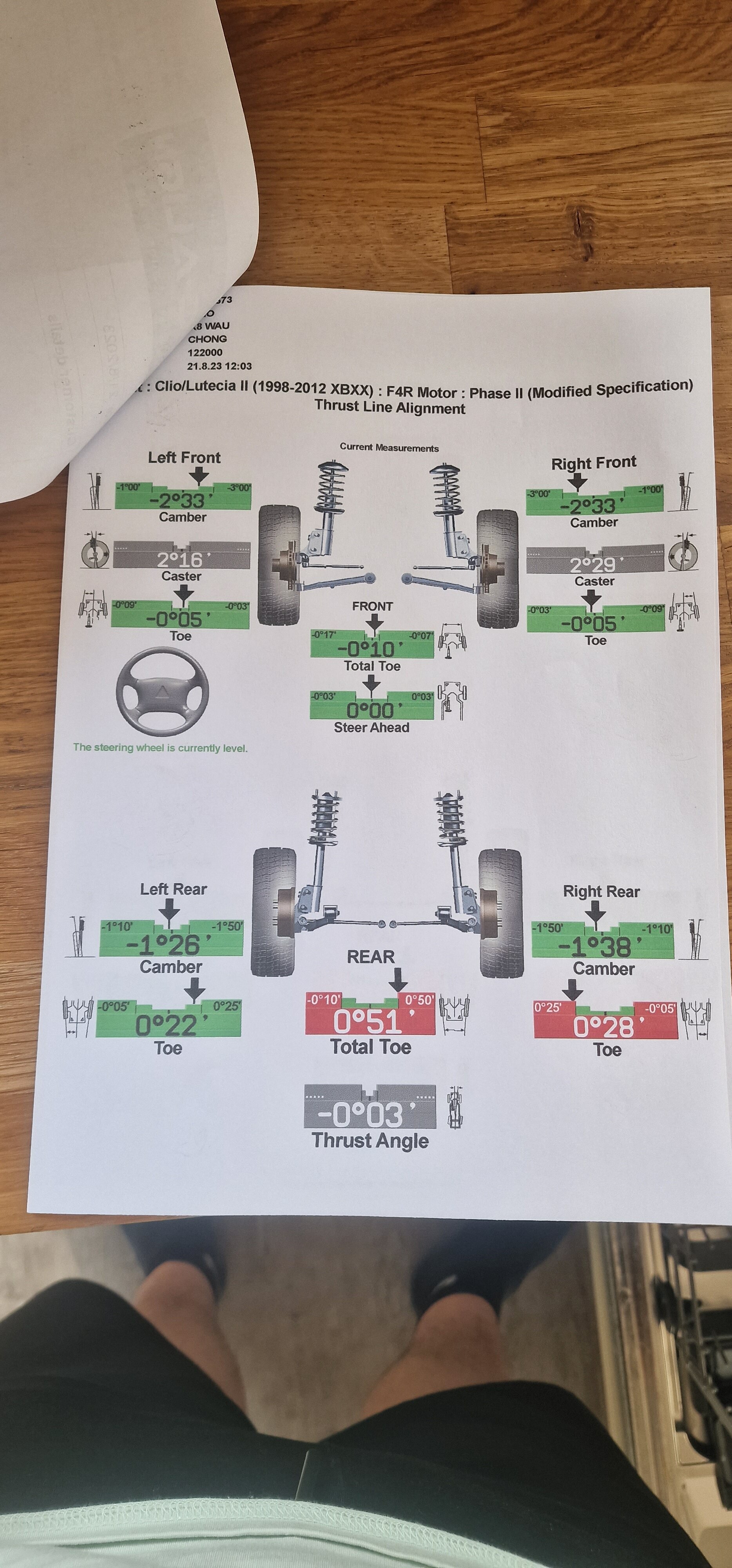

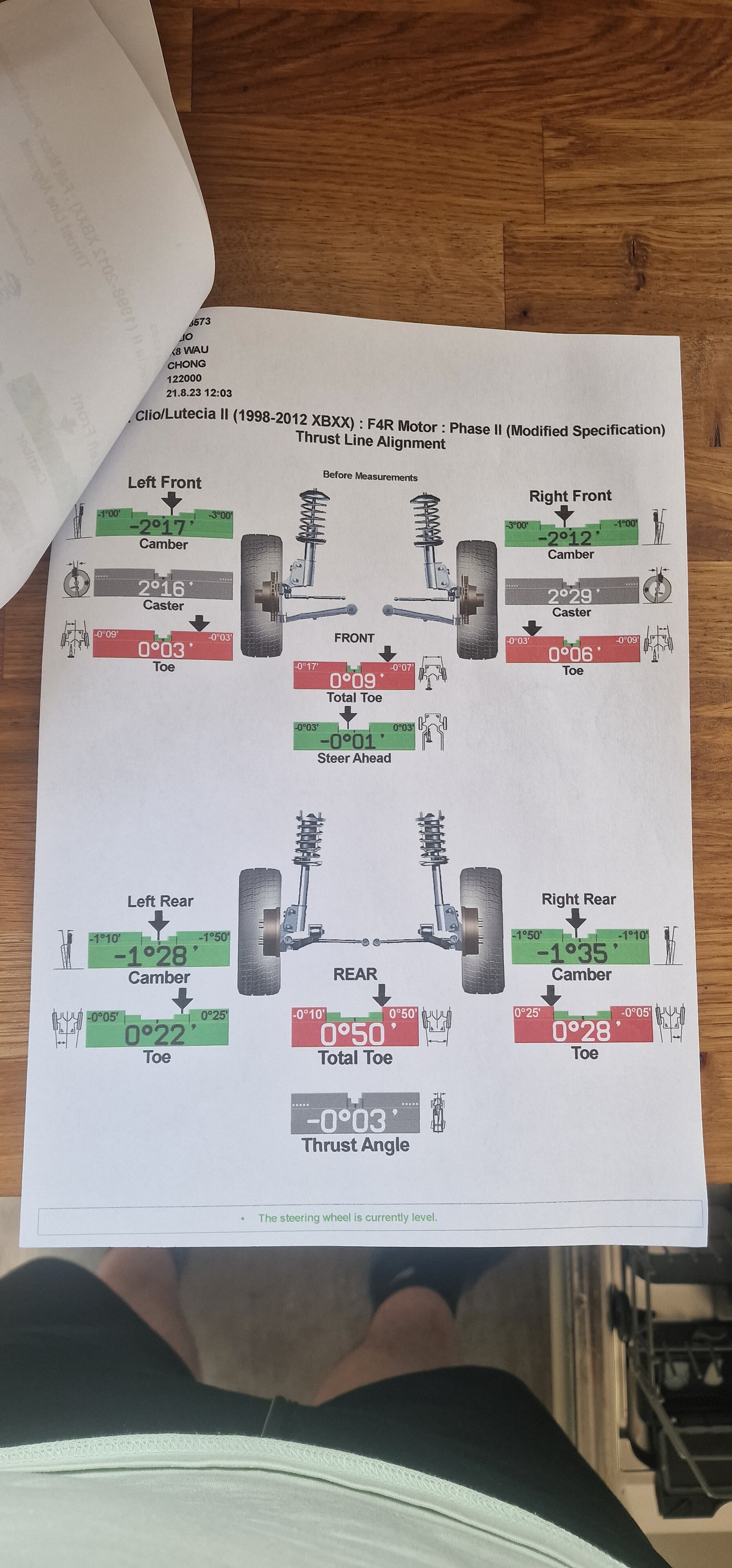

Shim the rear stub axles so you’ve either got parallel or slight toe in. It’ll help the turn in massively.
Some stuff called shim steel is your friend for this.
Aye I've got a few camber shims in the garage, will have a f**k about and see if I can get it anywhere near. Might get the axle stands and string out for that like

I dug into why I had errors for the angle sensor too. Turns out the f**king plug was unplugged and just clipped to the side of the squib. Not even sure how that's happened. Changed the squib because the cruise wiring was chuffed
First time I've never had a light on the dashboard on this in 5 years
