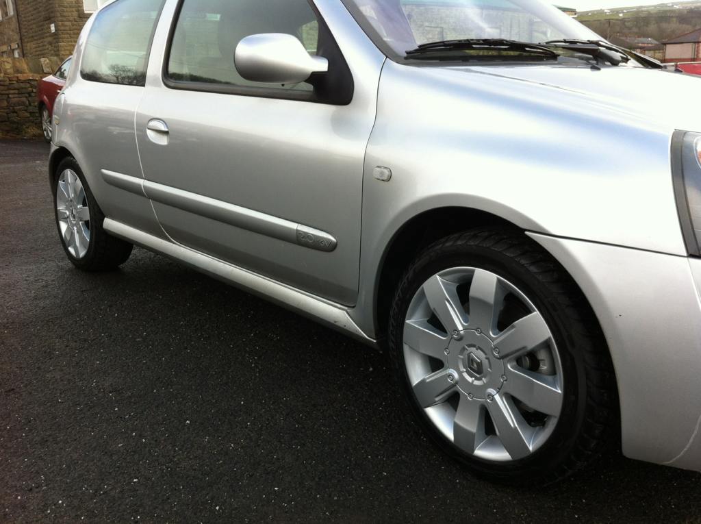

Some pictures from the seller;

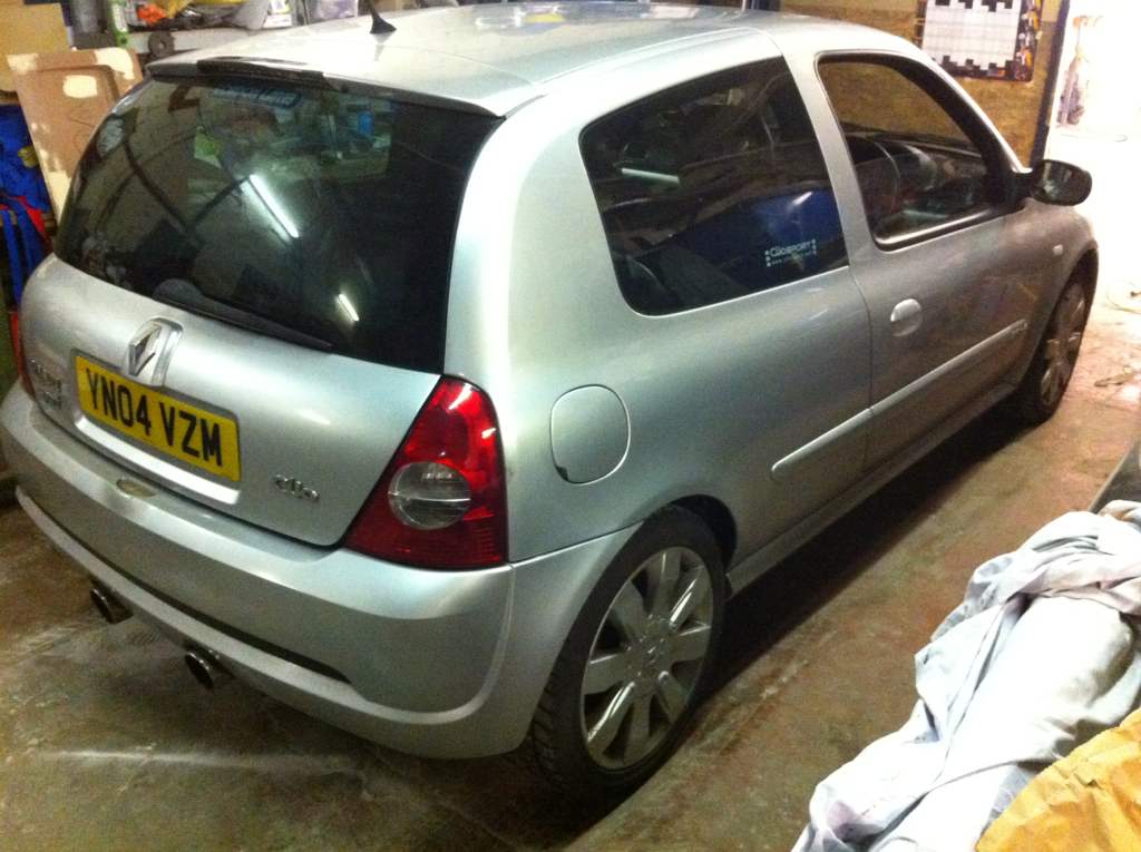

Managed a quick clean up in between the rain storms we have had recently, I also replaced my plates as the others were looking a bit tired - also check out how misaligned they are - as soon as i noticed that they had to come off asap!;

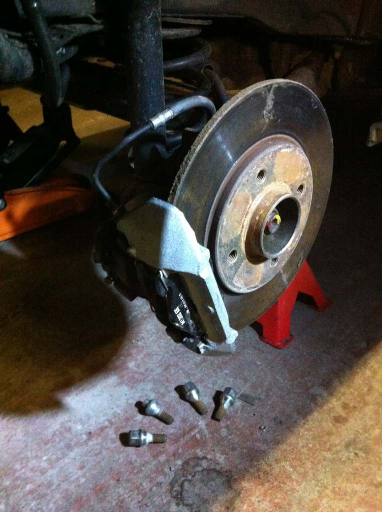

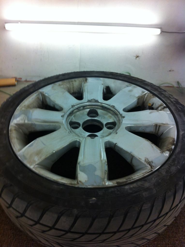

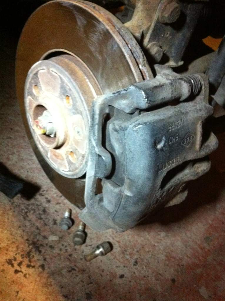

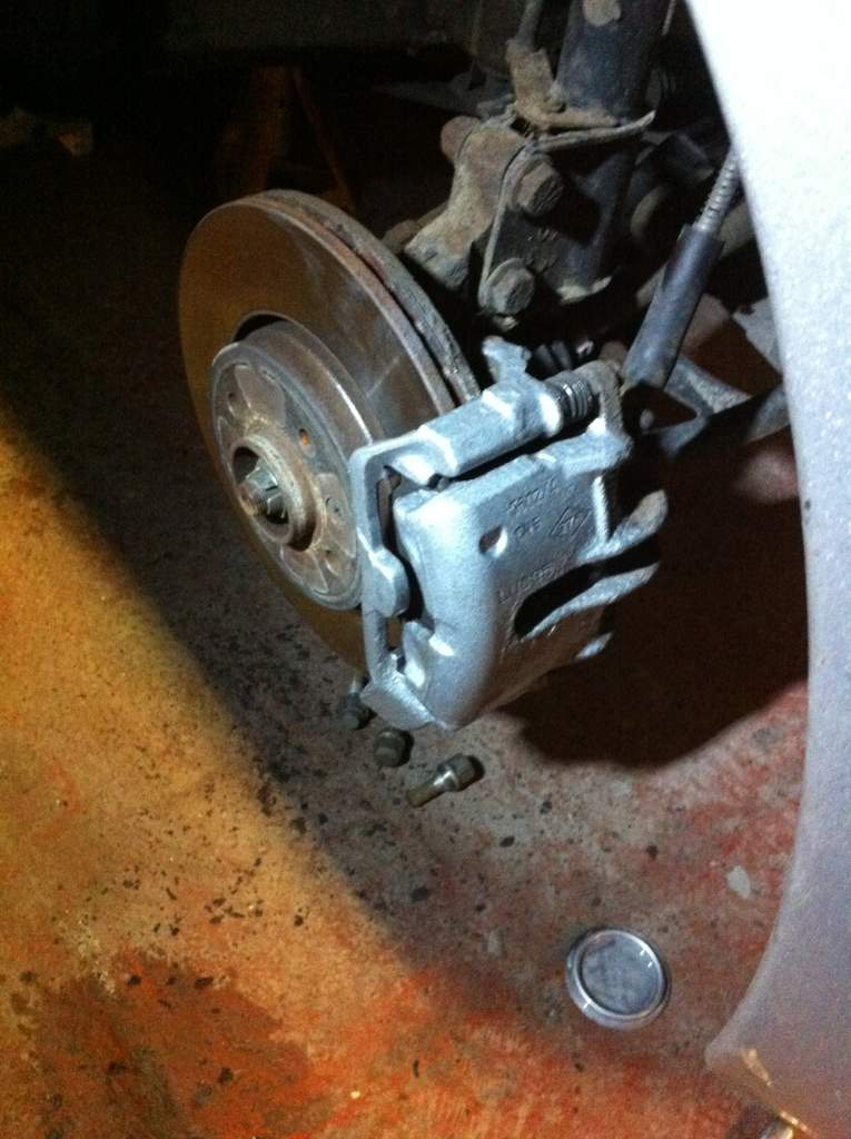

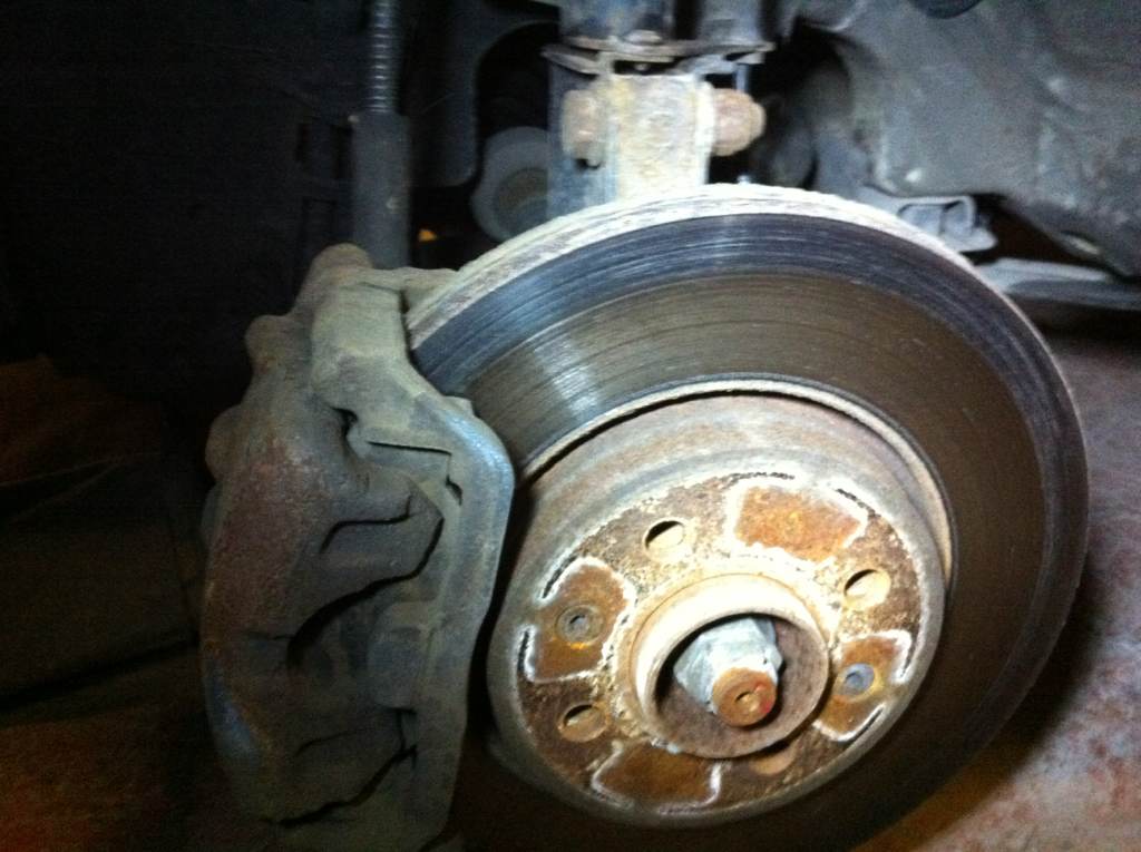

Spent tonight getting my alloys refurbed - whilst I had the wheels off I decided to change the brake fluid and tidy up the calipers .
When I arrived
Before
After a clean up
After a quick coat of hammerite (will be tidied up in the future)
Action shot of the alloy in the prep process
We got them masked up tonight, will be primed and sprayed tomorrow and picked up Thursday :)

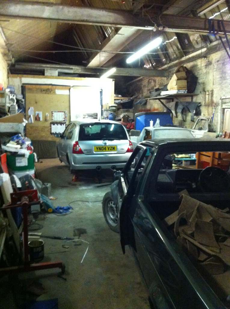

I know, no chance of doing it outside with the weather as it is at the moment. I will be popping back down to my brothers unit (above) at some point to give it a good going over.
