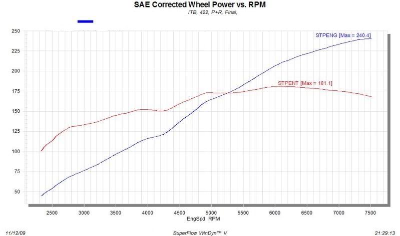

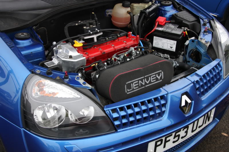

I built this a while back
  DON'T SEND ME PM'S!!
spec list was massive, but the jist of it was high compression, headwork and cams, fine tollerence balancing and throttle bodies with extra long trumpets.
spent days measuring every single clearance imaginable on the bottom end alone

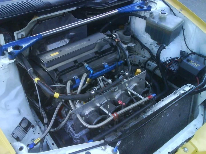

There have been 280bhp F4R n/a engines. Videos on you tube of one. Injectors going directly down the trumpets of the throttle bodies and a set of injectors in the usual place!
