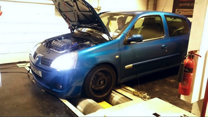

The car went in for mapping yesterday at efi parts, it managed 270bhp and 248lbft, the torque has been kept down to keep the rods safe.
I am very happy, its gained around 100bhp and 100lbft over standard, i should be picking it up over the weekend hopefully.

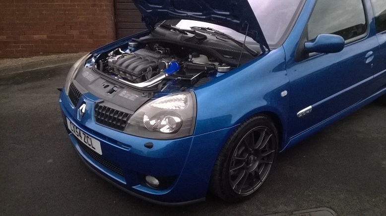

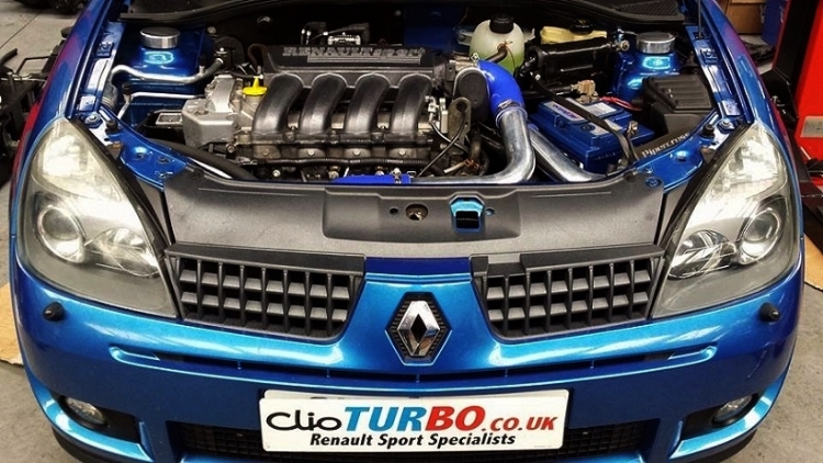

Looks v good. Nice smart engine bay. [emoji106]
Do it :tongueclosed: thanks for the comment, ill be giving the bay a good clean also, i also need to re fit my battery cover.

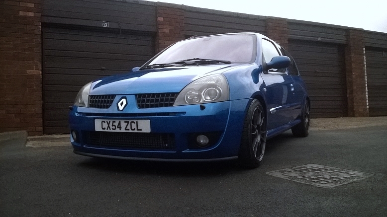

Heres a couple of pics i took after a clean, sorry about the quality of the pics, it was off my phone and it was getting dark, i did take my camera but the battery run out after the 1st picture lol.
