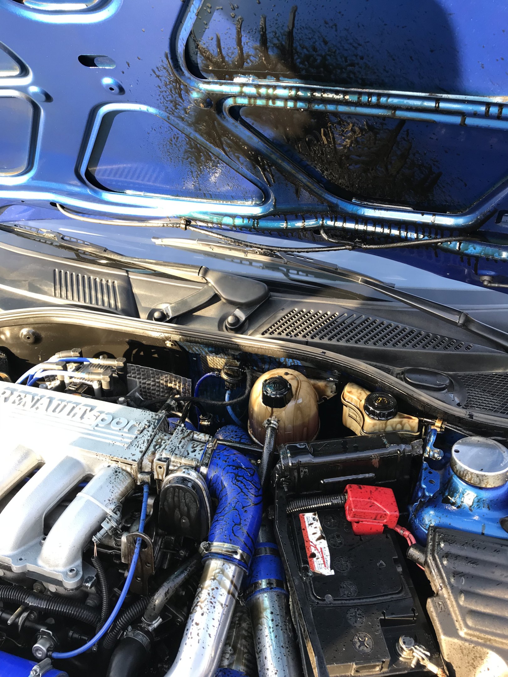

Yup, made it to J.29 of the M1. Only had to wait the three hours for uplift......lol
Don't worry mate, its already been sorted. I'm not happy with the obvious crank pressure issue but will get it all ironed out no problem, she will be a monster. I am collecting a 172 Cup on Saturday so not fussed how long it takes to get the 182 sorted, she is only a toy :up:
Fucksakes, i did tell let you know that i wasnt sure if it was breathing more heavy but i didnt have anything pop out or anything like that and it drove perfectly :pensive:
Don't worry mate, it highlighted an issue and now it will get resolved #TurboCarProblems lol
I didnt know this was going to happen mate or i wouldnt have sold it, im not that kind of person.

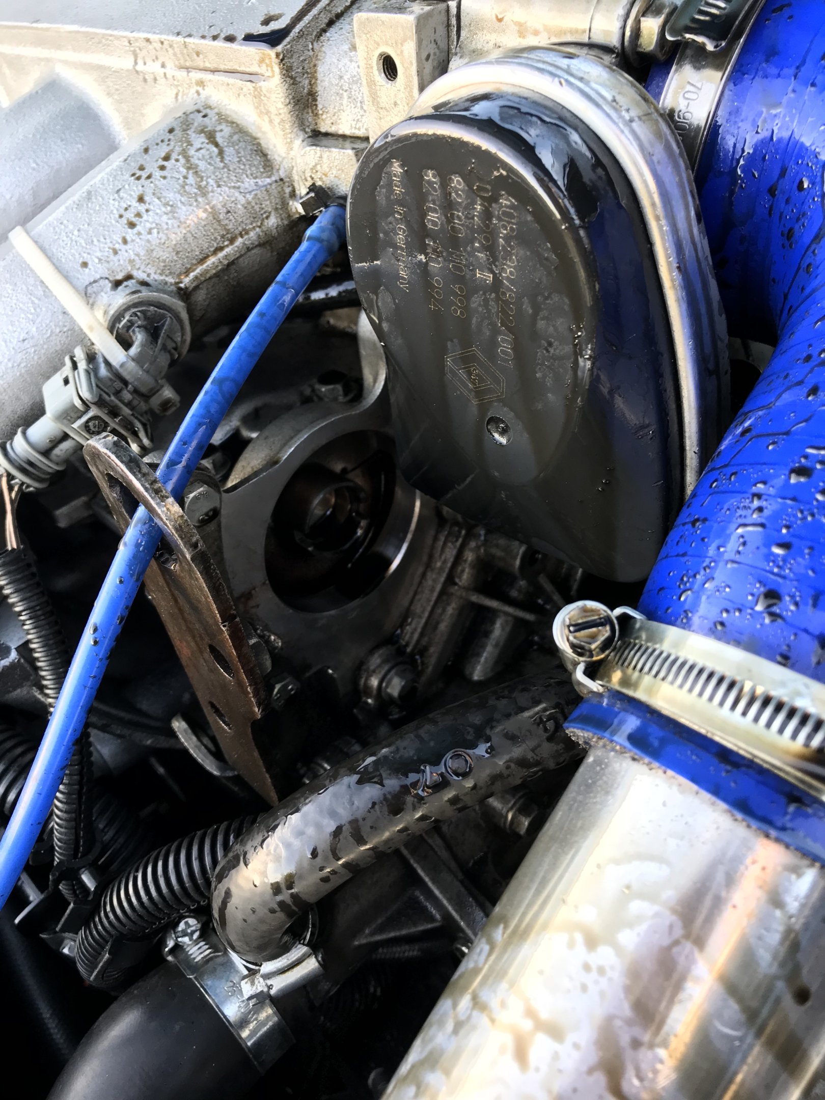

Have you checked the oil mate, how much did it lose?
Hopefully its just the camseal that popped out and hasnt caused any oil starvation issues.
Well, now i look like a right ‘un’
Camseals don't just "pop out" it's been forced out by excessive crank case pressure, that's what was coming out of your breather.
Anyway I wouldn't worry, I'd say the bottom end needs a rebuild.
