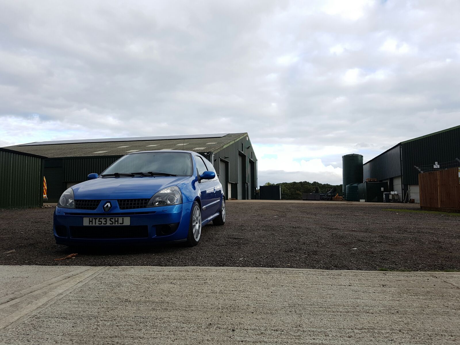

What do you use on the plastics? Car looks great.
3/4 plate finishes it off. Wish I could go back to having a 3/4 plate, police told me off :(

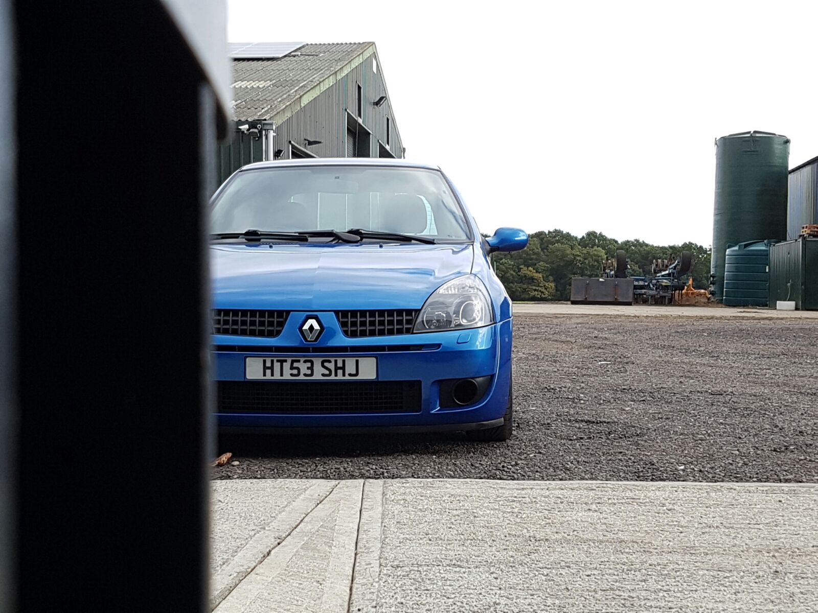

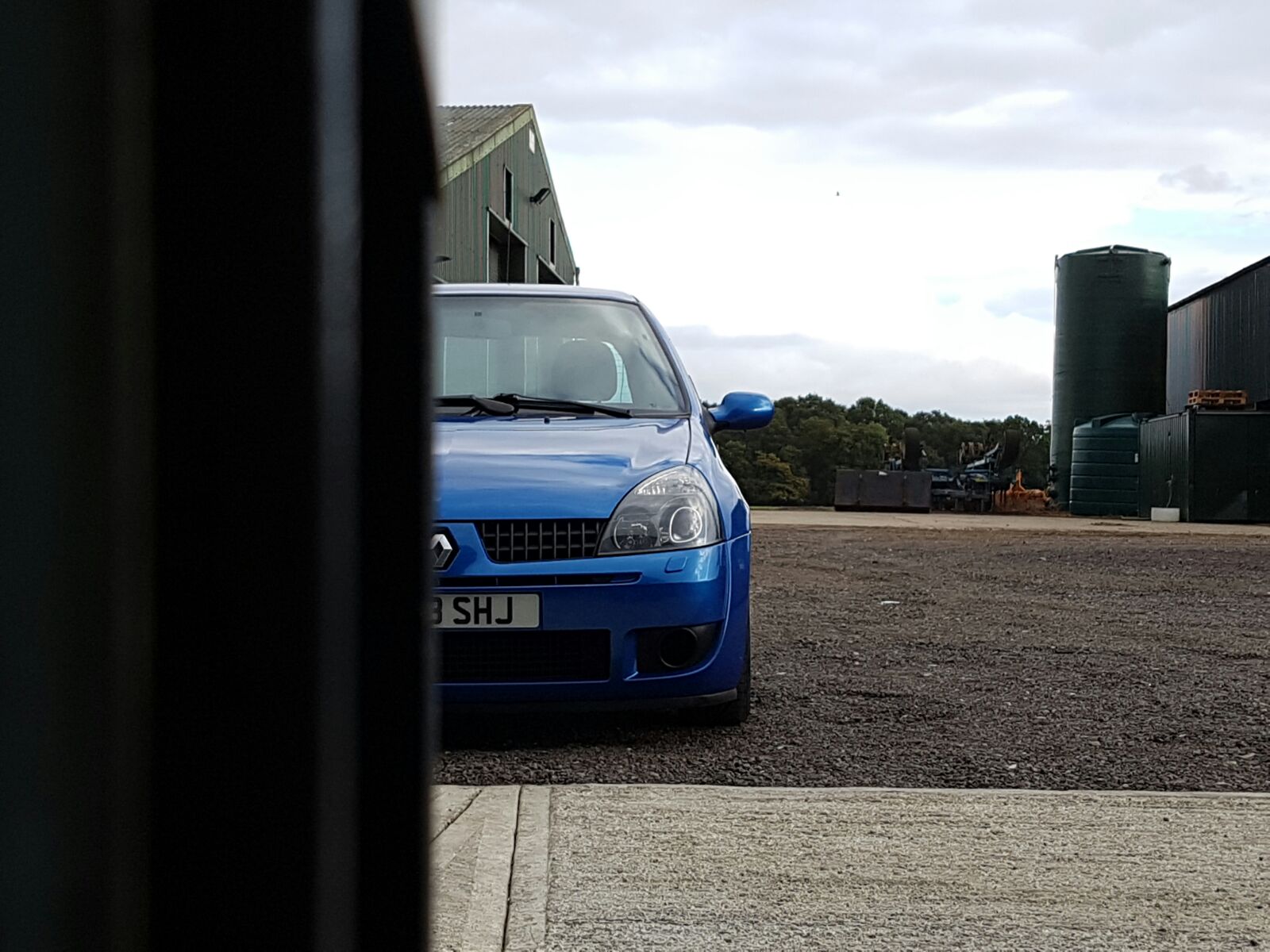

Ooh moody pictures!
That second picture (half the clio peeping around the Door/wall) reminds me of a moody child, peeping around the corner to see if you're looking at them 😂😂

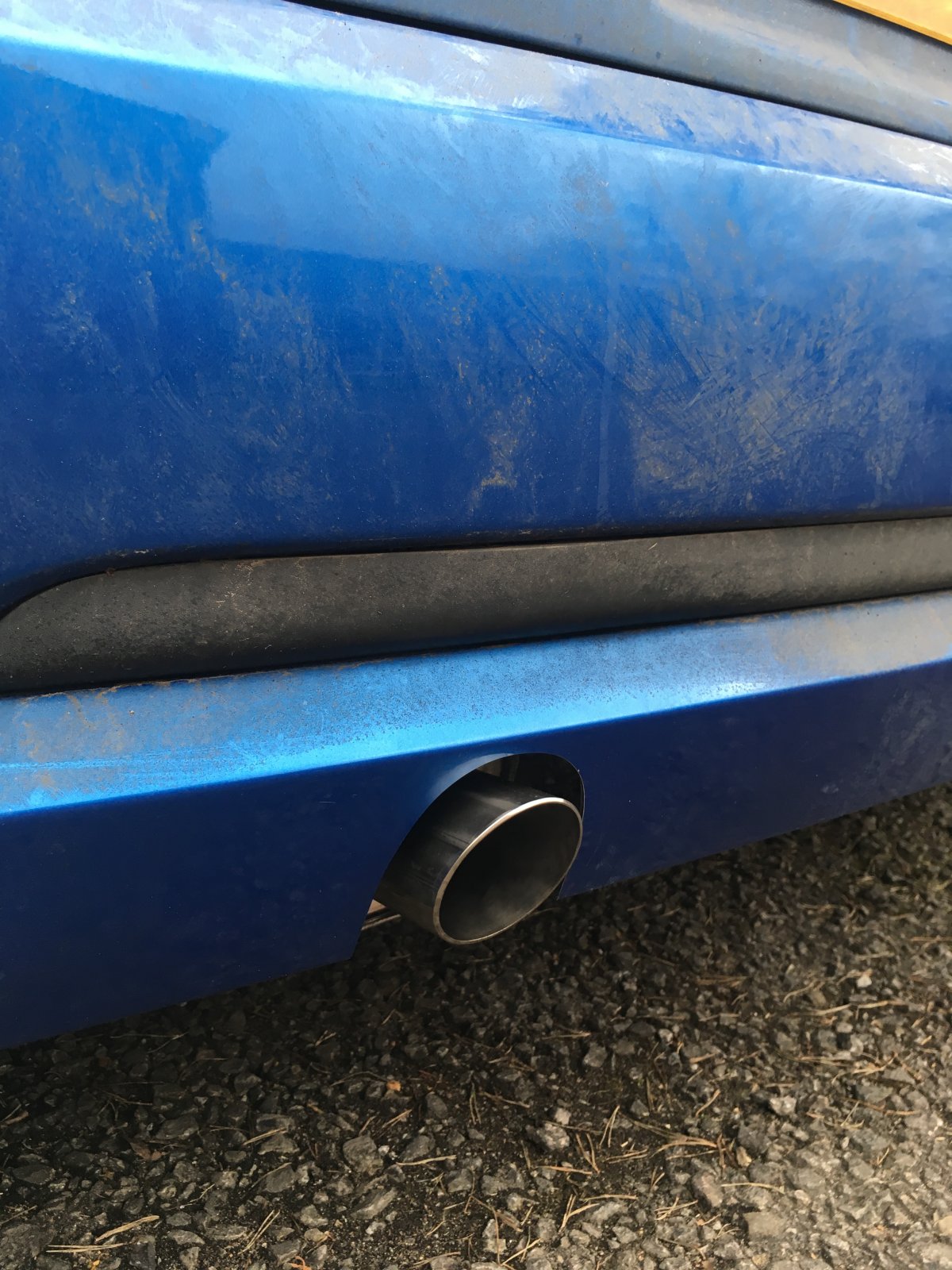

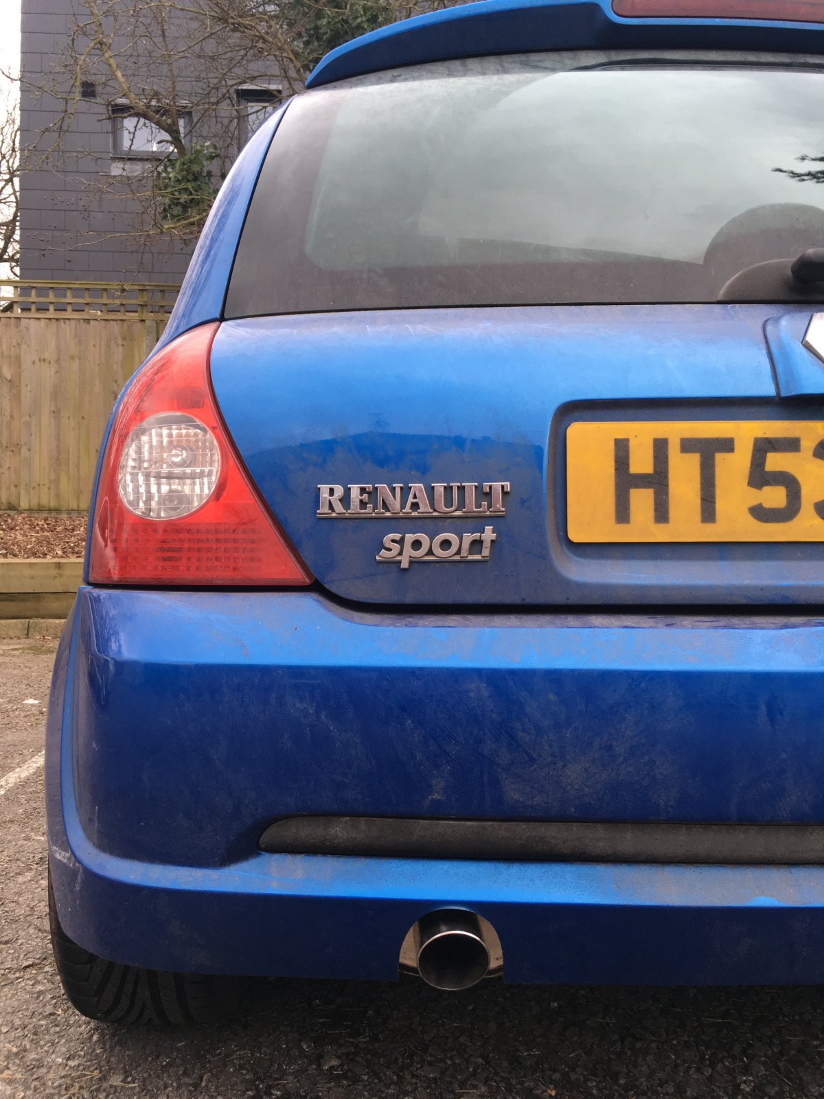

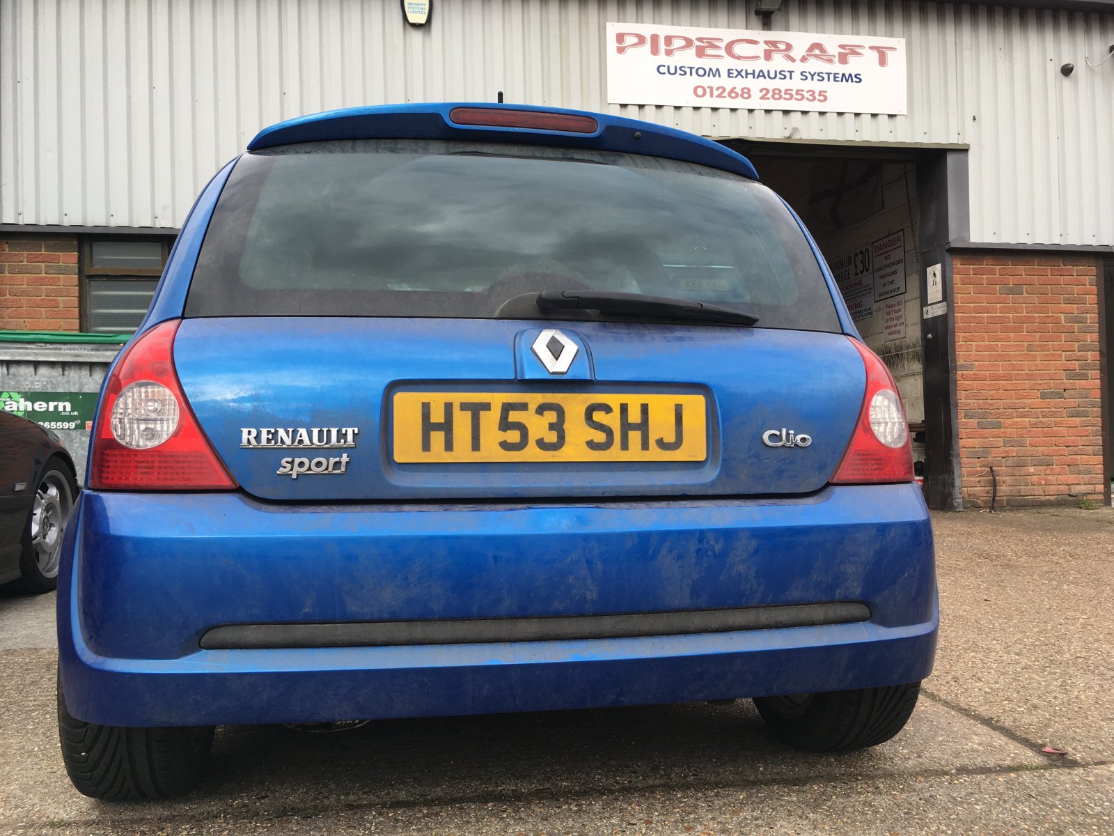

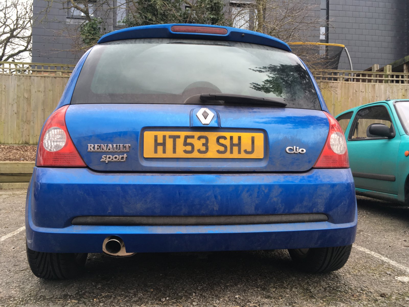

So i went to Pipercraft today in Basildon to get the tailpipe done,it was a stealth system which i do like but you get that horrible drone/booming noise on motorways etc at 80mph.So i decided to get the tailpipe made up so it pushes away the sound rather than bouncing back up under the car.
Car is filthy by the way!!
BEFORE
AFTER
Sounds much better now,no drone on motorways!.still get the sound of the exhaust as you would just less boom boom!

Looks really good , what sort of money does it cost ? Does it completely get rid of the boomy noise
MrBlonde
Only cost me £60 which i thought was ok.
Yeah it sounds a lot better and quieter without getting rid of all the exhaust note.But then mines a cup so will always be a bit louder as no sound deadening.

Mines a cup too mate just haven't changed my profile name from selling my old 182 , I'm really thinking about doing this the cup is just about bearable on the motorway with the drone , that price is really good hopefully I can find someone down my area that can do it

I would recommend it @Daz 182 mate,and I got a price from two custom exhaust places and both quoted me the same price,well one was £60 and other was 60 plus vat.
Pipecraft was recommended from a few people on here that live in essex or south east.
It only took him about 45mins to do and its 2.5inch,same size as the rest of the system.I didnt want anything to big and i like the raw look of just a straight cut piece of pipe just polished.
Maybe just have Google of your local area or ask on here.

I plan to do the same on my ph1! I love the simple look, luckily I can do it myself!
MrBlonde
Yes mate i did!.its 2.5inch mate same size as the rest of the system.
Yeah i cant make my mind up yet to leave it or put a surround on it,i dont think oe will fit tho,so will have to make one up @Chris_Beer
Do it mate,will better for on the motorways.
You lucky git!.i should of came to see you @m&l172ph1
Jekyll
Like others have said Steve, a nice surround would finish that off. Even if it's glued on.
Looks great though mate and a bonus of no drone.
Tbf, £60 for materials and labour isn't bad.
MrBlonde
Yeah just need to find something that will withstand the heat,what do you think of maybe using some black exhaust wrap round it?
Hard to come by a oe surround tho mate and are stupid price new,£30!!.haha how melted are we talking?? @Chris_Beer
