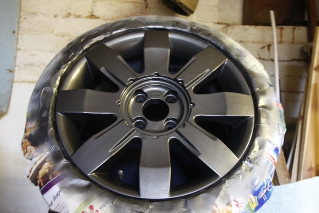

Fcs was coming up and i didnt want my lovely precurbed wheels letting the rest of the car down.
So over a bank holiday i did them the same as the badges.

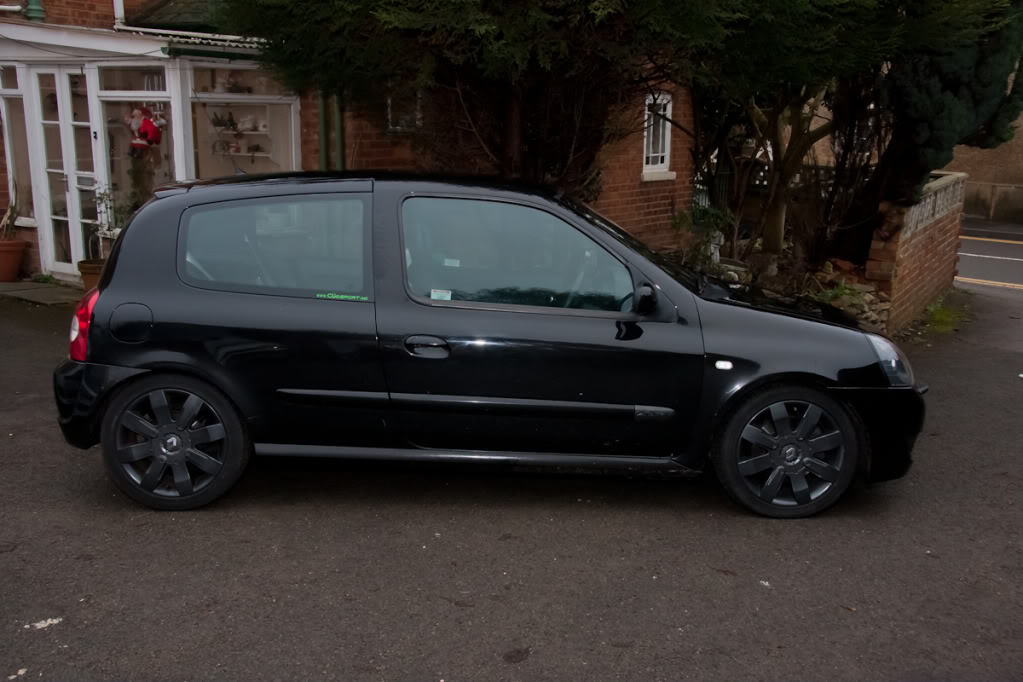

Here is the car as it stands tonight.
Looking at that picture it could do with spacers. But they arent as bad in person.
About halfway on each id guess. Could go alot lower but i want it too still be practical as the roads in my village are awful haha.
