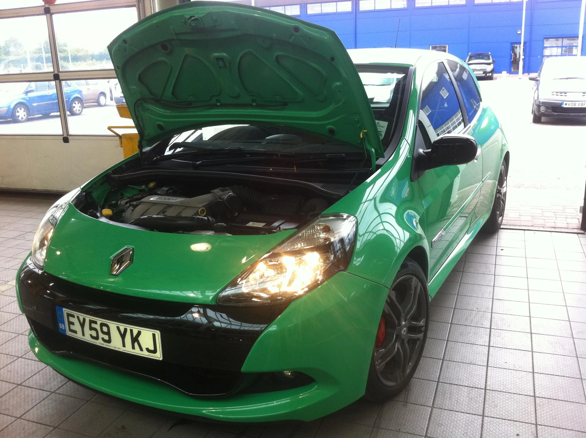

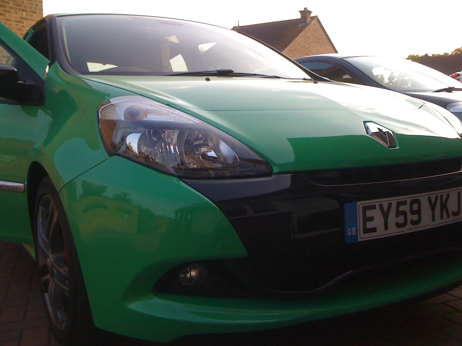

I bought the car about a year and half ago and started to do a few bits soon after, thought i would start a thread with what i have done and will be doing! and any issue's i have had lol
When i First got the car :)

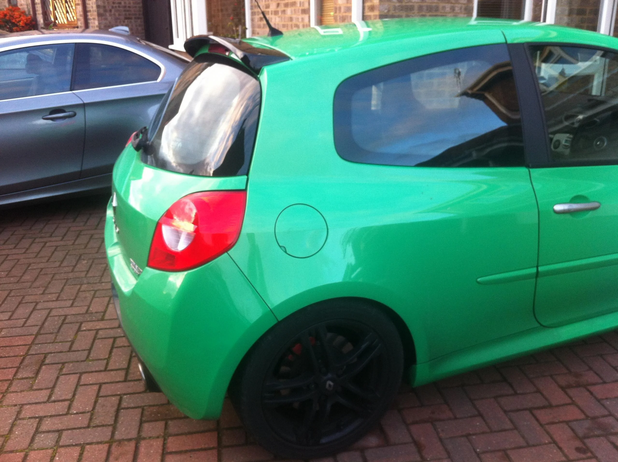

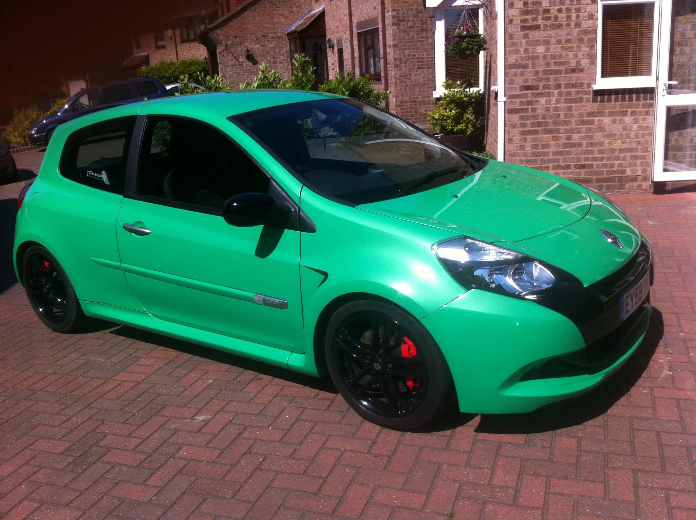

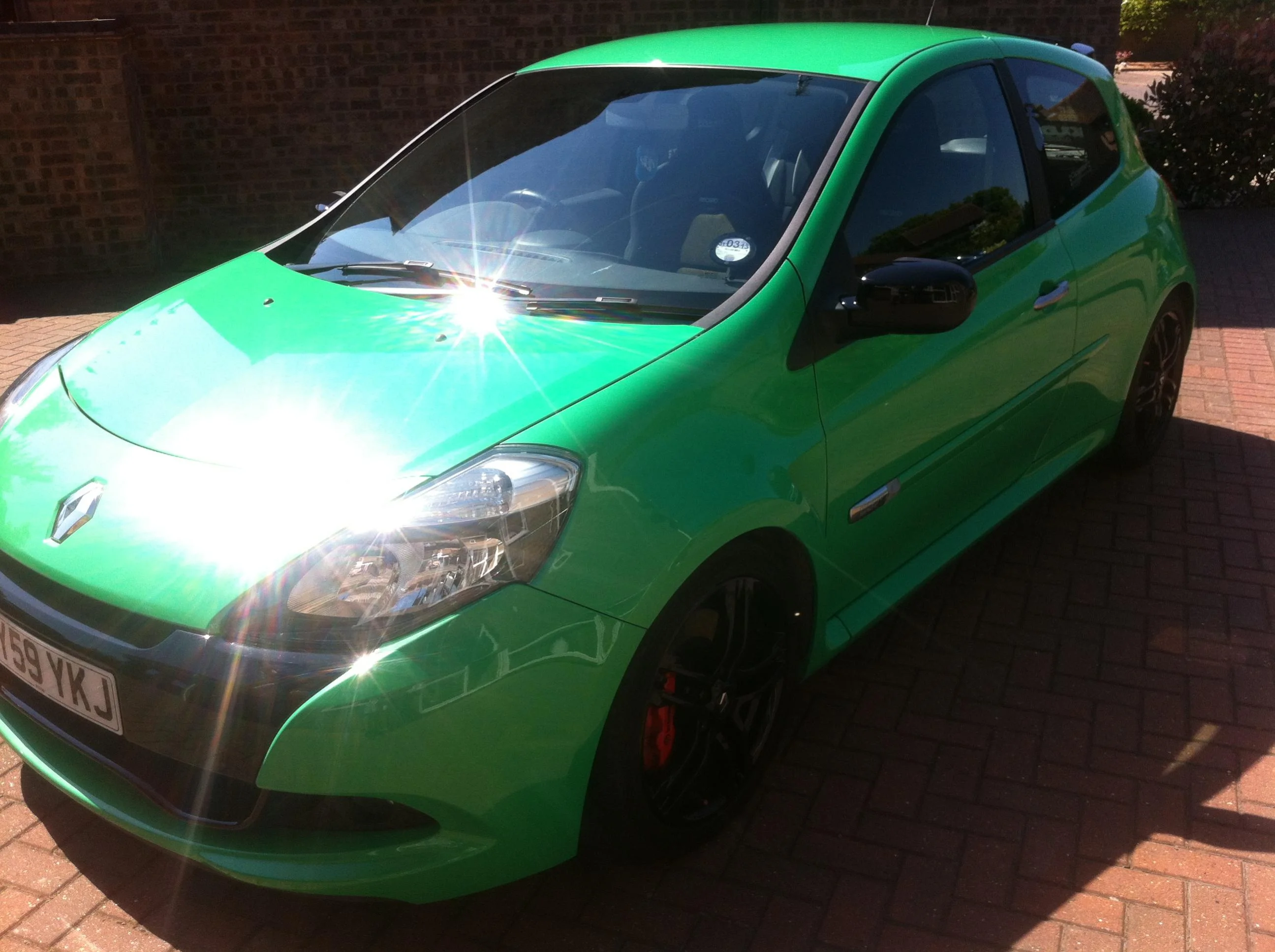

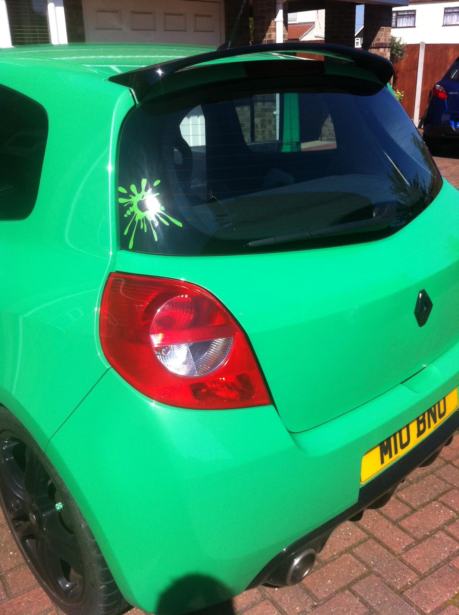

From there i got the wheels powered coated black which i thought made the car look alot better!
With Wheels done :)

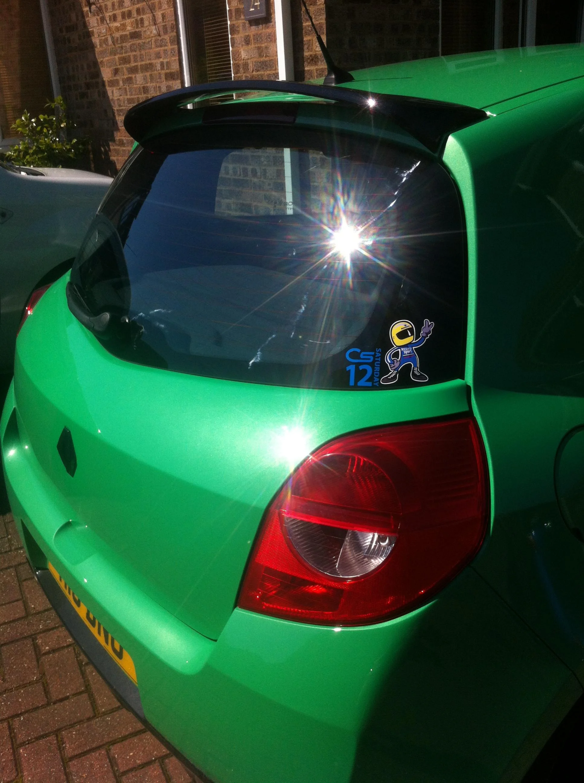

I then decided to finish the roof off with a spoiler, i decided not to get the Cup spoiler and went for the smaller one which i got painted black (pic below)

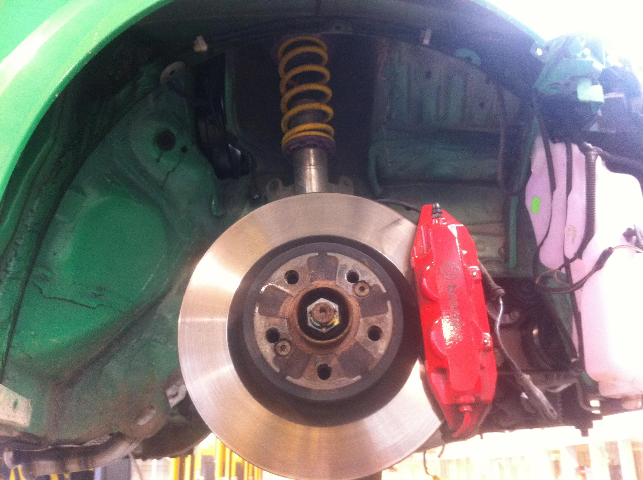

Got the money together and after thinking for awhile what coilovers to get i went for KW :approve: Fitted them straight away when i was quiet at work (quite handy being a mechanic with a ramp at work) here's a pic of what see looked like!
About a 35mm drop Front and Rear
Had a few issue's with rattles etc which i noticed straight away but easily sorted out :)

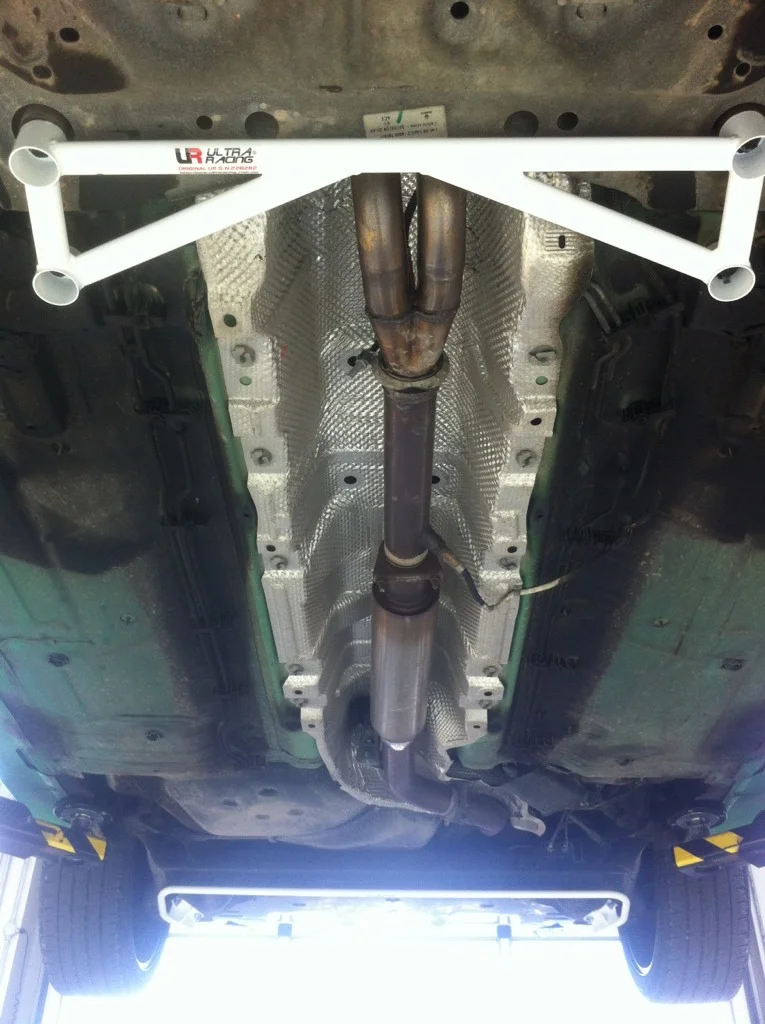

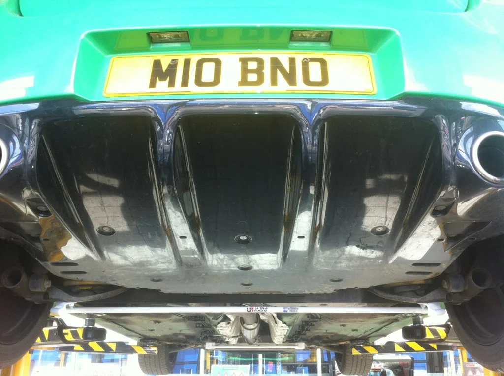

My next step was the exhaust system which i decided to get a KTR CAT back system with decat pipe, fitted on my saturday off and was really pleased with the sound (no pics atm but will do shortly, explain later lol)

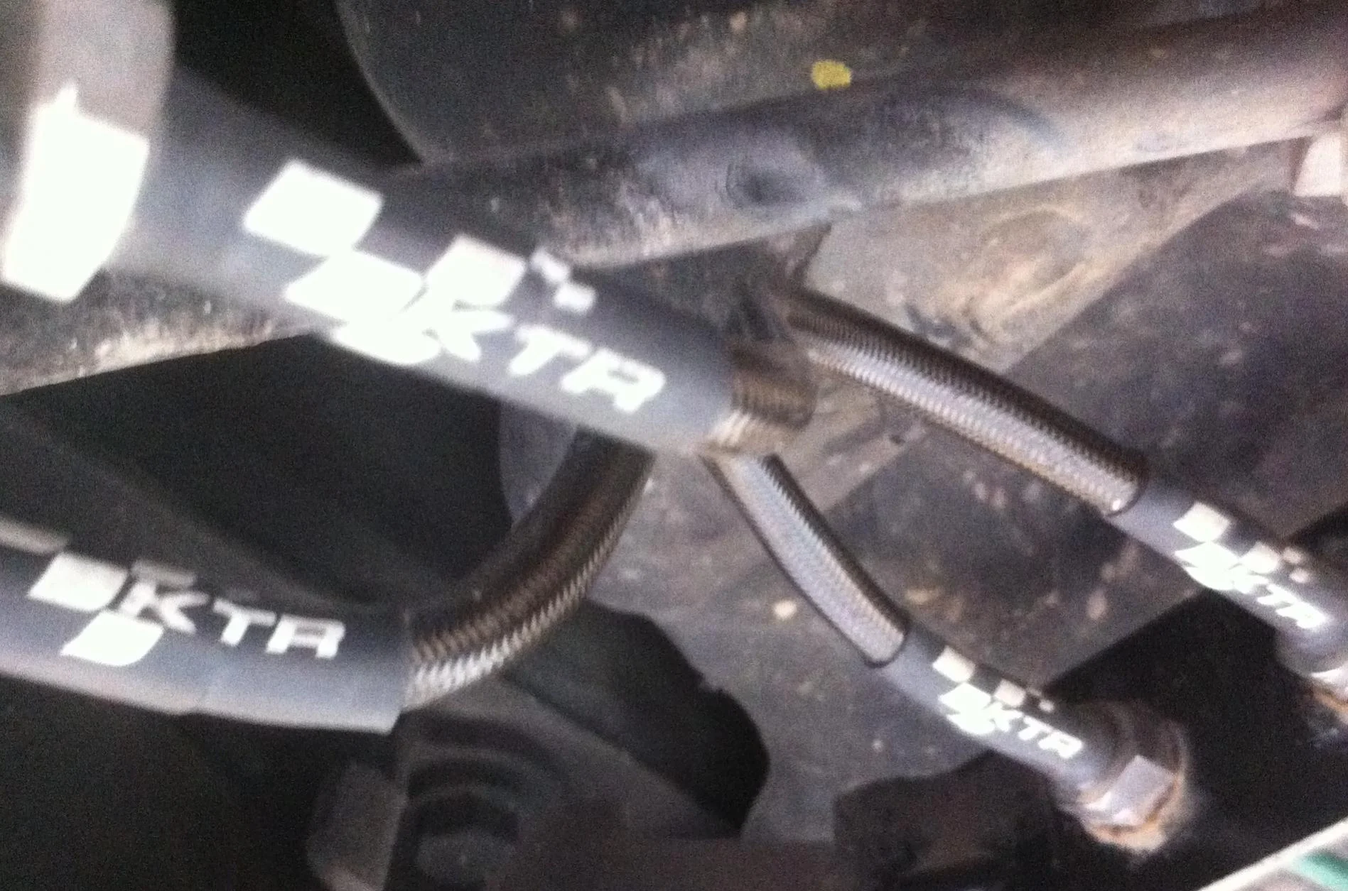

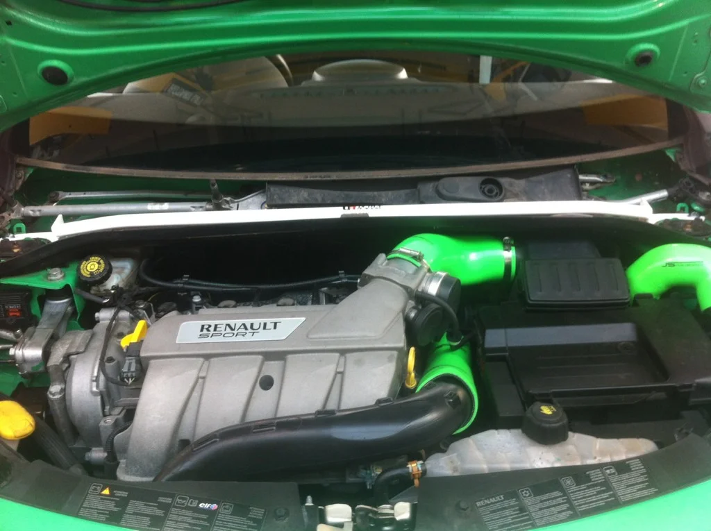

I then decided to get some braided brake lines (which made abit of difference, pics to come) Then got a panel filter and some induction hoses

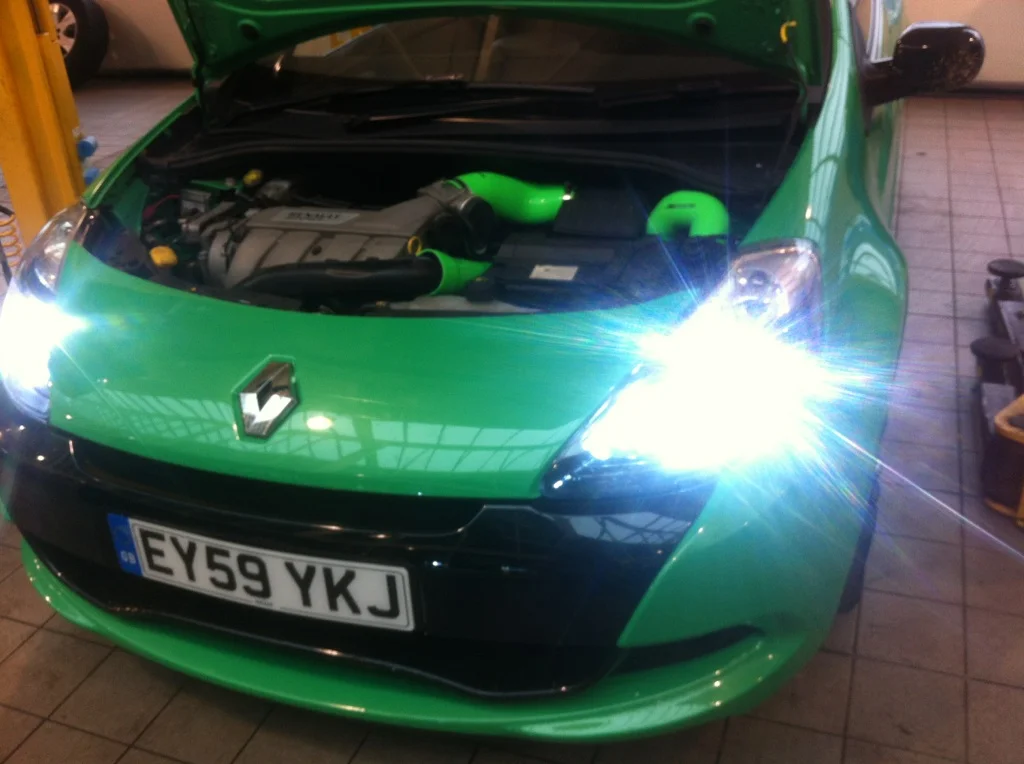

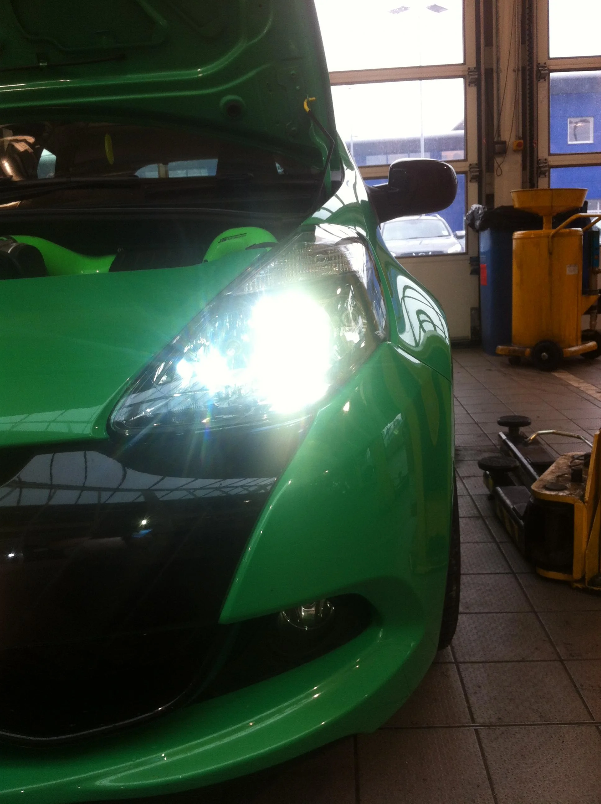

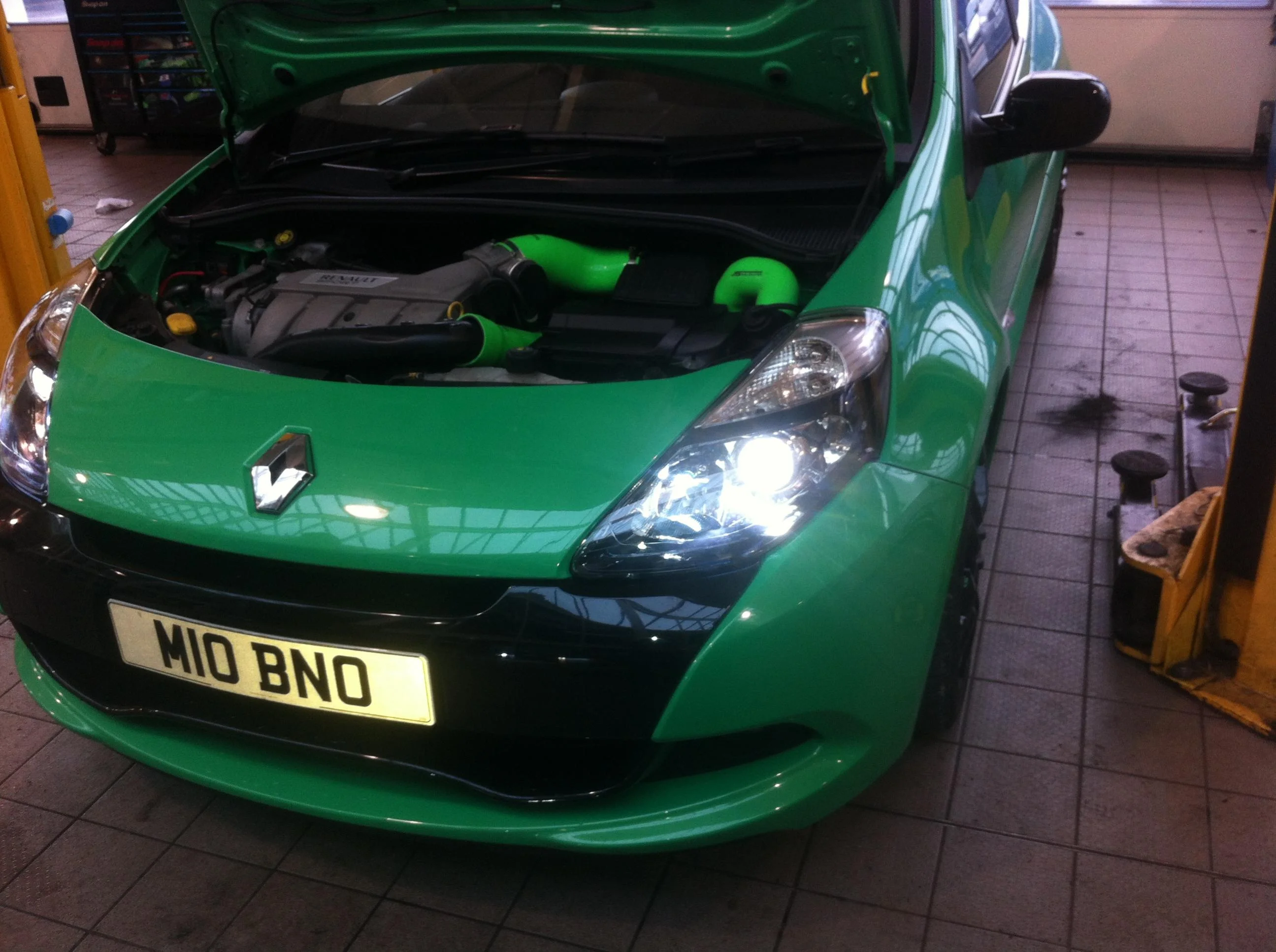

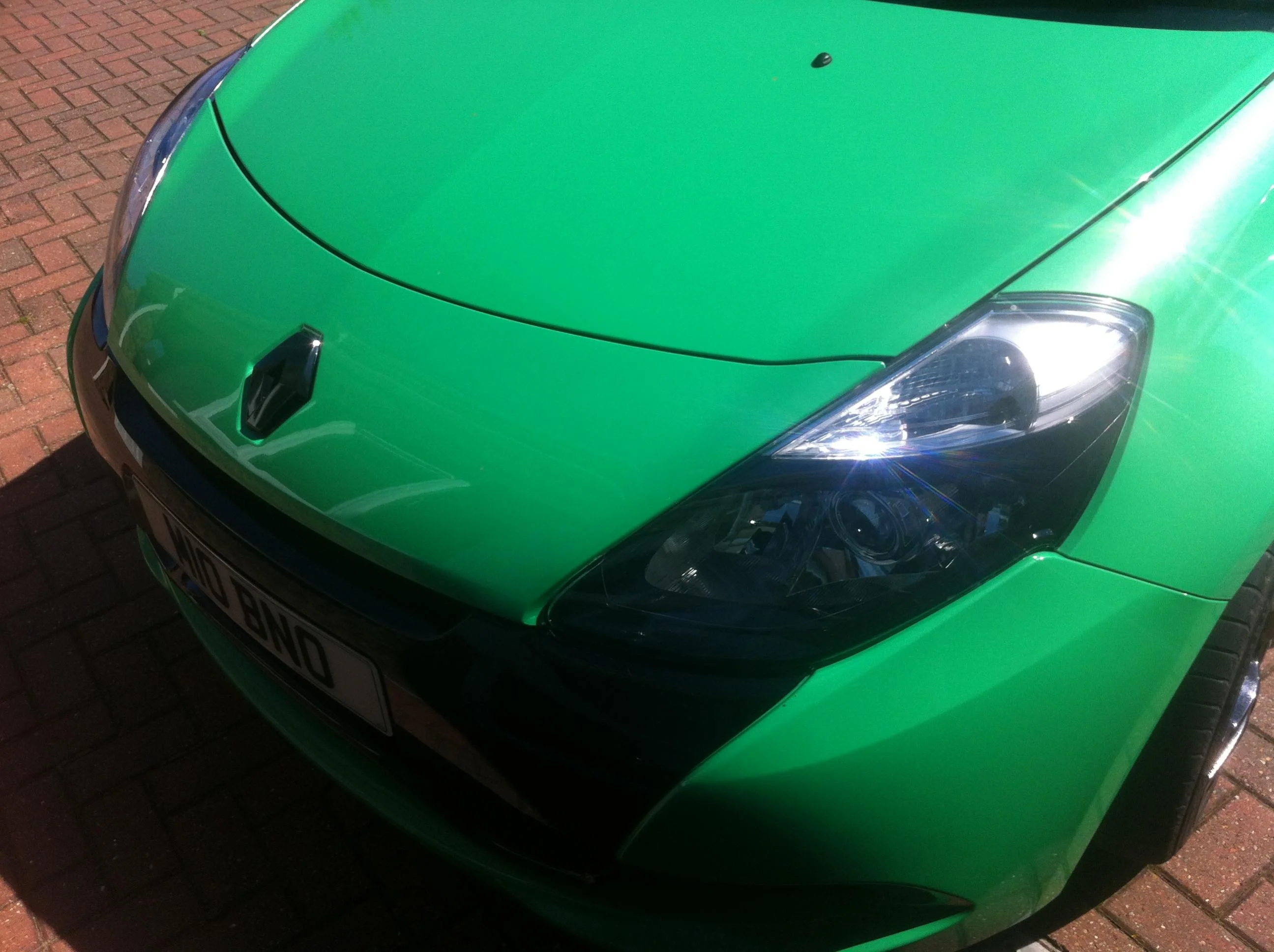

Next was the lights, fitted a HID kit, Chrome indicator bulbs and LED bulbs in the interior.
Thats all i have done so far but more to come, will be getting the door handles, Renault badges all done black, then will be doing a brake upgrade, then thinking of getting a 225 Turbo engine, modifying then putting in :)
One of the things that really stood out were the green hoses under the bonnet they look mint , looking good !
Those HID's are ridiculous. You need the projector lenses to make them work properly. Your just going to dazzle people and fail its first MOT.
Cars great other than that.
Yer i know i need to sort them out lol.. I can get them through MOT easy, the beam pattern to spot on in the tester.. I am a MOT tester aswell

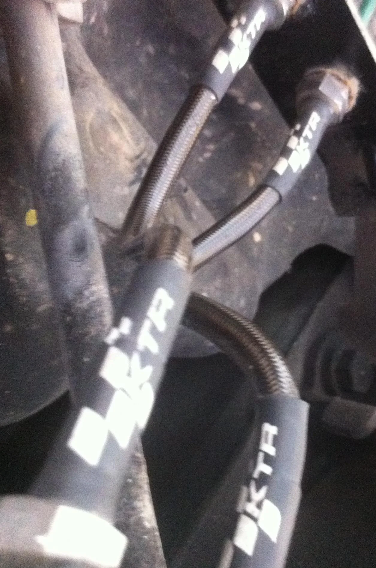

Continuing from previous, a couple of pictures of mods, coilovers and braided brake lines

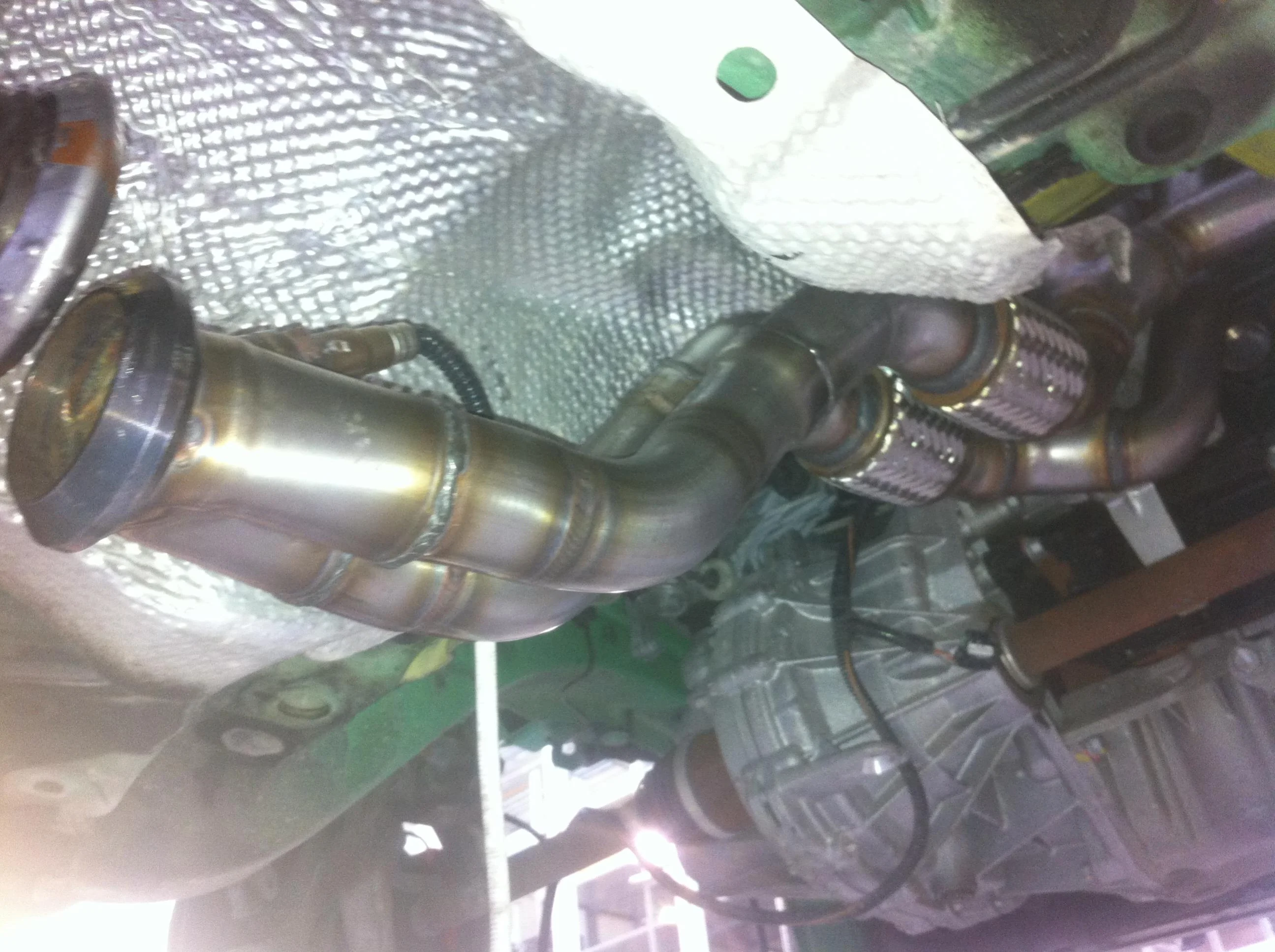

As from a previous post i mentioned my Manifold CAT had broken up inside and rattling, replaced during last week (dropping front subframe etc) thought while i have got the manifold out i would get the decat pipe, welded into place, fitted new manifold as shown in pic :p
All back together, sounds good :D Just waiting for my KTR RenFlash to turn up to do a remap :D (this week hopefully)

Fair play mate I'm rather jealous, i do really like the 200 and that colour is lovely with the black wheels. who due work for btw?
Thanks mate.. Yer i didnt think it looked right with gun metal wheels, so i decided to get them done lol.. I work for Toomey Renault in Southend lol whys that?

Your 200 looks much more "****" with black wheels :cool:

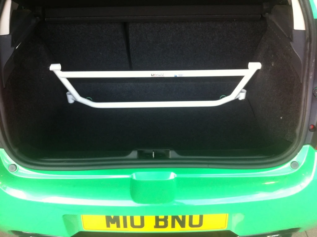

Went CS Saturday and got hold of a full set of braces! Fitted them awhile ago but didnt update this! Here are some pics!
Front Strut Brace
Subframe Stiffener
Rear Anti-Roll Bar
Rear Stiffener
