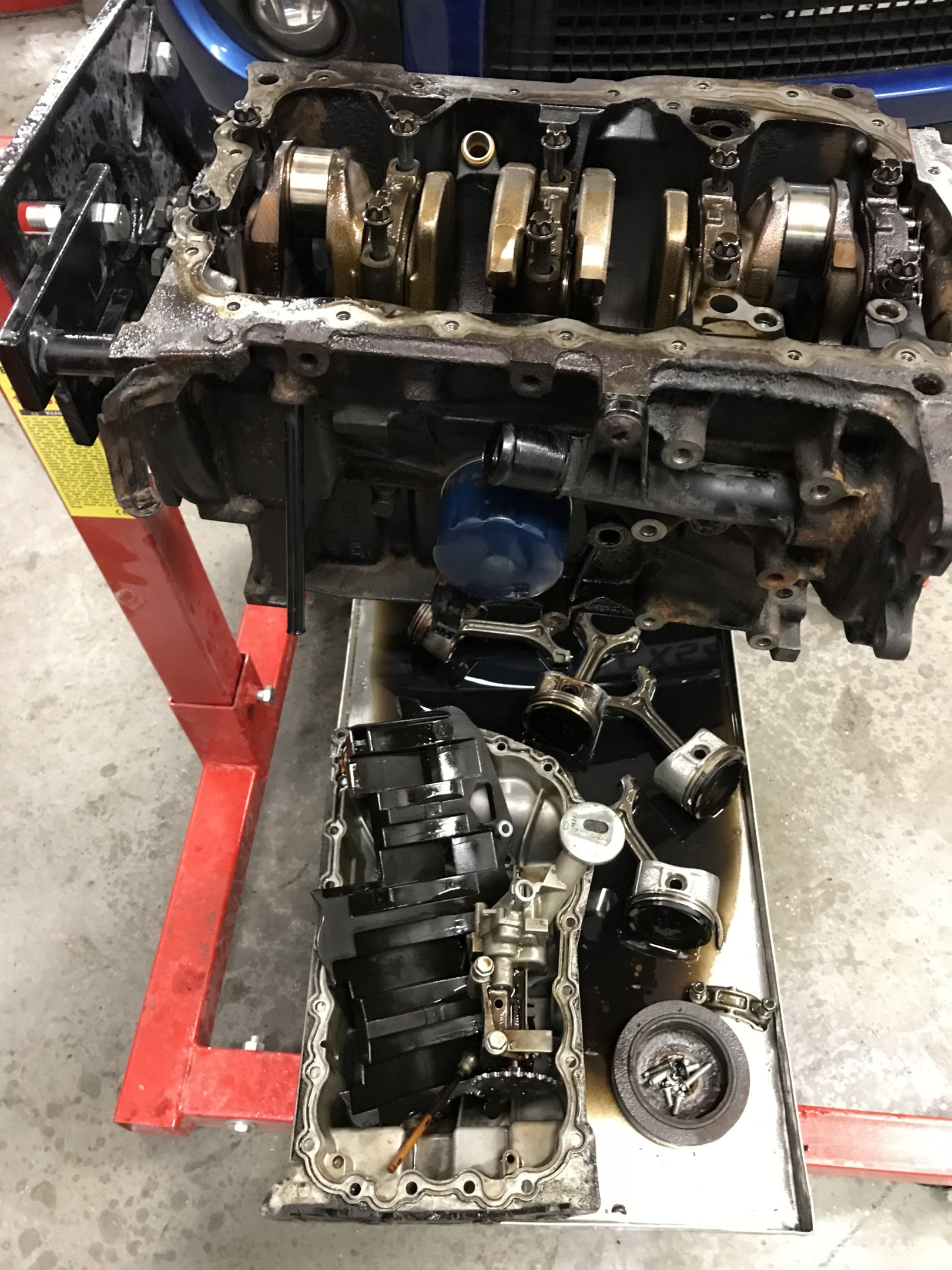

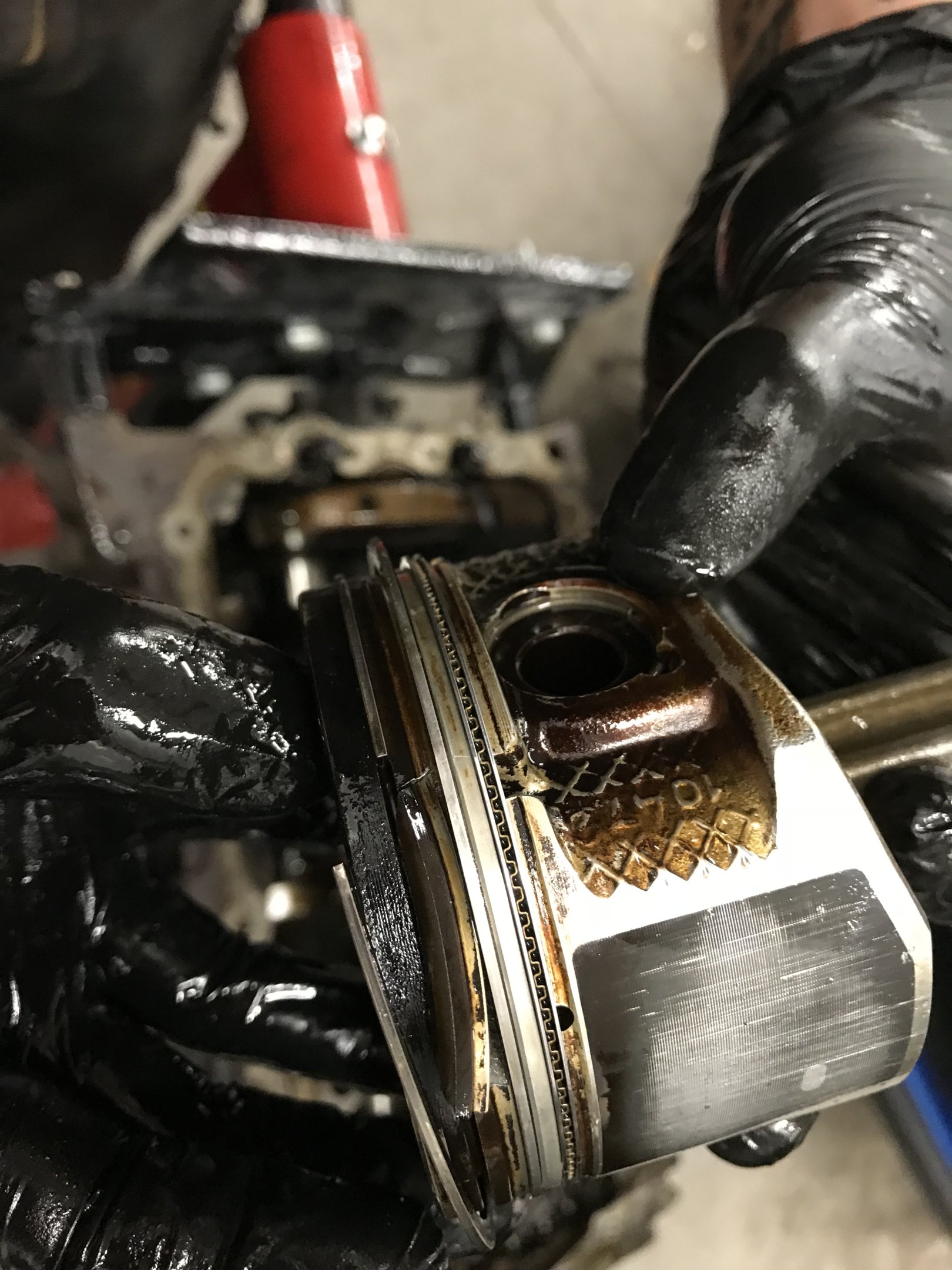

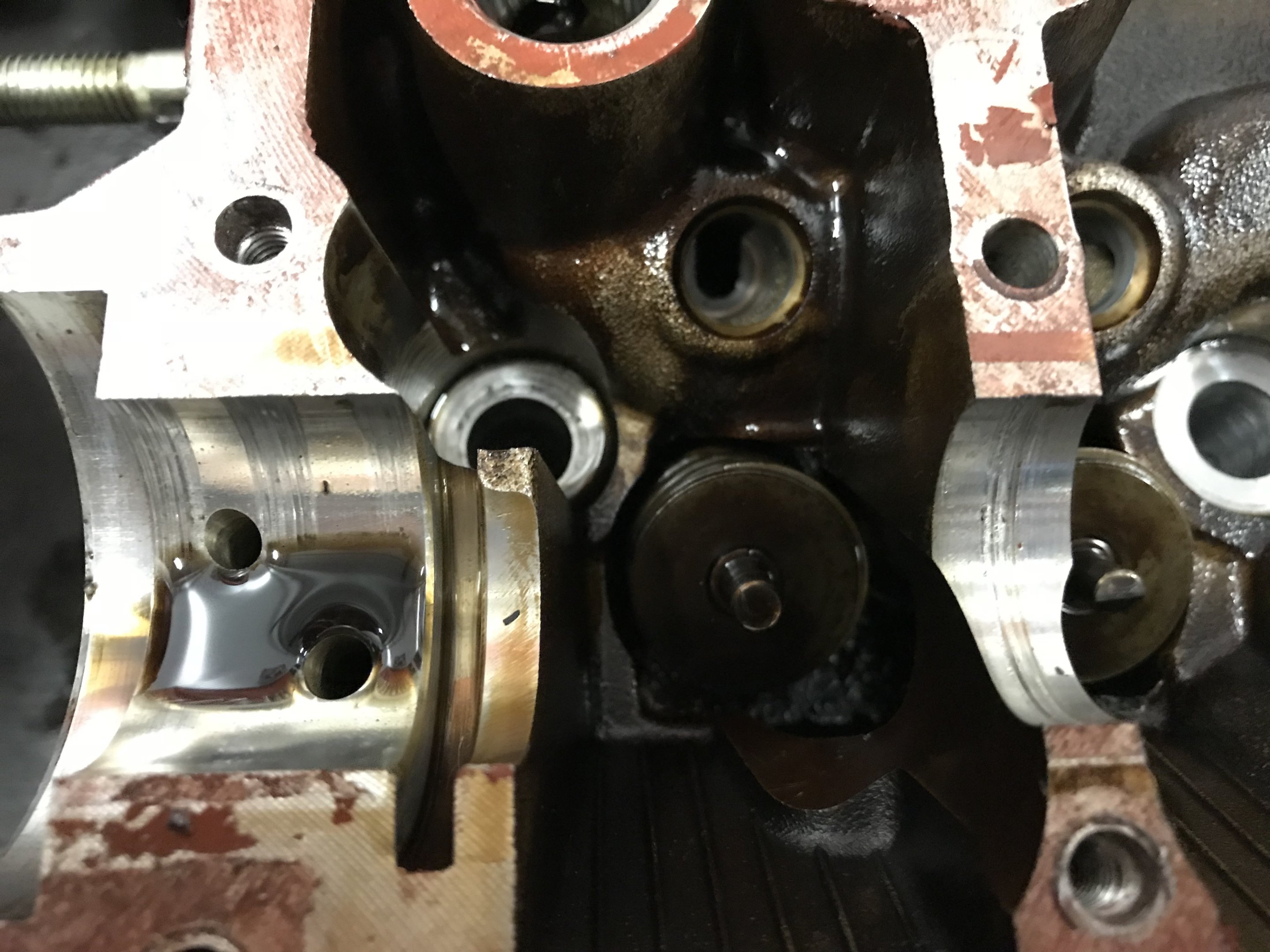

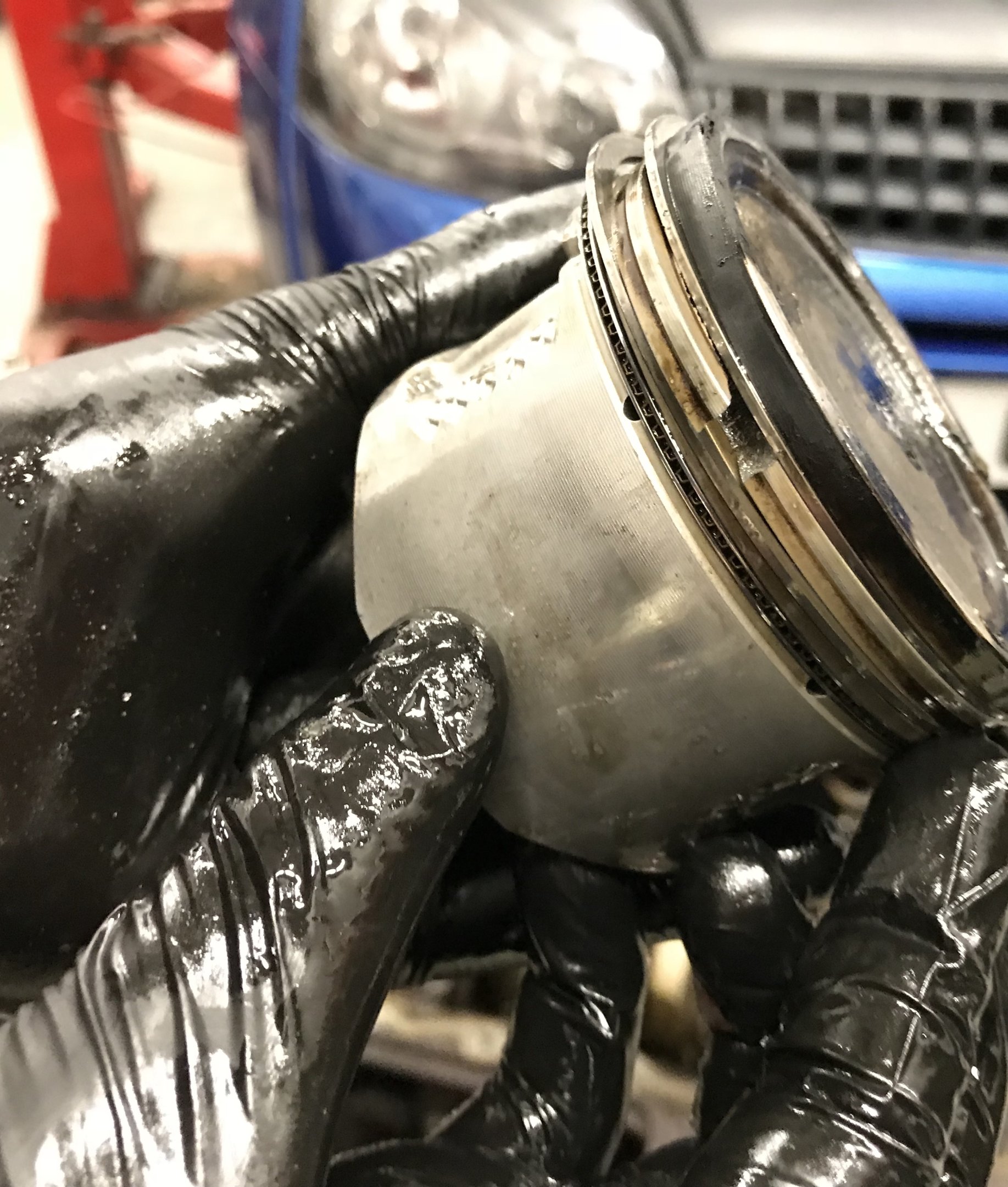

Damage to the inlet journals.

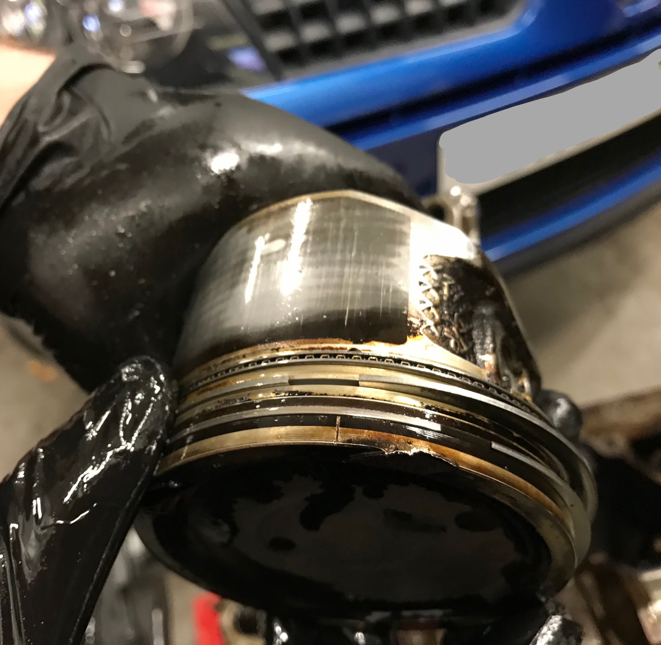

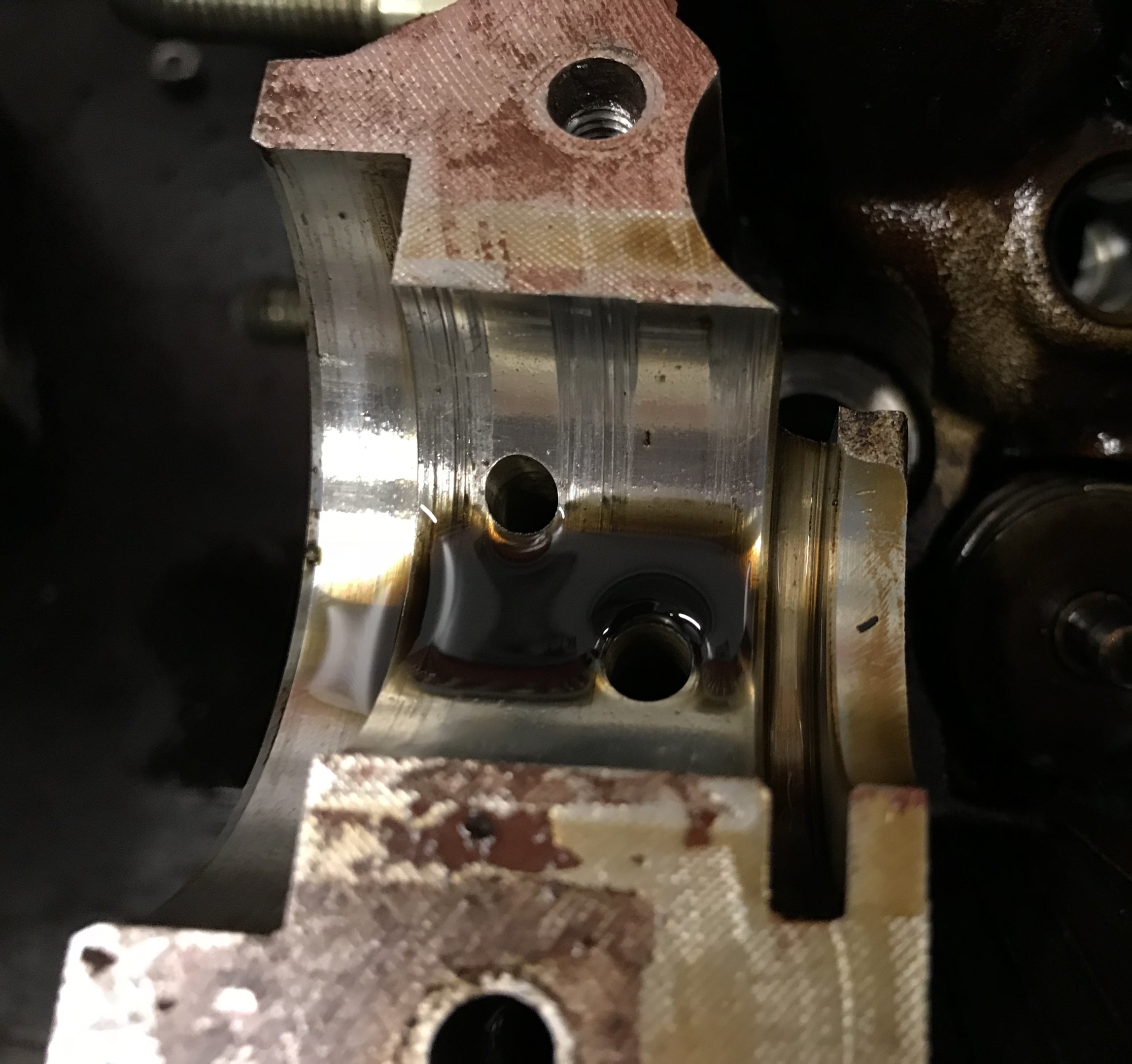

Shells were not too bad but some scoring.
Ringland on piston 2 an 4 were shot and the valve damage on 3 was the cause of the bottom end pressure :up:
To anyone boosting a clio, dont fit meggy pistons, they are turd!
I only drove the thing to work and back, i very rarely even booted it, pile of s**t things!
It wouldnt surprise me if they were fucked when they were fitted tbh.

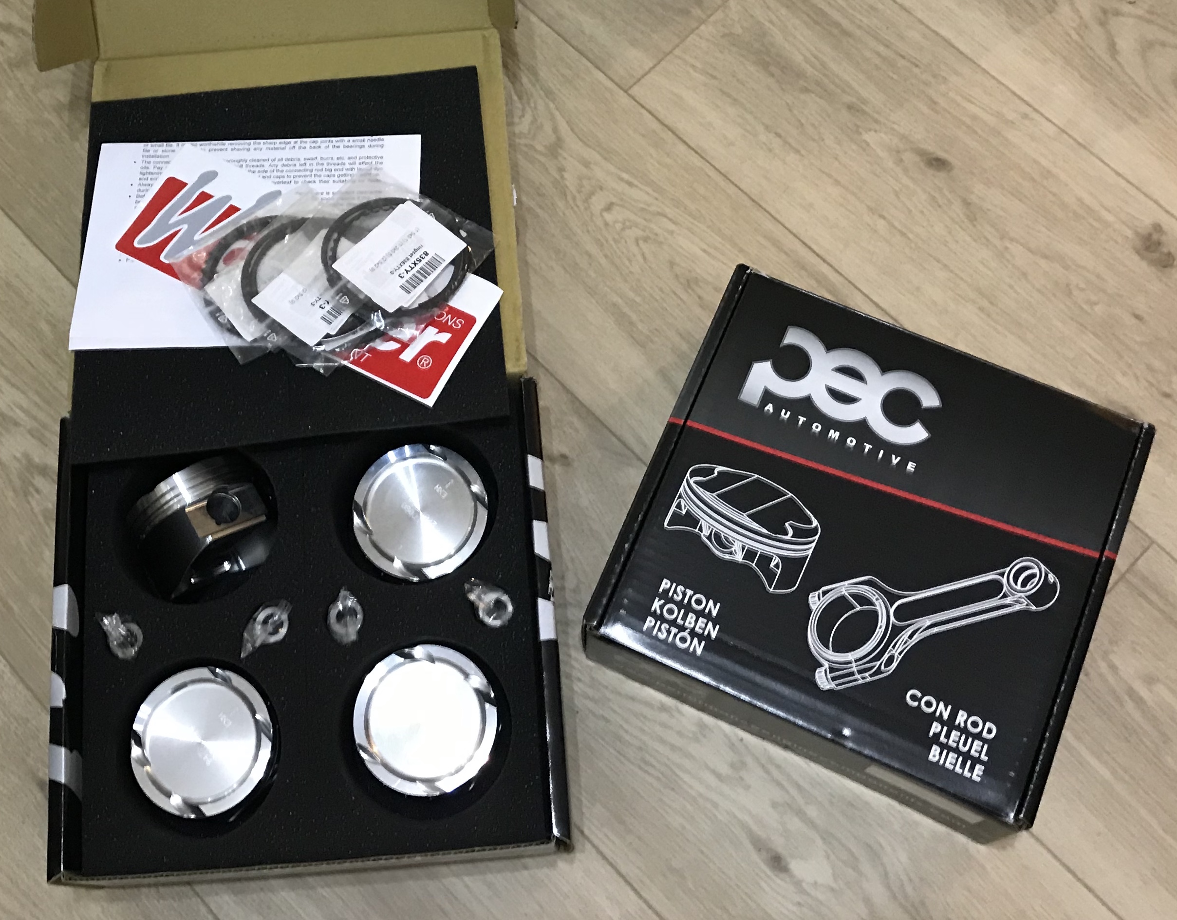

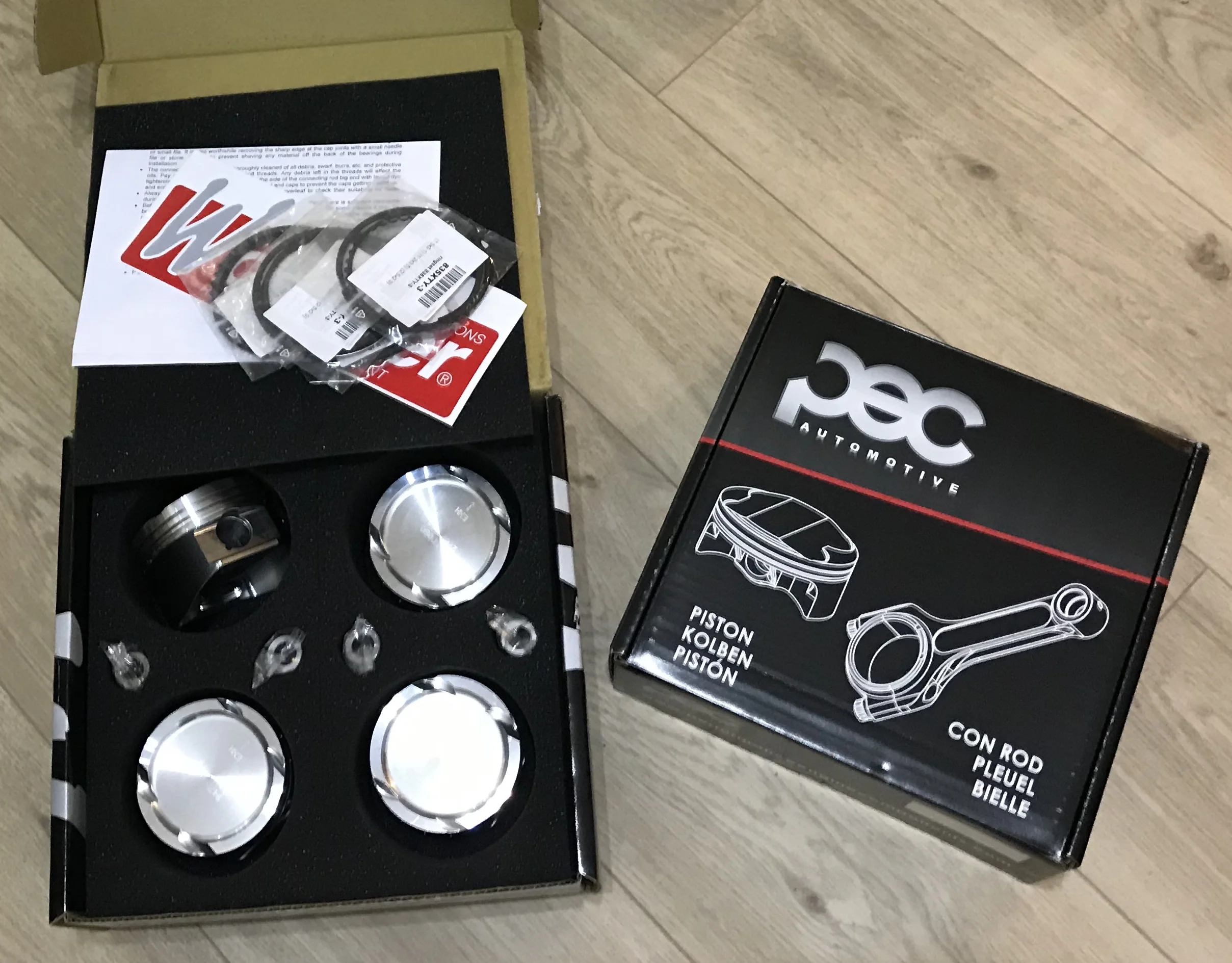

I've ordered Megane Wossner pistons and PEC i beam rods. I am having the block overbored to 83.5mm. Going the have the crank ground and balanced too. Am looking into no VVT cams and running vernier pulleys with supertech valves and springs BUT that may change
Nice! Will be a very capable motor :cool:

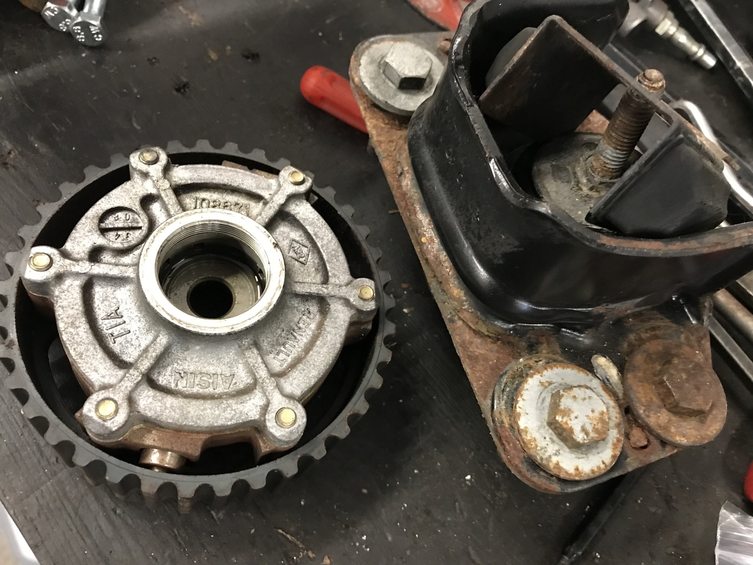

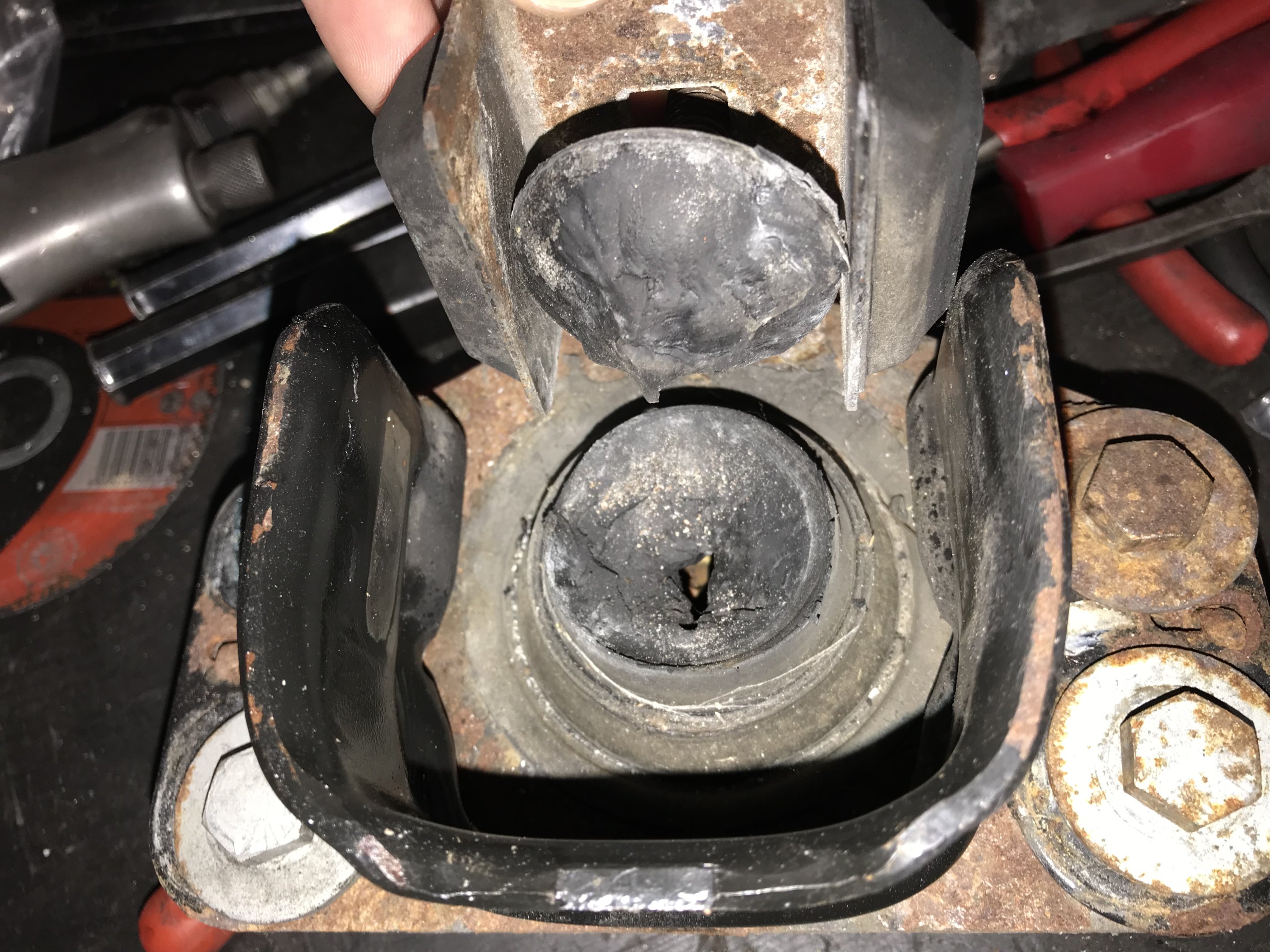

Old top mount and dephaser off the Cup. Replaced the top mount with the 182's Vibra mount :up:

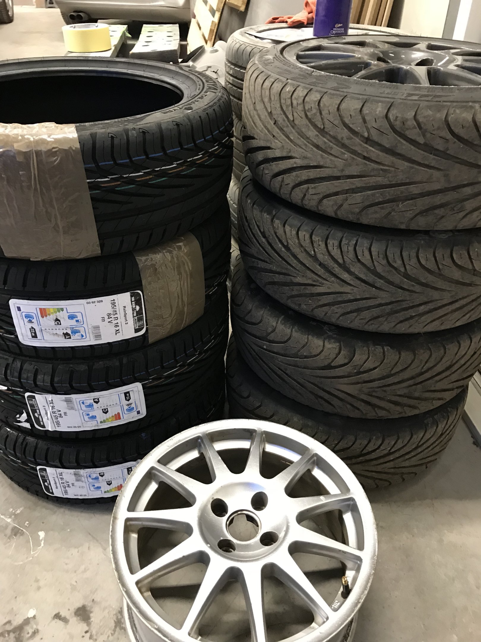

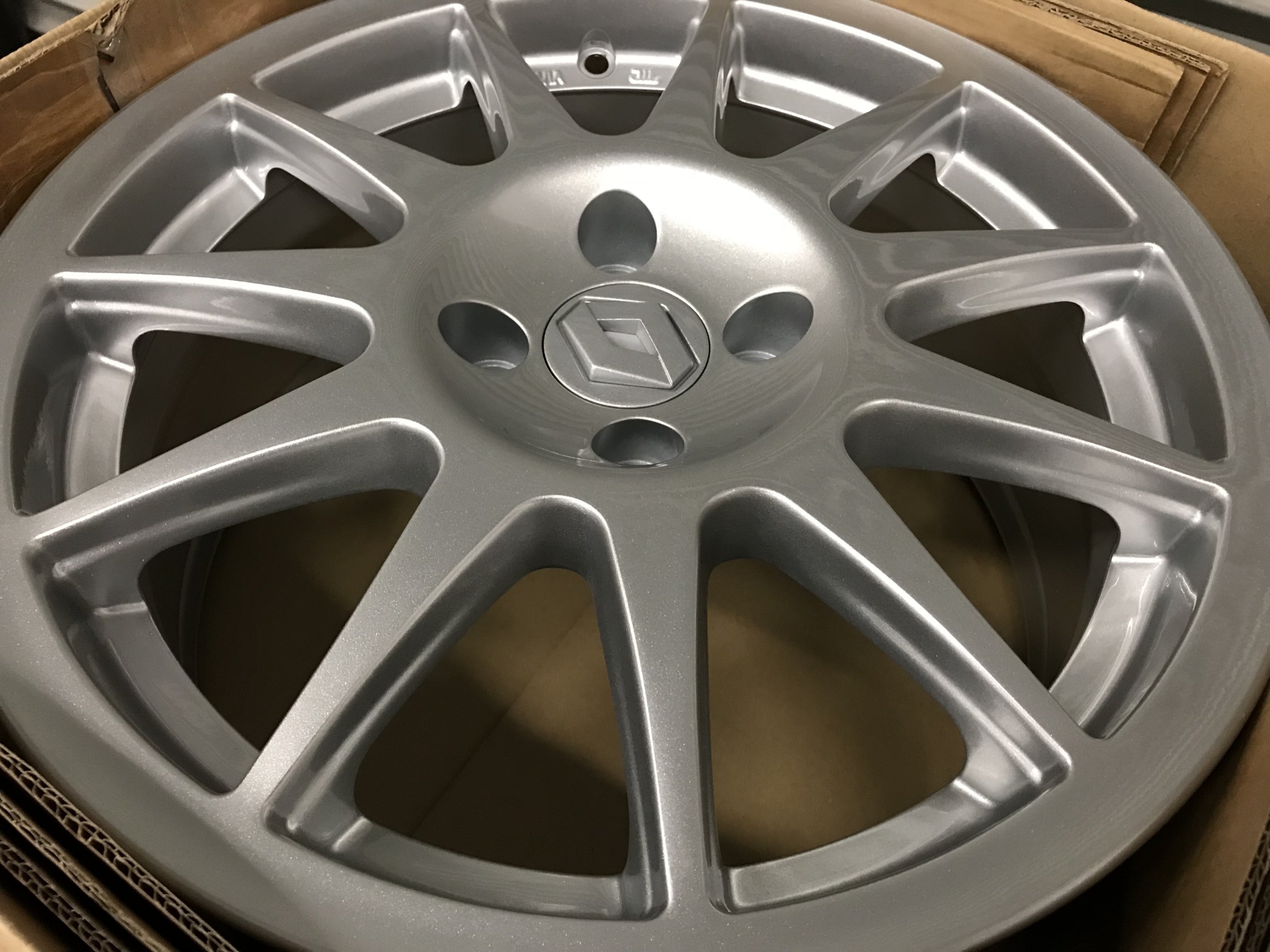

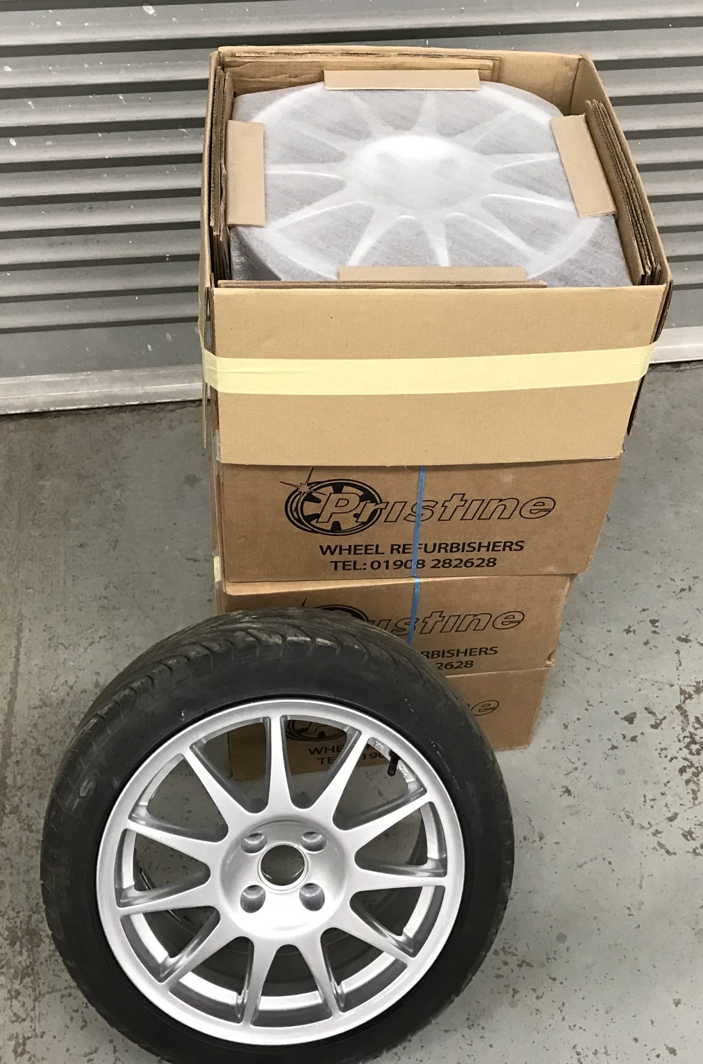

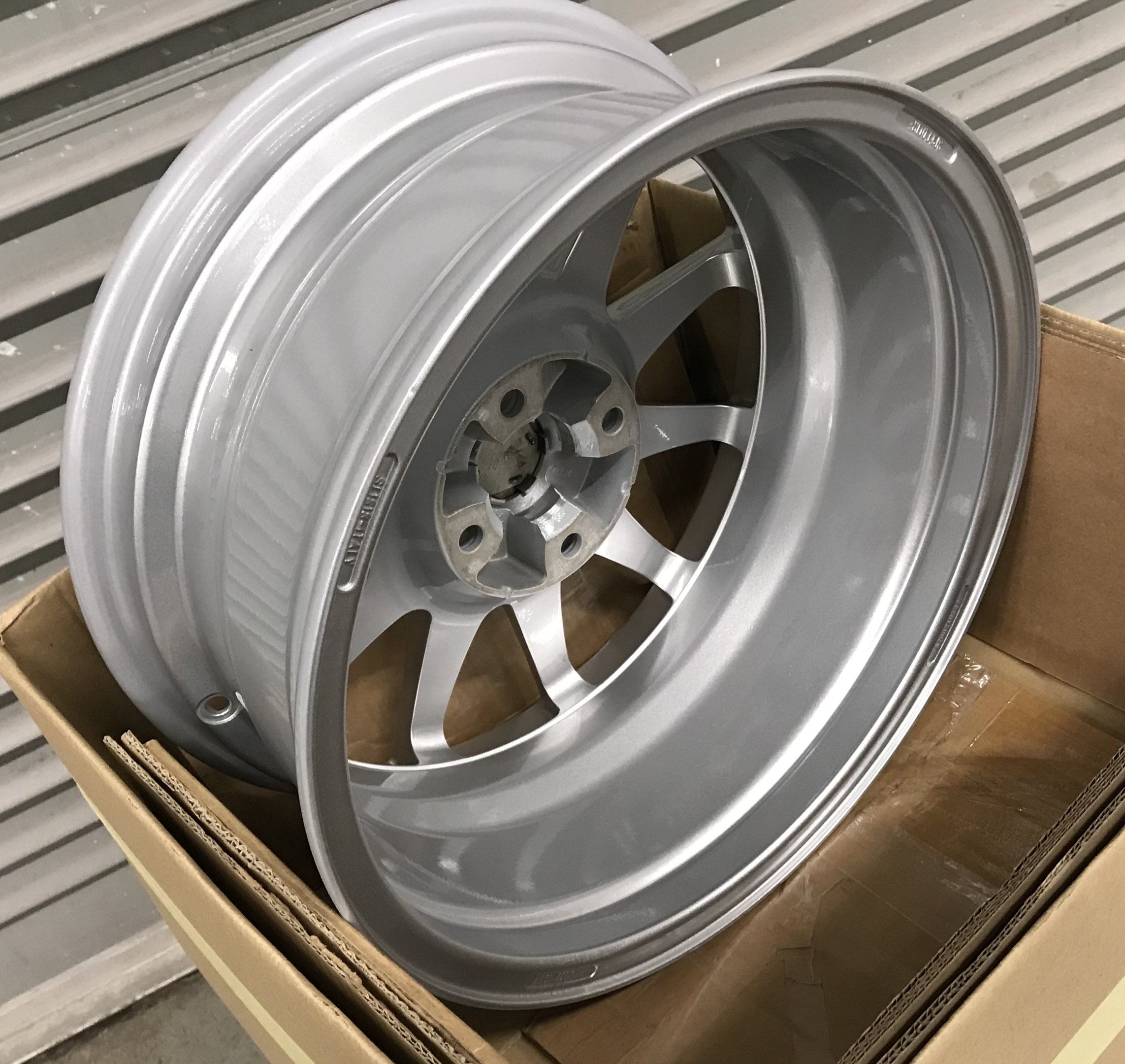

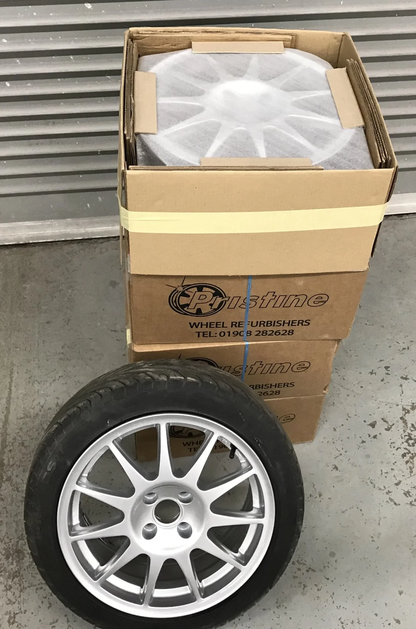

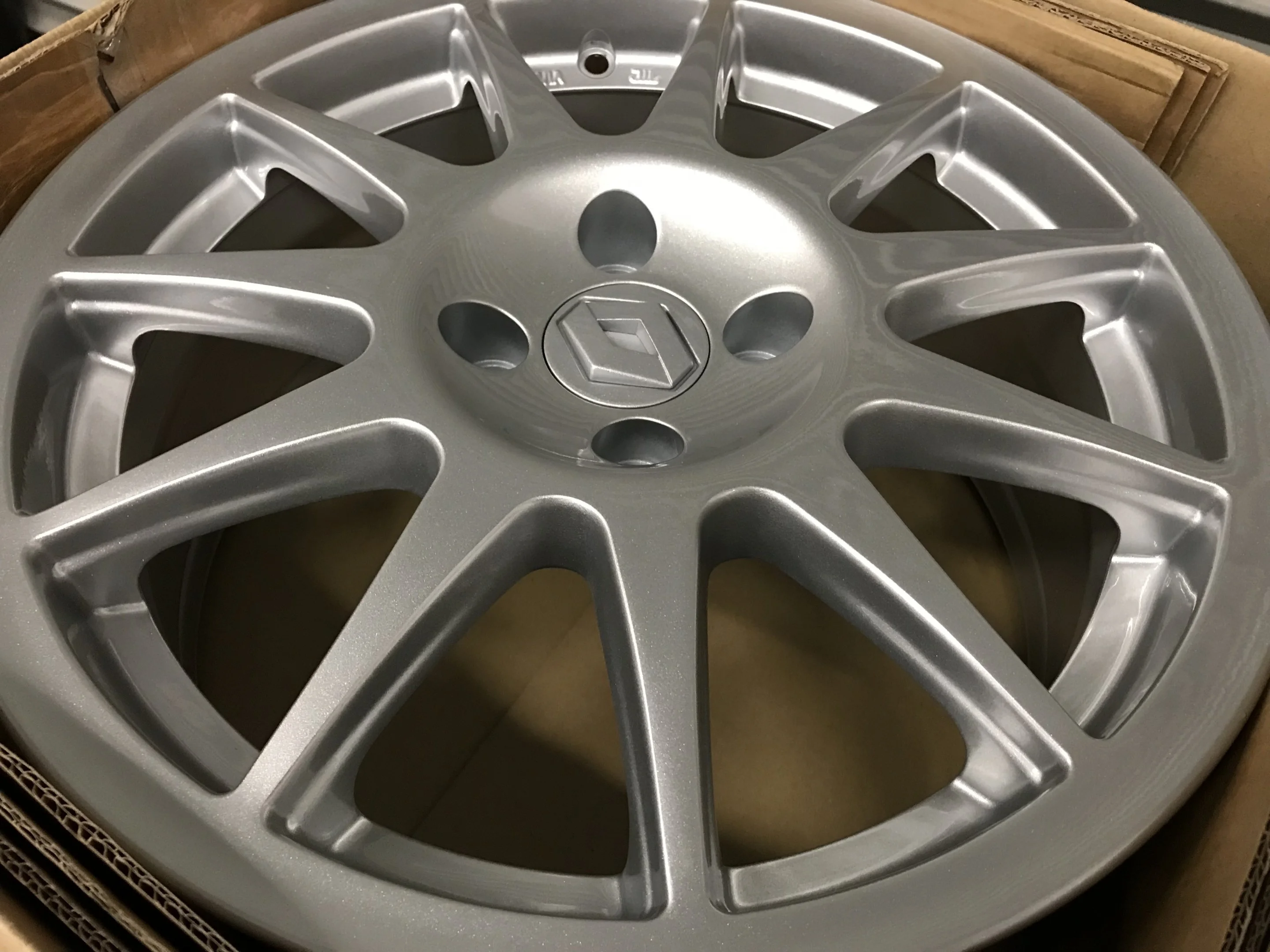

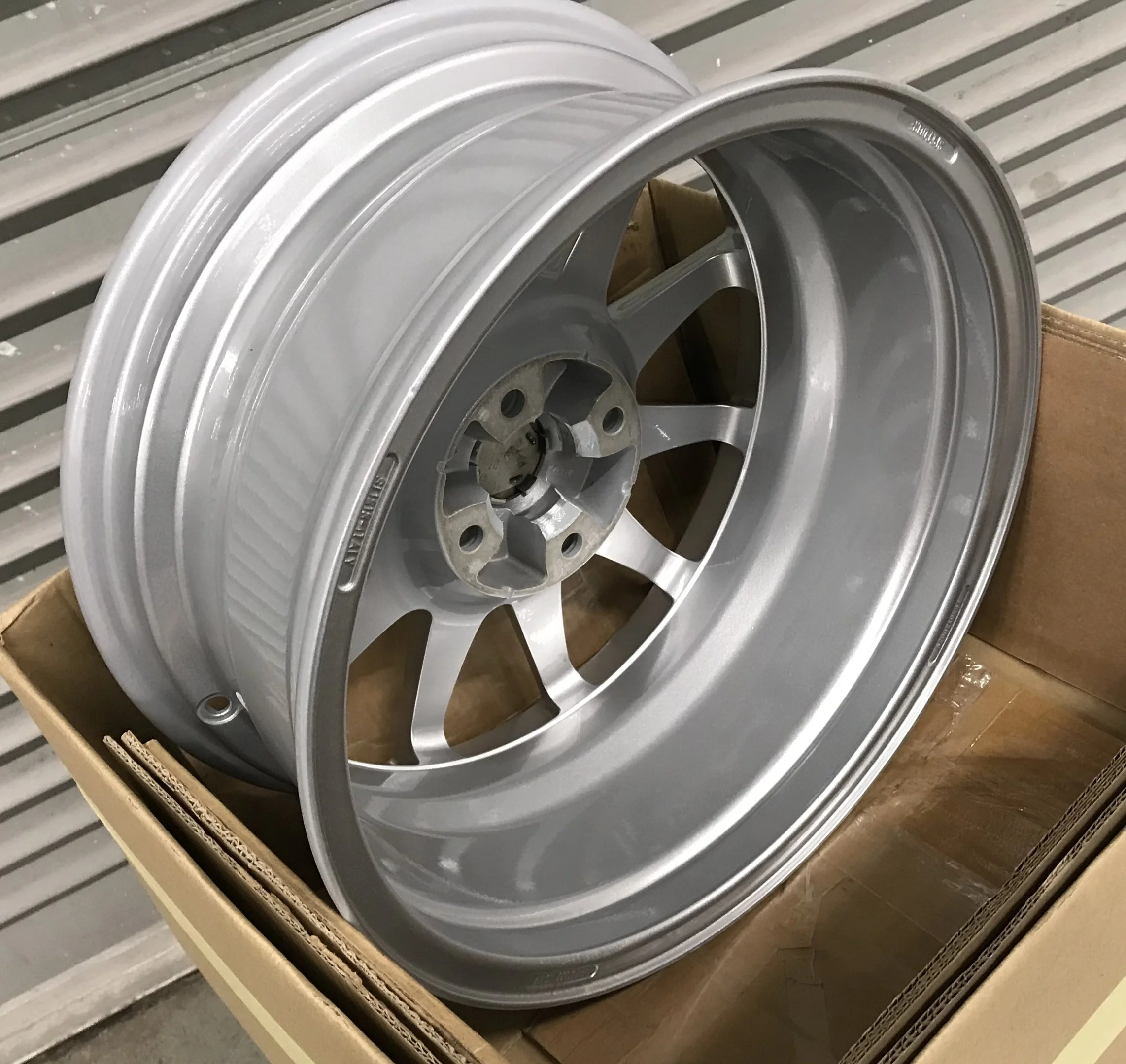

X5 Alloys refurbed (should be back Tues)

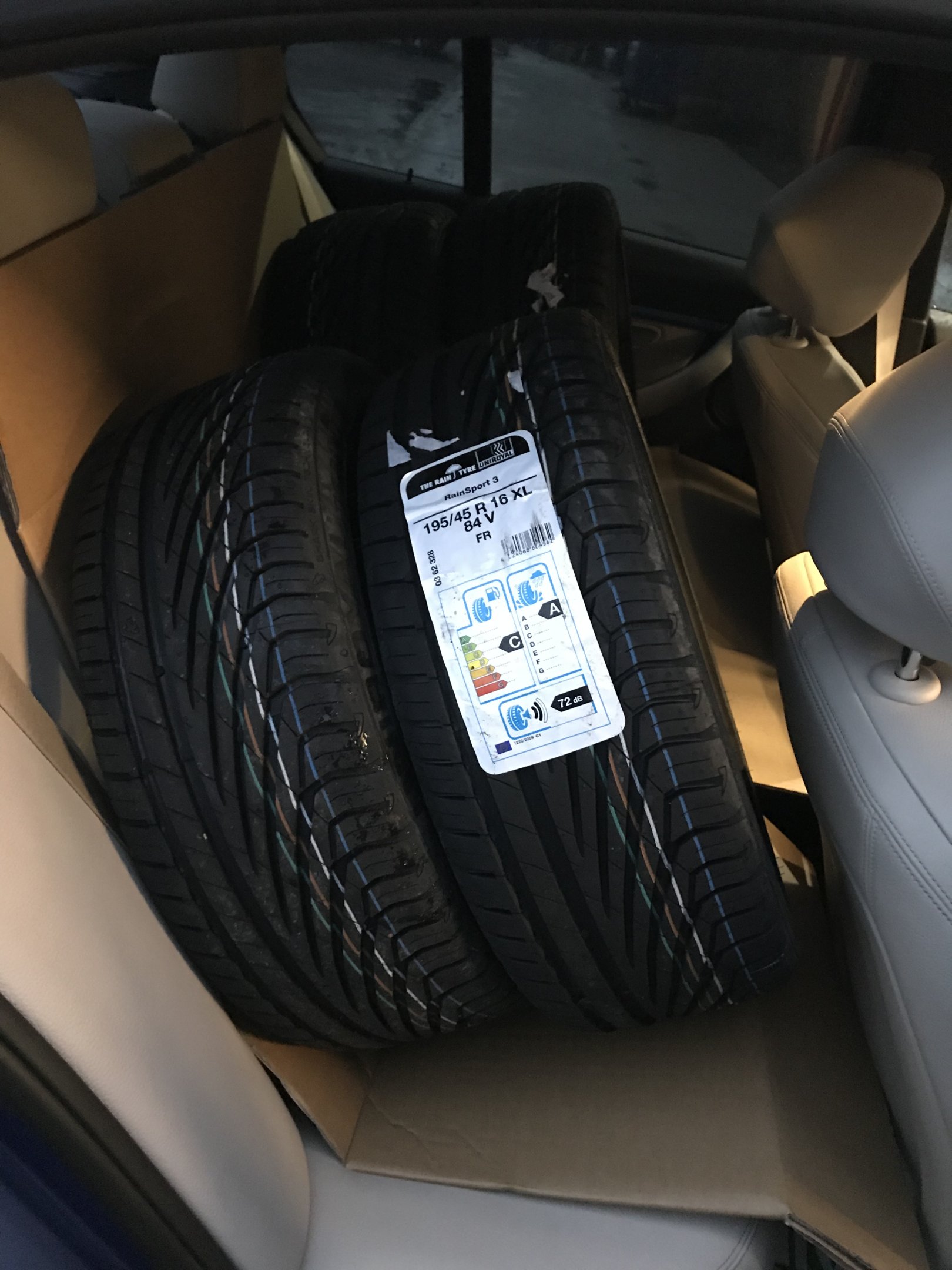

X4 Rainsport 3's

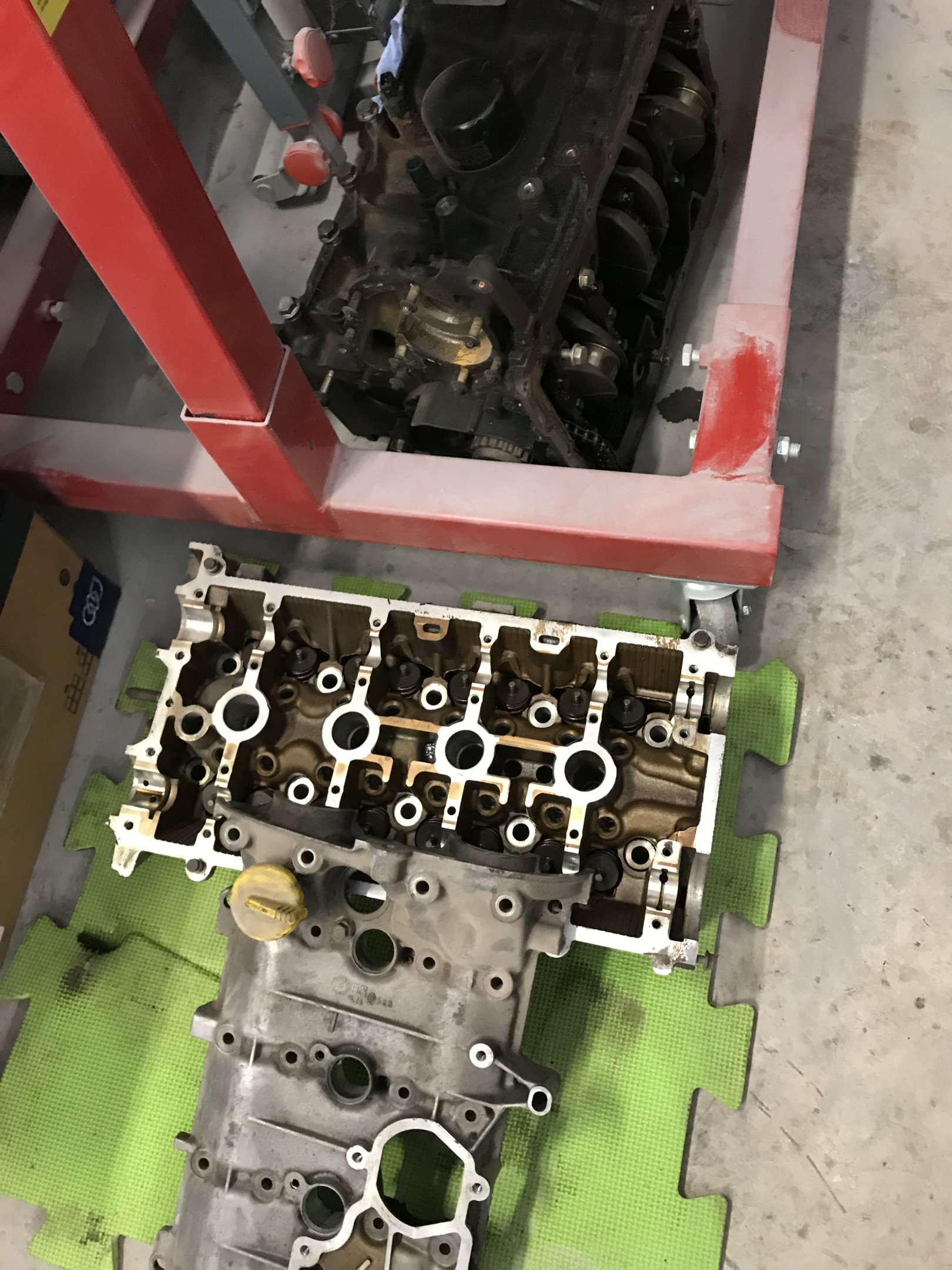

Picked up the new 2nd head for the 182T, came with a free block and crank :up:

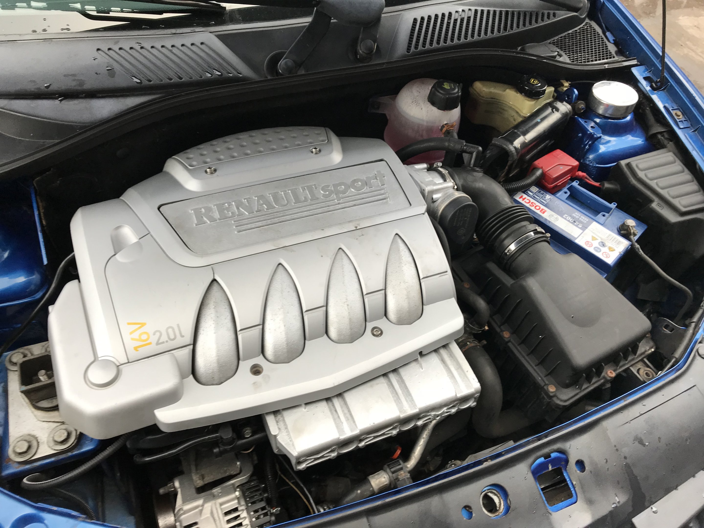

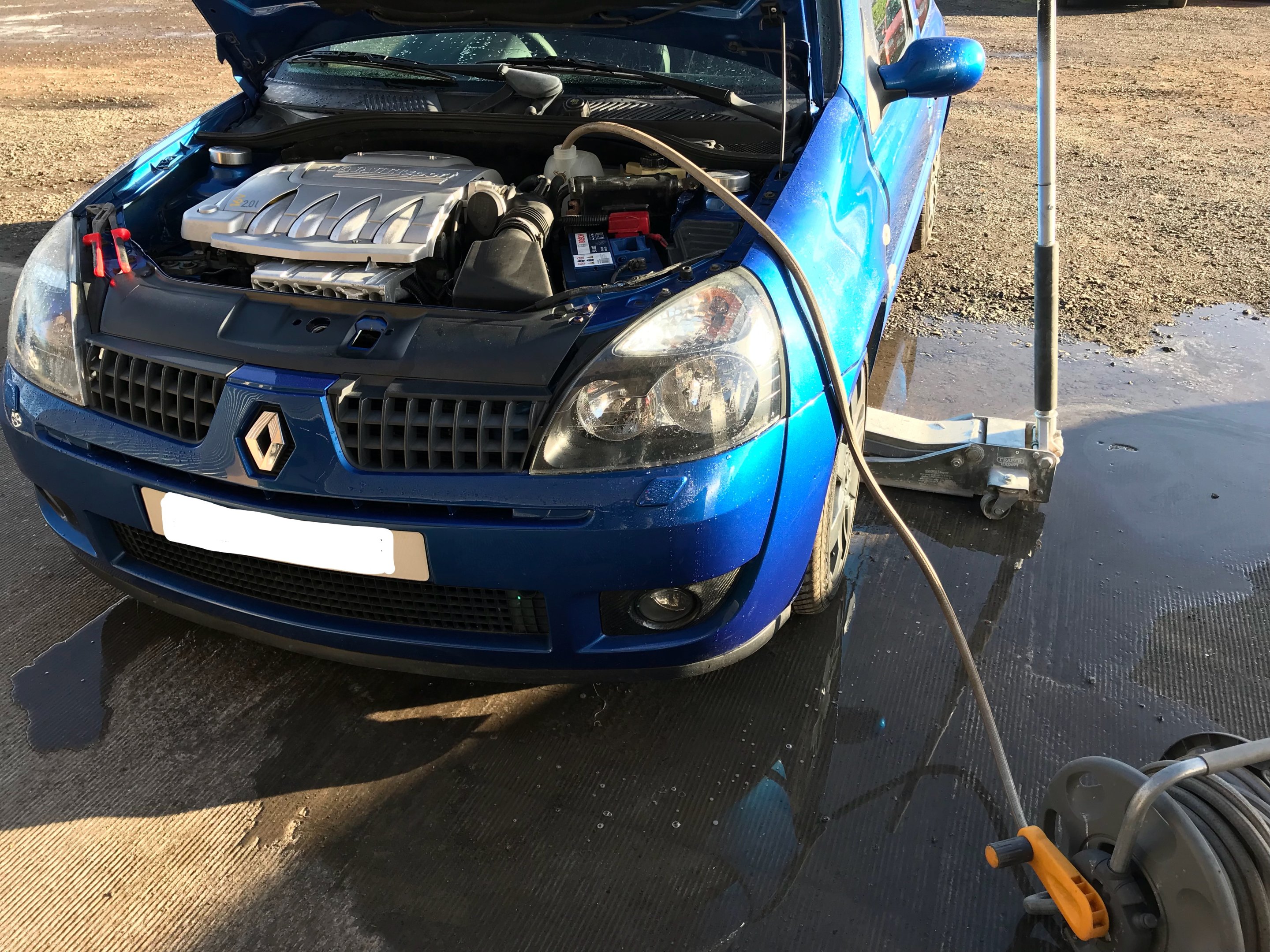

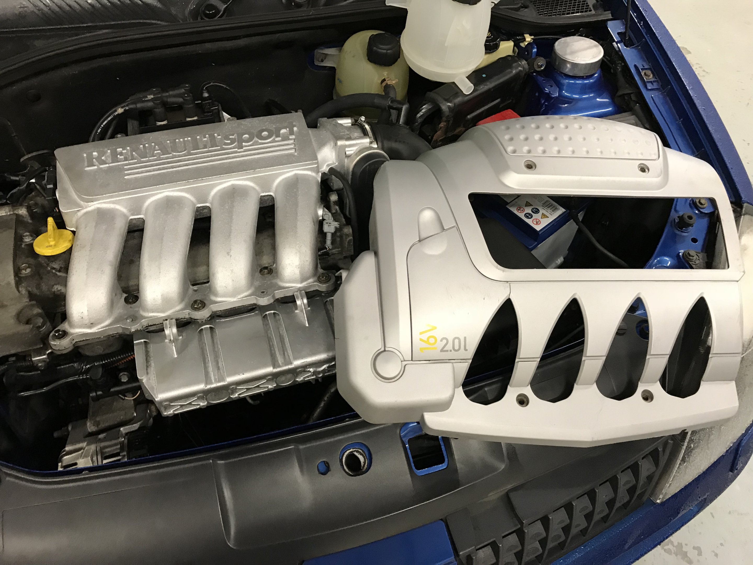

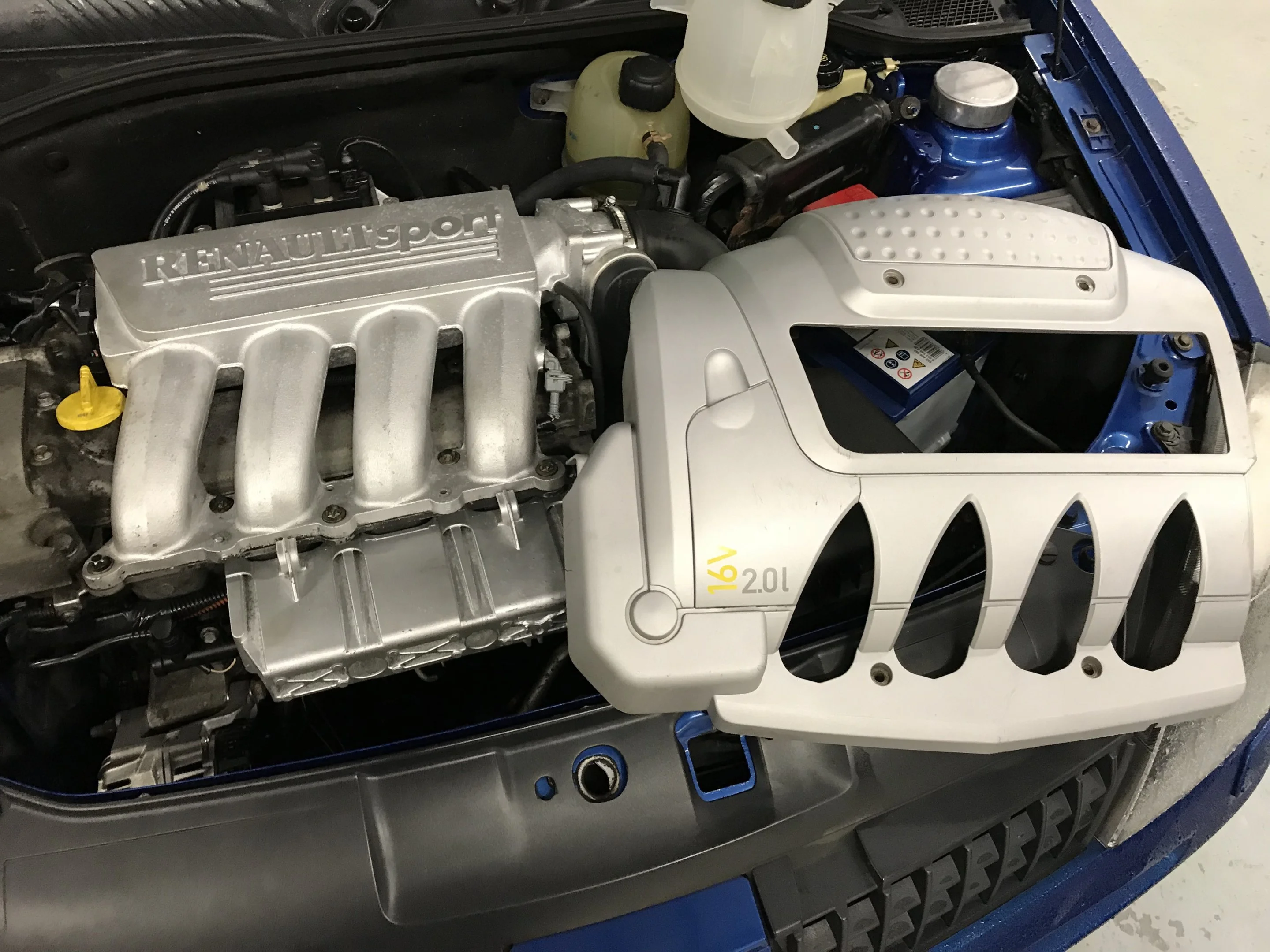

Fitted an engine cover and new header tank with fresh antifreeze coolant. Also did oil and filter along with new air filter. She'll soon be ready to help pay for the 182T build.

Looks good, love the wheels
What do you think caused the pressure in the bottom end from its original problem? I read some where’s turbo 172/182 suffer as they don’t have a one way breather on the crank case like the Meganes?
Don’t know how true that is
