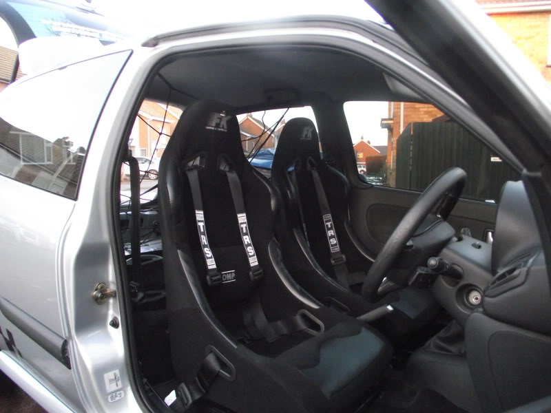

Interior- Stripped interior
fk bucket seats
omp seat subframes
TRS harnesses

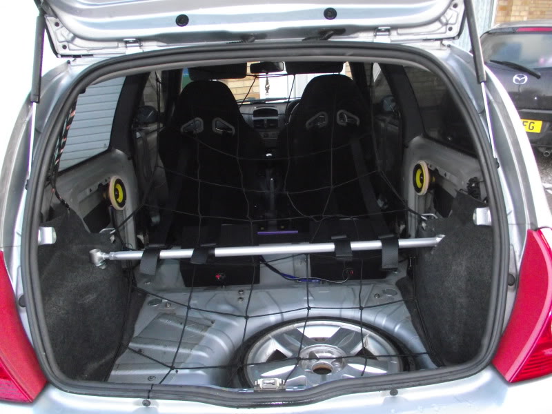

cargo net

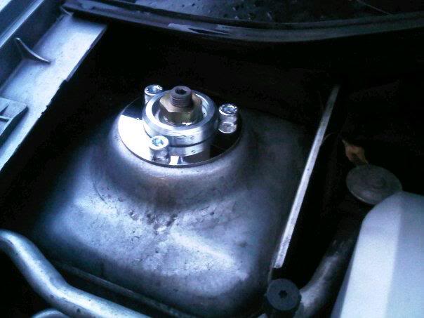

Suspension- Pure motorsport solid top mounts

Rear upper Strut brace

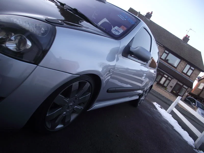

Clio 182 alloys

Looks good, just get a sabelt wheel in there and your winning..
EDIT: wtf, your seat belts are attached to your strut brace :0
Looks great, although don't fancy being in an accident in your car with the belts mounted to the rear strut brace.
wouldnt anyone advise that then? i can bolt them to the floor aswell but thought that looked better....................
not just looks.. to b honest thought it was pretty safe................. the strut brace isnt hollow its solid.
Neither the bar nor the mounting points for the bar are strong enough. Do it properly and get a rear cage with harness bar or go back to the original belts.
What holds the strut brace to the struts? 2 ten mm nuts! Thats all thats stopping you and a mate (20 stone if you're both skinny!) going through the window!
Apart from that, looks really good with a good spec!
Ye i will get them bolted to floor in the rear were original belts are secured.. Thanks again for the advice anyway. u could of just saved my life :)
Just so you know, attatched to the floor isn't ideal either. Potentially brakes your back in a crash. As said above harness bar to your cage or seat belts until you do. If you're going to do it, do it properly. Otherwise you'll look great in your harness.....until you crash.
Not worth the risk bud.

track car with lots of rear speakers??

and change your harness mounts!! :)

First of all, remove all those daft rear speakers. Again, if the worst happens they are fcuking heavy lumps that will smash you in the head and probably kill you. We don't want that.
Then decide if its a proper track car, sort the cage/harness situation out.
Also, if you're planning on keeping the carpet in it, remove the sound deadening from underneath. The carpet weighs fcuk all but the foam stuff underneath weighs a ton!

When re-mounting the harnesses, try to use "stress plates" and the inappropriately named "high tensile" bolts where possible if you can't stretch to a weld-in cage. E.g. http://www.demon-tweeks.co.uk/performance/harness-eye-bolts-plates

Apparently the 182 wheels aren't great for brake cooling, id get some cheap-ish multi spokes and ducting to them if you've not already. As well as sorting the harness issue. Death is bad, mmkaay...
ye speakers are just cuz i drive 300miles a week so like sumot decent to listen to music on cuz its my everyday car..
but ye im going to sort harnesses out and i didnt realise foam weighs so much lol

Lasted all of 1 session at Donington, if you want inspiration read some of the build threads on here, there are some proper track cars on this forum that get used on track. Remove those speakers ASAP or secure them properly same with those harnesses.
