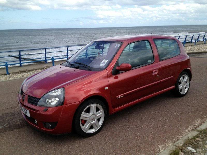

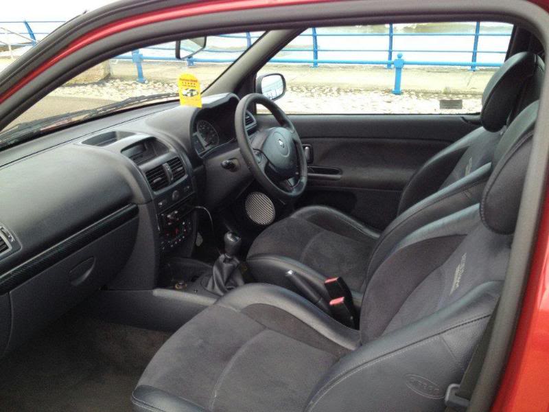

Just introduced myself and after picking up my car this morning at 10AM I got cracking straight away.
It started like this - (dealer pics)

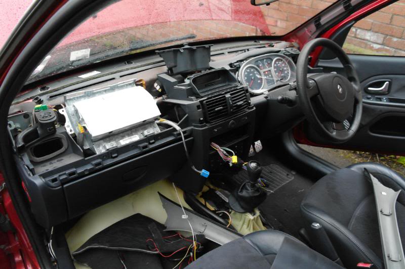

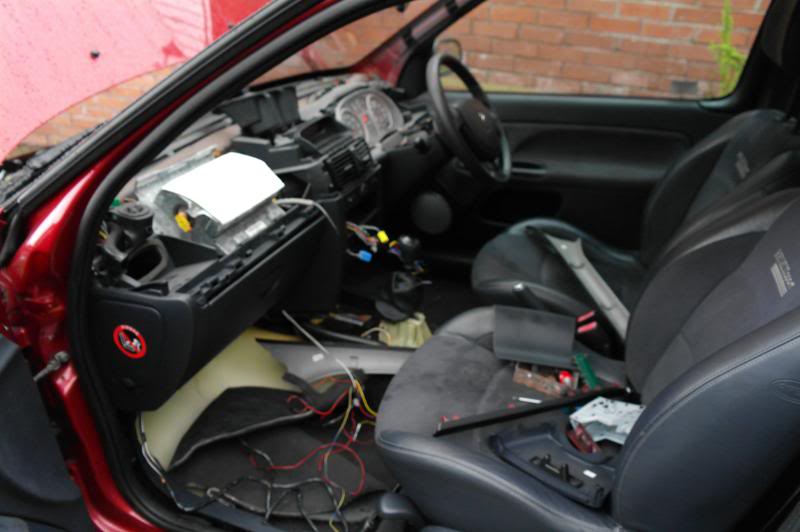

Upto now I have;
- stripped top of dash
- removed old ICE cables
- LED number plate bulb
- LED sidelights
- aero wipers
- short aerial
- in process of removing an old redundant alarm

As I left it today;

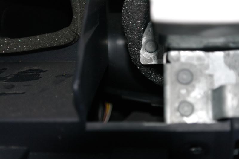

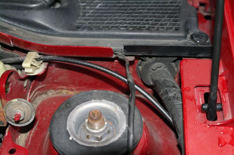

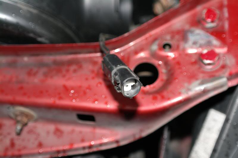

Question I have for people is - anyone know anything about these cables;
Engine bay RHS - ties into a power cable before going behind bulkhead;

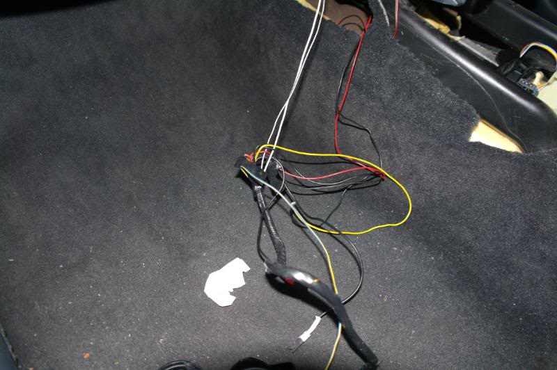

Then this appears to be on the interior side but cant find a module anywhere as yet - any ideas?
It was indeed the bonnet shut sensor and has duly gone in the bin along with the remnents of a Cobra alarm and ICE wiring

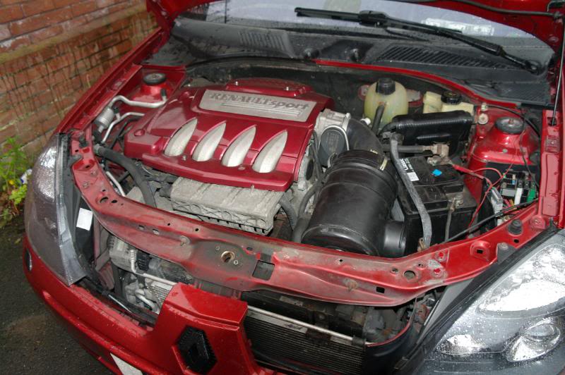

Painted the inlet plenum where it shows until I get another manifold to port and paint properly;
Another question today as well, this hose going to the throttle body - what is it for and why is mine blocked with a bolt?
Also got the paint cans out for some interior and exterior - the wheel centre badges have been painted anthracite as well as rear Renault badge;
Moved onto the interior and painted the dash inserts and the speaker grills to get rid of the Carbon wrap and silver paint;
Then removed the front fogs and wiring ready to make my custom ducts and also an air feed to the 3.0 V6 airbox

Question. Why did you remove the botton shut sensor ? Does your 172 not have a standard alarm ?
Sam!
Need to do more digging around on the car for the standard alarm but the Cobra was left with wire cut yet still connected to the battery - same as remote cable for ICE and few other cables. The alarm had been wired into the hazard switch for the flashing lights but the button was left not working same for the interior lock button. Shocking wiring in all honesty - fixed now though.

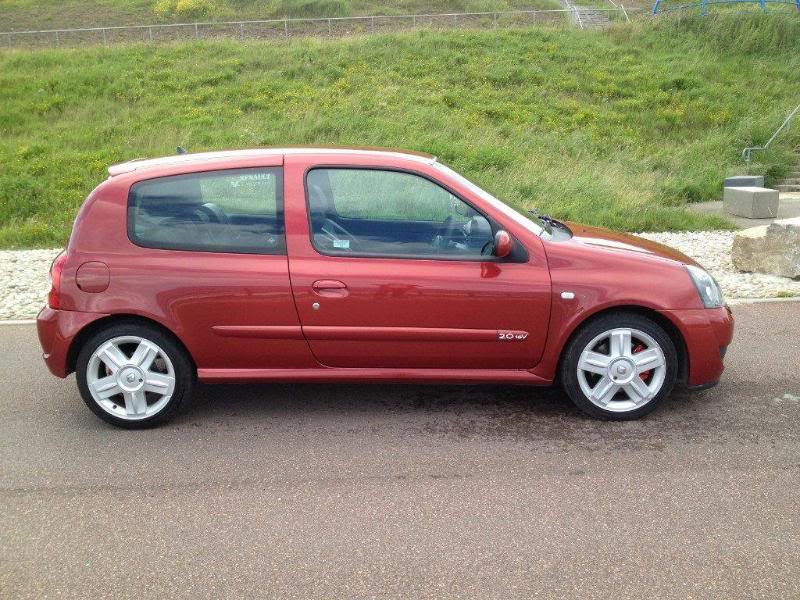

How the car sits before the coilovers arrive;
