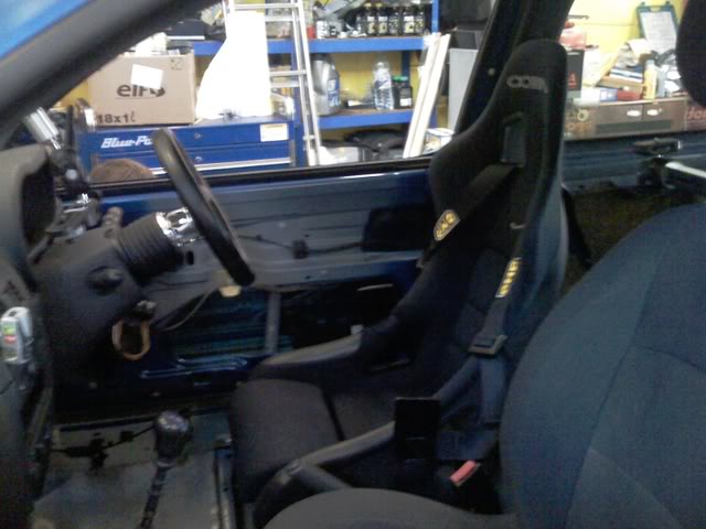

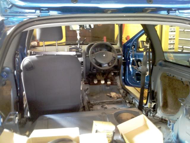

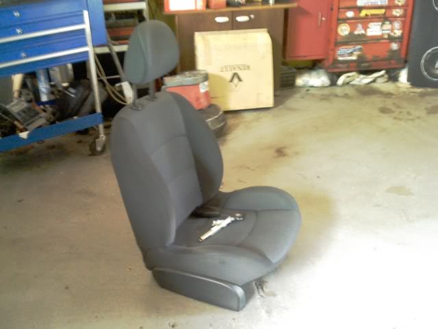

First things first, out with the driver's seat

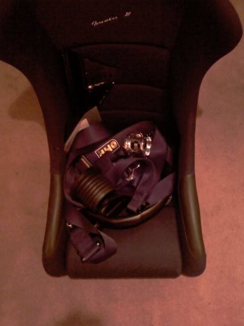

Bucket of lard

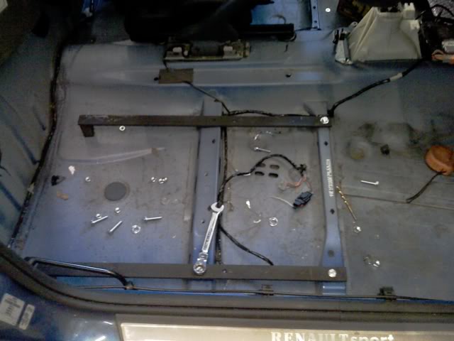

Brackets fabricated

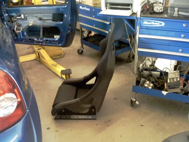

Bucket of lovliness

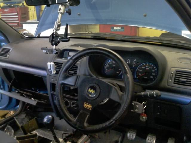

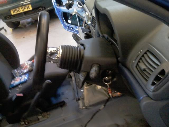

On with the wheel, boss and spacer
It's a bit of a reach to the stalks LOL

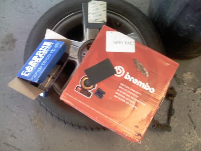

New front brakes ready for castle Combe on Saturday

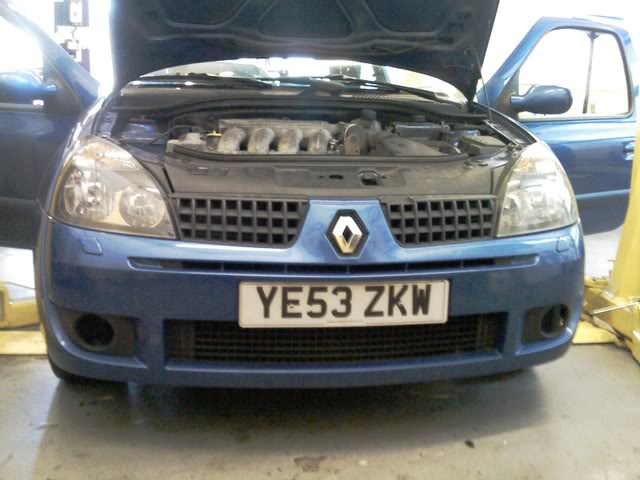

Foglights (and carbon thingy) removed

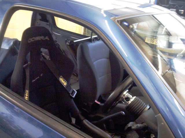

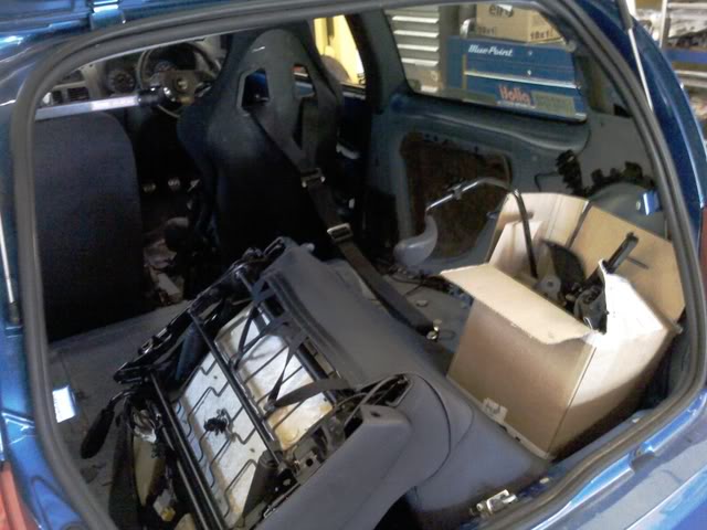

Seat and harness go in
Ready to go home to weigh all this
A nice little finishing touch

Daft question!, why did you need to put the spacer between the wheel and the colum?, is it because the new seat sits you further back?.

Ditch the passenger seat for another bucket seat and even more weight saved! Looking good. Would love to know how much that cup seat weighs?

mark, re that spacer, i bought a snap off from driftworks, fits solid as a rock with no movement, and lets you pop it off for security, will give you the same extension as that. About 70 quid I think it was. I have an OMP wheel, so it'll fit the boss you have on that one I think.

I always find the steering wheel to close to me, and if you move the seat back can't reach the gearstick, bloody thing lol.
To get comfortable with leg reach to the pedals, at 6ft 1in without a spacer the wheel's too far away.
I'll find out properly as soon as I get it all back.

surely your sub 950kg's or so?
With everything gone (carbon thing is surprisingly heavy), as well as the wheel carrier/tyre foam and fog lights, I think I've taken out a good 35 and maybe almost 40 kgs. The steering wheel and seat/bracket is a struggle on its own.
What seat is that mark? Imola S?
I think it's an Imola 2...that's what the cover says, but I was told the cover was a recent replacement IIRC so might be a different model. It's got low side leg bolsters, is made of Diolen (whatever the f*** that is) and weighs in at 5-6 kgs.

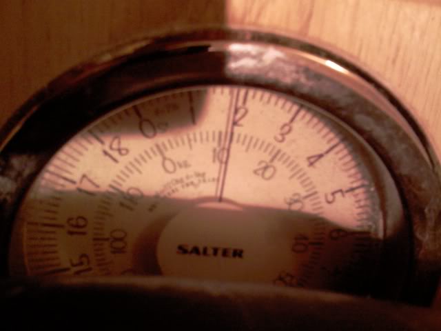

Here's what I put in weighed;
Add 2kg for the bracket and fixings, and that would give me a kerb weight of around 935 kgs.
So around 190 bhp per ton.
