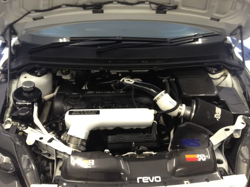

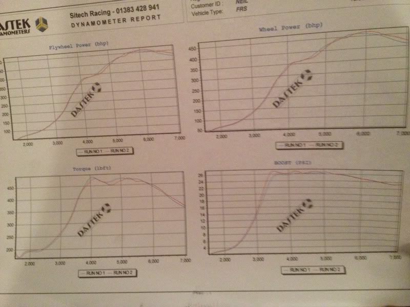

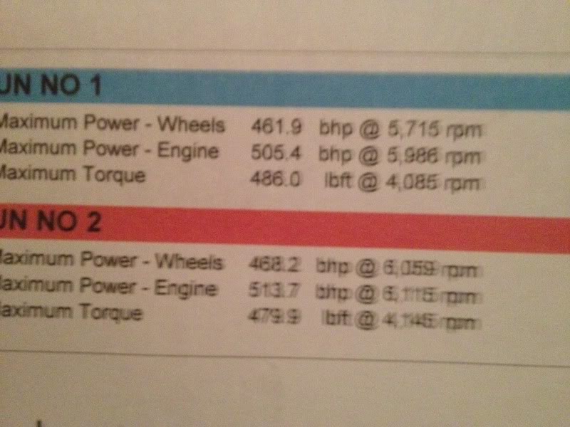

Ive had this about 2 months now and added to the spec a bit,taking the power from 440 bhp upto 500.
Revo stage 4/5
Spec R cooler
Spec R boost pipework
Spec R oil cooler
Spec R header tank
Spec R power steering tank
Pro alloy breather
Remus exhaust
Sitech Plenum
Group A K&N
SCC fuel pump
Sitech/Loba hybrid turbo
Sitech stage 1 cams
Aquamist water/meth injection
Sitech clutch and flywheel
Carbon dress up kit
BC coilover
Polly bushed

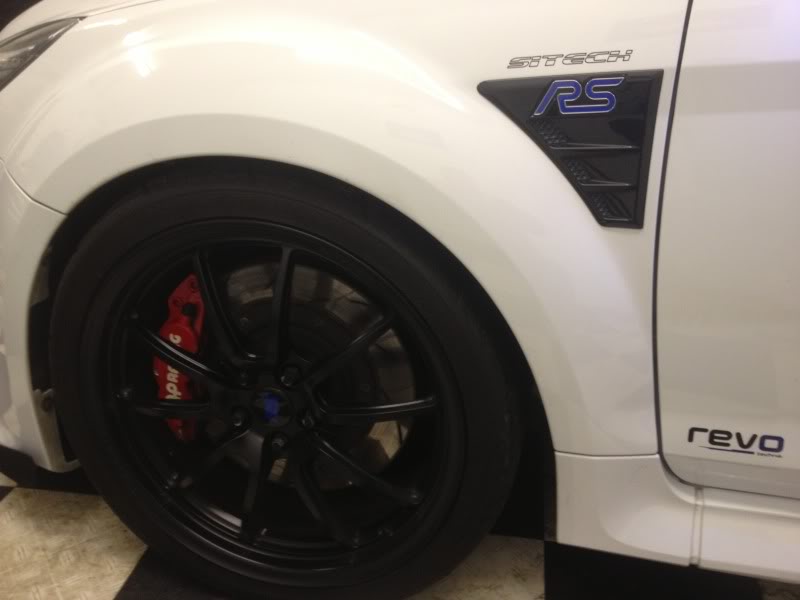

Ap brakes
Forged team dynamics
888's

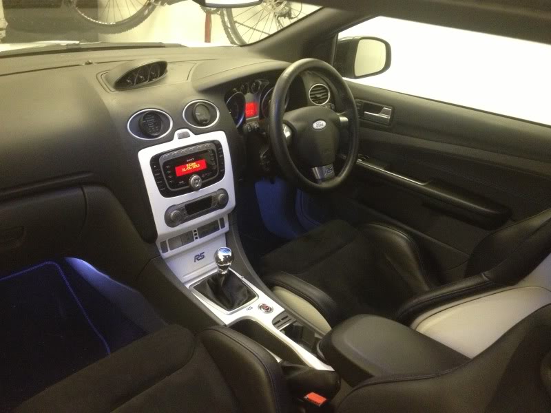

Wrapped seat backs
Wrapped dash section
Stack boost gauge
Aquamist gauge

The seat backs were already done by the prev owner,Ive seen a couple of cars with it done without problems.
f**k me. I know what mine feels like with a mincy c.380hp. That must be VERY fast. I'm guessing you often need to be in 4th gear even on a bone dry road to guarantee traction? Although it often depends greatly on the map. Some just dump huge boost. Others are more progressive and deliver the power at higher rpm. I believe Revo is in the latter camp. I run JWR myself, on top of OEM MP350.

It actualy puts power down ok in the dry but in the wet it will spin in 5th. It goes well but can still be used daily, these car do make and handle power well. My friends 650 bhp one actualy puts down power better than mine with the way the bigger turbos deliver the power.
