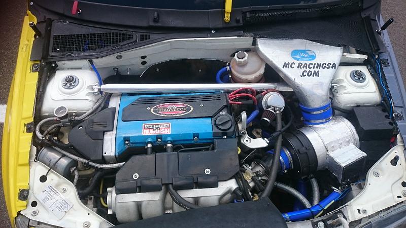

Engine:
2.0 liter F7R – 183,5 HP, 200 NM
Rebuild head,
Ported inlet, and outlet ports,
Biger inlet and outlet valves,
Rewar 290* camshafts,
Adjustable wheel timing,
PTFE set of gaskets,
Balanced and lightened crank system,
ACL engine bearings,
Lightened flywheel,
N-group converted oil pump,
A-group Oil sump plate,
Magnecor spark cables,
Electric power steering pump,
Air intake system:
Polished and lightened throttle body,
GSG throttle adaptor,
Espace v6 airbox,
Itg filter,
A-group air intake,
Exhaust system:
Clio Maxi devill 4-2-1 collector,
55mm exhaust system with side pipe,
Sport catalyst ( at these moment out of car).
Fuel system:
Green high flow injection,
4.0 bar fuel pressure regulator,
Fuel Line in steel braid inside the car,
Ecu:
Remaped on dyno and road standard ecu,
New engine and interior loom.

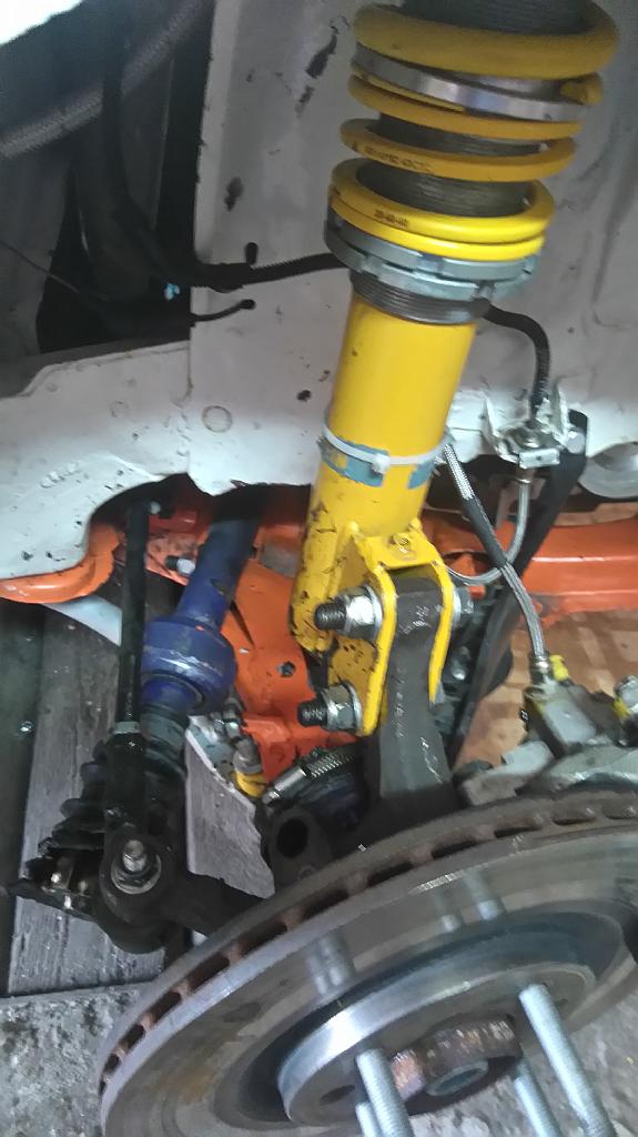

Front suspension:
Bilstein B8 coilovers,
Hr springs with Kw helpers,

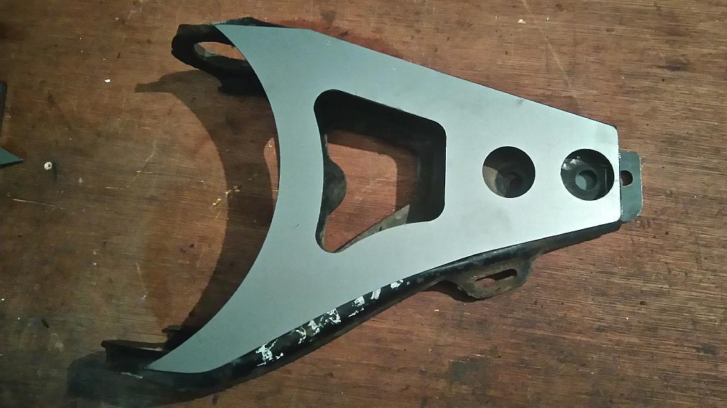

Front reinforced wishbones,
Wishbone and Arb poliuretan bushes,
Standard or 25mm front stabilizer mounted on poliurethan or uniball.
Front negative on eibach spring and shock absorber on uniballs.

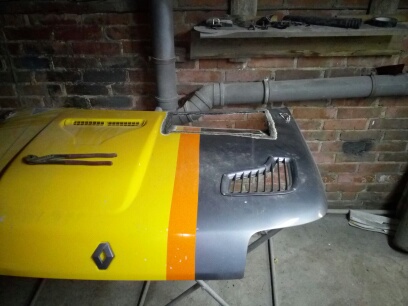

Clio maxi Hood inlet,

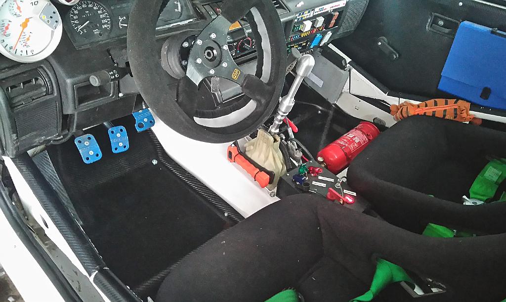

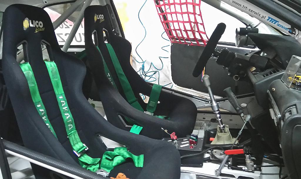

Interior:

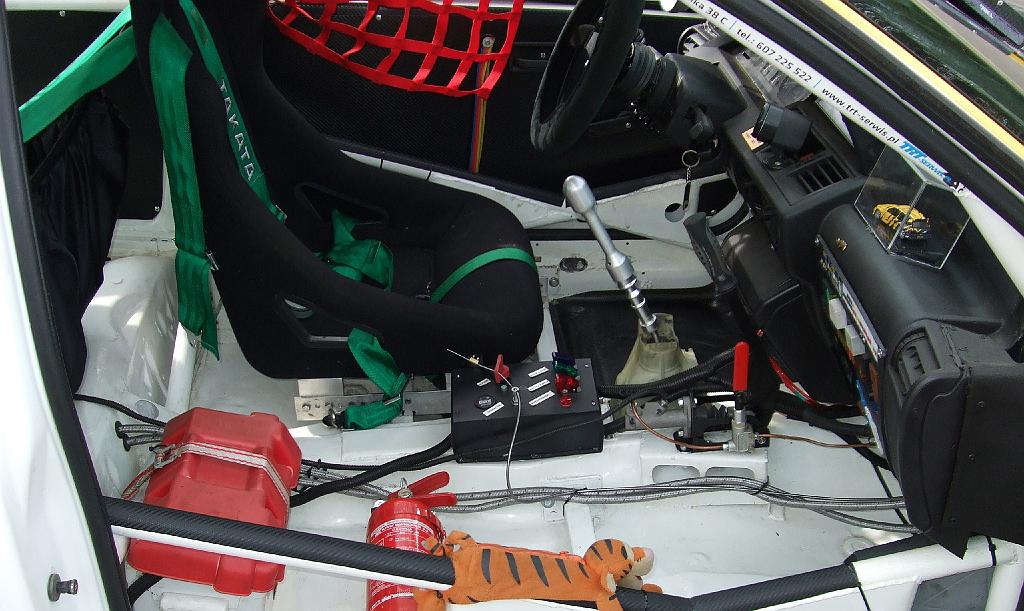

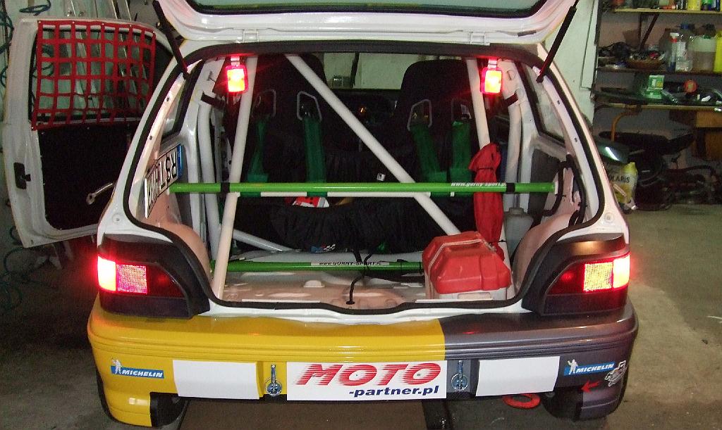

Full rollcage,
Front and rear strut bar,

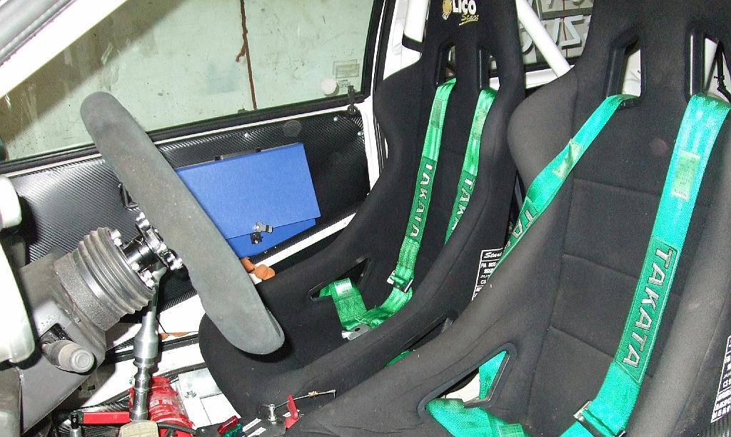

2 x Sparco junior approved bucket seat,
2 x Takata 6 point harness,
Battery inside the car in boot box,
Flocked dashboard,
RRS 350mm steering Wheel with snap-on adaptor,
Sport tachometer, oil pressure gauge and shiftlight.
Extra swithes panel with energy cut-off and voltmeter,
Carbon fiber footrest for driver and pilot,
Remove all unnecessary items.

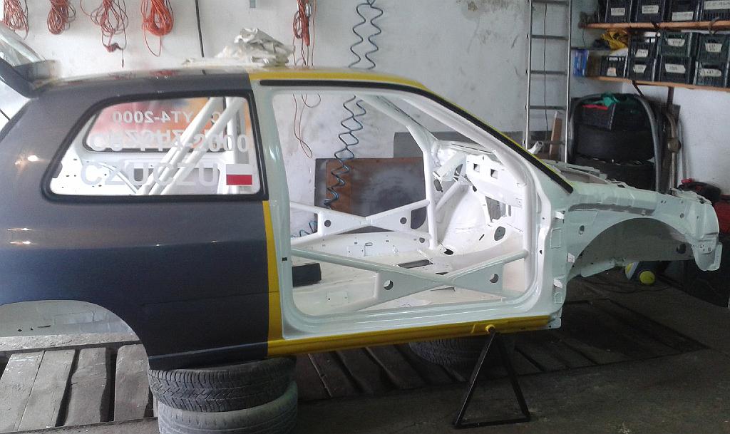

Whole interior sprayed on white.

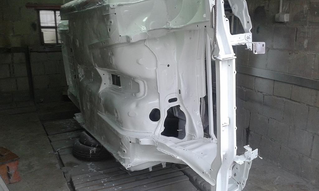

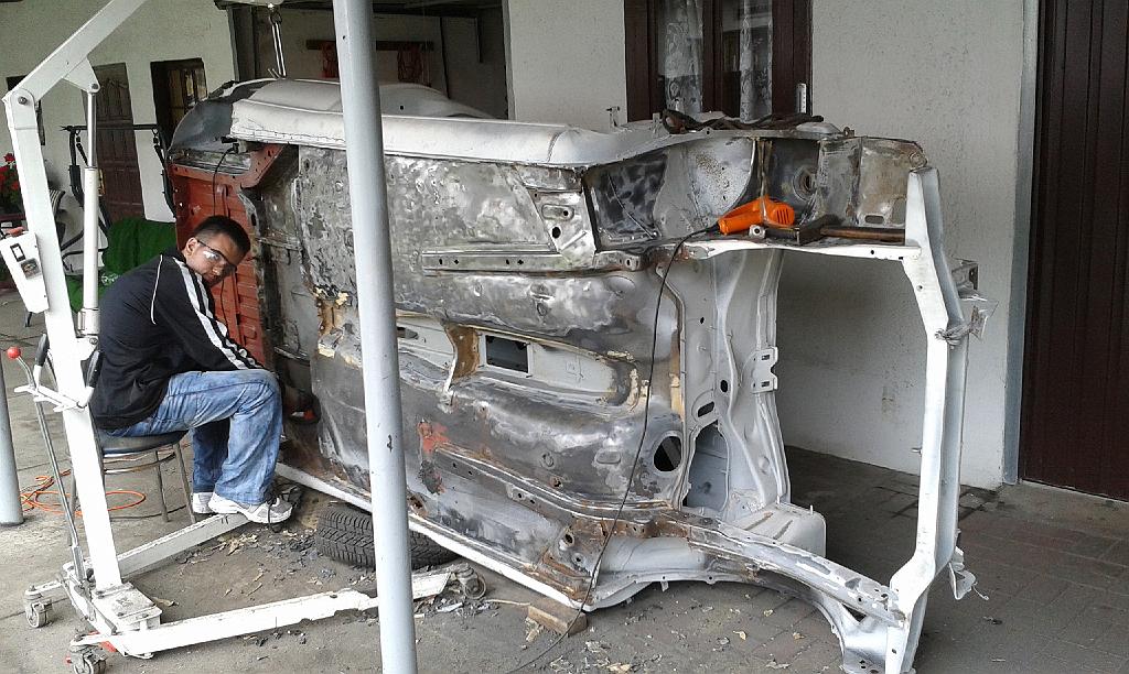

I start theese project in another clio body, but we make theese one from zero..
Old interior, now i make two seats.

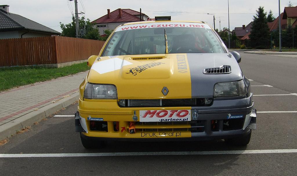

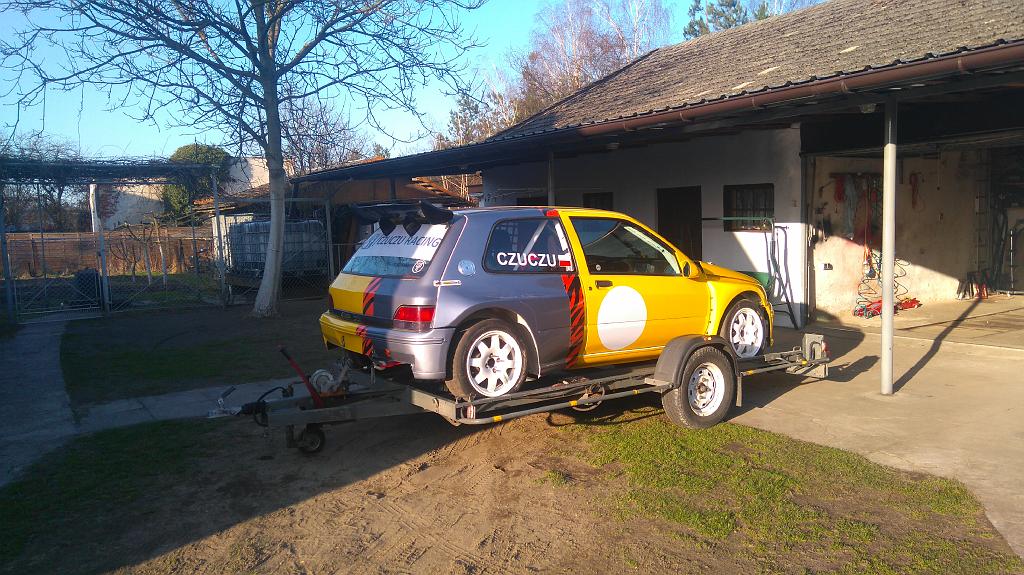

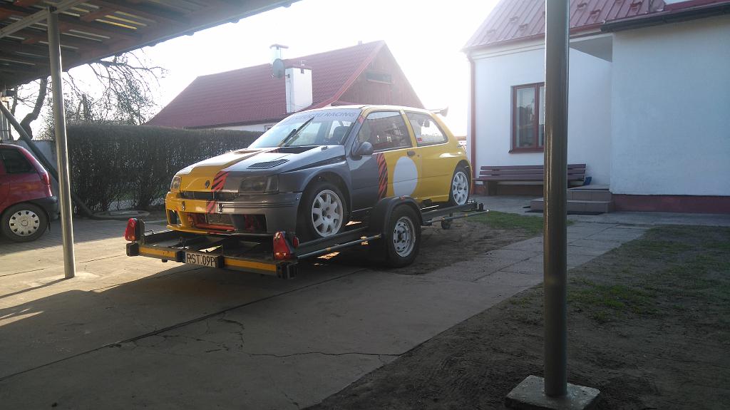

Quick update: my car on trailer

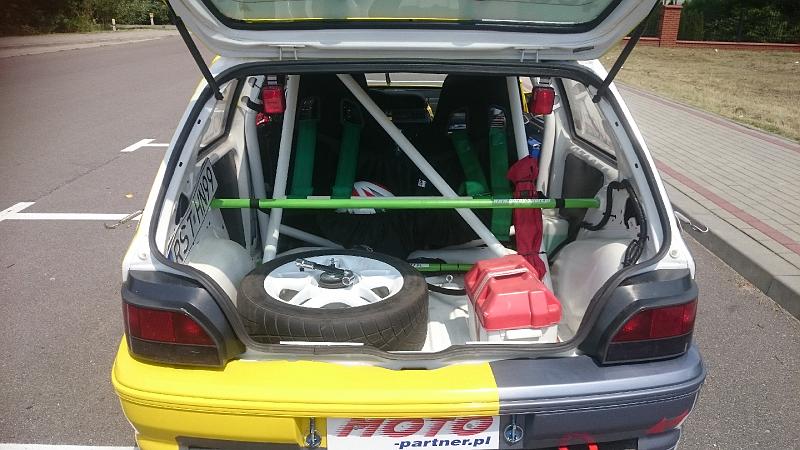

New aluminium strut bar, bought from celica for 3 pounds/

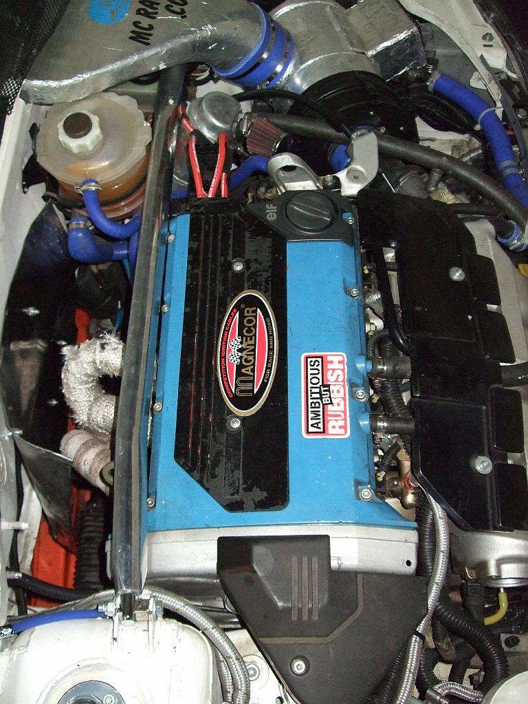

Package from England with Magnecor.

Battery removed from passenger seat to end of car

And for end i put standard lamps + Clio two eys blend + renault sport poli cover for lights.

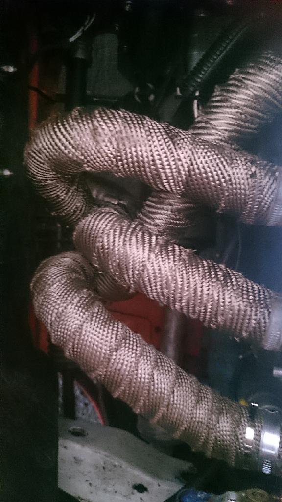

i put new thermo bandage cause old one was in ruin.

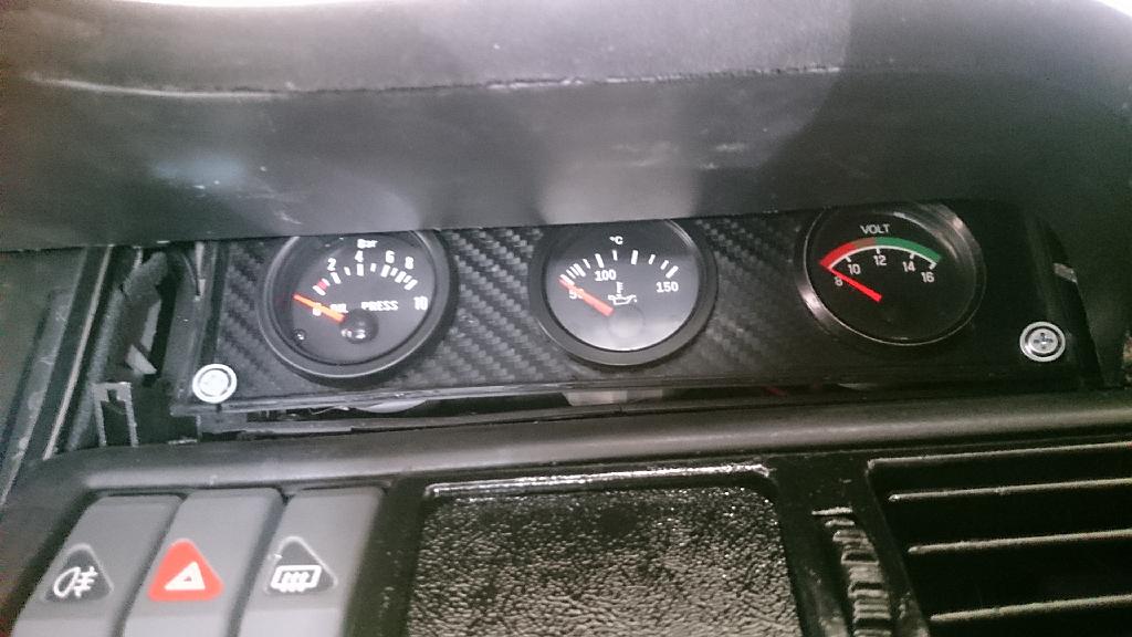

New stri gauge was broken ( from USA so no guarantee) so i put 30y old Voltage from VDO, new oil temp gauge from vdo, and 15 y old oil pressure gauge from VDo with new sensor.

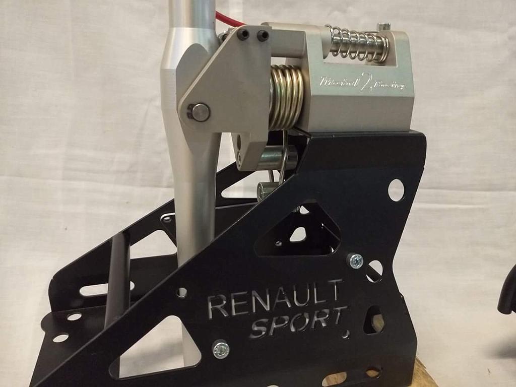

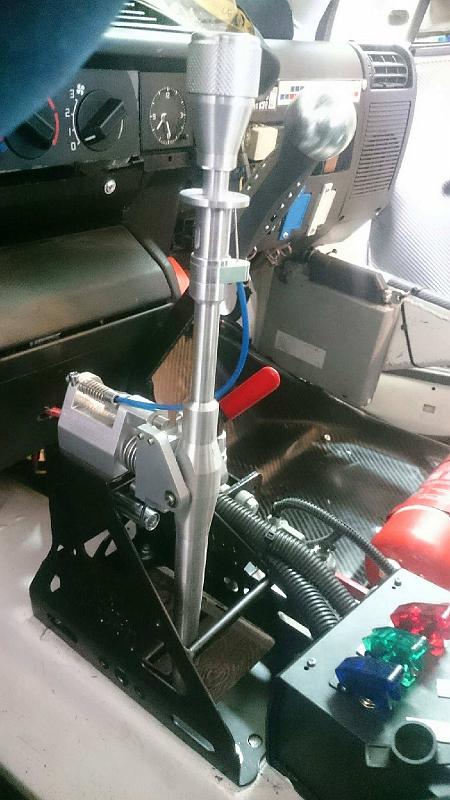

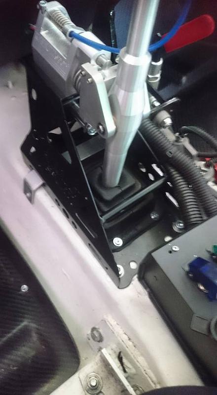

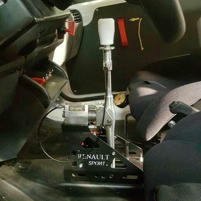

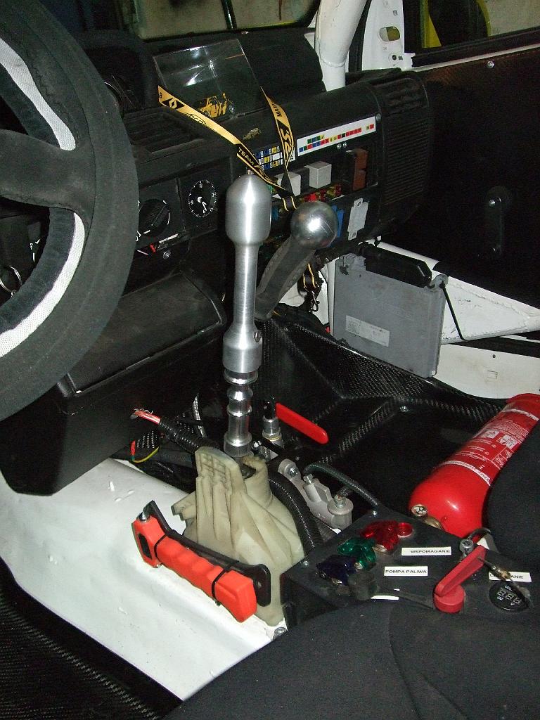

And finally i only wait for last package from italy with new short shifter. Should be much better than standard one on uniball, because here we have Spring like in CAI shifter.
Now misshift should be almost impossible.
  Clio Williams
I put new shifter and it really work wonderfull.
But dust from road and heat from exhaust was uncomfortable so i put a rubber from old polish car.

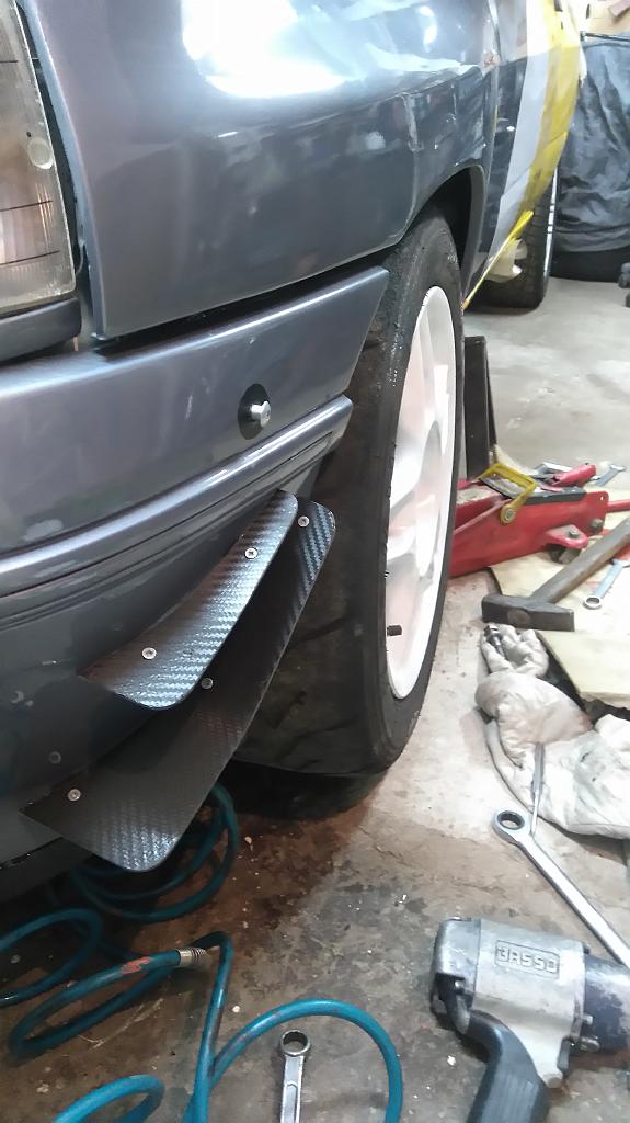

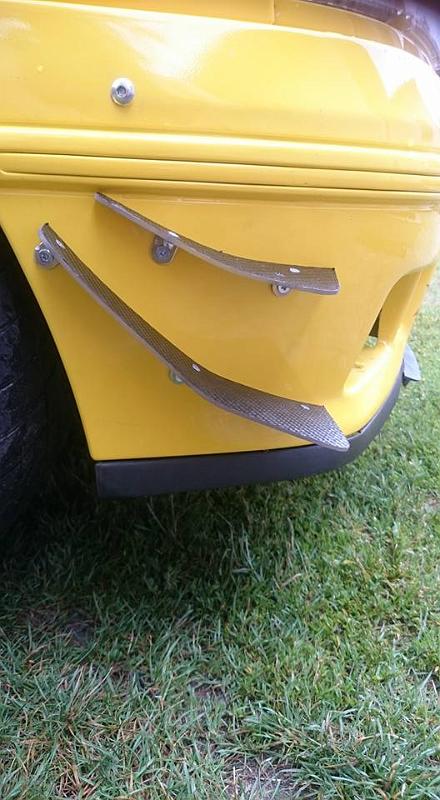

I also change screw from M4 to M5 in Canards.

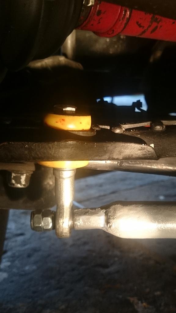

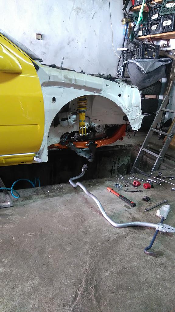

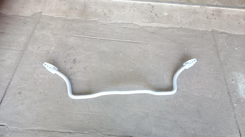

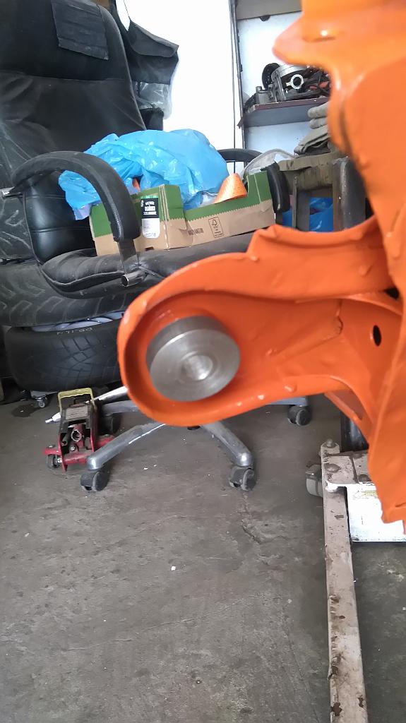

Thicker car stabilizer:
25 mm aluminium distance between gear knob.
When I see the thickner sabilizer work, i make it much better.

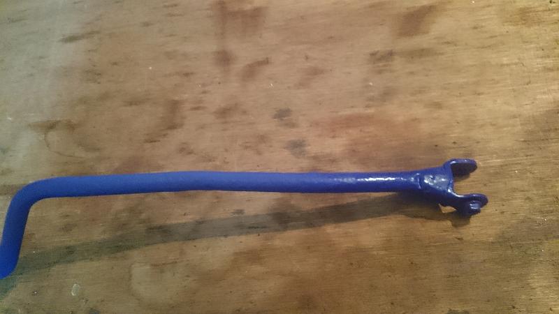

And i change and weld gear rod.

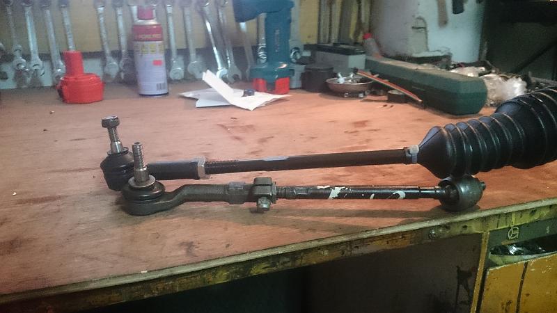

Yes i still rebuild it. At theese moment we try to put r19 stearing gear to clio, but nobody know is it the same part in both cars..

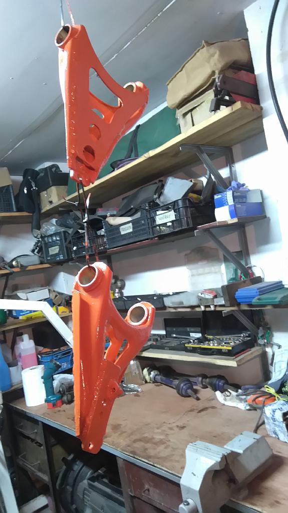

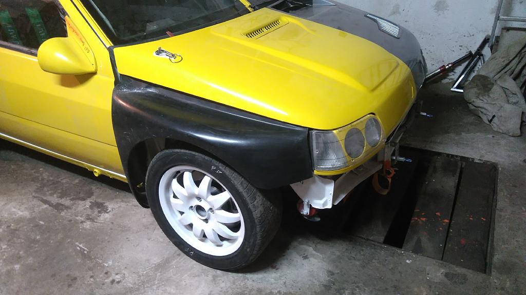

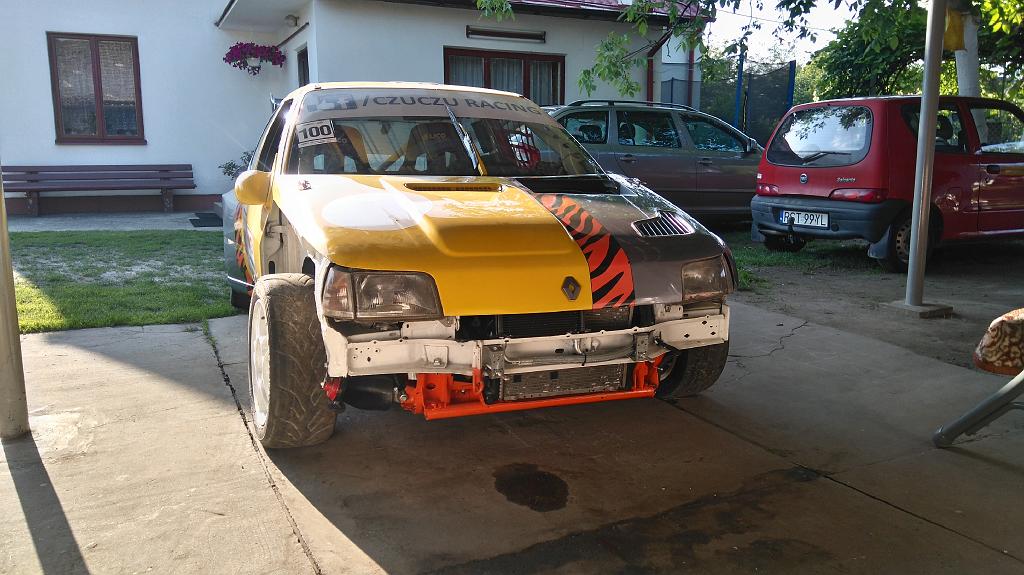

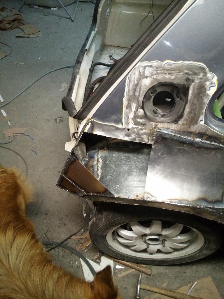

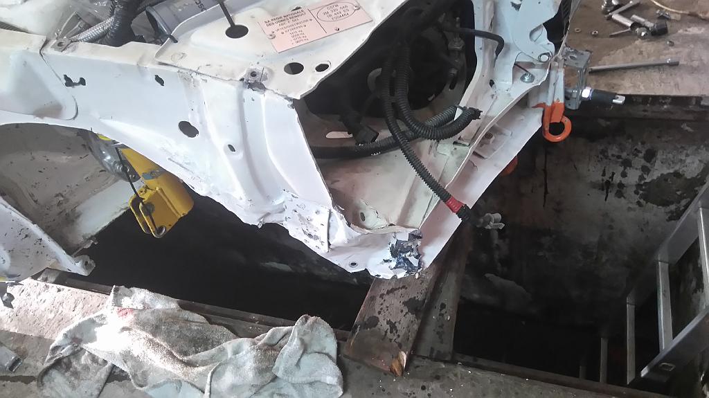

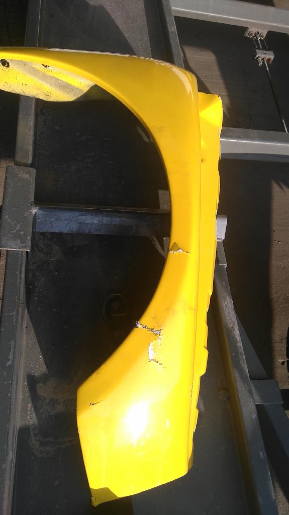

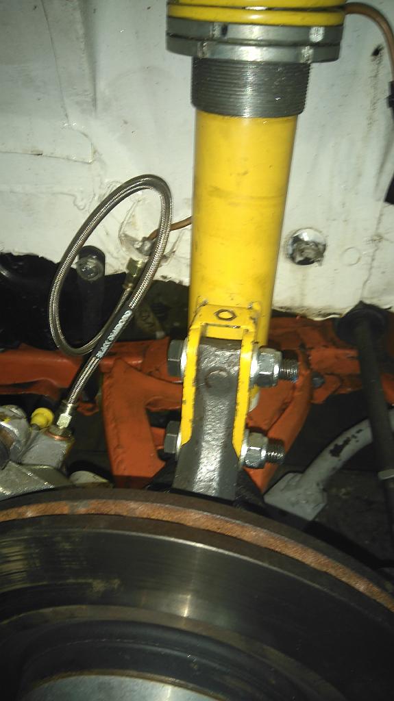

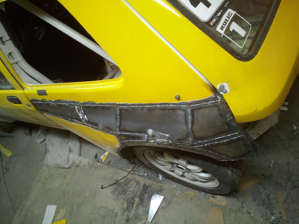

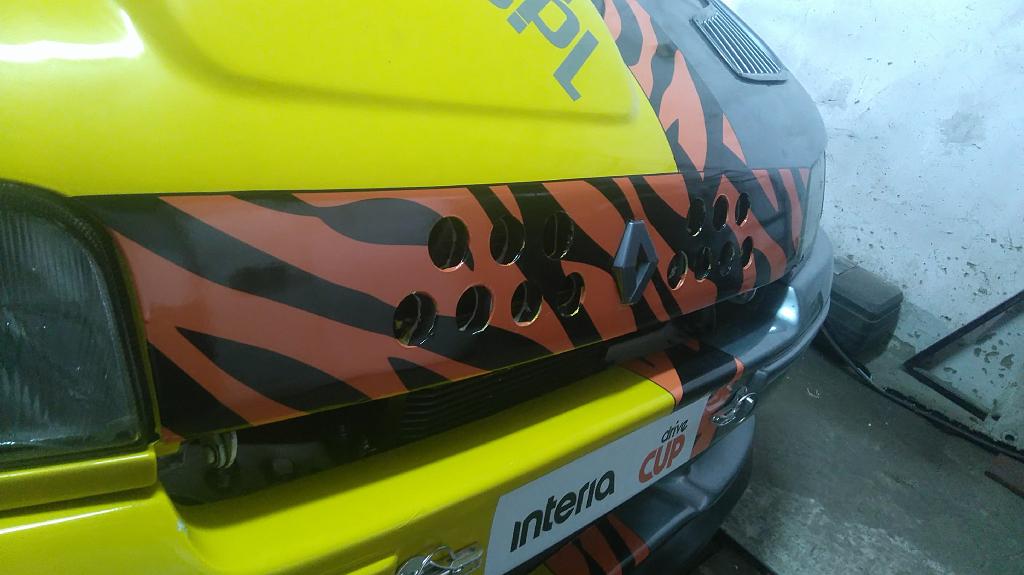

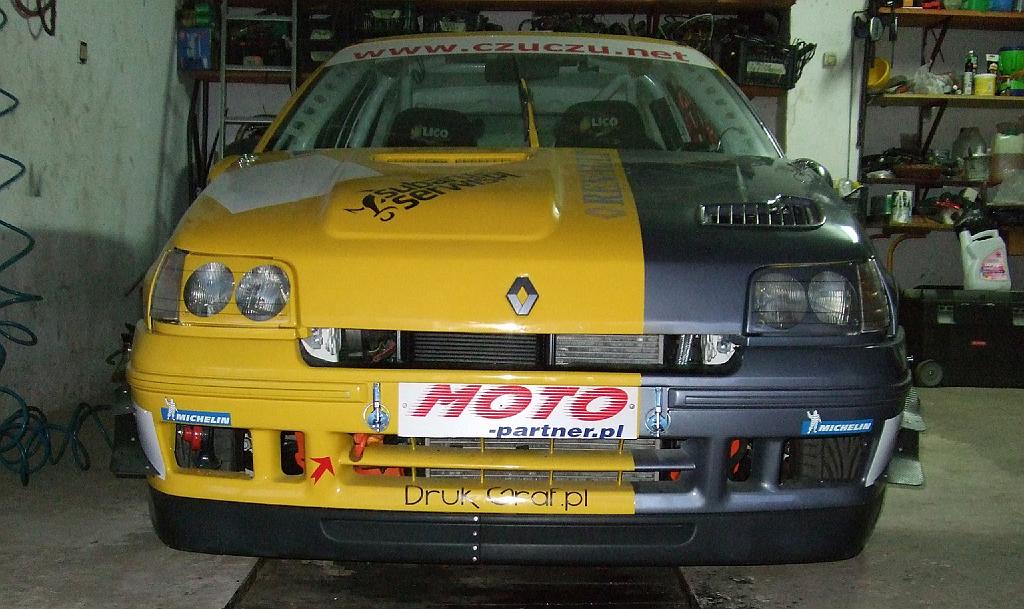

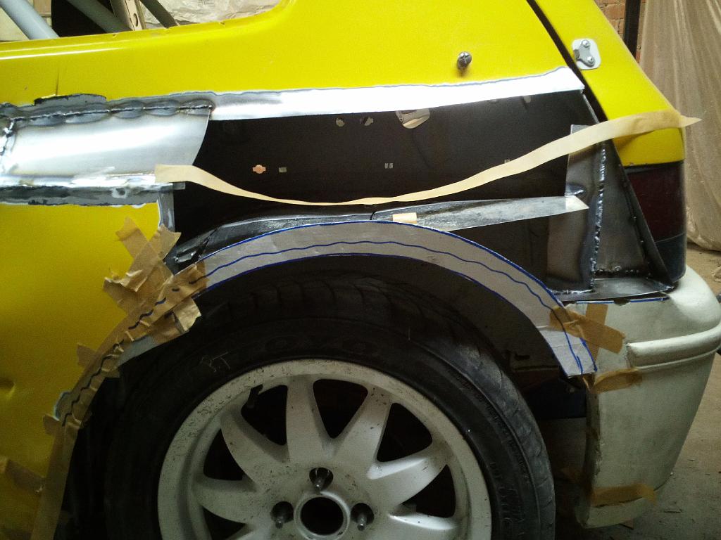

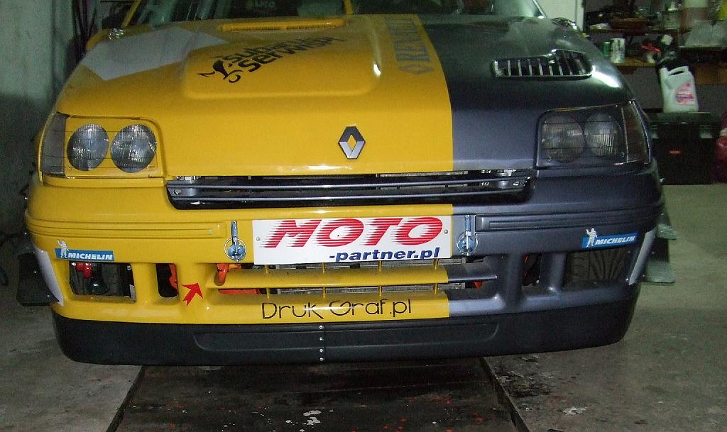

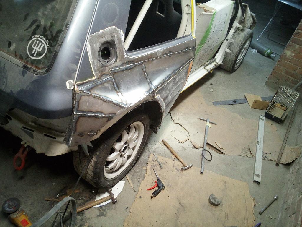

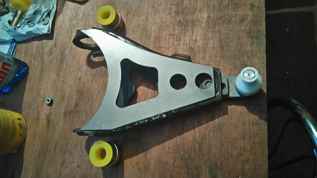

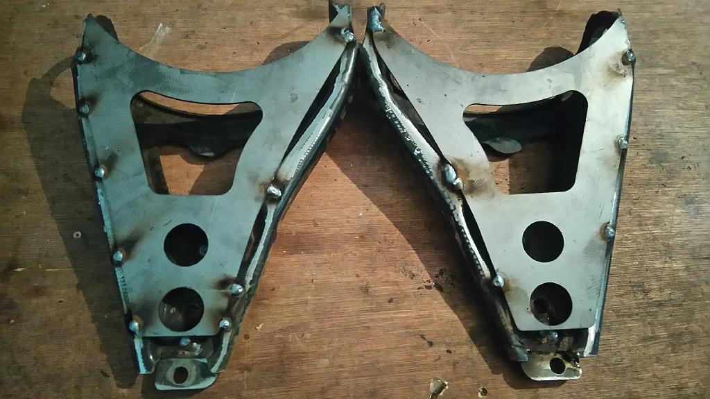

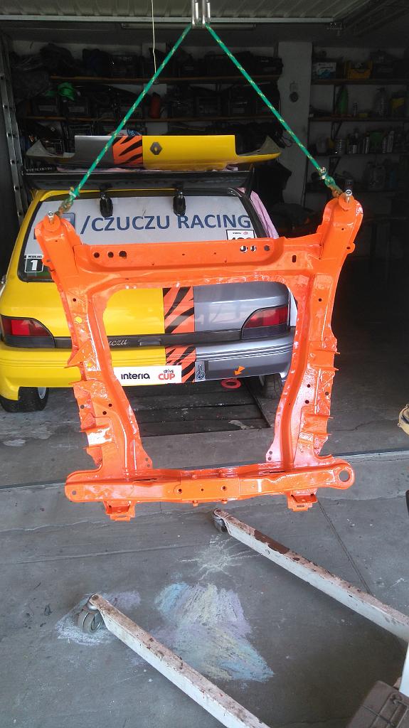

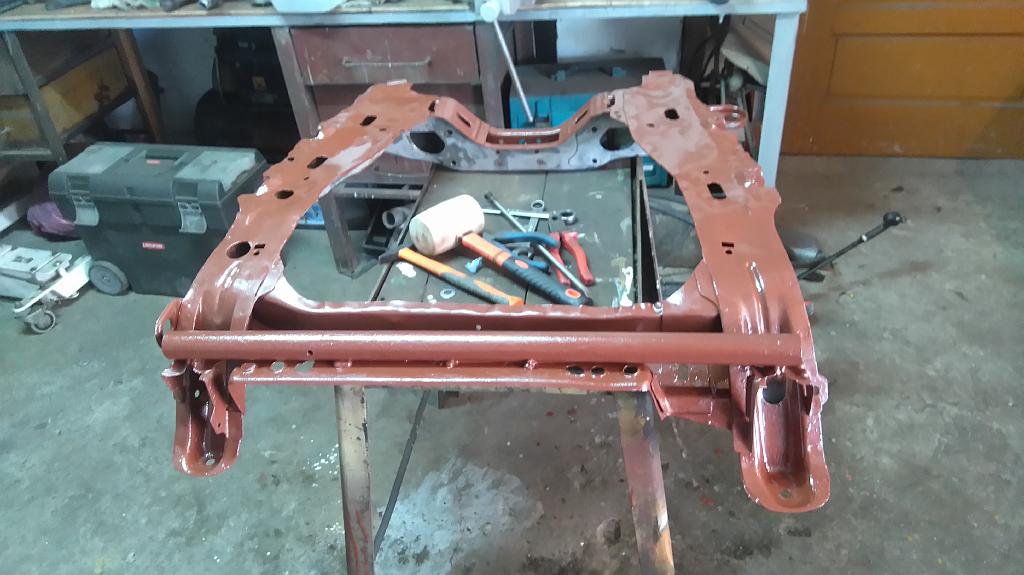

Quick up. I wrap a fuel cup, and cut a front bumbper.

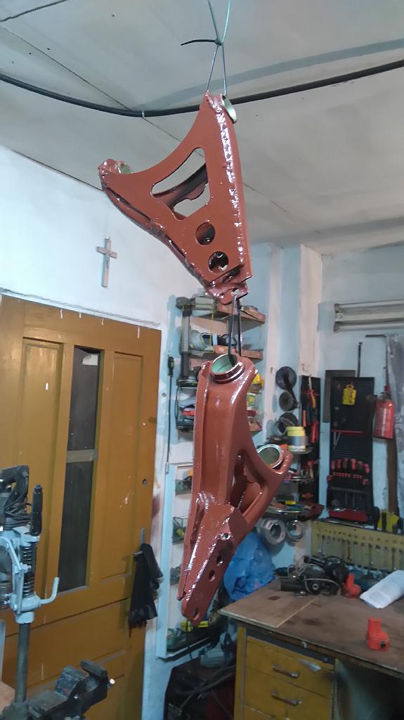

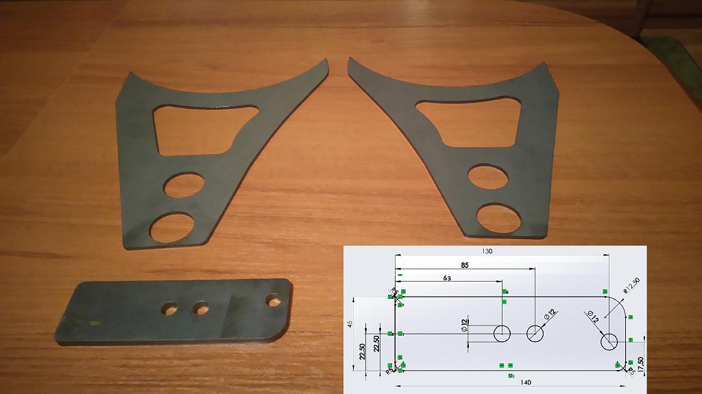

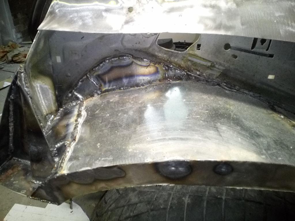

But most importand jobwas adding extra 10 cm on front axle
We cut it on laser.

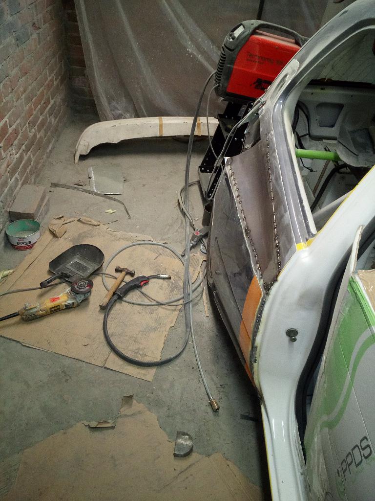

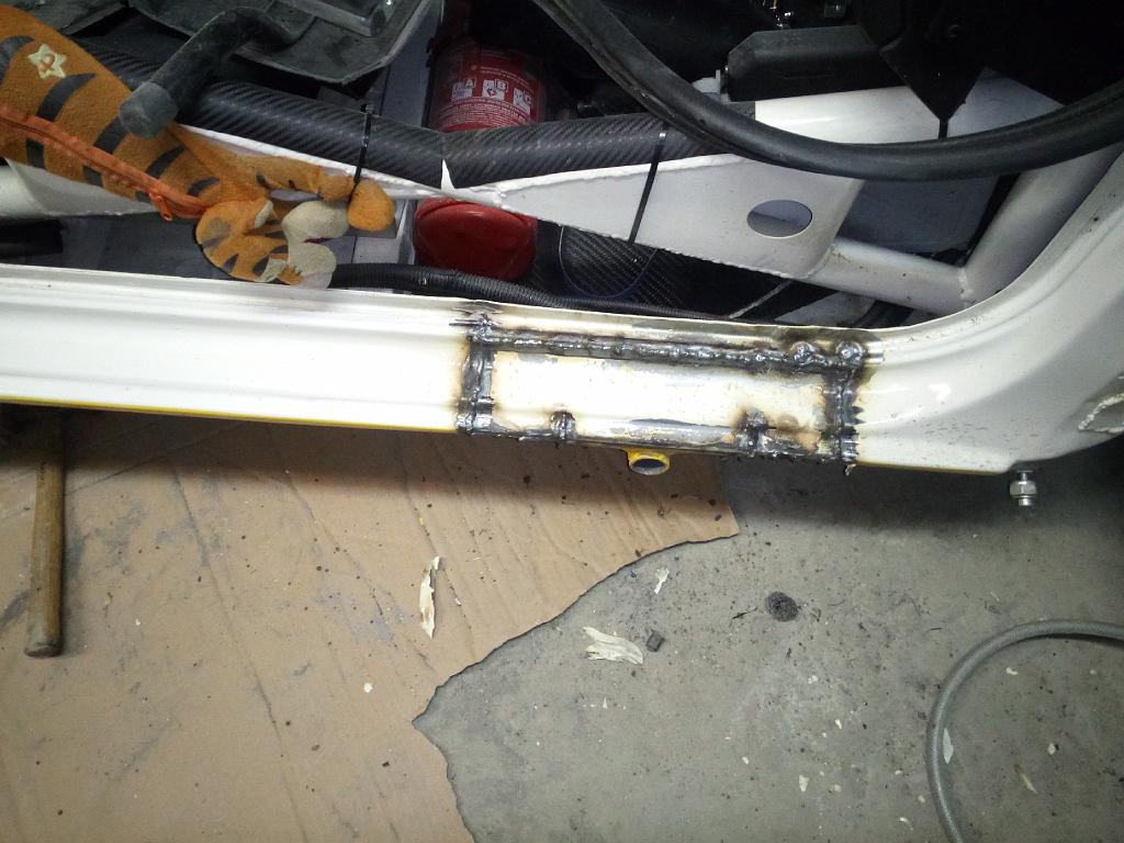

Unfortunately man who was welded these parts, has got bad day

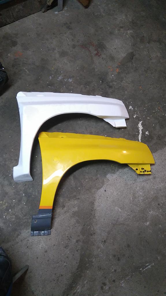

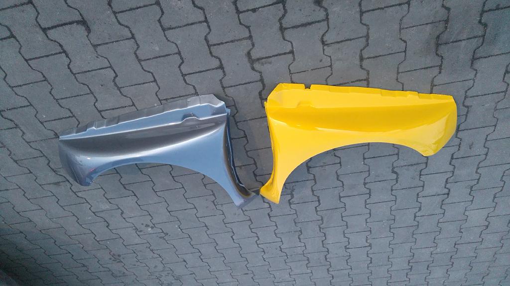

Finalcolor
Standard vs new ones.
On car.

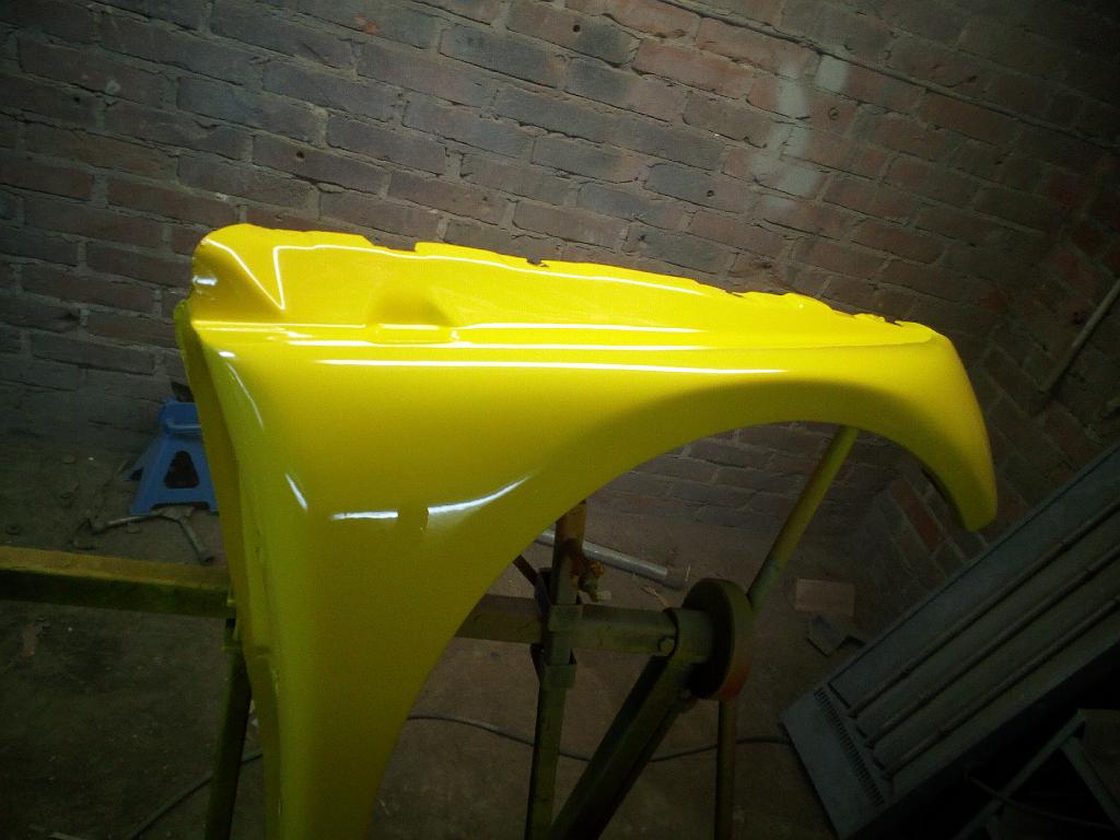

Now i wait for maxi front fenders to paint them.

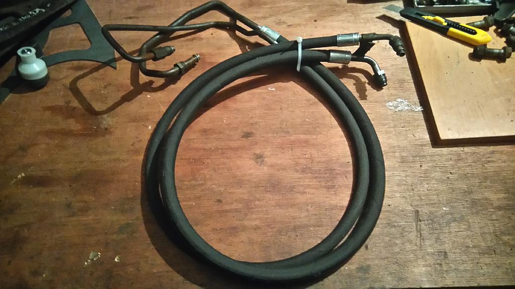

I also sent for regeneration standard steering gear. And new hydraulic lines.
New brake lines.

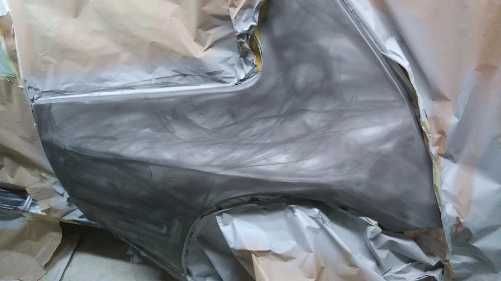

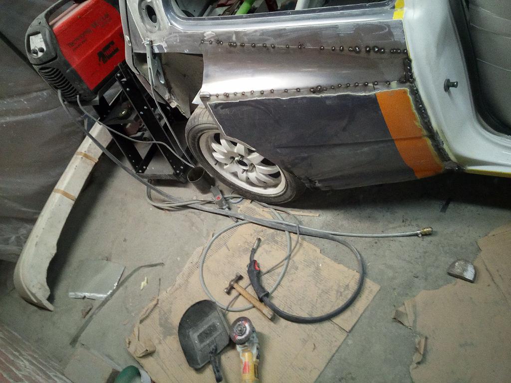

And now it's time to rear beam and fenders
  Clio Williams

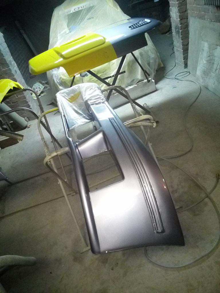

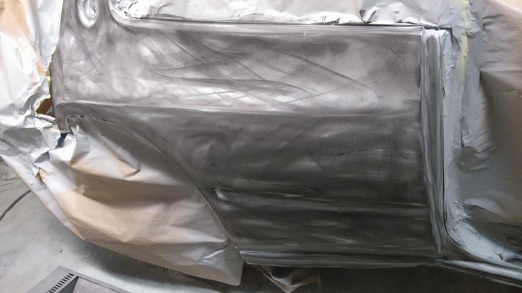

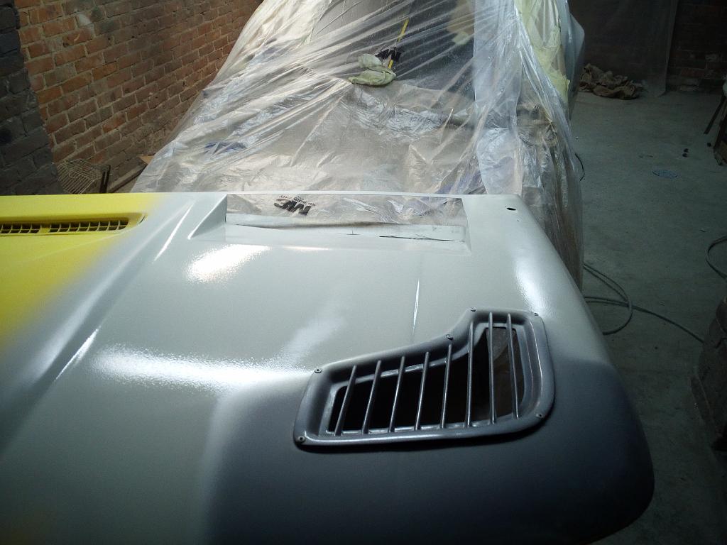

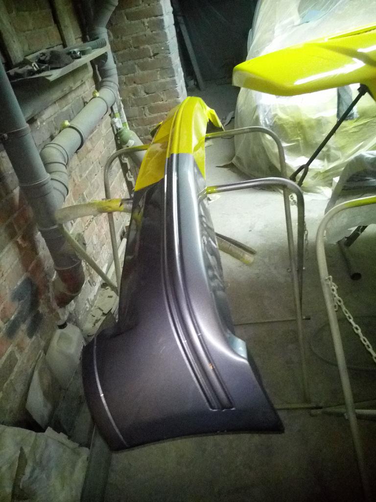

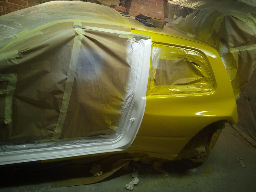

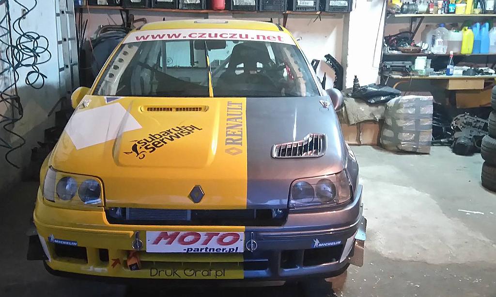

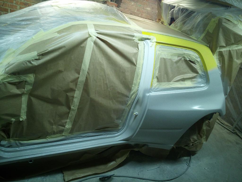

Time for up. We finish the paintjob.

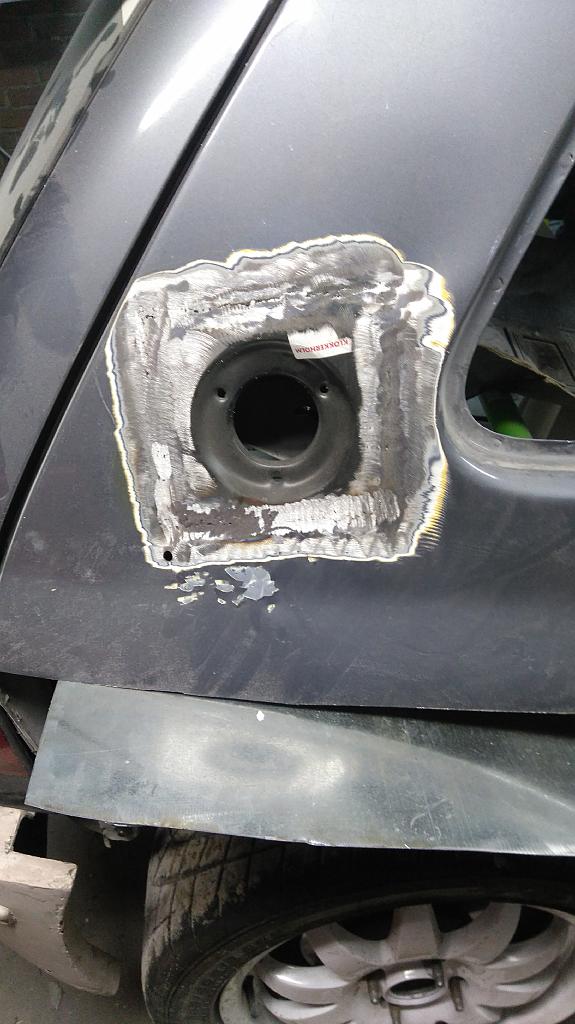

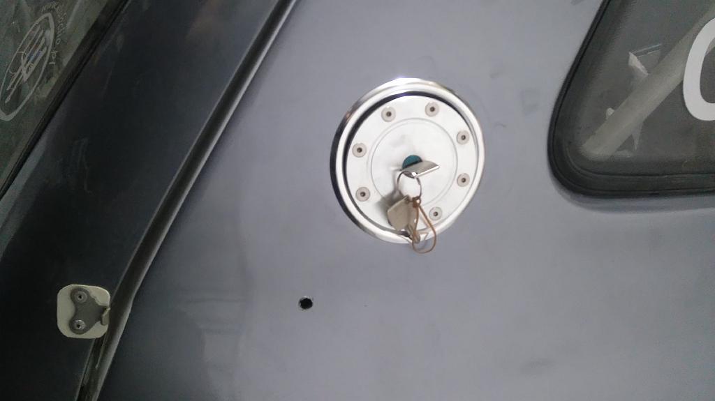

New vw fuel tank cap.

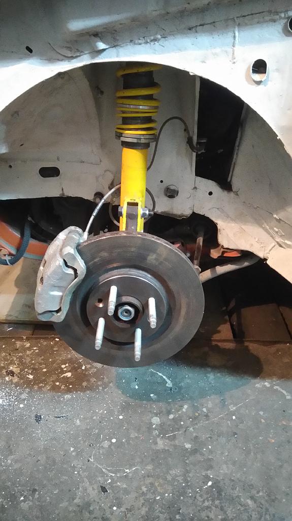

And we finish front and rear suspension.
Some new stickers.

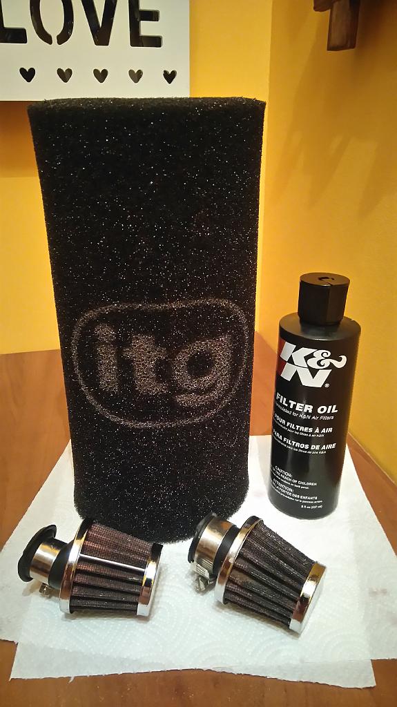

I cleaned the air filter.

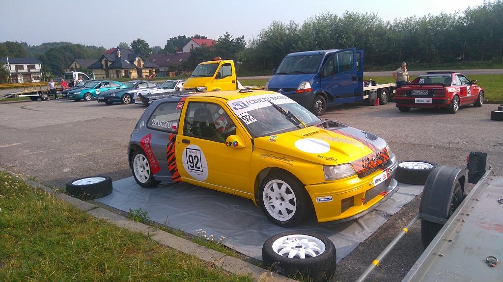

And we went to the trackday.
Some photos.

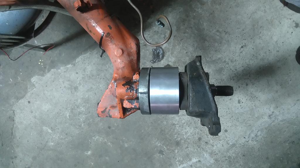

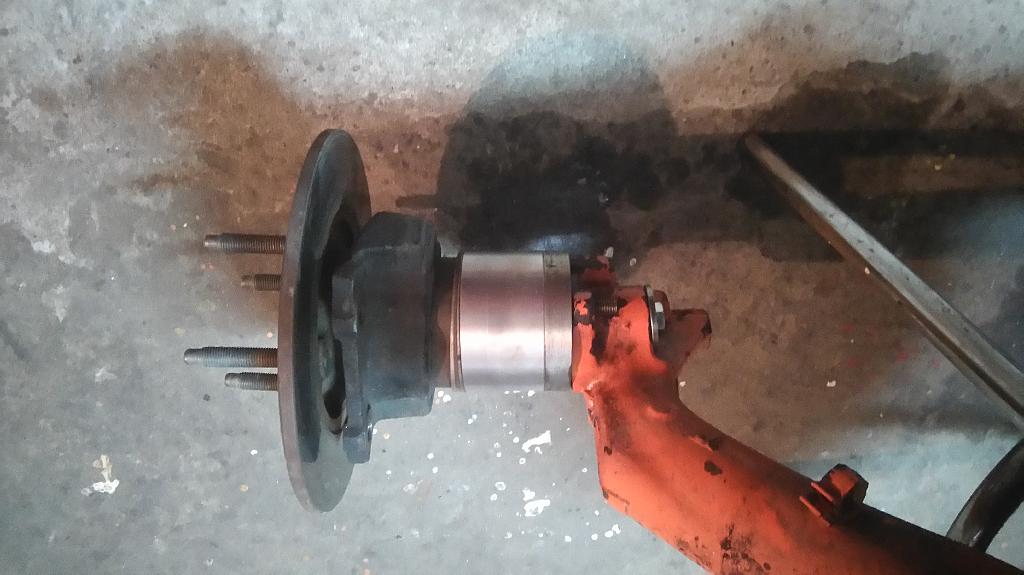

Unfortunately new rear bearing broke up.
And i crash...
But I make a new parts
Finally I almost fix-it.

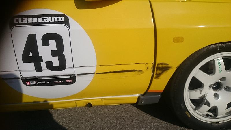

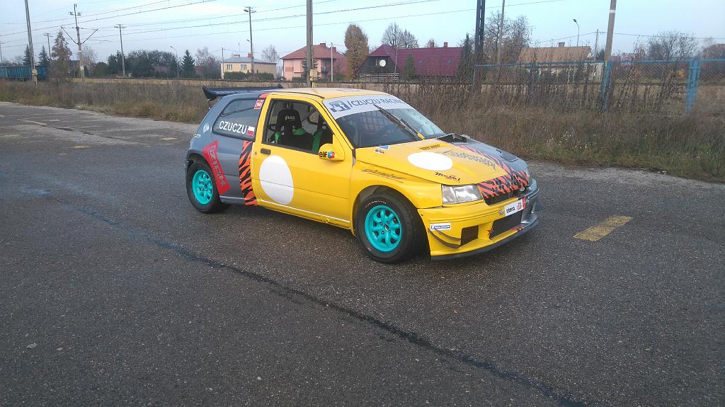

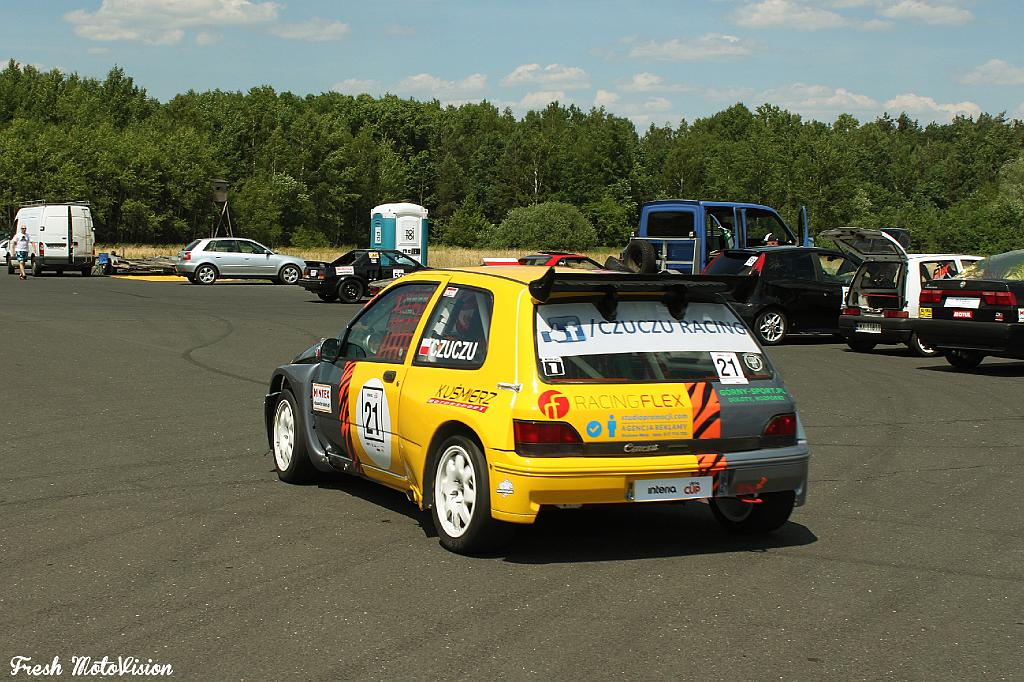

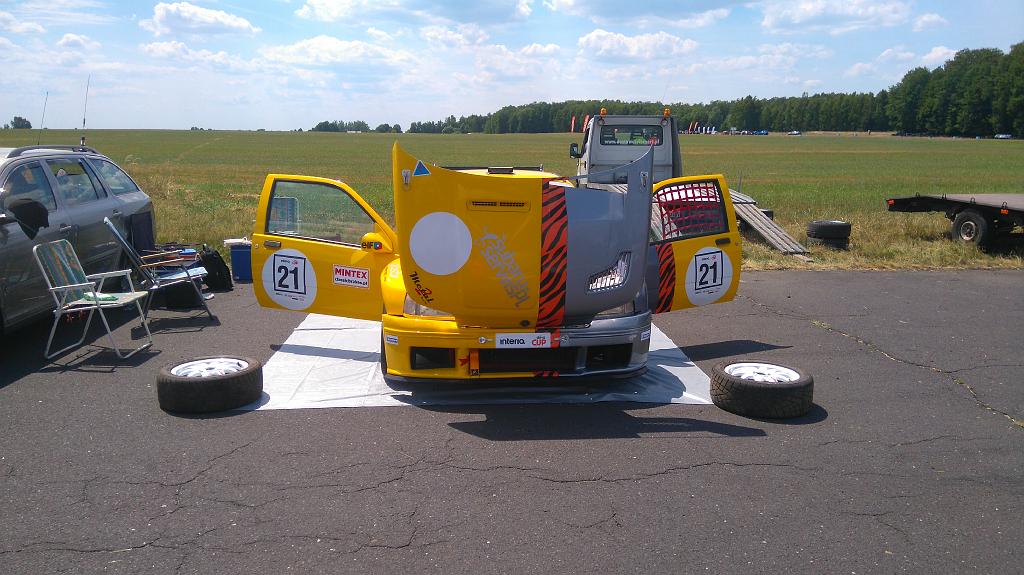

Time 4 up. I put slicks on rims.
Front bumber on his place.

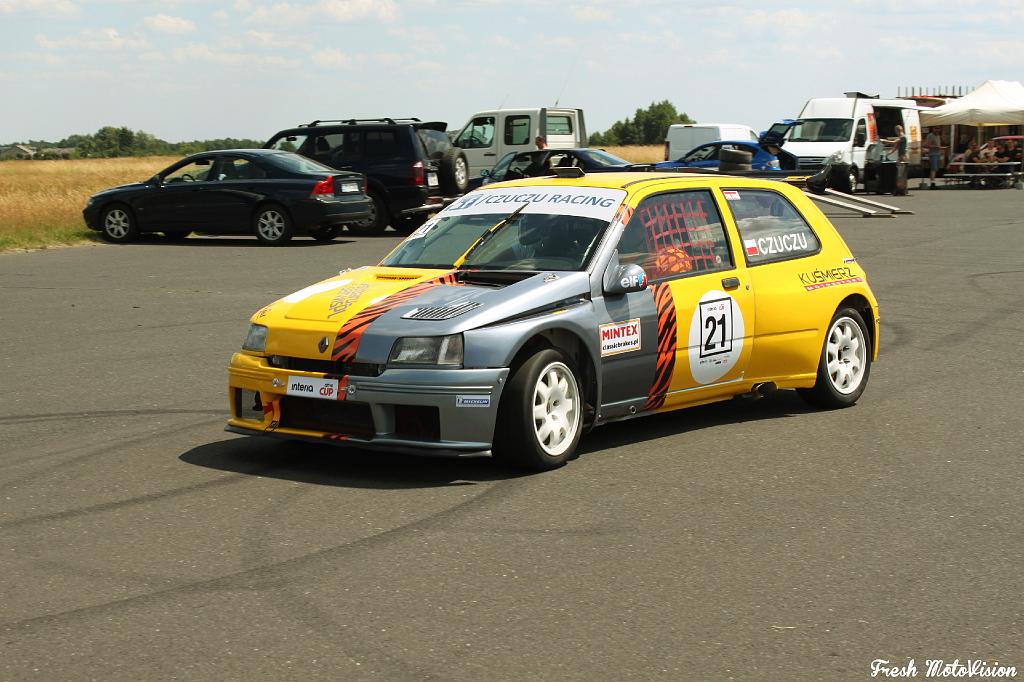

We put new stickers, fix all problems and went to trackday.
666666666666666666666666666666666666666666666666666666666666666666666666666666666.jpg
38 degress on plus, wchich make lot of problems.
6666666666666666666666666666666666666666666666666666666666666666666666666666666666.jpg
But fun was greatfull.

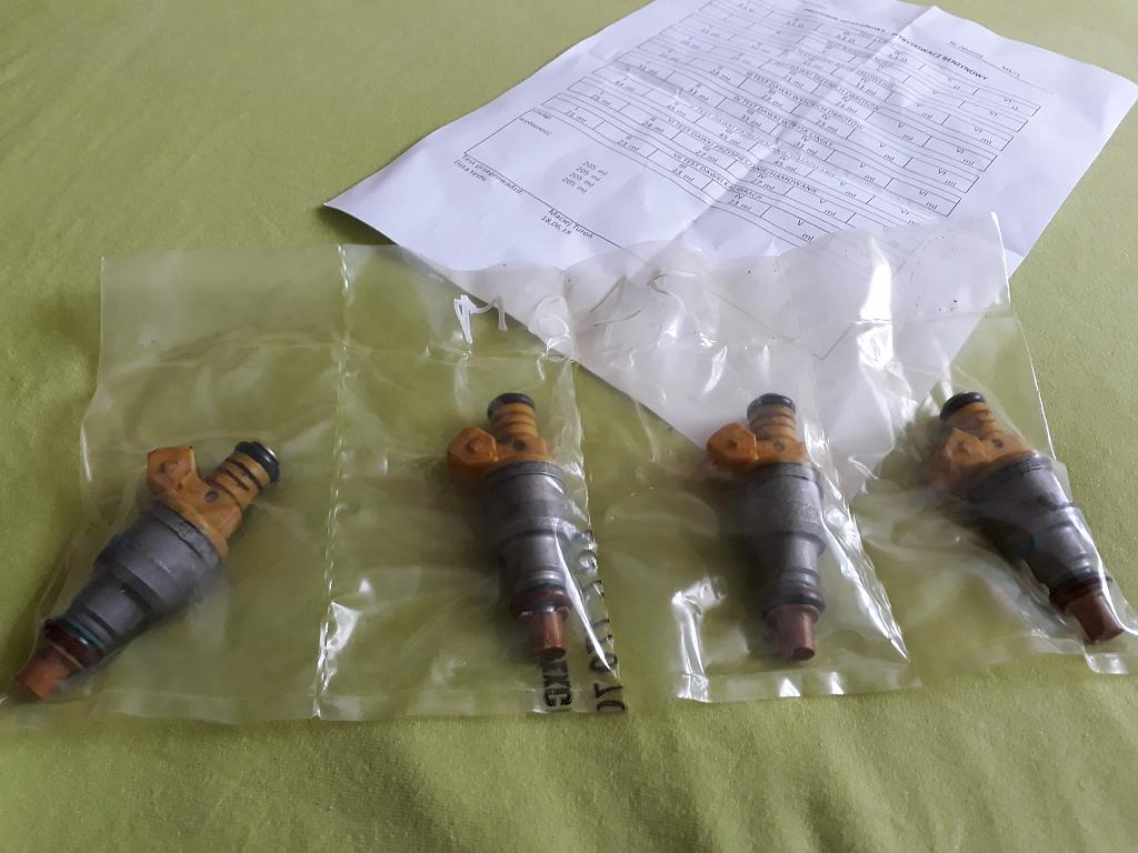

And send injectors to the Service.

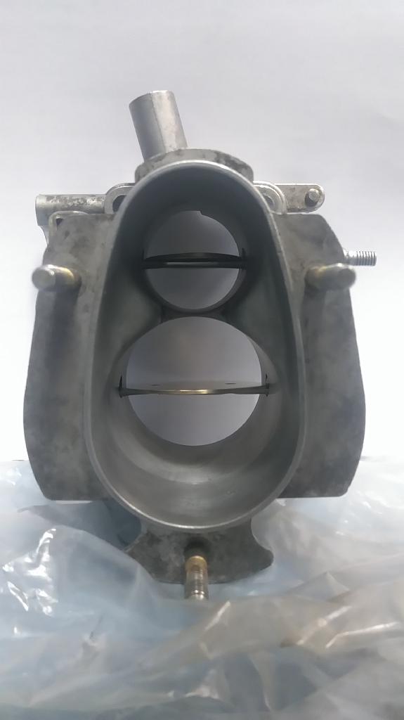

And I port the throttle body.
Now it work much better.

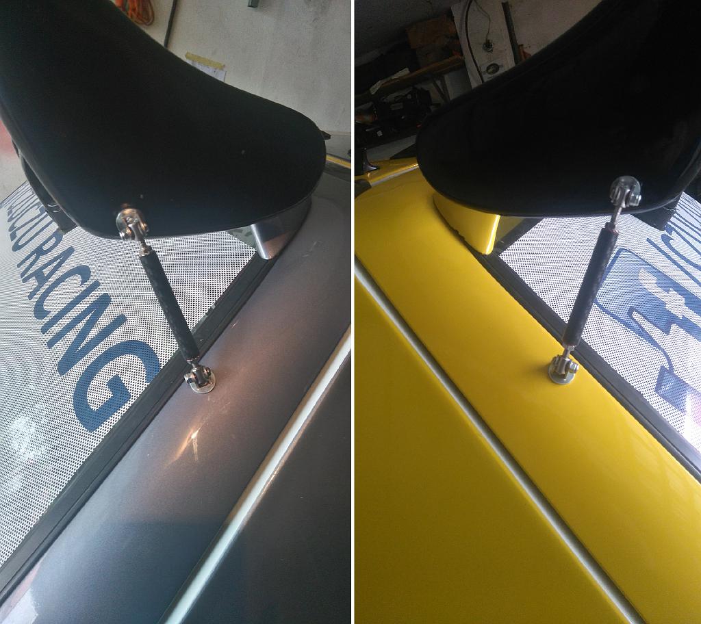

But rear wings need some support.

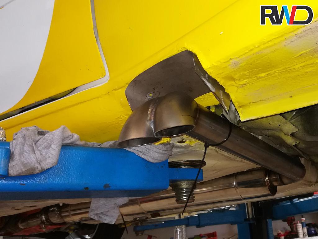

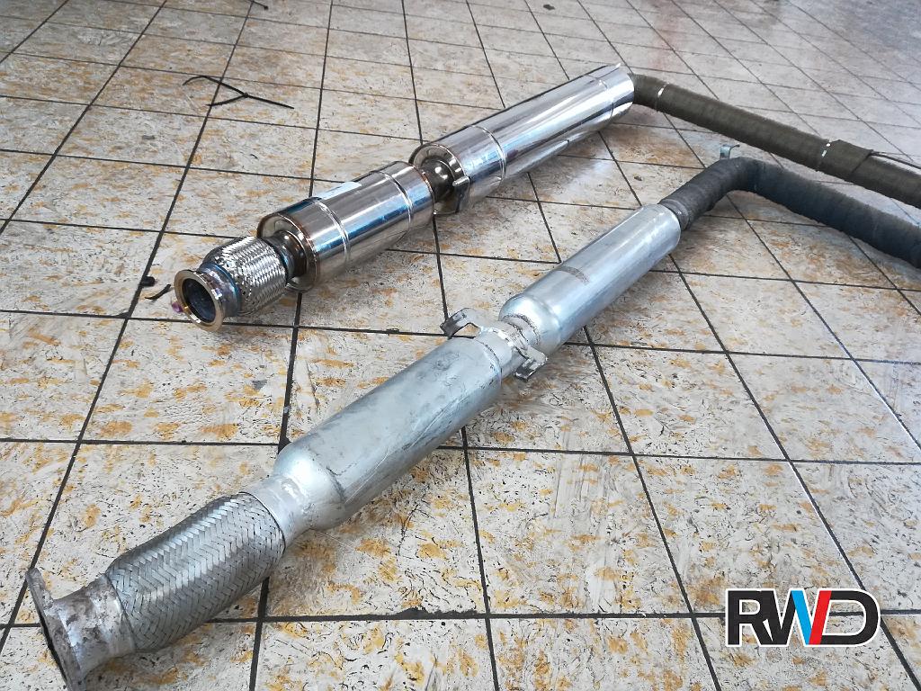

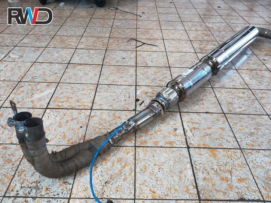

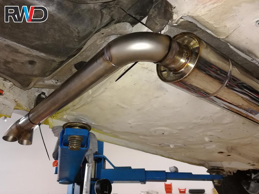

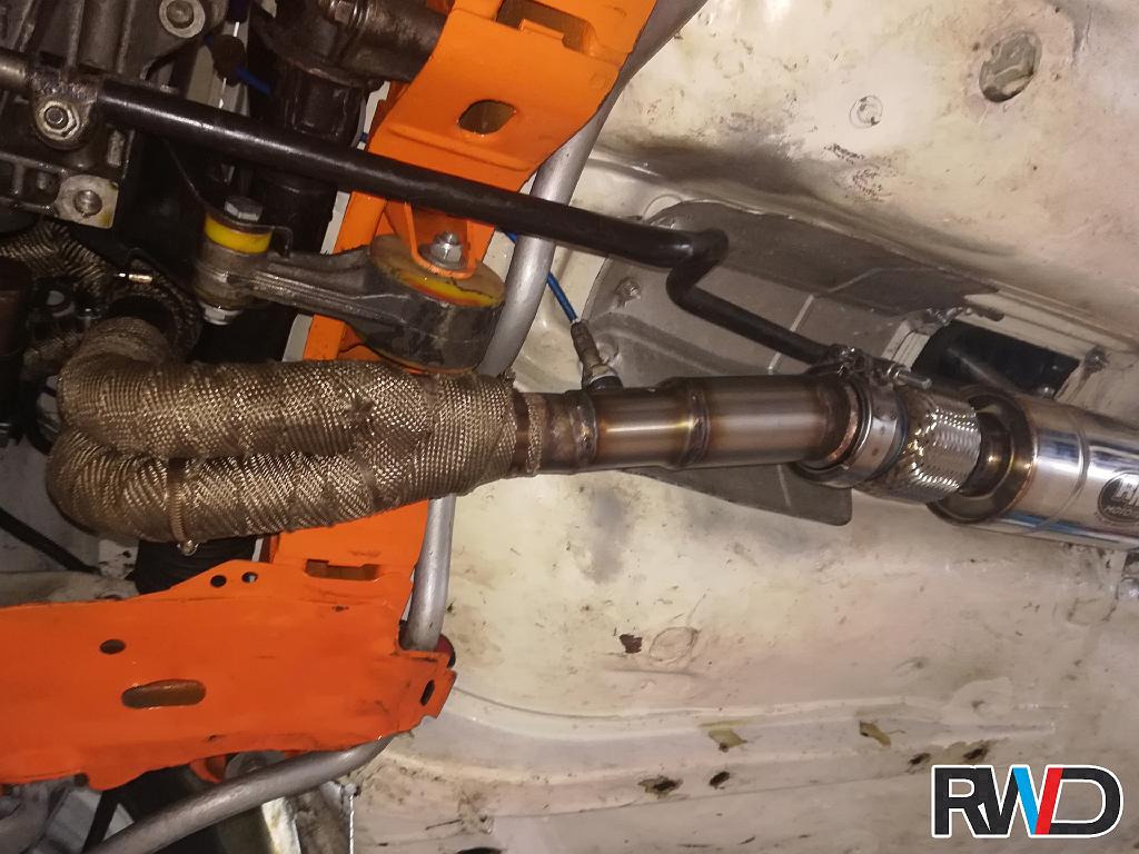

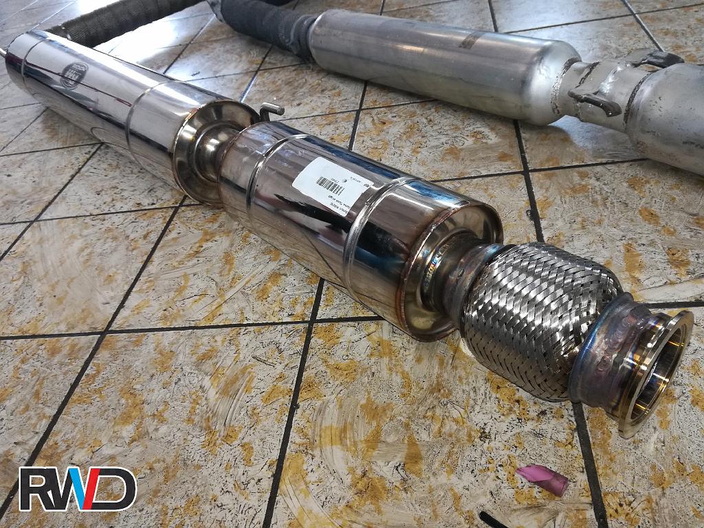

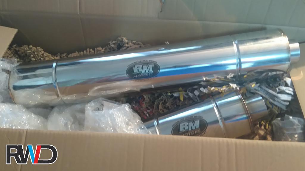

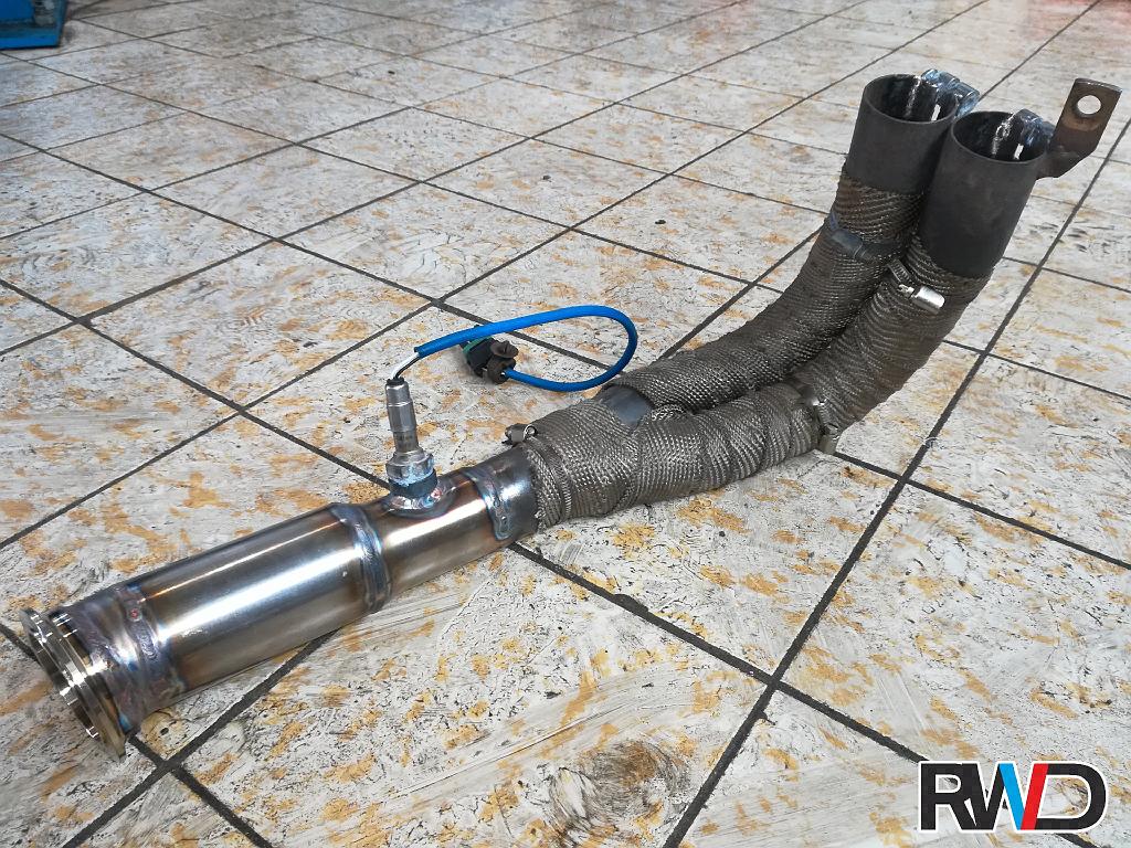

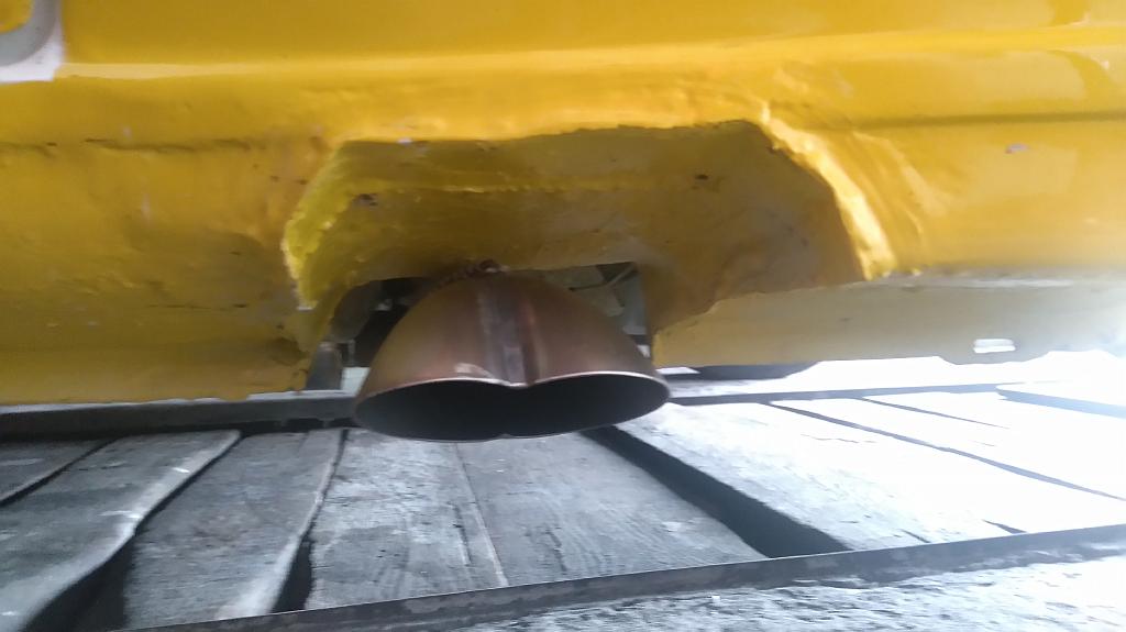

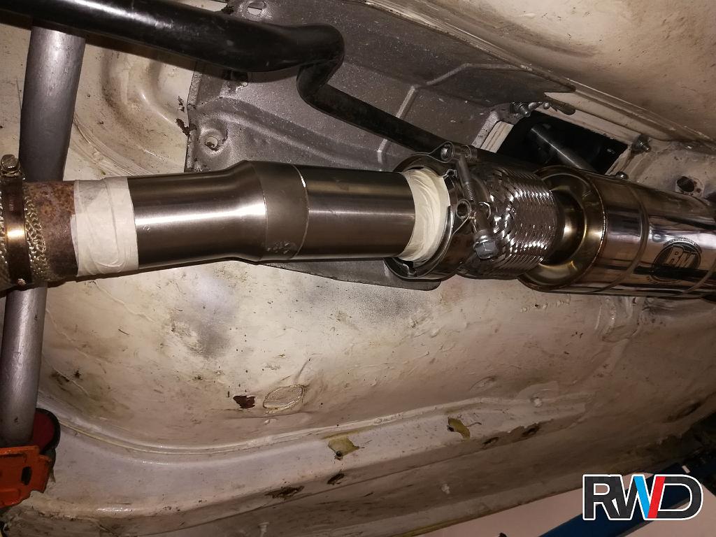

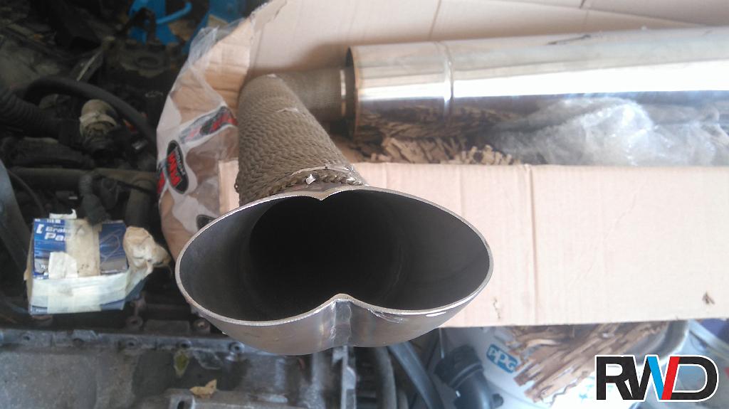

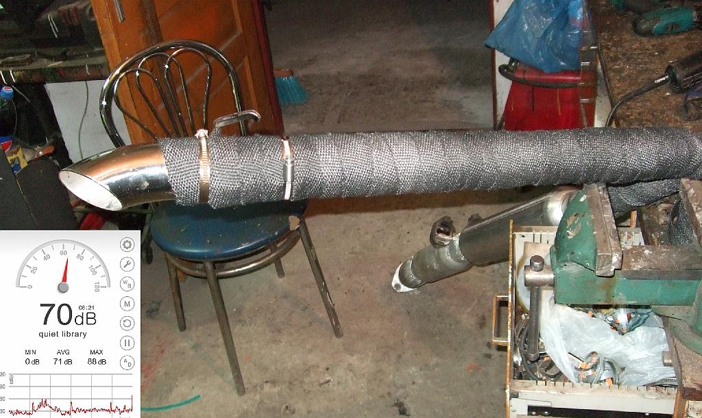

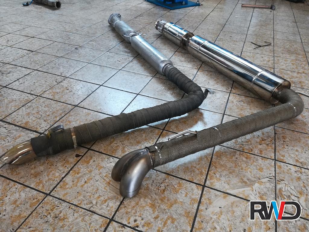

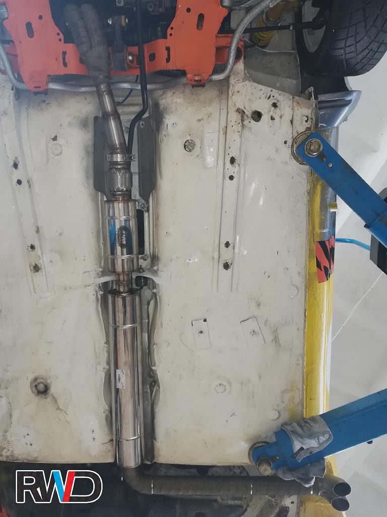

New 60mm exhaust system onboard
A whole system in 60mm diameter, v-clamp, and silencers build of stainless steel.
And some work with underpressure of engine.

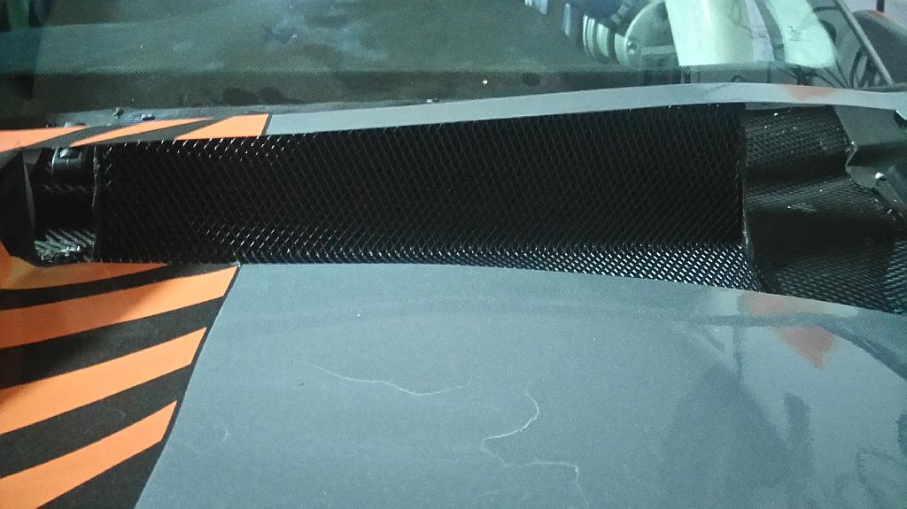

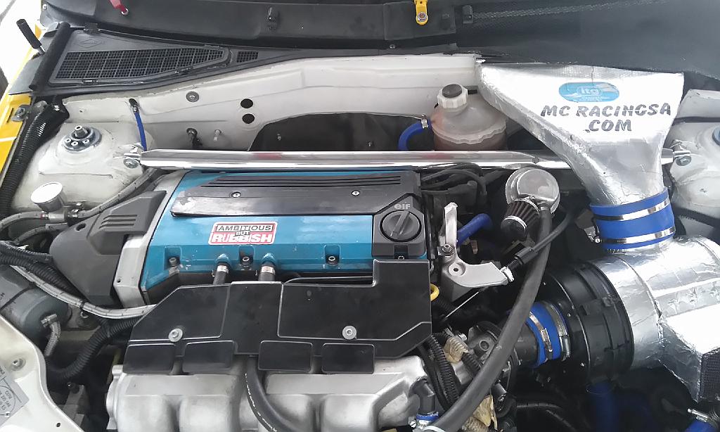

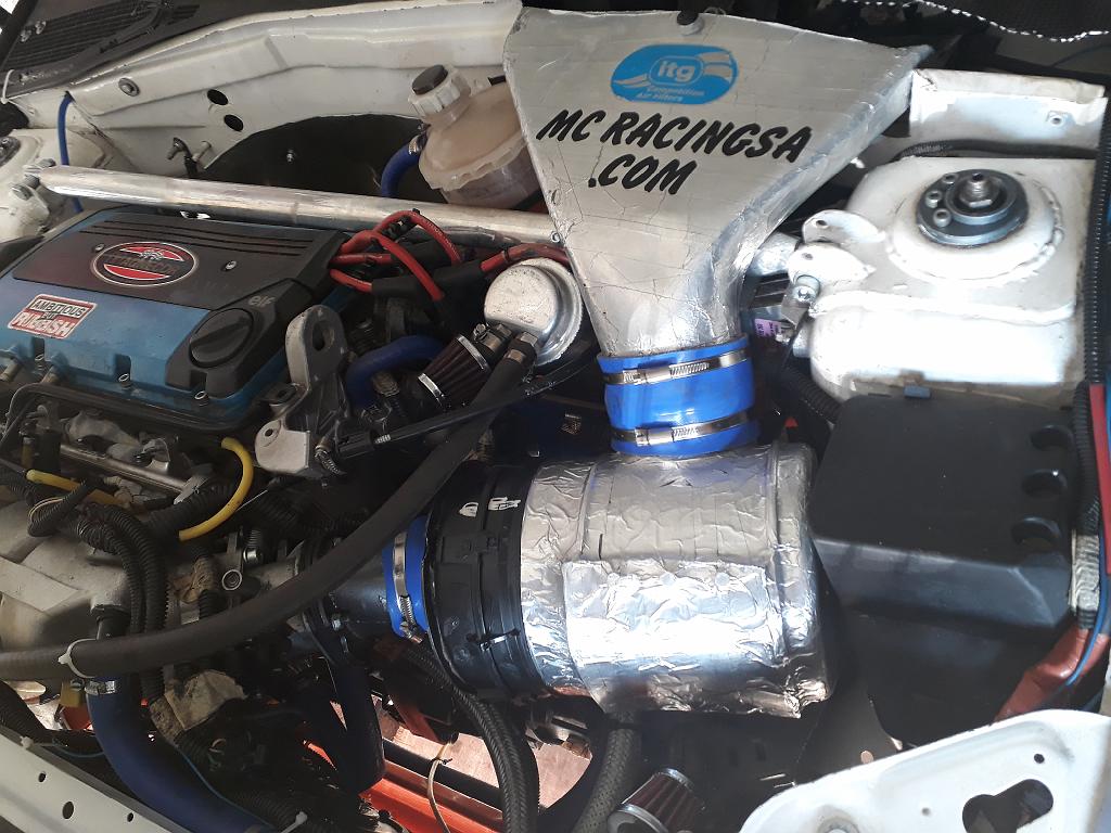

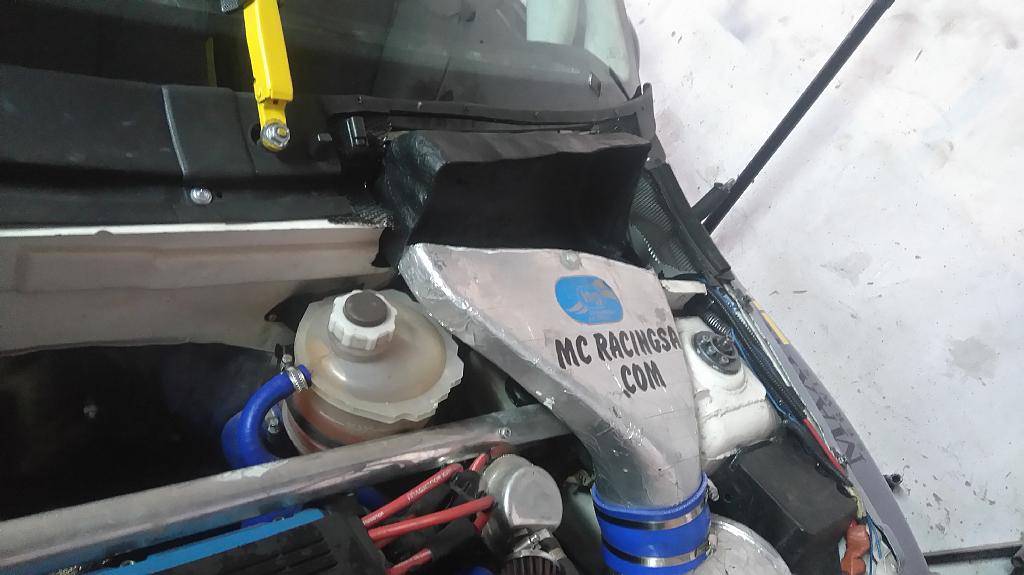

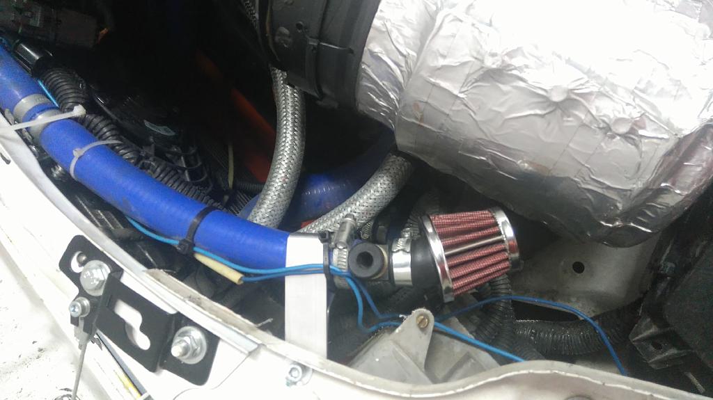

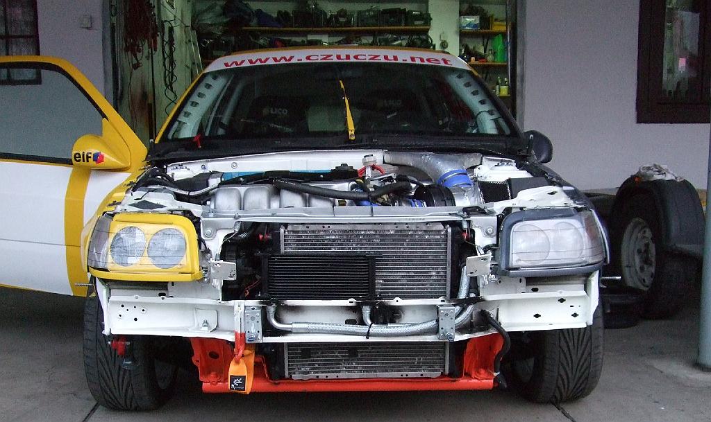

New cooler holes.
New air fed.

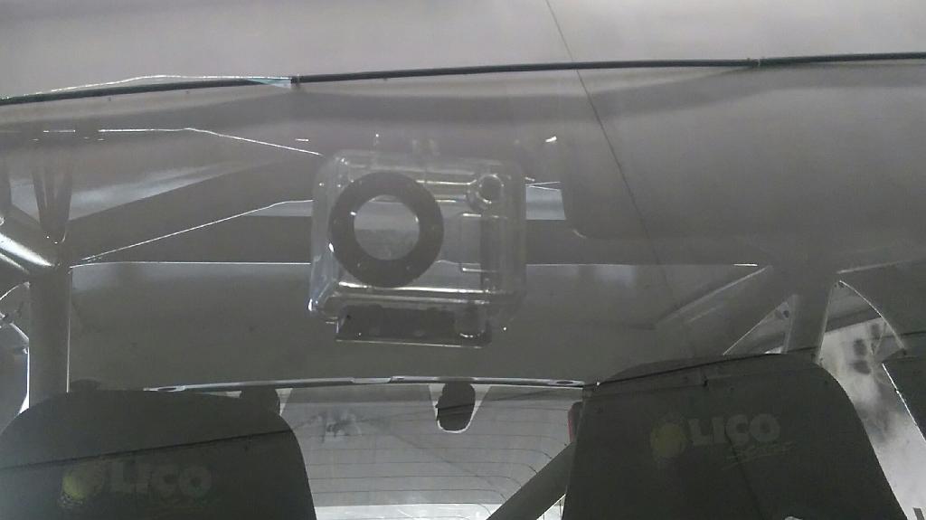

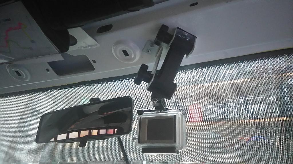

New GoPro mount.

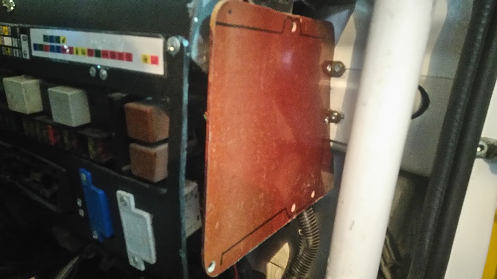

After the track i made a new computer mount.

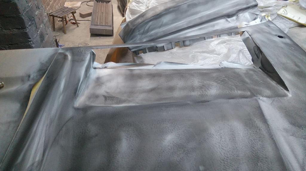

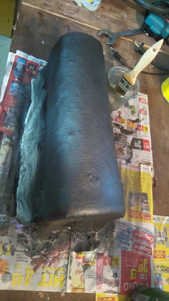

And I made a new air intake from the resin.

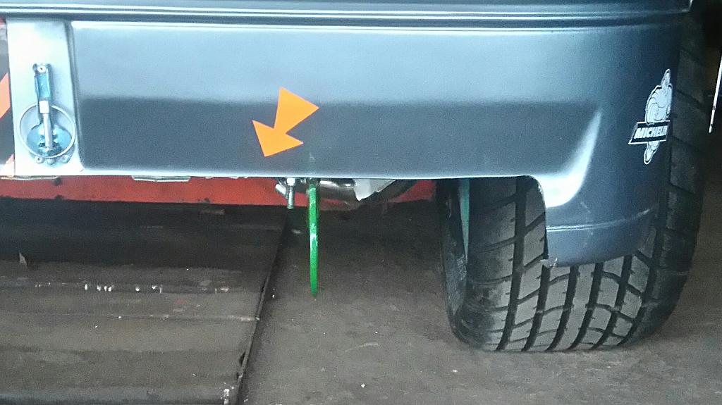

New exhaust heat shield

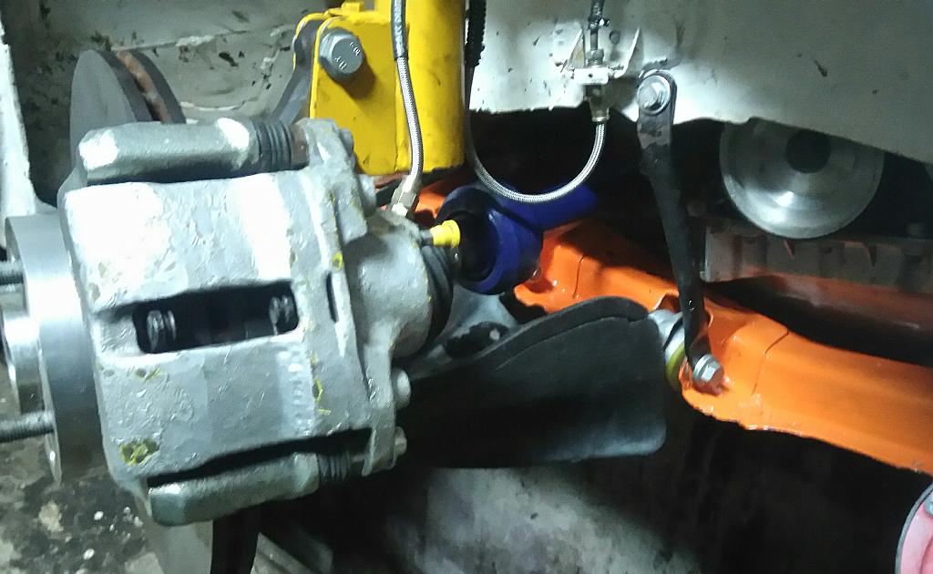

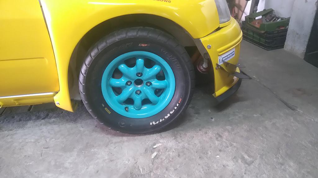

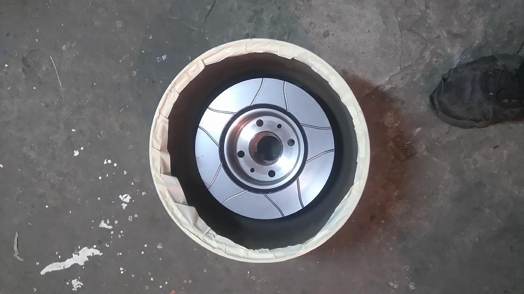

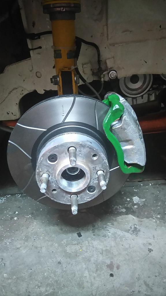

And i change the brakes from 285 to standard 259 discs, standard yokes, etc.

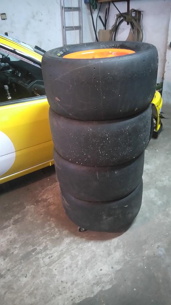

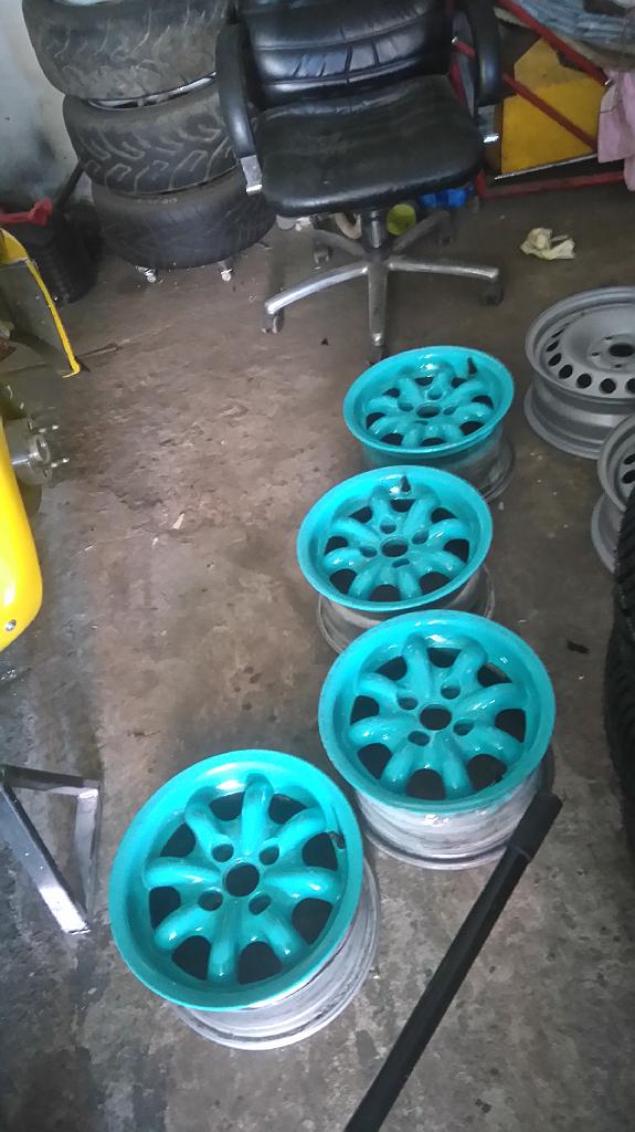

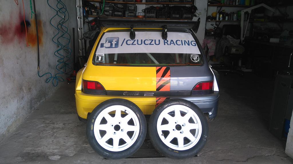

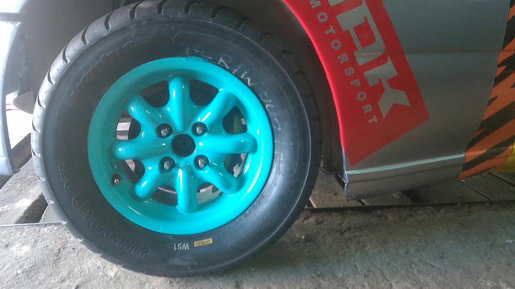

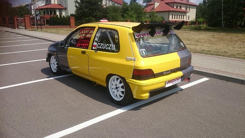

Almost new Hankook Wet's and slicks.

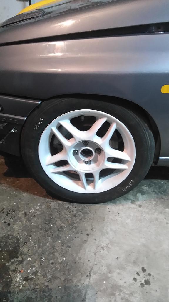

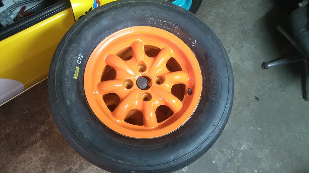

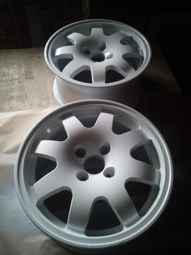

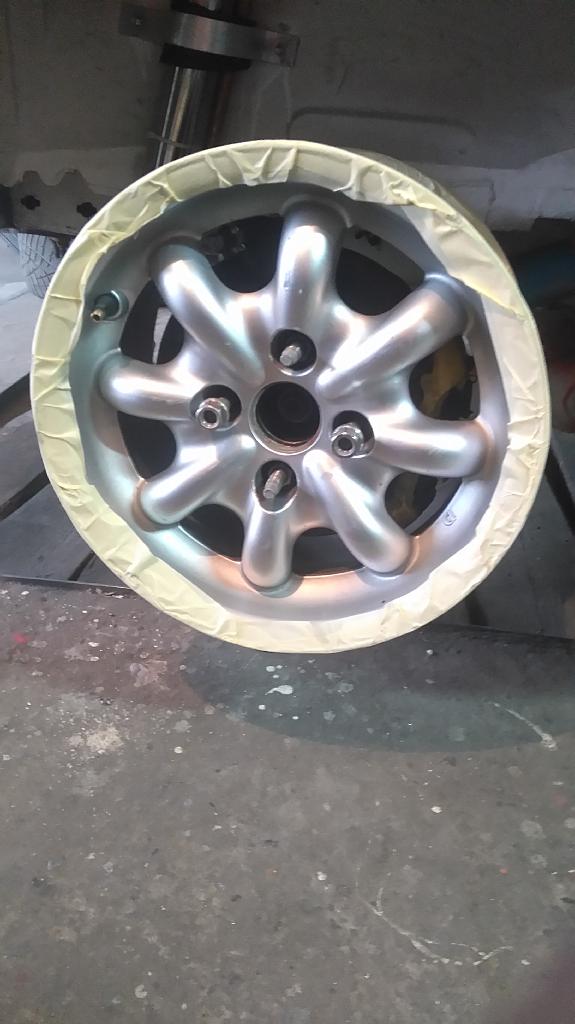

And first set of Intra wheels. ( from Honda )
And a second one.

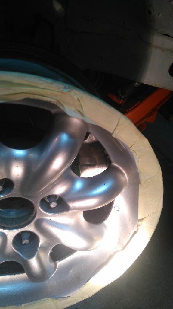

...painted by me. And wheels on car.

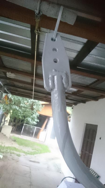

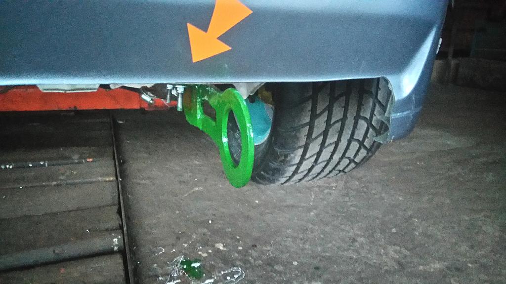

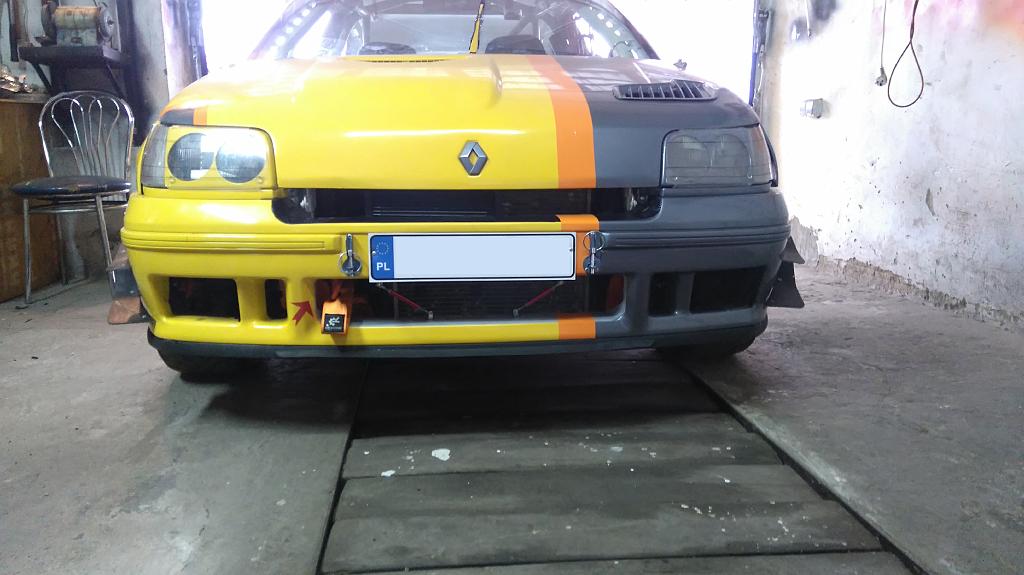

I screwed up the new tow hook attachment \.
